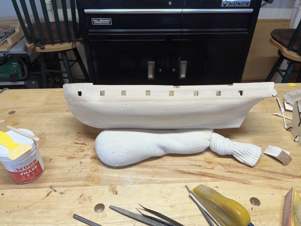

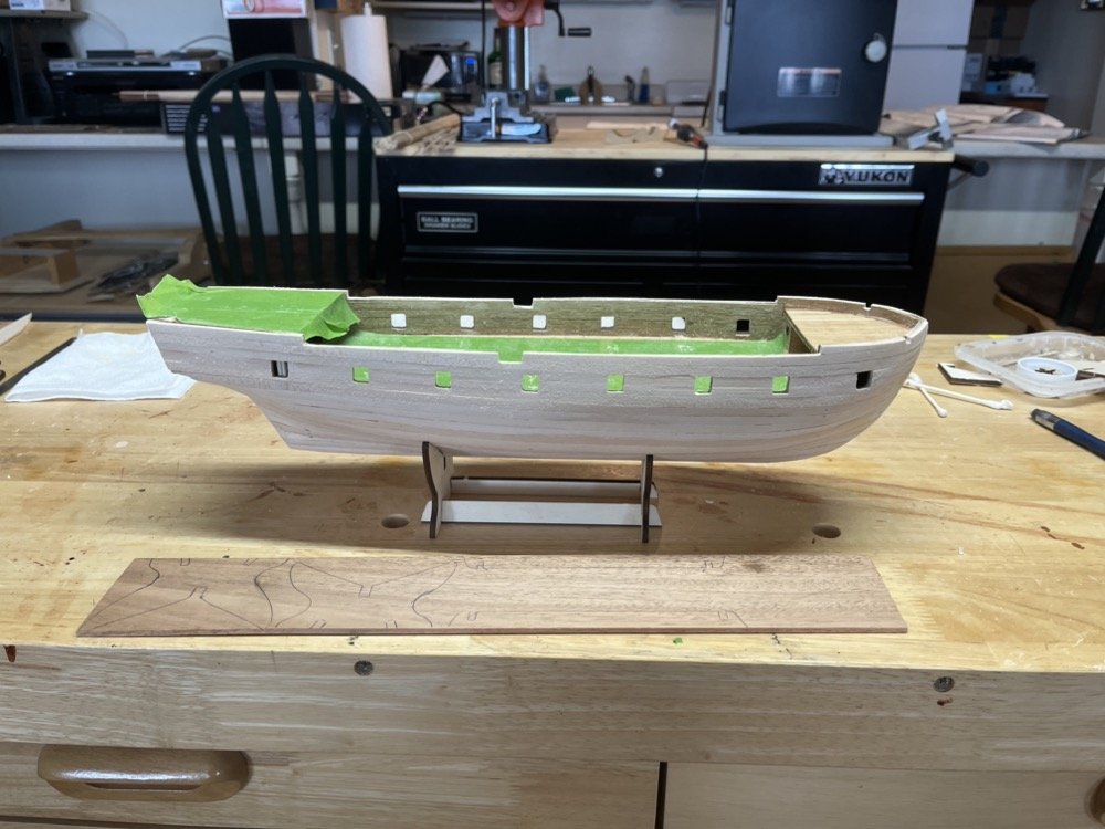

I have finished planking the rest of the hull and opened up the gun ports again. I gave the whole hull another rough sanding and shaped the planks at the stem and the transom. No wood filler applied yet but there are some areas I will be adding it.
I put together the supplied cradle which I will use as a working cradle. I did trace the pieces onto a sheet of mahogany, as you can see above, which I will cut out as use as the display cradle.
I spent some time cleaning up the transom so that the transom piece will fit without leaving gaps around it.

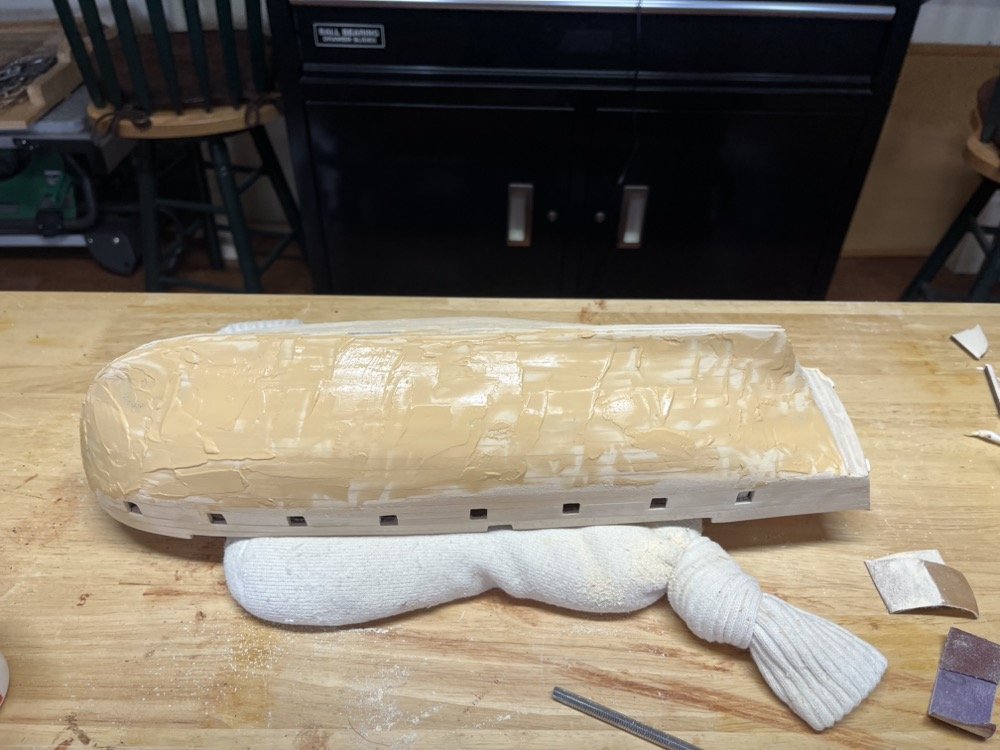

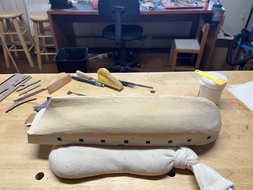

I fit the stem, keel and stern post and did some more sanding of the hull to get them to fit well. I then bought some thin wood filler, which is very creamy. It goes on orange but becomes natural after drying. I coated the hull below the bulwarks on both sides.
I sanded most of it off and it left a very smooth surface while still showing the individual planks. I then repeated the process on the bulwarks.
At this point I think the hull is ready to move on, after I clean up all the dust.

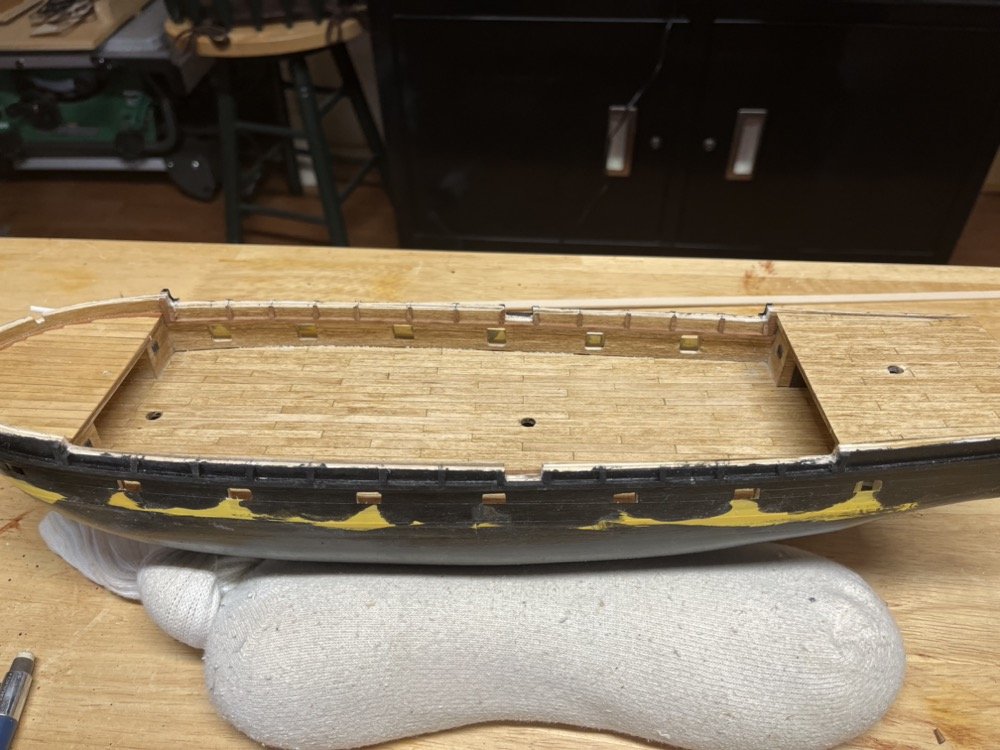

I cleaned up the hull using compressed air and mineral spirits. I ended up giving the decks another coat of oak stain and wipe on poly after I cleaned up the scratches from opening up the gun ports. I bent two pieces of 2mm square basswood for the upper rails and glued them on.
The instructions say to put on two more rails like these but the AOS Beagle book shows wider and thinner wales where the third rail should go. I have bent some 1/4" x 1/32" basswood to use for these wales but before I put them on and the middle rail, I am going to mask off and paint the white strip since the middle rail and wale are the boundary between the white stripe and black upper and lower sections. I can get a much better transition line if I add the rail and wale after painting the hull and I can paint them off the model.

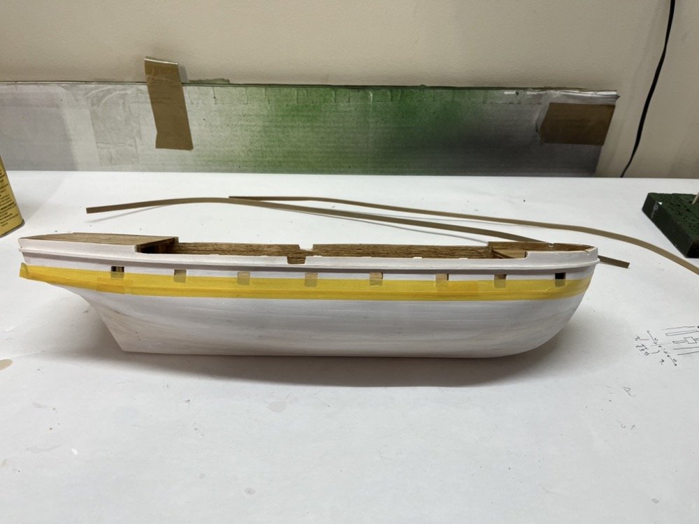

I painted the area of the white stripe and then masked it off for the black areas.
I painted the areas above and below the white stripe black as well as the bent strips for the wales. I then added the small triangular pieces between the top rail top of the bulwarks. I first glued rectangular pieces on then filed and sanded them to triangles. This worked well but I had to be careful not to mar the black top rail. After giving the black areas another coat of black paint, and while the white stripe was still masked off, I glued the inside rails on and added the triangular pieces on the inside. For these I cut the rectangular pieces then used a razor blade to cut them on an angle making two triangular pieces. In most cases I used only one of the halves but for some I was able to use both halves.
I need to finish up the inside trim pieces then remove the masking tape and add the second outside rail and the wales. I am also making the hammock cranes now that I have enough 0.7mm brass tube. I am using thin CA to hold them together, but I still plan to blacken them and will touch up any areas that don't blacken well with some black enamel paint.

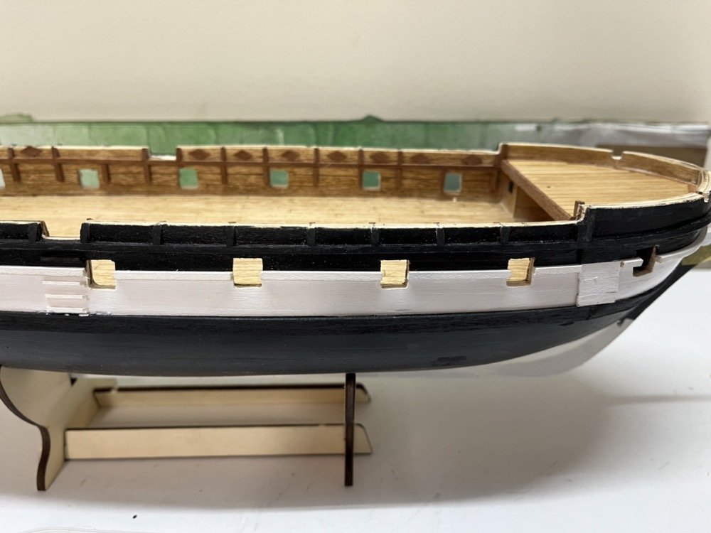

While I still had the masking tape on the outside of the hull, I finished adding the small detail pieces to the insides of the bulwarks, including the small diamond shapes and the vertical pieces.
I then removed the masking tape and touched up the white stripe a little bit.
The next step was to add the second white rail at the top of the white stripe. On the side shown I added these in sections between the gun ports, but on the other side I added the rail as one long piece and used an X-Acto saw blade to trim them at the gun ports, which came out better in my opinion. I then started adding the wales at the bottom of the white stripe, starting in the middle and working toward the bow and stern.
As you can see in the above photo, I ended up replacing the bow sections with pieces that had more of a downward bend so they didn't curve up too much at the stem. I need to clean up and repaint the joint which should hide the fact that it is two pieces.

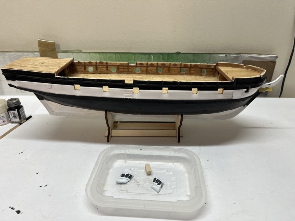

The state of the outer hull is coming along. A little more touch up painting to do. I added the anchor boards (is there a better name for these?) and the side steps which are not in the kit instructions. I glued a 1/16" and a 1/32" square piece of basswood together then cut the steps out at an angle. I trimmed the wales so the false quarter galleries will fit, then started painting the supplied metal galleries. I am using grey paint on the windows to distinguish them from the frames.

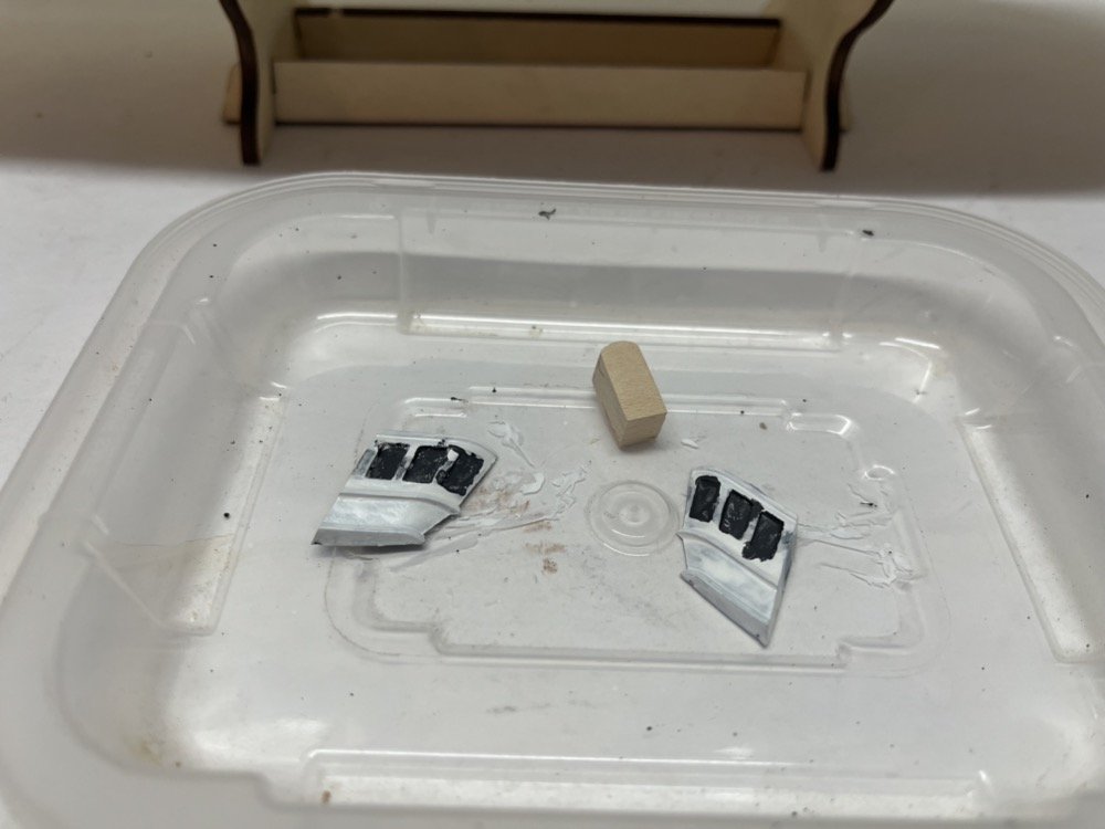

I made up the entry port sides using some basswood sheet. I made five pieces then glued them together so I could shape them all at the same time. I then used alcohol to separate  them. I am also working on the cat heads, fore deck and quarter deck rails, and the bow pin rail, which I am making from scratch because the supplied one has huge holes for the supplied belaying pins, but I am using smaller pins. I am also going to add the 4 sieves in the side of the hull for the fore and main sail rigging, which are not shown on the kit instructions, unless they are shown in the rigging section.

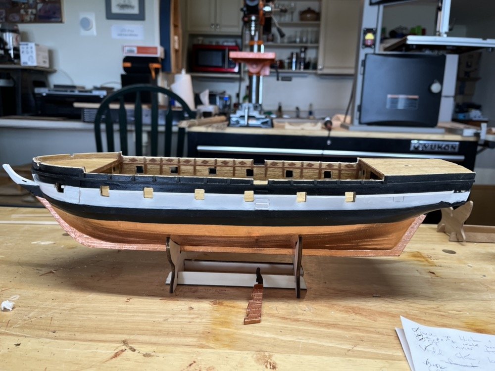

I coppered the hull and the rudder using 1/4" copper tape. For most of the hull I used whole strips with the plates marked out with a ponce wheel. For the top two rows I used individual plates around the curves.
Next I will mount the rudder then add the transom piece and plank it.
