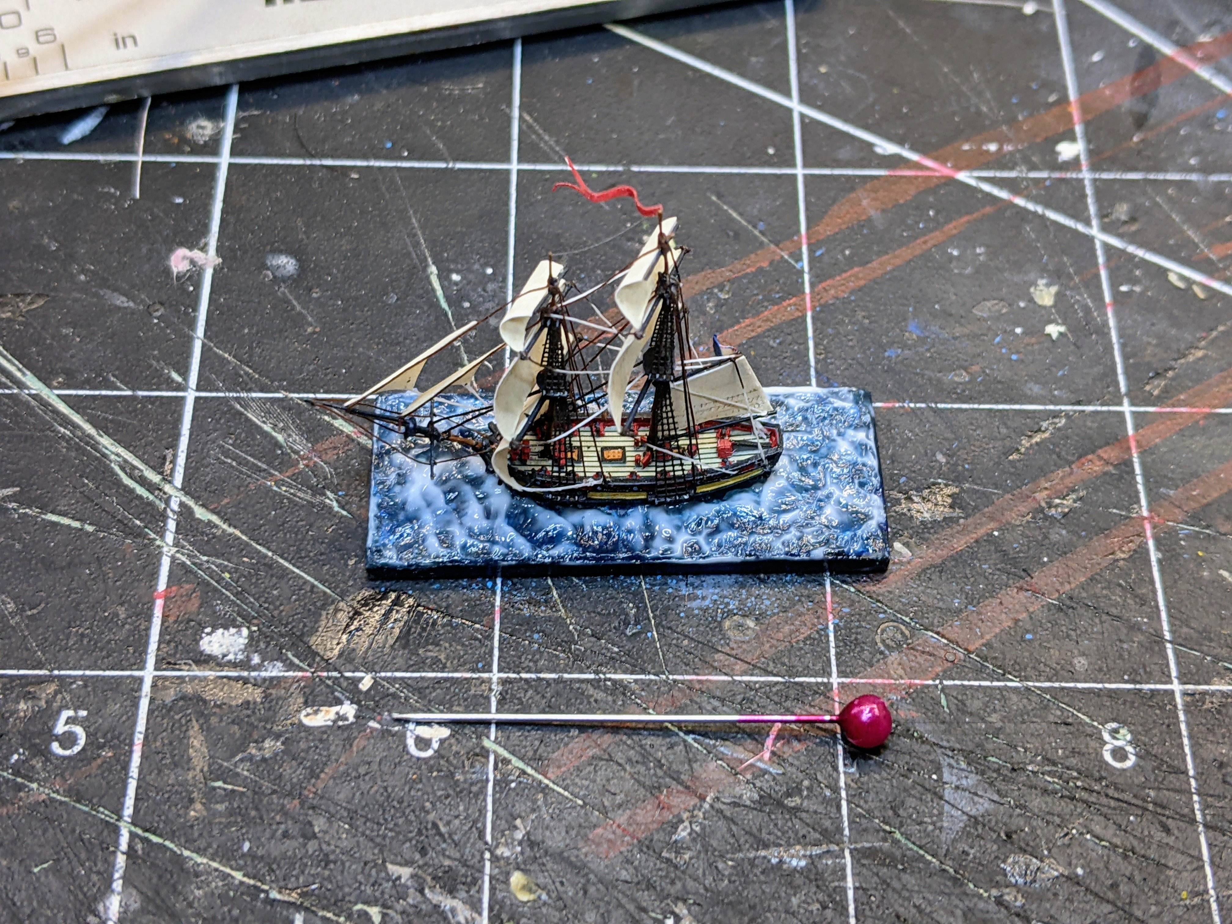

After painting the hull, the next step was to paint the seascape and attach the masts. Before glueing the masts in place I painted the bottom masts as accessing this area will be hard once they are in place.
The seascape I painted in a similar manner as previously discussed. I first laid down a thick layer of may darkest colour (dark sea blue) and then started wet blending in increasingly lighter blues to create contrast and the illusion of depth. I focused the lightest colours on the tops of the swells, the area around the hull and the wake. At this point the sea is done until I varnish the miniature as I don’t want to add the final water effects until everything else is in place.

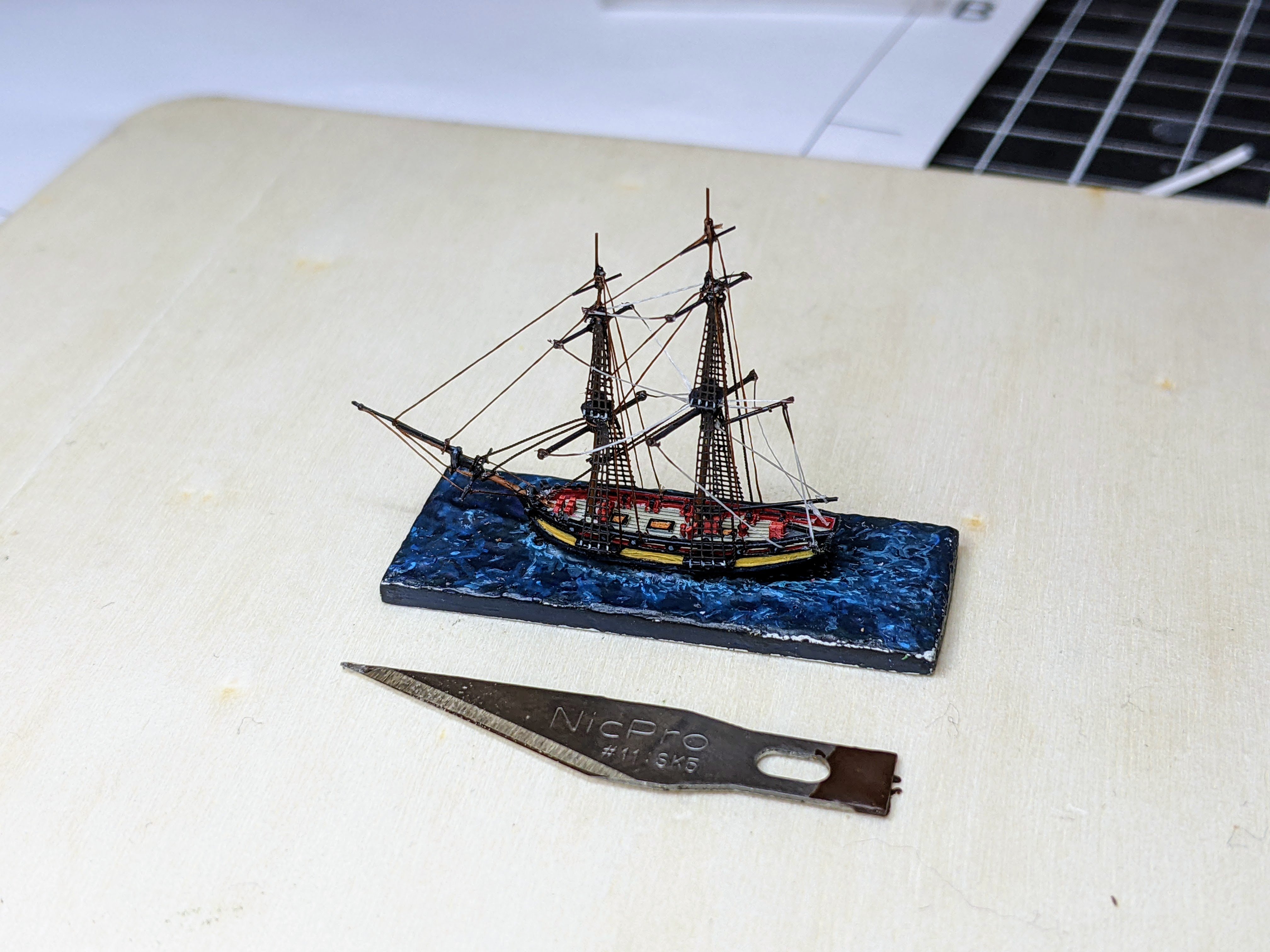

The picture below shows the current state of affairs. I have all the standing rigging done as well as the main braces and the running rigging for the boom and gaff. You may notice some damage which is inevitable when doing the rigging. Once everything is done I will go back with the paintbrush to touch up any problem areas.
I have decided that I will restrict myself to braces and sheets for the running rigging. This is enough to give a taste of things without making them too complicated. I have also been using a trick of painting parts of the white rigging brown to simulate pendants.

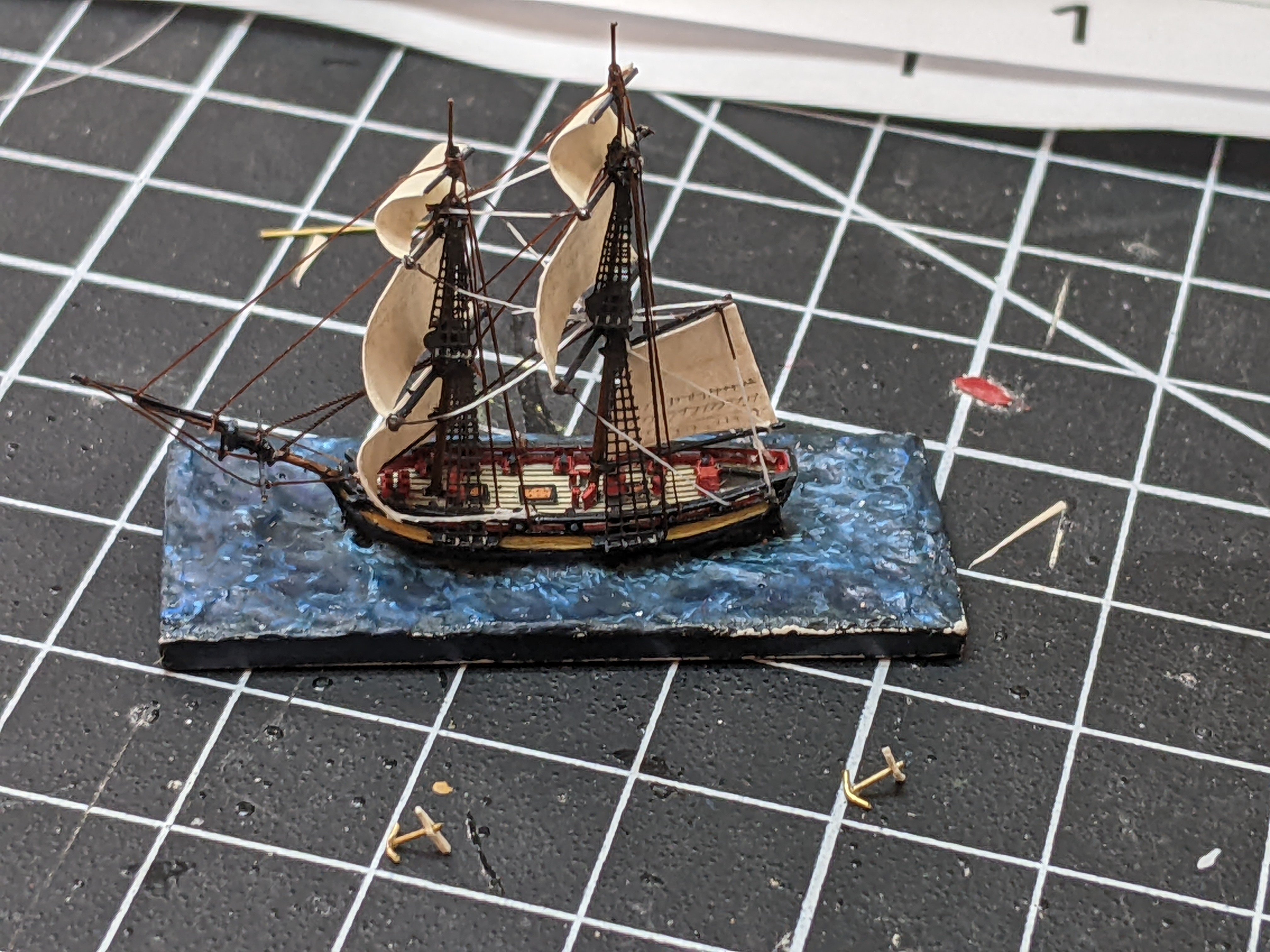

With the rigging done it was time to move on to the sails. For them I used the same paper I used for the cutters. I drew the reinforcements with a 6h pencil to keep the markings light and also used the pencil to mark the reef lines. At this point I also decided that I would go ahead and do anchors. This was the same method as I detailed for the cutters, but much smaller. Steel calls for 3 anchors for a brig, but I dropped one on the floor and couldn’t find it. I decided to just say that one was lost in a storm rather than make it over.
You can see the anchors before they were painted and glued onto the model just below the ship. Unfortunately you can also see where I used too much super glue on the sheet for the foresail. At normal viewing distances it is fine, but up close it looks a little rough. Unfortunately not much I can do about it. I tried to remove it, but couldn’t without risking damage to the rest of the model.

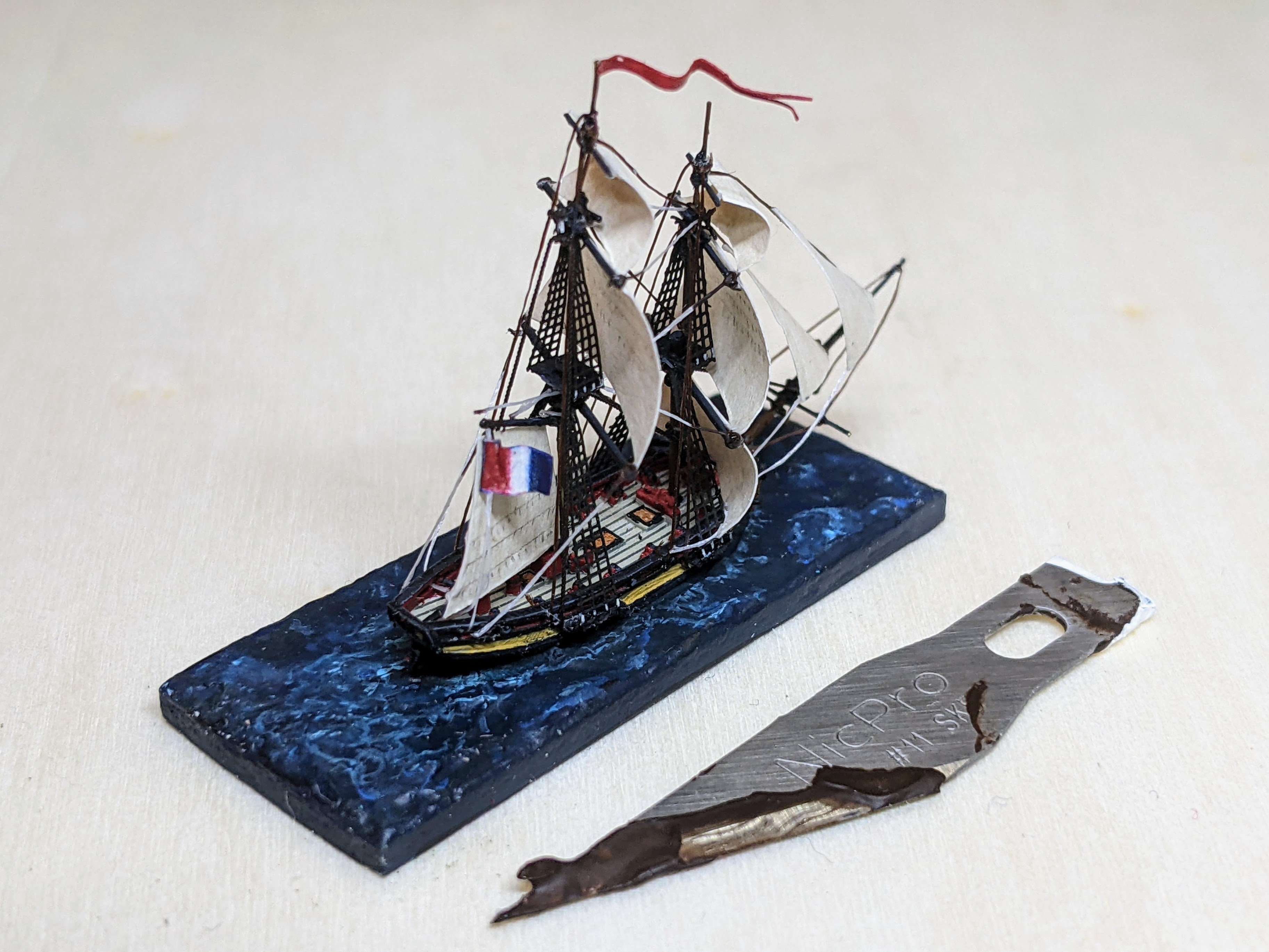

1/1200 Vigilant Class Brig - Finished
It has been a while since I updated this log as the vigilant class brig was sitting in limbo waiting on me to get around to varnishing it. Since these pieces are intended for gaming, it is important that a protective layer is applied over the whole model. This also helps to stiffen and strengthen the rigging and the sails as well as protecting them from the natural oils on your fingers. I used satin varnish as I want the colours to pop somewhat and we are at such a small scale that I felt matt varnish would render things too dull.

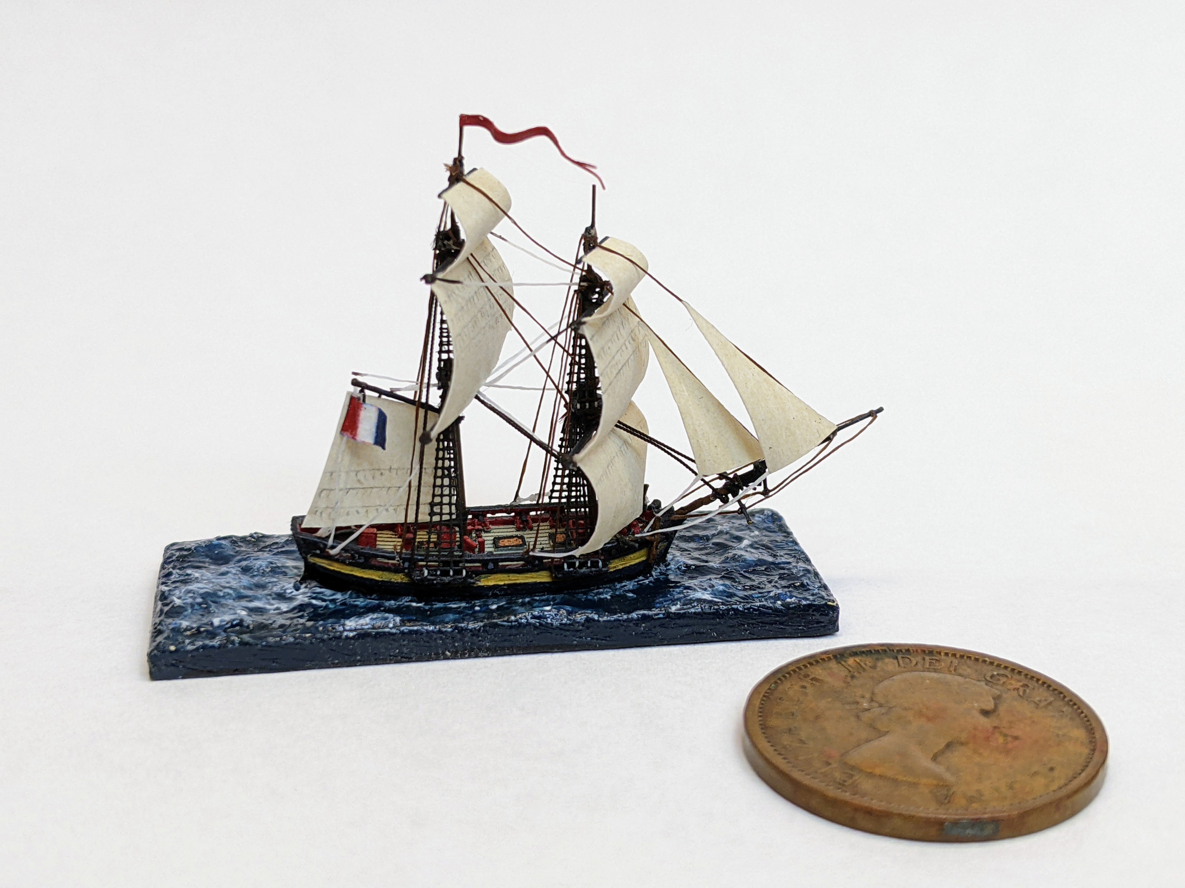

Once the vanish was on, it was time to apply the water effects. First I used a small flat head paint brush to dab on the water effects. I am using vallejo transparent water for this. The paste appears white when added and then dries clear. The dabbing of the paint brush causes it to sit in peaks and valleys which gives the impression of smaller waves.
Once this has fully dried, I mix some white ink with a little bit of the water effects and go back in with the smallest paintbrush I have to pick out the crests of waves and paint in some of the foam at the bow and in the wake.
And with that the model is finished. You can see it below with a penny for scale.
