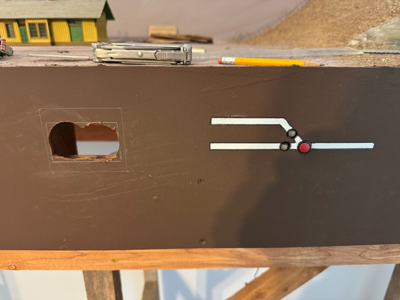

Looks like it's coming along really well.  Your turnout controls, their not tortoise switch machines, so what brand are they?  Are they servos?  Seen them but never used them.  I use Caboose Industries manual switch stand for my switching layout.  Backdrop looks great too.  Bet you can't wait to get trains running 🙂.

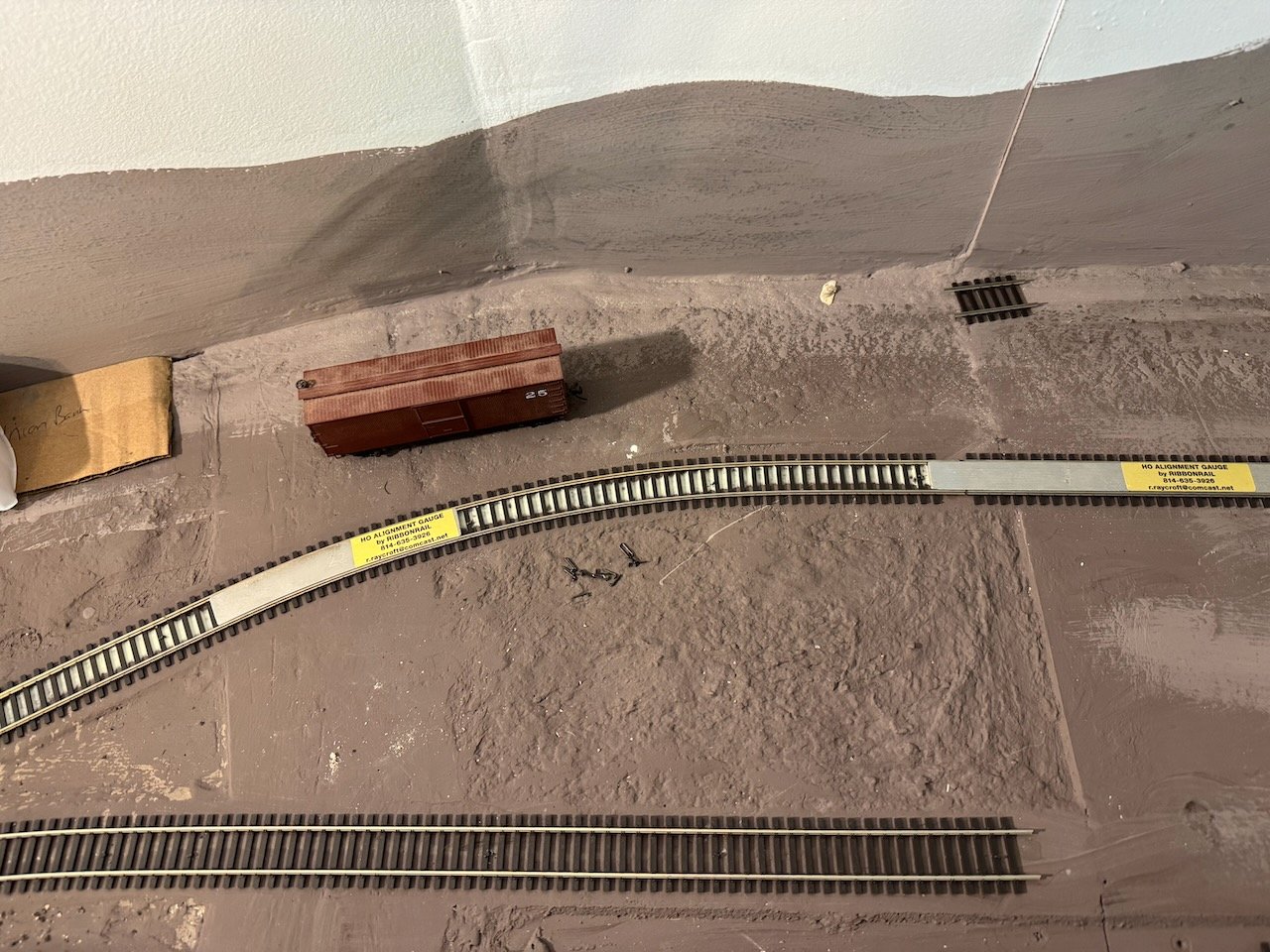

3 hours ago, Canute said:
I'm with Richard's vote. The tape is quicker to lay out, but it will dry out and curl (been there). Your module looks great.
My leaning was also the painted version, both for permanence and appearance (I think the thicker lines look a little child-like and overdone). As Rik said, harder to get right in the first place but worth it in the long run. And I could always paint wider stripes but I like the thin ones.

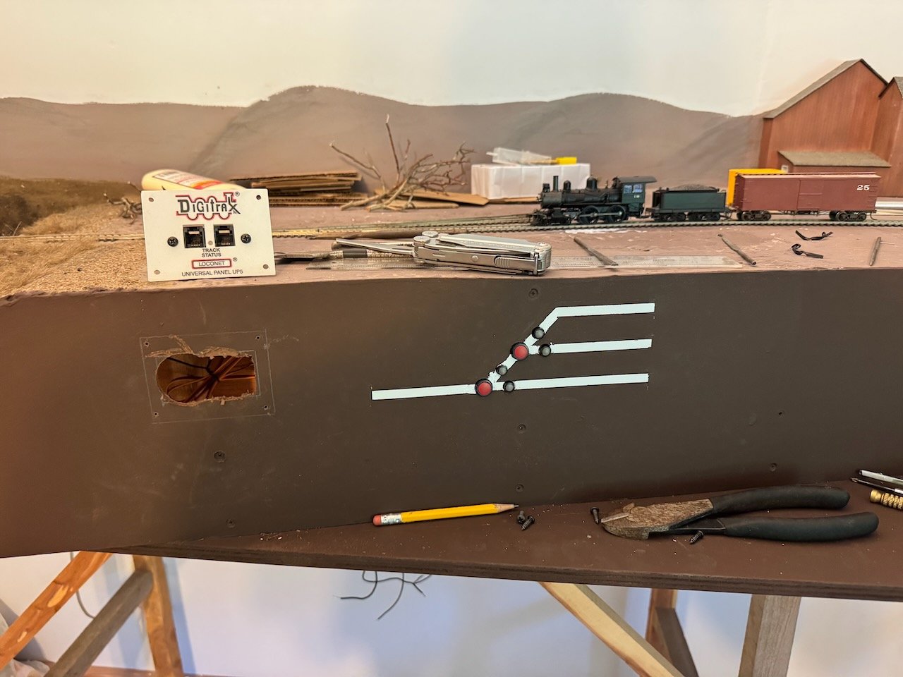

I'm using the turnout control system made by Walthers. I've used the Caboose manual throws before but I'm not a big fan of their out-of-scale appearance and I just felt they weren't entirely reliable. Plus, the fascia controls give operators a better sense of how routes are lined, potentially avoiding mistakes. Especially on something with a through-running mainline as opposed to a switching layout where the manual controls make more sense.

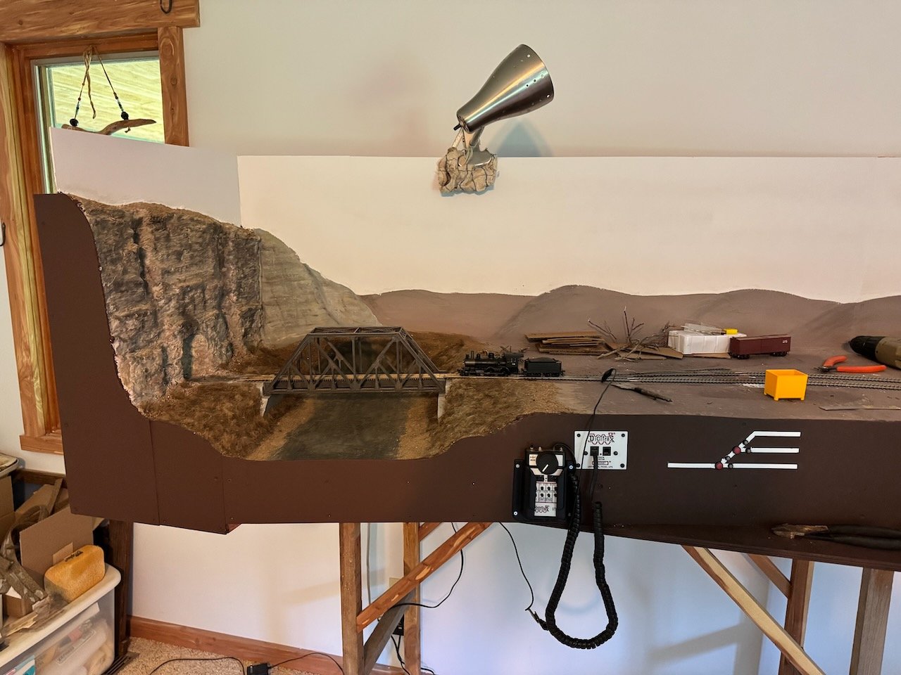

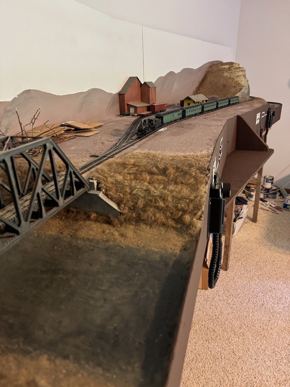

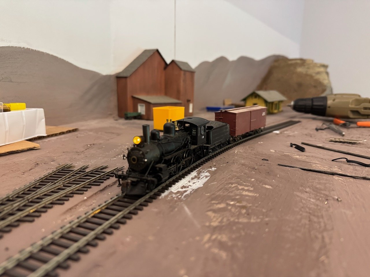

Yesterday featured a landmark occurrence: the first movement of a train on this project:

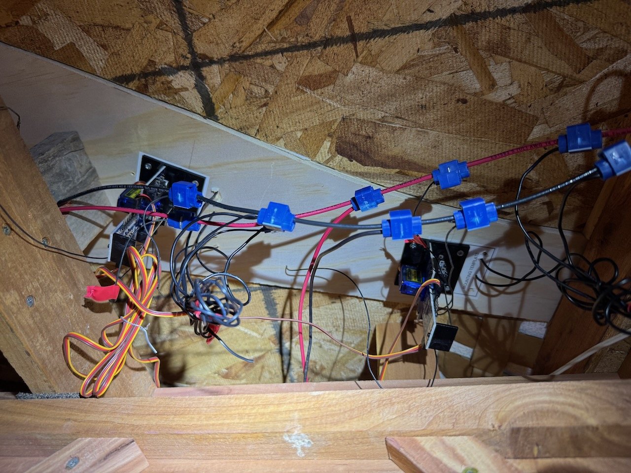

OK, fine, it was just a quick electrical test of the first bits of track laid. But it was still a very exciting moment! This locomotive is sound-equipped, and the huffing of exhaust along with a triumphant whistle blast brought Mrs. Cathead in to see what was going on. Here's a broader view:
I really hate doing electrical work, it's easily my least favorite thing about model railroading. But it needs to be done so I'm doing it. I already showed the turnout controls; another step was to install the panels where locomotive throttles plug in. These involve drilling out rough holes in the fascia to accomodate the circuitry behind these panels, them screwing them in place. You'll also notice that the left-hand track diagram is now painted instead of taped, as agreed on by the community.

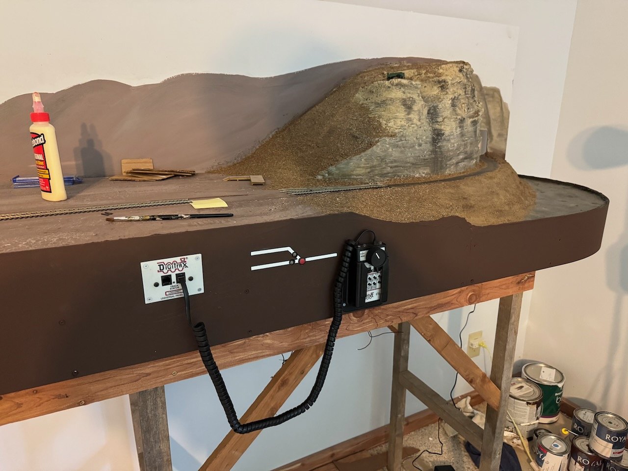

I then installed throttle holsters as well. So now the front-facing part of the electrical work is done, and it's time to start doing all the fiddly under-layout wiring along with additional tracklaying. I've already found something I need to troubleshoot and hope I can figure out. Did I mention that I hate electrical work? But the good news is that it directly leads to some really fun stuff (operating trains).

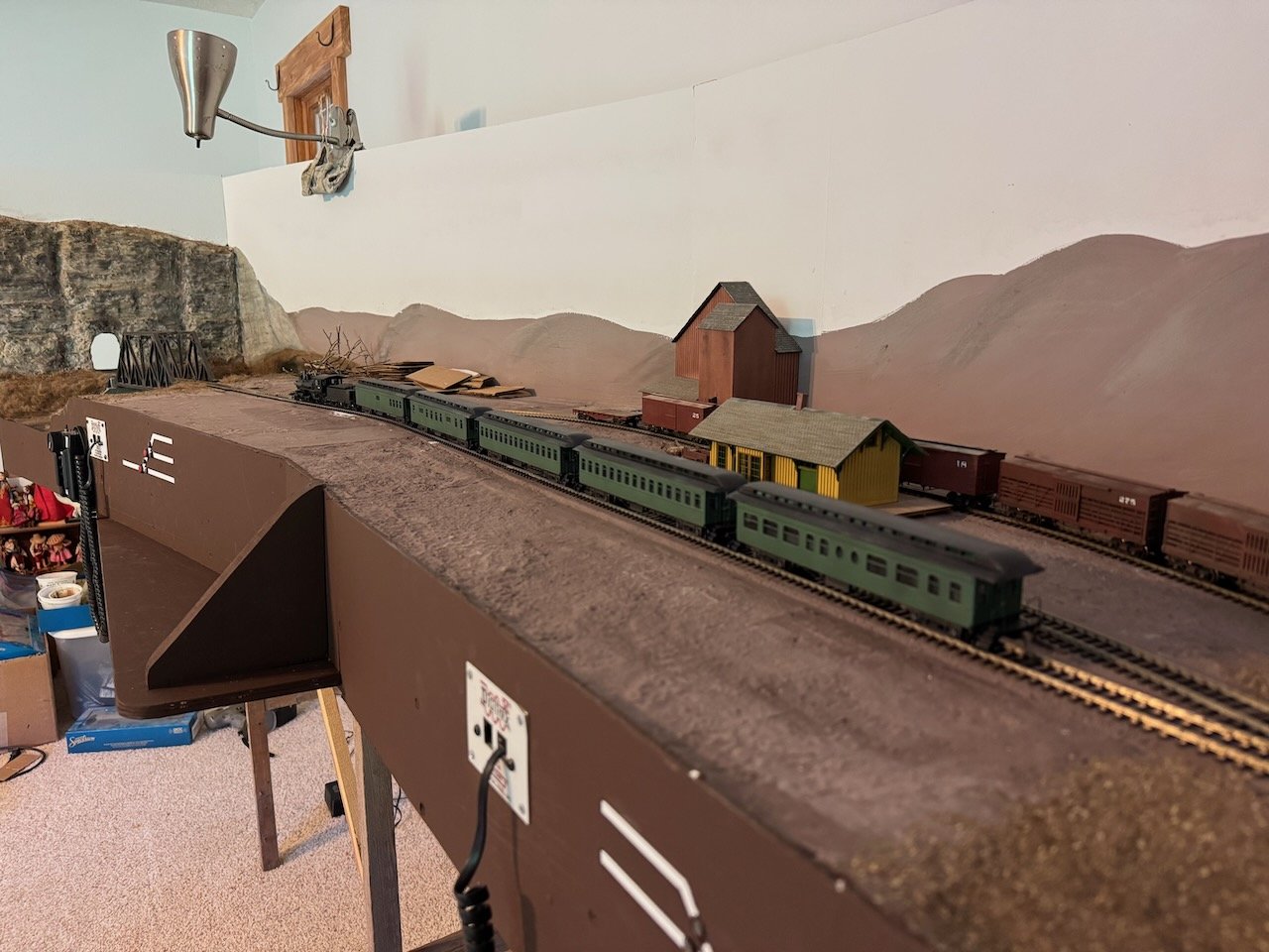

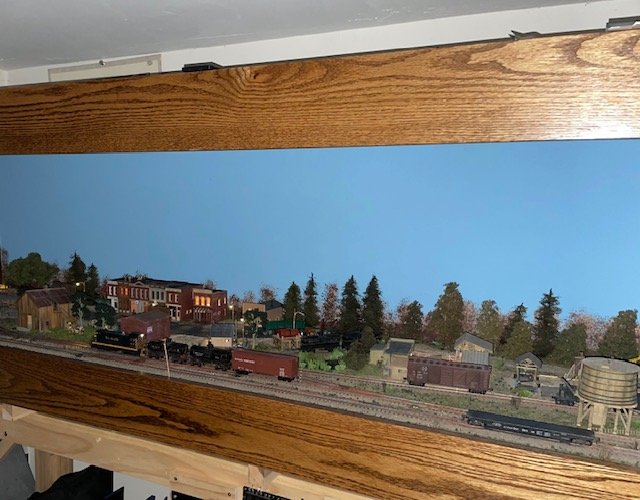

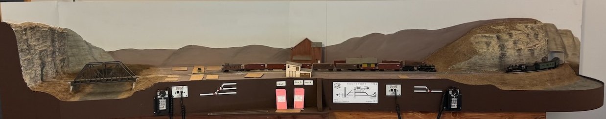

A few more status shots. It really is starting to look "official" with the fascia infrastructure near completion.
And one final shot down the tracks:
Edited by Cathead

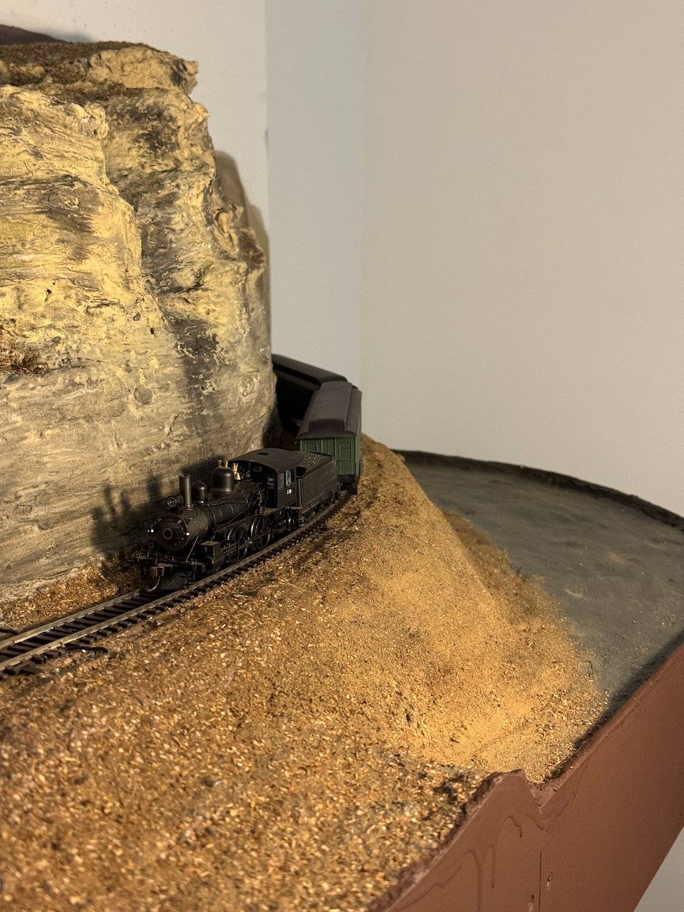

It's really coming together well, Eric. At some point I hope we'll get an audio clip.

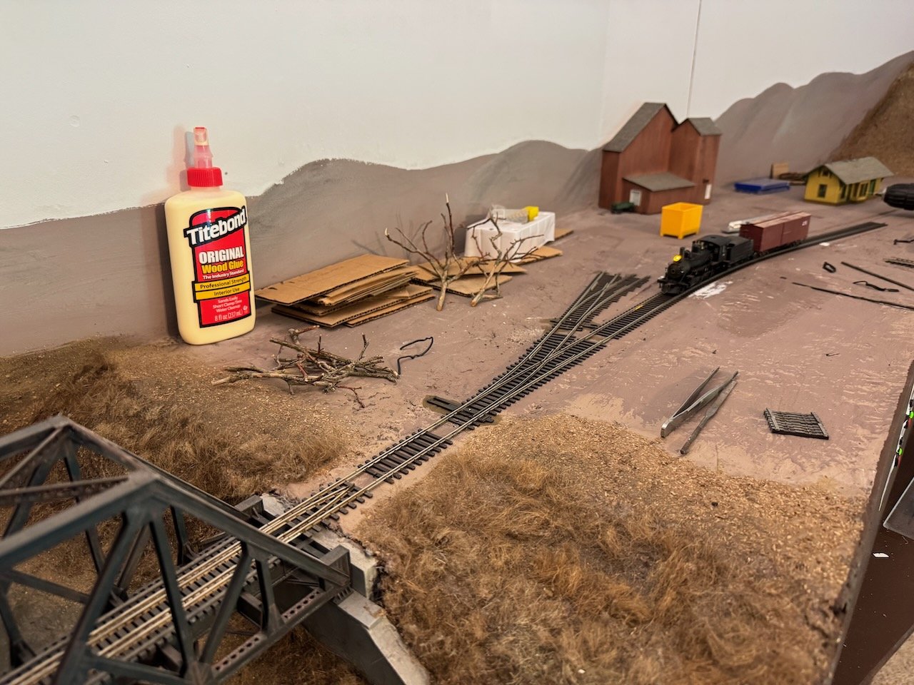

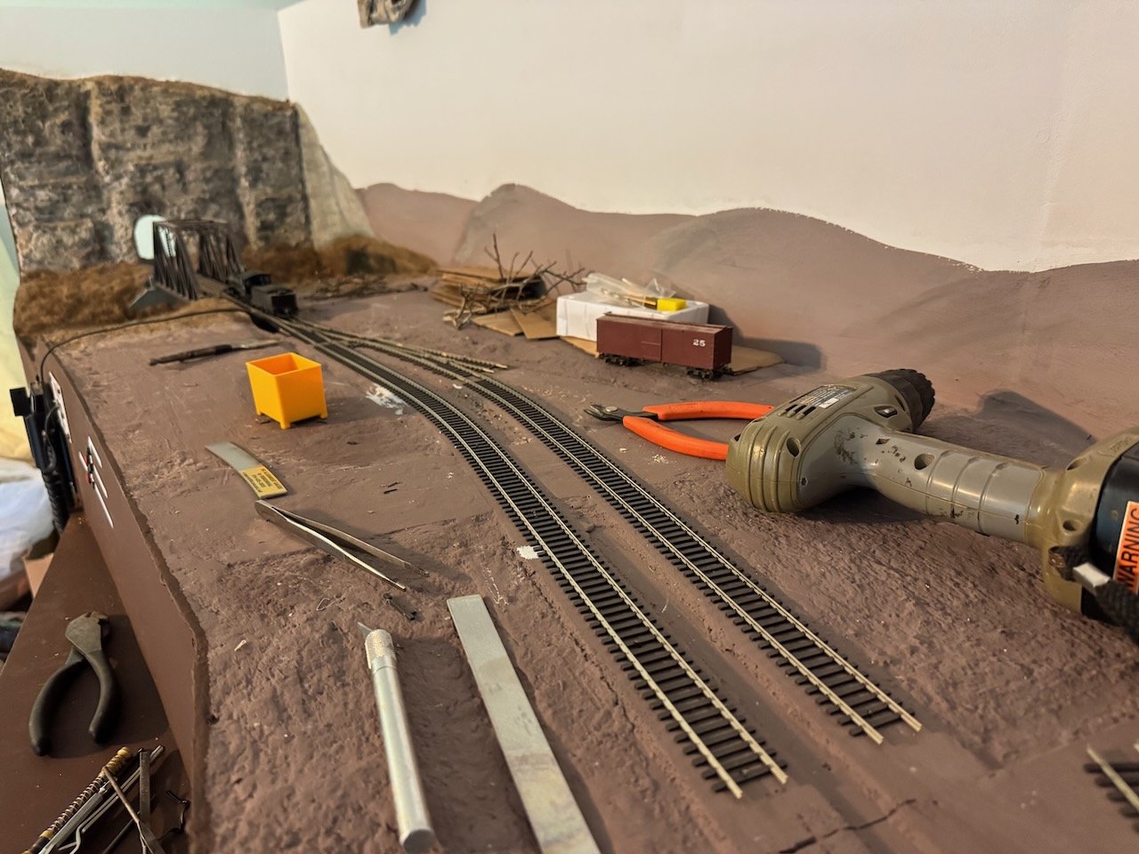

I continued on track-laying and wiring for part of today. Here's what the wiring under the two west-end turnouts looks like. It's not as scary or chaotic as it seems, like wires are actually neatly bundled together and nothing's soldered, meaning it's easy to adjust if needed. Thick black and red wires are the bus wires that carry main track power, smaller wires branching off from them carry power to individual track feeders, and yellow/brown/orange wires are the control wires for the turnouts. This is by far the most complicated section because of the turnouts and the throttle panel.
Here's a detail of track laying. I lay a thin smear of glue down on the roadbed, then use these nifty metal track spacers to set consistent curves or straight runs; these hold the flexible track in the right shape while I use a few small spikes to hold the track down until the glue dries.

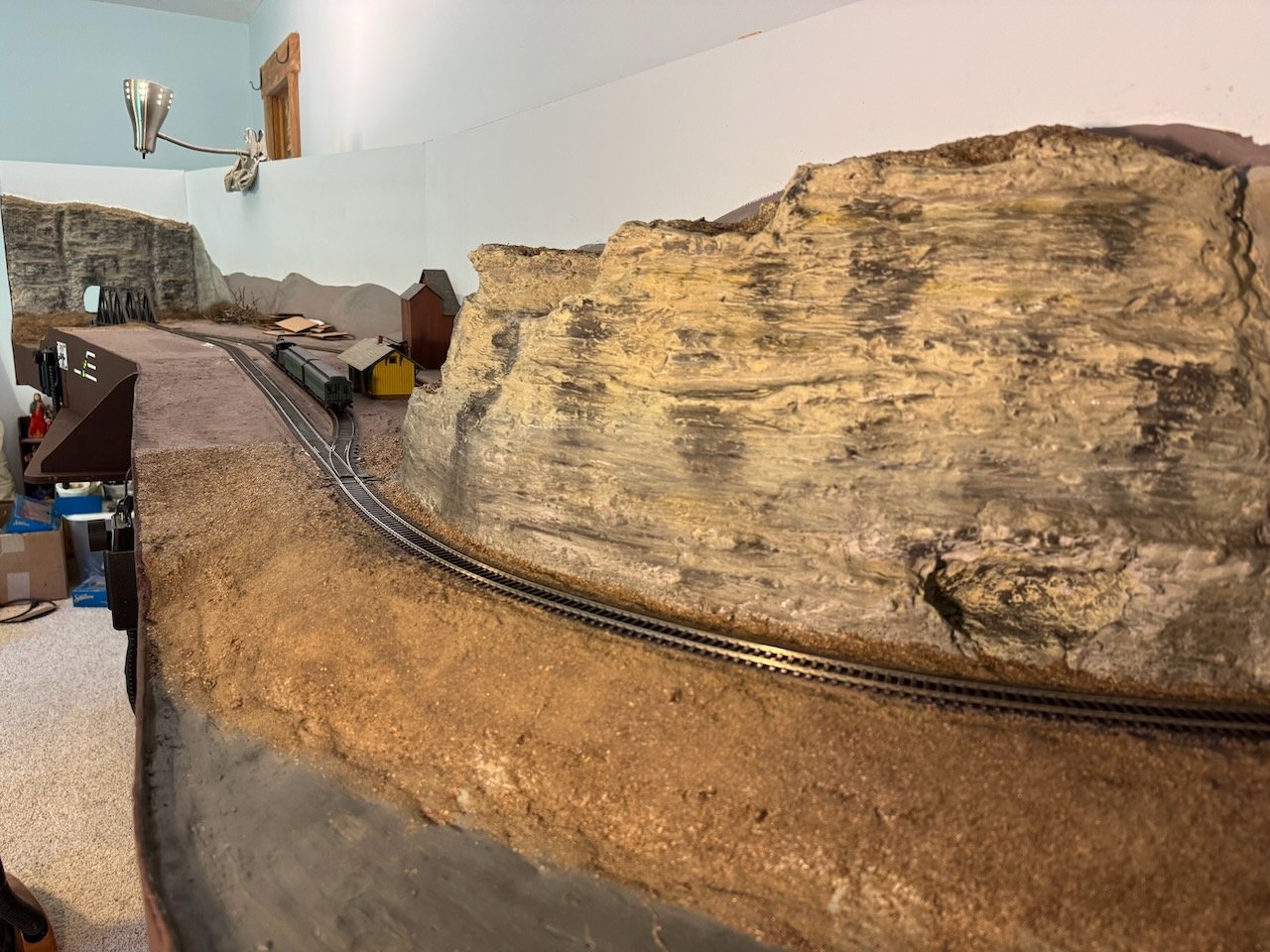

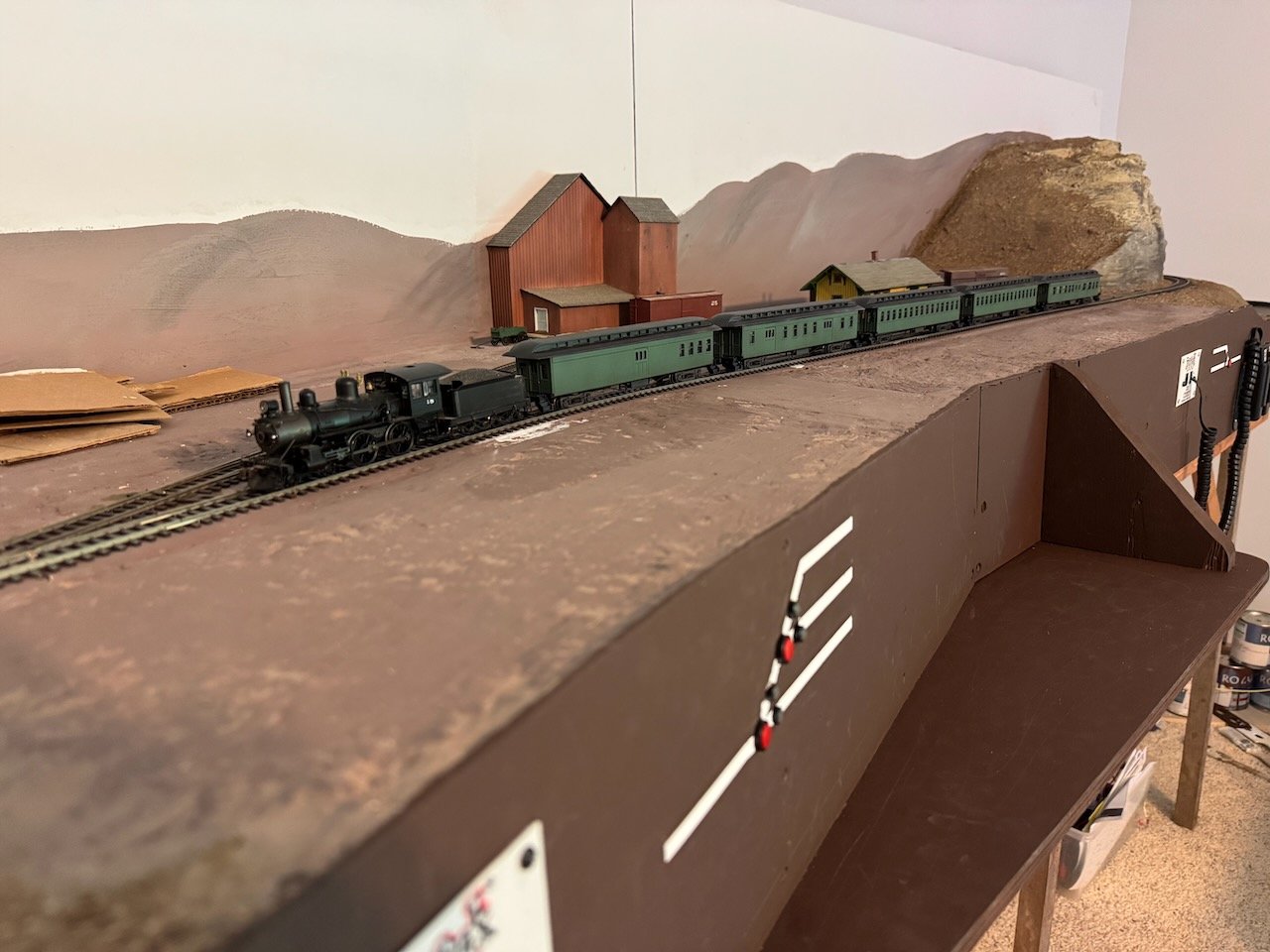

And the really cool news is that the track-laying and wiring are all done! After a small amount of trouble-shooting, everything appears to work smoothly and I can operate all across the layout. It's super-exciting. In celebration, here are some broader context shots with more trains staged for appearance.
It's so cool to reach this stage. It'll be back to scenery for a while now, but I can actually run trains!

EDIT: I forgot to add this image, which is a first rough take on recreating the historic photo that inspired this whole project. Pretty cool!
The actual location of the real shot is actually west of the tunnel (layout left), so it'll appear if/when I extend this to the next module. The layout shot is actually along the bluffs in the background of the historic shot, just east (layout right) of Rocheport. But it's close enough!

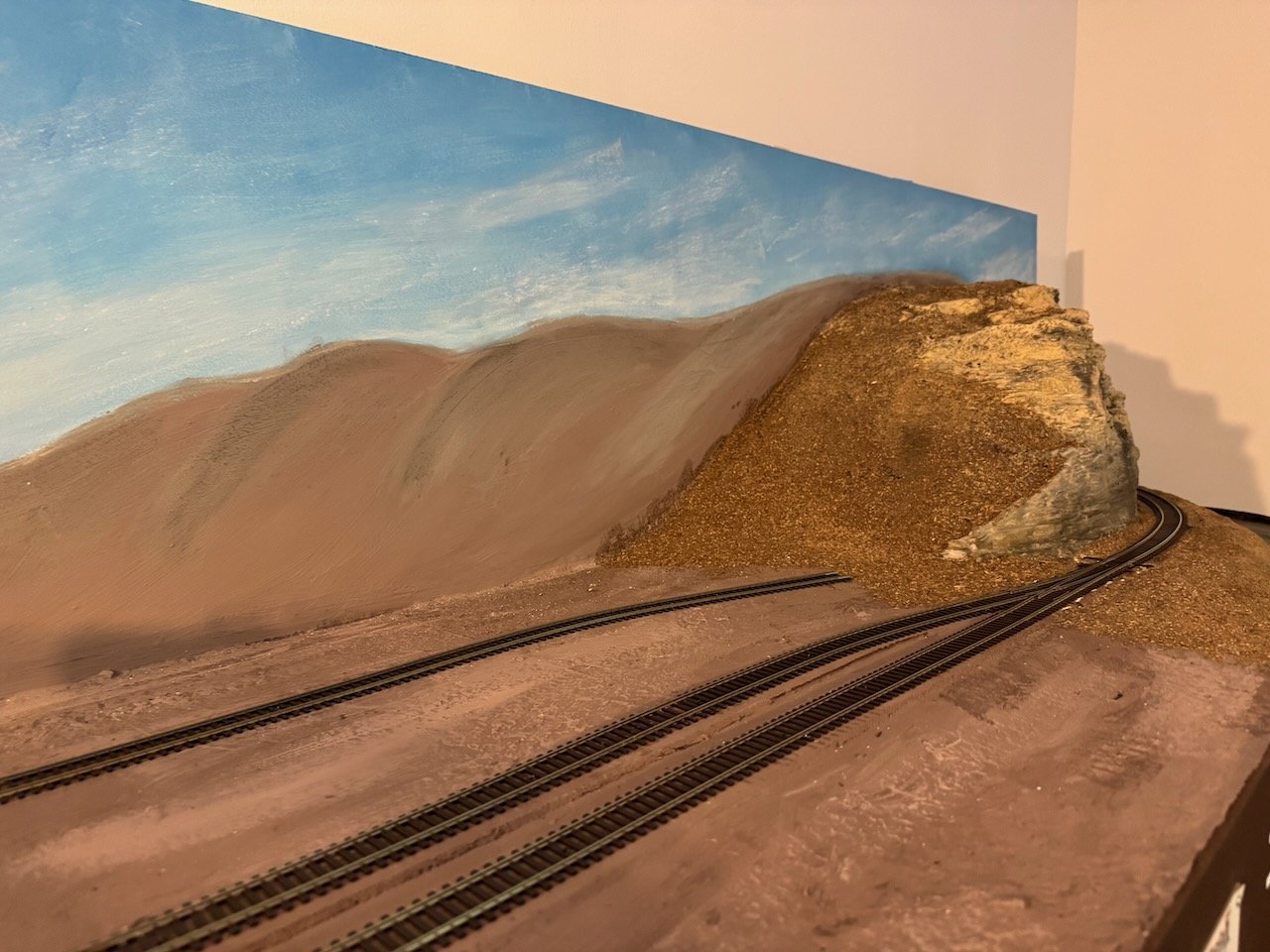

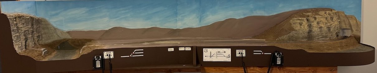

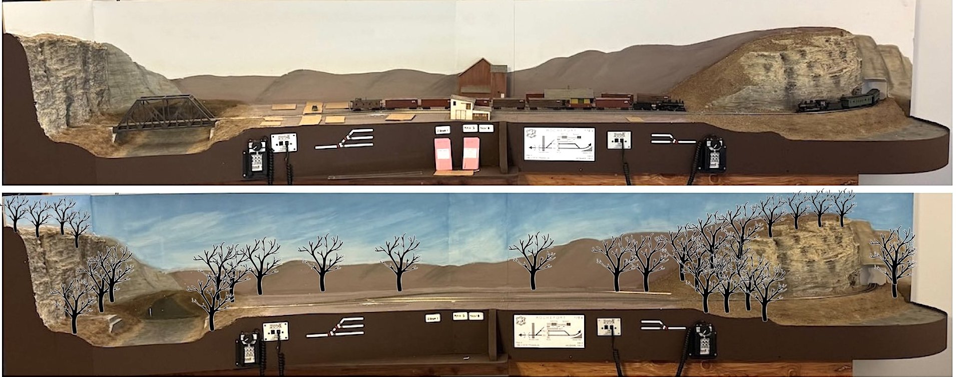

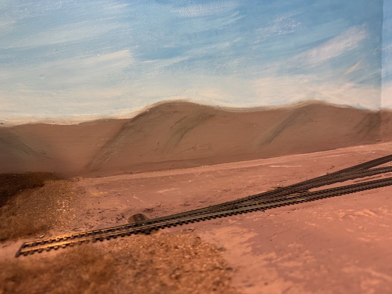

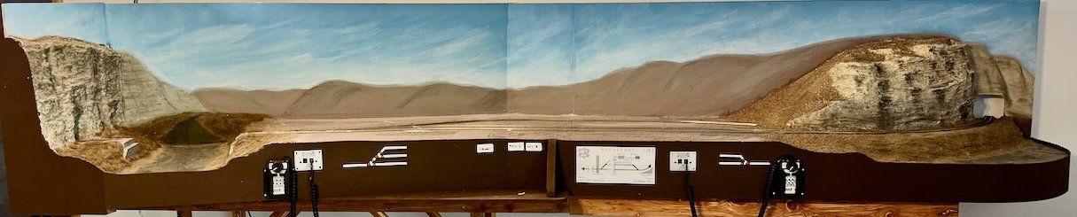

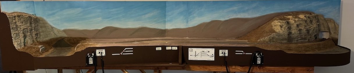

Here's a quick update on an upgrade. I finally made time to properly finish the backdrop. Although I did kind of like the bland threatening overcast look of the base sky color, I had planned on a different look. Some of my favorite Missouri winter days are those with clear skies but a haze of high clouds portending a change in the weather, like these reference photos from the Rocheport area in January:
And here's a before-and-after pair going from the background to the finished sky:
IMG_0274(1).jpeg.bed2a9378df2699d53e4db071c867e16.jpegIMG_0275.jpeg.2c08da3a1f12940fb90fa28fa6684802.jpeg
Thoughts? I'm trying to decide (a) how well it matches the reference photos and (b) whether I do in fact like a more overcast, threatening look.
You'll note that I was historically accurate and did not attempt to recreate contrails...
EDIT: Just realized I didn't describe HOW I did this. It's a technique pretty common for model railroaders; for example searching YouTube for something like "paint model railroad backdrop" will get lots of results. Basically I laid down a fresh roller layer of blue paint, then started brushing white in from the bottom, blending the wet paint upward to go from hazy near the horizon to brighter blue higher up. Then I started using brush strokes to develop the elongated hazy cirrus-like clouds, going back over everything with the roller now and then to blend things in. I actually ended up nearly done and then started over, because my first version was too blue and not hazy/cloudy enough. I also made things hard for myself by being over-perfectionist and trying to keep touching things up as the paint got too dry, which makes blending harder.
One other thing I did that you shouldn't do, is paint the foreground hills before the background sky. It's a pain to try and blend sky into pre-existing hills; much easier to start from the back and work forward. But that's not what I did and it just made the job a bit harder. You can't see it from the distance of these photos, but I need to go back through and use pastels to blend in the horizon/hill interface a bit. No excuse; I just got ahead of myself in being excited about scenery and didn't take the time to do the sky first. Oh well. I think it came out pretty well.

Hey Eric.  First, those are very nice images - especially #1. I love the low angle light of winter and can almost feel how crisp the air is.
Secondly, I think you did a great job of representing that sky in your backdrop.
If anything, I feel the clouds could be a touch whiter, but I suspect that's simply a camera white balance thing.  The blue is spot on.

4 hours ago, FriedClams said:
I think you did a great job of representing that sky in your backdrop...If anything, I feel the clouds could be a touch whiter, but I suspect that's simply a camera white balance thing.
Yeah, I think it's the photo color balance. Here are a few closeup shots just to show what this looks like, partly since the camera "lies" from distance. These all have an odd, Mars-like red tint that demonstrates color balance oddities. These also show that, like many things in modeling, a sufficiently close look can ruin the illusion (the clouds look more like paint here) but I'm still pleased with the result.
I also went through and touched up both the clouds, and the horizon interface with the hills, using pastels to soften some areas and blend sharp boundaries. I don't think you can tell the difference in the photo below but it looks better to me in person.
I brightened this photo; the version below looks a little closer to the in-person view, and also closer to what it might look like when I get the overhead lighting installed.

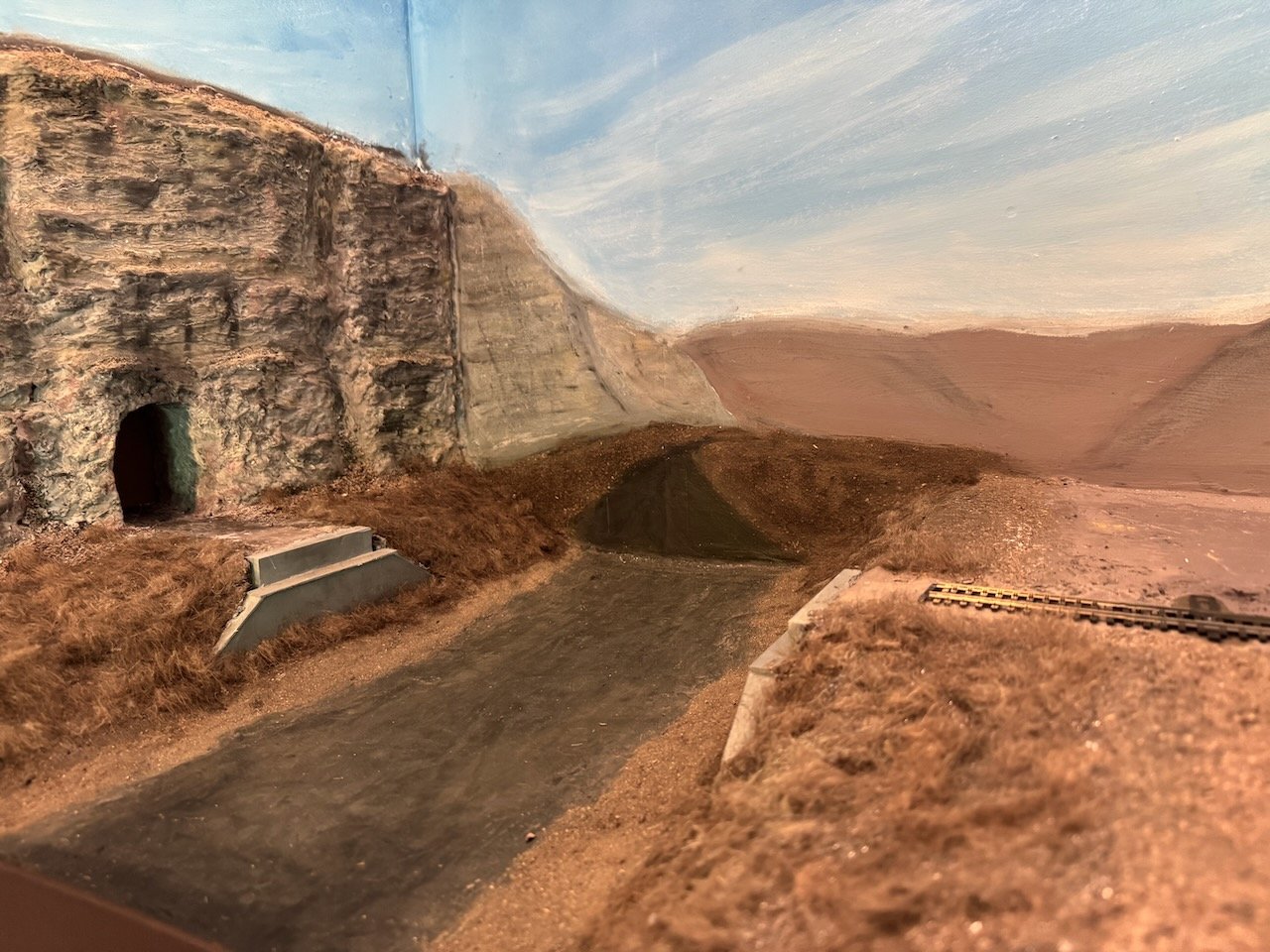

Great question. I don't plan on sponge painting as that's usually best for simulating foliage, which wouldn't fit for this late fall leaf-off setting. I'm still trying to decide whether I want to try drawing on a blend of bare trees or just leaving it as a hazy background. The challenge I see is that adding that level of detail would be all or nothing; if I can't get it the way I like, I'm going to have to repaint the entire thing because I can't just blend it back in the way I can with the current hills. And perspective/distance would be hard; the details of the trees would have to change from foreground to background or it'd look ridiculous since the way I have the hills painted represents quite a bit of depth (from right behind the foreground to miles away).
In other words, if the backdrop were "flat" and just needed to represent a line of trees right behind the foreground scene, it'd be easier to add more details. But I'm not sure if I can get the perspective right with slowly blending fainter and fainter tree details as the perspective retreats back. You could argue that sponging would work for giving the faraway hills some texture, but I'm not sure how to blend that into more detailed trees in the near-ground. Partly just my artistic limitations since I have no real painting experience.
11 hours ago, kgstakes said:
More foreground details, buildings, etc. and people will be more interested in what is going on in front and not even really notice the backdrop.
And this is also why I'm not sure it's worth trying to super-detail the backdrop. It stands out right now, but once the town buildings are filled in, and there's even a handful of bare trees breaking up and obscuring the horizon, I'm not sure the extra detail would really stand out enough to justify the work. I'm less worried about making any still photography look photo-realistic and more about creating a setting that feels real and immersive when you're operating trains in front of it.
The other consideration is that the current scene isn't meant to stand alone, but to be part of a larger layout eventually. So whatever design/color/detail style I define for this scene, I'm going to want to extend reasonably consistently to all the other scenes. IF I take this project to its full extent, I'll need at least another 50' of backdrop in addition to the current 11'. So do I want to be drawing/painting on complex tree details for another 50+ feet down the road so all the scenes feel consistent? In other words, whatever I do here defines the "style guide" for the rest of the potential layout, which creates different considerations than if this was just a stand-alone diorama.
All of which is why I'm leaning toward leaving well enough alone, but have not actually decided. It's possible I could paint a small test-case panel off-layout reasonably close to the current backdrop style and see if I can create a more detailed style that's effective and efficient. Oh man, what did I just talk myself into when I just spent this whole post talking myself out of doing more work!
After posting that, I decided to do a little visual demonstration. It's easy to focus on the backdrop when it's the dominant thing you see without the foreground details in place. So I went back to the comparison photos I posted earlier, and added some basic tree silhouettes to give a better sense of how trees will break up the horizon and focus attention on the foreground. This is roughly the plan for major tree location:
And this doesn't include the added effect of buildings, which granted will be no more than 1-2 stories except for the elevator, but will still further focus attention forward.
What this suggests to me is that I shouldn't worry about most of the background and horizon, but that I might want to carefully draw in some suggestions of trees along the top of the left-hand bluff line receding away above Moniteau Creek, as there the foreground trees vanish abruptly once the bluff reaches the backdrop. Same for the bluffs on the far right. But that's (a) a much more narrow and doable space and (b) will only be needed in a handful of other places elsewhere on future backdrops.
Thoughts?

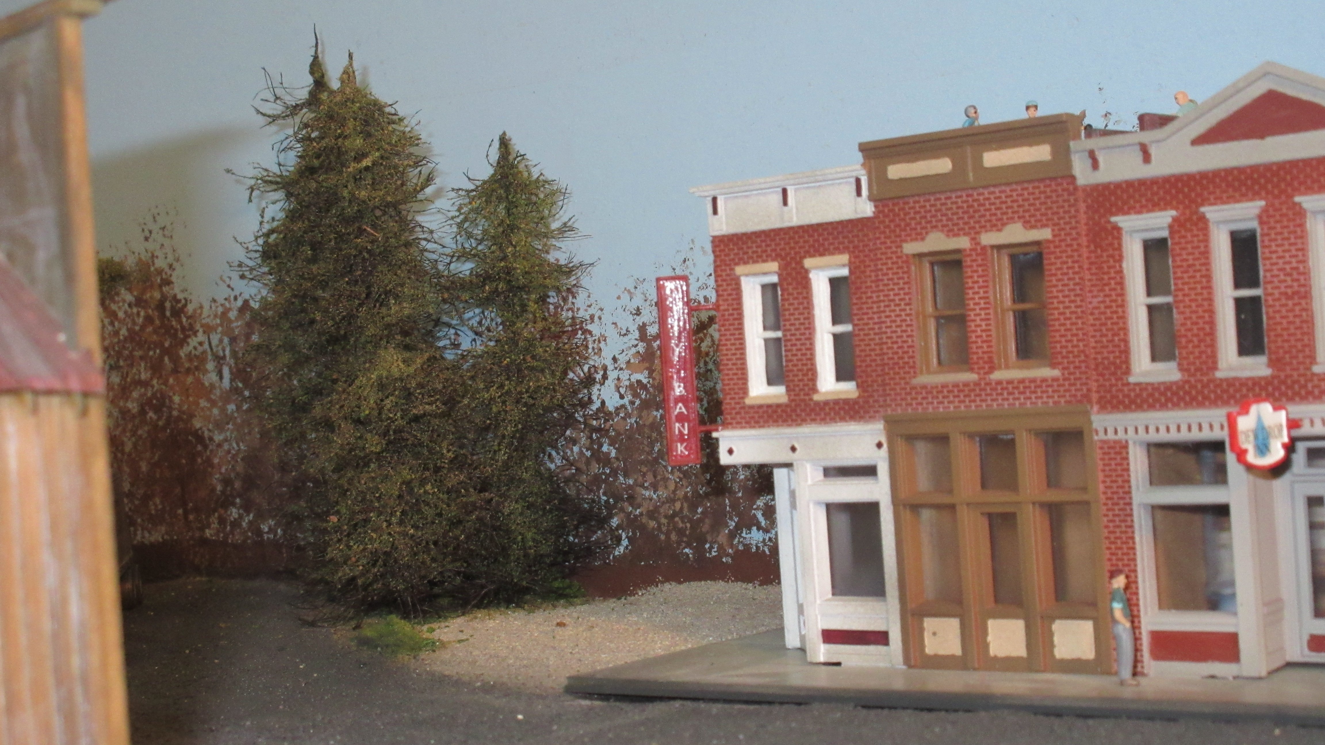

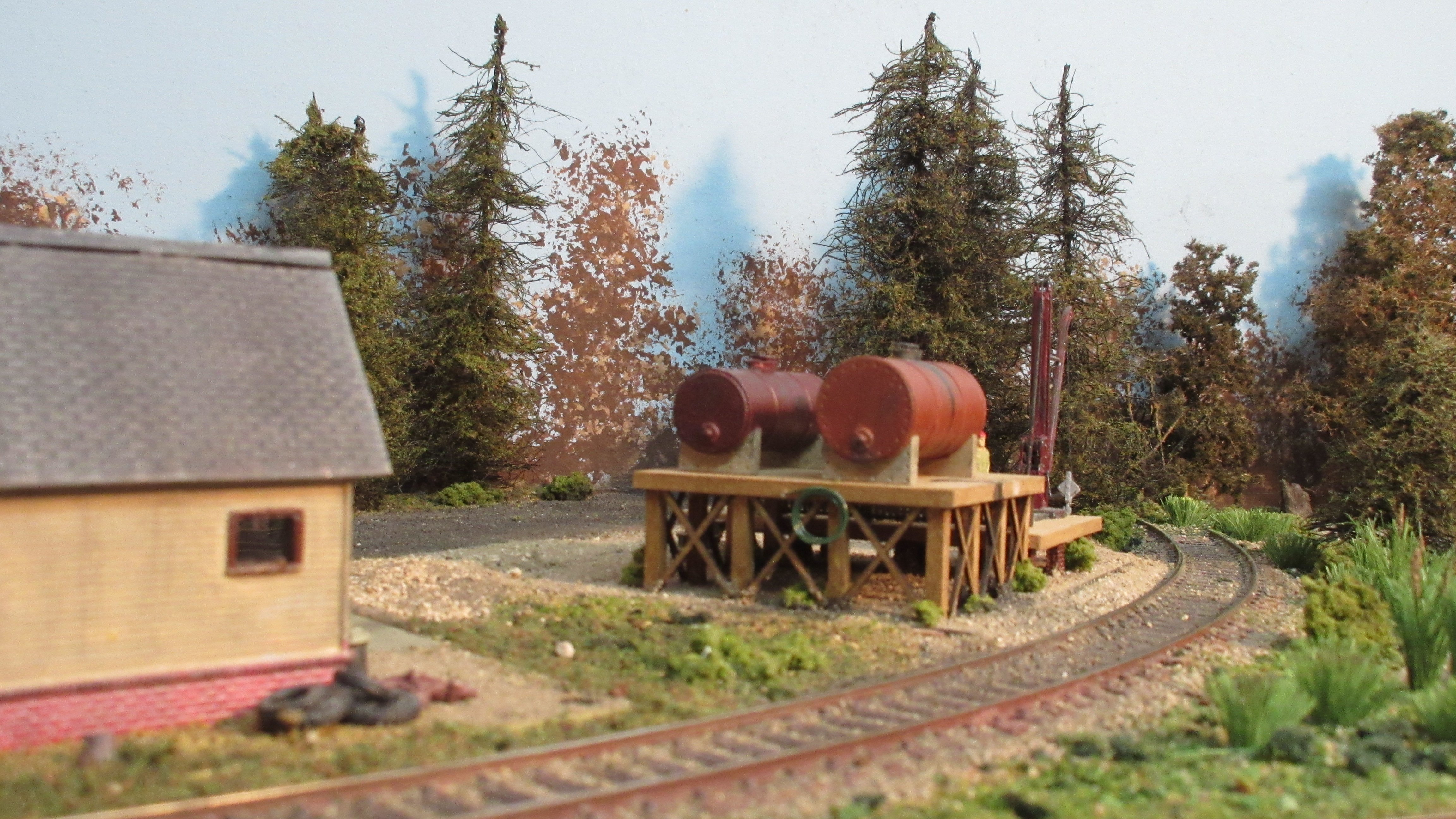

This is my background with buildings in front.  You don't see much of the "horizon" or for that matter the "sponge trees" peeking through the foreground trees and buildings.
With a fall scene it is really hard to make it look convincing with painted trees in the background.  I commend you on trying to create a "real scene" from the past.  Hands down it is a challenge.  What ever you do, if you like it, that's really that all that matters.
It is always a good idea to hide the line between the background painting and the 3D-foreground with some 'props' such as trees, hedgrows, fences etc.
I have seen in museum dioramas that the foreground (cliffs etc.) was continued as fading out relief into background. It is always difficult to convincingly continue a 3D-foreground feature into the background painting. There will be always a sharp edge between them. So it is better to have a clearly outlined feature in front of the background. Somehow, I have the feeling that the cliffs left and right continue as painting on the background - perhaps you can continue with the same style of painting as on the 3D-feature for a few inches and then let the cliff details become increasingly faded?
