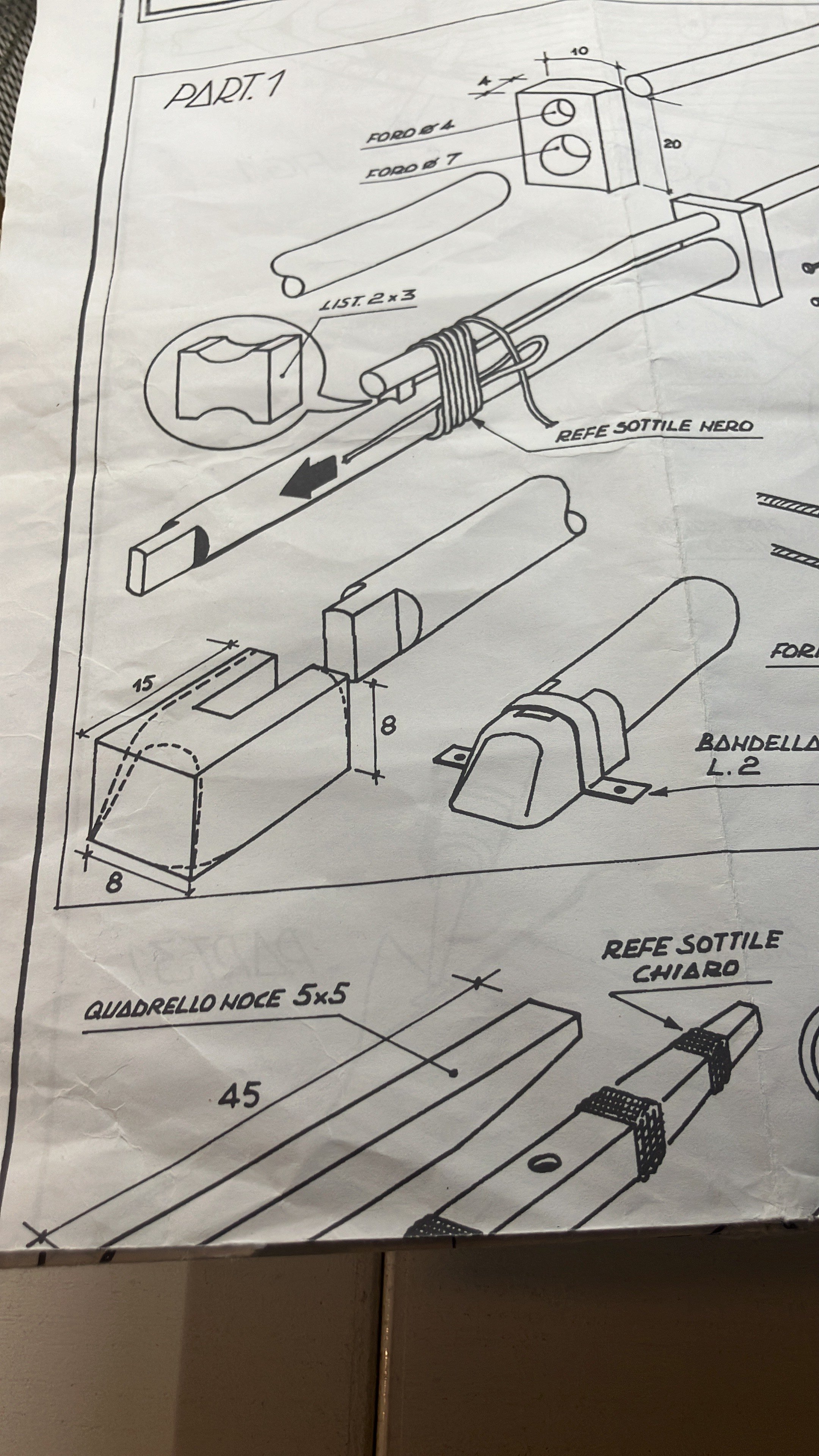

A WORD OF WARNING TO THOSE FOLLOWING THIS AND BUILDING THE SAME KIT:
The plans on the second sheet show the rigging for this model. @Dr PR was kind enough to point out a flaw in these plans when I shared them with him regarding a separate issue. Below is an image of the plans with the parts in question outlined with a red ellipse. Underneath the image is what Phil said about them:
The drawing you posted has a peculiarity - probably a mistake. It shows studding sail booms at the ends of the upper yard. But these booms were fitted only on the yards at the bottom of the studding sail. Since there is not a fourth yard above the topgallant yard (the royal yard) there would not have been a studding sail above the topgallant yard. Therefore there would not be a studding sail boom on the topgallant yard.
The foot of a studding sail was attached to the studding sail boom. The head of the studding sail was attached to the studding sail yard. This yard was raised with the studding sail halliard through a block on the end of the yard (yard arm) above. There was no studding sail boom on the highest yard.
For your model there should be studding sail booms on only the lower two yards.
I am truly grateful for his insight and willingness to help out us newbies :)
A week ago, I would have agreed absolutely and firmly declared that there could be no other way.
However, after having all four volumes taking up shelf space for more than 20 years, I am finally working through Jean Boudriot's remarkable "74-Gun Ship" (the English edition).  In Volume 3, he presents French practice of circa 1780 as spreading the head of each stuns'l to blocks on the boom on the yard above, as its foot was spread to the boom below.
Boudriot did not footnote every little detail and a few of his claims are surprising, so I'll not swear that he must have been right. Besides, what was done in France in 1780 may never have been done in the US during the War of 1812. (Why drag around the extra windage of stuns'l gear on the t'gans'l yard when the stuns'l is very rarely set and the alternative of hoisting a short yard for the head is being used successfully by your neighbours?) So if it was my model, I would follow @Dr PR . I just wouldn't be as dogmatic about it as I used to be!
Trevor
Great to hear from you, Trevor! Yes, I will be following Phil's sound advice (I have already laid those two extra booms aside that I cut this morning). It is now my belief that one could take various tomes to hand and find conflicting ideas about any nautical subject in most of them. History is just like that.

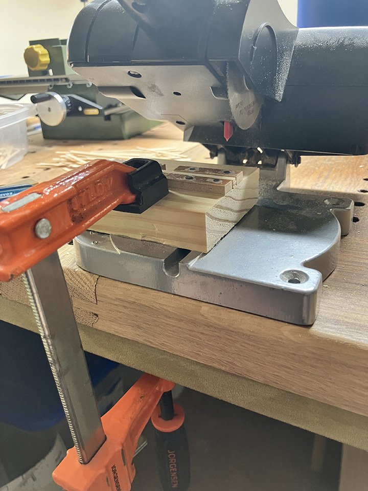

Hi folks. The summer is drawing to a close but the weather has been soooooo perfect these past two weeks it seemed a crime to be indoors. We have been busying ourselves with activities on and around the Chesapeake Bay (sailing, fishing etc.) and have loved every minute of it!

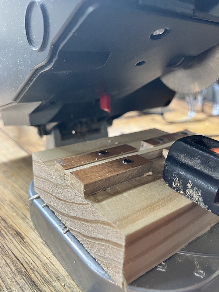

But, I did manage to devote my attention back to the Lynx recently and wanted to post a quick update. I made a small jig so that I could cut all the deck planks to the same length. My little mini chop saw took care of the job in short order:
I cut the planks a little longer than the required 80mm and let them hang out of both ends of the jig. After cutting the one side I simply reversed the pnks, butted them flat up against the outside edge using a flat piece of wood and cut the other ends. They are all nice and equal.

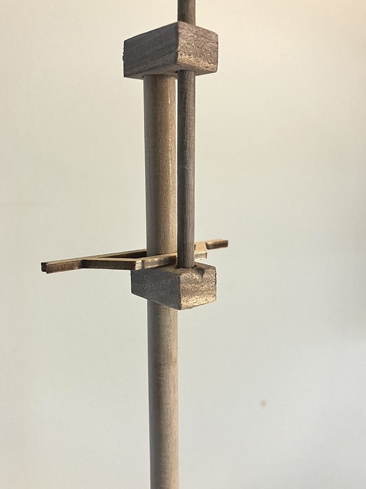

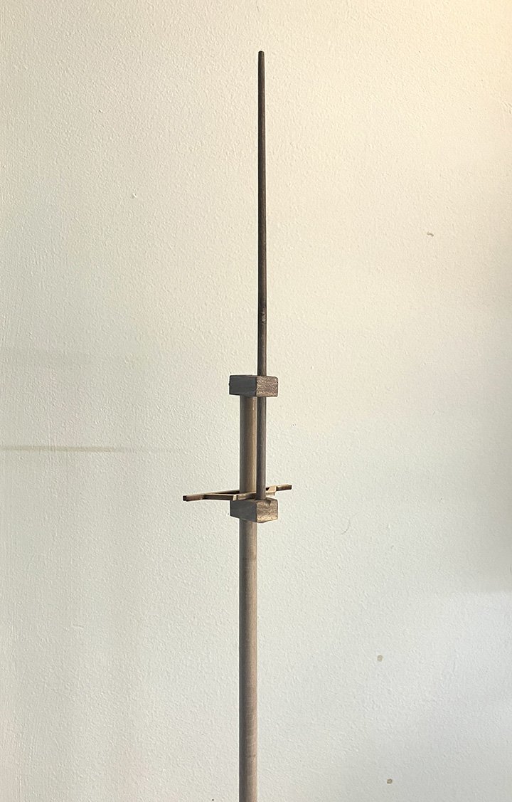

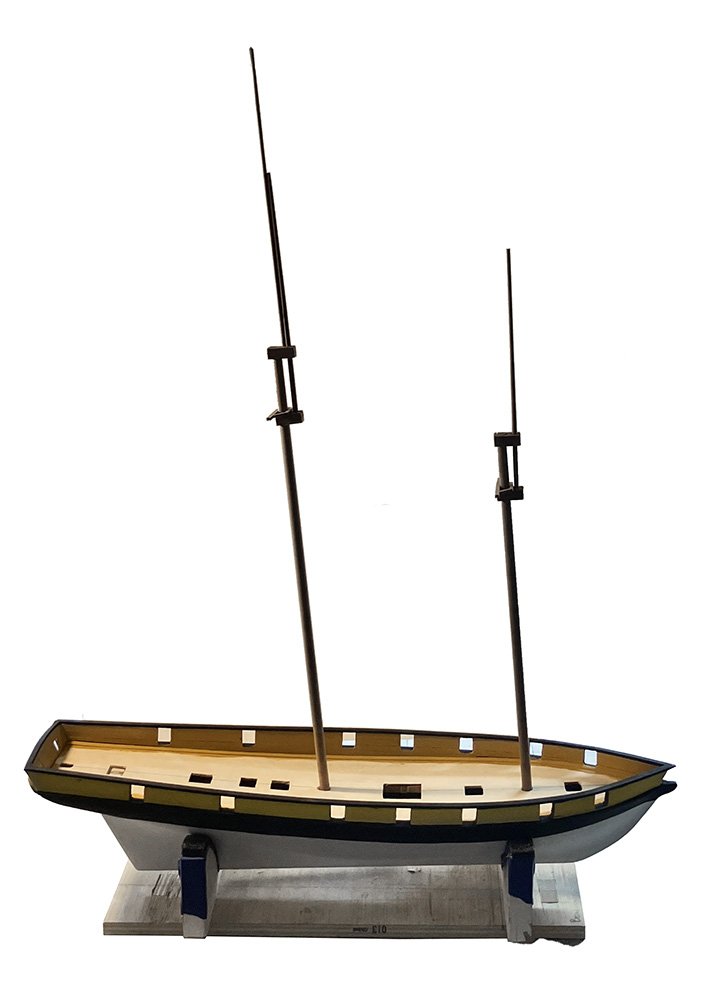

Next up was the masts. The cross and trestle trees are a simple affair on this ship and there is no top on them according to the plans. If necessary, I can add one if needed. As I mentioned earlier on in the build log, I remade the mast caps out of maple but scrapped them and decided to go with walnut. The plywood kit supplied ones were awful. I have not added the cheeks yet on either mast and the rake angles are not final, the masts are just sitting in place for now so that I could see how she looks.
All this has been my excuse for not yet tackling the intricate and, from what I have read, rather frustrating job of nibbing the deck planks. I cannot put that off any longer however because I need to get on with the rest of the ship once it is done. That will be my next task (or perhaps I will prep the yards and boom....??) We will see.
She is pretty.  I love the last shot where you made the background disappear - nicely cropped - really accentuates her lines!!

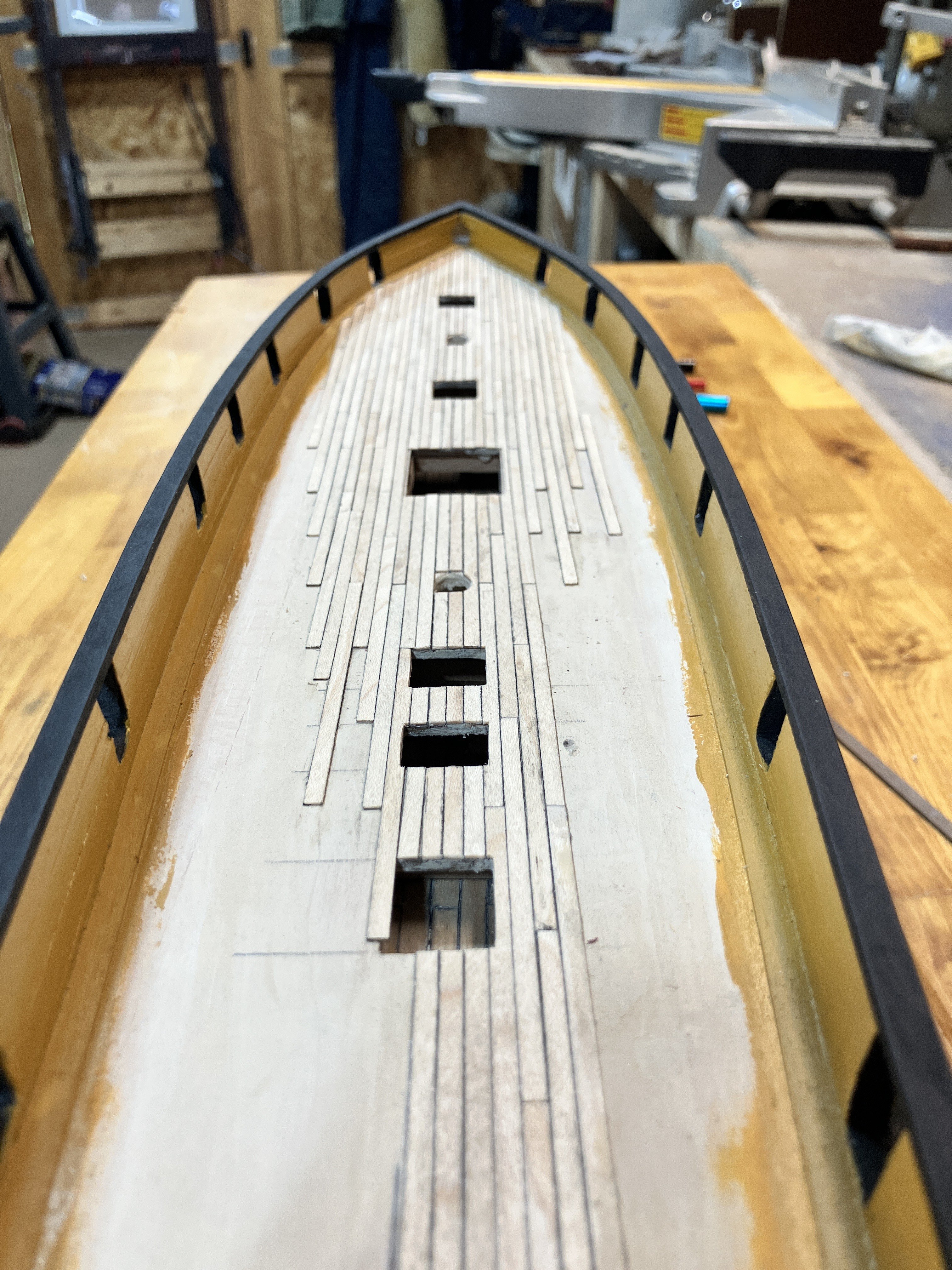

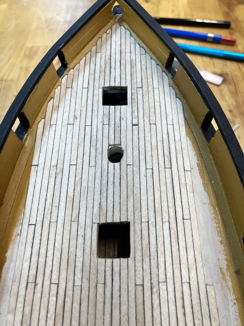

I am back in the shipyard and so very happy to be there. We got A LOT of work done here at home throughout the summer and, every chance we got when the wind was accommodating, we were out on the bay in the sailboat. Now, however, it is time to turn my attention back to my Lynx build and get her moving along.
I had been procrastinating with regards to the deck plank nibbing. The thing is, once I actually sat down and started to work on it, and once I got into a routine, it was really quite enjoyable. The first few attempts were at the bow and they will be hidden by the bowsprit support, that is why I started there. I am enjoying being back working on her:
I have a ways to go yet, the planks will need a good scraping once done, but she is shaping up nicely, at least in my eyes :) :

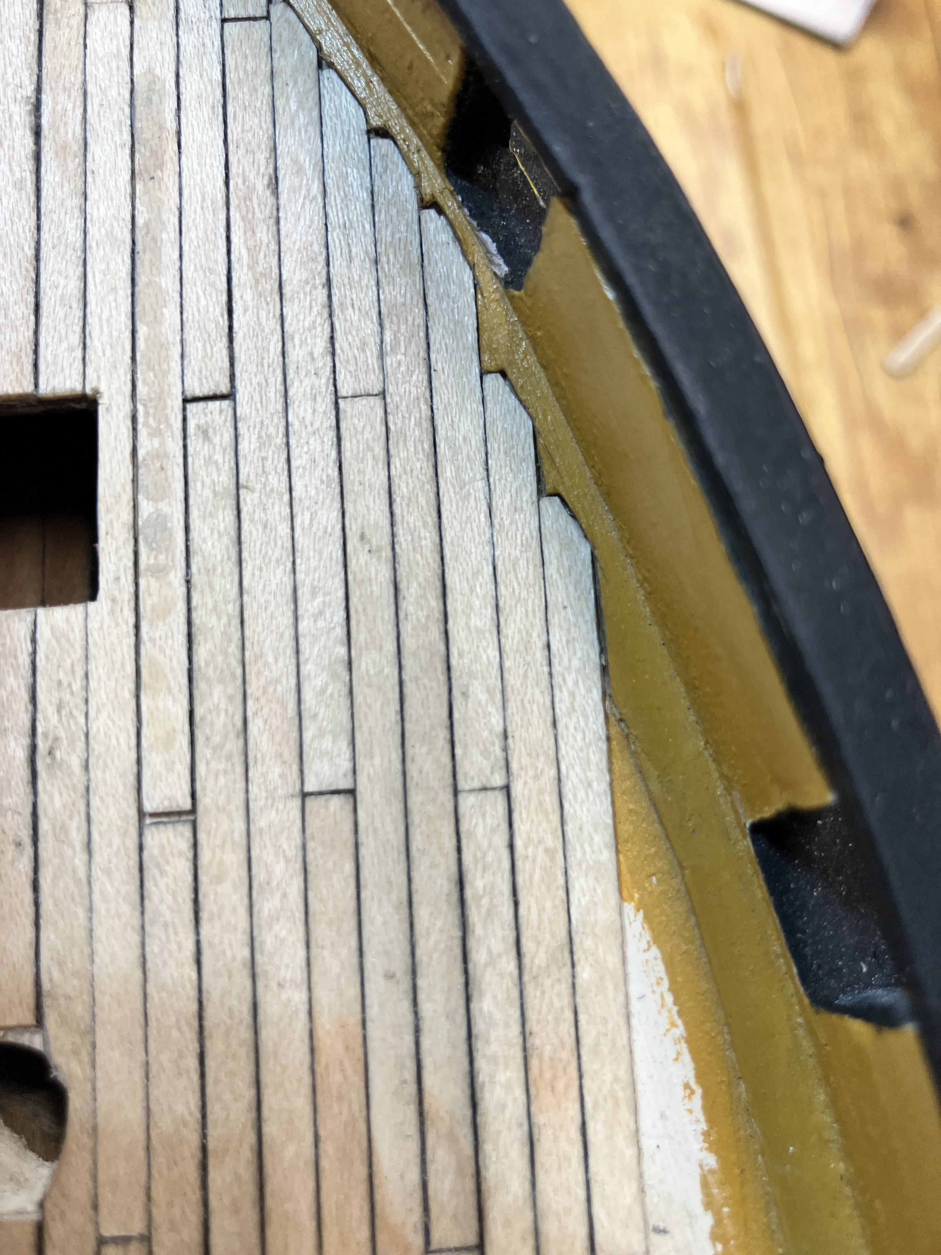

With your nibbing it looks like you are trying to cut each plank at the same angle. This is wrong, and you are about to discover the problem in a big way. The farther aft you go the deeper you are cutting into the waterway/nibbing strake/margin board. Eventually somewhere close to midships you will have to cut all the way through it.
Nibbingpattern.thumb.jpg.93adfeddae21e49546a42981a4a008d3.jpgThe purpose of nibbing is to avoid sharp pointed ends on the planks. These will tend to catch on ropes and other things dragged along the deck, and the plank tips will break off. And it is just easier to cut the nib than it is to try and match angles between the planks and margin boards exactly.
As a rule of thumb, never cut more than half way through the margin board. In some cases an even shallower cut is called for.
If the angle back along the margin board is less than 45 degrees (green lines - look closely) there is no nib and the plank is cut straight along the edge of the margin board. This is optional - it doesn't hurt to nib these planks too.
If the angle is greater than 45 degrees the plank is always nibbed into the margin board. The width of the squared off part at the end of the plank (red line) is about 1/2 the plank width (I have seen examples where it was 1/3 the plank width).
The angle of the nib at each plank is different. From the center of the plank the angle back is determined by where the edge of the full width plank meets the edge of the uncut margin board (dashed blue line). The nib cut (red line) runs from this point to the center of the plank at the squared-off end.
Near midships the edge of the margin board is almost parallel to the edge of the plank. Here you will need to be creative. Nib the plank as usual at the end. Then cut back to where the plank edge is half way into the margin board. Then cut straight back along the plank edge, never cutting more than half way through the margin board. At the other end of the deck do just the opposite for the outer plank, and nib the remaining planks normally.
Ooops. I am glad that got pointed out before I went much further. You are right, Phil, I am having to cut into the margin board a little too much. I am pretty much equal on both sides at this point so I can adjust accordingly moving forward. We will see :)

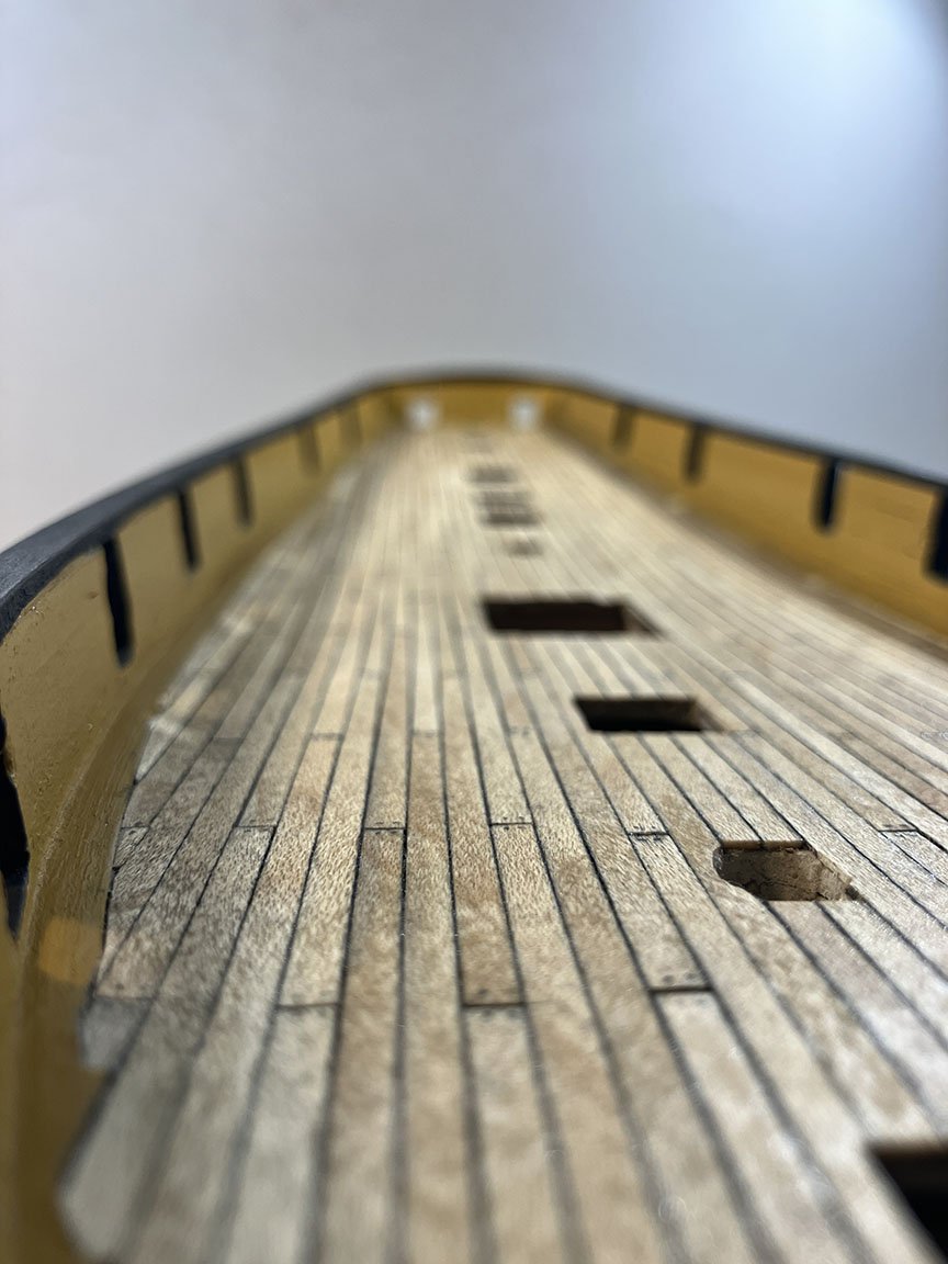

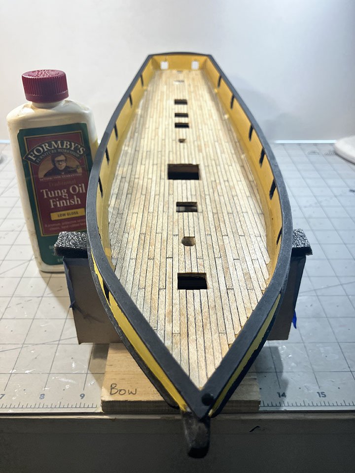

A sunny update from them shipyard (after 3 days of consistent rain - which I am not complaining about by the way, we had a very dry summer).

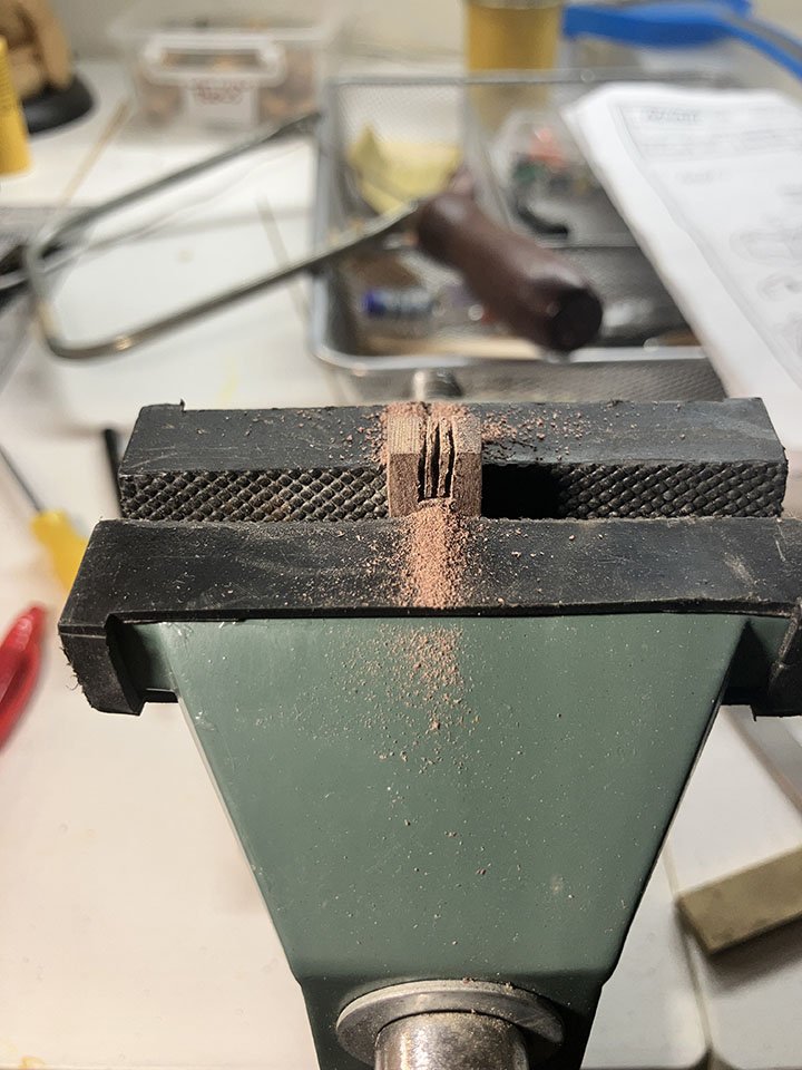

The deck is finally done but, I do have a confession to make. After @Dr PR's correction to my joggling in post #231 I went to work on making sure the rest of the planks were laid correctly. Well, that certainly did not work out so well. I made a complete hash of the stern planking and was more than dissatisfied with the end result. I ended up removing all the planks (and that is a nice way of putting it, I tore them out in frustration if the truth be known), including the margin planking at the stern and re-did the whole thing without any joggling (nibbing). I was not going to put myself through that again. In retrospect I think I was just trying too hard to get it right. The second time around I just shaped the deck planks to fit up against the margin boards. The only "joggled" planks now are the ones at the bow.
Once complete I scraped the deck with a razor blade and simulated the tree nails with a very sharp 2 HB pencil. The whole thing was then coated in a layer of tung oil to seal it up. She is sitting outside in the sunshine as we speak to dry out.

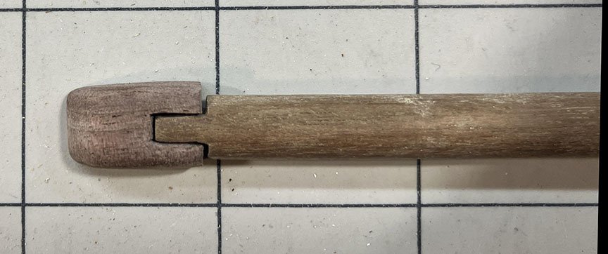

In between ripping my hair out and before I gave up the whole venture entirely out of frustration, I started work on something that would take my mind off the deck for a while. The bowsprit stem was up next. I decided to use my stock walnut that I had milled down instead of the kit supplied piece that was also walnut but looked a bit fragile. I cut the wood down to size, cut out the slot for the bowsprit and shaped it according to the plans:

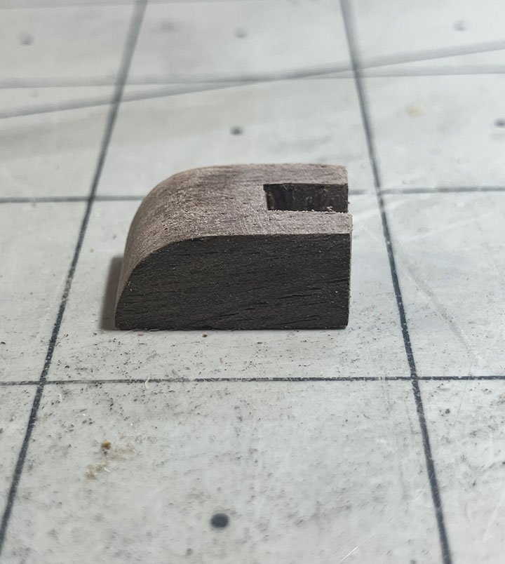

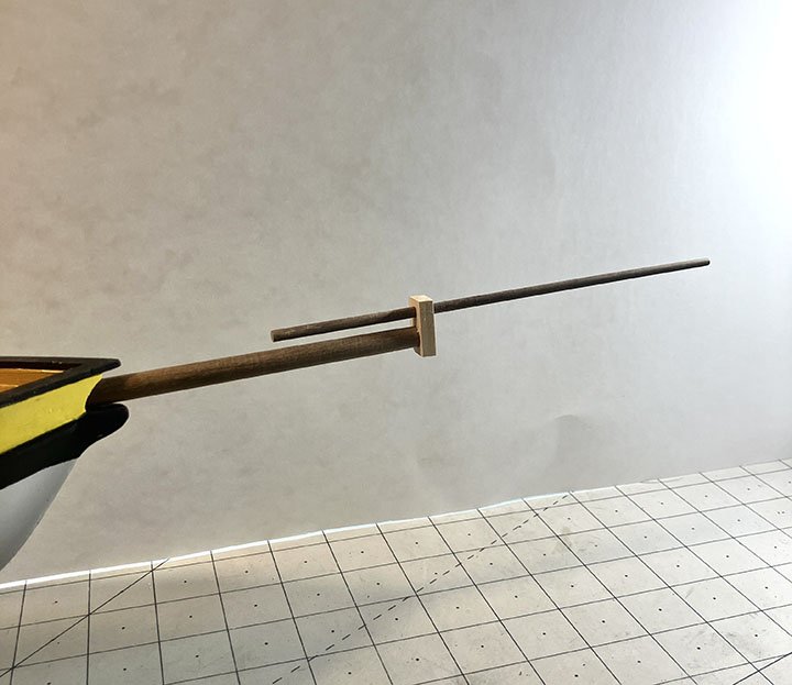

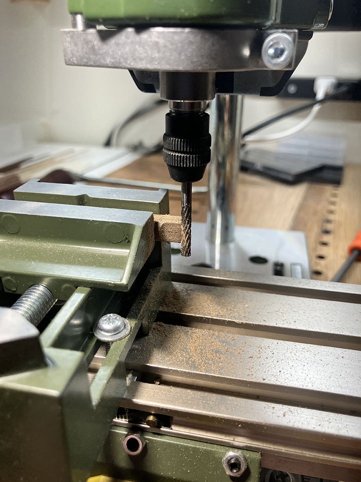

To be able to seat the bowsprit into the stem I had to shape the end as per the instructions. As yet I have still not ordered the mill but I do have a compound table and vise on my mini drill press platform. With that and using some small bits that I have in the wood shop for power carving with the Dremel, I was able to cut the slot down nice and accurately. A little clean up with a small wood file to sharpen up the corners and it fitted nicely:
Bowsprit dry fitted to see how she looks:

The deck and bowsprit look awesome Mark.  I particularly like the look of the deck wood.
Don't forget to check that bowsprit angle against a couple sources - it can cause big troubles!
Ask me how I know.  🤣🤪🤣🤪🤣

 Way to press forward, Mark. The deck looks great.
It is one of the many things on my "don't forget to do this" list, Steve. Thanks mate.
