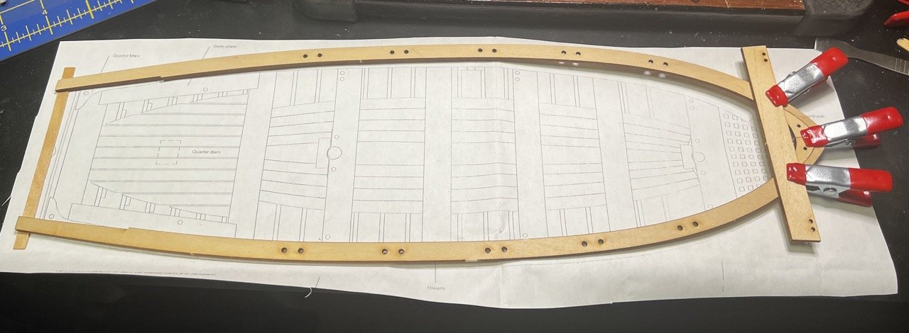

The first phase of building the mold is pretty straightforward. I decided to attach it to a board where I first put down guidelines to help keep everything straight and in proper position. I glued it down by welding corners with hot glue. I figured that gave me an easier out if I needed to remove it from the board. Pictured also is the frame materials cut to length in prep for bending to the mold. Side note, I would have left the sheer tabs off until after fairing. They get in the way and are easily added later.

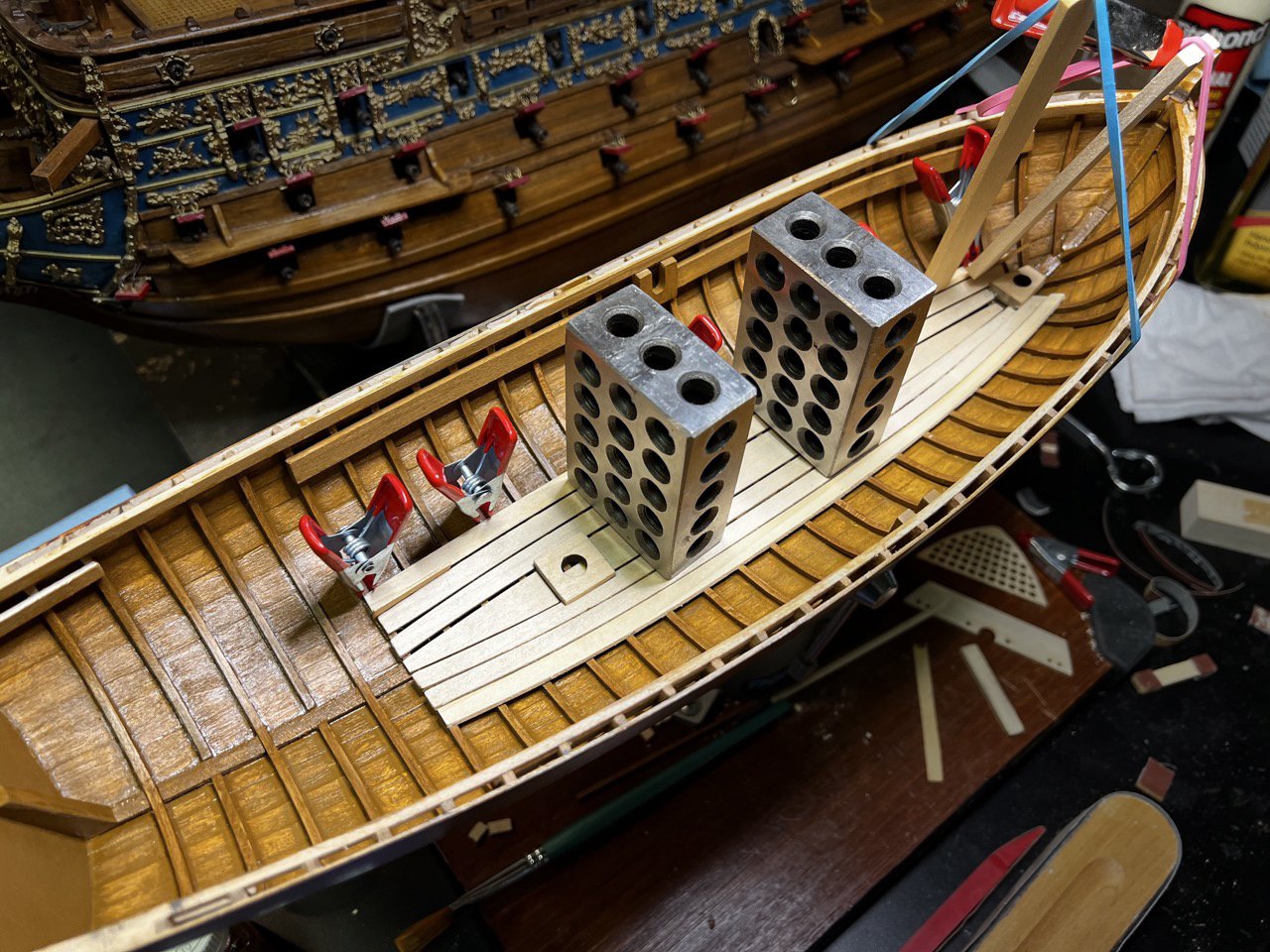

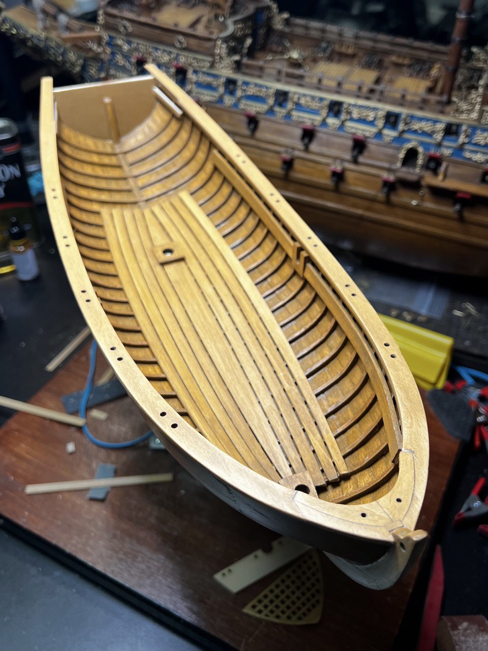

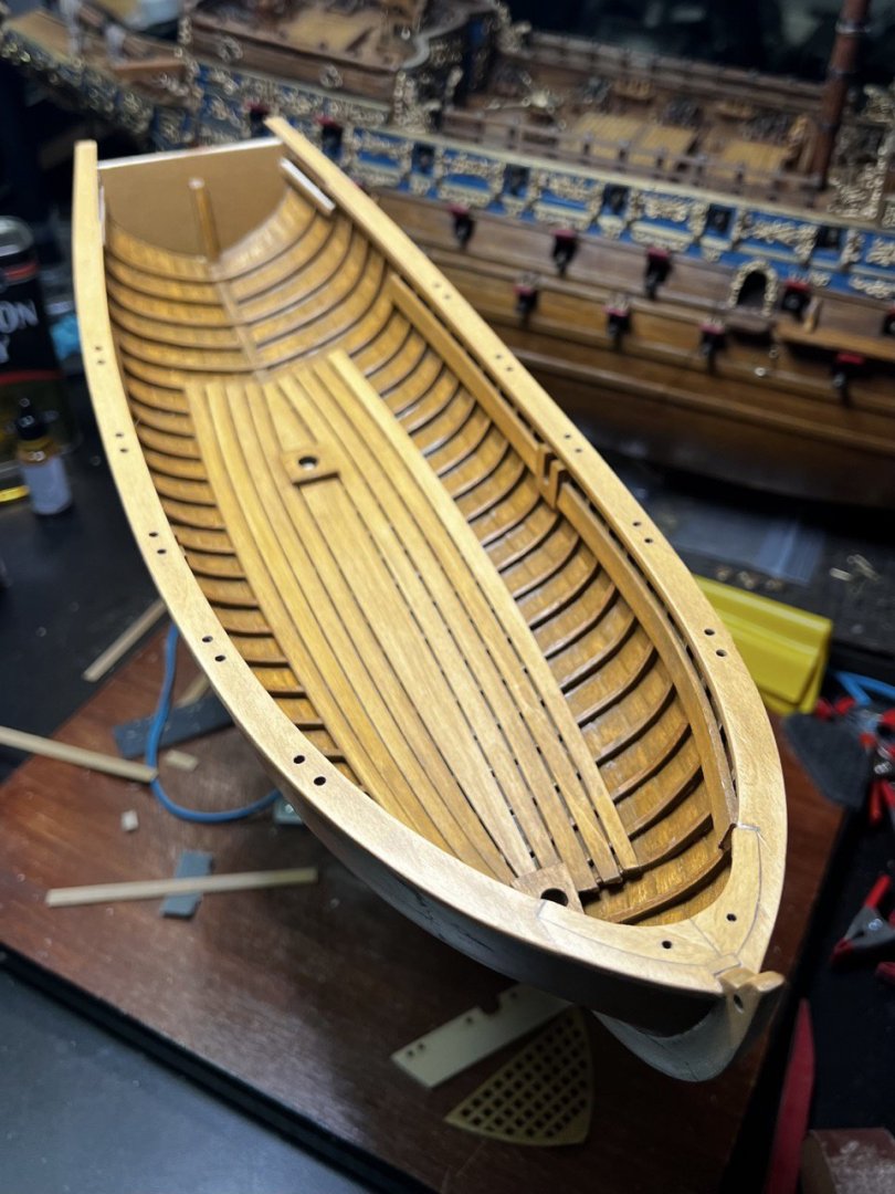

Progress continues on the launch. The interior staining involved some experiments and adjustments. It's like a dance, one step forward and two steps back. Stain was applied, sanded, and then corrected. The result is better, but lessons were definitely learned. The stain also added more gloss than expected, which was also compounded with a clear coat. I'm planning on addressing the sheen later down the road. I also started adding interior components. Creative engineering was used in the moment to hold everything down.

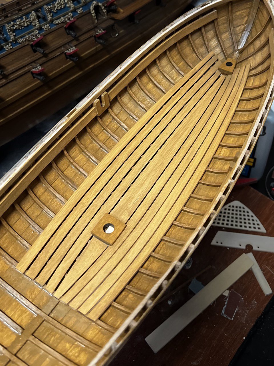

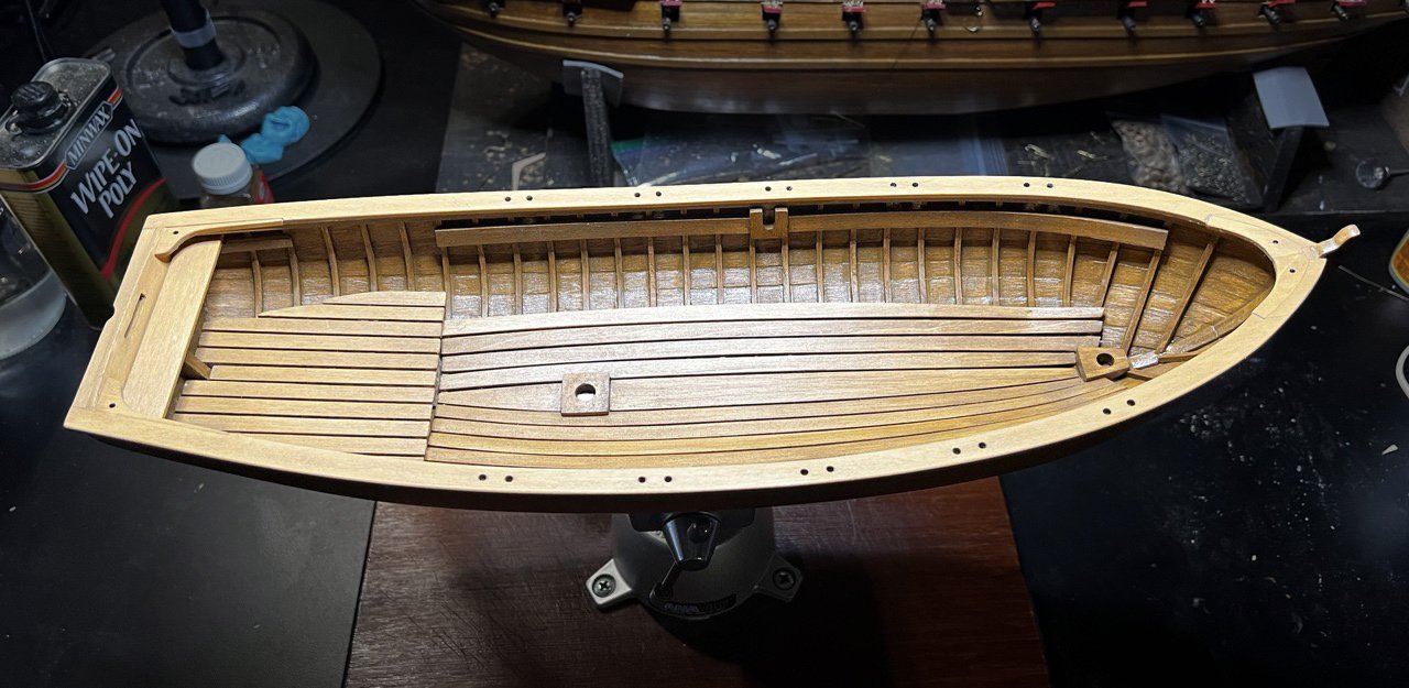

The instructions leave out any mention of the quarter deck. This step requires use of the plans for a general idea of what to produce. I made slight adjustments to keep the supports at a proper height and level. I also installed the rear thwart area. It was nice to complete this area as it was the last unfinished area of the hull. Stain and a coat of poly was applied to the newly installed parts.
Note for other builders: 1-2-3 block make for great weights like this. Just note that when new they often are well-oiled to prevent rusting and even if you clean off the outside, oil can still seep out from the holes in the blocks and stain wood. Thankfully for me I learned that when building a Syren serving machine, not a model.
