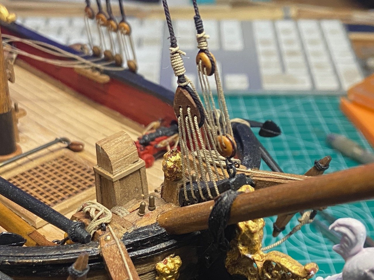

The next issue on the Mary is to fix the positioning of these fittings that work like cleats or kevels. Does anybody know the proper term for these Dutch belaying points?
These fittings were mounted so low on the bulwarks that there was no room to wrap lines around them. I had to debond the glue that was used on them, which was some kind of rubbery adhesive. It made them easy to remove, but left a lot of rubbery glue spots and some hard to remove residue on the model. I did what I could and re-attached the fittings with thick CA glue.
This allowed me to finally rig the lines for hauling up the lee boards. Rope coils to come later.

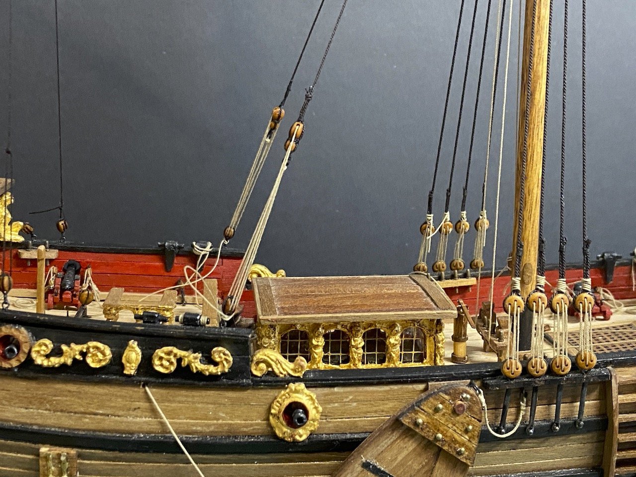

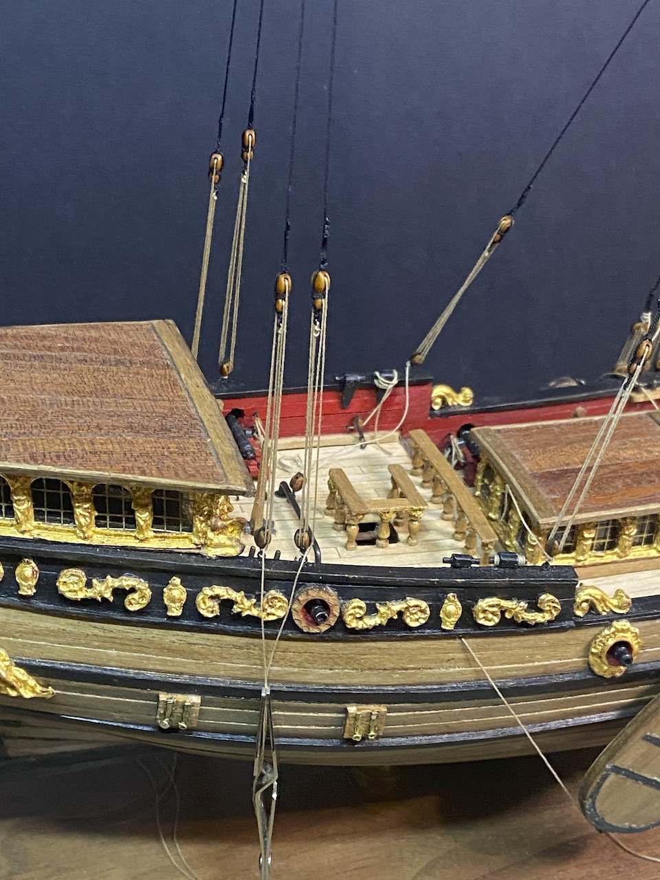

I FINALLY made some progress on setting up the shrouds on the Mary. I find this to be a lot of work and am usually much happier when I get to the part where I can just mindlessly tie clove hitches for the ratlines.
Took me quite a while to be happy with the work I was doing, first seizing the shrouds around the mast head, then adding the deadeyes, and then seizing them into place. This was a good project for easing back into this process, since there are only four shroud pairs total.
Note that the shroud lanyards are not yet secured, since the setup is only temporary, to make sure everything lines up okay. The slight variation in the line of upper deadeyes should mostly go away when I secure the lanyards. They're still loose enough to cause that bit of variation.
This is also kind of a practice run for rigging the shrouds on my HMS Wolf card model, which is currently on hold, but I'll be getting back to shortly.
All the rigging here is Syren's Ultra Scale Rope, and the deadeyes are also Syren's 3D printed swiss pear colored resin deadeyes. It's been a while since I made my own chain plates of this type, and stropped deadeyes with them. I had to handle and work the parts a lot to adjust the fit, which is why so much of the blackening has worn off the deadeye strops. I'll get back to working on my technique in future builds.

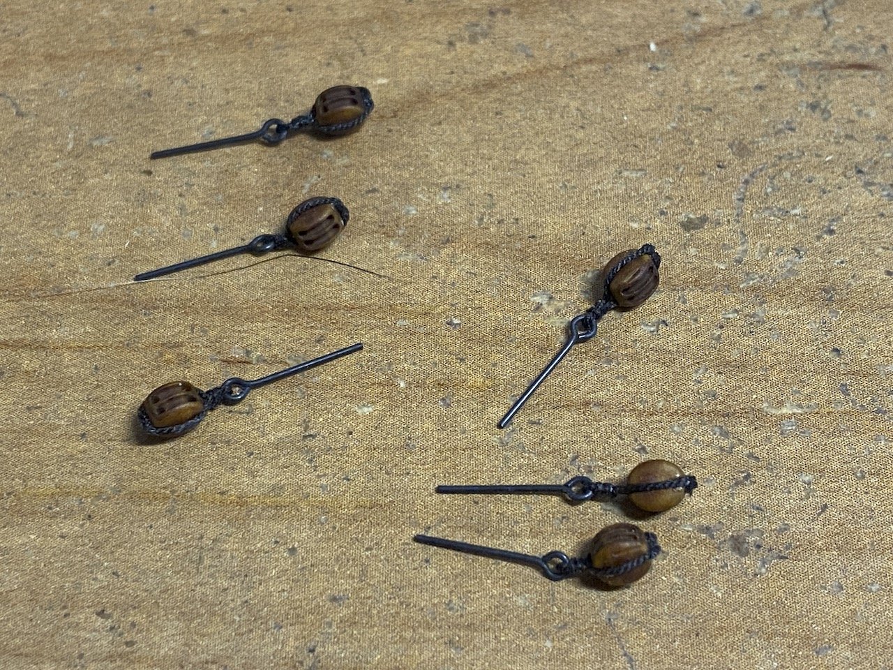

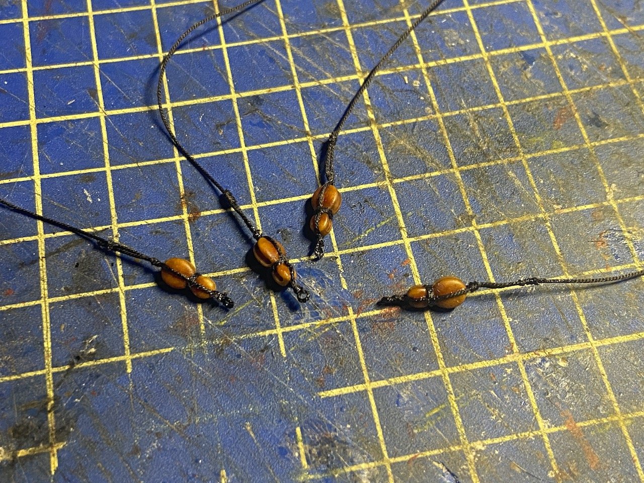

Now, I'm in the process of rigging the gun tackles. I'm using Chuck's 3/32" 3D printed blocks. To be safe, I drilled out the holes with a #78 bit, which worked well, and allows me to pass a his .008" Ultra rope through it pretty easily. I decided to do a simplified job of it, using no hooks, just tying the strop through the eyebolts.
IMG_1157.jpeg.9ac2e58b0264f22d9738a405f5c51f75.jpegIMG_1159.jpeg.25fbe4a7a8fcdbdd41bb579378ed695f.jpeg
I don't have a photo of them, but I have double-blocks stropped through eyebolts that will be attached to the bulwarks. Oh, and I realize that this particular gun is missing the trunnion caps. That's because it was one of two "spares" I decided not to use. Then, during the rigging process, one of the eyebolts got stuck and broke off. So, I just put one of these spares back into service. It'll get it's trunnion caps shortly.

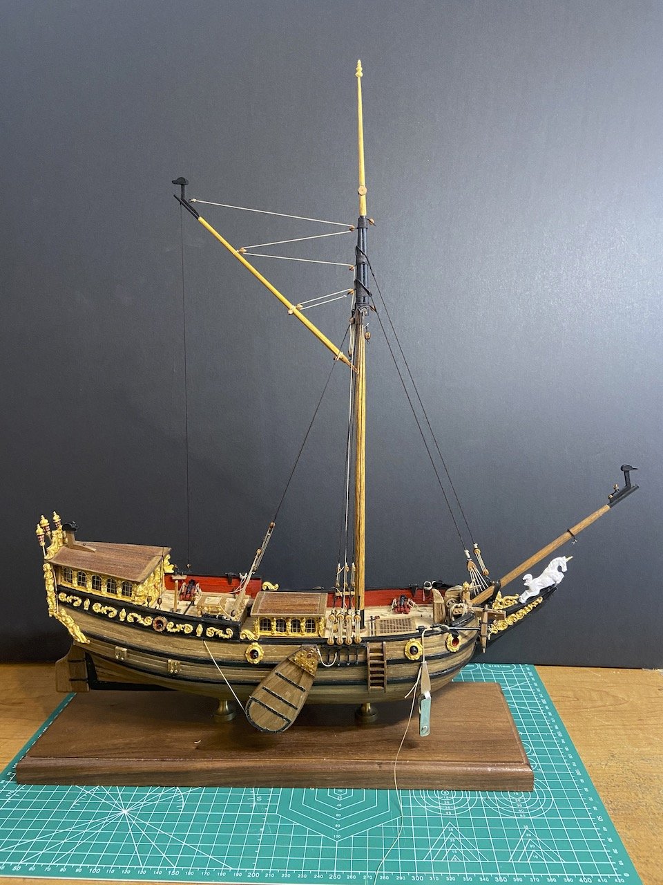

My work schedule changed today, and I think I may actually have enough spare time today and tonight to complete these! 🤞

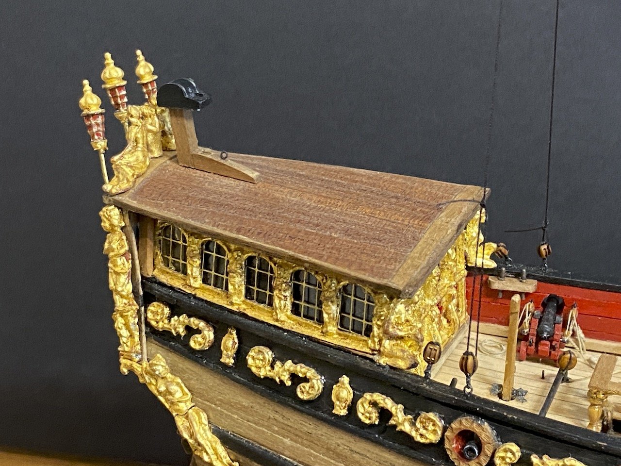

A minor update, but fairly significant for the model.
Today, I got sick of the enormous gap between the sternpost and rudder and I clipped off the pintles and just pinned the rudder into place. I think it makes the model look a whole lot better!
IMG_0792.thumb.jpeg.5310b1751f929ebc6b075f6456d876d4.jpegIMG_1169.jpeg.5b29b4ff3dffd387e2eeeefbfe5affd8.jpeg
Yes, it's not perfect, and you can see one of the pins if you look closely. But, I'm not striving for perfection here. I'm just going for a better appearance, and I think this works.
Now, I can move on to other things, as this is the last item that just bugged me!

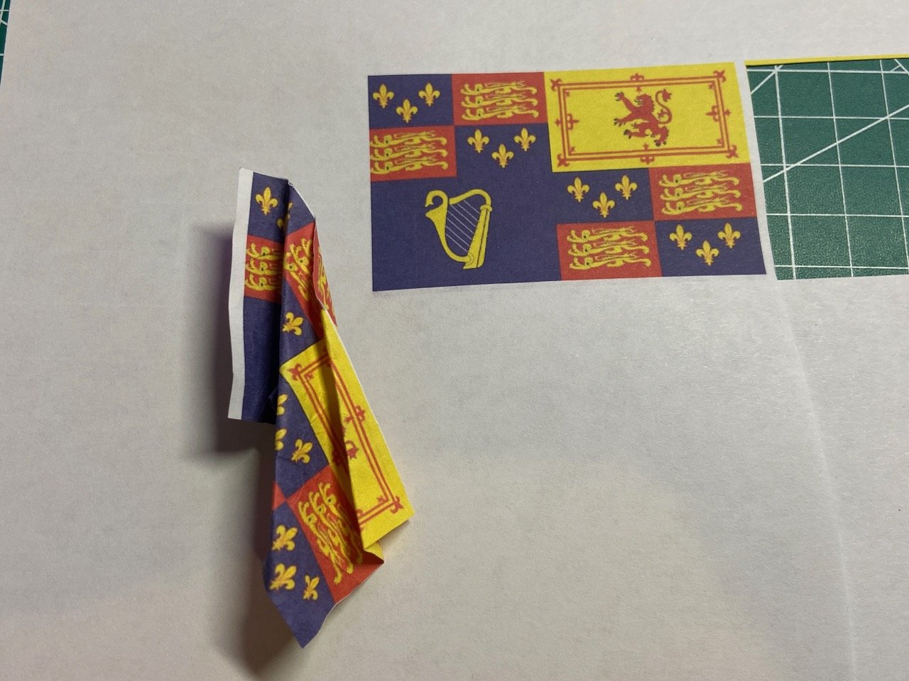

Looking at the flags in this Mamoli/Dusek kit. They appear to be printed nylon. They're not really dissimilar from the flags in the Woody Joe Charles Royal Yacht kit, but those flags could be shaped quite nicely. These don't seem to hold my attempts at shaping.
I've found what I think is appropriate artwork on the Internet, so I'm considering printing the flags on my color inkjet printer. I think I want to print both sides of the flag and fold over and glue. I'm considering trying to print on silkspan if I can get that to work. Any suggestions on how to do that successfully?
I just don't want them to be look too thick. I just noticed that the first flag is truncated slightly on the left side. I think I can fix that without too much trouble.
Alternatively, anyone know of a source for the needed flags?
Hi Patrick, thanks for the link! That's exactly what I've been thinking of doing. I hope I can get my flags to look as nice as yours!
Edited by catopower

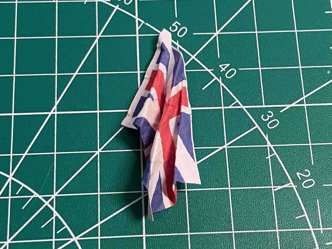

Made my first attempt at printing flags on tissue paper and couldn't get the paper to not jam up in the printer ☹️
I was able to print on regular paper and thought about folding them over, but I know how thick that ends up. Decided to see how good the alignment consistency is on my printer. Turns out, if I'm careful and have the images perfectly centered, I can print one side, flip the paper over, and print on the other, and it's pretty darned close.
I have three usable flags done this way now, and just the pendant left. I don't have any artwork for that flag, so I'll have to draw it up from scratch. Pretty basic, so it shouldn't take that long to do.
I only folded the flag above. I didn't try to wet it at all. I'm not sure of the colorfastness of this ink. I'm using some cheap third-party ink, so I think I have to spray this with something to keep the colors from running. But, I'm not sure if that's just going to make the whole flag itself waterproof, and prevent me from using water to shape it. It probably doesn't matter, as I think the flags will shape nicely, even without wetting them.
The one thing I forgot about is the white edge of the paper. It's just like paper modeling, one needs to color the edge to take off the bright white color.
Note that I tried to give the above flag some texture, but I made it a bit too wrinkly. I'll keep that in mind for the final flags.
What is your technique for getting the folds?
When you tried with the tissue paper, did you tape it to a plain piece of paper.  I have had pretty good success doing that.
― Jimmy Buffett
On Hold:    Rattlesnake
Hi Gregory, for the folds, it's hard for me to describe. It's basically a matter of holding the mounting edge tight, while pulling down on the top edge of the flag.
I start closest to the mounting edge. I guess the trick is to fold back and forth, just keeping in mind how gravity keeps pulling down on it, while the wind is trying to push out on it. Because it's plain paper, it keeps its shape pretty well. I haven't decided yet just how windy the conditions are for the ship!
On the tissue paper, yes, I taped it to a plain sheet. Did that a couple times. The way my printer, a Canon IX6820, feeds, it doesn't feed it evenly, and I end up with a crumpled mess. I might try again in the future, but for now I'm pretty happy the way the single-thickness plain paper is turning out.
Maybe this will work.
print the flags on regular paper first
apply glue (pritt) around the area of the printed flags.
and certainly up to the edge of your tissue paper.
let it dry well.
print.
and cross your fingers 😉
I did mine on the (expensive) laser printer at work.
After retiring, this is the only thing I miss now...

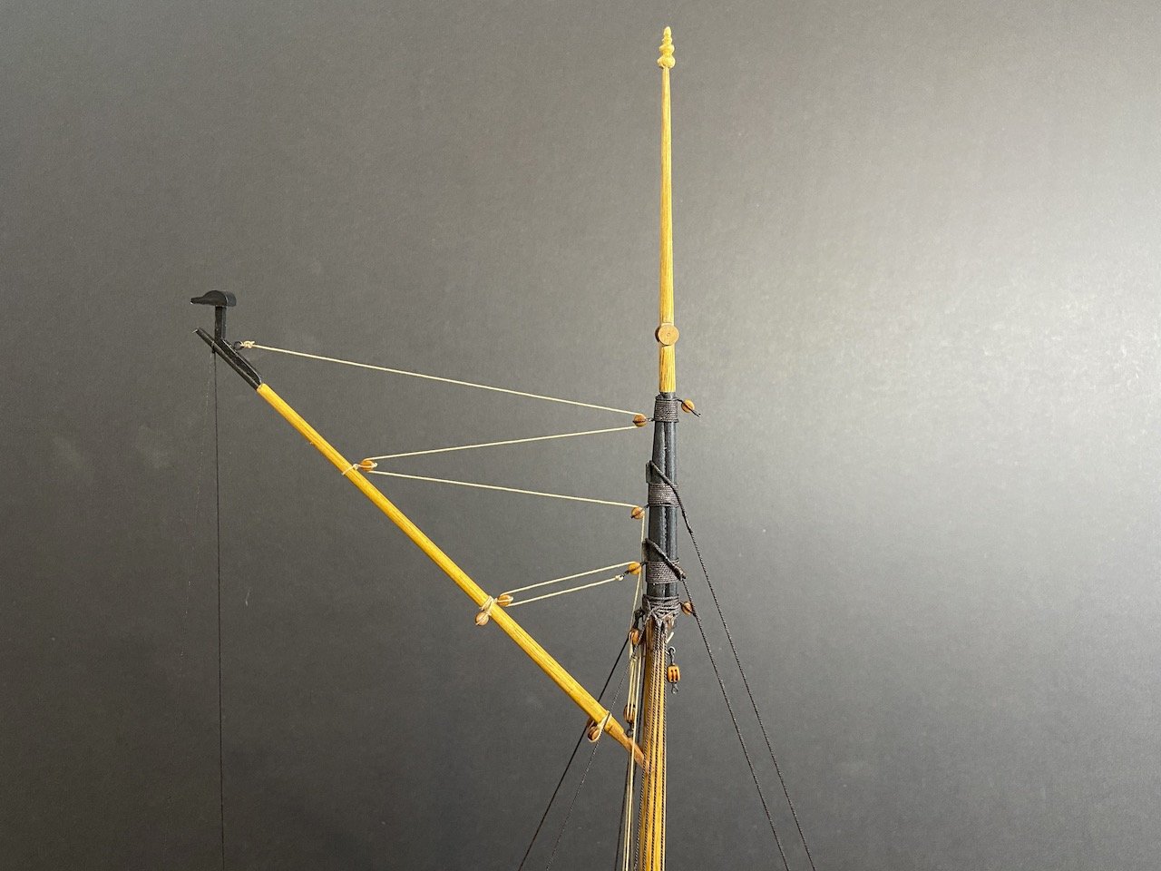

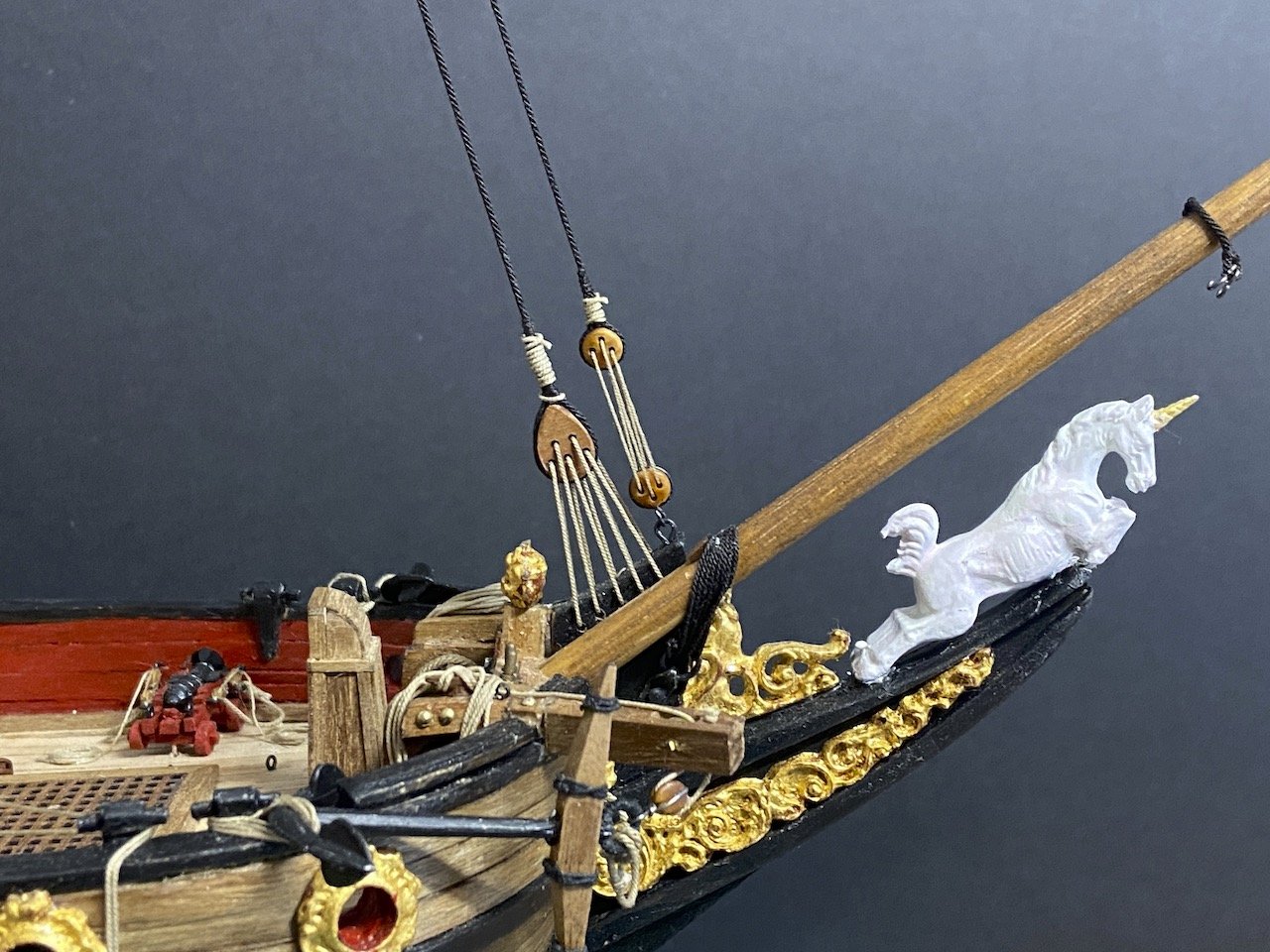

Flag work aside, and with all the main detail work done, I finally made some progress on rigging.
Forward, Back, Cha Cha Cha...
That's the kind of dance it's been the past couple days on this project.
I made the standing portion of the vangs. Are these pendants? Anyway, made all four of them with 8mm fiddle blocks stropped in their ends. Then, I realized that I didn't rig them with beckets. Had to redo all four... 😖
Today, I fixed the issue, cut away the temporary line I had in place of the vangs, and rigged the vangs. All looks good. They're not permanently in place, since I may have to remove the gaff when I rig the sails.
IMG_1262.jpeg.6fe119199a99a7c44987f5eb4bb16f60.jpegIMG_1266.thumb.jpeg.f38576e10d238b6de7d1a0bdf362b41a.jpeg
During this last step, the stropping of one of the double blocks (the very last one I was working with, of course) gave way, so I had to remove the eyebolt for that block. It didn't want to come out, but finally did. I destroyed the eyebolt in the process, so had to replace it and re-strop the block to it before finishing up... three-four... cha cha cha...

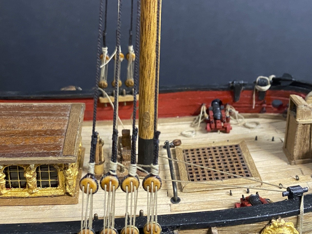

The shrouds are now "rattled down". I didn't get too fancy and just did my usual clove hitches all the way across. It's the way I've always rigged the shrouds, but in the future, I think I will try using cow hitches at the ends as someone suggested. I can see where this could actually make the ratlines easier to do, as well as make them more secure. It's not easy to trim those end knots and for them to stay secure. So, I gave them a strong dose of PVA to hold them.
Not perfect, but it's done! I redid a few of the ratlines where I needed to do some adjustments and had a few knot failures. But, it's all secure now. Also, the photo is before I added one more ratline at the bottom end.

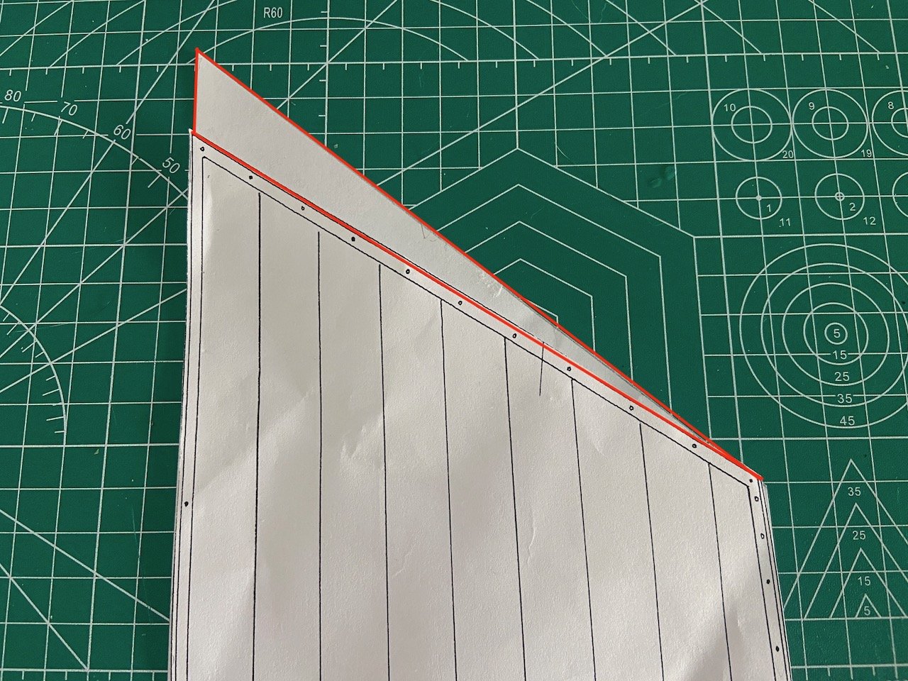

I've constructed my model with higher peak, so I can't use the kit pattern as is. I cut a new pattern with the added area highlighted in red, above.

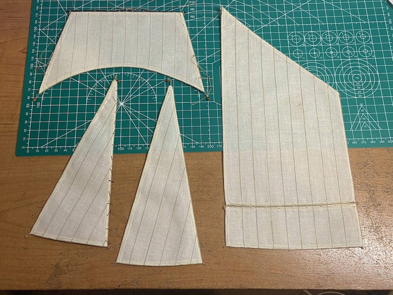

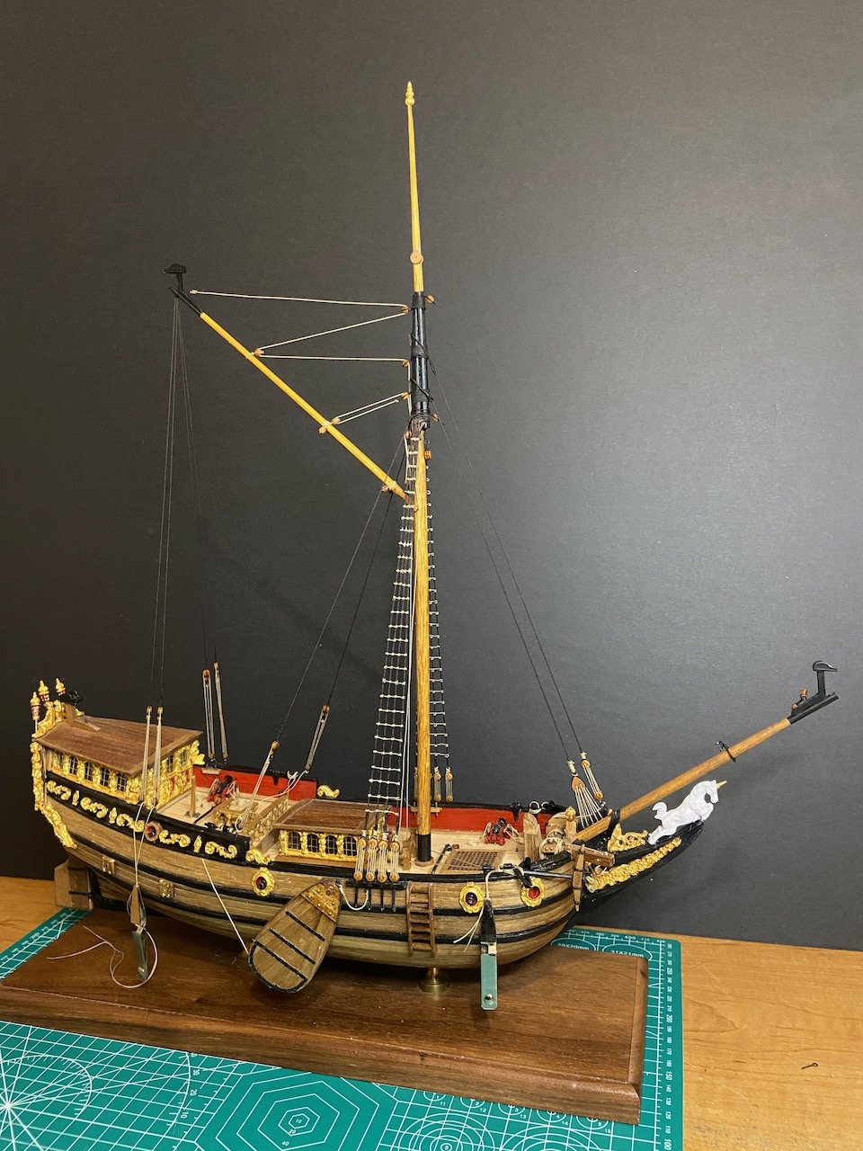

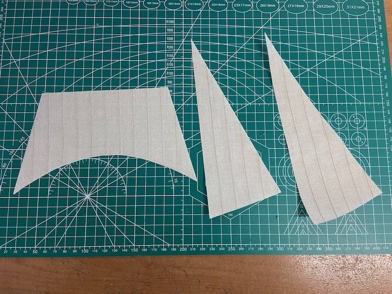

After making the head sails and the topsail, I can honestly say that I hate how these are turning out.
I can sew just fine, but the tablings are too bulky, and they're ruining the appearance of the whole thing. It's hard to get the corners done nicely, and all. I think I'm going back to making the sails in the way that I can do best, which is making them almost the same way others make paper sails. I think the process will also go much faster, which is a good thing, because I'm getting tired of remaking sails.
The topsail isn't great, but it's actually okay. Still, if I'm going to change the way I make one sail, I have to change them all.
I'd just love to be able to move on. Unfortunately, I probably won't have time to do much until closer to the weekend. But, on the positive side, there are only four sails to make, so we'll see.
Not much to actually report, except that I've been trying to get these sails done for a couple weeks, and since I switched my sail making technique, I managed to make good progress over two days.

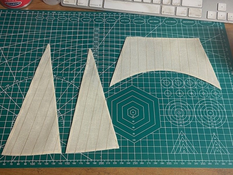

I probably mentioned this before, but I'm using unbleached cotton muslin. This was hand washed and then treated with a fabric stabilizer called Terial Magic. This has to soak in for 15 minutes, wrung out, then the material is ironed. The resultant material acts like paper. The stabilizer can be left in or washed out later.
Topsail and head sails were initially sewn and cut to shape.

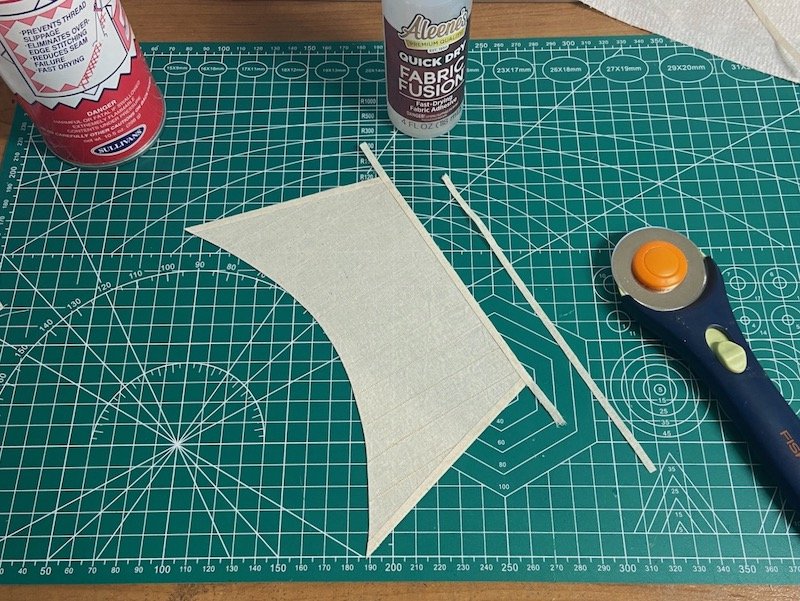

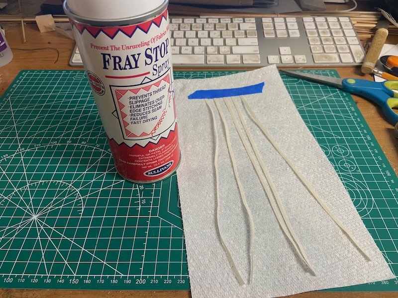

I cut some strips of fabric and sprayed them with Fray Stop, which is like the fabric stabilizer, but it doesn't wash out. It smells a lot like lacquer(!). I'm doing this, because I think I'm going to wash the Terial Magic out of the sails later (maybe), and I'm a little concerned that later the edges of these strips might start to fray.

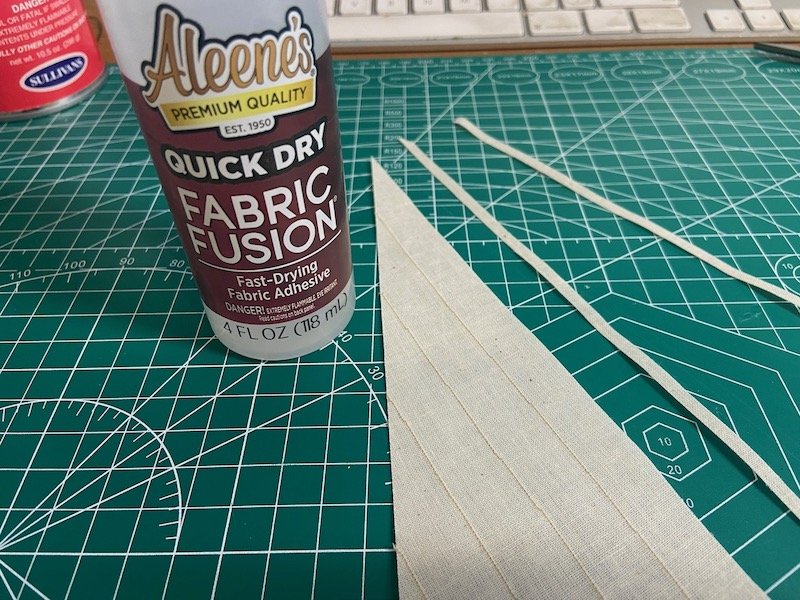

I'm gluing the strips using Aleene's Fabric Fusion, which is a clear, permanent fabric glue. I've never used it before. It's possible that my using the Fray Stop may keep the fabric glue from sticking as well. Not really sure about that. I didn't really consider that when I cut and sprayed those strips. We'll just have to see how it goes.
I glued the strips into place using Aleene's Fabric Fusion. I'm showing a rotary cutter in the photo below, but I actually ended up using a scalpel with a fresh blade for more of the cutting. The rotary cutter might have worked better if the blade was newer. It was fine really, but the fresh scalpel blade was better.

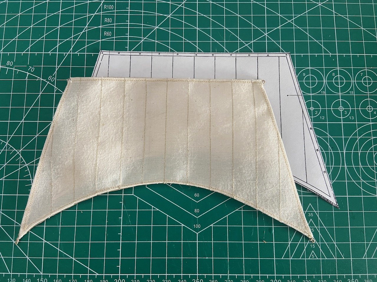

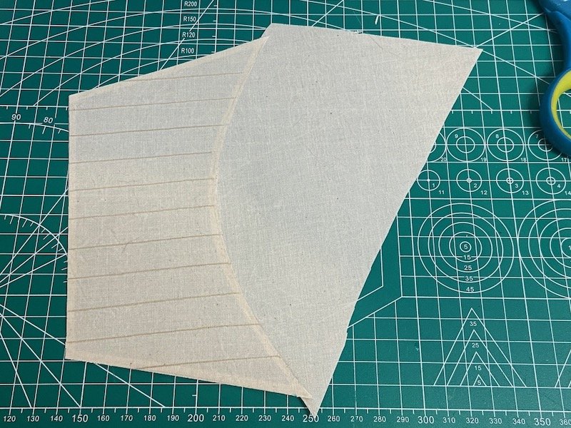

That curved edge of the topsail was the biggest challenge. I matched the cure as best I could in a larger piece of cloth, then glued the whole cloth to the sail. I then just cut the excess away.

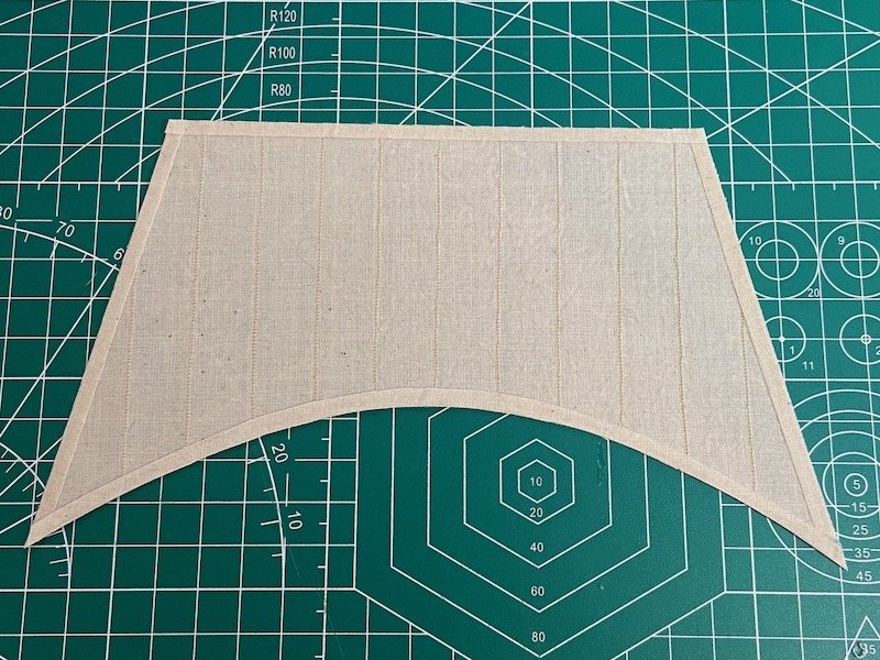

All tablings glued into place. I considered just leaving the sails in this state, but I wanted to show stitching of the tablings. I also thought that the tablings might hold up better if I end up washing them after I sew them.
Finally, here are the first three sails. Just the mainsail to go. The tablings are all secured with one line of machine stitching. That part turned out okay, certainly a lot better than my earlier attempt. I still need to add the bolt ropes. I'm not too worried about that part. I'm just gluing them into place. But, I'll probably add the bolt ropes to these three sails before I make the last sail.
