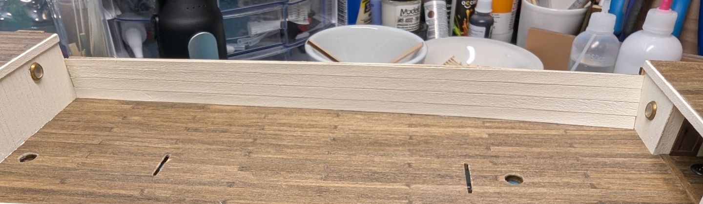

Gluing the decks was pretty straighforward.  I ran into a small problem with the bow bulwarks.  Because I reshaped the forward deck there weren't any notches to aligh the bulwark with.  This may be why I ended up with a larger gap than could be covered by the 4x4mm wood.  I cut a piece off the 6x6mm piece instead and made that work.
I saw a suggestion on Tom's build log about planking the bulwarks.  I've been trying to find a use for the kit supplied sycamore and this was the first place I felt it would be "ok".  I think it's a bit wide but I can live with it.  Painted first and followed up by adding the bulwark stanchions.  I used 1/31 x 3/32 wood for the stanchions instead of the kit supplied wood.
When I put the deck plank that runs along the bullwark (the waterway?) it didn't quite snug up enough against the bulwark and there were some gaps, especially at the curve.  I had purchased some 1/32x1/32 wood to make doors with (more on that in a minute) so I used it to lay another framing piece to cover the gap.  I decided not to try and paint the 1/32x1/32 wood in advance because I thought it would be a pain so I painted it after gluing.  I touched up the paint all around at the same time.  I'm pretty pleased how this came out.  Probably not historically accurate but it looks pretty good! :)

The final thing I needed to solve before I could plank the hull and block access to the wiring was the skylight.  I thought about this one for a few days before deciding I would try and cut a hole in the deck and see if the ambient light from below would be enough to illuminate the skylight.  It was not and in the end I added a specific LED.  I didn't think of cutting out the middle until I'd already assembled it.  That made it a little tricky.
First, I had to pick a stain.  After trying a few, what I liked was a mix of the Sapelli stain from OcCre and a stain called English Oak.  I mixed them 50/50.  Also, I didn't not like the look of the scratched plastic, so I bought some 7 mil milky white sheets off Amazon.  The LED by itself was much to bright, so I build a light box to diffuse the light.  I ended up using 3 layers of plastic for the light box and 2 layers for each window. Finally, for the hinge on top, I'm using a polystyrene rod.  Easier to work with and takes black paint well.
It's not quite finished but this is the work in progress.
