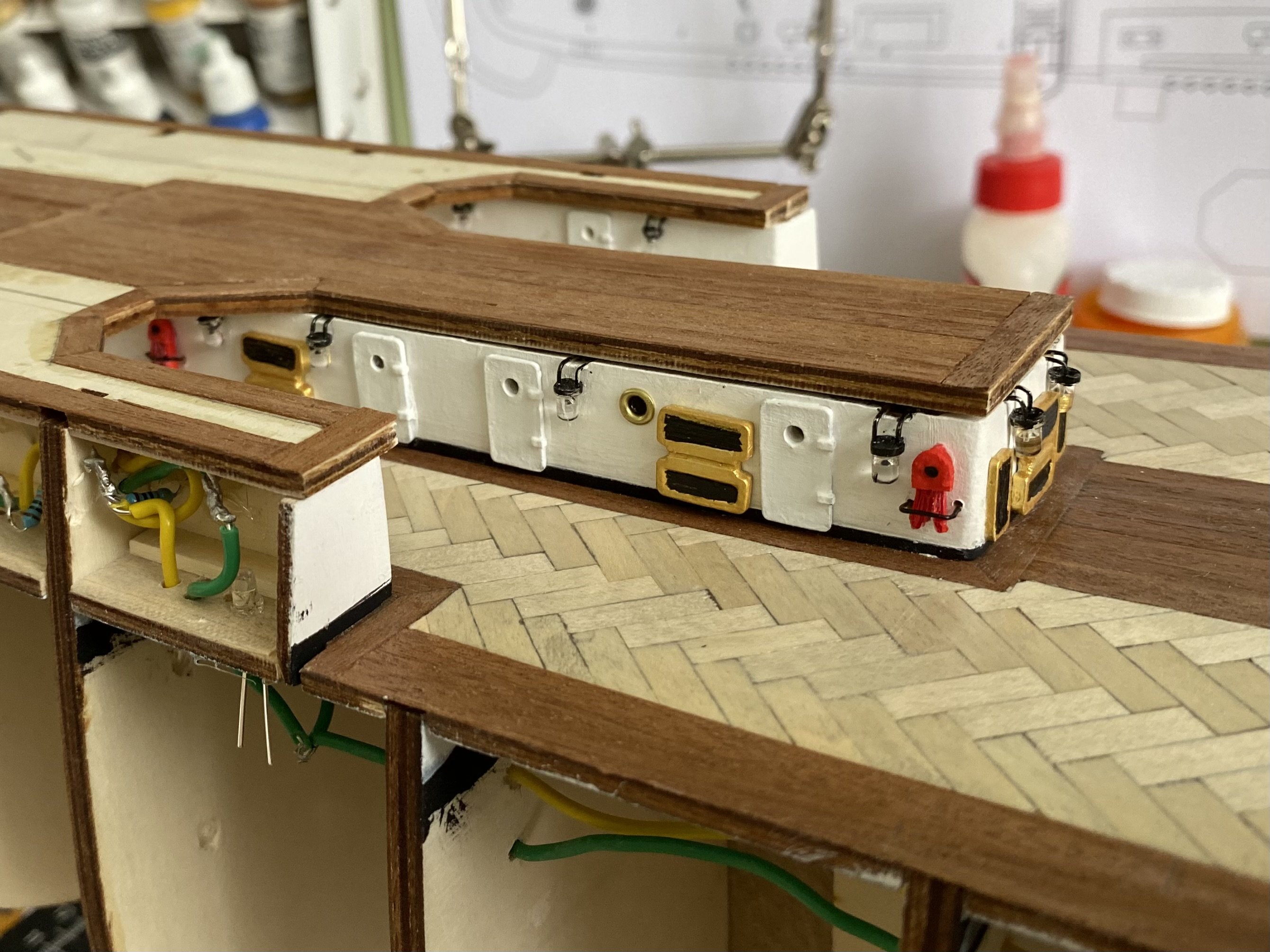

Today I am getting into dry fitting the main deck structures so I can begin the layout of my future deck planking. My plan is to go way out of the box and do a herringbone deck pattern with the included deck planking material but also outline the structures with walnut planking left over from my Endeavour. Will dry fit a bit of the planking to see how it looks before I proceed with the scheme.

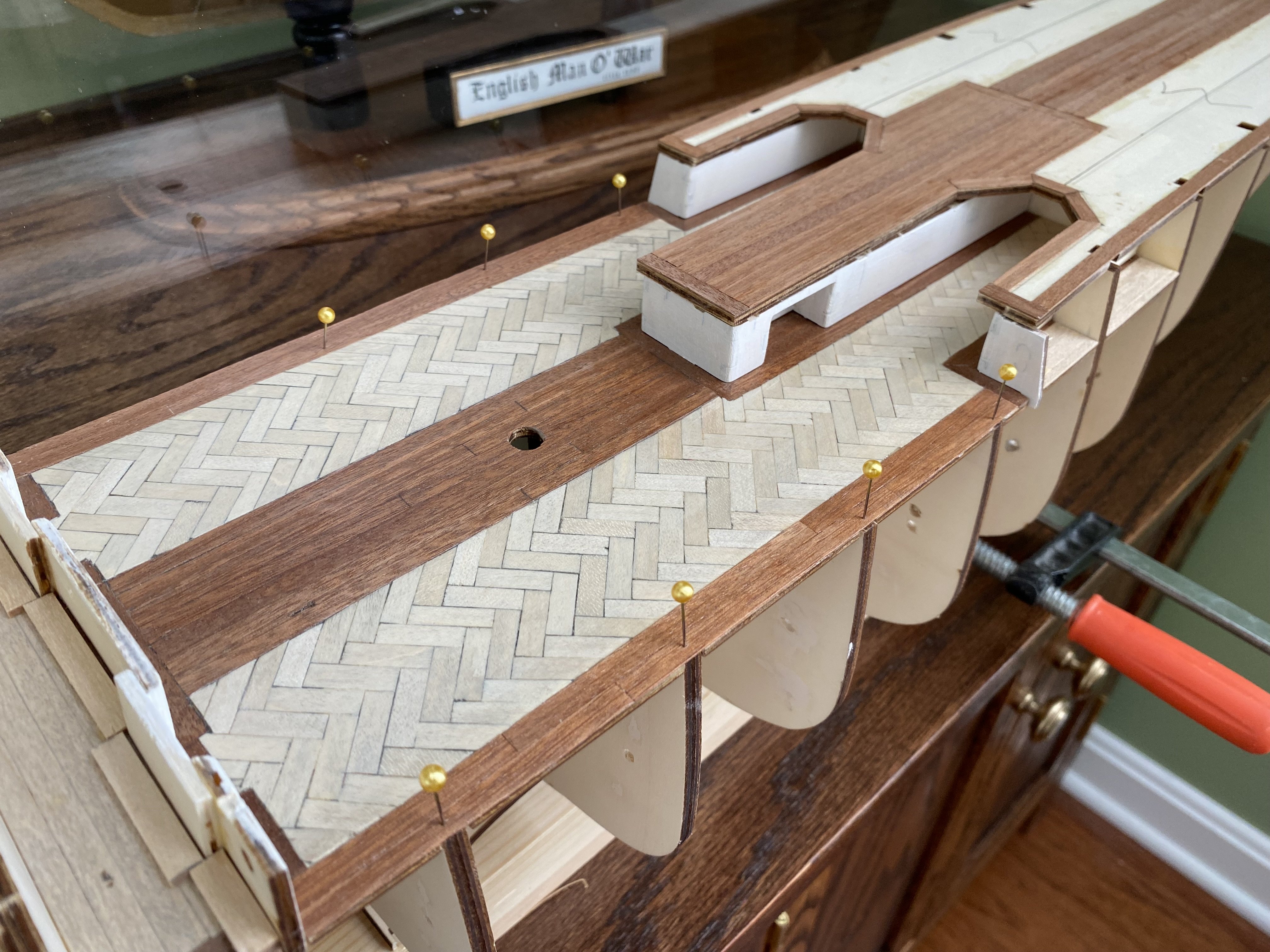

Call me crazy but I think this is going to look pretty cool. I have started planking the main deck. I used walnut strips to border the sides and structures and run a band down the center of the deck which will be furthered copied on the fore and aft decks. The area inside the borders is being filled with the lighter planking supplied with the kit. I am laying this planking in a herringbone pattern.  Nothing at all authentic about this. Just something I want to do to add additional visual interest.

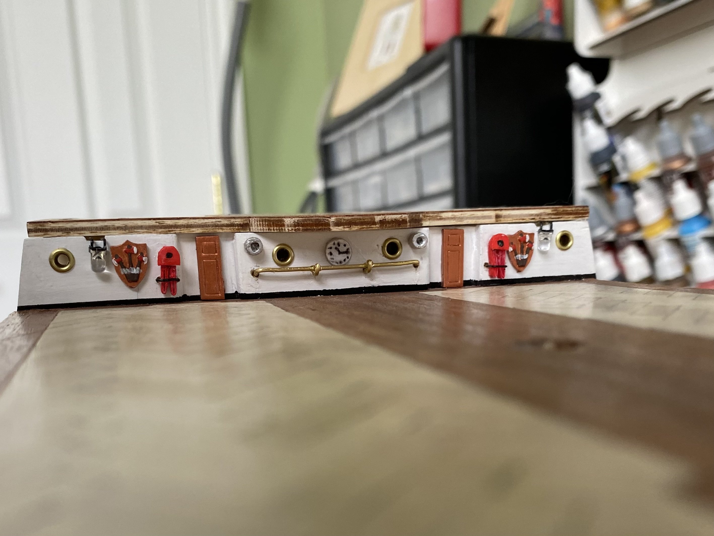

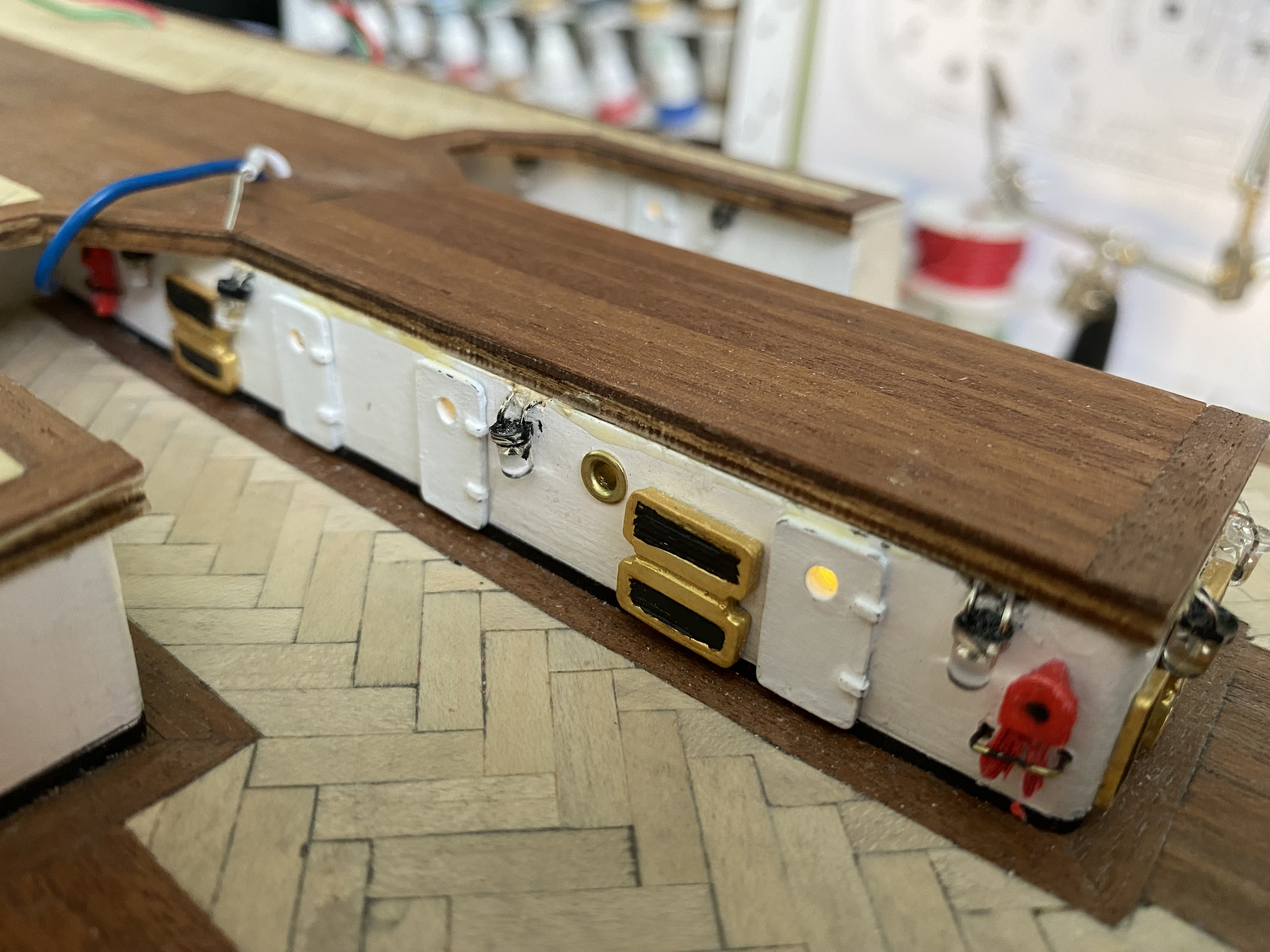

Working on building and wiring the fire control room. Following a plan using Daniel’s build along with the OcCre instructions and the online video tour of the ship. As I mentioned before I am going to step outside the box with my build and add some personal artistic license over complete authenticity. Since I will be installing LED lights inside the room I used the OcCre supplied doors with the small holes and further drilled the holes into the walls of the room. This will allow lighting from the interior to shine through these small holes as well as the port holes. Following the OcCre instructions I painted the vents gold. However after further review of the online tour I may remove the gold and paint them white just as Daniel did. The circuit that powers these lights will also power all the other main deck lights. I intend to add other elements to the outside walls of the room like fire hoses, etc.

A little main deck work continuing. Stern walk finished with adding the two axe holders and fabricating firehose mounts which are not part of the OcCre kit. Fire hoses also added to the fire control center. A few more trinkets added here and there. Then will see where I want to go next.

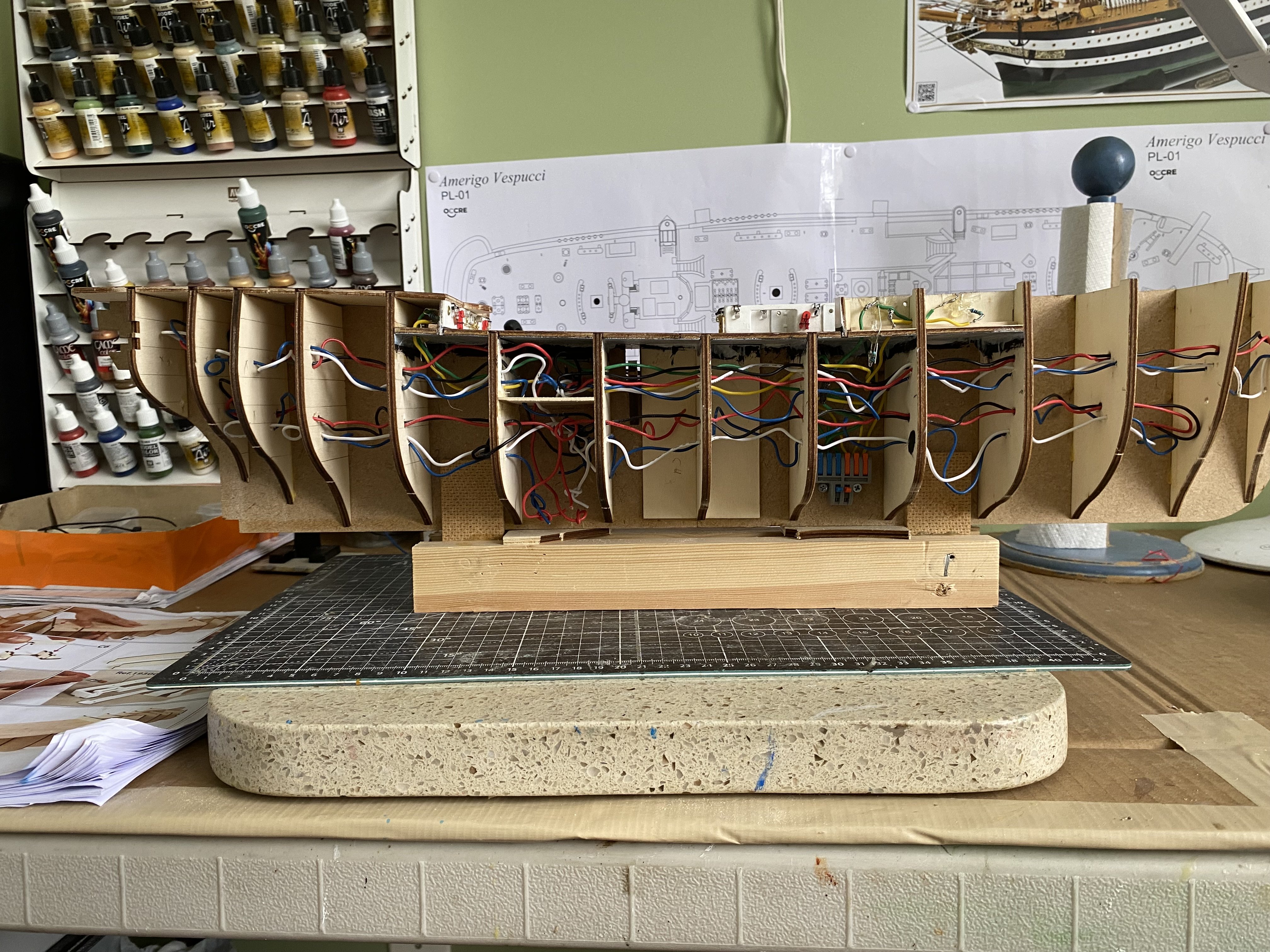

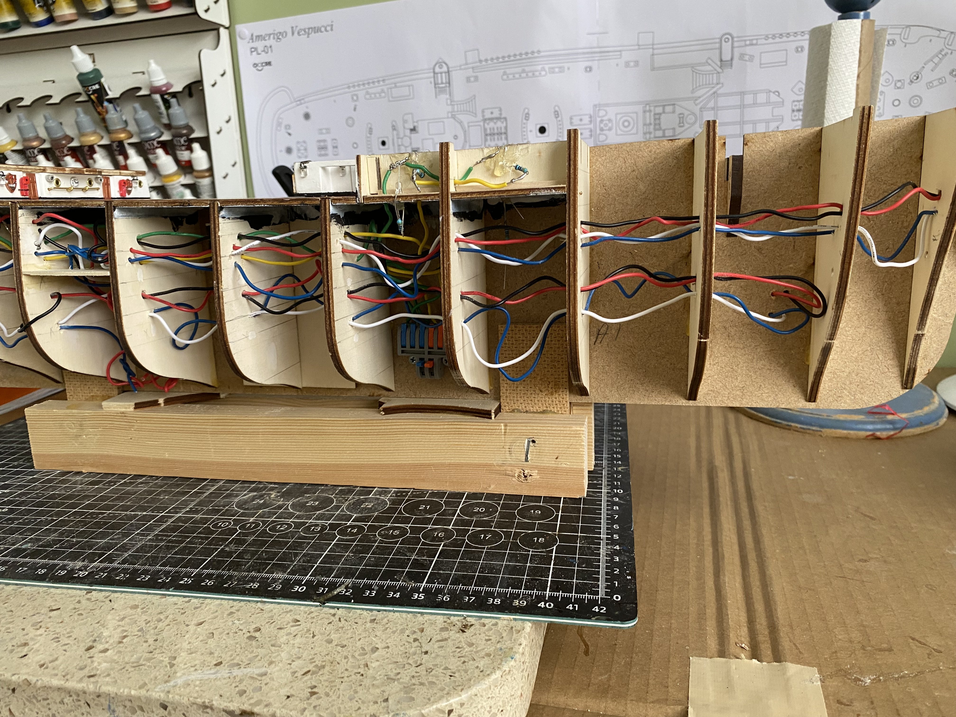

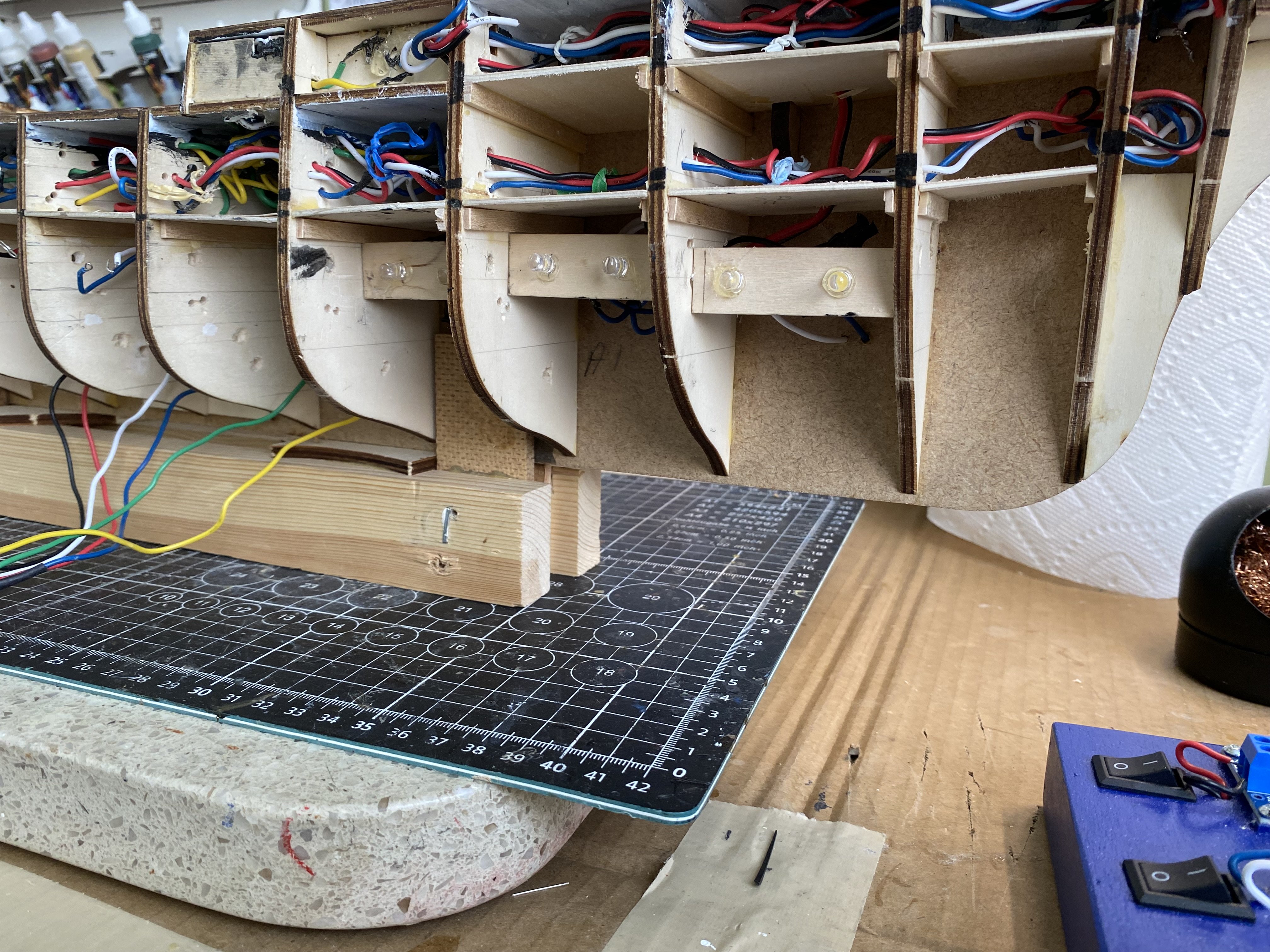

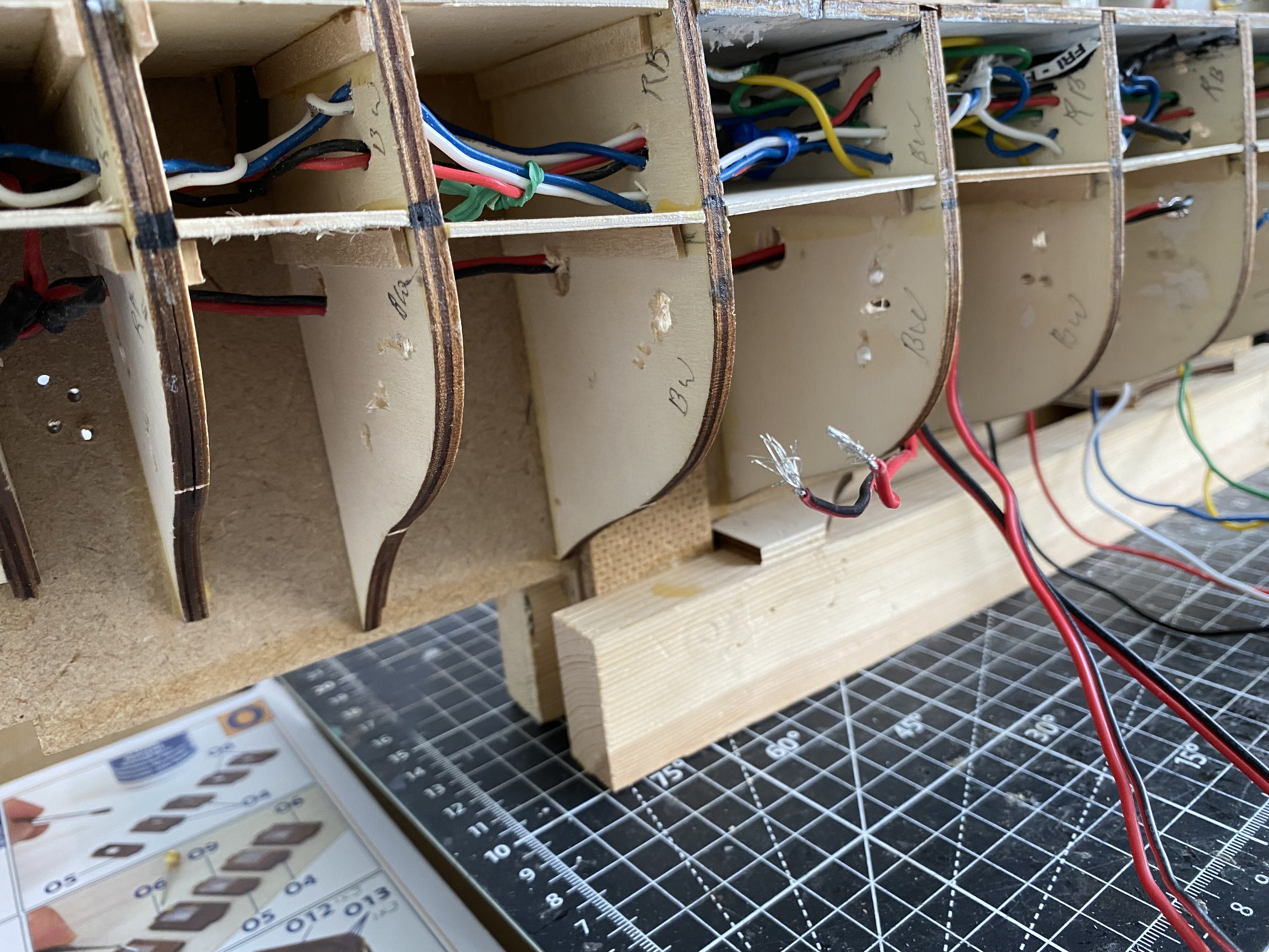

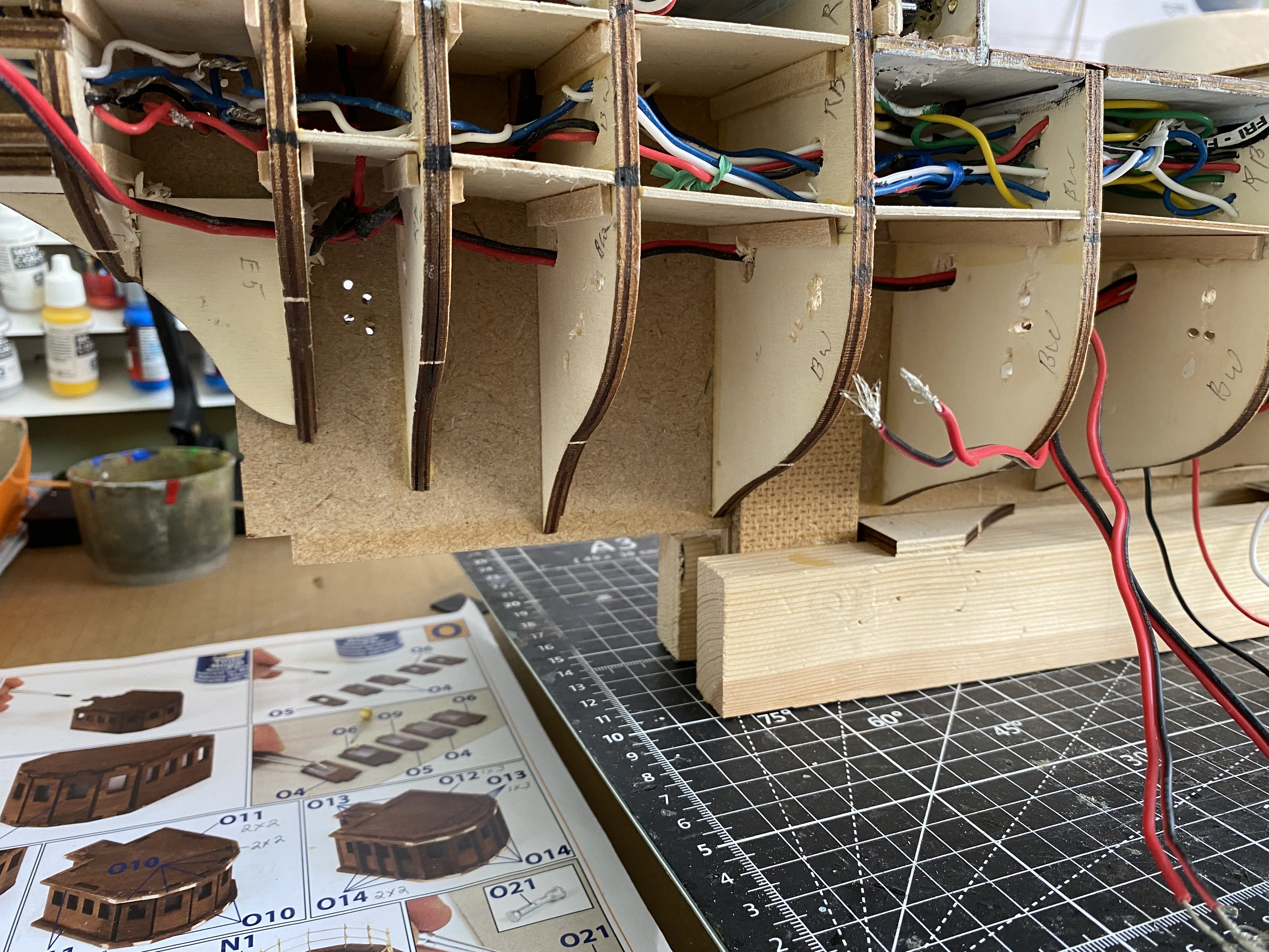

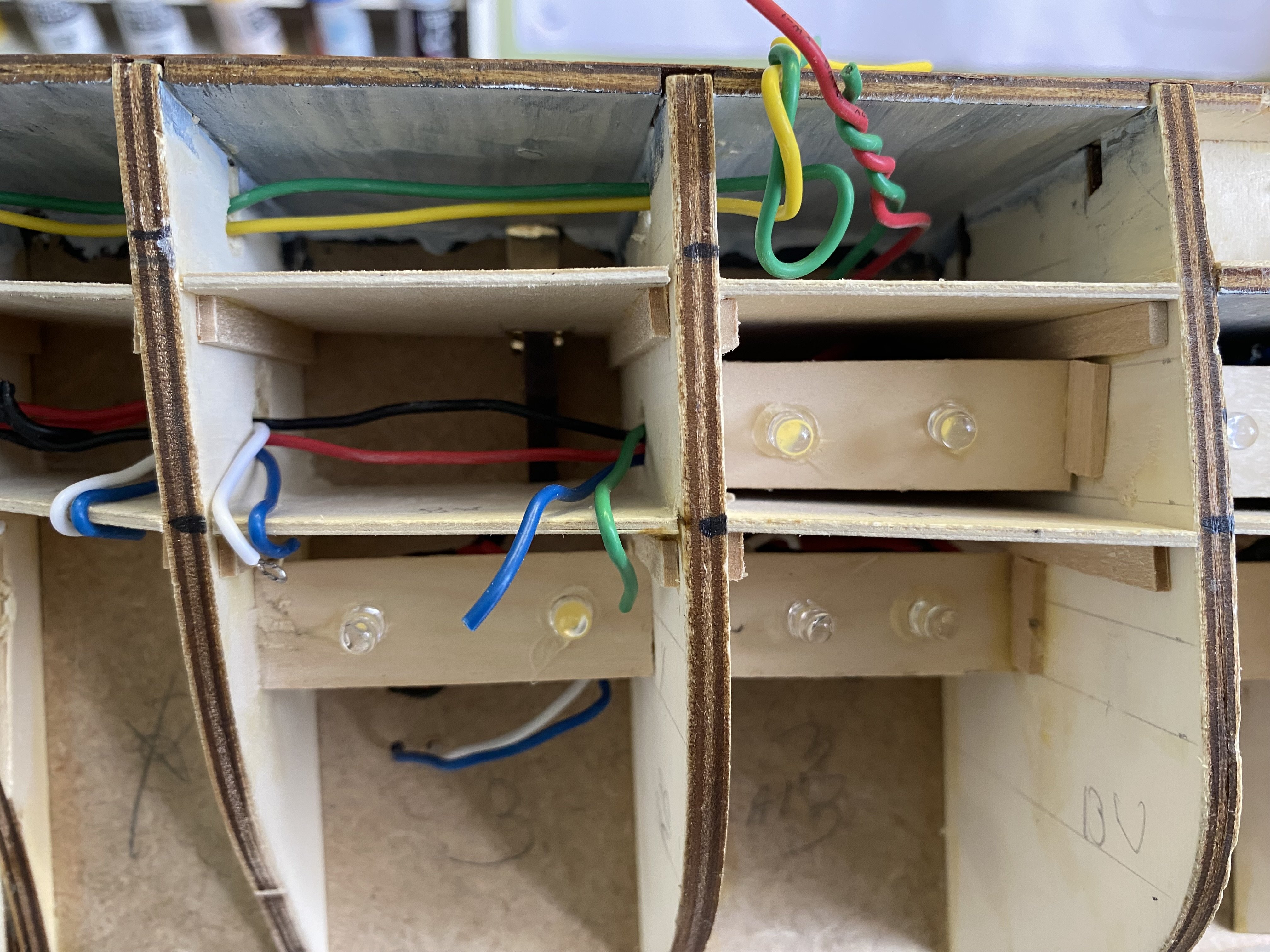

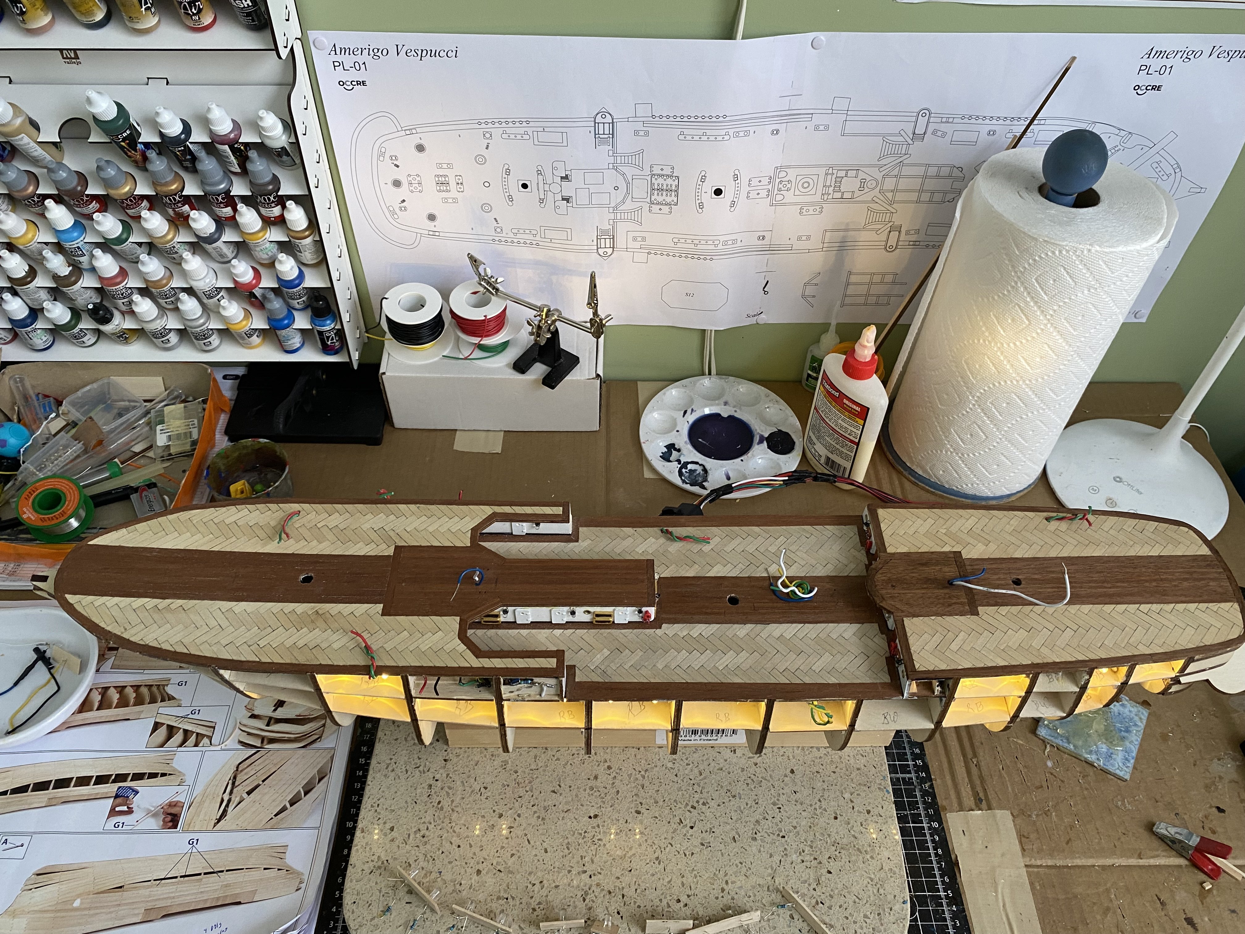

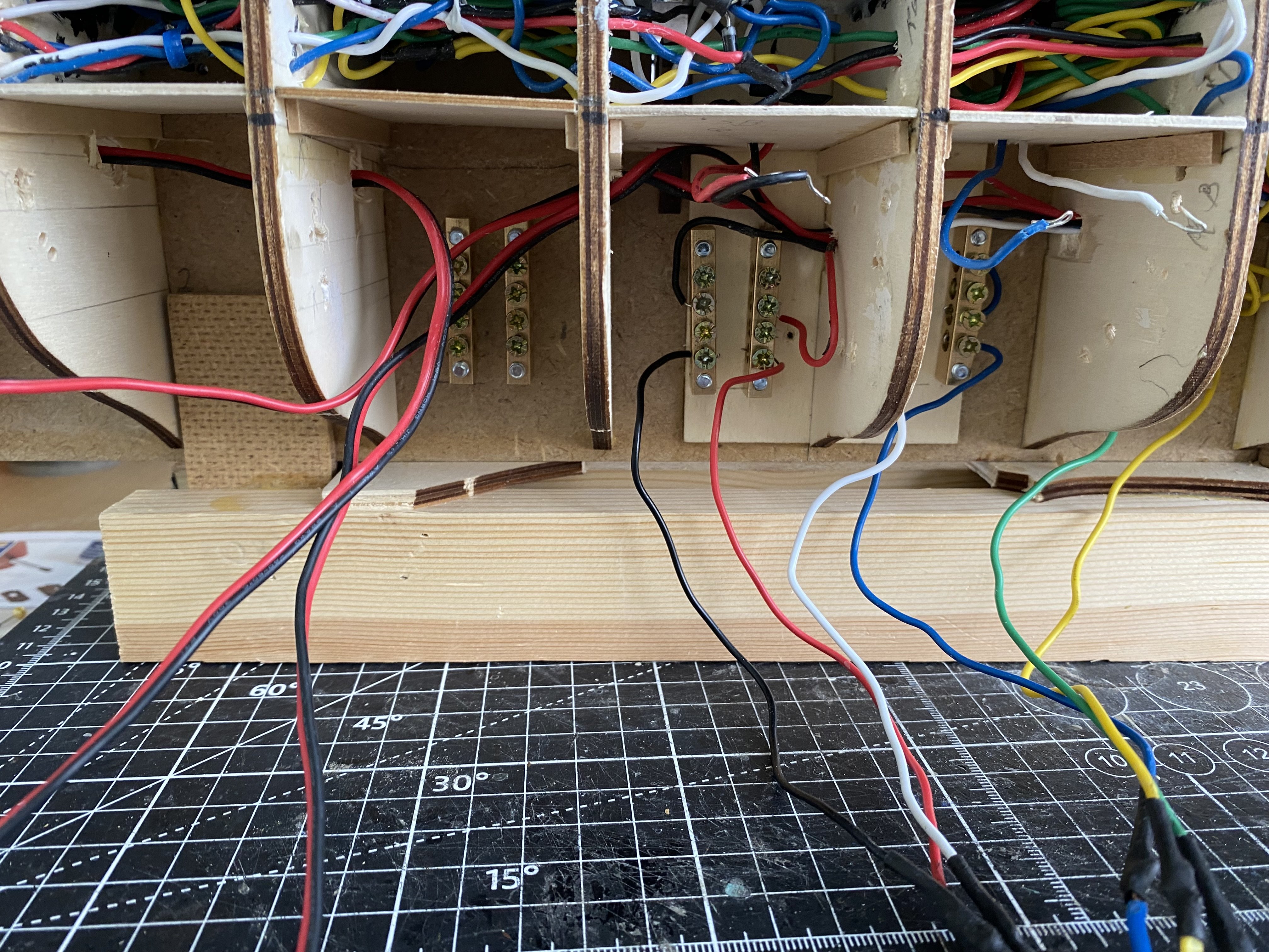

Definitely a lot of electrical wire going to the hull of my AV!  Running wire for my future plan to have three separate circuits of LED lights. One is the deck lighting (green and yellow), two is selective port hole lighting on both decks (black and red), three is the other port holes not lit with circuit two (blue and white). The goal is to not have all port holes lit at the same time. Some on, some off, or all on. A forth circuit will be added eventually for the navigation lights and the distinctive mast lighting.

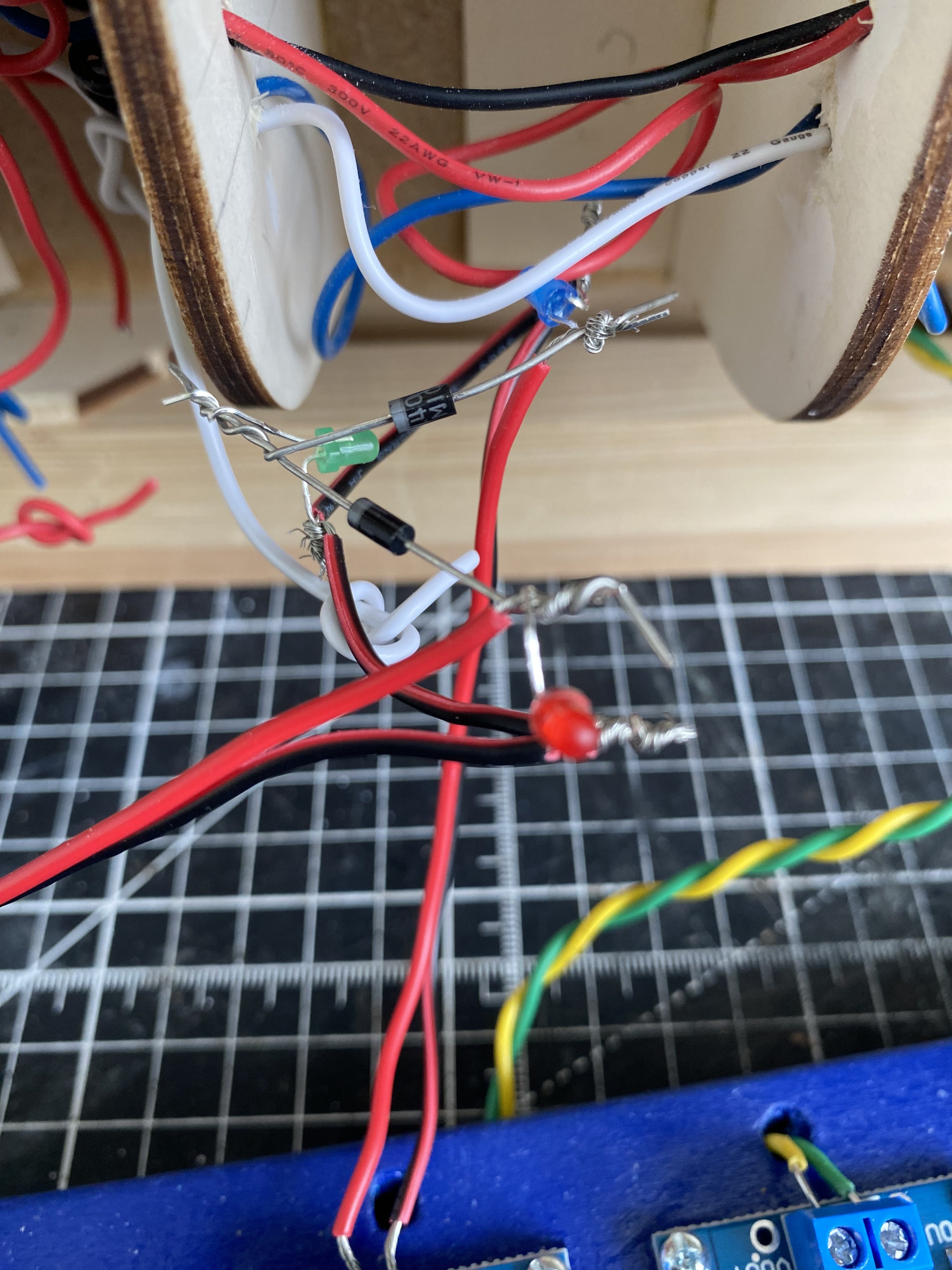

For my plan to light my Amerigo Vespucci I had an issue I needed to figure out. I am running two separate circuits for all the port hole lights on the two lower decks. I want some on, some off, or all on. I think this will give a more true display. However I have or will have interior lights in the deck structures (map room, fire control room, helm, etc. I want the lights in these structures to come on with either of the port hole circuits, not just one or the other. With Daniel’s guidance I discovered diodes in my elementary electrical skills. These little guys are perfect I making this circuit(s) plan work perfectly. Photo is just my test of how they work. The diodes are the little black cylinder shaped guys  IMG_6910.thumb.jpeg.42b13622f5dddd072e6a7b07fe558d5d.jpeg

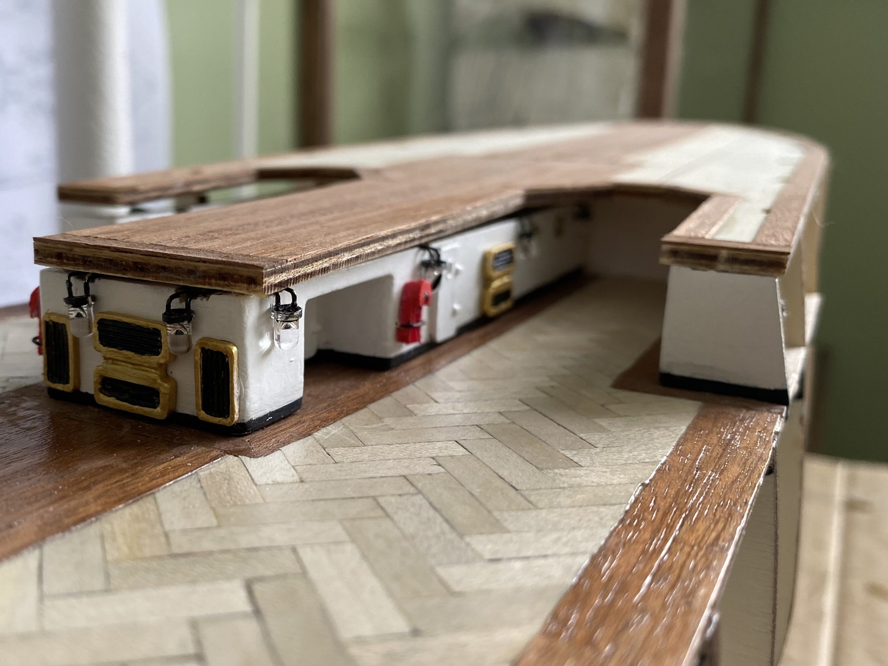

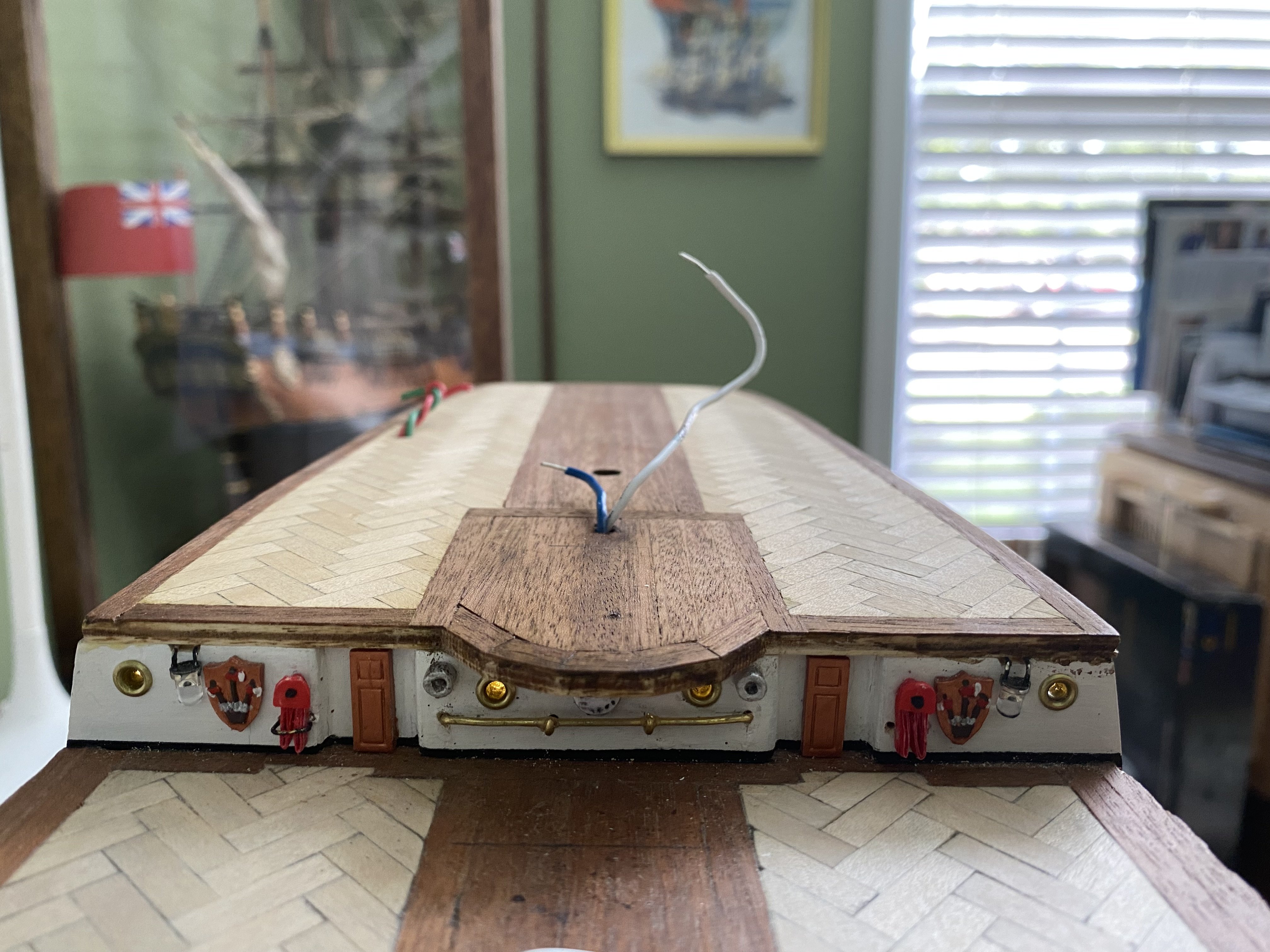

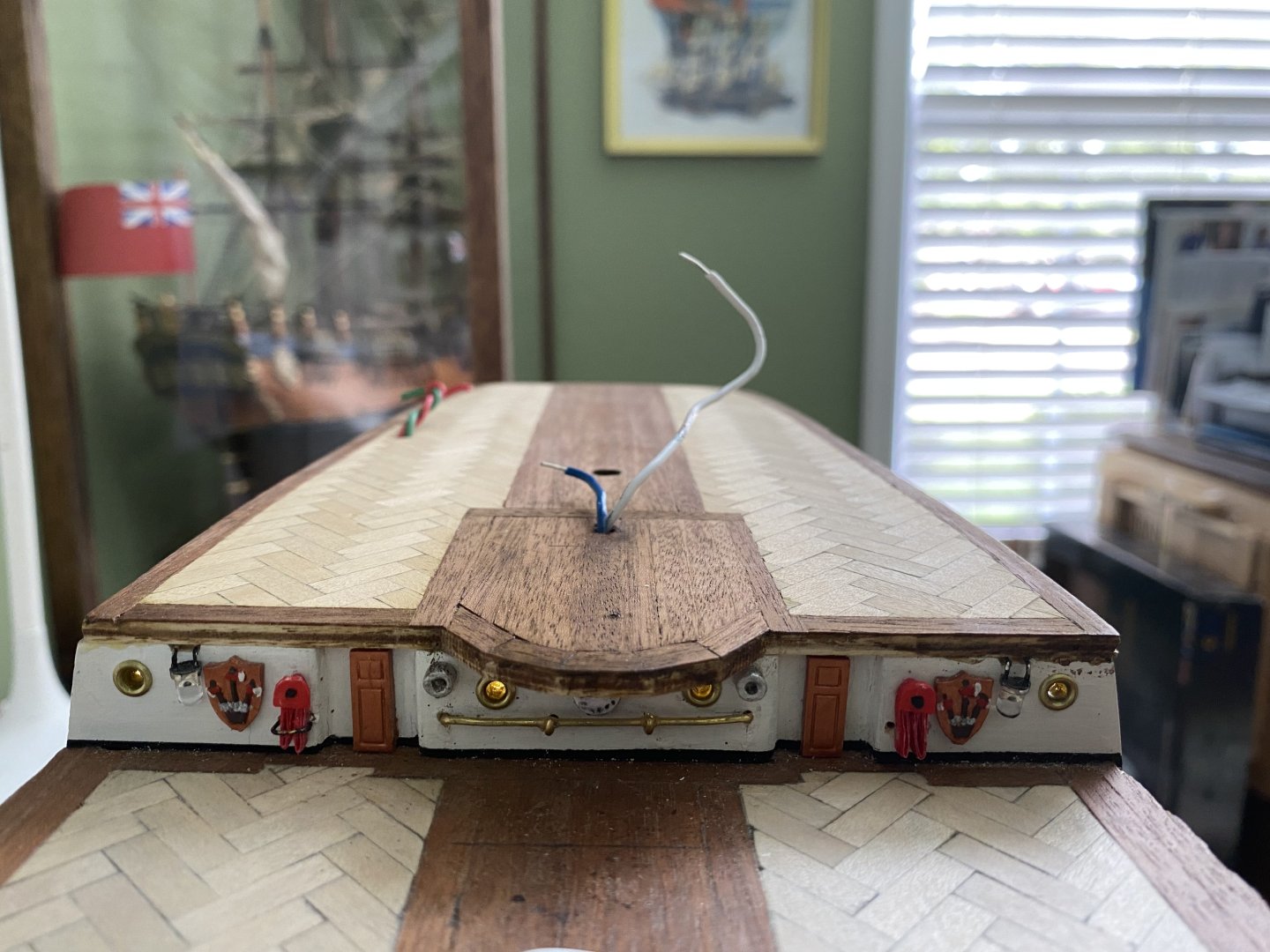

Finished the planking of the three deck sections. Many will call me crazy for doing it but as you can see I did a herringbone pattern using 3mm x 6mm planks laid in opposite direction on the port and starboard sides. I also laid contrasting walnut planks down the center and outlining the edge of the decks. This is obviously not authentic but I want to venture outside the box on this build. The fore and aft deck sections are dry fitted at this point. A little more work to do below deck before I put them permanently in place. After I glue them in place I will add a coat of black paint followed by an additional coat of white paint to the underside. This will hopefully prevent light bleed through the thin deck from the LED below deck lighting I have planned.

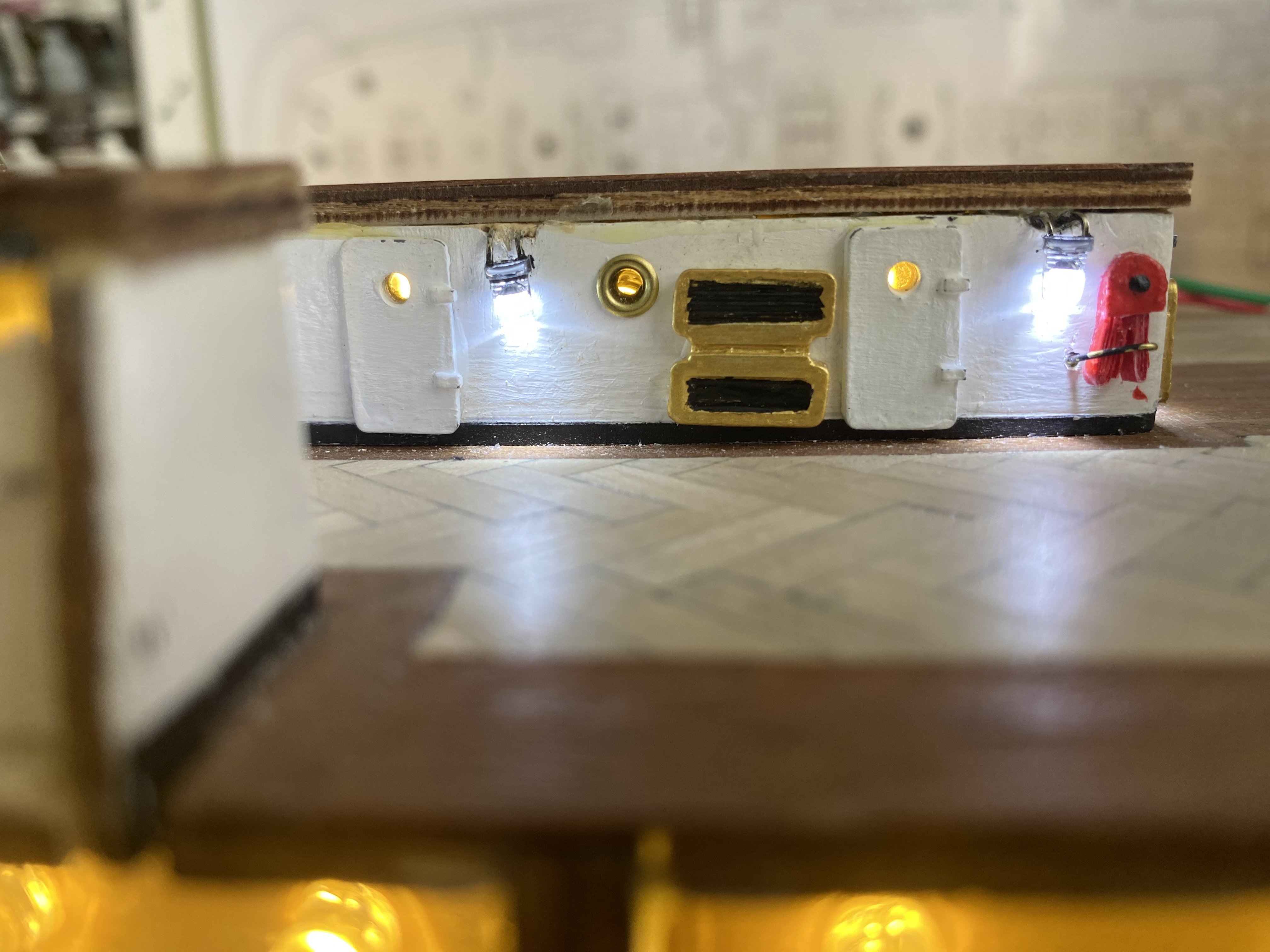

Daniel I made an interesting discovery. LED lights are brighter viewed from the top rather than the side. I researched this a little and found it is definitely true. This will add a degree of complexity to my lighting plan if I want uniform brightness. My plan for the side portholes is to mount the LEDs horizontally close to where the port hole will be. This will give maximum brightness through the port hole. However for the deck structure interior lights, that will be on the same circuit(s) using diodes, my plan was to mount them vertical in the deck inside the structures. This plan results in dimmer light shining through the windows and portholes compared to what eventually will shine through the hull portholes. So if I want uniform brightness I will need to mount them horizontal as well.
Been a bit since my last update. Have been working on the issue I described above. I noticed I was not getting a uniform level of light from the port holes on the deck structures if I had the LED bulbs mounted vertical. I am also using 5mm lights. I have 8 holes in the fire control room including port holes and holes at the top of doors. So I really wanted to mount a LED at each hole. It is a bit of a snug area. The wiring for the outside down lights is also I closed in here. After a number of iterations I finally got what I wanted. I am using 5mm warm white lights for the interior of the deck structures and will use this same LED for the port holes on the two decks. The deck lights are 3mm white bulbs.

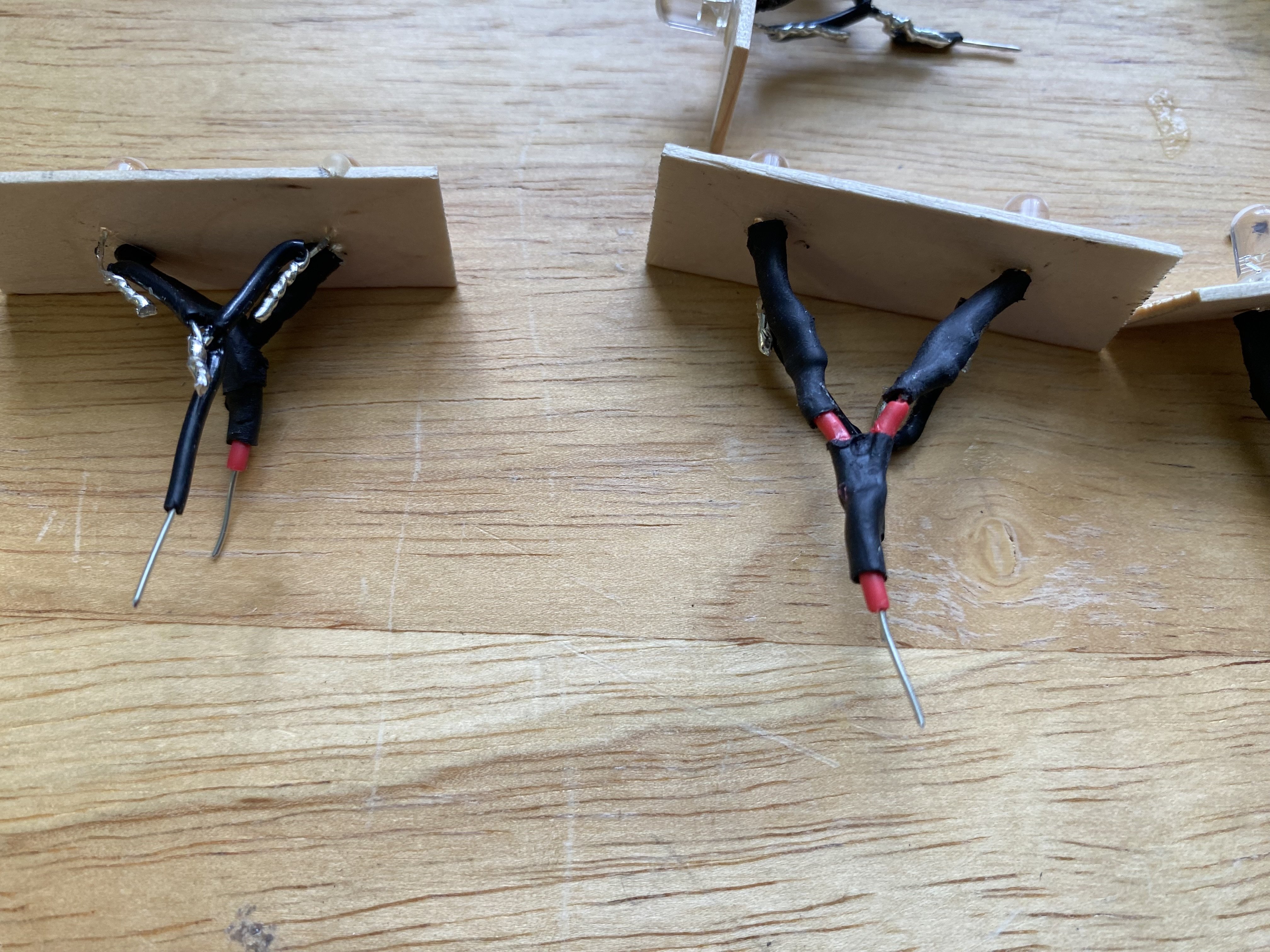

Bill, love the LED "deck lanterns" and internal illumination. To reduce possibility of shorts, you could provide protective "heat shrink tubing" at your soldered joints. It is a neater solution than electrical tape. Can't be added now except at "dead end" joints for example to the left of the third internal LED in the first picture above, where you could slip the tubing onto the soldered length then shrink. Either a heat gun (preferred) or your iron can be employed to heat thus shrink the tubing.
Just an idea for future soldering 👍

I love the herringbone, Bill. That must have taken some careful cutting. The lighting looks amazing, though like almost all things electrical the detail is a mystery to me.

Yes Ian you are correct on the heat shrink tubing. I am using that product extensively on my newer soldered connections. Before  I was fully knowledgeable of it I had a number of connections already soldered. For those I found a liquid rubber product I can just paint on a soldered connection. When it dries it forms a rubber coating to protect. Many many soldered LEDs to go in 4 separate circuits.
Thanks Kevin. It did in fact take a bunch of plank cutting. The electric lighting really is not extremely difficult. Once you learn the basics and if you have a great tutor like I had in Daniel.

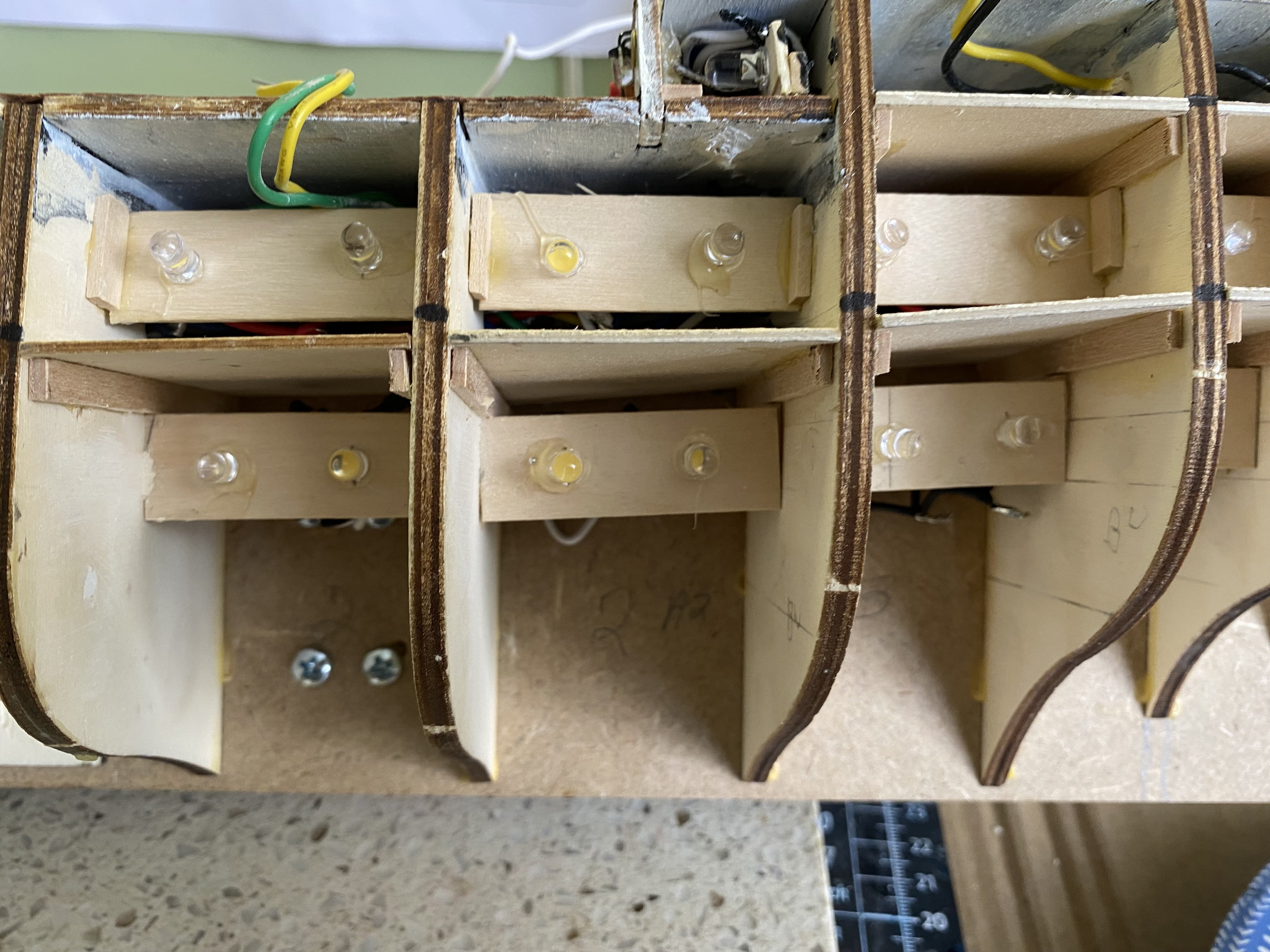

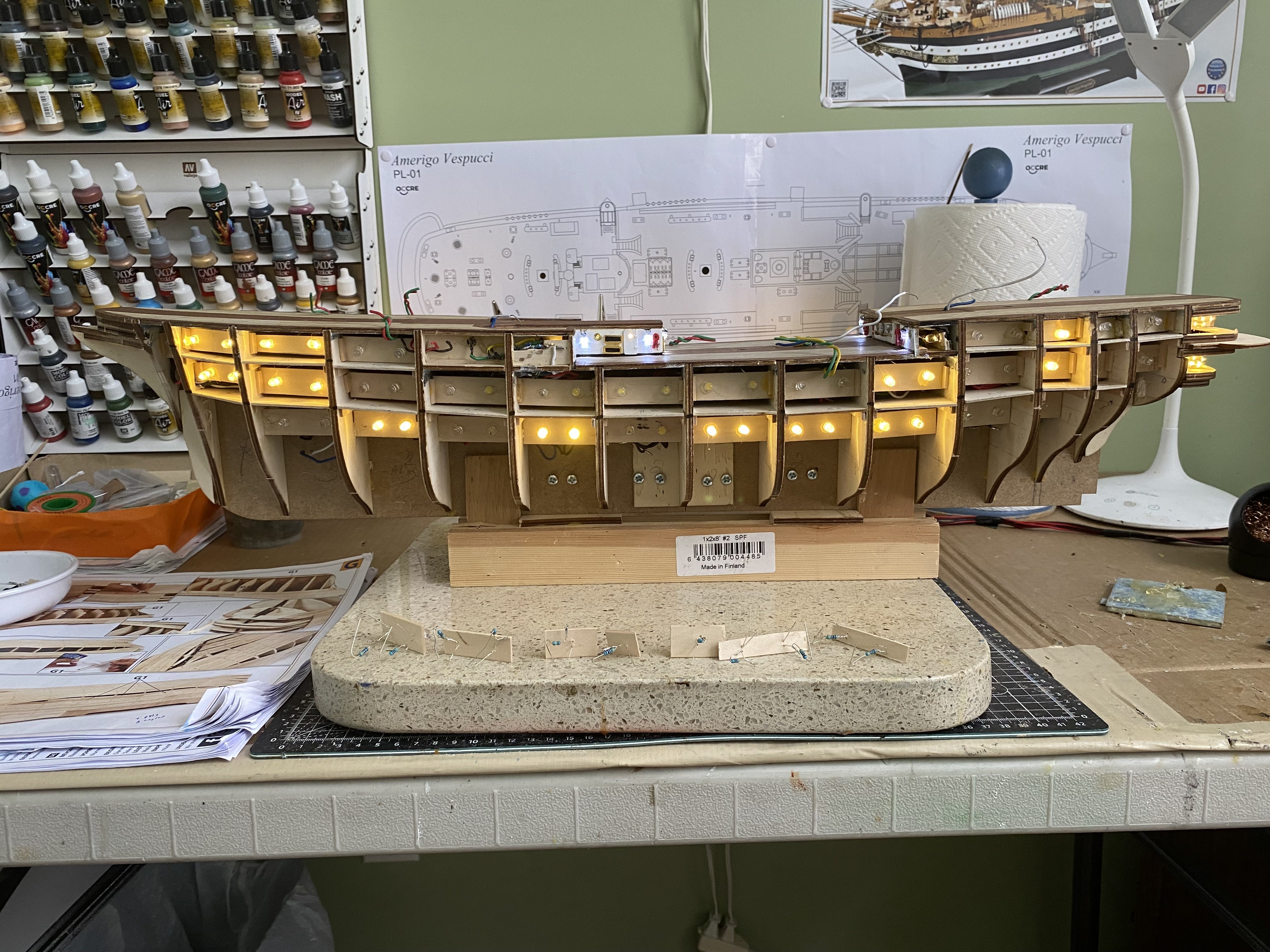

I noticed it has been about 3 weeks since my last update. Never fear I have not given up on this beautiful model. However I have spent time going backwards.  I came to the conclusion that I really was not pleased with the installation of my lighting for the lower deck port holes. After Daniel expressed his concern with the circuit distribution little plastic clip things I was using I started feeling less confident in them. I therefore purchased and installed bus bars. I think I will be more confident in them and even considering putting a drop of solder at each screw to prevent ever coming loose inside the hull. Next I realized when I drilled all the holes in pieces that make up the hull (forget nauticle name) before gluing it all together I drilled them too close to the outside edge. When u started running all the wiring I had no place to put my LED light supports.  So I just decided to pull out all the wiring and start over. Fortunately I have an 18 inch long small hole drill bit I was able to start at the bow and stern to drill all the way through close to the center of the ship. Now I am running the wiring through these new holes which leaves plenty of room for the LED supports. I have just done the lowest deck so far. The middle and top decks are still to follow. You can see in my photos how crowded the wiring is in the middle deck. I also decided to go with two lights in the wider sections of the ship to get better light uniformity.

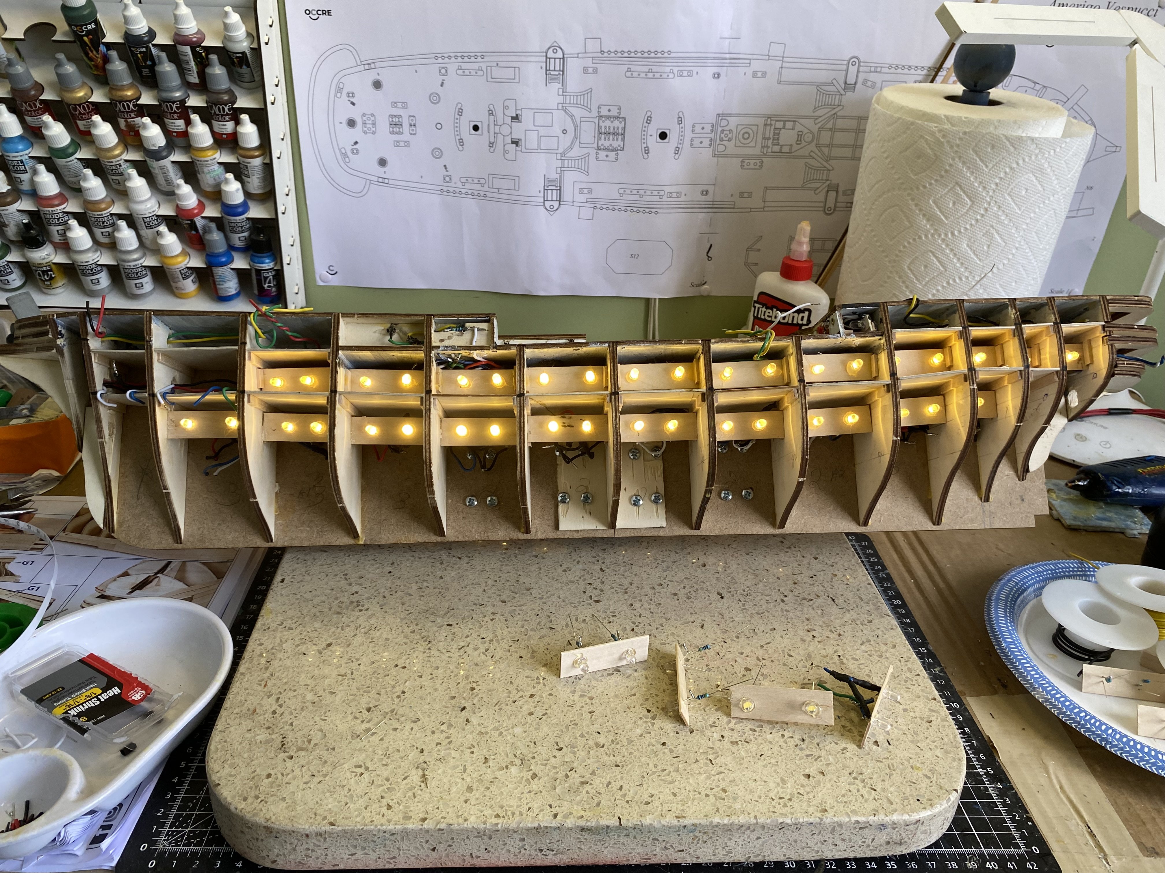

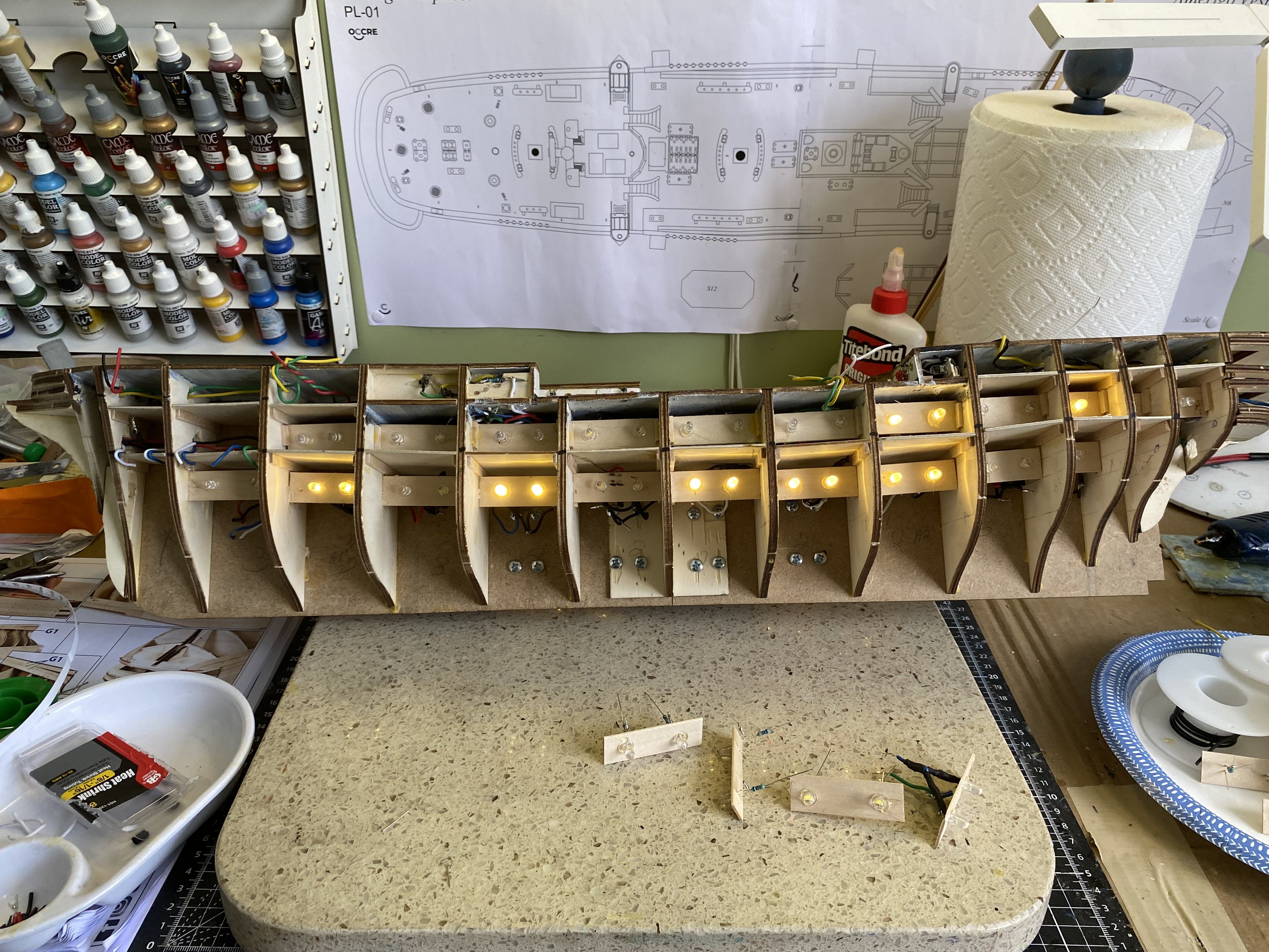

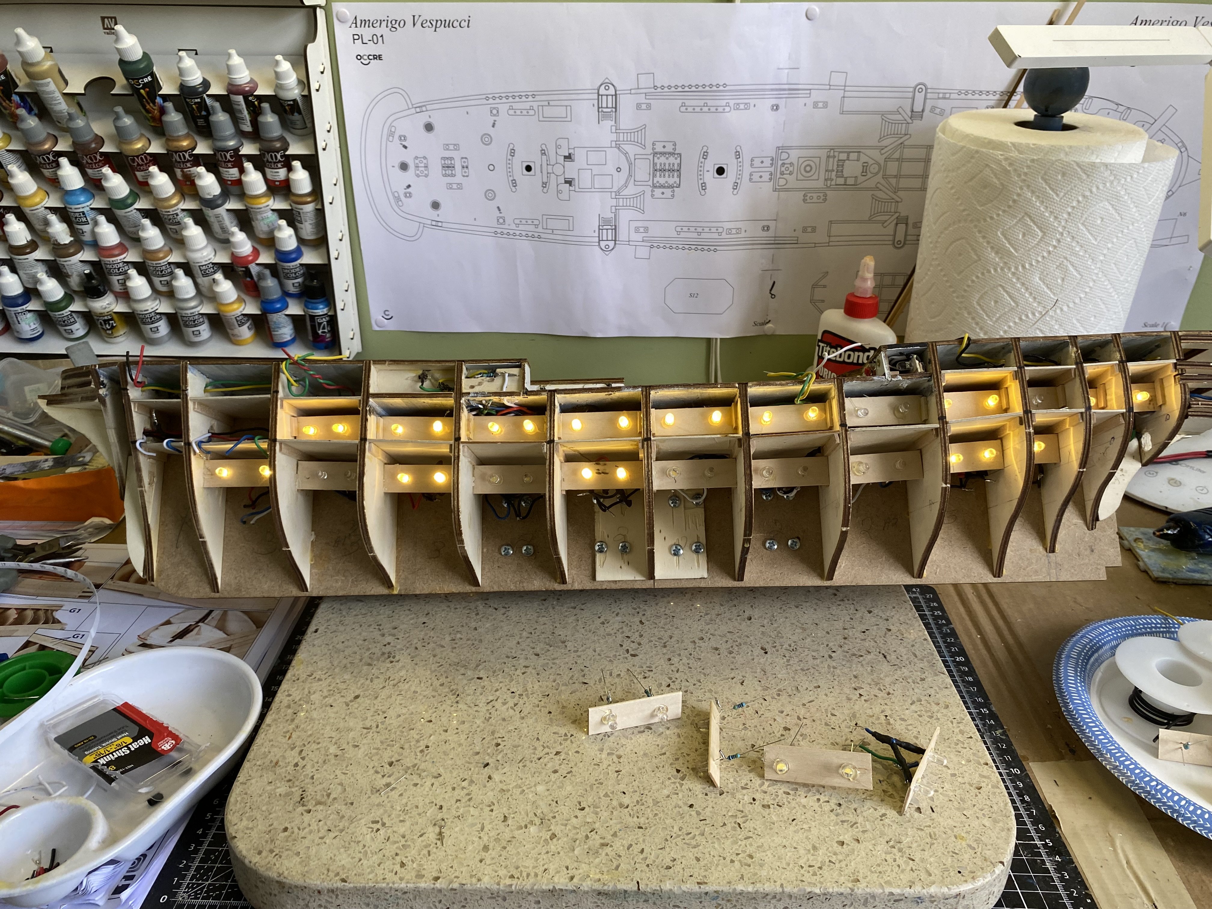

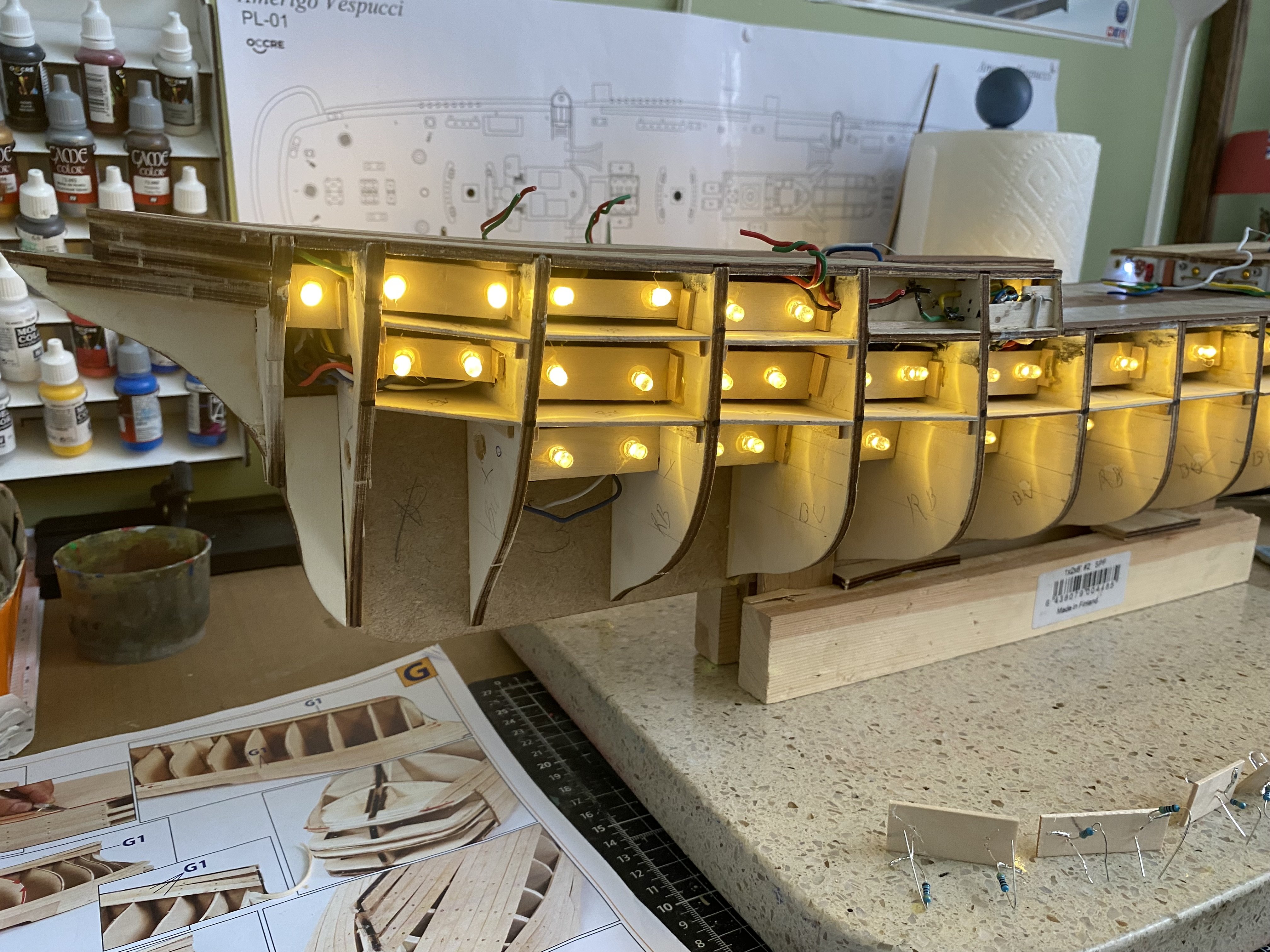

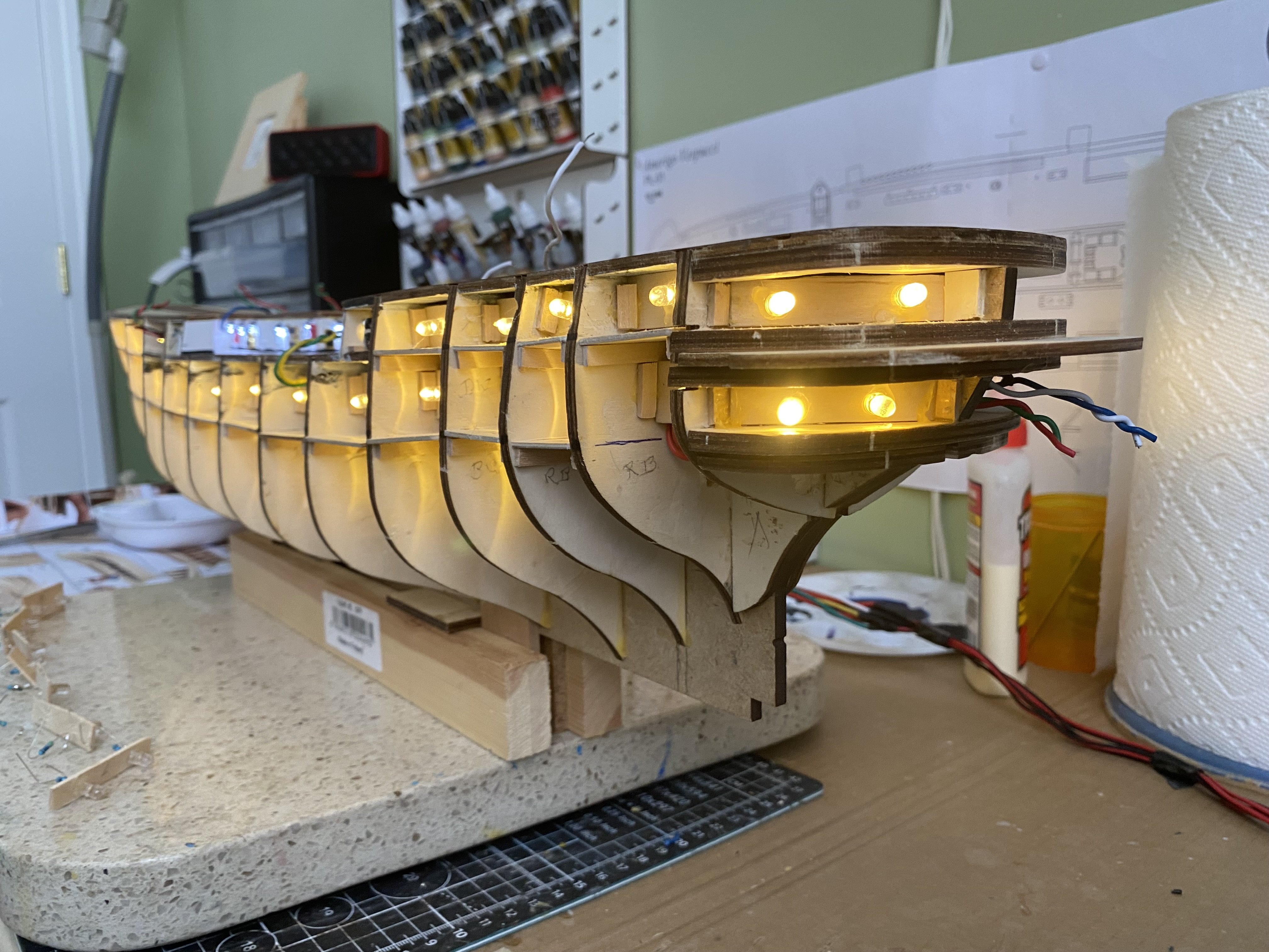

Warm white LED lights installed on the port side lower deck which will eventually shine out through the port holes. I used two separate circuits so I could display with some lights on, some off, or all on. This will more keeping with what it might look like at night. I made deck sections to separate the lower and middle decks so light from one deck will not shine through the port hole on the deck above or below.

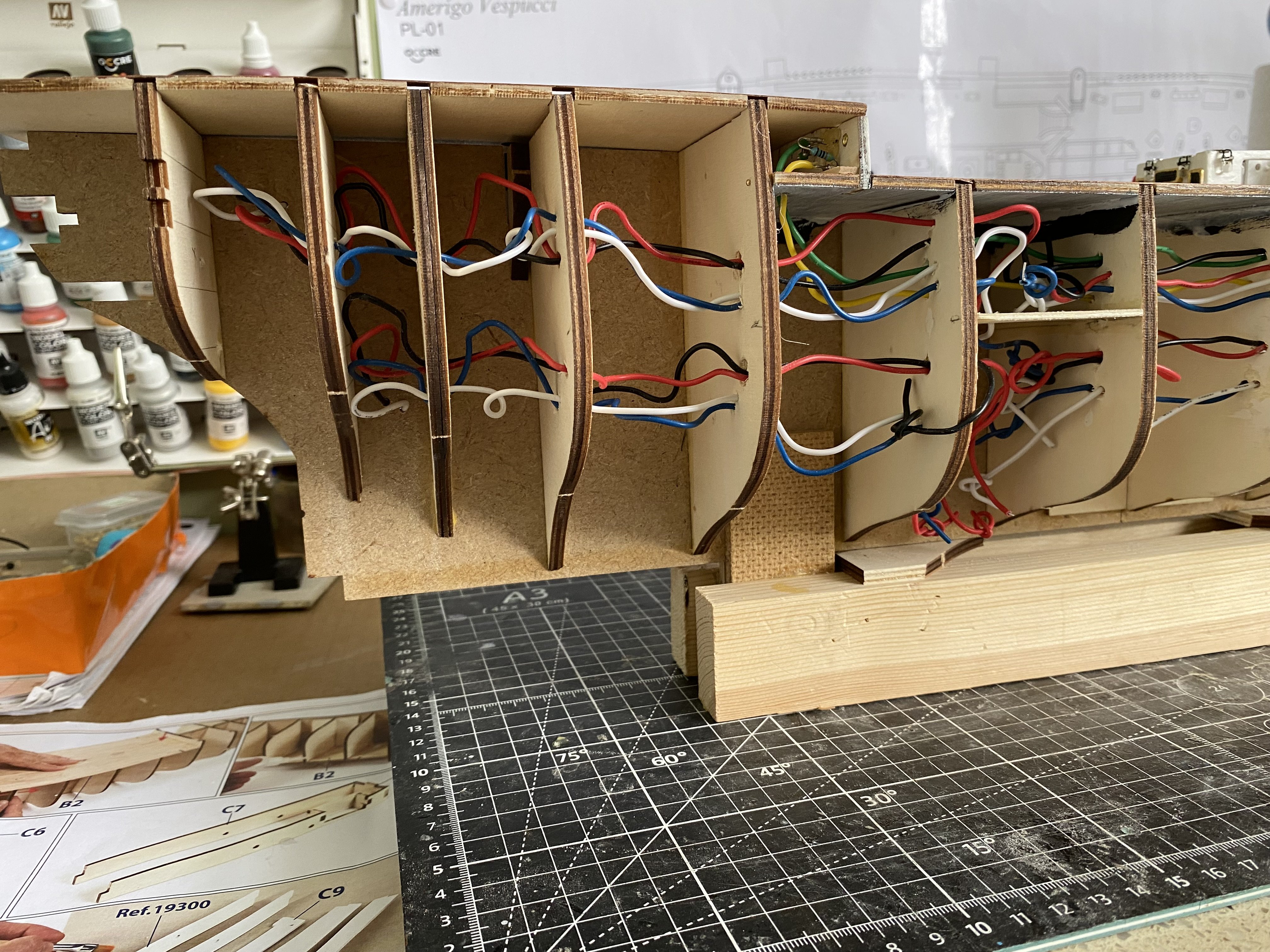

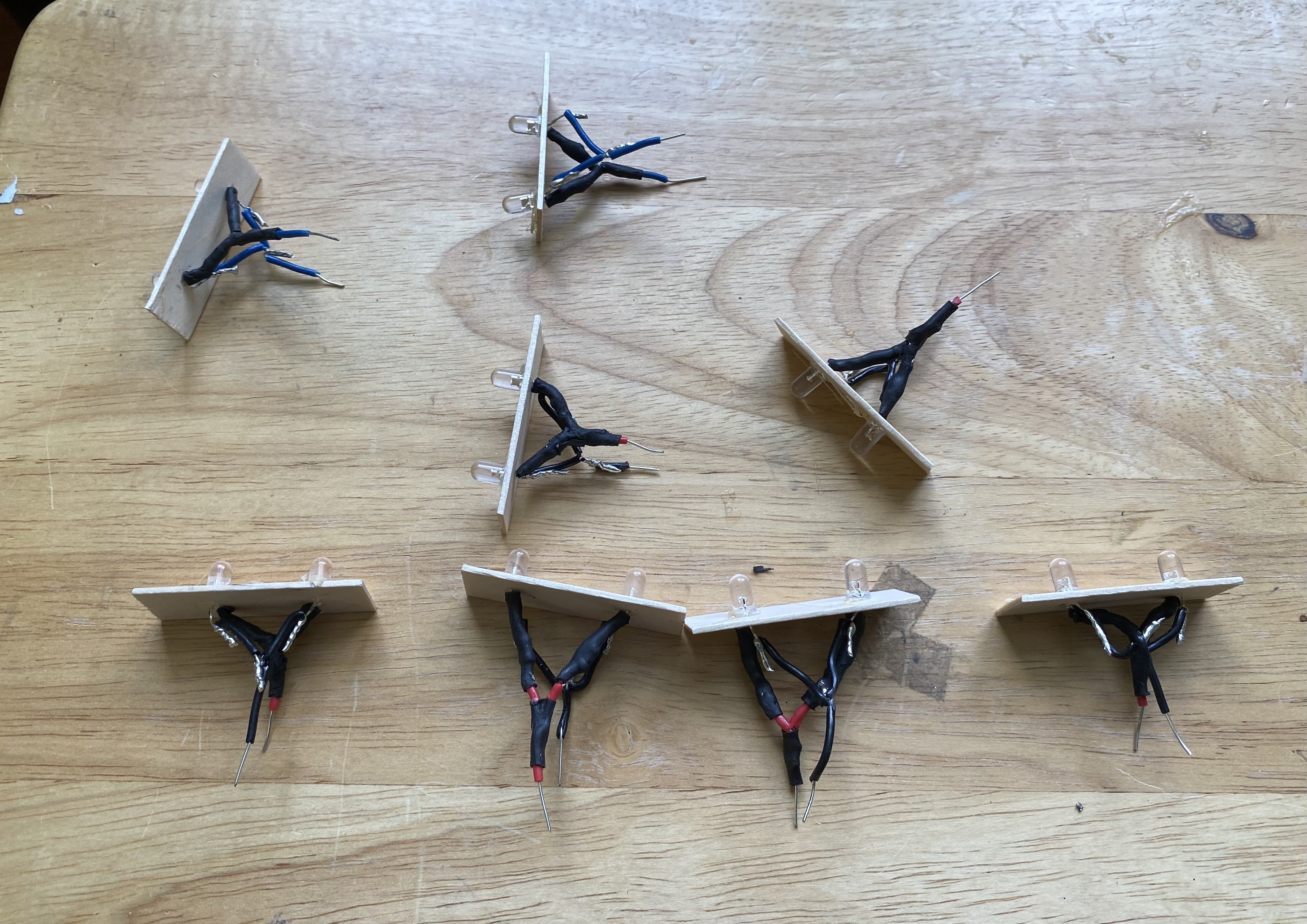

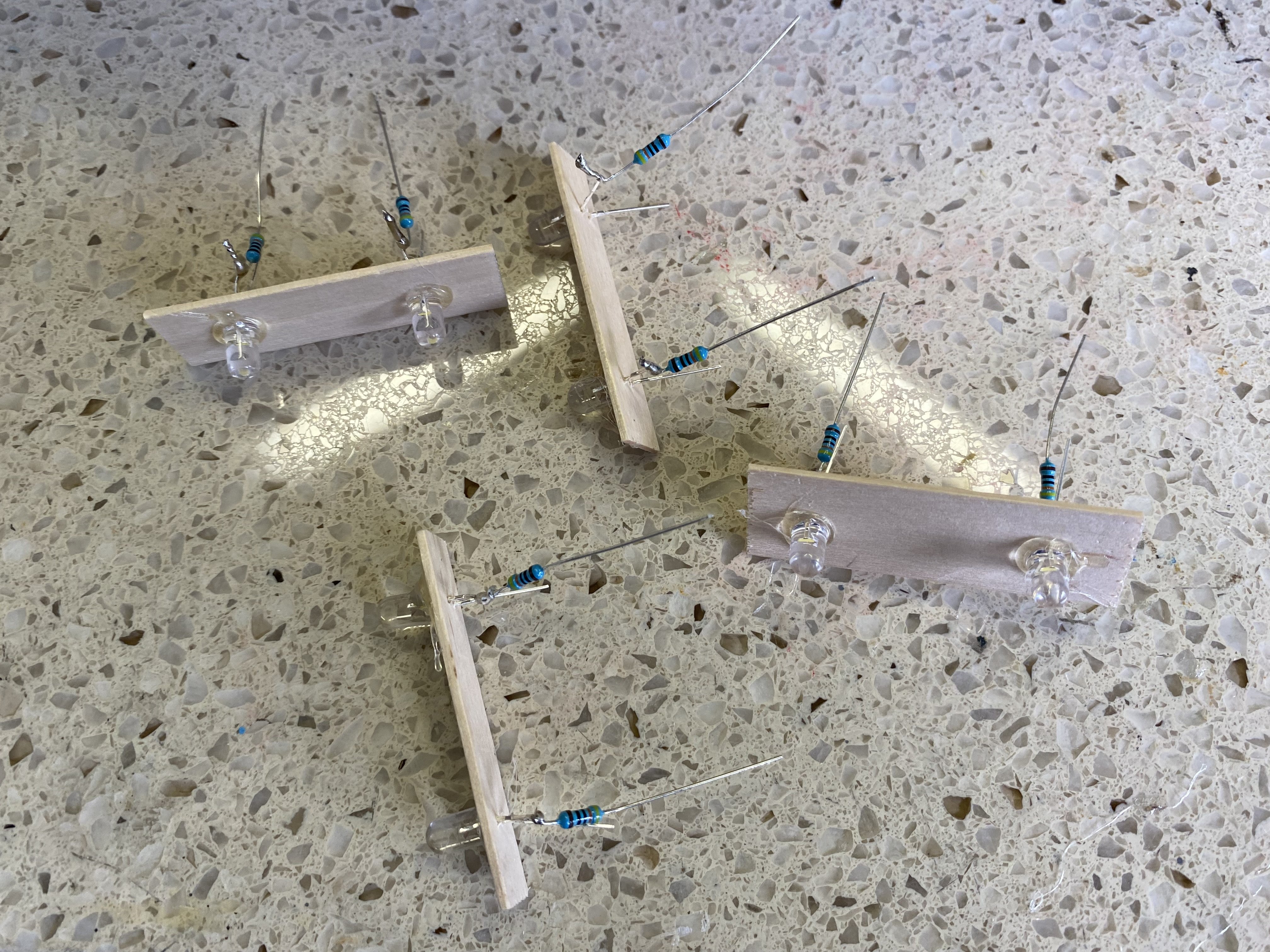

Slowly making my way through making all the LED light strips for my lower deck portholes. I decide to use two warm white LED’s at each section in the hull in hopes of getting more uniform light shining out. Each 5mm LED gets it’s own resistor and heat shrink tubing that is then shaped and soldered into “Y” shapes to accept the positive and negative circuit wires at each location set up as circuit 1 or circuit 2.

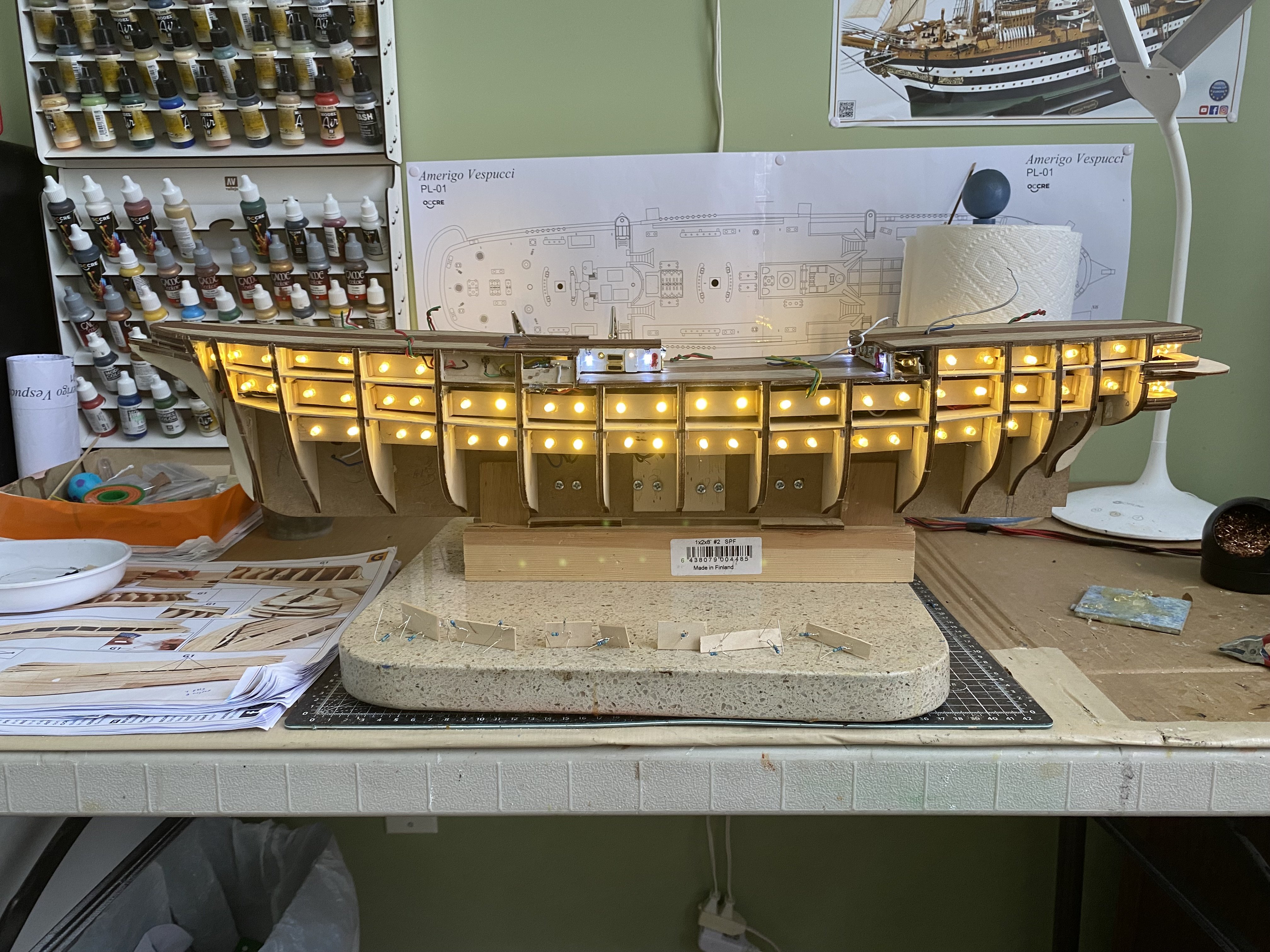

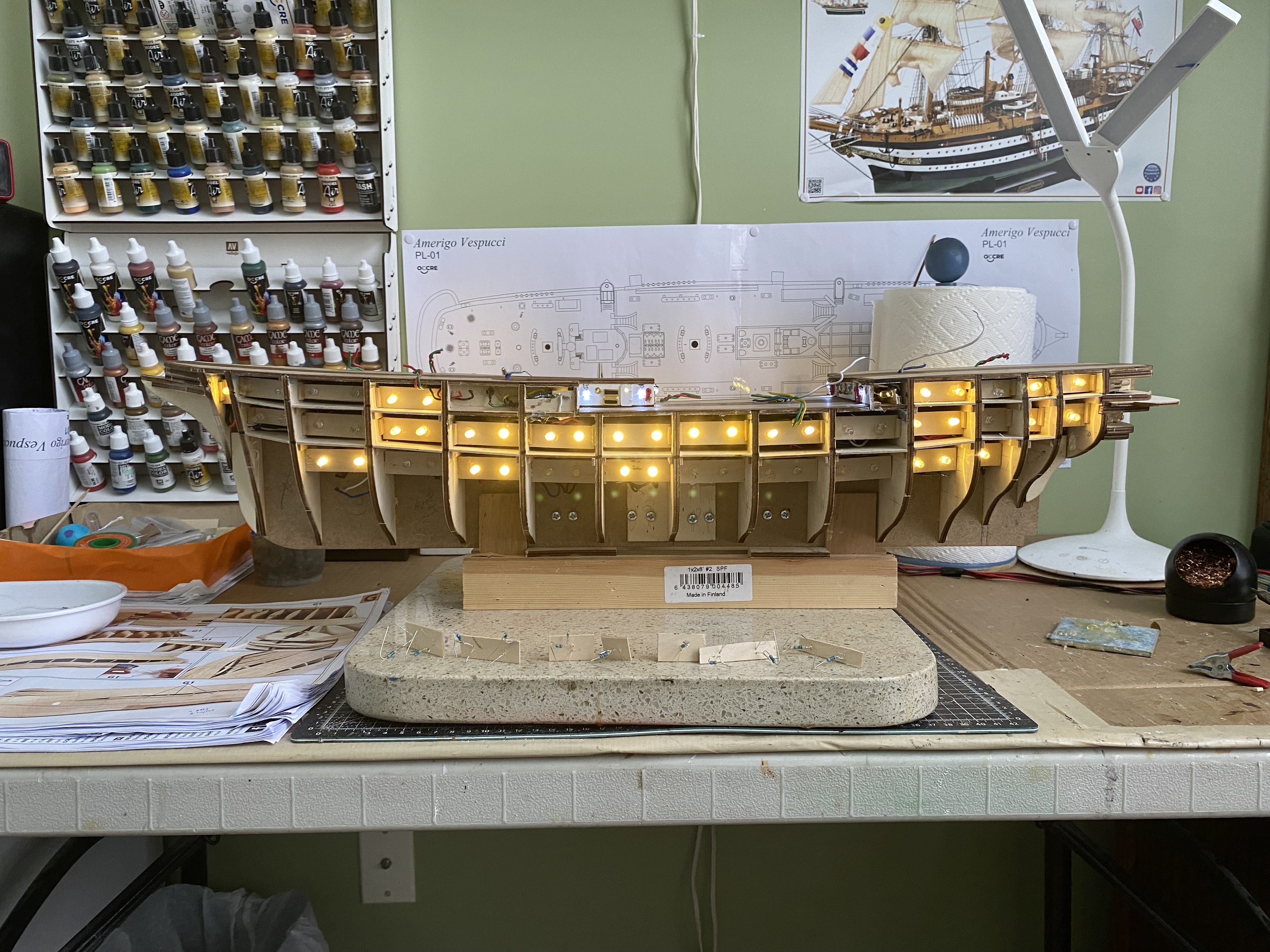

Slowly but surly adding all the warm white 5mm LED’s to the lower decks which will highlight all the port holes. There are around 60 in each side. I have them powered by two separate circuits so I can have some lit, the opposite lights lit, or all on. I have the interior lights in the deck houses wired using diodes so they will be on regardless which below deck lights are on. Wires are run ti accommodate the future deck structures that will be added.
