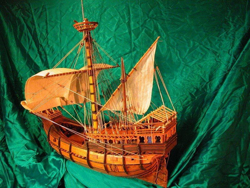

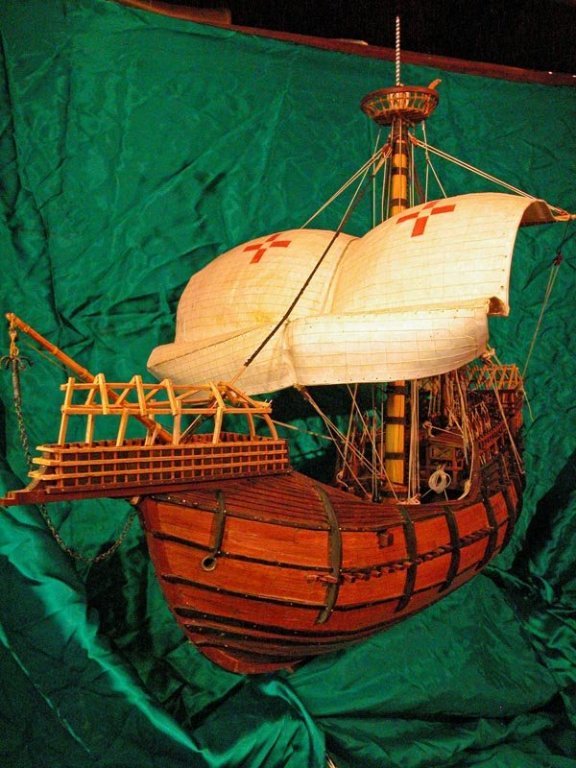

On 8/15/2025 at 3:40 PM, Alvb said:
Perhaps someone here has a tip on how I could create such a billowing, curved sail.
In my build of the Trombetta carrack of 1445 :
On page 16 there is a description of a method to create a billowing mainsail from plaster of Paris and paper
You may find this of use
Cheers
Dick
DSCN1492a.thumb.jpg.0b458c0a8989eb4508b3e5238c6120f3.jpg.4951ffbbf325c66bb03e21fea7d49ac5.jpgdscn1489a.jpg.23bf58215eadd2b39ae80d823fd285ac.jpg.5660ece1a1534e5872e459a63458de11.jpg

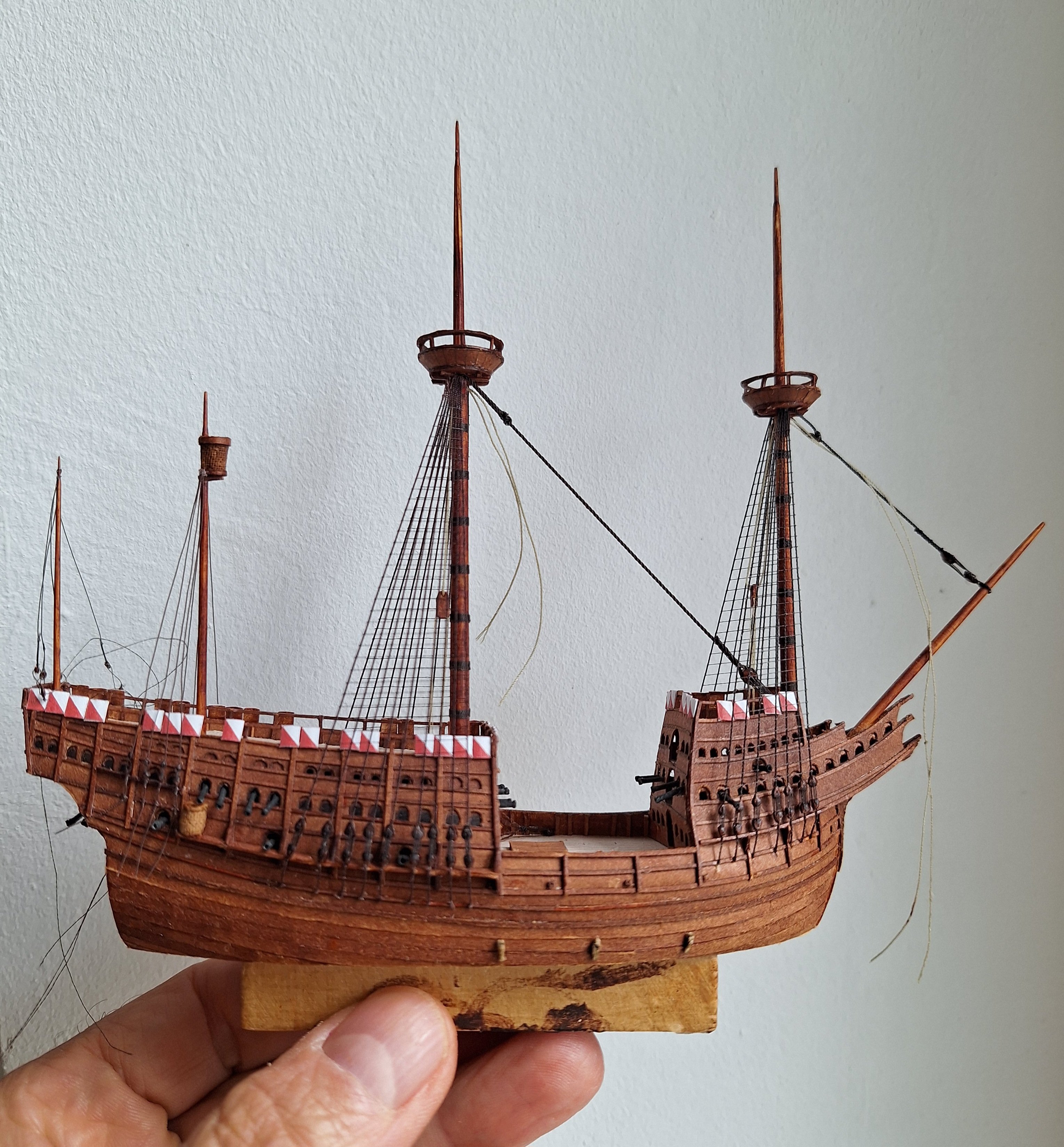

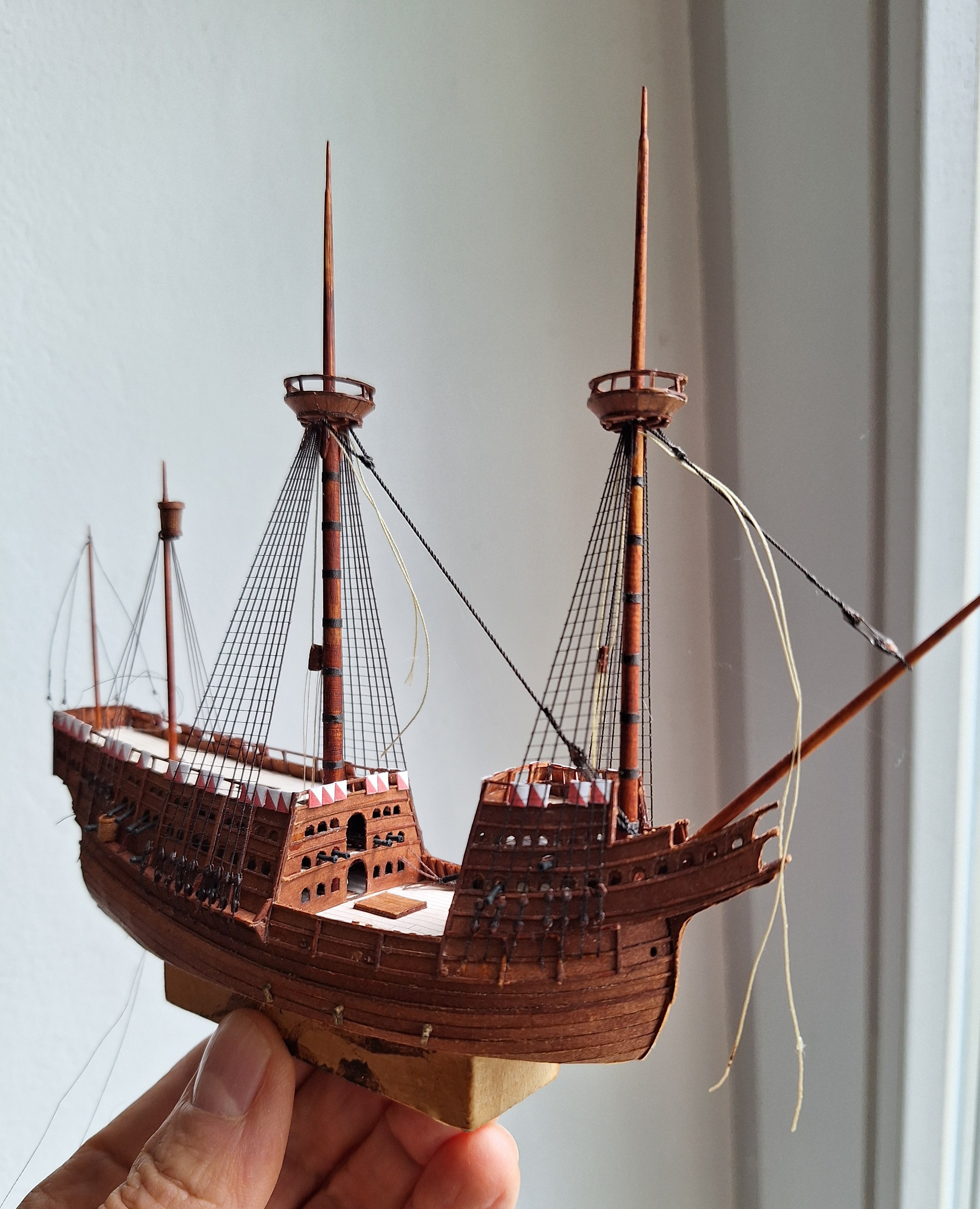

On 10/1/2025 at 3:00 PM, amateur said:
How on earth did you get the ratlines to this stage of perfection??
Jan
I use these subframes made of sturdy cardboard.
The shroud ropes are clamped into them, and then the web lines are placed over them. At the intersection points, I use a needle to apply tiny drops of shellac as glue. Finally, the entire shroud system is removed from the frame and any excess length is trimmed off. It's ready for installation on the boat.

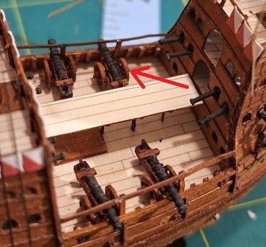

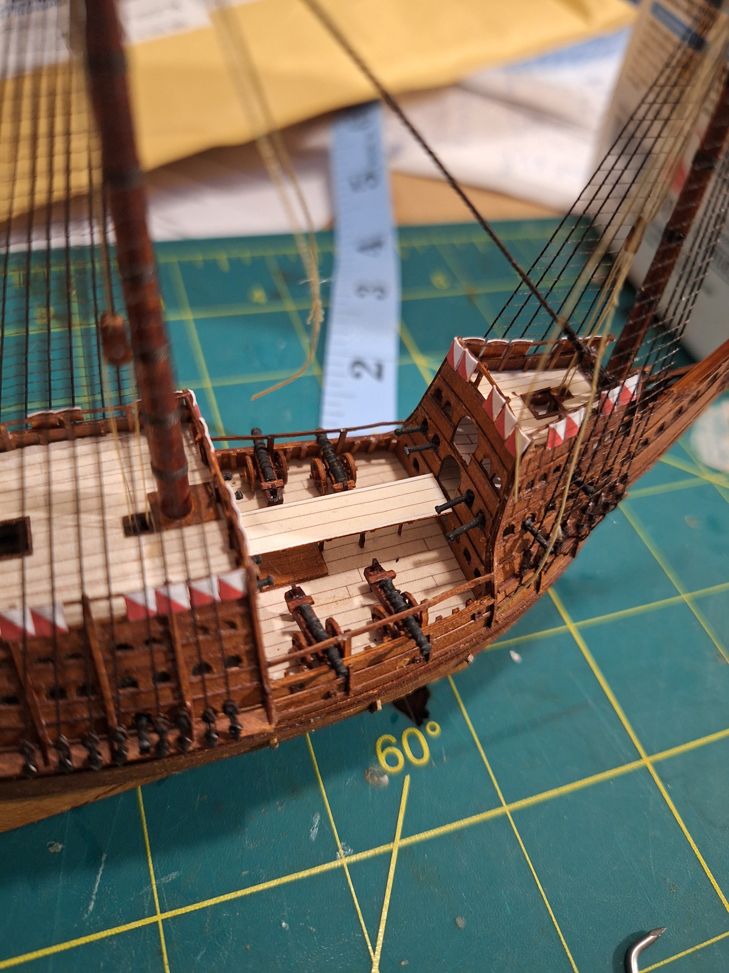

It's been a while since I've shown anything here.
I'm currently trying to make guns for the ship's deck.
It's difficult.
The gun shown has a total length of 1.8 cm, or 0.75 inches. The wheels have a diameter of around 5 mm, or 0.2 inches.
I'm curious to see how much of it will still be visible under the anti-boarding nets.
Alvb
Unfortunately, the image is very poor....
Edited by Alvb
Thank you very much for the feedback.
I actually had to shorten the guns a bit; otherwise they would have been 5 meters long.
Yes, I'm thinking about incorporating some figures, perhaps like in the painting. Let's see if I can find or create some in 1:250.
Which ones do you mean? The small wheels of later gun carriages, or the small ones in my photo? The small wheels in the photo are the wheel hubs.
