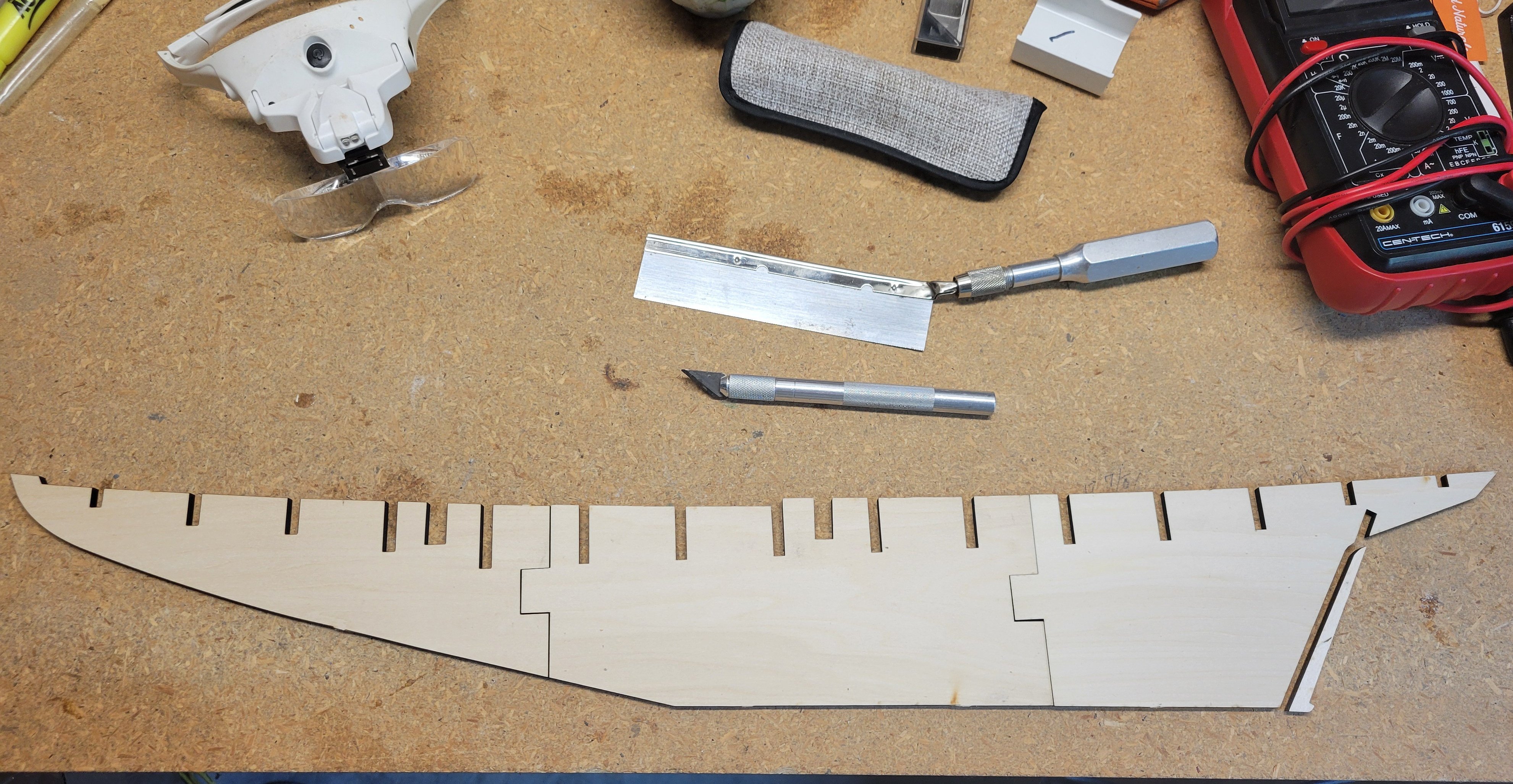

I cut the keel parts from the sheet and got it all out without breaking anything

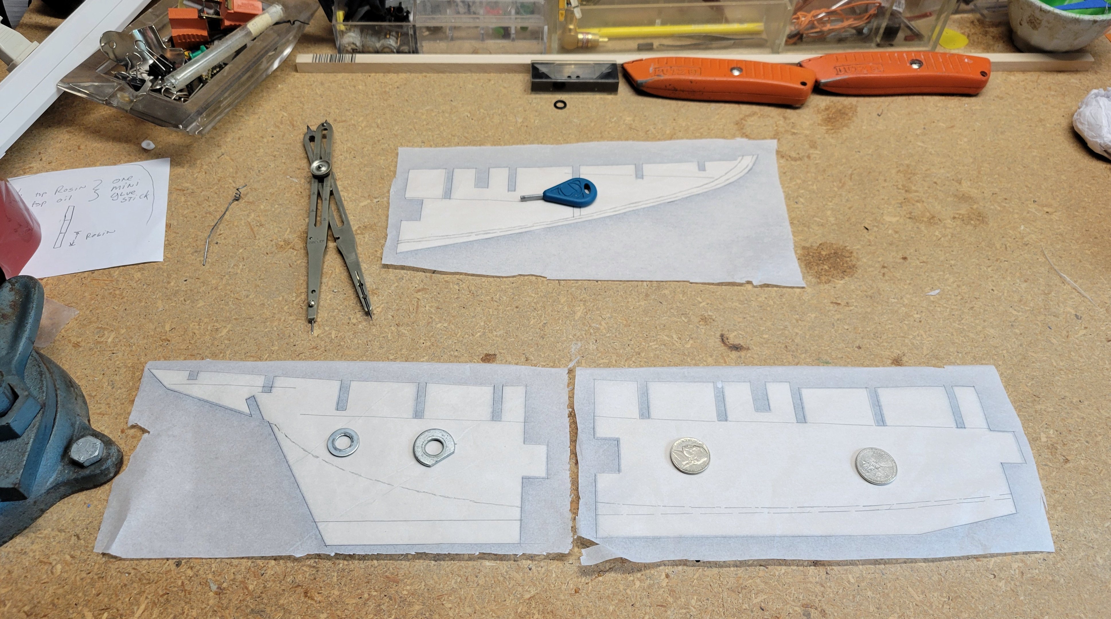

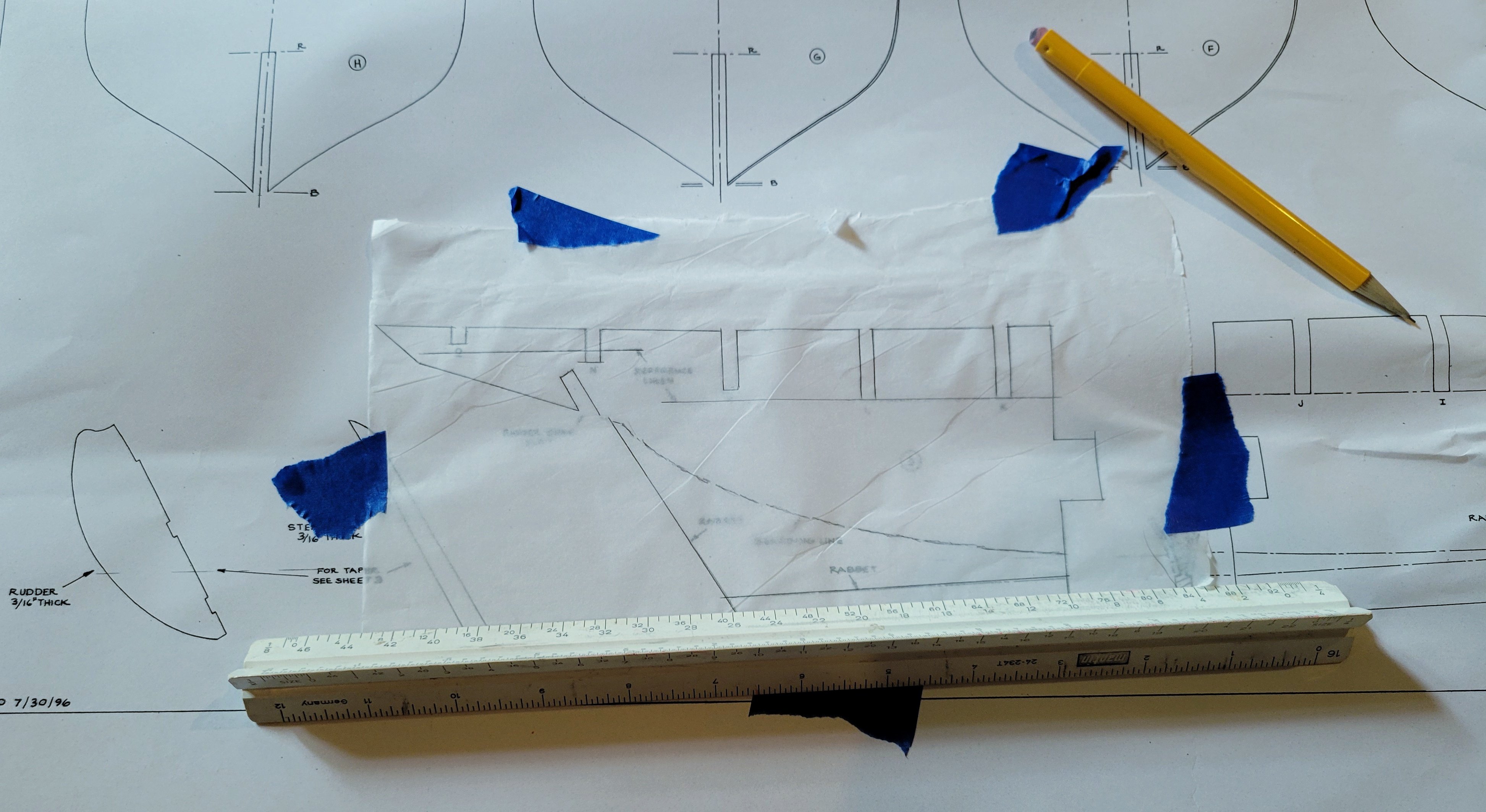

Using my wife's "Christmas" tissue, I traced lines on the drawings to be transferred to the keel sections.
I layed the tracings onto the sections. I'll transfer them over with carbon paper. Or I'll poke through the thin tissue with a sharp pencil point and make a series of dots. Not sure yet.  I'll glady accept any ideas.

Another option is to photocopy the plans so you can cut portions out and use something like a light coat of rubber cement to adhere them to the frame (the rubber cement let you easily peel it off). I often photocopy portions of plans to that I can cut into them and poke holes in them and spill things on them, knowing that I have the fresh plans stored in the box.
Good idea!! Thanks

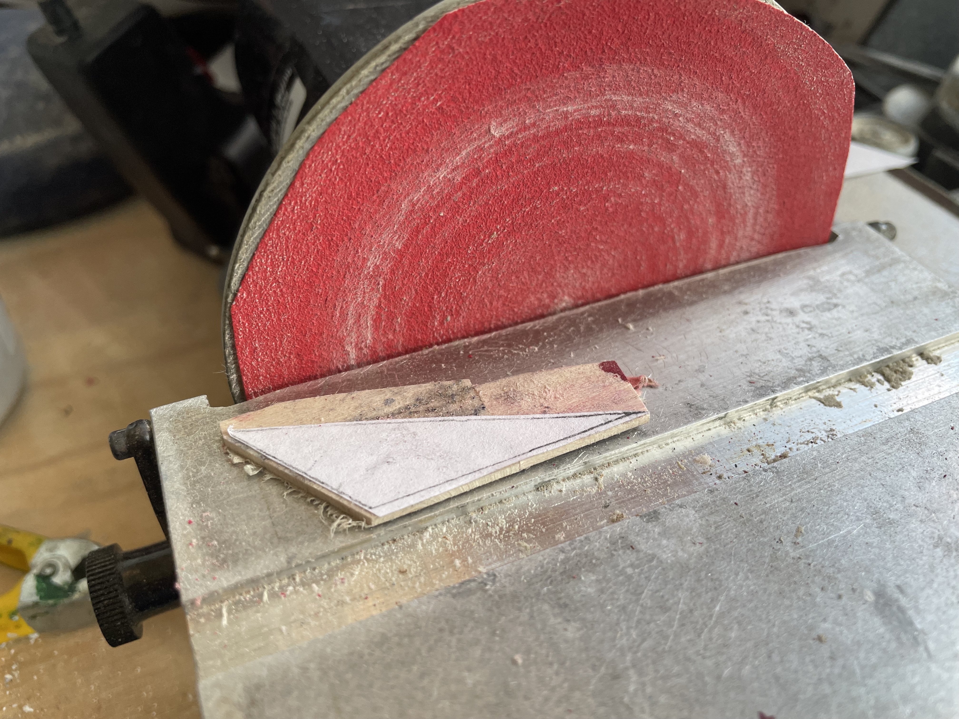

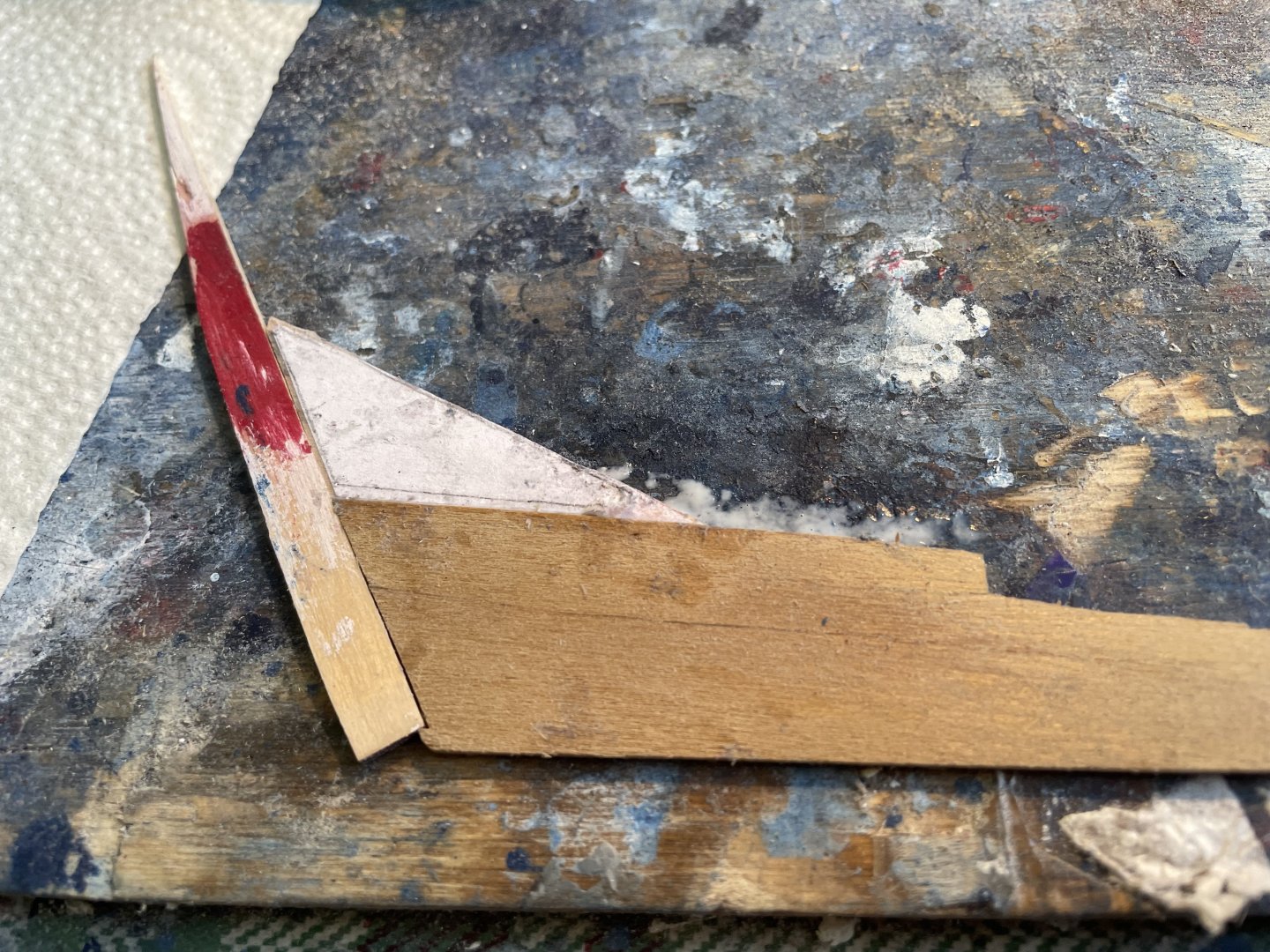

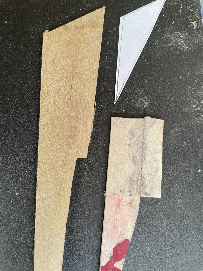

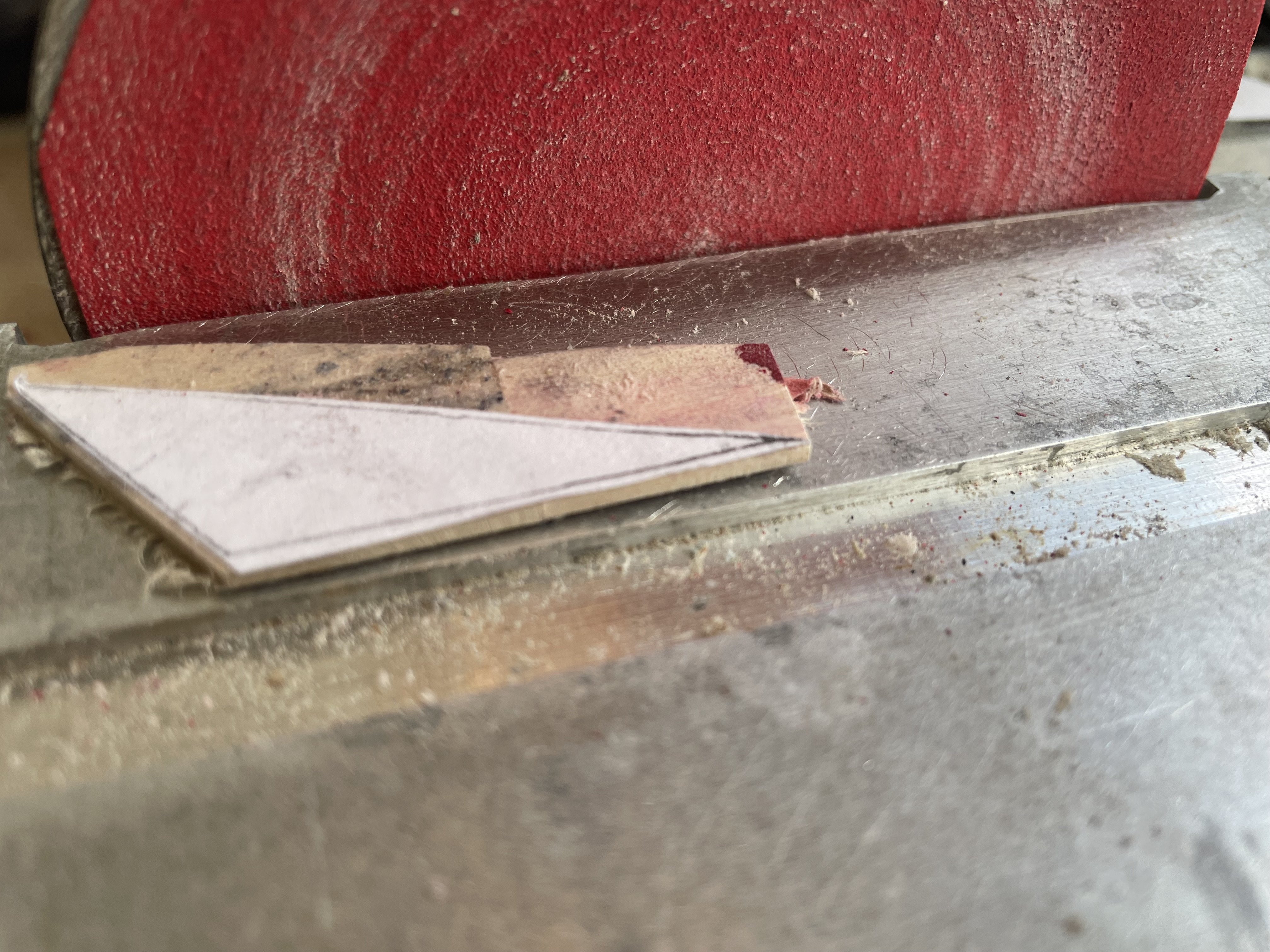

I took a little different approach to the stern blocks. Instead of using the supplied blocks, i laminated cut pieces of scrap laser cut keel sheet. It was likely the same amount of labor. I chose more cutting and less grinding. As far as the initial shaping of the blocks, there's a portion of Bob Hunt's practicum, available free on his website, detailing a method. Very helpful.
20250825_120910.thumb.jpg.d046806c23d8bd93a014955979a45173.jpg20250825_155554.thumb.jpg.b96083a548fb94ea35a36c7c835820d4.jpg
Getting the stern blocks to match the side profile was a bit tricky. Simply lifting the lines from the plans and shaping wasn't going to work. You can see by the photo that a plank would not flow smoothly around the block section to the transom. It would jut out a bit and not fair with the rest of the hull. I took measurements in many places on the plans and found I needed to shim the sides of the last bulkhead "O" with strips and sand in the edges of the blocks to make a smooth plank flow and match the drawings.
