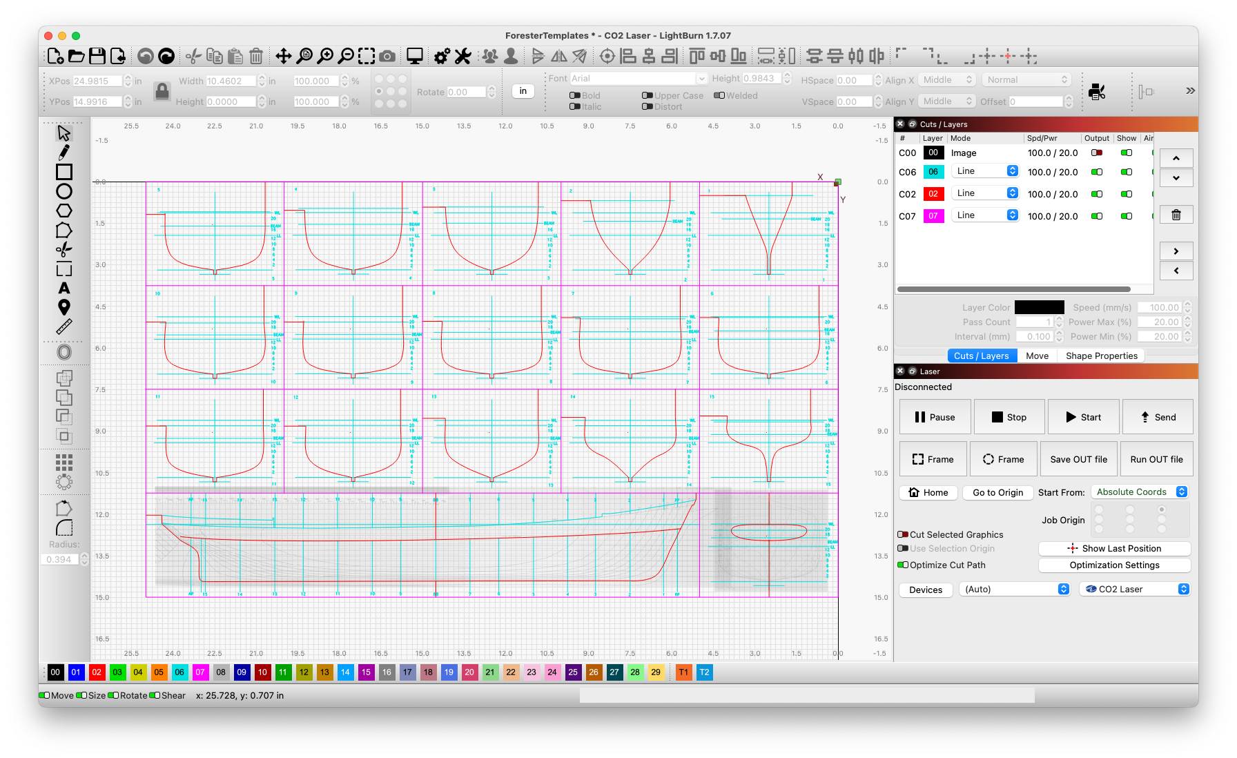

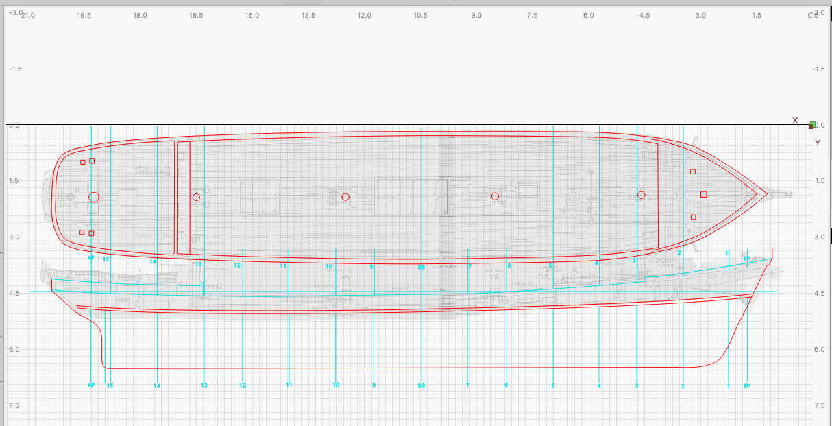

The first step was to make digital copies of the plans.  Ideally this would be done with a flat bed scanner.   For expediency  the images were photographed on a copy stand and stitched together using a panorama app.  The results were then traced in the program Lightburn for cutting on a large bed laser engraving machine.
There was some pin barrel distortion in the center of the image.  Given the small scale of the model this was deemed acceptable and in some places compensated for. The resulting templates are a good fit for the plans themselves.  According to my 3/32 ruler these variations are within 3 inches of scale.

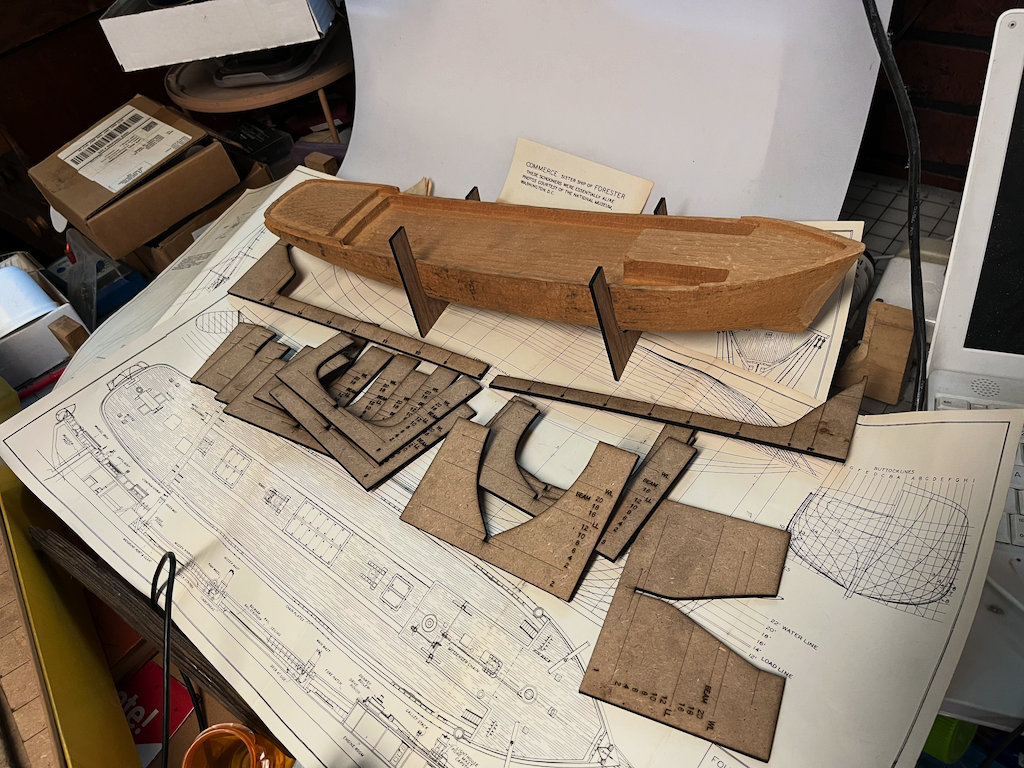

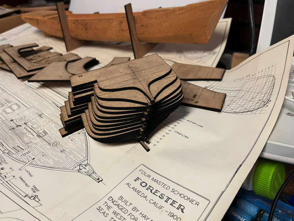

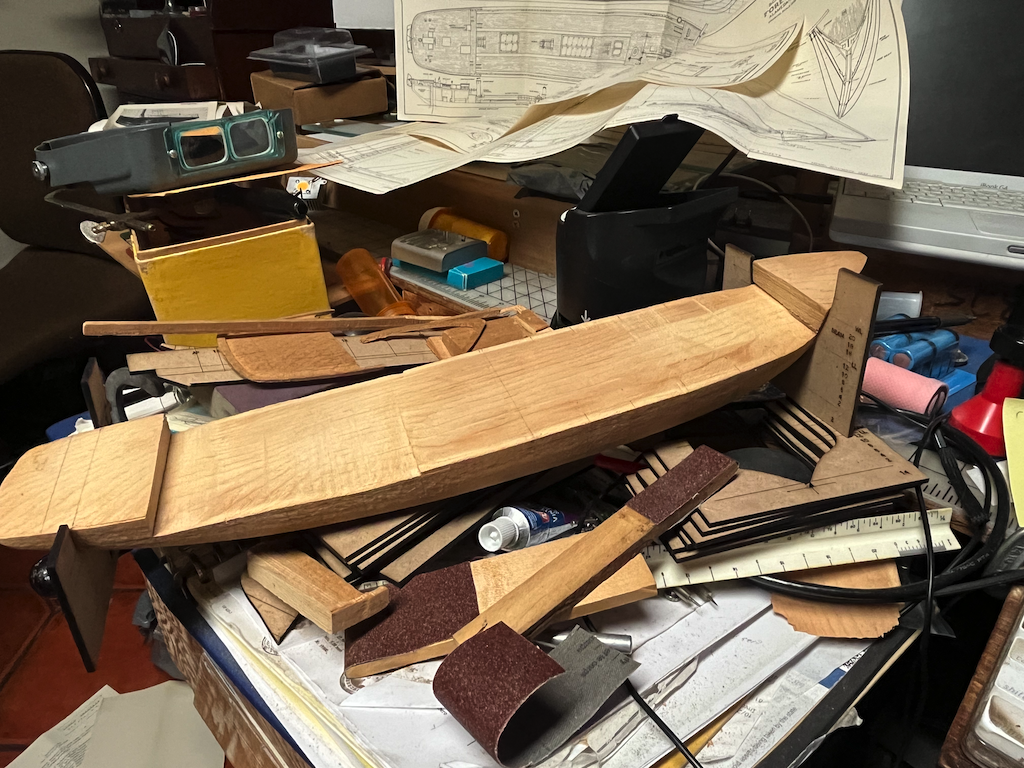

The sparse kit 'instructions.' do indicate that the stem and stern need the most fitting. which is consistent with the resulting templates.

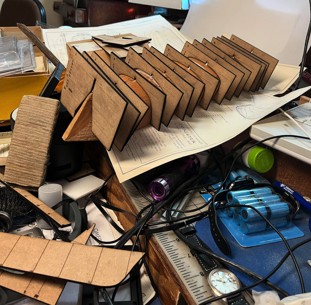

For fun the full set of templates were test fitted to the hull block. This shows the close fit.
The laser leaves interesting waste (enough for a second plank on bulkhead model if desired.)  These were numbered.  one side of the template was also left longer to use as a handle for holding.  The templates also work as a sort of temporary cradle.
Downside is the template sides tend to get soot over things, which can be wiped off.

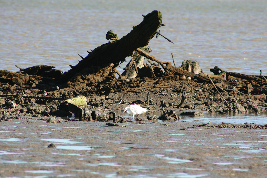

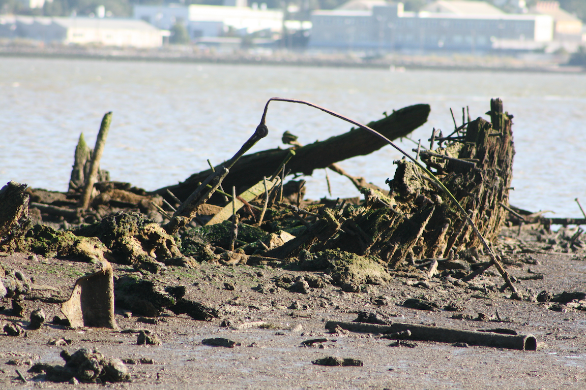

Another field trip this morning.  There was a -0.3 foot tide.  So most of the wreak was exposed.  There is a YT video of a kid running around the wreak when it is in this condition.  I found though that the mud is pretty soft, so one would sink down about a foot or so into it.
I loaded in more of the plans to lightburn.  Then copied over the existing templates what I cut with the laser.
There was too much tilt between the two images.  Bit lazy to re photograph them.  I was attempting to align the two half images with the shroud stays. So having looked for a couple days at these on the plan this was the photo I wanted.  Shows some nice construction detail.
I also notice there were a few of these braces visible near the stern.  This is the port side looking aft.  Such would be a good candidate for the fiber laser, such could be cut from old used razor blades.
Looks like the ship has a few visitors.  See if you can spot them.

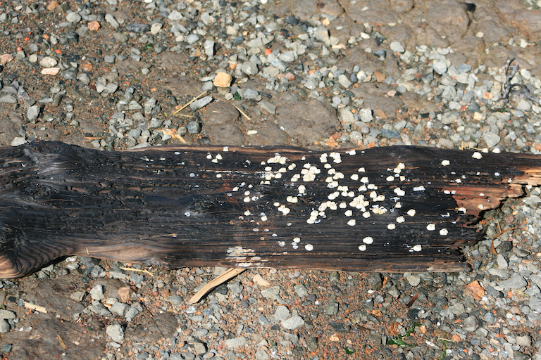

There was an interesting piece of driftwood.  I took some photos of it.
There was a time when such things were fair game, now with 1000s of people enjoying this it is probably best to leave it in place.   Would be fun to use some actual wood in the model.  Not sure how often that is done.  But this is not the place to do that.  Besides I like the pun.
I probably should make one of those archeological poles with the tape on them. Although for the most part it is hard to get close to the actual wreak.  Which is quite large.  The driftwood was about 2 feet by 10 or so inches.   It is interesting to study the wood.  Looks like common fir, not to different than framing lumber.  Nice straight grain.  Probably excellent for making a violin, since it has been pickled in brine for 50 years.

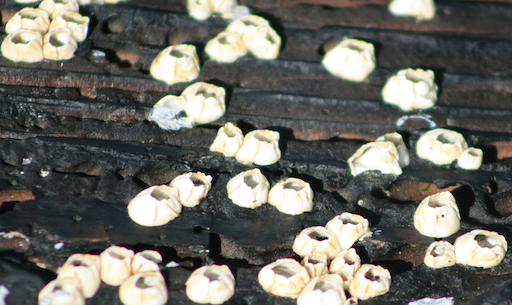

Here is a closeup of the critters what were attached to it.  Can not really have a ship without barnacles.

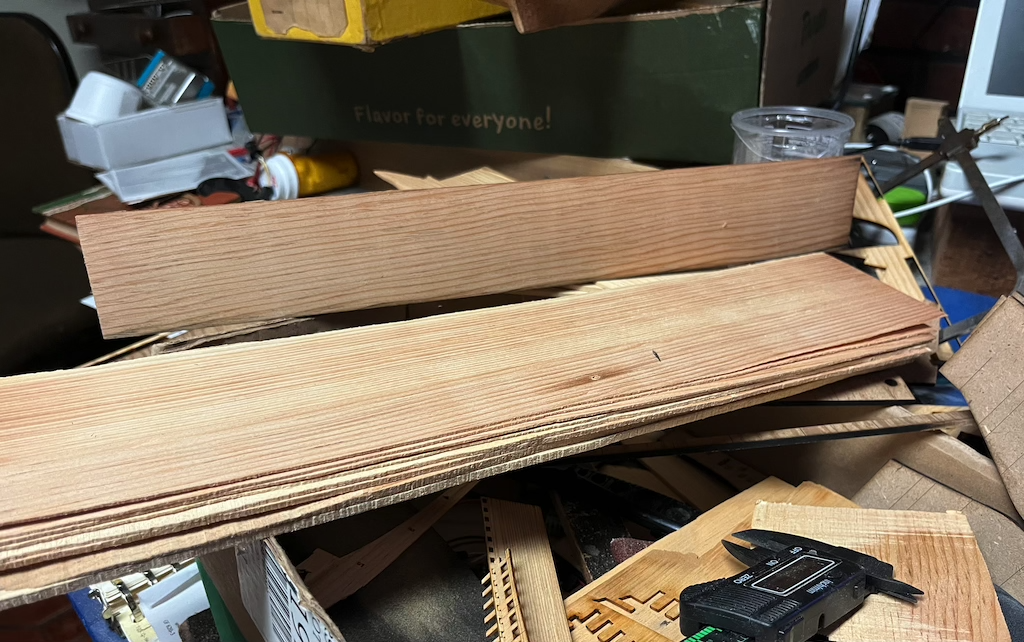

Over the last 25 or so years, I have been an organ builder.  Mostly making small crank organs.  Over the years I have collected a fair amount of wood, which has been in my workshop for some time now.
Some of these scraps are quite old.  When a large Wurlitzer was installed the framing for the swell shades what control volume was too short.  Since re-framing the chambers was out of the question the bottom foot of the shutter blades was cut off.
In order to block sound this is dense wood.  The organ dates to the 1920s, so this wood is at least 100 years old.  With tight straight grain.  I was able to use the band saw and slice off some thin strips, which could then be run through the thickness drum sander.   I wanted to see how thin I could sand a piece.
I then proceeded to hack up the bow of my model.  IMG_4881.png.611abe7c4cd42679648379322f3833d1.png
Probably should not continuing to use the band saw on it, but it is so tempting.   Lumber ships have doors in the bow for loading long timbers into the hold.  I decided to open up this section.  Turns out angles projected on one side,  do not mirror on the other.

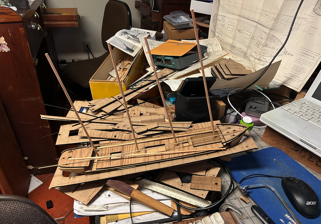

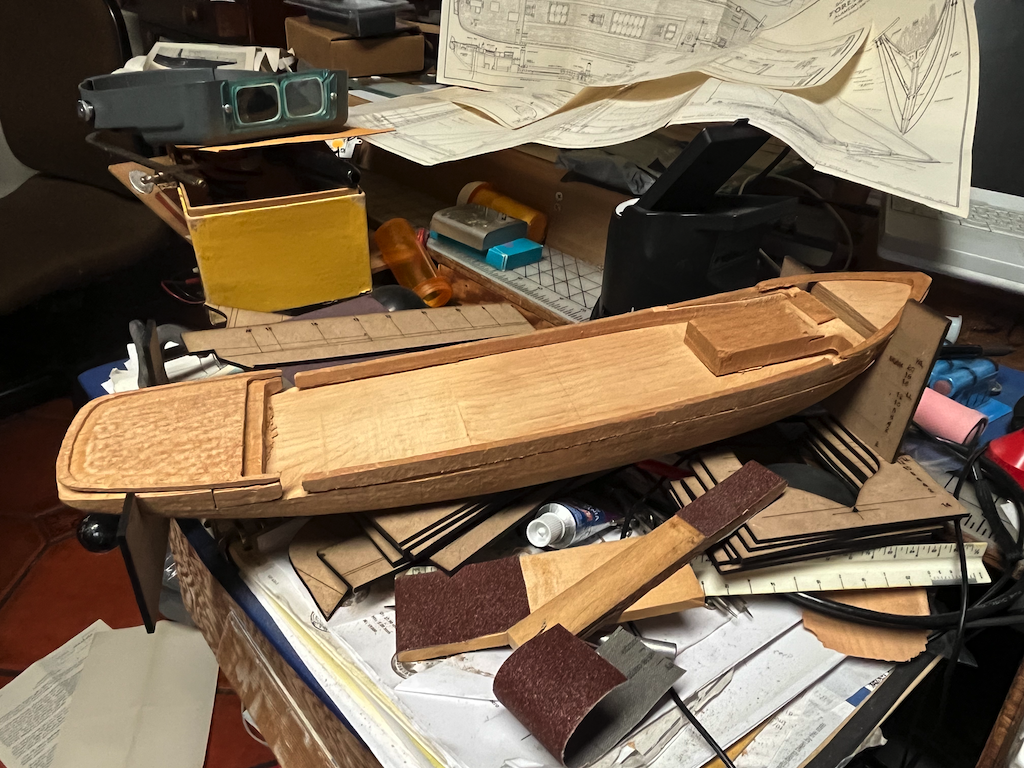

I wanted to try setting up some of the deck.   Since I over cut the hull with the band saw, I projected the centers of the timberheads onto one of the thin pieces of stock.  This gives a place for them to fit into a sort of socket.
Here things are with everything just set in place.  One of the sticks that came in the kit box looks like it is intended for a jib boom.  So it is quite fascinating to see things together for the first time.

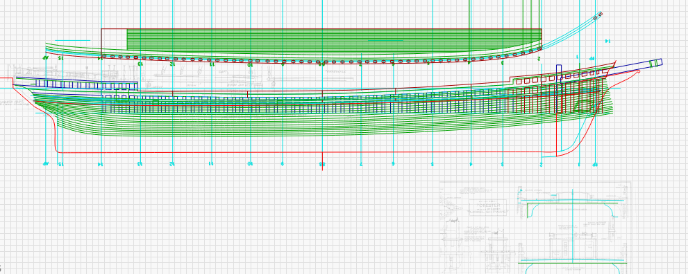

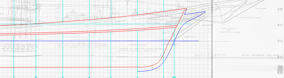

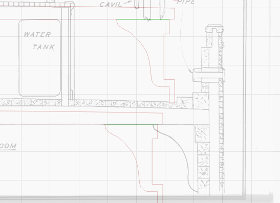

Did more tracing of the plan documents.Screenshot2025-08-24at10_52_38PM.png.1ba32545e90da8c19ac50d8c6ed408f3.png
The plans show plank placements, so I traced over them.  on the bow side I simply copied and pasted the first planking line.  This extends out a bit.  Since there is some 2 to 3D projection involved, it will be interesting to see how this wraps around the model.  The sheets are thin enough to actually do some of this warping while test fitting.
Moved some of the timberheads around and decided to extend the deck all the way. The band saw bought deeper into the deck space than I initially thought. In places it is almost 1/4 inch below the 'top of beam' line.   It is easy to get lost in the zoomed in scale of the program.  A single pixel can represent three inches.  So it often seems there should be more space, than the scale allows for.  A similar effect happens when I work on watches where the world of small, can feel quite large.
The aft section required a lot more warping to match the drawing lines.  I had removed quite a bit of the aft cabin, all the way back to station 14.  So it looked best to draw things down to the point which was marked load line.  This is about where the side view drawing ends.  There may also be a bit of camera keystone distortion in this area.  There are some definite creases in the paper which were hard to iron out.  One could spend a lot of time on this.  Or I could build a large format scanner, which would also take forever.  I have 600 pipe organ (orchestrion rolls) which have been waiting 25 years for me to do a similar project.   I am not all that fond of filling up my phone with a bunch of images, since once captured are hard to delete.
There was also a small sheet with a couple of cross sections.  This says sheet 3 of three.  Which seems odd as there should me more,  like the arrangements of the cabins.  The C. A. Thayer documents note that the cabins were remodeled a few times.  Photos of the Forester show a much wider companionway.  What is interesting is overlaying and scaling these drawings, show that they are quite consistent.  With the deck and side planking lining up.

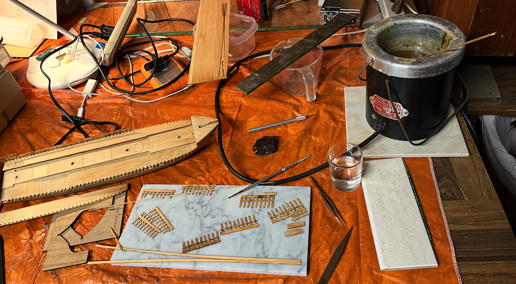

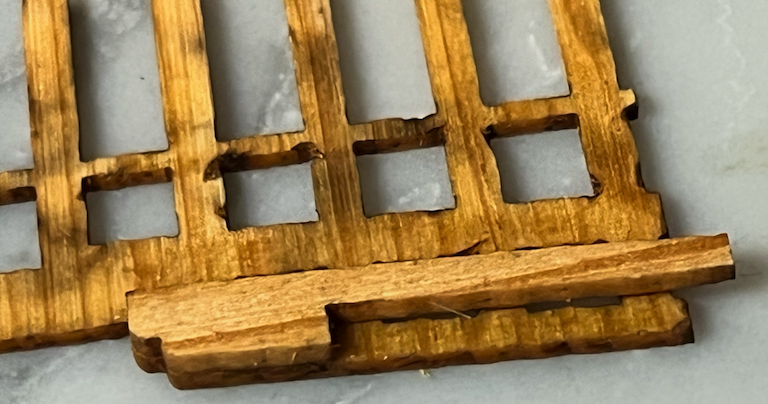

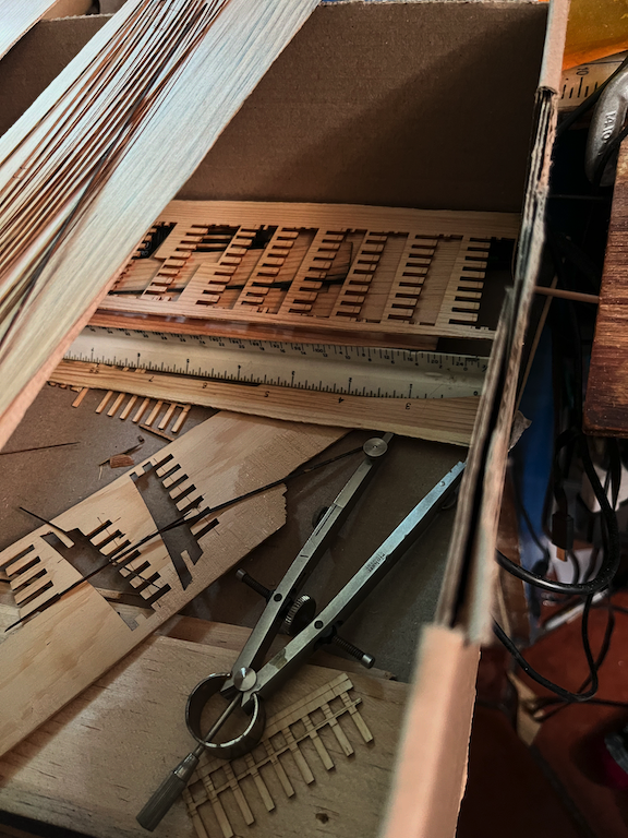

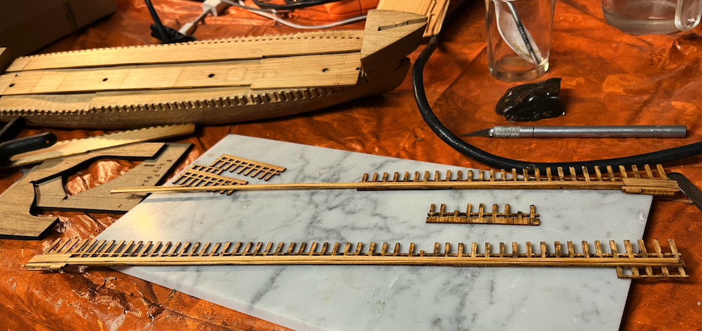

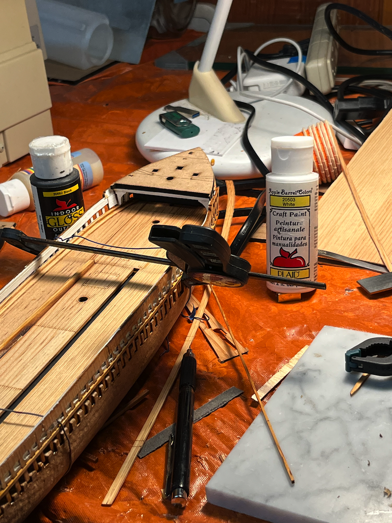

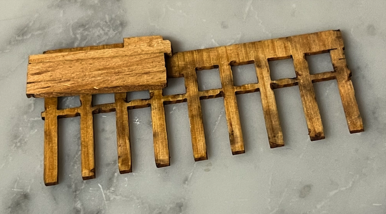

More time yesterday with the laser.  The hardest part is figuring out what parts to cut first.   The deck and bullwarks is the obvious choice.  When making the test pieces, it seemed logical to extend the decks the full length.   The wood must be spliced, in the photos and at this scale that is hard to see.
I probably should have cut the waterways.   Really wanted the side planking to experiment with.  More on that below.

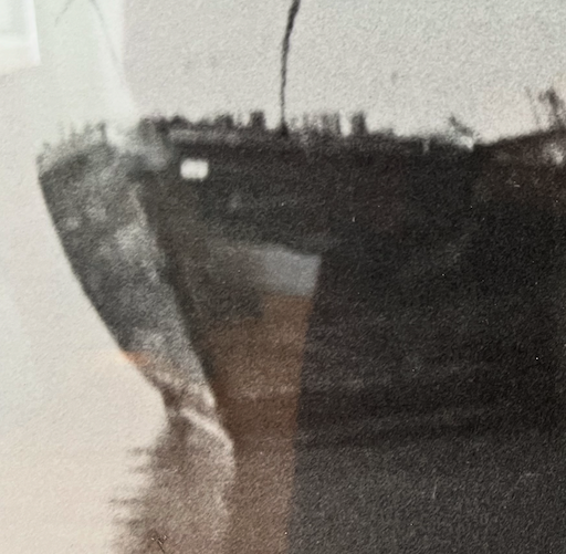

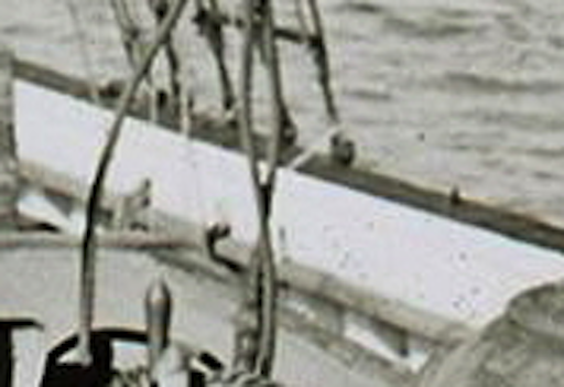

One thing intrigued me is a zoom in from this photo.  Which will probably be referenced a lot in these build logs.
Since the upper deck seems to have beams and knees visible, this looked like it would be fun to model.  These need to work with the timberheads I really wanted to see what this would look like. This is also an area where the bandsaw cut deep and angled from when I removed the crew quarters deck house.
I was quite pleased with the results.
Most of this will be lost in shadow.  Does mean I will need to think about how I am going to paint things and with what.  It also brings up whether or not to model some of the chain windlass. Most of that stucture is in the solid part.  I used the station what intersects the capstan as a reference point when I sawed the blockhouse off.   There are also hints in the sparse plans that there was a locker on the port side.  There is a door visible in the cross section.  A corner of this is shown attached to one of the port side bits.
Using the laser to mark the machine sanded planks, looks like no other finish will really be needed.  It feels odd to be working with hundred year old wood. Does seem to make a difference in a way.  Wurlitzer was in North Tonawanda NY.  This to be close to the locally supplied materials.  These instruments were mass produced. In the thousands for so many to survive.  There were also West coast theater organ builders.  Always thought it interesting that there was a desire for the pipe organ to be imported from some distance away.  All this came to a collapse when sound films became popular.  The silent film era lasted such a short time from about 1925 to 1927.  By the early 1930s few theaters were being built.  The market saturated as pretty much every town had a theater or two, and the large cities dozens.
The hull planks were not as successful.   Since this was somewhat a test I used the last board which was only sanded on one side.  The other side was painted with a flat black paint.  The test plank also does not run the full length of the ship.   I had marked out using a diagram I found in the planking subsection of a 4 butt order.  I figured that I could run the program twice.  Extra planks would no be a bad thing to have either.
I figured not to cut through the outer edges of the planks.  Since the planks are over long I labeled this edges with letters.  Used the wrong setting and these cut through.  The other edge was off the board.  The first cuts came out great.  These are not closed paths so the cut in the draw edit order.  After a bit the aft planks started to curl up. The laser then proceeded to shred through the loose planks.
Not a complete loss.  These were test planks anyway.  Most of the forward planks did not curl.  These are surprisingly robust, springy and supple. I can line up three or so and lay them on top of the model. There they flow much like the planks in the photo what inspired me to build this ship.
The laser only goes so far. There is still a lot of hand work needed.  I noticed that in the box, along with scrap pieces, that the tools of the trade do remain.

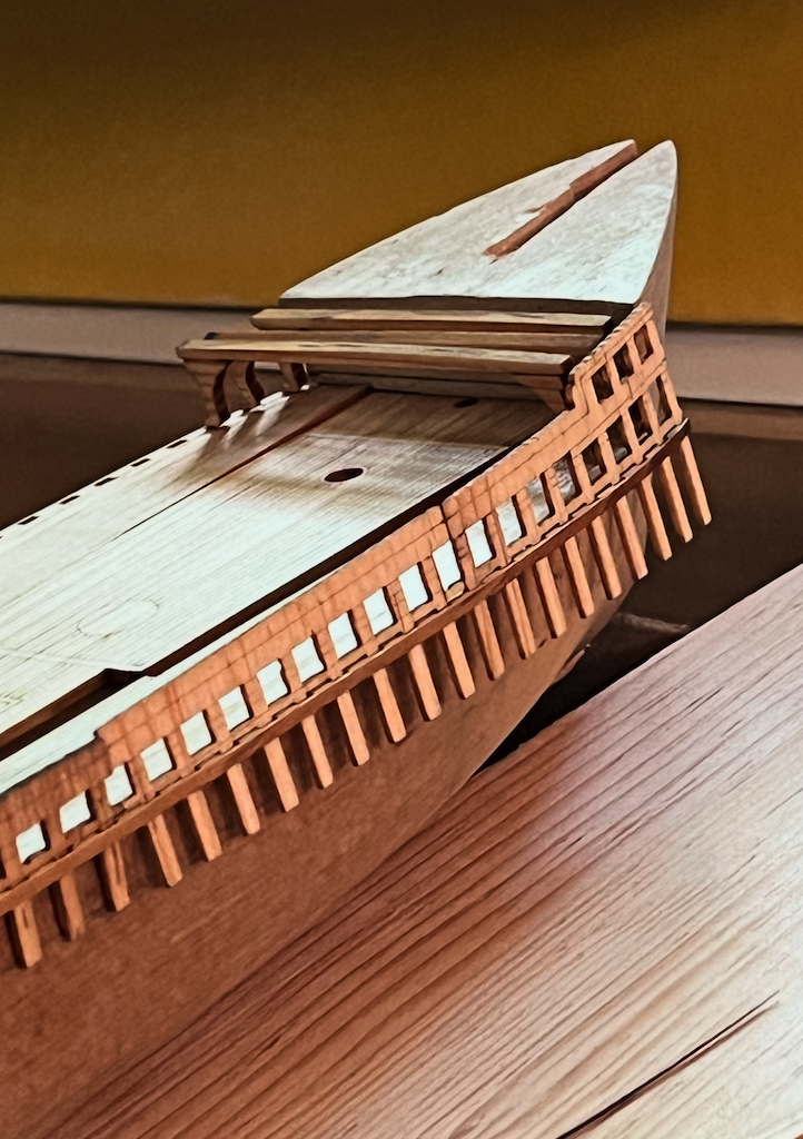

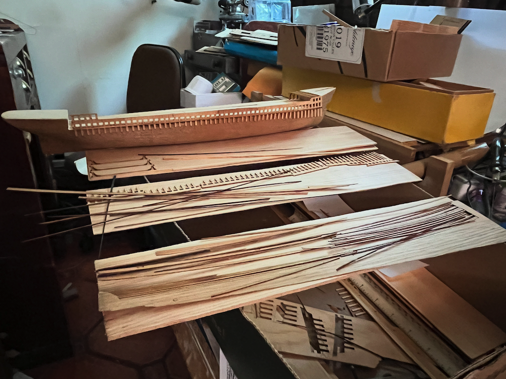

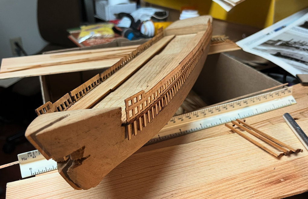

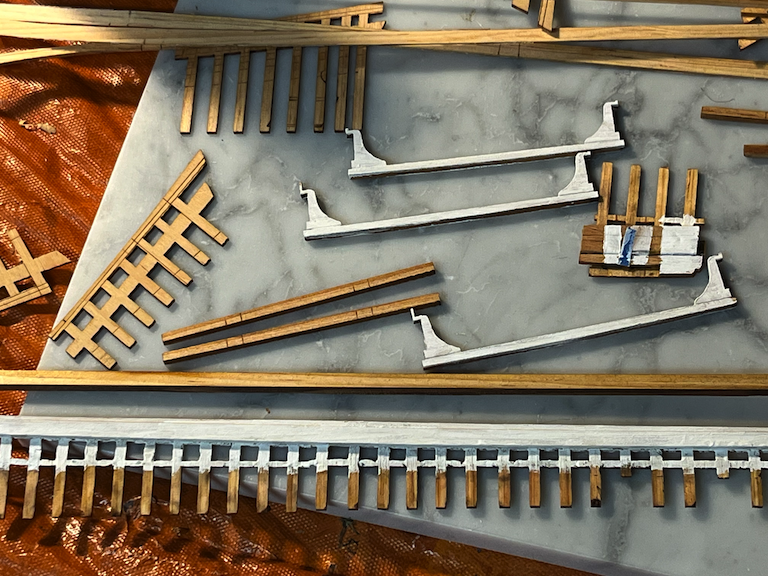

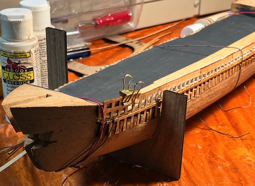

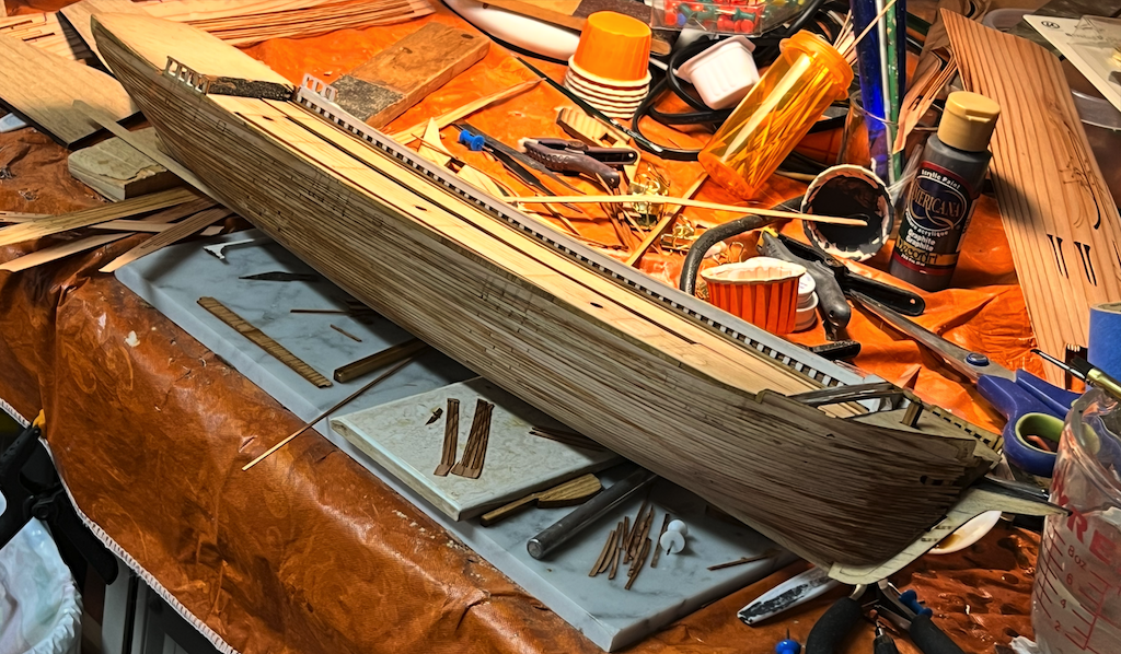

Dry fit of the bulwarks pieces on the hull block.
BulwarksSB.png.8e0b93834ada2c714c4d74a1b0d2add7.pngBulwarksPT.png.5a37273dba8416f82973b4161850750f.png

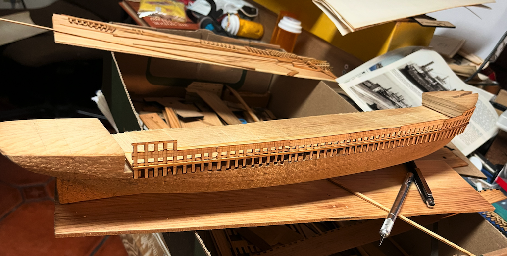

108 notches cut into the hull for the timberhead posts.  To get the grain to align each subsection has 9 posts.  They fit surprisingly well feel a bit like pressing together lego blocks.  The ubiquitous #11 blade worked well so each notch only took a few minutes.  So this only took three days with a lot of breaks between sections.
Does show a bit where the saw gouged out the hull.  Decided to leave this rough since it will be hidden.  There  does remain an option to leave some of the deck hatches open.
The bow has a whole superstructure that follows the same lines.  The hull carving seems to be a bit undersized from the drawings in this area.  The test planks are around 2mm so this will bring it in line with the forward templates.  This wood is surprisingly workable.  Did break off a few of the lower posts where the laser weakened the wood.  I could recut these, however I am motivated to install some of these parts to see what they look like.
The next step should be gluing some of this together along with some preliminary inside painting,  The long rail and ceiling stringers will glue with a cross grain direction, sort of like homemade plywood.

Setting up the workspace in preparation for gluing.
My preference is for using traditional hot hide glue.   On the Mechanical Music and pipe organ forums,  glue is a sordid topic, what was known as the 'glue wars.'   The short of it is that in the 1970s restorers started using the PVA and PVC glues.  Several companies went out of business as the resulting instruments were seen a ruined due to early failures.  Hide glues have been around for centuries they have known lasting properties.  One is that with heat and moisture they are for the most part reversible.  They are also easy to clean.  Usually only minimal clamping is needed.  After a few moments the glue forms what some call a death grip.
The main disadvantage is that due to the organic nature, It has a distinctive smell.  Basically it is expired gelatin.   Add sugar and you get gumi bears, which do actually work pretty good as a glue substitute.  Gumi candy also makes great printing transfer rollers.
I personally have nothing against CA glues.  I use them a lot in other things.  I find though that it tends to not have much torsional strength.  One can usually break the bond by twisting.  Resin glues and epoxies have their place as well.
Since I am working with century old wood I figured to stay traditional.  It is what I am used to working with.
So here is the first part glued.
And the second ...
The first part is about the size of a toothpick.  I was able to trace over the plans. which only show a couple of cross sections.  This was used to create the beams for the upper deck,  Which I think is the one called a forecastle but never pronounced that way.  It looks like this is around station 3.
For some reason the plans show a hawse pipe.  The photographs actually have a large rectangular opening, which I think is what they call a scupper.  I noticed on the C. A. Thayer, these were a series of holes at the deck level.  The Commerce, does have this haws pipe structure around station 3.  I think these holes were also used for the mooring lines to pass through.
Photographs of the forester bulwarks show clearly visible timberheads.  The plans call the the rails, the Rail stringer and Ceiling.   Since they are different thicknesses I cut them as two different pieces.  That makes for one long toothpick.  what looks large in the plans is only a few millimeters when cut out.
Here is the port side glued up and half the starbord side.
The resulting structure is quite strong while remaining flexable.  There are a few places where the laser cut a bit deep into  lower tabs at the top of beam line.  These broke off.  Since I had everything ready to glue, and I also have the tabs, I figured to glue the back once things are together.   I still have plenty of other parts to cut.
Next up will be to paint these rails.  I do not want to get paint on the nicely etch deck pieces.  I also want to pre bend the forward parts where it starts to curve.

I painted the bulwarks.  Not having access to miniature four dimensional dock yard workers, I figured it best to paint things before gluing.
My dad had some old paints from various projects.  Since I am making this up as I go, using them seemed like the simplest option.
The top of the hull, where most of the gouges are was painted with a flat black graphite color.  I may make some of the hatches open.   The area under the forecastle, behind the galley and crew quarters should disappear in shadow.  I am still contemplating modeling some blocks to suggest the capstan winch.  Will see what it looks like when I get things together.
The milled down sheets from the pipe organ swell shade blades, are not wide enough to cover the whole deck.  So I did them in sections.  I cut separate thicker pieces for the long deck stringers.  Since I had the graphics for some deck stringers. I cut some more without the knee braces.  This should help with the installation as there is warping of the decks in three directions.  Interesting that when glued up, there are optical illusions which make the straight lines look curved and the curved ones straight.
There is a large photograph on the door of the museum to the Forester room.  I took a shot of it with my phone.  (there are some reflections on the glass.)
This shows a bit fuller bow than the model was carved.  The station templates do allow for more thickness in these parts.  This also shows the ship stripped of most of the fittings.   What it looked like shortly before it burned.  In the photos, and my recollection the decks were covered with all sorts of junk.  The owner at the time was the sort who did a lot of itinerant jobs about town.
For the most part hide glue does not need a lot of clamping. I did find that where the forward parts do need to wrap around the bow, that the wood tended to spring back a bit.  So I used some telephone wire scrap from a pipe organ relay.   When I pre-bent the end of the bulwarks they broke at where I joined the cross grain rails.  So I clamped this back after installation of the side and deck structure.
Some of this will get filled and sanded so the planking can be laid.  The width of the deck was trace from the top view well for shaping these parts.  I did cut some test planks from scrap.  These feel a bit thicker than scale.  For the most part I am finding the parts to align with the traced plans.

The bottle says 'Plaid' located in Norcross Ga.  Label says craft paint.  Materials indicate water base acrylic.  The grouping is called Apple barrel colors.  The gloss says it can be heat set in the oven.   They would probably have come from Michael's or Arron Brothers.    They are a bit old so could be a bit passed the best buy date.  I had to add a bit of water to the brush.
Here is a shot of the latest progress with the bottle in the photograph.
I had to use stronger clamping on the starboard side. Since the center deck is in place.  The deck stringer and forecastle beams are just set in place.  There is a bit of a gap as the hull block is a bit wider, or the notches not cut as deep as they should have been.
 This affects the angles where the forecastle beams attach.  Not quite sure how I will compensate for this.  I need to wait for the main glue to fully dry and see if I can steam and clamp the bulwarks rail.   The deck template is in place as I wanted to see how the shadows work.   There probably should be something to represent a locker on the port side.  The winch probably should be suggested.
May be some time before I get to the deck house.  I want to plank the outside of the hull first.  Was a bit afraid the bulwarks might be too fragile,  The tabs did chip a bit where the laser scored marking lines.  Once glued things feel surprisingly strong.  Even so there will be no more tossing it into the box with the rest of the sticks.
I did glue some of the water ways in place.  Not sure yet what to do with the scuppers.  These are marked with simple laser lines.  The scale and photographs indicate these might be about one meter square.   The 'Commerce' has haws pipes  in these location.

Applying the under supports to the Bow.
Feels a bit like more of the same.   I borrowed some ideas from the planking section to use push pins.  The hull wood is soft enough to press them in.  Does leave a big hole.  This will all get covered with the "planks."
There is a bit of overlap at the stem.  I based this grid on the top plan view, and projected it back.  The rough kit suppled hull feels a bit undersized when compared to the plans and photographs.   The planks where made by tracing some lines off the plans and extending them.  The plank wood is about 1/32 thick, which might be a bit large for scale which is 3/32 so that would make the planks 1/3 of a foot or about 4 inches.  Ship timbers do seem to be fairly thick, so this might be close.
In the lower right, there is some texture for the lower capstan chain winch.  This is set next to the ubiquitous coin, which in this case is a penny.  For some reason Apple messed up the color calibration in the latest version so the image looks washed out on my screen on the web page, but not in the preview app.  If I leave the default settings uploads come out too dark.  Ironically I tested this sort of thing for Apple back in the 1990s.  The system does work, if one stays inside the walled garden.
I left the ends of the planking strips uncut,  They still came apart as even the marking pass cuts almost 1/2 through at the lowest setting.  Most likely I will need to extend the lower part of the stern.  There should be enough material to cover the bulwarks down to around the water line.  Below the waterline the planks are pretty much cut and paste.
Sorting this stuff out can be a challenge.  I probably should have marked the back, like one does piano or organ keys to reposition them.   At least this time they did not warp up, so the laser did not shred them.   I used an old 2x4, which I think was from a project about 8 or so years ago. Seems pretty dry. Grain is courser than the century old wood.  Those blocks are not long enough to cut the full lengths of the planks.   This all gets painted.

Started planking the hull this week.
The hot hide glue is working really well.  I find that if I place a few drops into an old plastic spoon.  Upper right.  I can use a tiny paintbrush to apply a small drop or line to the thin planks which are about 1/32 inch square.
Unlike other glues, I can let the blob of unused glue dry and throw it back into the pot.
Only minimal clamping is needed.  The push pins only need to go in about a milimeter or so.  Mostly around the curved parts.  On the bulwarks I could use tiny binder clamps.  Setup time is fast.

Still pretty much rince and repeat on  the planking.
Most of it is covered apart from the keel which is being dry fit.  Also cut out a rudder.  May need to fit some of the lower stern decking. Cut some out last week, since the bulwarks extend over the edge and the rear may be a bit oversized there is quite a bit of gapiness.
In the photos, the cabins are set back a bit from the rail, so the top view of the cabin may reflect that setback.   I need this deck, to place the rudder hole.
I am liking the texture effect of the planking.  It is what shows in the old photographs.   I noticed that I may have used old growth redwood heart for the planking.  In looking at the cut sections of the board it looks pink now.
There was some discussion in the NPS booth at the Maker faire, if redwood was used in these ships,  They did have samples of wood from the C.A. Thayer reconstruction.   One of the blocks does have a pinkish hue.  To me that looks more like the eastern red colored wood that comes from what they call red eucalyptus.  The western tree though is usually called blue gum in the southern hemisphere.  Wurlitzer used this wood in pipe organ valve blocks.
My understanding is that shipwrights were fairly conservative in the woods used.  Hence the controversy over the use of laurel in the Saginaw.   There is also debate if this was imported laurel from the southern US, Or the local bay laurel what grows like weeds in the local live oak forests.   To me importing wood thousands of miles (before rail) makes no sense, when there are local old growth forest locally.  Since most of these forests were clear cut, it is hard to say one way or the other.

 Nice progress, Julie. The planking looks great.
I was afraid the small scale would not show any detail.   Learned a lot from your (@Keith Black) build of the hard coal barge.   I am leaning for doing the other ships I want in this scale. The C.A. Thayer and Galilee would be nice additions down the line.  The thin strips flex easy.  Having access to the laser really helps.  Will be interesting what the fiber laser does with the fittings.
Of course we will see how I still feel when it comes to the rigging.

Wednesday mornings there is a neighborhood walk to the marina. I have been taking time out to go on these nature walks, and interact with others in person. And even listen to what they might have to say.
This morning the tide was out.  Could not resist this photograph of the wreak covered in seabirds.
I am also not too fond of Apple insisting to AI enhance my phone photos.  What I see on my screen is not what is being uploaded.  All the subtle contrast is lost.
There was also mention of the shipwreck in the local paper (San Francisco Chronicle.) this week.  Not sure most readers pay attention to such comments.  The real trivia is the Martini was named for this town Martinez  on the other side of the straights where the Napa river (Mare island and wine county oligarch resorts are.)  The only question is what bar did it happen.  Here or in the city that calls it self San Francisco.  Since we do not drink friscos (a town in texas) obviously the drink comes from Martinez.
It is also curious as to why the Wawona was shredded like 1600 Pennsylvania ave.  In the dry dock.  Granted the timbers were rotted.   So are the remains of the forester. I looked at another timber a week ago.  Was still there in the pile this week.    This is what is called a regional park.  Which is sort of connected to the National park, but not a state park.  The boundaries cross county lines, so these are not city parks either.  Have their own administrative  and tax districts.   (I stole a rotted 2x4 from the tide a couple weeks back and waiting for it to dry out and cut it into blocks. 'beach cleanup')
Next week we are going kayaking in the Suisun marshes.  (which look pretty much the same with similar birds.)   Now according to the paper 'investors' want create a new shipbuilding center in Collensville.  An AI generated 'city' called California Forever.  The infrastructure has already started with some widening of HWY12.   No there are no desires to  re open the old ship yards since the old ones have historical baggage.  And the workers are on the dole. Who are lazy and could have jobs if they really wanted them.   These oligarchs want to pave over the uncontaminated marshes and write their own history and local laws.  Currently  lands are held through land trusts coincidentally were recently repatriated to the 'Natives'  Who still do not have federal representation 'as they would probably build a casino on it.'  (LOL)   'All in the name of national security.' Plus luxury resorts. Like the Blue lagoon in Iceland.  (yeah let us build a spa inside an active volcano that has been dormant for 800 years.)   Sea level rise anyone?  Oh and these Islands are covered with wind farms and have been for nearly 50 years some of the oldest modern power generation in existence.
It is also interesting how the 'Narrative' gets written.  Much more interesting hundreds of years in the future looking back.  A week before the shutdown I got NPS contacts for volunteering.  Perhaps I might get a chance again down the line.
Weeks ago I could find videos scrapping the Wawona,  Now my search profile gives me something completely different.   I did find a PDF  (not sure it is one I have found before) what gives the arguments relating to the choice as to which of the two ships was saved (Wawona vs Thayer.)
I guess these are choices that has to be made.  Difficult as it is.   The difference between an archivist and a librarian and a museum curator.   The librarian weeds out and destroys books people are not reading.  Archivists and Curators are both hoarders.  Archivist keep everything including the trash which they re bury.  Curators like to hide stuff the closed off basements and store rooms that they do not agree with lest someone steal it.   I think there is a joke here somewhere, do not know what the punchline is.
