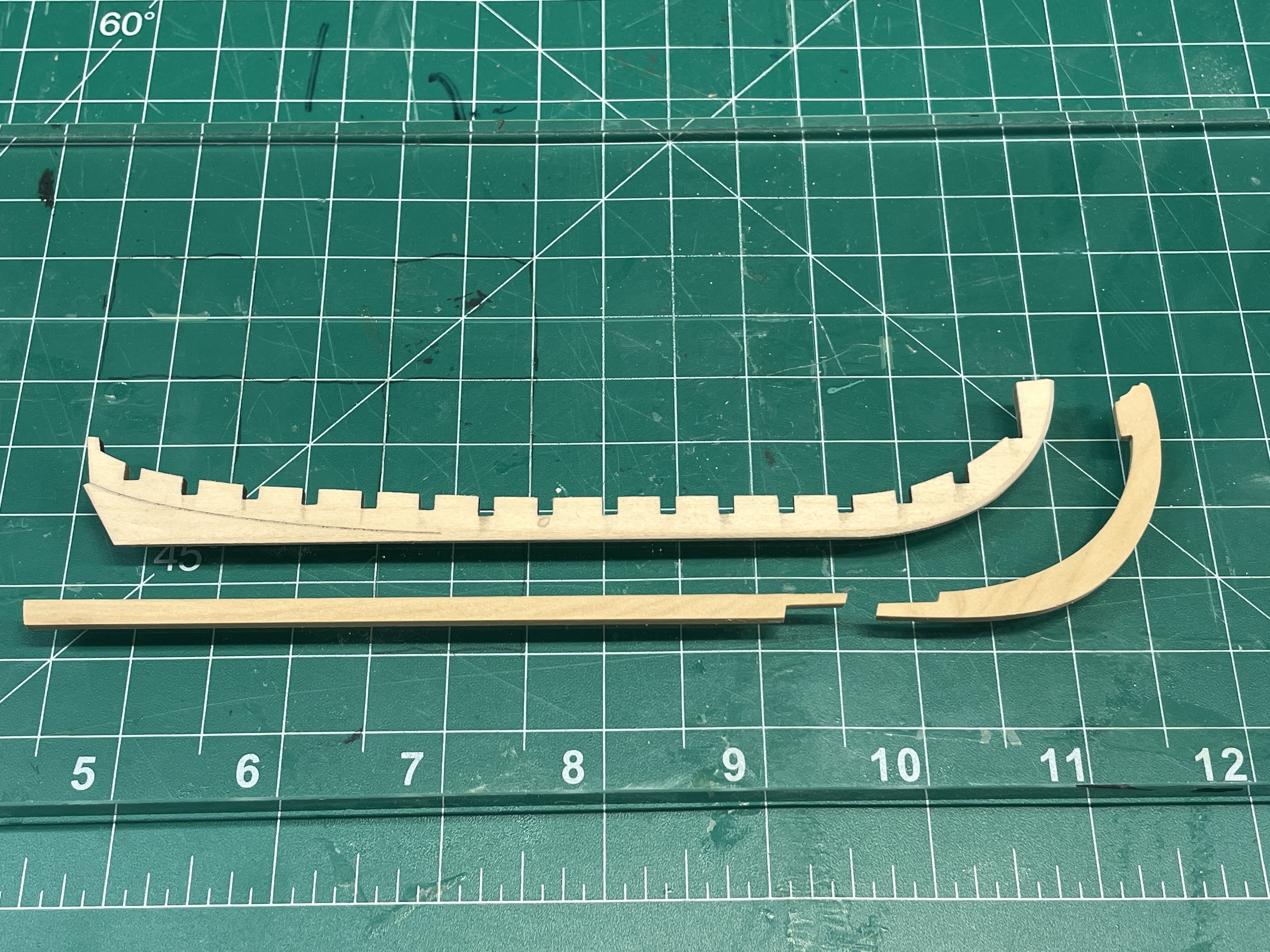

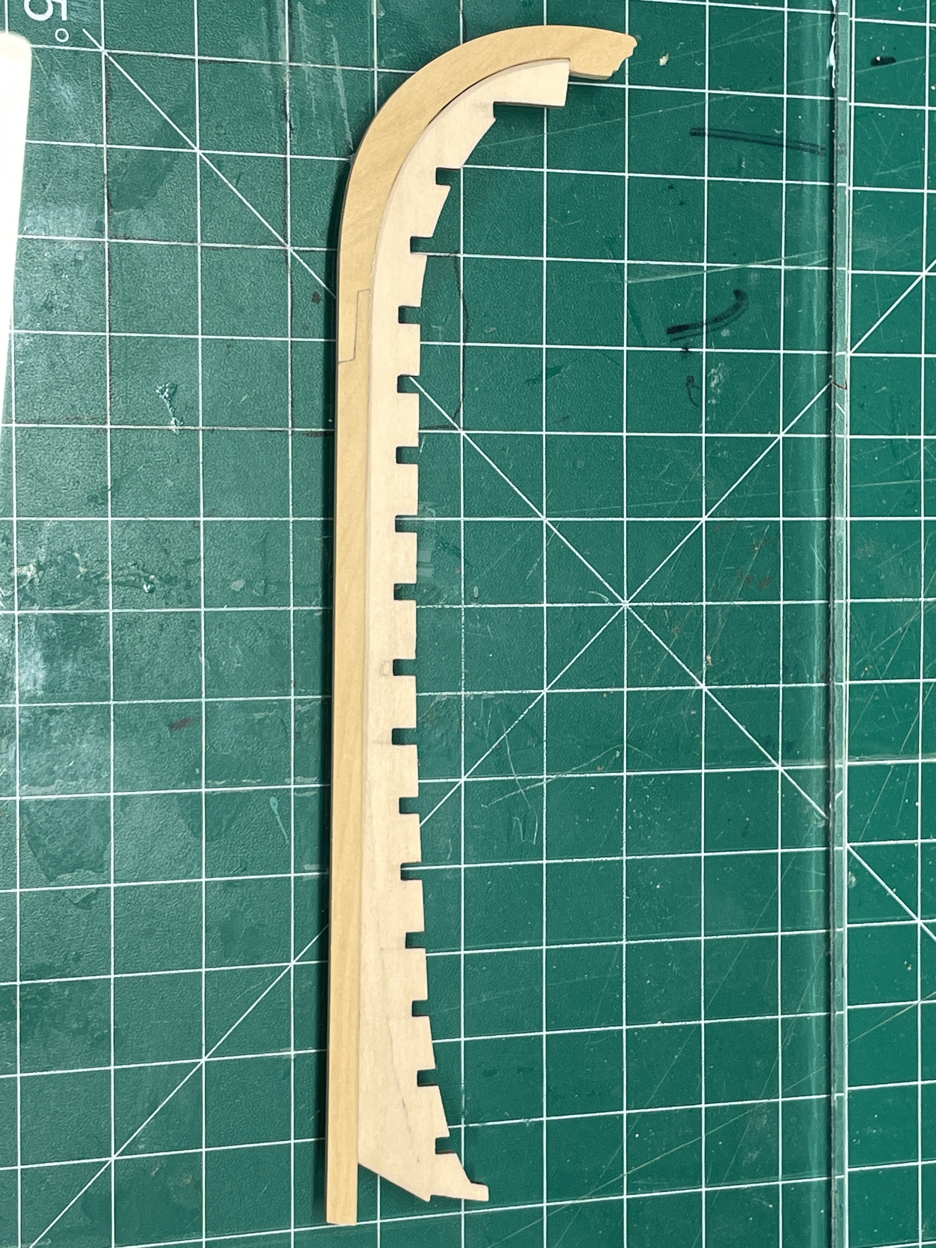

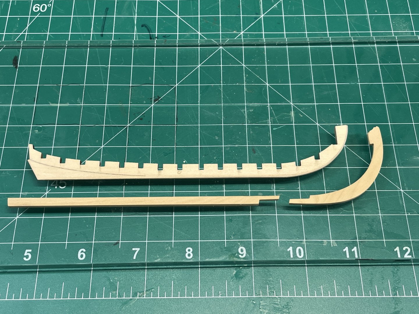

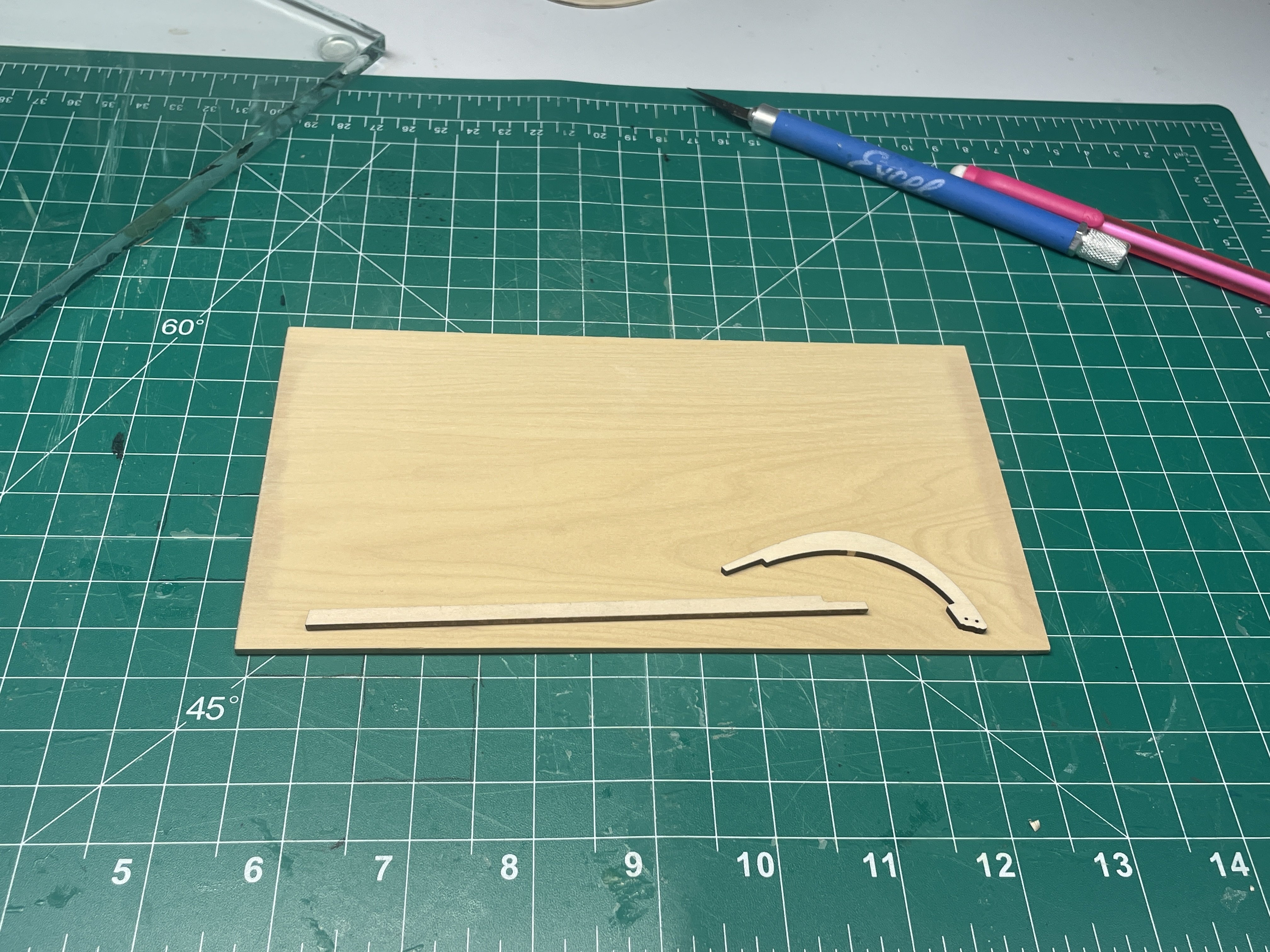

Marking out the keel and stem on a piece of boxwood. I then cut them out with a hand scroll saw.
I cut the scarph joint and I’m preparing to glue it to the false keel after sanding the bevel. I’m doing it on a piece of glass.

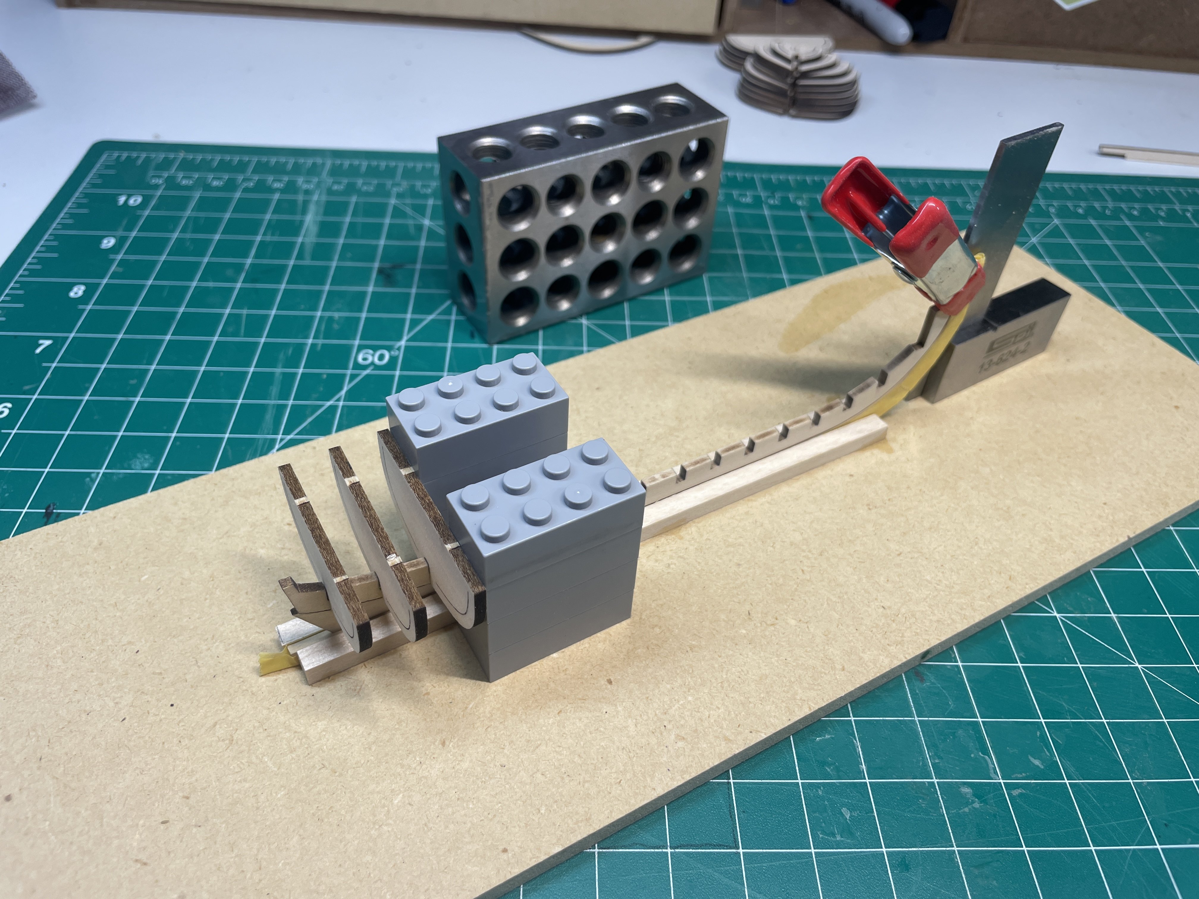

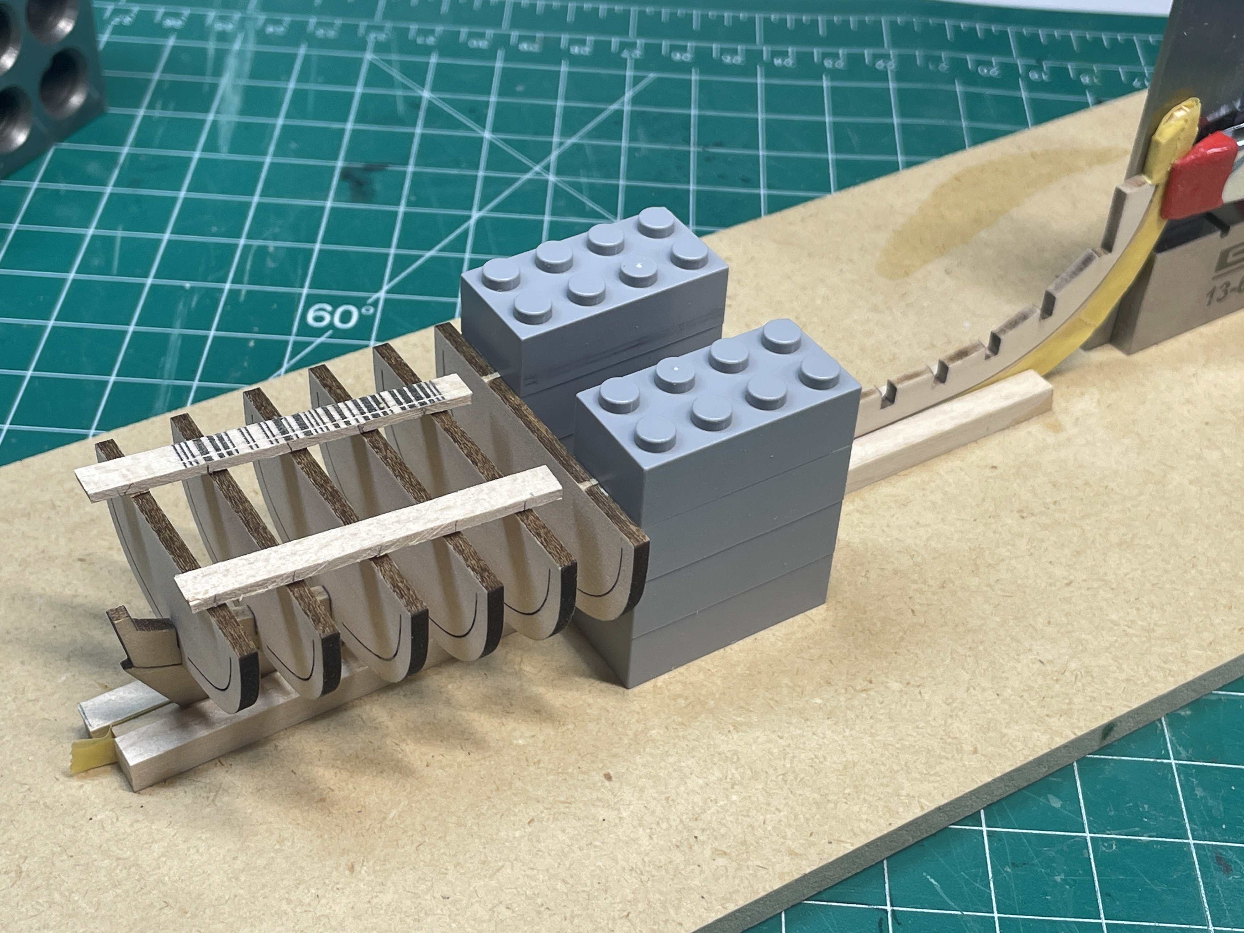

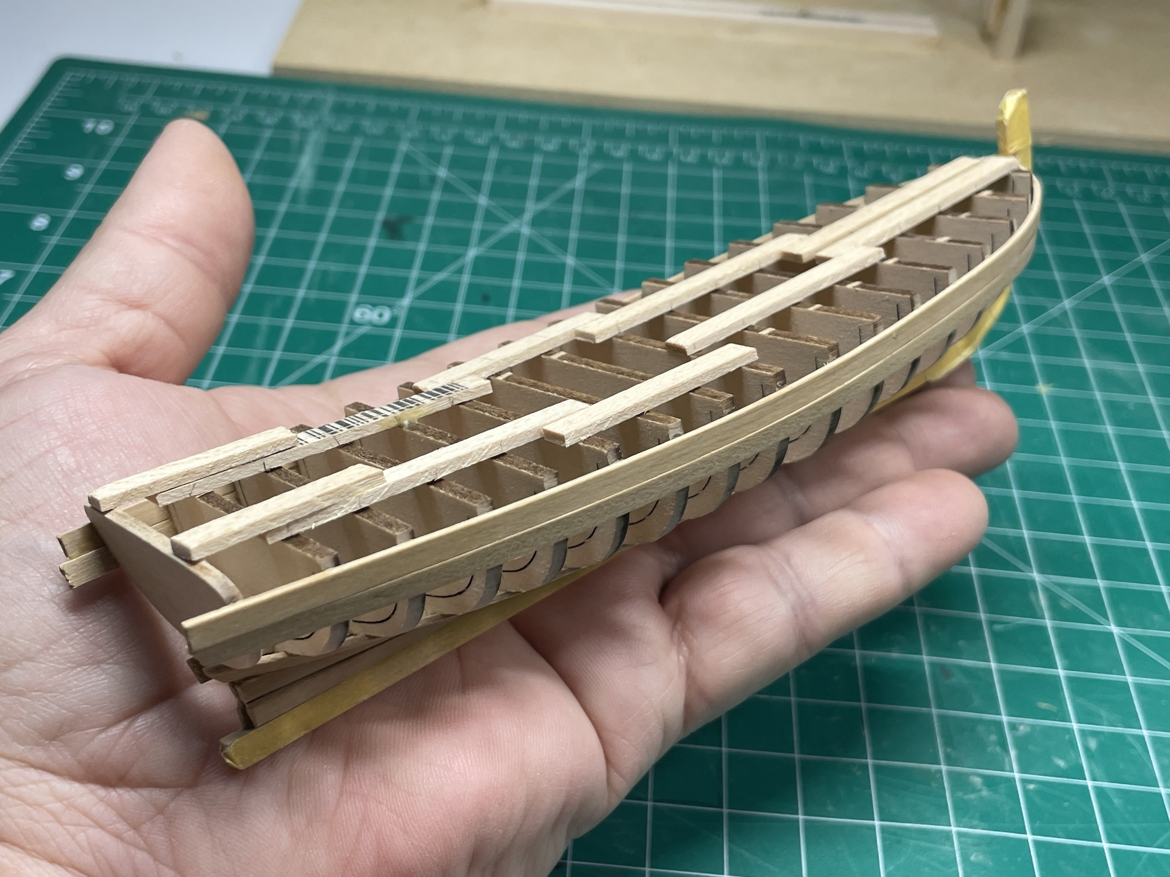

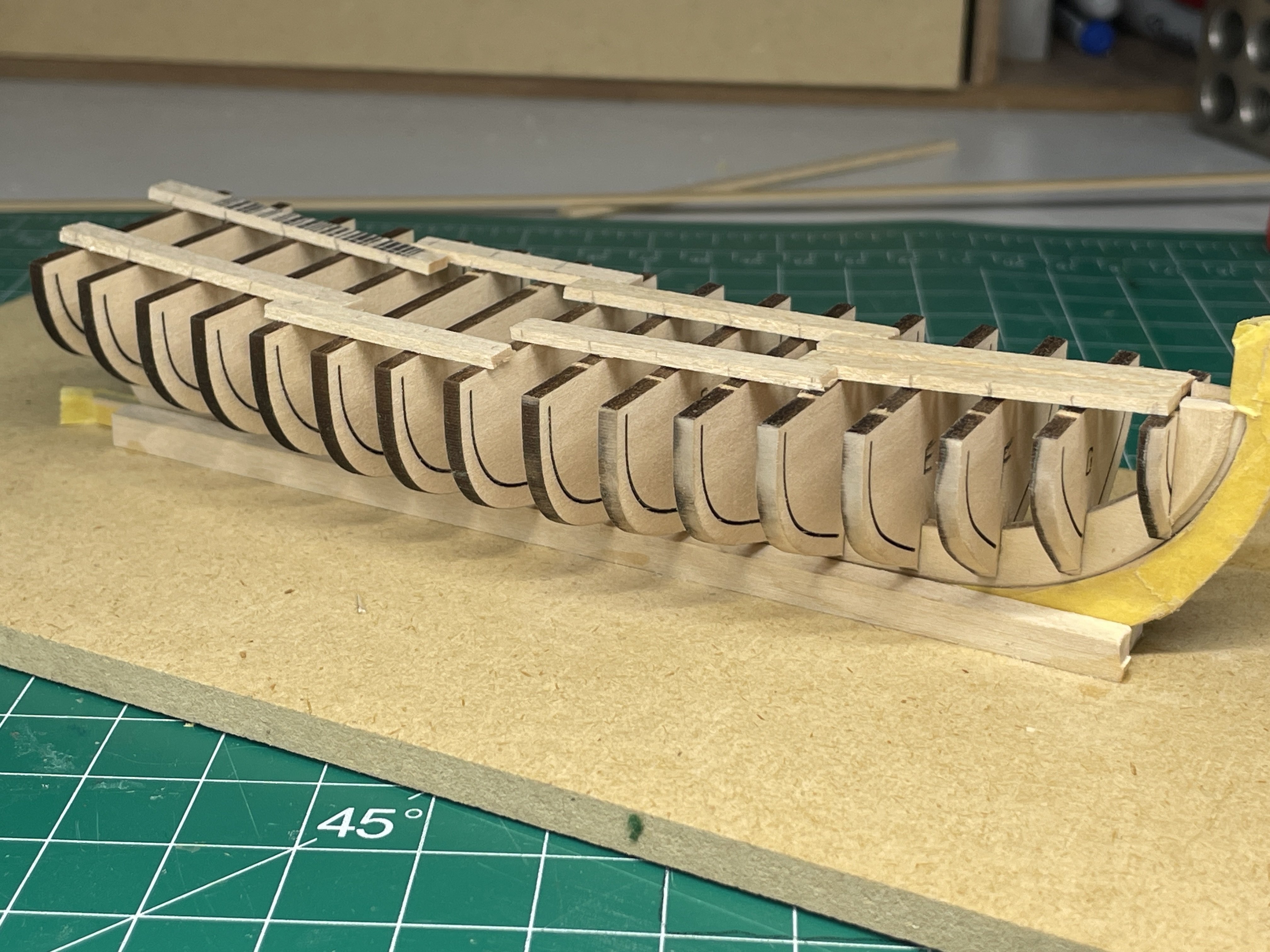

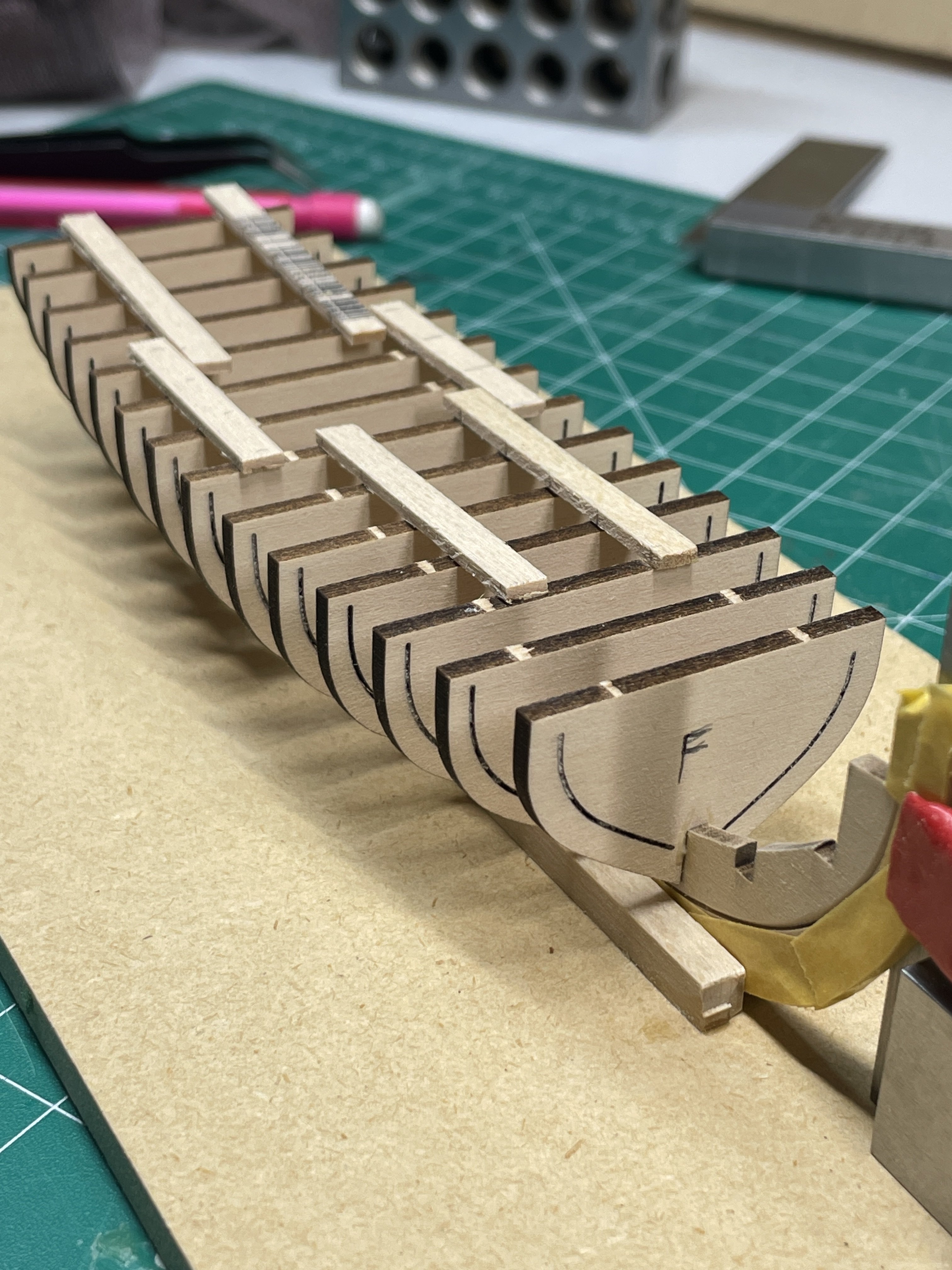

Little MDF building board I put together to keep it square. Using Lego blocks, I saw it on here and decided to try it out.
I glued support pieces as I went along to keep it square. I glued them to the waste part of the bulkhead.

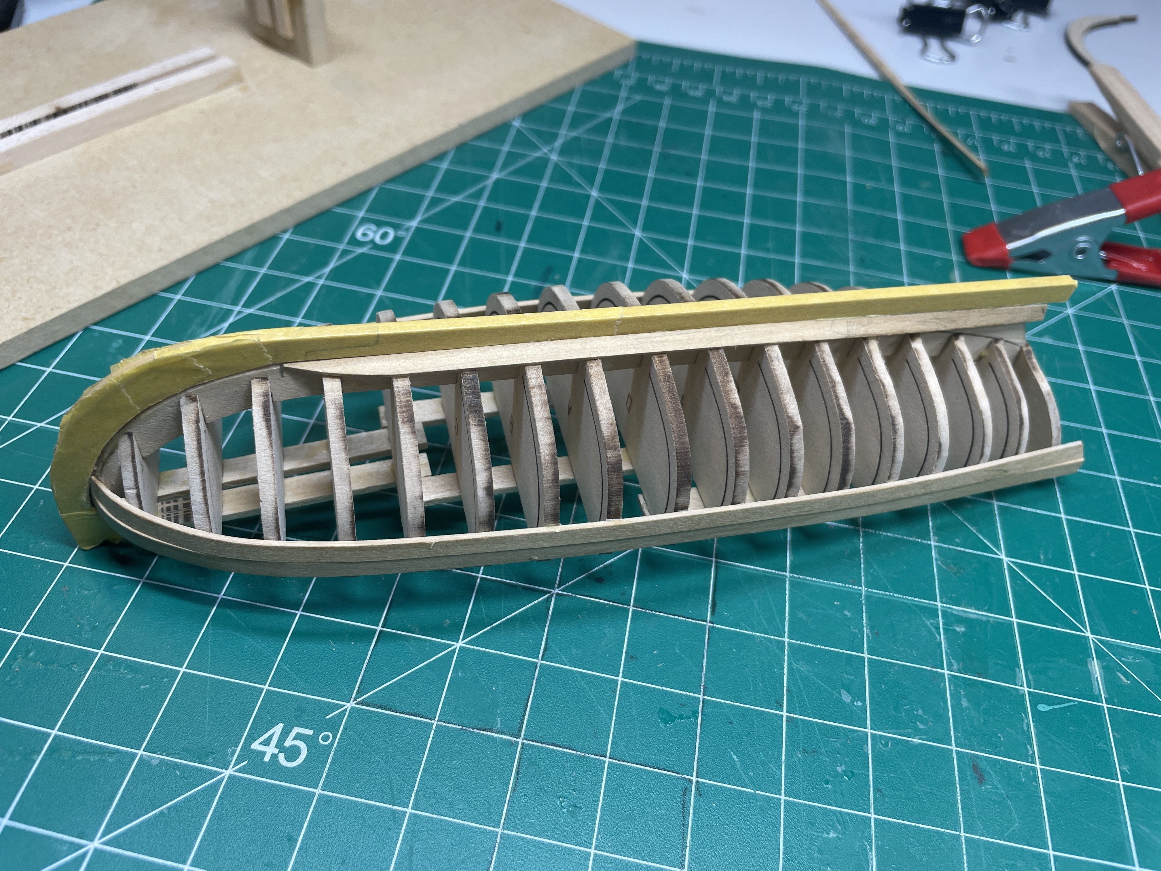

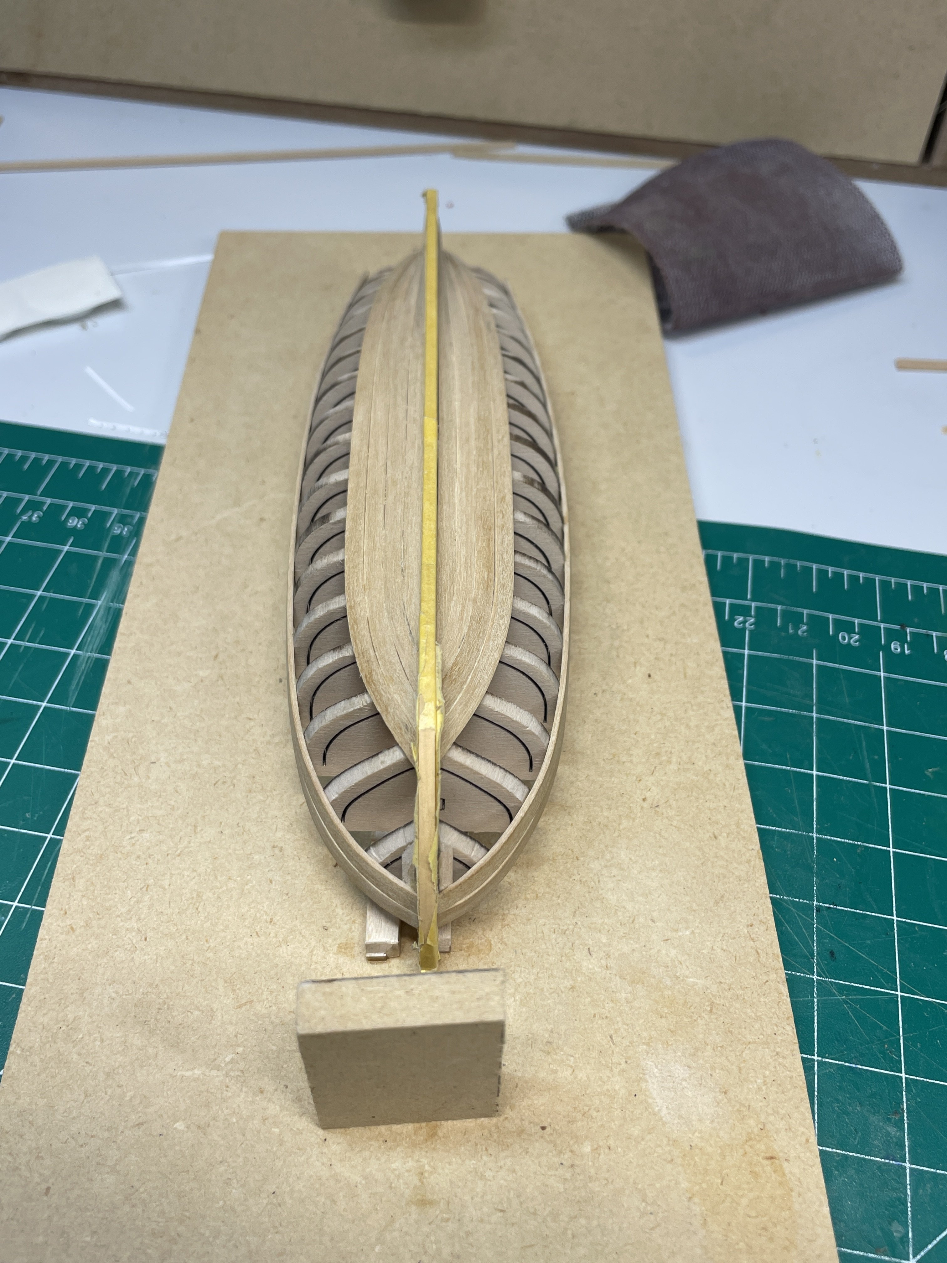

Starting the fairing process. This always causes a lot of stress on me. I’m always worried I’ll take off the wrong amount.
I put two planks at the top as the instructions stated, then went to the garboard strake. This is another place where I’m just never sure I’ve got the shape correct. I’ve got the keel and stem taped to protect them.

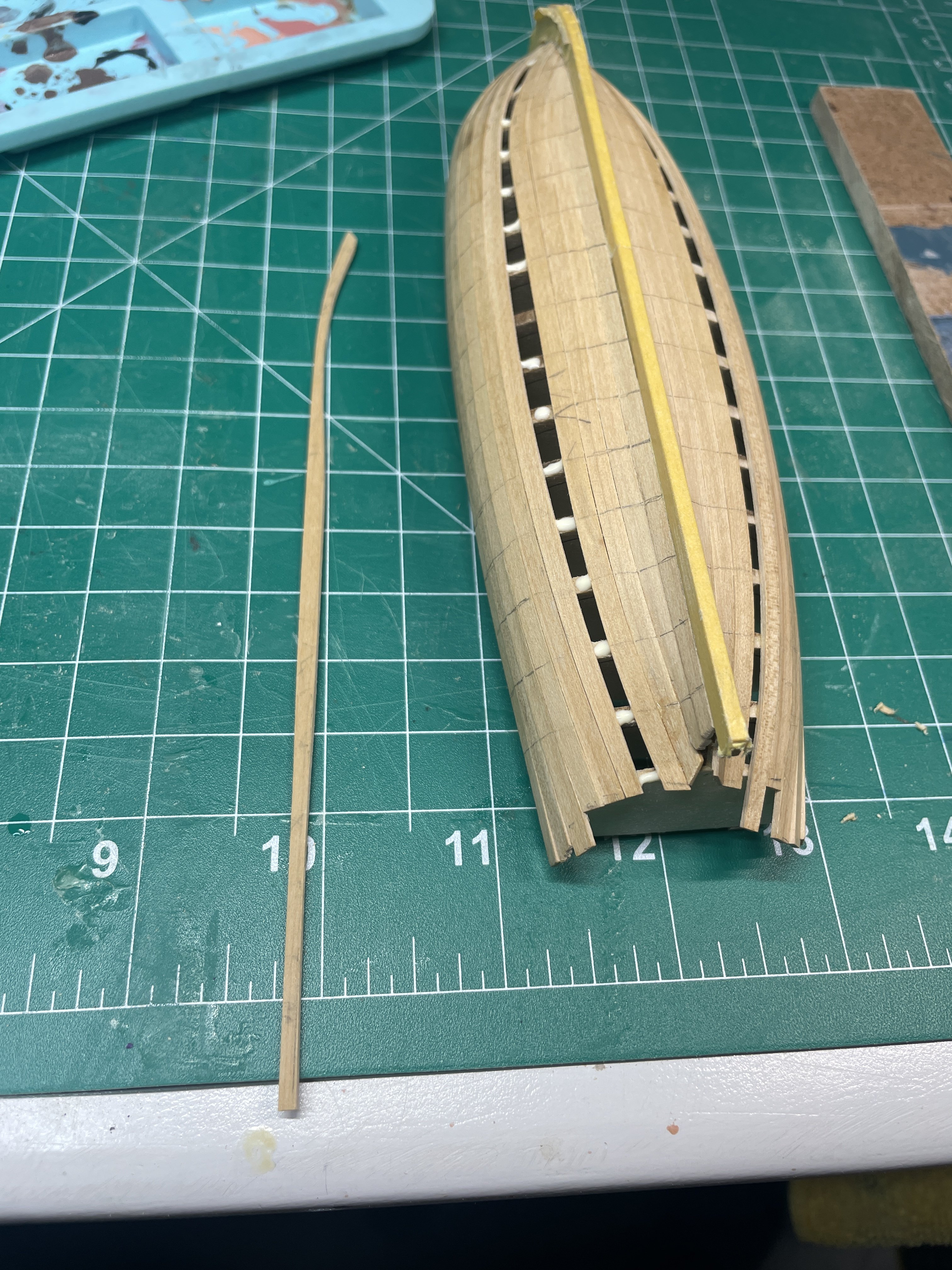

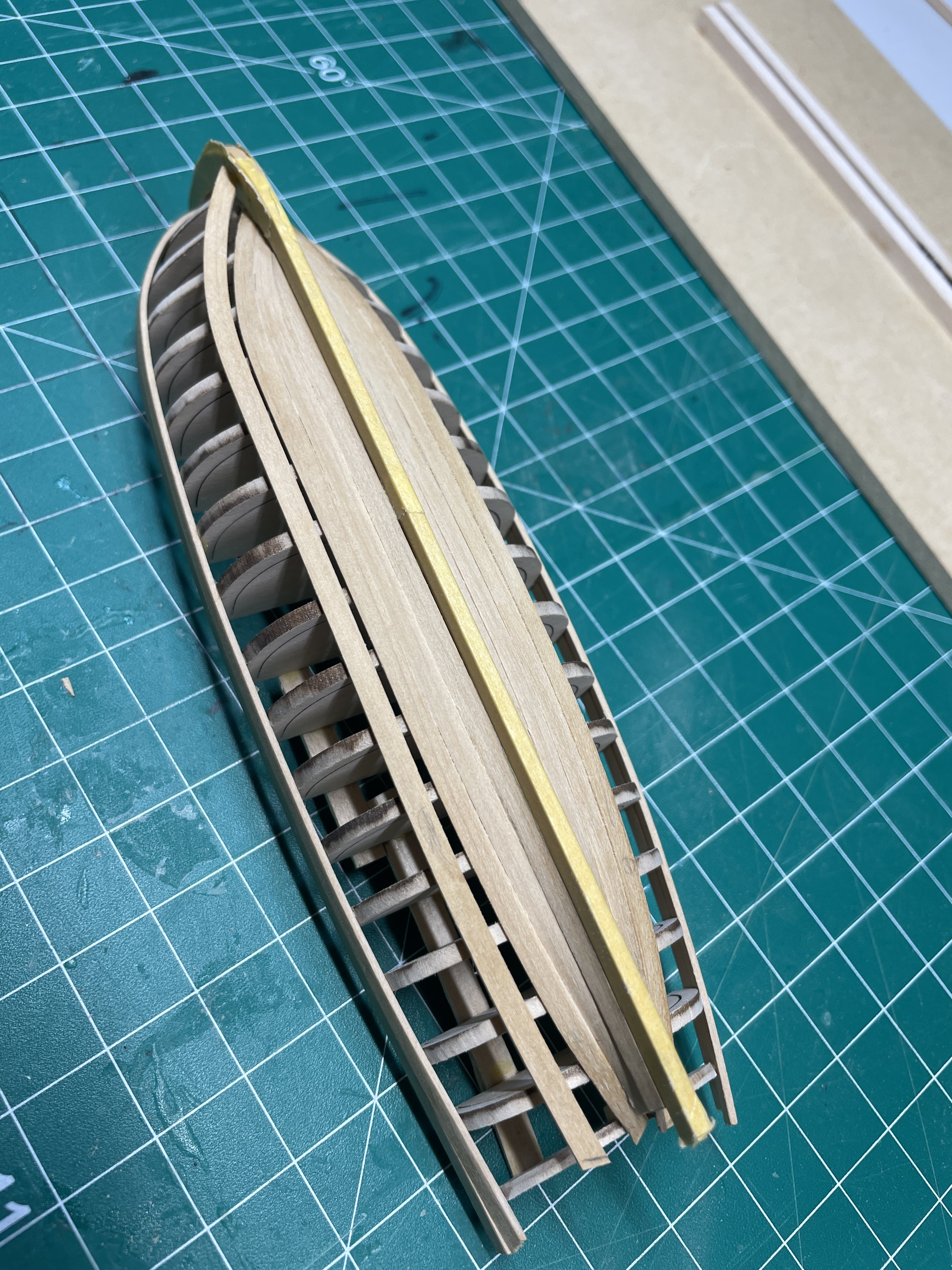

Planking this little boat is not easy. This is an example of the edge bending needed up at the bow. I had some difficulty getting the twist at the stern but I’m thinking it will be OK.
Thinking of previous builds basswood might bend easier, but maybe not as smoothly as boxwood…? Or maybe my technique has improved making the bends smoother. Hahaha

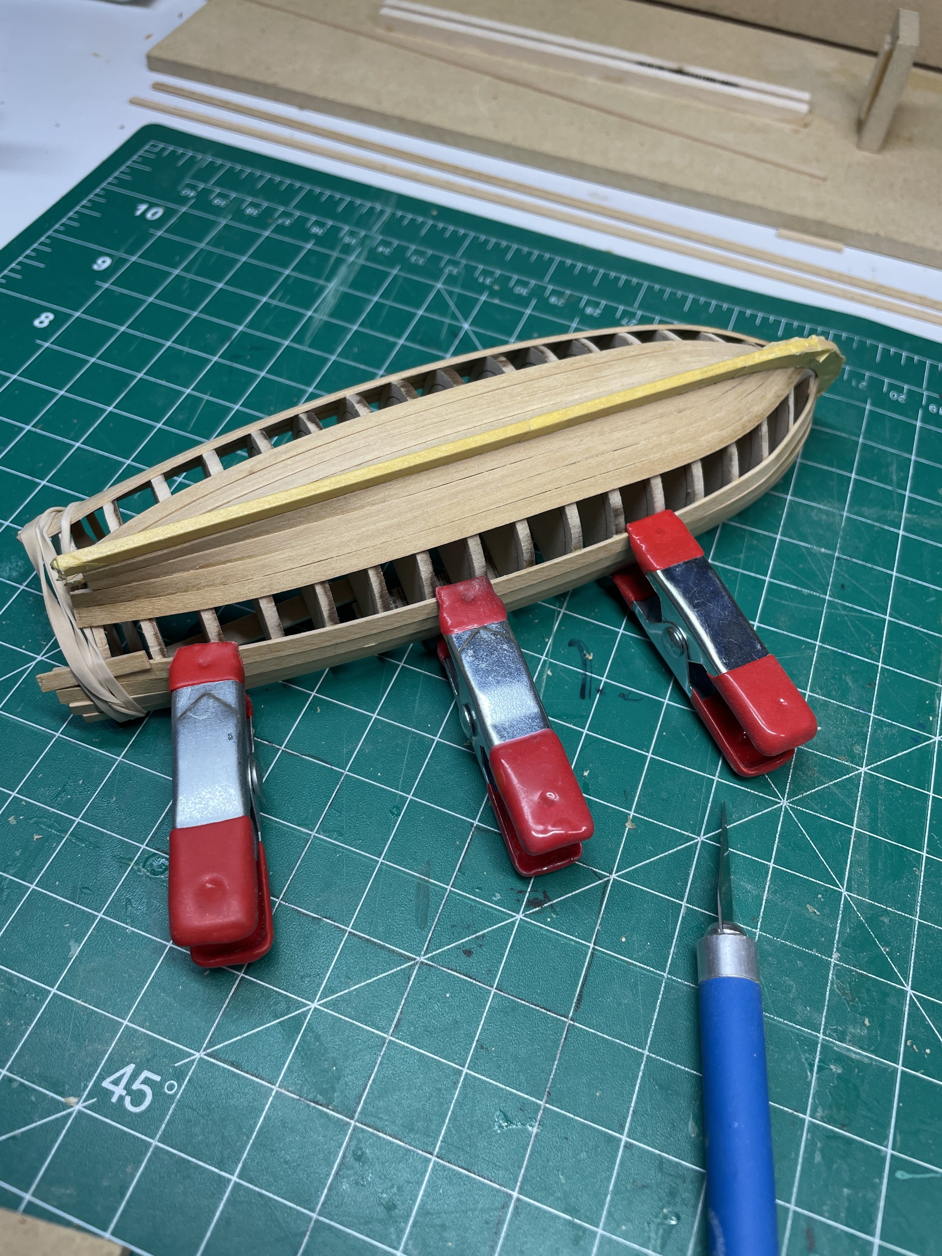

I’m continuing with planking. These are some tight curves since it’s so small. The boxwood seems to want to fight back against bending. Does that match with other’s experience using boxwood?
Used some clamps to help keep the seams tight.

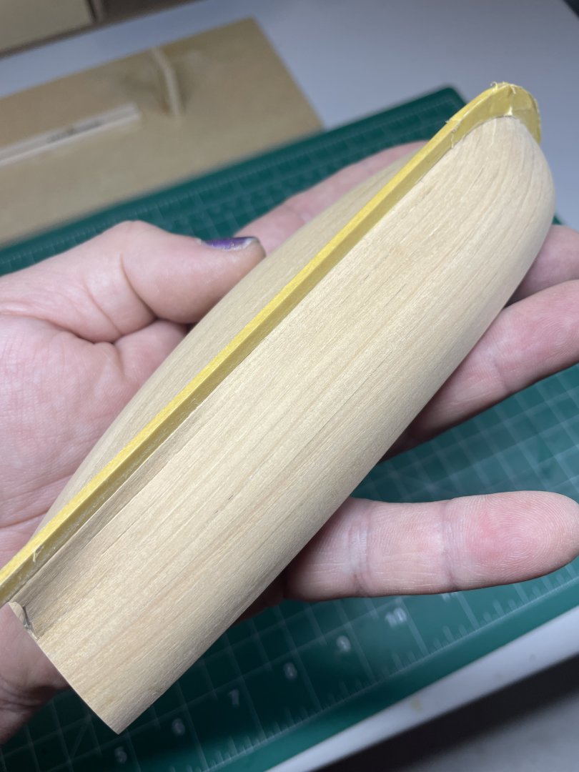

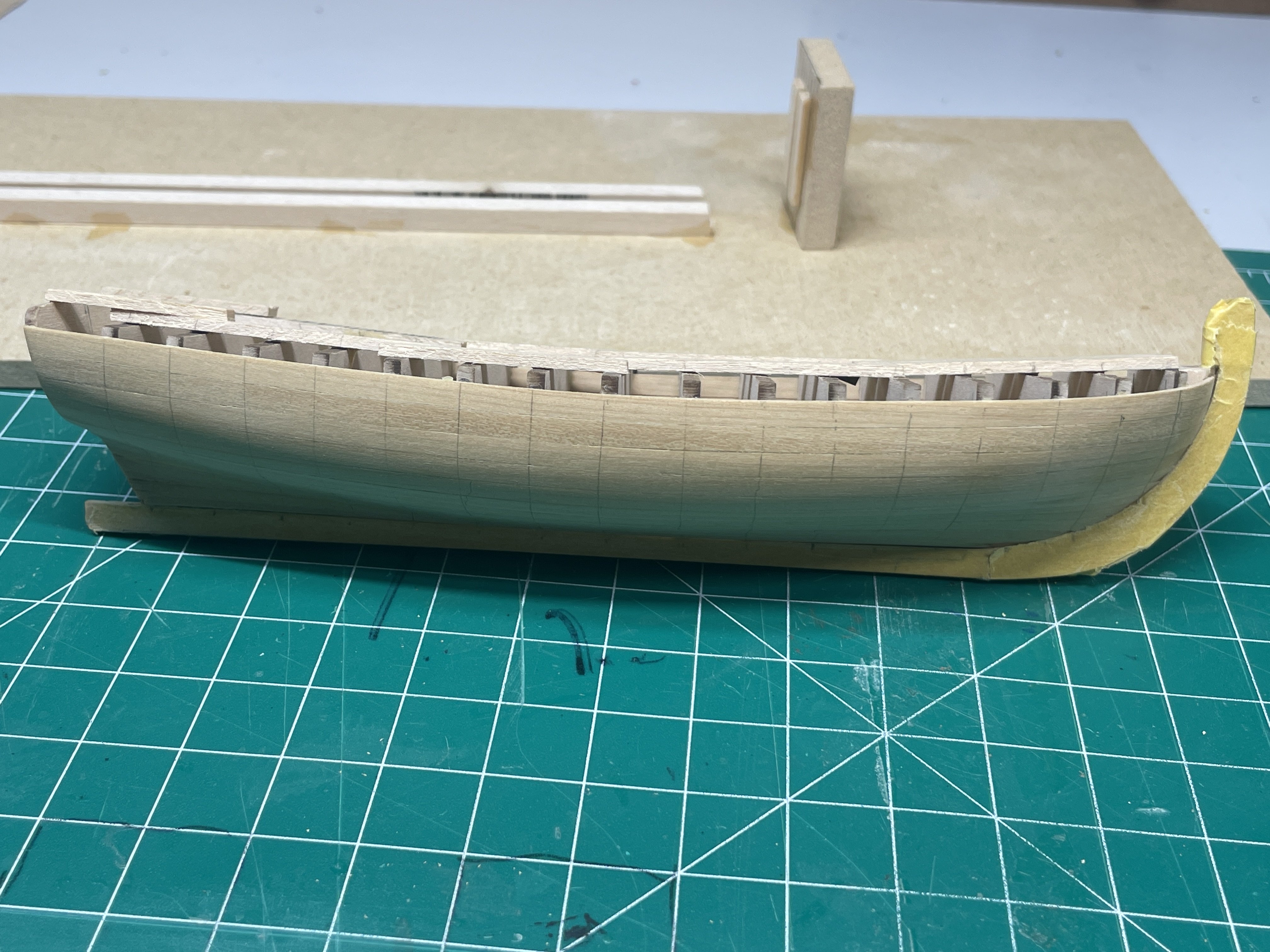

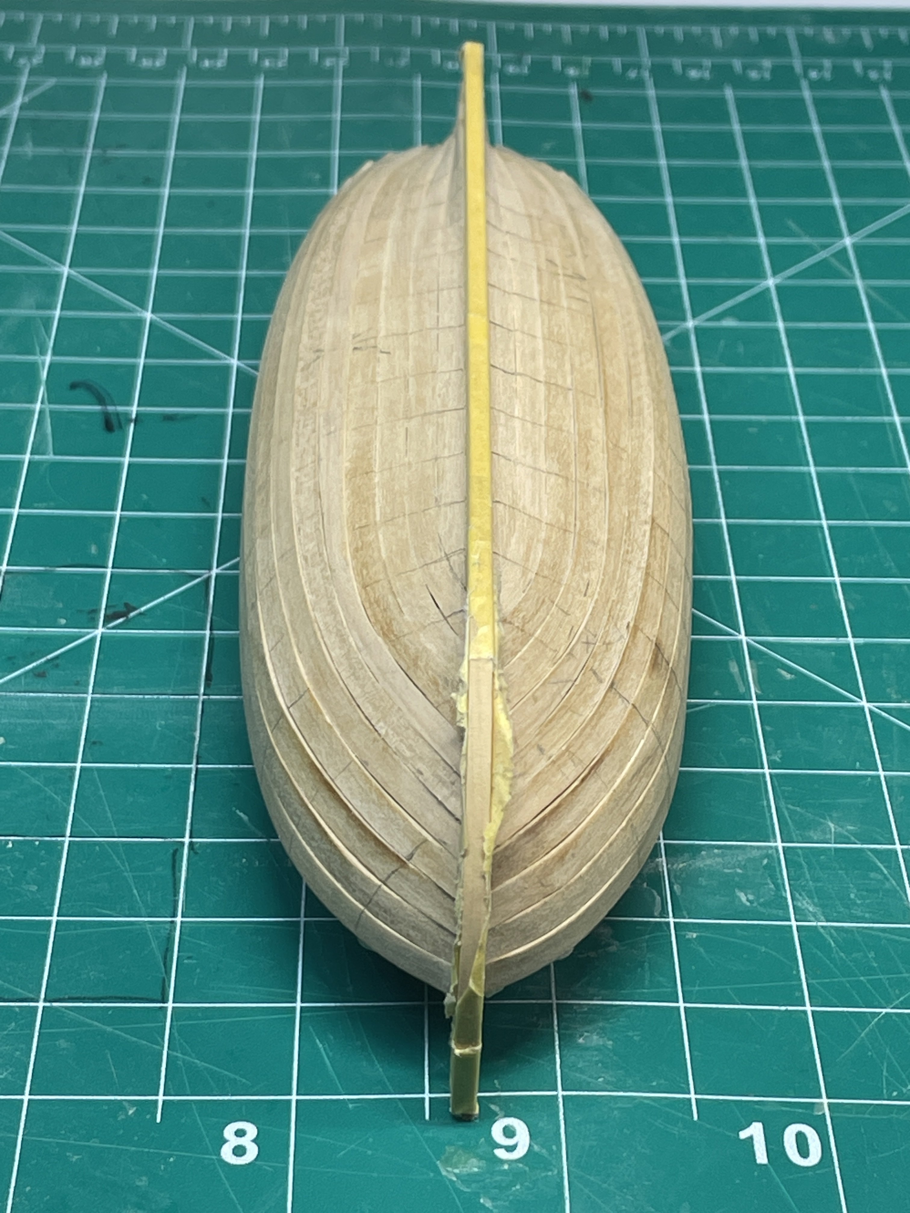

I used the Scotch tape method to get the shape of the final plank and then shaped it.

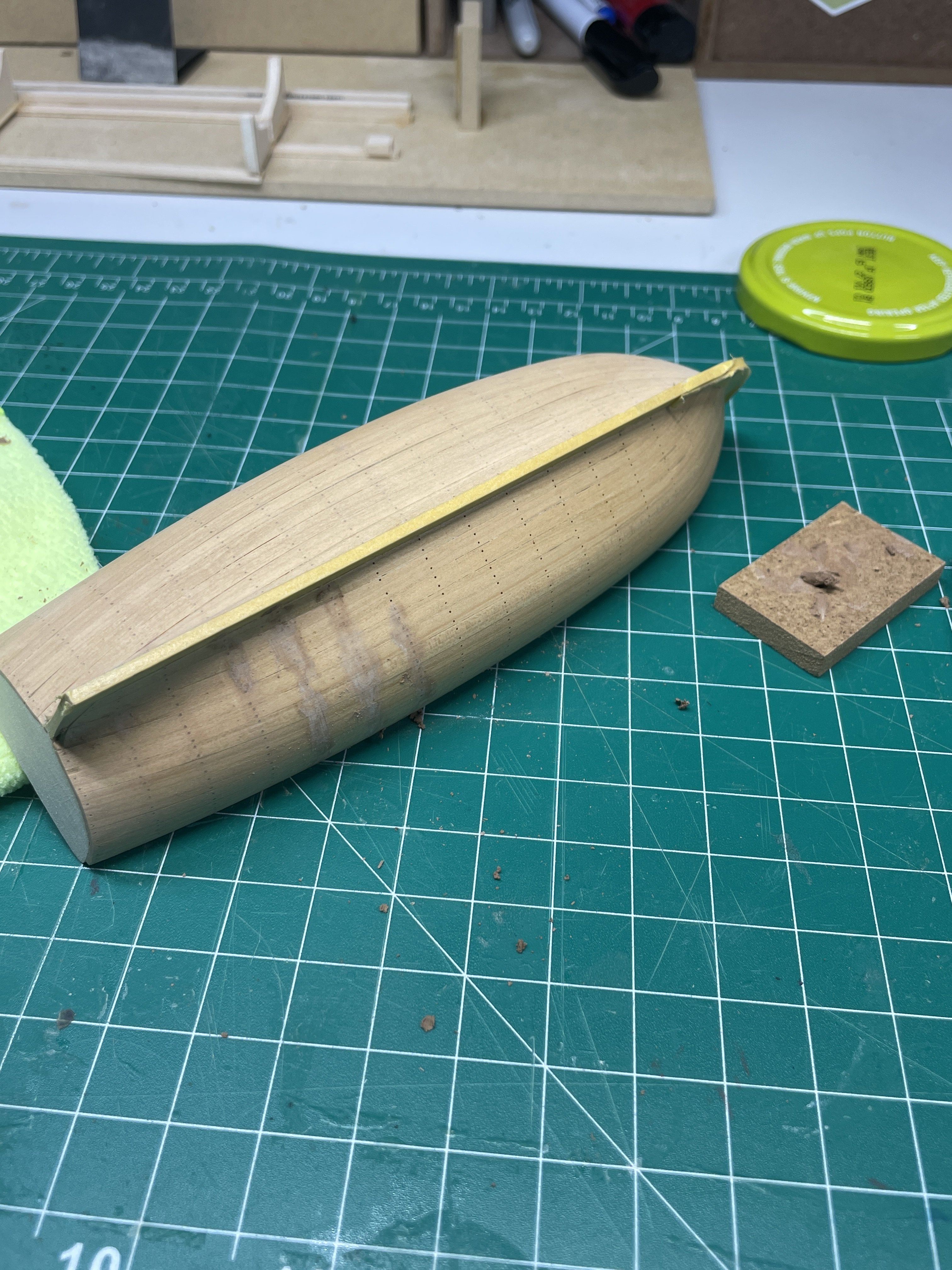

Here she is pre sanding. Not the prettiest planking but I think my skills are improving.
Post sanding. I was able to not have to use any wood filler. I did use a little thinned glue in a few seams while I sanded it smooth.

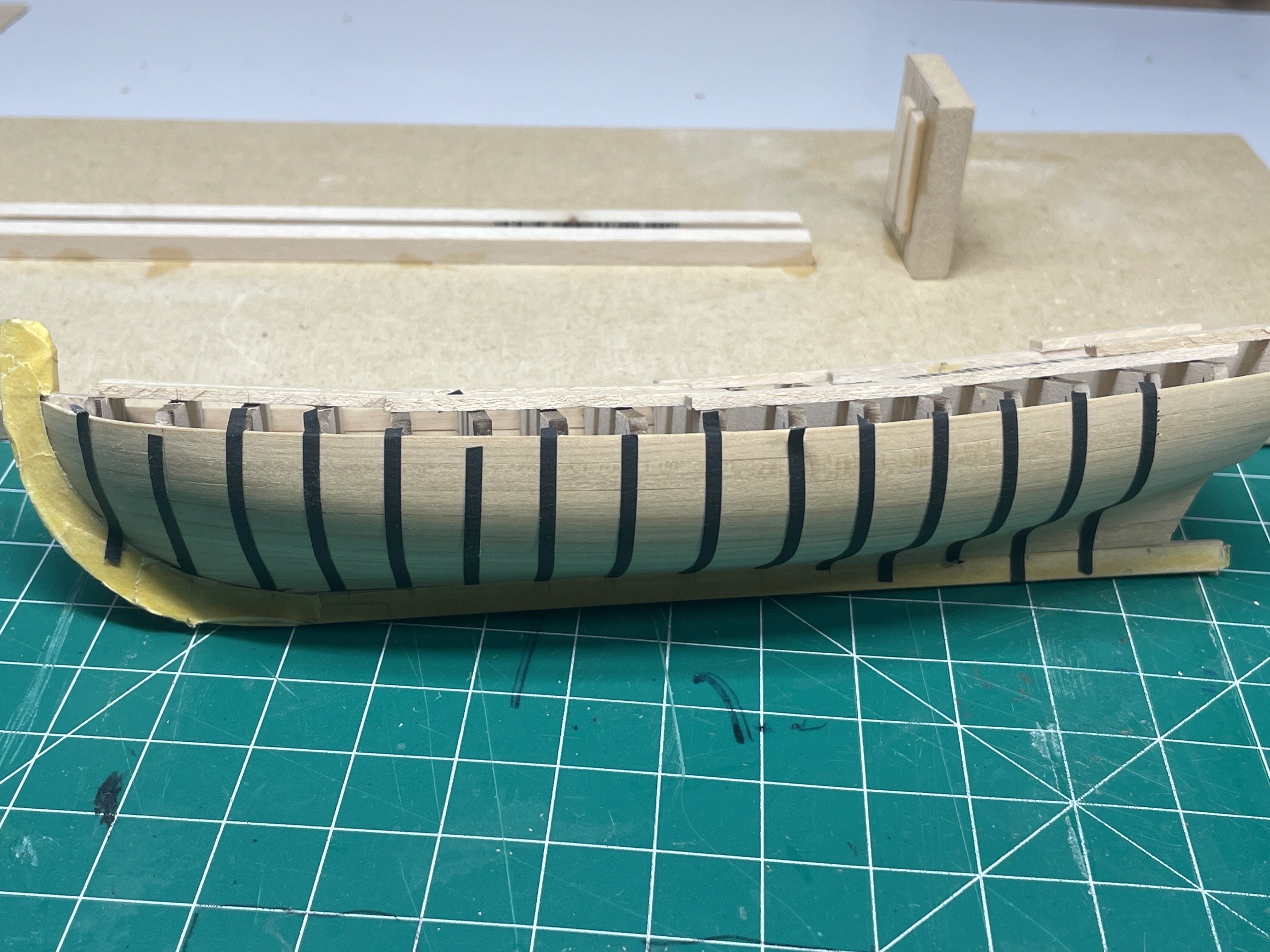

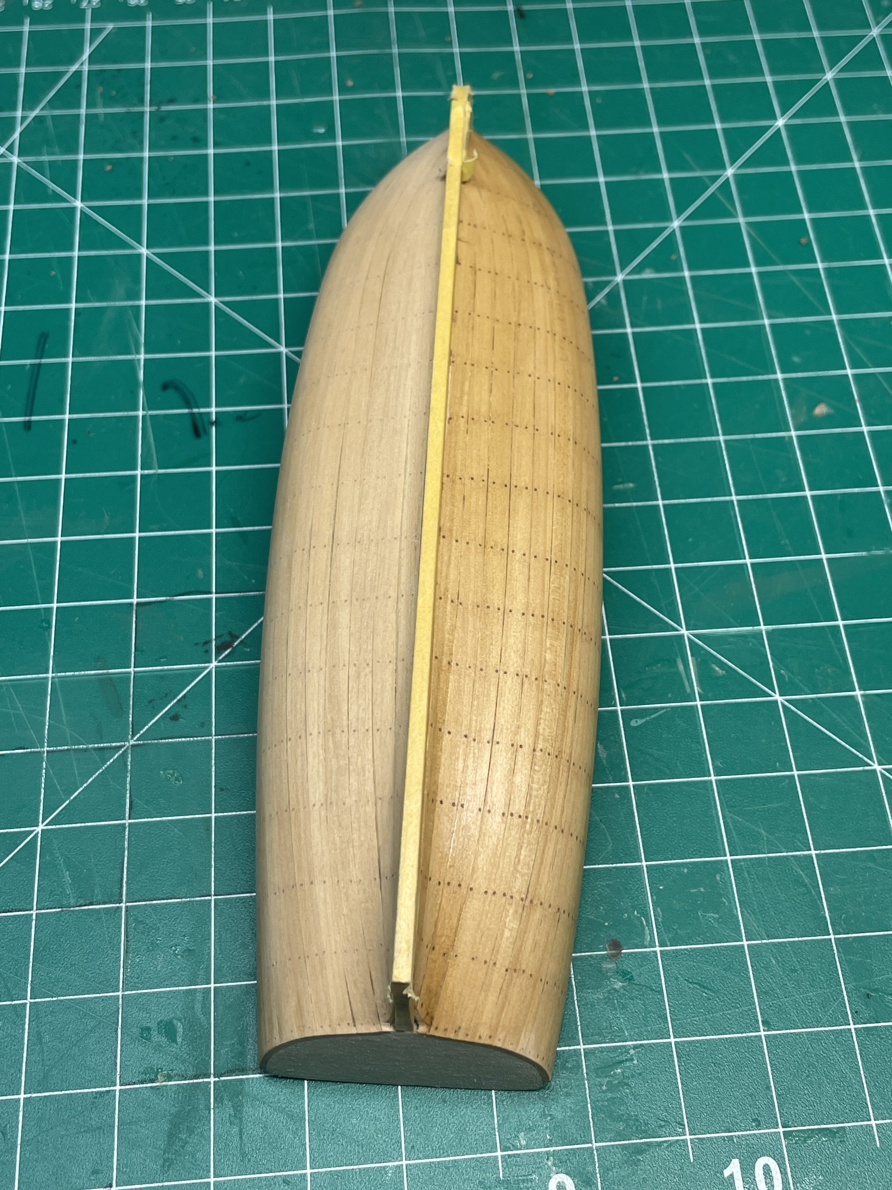

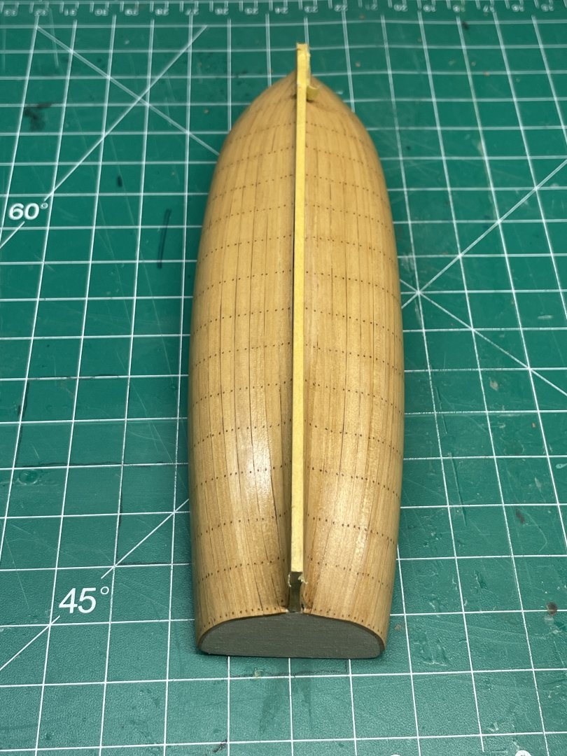

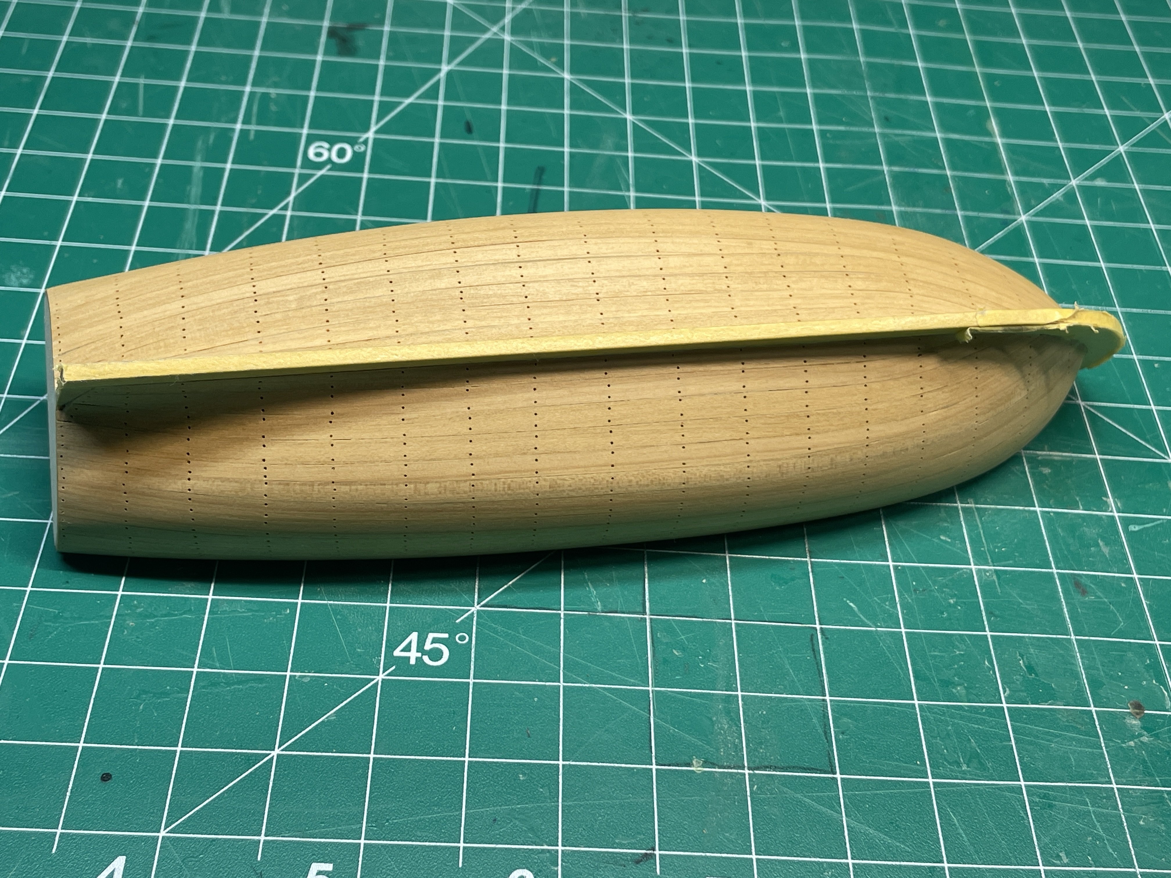

I then used tape to line out the simulated treenails. On the other side I used pencil marks.
I’m not sure where the line is between dedication to the craft and insanity. If my rough math is correct I drilled just short of 800 holes.
I gave the hull a couple of coats of WOP, this was to try to limit any staining from the wood filler that I plan to use in the holes.
I used a lab spatula to push walnut colored wood filler into the holes. I would then use a damp micro fiber cloth to wipe off the excess.
One side is WOP’d the other not.
I’m really happy with the results. It looks a little shiny because it’s wet. The dots are less pronounced after drying.

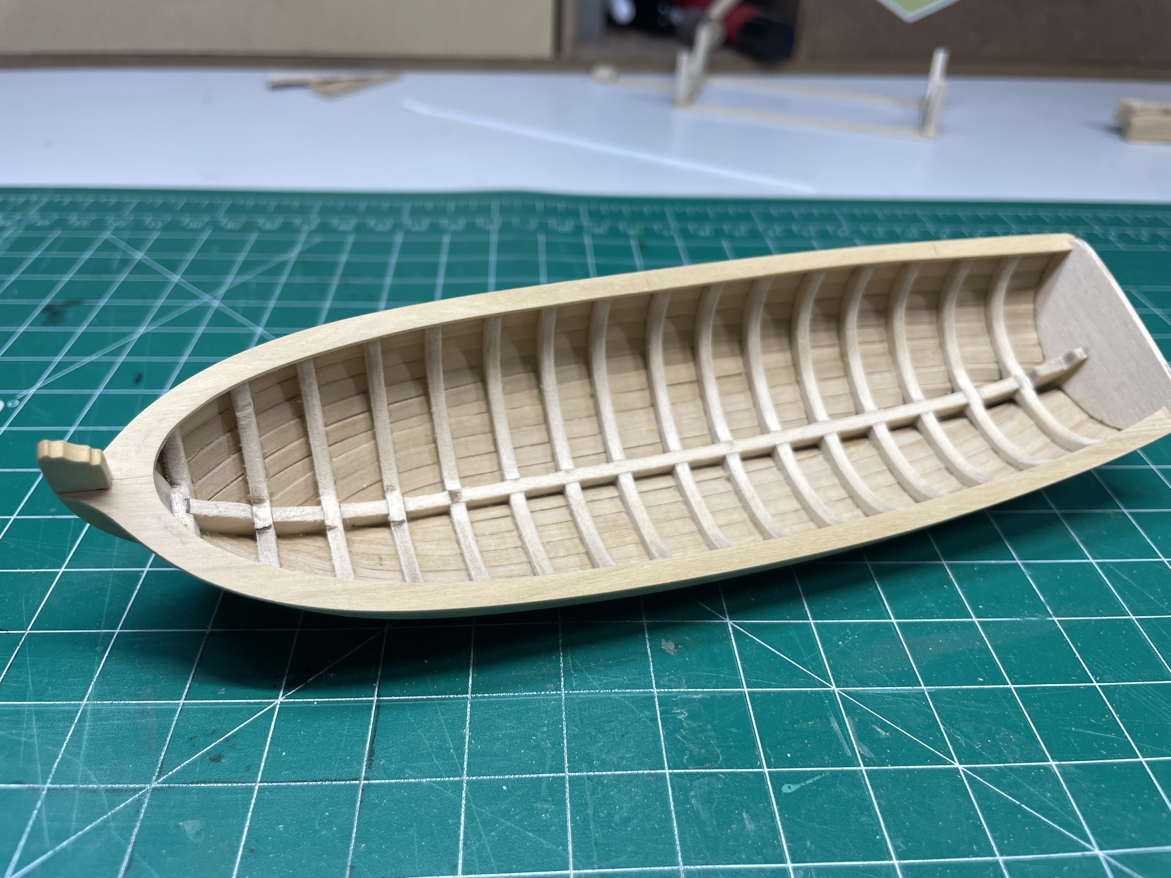

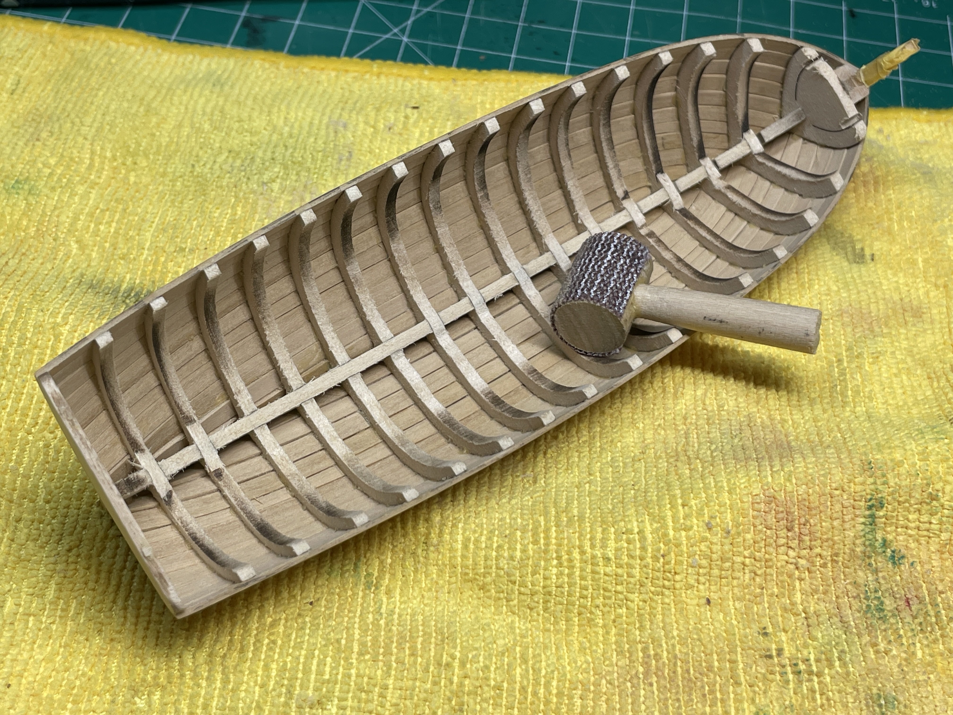

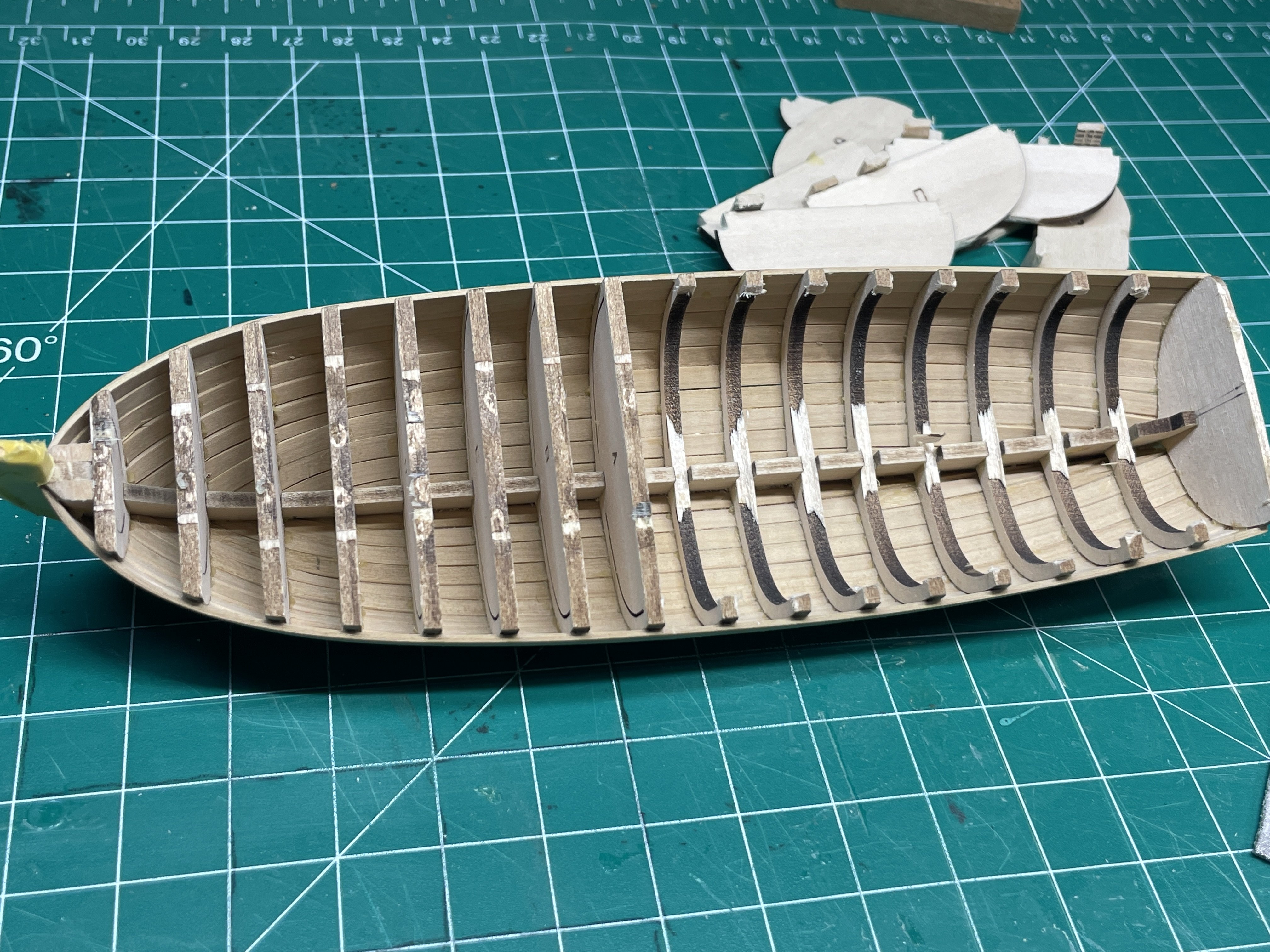

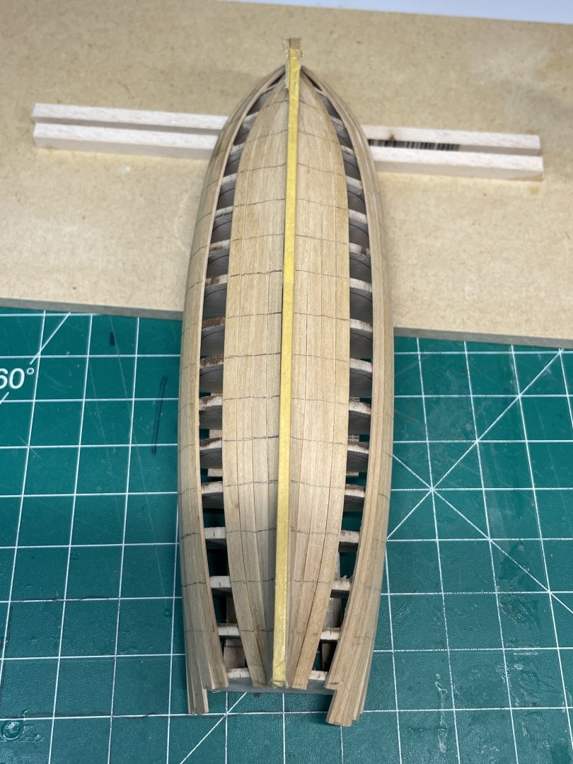

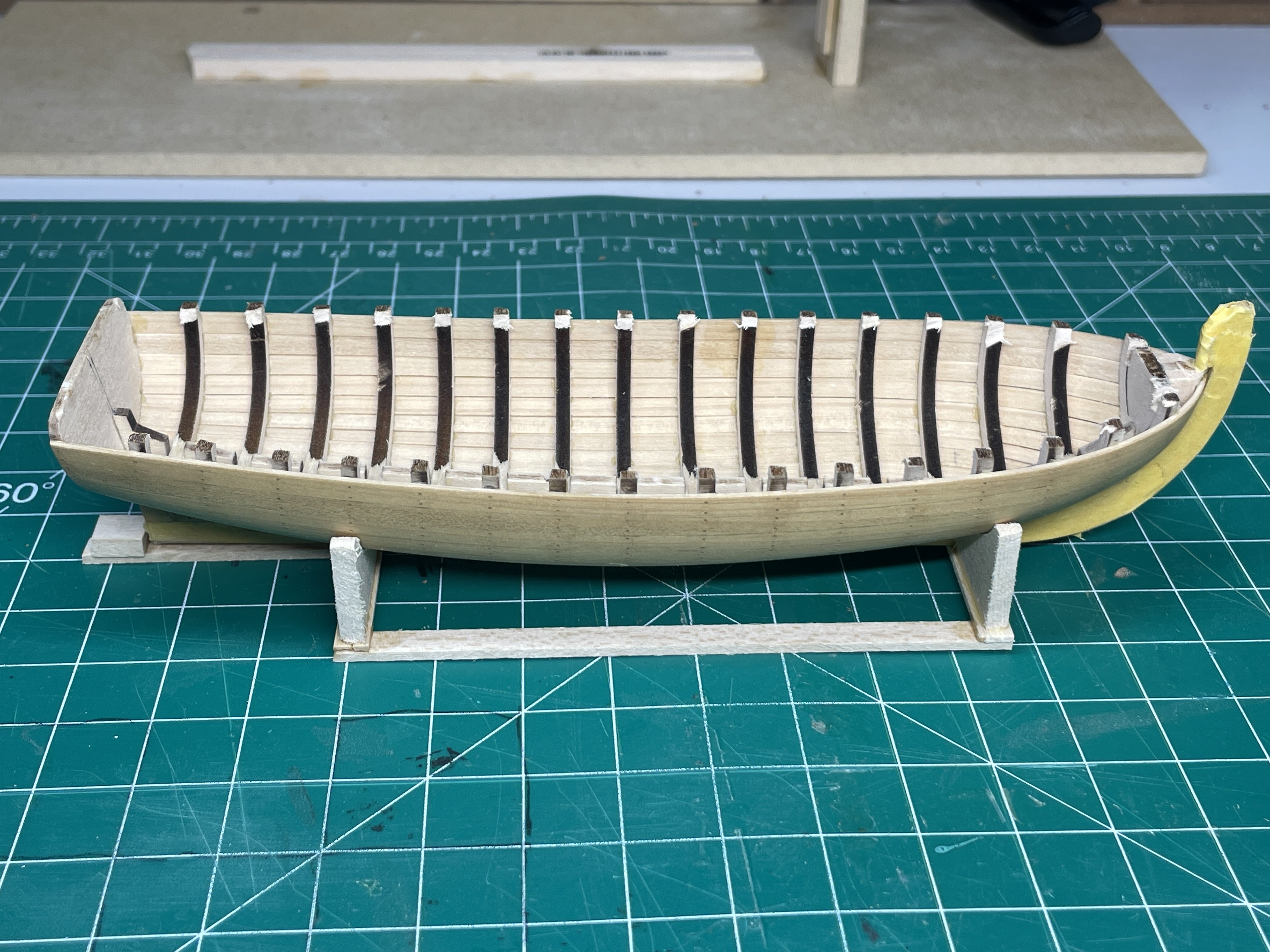

Now it’s time to remove the bulkheads and thin the frames down.
I used one of the course files you get in various tool “kits” from model expo. It made quick work of the attachment points without causing any trouble. I did snap off a couple of frame tips that were not attached to the top planks very well. Those were easily glued back on and it’s essentially invisible. I tended to use lesser than more glue because cleanup was hard to get to during planking and it’s not going to be easy cleaning up a lot of excess glue between the frames.
Then sanding them down was tedious. I didn’t want to use power like a dremel for fear of taking too much off. So various grits of sandpaper and I went at it.  Made a little Thor’s hammer to help. It was OK but wasn’t used everywhere. I saw this on @BobF’s build of this boat. I actually need to give him more credit than just that as I’ve studied his build log immensely.

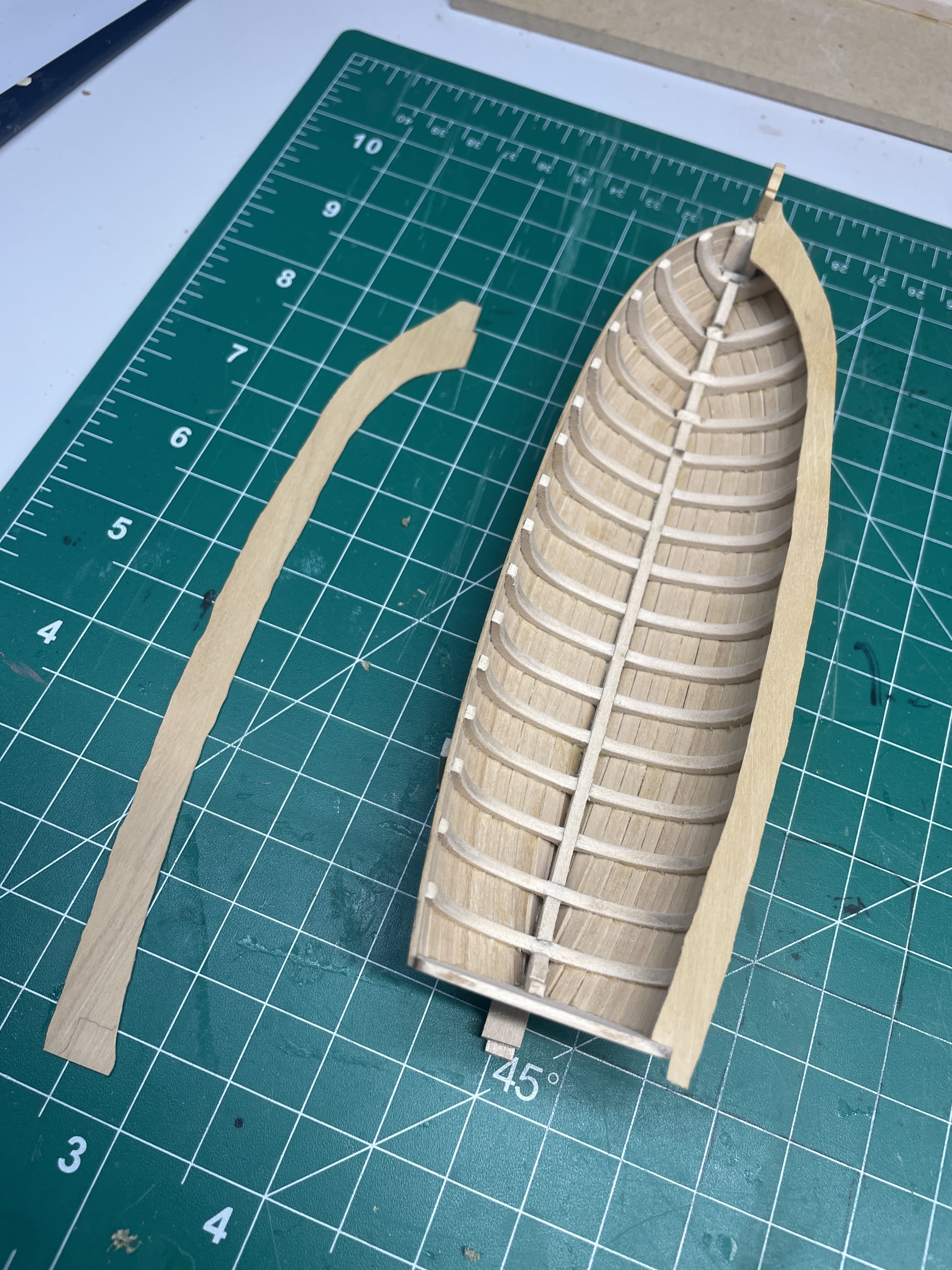

Got them down to where I liked them and then it was time for the cap rail. I held a 1/16 sheet of boxwood against the wale and traced it.
Here’s a question for you guys, while I was cutting out the boxwood it seems really brittle has that been other’s experience? Now I was using a bandsaw with a fairly rough cutting blade so it could have been that. Also cutting out small pieces with a sharp exacto will have it split sometimes also.
Anyway I cut out the piece way oversized. I cut out the part for the stem and glued it on.

Here’s where we stand so far.

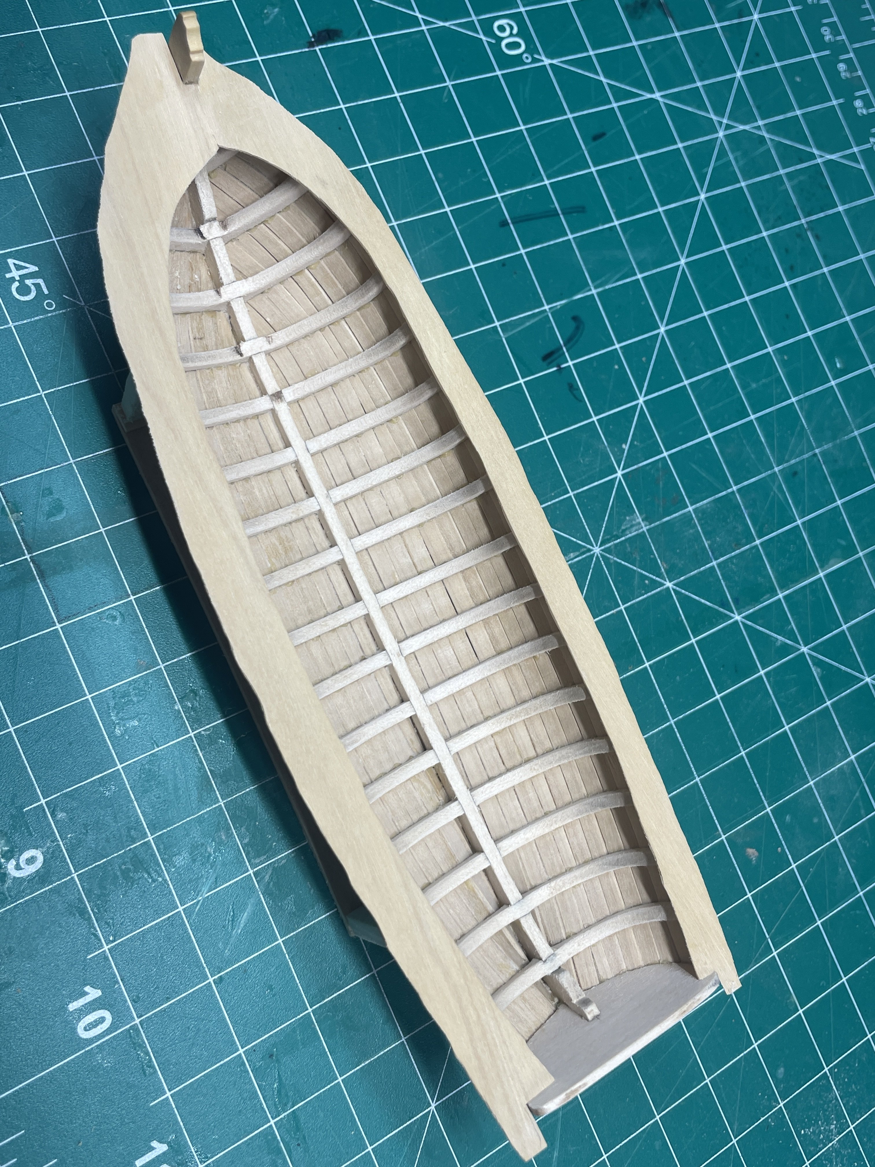

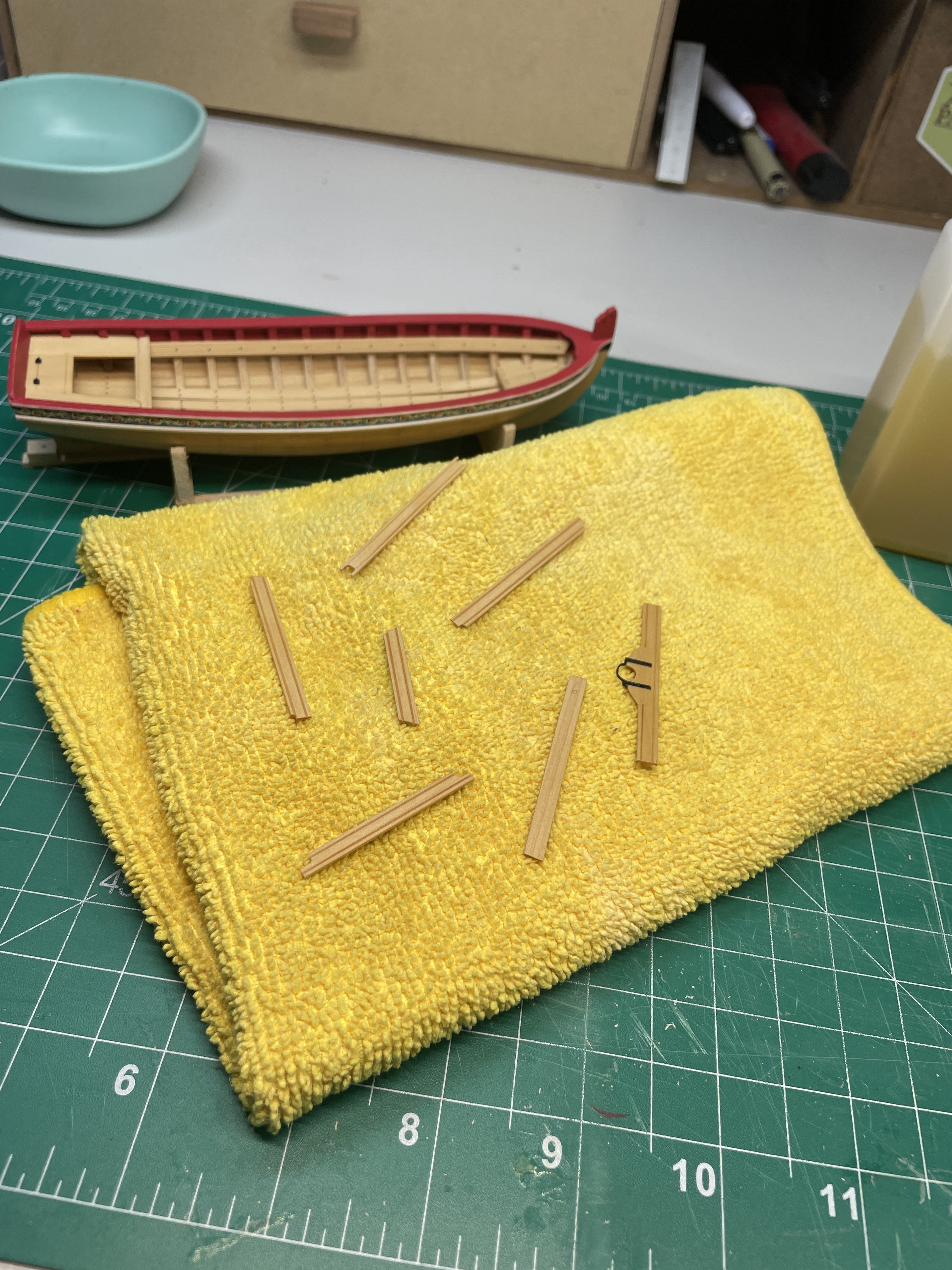

Today I’ll be finishing up the floorboards. I think they’re looking good.
23 hours ago, Chuck said:
Very nice...excellent work on a model that is not a easy project.  Its a challenging project.  It looks great.
Thank you Chuck. I wanted a quick little project before I started Cheerful. I’m not sure I chose wisely. HAHA. I love the little boat! I’m just really trying to complete her to my highest ability. So that does not equate to quick little project.
Time to start on the floorboards. I wanted to play around with black monofilament for bolts or nails and such. I did some shaping of the center board from the plans and also did some test holes for the monofilament I have. I ended up using a #77 drill bit. The line is .40 mm.
Then just more of the same for the other boards. I really thought I was doing well and I see the nail lines are not straight. There was a lot of things to keep track of while gluing those in. I’m not going to worry about them and just keep it as a lesson to keep a closer eye on those also.

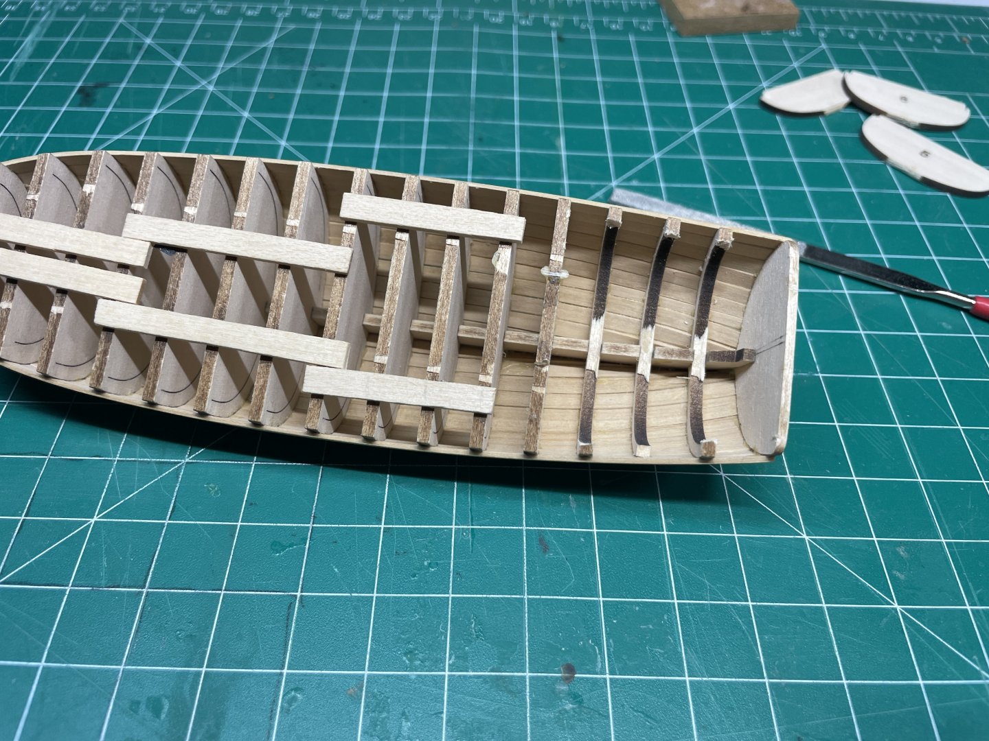

Now on to the little decks. I was not looking forward to these as I have a really hard time visualizing what shape things like this need to be when they have compound curves. Plus its basically impossible to measure in there. I used a trick that I saw in the build log of @BobF.  He used little bits of paper and made a template. I tried it and I think it worked out well for me. I transferred it to a single layer of manilla folder then onto the boxwood floors I had made and cut them out. I don’t seem to have any pics of the backs but I did put some 1/32” boards on the back for strength and to help keep them flat. The final fit could be better but I’m good with them.
When final dry fitting something like this how do you tell where the part is getting stuck and needs a little more shaping?
Here they are installed and a coat of WOP.
