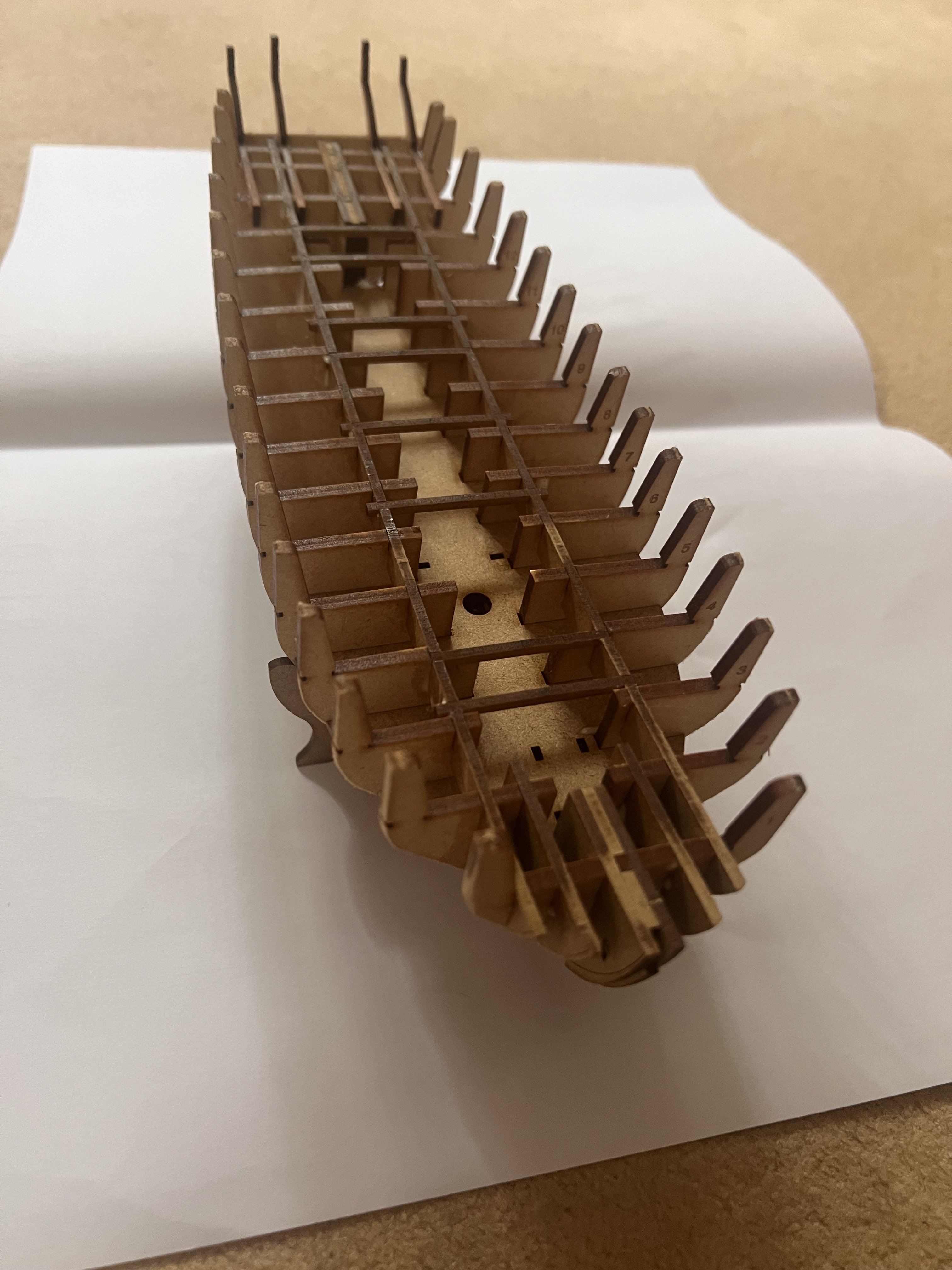

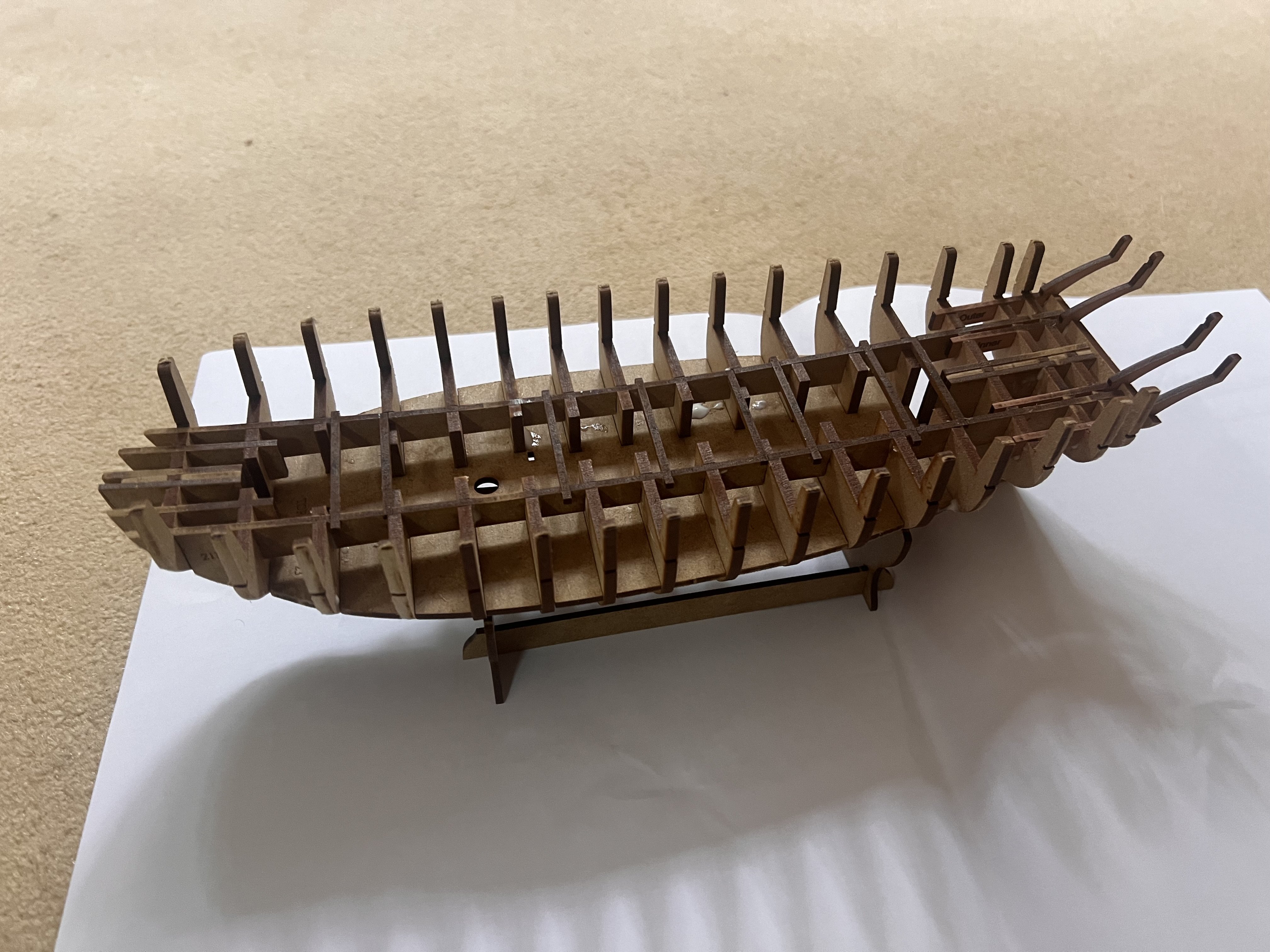

The first stages are assembling the frames which fit together precisely and create a rock solid core for planking later. These are made of MDF and easily slot together with no breakages. The four timbers at the stern are wood which is nice as they will be the only parts of this structure visible in the finished kit. IMG_6815.thumb.jpeg.e34907b11c5c100f90510cc71f5f1004.jpegIMG_6814.thumb.jpeg.d9e54d99d51d9c094a94ac017d1f75b3.jpeg

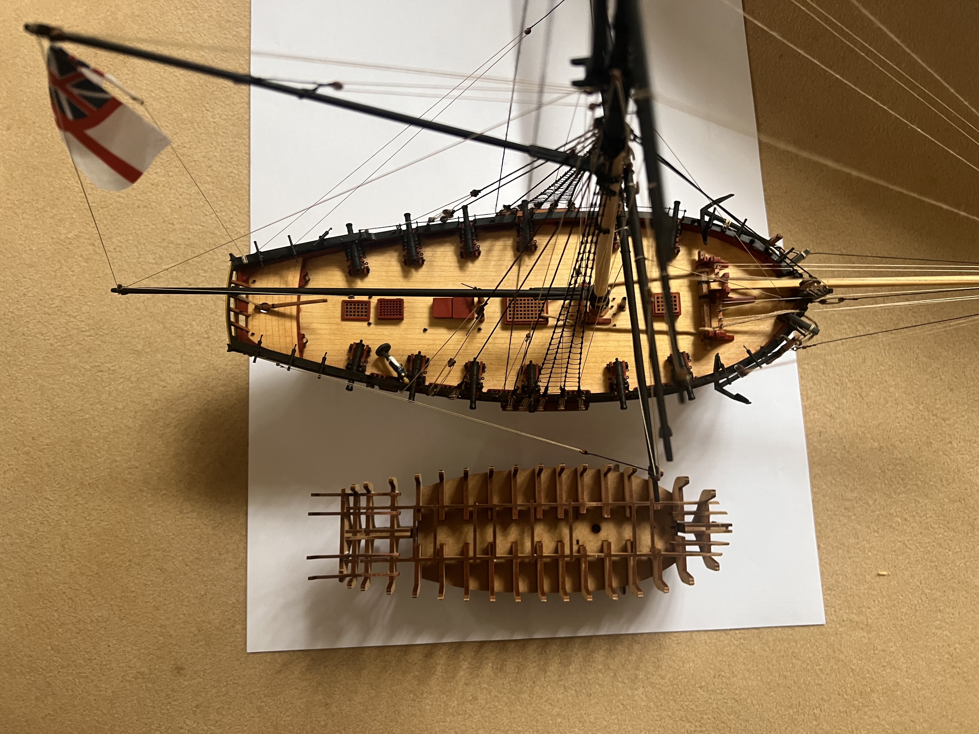

I have been describing Sherbourne as small, but I hadn’t quite realised how small she is. The behemoth next door to her is no ship of the line but merely another cutter Alert (albeit a large one). IMG_6807.thumb.jpeg.bb0155affe4469ff6d08ce4ae879d615.jpeg

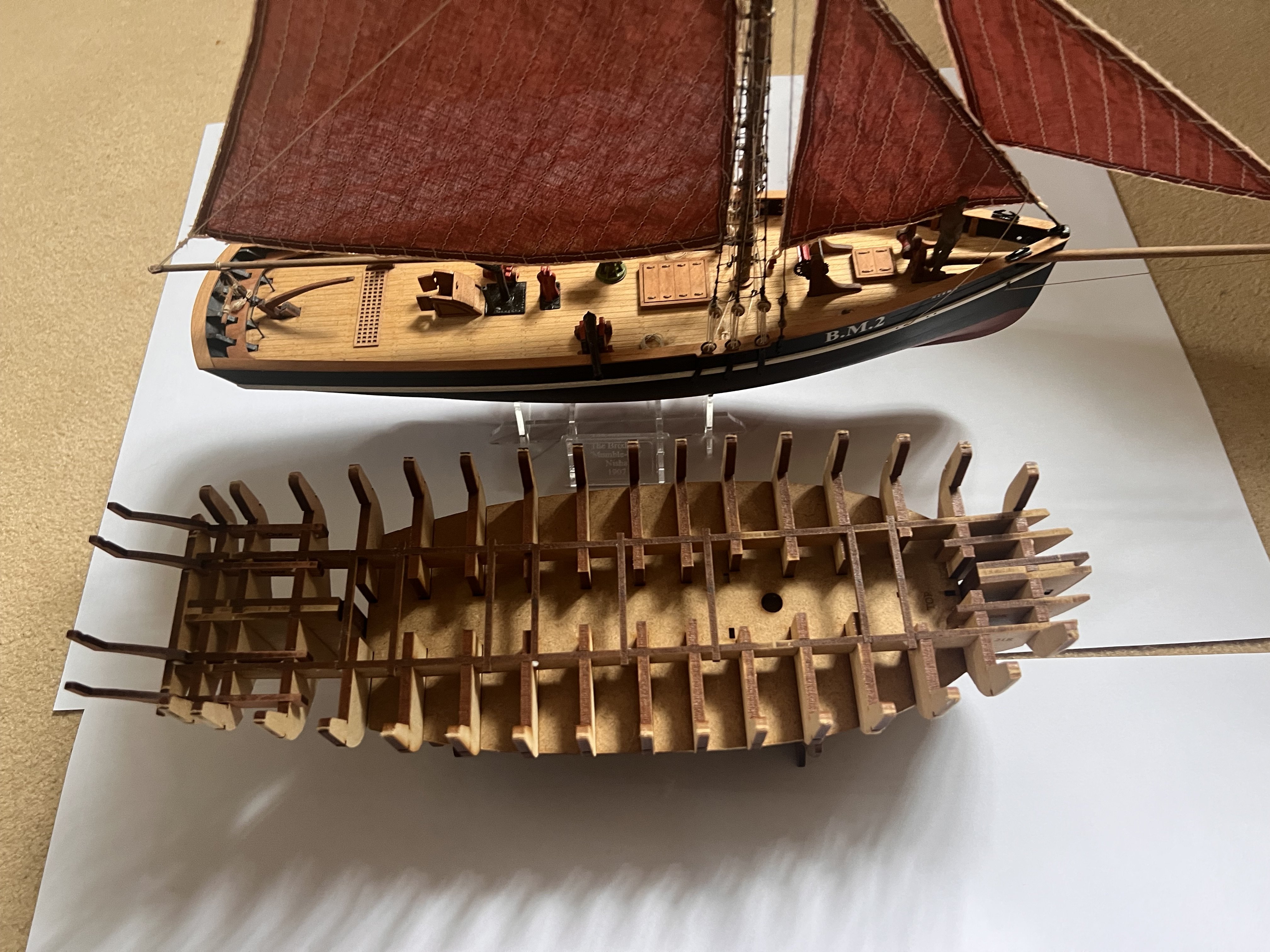

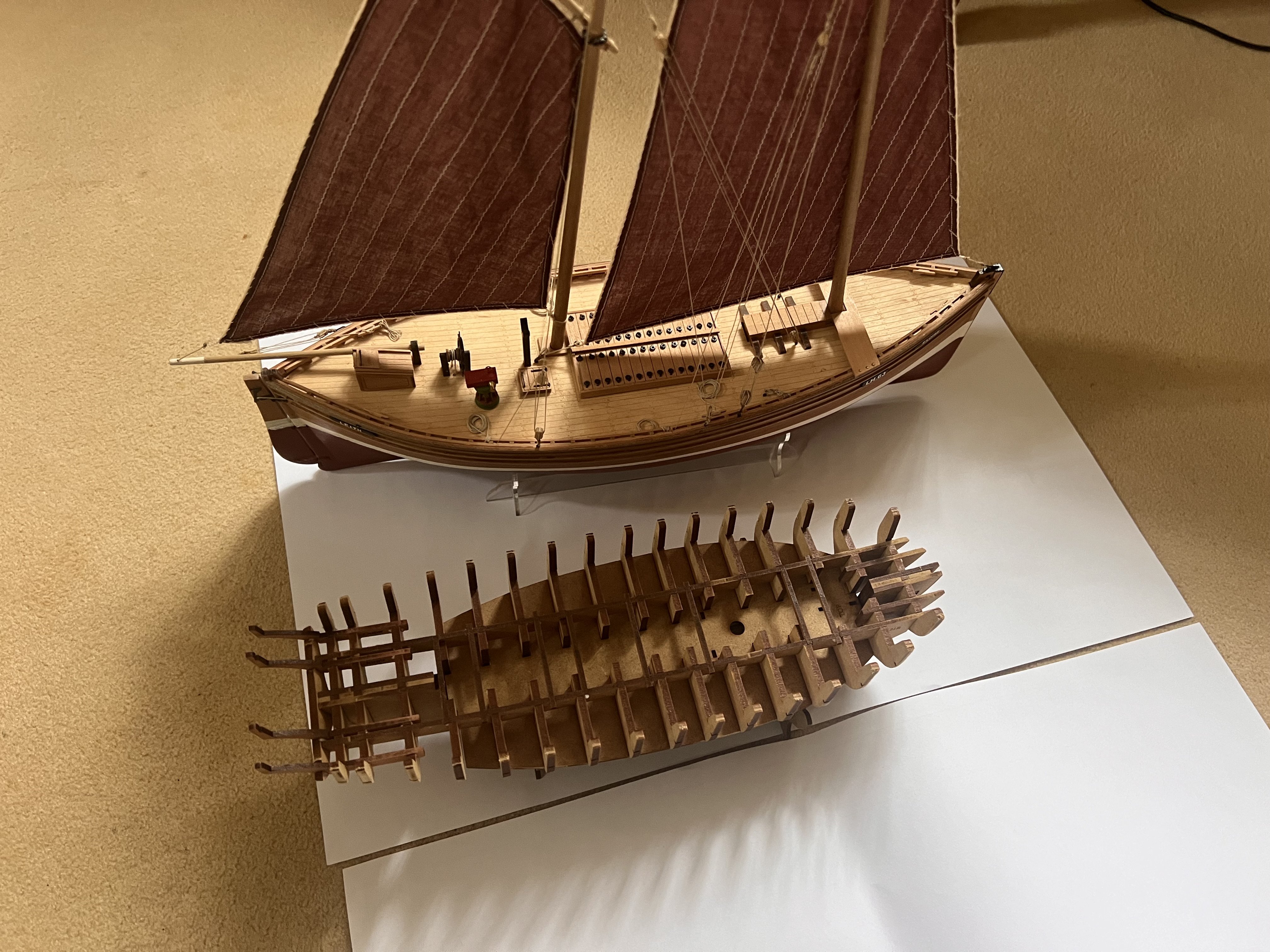

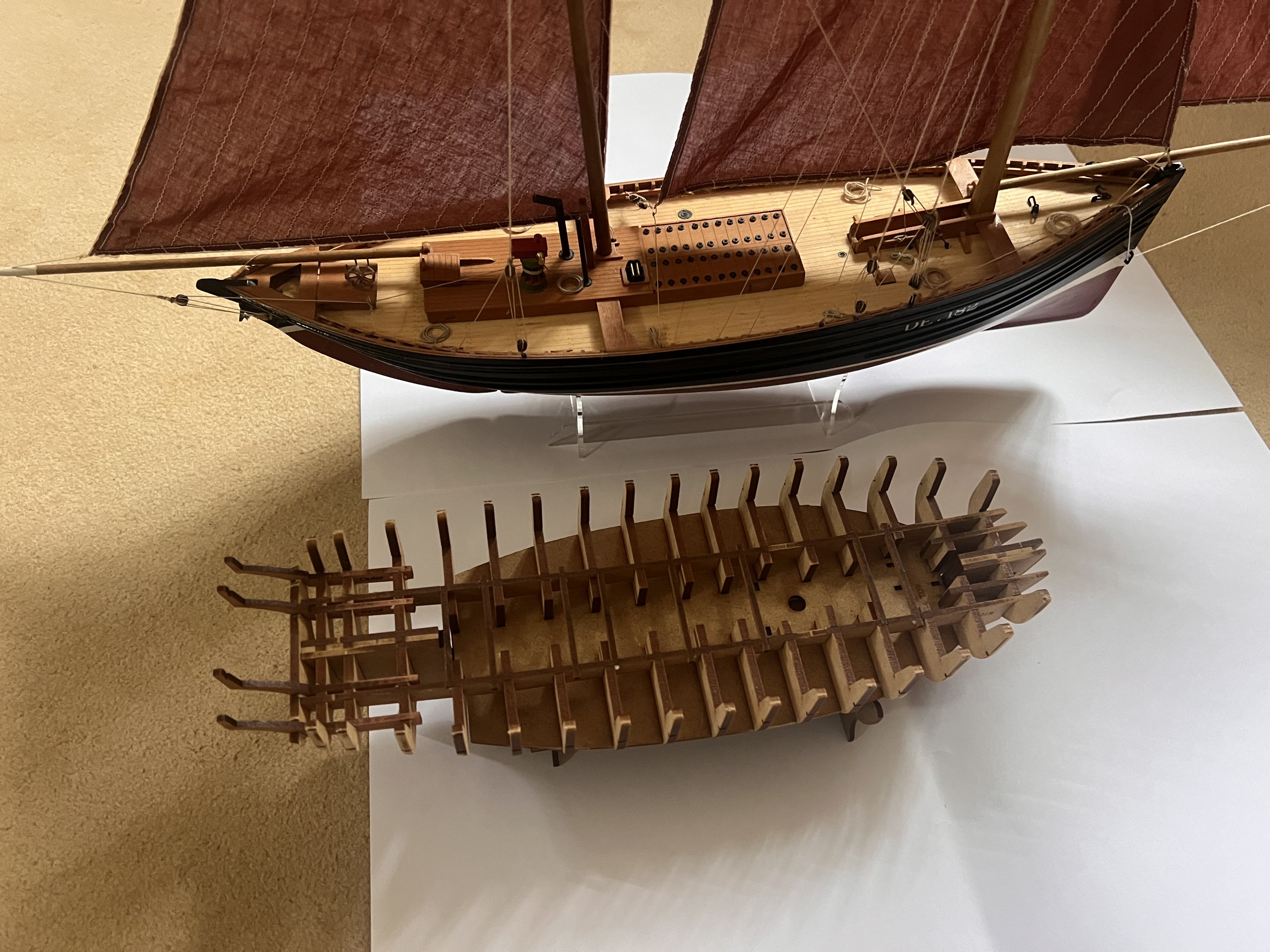

She is even dwarfed by some of the fishers:
Zulu
Fifie
Even the tiny Nisha appears to have a marginally longer, albeit less voluminous hull. IMG_6809.thumb.jpeg.648ea230f71372567f86c4e4ac4ed90c.jpeg
Size isn’t everything, she’ll be great fun to build.

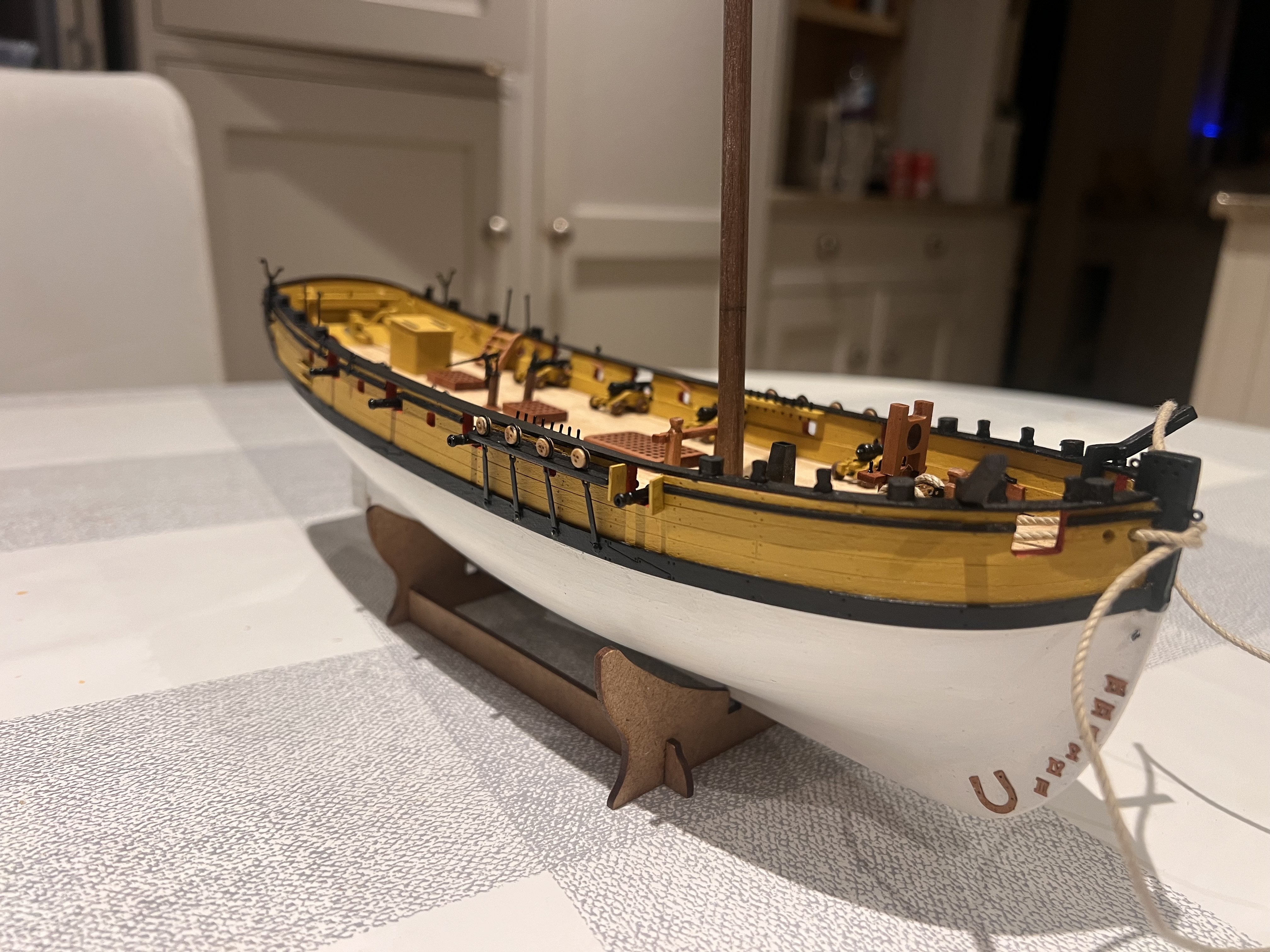

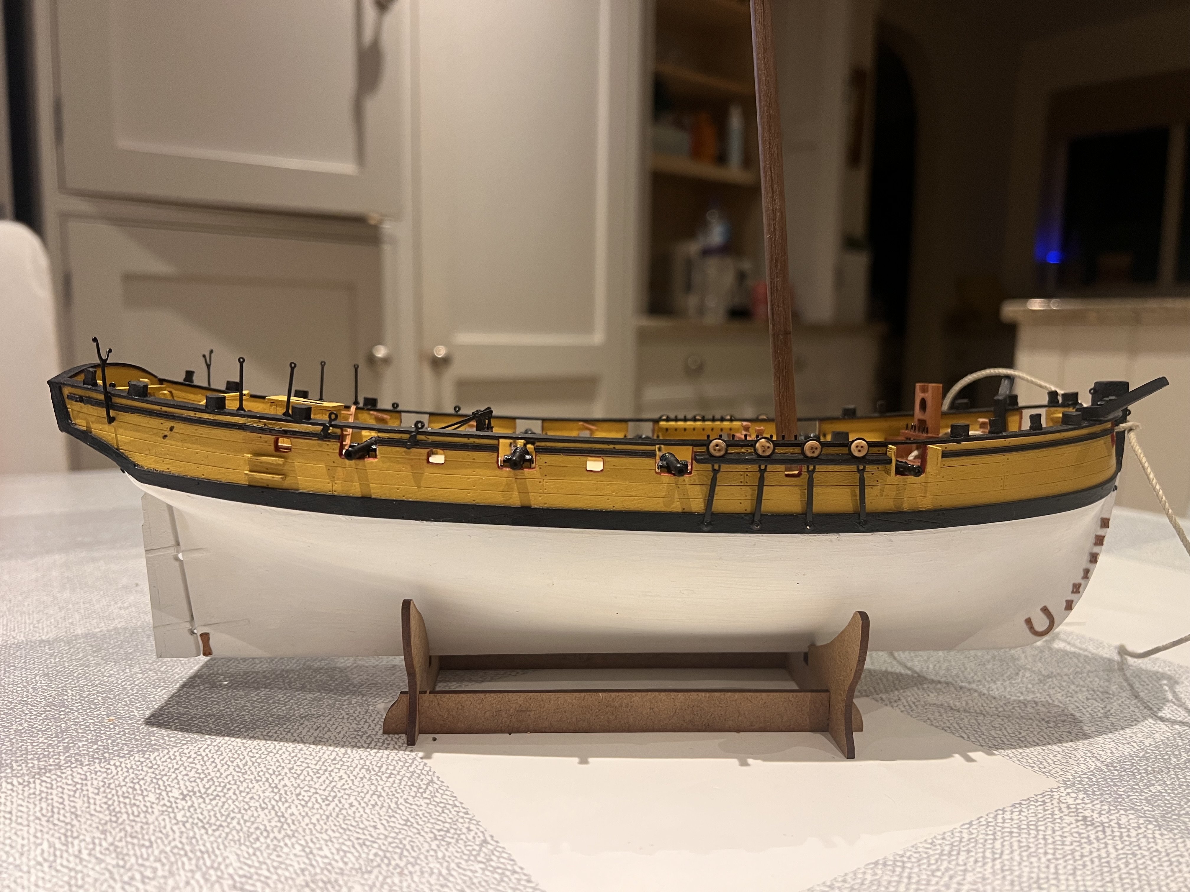

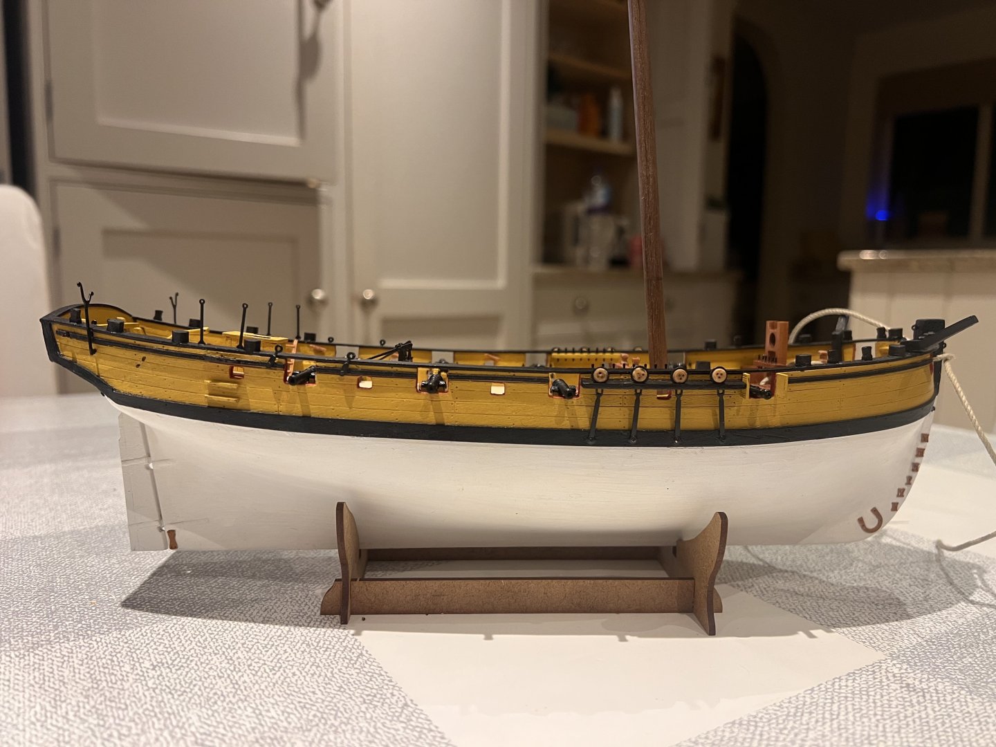

3. Mix and use wipe-on poly. You can’t easily buy wipe-on poly in the UK. I used the Blackfriars oil based polyeurethane varnish clear satin that BE recommended and mixed it with white spirit 50:50. Seems to work well. The effect on bare pear wood is almost identical to the finish I’ve achieved on other boats with Danish oil. Being a varnish I guess it seals and protects the wood better.
The latter two have been a success  - some progress photos below:
IMG_8098.thumb.jpeg.8c6ffba6b94d0f1f4fd05061893b3456.jpegIMG_8095.thumb.jpeg.3650ef44cc425d0384df7e2f757f6d23.jpegIMG_8097.thumb.jpeg.1b1de06f4acf78c584c170319db55119.jpegIMG_8100.thumb.jpeg.243fe1f45b8089b405eb0e323f1c7e09.jpegIMG_8101.thumb.jpeg.a4691ea1d3bd28bd1a1f473ac2bf22b3.jpegIMG_8104.thumb.jpeg.f0cefd434319ff97e0bde69c373f9aca.jpeg
There’s still work to be done to the hull before starting the rigging. I’m not going to put any ropes on the cannons on this build. I forgot to do so before fitting the ring bolts to the bulwarks and they’re so small on this build that I’m not going to try and add them later.

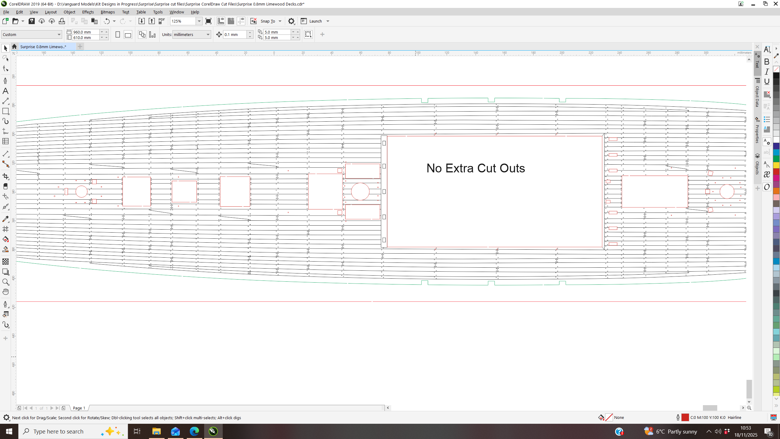

I really like the Vanguard engraved decks. I’m less keen when they’re cut away to show the interior as they are on Sphinx and Surprise. The cutaway deck works really well on Harpy as it makes the model much more interesting, but in my opinion detracts from the small frigates. It’s entirely a personal preference but I’d prefer they weren’t cut away as standard. I’d like to have had the option to fully deck Surprise myself so I can choose whether to have the cutaway engraved deck or not. I may have another go with deck planking on my next build (Speedy).
This is always the issue, I cannot please 100% of the people 100% of the time.
However, after reading this, I have done a modified Surprise upper deck with NO cut outs (apart from the required ones for hatches). So if anyone orders a Surprise, let me know if they want a deck with no extra cutouts to show the beams. So for my next kit, at least, the option is there - you will just need to ask. :)
One option is just to buy some extra strips and plank the deck yourself. It will look better and then you can control the amount of planking you want to do.
You are spoiling us Chris, most (if not all other manufacturers) would say "like it or lump it!" :imNotWorthy:
If the customer is happy, then I am happy! Doing alternatives like this is possible because I produce all my own stuff, rather than sub contracting to some Chinese company. So if I feel I have the time and it can be done, I shall endeavour to do it - like personalised nameplates for pre orders on some past kits.

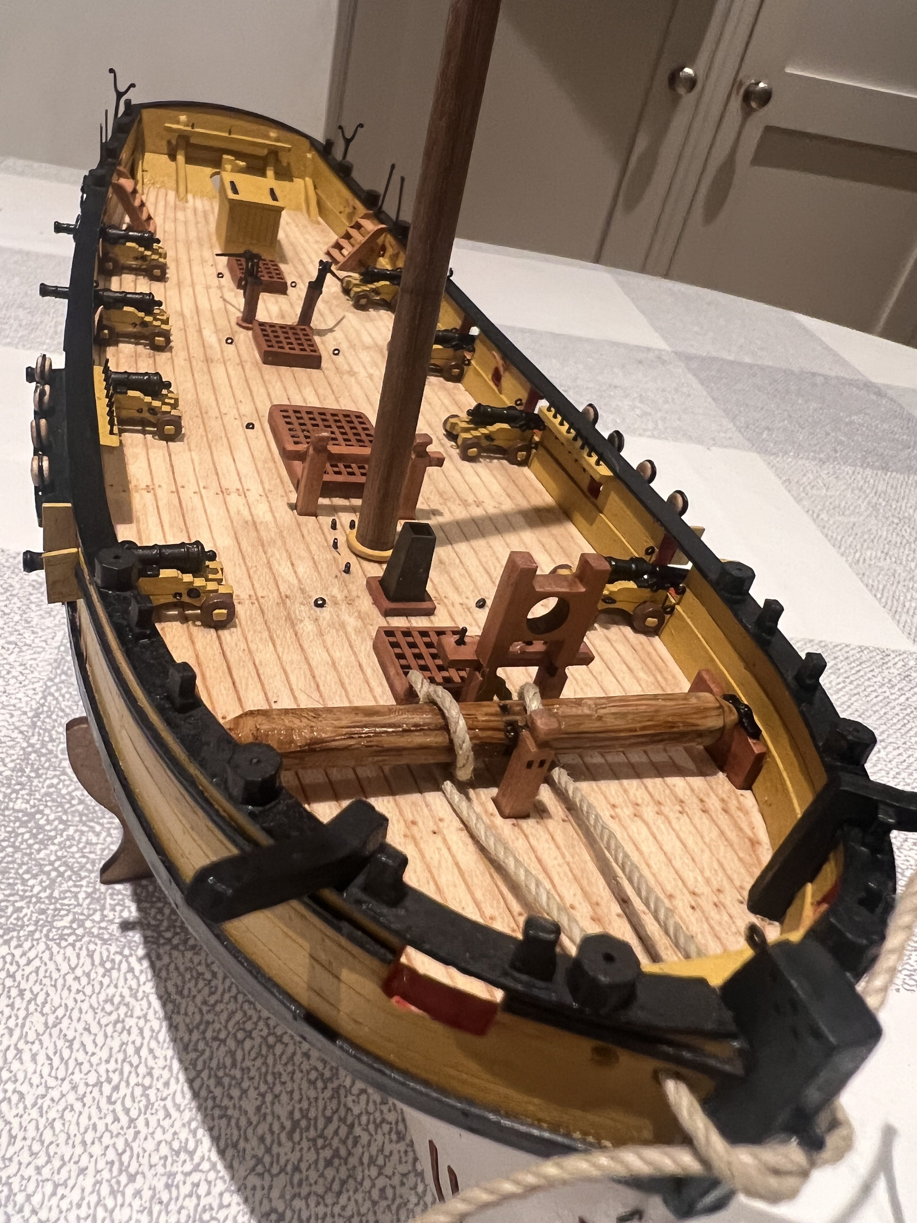

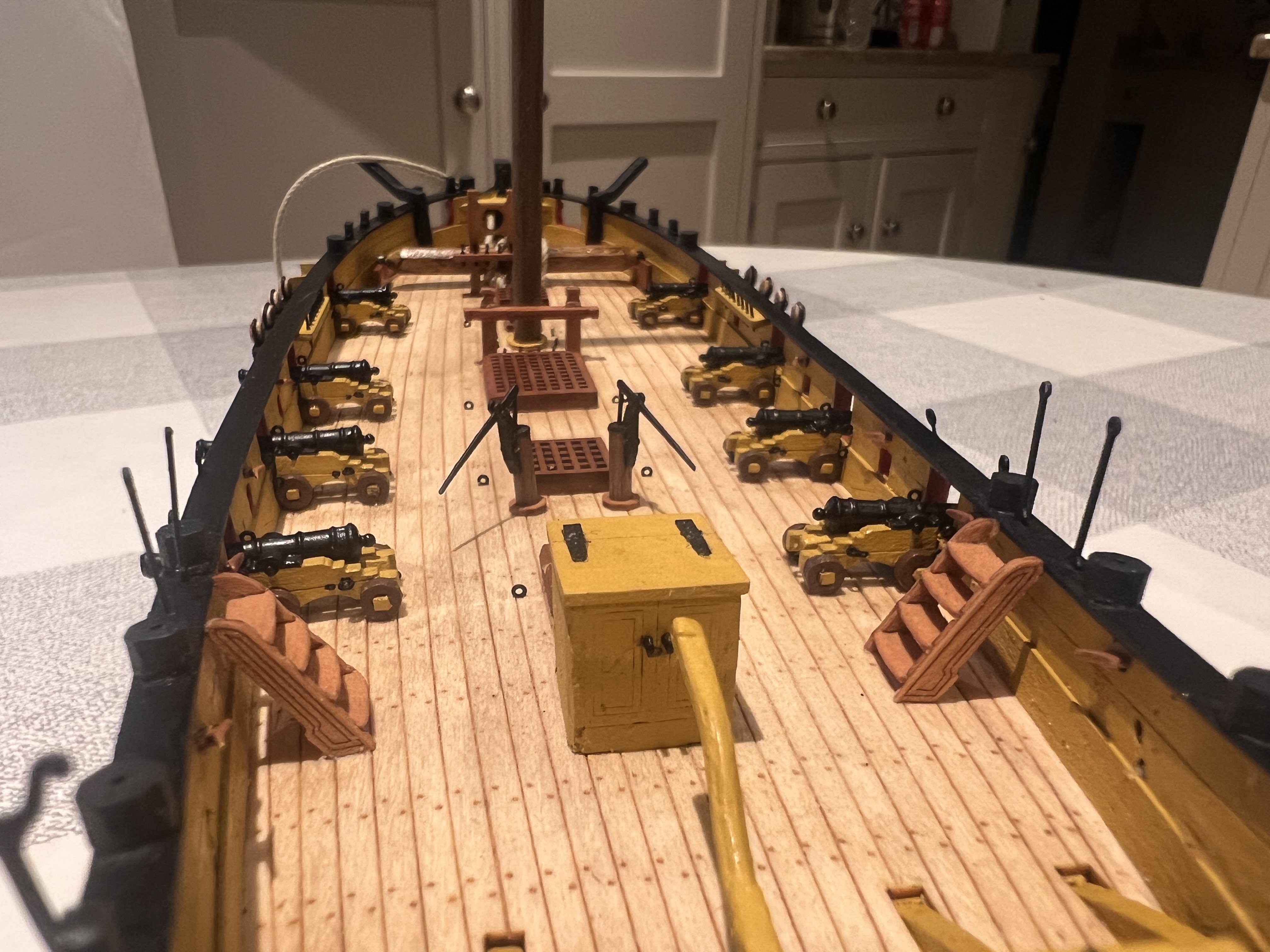

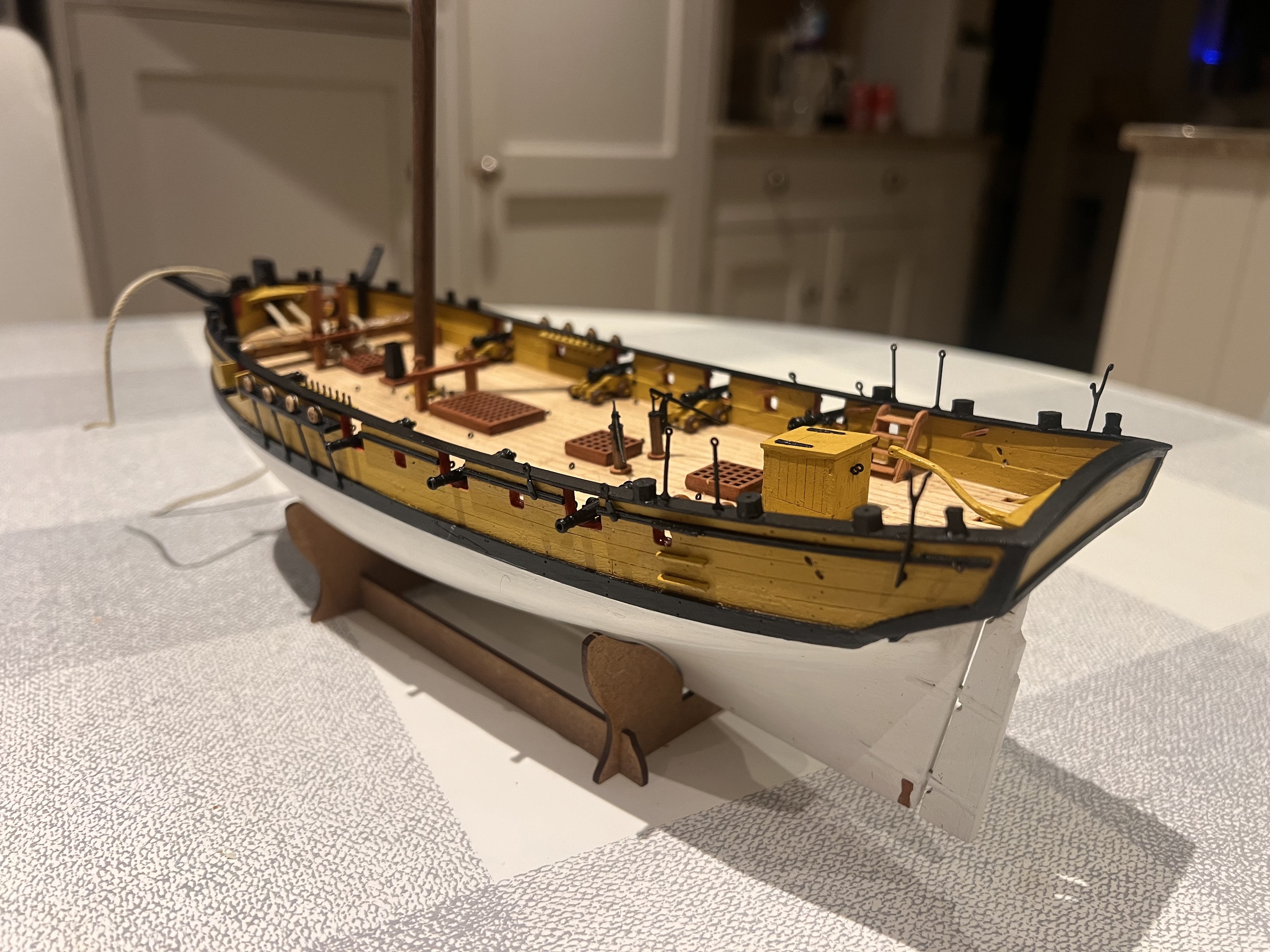

Hull now fitted out except for anchors and swivel guns that will be in the way of rigging. Pretty little boat. I like the yellow ochre, makes a nice change.
