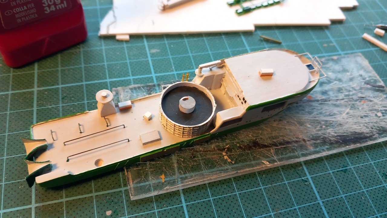

I've now come into a detailing phase, lots of work and little to show for it.
Prepared a lot of items for primer and final white coats. Cranes are nearly finished, the control cabins are also sprayed, but I still need to add the windows before mounting them on the cranes. They will also get fly tying thread wires.
As you can see, the cable lay installation is started. A lot items are left out.

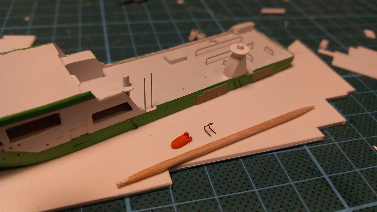

below you see the stern chutes (shoots?) in progress. They are probably the most fiddly parts I ever built. Mostly built up of 0.3mm styrene sheet and just 1 single straight edge on the whole thing....
In between I'm doing some "quick" items like davits and the large yellow boarding ladder (called a "surfer" to transfer people from small craft at sea). On other ships its either near the stern (bad when the vessel is pitching) or permenantly on the side (annoying when mooring since it requires decent fenders and often interferes with shore fenders). So here they seem to only hang it over the side when they use it.
The helicopter deck is also cut and primed.
The reason it's all still dry fitted is that I'll need to repaint the deck in a slightly darker shade of grey (as well as the bridge top, chutes etc.)

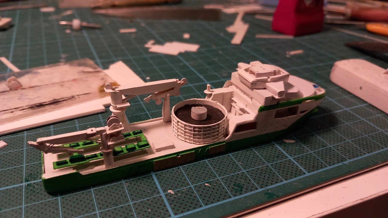

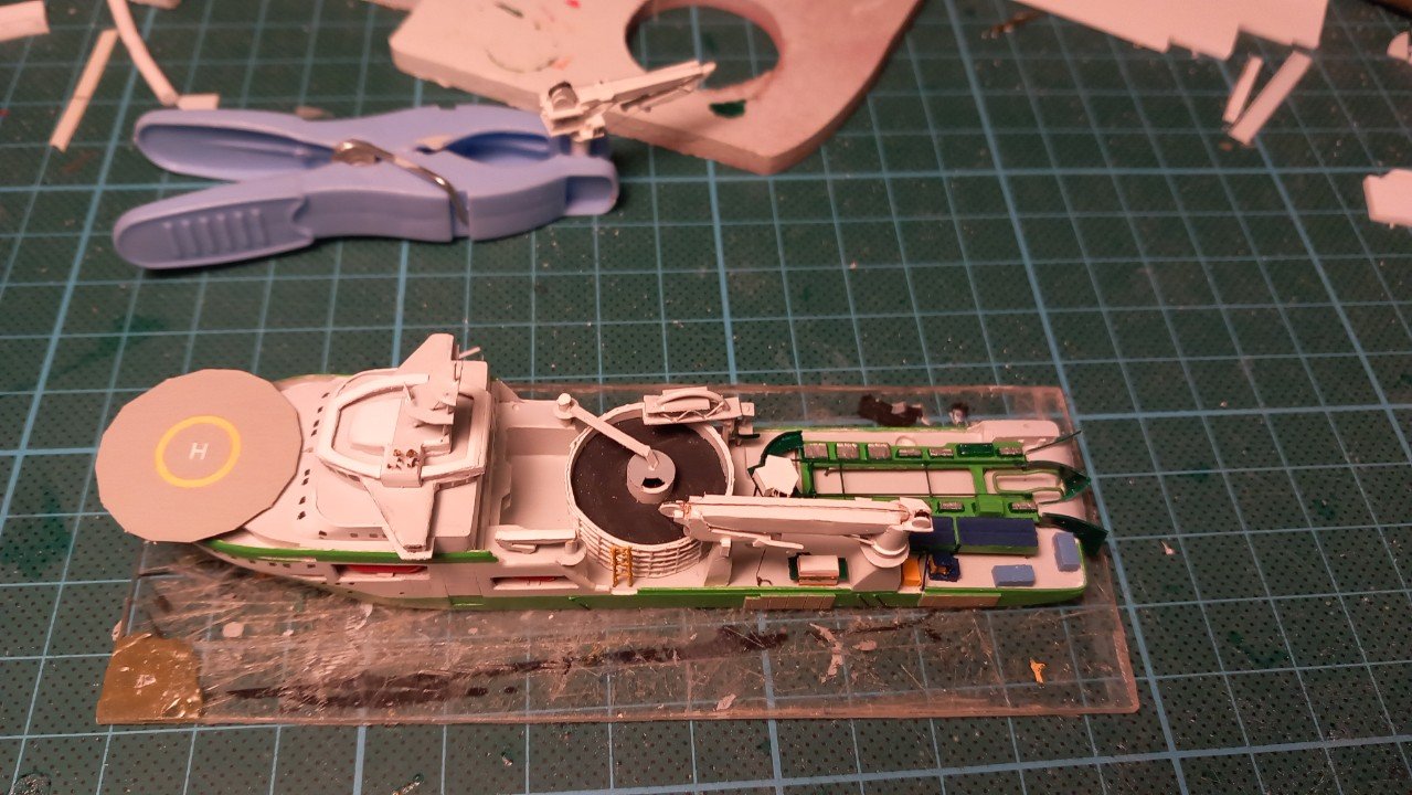

Thanks, moving forward. Finished that darker grey deck colour and continued with the helo deck and its supports.
In the meanwhile also started the challenge of that fancy mast structure. Doesn't look too good for now, but next attempt will be better. It's mostly the middle platform that causes issues. (still a template for now)
And the cable lay system is advancing as well. I will be able to start installing a lot of parts now since the grey paint is on.

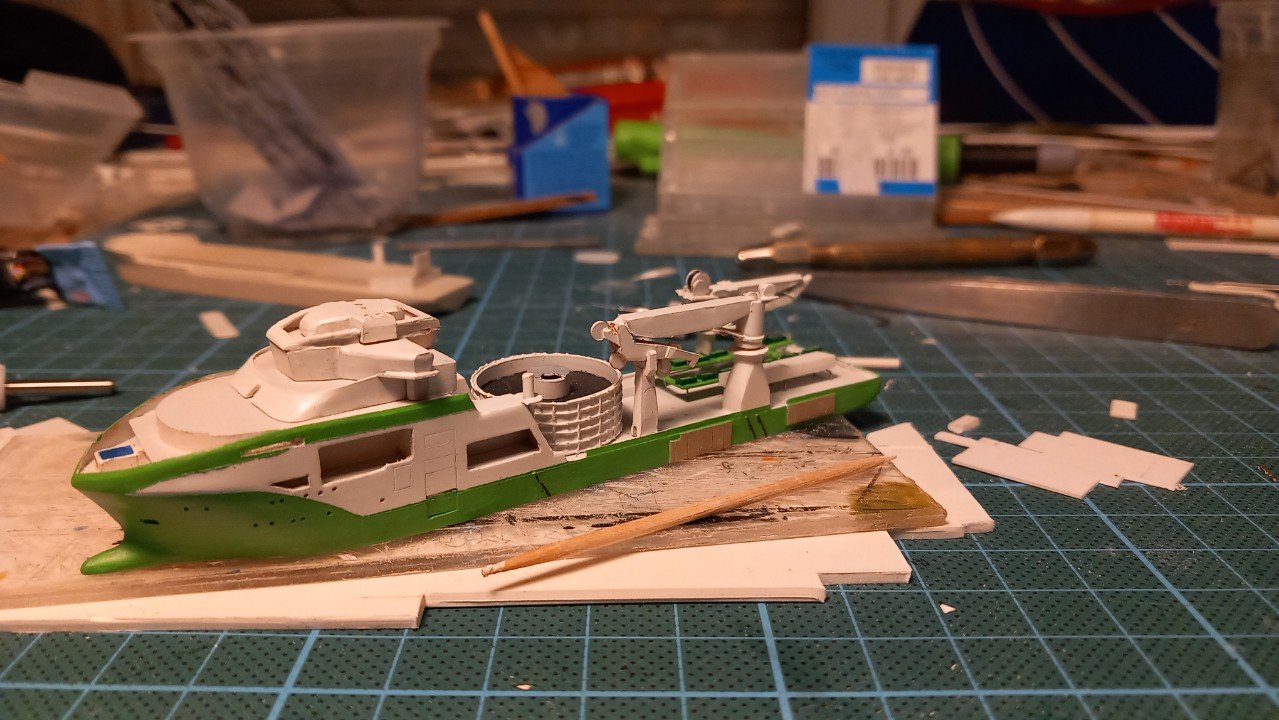

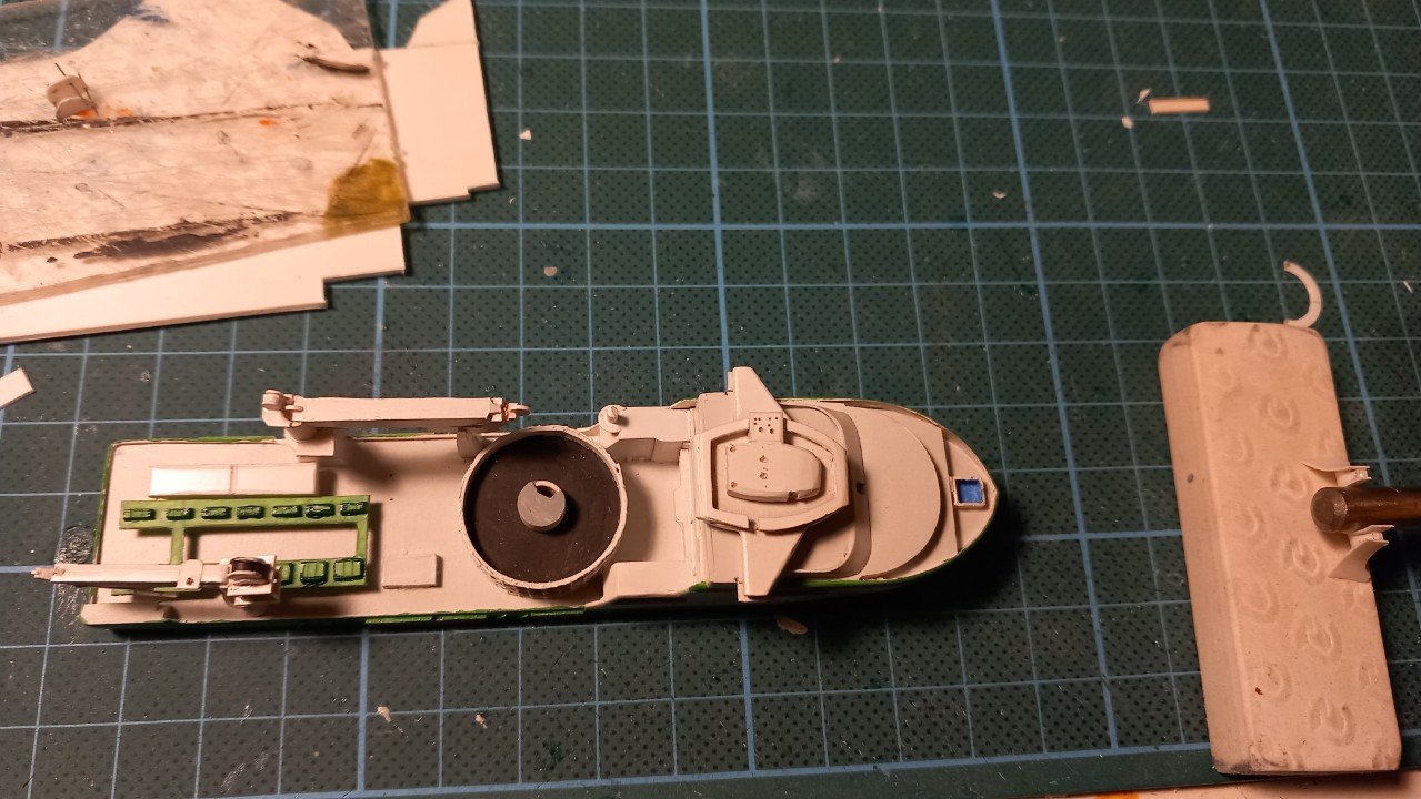

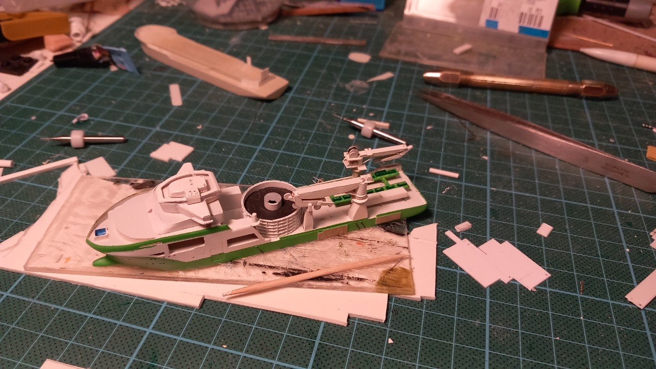

And finally finished handling and turning over that hull, so time to continue building up now.
A bit to small to use a piece of railway track, so I'm using other relatively heave and stable objects.

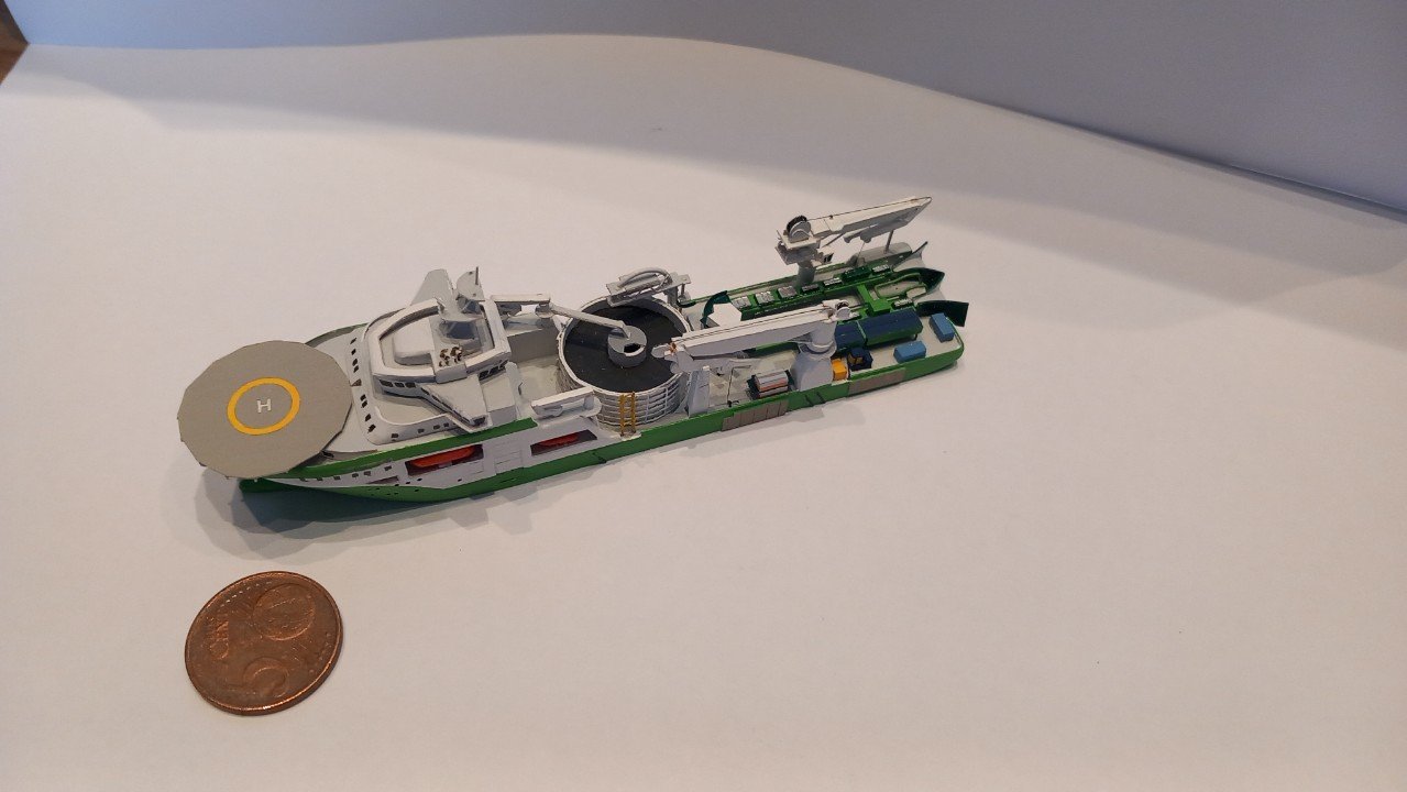

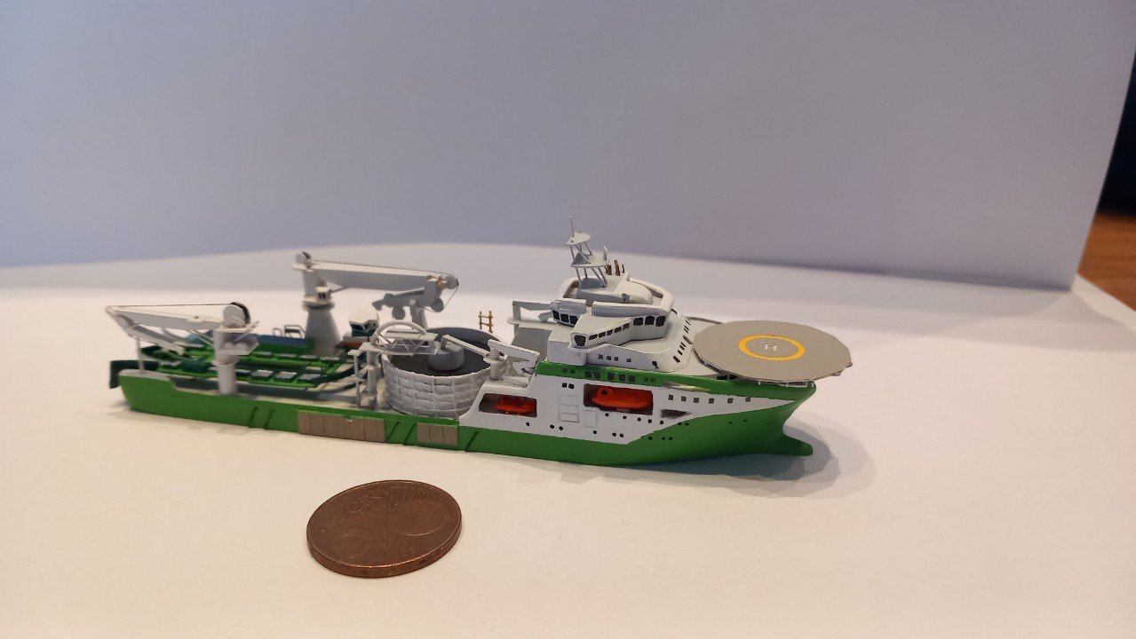

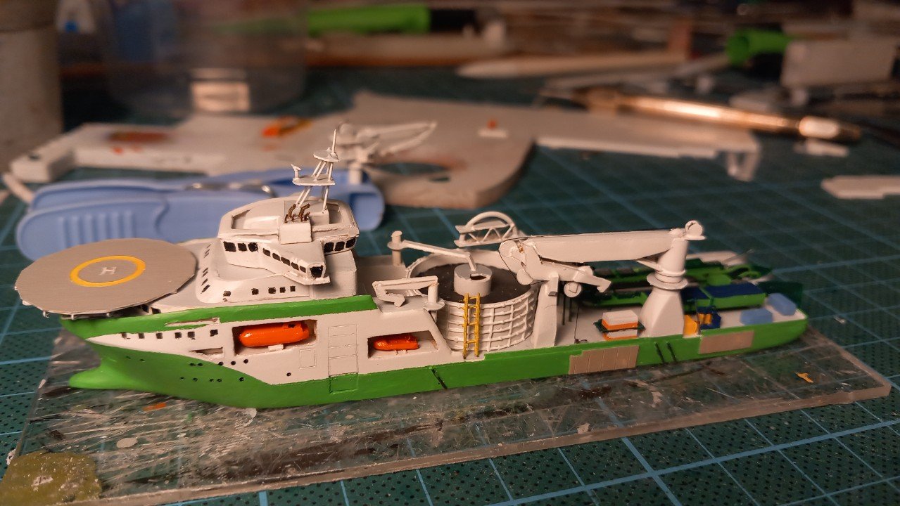

Assembling a lot of parts now. This way it becomes obvious which parts I forgot to build 🤫
The crane is rigged with fly tying thread and the end is fixed to a tiny piece of copper wire inserted in the deck. They lash the real hook on deck as well to avoid swinging during sailing.
The boats were glued to the davits to enable insertion in the recesses.

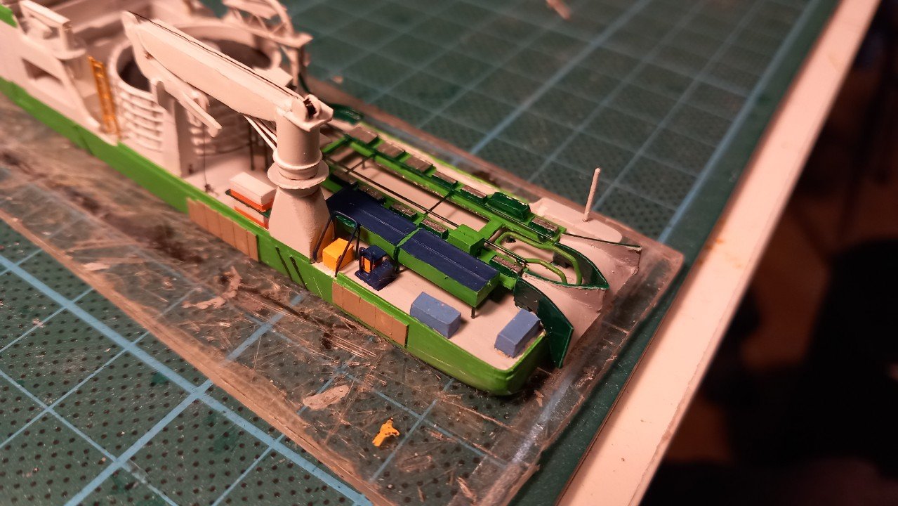

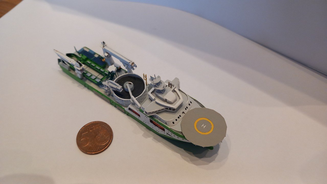

Helo deck has its markings. I used my stencil cutter with vinyl to make the mask for the first time. Although the vinyl sticks a little too strong to my liking it did not have any bleeding nor did it tear out any paint underneath.

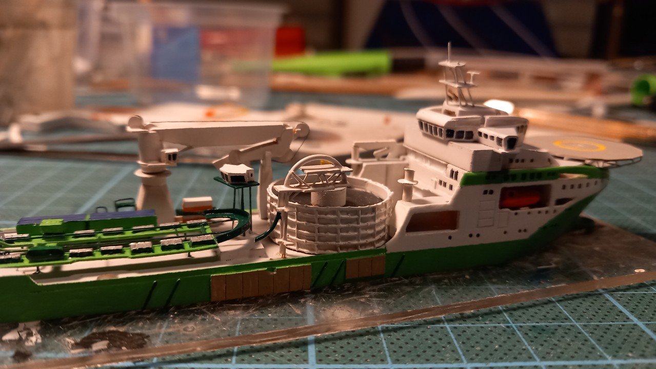

Working on the ROV area as well as some details on starboard, the main item being a large curved loading arm for the carousel. I thought to leave it out (no idea why really), but it's a really visible item.

The item I sort of ignored is what I assume a loading tower for the carousel. I assume the cable comes in from deck (dark green bend near the deck) and pulled up over that loading bend over the edge of the carousel. Not sure if that tower can rotate inward and outward to follow the cable or not.
Here's a shot of the ROV area.
And with the first rescue boat in place.

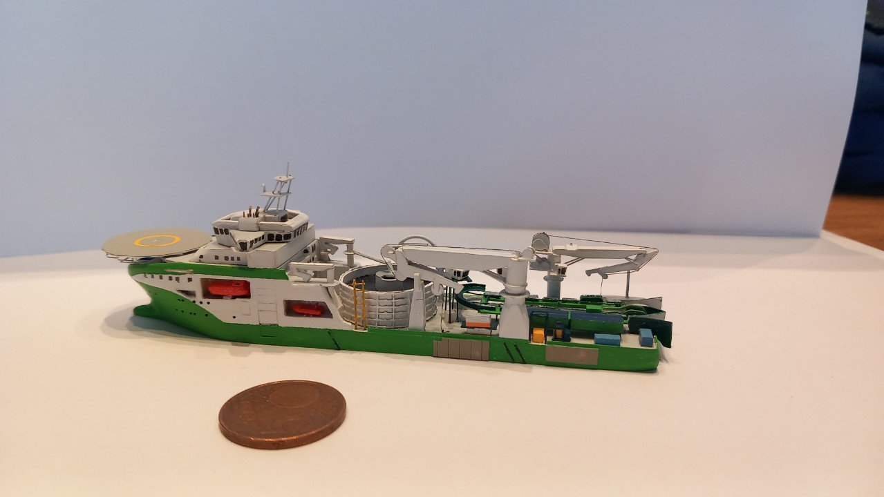

The auxiliary crane is being rigged and then it's time to round this one up.
Roel
 She's a little beauty, hats off, Roel.
 Congratulations, Roel. For one who works in small scale I'm gobsmacked by the amount of clean detail you've achieved, really phenomenal.
Amazing build Roel. She is a little gem.

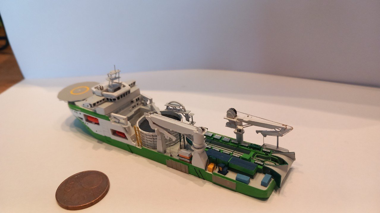

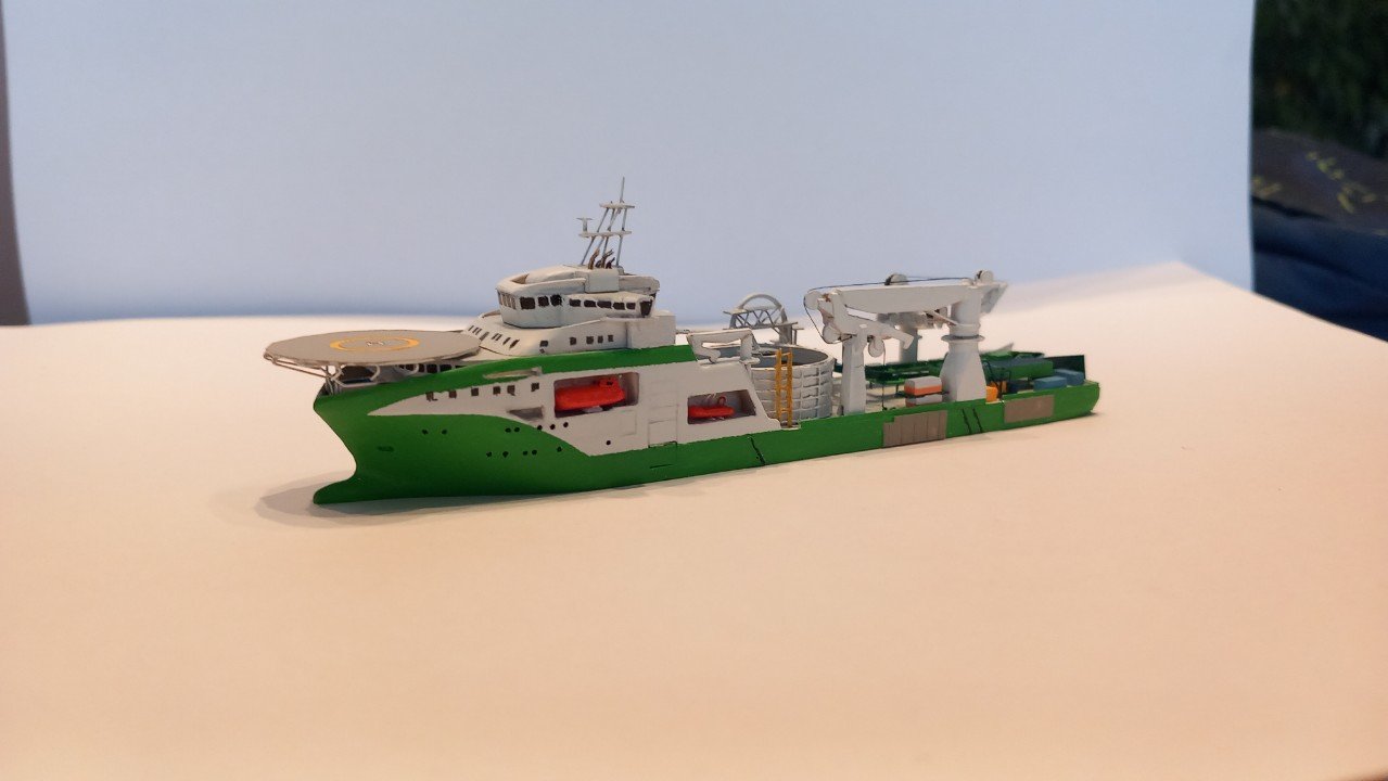

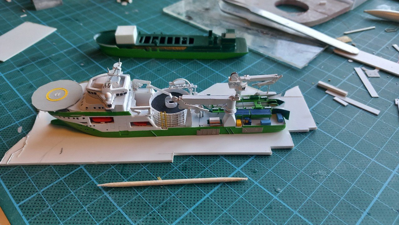

Thanks for the comments and likes.

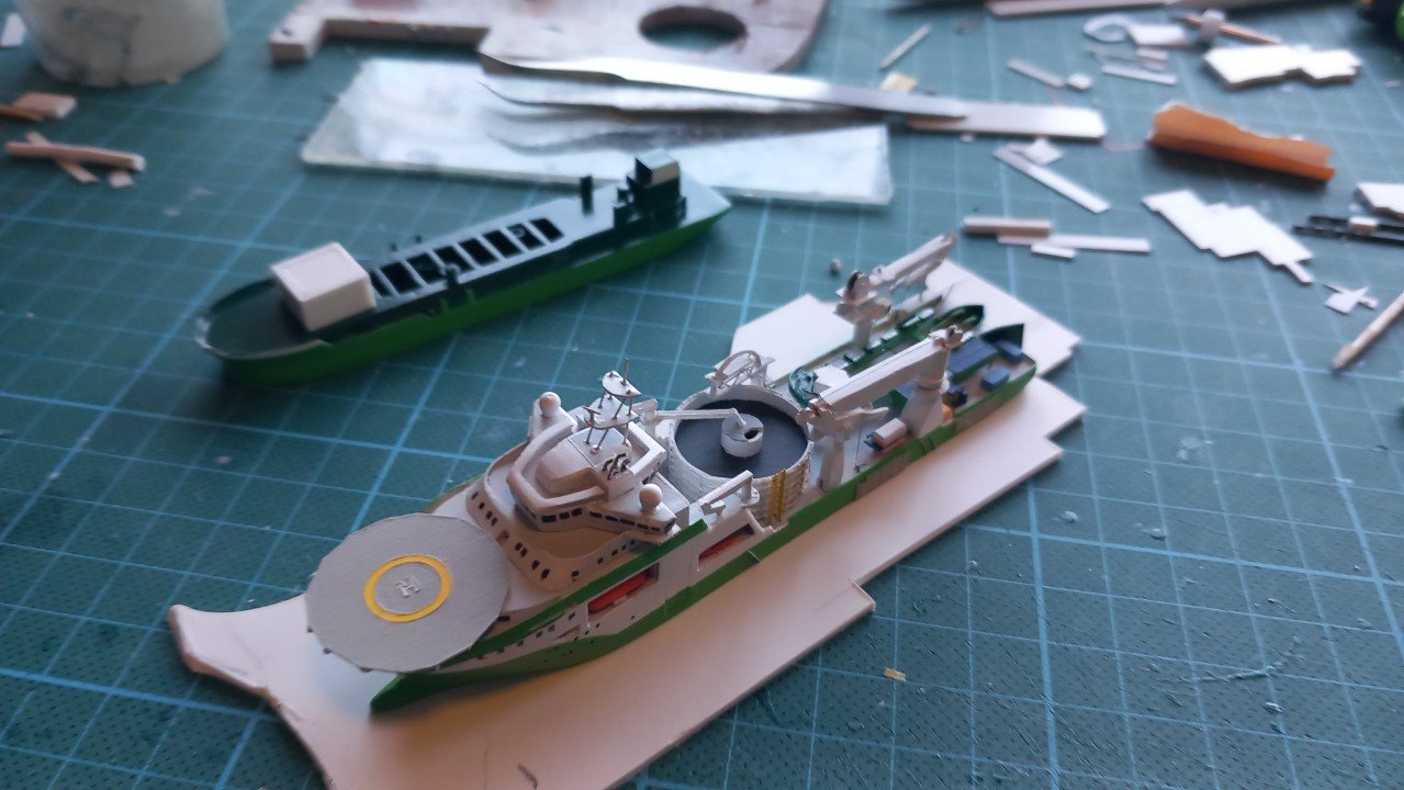

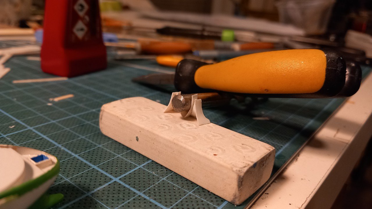

In all my haste to call this one finished, I actually forgot about the 2 large communication domes on either side of the bridge.
I've made them from 3mm styrene rod inside my Proxxon and filed them to shape.

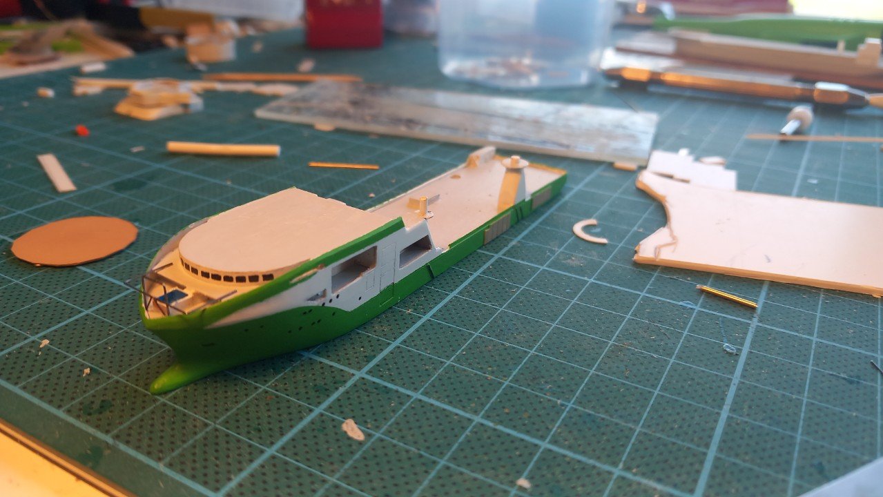

As you can see, the second ship is also taking shape.
@Glen McGuire, the only reason this build went do fast, was my preparation. I have been preparing a 1/100 scale RC build of this ship, which means I was familiar (and thought of solutions) with most of the issues I'd encounter by that integrated accomodation. Also having built a very similar cable layer in the past has helped to detail that installation with precious little info available.
Although I have built a Trailing Suction Hopper Dredger before, I believe that Lange Wapper model may be more challenging. I've never been onboard of it and the dark green deck colour makes details on deck very difficult to see in pictures.
