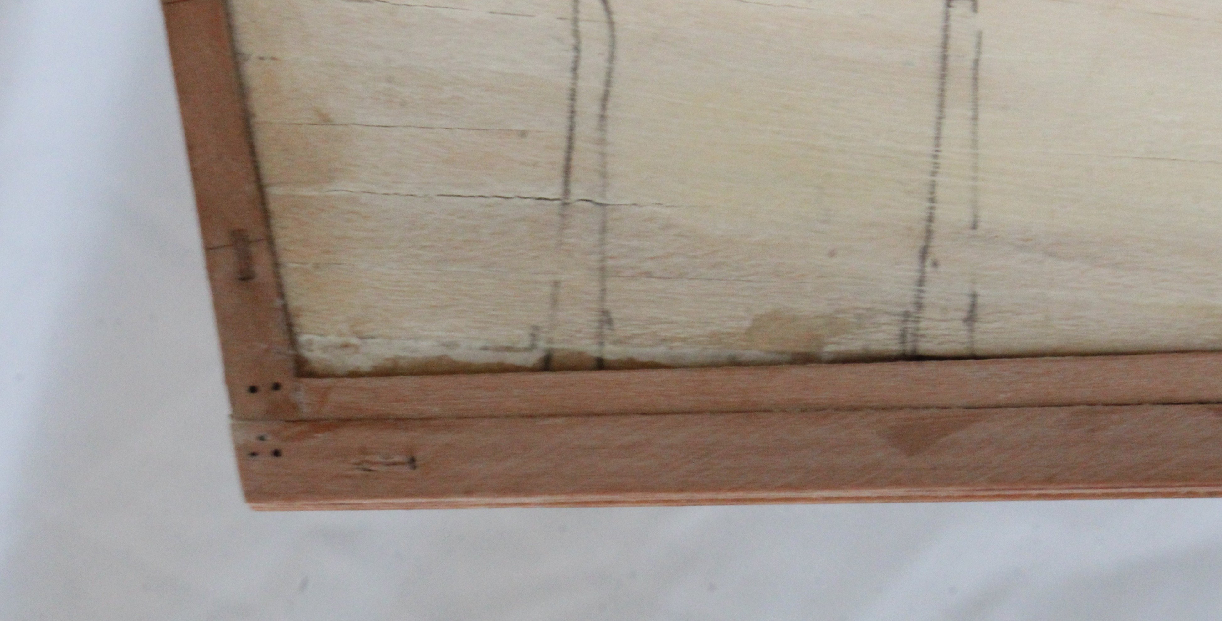

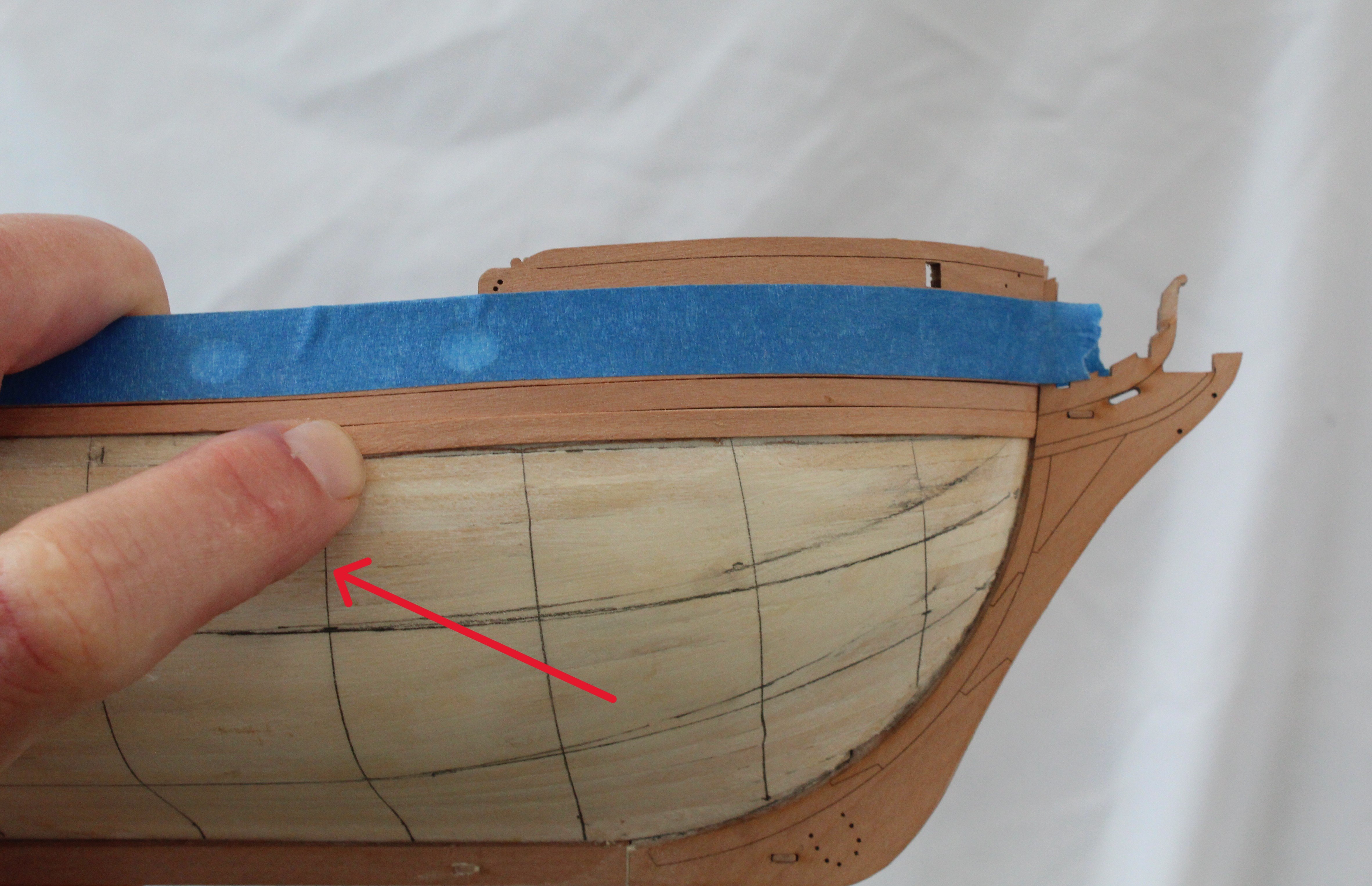

Task 32 – Adding the first plank

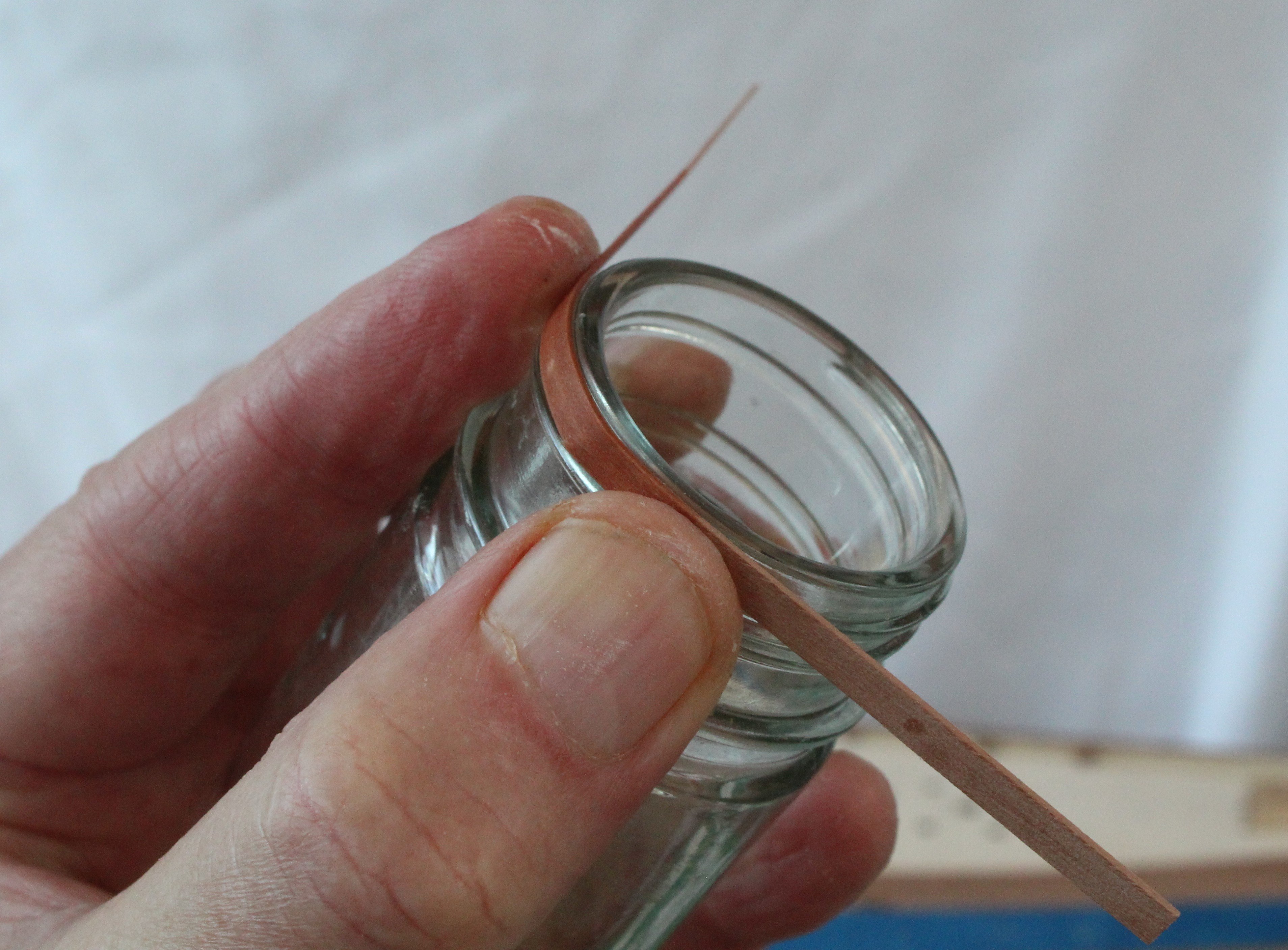

After selecting the first plank it is test fitted in the rabbet and a line is drawn so it follows the curve of the stem post.
Following the information provided by @Chuck lateral bending method I set about working out the central point of the U-shaped bend. The plank brushed with water and clamped. A hairdryer was then used to apply heat.
The first planking layer (right and left sides) was then glued to the hull.

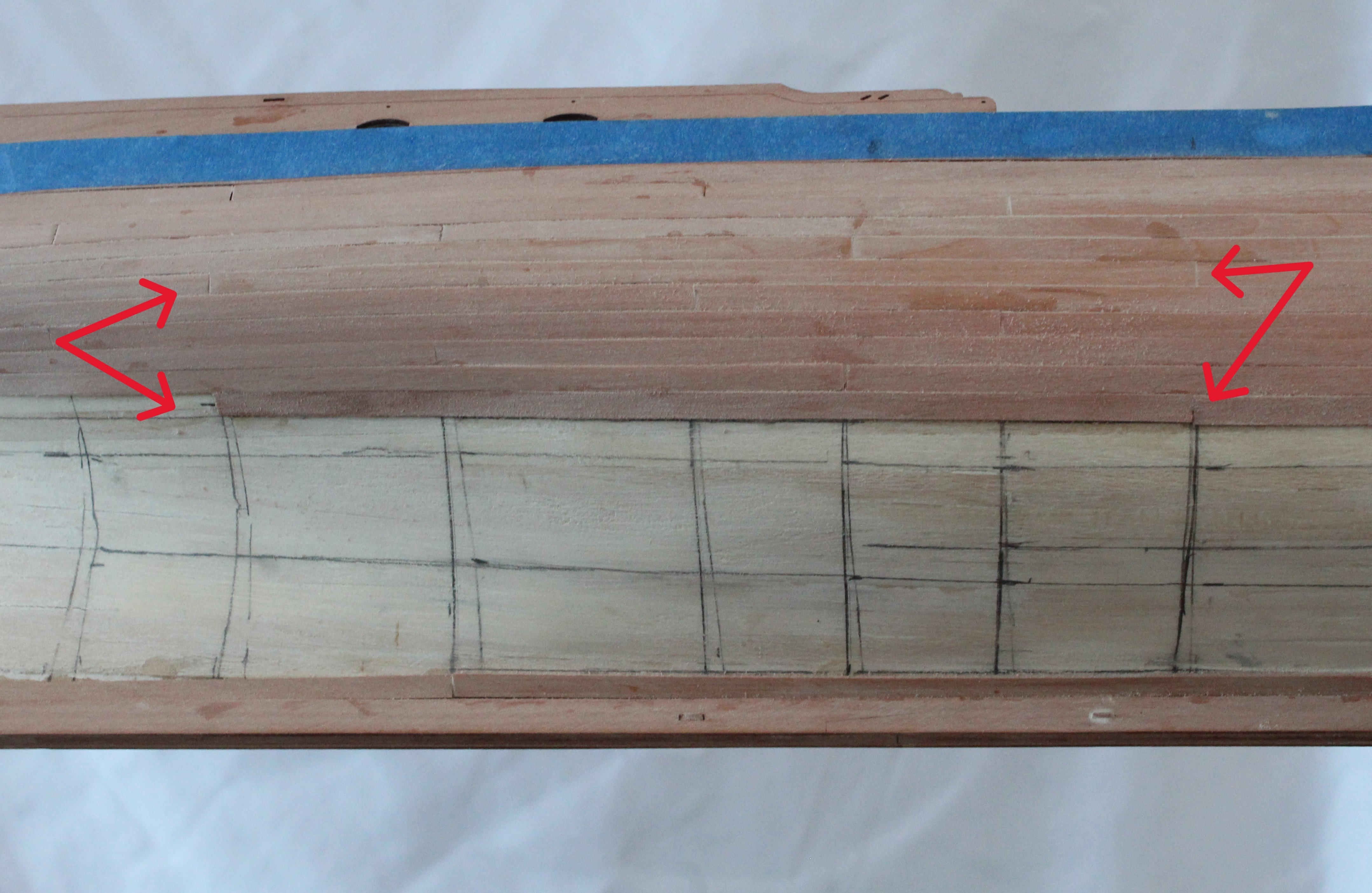

It was then a case of cutting planks to the required lengths for the 4-butt shift pattern and gluing them to the hull.

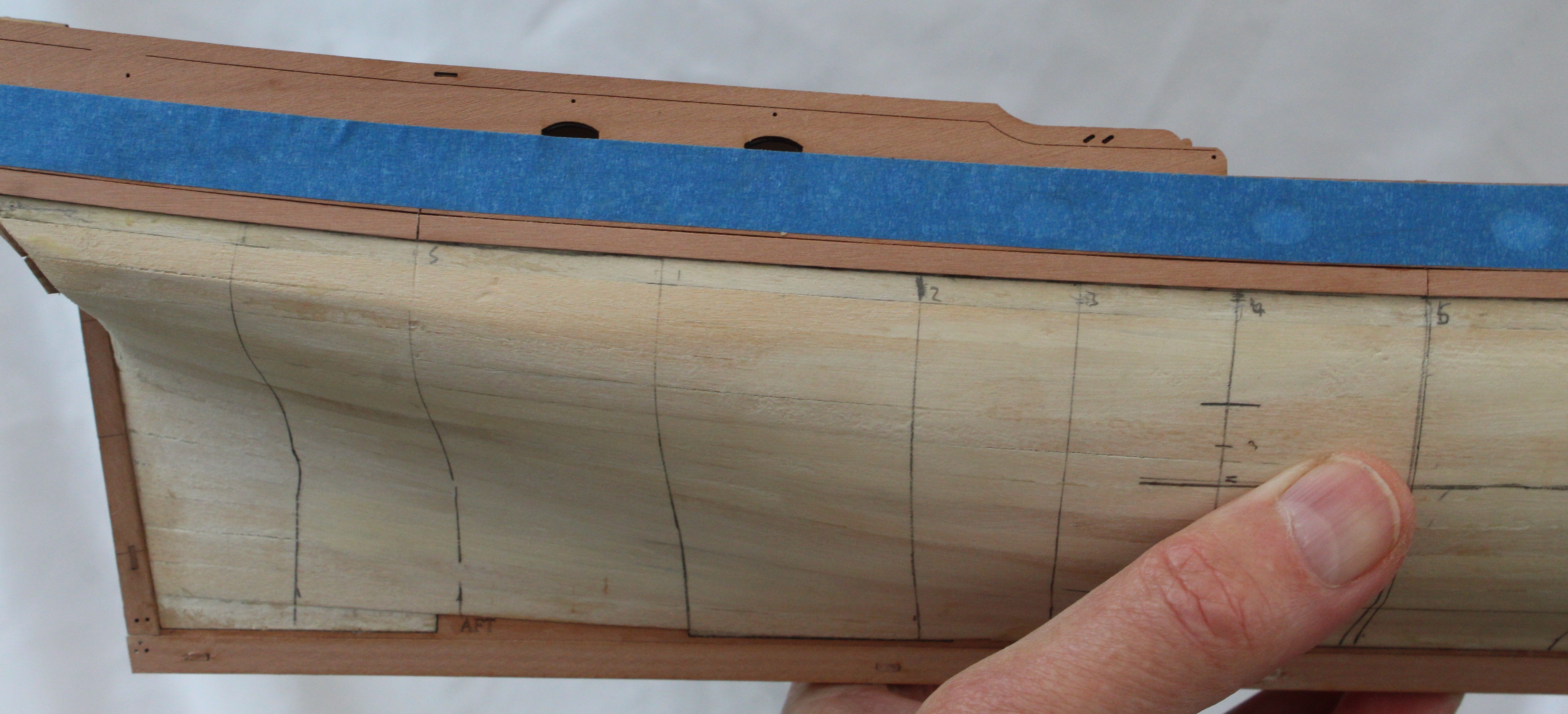

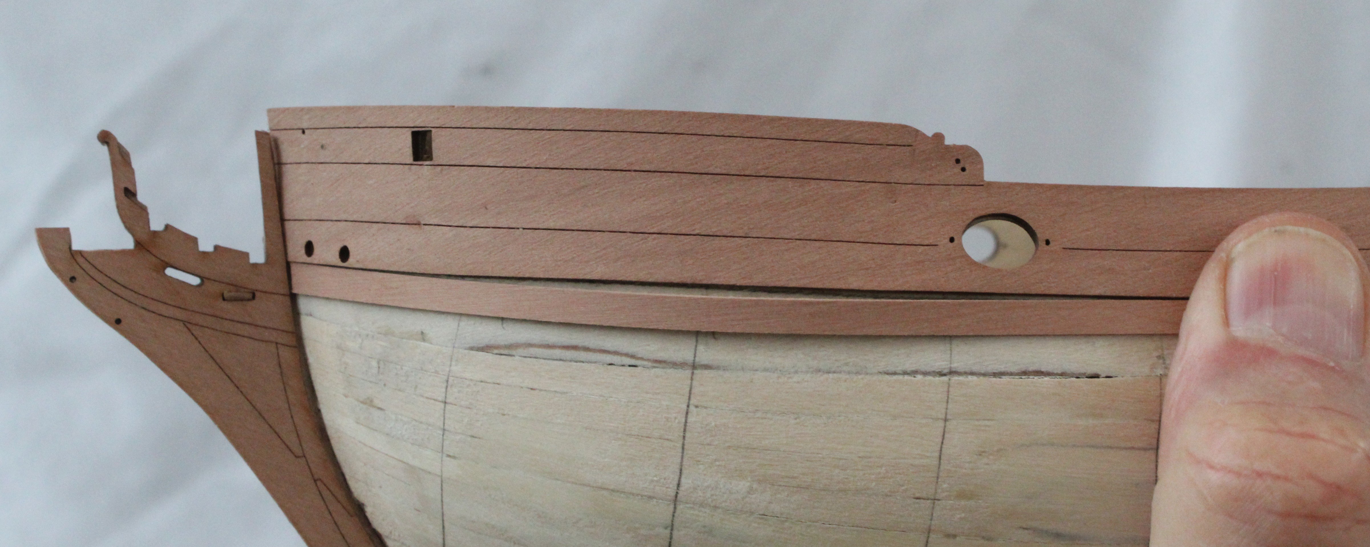

Task 34 – Garboard Plank
Noting that 24 planks / side would be required, and as 3 planks had already been fitted below the bulwark I thought it would make sense to add the garboard plank which would then leave 20 planks to fill the gap. This would make it easy to split this area into 4 planking bands, width 5 planks per band.
I took my time to get the required shape around both the the stem and stern post. I also worked out the required plank start positions for the 4-butt shift pattern, based on pattern created by first three planks.

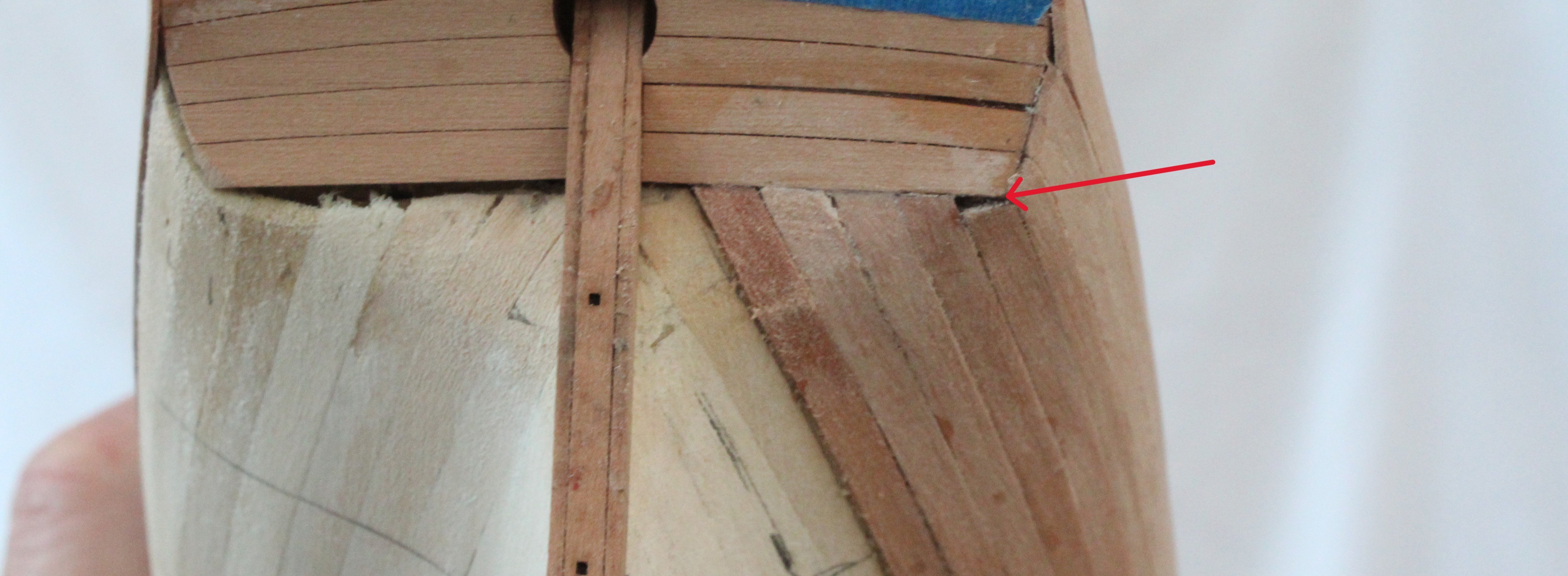

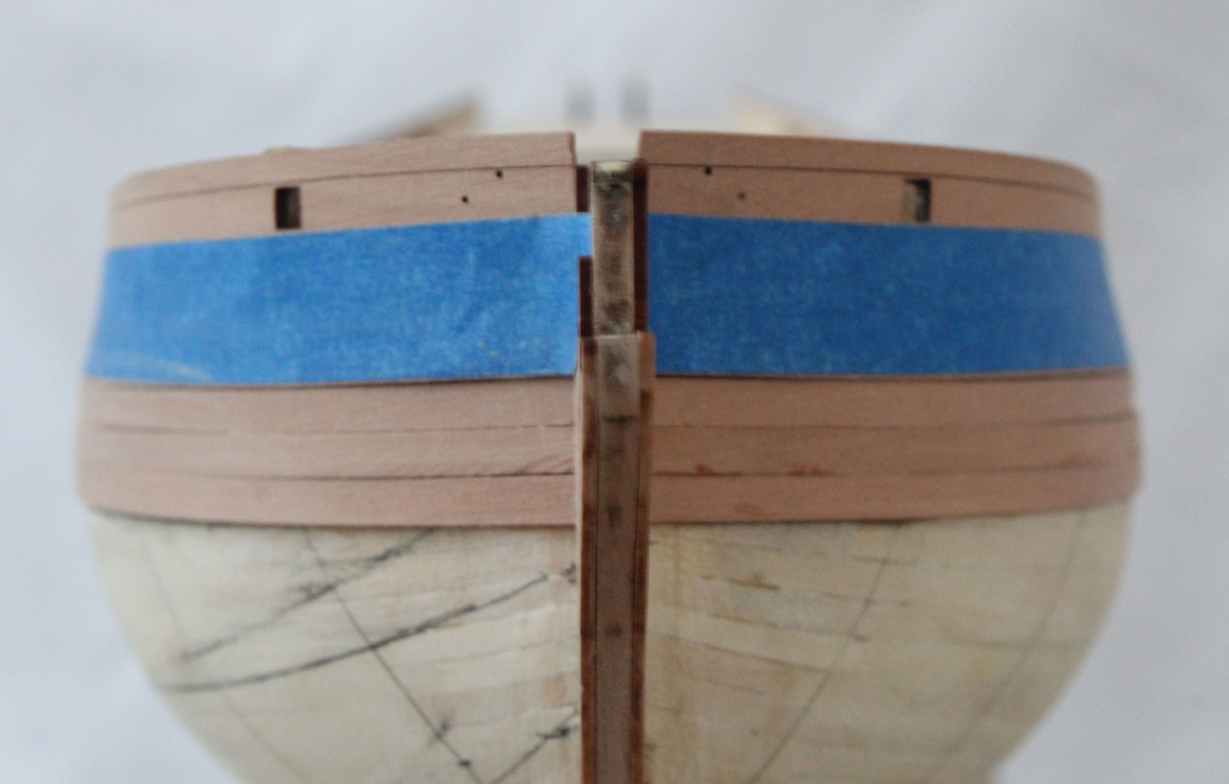

In the photo below I an checking if three full width planks can be fitted around the bow, not colour matched.

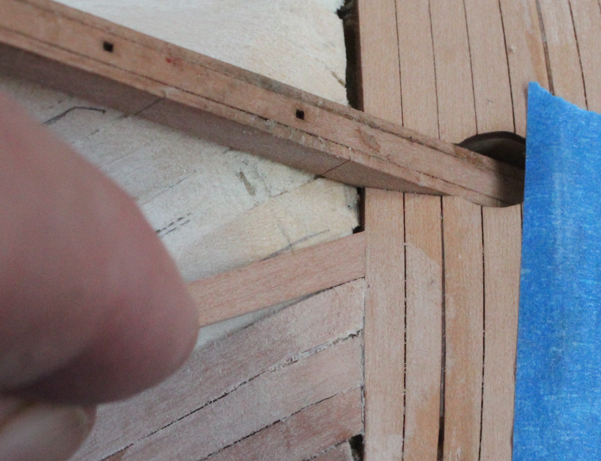

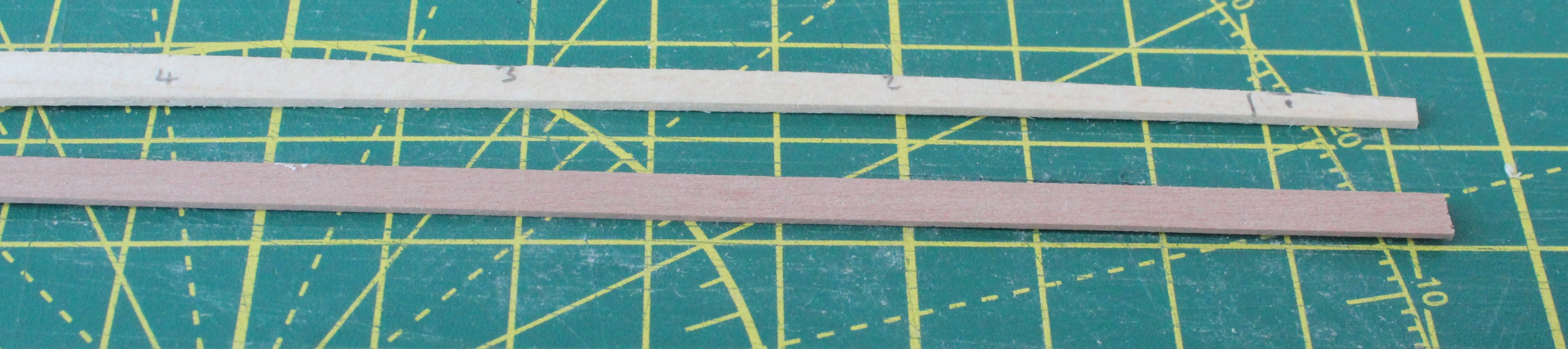

002.thumb.JPG.8b9c9a9cd8f85dc54764e93fb22e11b8.JPGIn the next photo I am checking the colour match of first plank with the bulwark, it looks good.

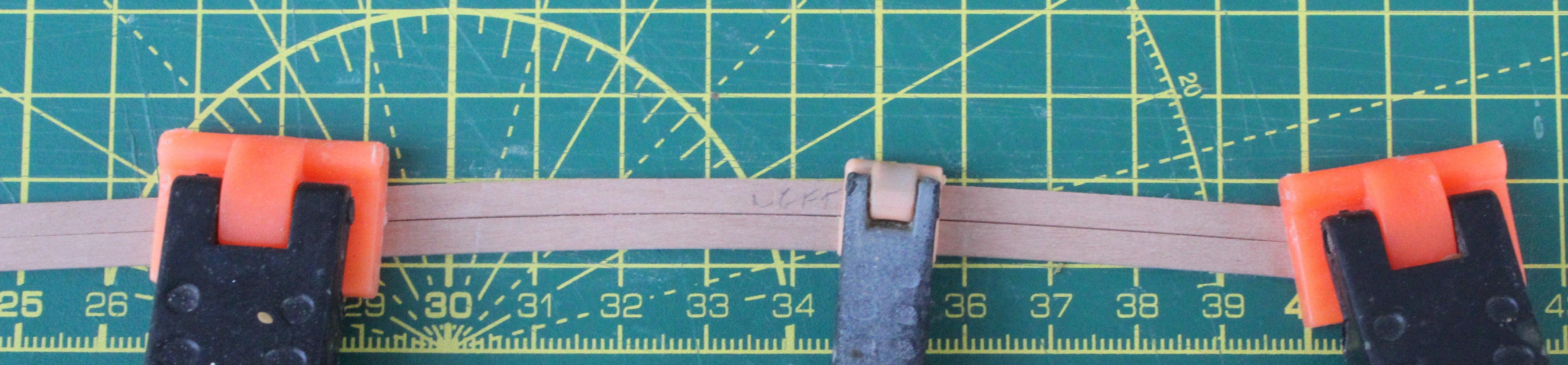

003.thumb.JPG.8d0c5bd56228c9ff7da57720122aeef6.JPGThe next photo shows marking the plank for rabbet so it follows the curve of the stem post

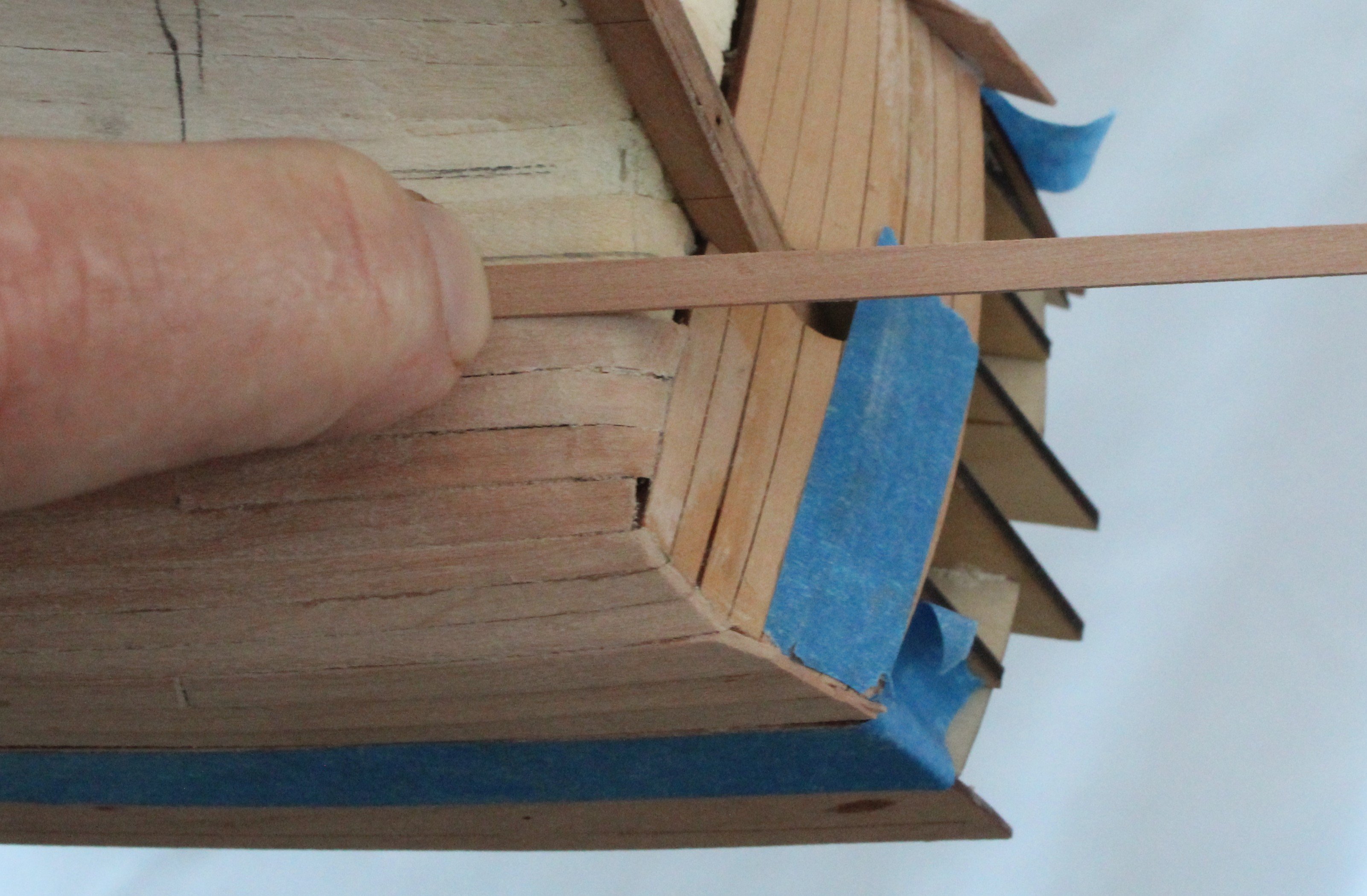

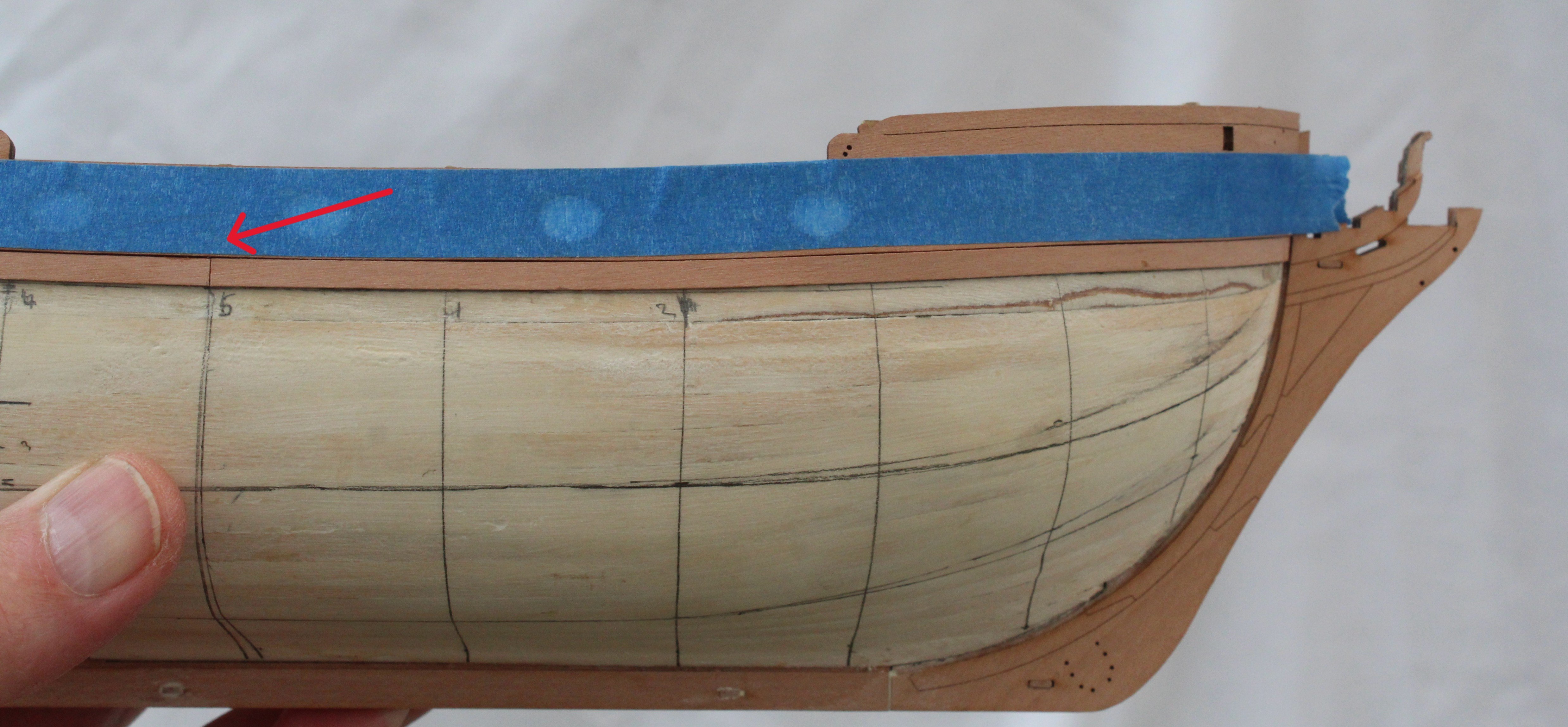

The next photo shows the central lateral bend point, which is where the widest gap is
005.thumb.JPG.41213a66cbb465493c478698a103ebb2.JPGLateral bending of the first plank (left and right)

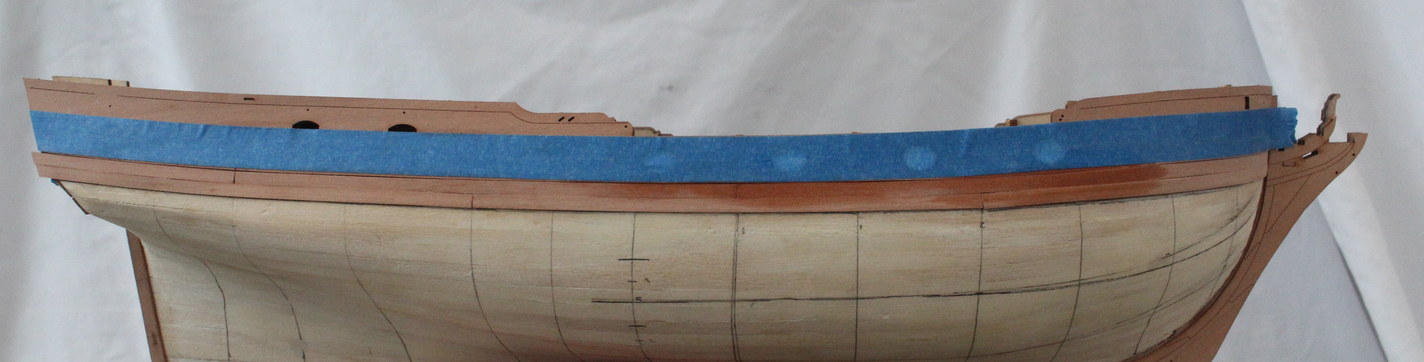

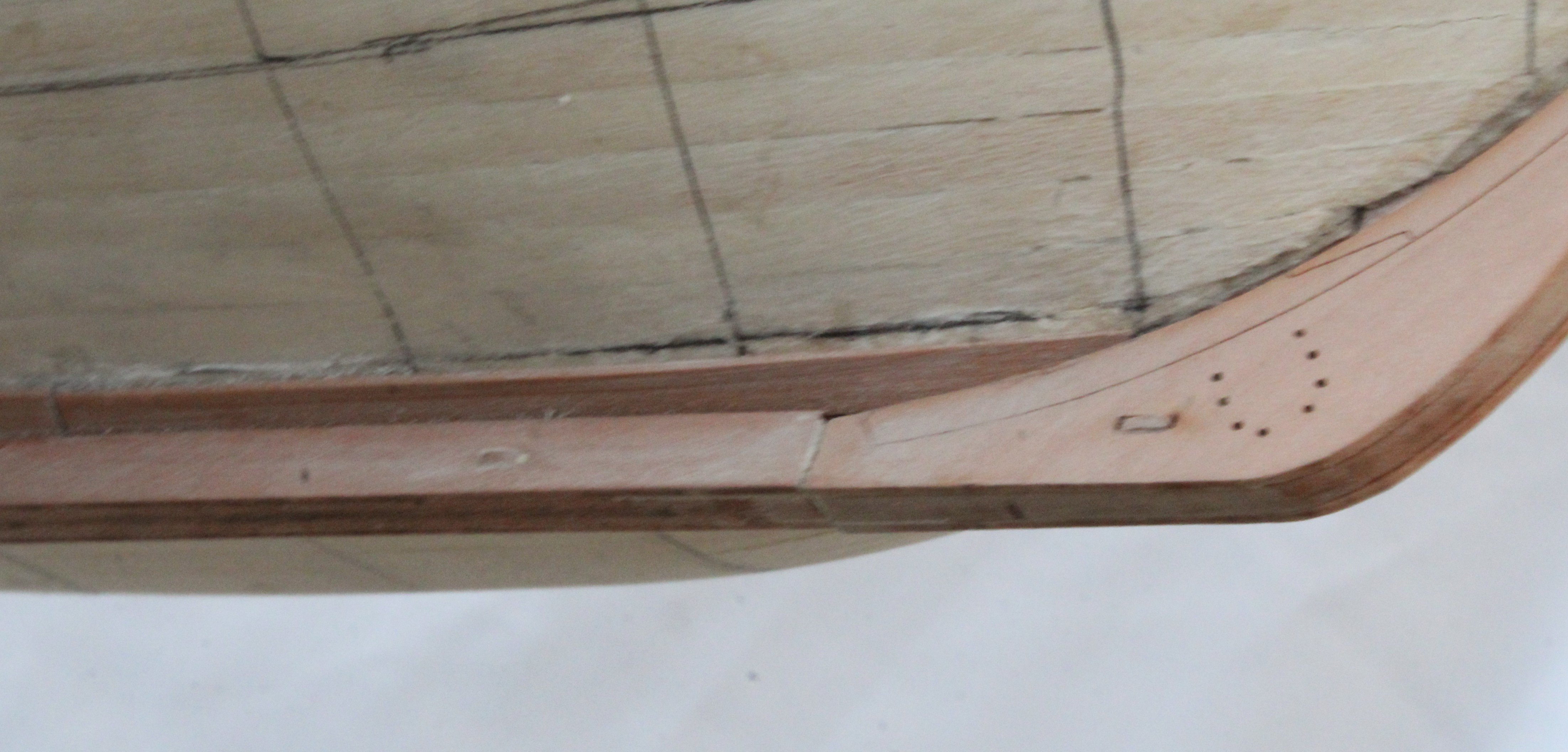

First plank has now been fitted, and the 4-butt joints can be seen

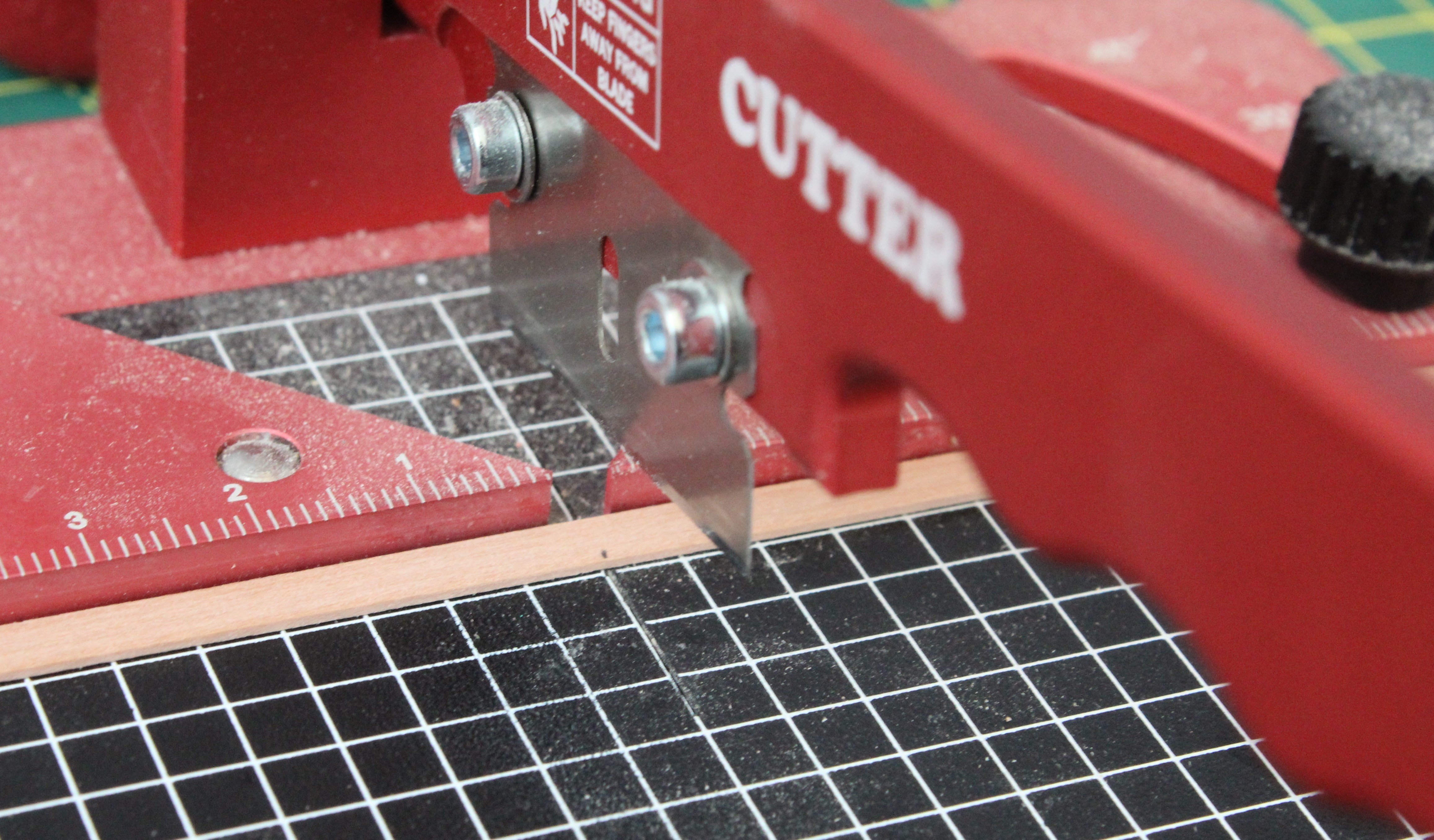

009.thumb.JPG.3ee0380f134fffb7fafa897563e5f2ec.JPG Cutting planks method. This tool give a nice shape cut. I do give the cut edges a very light sand.

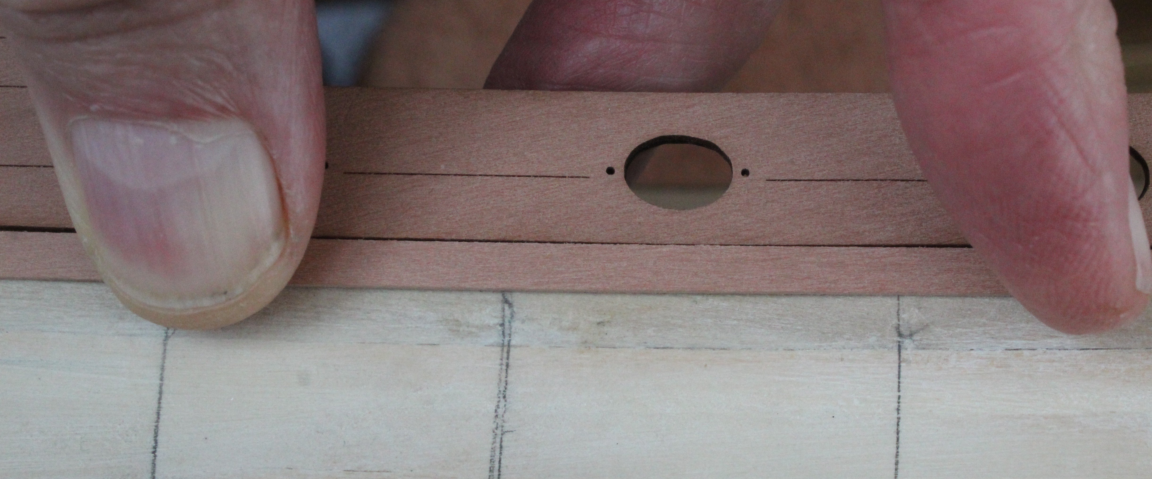

Second planking layer completed, I am using acetone and water to clean the planks to remove excess glue. The 4-butt pattern can be seen.
011.thumb.JPG.417f2e7e588cce40f391b60c69454a4b.JPGThird planking layer completed, so far so good.

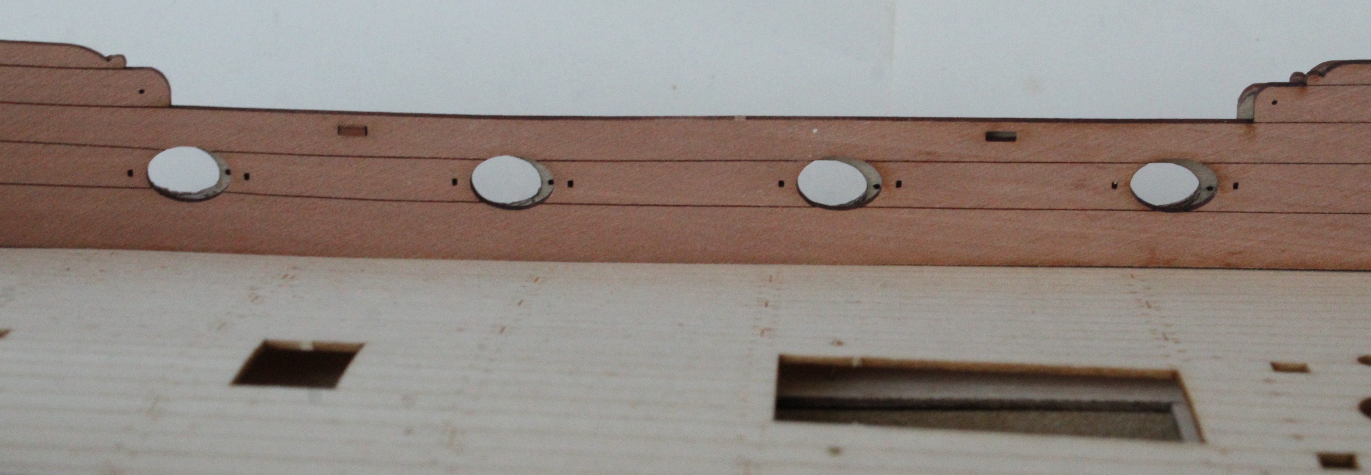

012.thumb.JPG.2ce0a8b6d5e8f1331e983f796b588e9a.JPG Garboard plank - stem post
Garboard plank - Stern post

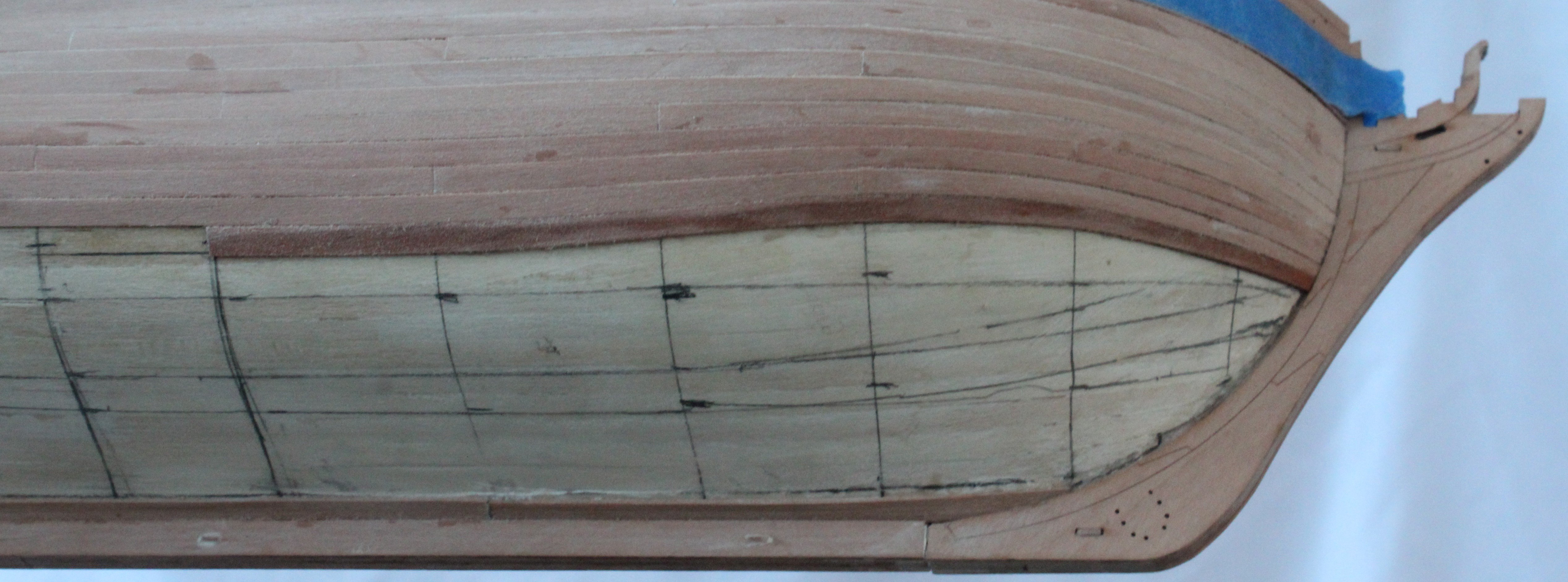

Task 35 – Banding Preparation

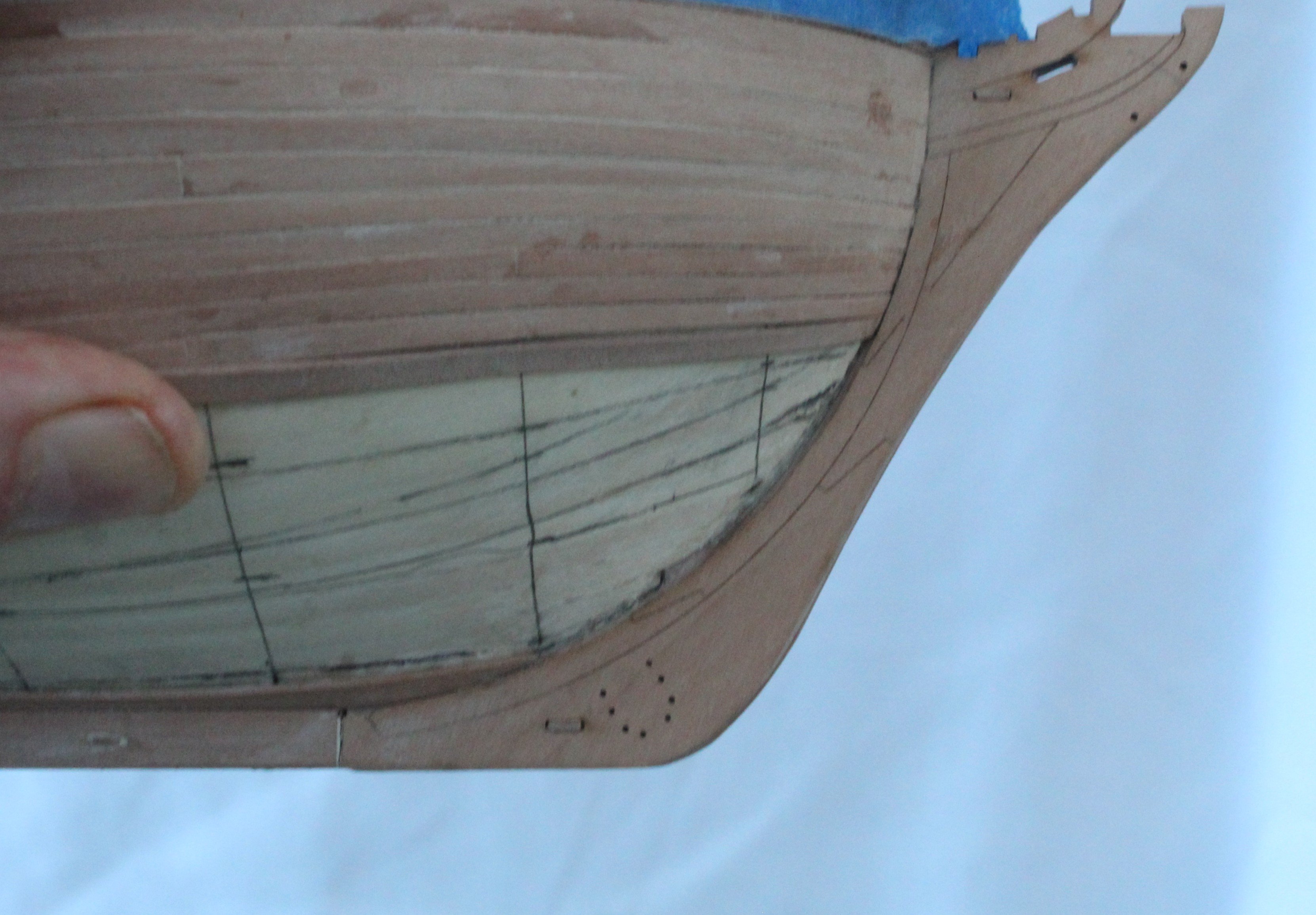

After fitting the first 3 full width planks and the garboard plank I was left with a gap of 80mm to fill at the midships, which would require 20 x 4mm planks to fill.
I think it will be a good idea to split the infill area into 4 bands, with each band comprising 5 planks.

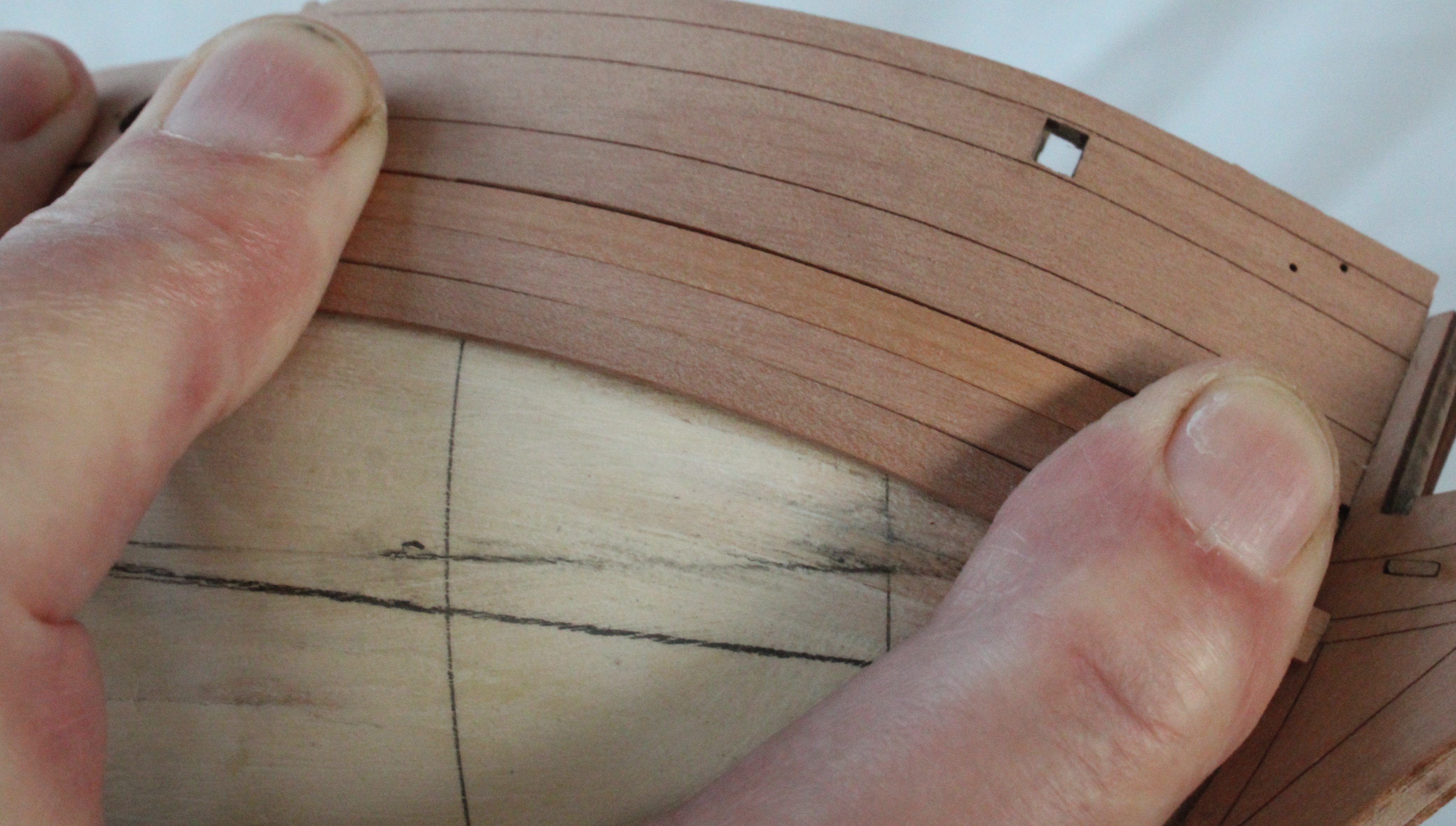

I made a couple of paper templates, one for the bow area and one for the stern area. I added the required curve to the bow section template which will help with the lateral bend.
Using a spare piece of 4mm planking material I made a bow plank (from bulkhead 4 to stem post) and a stern plank (from bulkhead 8 to stern post) using the above table measurements and templates as guides. I was happy with how they both looked when test fitted.
The test planks, when held against the hull, both appeared a good fit, therefore I can now proceed with planking the first banding section.

The paper template is being checked in the photo below. I took my time to get the right shape for the top edge. The bottom edge and drawn planks could have been neater.
The stern template. I did make a hash of cutting the bottom edge.
I also did a test the template around the stern counter as would like to fit two planks to the outer edge before the planking has to rotate so it terminates with the bottom edge.
I did purchase a set of proportional dividers to help with tapering the planks. It has been correctly set in the photo below.
Test lateral bending of tapered bow plank, using the template as a guide.
Test fit of the test plank, looks OK, noting it was not colour matched.

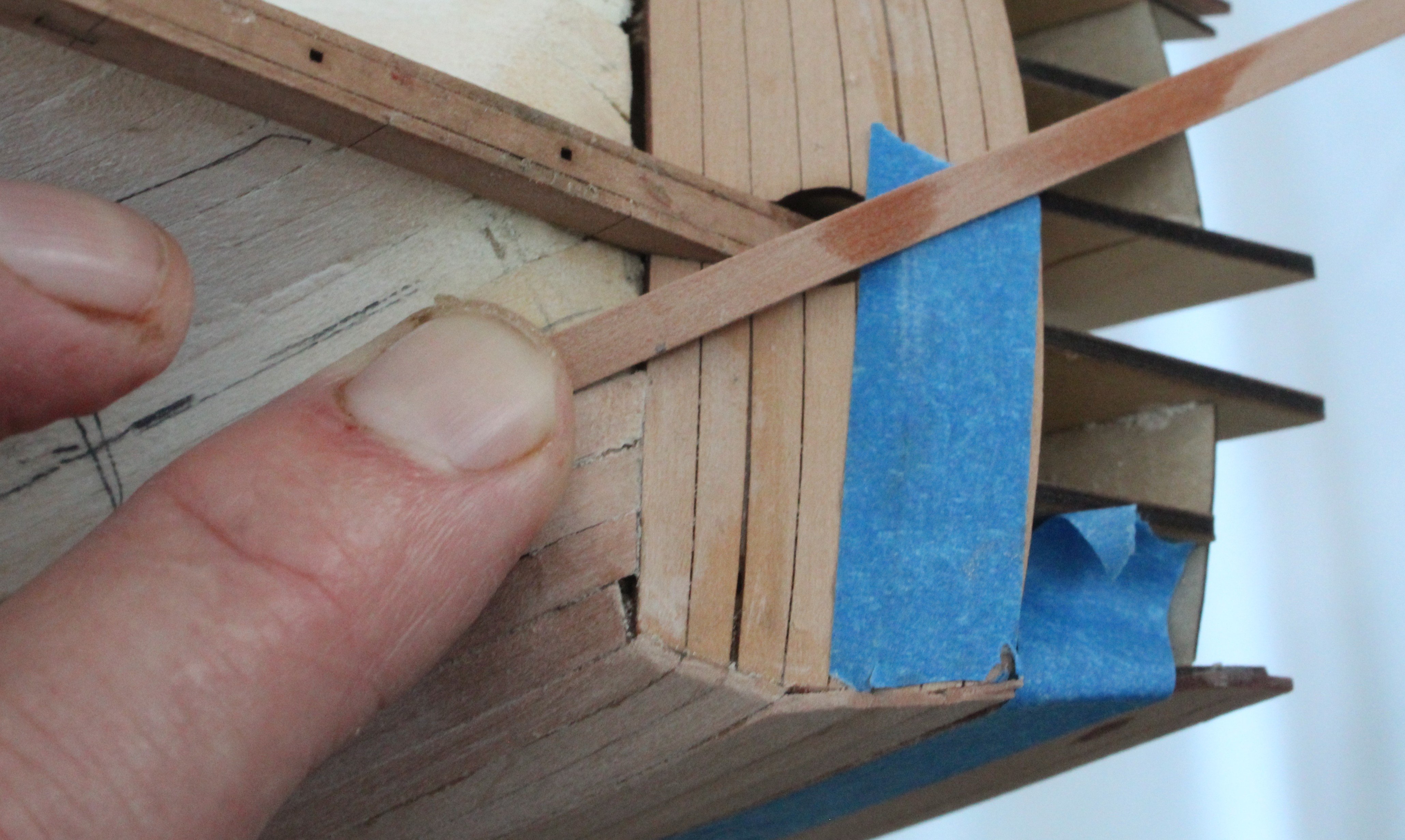

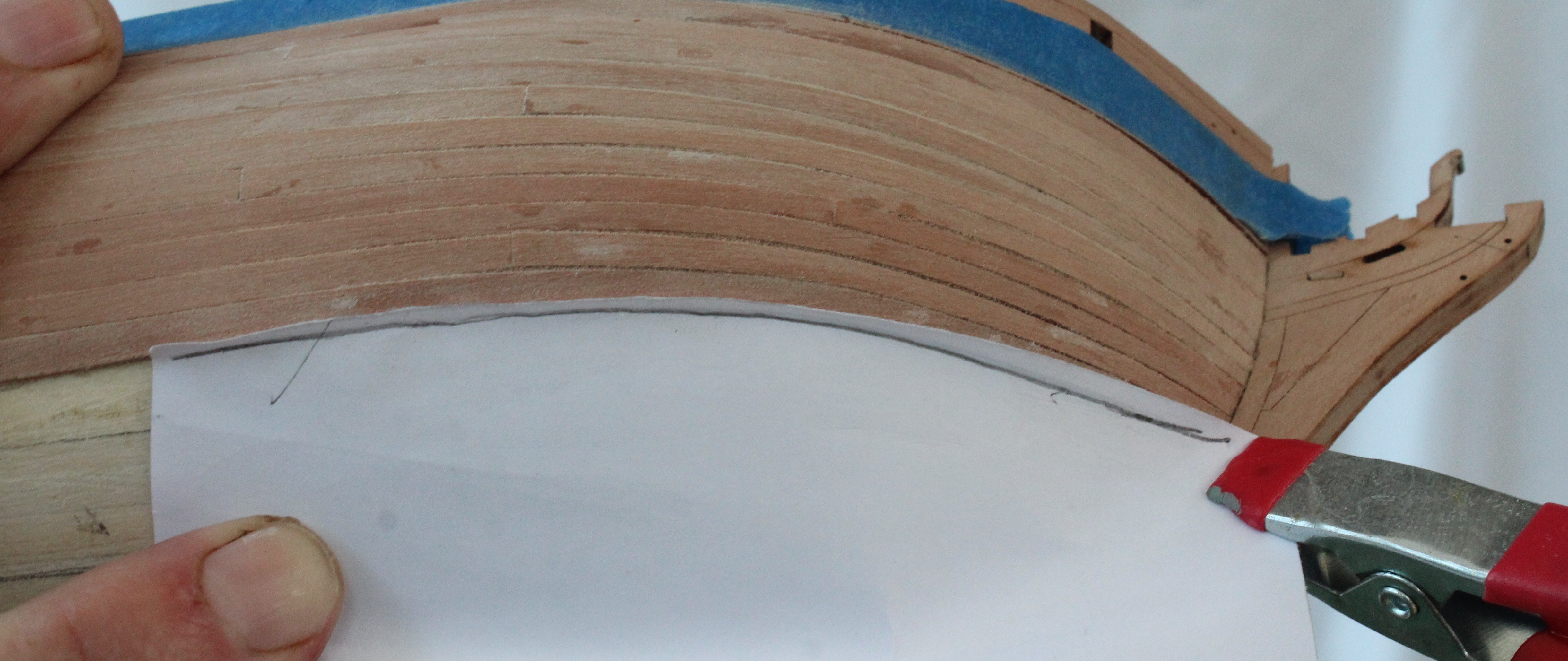

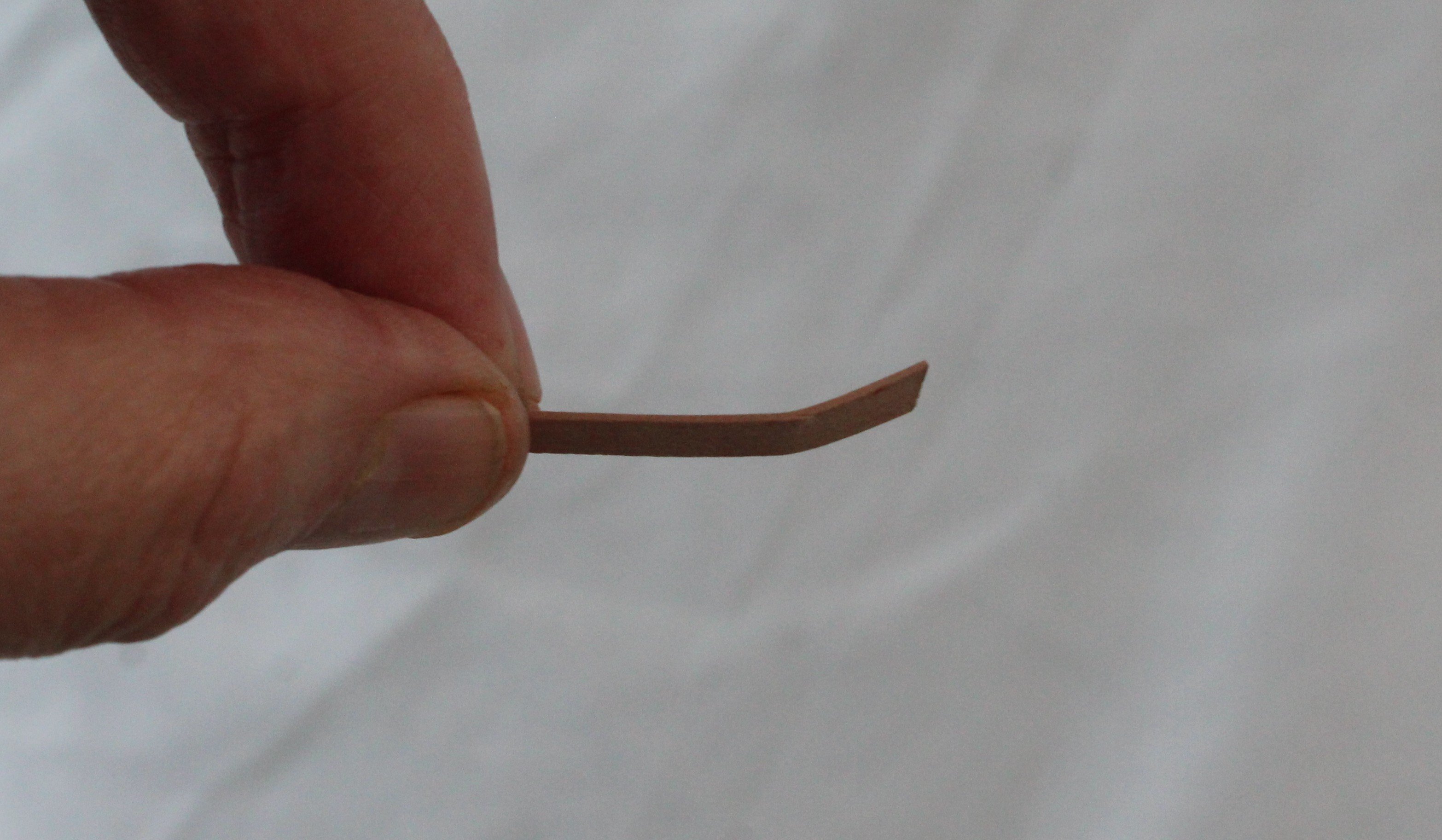

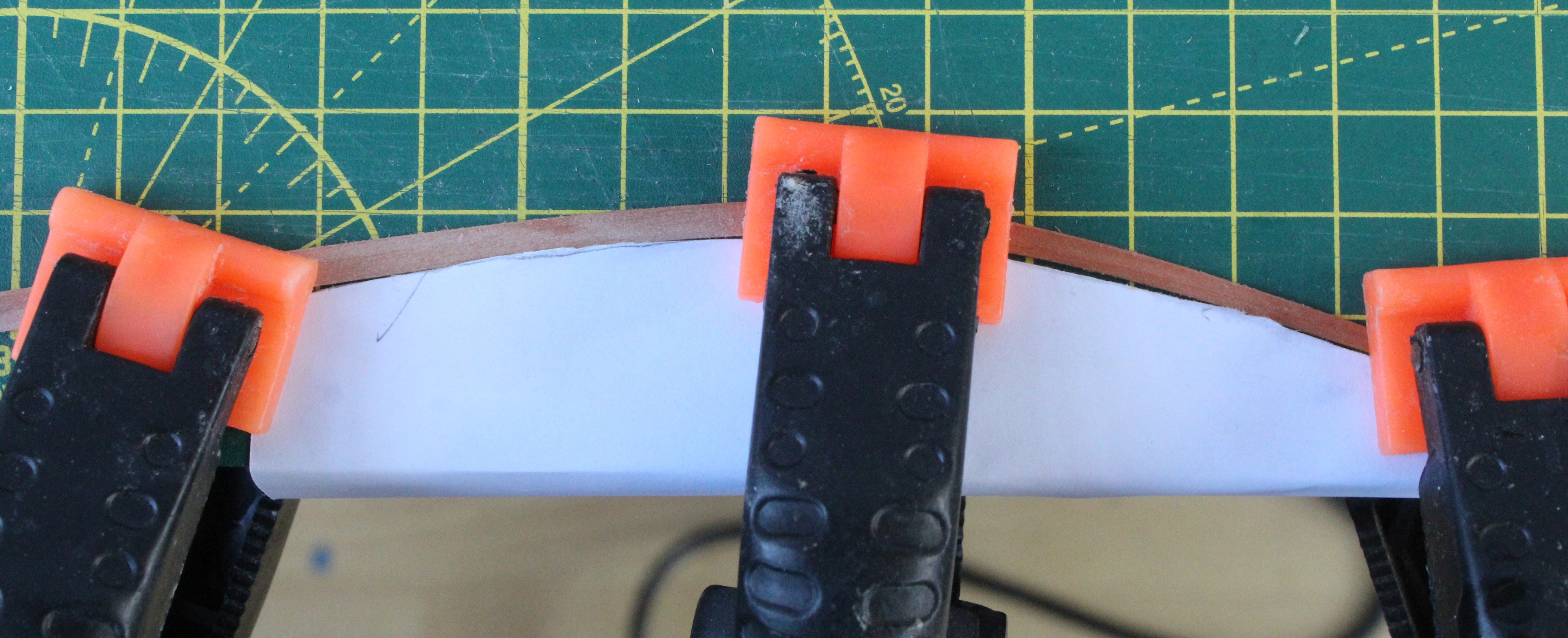

Step 1 – Creating a paper template for the lateral bend
A piece of paper is folded underneath the plank. I then use a pencil to trace the required bend, as shown in the photo below. Next I cut along the pencil line and this becomes the template for the lateral bend.
Step 2 – Tapering the plank
Using the various bulkhead measurements taken when creating the banding areas, I use my digital callipers to mark the required widths. You will note, in the photo below, I also have a guide plank to indicate the positions of the various bulkheads.
Step 3 – Lateral bend of the plank
Once the taper has been applied the plank is then laterally bent. The paper template is used to set the required curve, as shown in the next photo. Water is brushed on to the plank and a hair dryer is used to apply the heat.

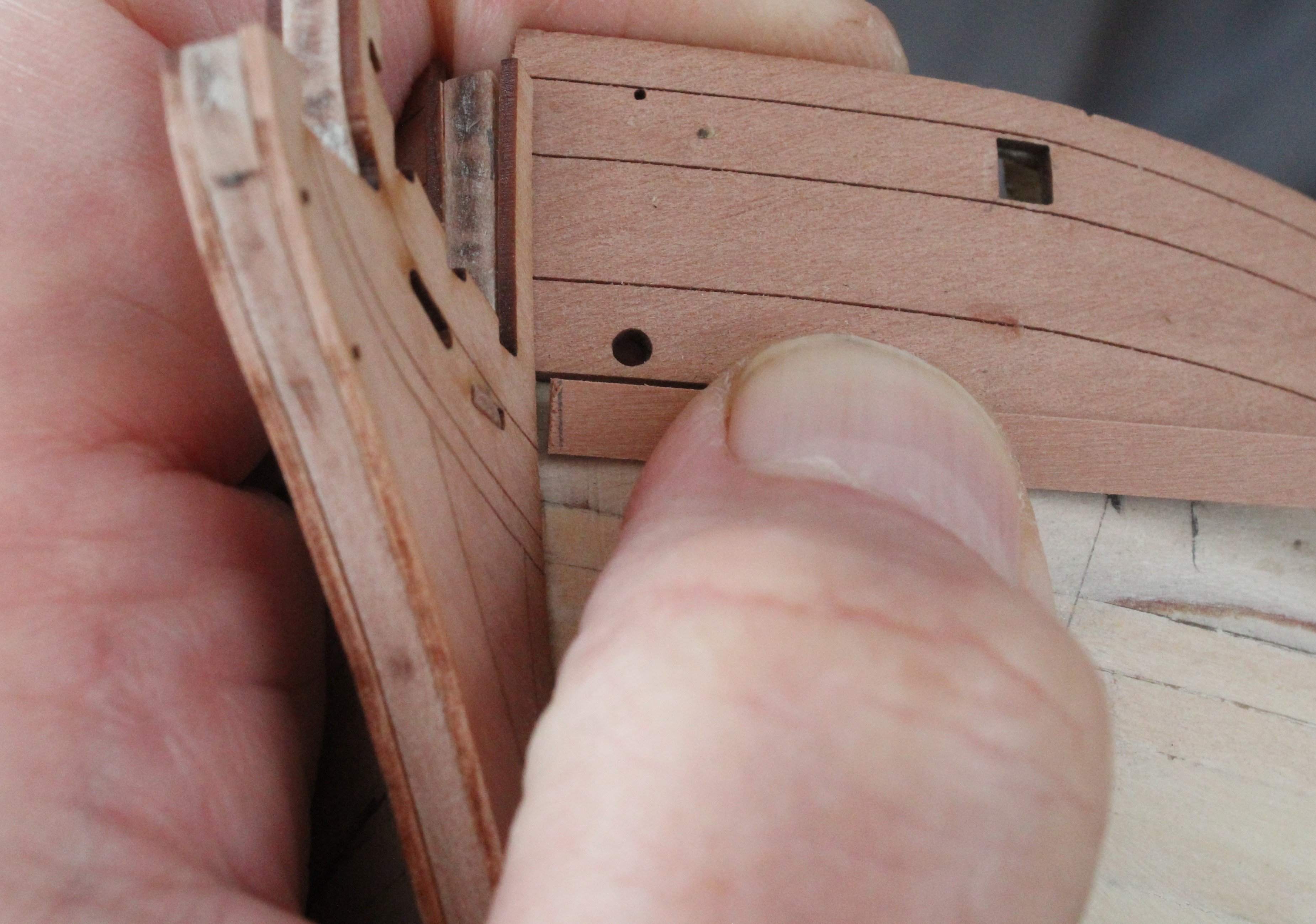

003.thumb.JPG.a9d85f78137d394d828feab81c990fbf.JPGStep 4 – Test Fit
Once the plank has been bent as per the template it is test fitted. As can be seen in the next photo the plank sits flush with the previous plank without any force added. The plank is then cut to the required length as per the 4-butt shift pattern.

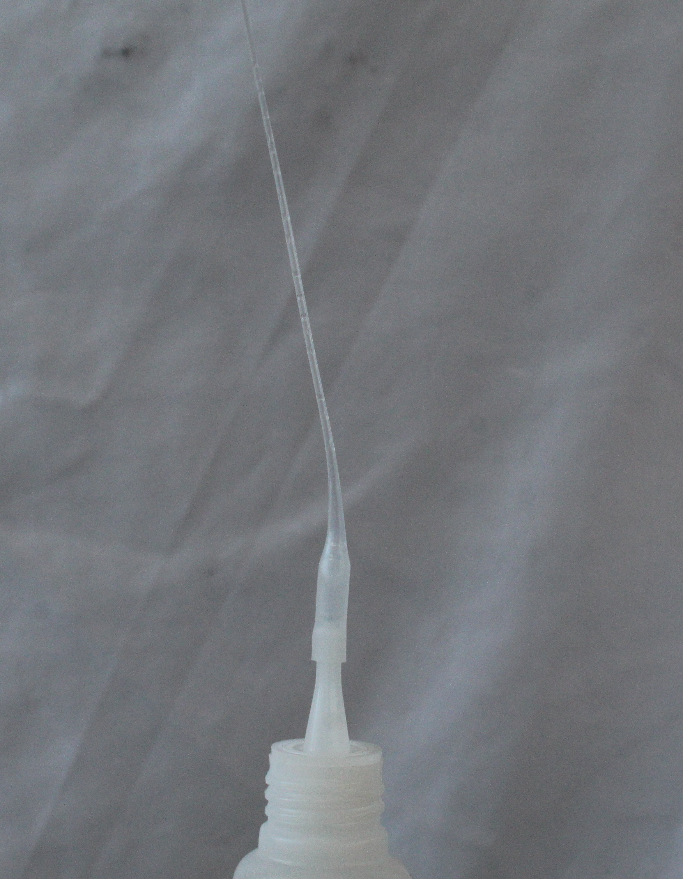

004.thumb.JPG.17fc473fe38fb1e8d24ad1efec28ebde.JPGStep 5 – Gluing the plank
Glue is applied to the hull, using the following attachment to the super glue container. This attachment has proved to be an invaluable asset in this respect.
I brush some water on the underside of the plank to aid the adhesive with the ca glue. The plank is then carefully fitted, working from the stem post. I am happy with how this plank (still damp) looks, once glued in place.

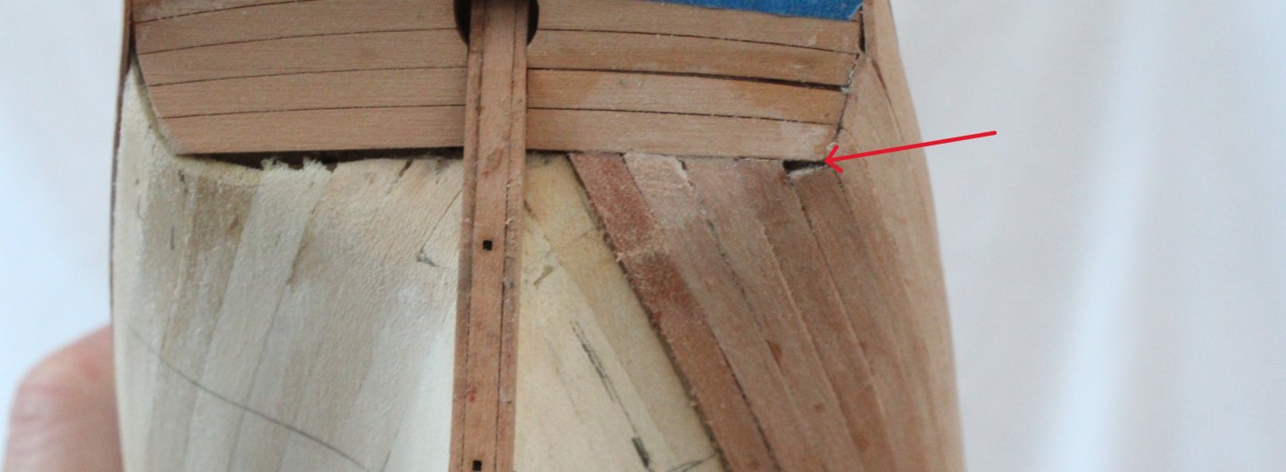

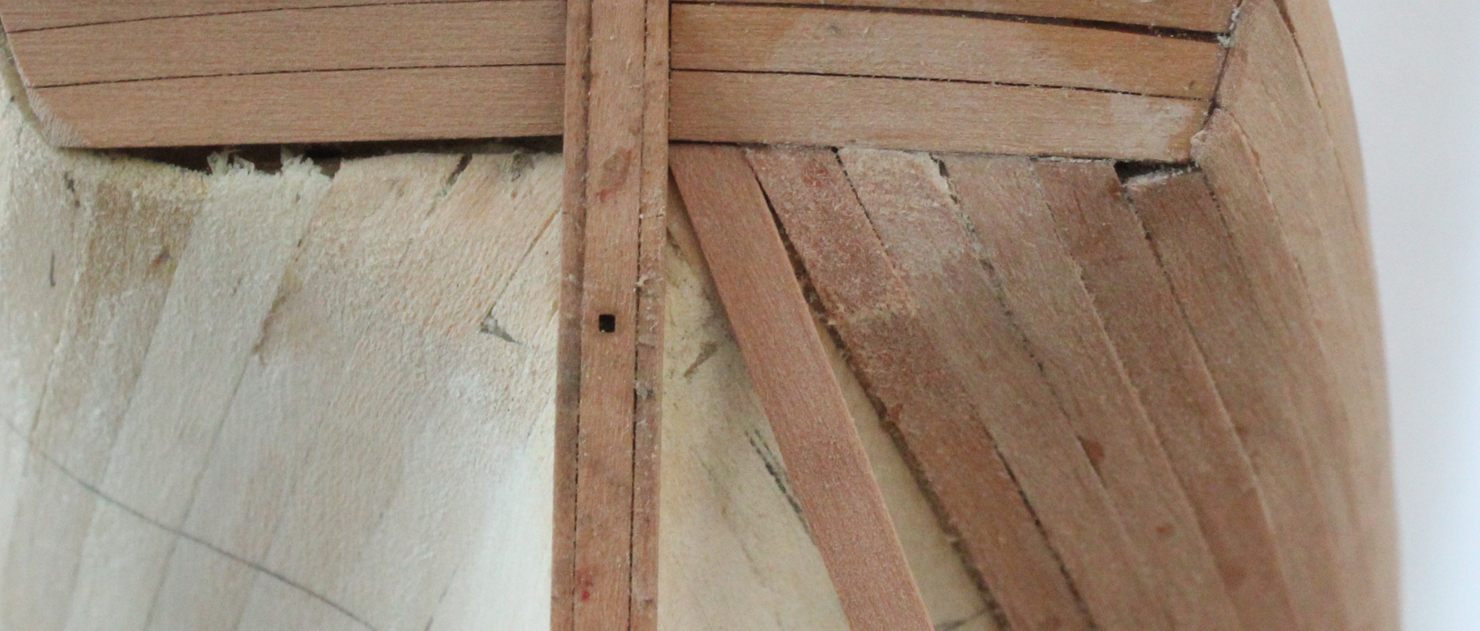

Step 7 – Stern Post Plank
This is the plank that takes the most effort to fit. With the plank in position, as shown below, the underside is marked where the sharp bend to the lower stern counter pattern starts.
The bend area is then wetted and a bend applied. I usually start with a gentle manipulation with my hand to get the start of the bend. Next I use a bottle to complete the task. A hairdryer is used when the plank is being bent around the bottle.
The bent plank fit is then checked, as shown below. The bend looks OK. The pencil dot is where the plank need to terminate with the stern counter.
Using the pencil mark on the plank I use the following template to cut the correct angle.
The next photo shows the stern post plank prior to fitting.
The dampened plank is then glued in position. This time I work from the stern post to the midships to ensure I get a good join with the stern counter. Apart from one plank (red arrow), where I worked from midships to stern counter when the plank was fitted, I am really pleased with how the joints with the stern counter looks.
As can be seen in the final photo of this post the remaining stern counter gap to fill is exactly one full planks width which is ideal.

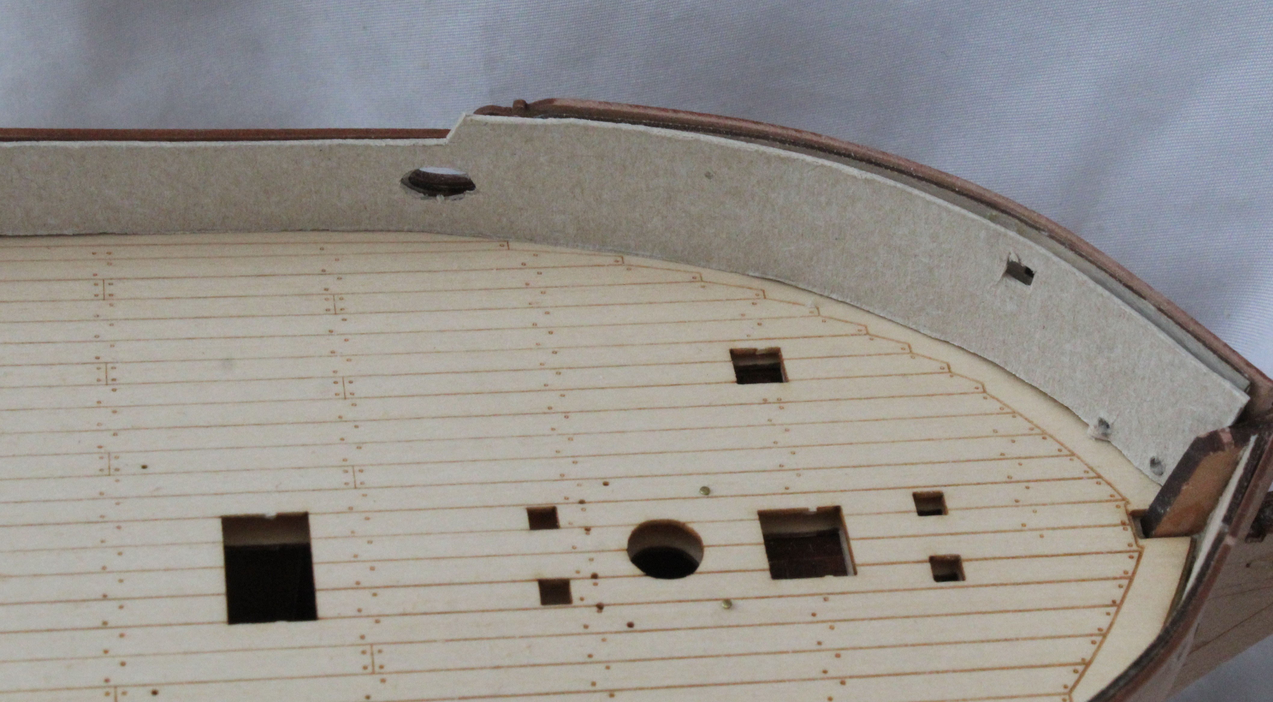

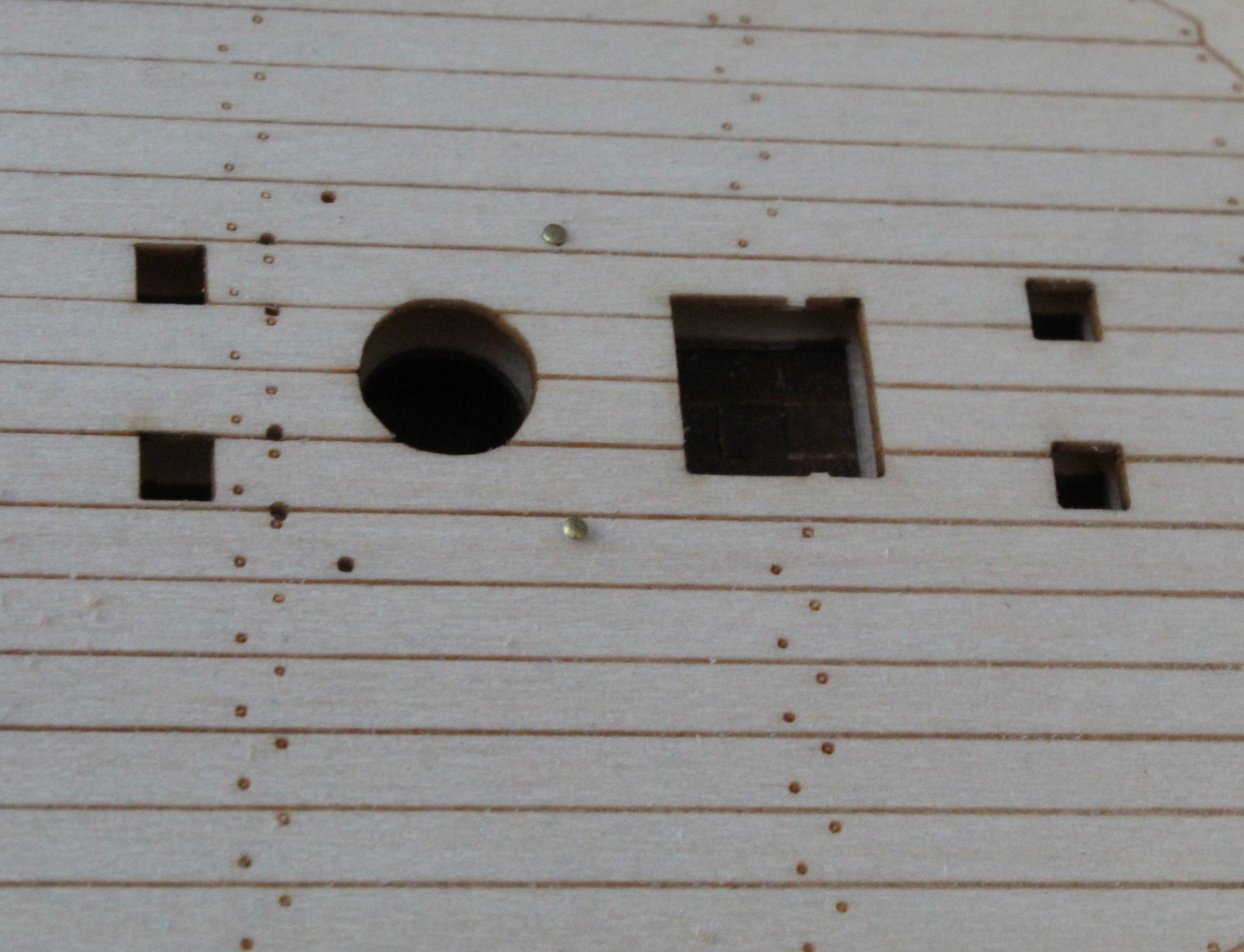

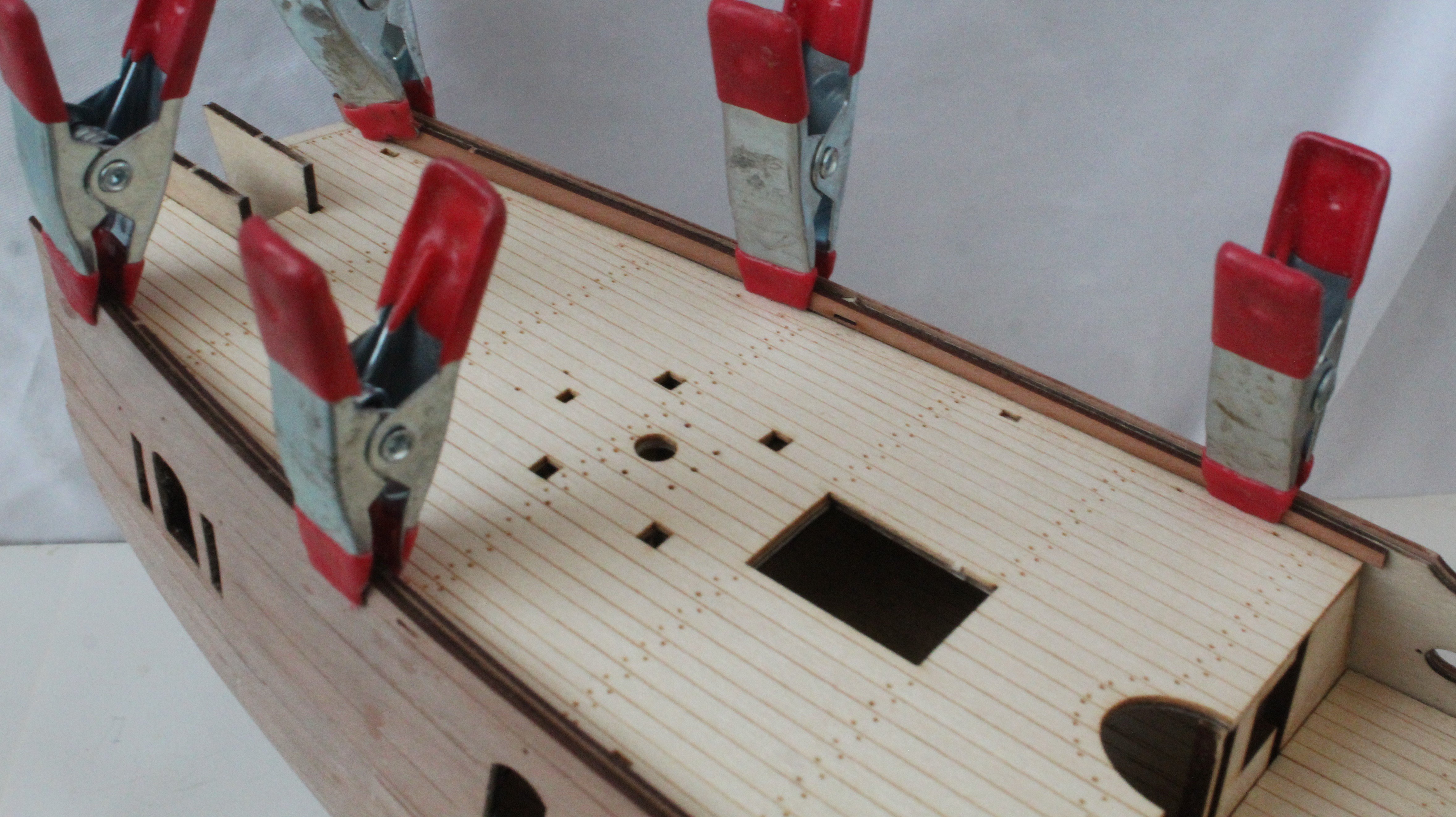

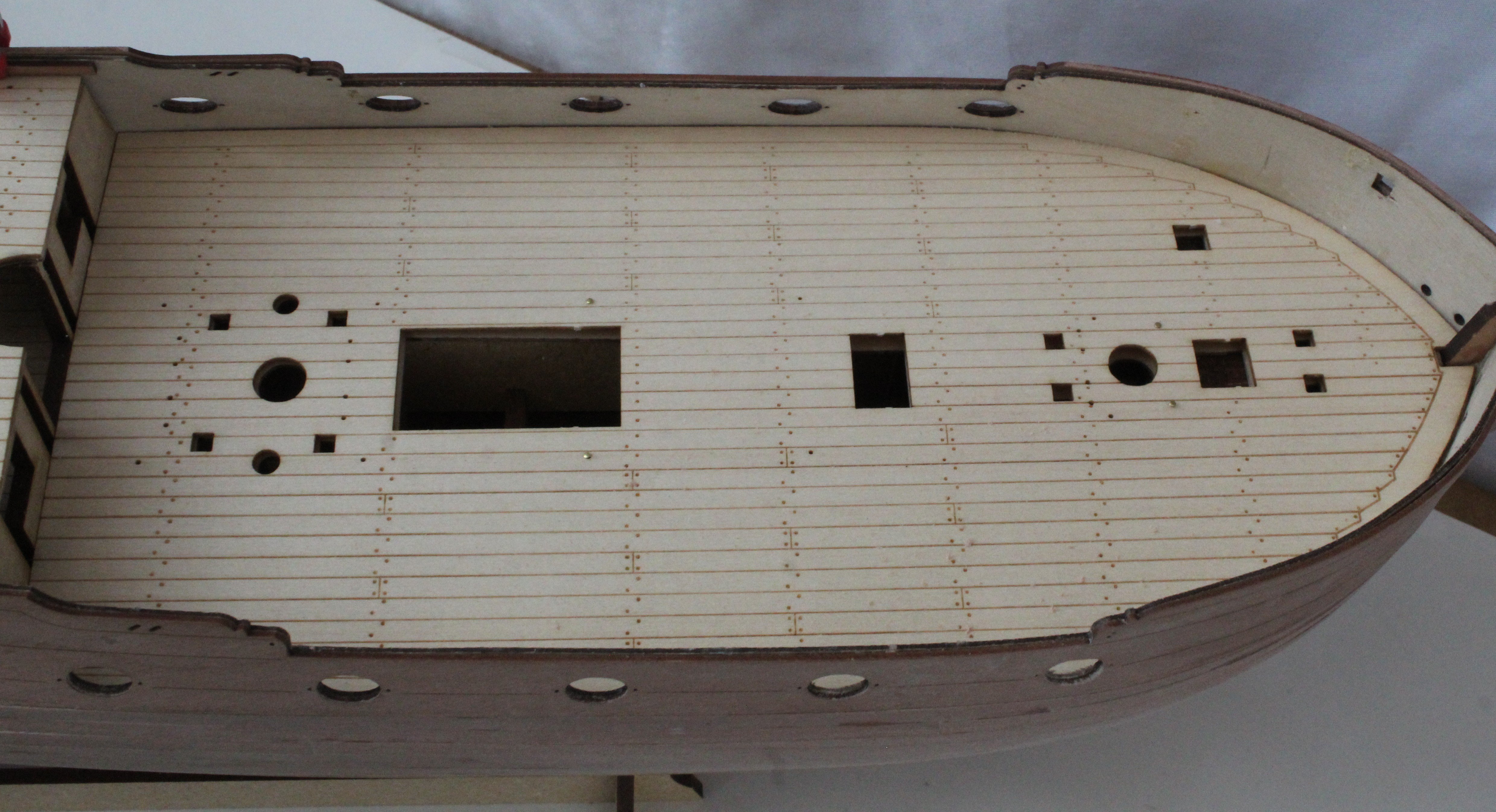

Task 41 – Prep for adding Laser Etched Decks and Inner Bulwark patterns
It will take me a few days to complete the next task of adding the two laser engraved decks and associated inner bulwark patterns.

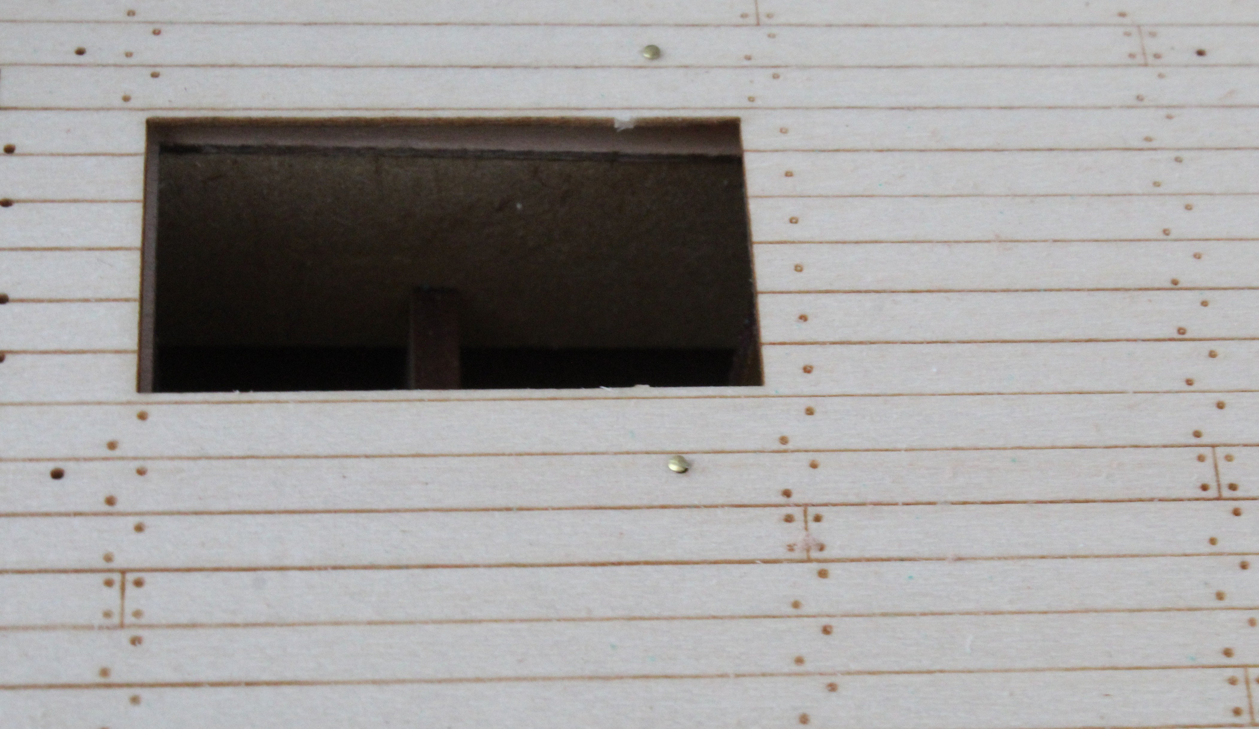

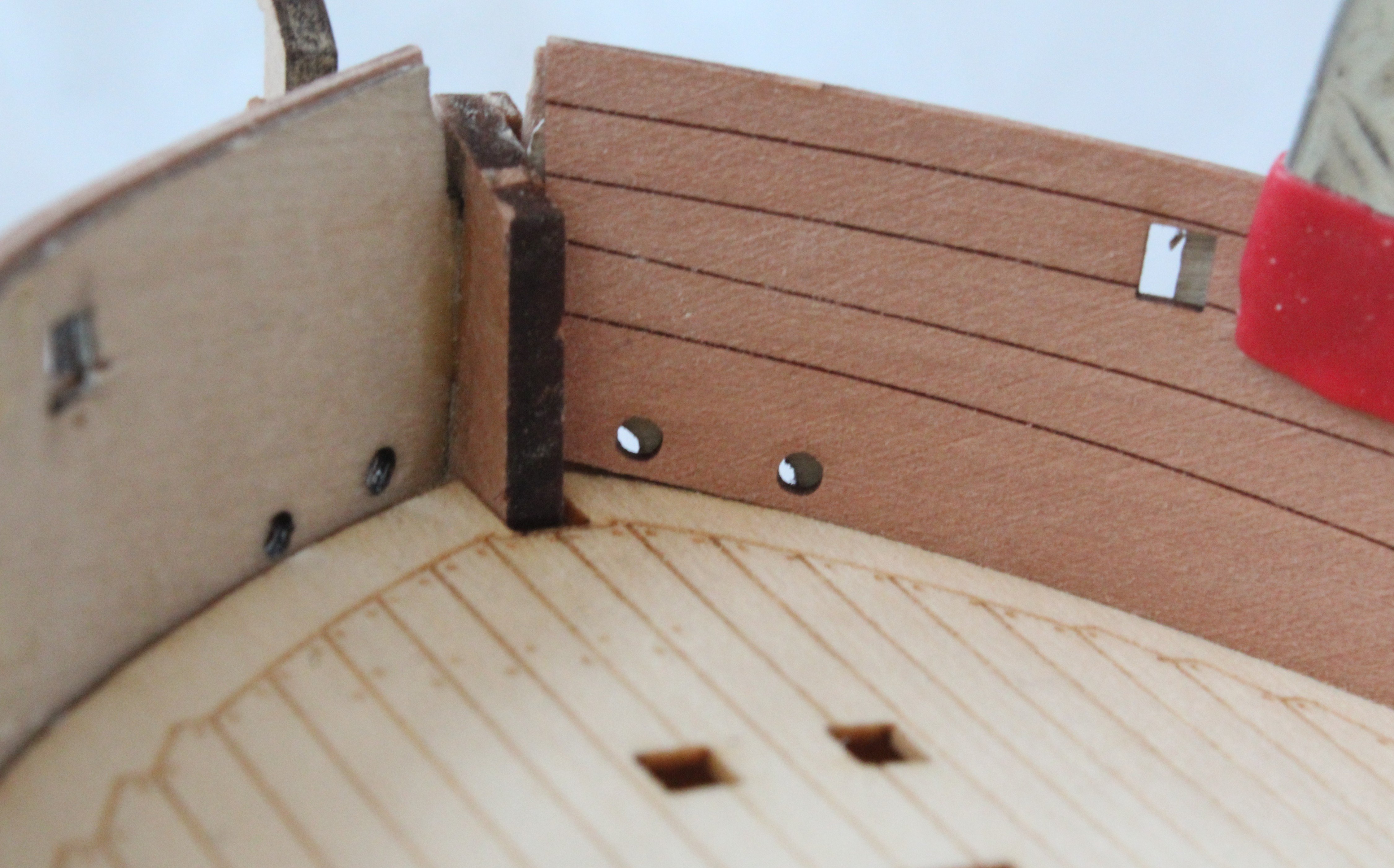

The first task was to remove the bulkhead ears that protrude above the decks. These snapped of easily and the deck base was then sanded to remove any remaining excess bulkhead ear material.
Once that was done, I did a test fit of the upper deck and bulwarks. Everything seems to be well aligned. Pins were also used to double check the deck was properly aligned with the deck base.
Next I did a trial fit of the lower deck. This is a bit tighter and did require a little bit of sanding to ensure a good fit. Pins were once again used to double check the deck was properly aligned with the deck base.
Using the same template used when bending the outer bulwark patterns the right-hand side inner bulwark pattern, after a 30-minute soaking in hot water, was clamped to it. Once it had dried out, I did a test fit. I will need to make some minor adjustments to this pattern to ensure it is properly aligned such as sanding a bit from the bottom of bow section of this pattern. I also need to add a chamfer to the leading edge, so it locks in with the stem post.
I made a cardboard copy of the left-hand bulwark pattern to see what modifications, if any, would be required. The left-hand pattern, after soaking, was clamped to the bending template and will now be left to fully dry out overnight.

Upper deck trial fit with bulwarks
Lower deck trial fit
Pins used to check lower deck alignment
003.thumb.JPG.ffde9bd4ded2a0ae93c84507f651202f.JPG004.thumb.JPG.470dbee653c90ae28f8be7954934cdf1.JPG
Right-hand inner bulwark alignment. I need to sand a bit from the bottom of bow section of this pattern. I also need to add a chamfer to the leading edge, so it locks in with the stem post.

The two laser etched deck patterns were then glued in place. I used some pins pushed through the eyebolt holes to make sure these patterns were aligned with the deck bases.
When test fitting the upper deck bulwark patterns I noted, when properly aligned, there was a gap between the bottom edge and the deck in the mid-section. I did consider making some new patterns, but I decided to sit these patterns flush with the deck when they were glued in place.
The lower deck inner bulwark patterns were then glued in place. I used the catheads and oval locator plugs to position these patterns before clamping. Once clamped the catheads and locator plugs were removed.

Laser Etched Decks Fitted
005.thumb.JPG.13027dbc7804ee66b50ec4e5cbde2648.JPG006.thumb.JPG.5debbd21fc94e8ba51b42d55fc62d11e.JPG007.thumb.JPG.f0d1a2b3715ef834ee04a4c57855cb68.JPG
The next photos shows the mid-section gap when the upper deck inner bulwark is aligned.
008.thumb.JPG.95d7b2ee7ea1805ecc1e25ab4d3ecbdd.JPG009.thumb.JPG.880554085f04f2e320e002302faf9762.JPG
Upper deck inner bulwark glued in place, without the gap with the deck.
The lower deck inner bulwark pattern clamped in place after gluing. The oval locators were removed after this photo was taken. You may also note that I have drawn and taped the preliminary water line

I have now sanded the tops of the bulwarks level and did test fit the gunwales. All looks good. I did brush on some diluted wood filler around the curved sections that are not covered by the gunwales so the laminations between the layers will not be visible once painted.
The gunport opening were also sanded smooth and coated with diluted wood filler so that, when painted, the laminations between the layers should not be visible. I copied this method from @DelF.

Build Log - Day 25 (7th & 8th Dec 2025)
Task 45 – Main Rails Prep Work
I am currently doing some more prep work this time related to the main rail patterns as it is important to get a good fit with these decorative patterns.
When test fitting the main rail it can be seen that stern frame counters still need to be trimmed so they are flush with the end of the main rail. I marked the end position of the main rail pattern on the hull and then with the patterns removed, using some different grit sanding sticks, the stern frames were sanded to the marked lines.
001.thumb.JPG.67081f5338ccbe45f2b23f3e57fec668.JPG002.thumb.JPG.ac6f5770e9961bea1c93fe2e31b166dd.JPGI did manage snap off the four dangly bits from the two rear window shapes on the right-hand main rail pattern when removing the laser char so it may take me a bit of time to sort out before that part can be fitted.
After carefully removing the laser char the bow main rail patterns they were soaked in hot water and then clamped to my bending jig (see earlier posts regarding the jig). Once the patterns had fully dried (after 18 hours) they were test fitted and were a good fit.
The next set of photos shows the test fit of the main rail patterns. They do look nice.
004.thumb.JPG.c083c0b051d3c3c090a373a9f4aa69ea.JPG005.thumb.JPG.efcc72f20c2460bab48fbcb8dd616854.JPG006.thumb.JPG.108c62853f27af58da9f4984fdcdaad8.JPG007.thumb.JPG.bd19635619abcb04aaae2bce1629af18.JPG
I will have to trim the bow section of the lower main rail patterns, so they fit flush with the stem post.
The bow gunwale patterns did need a slight adjustment to the curve at the bow end, so they accurately follow the curve of my hull. The patterns were soaked in hot water for 30 minutes and then clamped to get the required new curve. Once the clamps were removed I was happy with the fit. I also test fitted the midship and upper deck gunwales and I was happy with how they looked.
I am also adding a slight lateral bend to the rear section main rail so it follows the curve of the hull, as can be seen below.
