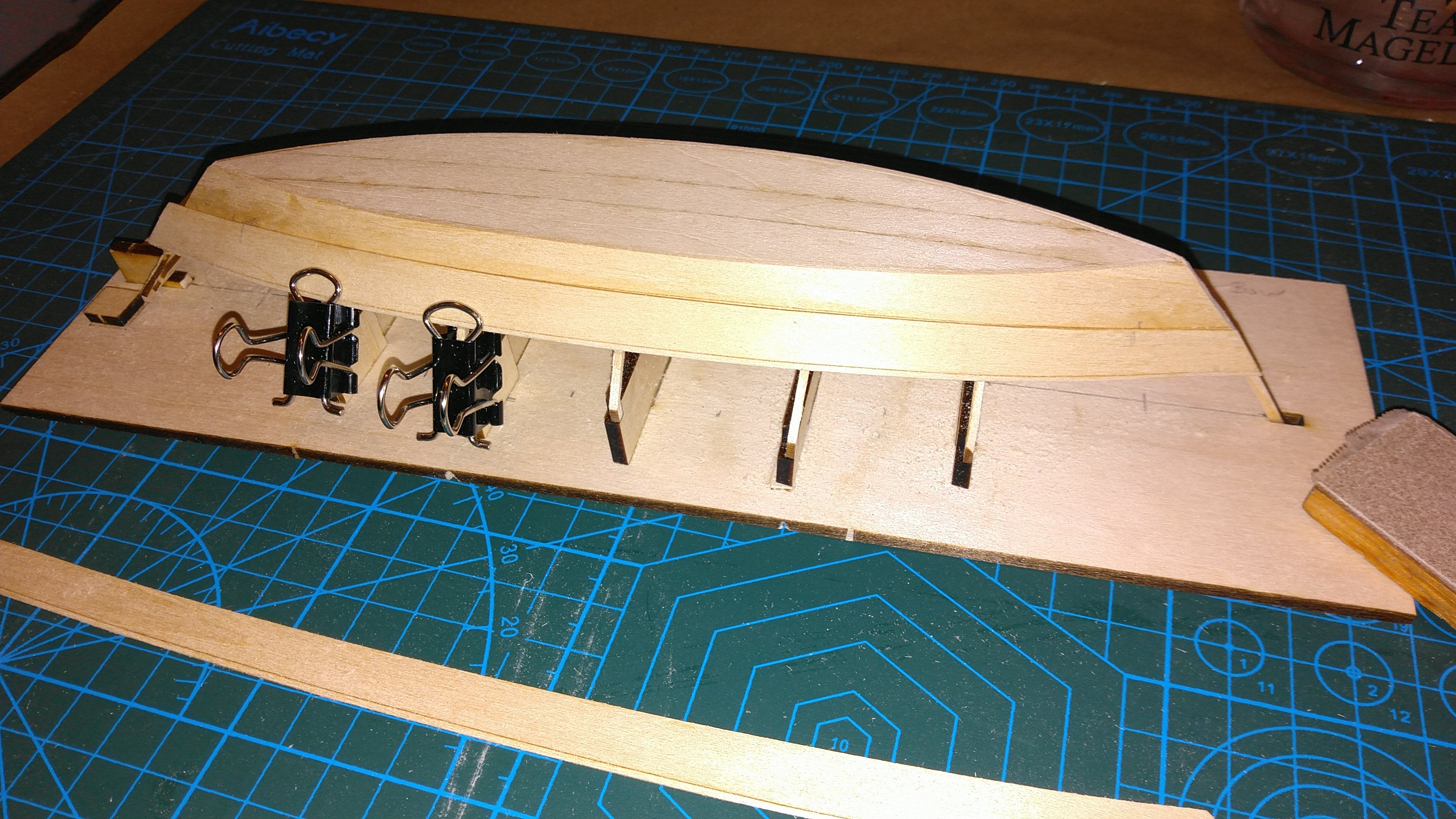

So, I finally got one of the broad boards glued on; it was much more difficult for me than the first plank. Also, I think I was too sparing with the glue, as things kept springing loose right when I thought I had it stuck for long enough to get some sort of clamp or rubber band on it. Therefore, a bit more glue was used which seemed to help. White titebond for the detail oriented, which is probably everyone reading this. :)

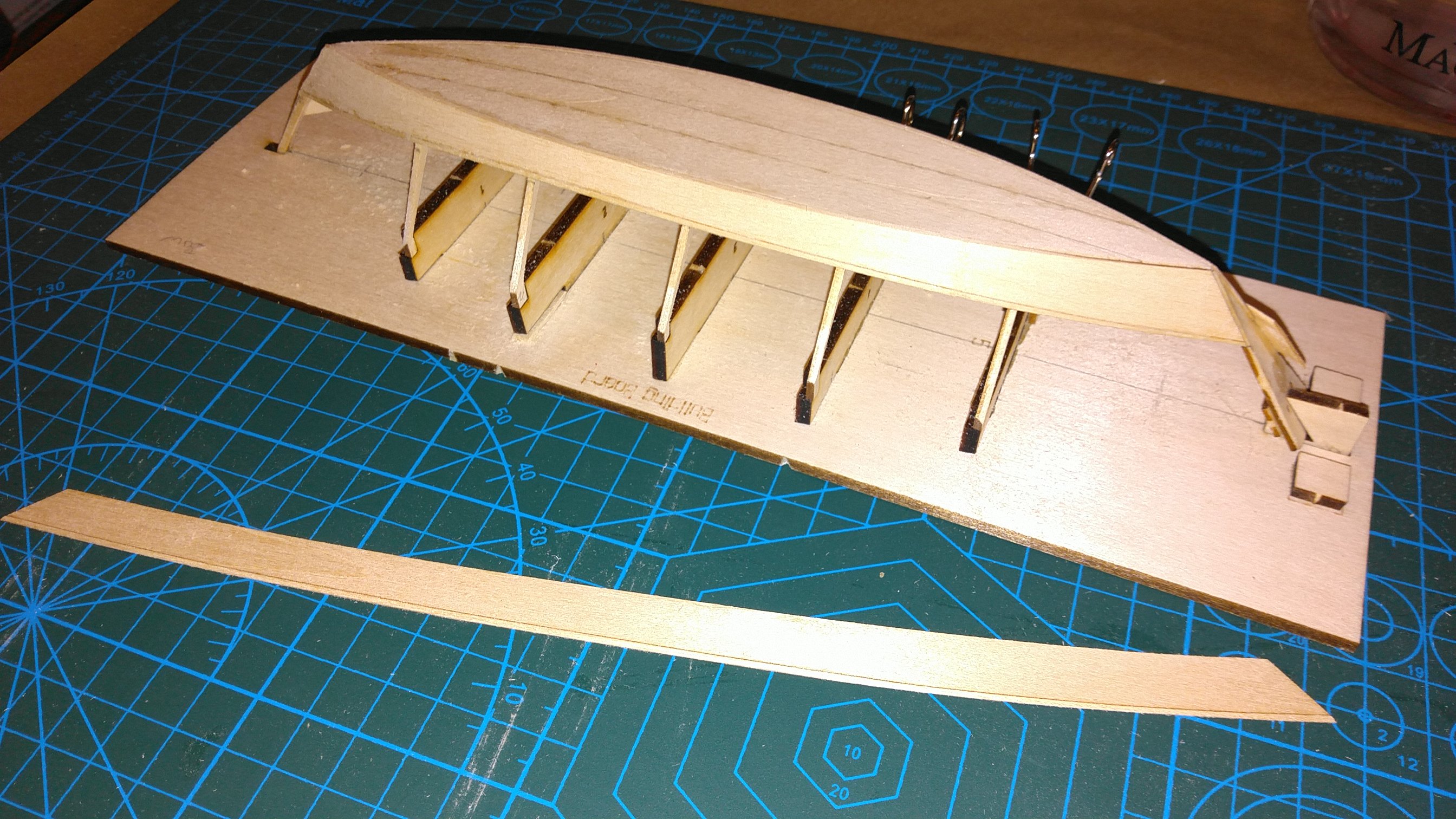

And, the other side ready to bend in place for another go. You can see I got a bit sloppy with the glue at the stern, which was giving me fits.

Brian, welcome, and looks good so far!  I am just a tad ahead of you on the MS Dory.  Do keep an eye on the relative alignment of each of the port and starboard strakes—if #2 is misaligned, it’s hard to make it look right with #3.  Also, I found it better to lop off a lot of the extra length on the stern side of the strakes before I attached them;  otherwise the extra length gets in the way of the building board.
-Eric
Have no fear with the glue it will sand off in the end. Brian remember it’s always better to have it securely bonded than fall off in the end ( especially with white glue). A little extra glue also fills small openings. I use white glue more than CA because every time I use it, it sticks  to everything (esp my fingers) except the part you are gluing which proceeds to fall off. We all have experienced this
Best. Rick
