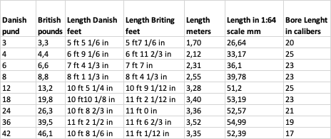

For this first post, I have found a series of cannons from the period 1720-1750. They are from a Kaddet book and the scans cam be found here: https://www.arkeliet.no/sources/kadett_fm_1700/kadettbok1700t.htm
The series is one of the most complete onse I have found and includes: 3 pdr, 4 pdr, 6 pdr, 8 pdr, 12 pdr, 18 pdr, 24 pdr, 36 pdr and 42 pdr cannon designs, sometimes severel versions/lenghts of each.
I have started with just one lenght of each as can be seen in the table below.

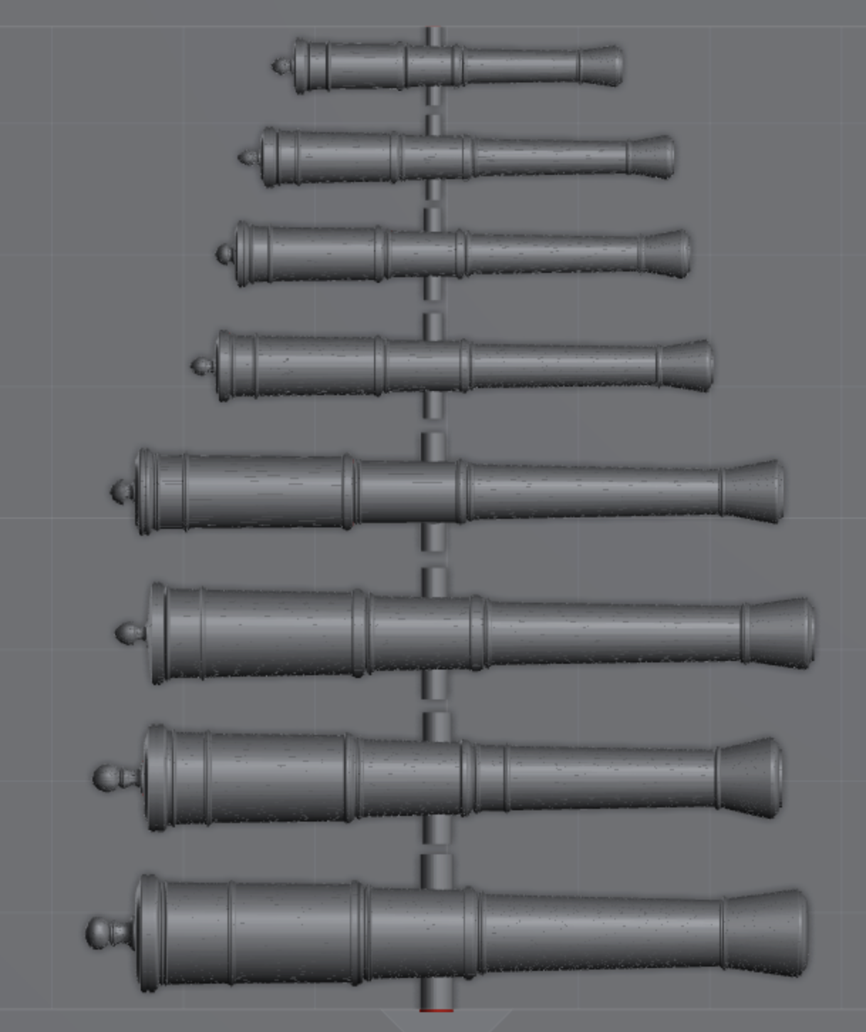

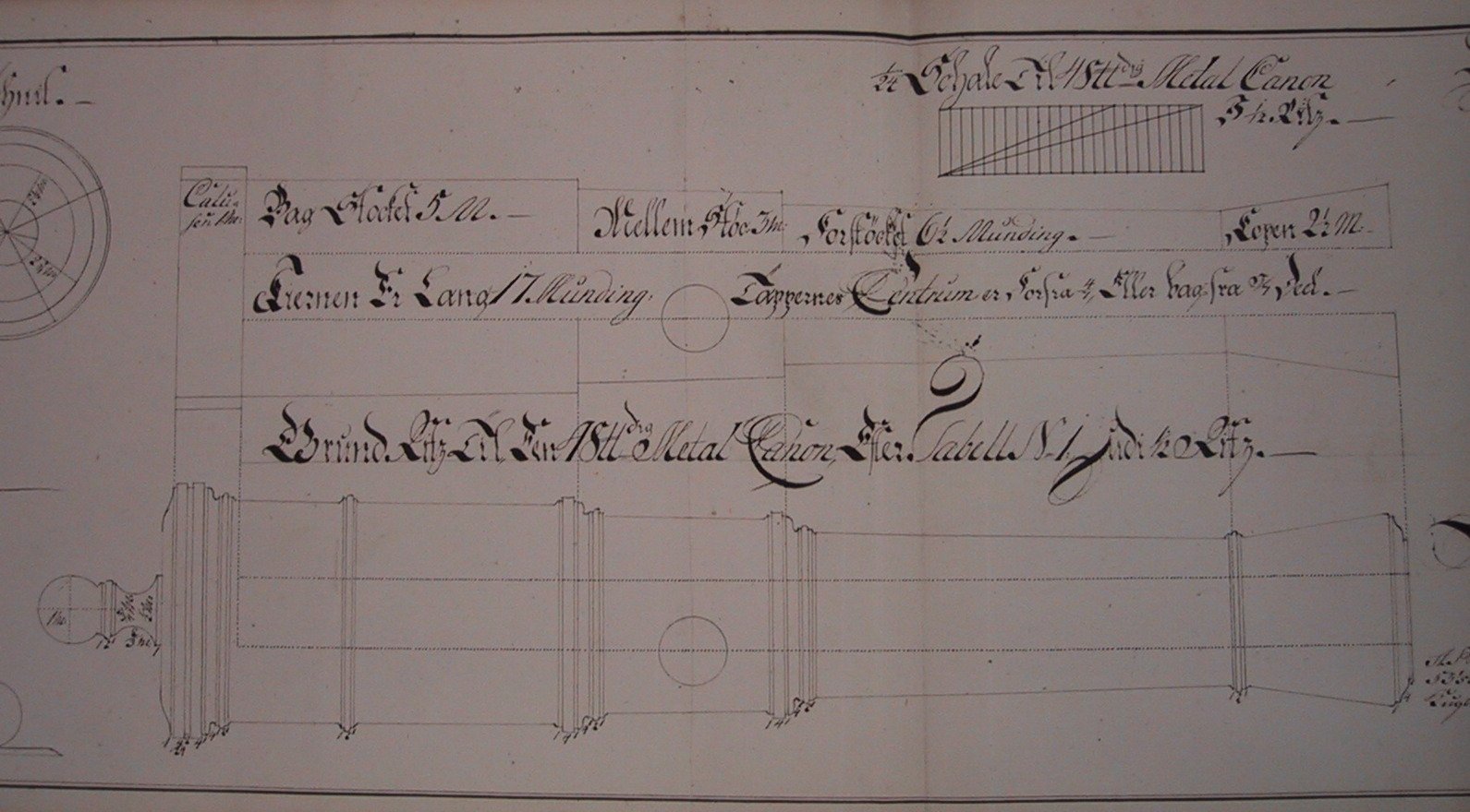

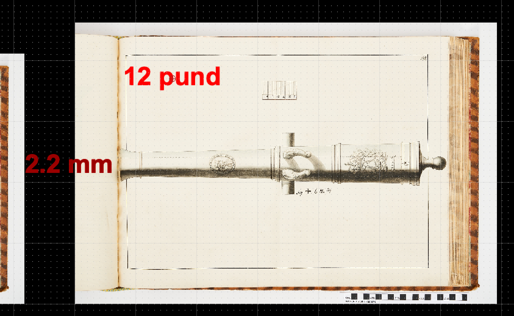

Here are the drawings used:

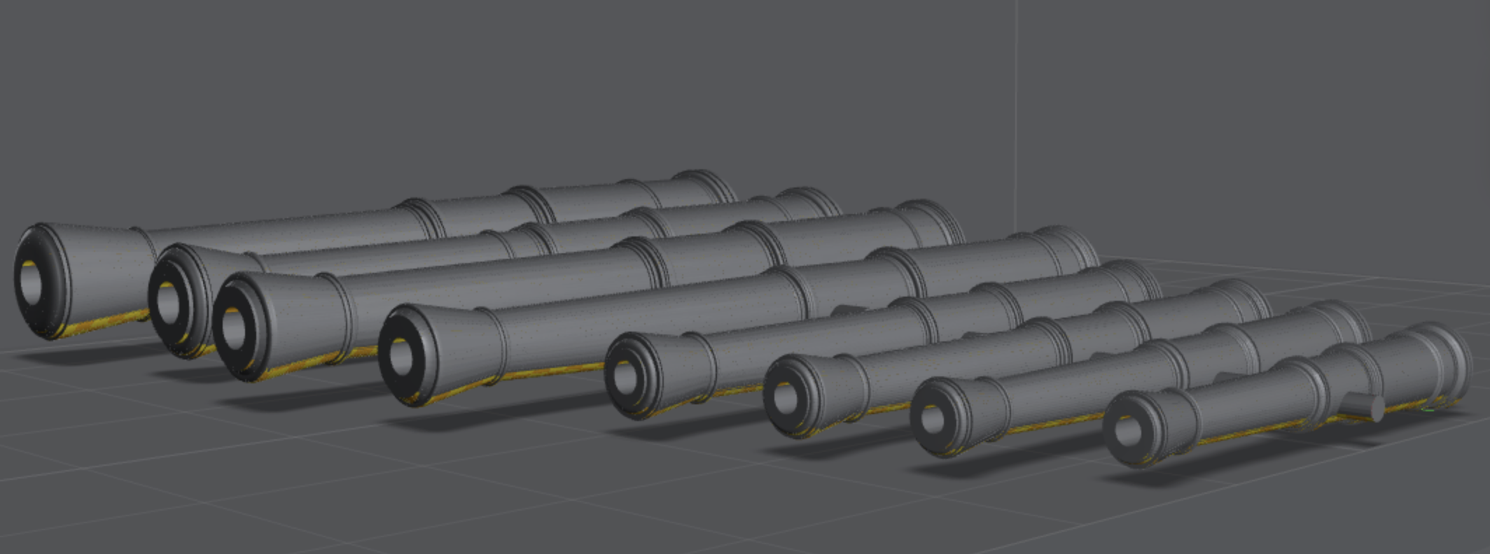

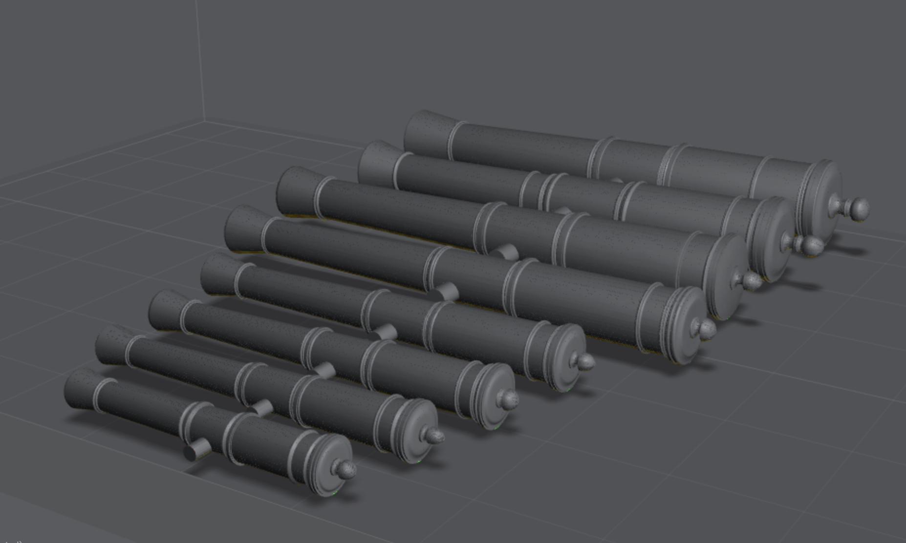

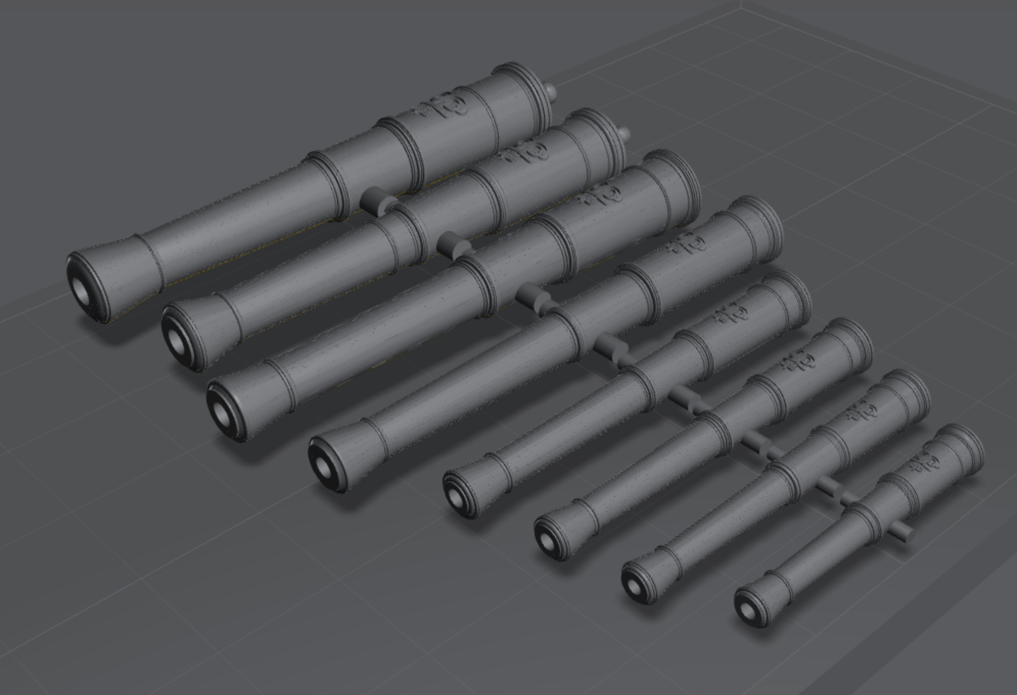

Here you can see the files, except for the 42 pounder:

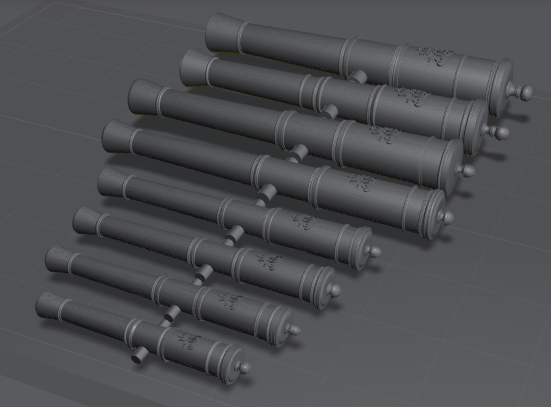

And then I have versions with the monogram of King Christian VI, which should be appropriate for the period (though Frederik IV and Fredrik V could also be appropriate).
You can see some of these (8, 18 and 36 pounders) printed in 1/32 scale in @Beckmann's build log for Tre Kroner.
The STL files are in 1:64 scale, but are of course easily re-sizable to any other scale.
I will attach the STLs in the next few posts

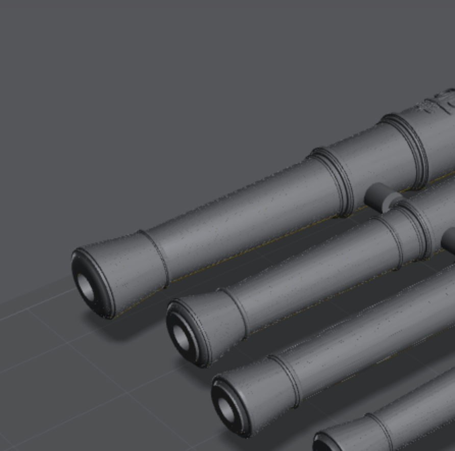

3 pounder - no monogram:
3 pund.stl
4 pounder - no monogram:
4 pund.stl
6 pounder - no monogram:
6 pund.stl
8 pounder - no monogram:
8 pund.stl
12 pounder - no monogram:
12 pund.stl
18 pounder - no monogram:
18 pund.stl
24 pounder - no monogram:
24 pund.stl
36 pounder - no monogram:
36 pund.stl
42 pounder - no monogram:
42 pund.stl
3 pounder - C6 monogram:
3 pund C6.stl
4 pounder - C6 monogram:
4 pund C6.stl
6 pounder - C6 monogram:
6 pund C6.stl
8 pounder - C6 monogram:
8 pund C6.stl
12 pounder - C6 monogram:
12 pund C6.stl
18 pounder - C6 monogram:
18 pund C6.stl
24 pounder - C6 monogram:
24 pund C6.stl
36 pounder - C6 monogram:
36 pund C6.stl
42 pounder - C6 monogram:
42 pund C6.stl

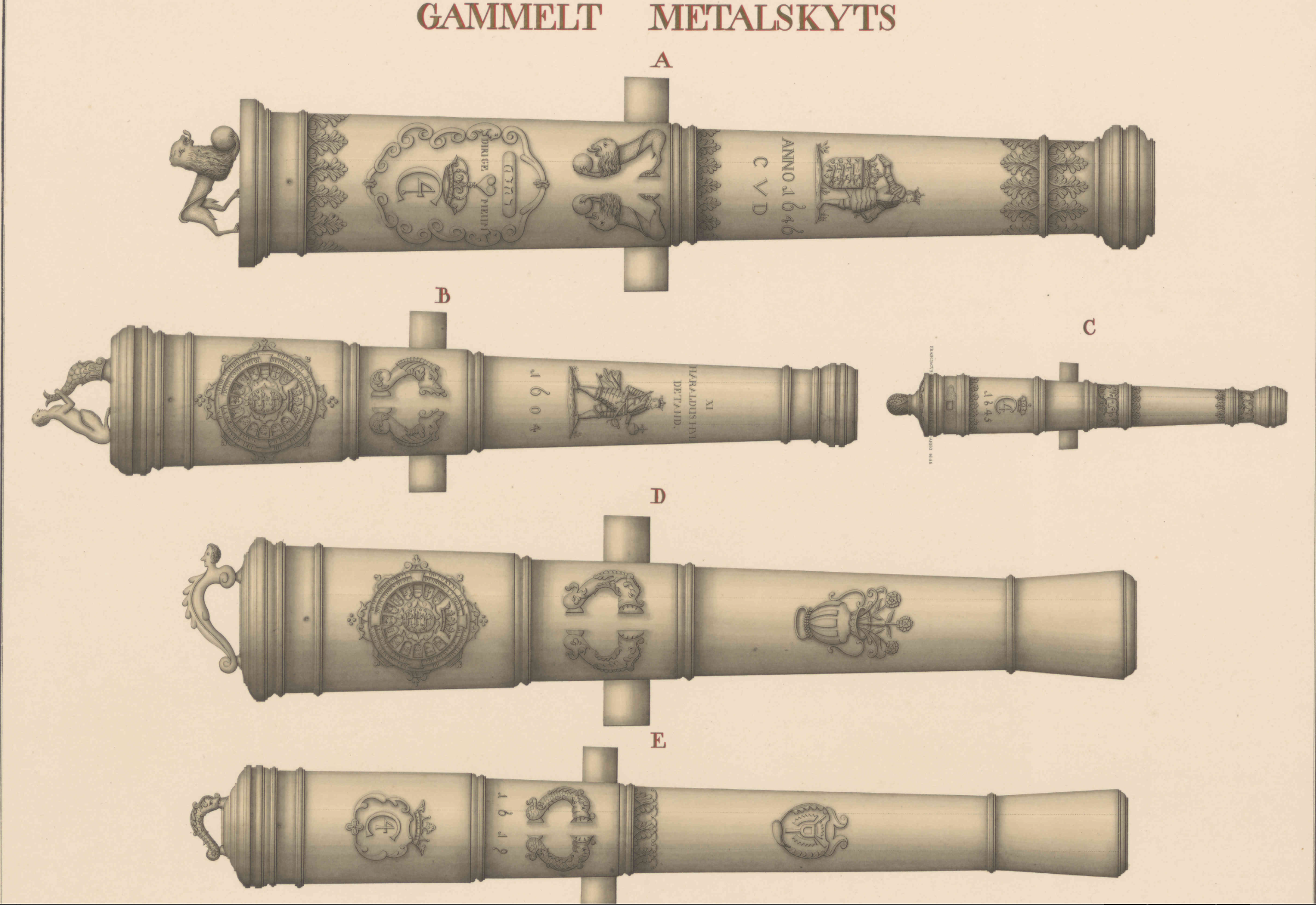

Time for little update. With a lot of pictures!

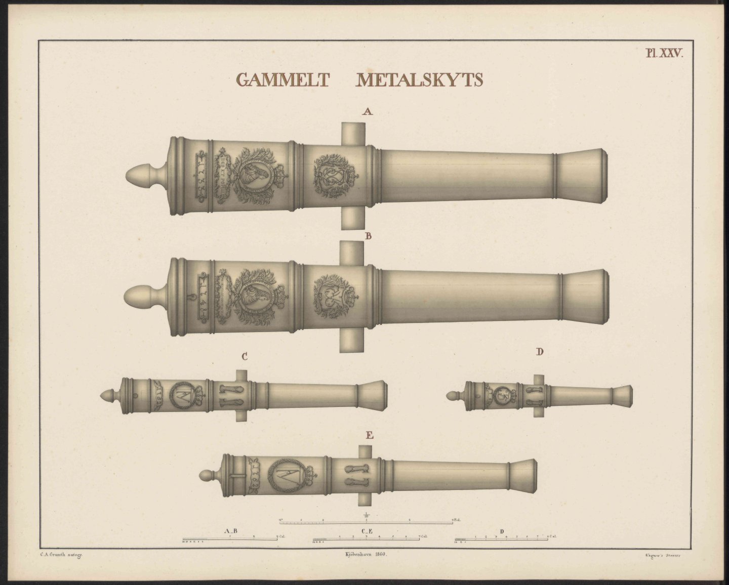

I have been looking for a specific collection of lithographies from 1860 depicting Danish bronze cannon - it is called 'Gammelt Dansk Metalskyts fra det XVIde-XVIIIde Århundrede' which translates to 'Old Danish Metal Artillery from the 16th-18th century'. 'Metal' here means bronze, as opposed to iron.
I found the the royal library had several copies, but none were scanned. It turns out they offer a scanning service free of charge, at least for some documents, so I just placed a request and 3 days later I received an email with a lik to a nice, high resolution PDF scan!
To say I was happy is an understatement!
The drawings are absolutely wonderfull, here's a taste (btw, it is fully permissable to reproduce these for any purpose, as long as credit is given to the royal library - you can find the work now as open access here)here :
These are primarily from the 1600's as these from the time of Christian IV, but there are a few from the 1700's as well, and one from the time of Christian VI - basically corresponding to the 36 pounder I posted before - except now I can see the excact decoration of that cannon - the top one in this image:

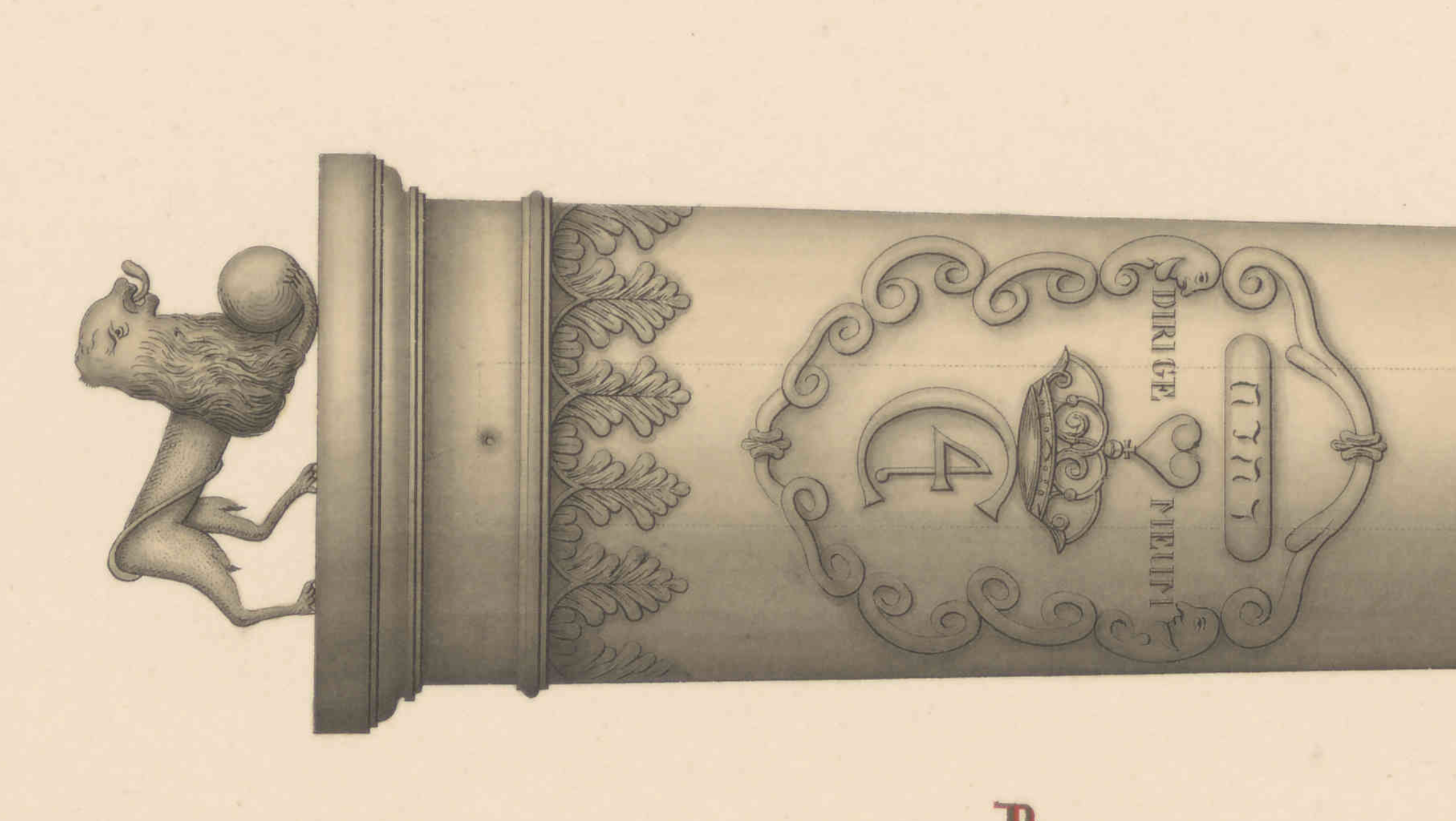

Quite a bit more than just a monogram!
Fortunately this is exactly the kind of thing Meshy can help with. I made a total of 5 Meshy runs for various parts of the decoration:
1) the year and frame
2) the motto frame
3) wreath and crown (blank oval)
4) the portrait of Chr. VI
5) the monogram
Based on the mothly subscription cost, this is $2 worth of AI help 😁

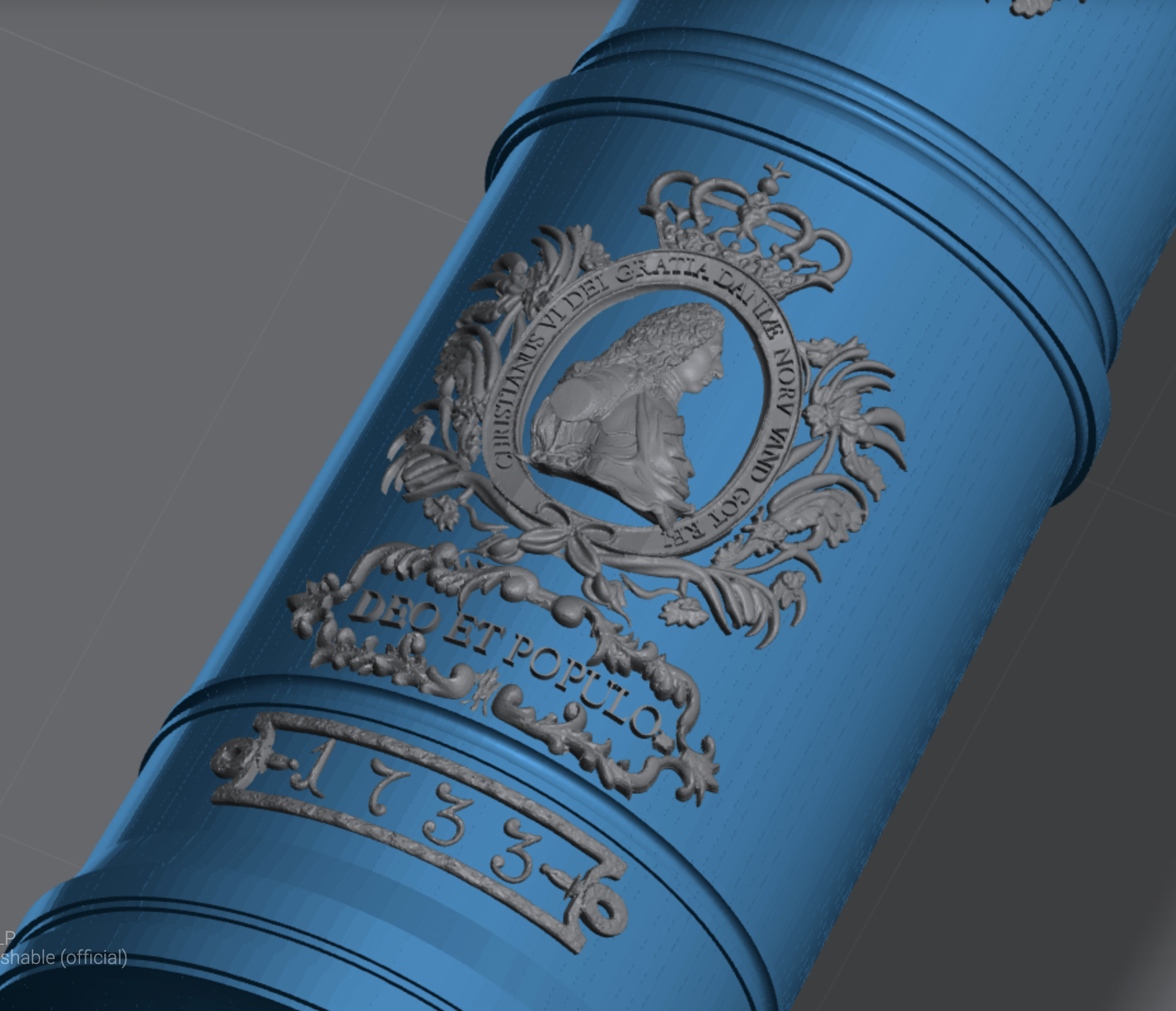

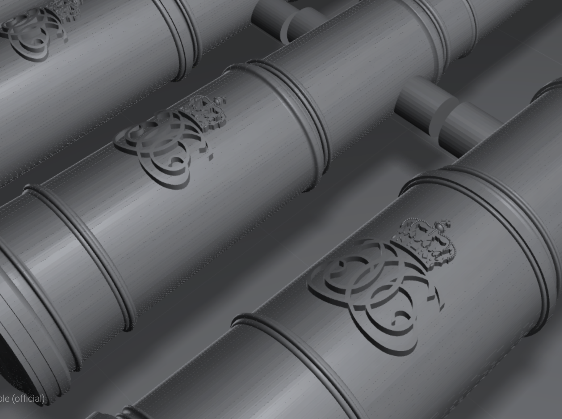

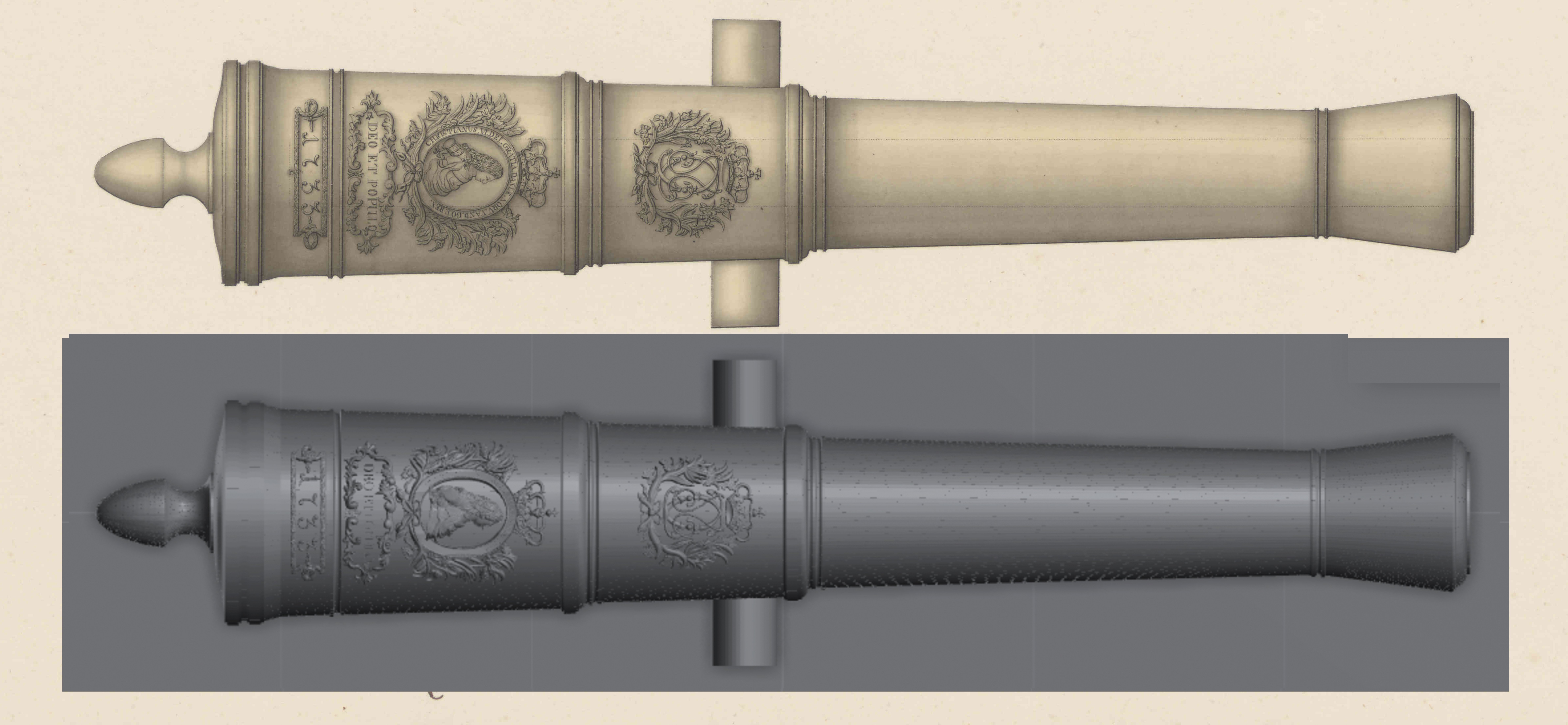

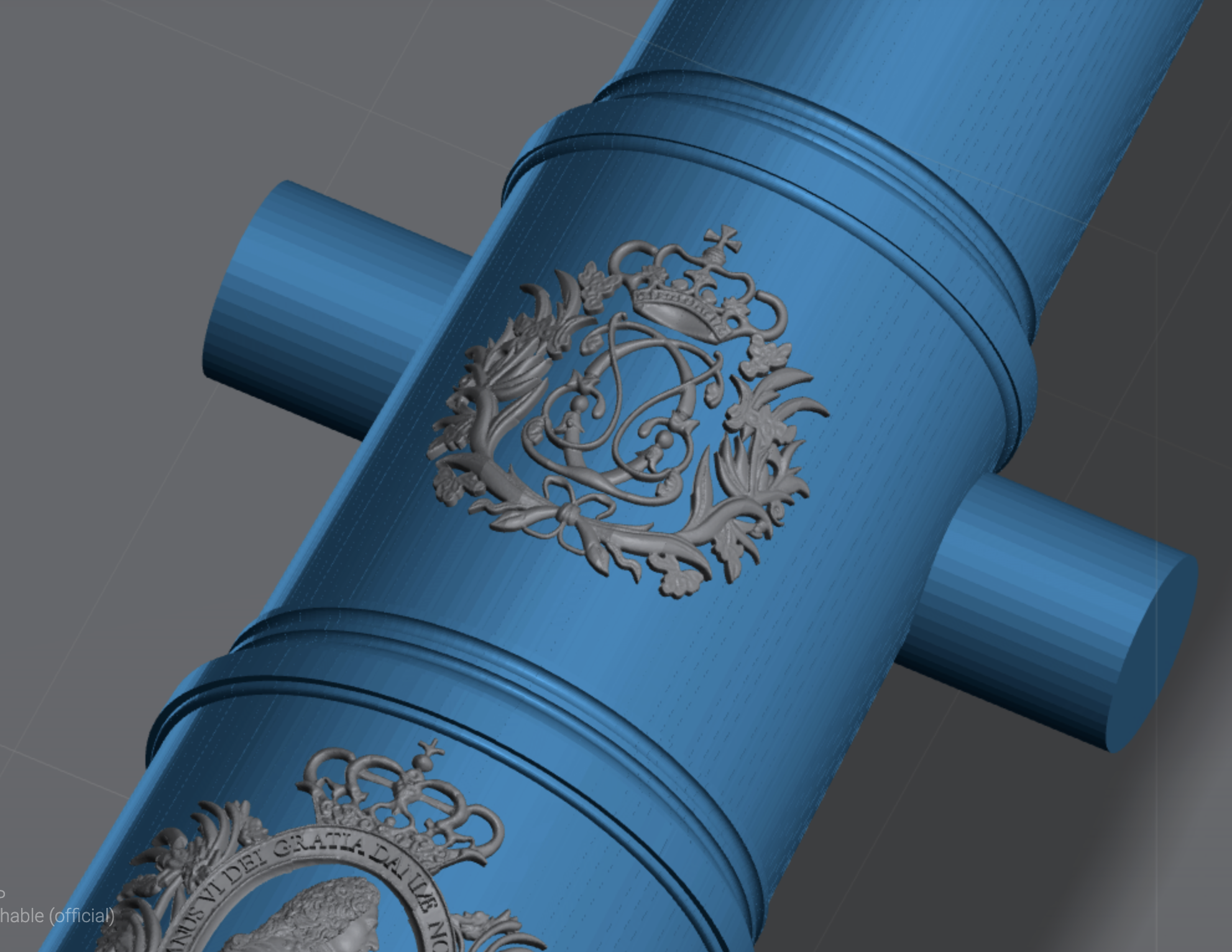

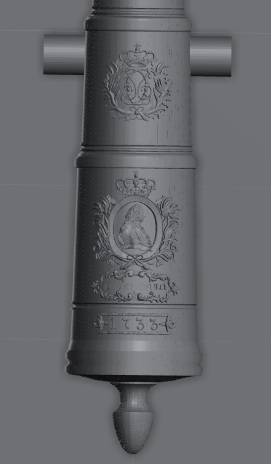

Then it is a question of 'wrapping' the assets around the gun barrel and composing the whole model. Somone who knows Blender and the likes can do this seamlessly - I just chop the assets into strips/pieces and angle them to get an overall curve. That is a very crude way to du it, but at our modelling scales, it works just fine.
Here's a few shots of the 3D model:
The text is made seperately, drawn in CAD, extruded, imported and placed correctly.
I am quite happy with how this turned out!
Here's a 1:1 comparison with the drawing:

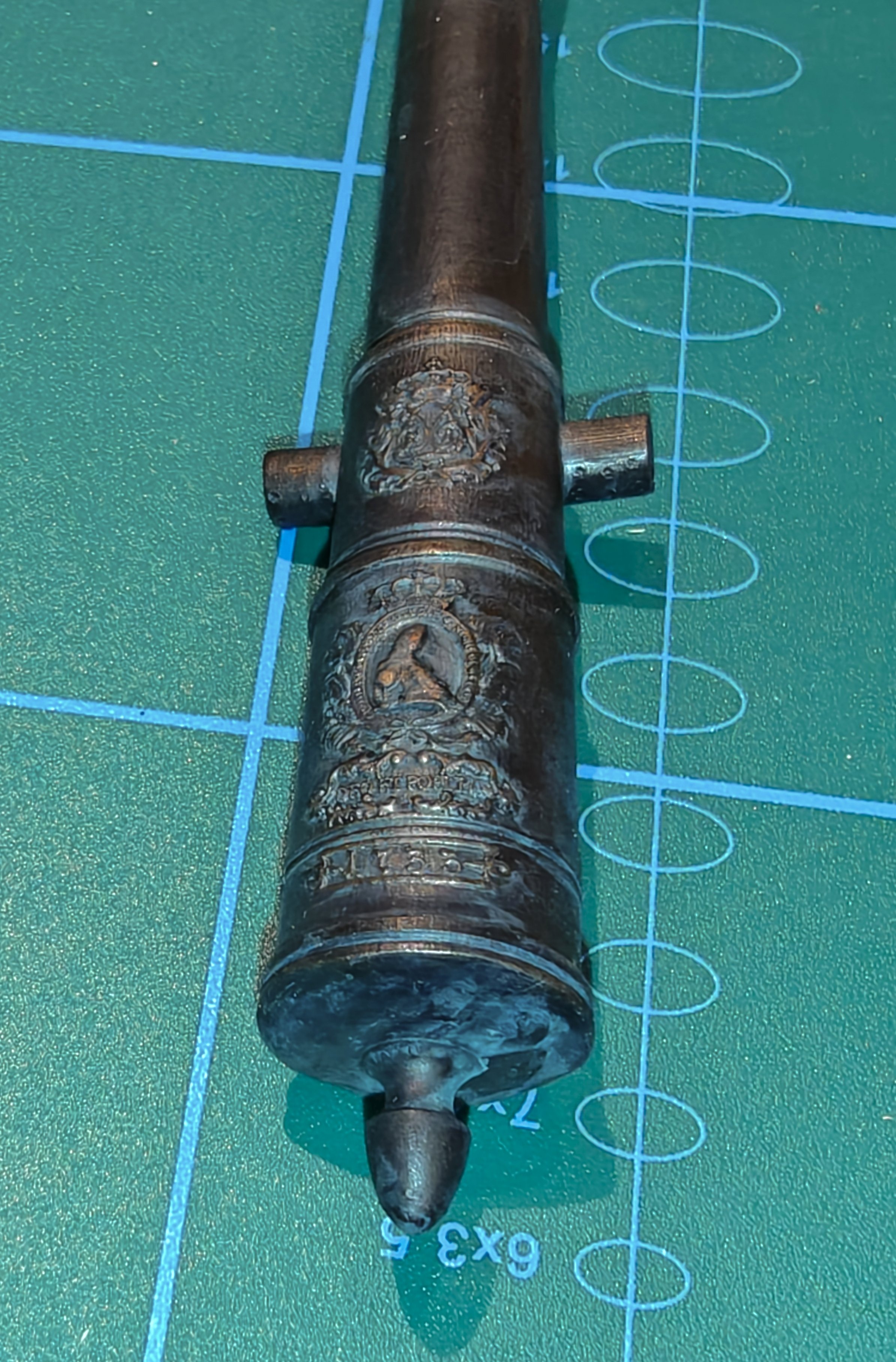

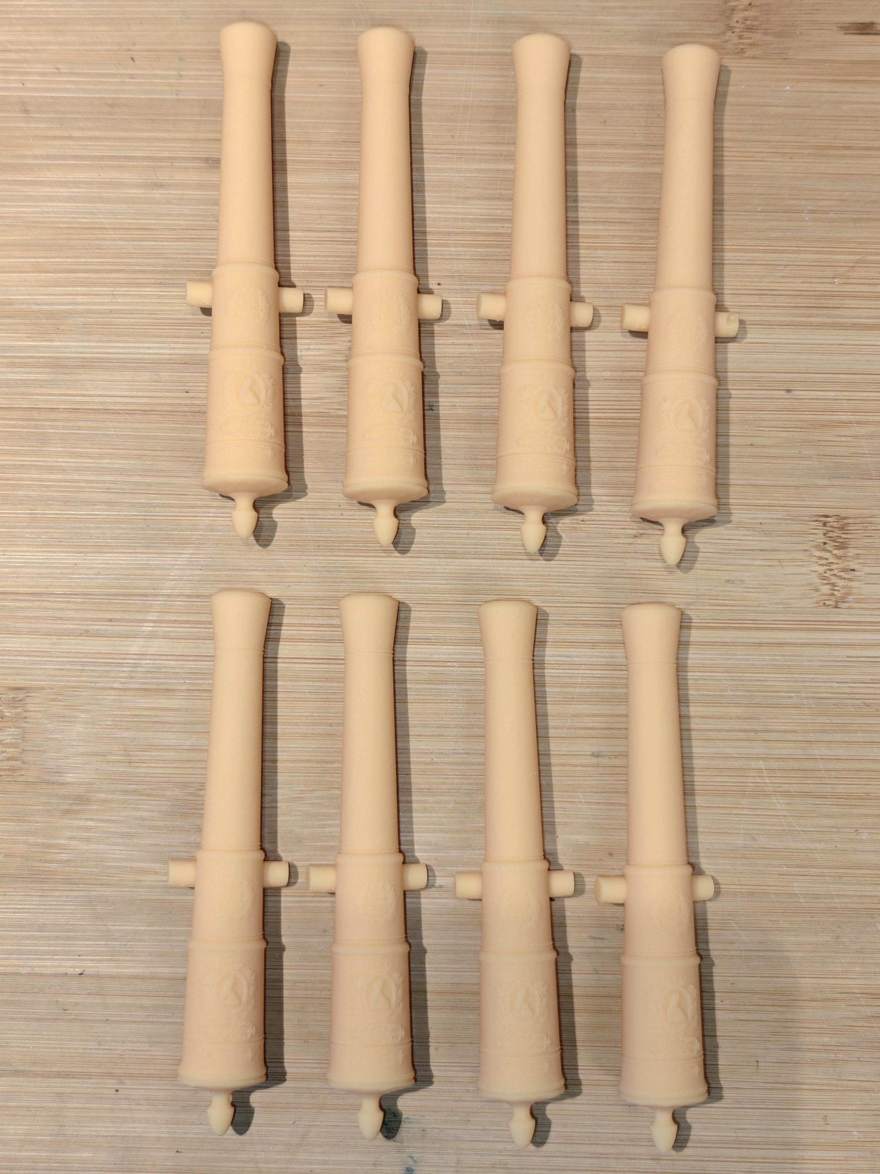

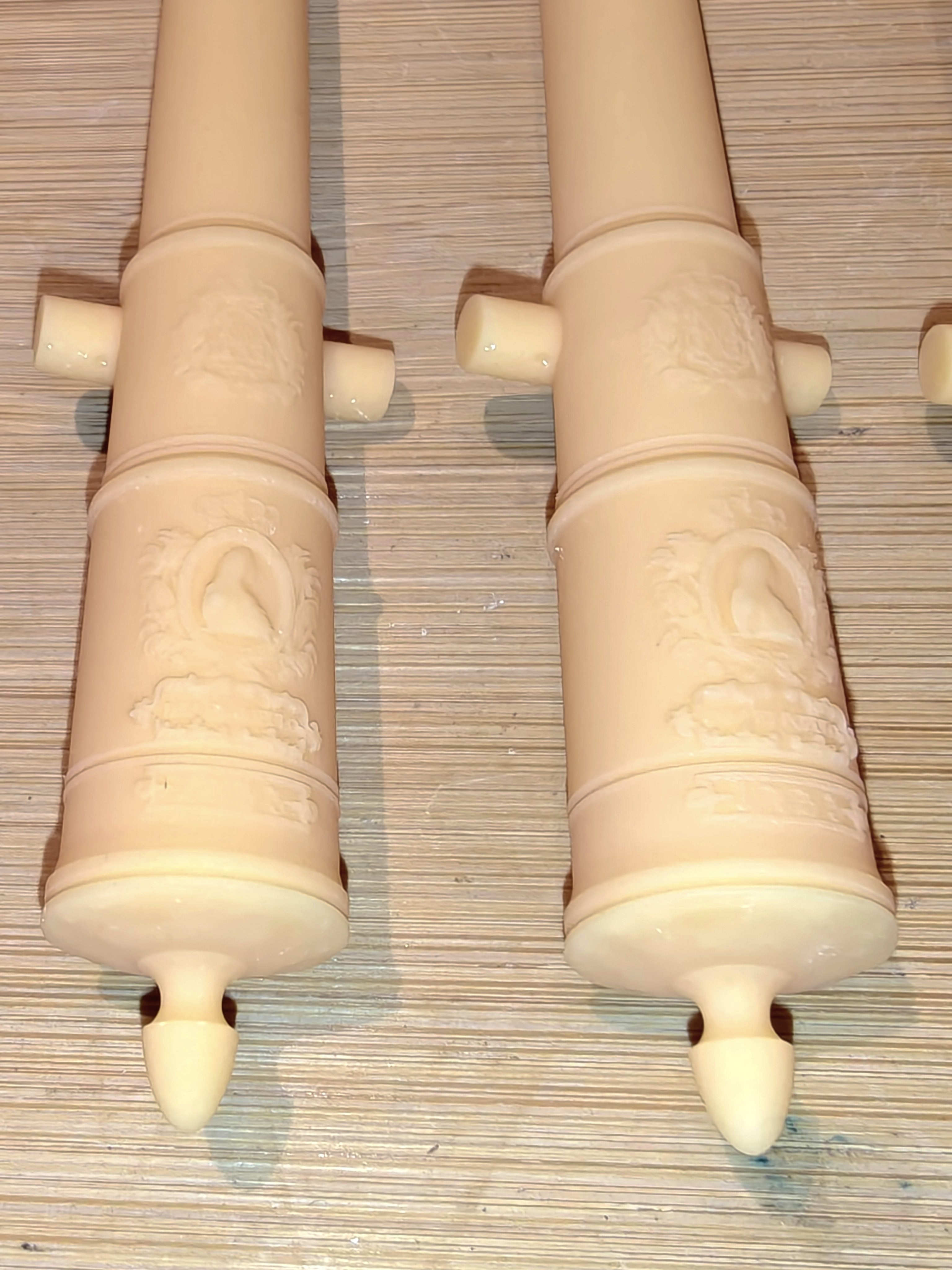

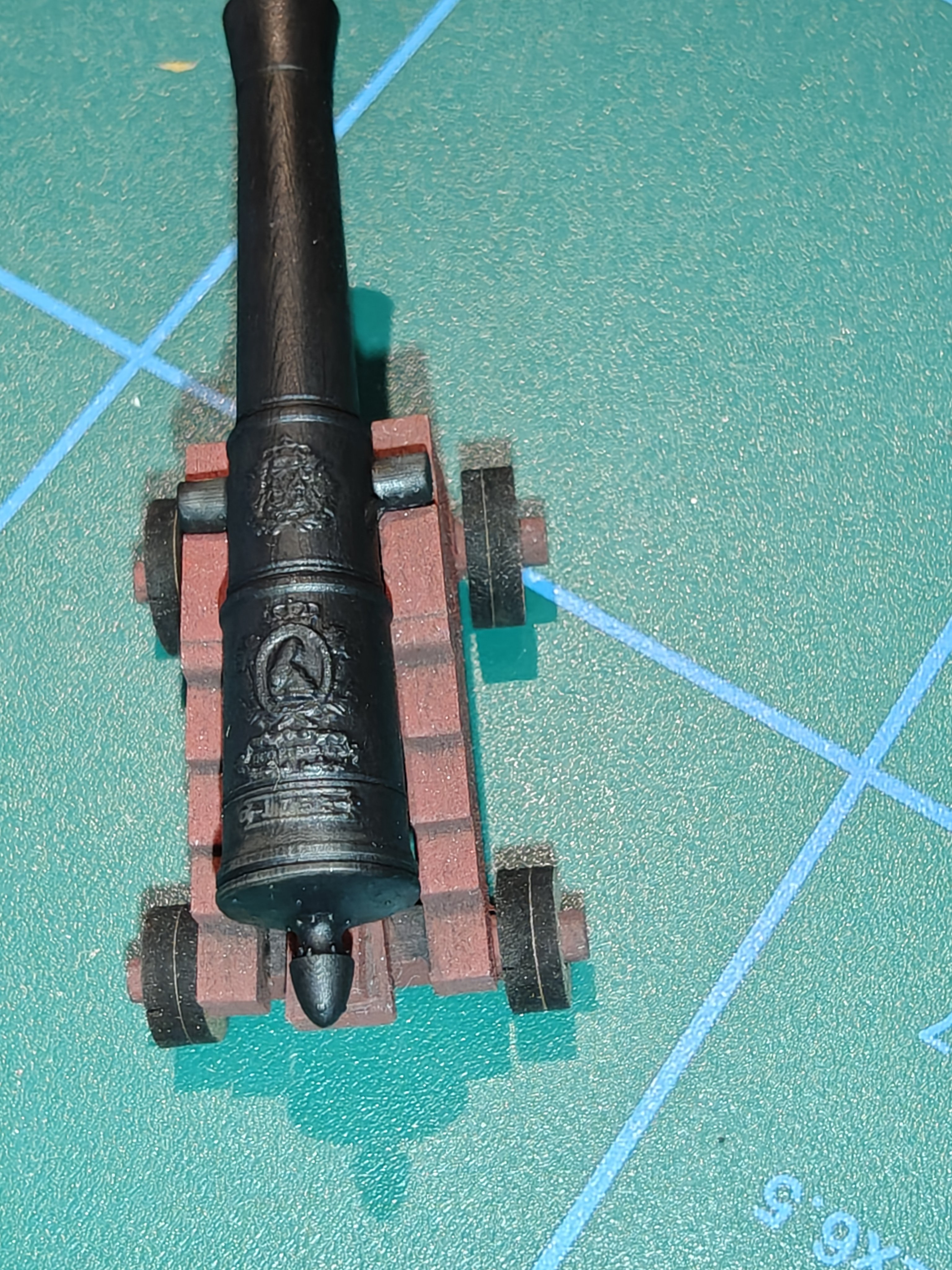

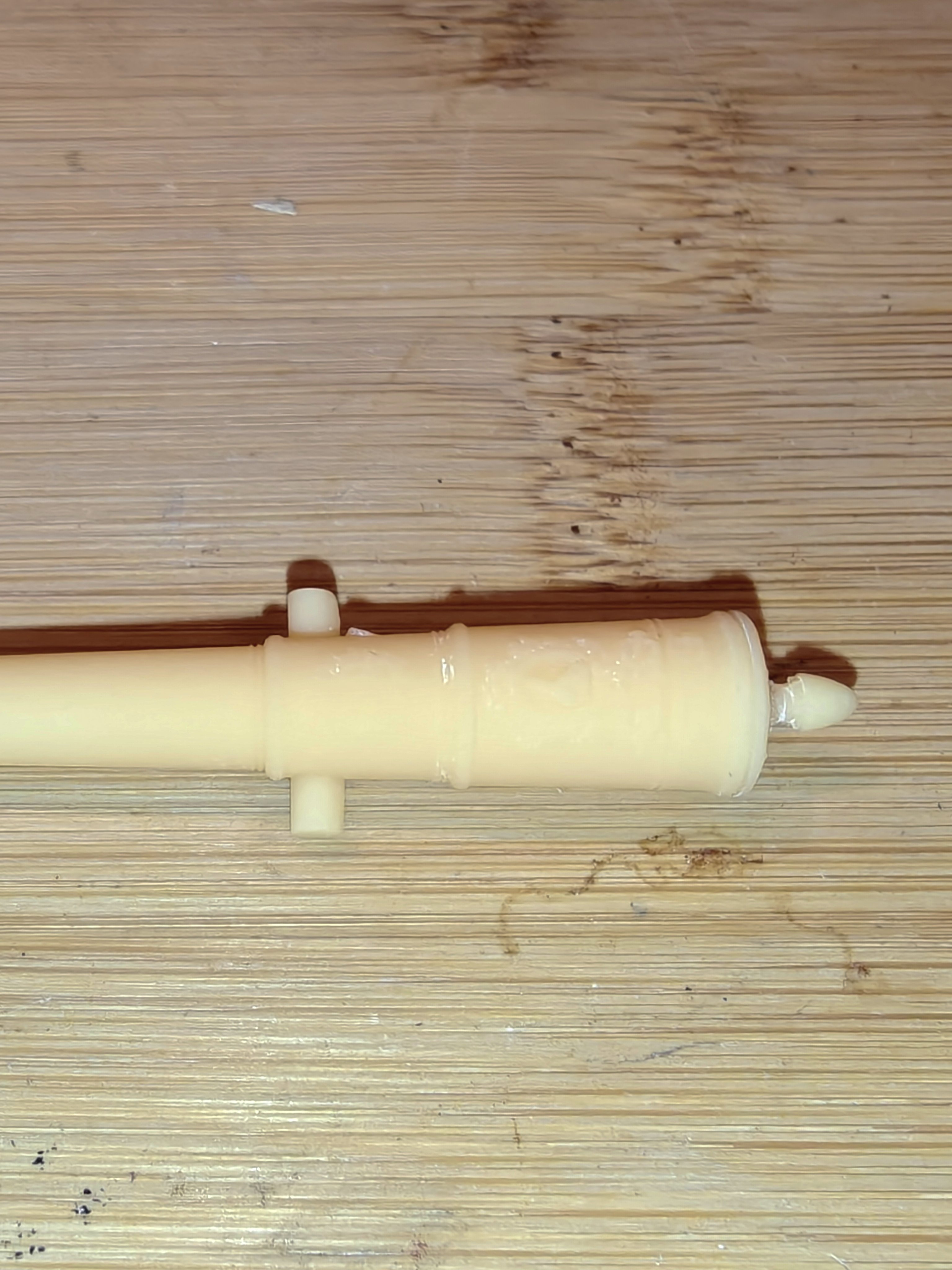

So, does it print?
I chose this particular cannon as I have been helping @Beckmann with cannons for his Tre Kroner and now that I had the actual drawing of the 36 pounder, it was obvious to try to make this one.

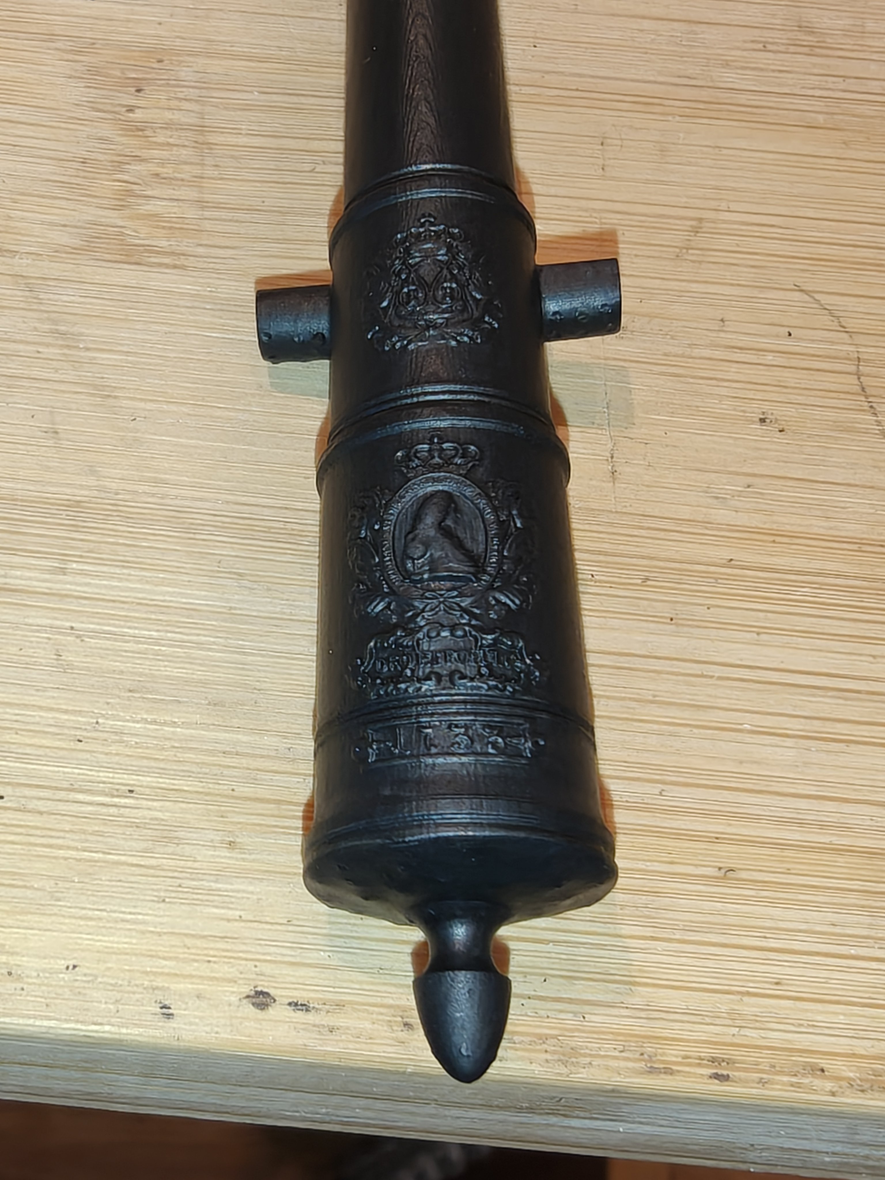

I have printed a set of 1/32 scale for Beckmann and a single 1/64 scale, just to see what would show at that scale:

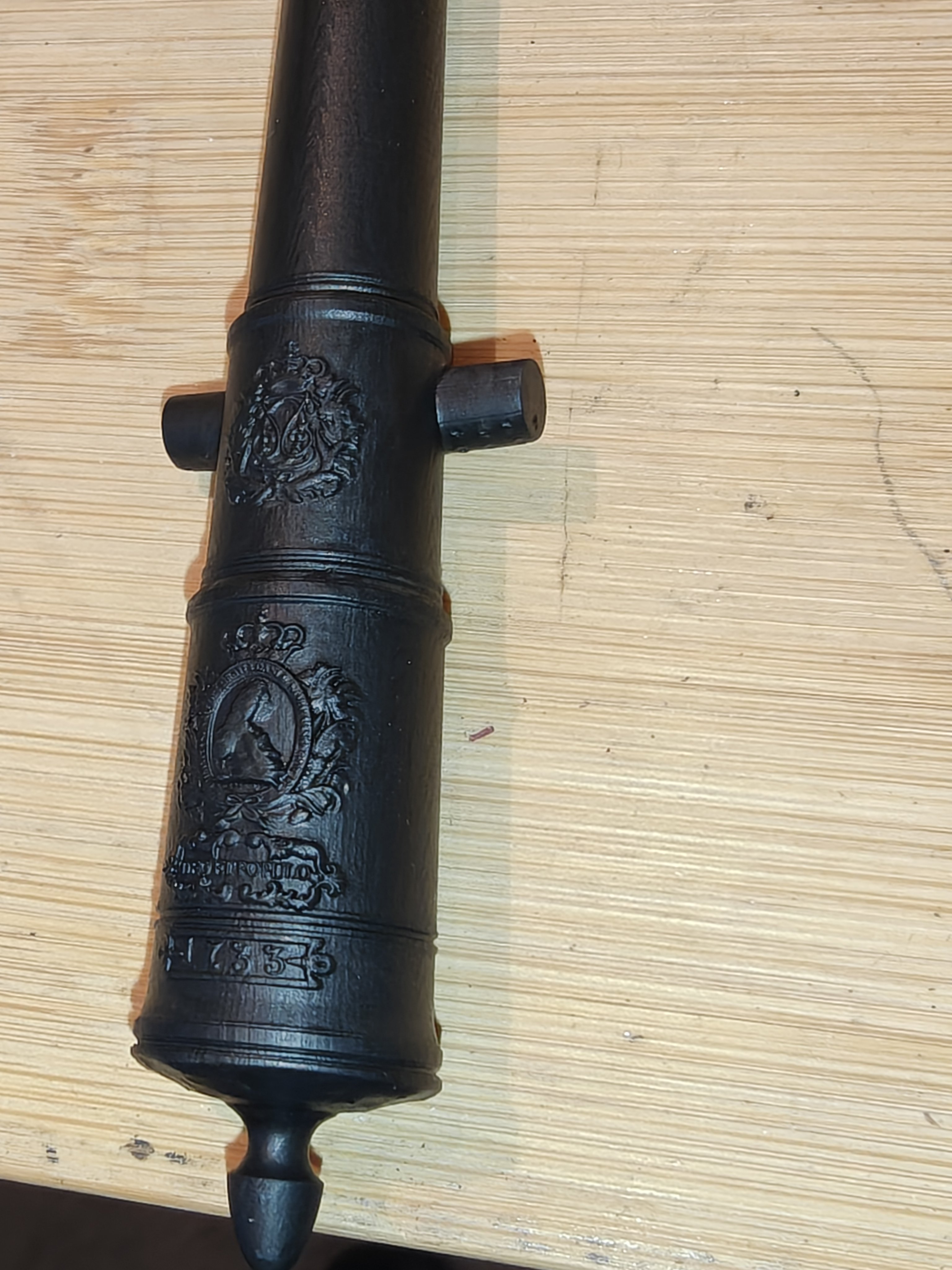

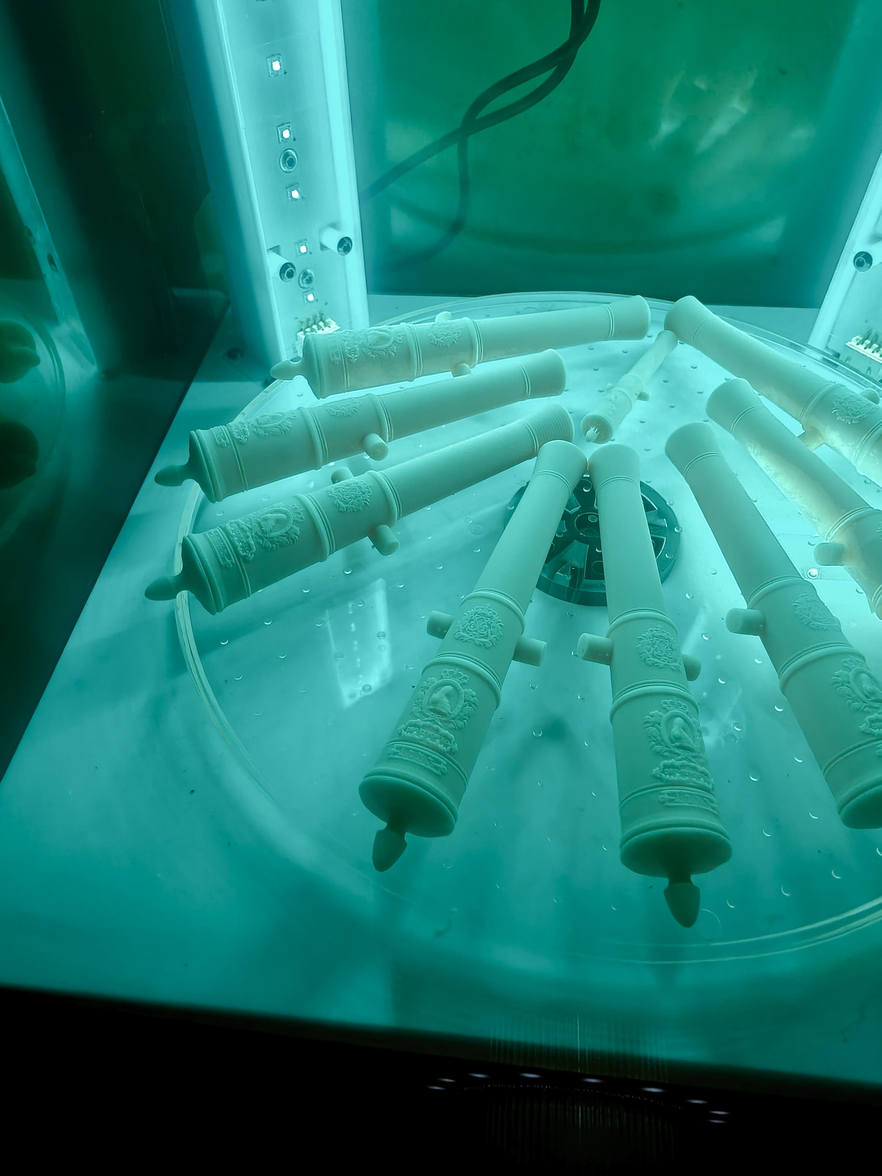

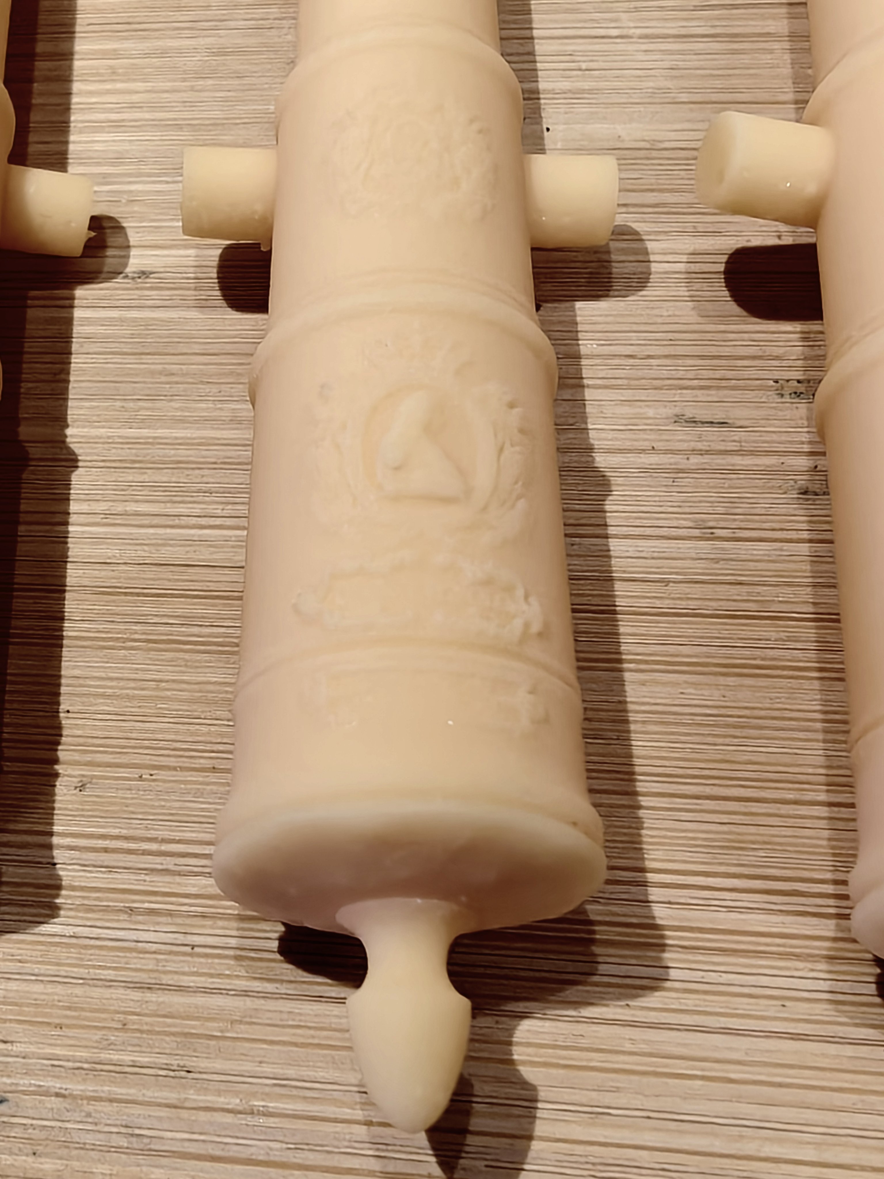

It is very hard to see the details on the beige resin, but it shows better under the UV curing light:
Painted black:
Bronze highlights:

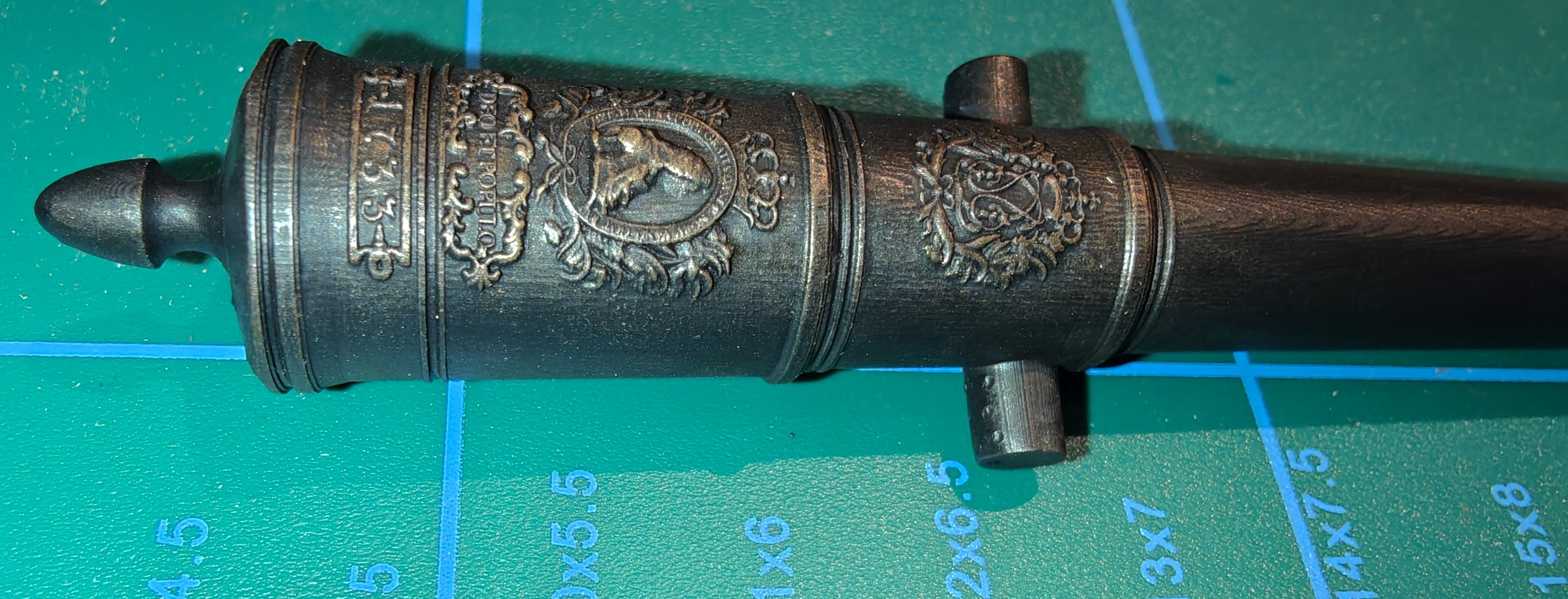

Weathered:
(this might require some work to get good...)
Remember, these are macro shots, and it looks a bit rough in places and with the stark flash light, print layer lines are showing quite prominently in the photos - they are almost invisible in real life.
I am also a bit limitet by the 50 mu resolution of my printer - higher resolution of down to 14-18 mu pixels are common for 8K-16K printers and that would surely improve the final print quality!

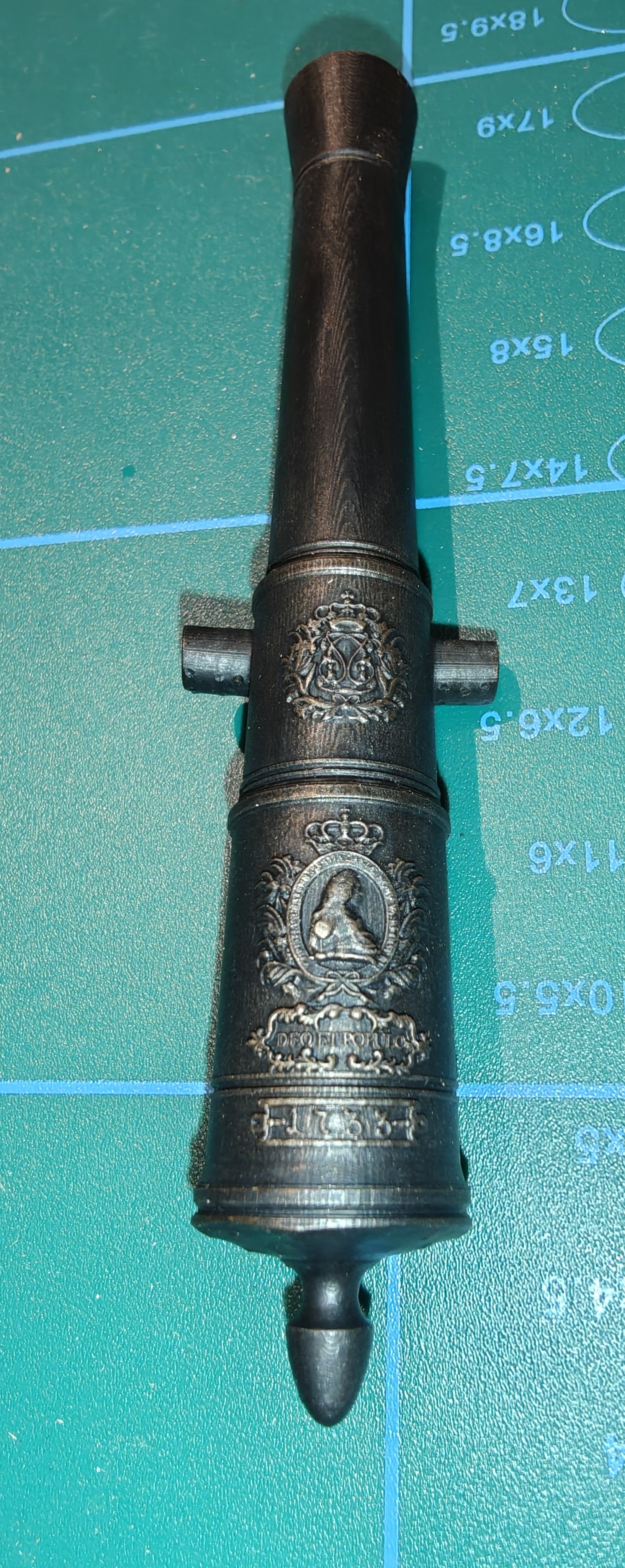

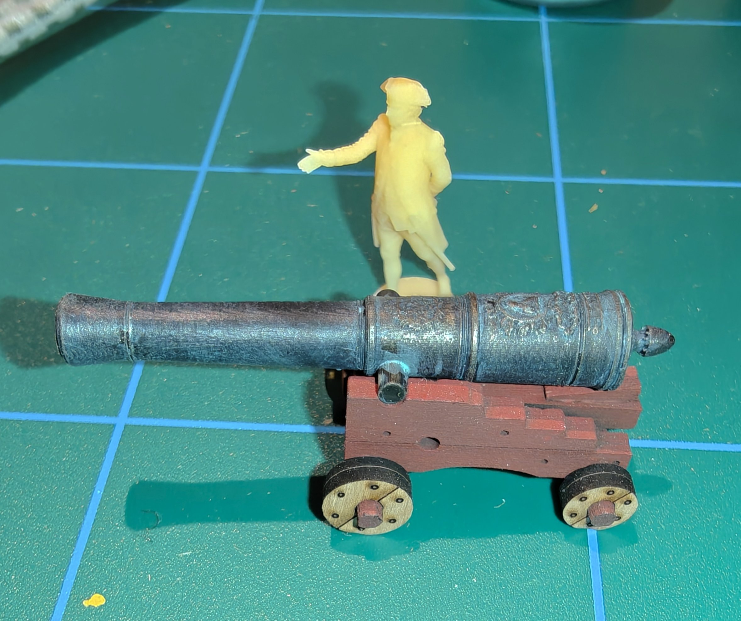

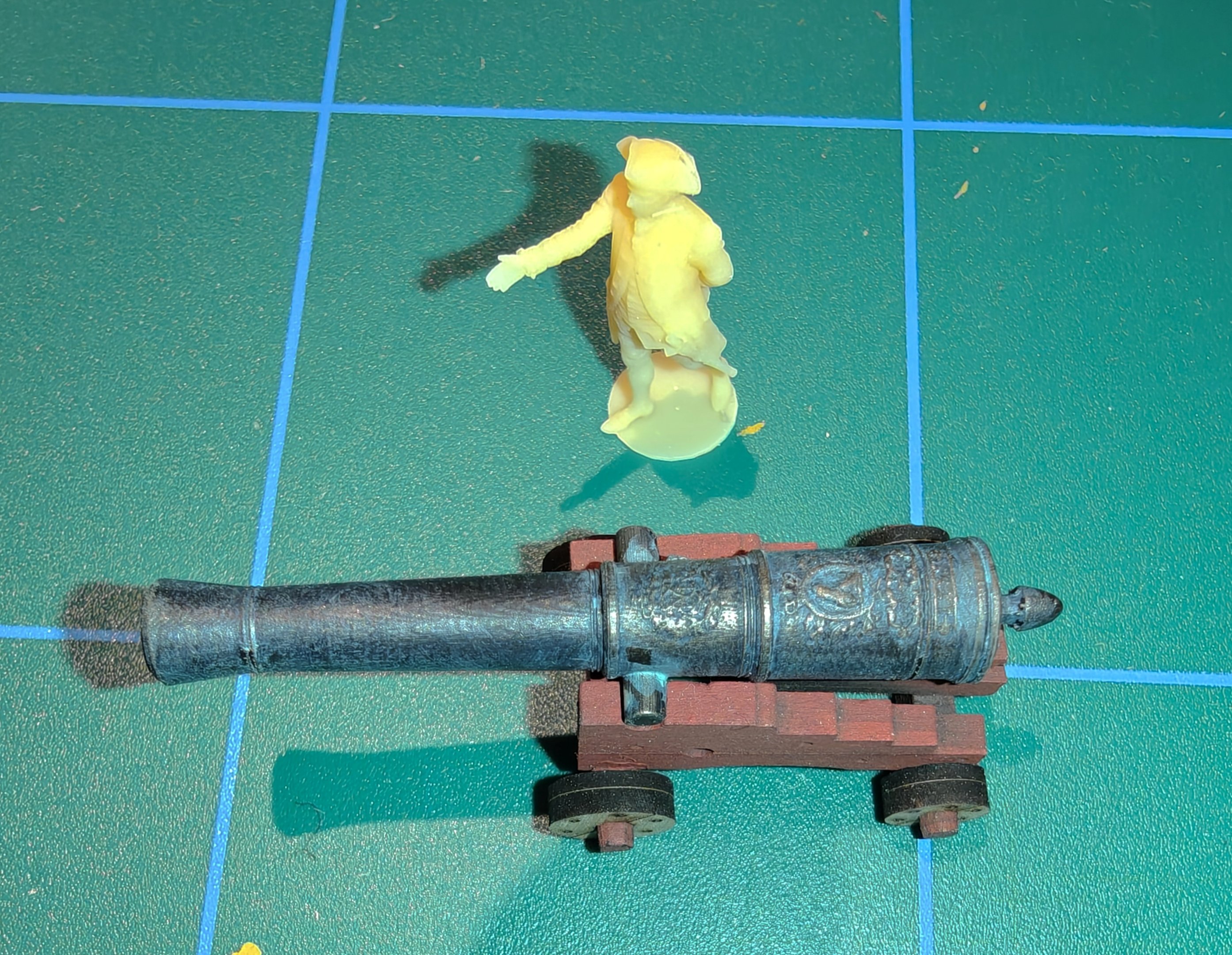

Finally, here are some images of the 1/64 scale print:
The guy at the back, for scale, is also made with Meshy, based on a ChatGPT made image - double AI! 😅

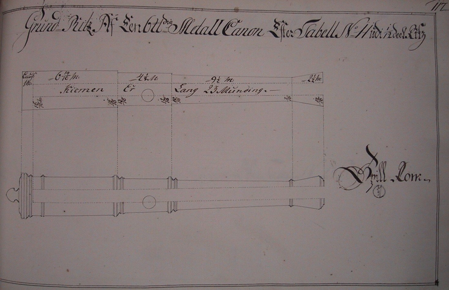

Below is an example of a typical plate, depicting a Danish cannon cast in 1613, i.e. from the period of the reign of Christian IV (or IIII, as it is written on this barrel :)).
Wow, thanks! It looks like there is another 70 or so Danish artillery pieces in that collection! Thanks!

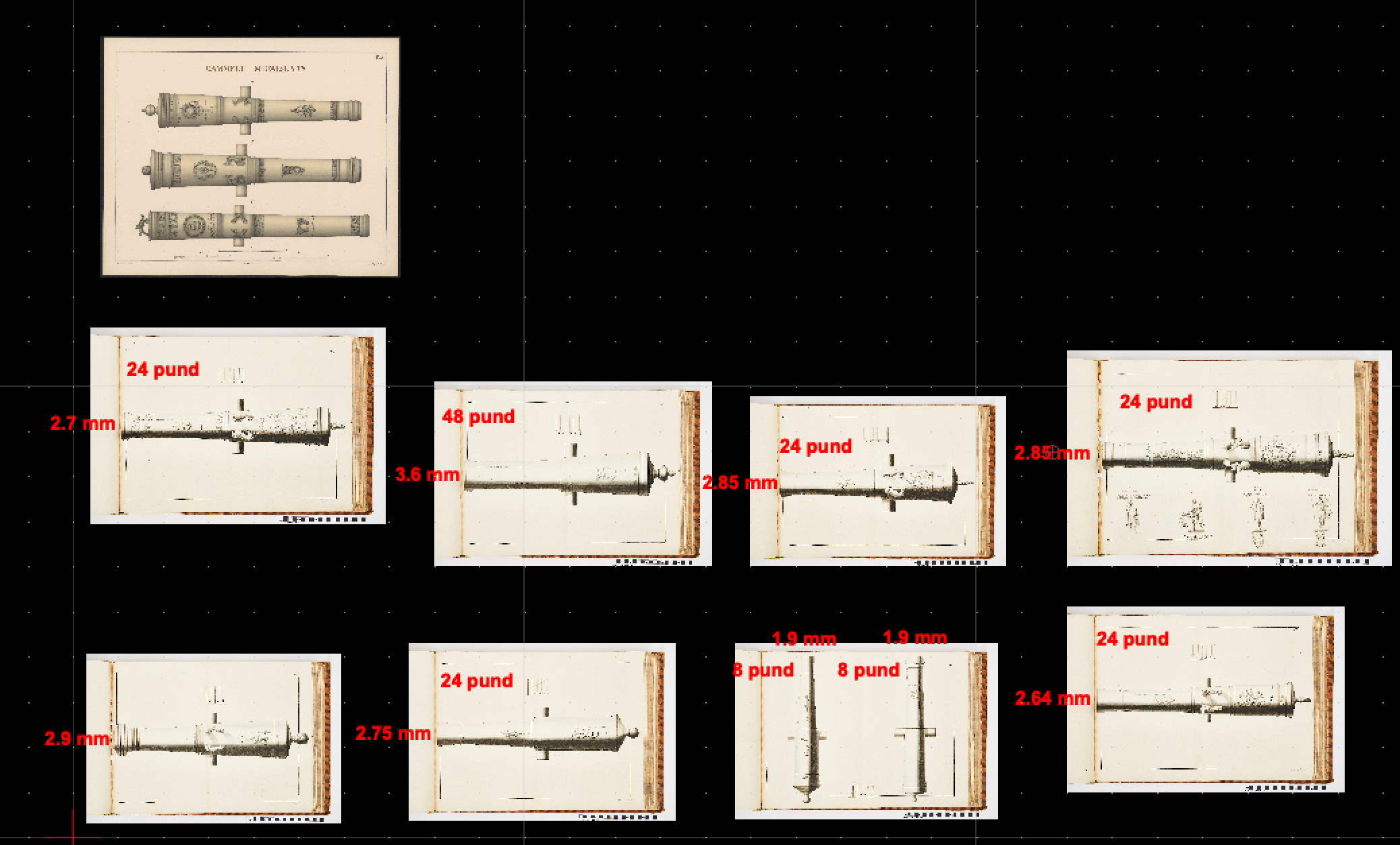

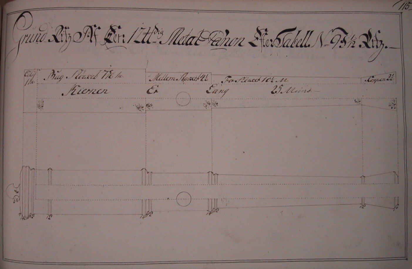

Oh, I have one request for you, but only if it is not too much trouble. After identifying the Danish specimens in Thelott's drawings, would you please send me a list of them by volume and plate number? I would like to mark them as such in my copies.
To be on the safe side, I would like to add that many gun barrels have their weights engraved in the Swedish system, which can also be very useful in identifying the size and calibre of these specimens. This is in Roman numerals, skeppund : lispund : markpund, separated by a ‘:’, in proportions of 400 : 20 : 1, or metrically 136 kg : 6.8 kg : 0.34 kg.
I will probably not go through all of them, but the ones I do find the poundage of, I will report back on.

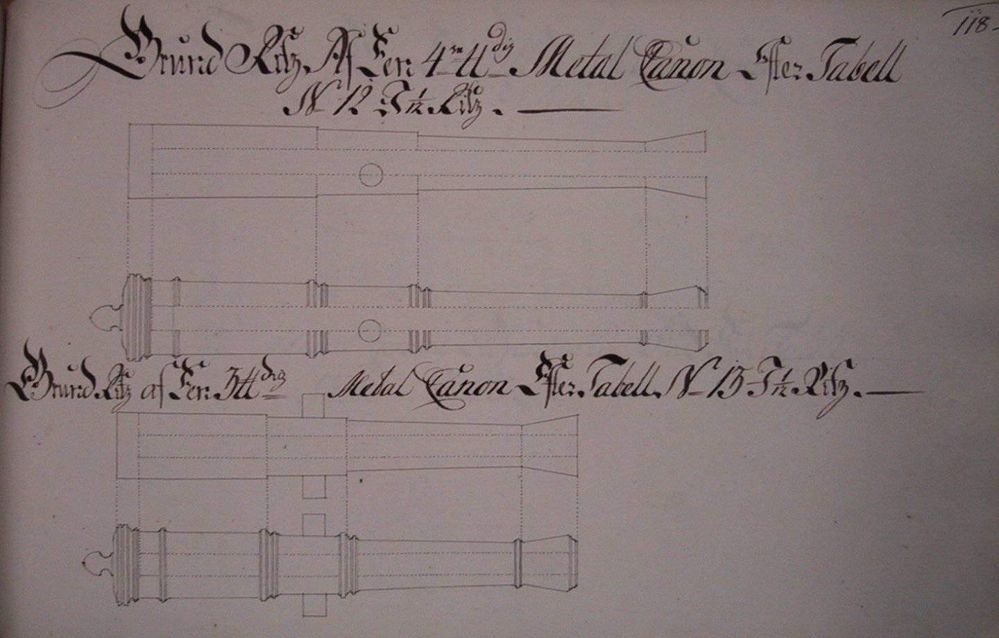

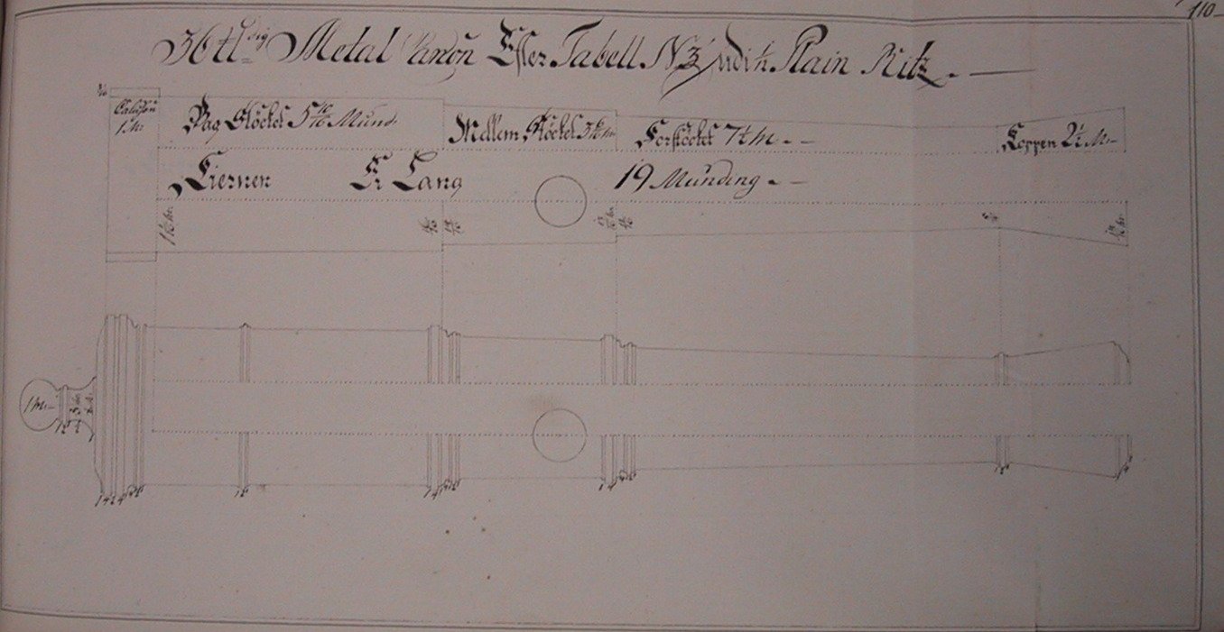

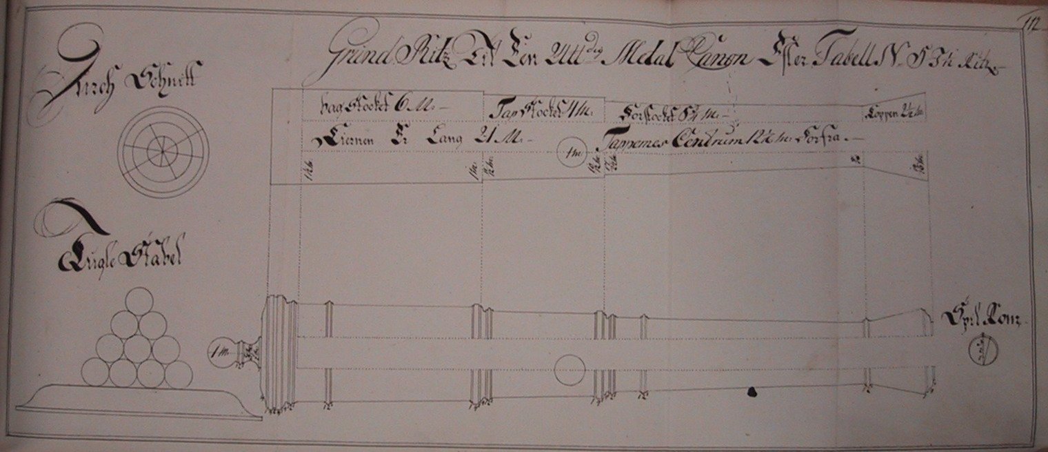

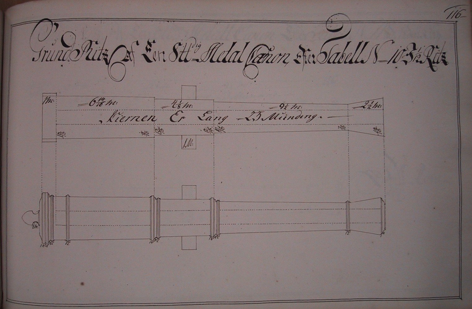

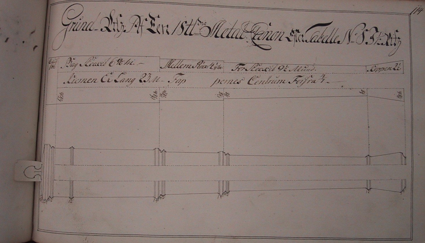

But the scale in the drawings are puzzling. It goes from 0 to 24 in increments of 4, so I assumed the unit was Swedish inches, and thus the total would be two Swedish feet. But that does not fit at all! I have a pattern of 24 pounder which is depicted both by Thellott and Grunth so I can make a direct comparison there snd use that for the rest of the Thelott drawings. The difference is huge: if I assume Thelott's scale is Swedish inches, I have to reduce to 0.603 scale to fit the Grunth drawing!
Was there a unit of length used at Thelott's time that was 0.603 of a Swedish inch? Around 14.9 mm?
Ah, these supposed scales do not show absolute units of length, but rather a gun's calibre divided into 24 smaller parts, because barrels, and especially their small elements such as the thickness and width of the rings and other decorative elements, were designed and measured proportionally in these submultiples of the calibre.
This is precisely the problem with Thelott's drawings, that these ‘scales’ do not facilitate identification at all and even the estimation of size.
In these circumstances, it will probably not be helpful that the Swedish foot is 297 mm, divided into 12 inches.
... and Thelott just arbitrarily scaled the drawings to fit the available space on paper.
Edited by Waldemar
Hmm, I know it was common to measure the length of the bore in calibres, but I don't think the scales in these drawings are abitrary - I agree that the guns are scaled to the size of the paper, but the scale is matching as well. If I scale drawings (at 1/64 scale just for my convenience) to the known 24 pounder from Grunth, and then scale all of Thelott's drawings to that one, I get a very consistent pattern: all the ones i would guess would be 24 pounders (a well known series called 'konger' = kings) all end up with close to the same bore diameter (2.7 cm at my 1/64 scale - plus/minus 0,15 mm). I have also found what must be a 48 pounder and some 8 pounders.
So I do think the scale is somehow absolute and can be used to infer the shot size from the indicted bore diameter. But I have not found any 36 pounders. and I think I have looked into the ones that was plausible.
But there are still so many nice patterns of other sizes, so it is really a great collection!
Edited by TJM

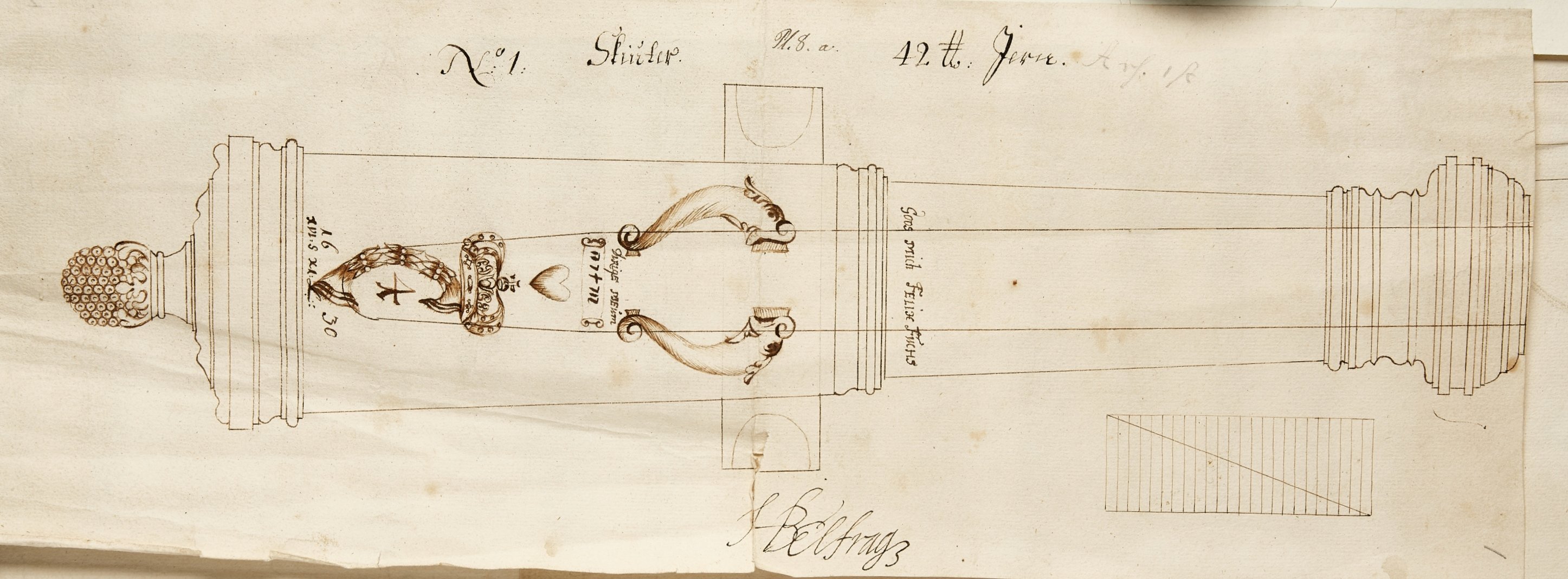

@TJM

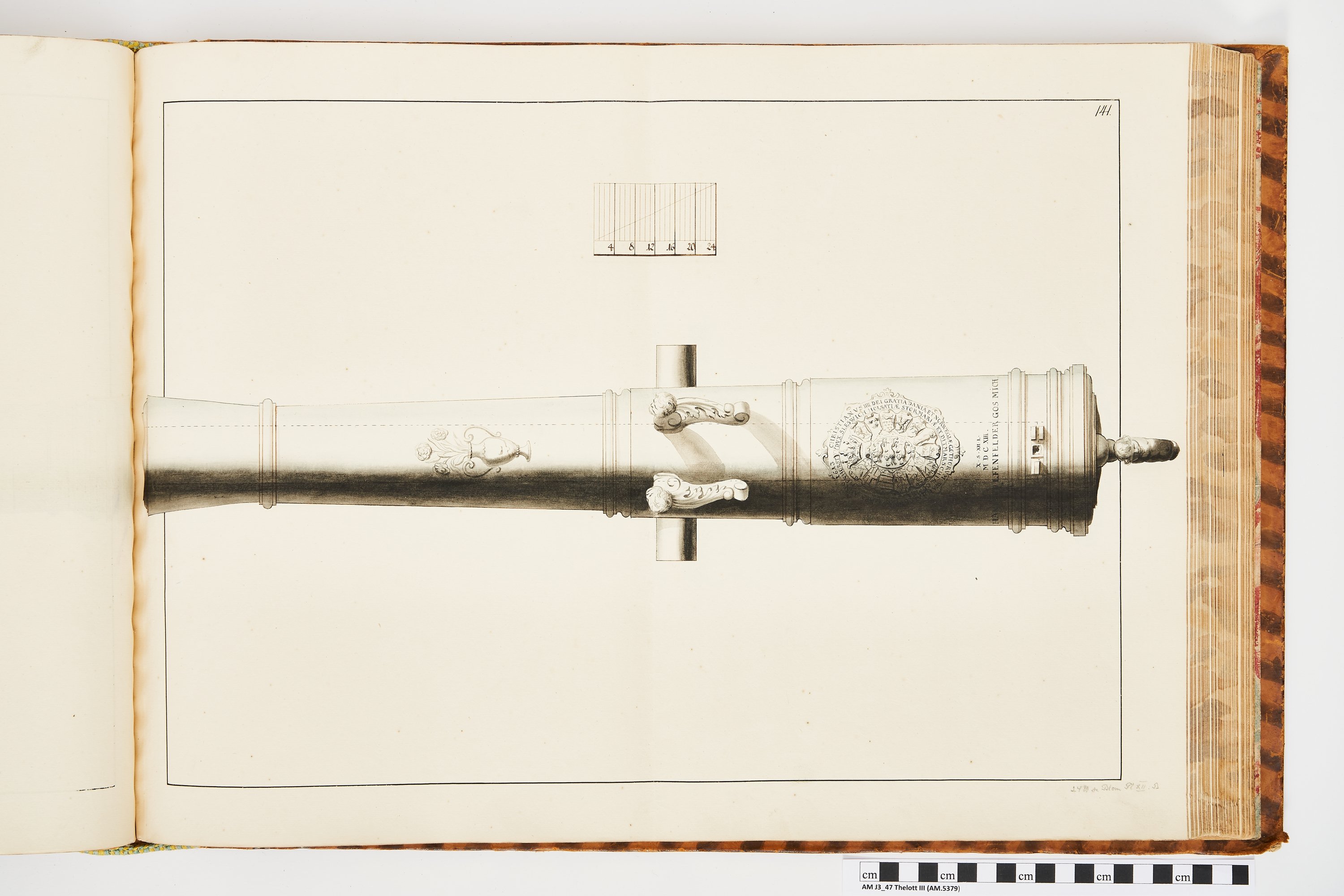

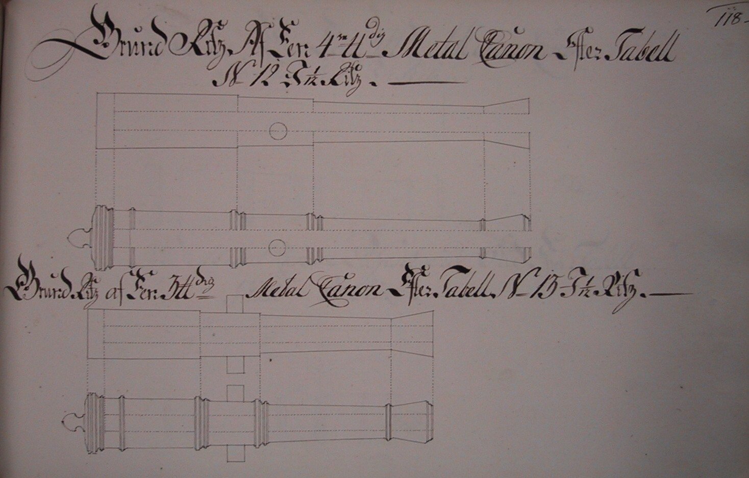

I think I have found a drawing of the Danish 36-pound cannon from the period of Christian IV that you are looking for. It is a chambered cannon, also known as a ‘drake’.
Admittedly, the drawing does say 42 pounds, but it is a Swedish made drawing, and in Swedish artillery of that period, calibre was given in skålpund, which was 0.425 kg. When converted to Danish pounds (0.5 kg), this gives a calibre of 36 pounds.
As in Thelott's drawings, the „scale” is a just gun's calibre divided into 24 parts, so you will have to find the overall size of the barrel by referencing to the known diameter of the gun's bore.
Edited by Waldemar
52 minutes ago, Waldemar said:
@TJM
Fantastic,thank you so much! Where is this image from? Is it a physical book, or do you have a link to the source?
