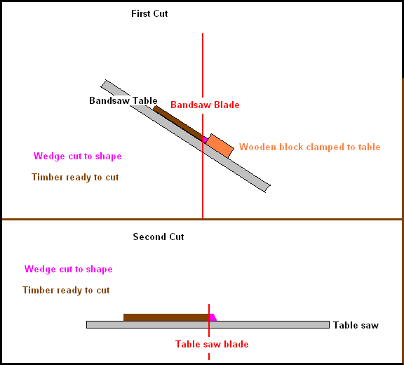

They are looking really good. I cheat though, I turn the shape of the barrel, mark out the staves, then scribe them, then add the rings with thick black construction paper. I am going to try your technique, but how do you cut the wedges?
  Ron W.
Ron W.
Hi Ron.
I use a band saw and a table saw to cut the wedges.
I choose the number of segments I require in the cask.
Example 10 degrees gives me 36 segments.
              15 degrees gives me 24 segments.
              10 degrees gives me 18 segments.
              20 degrees gives me 15 segments.
              24 degrees gives me 12 segments.
The drawing is better than a hundred words :-

Hope this helps.
