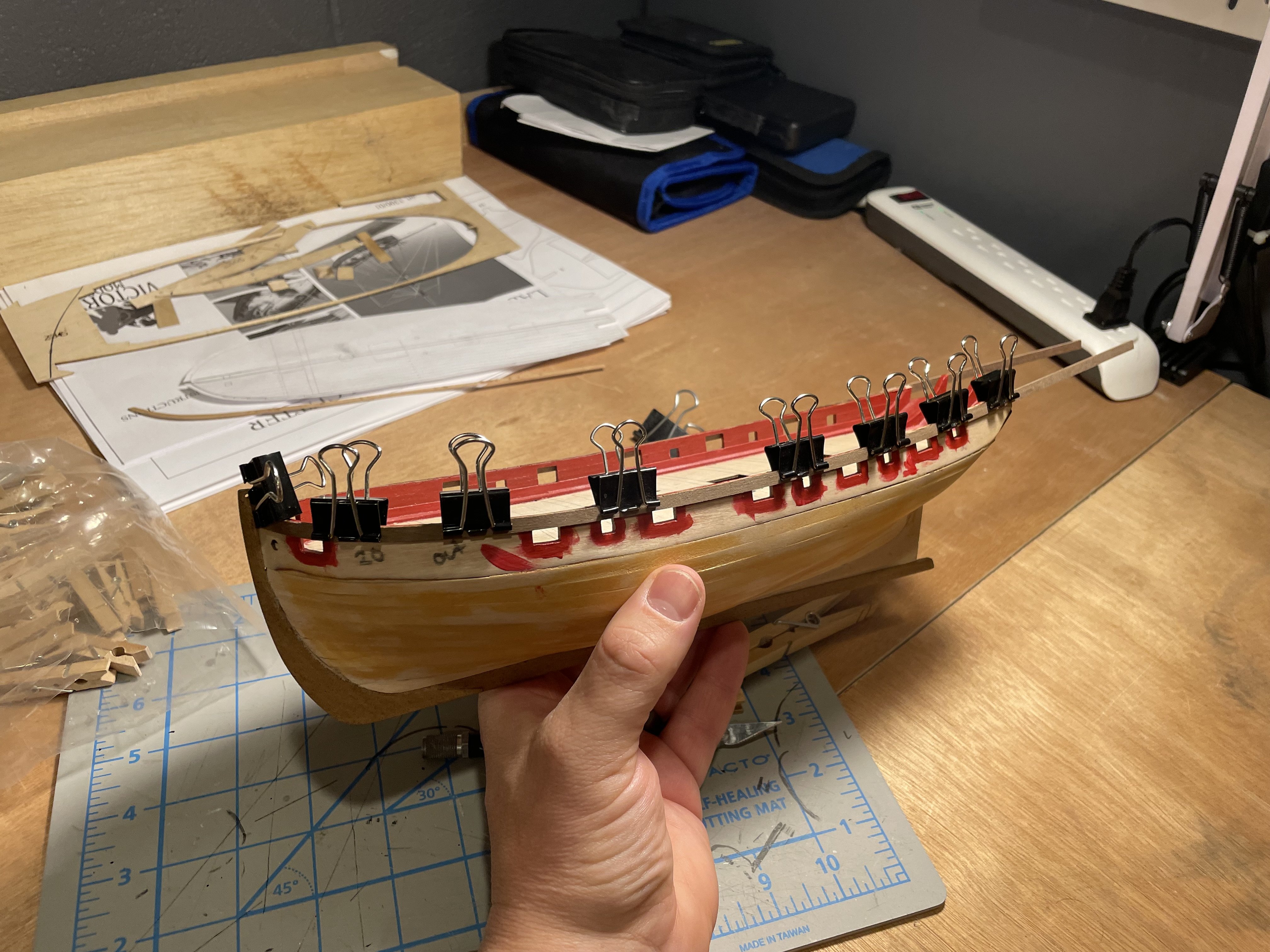

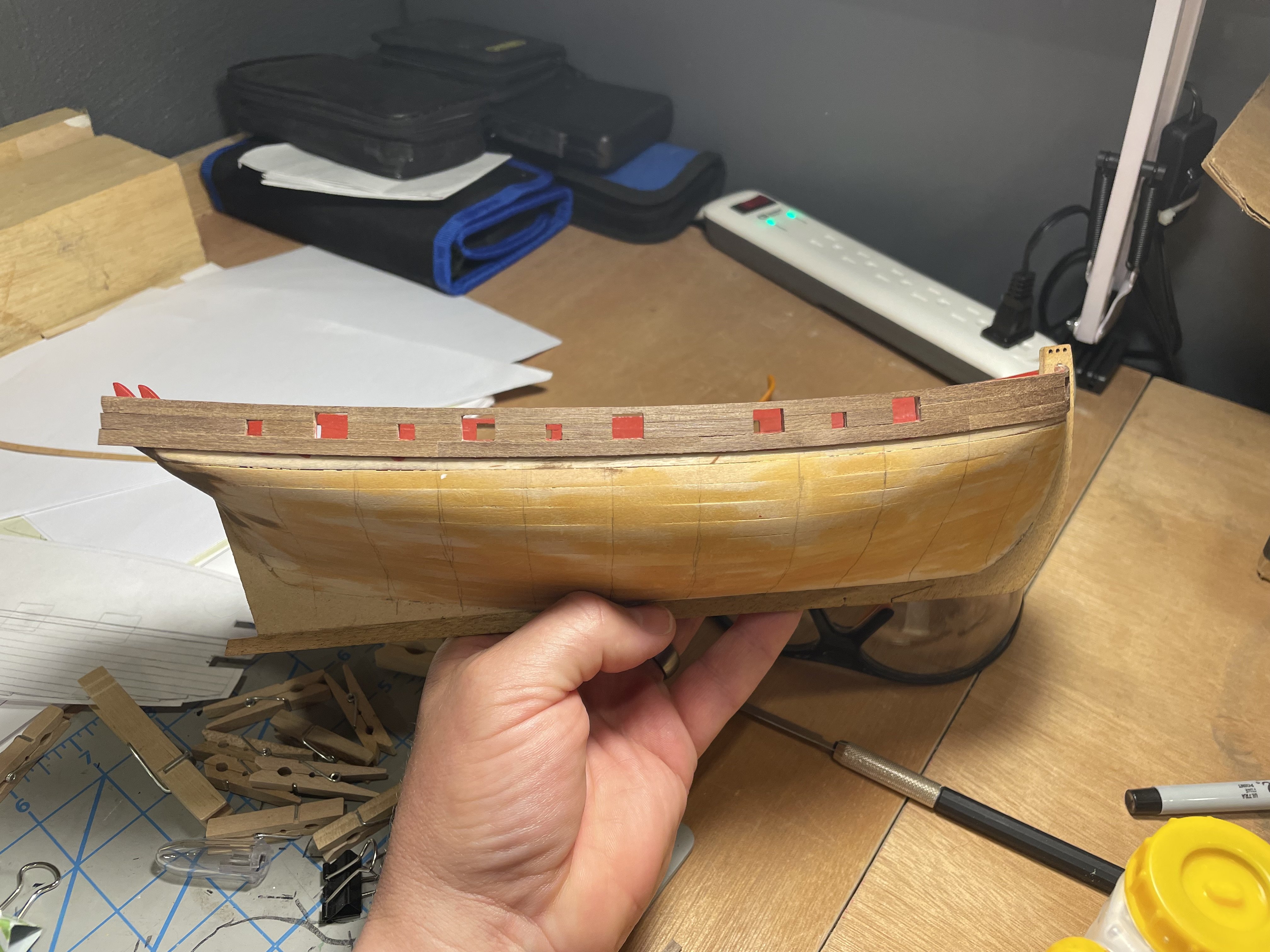

We had some family crafting time in the basement today so I did some more work. I had apparently given up on finishing this thing at some point in the last three years because my plank bending board was in the scrap pile in the garage. 😑 I did go ahead with a 4th full plank before trying to bend and taper. I previously marked bulkheads on the first planking. I want to try to do pseudo scale plank lengths and alternate plank shading for some extra eye appeal. I am trying a slightly different technique for my second planking. I butted together five full planks and marked the hull. I used a scrap piece of cardboard to copy that mark to each bulkhead. I then used the sectioning method that Chuck teaches and some Tamiya masking tape to try to mark off a better line to taper to. When I did the first planking, I started to taper way too early and it didn’t go well. With the tape line and marked piece of cardboard, I could see exactly when to start the taper. Another thing I did different was that I bent and edge chamfered a full width plank before marking and tapering. I was able to math the taper at the leading edge and hand sketch the taper. I used a knife and sandpaper and I make the taper. After two hours of work, I only added two more planks, but I think I am off to a better start than my first planking. It did take me a minute to get the hang of soaking the plank and heating with my iron to shape again. This is such a slow process.

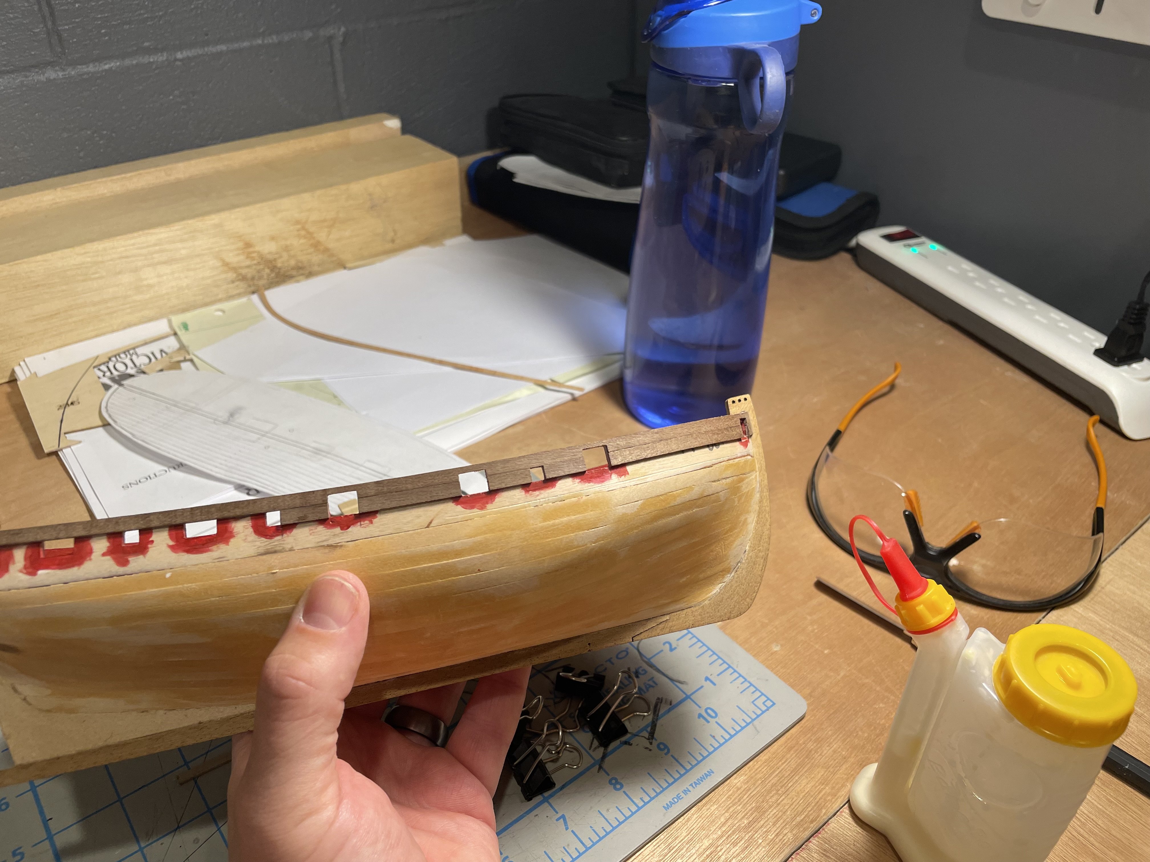

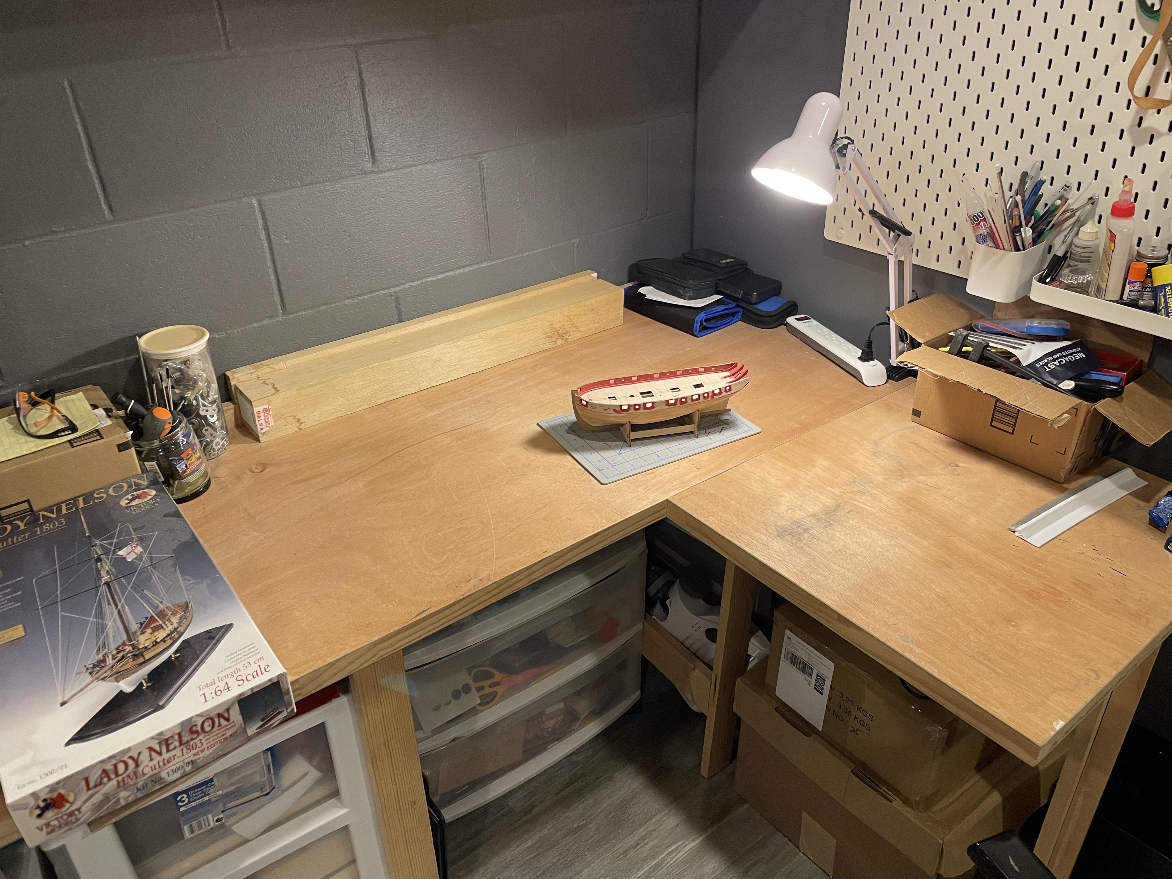

After 3 years and 3 months, I decided to pull the ship off the shelf and see if I can start to make some progress again.I have stressed over the second planking and fitting around the gun and sweep ports so much. I just decided to go for it. I started with the shear planks. There was a little non symmetry going on at the stern, but I was able to fix it. I just kept going from there. Got the top three planks done on the starboard side. I was hoping to get 4 full planks before starting to taper, but three seems to be the limit. Happy with how it turned out.
