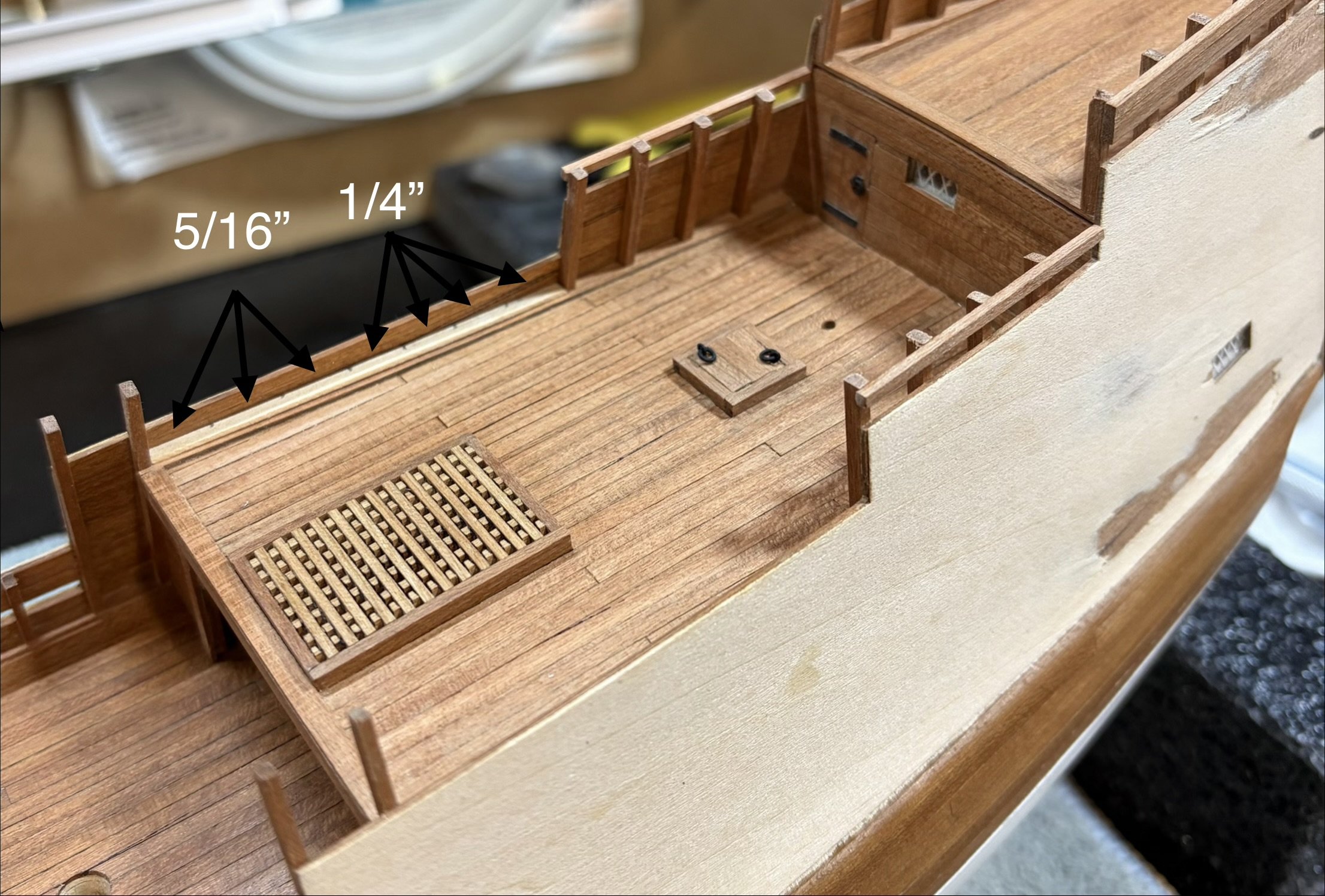

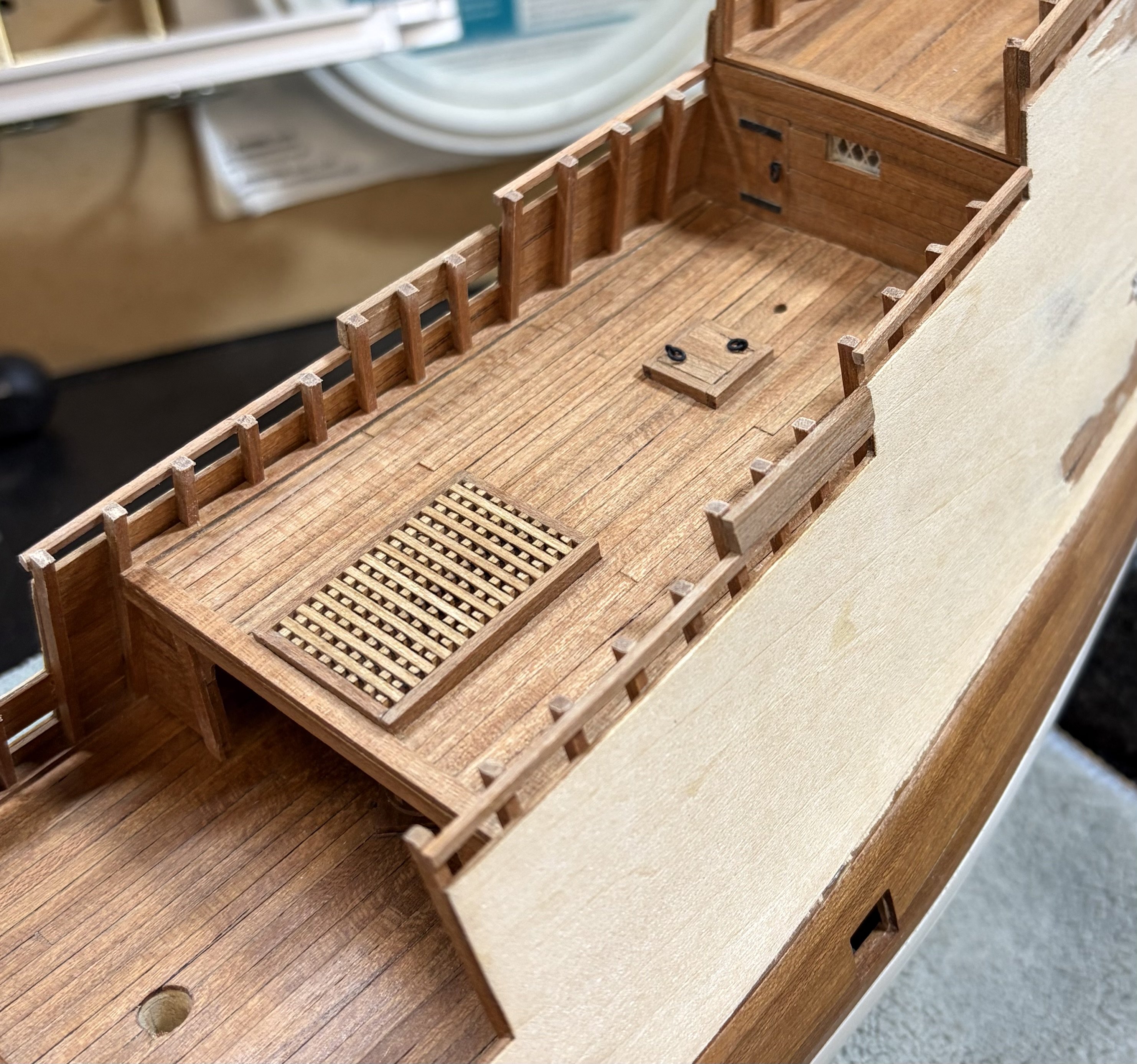

Poop deck stanchions complete. Same procedure as with the forecastle. The transom did need to be raised about 1/16” to accommodate the pre-planking. I noticed in Mike’s log that he had to do the same. More sanding was done on the bulwark templates to get them to 1/32” thick. One photo shows how I measured the thickness. The smaller pre-planking pieces were custom shaped. 1/8” x 1/16” strips did not fit the space proper. One photo points to this area. Just like with the forecastle, there were many redos on this part. Forward progress still outweighs the setbacks. Steve
Completing the forecastle stanchions and pre-planking was tedious and required planning and concentration. I’ll outline what I did to assist those few building this kit. I started by sanding and applying Wipe On Poly to the 1/16” x 3/32” strips. I measured 1” sections and cut them using the mini chop saw that I used earlier in this project. The corner stanchions were installed first so I could plan the spacing of the rest of the stanchions. I created tick-strips out of scrap basswood to mark even spacing for the appropriate number of stanchions as shown on the plans. Make sure you check the plans carefully here. Pin rails will be mounted later to specific stanchions. I taped the tick-strips to the deck so I had visible reference points while installing. This was absolutely necessary to line up the stanchions. Using spacers did not work for me here so I adjusted them by eye. I remounted several along the way. It took several days to figure out this method. The pre-planking was prepared and sanded before cutting to length. These were not treated with WOP as they will be painted later on. I installed the fore and aft pieces first. This helped when mounting the side pieces. See photos for this and the method I used to bend these pieces. Hot water then bending as shown. Excess lengths were cut using a sprue cutter. I tried a rotary tool first, but this was a mistake. Sanding sticks were used to polish the rest. I will round the stanchions after the rest are installed on the poop and upper deck. I hope these methods provide useful to others. Steve
