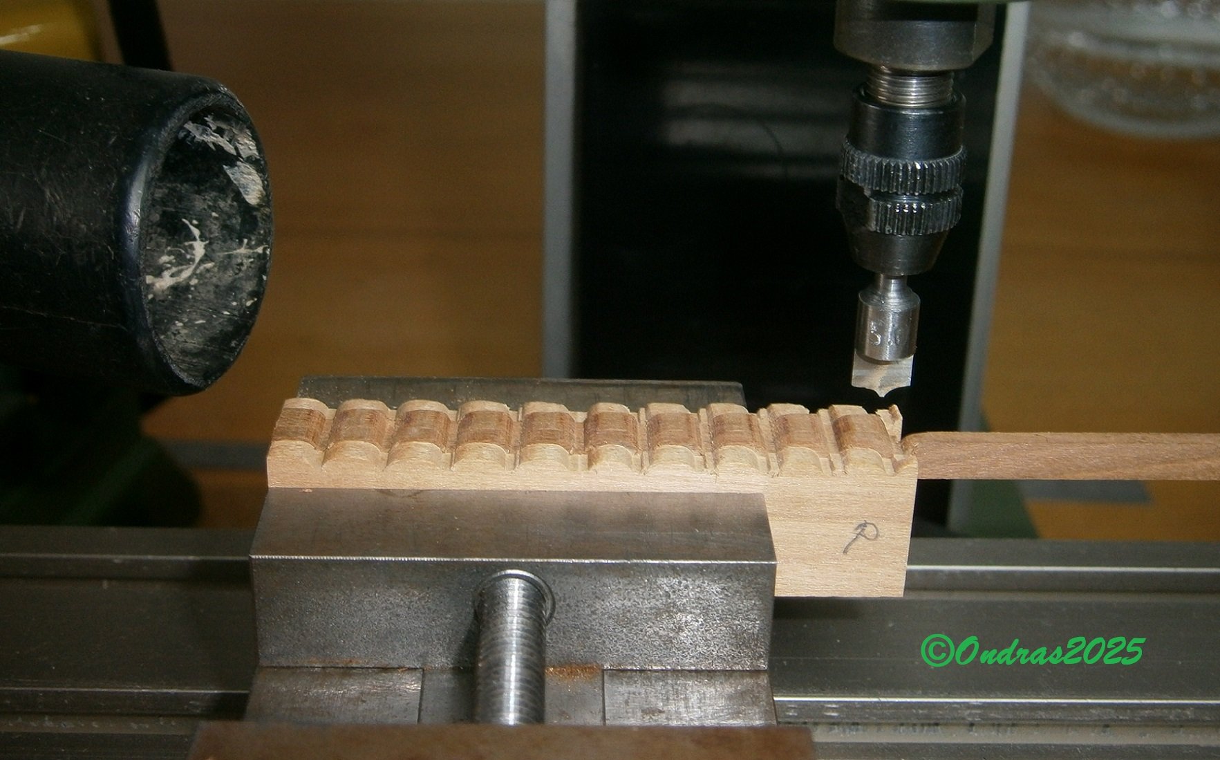

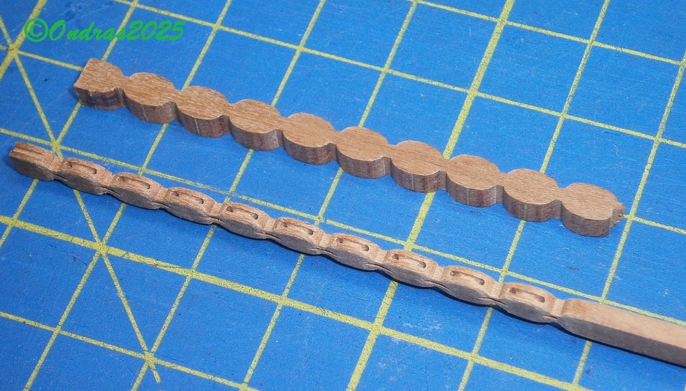

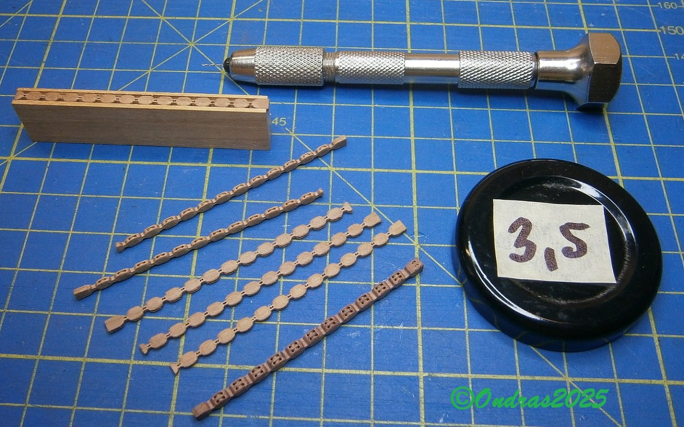

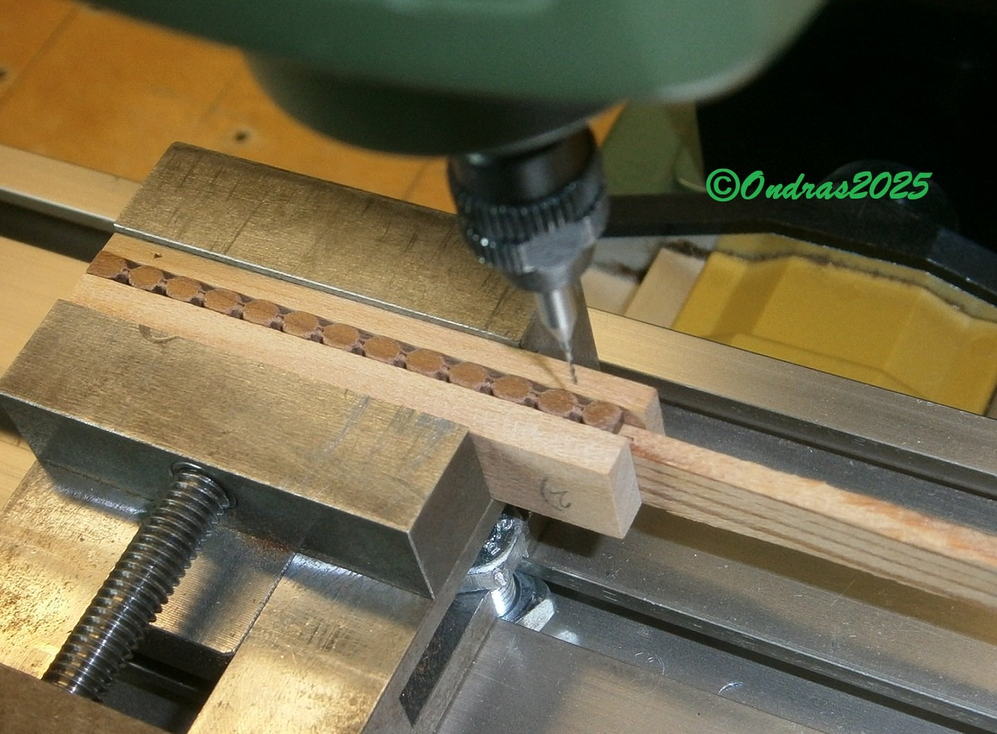

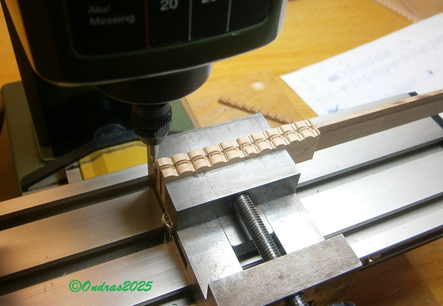

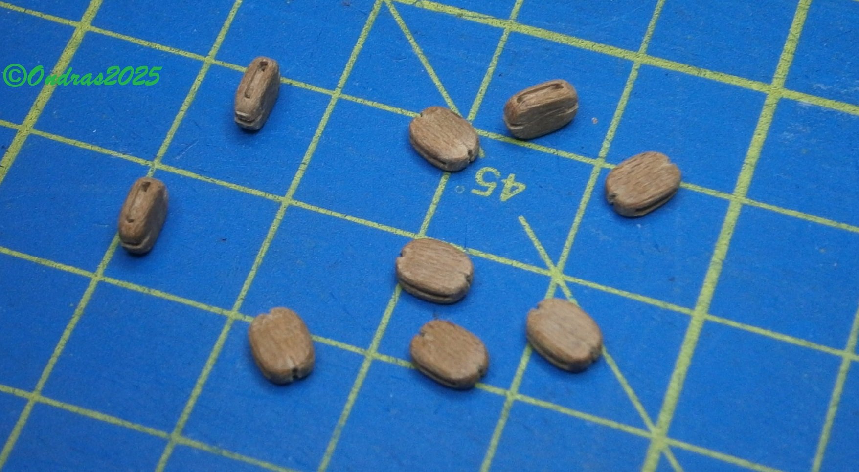

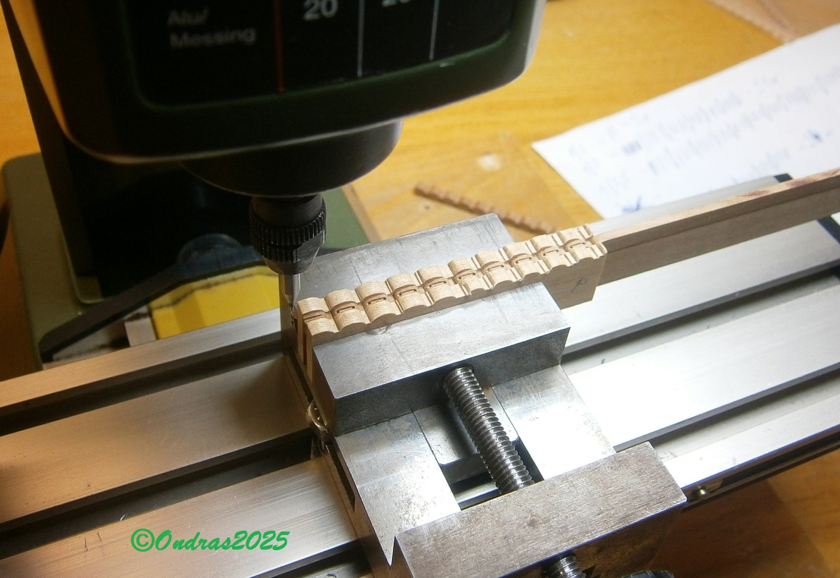

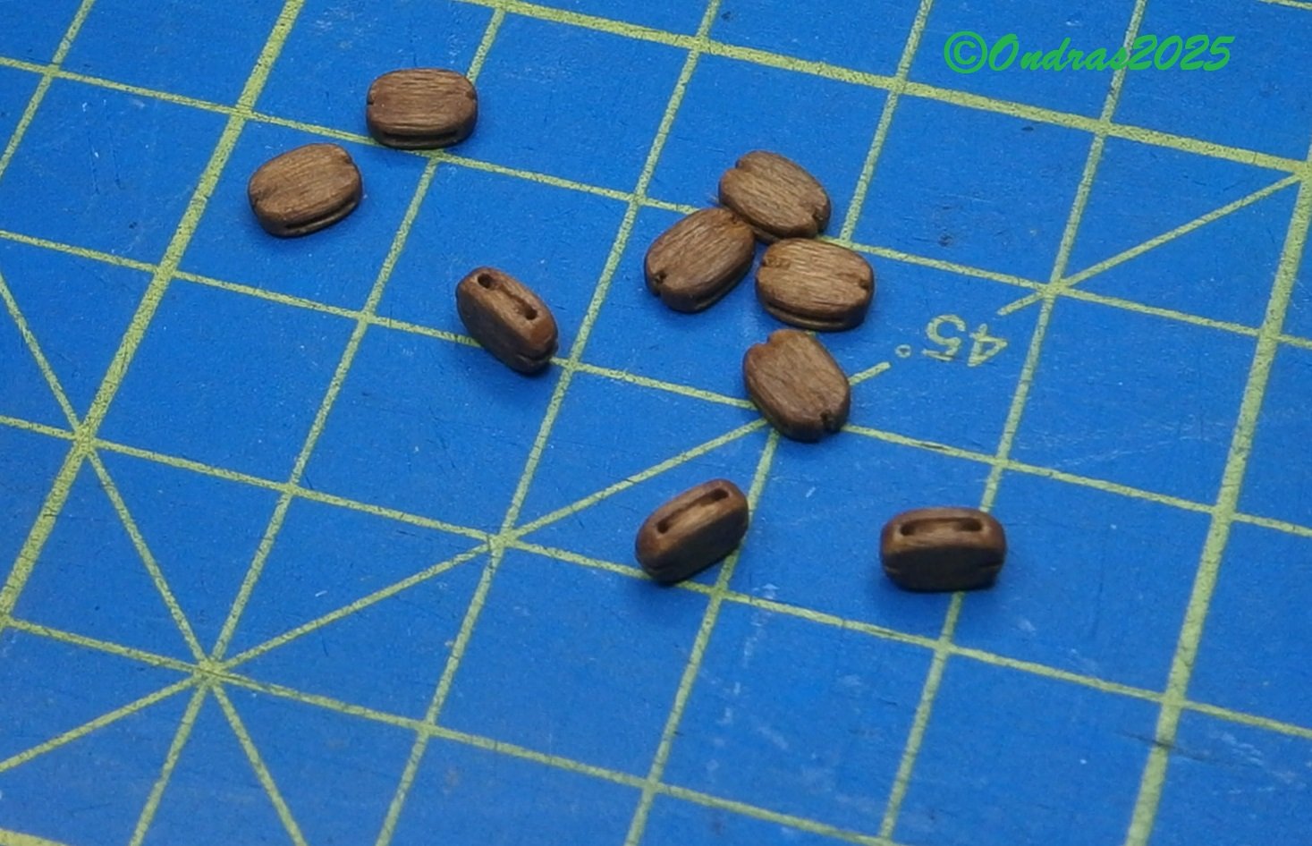

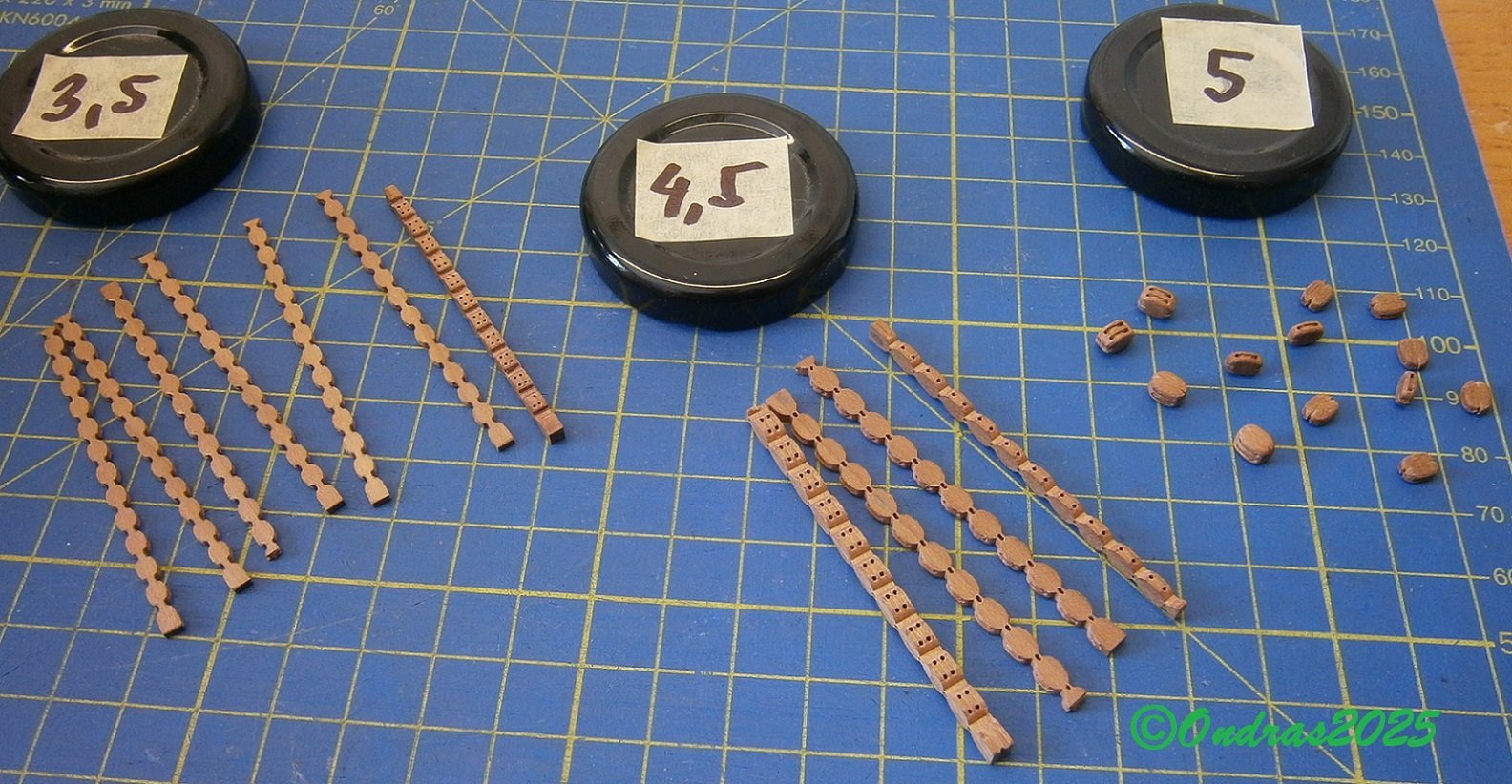

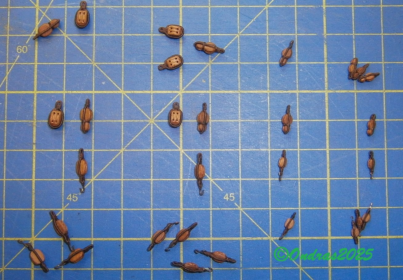

I continue to produce other blocks of smaller dimensions. "Machine" production with shaped cutters..:default_wallbash:
waxed...
I'm gradually getting smaller and smaller.
There will still be a lot of manual labor here..😴

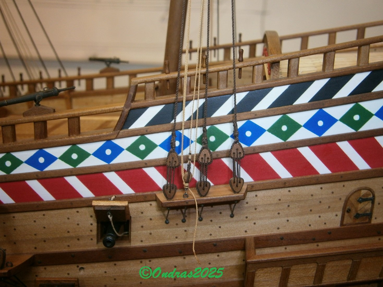

I have been making tackle pulley halters for a long time.
I chose a system of tying and gluing the tapered ends of the cables..

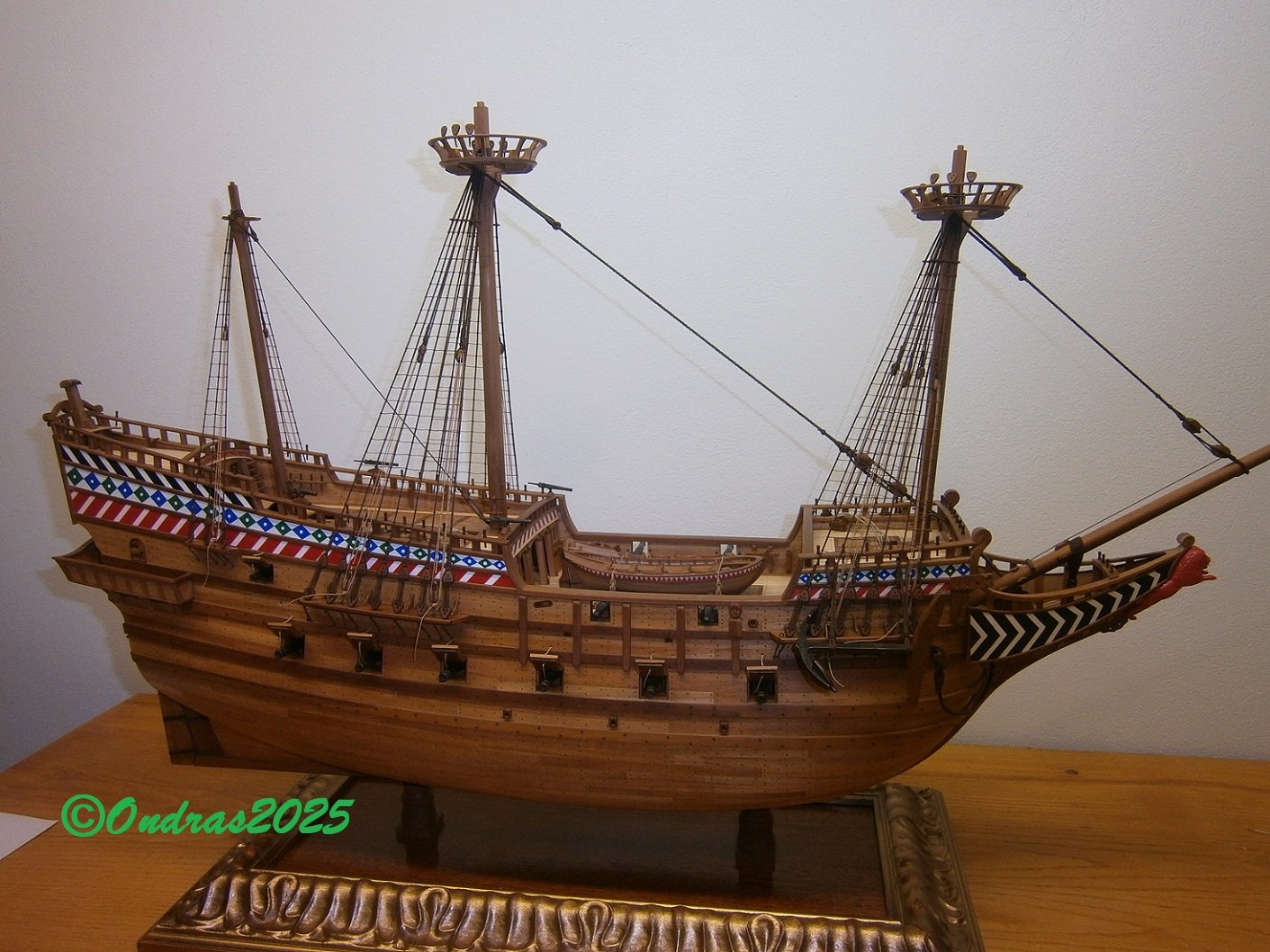

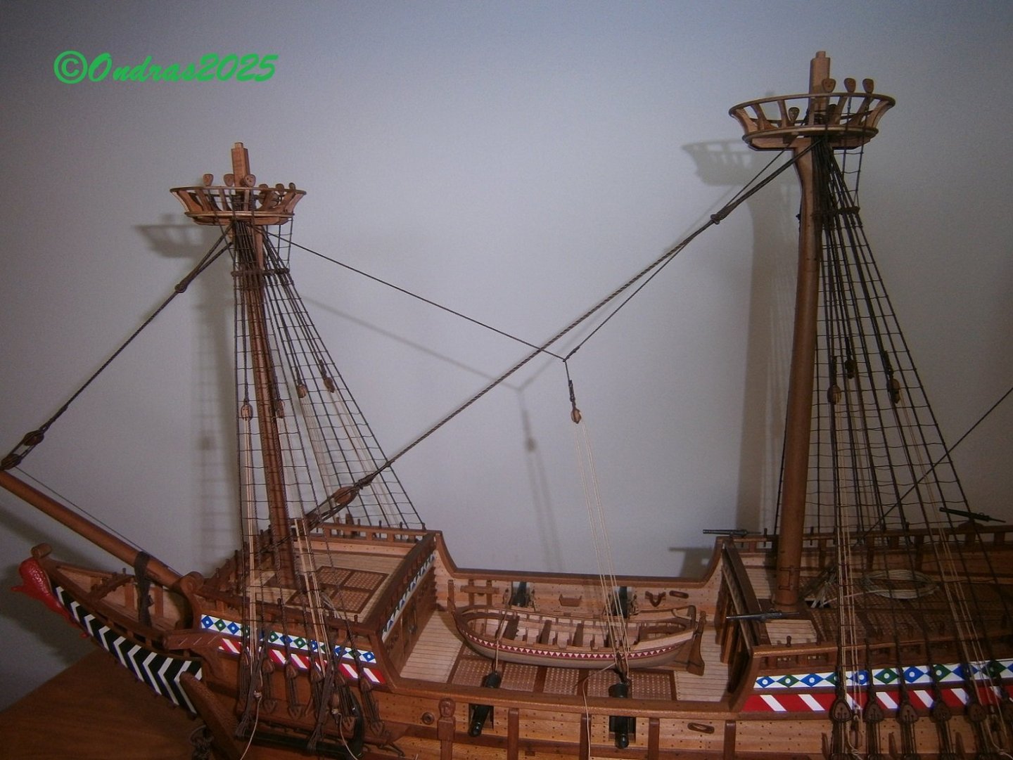

As I reported, I enjoyed a weekend in Sweden with the main goal, the Vasa Museum. https://www.vasamuseet.se/cs
I had been preparing for this for about 40 years and it was worth it. When I arrived, my watch reported increased blood pressure and heart rate... I spent over 4 hours here, I could have stayed longer, but I took into account the company of my son. I walked around the ship several times and compared the beams and planks with the strips from which we model them... Having the ship about three meters away from each other is unreal. I tried to look at and photograph every detail. Simply indescribable, at the end a very long viewing with contemplation..🔥

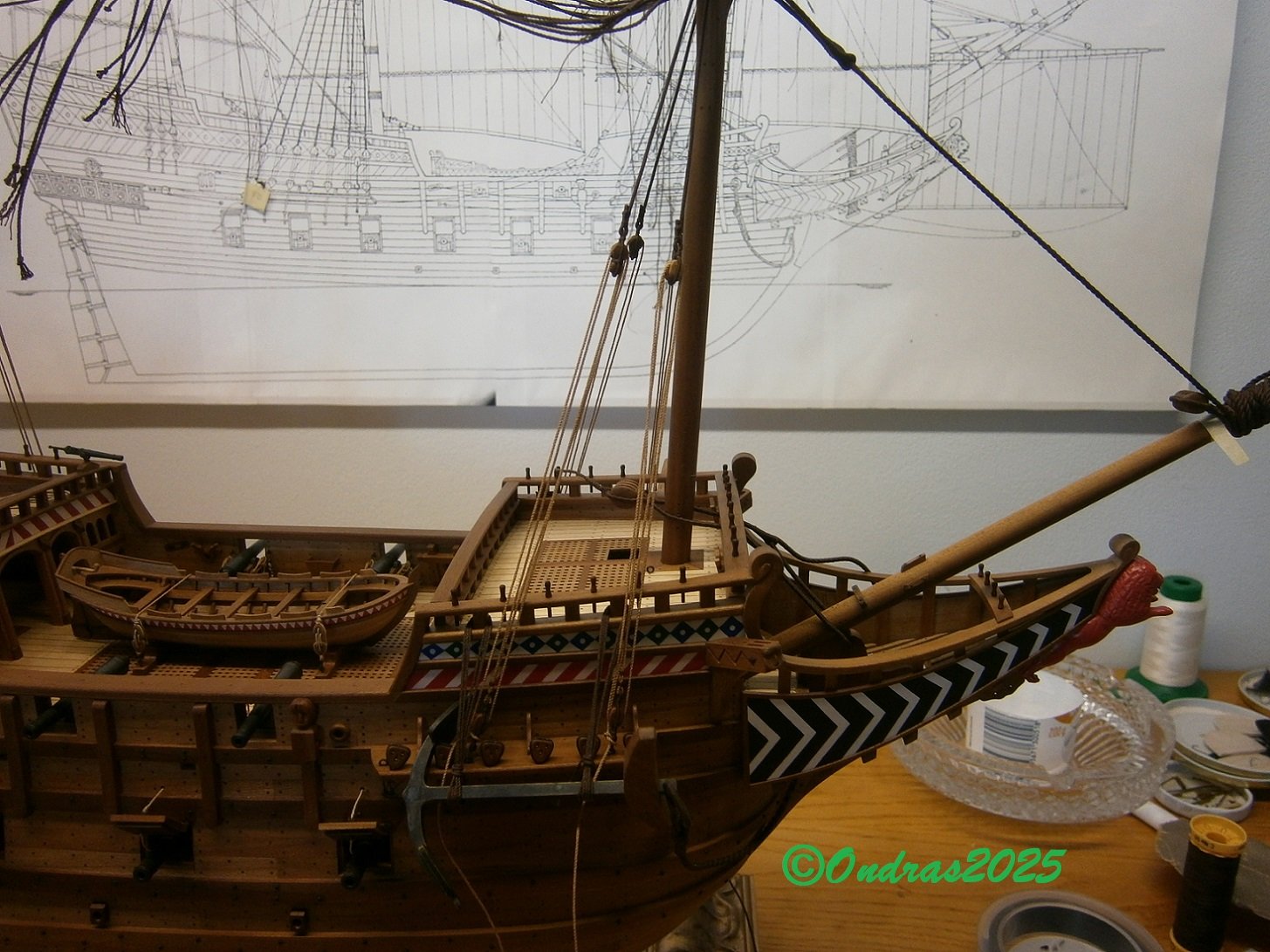

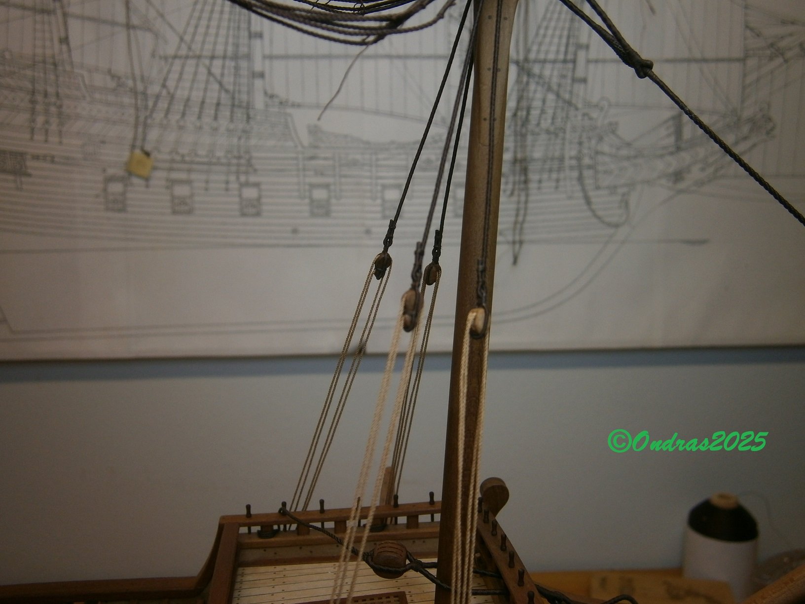

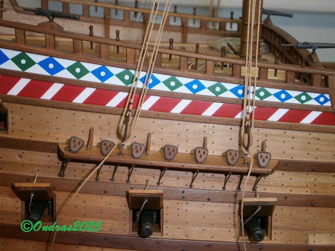

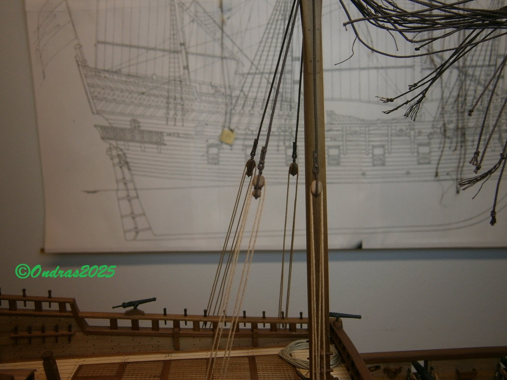

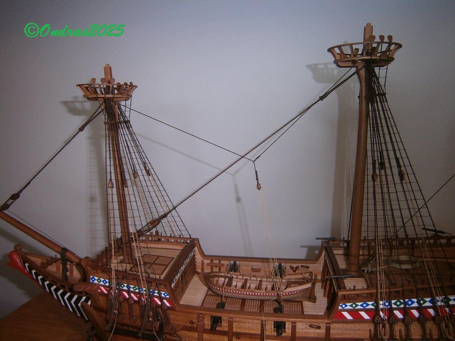

I've made some progress on the boat. Front and main tackle finished, I'm tuning the Stays and the Schrouds are waiting for me..:)
Mainandforetackle(1).JPG.58d1ad0a86f05384ae97fc689e42e54e.JPGMainandforetackle(3).thumb.JPG.4cb0a34998e94d8a1b9dca8bf766efc7.JPG
Mainandforetackle(4).thumb.JPG.f2429416448f51ef8edbcac55e1a9f79.JPGMainandforetackle(5).JPG.1fabe5949a401c632afde3f738bec678.JPGMainmaststay(1).thumb.JPG.ee21fc640be9849916698945c9dc4f24.JPGMainmaststay(2).JPG.821ce8babc88fd786f42ba675dd9ec0a.JPG

Good day Ondras!
Very fine and clean work! Such a great pleasure to look at it and to see how she is slowly growing up!
All the Best!
Kirill
Ps
I' m not an expert, but by visual impression, deck boat lashing  looks a little bit too light and fragile . May be there is sence to use some set of 3 ropes or some more thick rope for that purpose/ to hold( secure) boat on deck?

Thanks Kirill. Now with the installation of additional ropes, the boat rope really seems weak to me. I plan to install stronger ones..:)

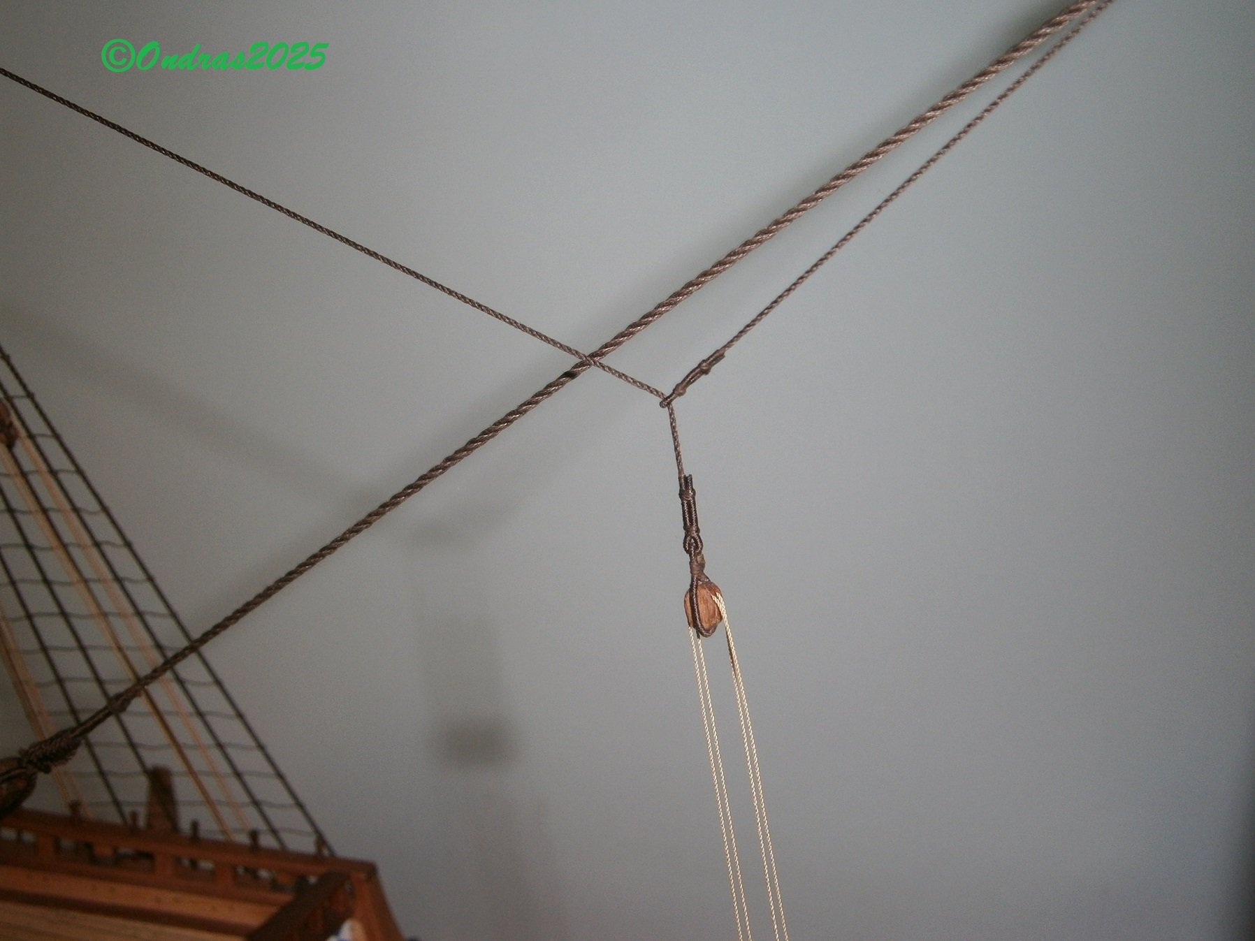

1 hour ago, Alvb said:
Don't the jib halyard's cable and the lower block of the mainstay get in each other's way?
Bela
Hello Bela. Due to the poor plan, I am still working on these things during the installation to make the result look believable. Thanks for the timely warning..:imNotWorthy:

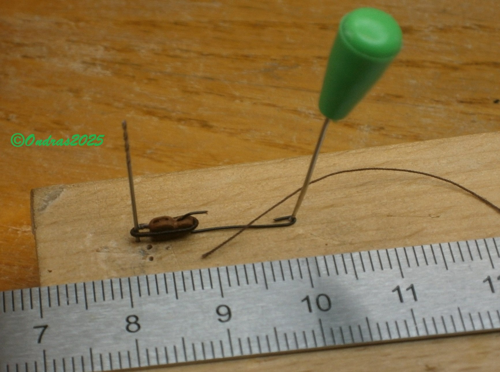

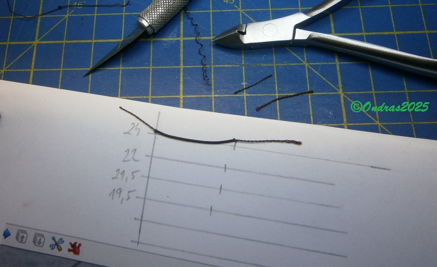

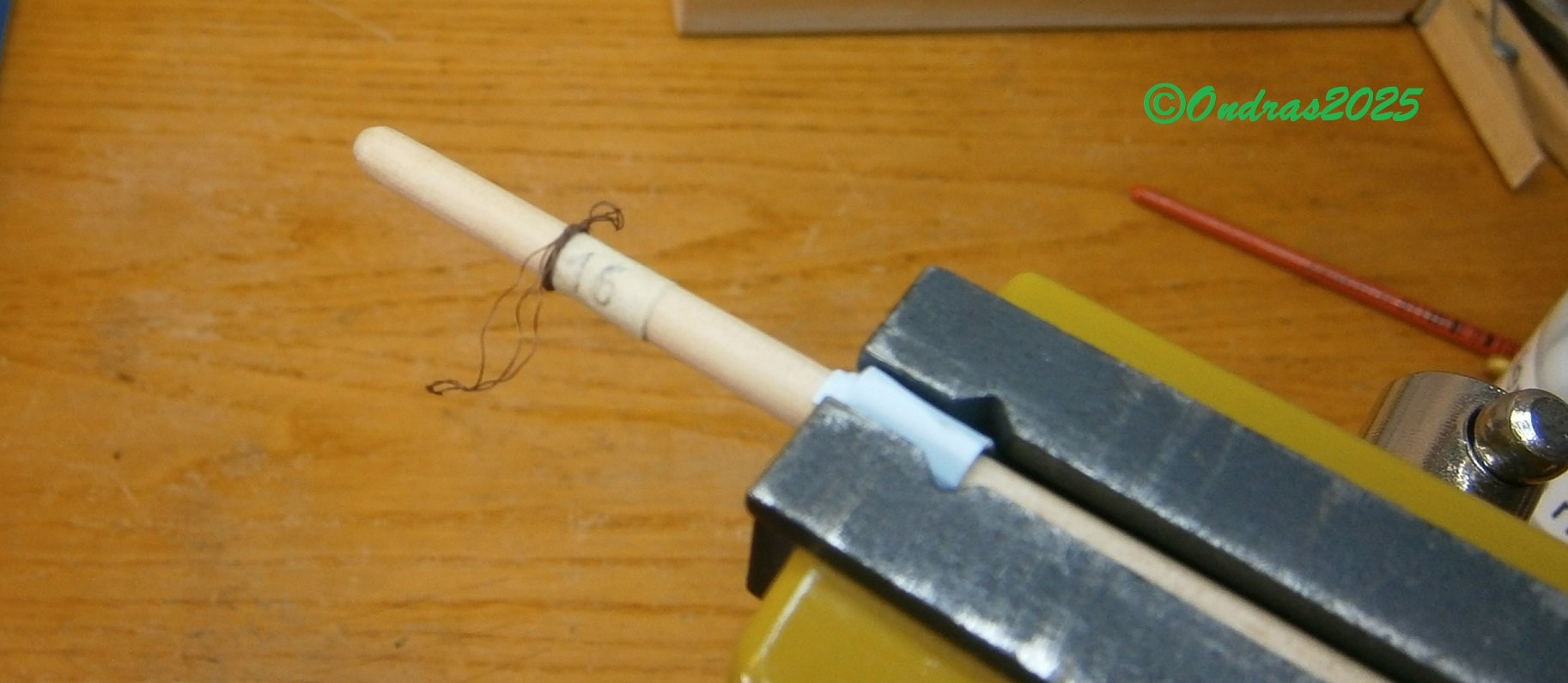

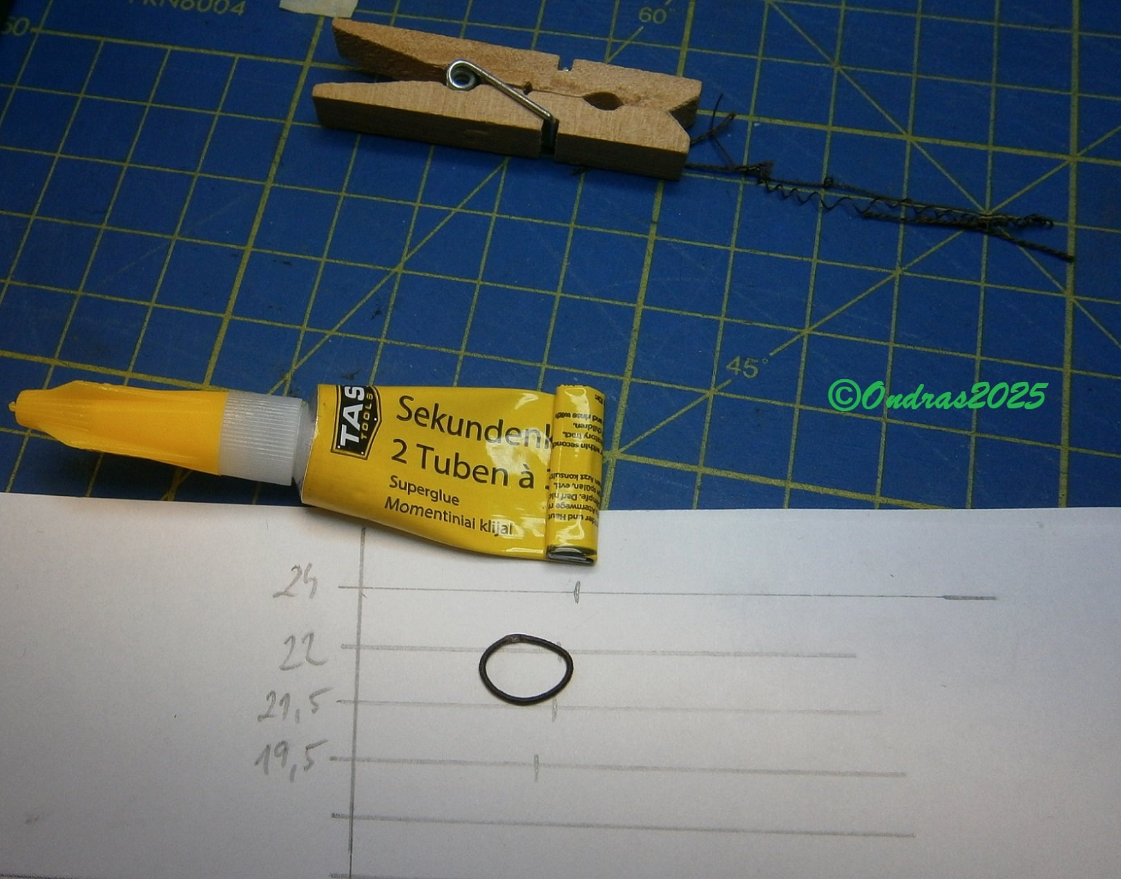

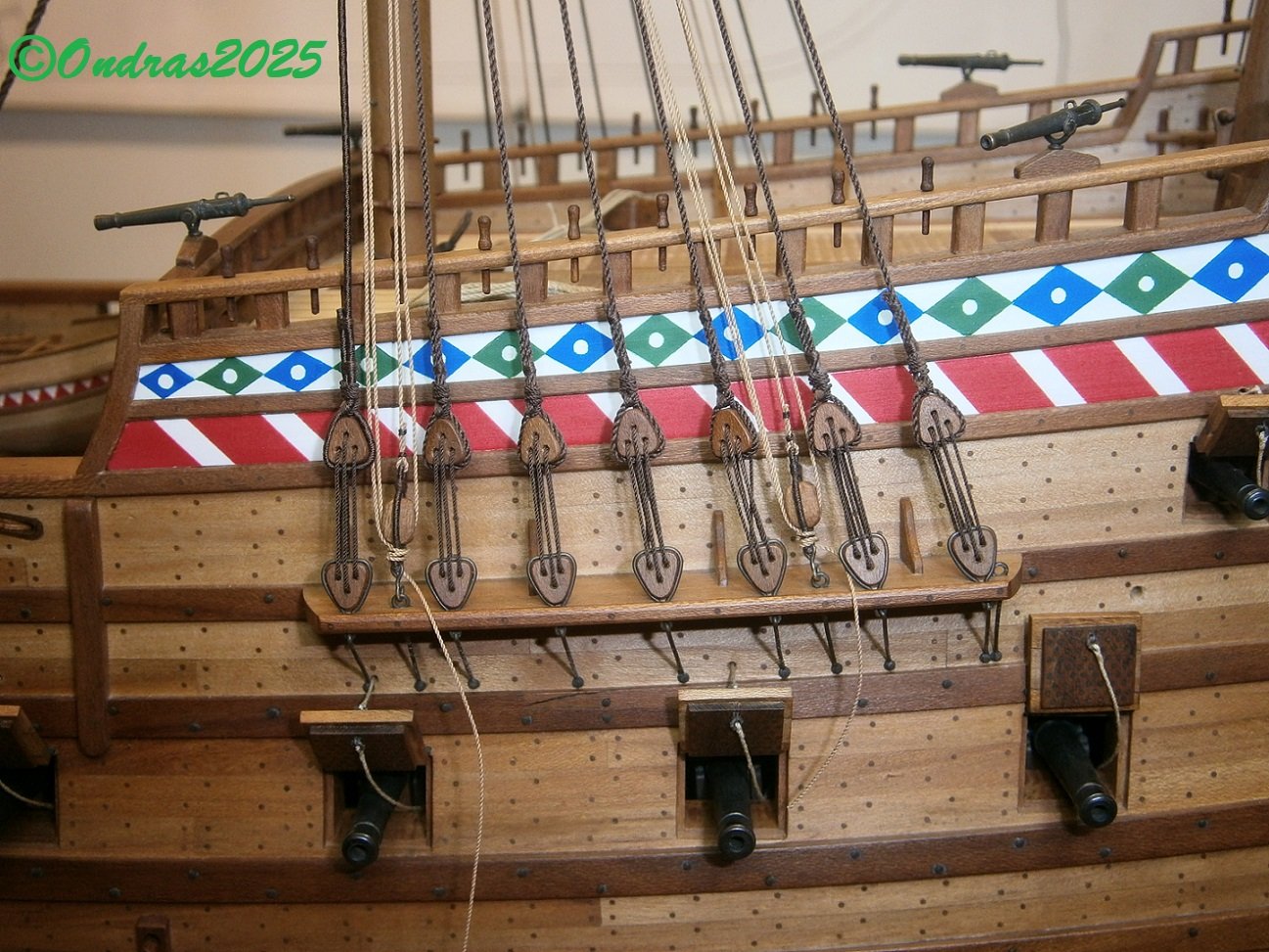

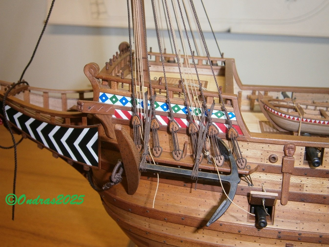

This is how I tie the Deadeyes to the main Shrouds. Due to the different distances between the upper and lower Deadeye, I used the system that modeler "archjofo" uses when building his beautiful rigs.
It is a log with a diameter of Deadeyes, which is at the correct height even with different inclinations of Shrouds..👍
Then another binding..
Result ok..💥

Hello Ondrasch,
First of all, let me say you're building a wonderful model with outstanding craftsmanship. I'm also truly honored to be mentioned in your build log—thank you for that.
I'd like to offer a small tip: If you carve a shallow groove into the round wood used for attaching the deadeyes—just as shown in my photo—it becomes much easier to push the needle through. It’s a simple adjustment that can really streamline the process and improve alignment.
Looking forward to seeing more of your progress.
Your work is a pleasure to follow!
On 9/28/2025 at 9:10 PM, archjofo said:
Hello Ondrasch,
Hello Johann. Thank you for the compliment. I admit that I didn't recognize the groove, I only saw a thick line. The groove is really needed!!🔥
Bela
Hello Bella. Did you mean this crossing of blocks? Fortunately, the distances are fine.💥

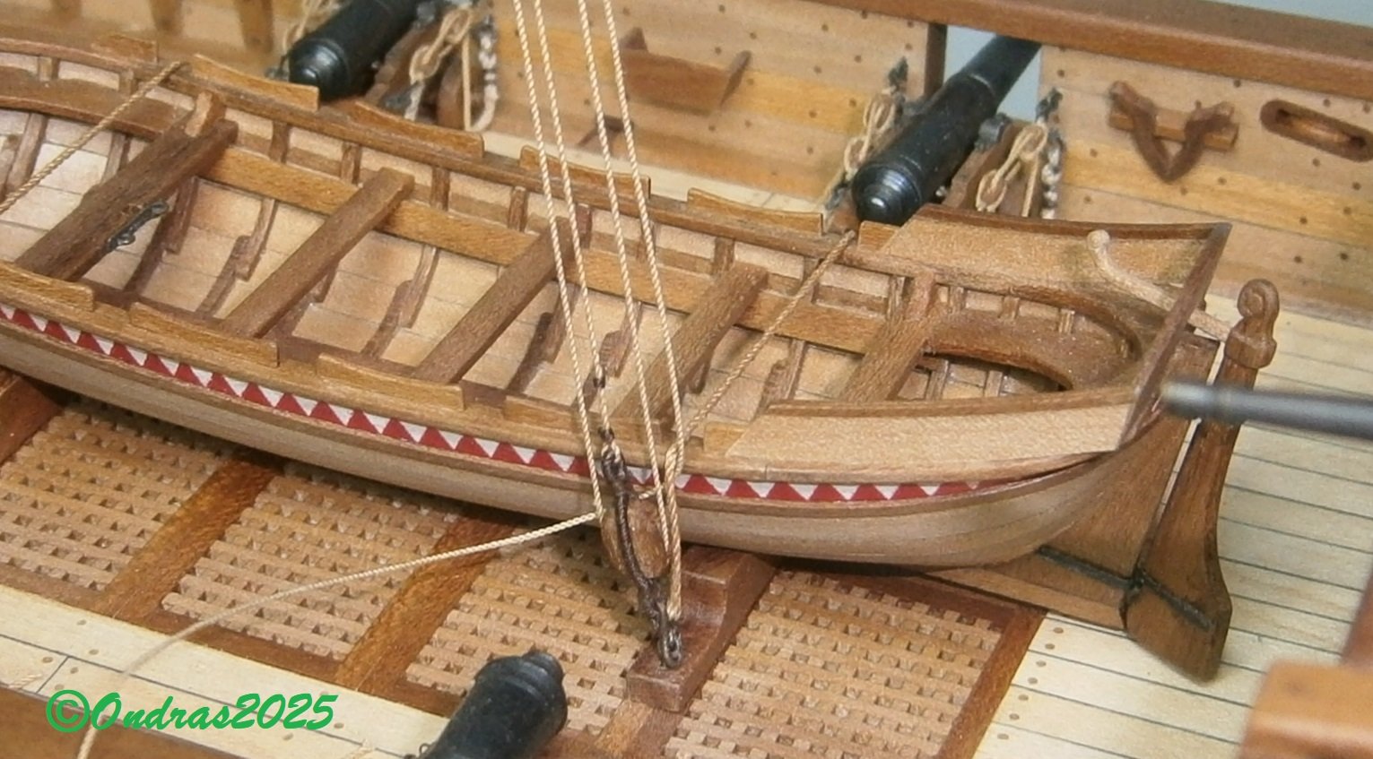

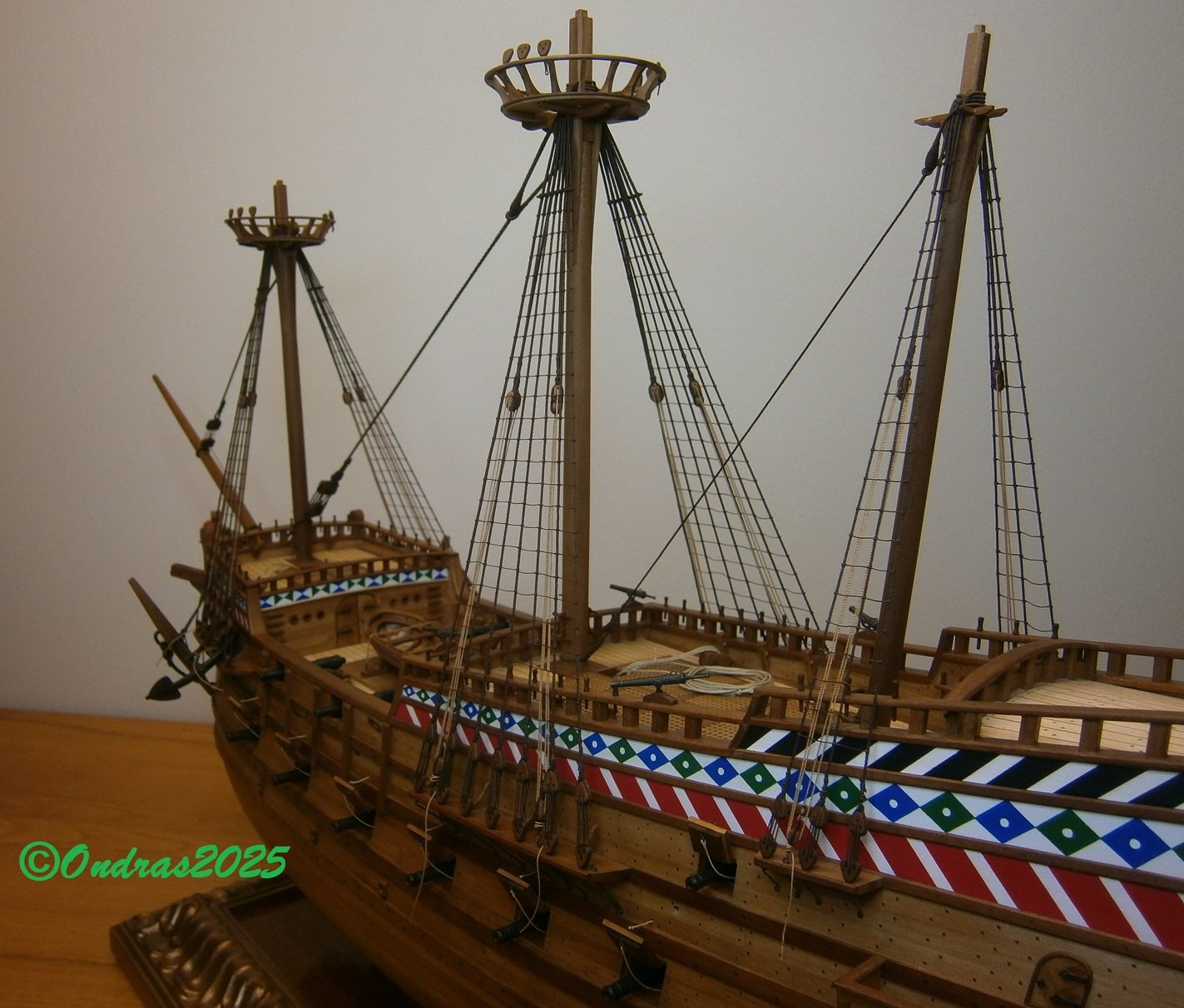

Before gluing the masts, I tied the boat up, as Kirill had pointed out. I put in a thicker rope and immediately created smaller deadeyes..
All sizes created by me..
Deadeyes of the foremast measured..

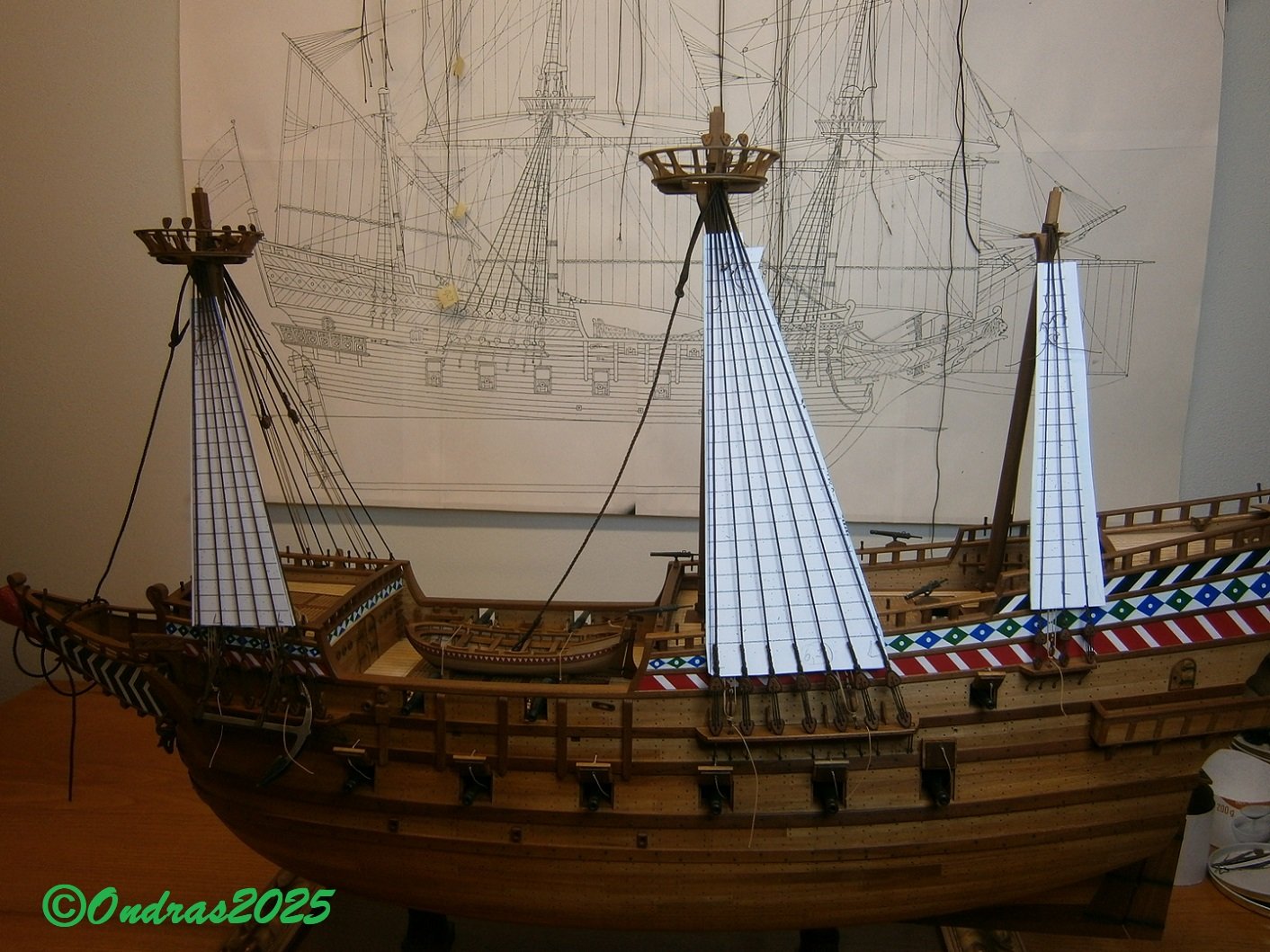

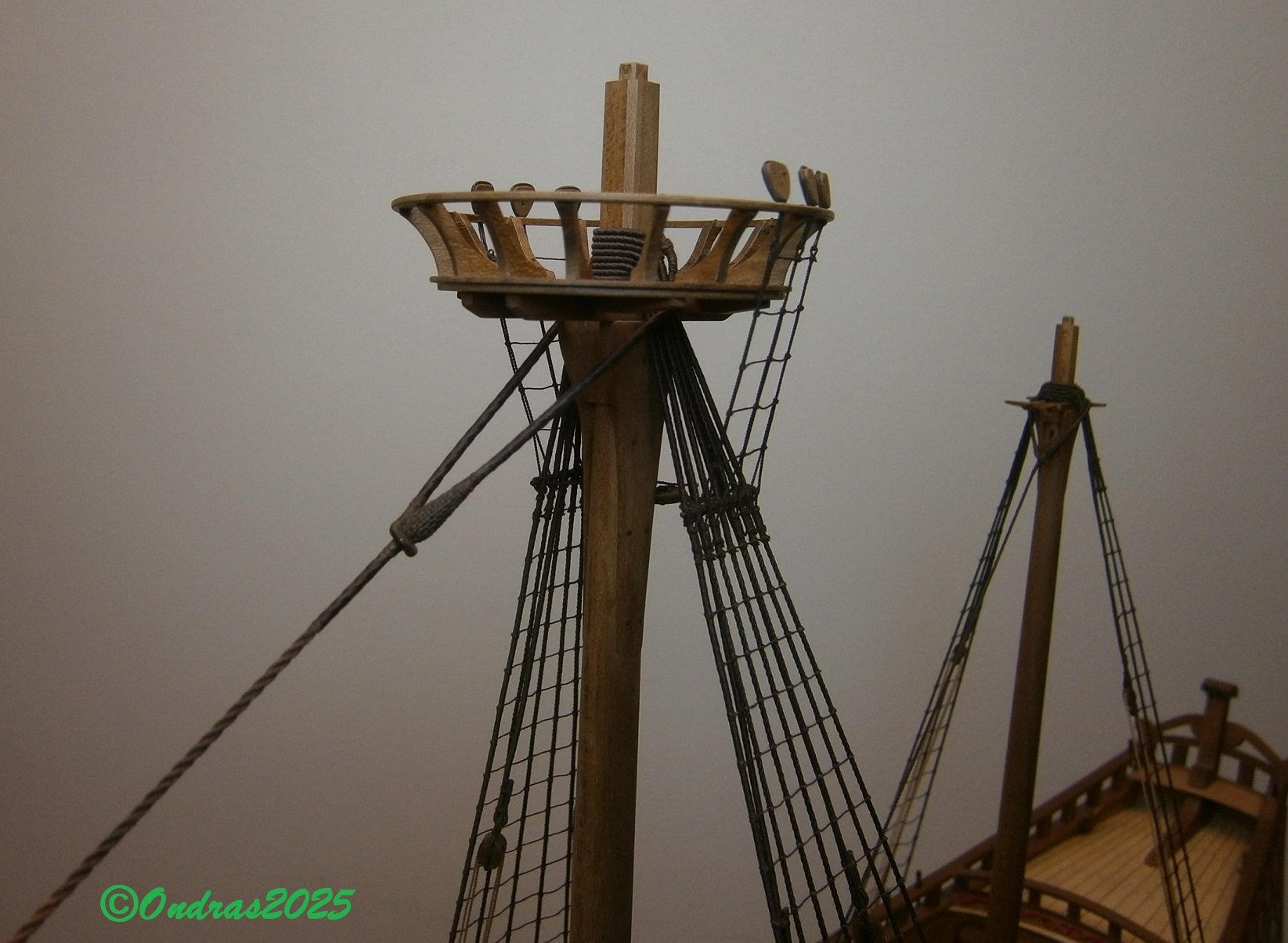

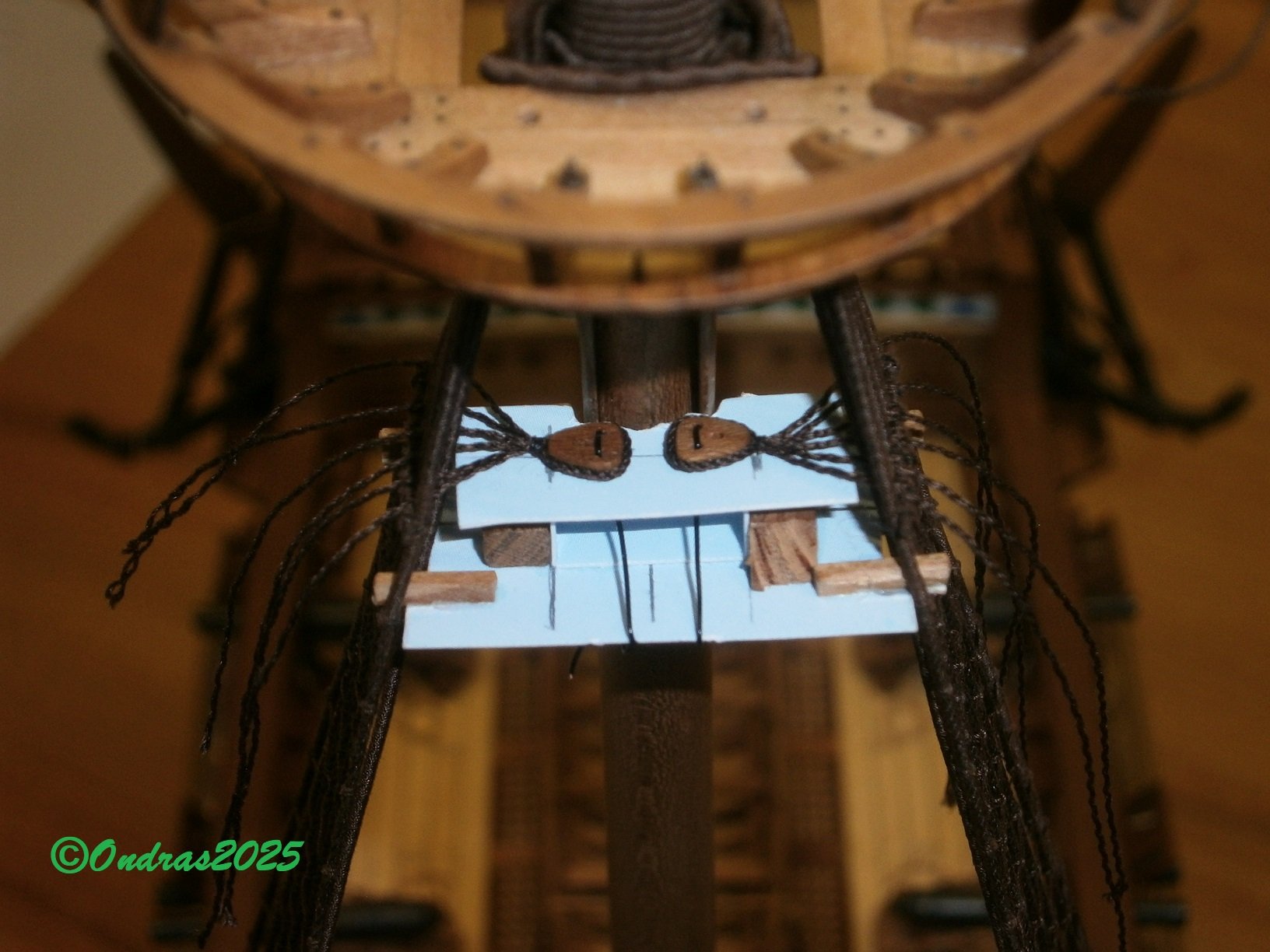

I continue tying the deadeyes. Mizzen mast..🔥
After measuring and tying the deadeyes to the shrouds, I glued the masts..
"Tackle" and Deadeyes tied cleanly. Just need to adjust the height..💥

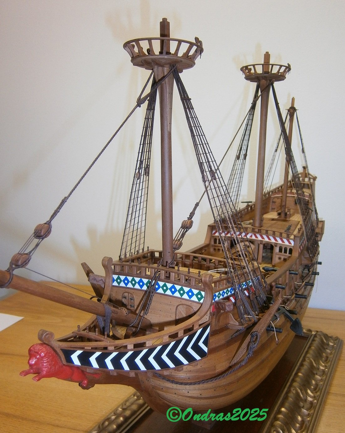

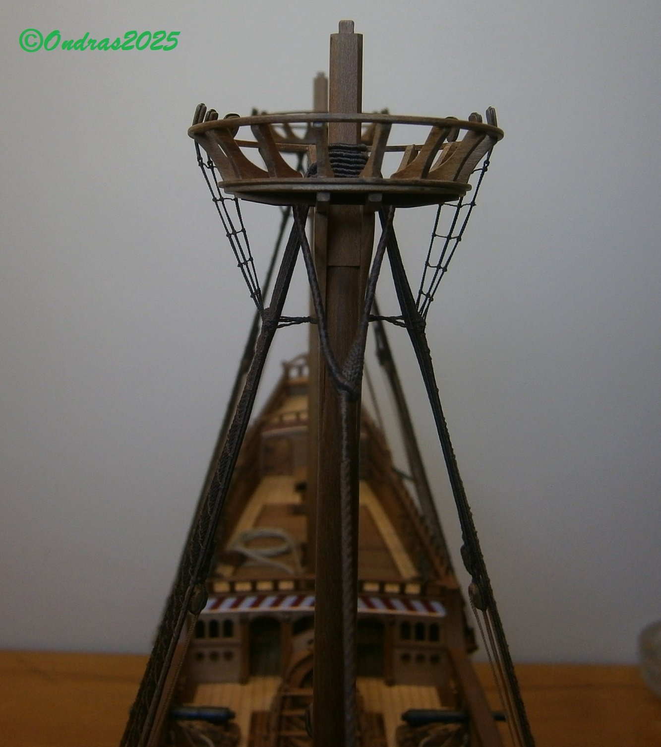

Bowsprit equipped with blocks..
Ready and tight Stays..

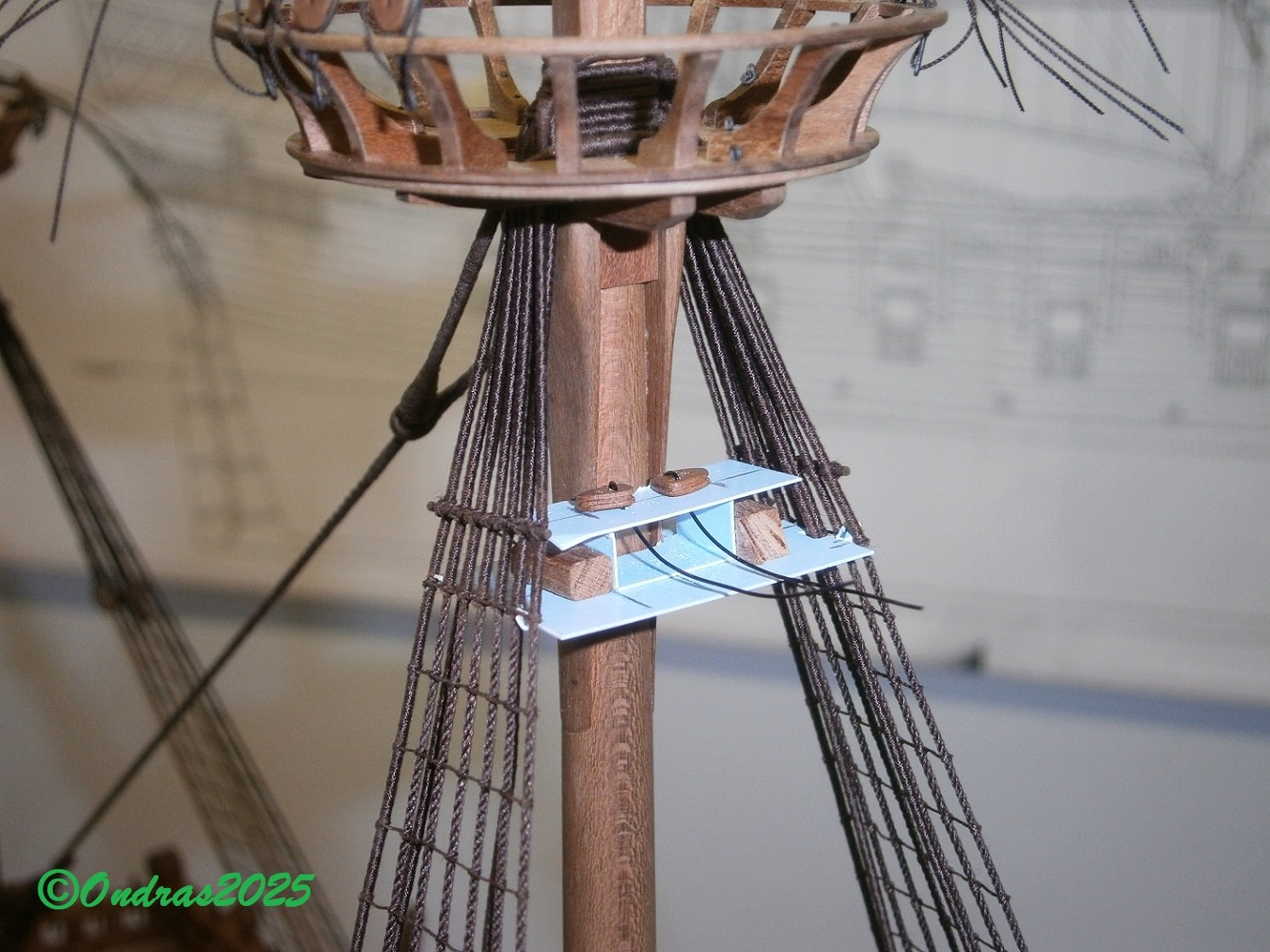

Added Ratlines metal crossbar (Futtock stave)..
Ratlines knot tying begins..:default_wallbash:

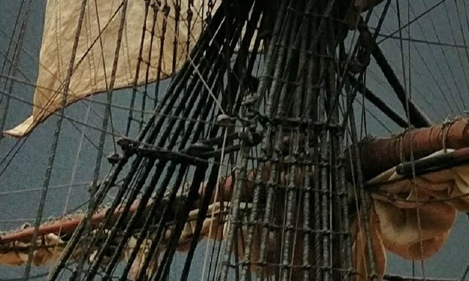

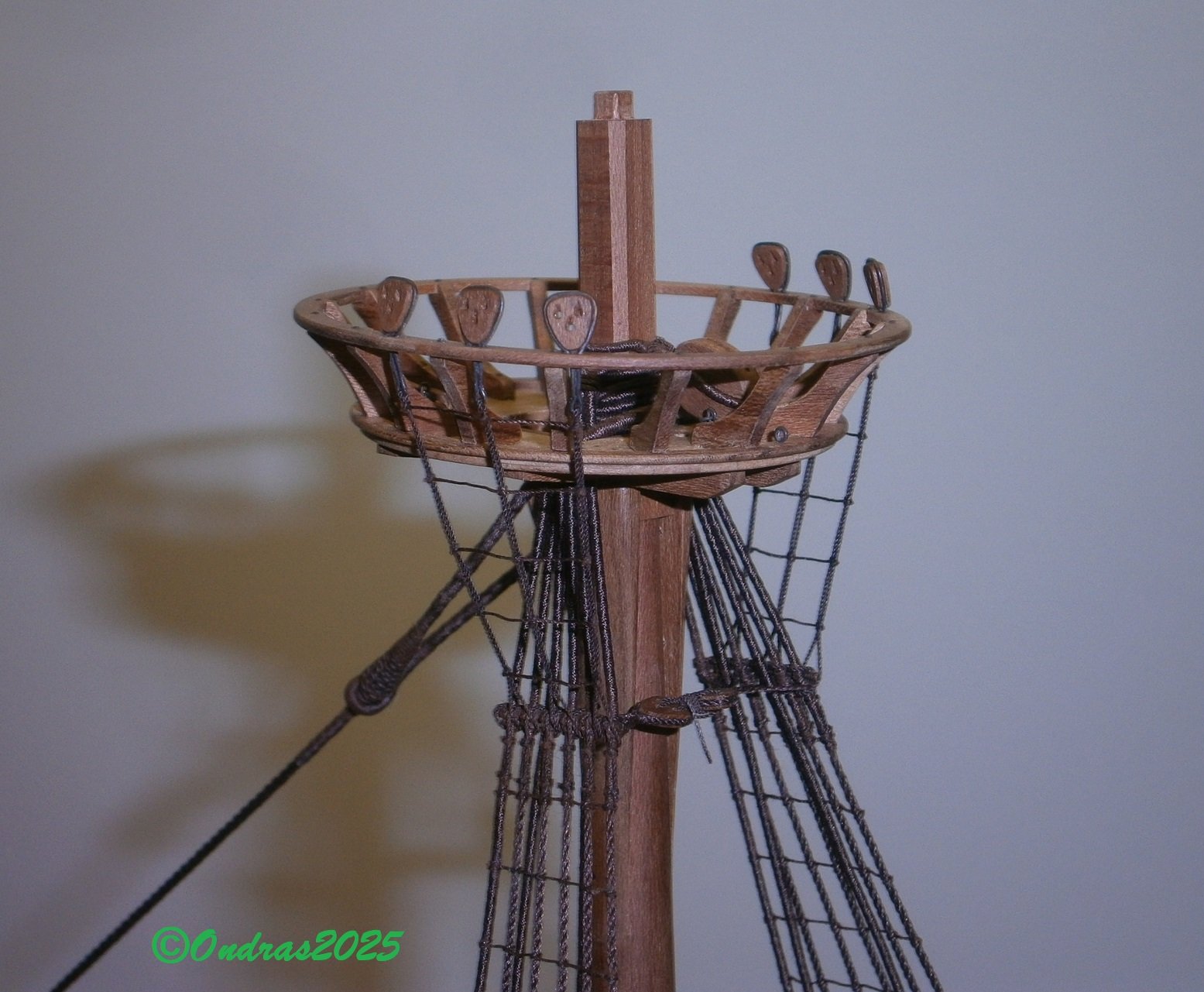

Bottom Ratlines strung..🔥
..compare again, glue the end knots and cut..🙂
Measurement by the figure of a sailor..
Sometimes a rung had to be replaced..
This is how Ratlines are knitted on the replica "De Witte Swaen"..💥 At 6:00 minutes...

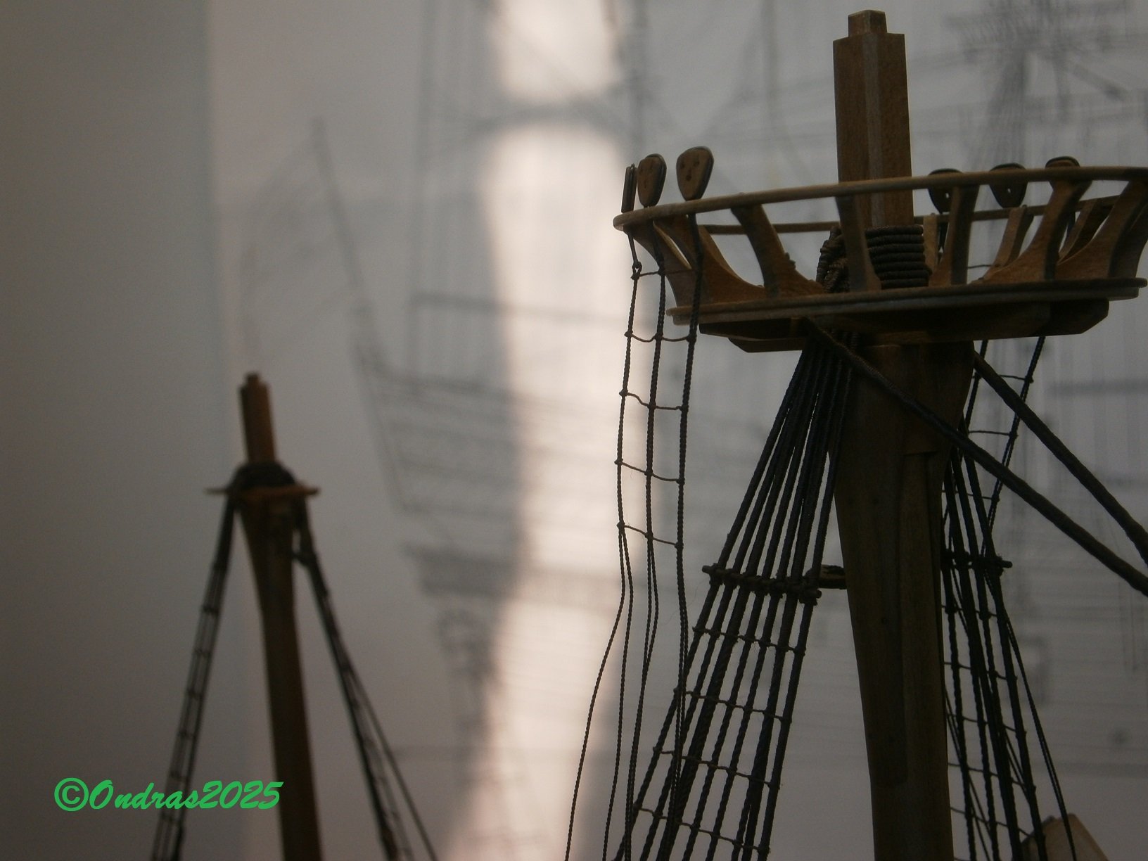

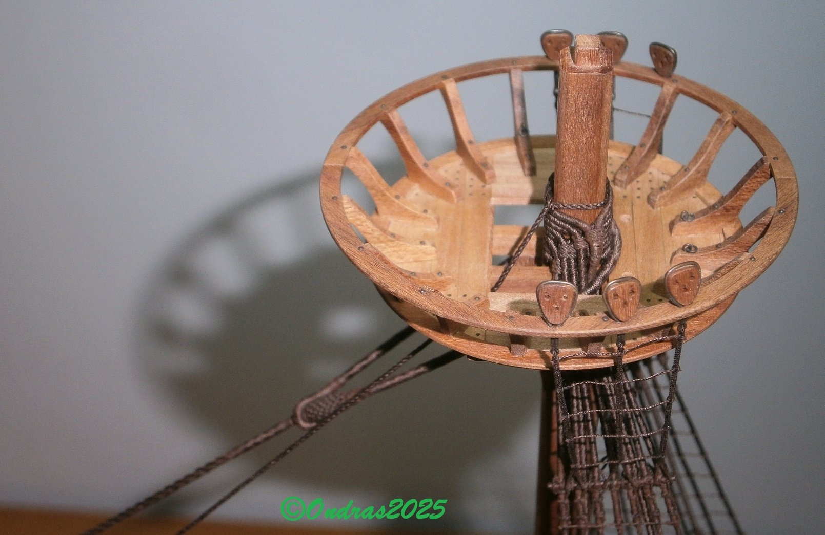

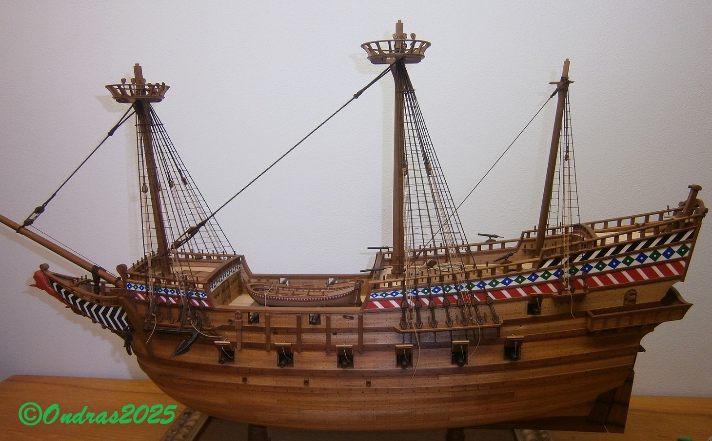

Lower Ratlines finished..🔥
Next is the Catharpins component, seen from the William Rex ship model..:Whew:

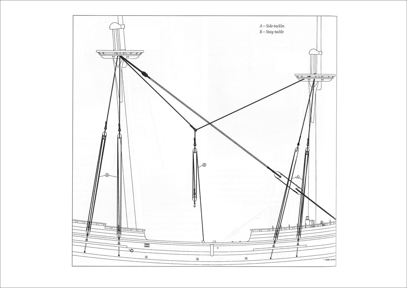

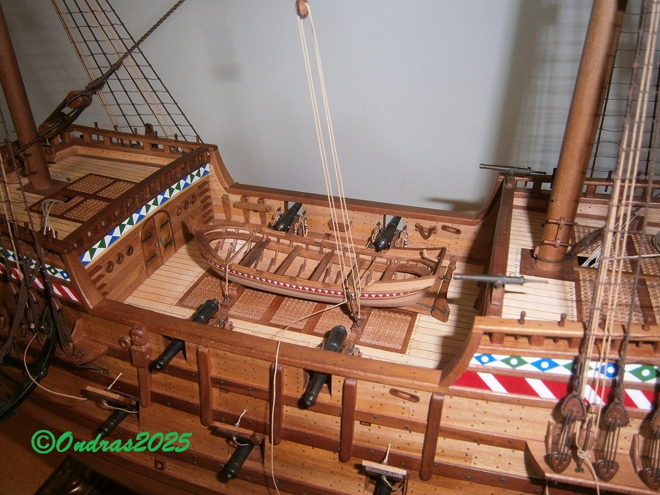

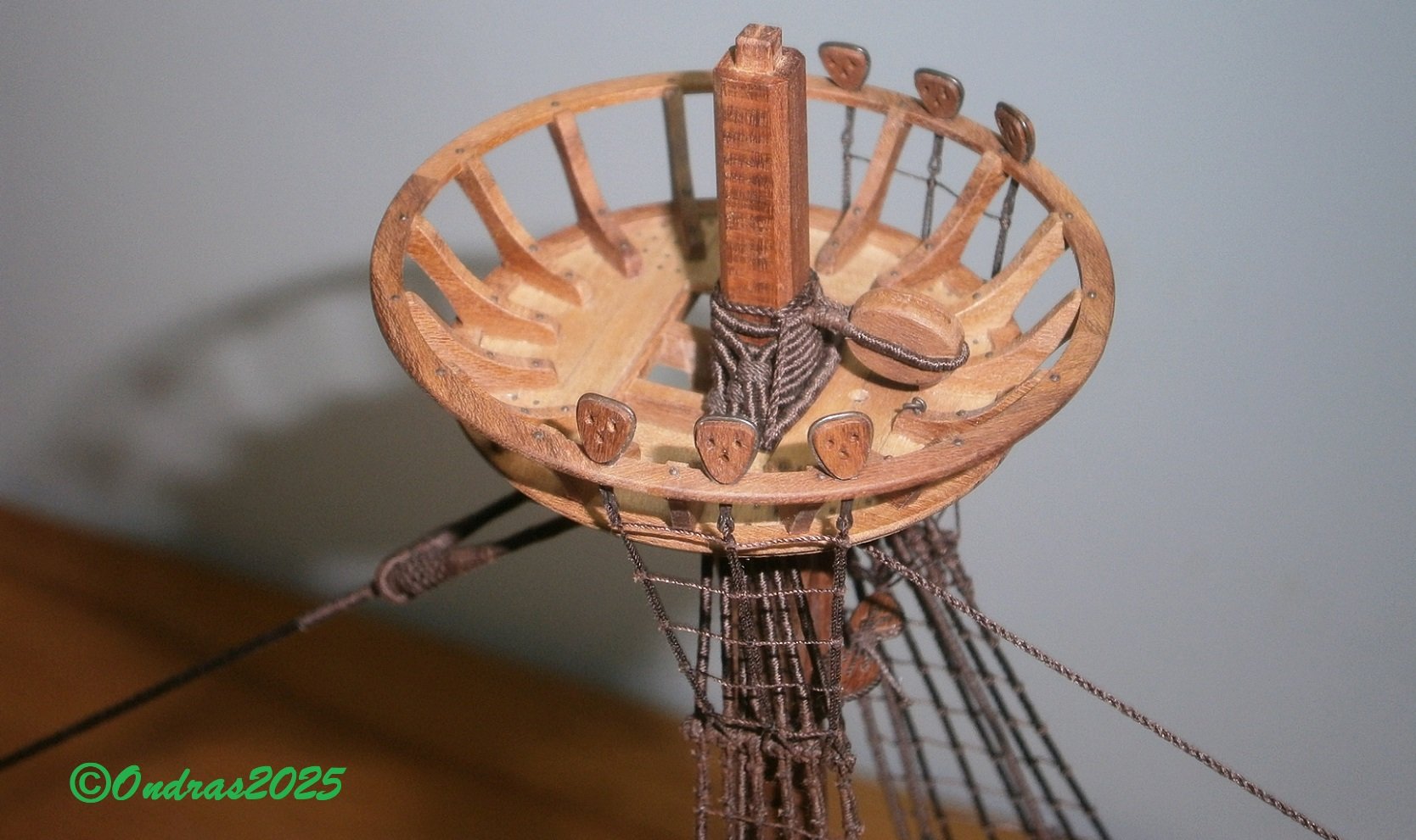

Another component. Removable loading hoist "Stay tackle"..:rolleyes:
It was nicely discussed here by modeler Mati and the author of the book "The ships of Abel Tasman" Ab Hoving. https://shipsofscale.com/sosforums/threads/pinnace-papegojan-1627-1-48-completed-build.7055/page-2#post-159810
Staytackle(1).thumb.JPG.2f7f829320f3e3b1c47446386524475d.JPGStaytackle(2).JPG.d683fd13c81ad0ce26e807cd7fd63322.JPGStaytackle(3).thumb.JPG.6c9bd69f499fe6f66a5c766cc256528f.JPGStaytackle(4).thumb.JPG.faefe1103b22d0fd41b7765cacad7c94.JPGStaytackle(5).thumb.JPG.07f641eb5ee36bf713a9daa4d767070e.JPGStaytackle(6).thumb.JPG.c3917ed0f1170405048e929c4ad9e050.JPG

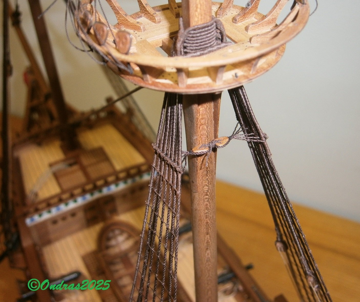

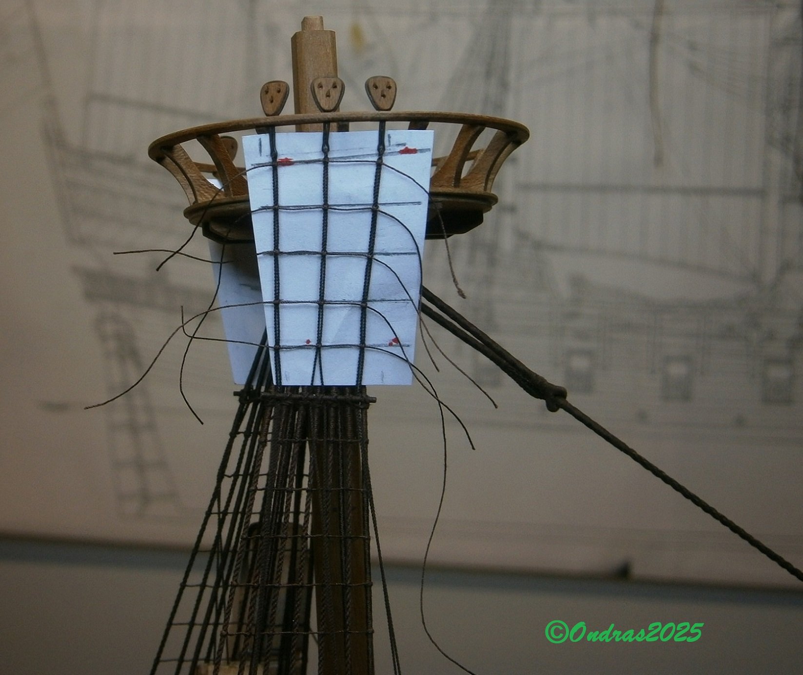

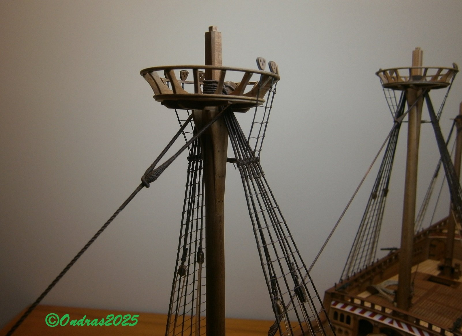

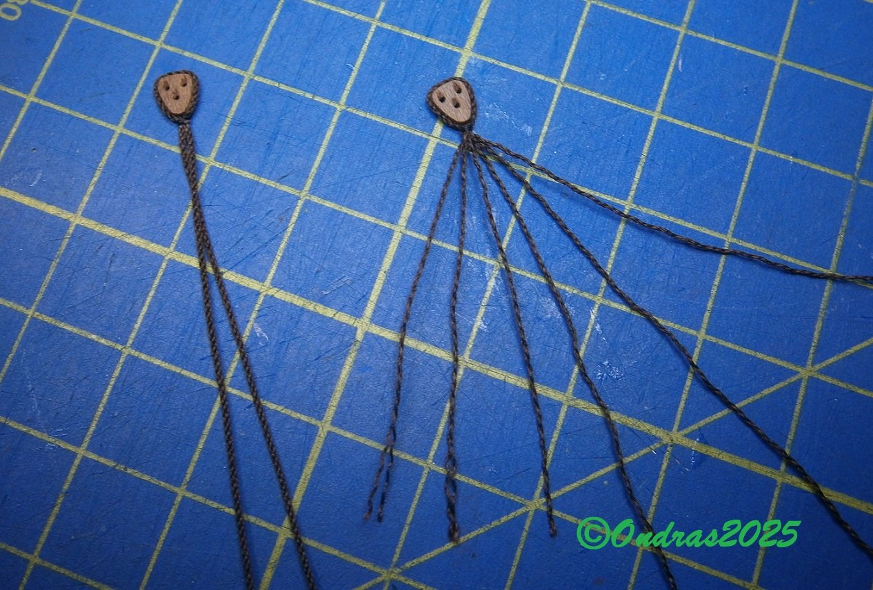

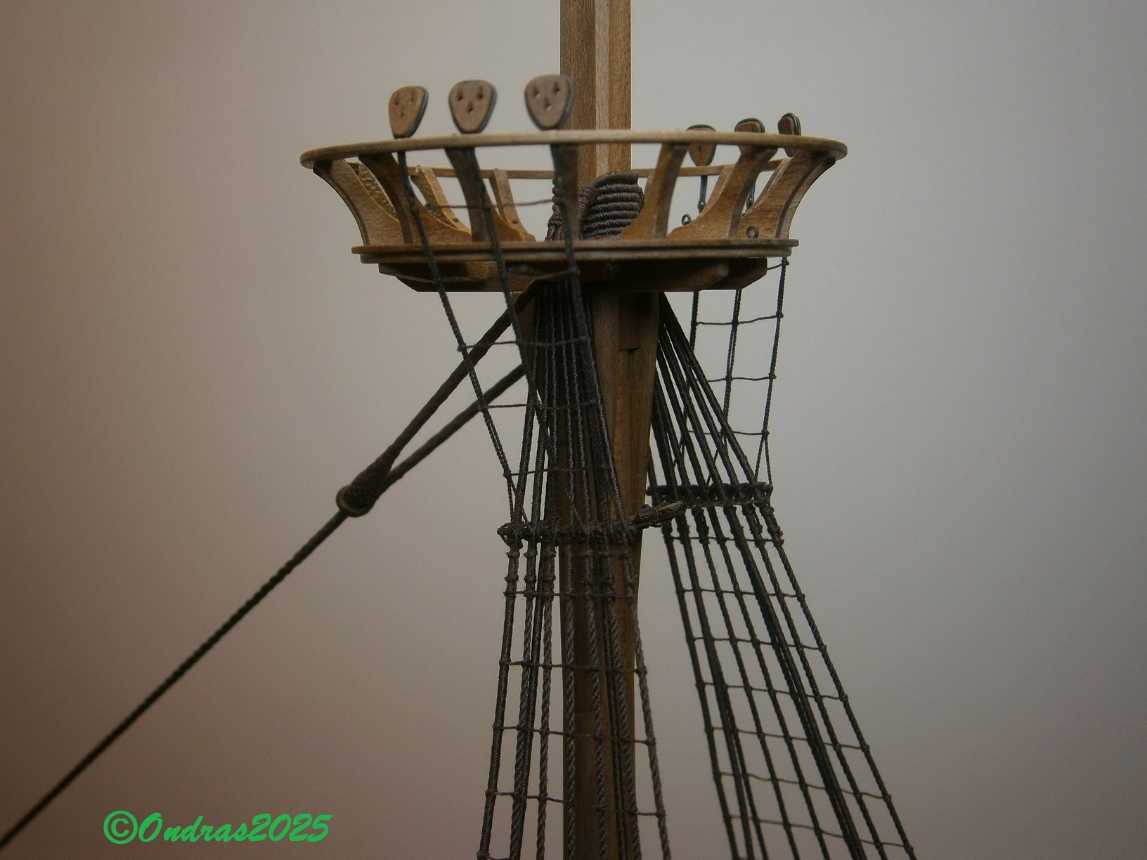

So in the new year, I measured the Topmast shrouds..🙂
Topmastshrouds(1).thumb.JPG.3e28098f76c1728167db65a99a52f1fa.JPGTopmastshrouds(2).thumb.JPG.1acfc91ae7546cdb0958684e9f456fbf.JPGTopmastshrouds(3).thumb.JPG.8e0feffd1732fb3713e79bece5df19a2.JPGTopmastshrouds(4).thumb.JPG.899deb553cd60e197a153c7467b24b23.JPG
Tied up temporarily. Topmast will be removed..
Topmastshrouds(6).thumb.JPG.3cd30190484e0ed9af138c6a36ca0d3e.JPGTopmastshrouds(7).thumb.JPG.75748d8828d44bfc49af1f7b14a0340e.JPG
