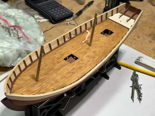

Well, it's been another year - obviously not a fast worker. However, I fortunately was contacted by a local modeling club that I didn't know existed and invited to join.  These guys are experts and I now have a mentor which has made a world of difference.  I redid the deck which I think is a major improvement and have added bulwark stanchions.  Now I'm installing the knees as seen in the picture.  Next, benches, pin rack and then rudder.image.jpeg.5af9b4e4459139f321c17d4533949f56.jpeg
New deck and stanchions are looking great, Jim!  Excited to have you in the local KC Square Riggers club!  And, yes, a wealth of information is available from many of our "seasoned" fellas. 👍👍
