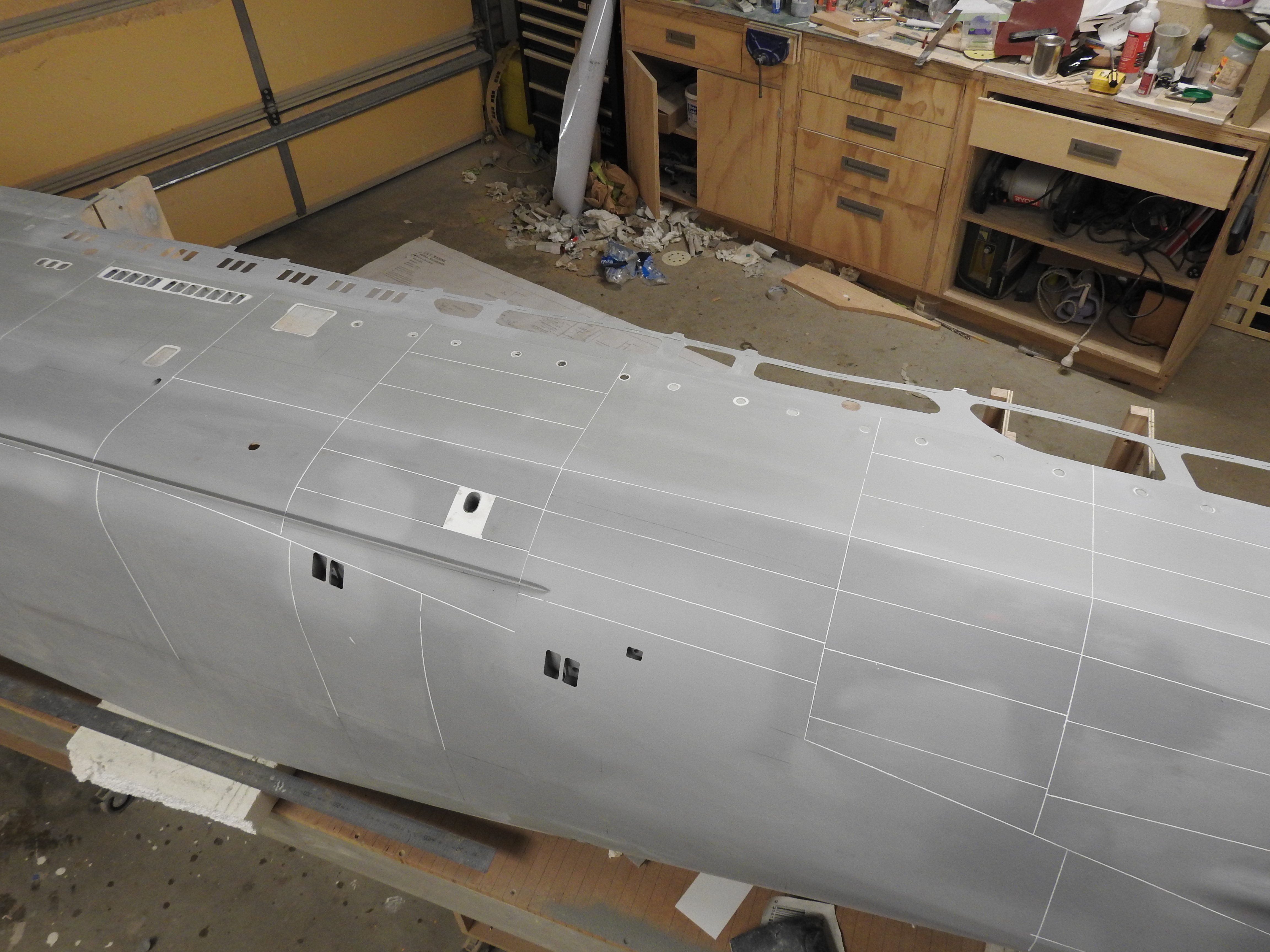

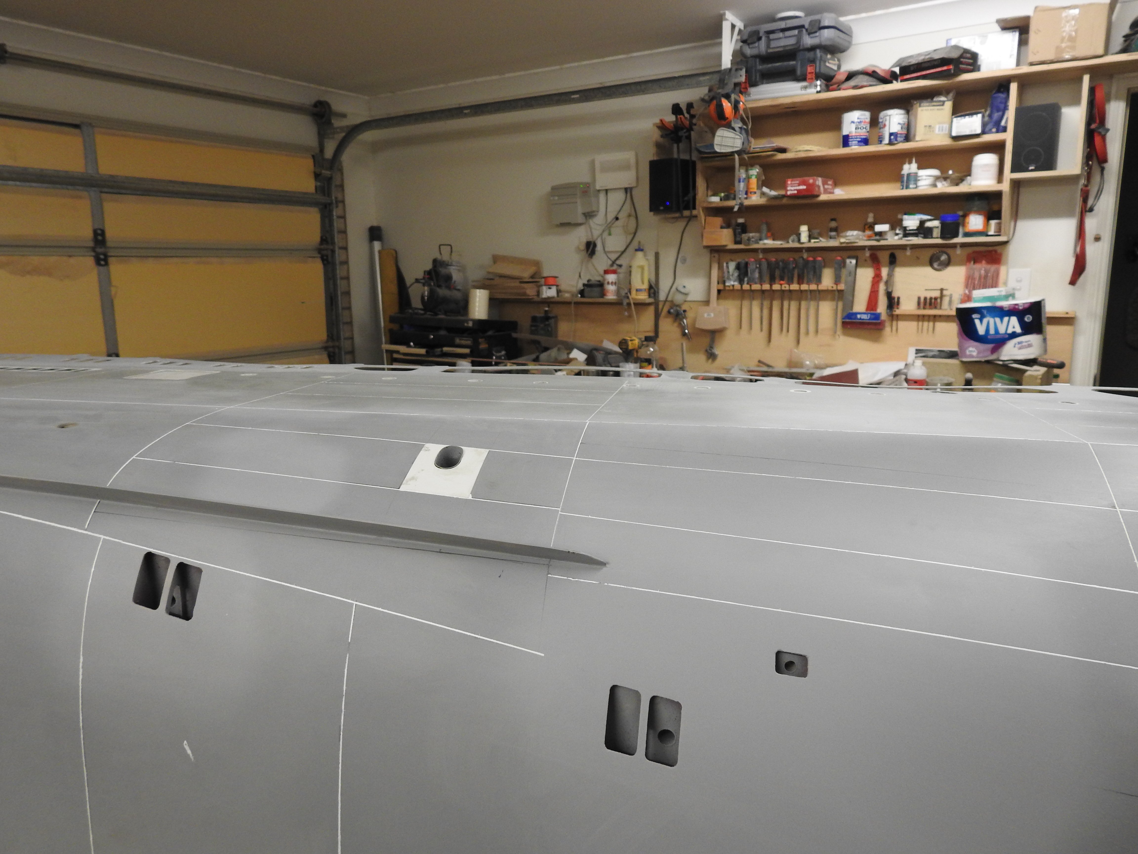

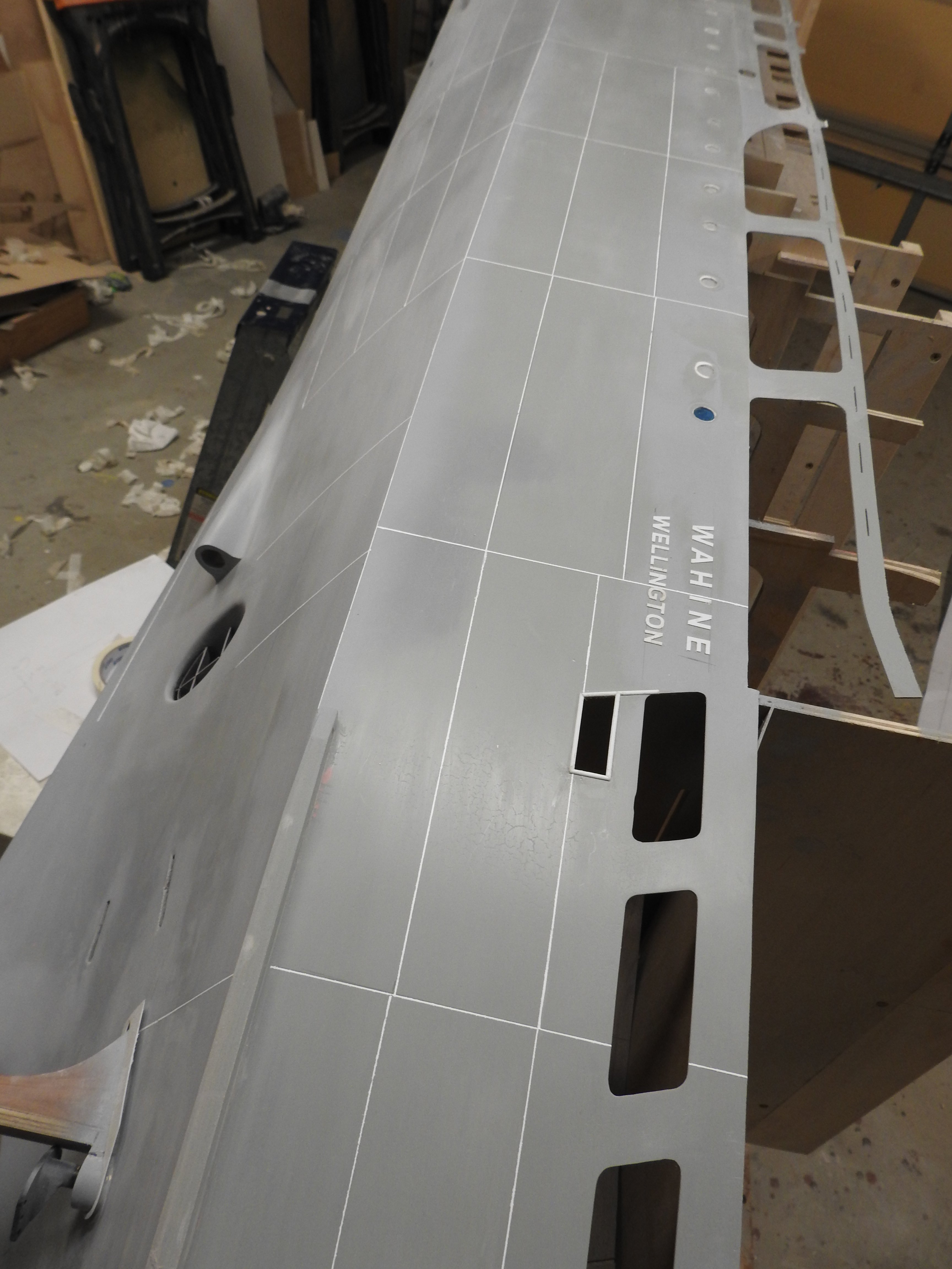

Well the plate distortion is not visible in primer as you need some gloss for it to show but the weld beads are nearly done and the hull is primed to 600 grit , the portholes are all masked at the moment, all the running gear is hooked up and the prop shafts and props are almost ready to install for good. Some superstructure elements are removed for now of course.
Edited by Richard Dunn
