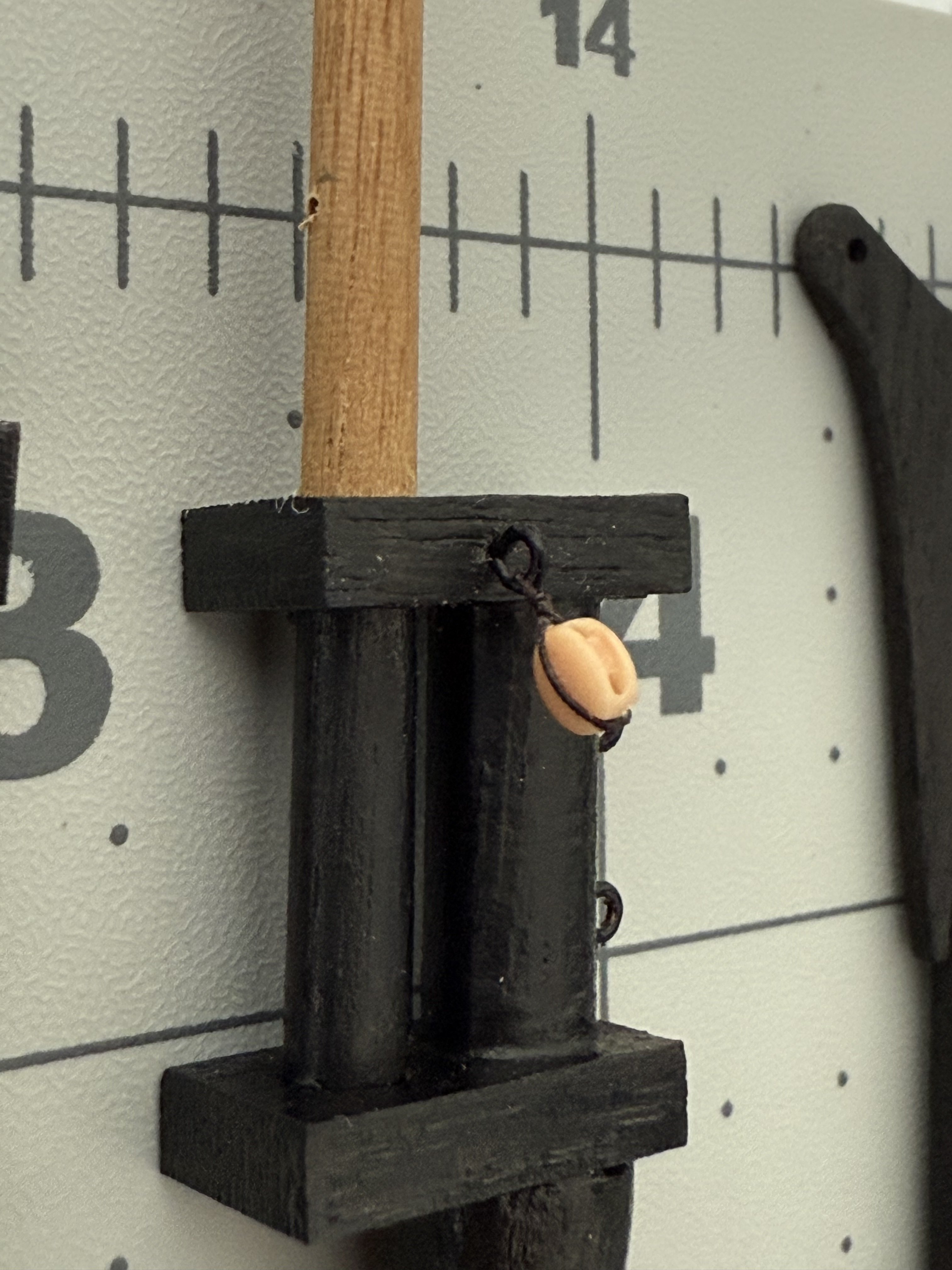

Just a brief update…rigging begins. For stripping blocks, I am using Chuck’s guide, Stropping Blocks. It is still a fiddly process for me, at least with this 3mm block from Syren and .25 mm rope from Ropes of Scale. One thing that I realized was the need to make sure the rope will go through the sheave(?), and in order for a .25 mm rope to pass through this block, I had to open up a little with a small drill bit.IMG_9154.thumb.jpeg.67d70ac8bf4468a6ddc187aadb5e79af.jpeg
