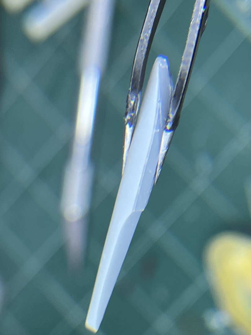

Thanks.  There are thousands of parts and it will take a while.  Just starting on the ladder rungs.  These little rungs are so small it is time to sharpen the tweezers and get higher magnification glasses.  The lighted magnifying glass along with reading glasses really helps.  The drill guides provided with the Pontos kit really help.  The #80 drill is really small, 0.0135" or 0.35mm.  I have decided not to shave off the doors and fire hoses.  There is a fair amount of detail on the existing ones.  For the doors that don't have sufficient detail I will use some of the Pontos doors.  I will also selectively have some of the doors open.  For the doors that have wheels to open them, I add the Edwards parts.  I purchased one of the Edwards part sets, the sheets that contain the vent screens.  The added vent screens should look good with the background painted black to give them some depth.
