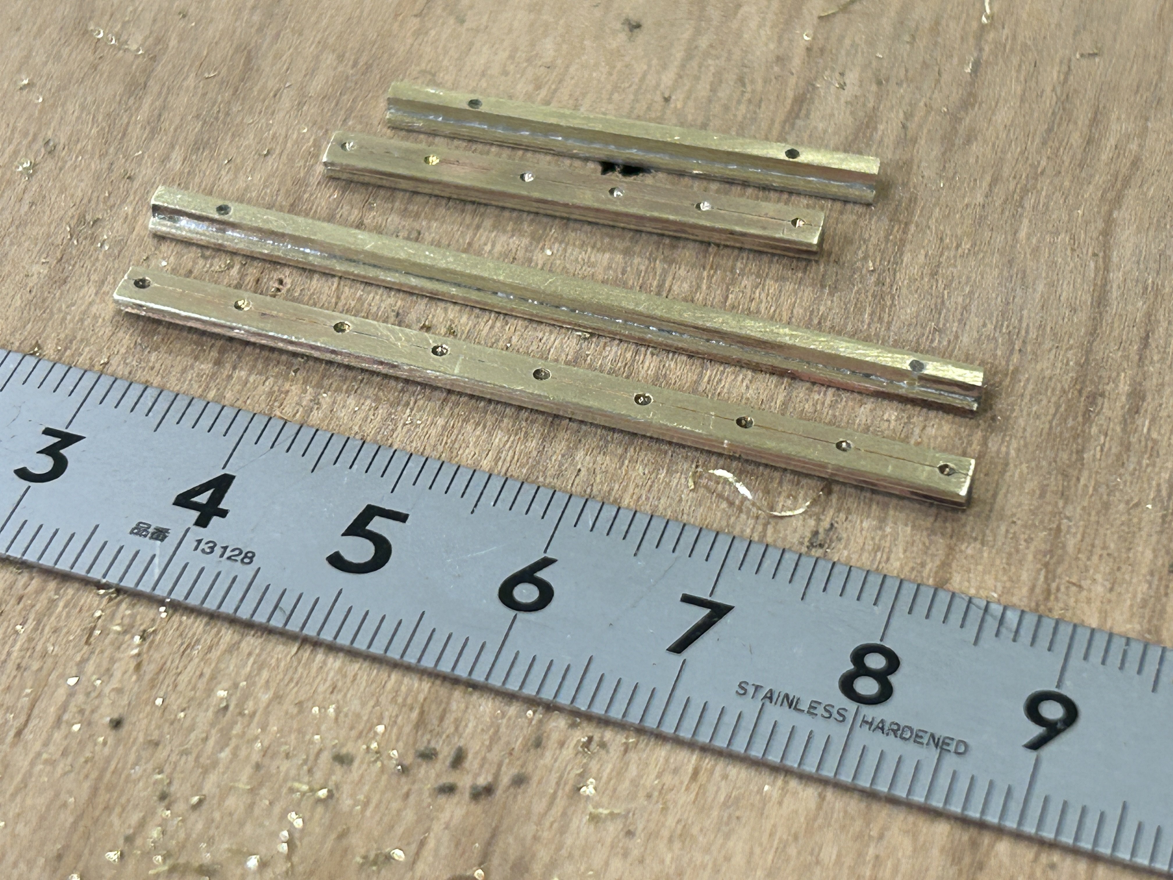

I'm starting on the metalwork, beginning with some easier stuff, which reminded me of some techniques, the main one being: capillary action will flow the solder provided there's sufficient heat where you want it to flow to.
The four jib tracks are done, & I just had enough of the smaller sections of brass for these. I'm still confounded by the changes in the K&S range, to drop out so many smaller sections. The base part of the tracks was thinned a bit by sanding them - they are still a bit thick but look ok. I'll probably give them another sand later.... The subtle line down the centre lengthways is on most metal jib tracks, & I put it on as one of the "delicate" details. I think that if you include a few of these in a model it can give an overall effect that you think there's more detail than there actually is. More cleaning up later & then the tinning finish (thanks again Wefalck).

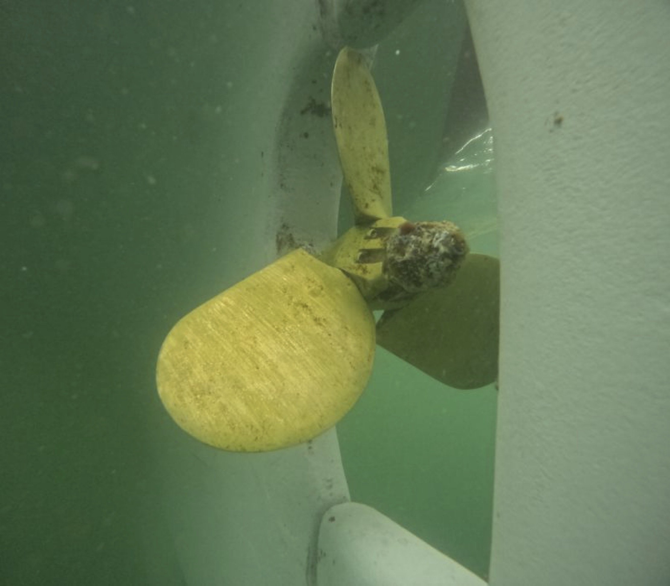

Hi John, for your interest here's a photo showing the blades rotated, on a slightly different model of the same prop brand. You can see how the lower section of each blade is quite thick.

FWIW, we had the 2-blade versions on our boats and they were indeed slippery when feathered. The MaxProp versions we had did require the shaft rotation to change direction in order to completely rotate the blades so that the leading edges were "facing into" the proper orientation for the boat's heading.  When one shut down the motor, (and if one was moving through the water sufficiently), the props would then feather into a fore-and-aft configuration for minimum drag. However, those flat blades do give up about 10% in thrust when compared to blades with non-flat sections.
Most of the time, that loss of a certain amount of thrust was not a problem.
Craig
Hi Craig, thanks for the compliment, it worked out nicely. Re the loss of thrust, I suppose they factor a bit of extra blade area in when selecting the appropriate diameter & pitch etc. Another option is solved in another way by a local traditional sailing type, that are restricted to fixed props (ie: no feathering allowed), they use 2 bladed & put a spot of paint on the shaft so they can align the 2 blades vertically, so the blades sit behind the deadwood.
