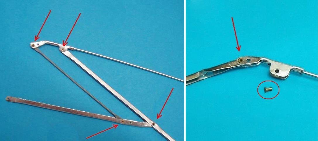

Hi.
I don't know how much "tiny" but see whether those joints from an old umbrella might suits you...
Thx
