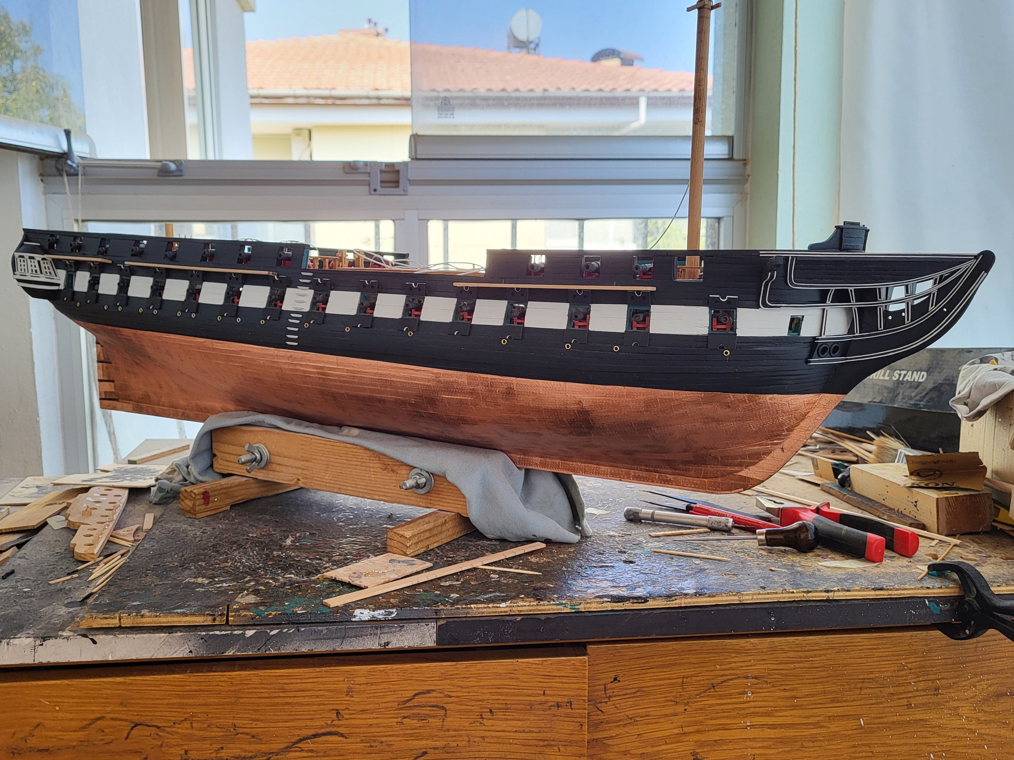

Sorry to interrupt your summer hiatus, Mustafa, but, can you tell me roughly the thickness of this curtain? I tried pounding 1 mm wire and ended up with something like 1.25mm.  I'm just trying to decide if my "eye brows" are oversized at 2mm.  BTW, The Britannia castings provided by Model Shipways are 1.38 mm.
Yours
20250528_095811.thumb.jpg.644f53c70e31339f9c81c2e4c0876552.jpg.123383395bda5a329a305275596b6c45.jpg
Mine

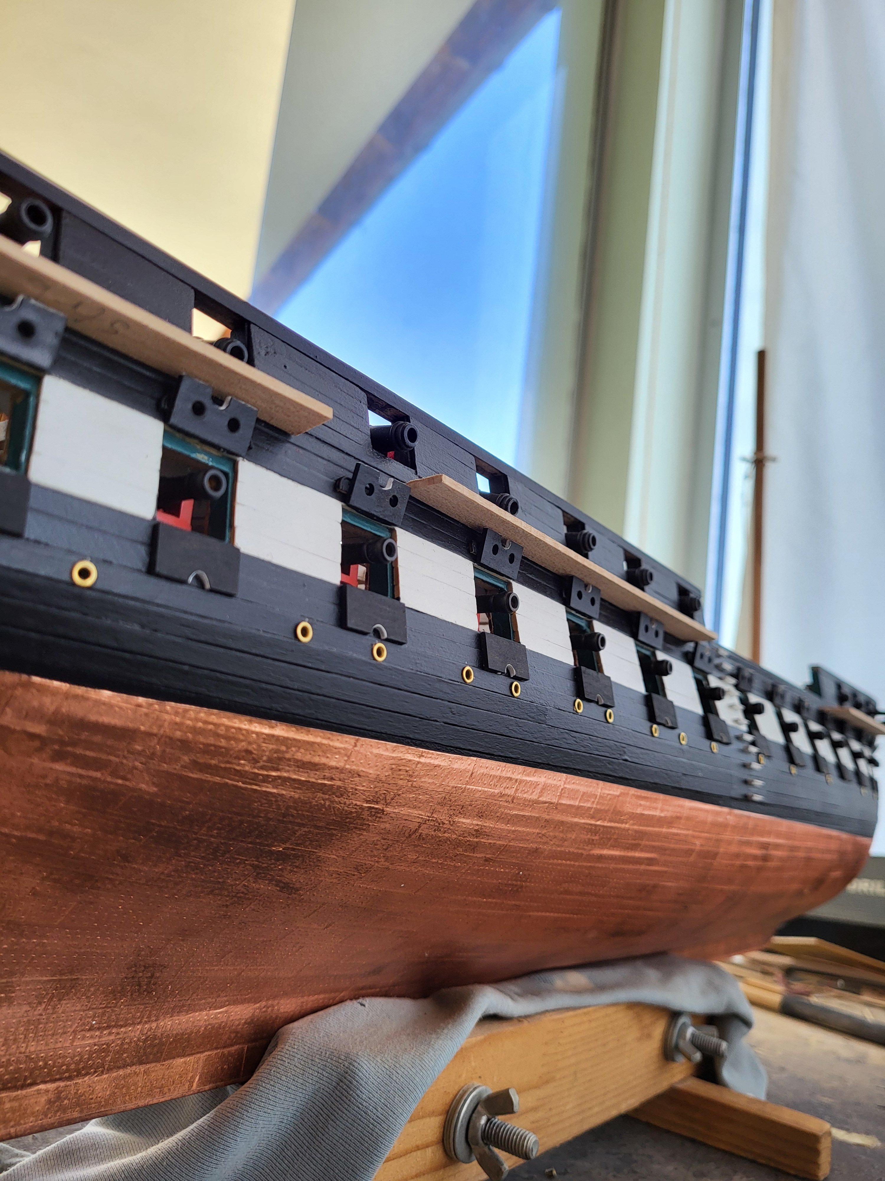

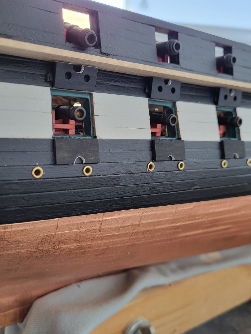

I'm back at my shipyard after a long break. At this stage, I've decided to add the berth deck portlights. I'll be making the channels and chain plates next. I've completed the installation of the starboard portlights. They will be painted black later.

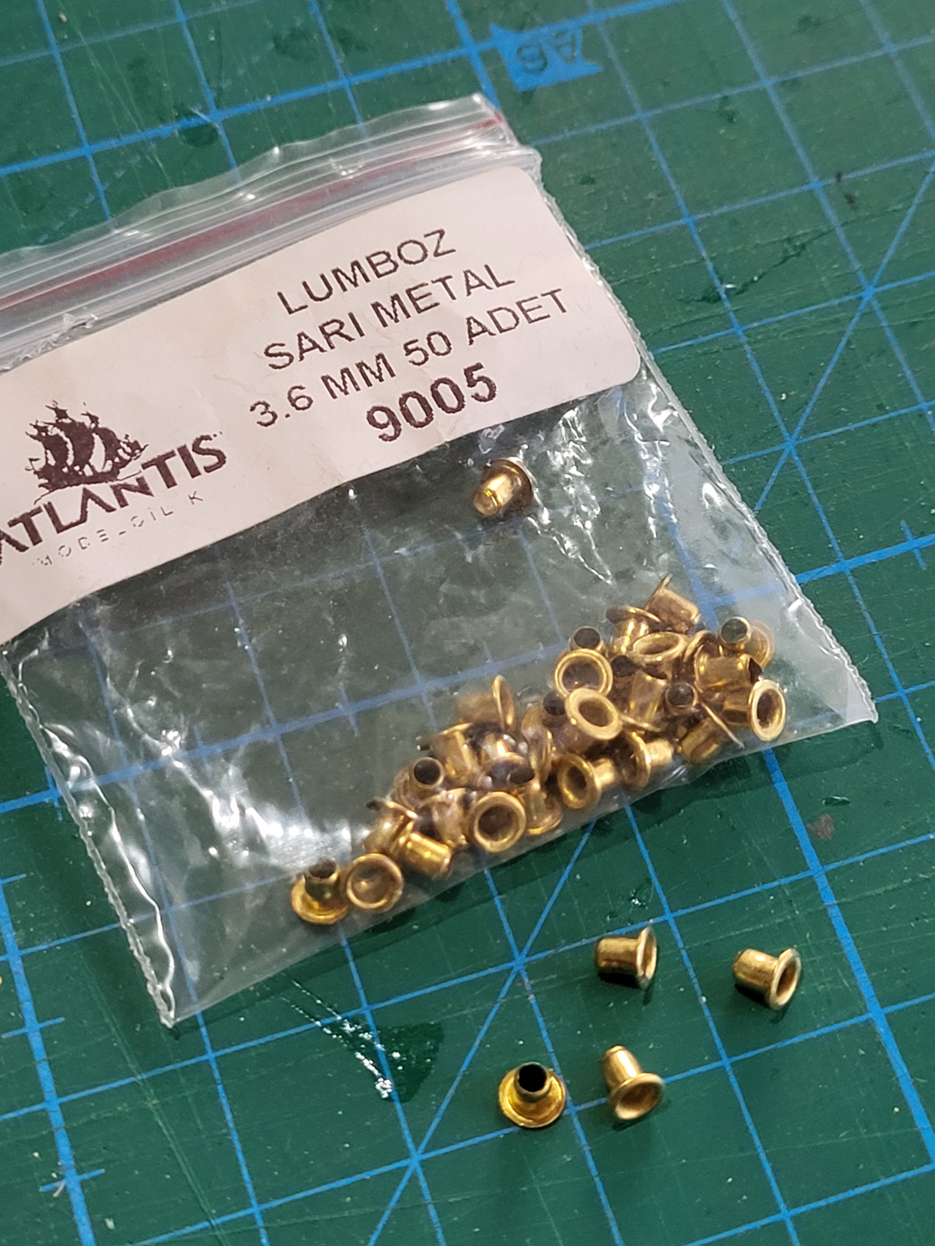

I assume the berth deck portlights are simply small brass tube pieces inserted and glued
Gregg
Hi Greg, no I didn't cut these from brass tubing. I bought them from a hobby store.The diameter of the flange is 3.6 mm and the outer diameter of the pipe is 2.4 mm. I first drilled 2.4 mm holes in the ship's hull and placed the portholes inside.

Ahhh, they look great, Mustafa!  Perfect detail.  I appreciate the detailed info.  Put that in my memory for... whenever I get to this! 👍
and they would match my color scheme!  Thanks for sharing this with Gregg.  I shall benefit, yet again, from your input.

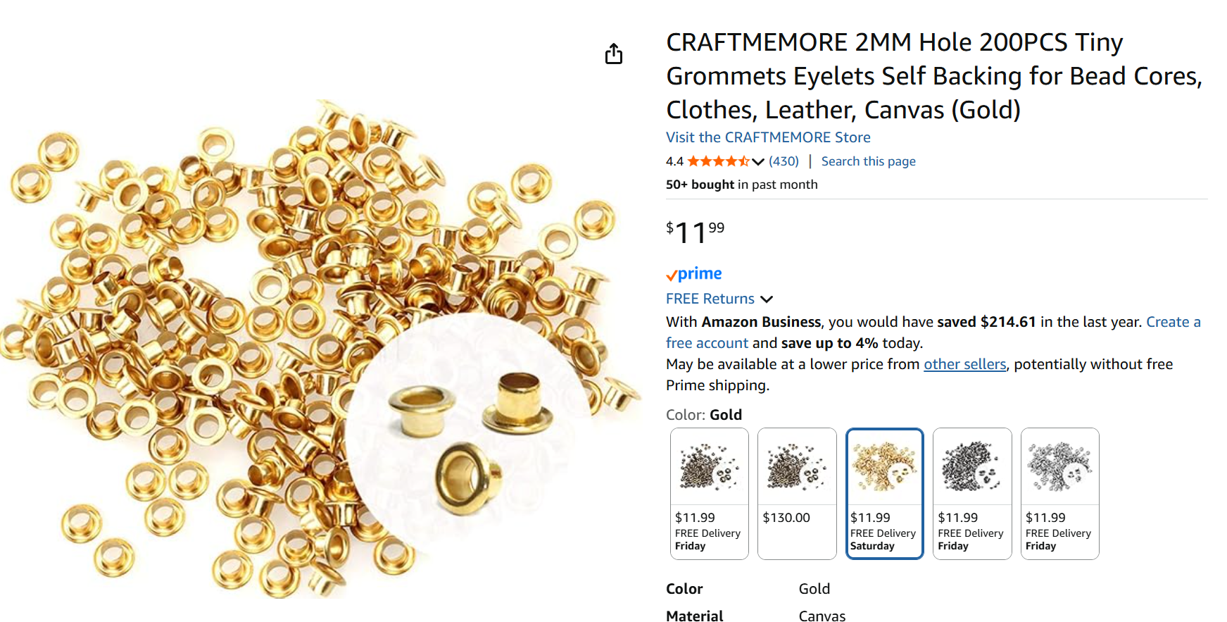

..but then again, nothing is ever easy.  Checking for "2.4mm hole brass grommets" online, the closest I could find to your specs were eyelets for 2mm and  3mm holes.  And, of course, flange diameters are not provided in the specs.  I suppose being .4mm too small beats being .6mm to large.   I suppose a $12 investment in 200 of these won't break the bank, and it beats having to file, polish and spray paint the parts that came with the kit.
Hi Peter. The outer diameter of the pipe on my grommet is 2.4 mm. I believe the 2 mm measurement on the grommet you found is the inner diameter of the hole, and the outer diameter is probably equal to mine.

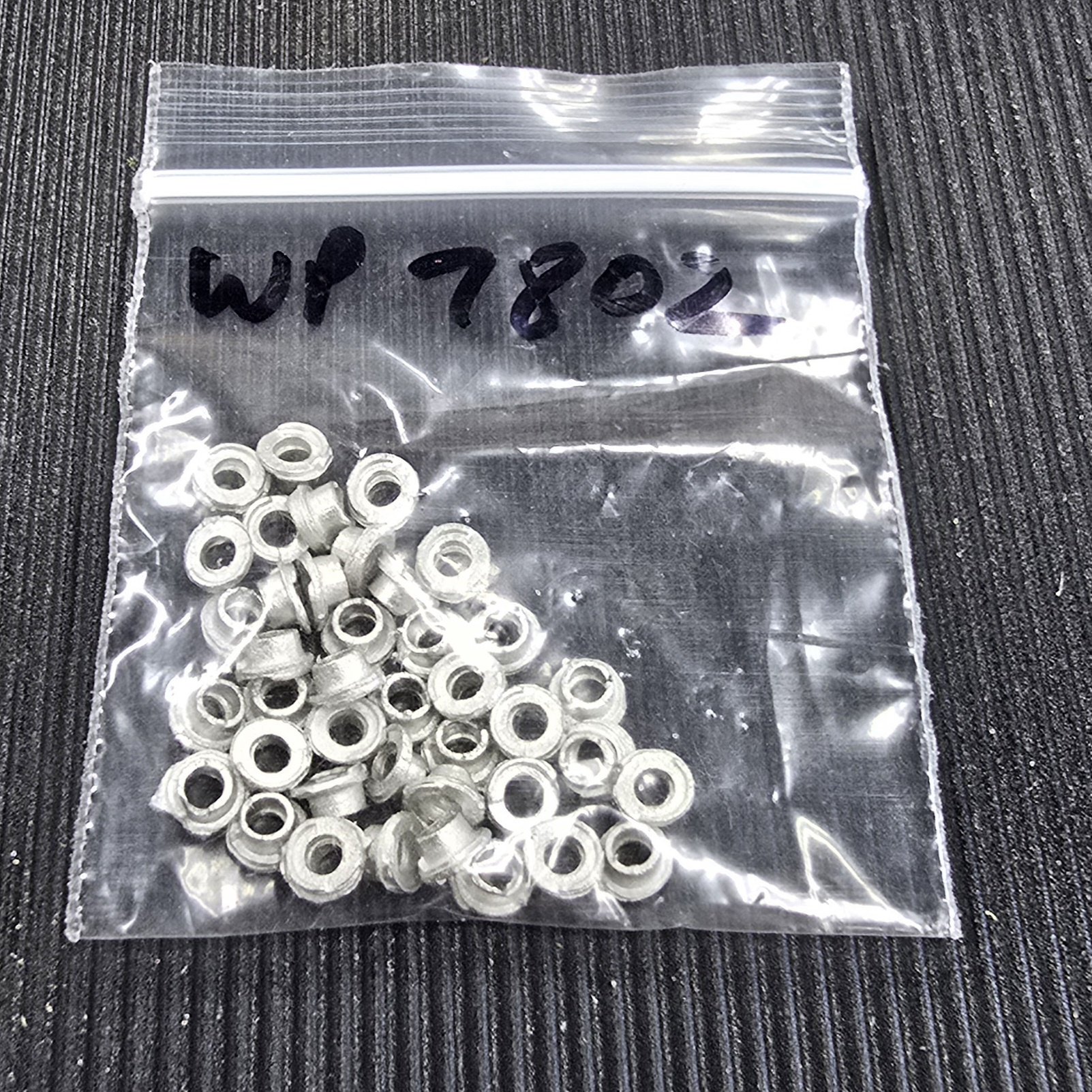

Peter, didn't your MS kit come supplied with the grommets? Mine did. If yours didn't, you should be able to get a free replacement from Model Expo.

You mean these?
If, like the rest of the modeling universe, I was going to paint these black, yes, I could use these misshapen slugs. But since I'm going for brass, I'd rather spend the 12 bucks and save myself the labor of cleaning these things up and painting them gold or brass.

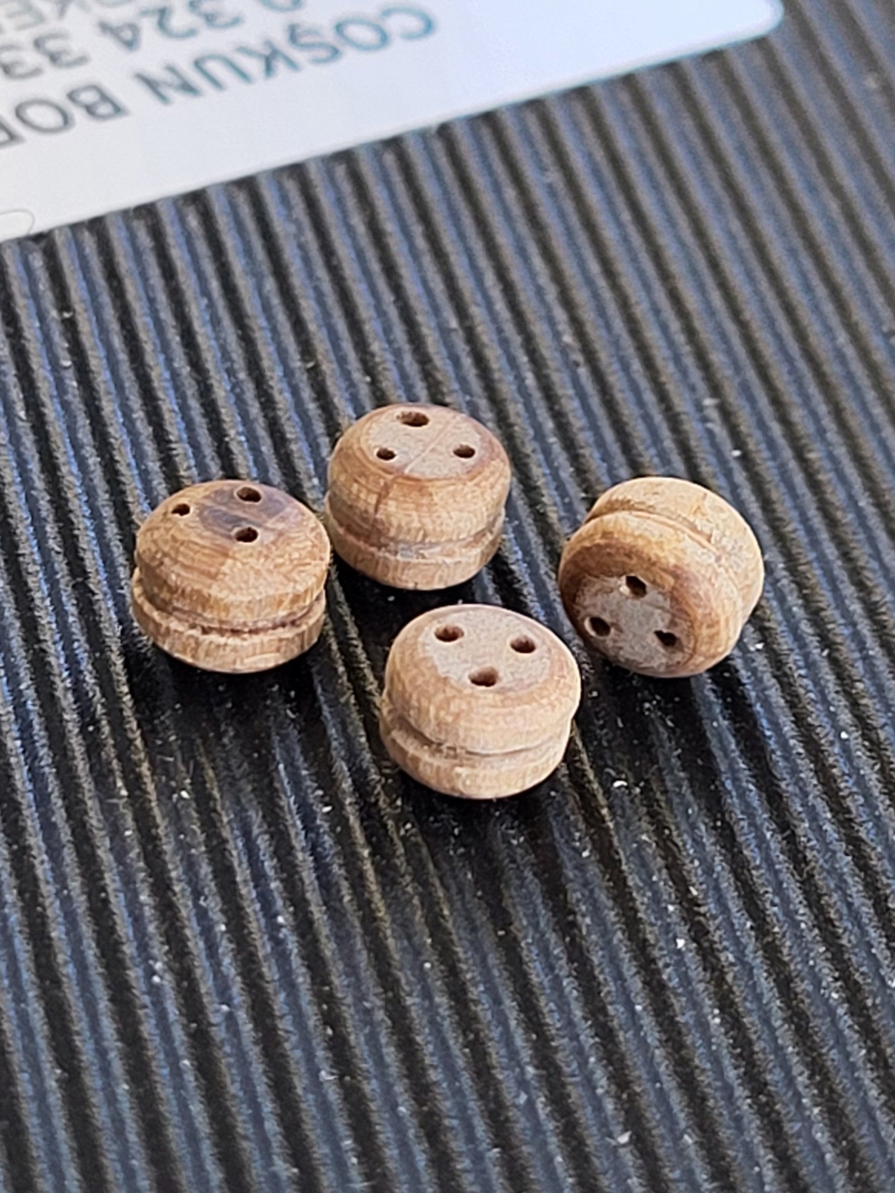

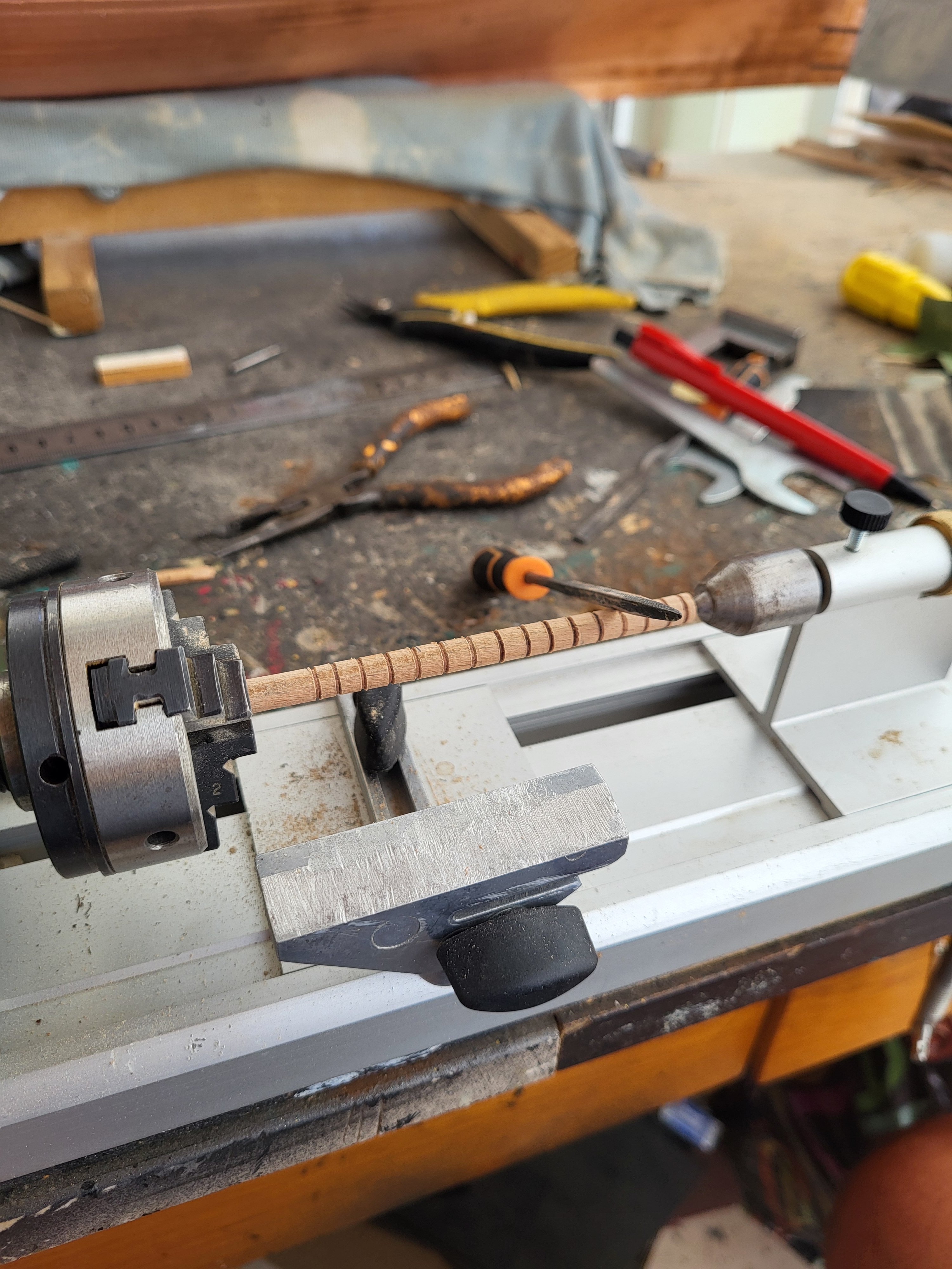

I have reached the point where I need to make deadeyes. At first, I considered buying ready made ones but I decided to fabricate them myself.

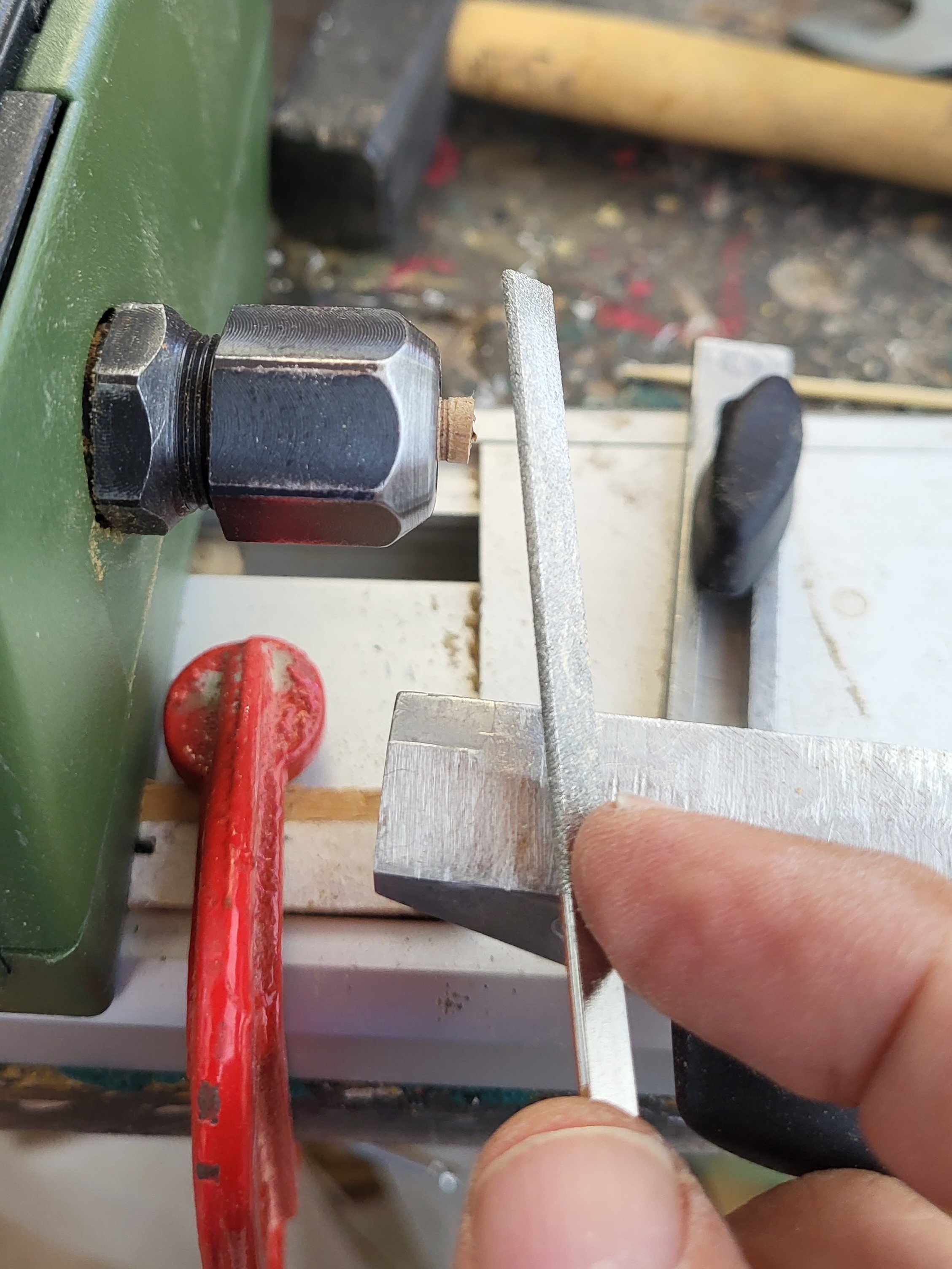

I began by using a triangular file on the lathe to carve the classic grooves into the dowel.

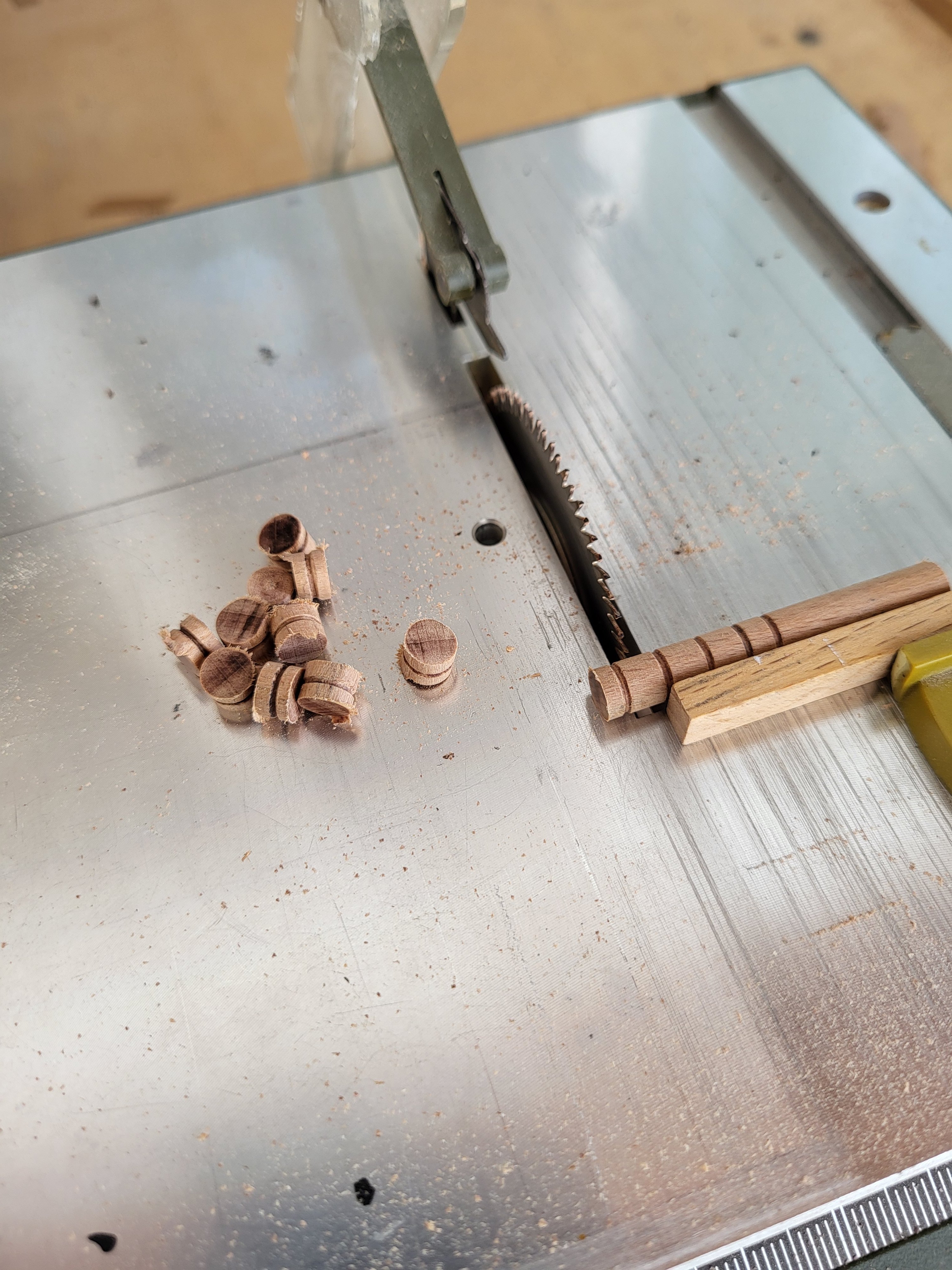

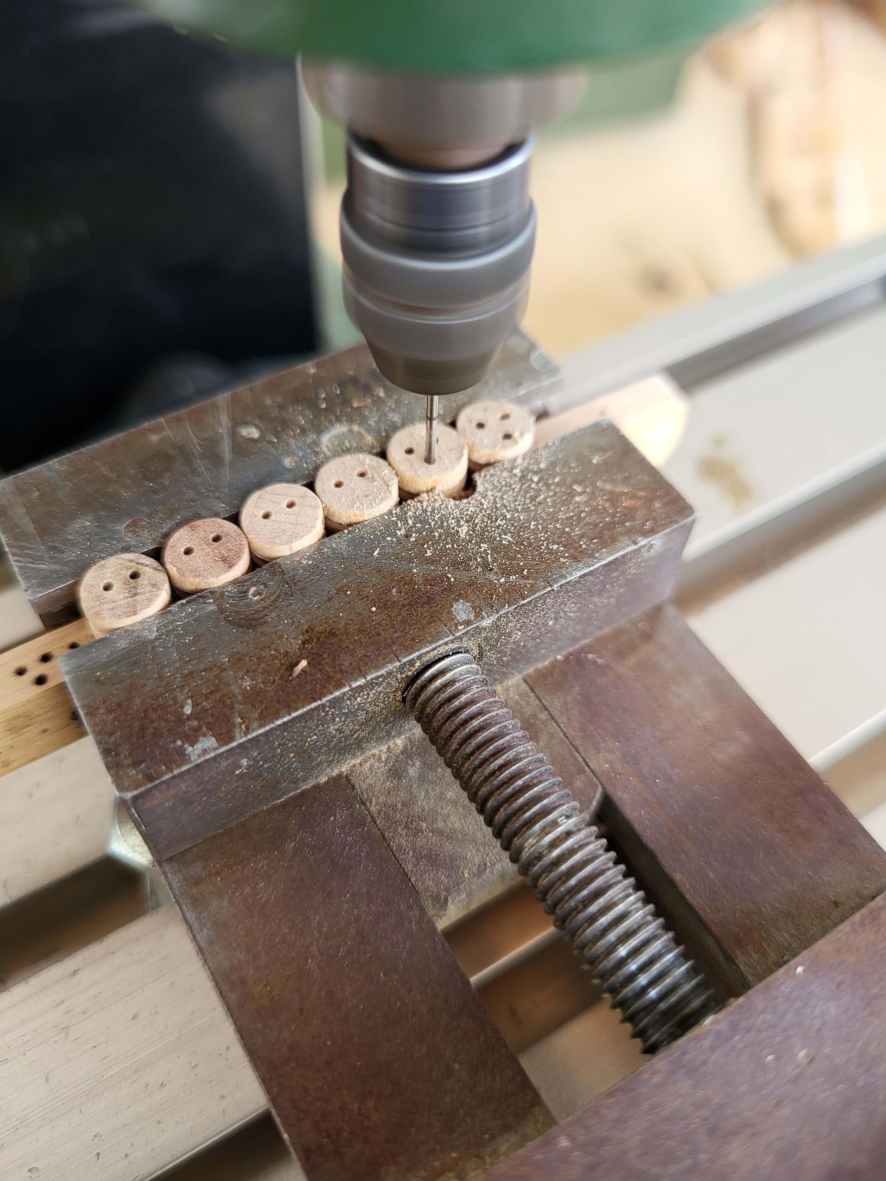

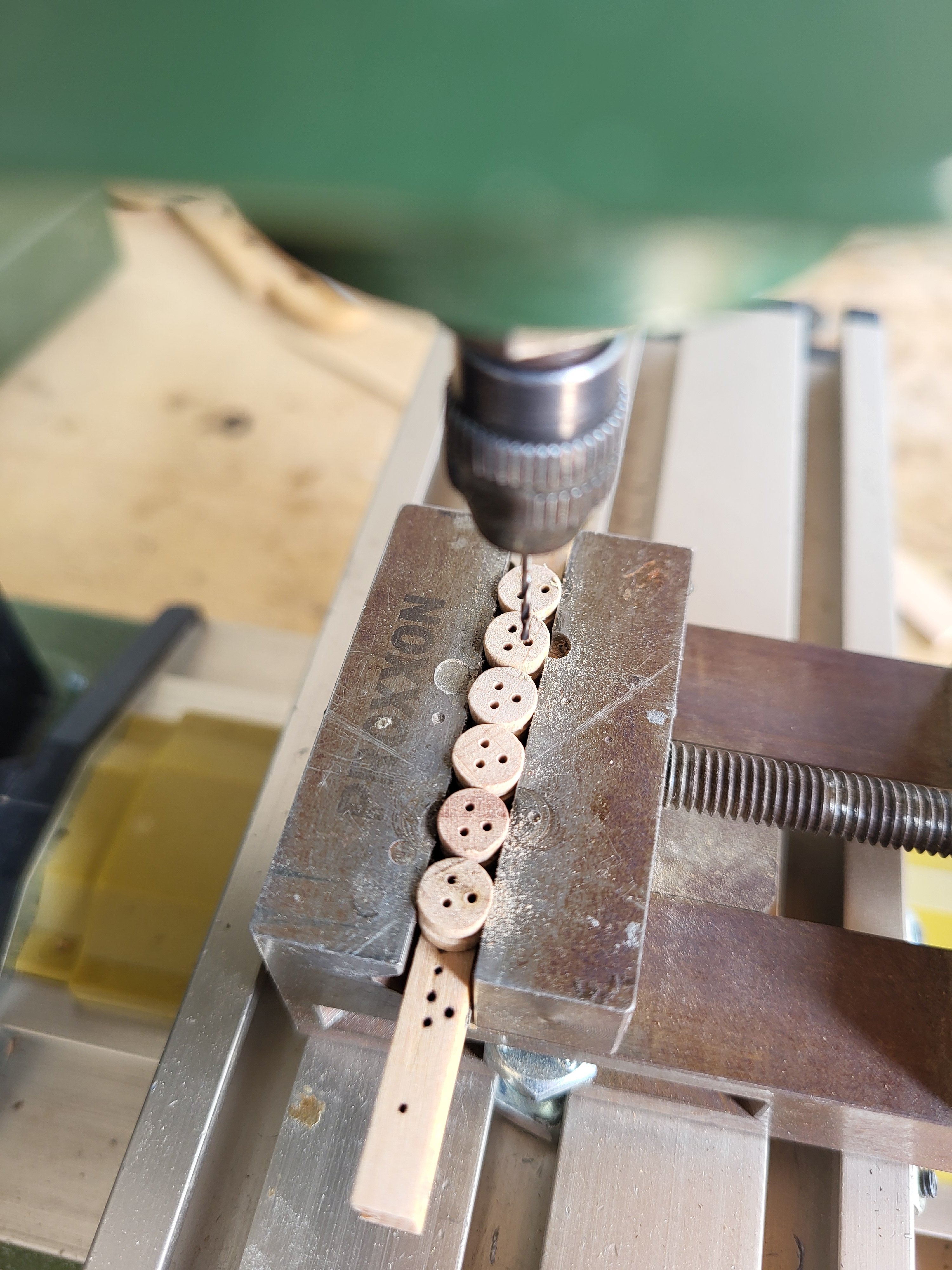

Next, I sliced the dowel into discs of the correct thickness using a circular saw, then drilled three evenly spaced holes in each disc using a 0.8 mm bit.

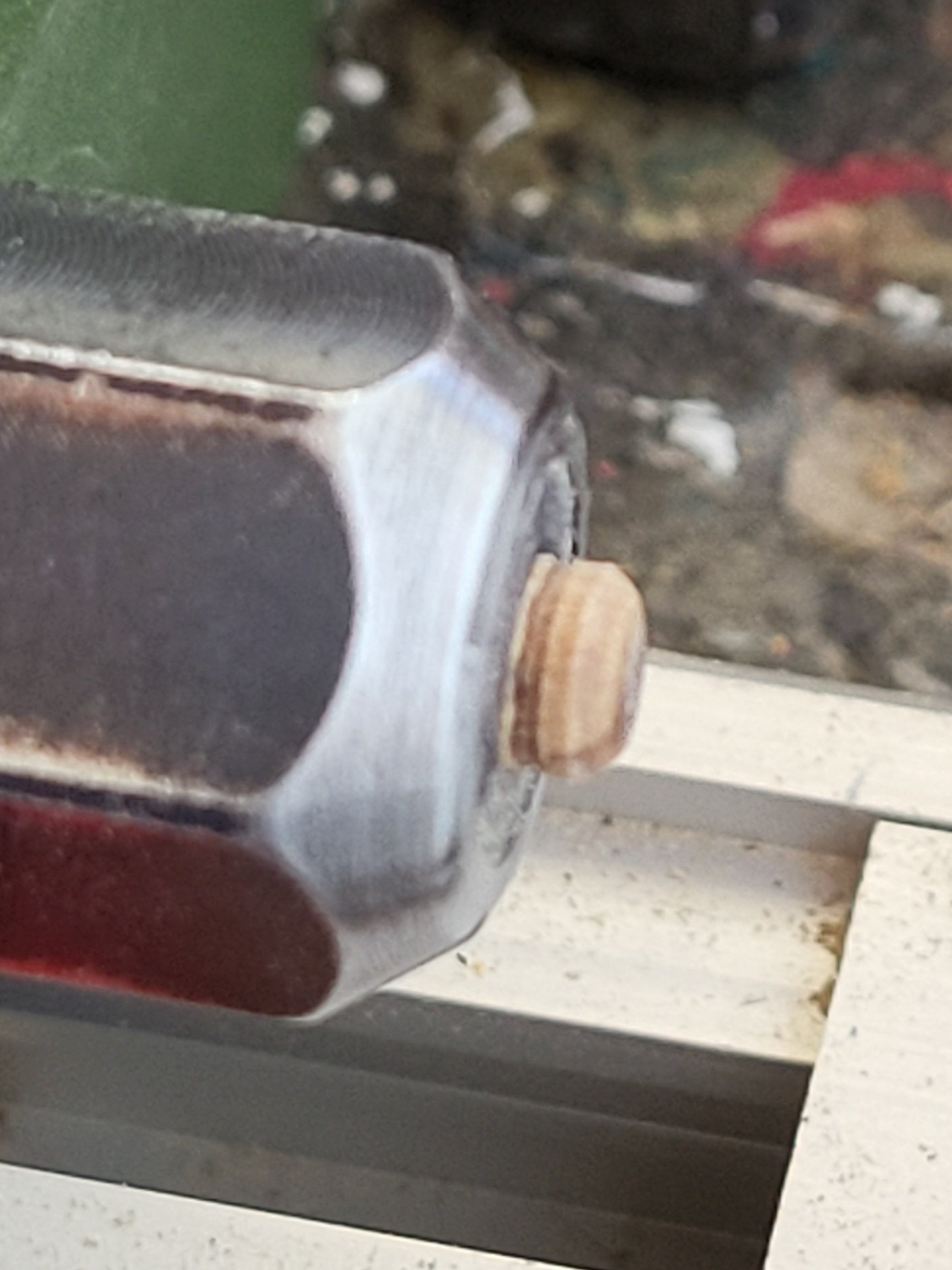

After drilling, I remounted each piece on the lathe and gently chamfered the edges with a file. This final touch gave them a smooth, polished finish. The result: clean, functional, and completely handmade deadeyes.

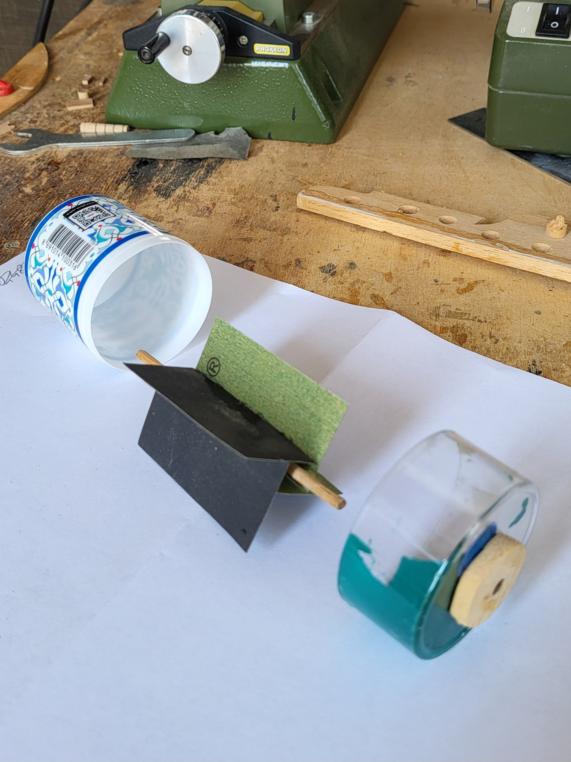

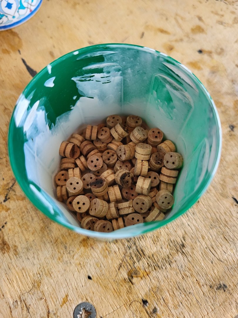

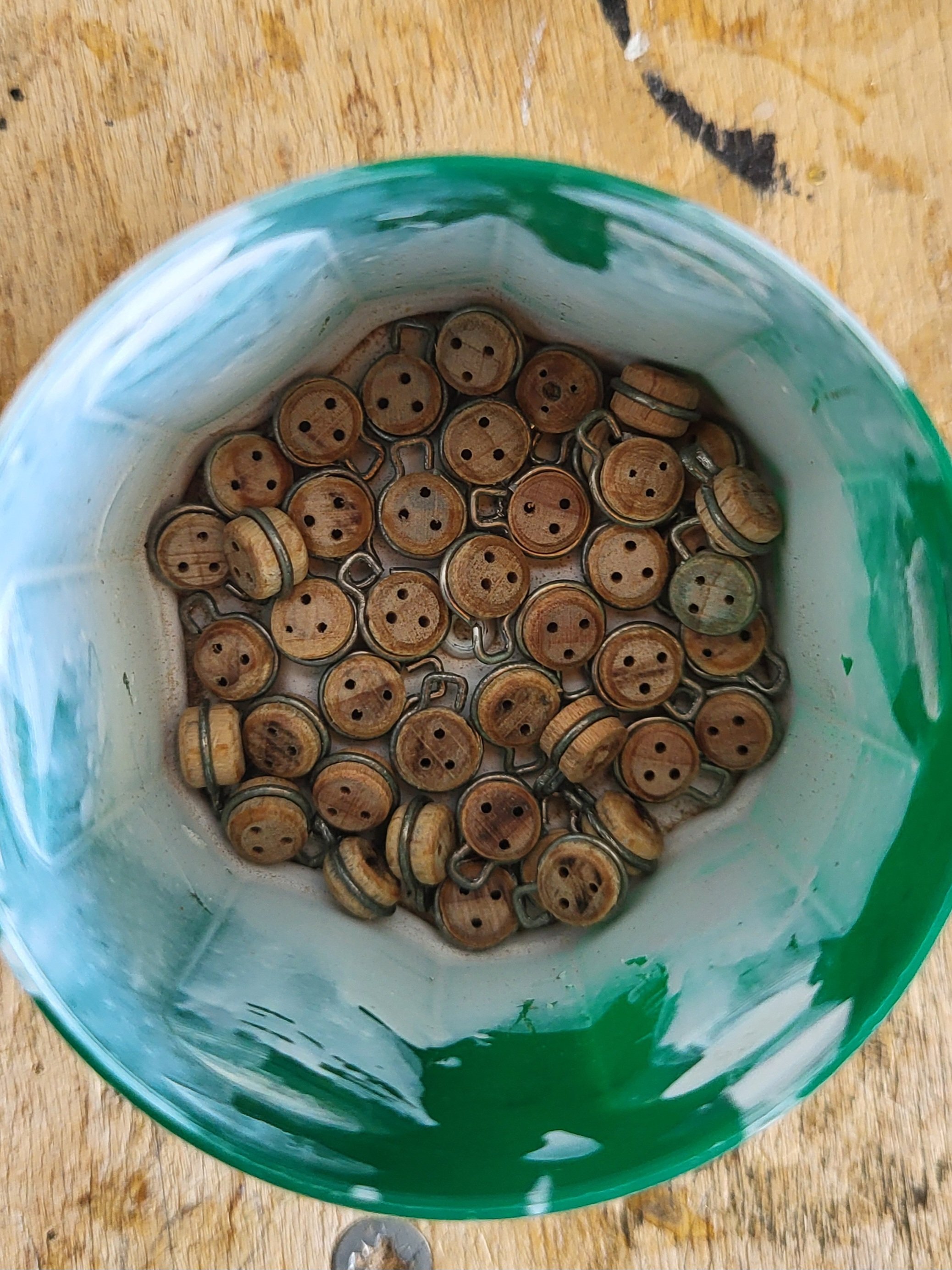

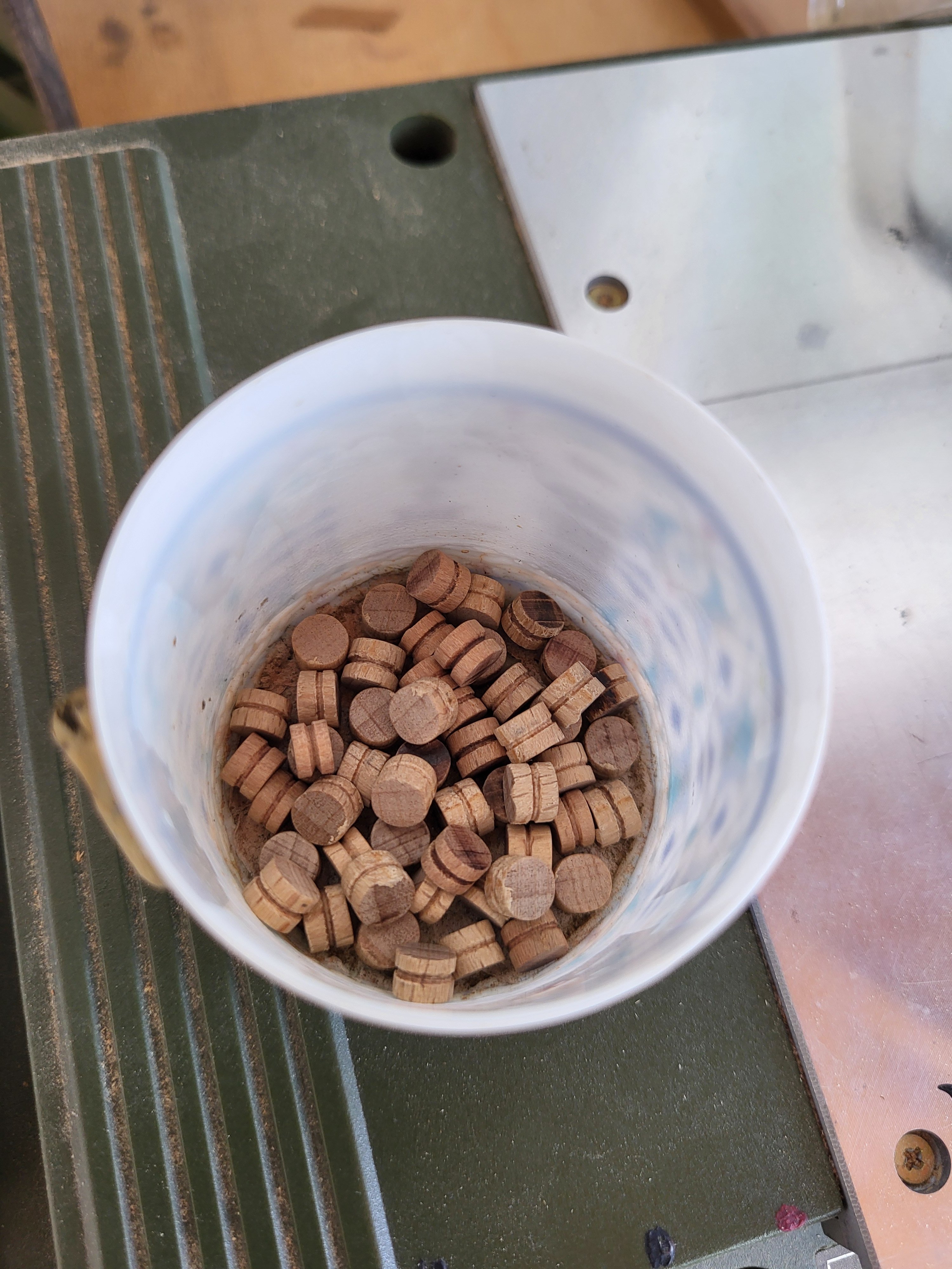

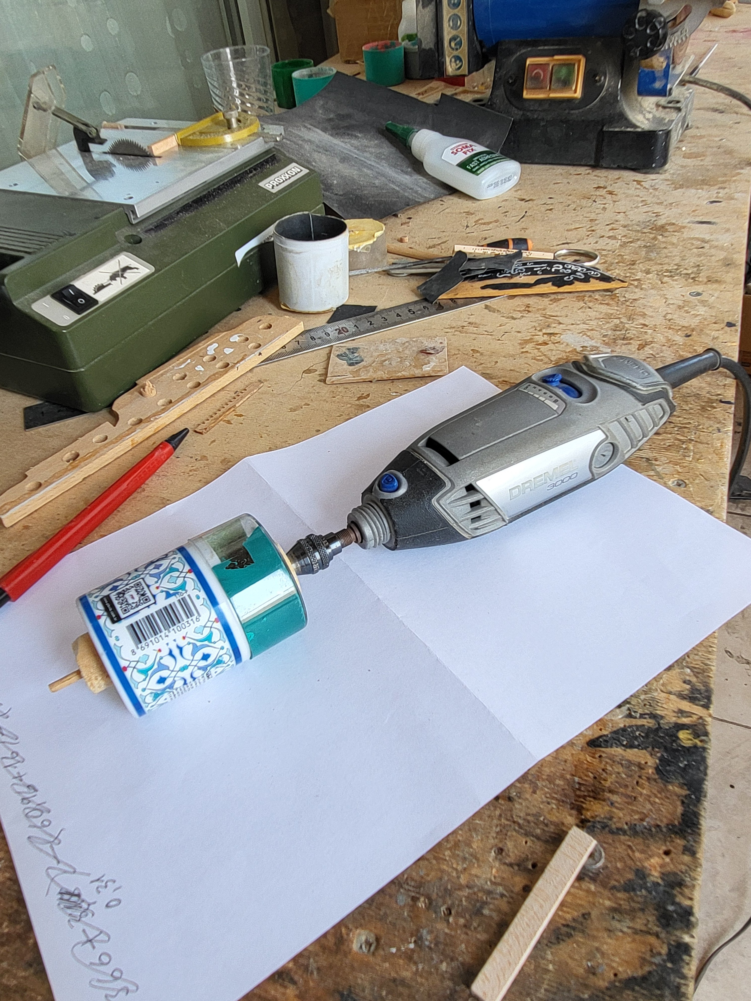

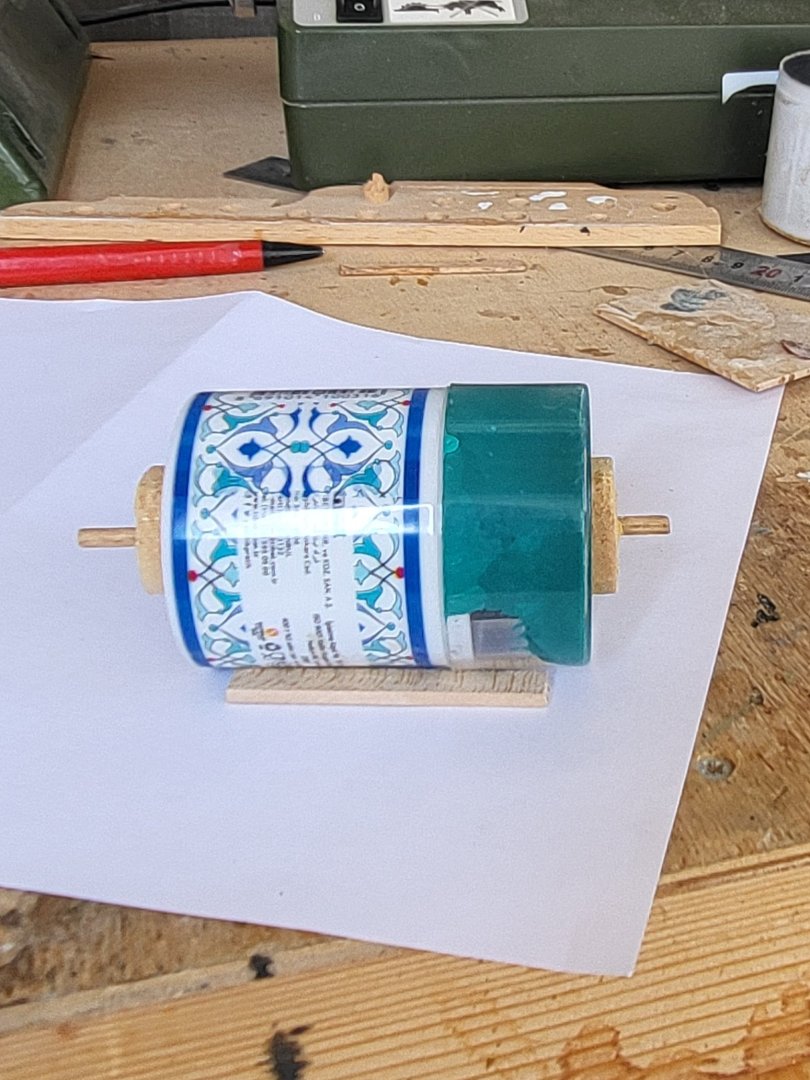

After this step, there are a lot of small parts like deadeyes and blocks that need to be sanded clean, so I made a simple sander to make the job easier. You just drop the parts in, turn the sander with a motor, and they come out clean and sanded.
Edited by mtbediz
I'm sure your deadeyes are much better quality than what they give in the kit.  I disintegrated several of them along the way, lol.

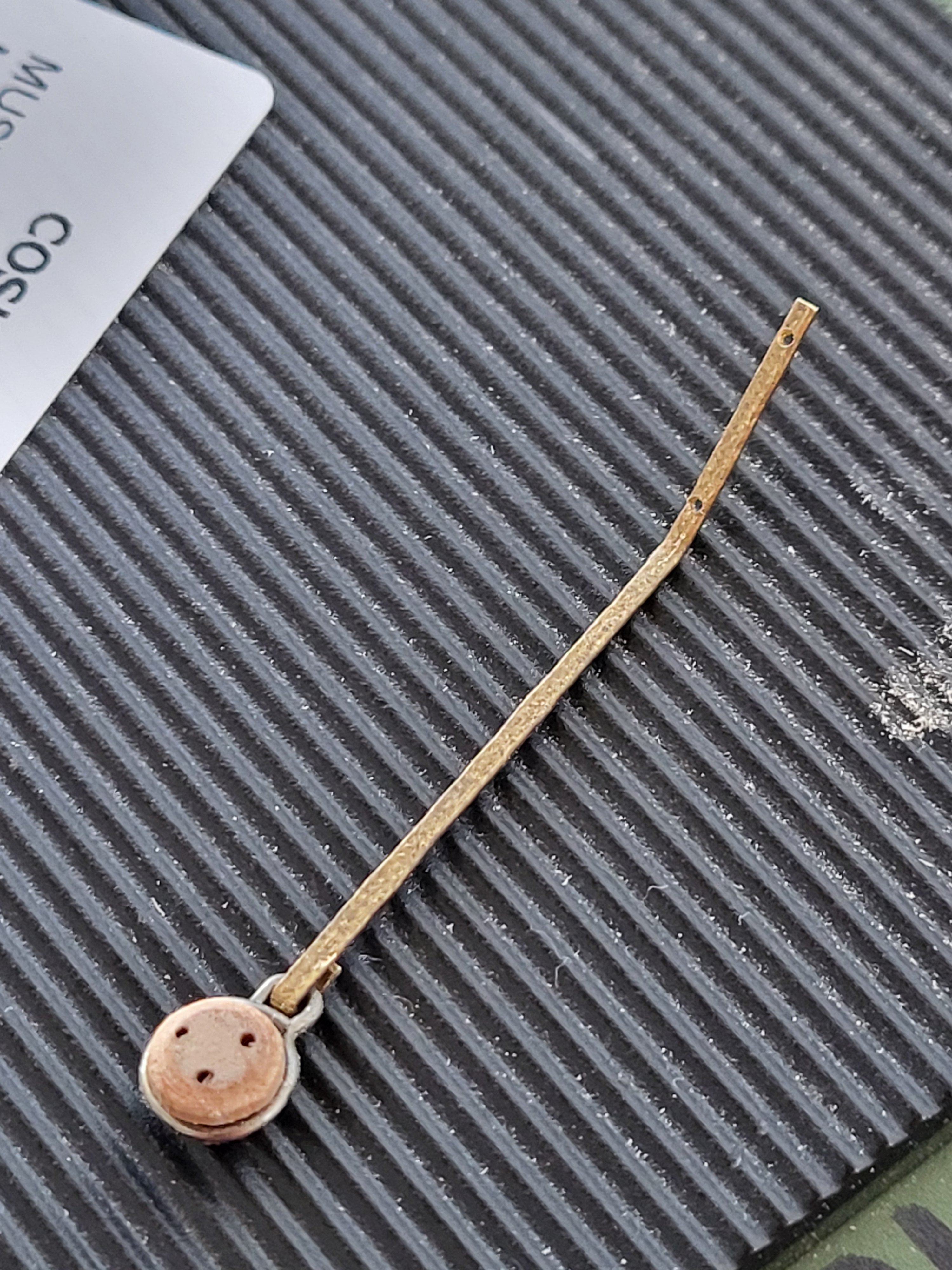

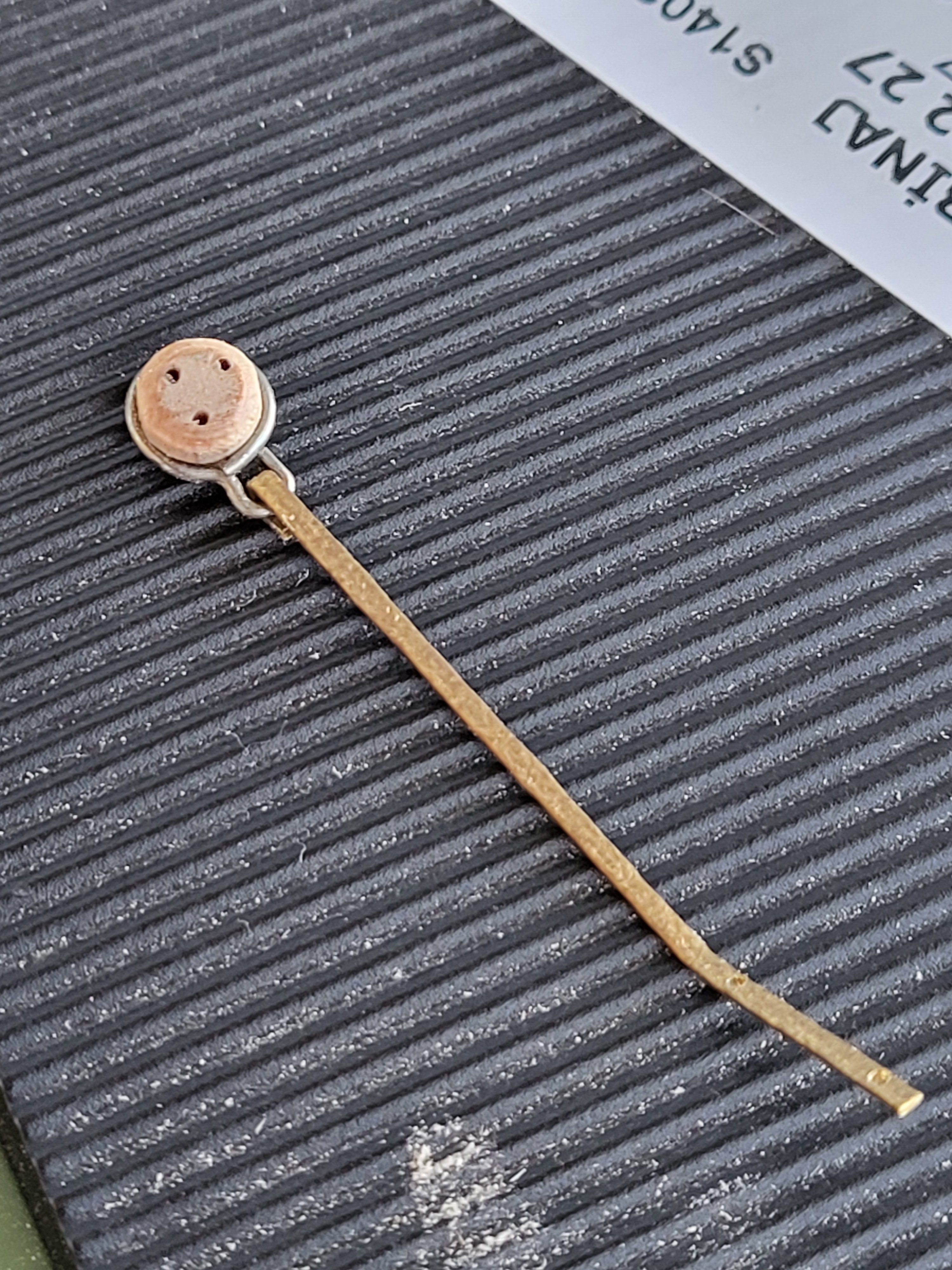

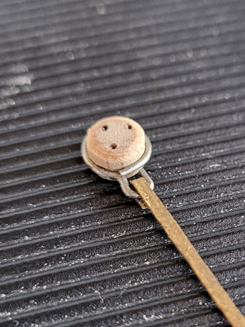

When attaching the deadeyes to the chain plates, I'll use the same method I used on the Cutter Alert model, as this is the closest I can get to the appearance of the real ship.
P.S. I flatten the 1mm diameter brass wire by hammering it and use it in the production of chain plates and I drill two holes for the bolts with a 0.6 mm drill bit.
