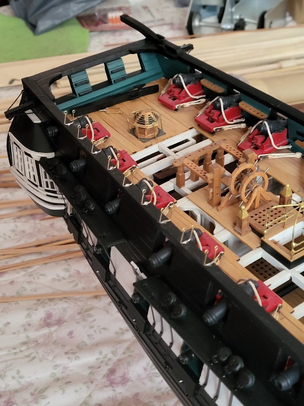

Hello Mustafa, I didn't want to copy the photos from your post after you installed the channel caps and clutter up your build log, but I have a question. Did you taper the channels from the hull to the cap? It doesn't seem to me that you did, which is perfectly fine by me. I'm just looking for justification to follow in your footsteps.
Since I can't cover up mistakes with black paint, I have to very carefully consider the steps involved in attaching the channels, chain plates, dead eyes and caps.
If you did taper, it's hard to see in those photos..
Thanks in advance.

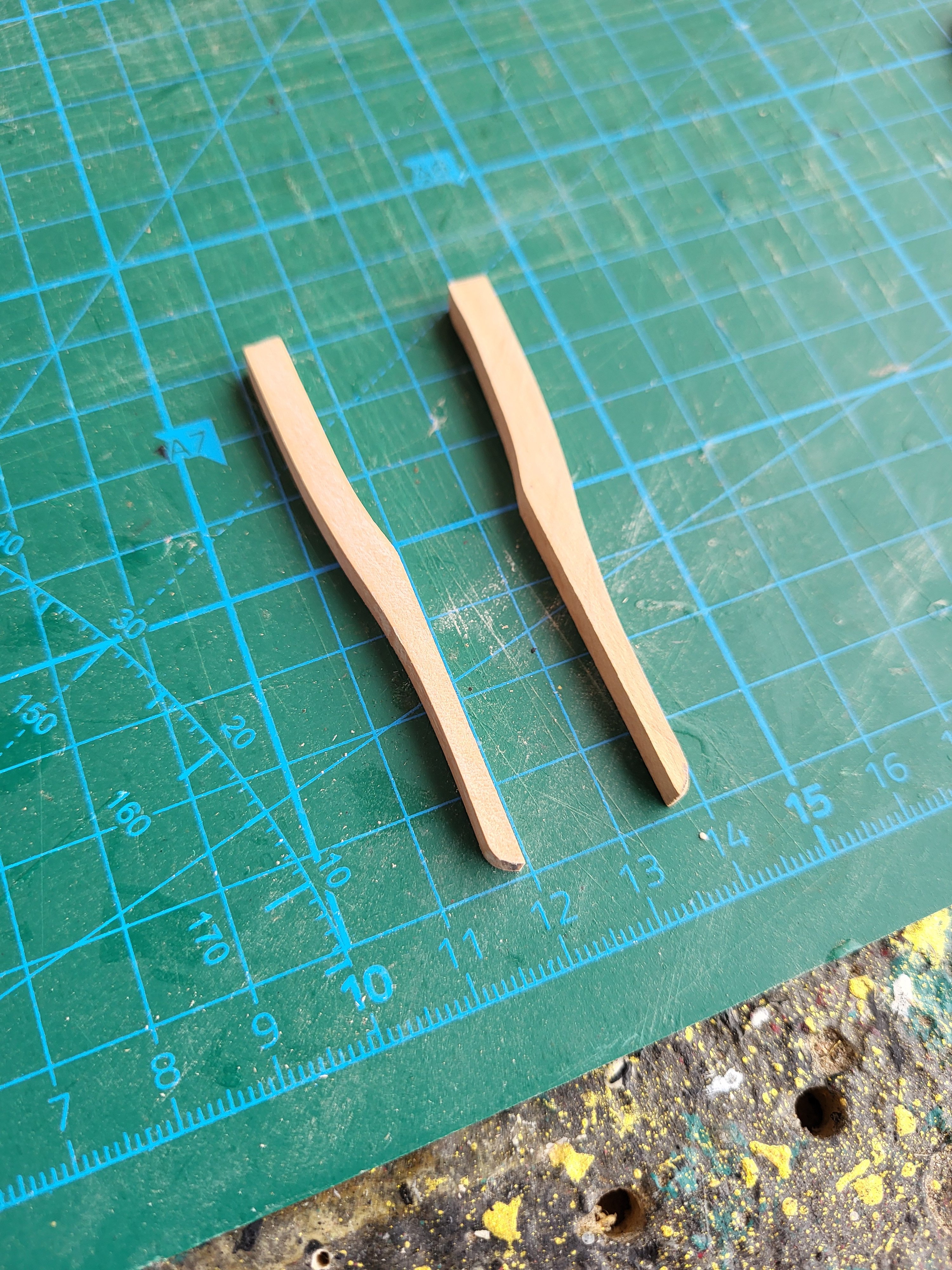

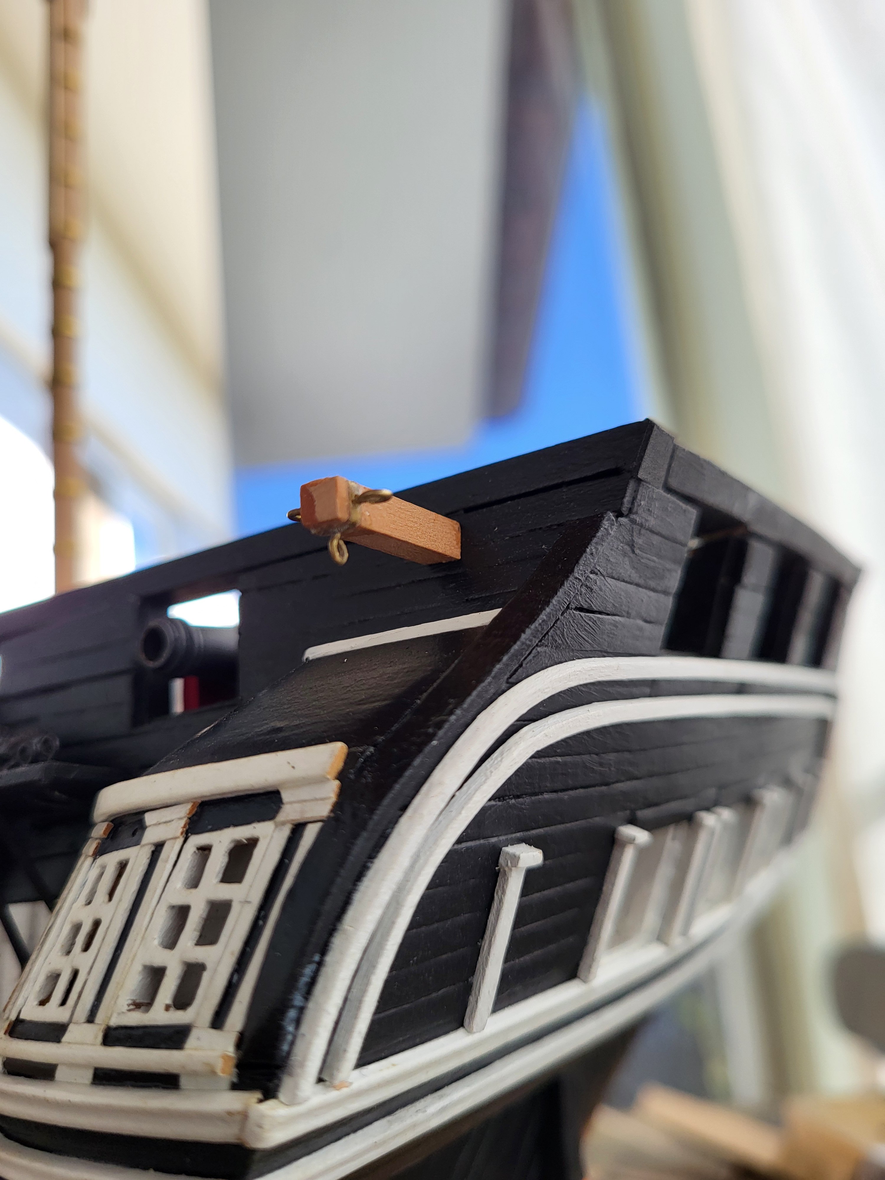

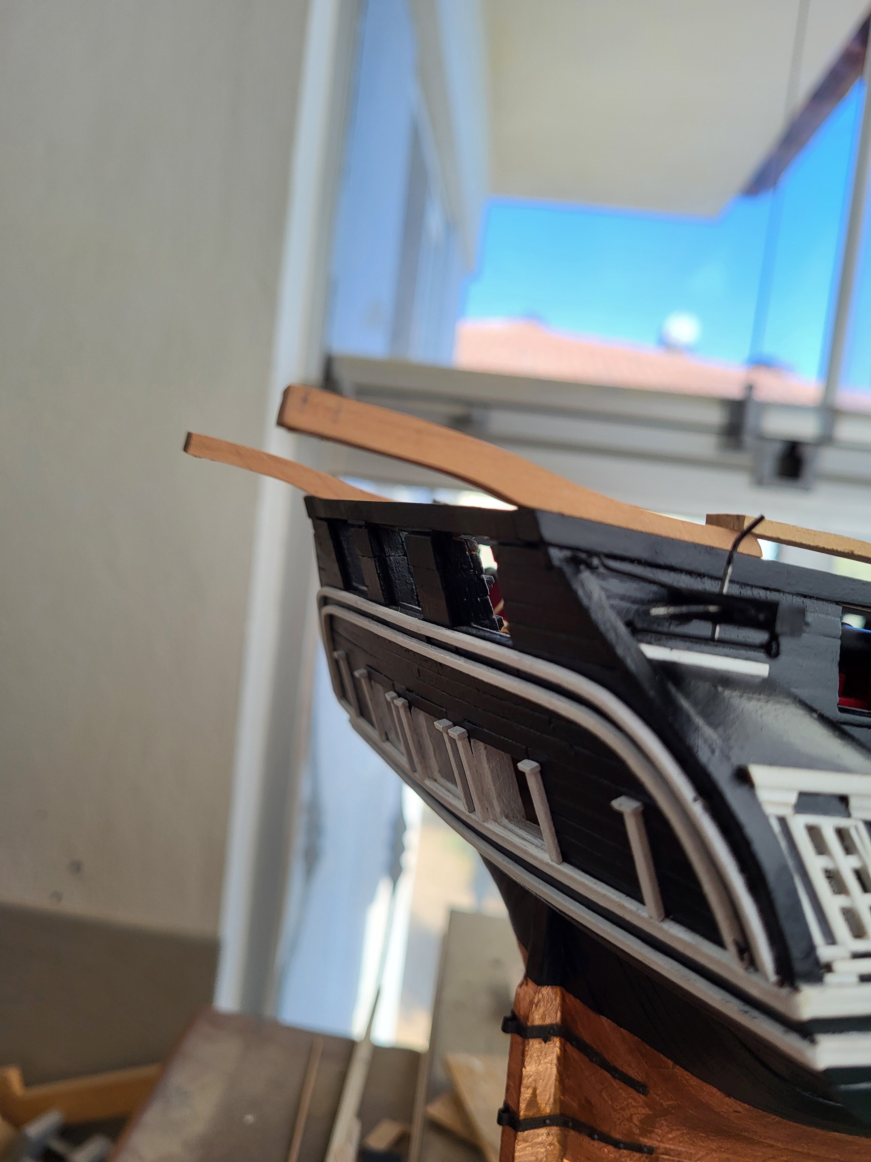

I'm taking a break from working on the masts and tops for a while to complete some of the other missing parts. Right now, I'm fabricating the main brace bumpkins and the stern boat davits.
You don't disappoint, they look gorgeous!

Sorry Peter, I just noticed your post. I don't know why, some posts appear much later in my build log. I guess this is one of them.  No, I didn't taper the channels. I didn't even know they needed to be tapered.
Edited by mtbediz
Oh snap!  My bad.  I just double checked the Hunt practicum and learned that I misread that portion of the instructions.  The channels are tapered, yes, but only by 1/16" of an inch at their fore and aft edges.  Sorry abut the miscue.

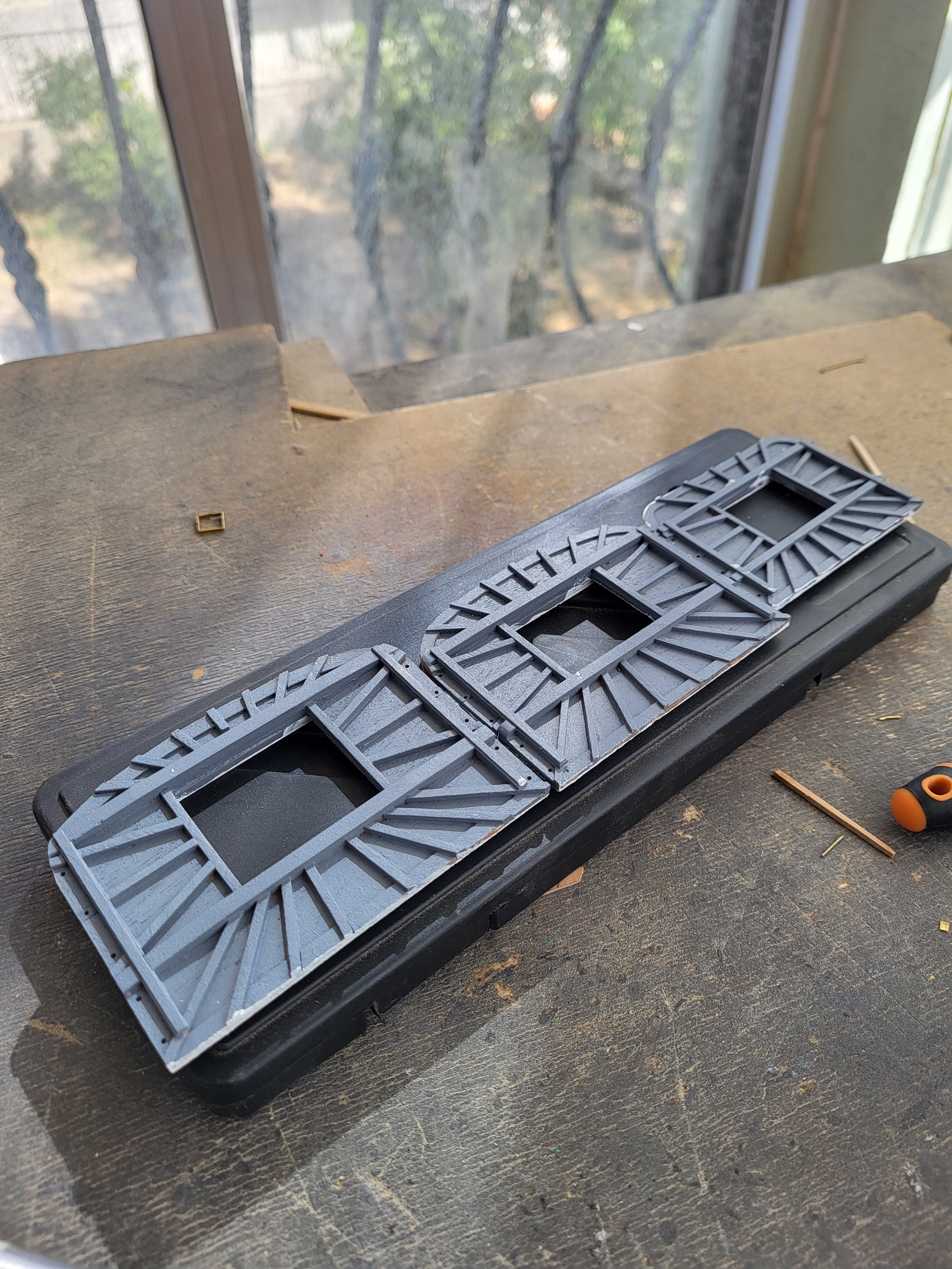

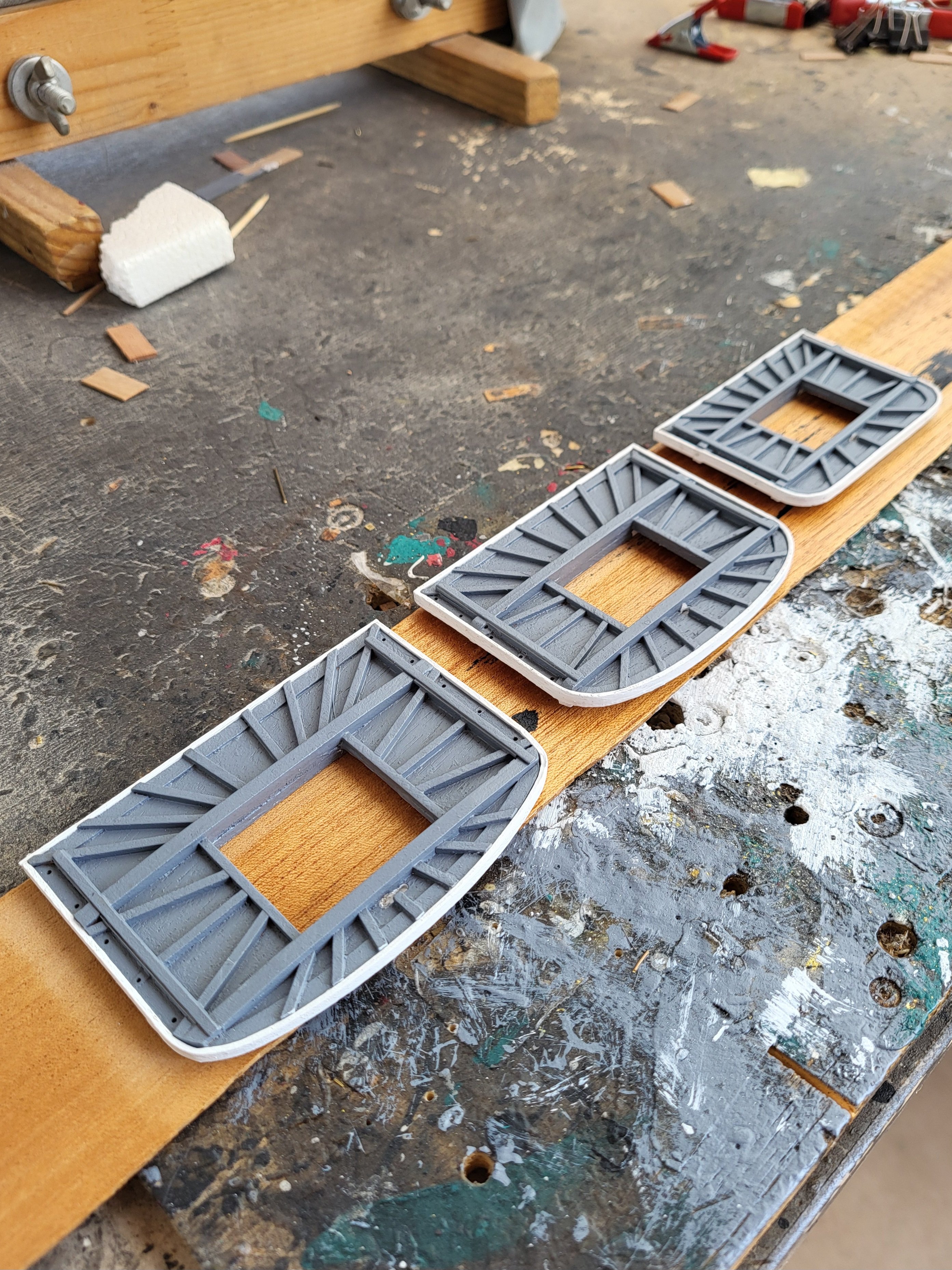

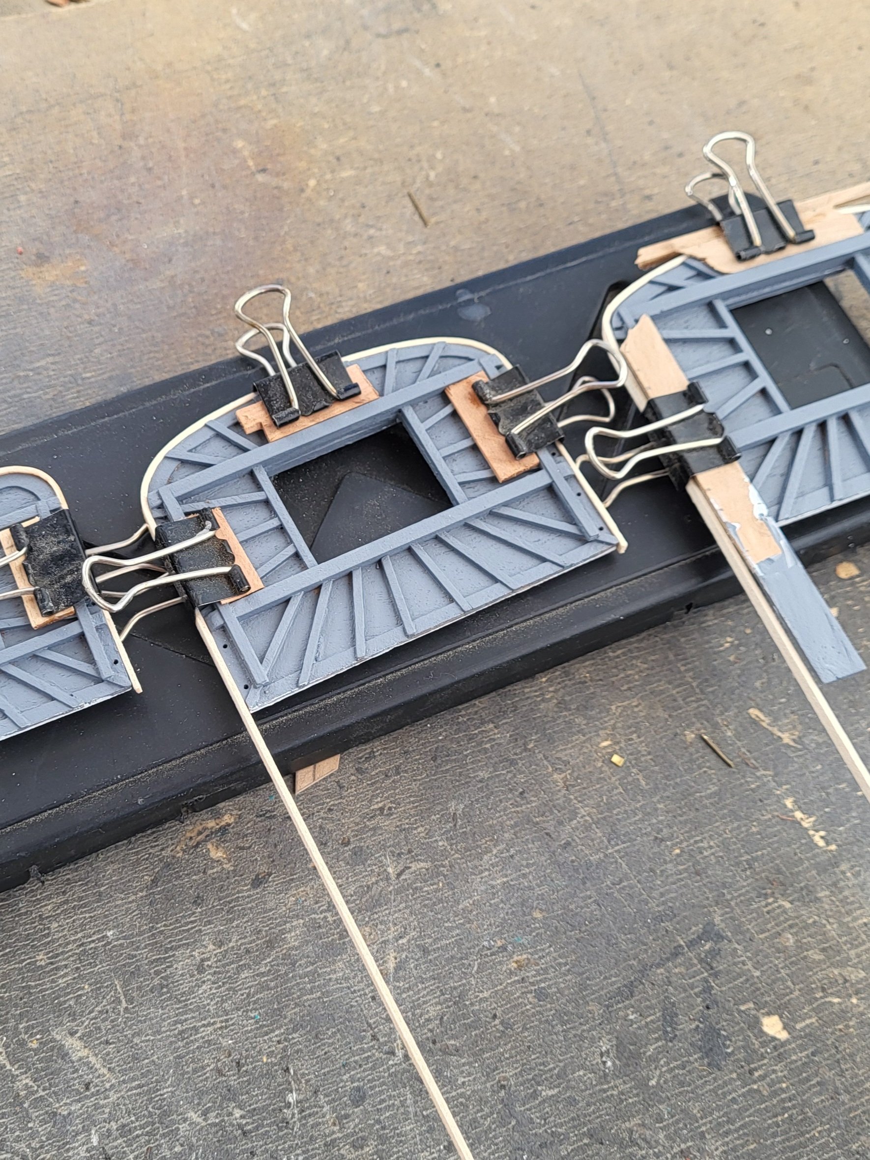

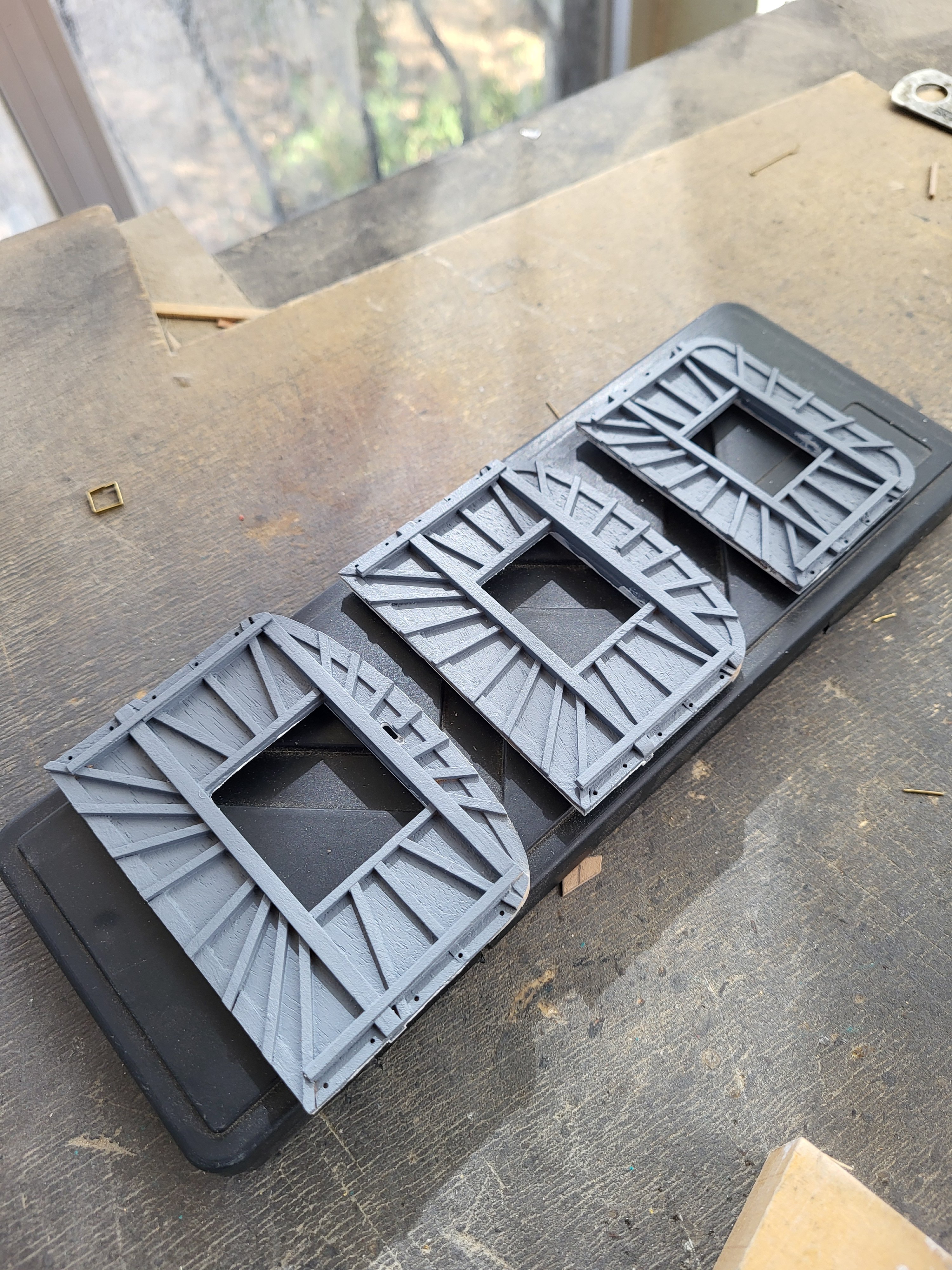

I turned back to the fighting tops. The tops were painted gray and the bottoms white. The strip surrounding the top was soaked in boiling water for about 10 minutes and then held in place with clamps. Once dry, it was removed and, after being painted white, glued back in place.
I finished today by installing the deadeyes that I had previously prepared for the top mast shrouds.

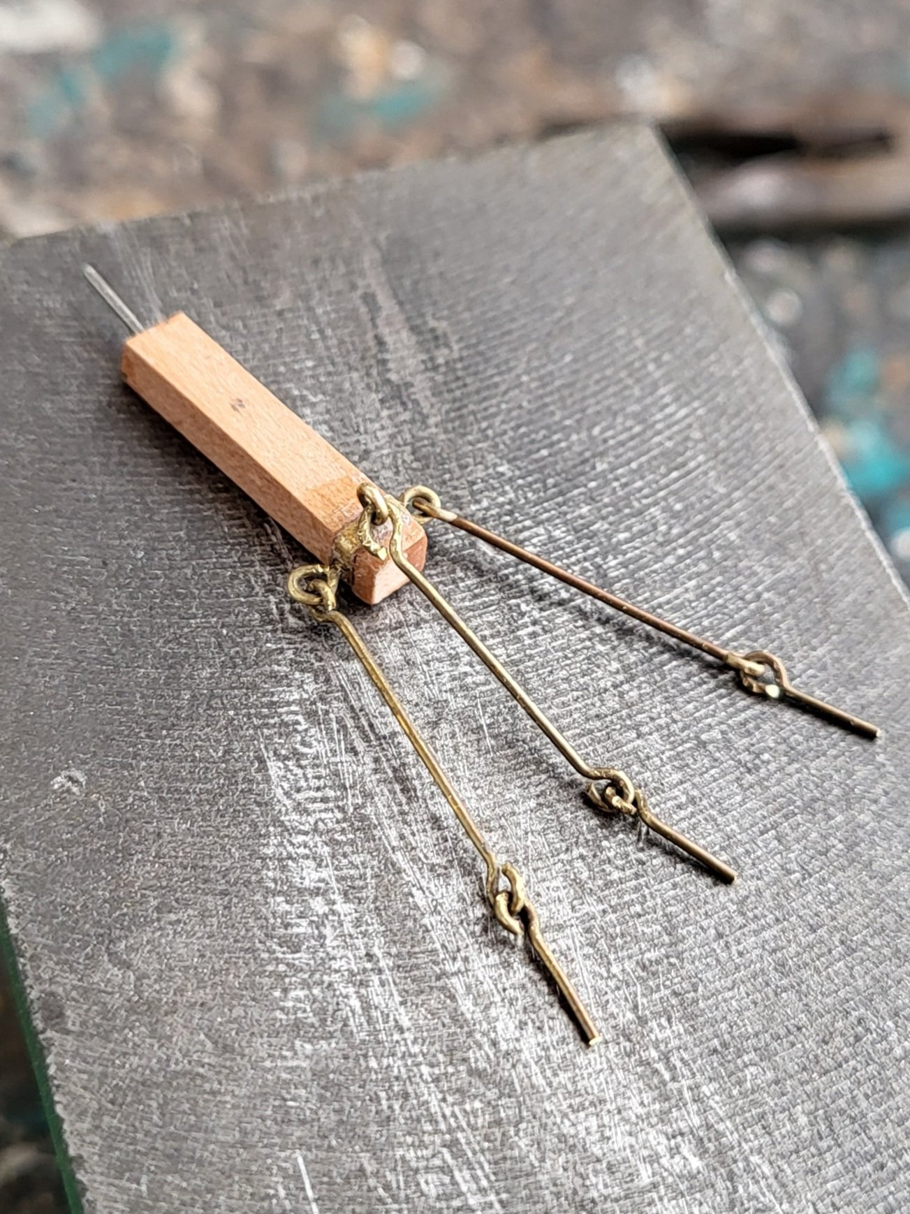

For trial purposes I formed a bobstay collar for the mast using a jig. I glued all the seizings with CA and trimmed excess ends. The result is good enough for me.

It's good enough for me too. I LIKE it!
Jon
Nice work, Mustafa!  XKen is a good person to steal ideas from!  And I'm stealing ideas from all of you!
Gregg

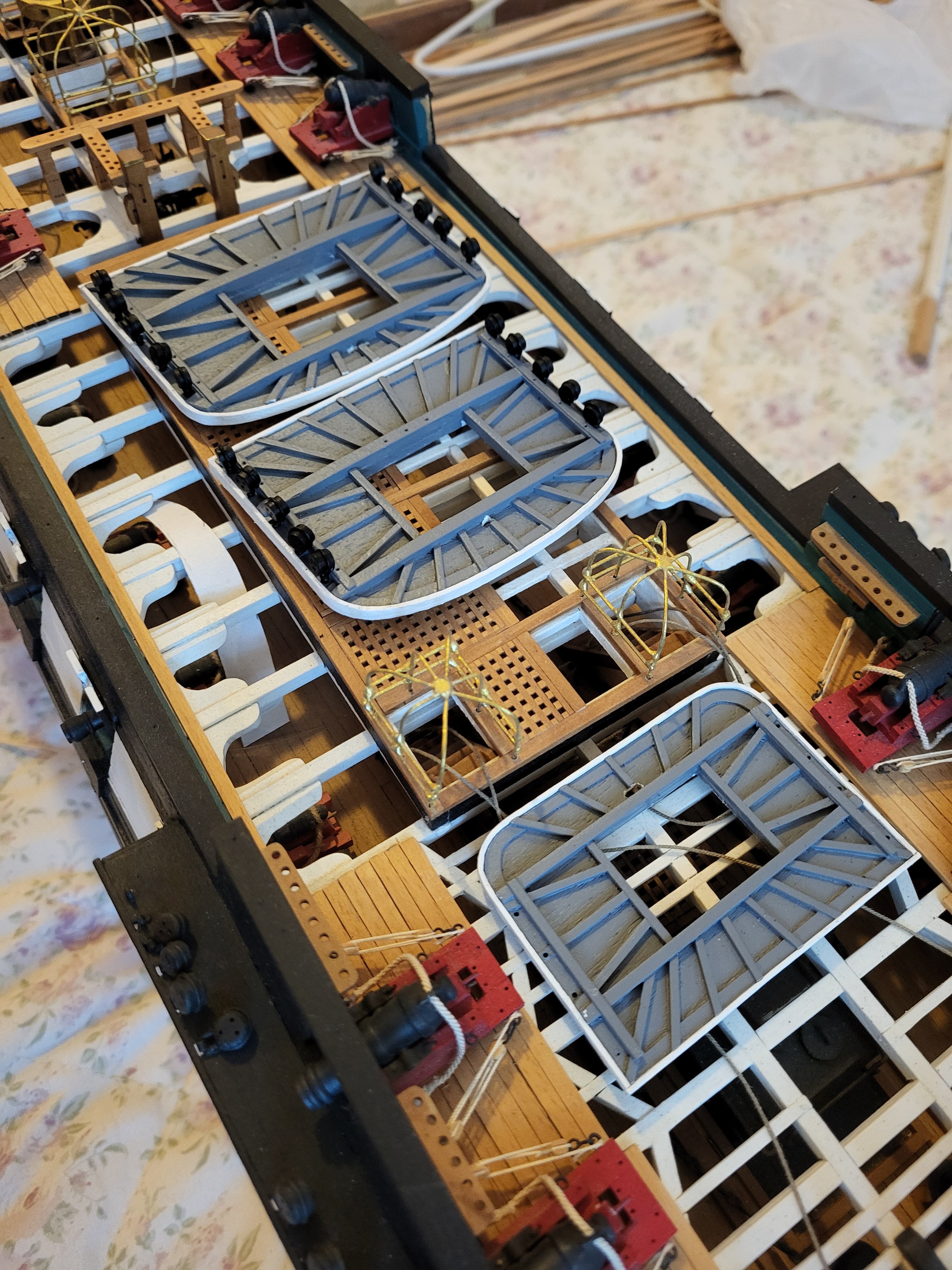

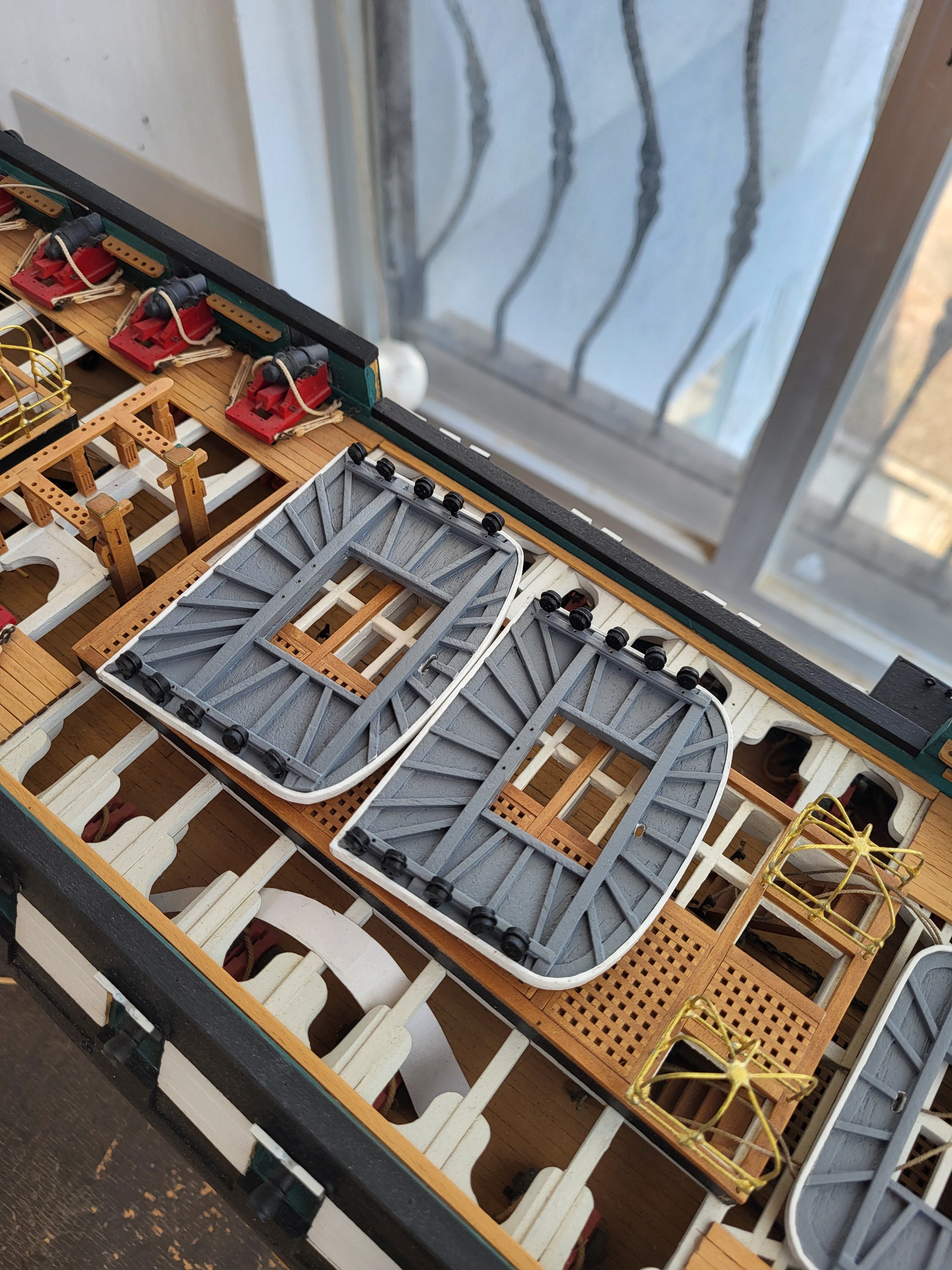

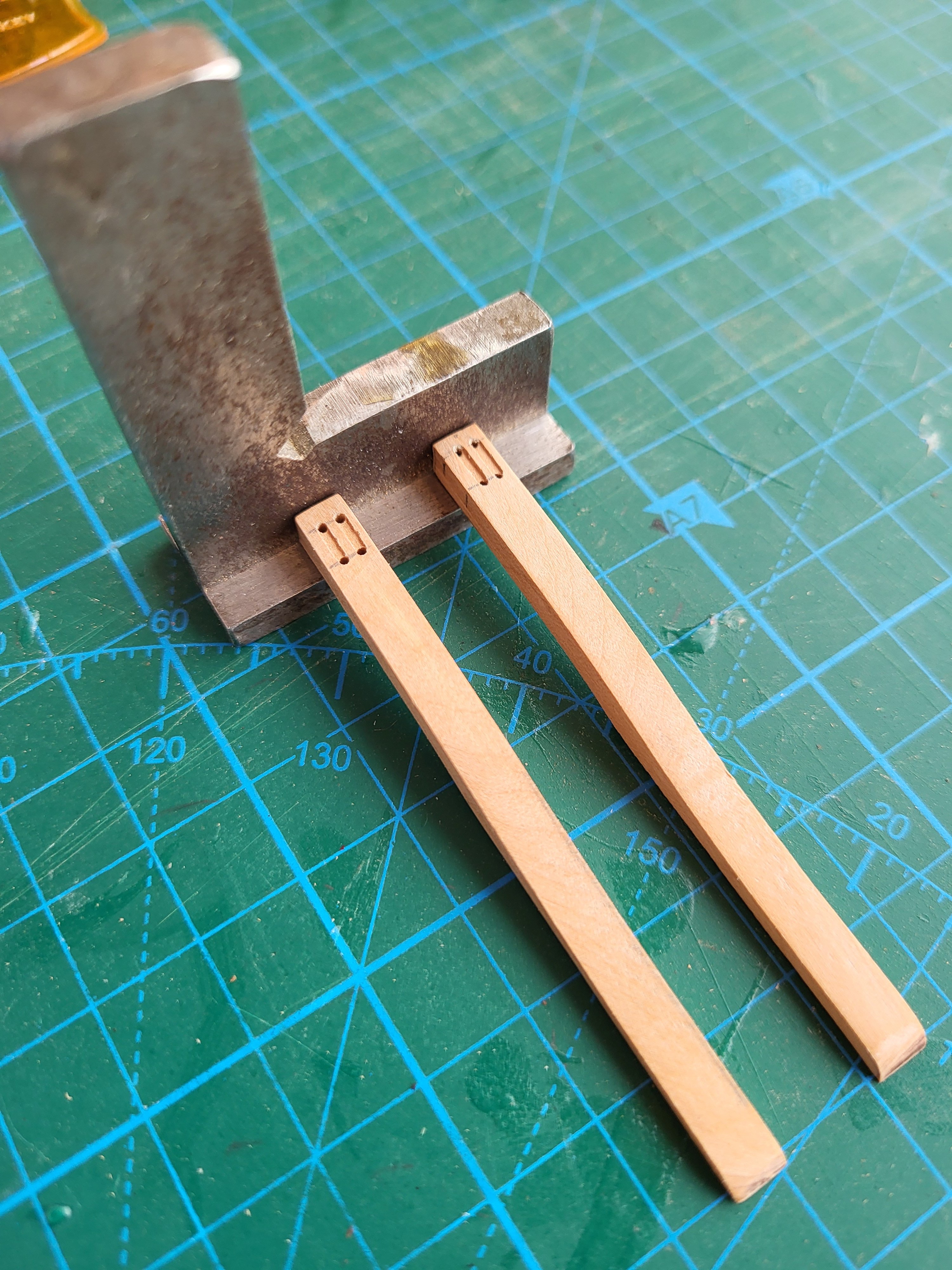

Thumb cleats, blocks with sheaves inside them, and bolsters were fabricated and fitted to the trestle trees today. As I always do, I drilled a small hole and a shallow channel to represent the sheaves.
Once these fittings were in place, the main and fore trestle trees were glued to their respective masts. The platforms, however, have not yet been glued, they will remain separate until the shrouds are completed.

Fantastic work, Mustafa!  It's obvious that you put your milling machine to a lot of work making everything fit together perfectly.
And I love the pictures that are (once again) showing the open spar deck and exposed gun deck.  This is what I hope to shoot for with my Constitution.  That last picture reminded me to ask you, though, are you eventually intending to place boats on the main hatch or leaving them off to help keep exposed as much of the gun deck details as possible?  Curious...
Gregg

Thanks, Greg. I plan to build all the boats and put them in place. I think I'll make the ones on the main hatch unfixed so they can be removed if needed.

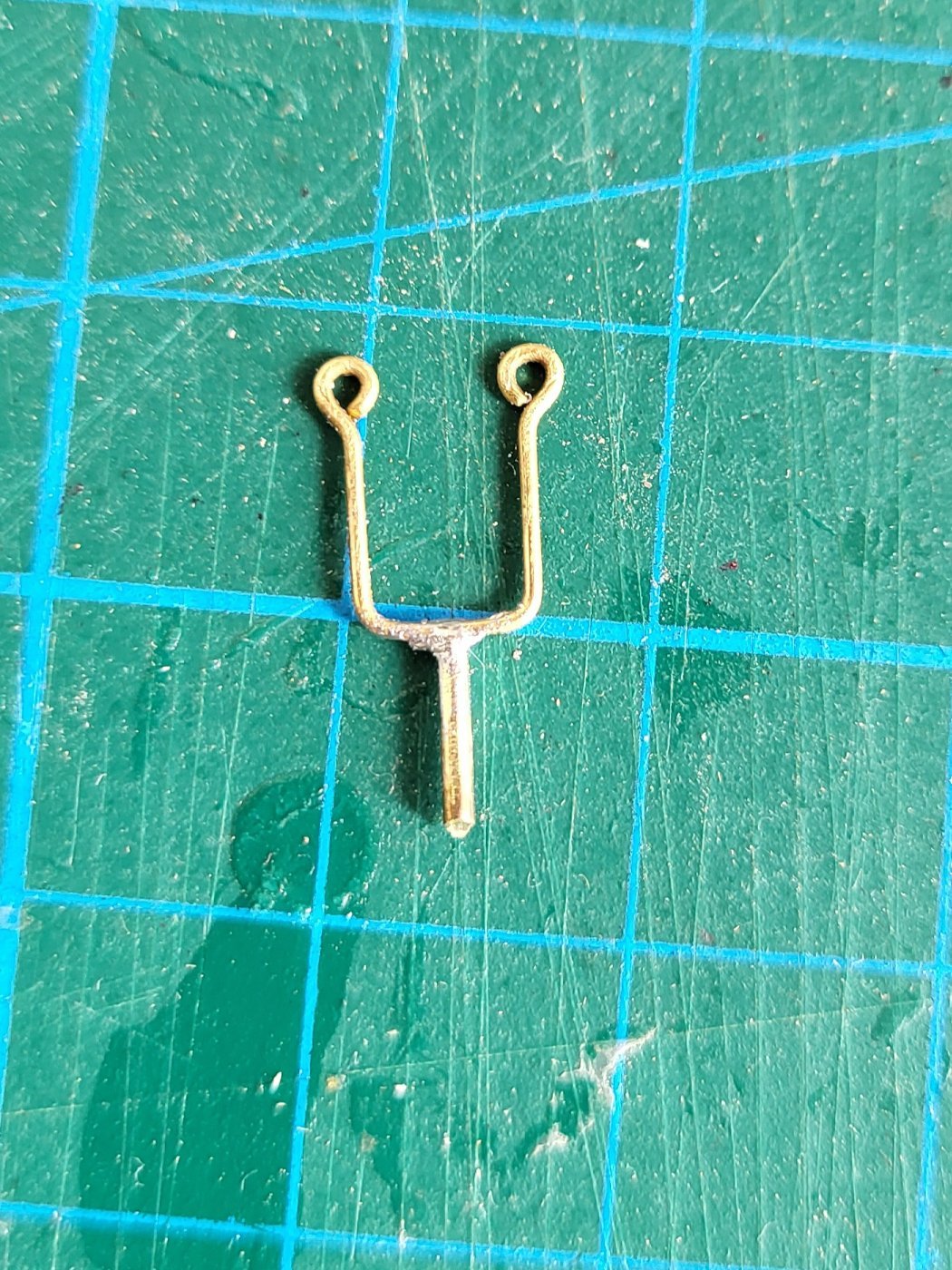

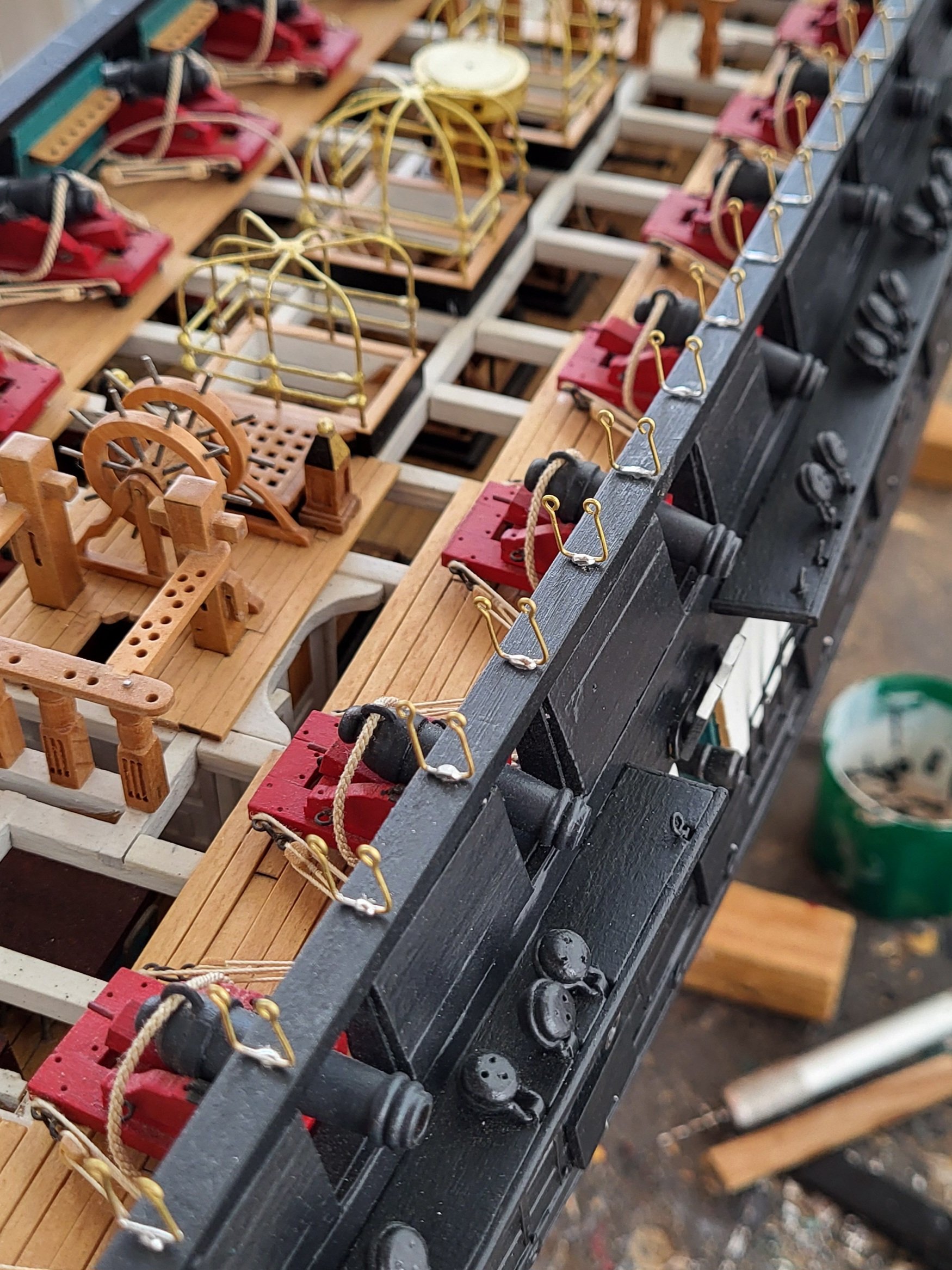

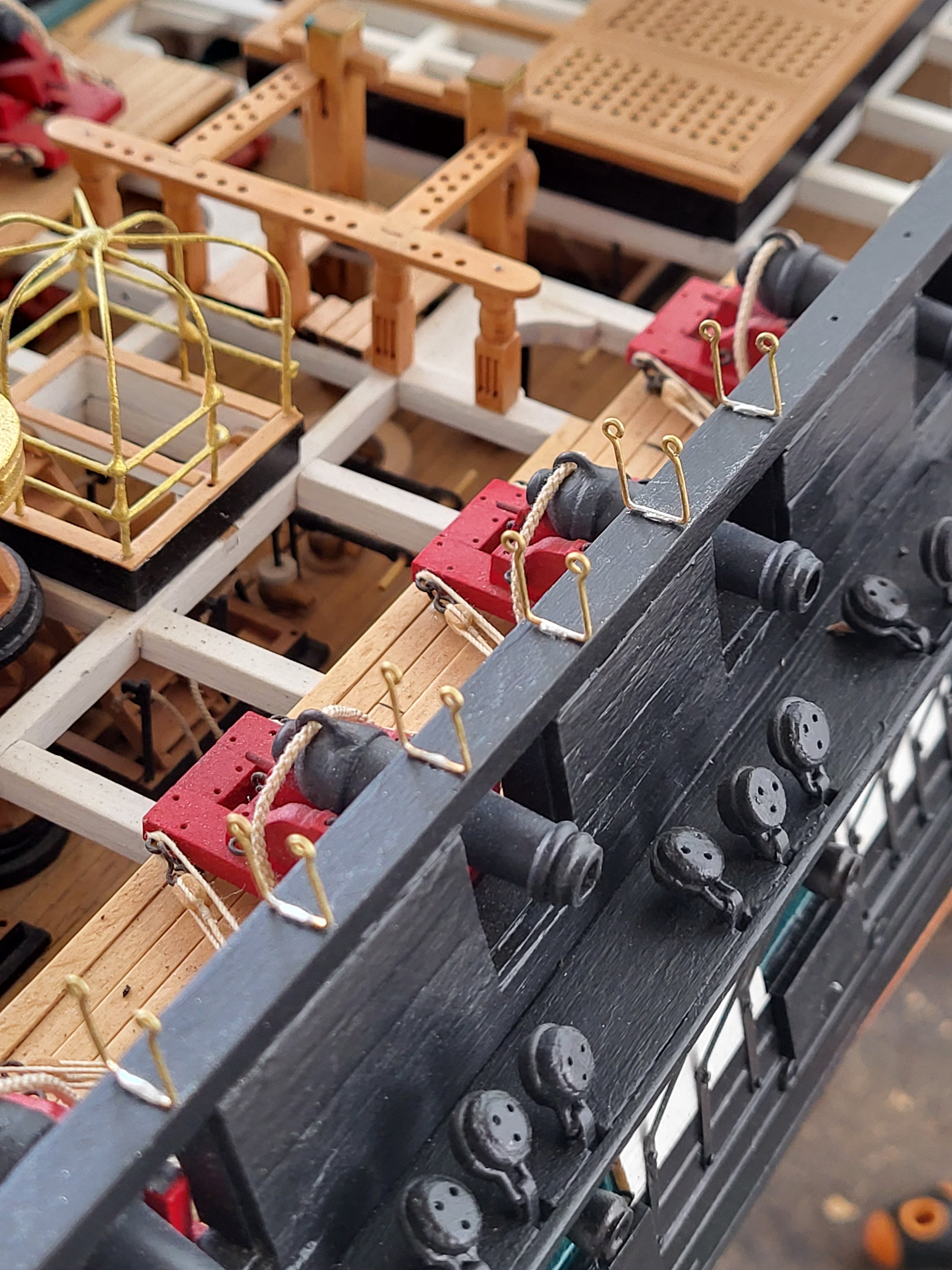

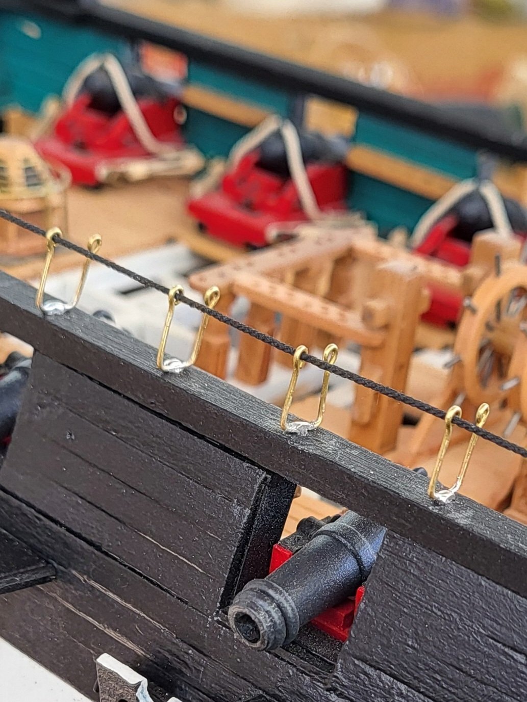

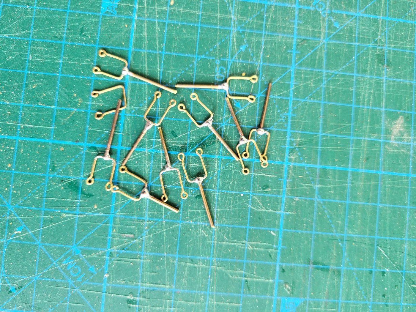

Before attaching the shrouds, I decided to make and install the hammock net frames. Once assembled, they will be painted black. The frames on the actual ship are made of square section forged iron, but since I don't have square-section brass wire, I am making them from 0.55mm round brass wire.There will be 54 of these made, and they all have to be the same shape and size. I'm using jigs to make them.
Edited by mtbediz
Great looking hammock stanchions! That exactly why I made mine the way I’d did! They wouldn’t have looked half as nice as yours. Did you use a jug to make your stanchions?
