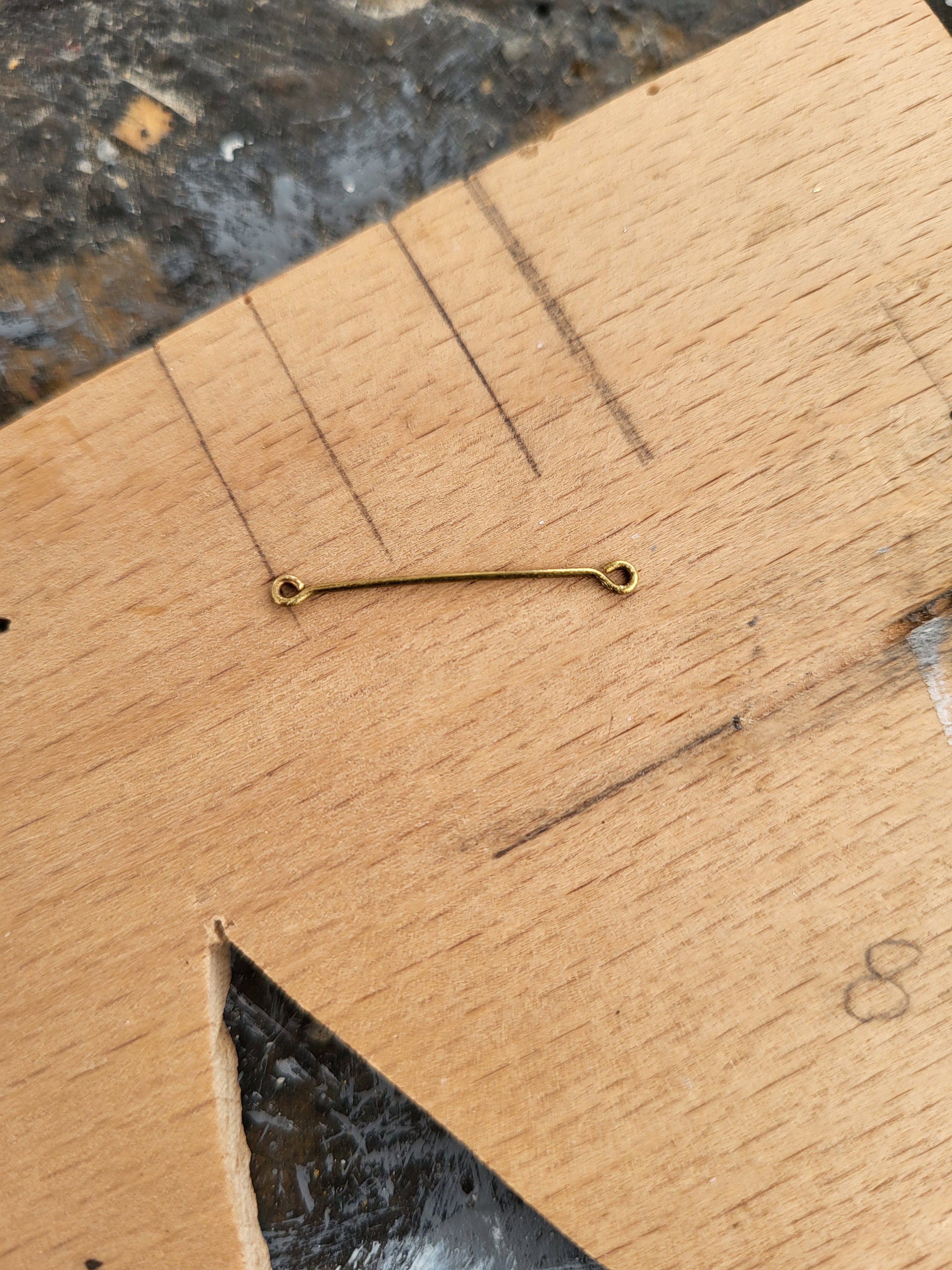

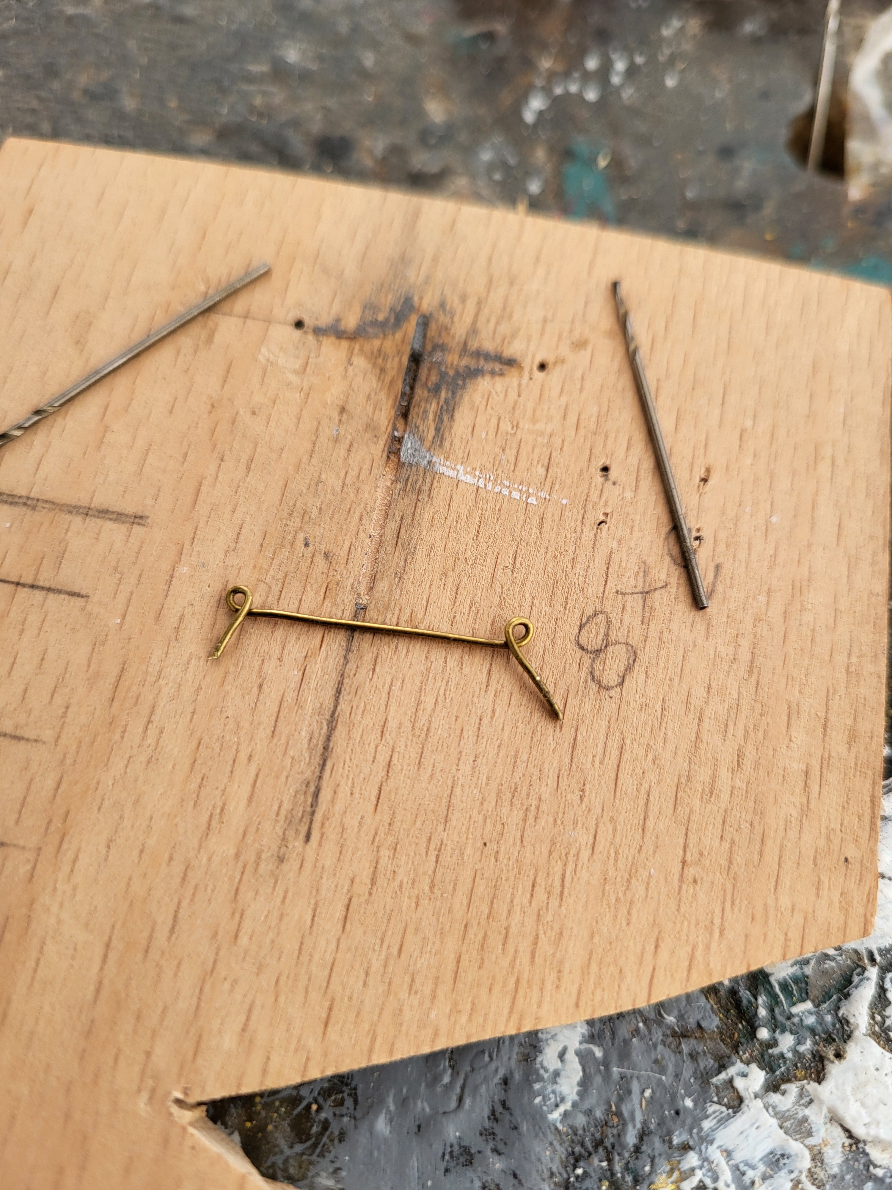

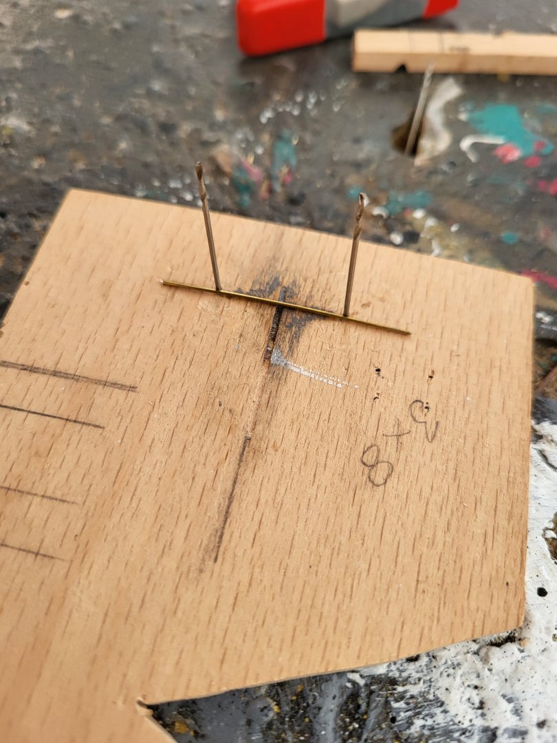

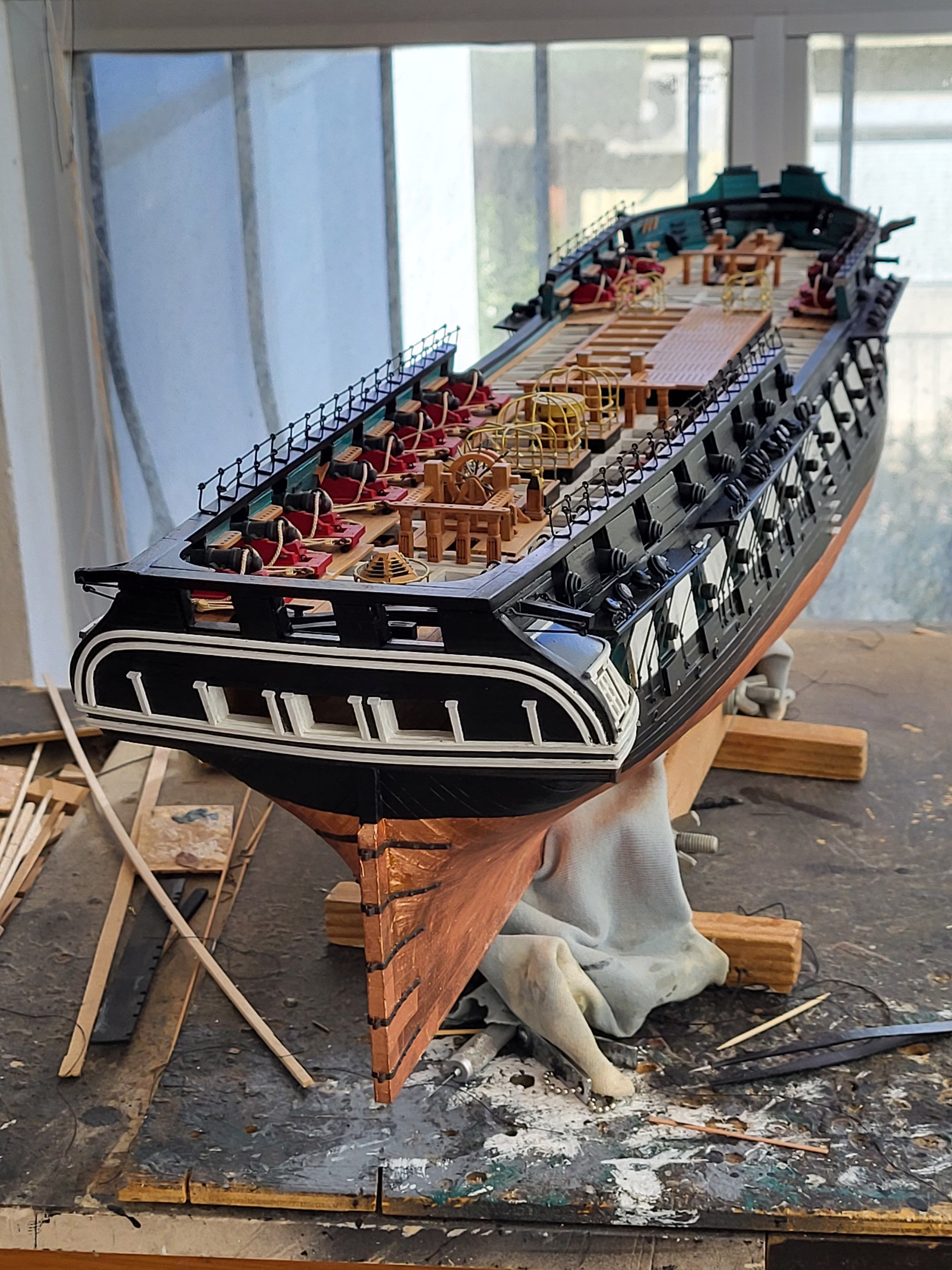

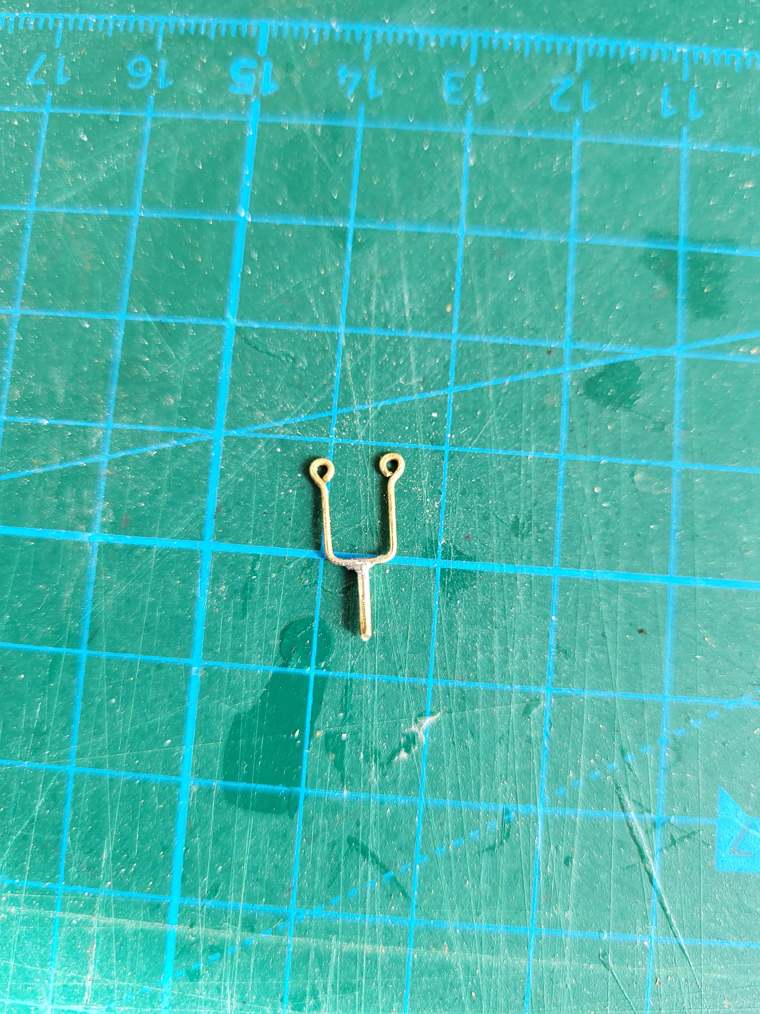

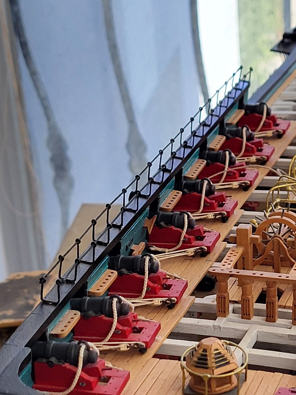

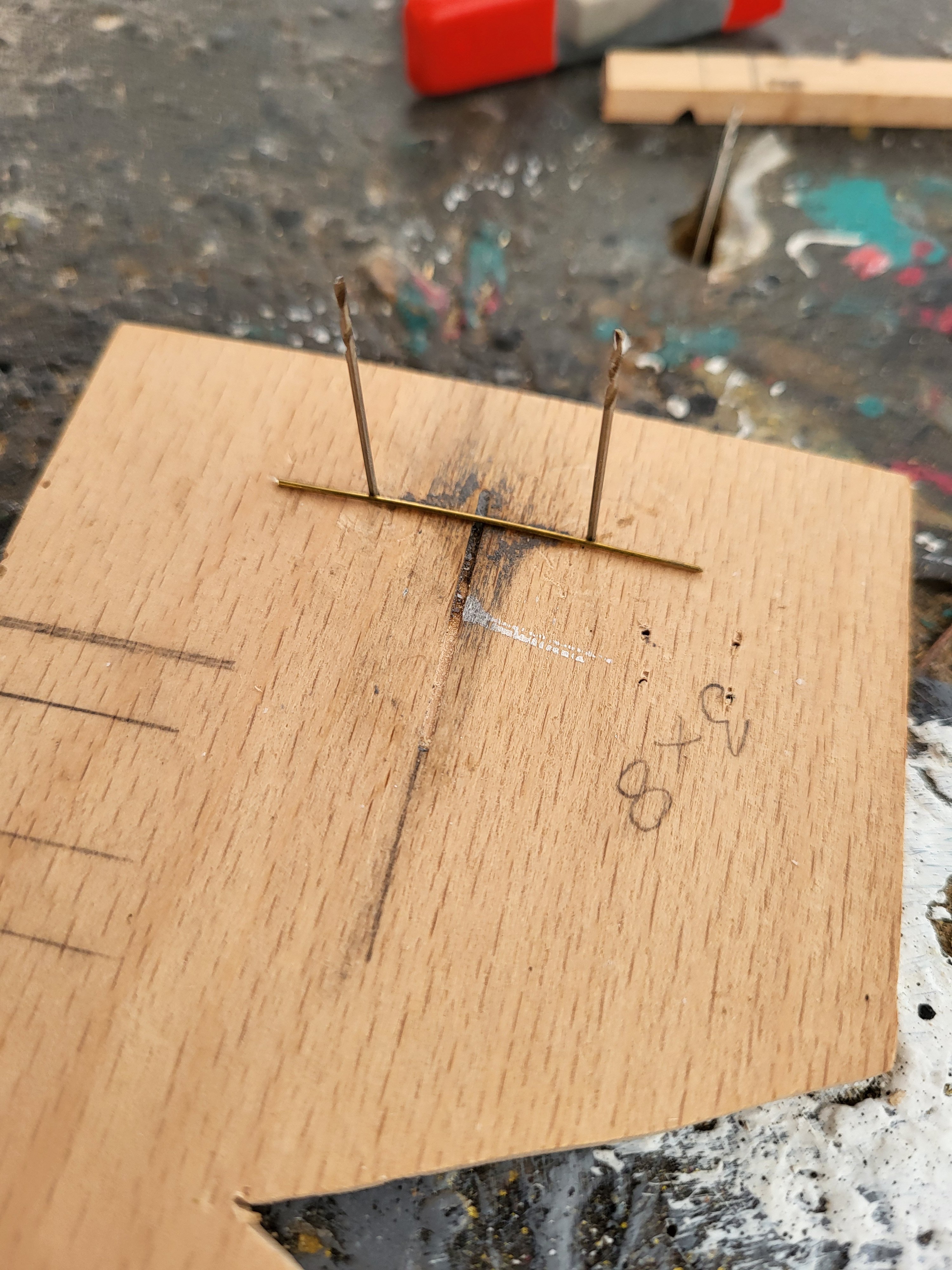

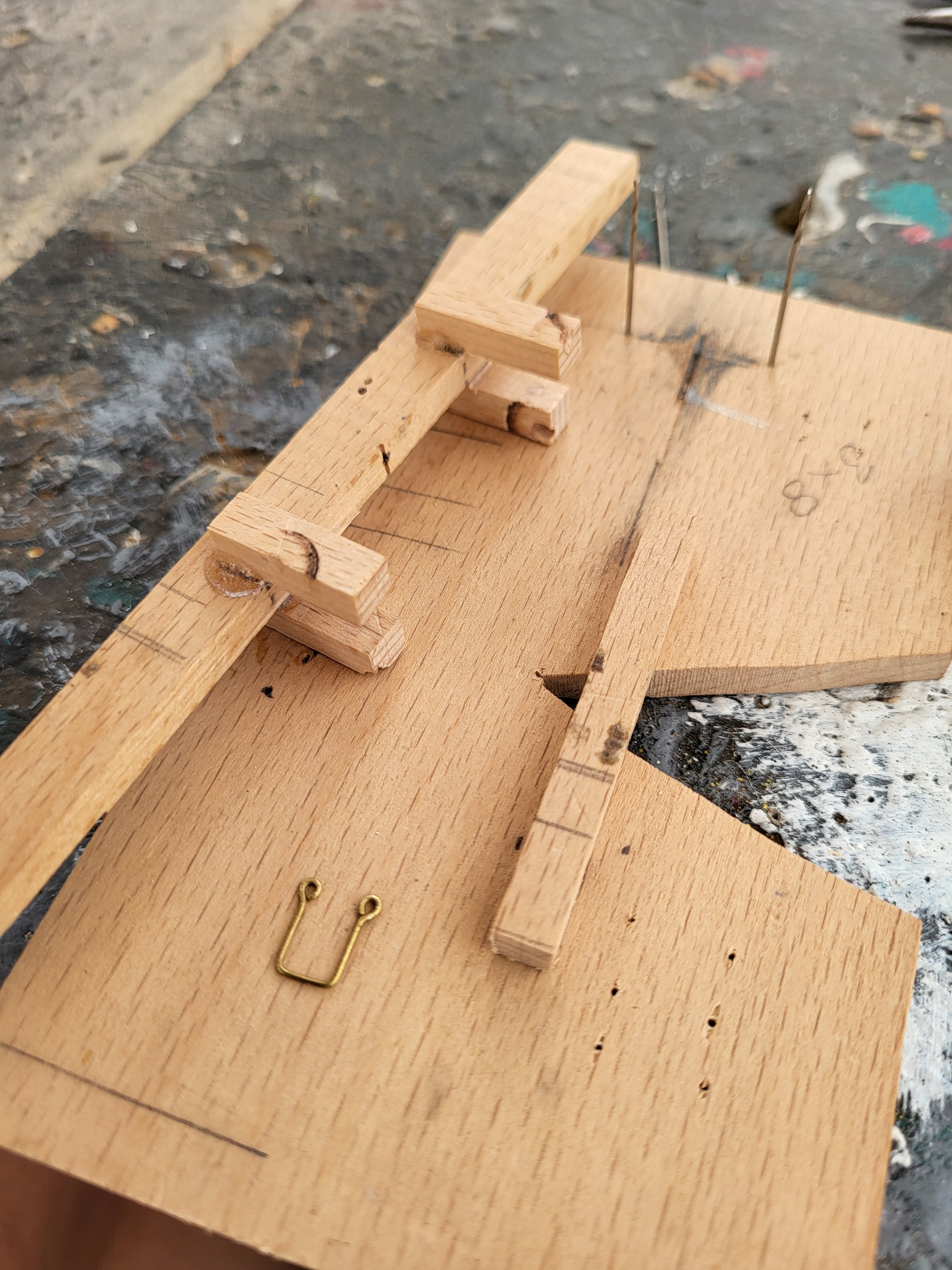

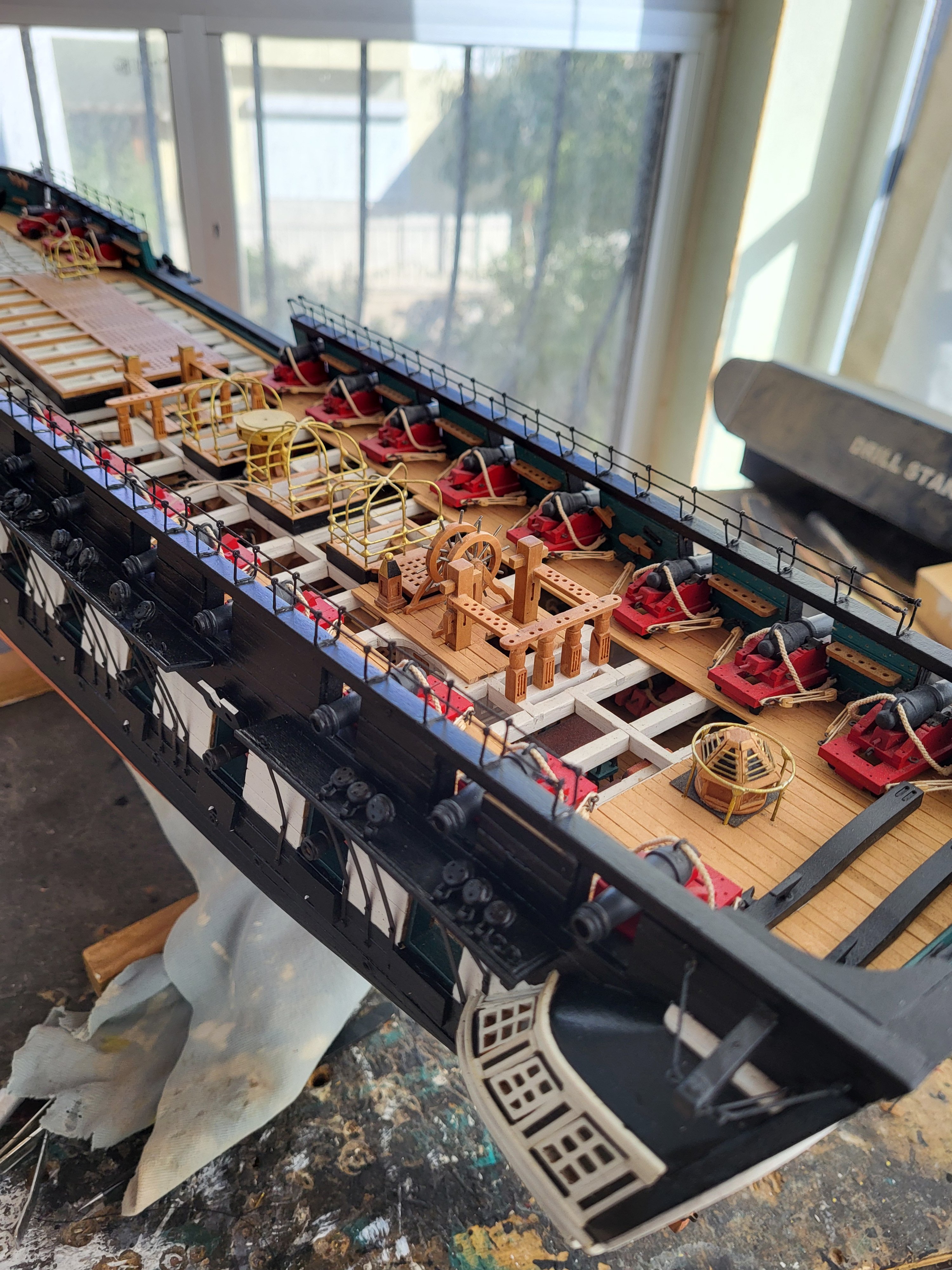

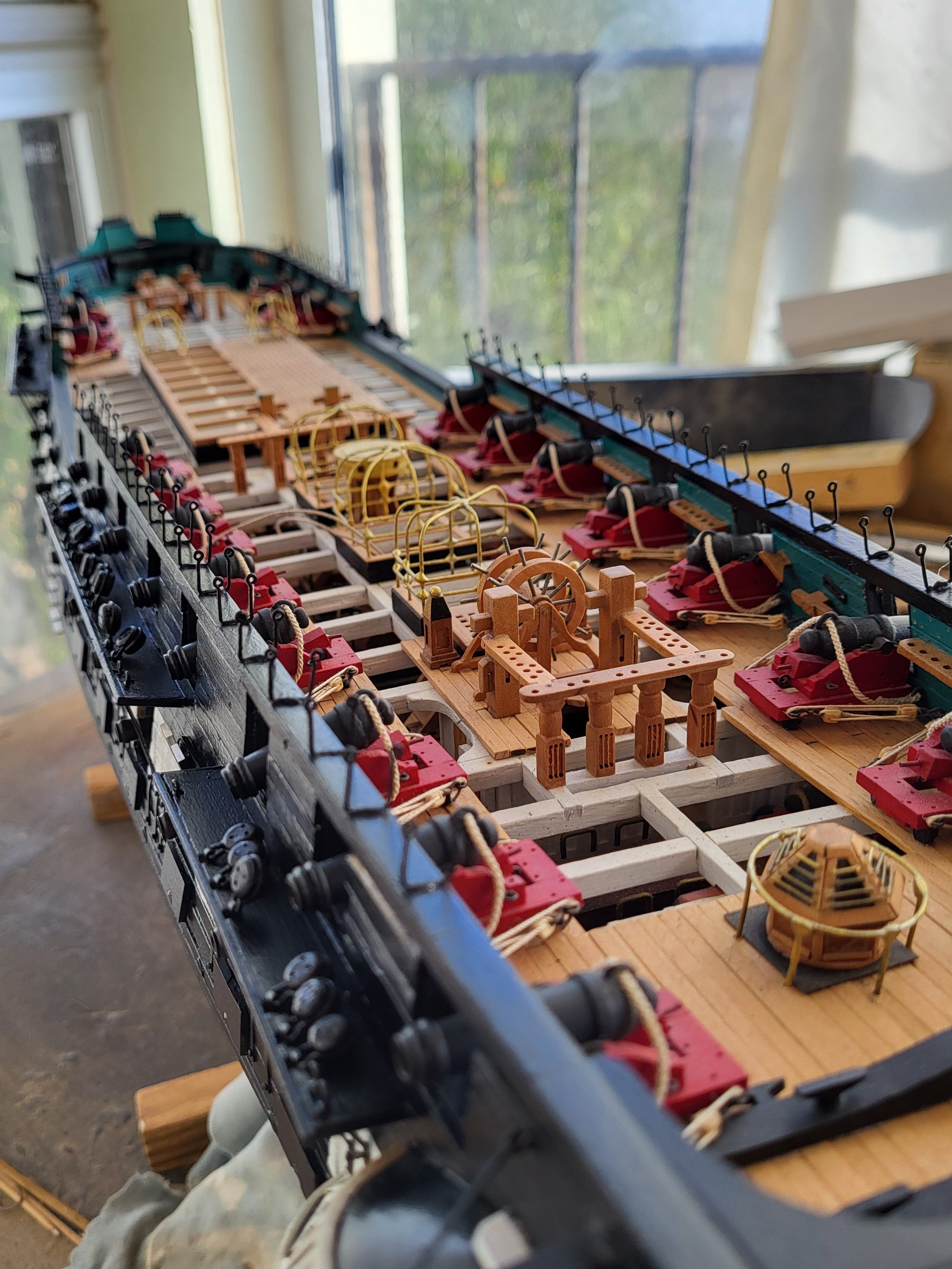

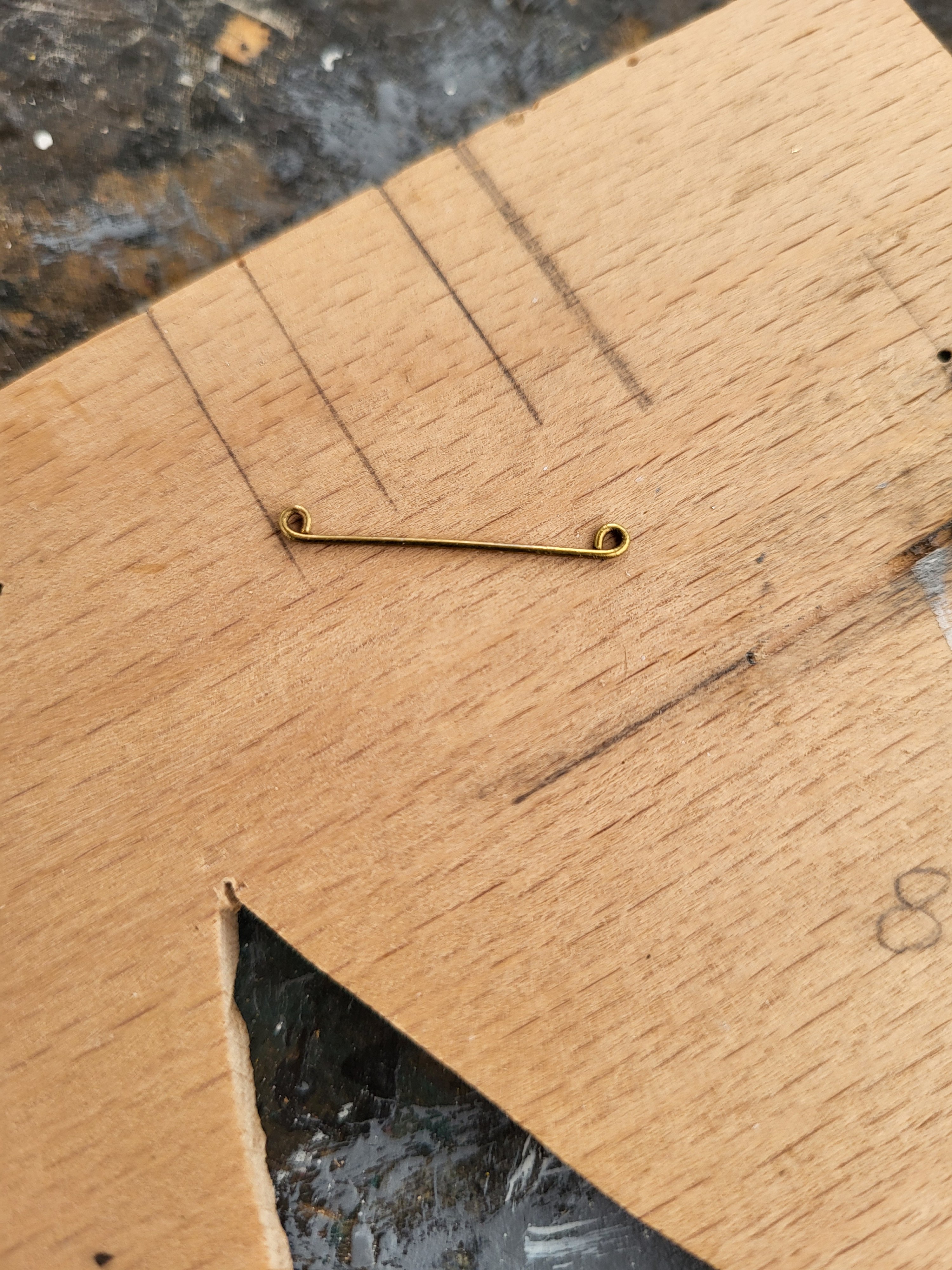

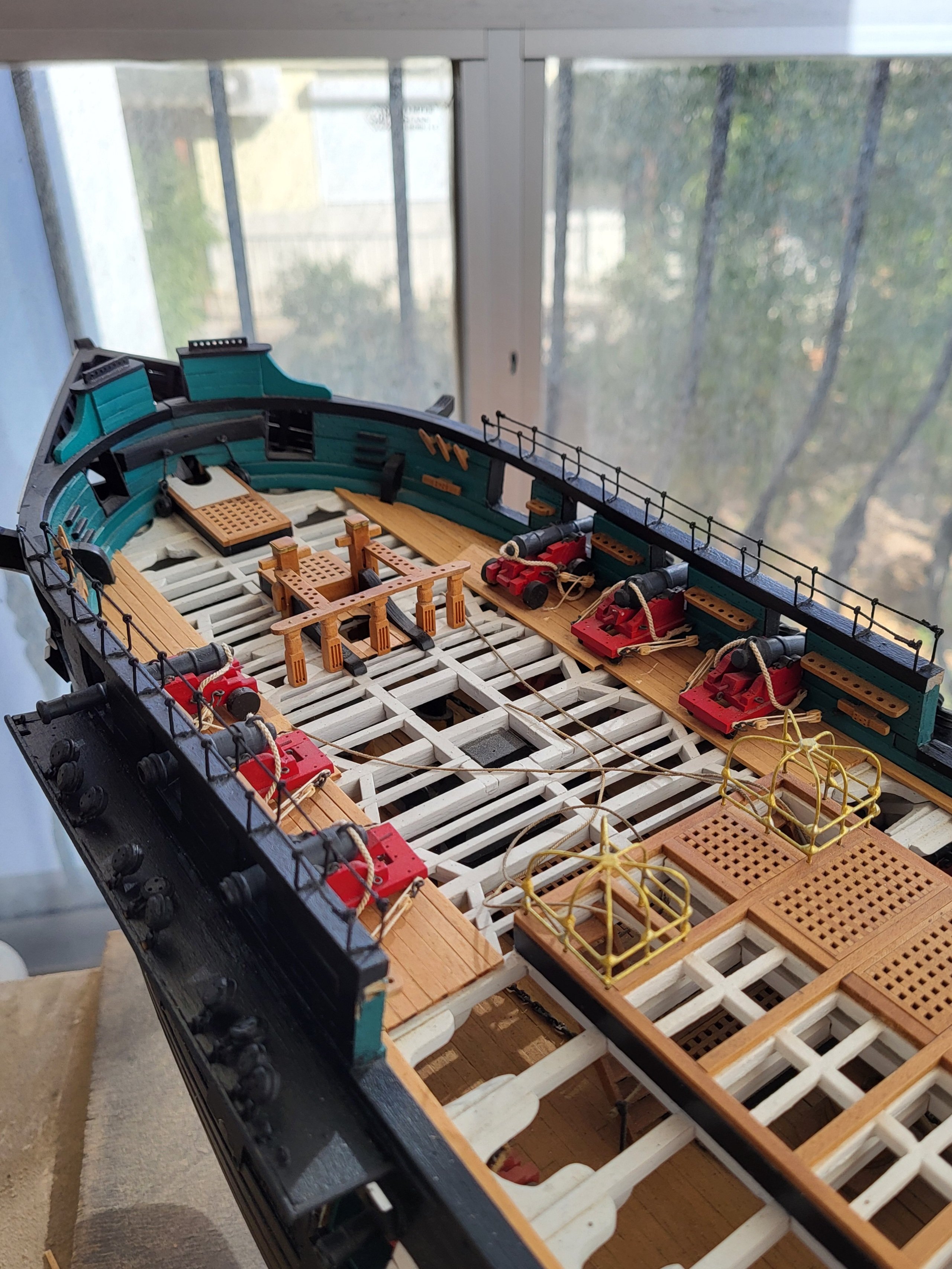

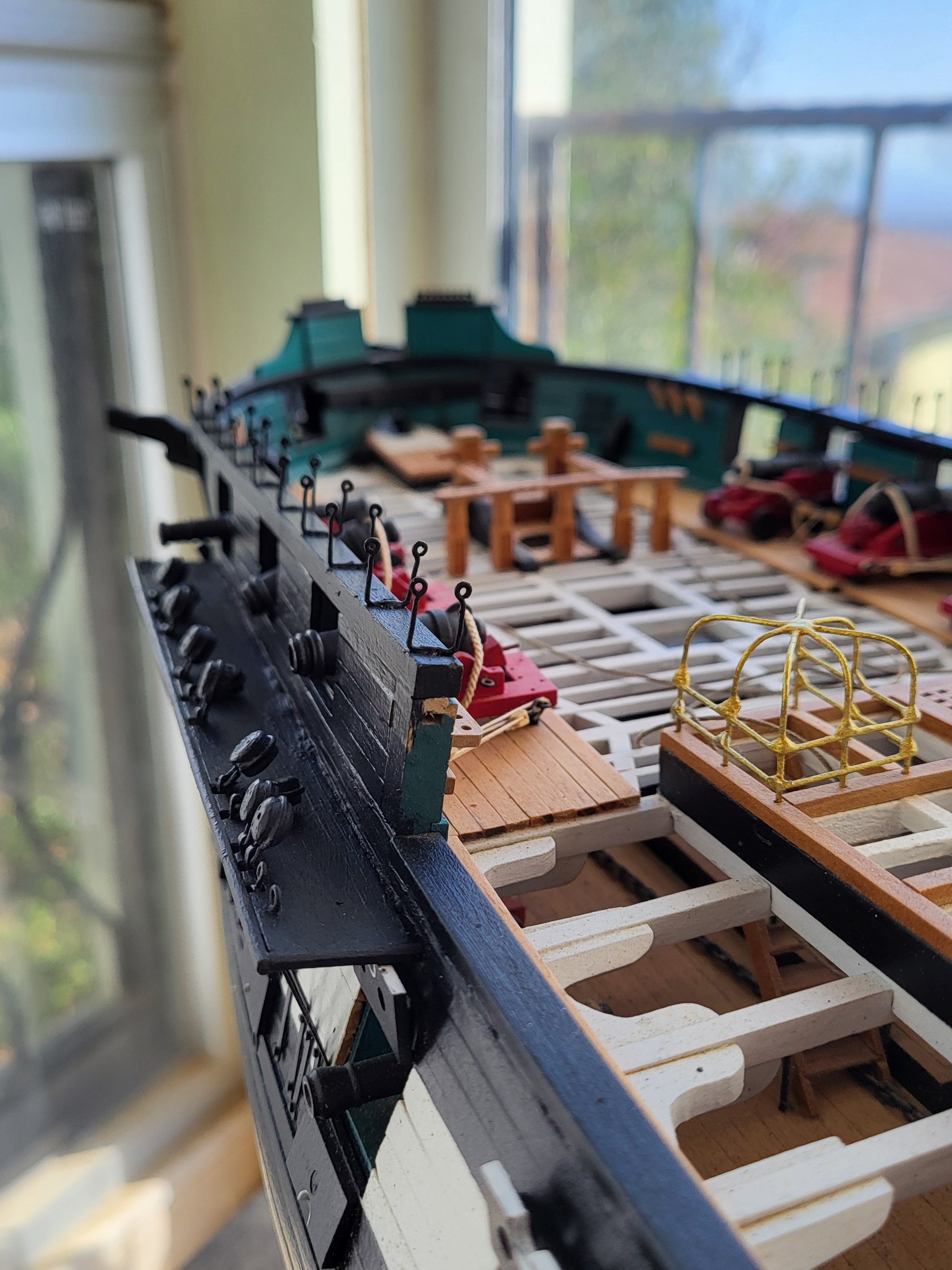

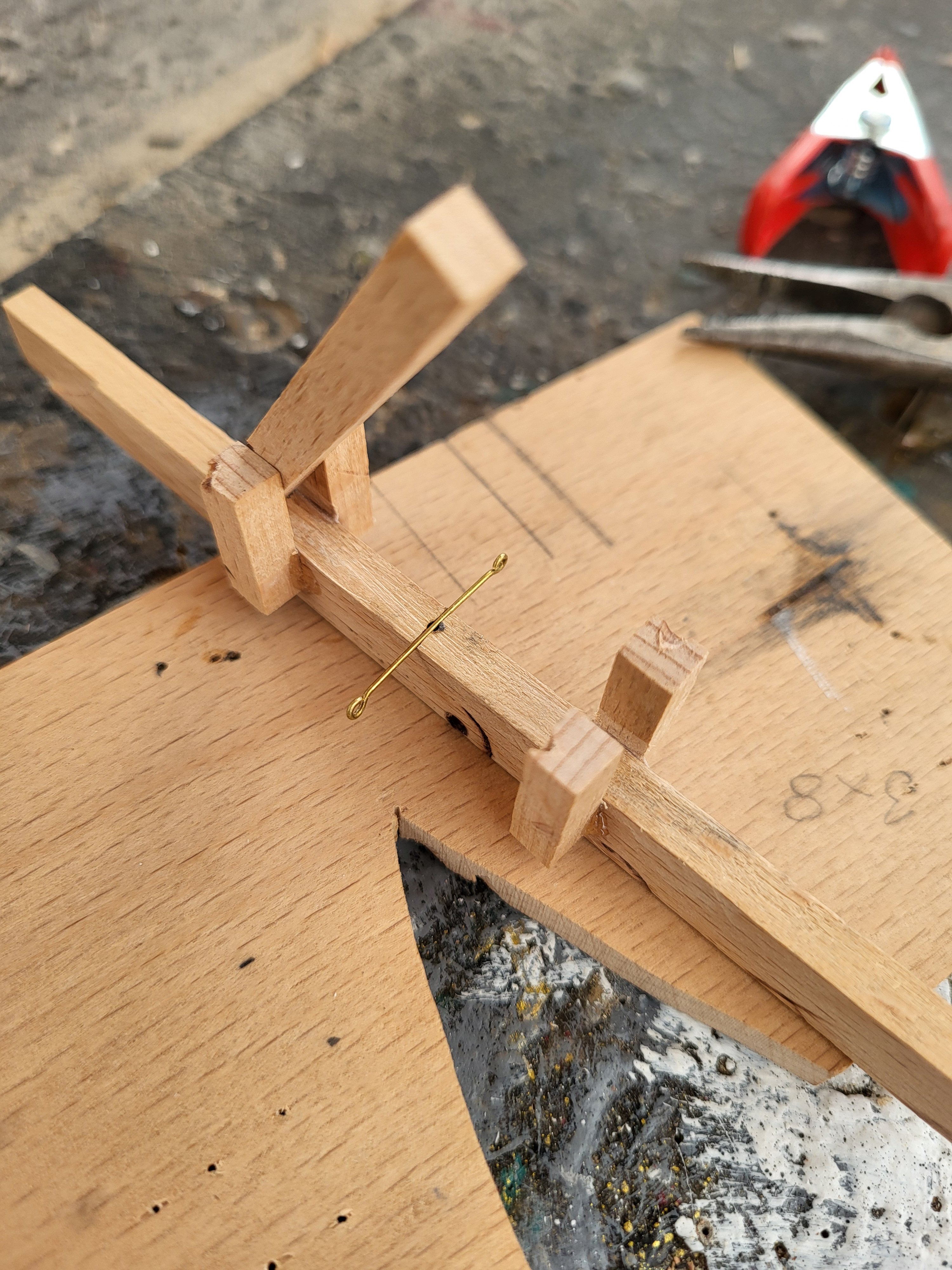

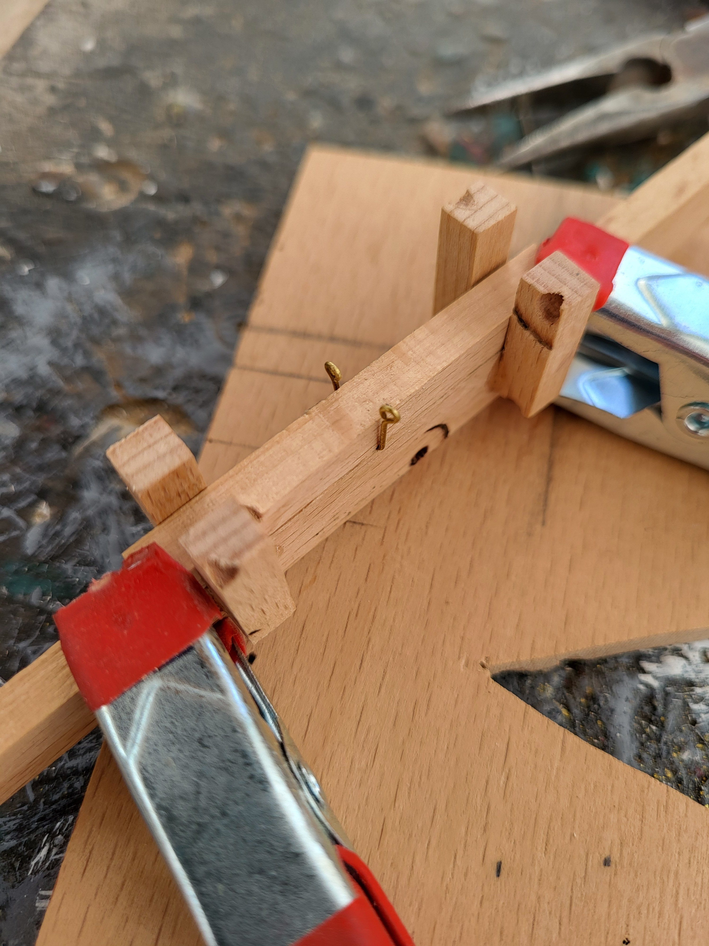

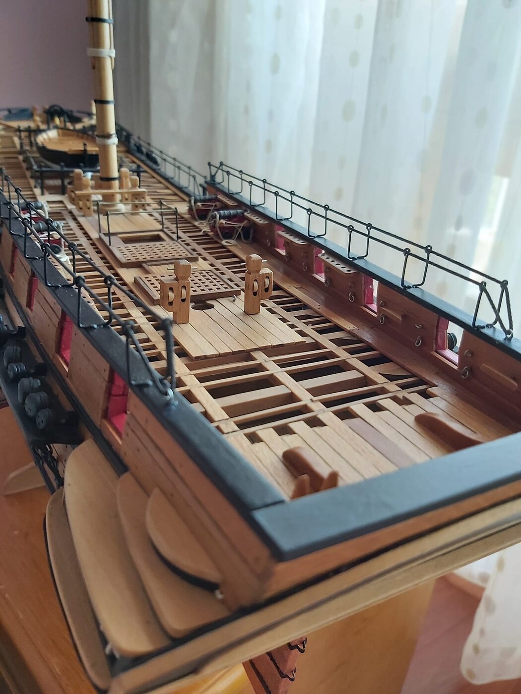

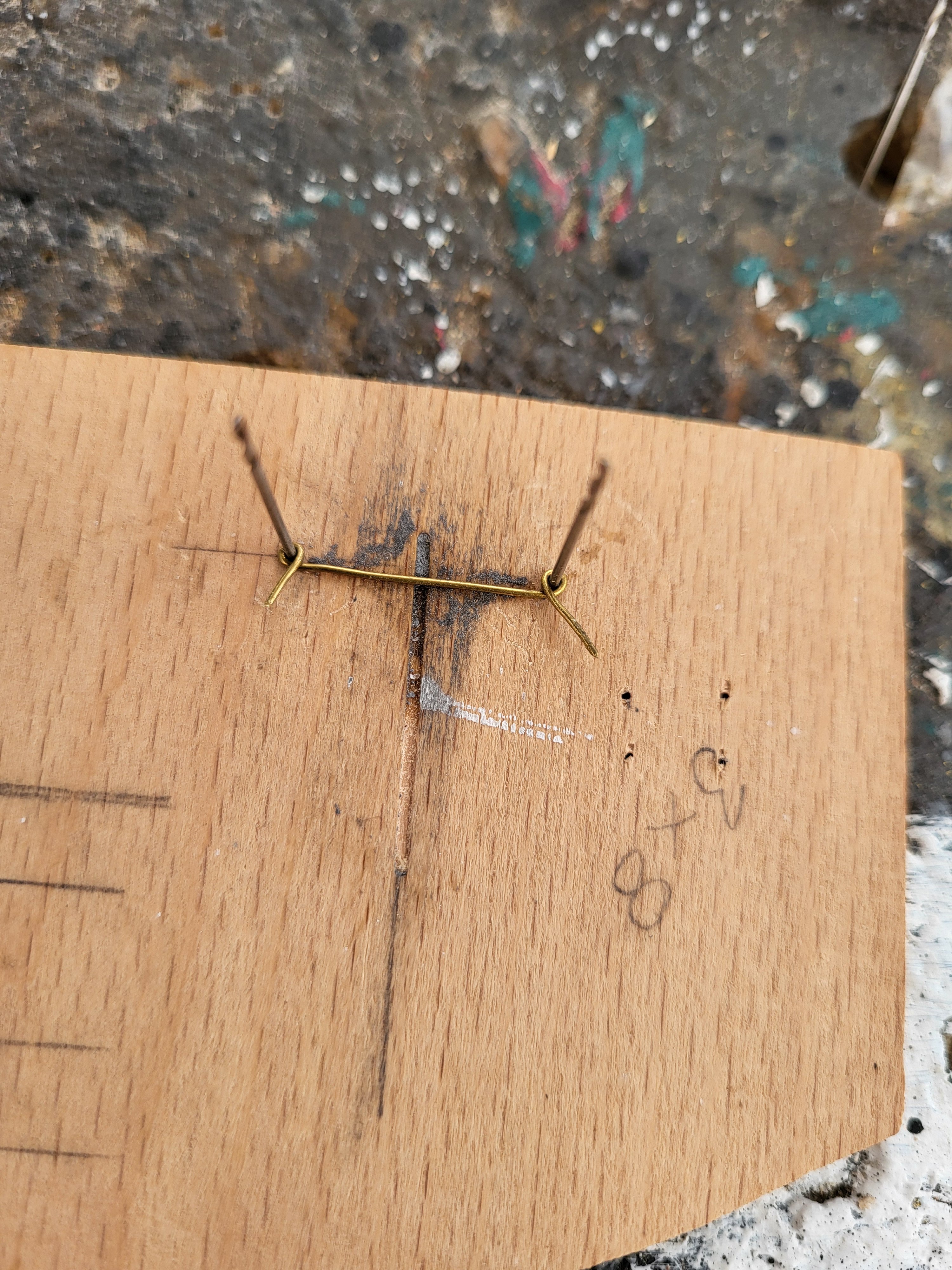

50 minutes ago, Unegawahya said:
Did you use a jug to make your stanchions?

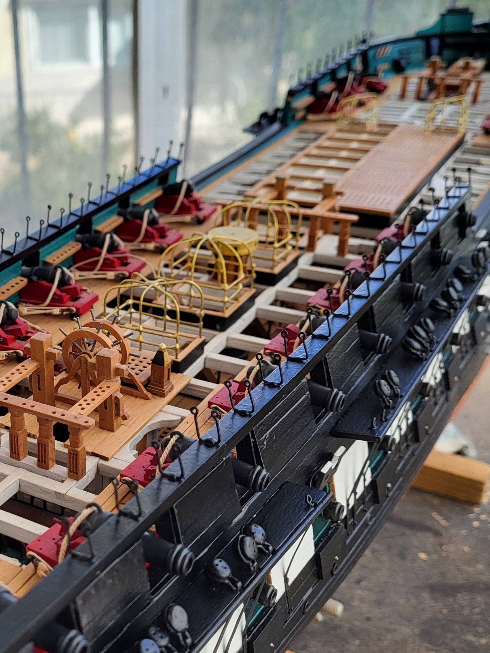

Thanks, Thomas. I used two jigs to make the stancions. One to create the loops and another to create the frames. I had to make these jigs because I needed to make 54 stancions, and they all had to be the same shape and size. Finally, I soldered the extensions.
Edited by mtbediz
I love your jig creation, Mustafa!  Perfect stanchions.  Great work, sir! 👍🏆
Gregg
That is some jig you made. It worked perfectly!
Jon
Edited by JSGerson
I do not plan to add stanchions to my model, but I took great interest in your use of jigs to manufacture yours. Were I to add stanchions to my model, I wouldn't have the luxury of soldering on the extension, leaving me with the mental exercise of figuring out how to modify your jig to also factor in the extension.
You're leaving me in the dust Mustafa! The good news is, I'll have plenty of fresh new references to help me in the coming years to help me finish my Constitution.
Great work as always.

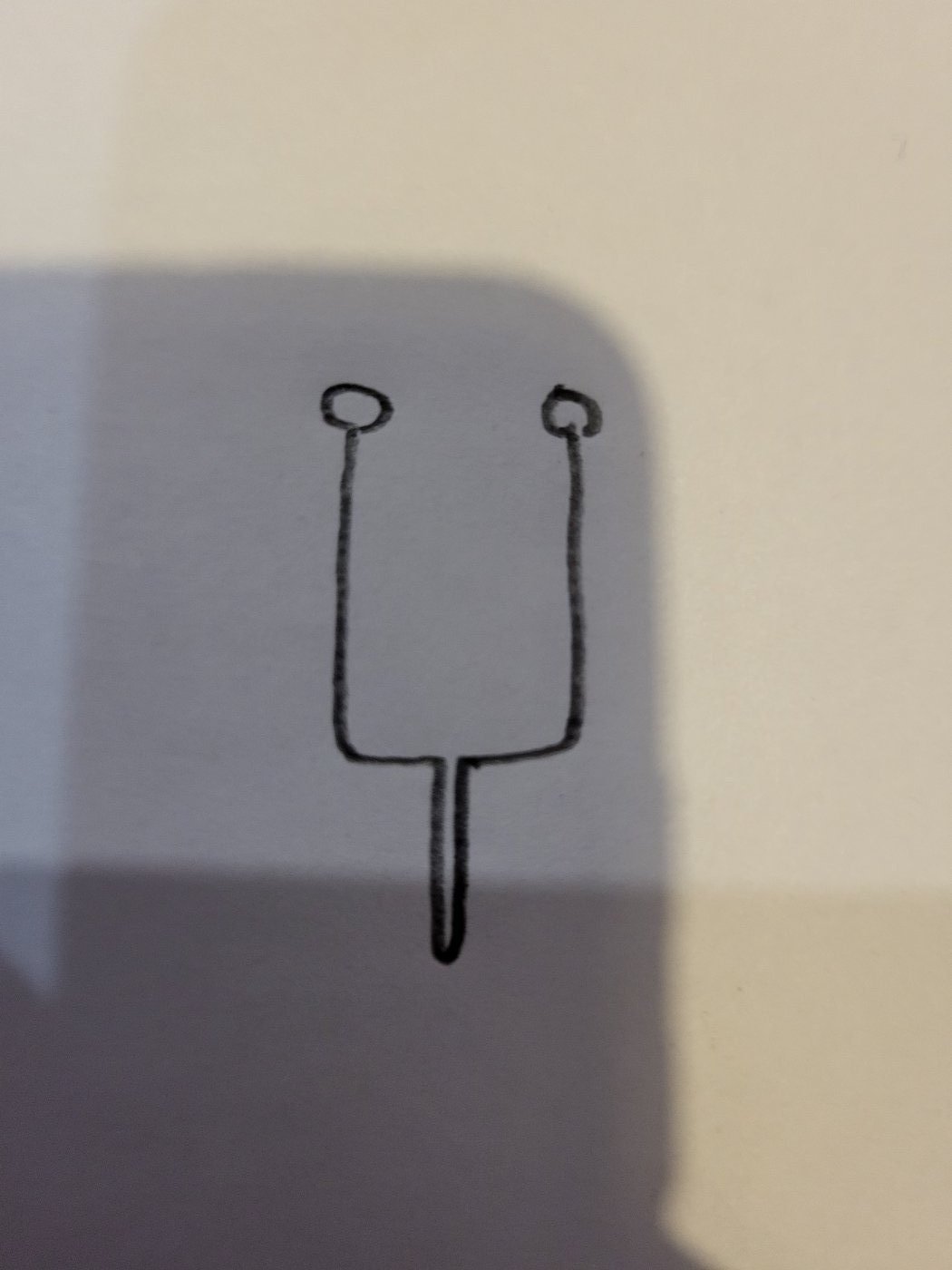

Thanks Peter, a few years ago, before I had the luxury of soldering, I made similar stancions of my Essex model like the ones in the photos. I can't show you how I did it or what kind of jig I used because I didn't take any photos but It probably wouldn't be too difficult to design a jig or jigs to do this. I'm sharing this with you to give you an idea.

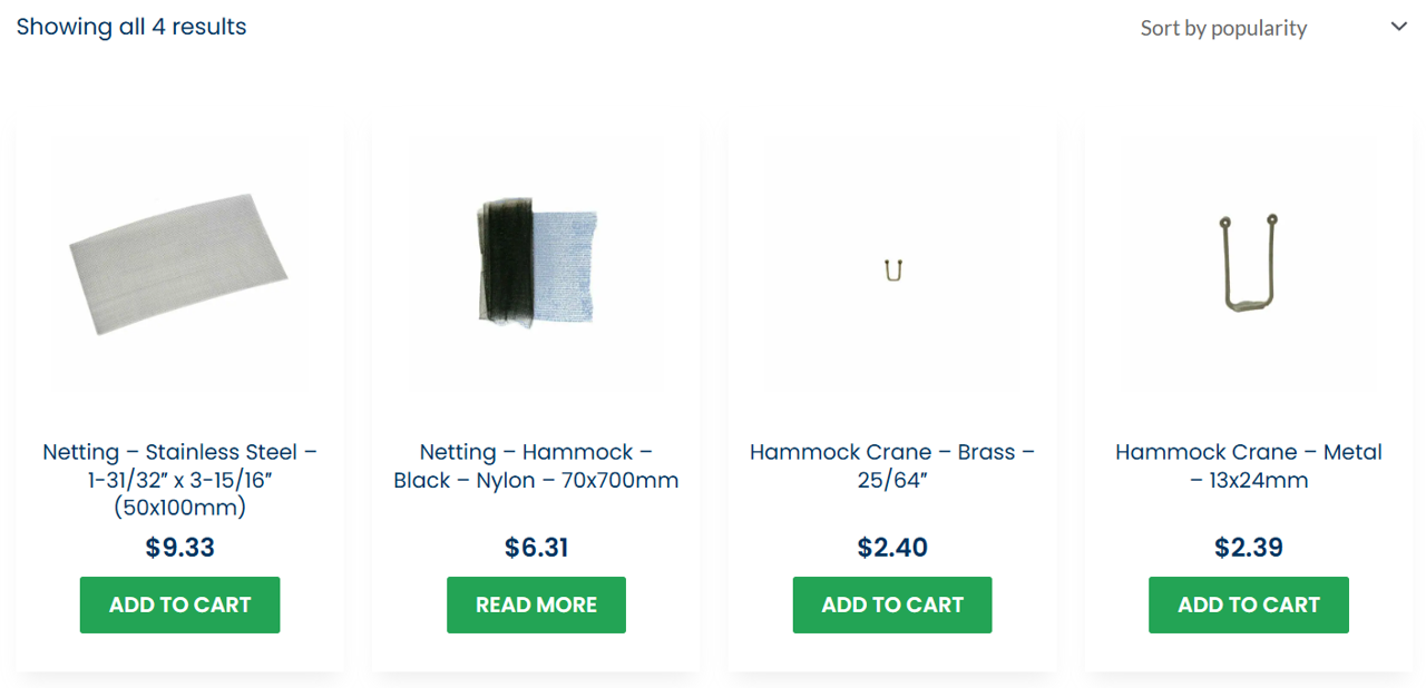

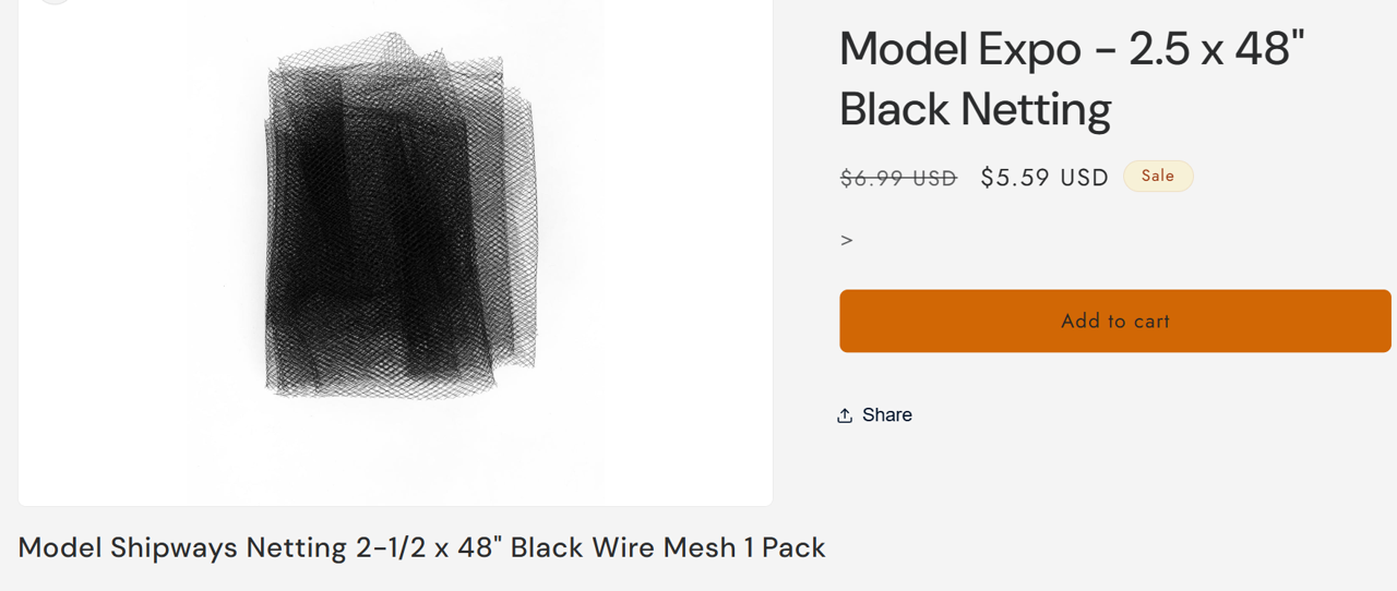

Not to get ahead of your discussion in what you are probably about to work on, but what are you going to use for the netting in these stanchions?  I've seen others use tulle, which I was unfamiliar with until I saw others using it for purposes like this.  I saw that Jon used it on one of his last builds, as well.  Exciting to see you moving forward with all of this!
Gregg
The main thing I don't like about tulle is that it is not a true cross net. If you look closely, the intersections of the lines forms a star pattern. Of course, you would have to be up real close and be wither very near sighted or have a magnifying glass so the model builder can get away with it.
I have found ship blogs where the builders weave their own nets. If anyone is interested, I can point you to them.
Then there is the alternative: Steel mesh.
I have not used either one
Jon
On 11/5/2025 at 5:29 AM, GGibson said:
Well, there is a distinct difference between having the luxury of soldering and the luxury of doing soldering well  !  You have the latter ability,
Thanks, Greg. I've only been soldering for about a year. I use solder paste. It's a much more practical method.
I am planning to use a piece of screen mesh inside the hammock cranes to represent the netting which I will be trying for the first time.

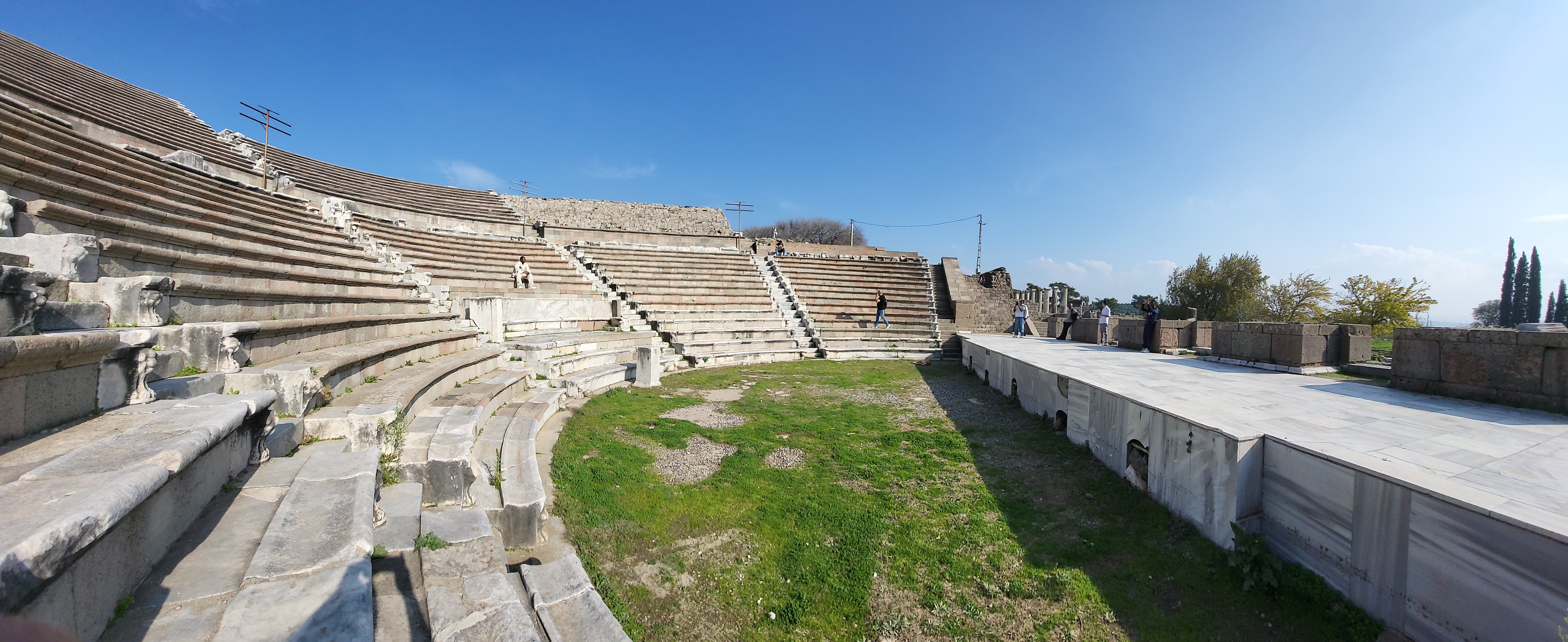

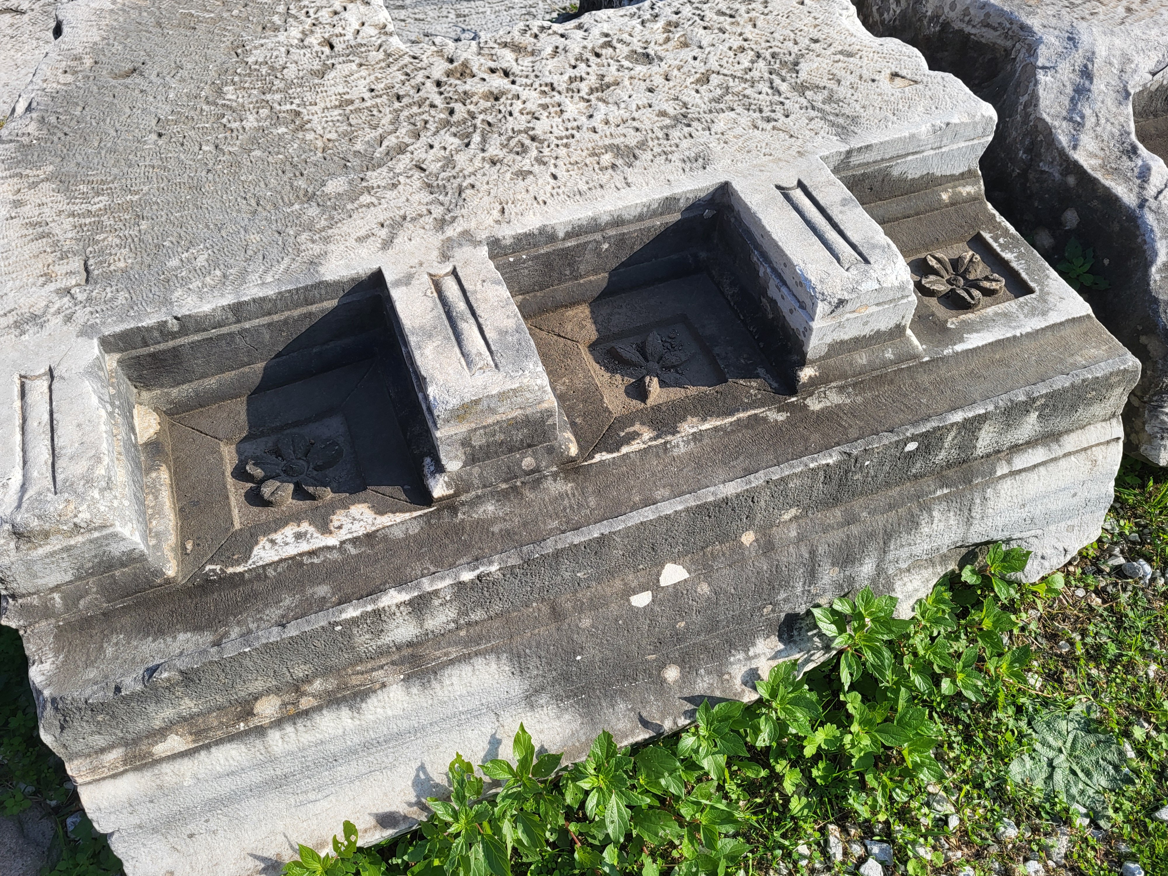

We're in Izmir (Smyrna) for a week to visit our daughter and grandchildren. Izmir, located on the Aegean Sea region, is Türkiye's third largest city. There are many historical and touristic sites surrounding Izmir, and yesterday we visited one of them, the ancient city of Pergamon.

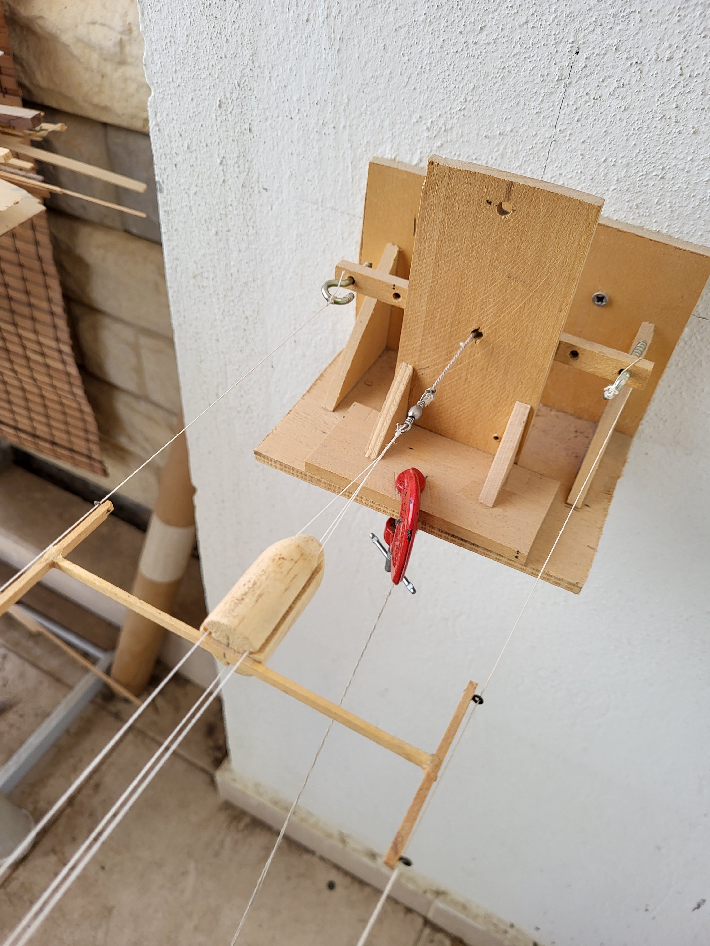

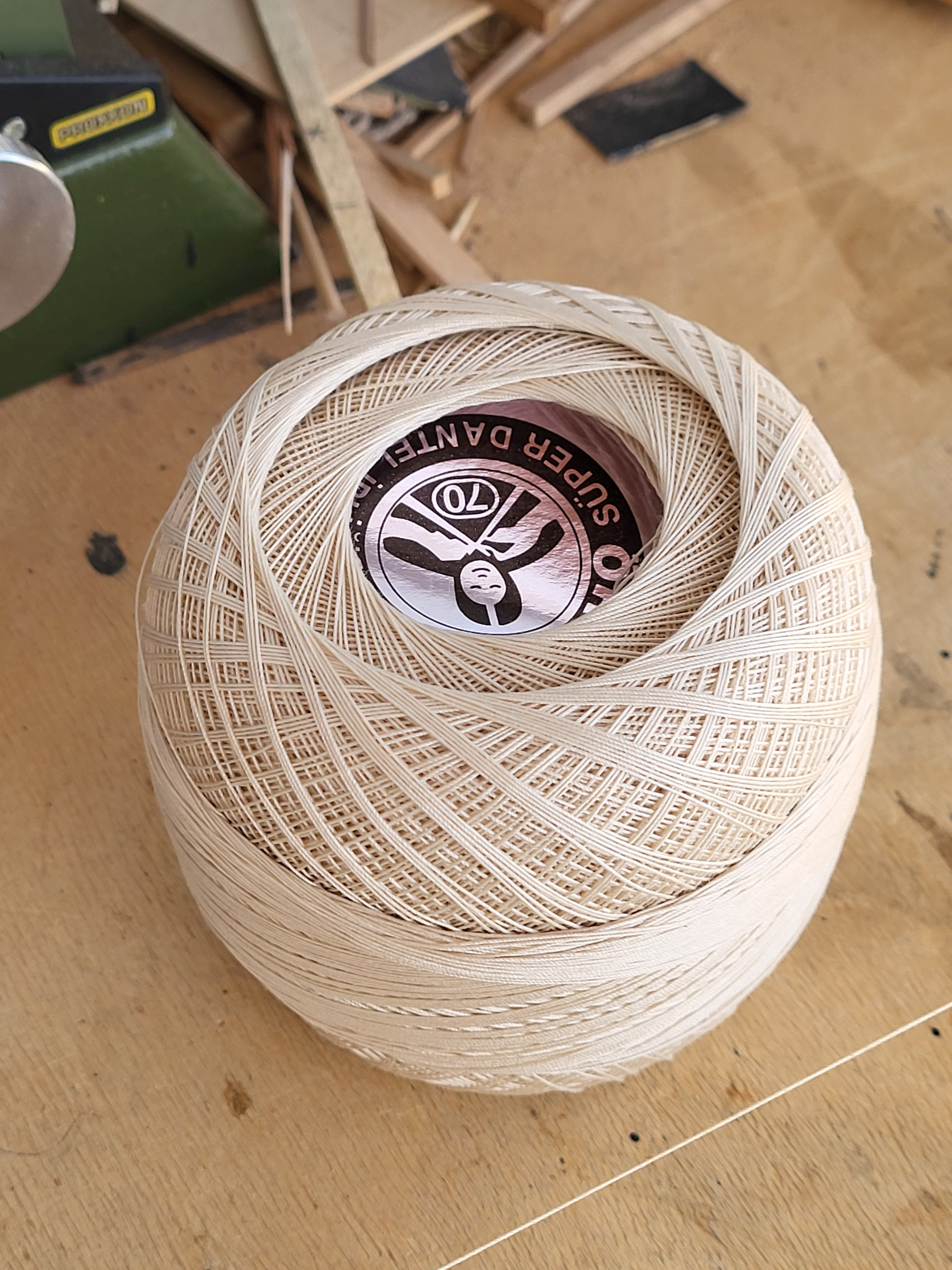

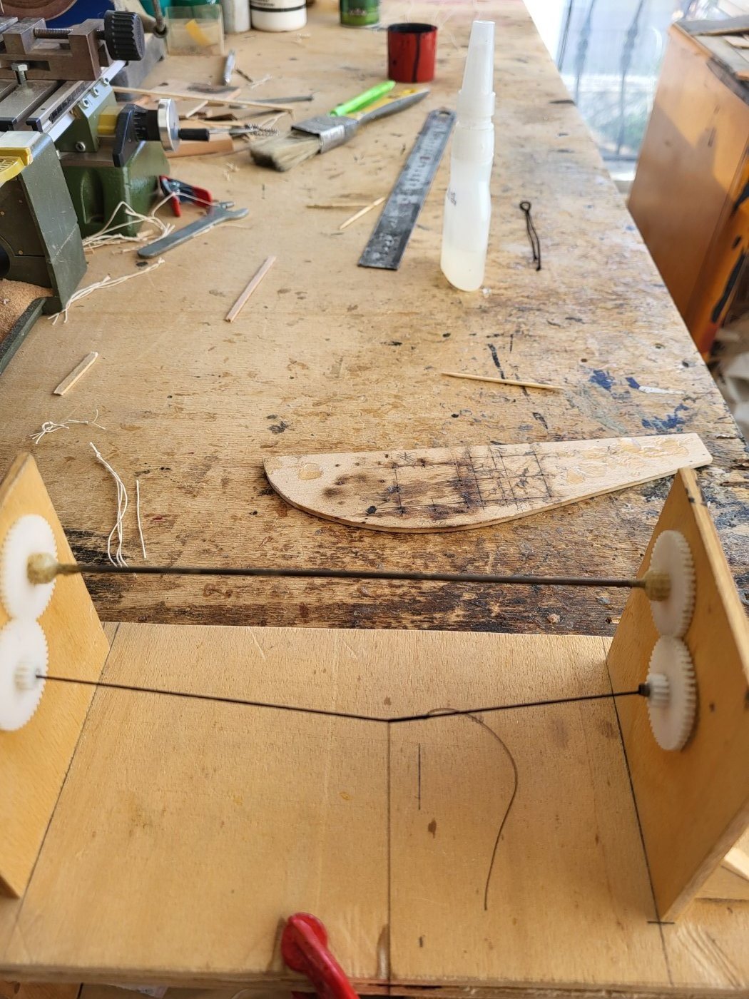

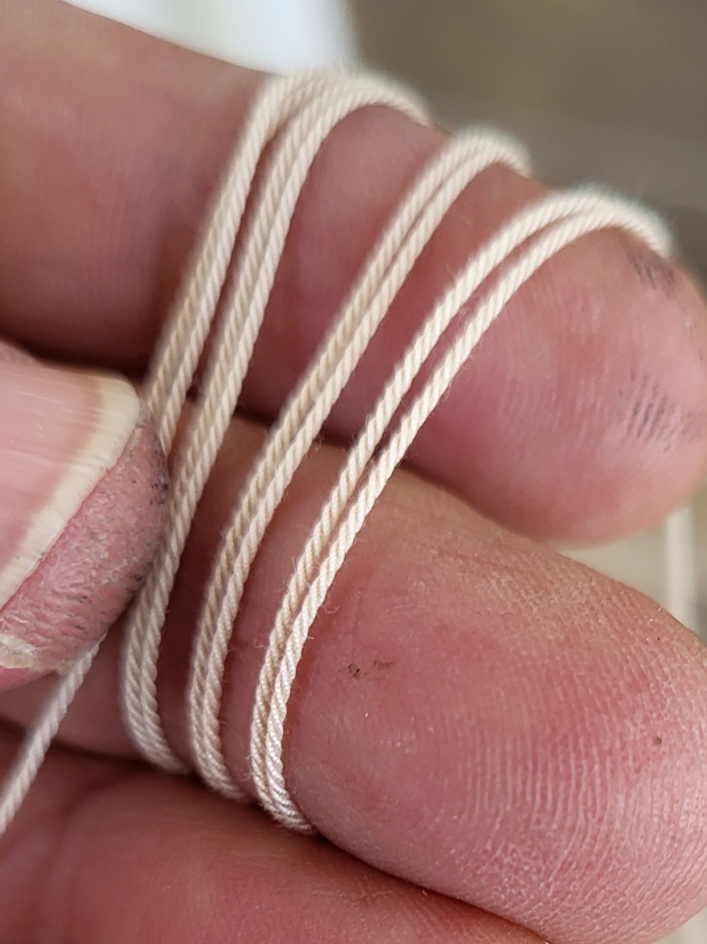

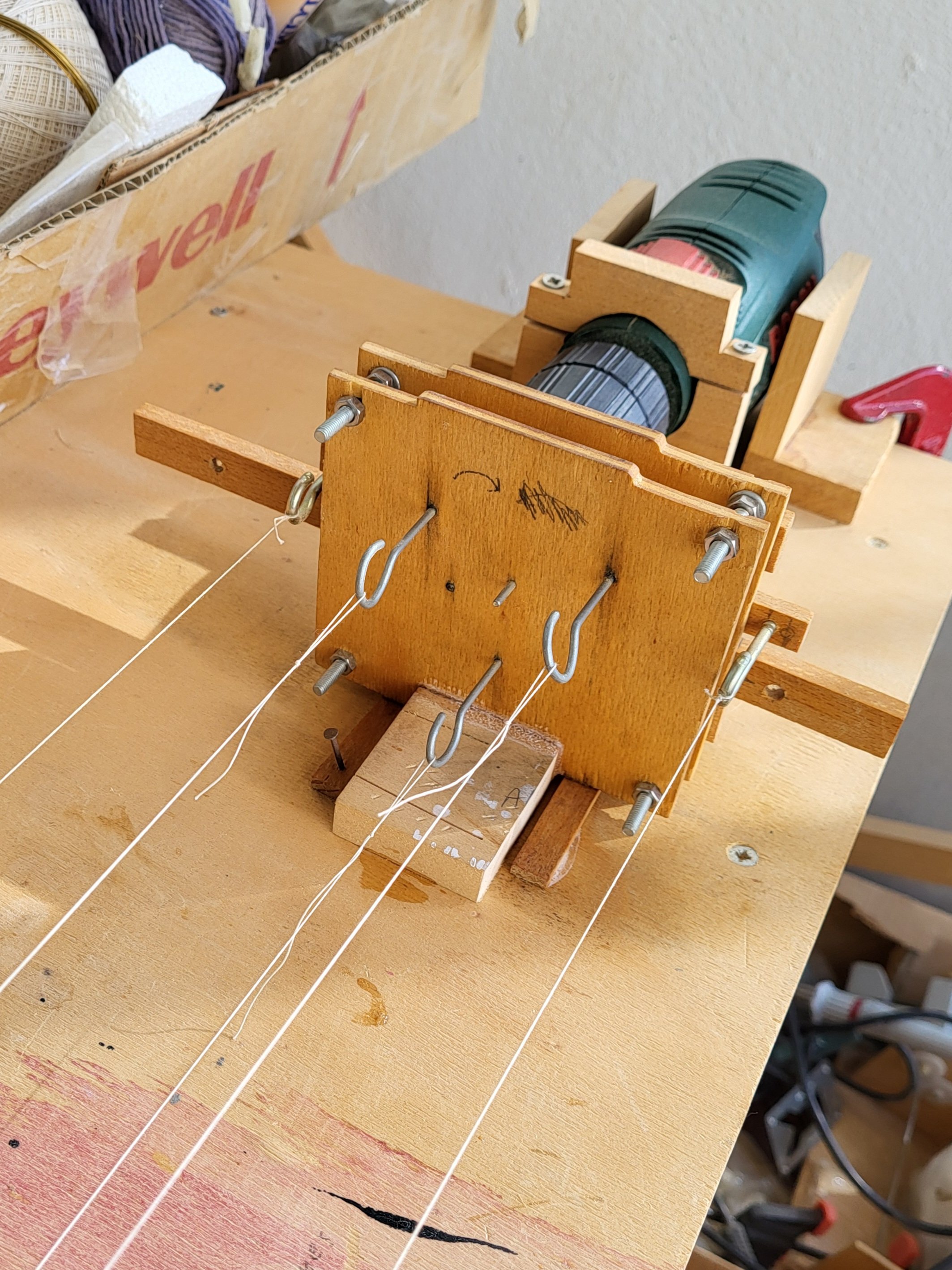

So, there is a weight compensating the shortening of the rope you produce in yor maschine?
"Pirate Sam, Pirate Sam. BIIIIIG deal!" Captain Hareblower aka Bugs Bunny
6 minutes ago, Marcus.K. said:
Beautiful!
Thank you. Yes, there is a weight at the end of the thread going down.

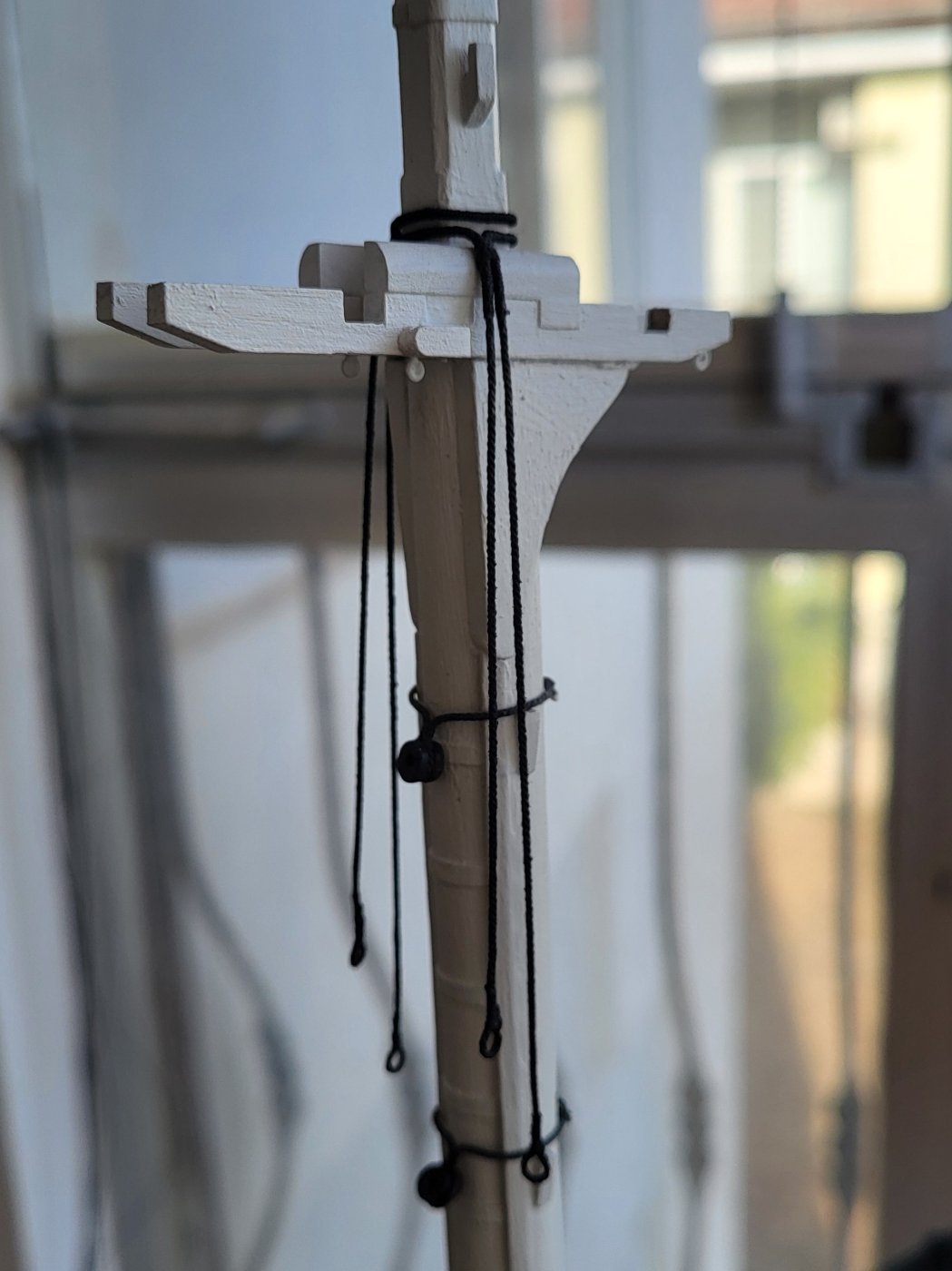

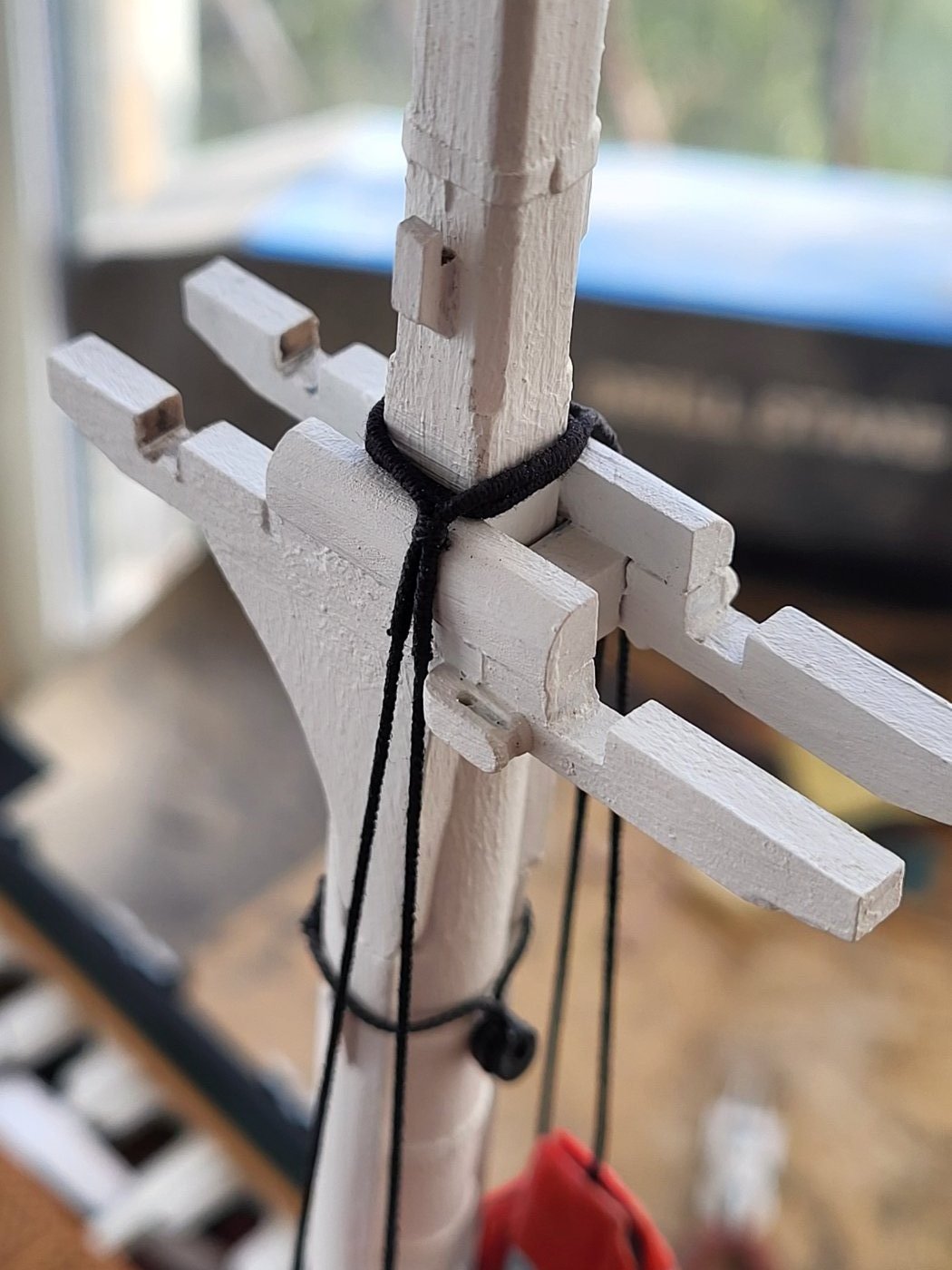

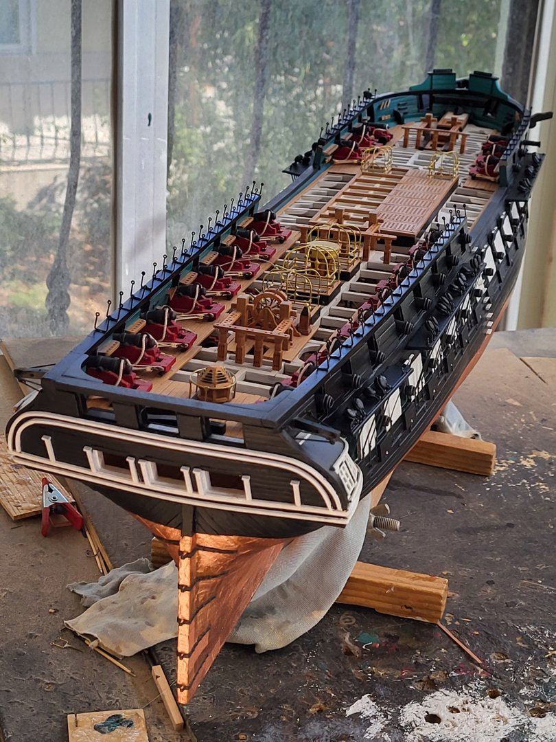

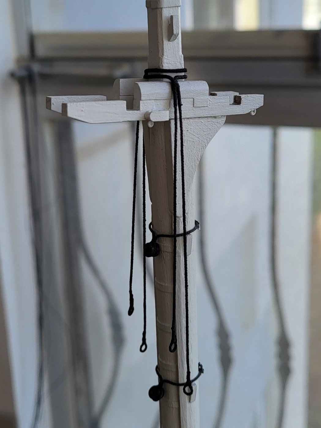

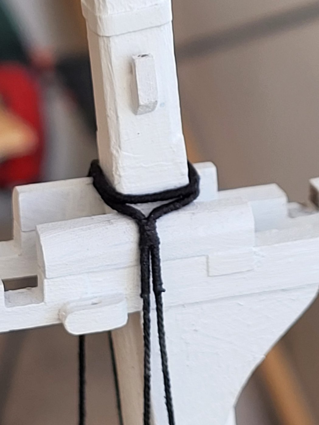

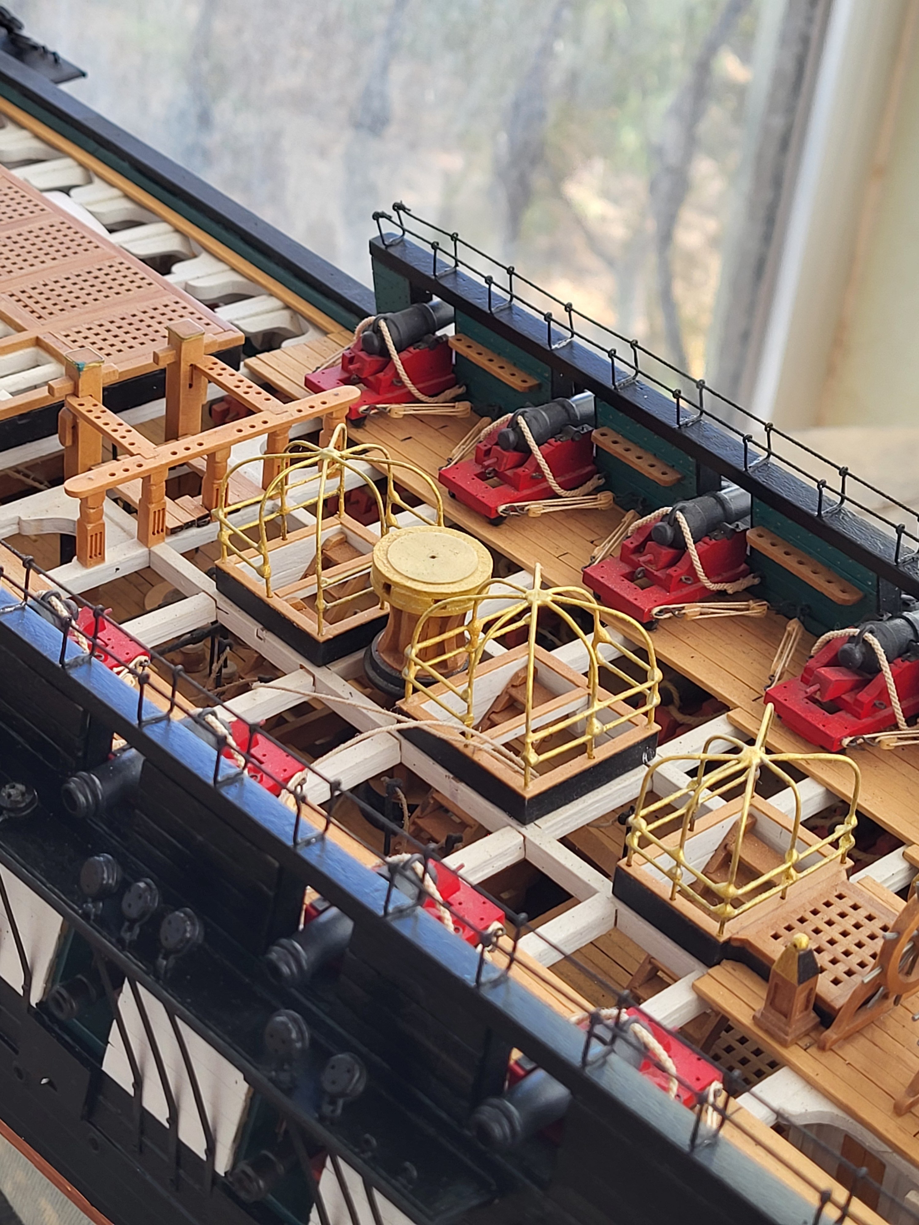

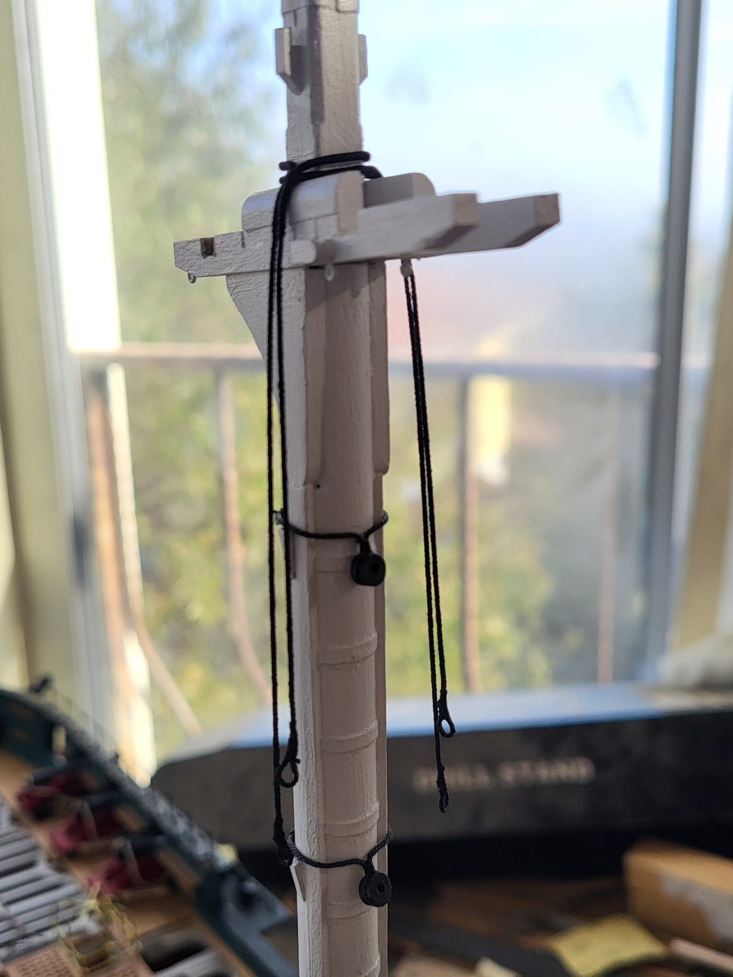

Now it's time to start rigging. There's no particular reason, but I'm starting with the main mast. I think it's just a matter of habit; I always start with the main mast, then work on the fore and mizzen. The main mast has now been set in place and glued securely. The pendants need to be prepared and hung before the shrouds. I didn't use thimbles for the pendants; I simply created a loop and stiffened it with CA. By the way, I didn't make the pendants as shown in the plans. If you compare them to the plans, you'll see what I mean. I chose a simpler method because they would be hidden under the shrouds and wouldn't be visible.

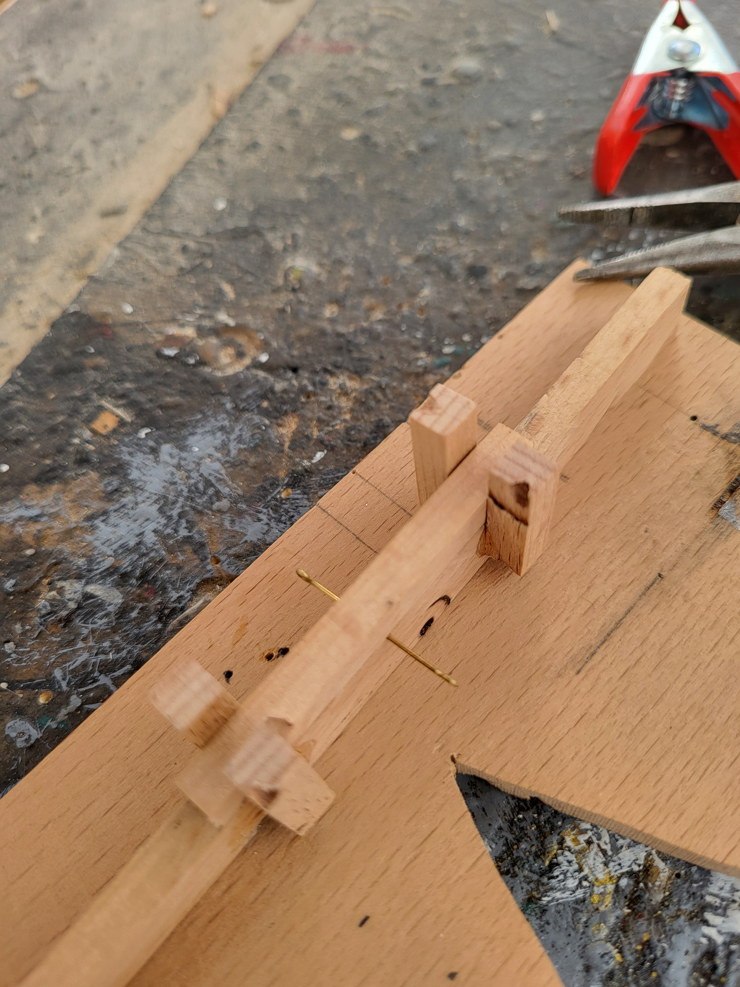

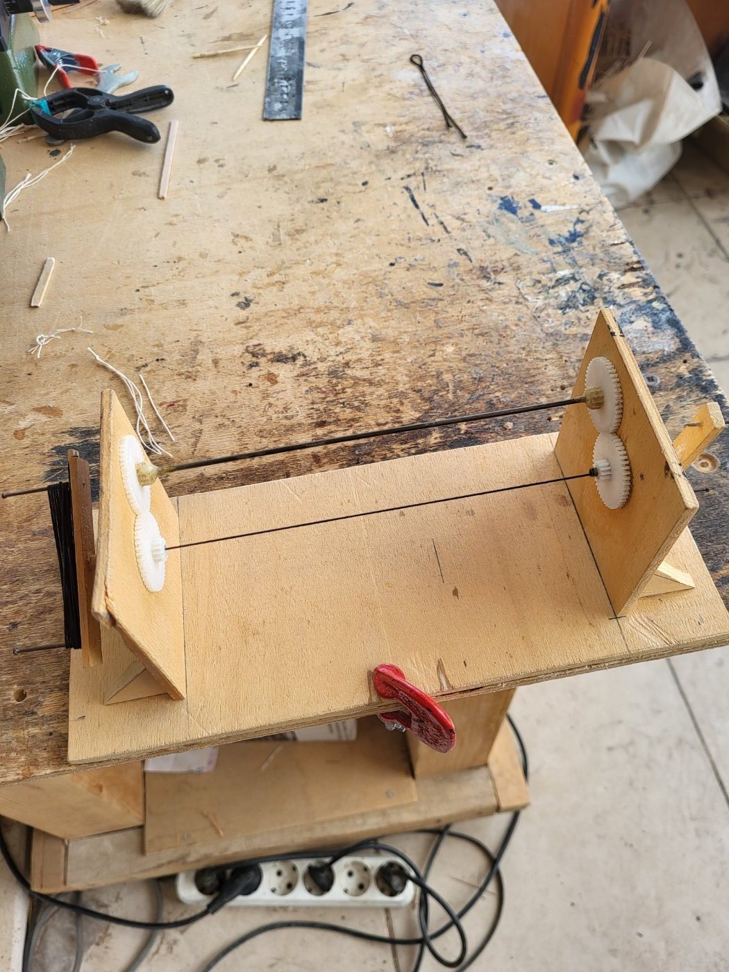

When seizing the areas where the pendants are wrapped around the mast, I use the serving machine I made.
Let me state now that I will not be adding the sails and therefore some of the ropes.
Edited by mtbediz
Great to see you starting on the rigging, Mustafa!  Will be an entertaining and informative following.  And I appreciate your decision on the non-sails.  I recall you were on the fence as I read your early posts.  Not having sails will allow your family and friends to see your magnificent work even clearer.  We all aspire to build a "Mustafa-quality" Constitution.  Congrats on achieving this crossroad, my friend!
Gregg

P.S.  It's not entirely clear to me how that serving machine you made works for seizing the pendants.  Is there a motor attached to your gizmo?  How are you doing the winding?
Hello Peter. No, I don't use a motor in this, it doesn't need high speed and I turn it by hand.

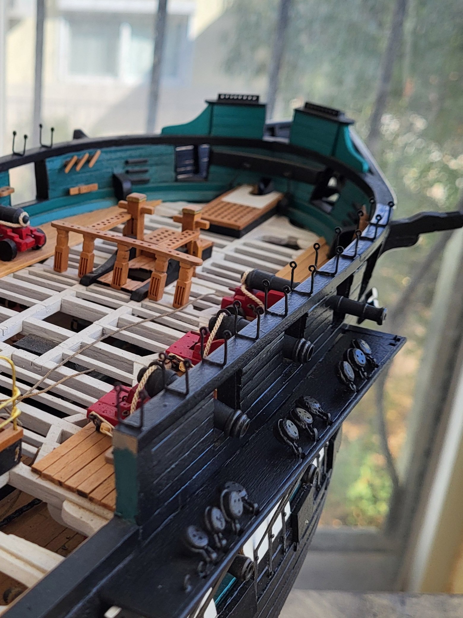

I've slowed down a bit these days as I'm waiting for Peter's calendar project to be finished. I can't bear to see him fall too far behind in the race :) I tied some shrouds.
