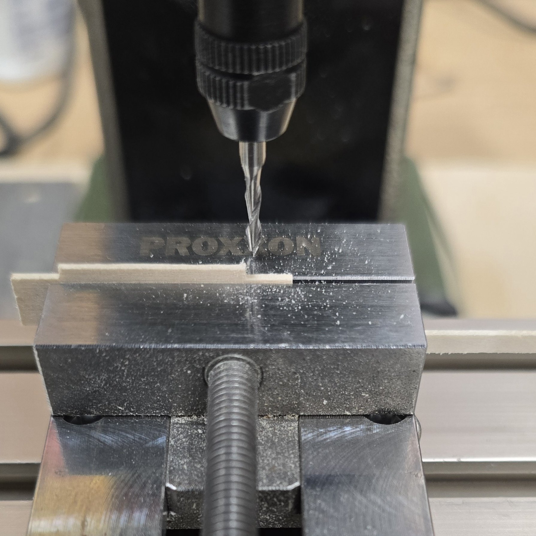

(As an aside, this dividing attachment is a pretty crappy accessory for the proxxon MF 70 mill.  It would be nice if the rotary base would accommodate the small proxon vise instead of having these ridiculous Jaws. At least I got one thing accomplished using the tool.)

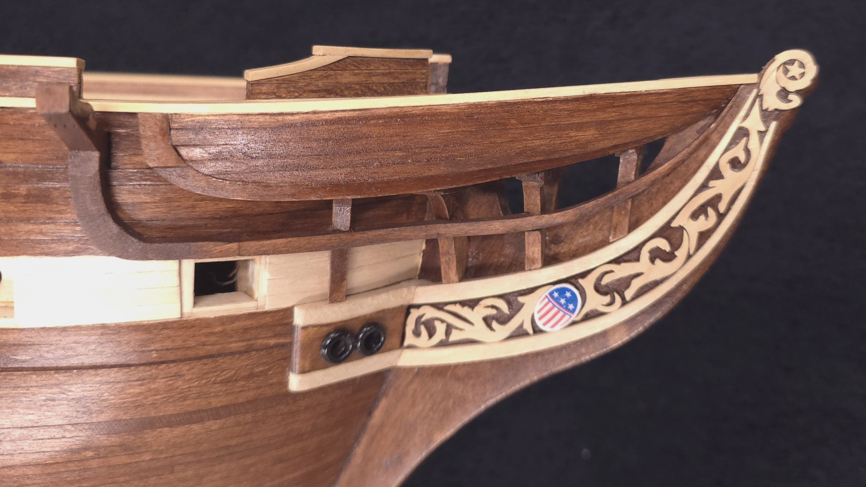

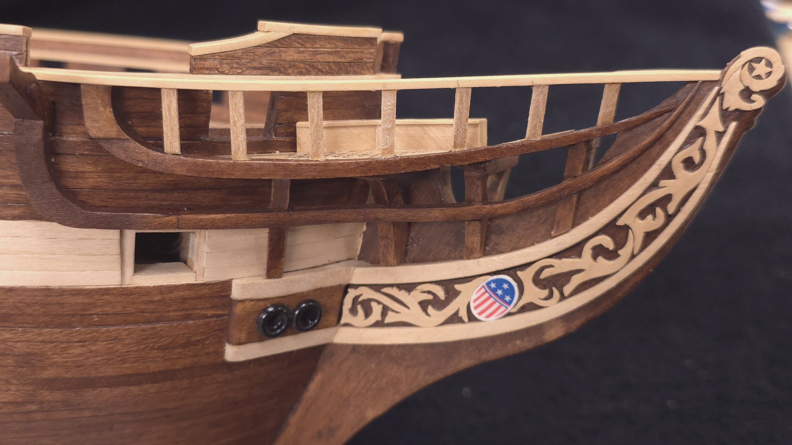

Finally!  While not perfect, due to slight discrepancies in symmetry between port and starboard sides, I am pretty satisfied with the result of the port side planking. More than that, I'm happy to be moving on to something else. What that will be remains to be determined.
Drat! I think I know what that's going to be afterall. I noticed a chip in the bottom port side rail, right near the top by the ornamental arrow in the trailboard scroll work. Maybe I'll try to fix that. I have no idea when that happened.  Again, the camera sees more than the naked eye.
Before I left the shipyard, I had to at least try to fix the chipped rail.
Edited by Der Alte Rentner

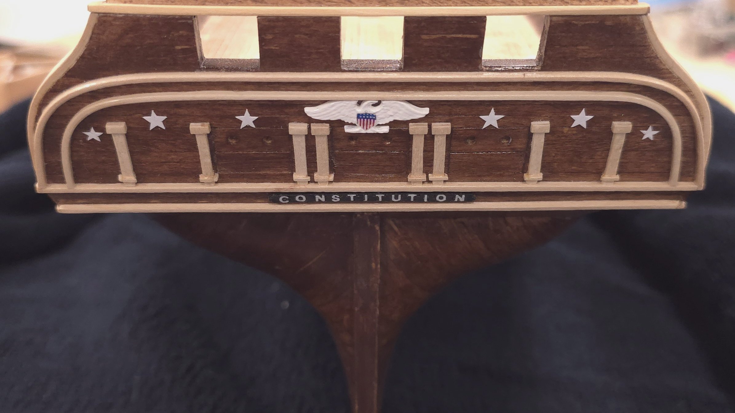

I give your transom work a 6-star rating review! 👍🏆
Gregg
14 hours ago, mtbediz said:
Your transom looks very nice, Peter. I either have to buy these stars or cut them out myself. What tool did you use to cut these stars?
I used double-sided tape to affix printed star shapes onto a styrene strip (.010" x .188"). I then used an Excel 17a chisel blade to cut out the shapes.  There's no way these are going to end up being perfect. I threw away about as many as I ended up gluing to the transom.
Truth be told, I think it might have been easier to make them using boxwood and my scroll saw, as I did for the stars in the decoration on the trail board/stem. Scroll back a bunch of pages to see how I did that in my build log.
I could not find a source for Star decals in the size required for this job.

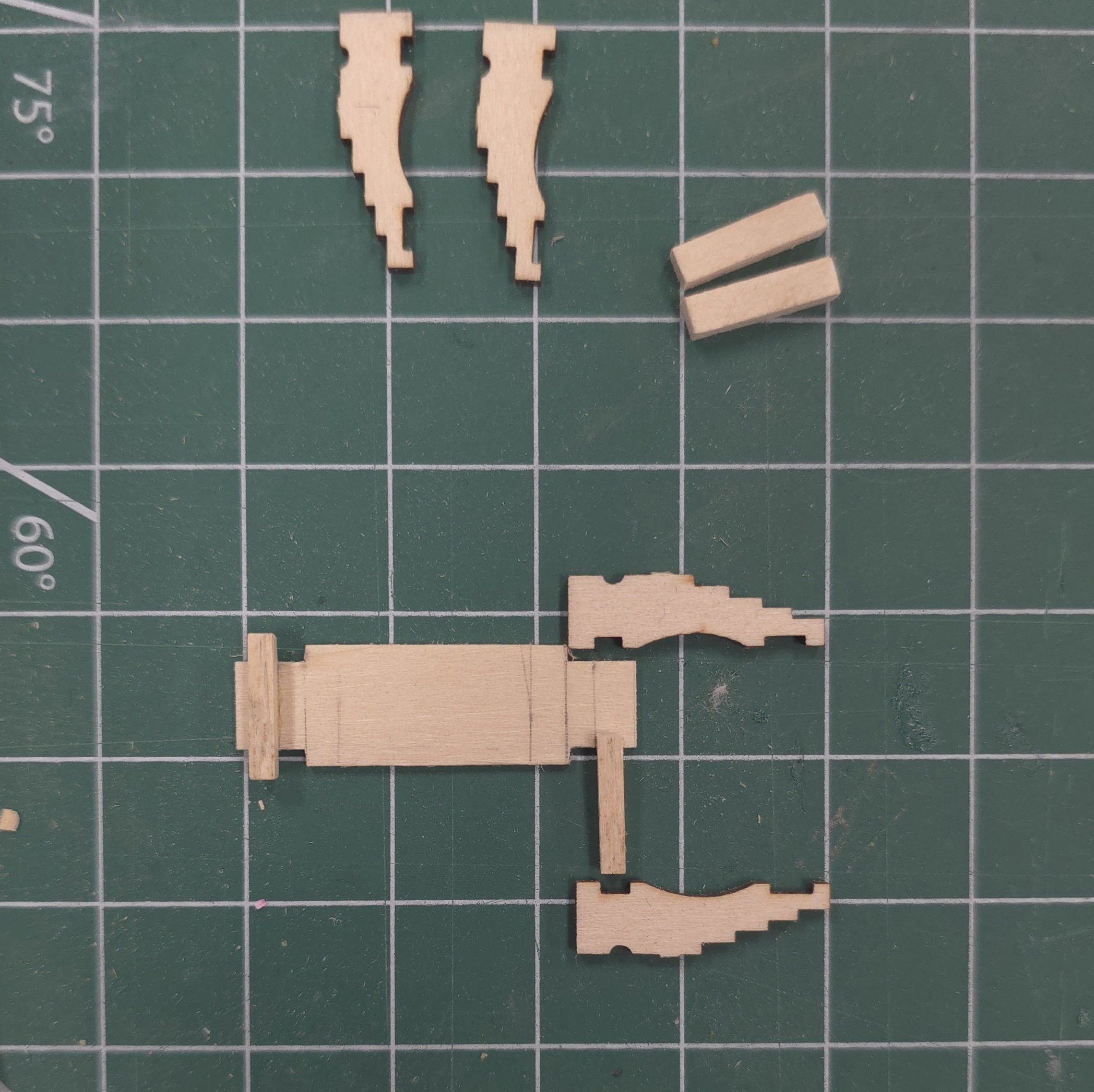

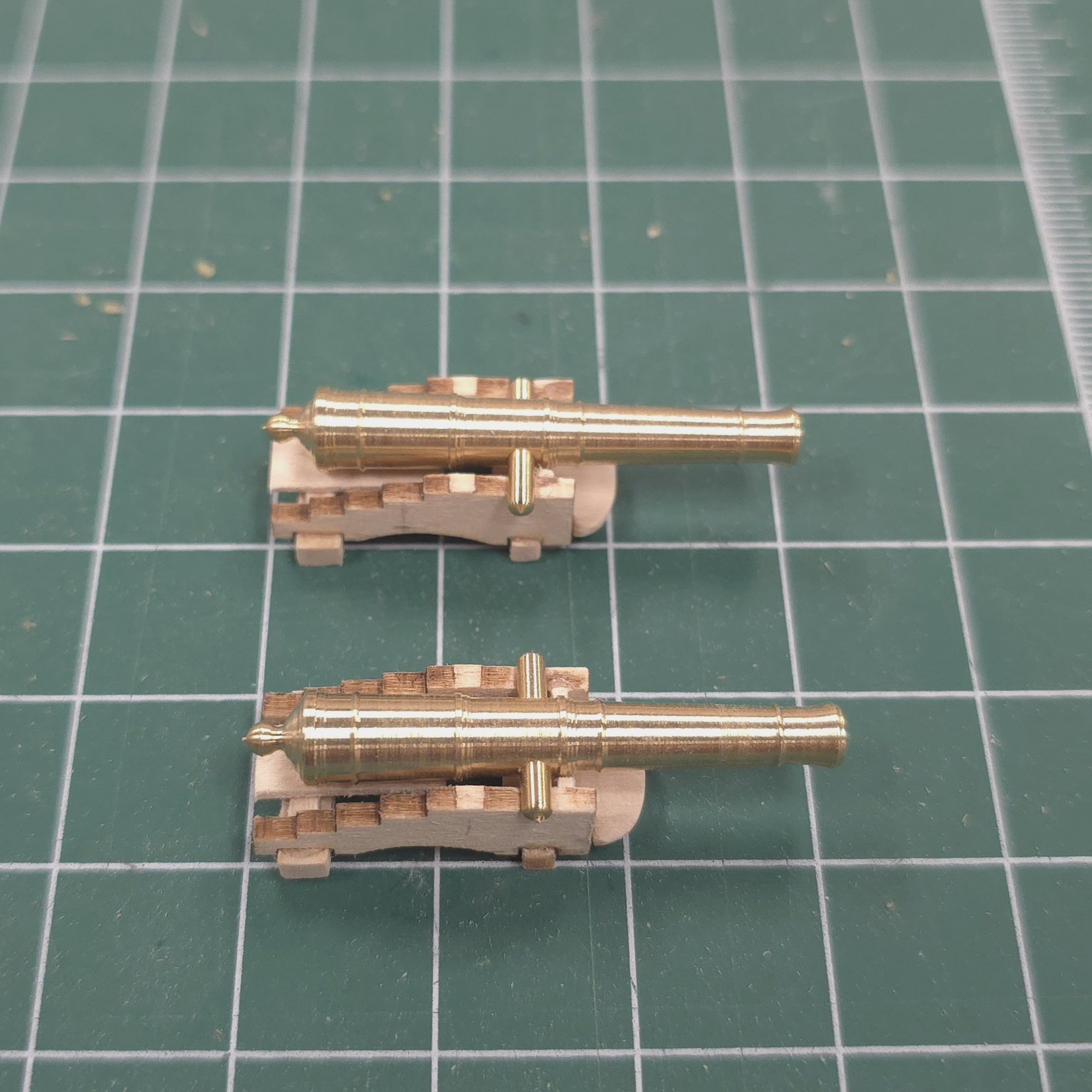

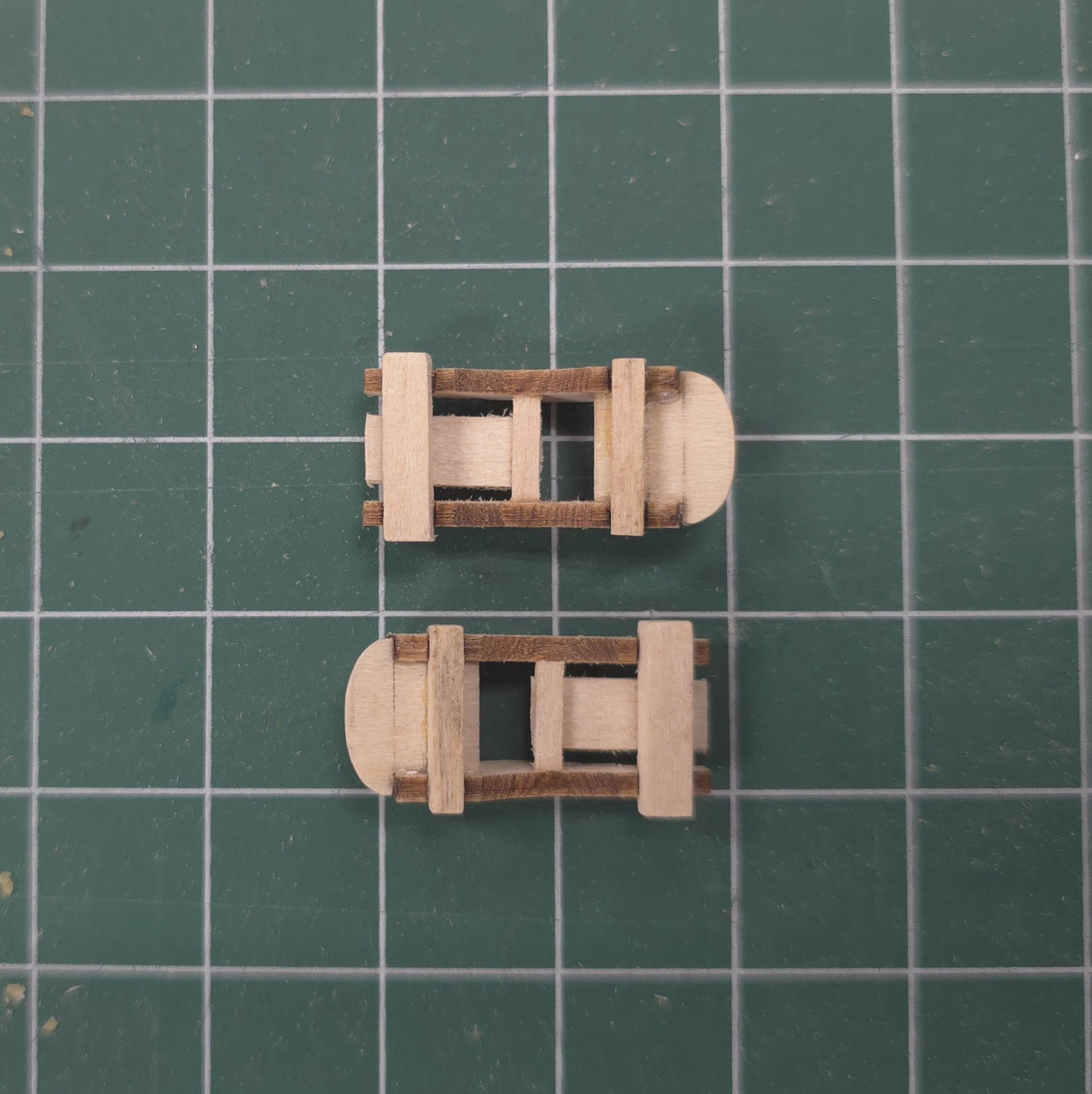

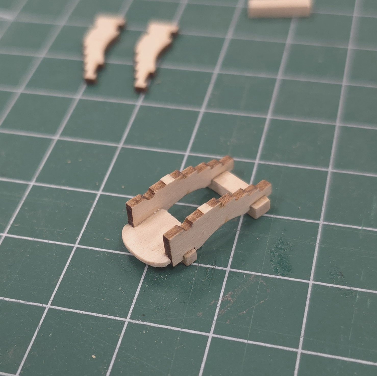

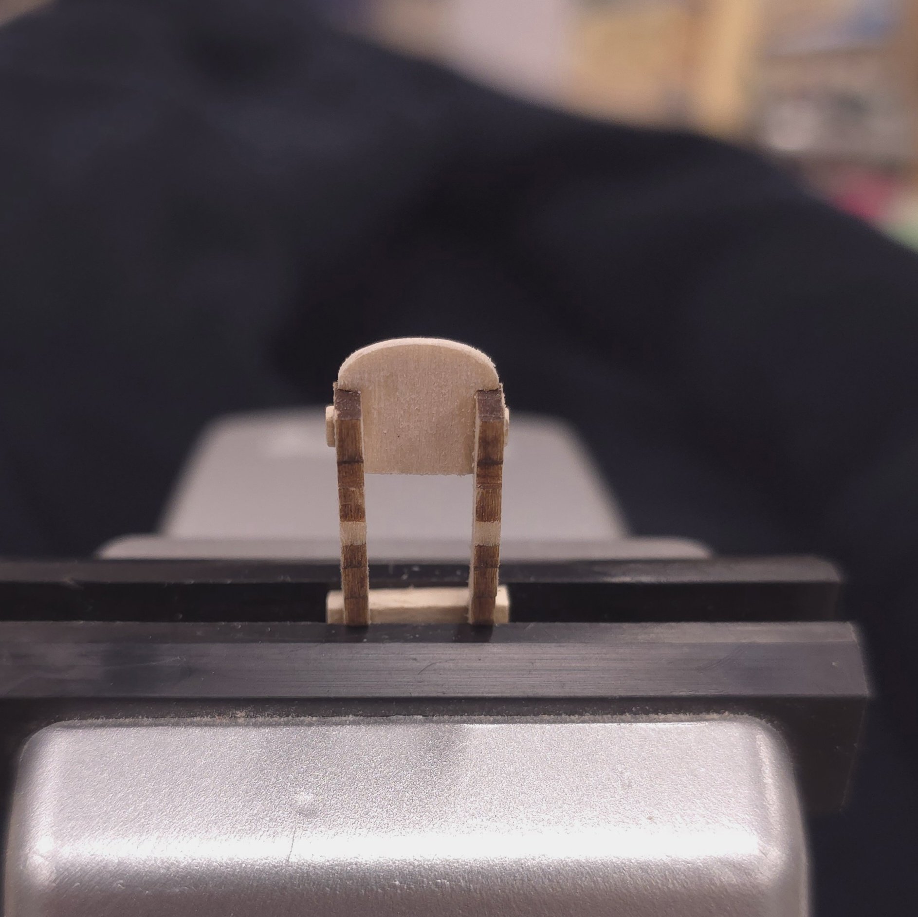

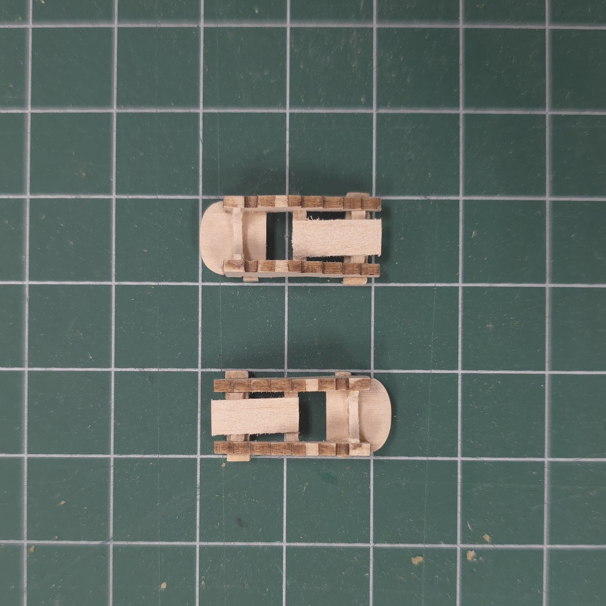

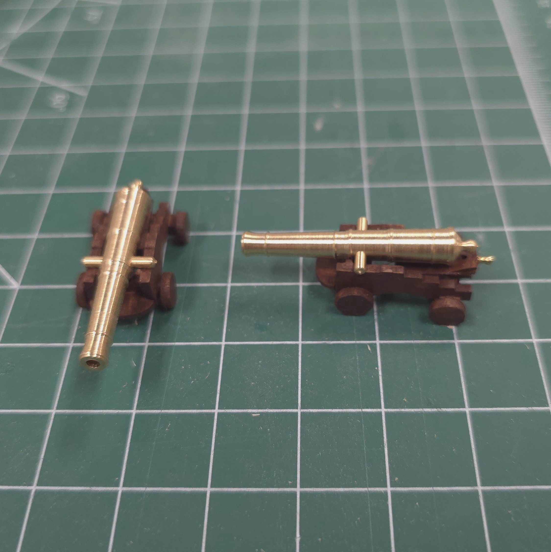

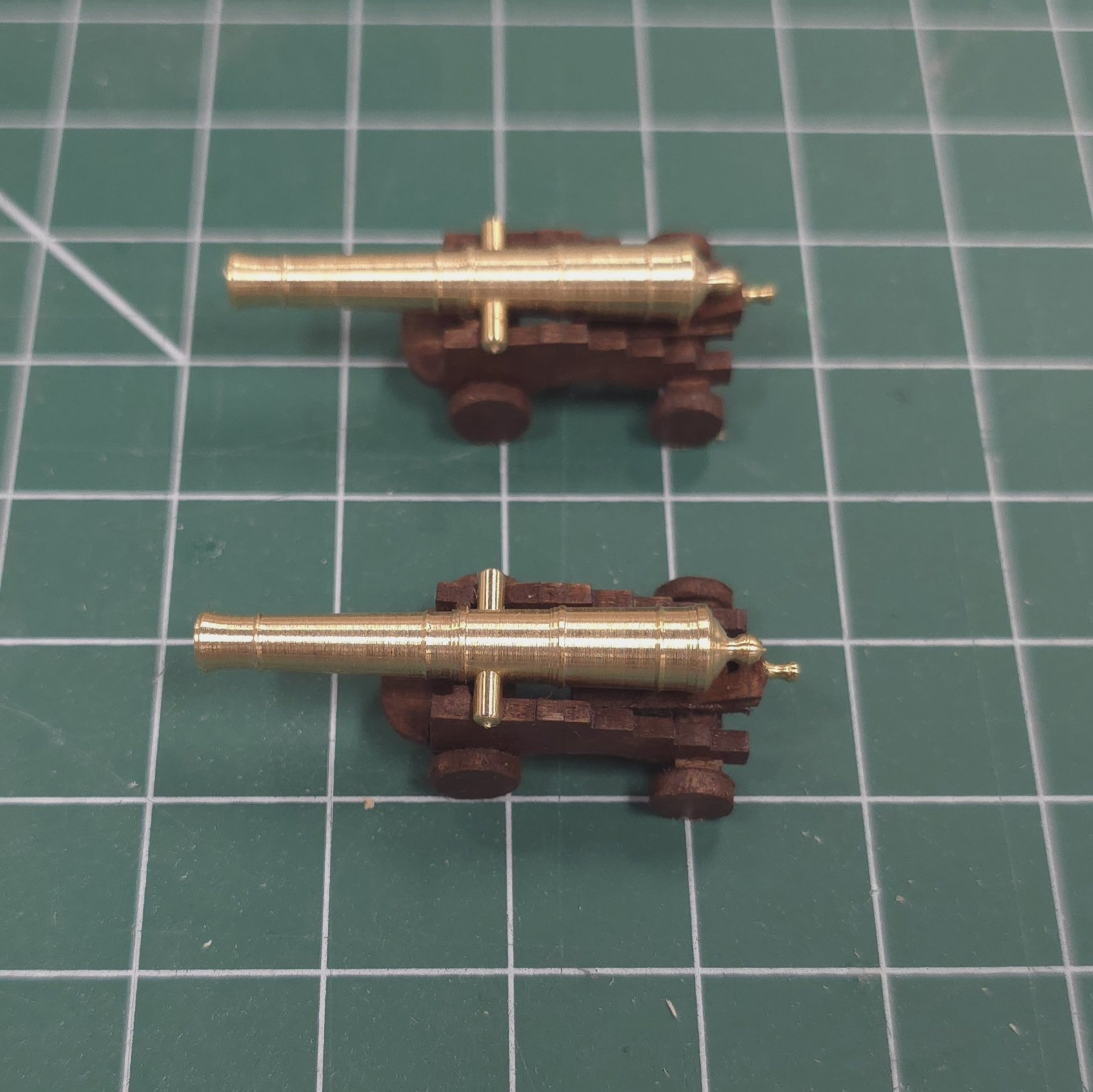

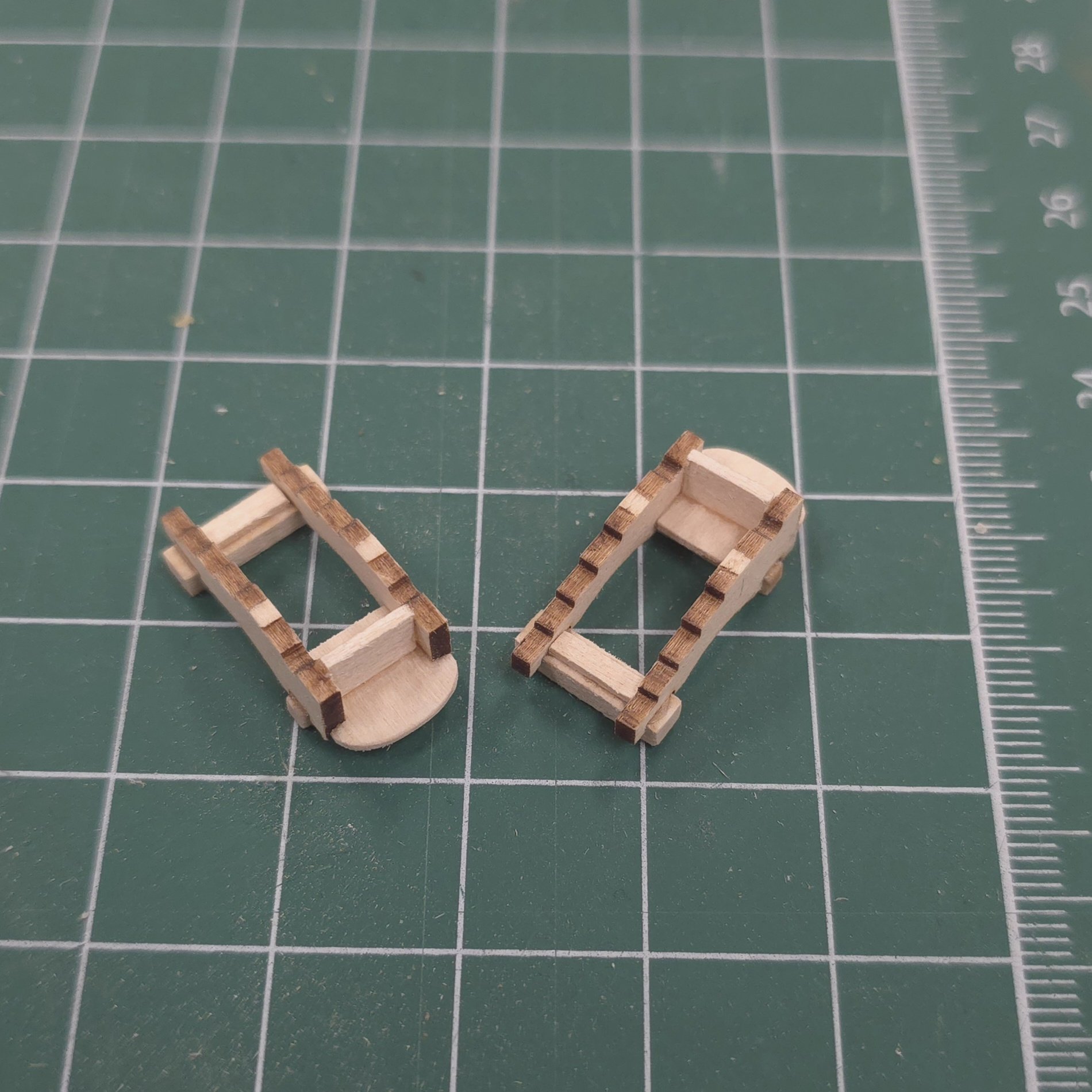

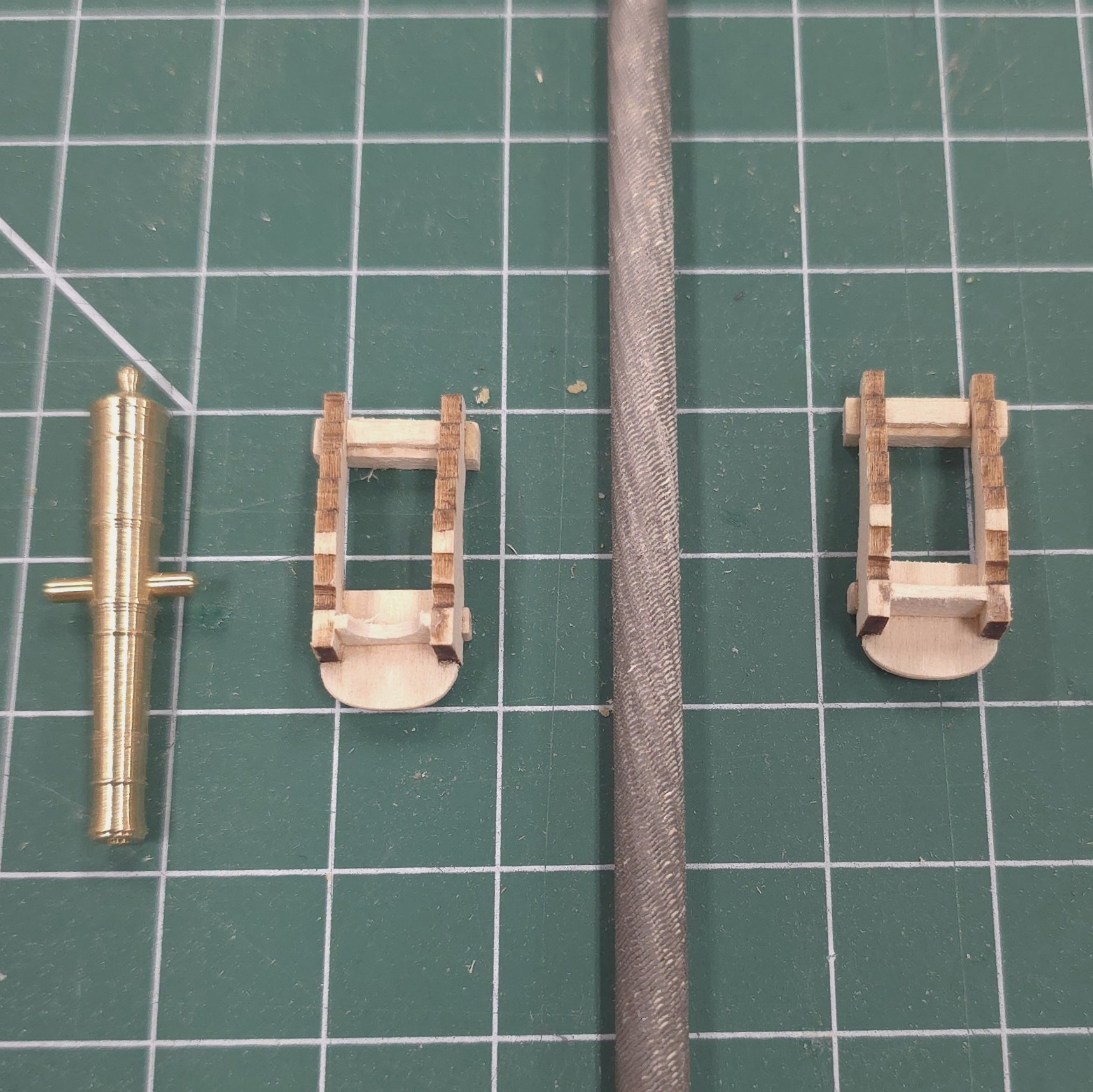

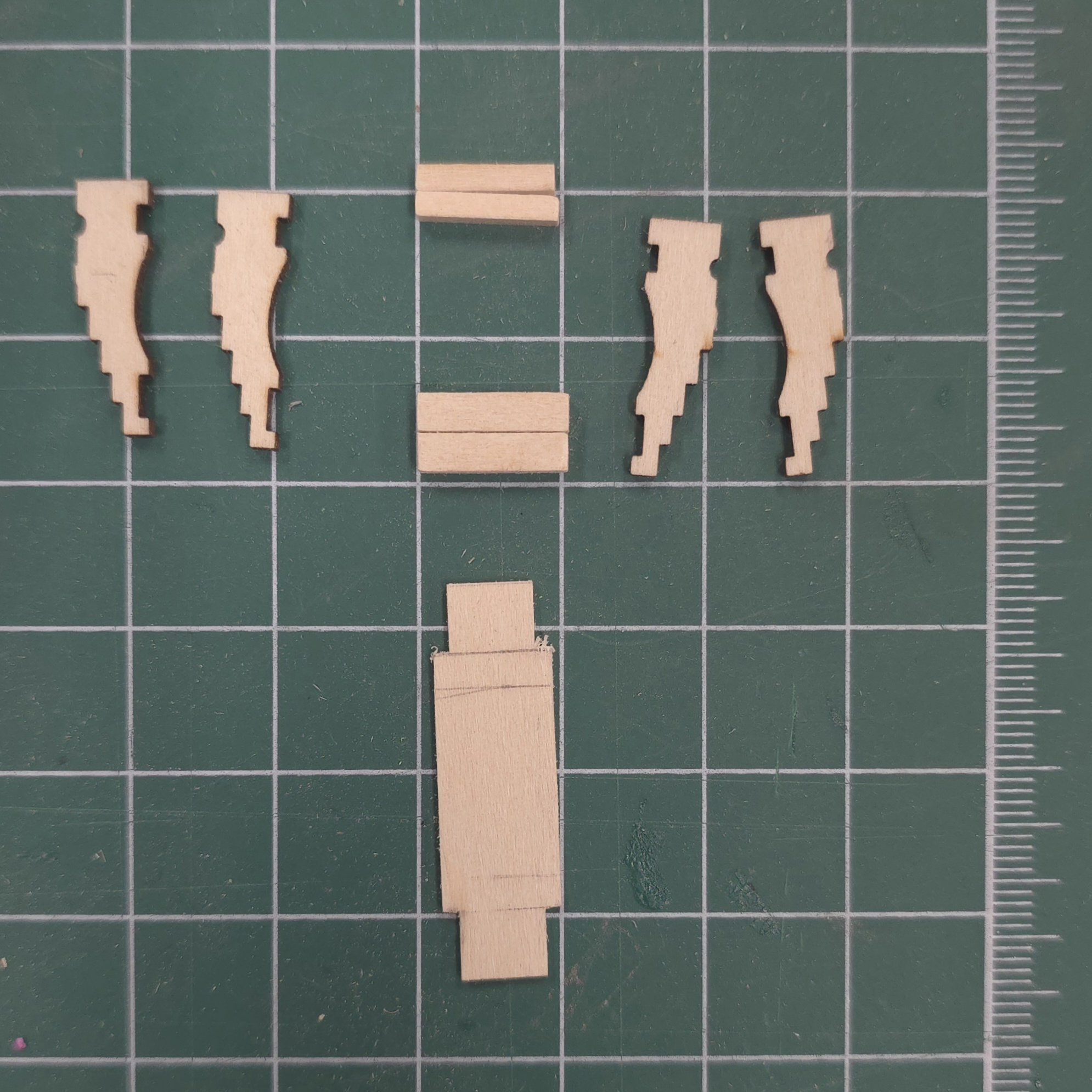

I had hoped to finish the long guns for the spar deck today. But I grow weary. I don't think much needs to be explained below, except that I did take a slight deviation from the Hunt practicum in that I did not use a brass rod to support the stool bed. I figured that it would hardly be seen and add too much complexity to the construction. I took an easier route that didn't risk poking holes in the carriage sides.
(Boy, it would have been fun to be able to jump from my previous post to the finished Constitution, like Gregg just did with the Santa Maria. Sadly I'm not quite as productive as he.  Once again Gregg, congratulations on a beautiful build.)

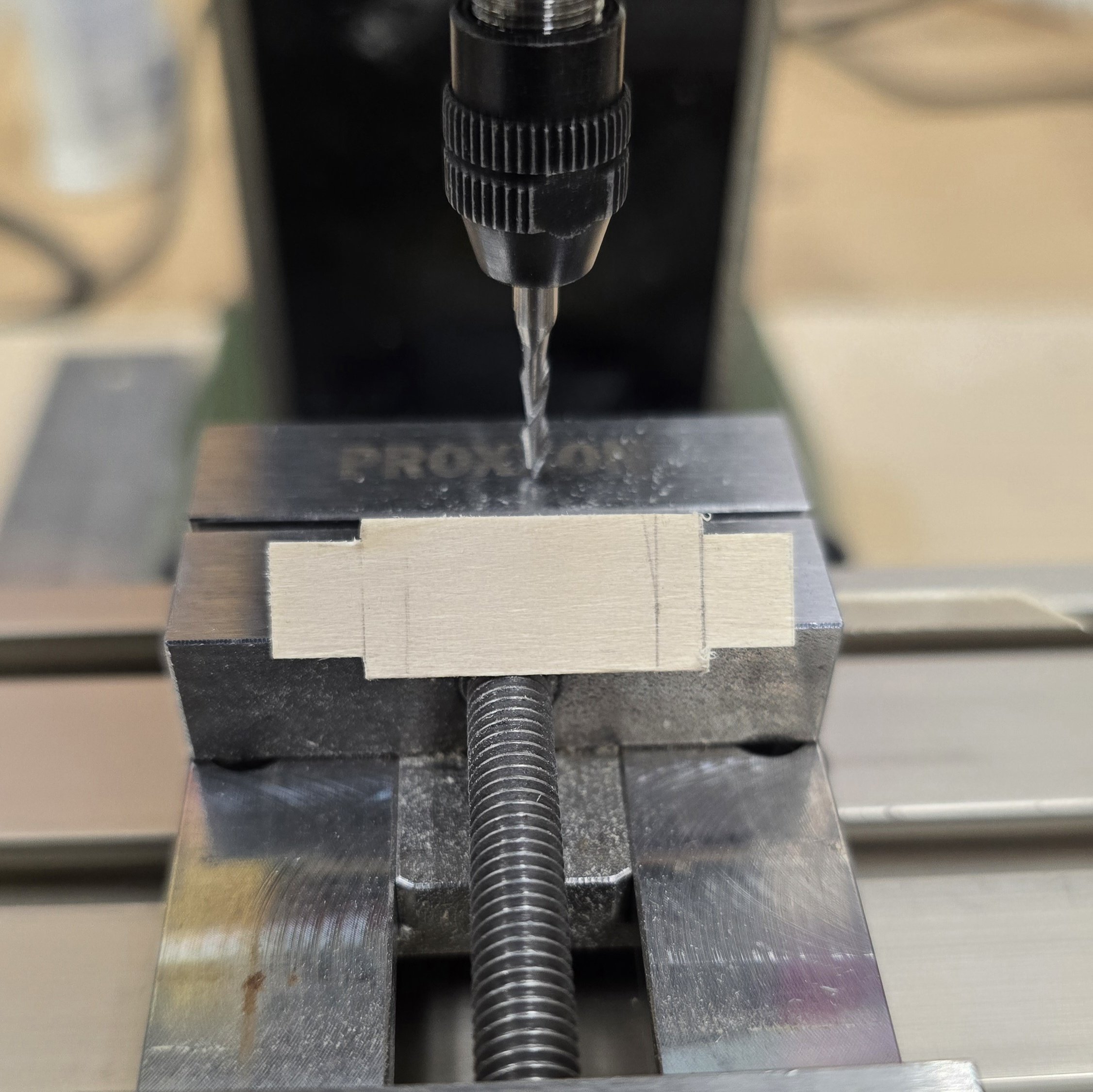

As far as the wheels are concerned, I'm going to take a simple approach by cutting dowels of the proper diameters and simply glue these to the ends of the axles.
The quoins should be a piece of cake, since I think I still have some leftover material from when I built the carronades.
Typos, typos, typos. Speech to text is not the best tool to use for these posts.
Wow, those carriages look sharp, Peter.  Nice work!
