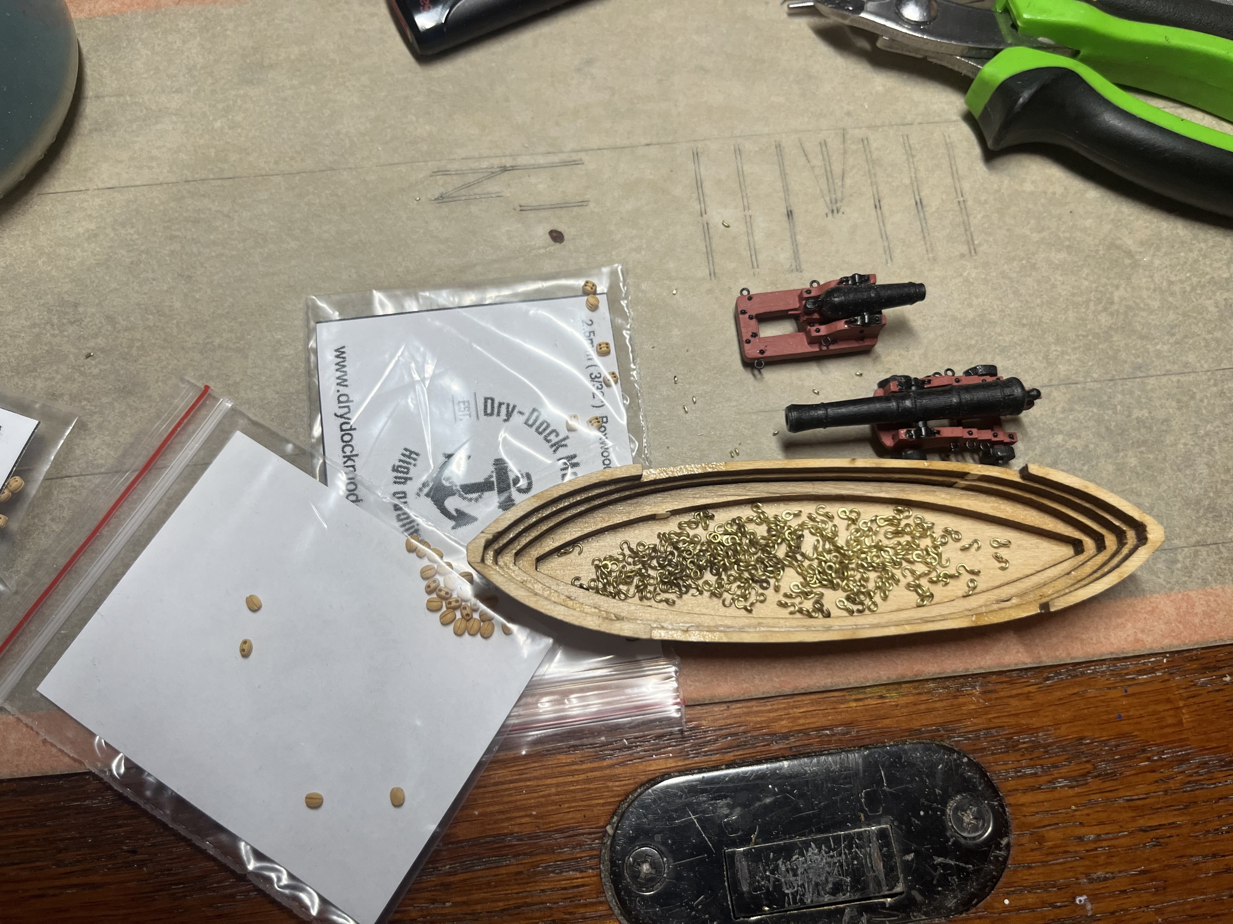

 You won't see the blocks installed anytime soon, but here are the Syren Ship Model Company 1/8" double and single blocks (left) compared to their equivalent(?) versions as supplied by Model Shipways (right).  Yes, I'm sure those are the correct ones from Model Shipways. This was verified by the count of the blocks compared to the parts list that came with the kit.
Attaching the hooks to the Syren blocks is going to be an interesting proposition.  Pin vice and drill baby drill?  Looks like it will work.  I opened up the eye of an eye bolt and trimmed the bolt to fit the hole I drilled in the block. Only 79 more of these to go for the tackle.
I had hoped to be able to wrap one of the Jack stays completely around the block but there's not enough material there to cover the circumference.  And frankly, experimentation has shown that it's too difficult to do anyway.

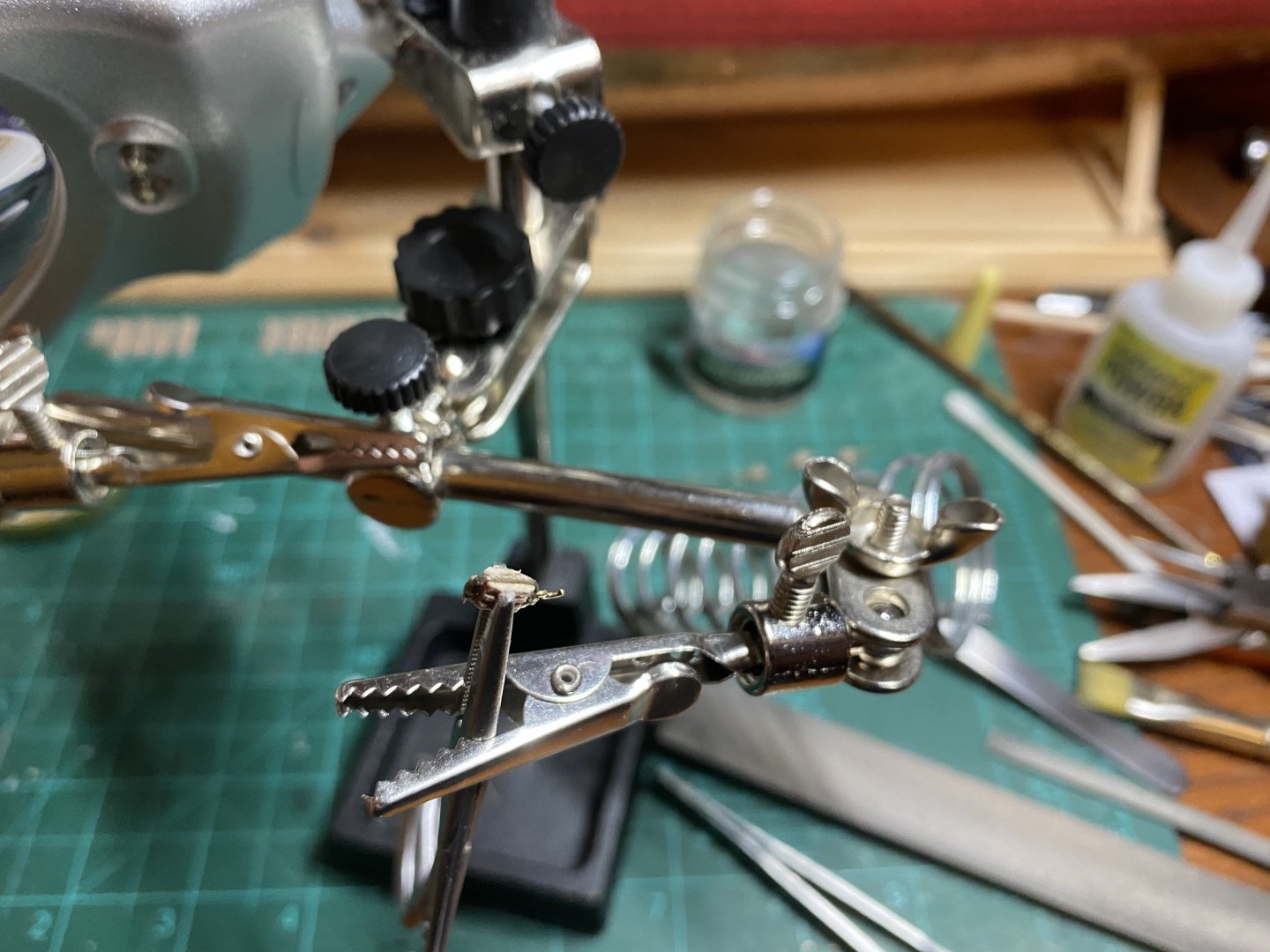

I found that I needed to hold my hemostats with my soldering stand to be able to tie on my hooks to my blocks.IMG_1317.thumb.jpeg.d1cd65450cfd5702a9011180e1378aca.jpeg I also ended up making all of my own hooks for the blocks.IMG_3795.thumb.jpeg.6d623b9904c58c65320c5586adff3efb.jpeg
I need to find some slightly "weaker" hemostats, as many of the smaller blocks on my Santa Maria rigging were getting crushed by the hemostat I have, so I was just using the clips on my helping hand to hold the blocks while stropping.
I’m sorry. I forgot to say that the hemostats were being held closed by the spring clips on the soldering stand.

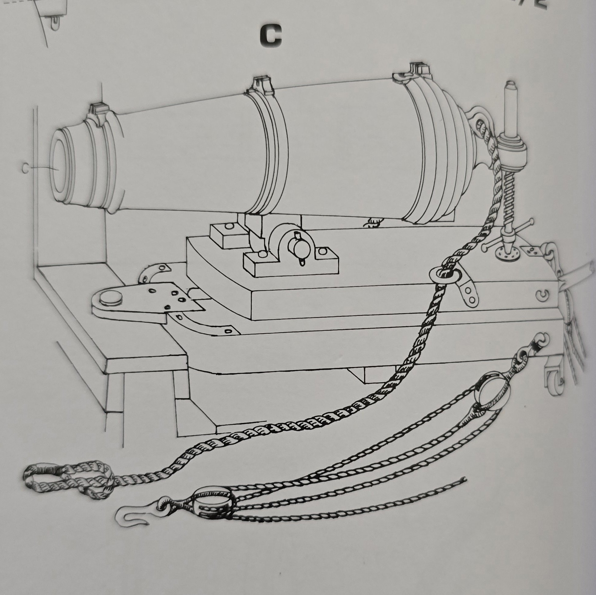

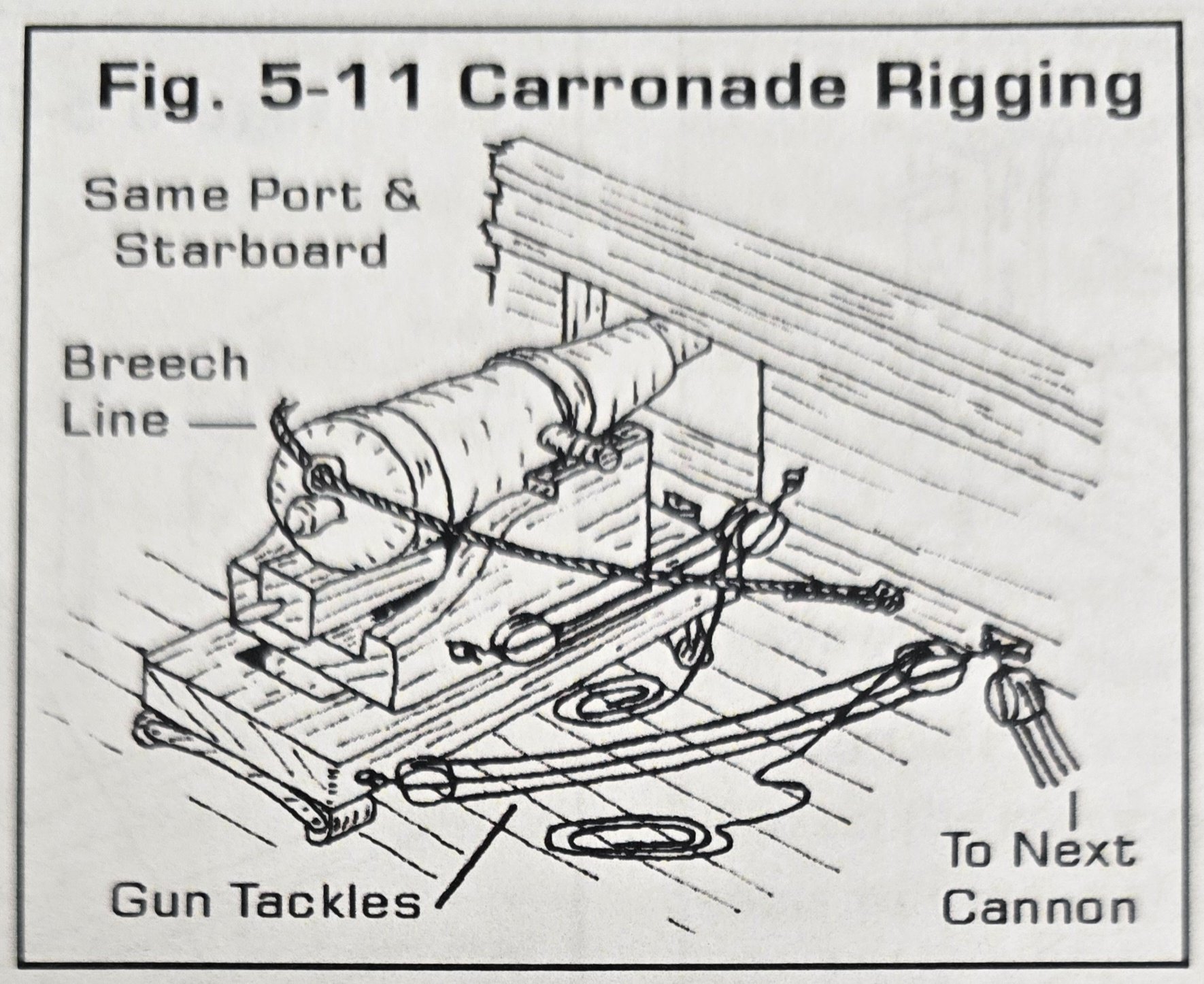

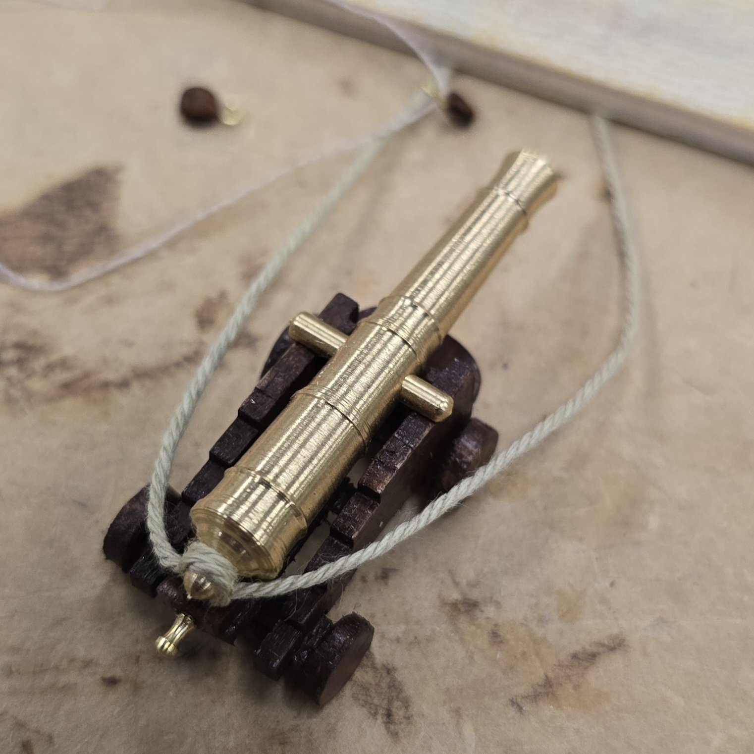

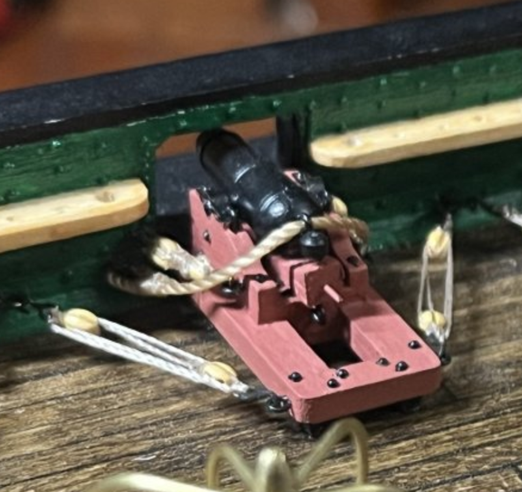

This all comes up under the rubric of rigging block and tackle for the cannons and carronades.  Somehow, I would have thought that the loose end would be wrapped around a belaying pin somewhere.  Evidently not.  Here are some methods I've seen employed.  Not even the Constitution is consistent in this.  Why the difference between forward and aft rigging?
Other modelers:
XKEN
Unegawahya
Mustafa

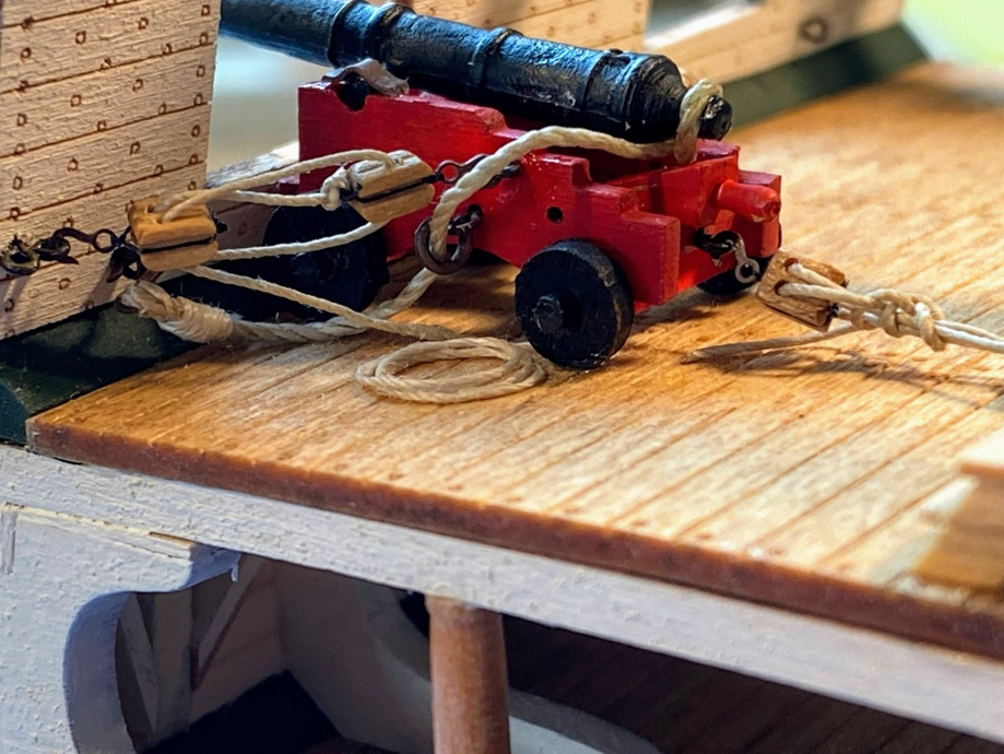

and this.  Sorry, I forgot whose build I saw this in.  Obviously someone working on the cross section.
Jon, I'm sure you're going to chime in with the "correct" rigging diagrams (at least I'm hoping you will 😁)
So you didn't engage the lock on the hemostat, letting the spring clip do the actual clamping, yes?
That is correct! I’ve had great success this way.

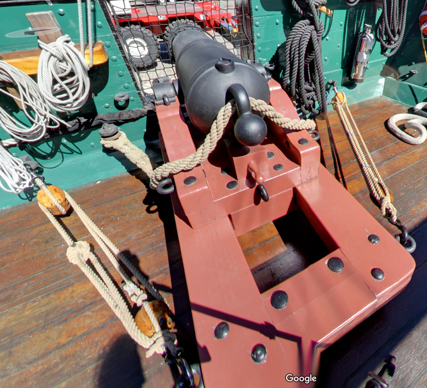

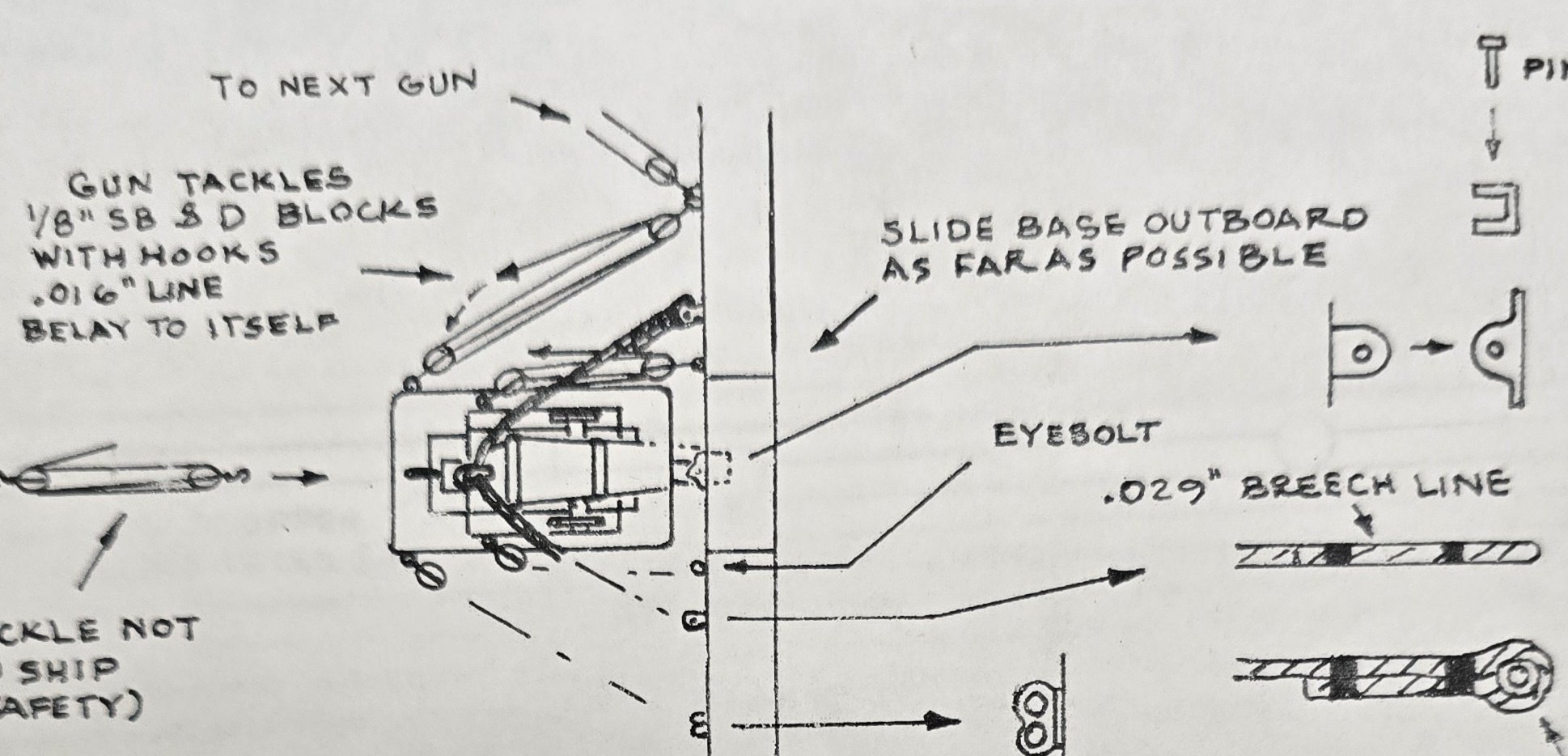

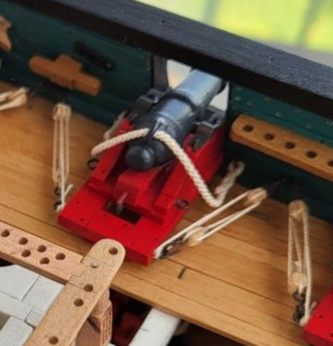

First off, I'm not nautical expert, have no military experience (except army ROTC), let alone any naval experience. What I know is from model builders I've followed on various sites and books. So my two cents: As near as I understand it, if the guns are rigged for sea voyage but not battle, the tackle and guns are rigged fast so as to not move or be in the way of the sailor's activities, the gun is pulled up to the bulwark and the gun port is closed and the loose ends of tackle are made snug against the guns. When the guns ae on display for the public or inspection, the guns are pulled through the open gun ports and the loose rope may be coiled "pretty" or remain snug to the gun. If the guns are posed "ready for battle," everything is loose so the gun can recoil freely and the tackle can be manned for loading and pulling back through the gun port. In other words, it all depends on how you want your model to look.
Jon

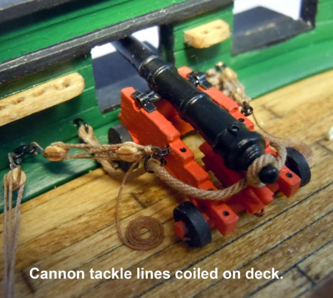

That looks like your standard ready for battle setup: the gun is pull through the gun port, the tackle is loose, and not coiled.
Jon
It looks I may(?) be shopping for aftermarket cordage.

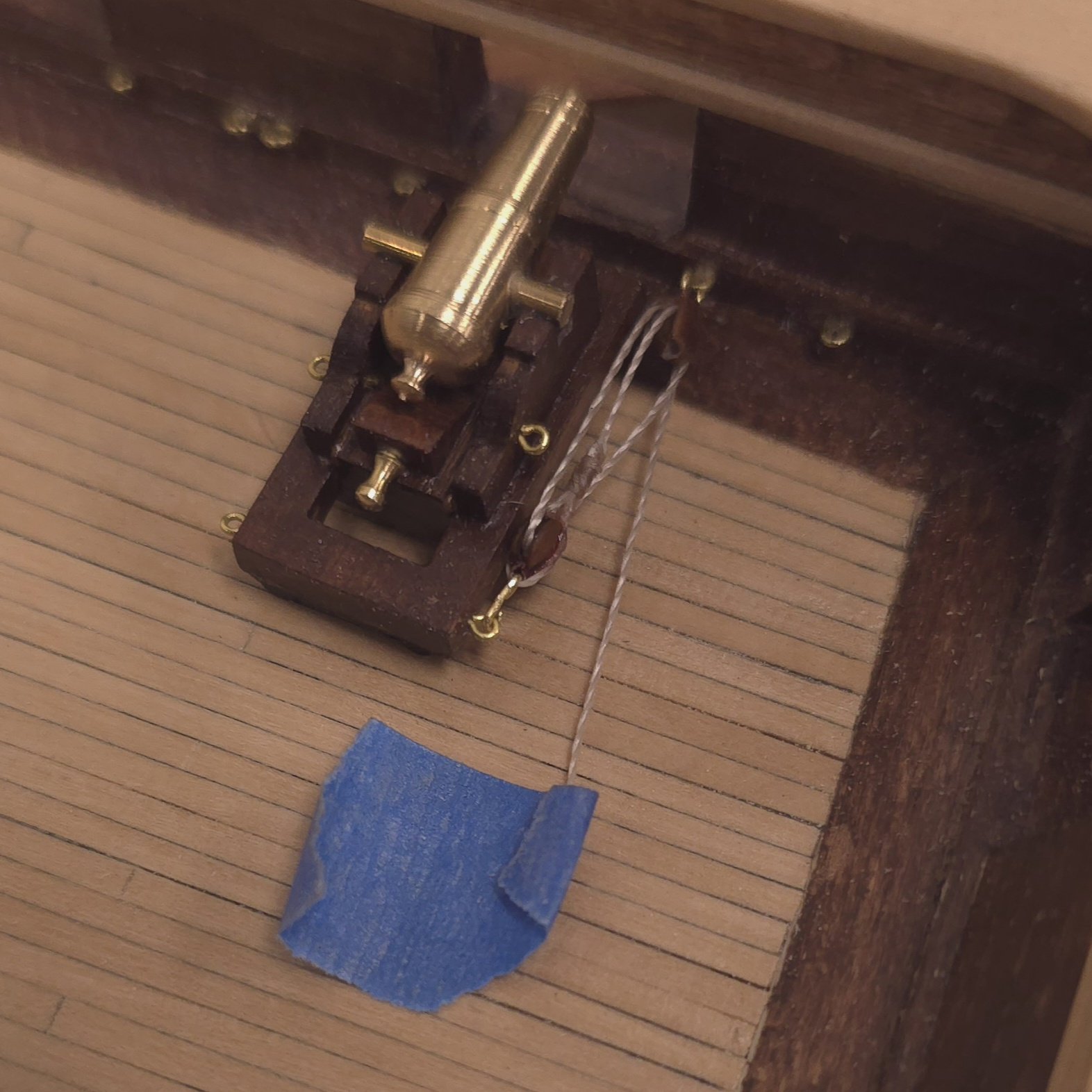

The plans call for .016 in (.41 mm) line for the tackle and .029 in (.74 mm) for the breaching rope. The kit provides .008 in (.20 mm) and .021 in (.53 mm) tan line.  The only other tan thread that comes with the kit is so thin it must be intended to be used for seizing.
For grins, I tried the thicker line on for size for the breaching rope.  Unsatisfactory..
However, the Constructo kit comes with what measures to be roughly the correct sizes. No sizes are actually provided, so I'm going with what my Vernier caliper delivers by way of measurement. Here is the same cannon with breaching rope from the Constructo kit. It's a small thing, but I like the color  and finish better of the material that came with the MS kit.
Funny, in the photos, the difference doesn't appear to be all that great. I guess I'll order some properly sized cordage from the vendor that Gregg suggested and compare.

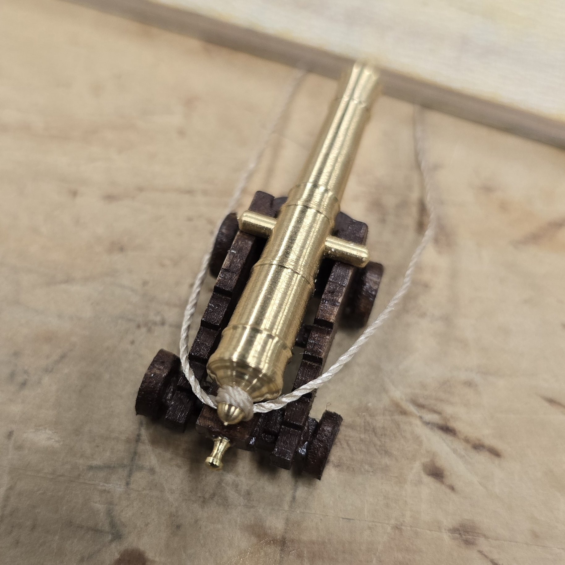

Jon
For what it's worth, because I failed to note the Hunt misdirection(?) for the waterway early on, my carronades will NOT be pulled through the gunports. I will therefore be coiling the tackle, or doing whatever it is they're doing with the Constitution today. See above.

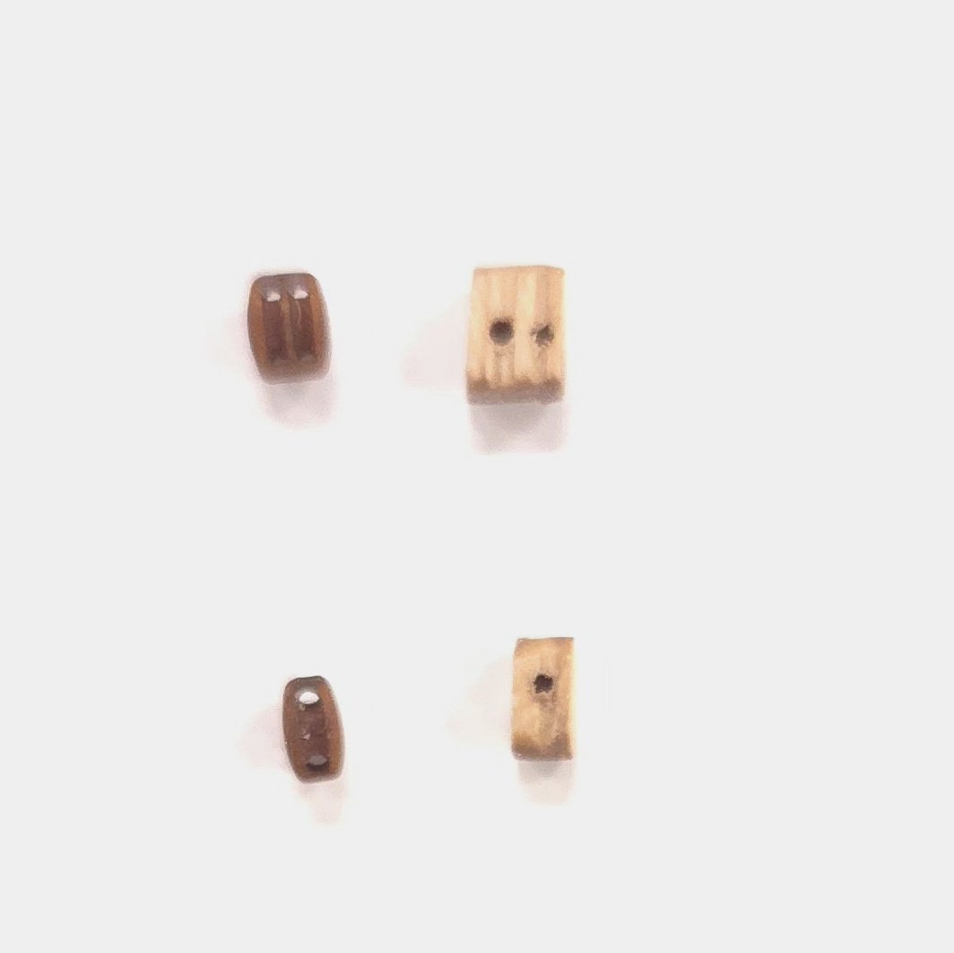

As it turns out, it may be that the holes in the syren blocks are so small that the .008" (.20mm) line that came with the kit is all that will fit through.
Before I go much further, I order some .25mm line to see if that works.
In terms of looks and scale, I might get by with the MS .20mm.
Either way, this is going to take a LONG time..

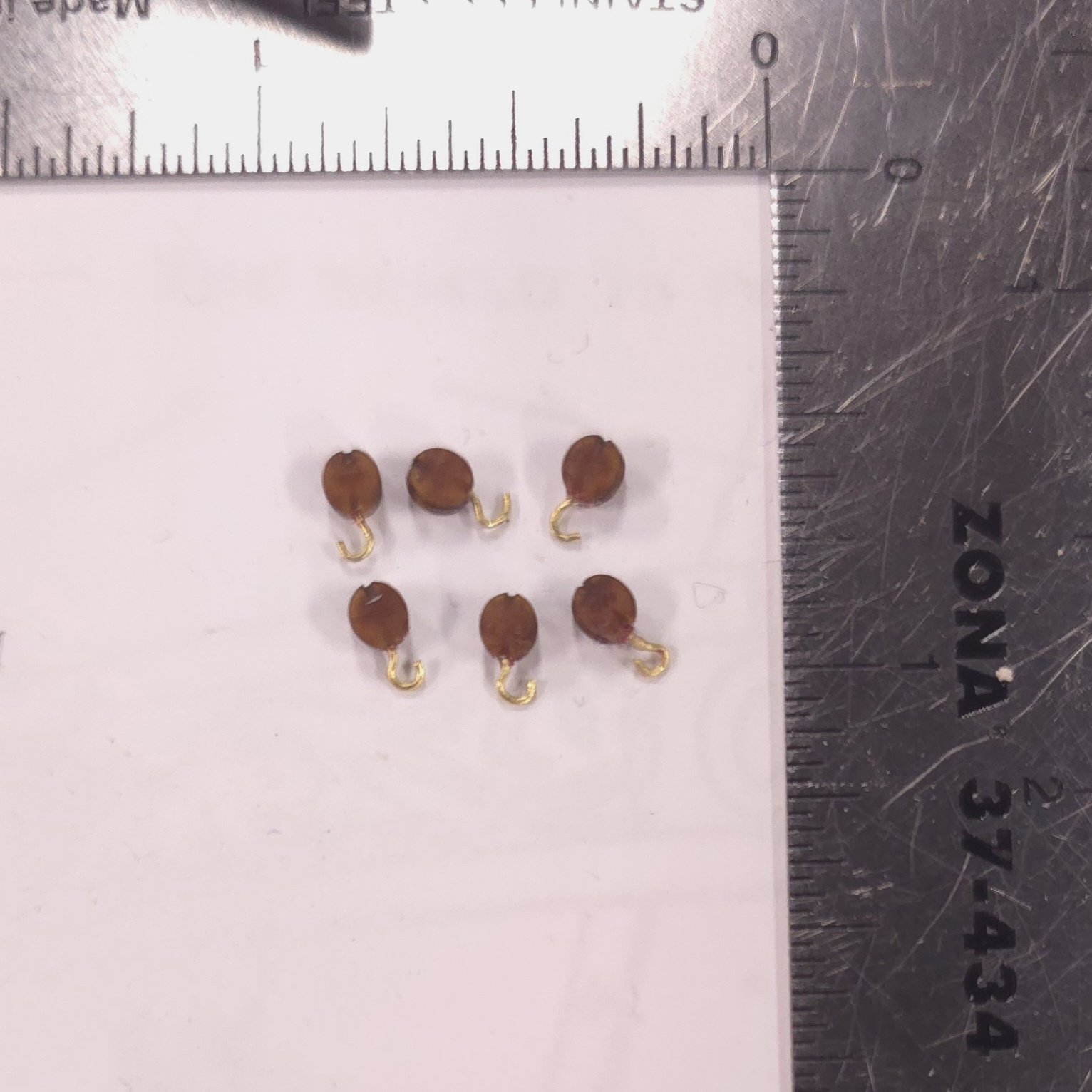

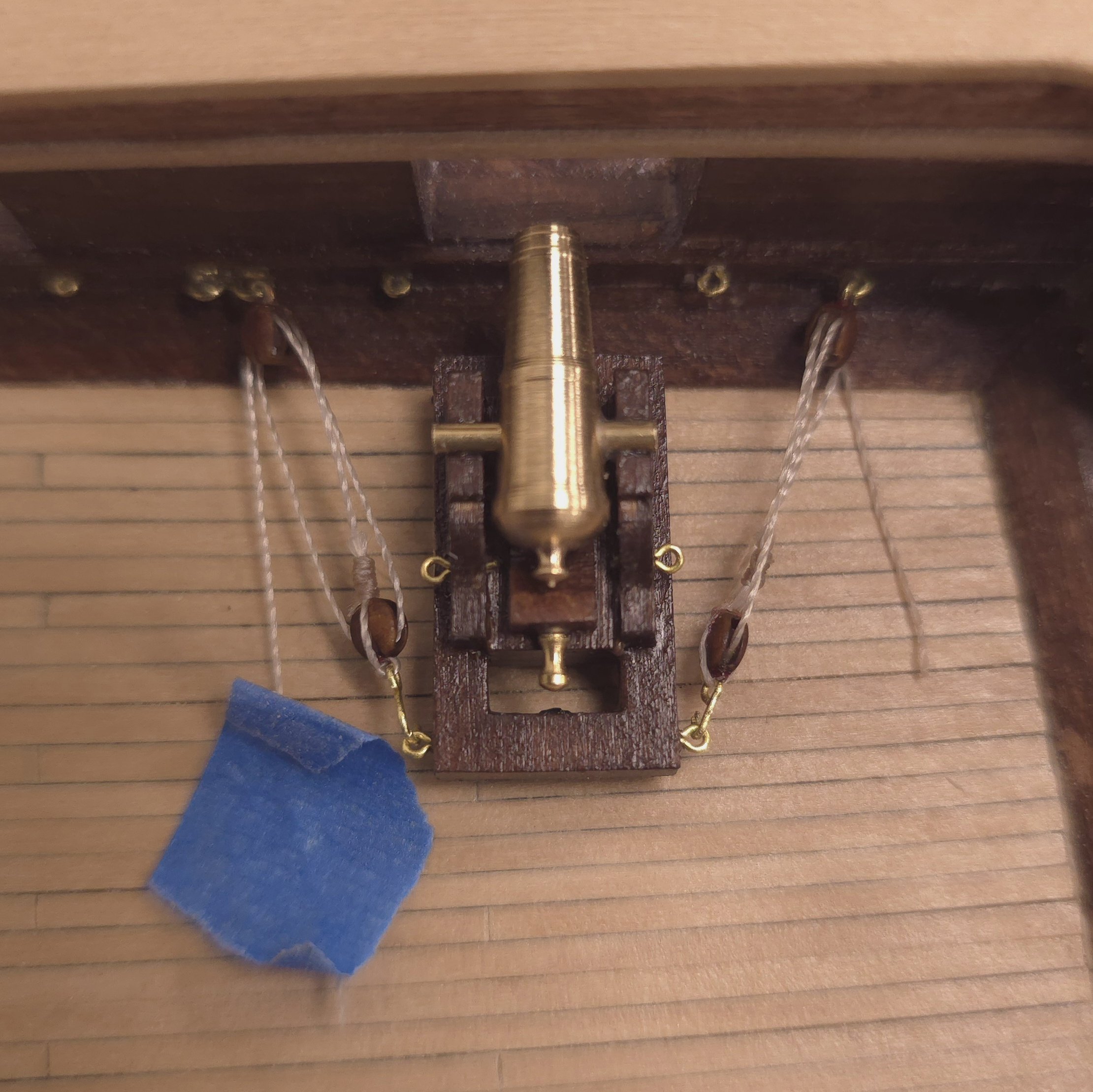

I think I've figured out the processes of making hooks and attaching them to the blocks.
Next up, figure out how to rig the breaching rope.  Of all the builds that I have studied, I like the looks of Mustafa's the best.
I can't decide if I like how skinny these tackles look. I should probably hold off until the order of new materials arrives before I go into mass production. In the short-term, I'll be attaching hooks to the double blocks, which requires no rope at all.  Just a lot of patience. 🙄
Edited by Der Alte Rentner

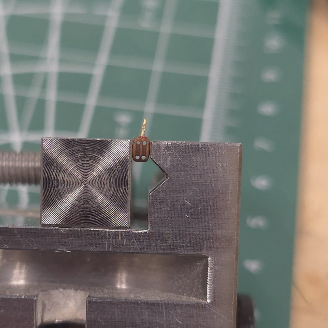

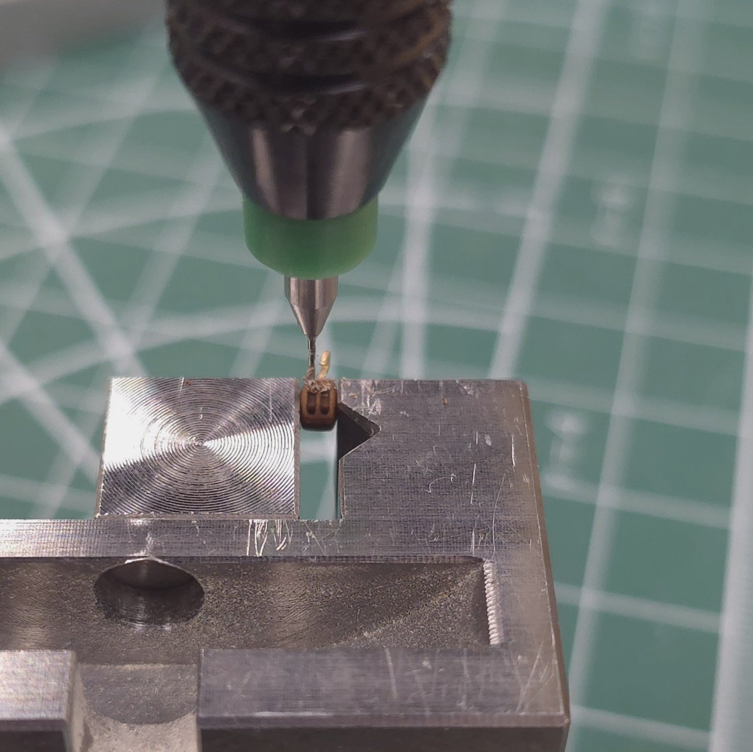

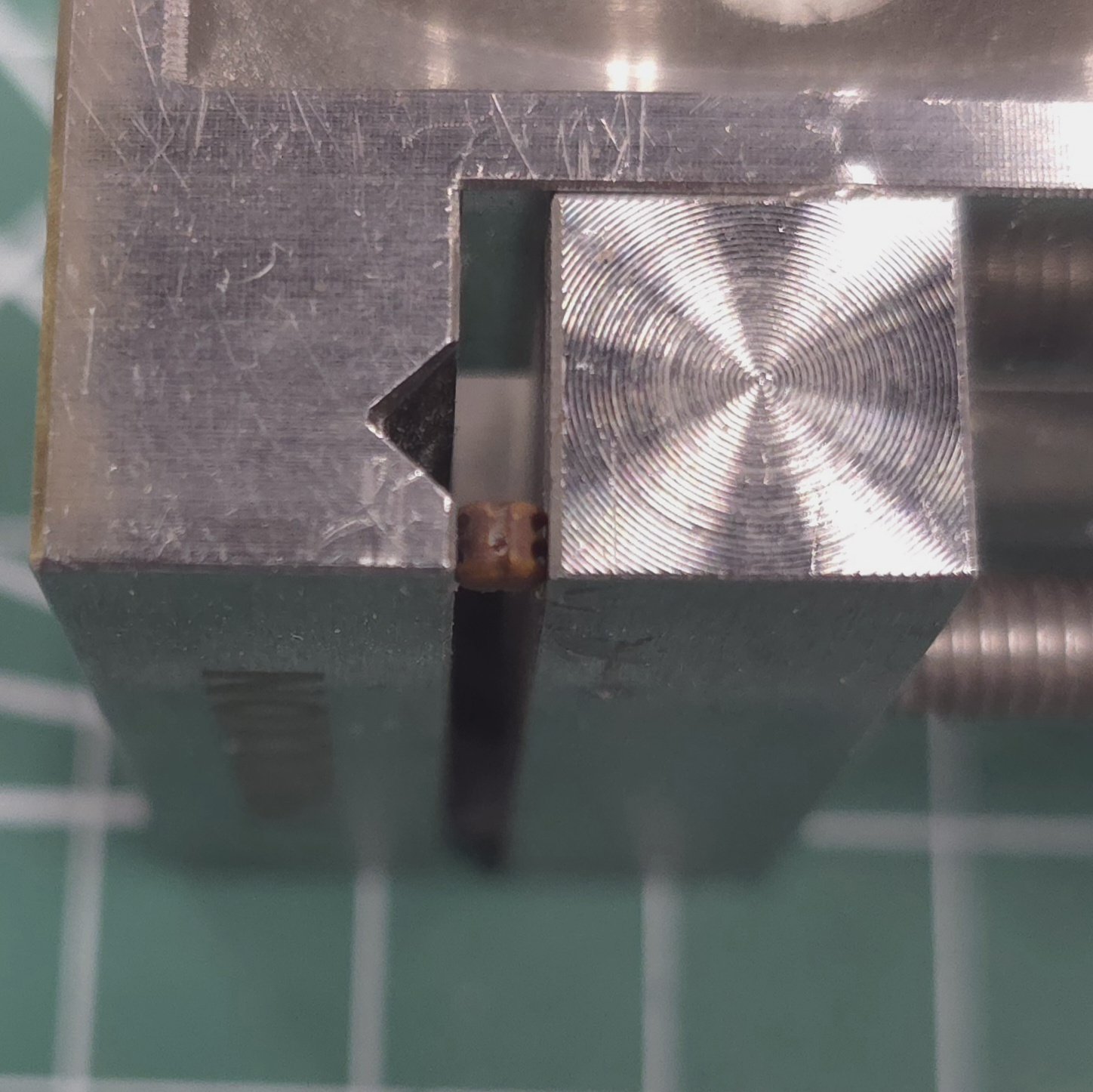

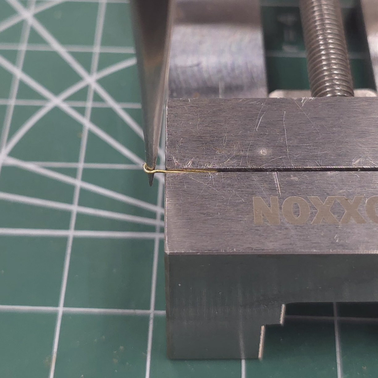

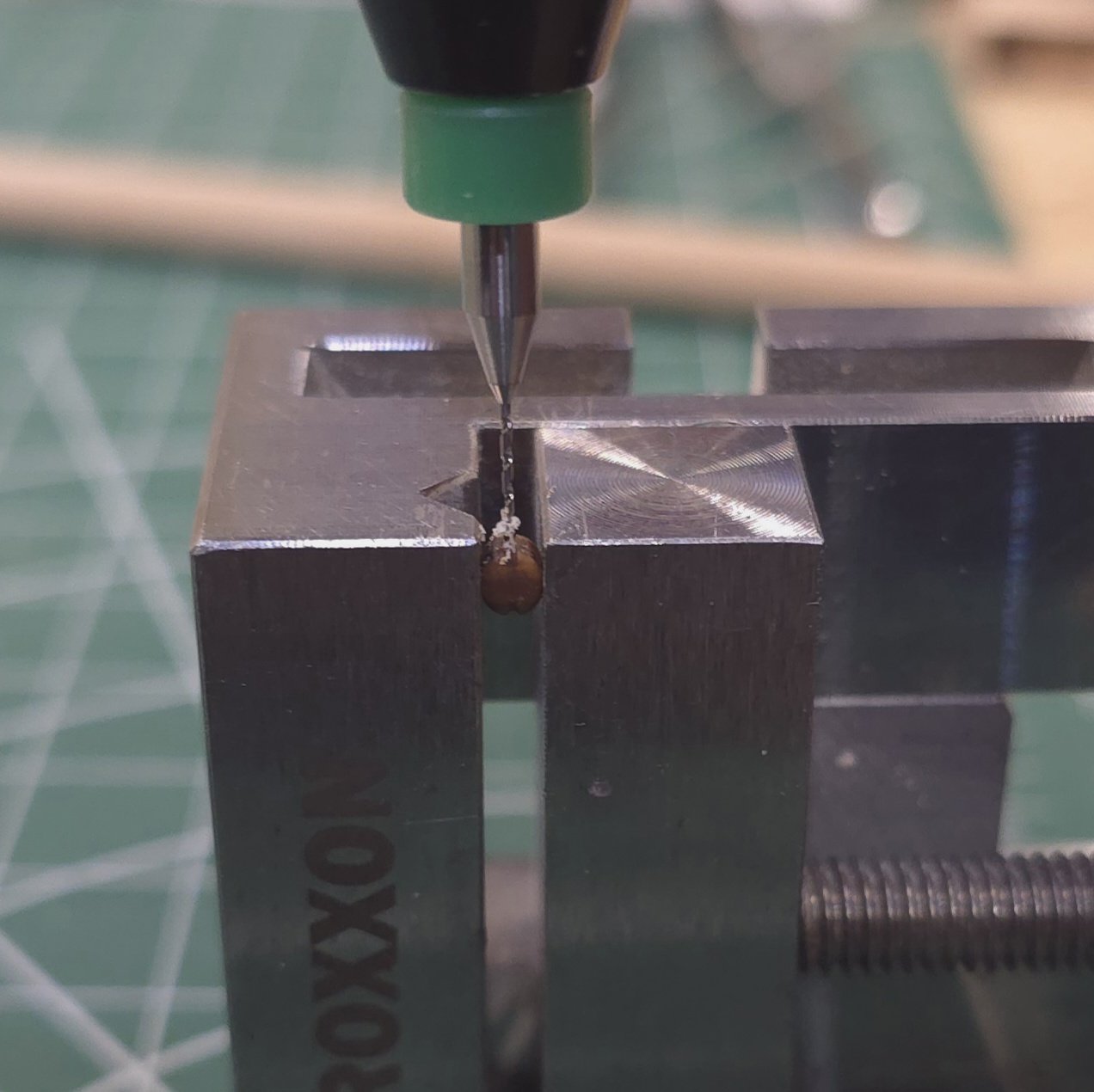

It's funny that you ask.  I couldn't stay up long enough last night to watch the overtime of Edmonton Florida Stanley Cup game, so I decided to watch the rest of the game at my Shipyard while doing some busy work. The busy work is fashioning the hooks and double blocks.

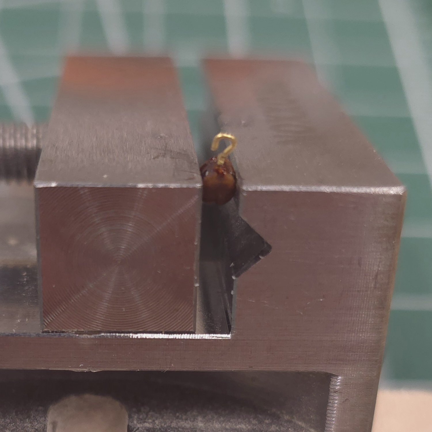

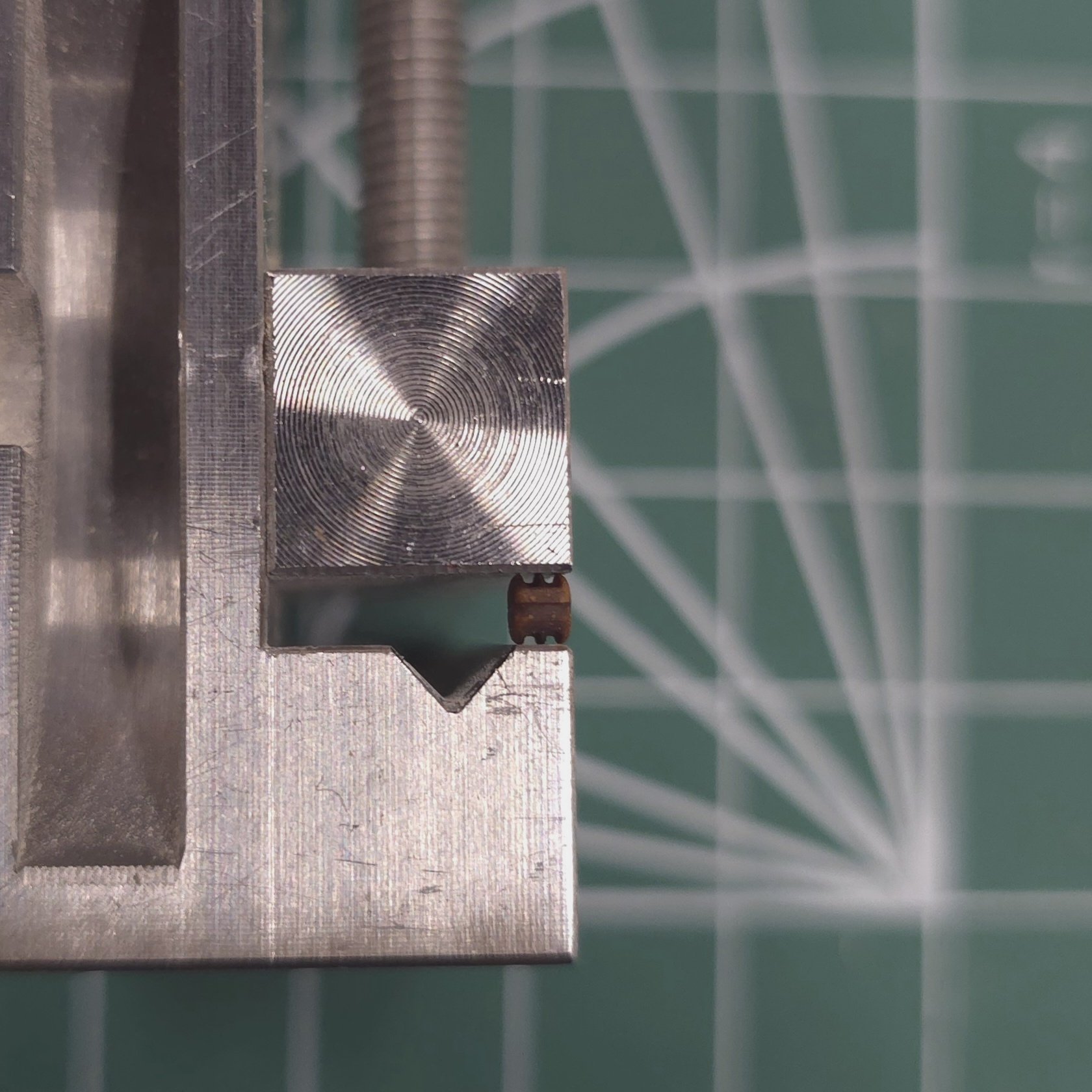

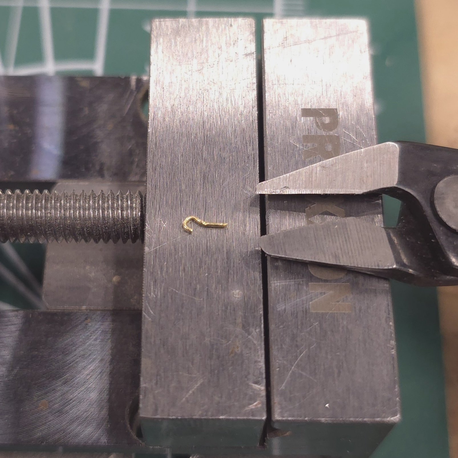

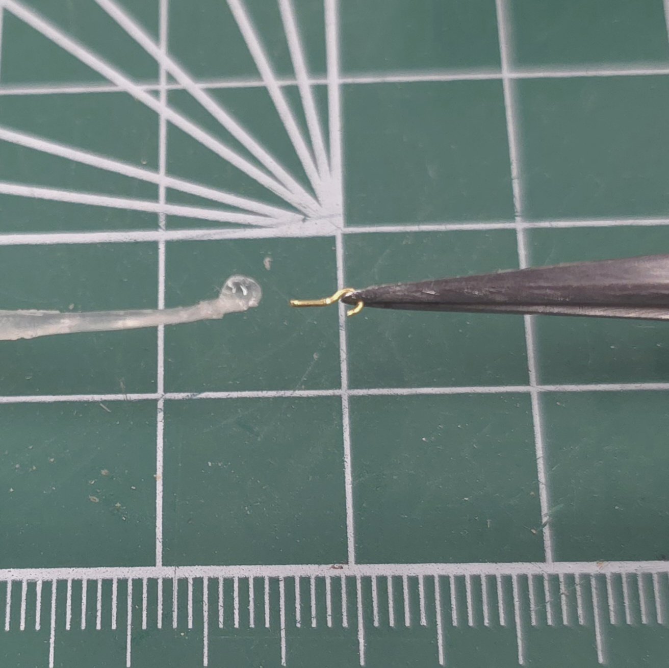

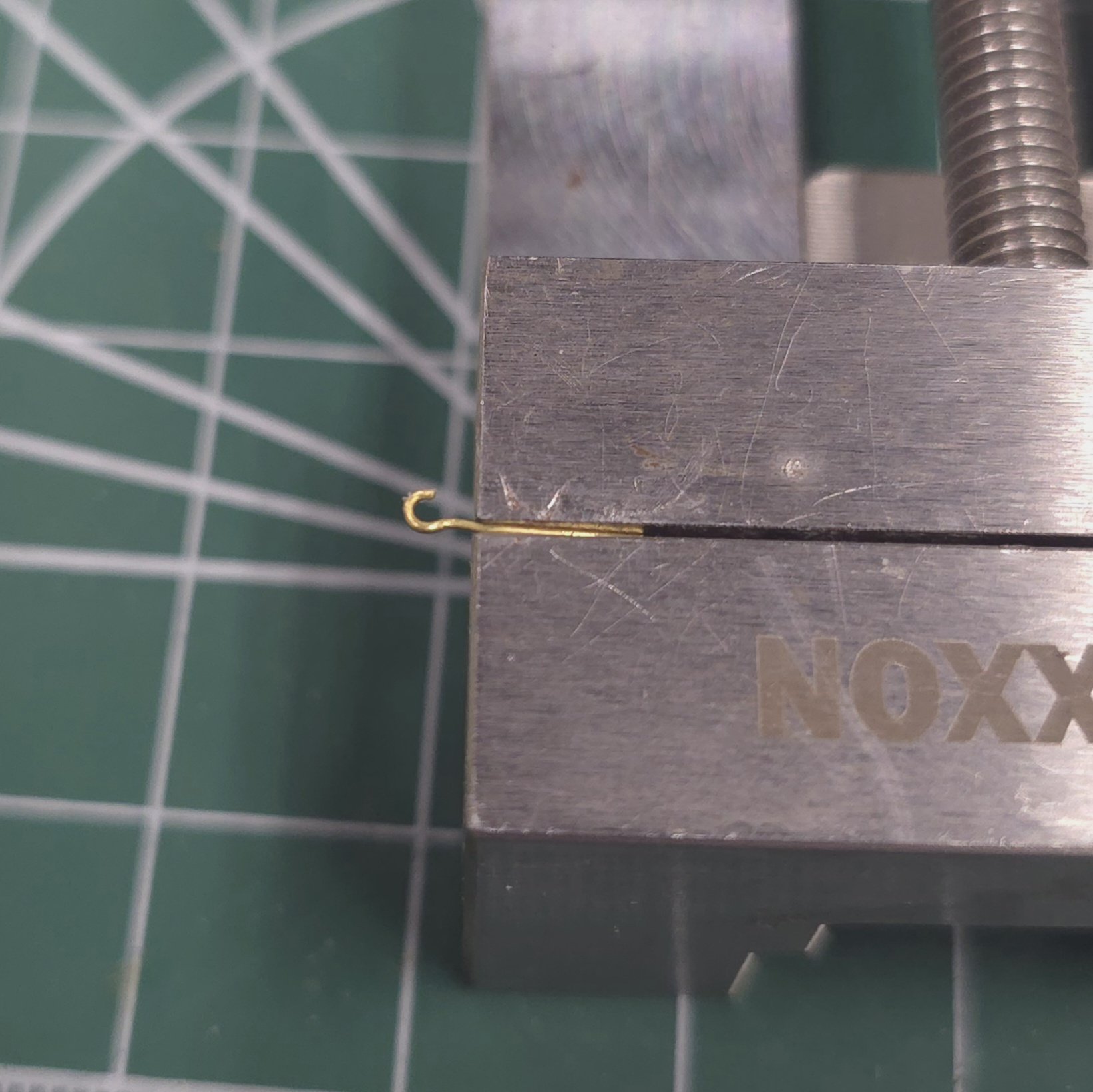

The steps follow:
Clamp the block in a sturdy vice.
Do the absolute best you can to center the drill, which in this case a .48 mm drill, on the end of the block.  No, I am not using the Proxxon mill to drill the hole. I'm using a pin vise.
Open up the hole in the standard kit supplied eye bolt.
Trim the bolt.
Glue the hook into the block.
And now for the tricky bit. If you didn't Center the hook well enough, you won't be able to get the thread through the holes nearest the hook. Even if you do center it, you will need to clean out the holes. So, I used the same drill and very carefully reamed out those two holes.
Ta da...
Note: I tried using some .30 mm brass wire wrapped around the block then twisting the ends to fashion a hook, sort of like this:
But the brass kept breaking.
I've made a grand total of four of these so far, and only screwed up once, where I didn't get the drill centered.
For what it's worth, had I used the blocks that came with the kit, this would have been a piece of cake. Given that they are oversized and the holes for the line are in the center of the blocks not at the ends like with these from Syren.  Note to Syren, perhaps you could offer up blocks with one pre-drilled hole?

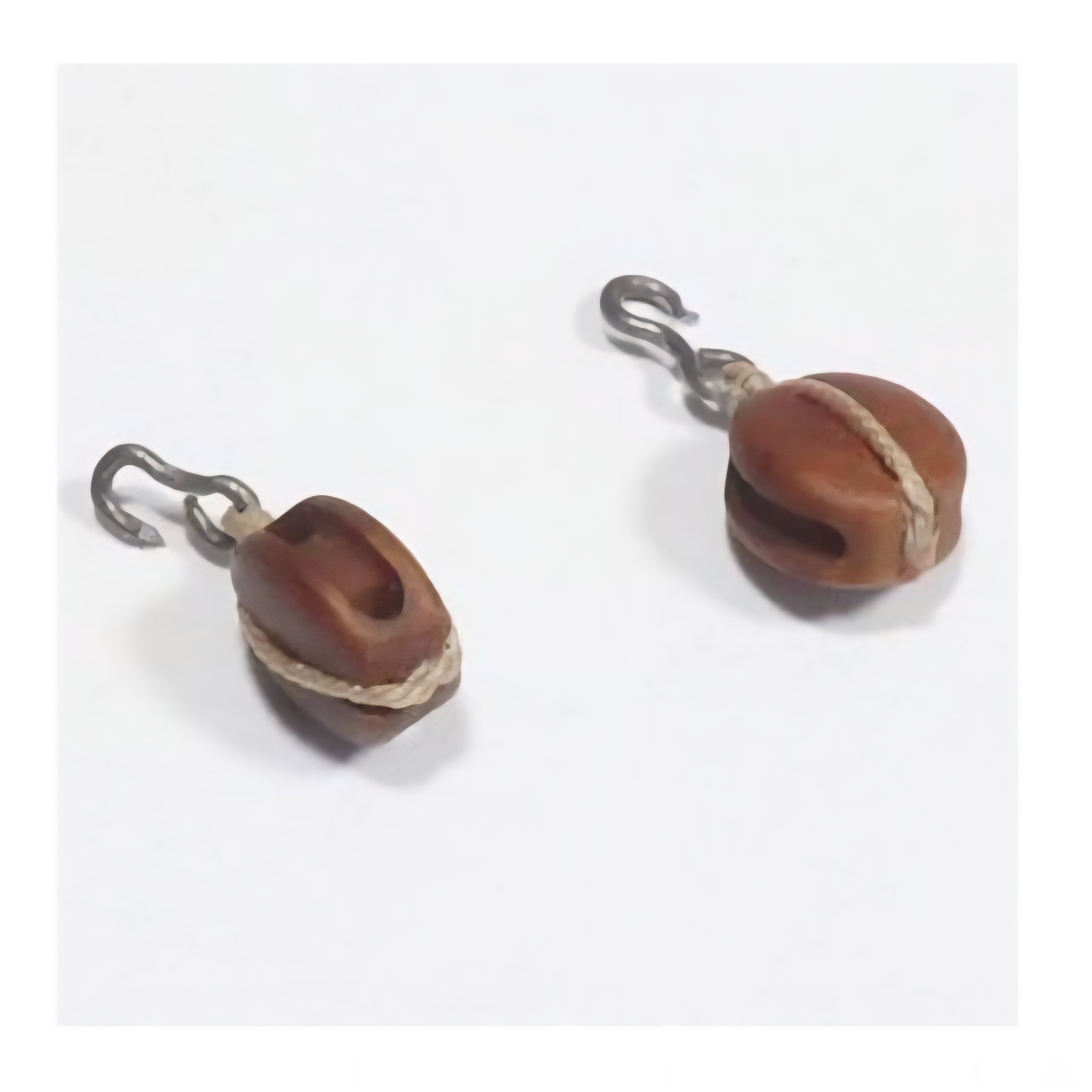

Thanks for the explanation Peter, I liked your method. I am sharing my own method for the friends who follow. So it will be a second alternative for them. I pass the rope through the hole of the hook, wrap it around the block and tie a simple knot. I put a small drop of CA on the knot and cut the excess of the knot after it dries. Unless you look very carefully, it is almost impossible to see these knots on the model with the naked eye. This only  takes me 1-2 minutes.
Edited by mtbediz
5 hours ago, mtbediz said:
.. I pass the rope through the hole of the hook, wrap it around the block and tie a simple knot.
That sounds SO easy.  But I have found it quite difficult to tie that knot and keep the rope in the channel on the rim of the block.
That may have something to do with the small size, or simply the nature of the Syren blocks.  I am experimenting with different clamping techniques to try to tie the hook to the block today. I will post my results when I've found an effective and relatively easy solution.

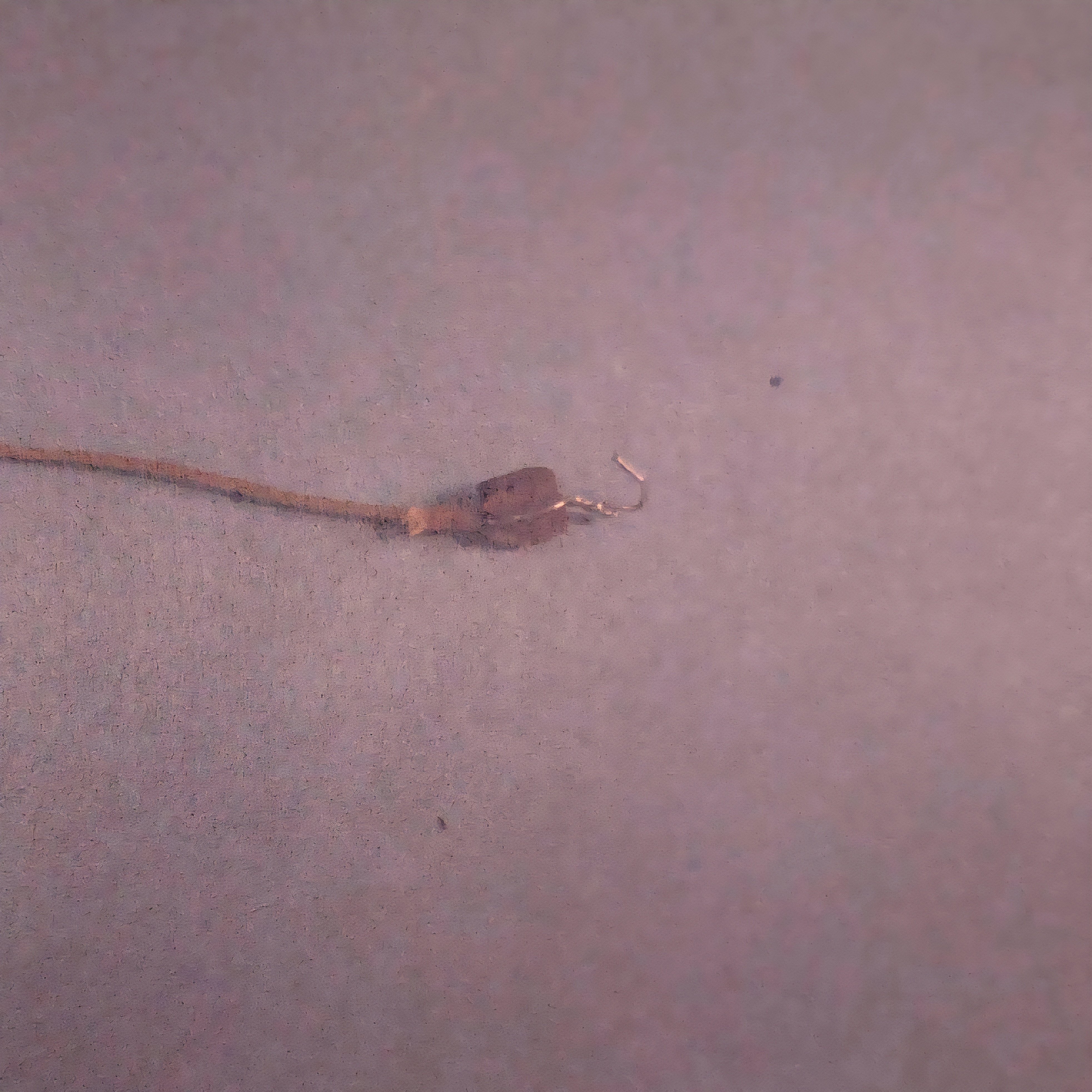

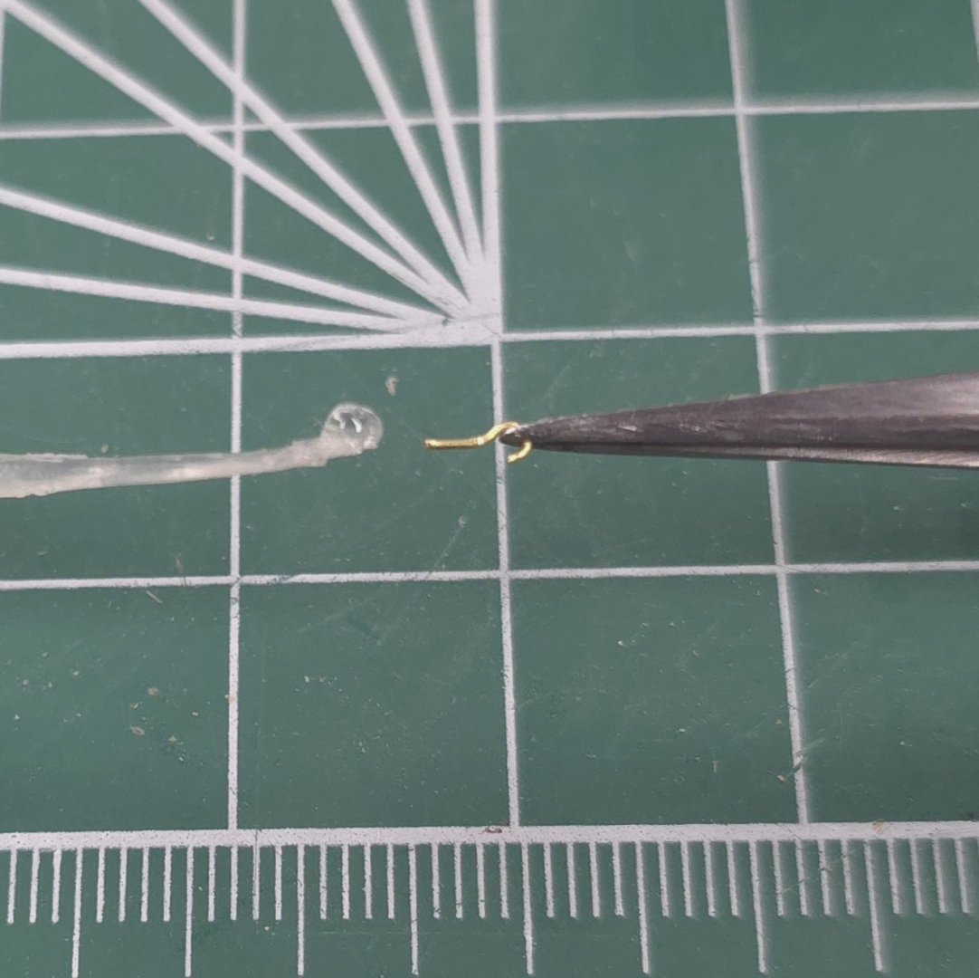

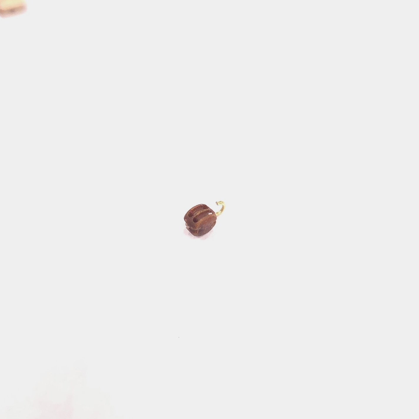

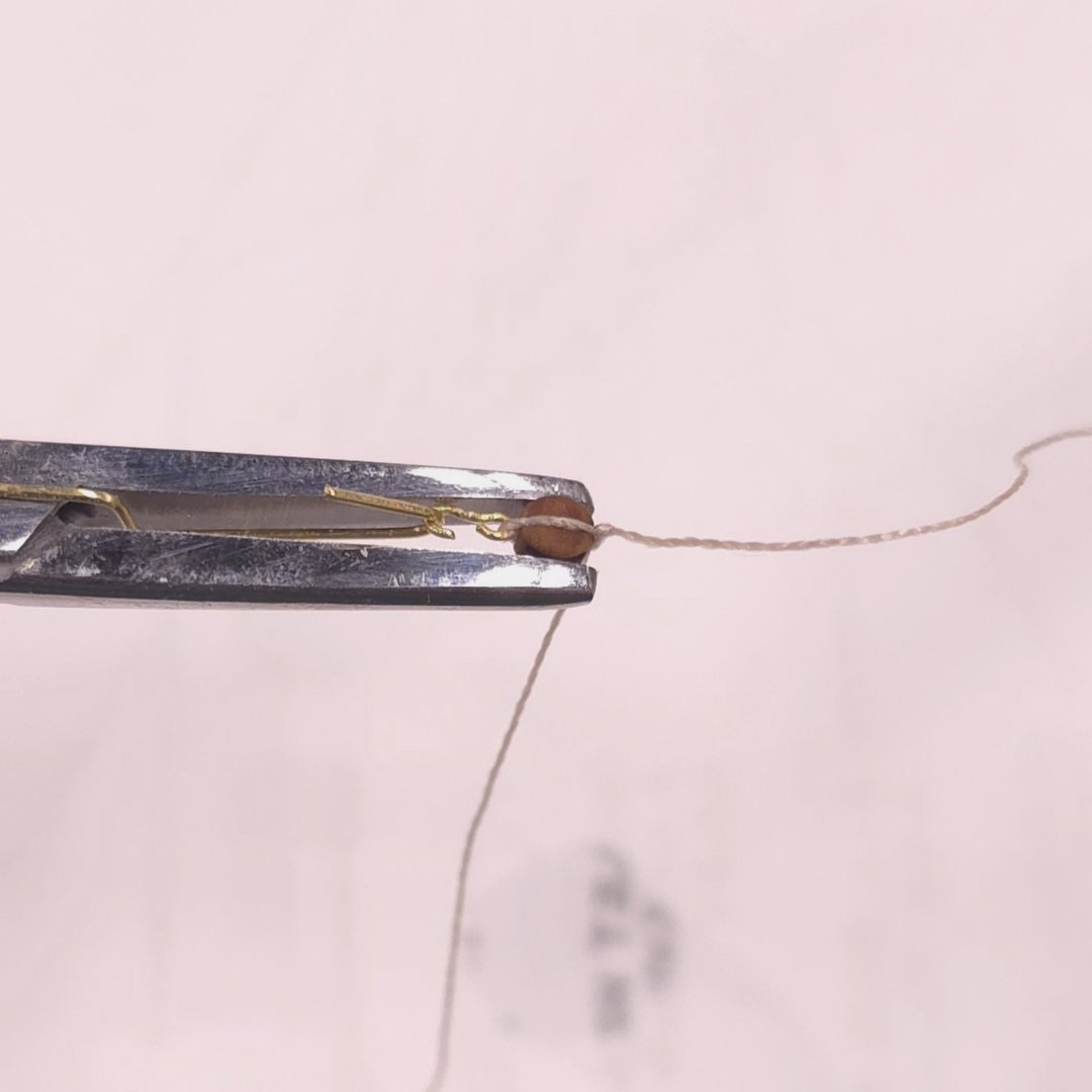

Adopting Mustafa's method and adding Gregg's three hands, I have settled on a procedure that goes fairly quickly. Sadly not as fast as 2 minutes per block, but a lot quicker than what I was doing by drilling the holes before.
I loop the rope once around the eye in the eye bolt and add a small drop of CA to keep the rope from moving in the eye.
The only way I can get the knot to work was to adopt Hunt's technique of keeping the hook on the left of the block, for which I made a little rigging rig. (I won't bother showing pictures of the two other methods that were only semi-successful.)
Tying the knot.
After this, I use a thin brass rod to drop a little AC at both ends of the block. To keep everything from unraveling.
Finished product.

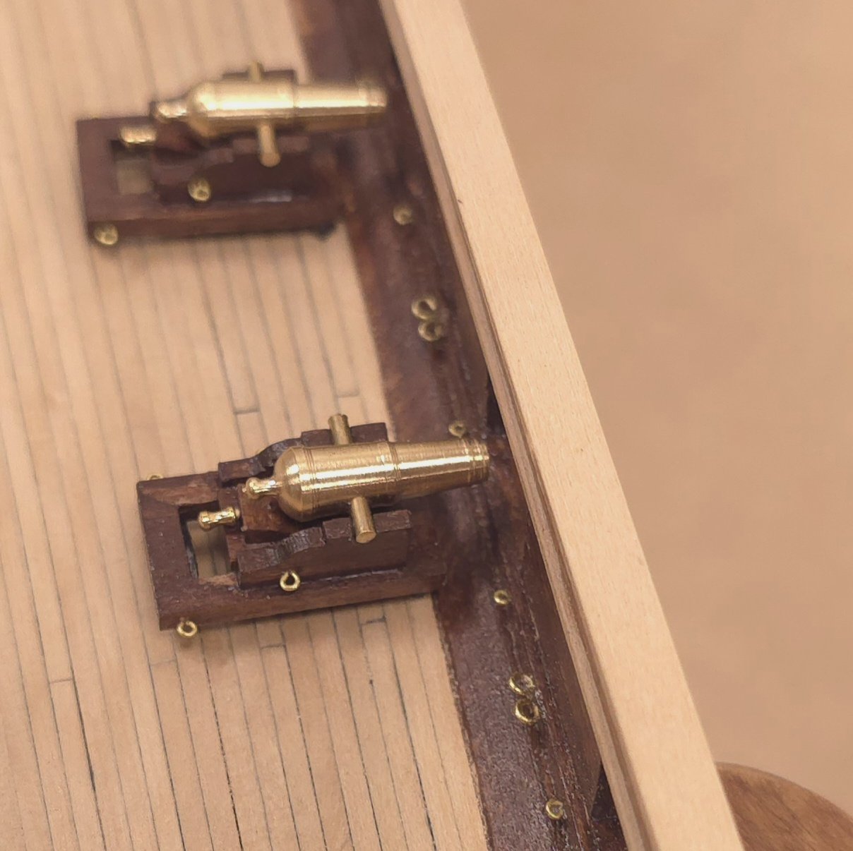

On 5/20/2025 at 10:44 AM, Der Alte Rentner said:
Exactly what I did, Thomas.
In the end, the planking strengthened the entire structure.  All's well that ends well. Starboard side done.
Now I get to relive the entire adventure on the port side. Oh joy! 😁
P.S. Once again, a photo shows me something I didn't see with my naked eyes. I have to redrill the Gammon holes, preferably before I plank the port side. And yes, Mustafa, rope gammoning is correct. I've seen several references to it online and at this website.
Finally, before anyone asks, I have no idea why I put dowels in those holes in the stem..
