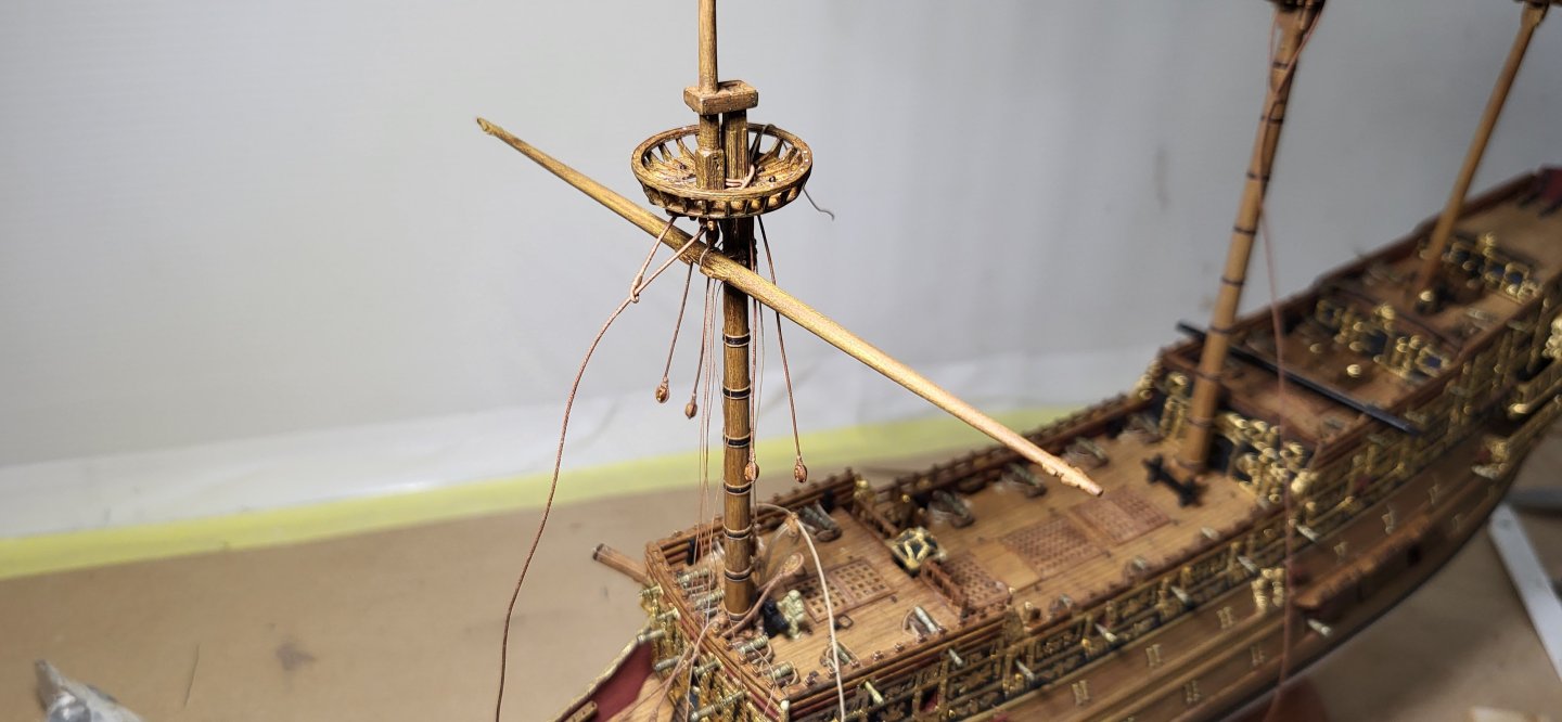

I was hoping to use the kit supplied fore course yard, but it is far too short as you can see, new one measures out to approximately 6-1/8", at scale is 86', mocking up the top rope I forgot early on when rigging the hallaird for the tie, the deception looks pretty good, up next I'll be fabricating the parral.
Michael D.
