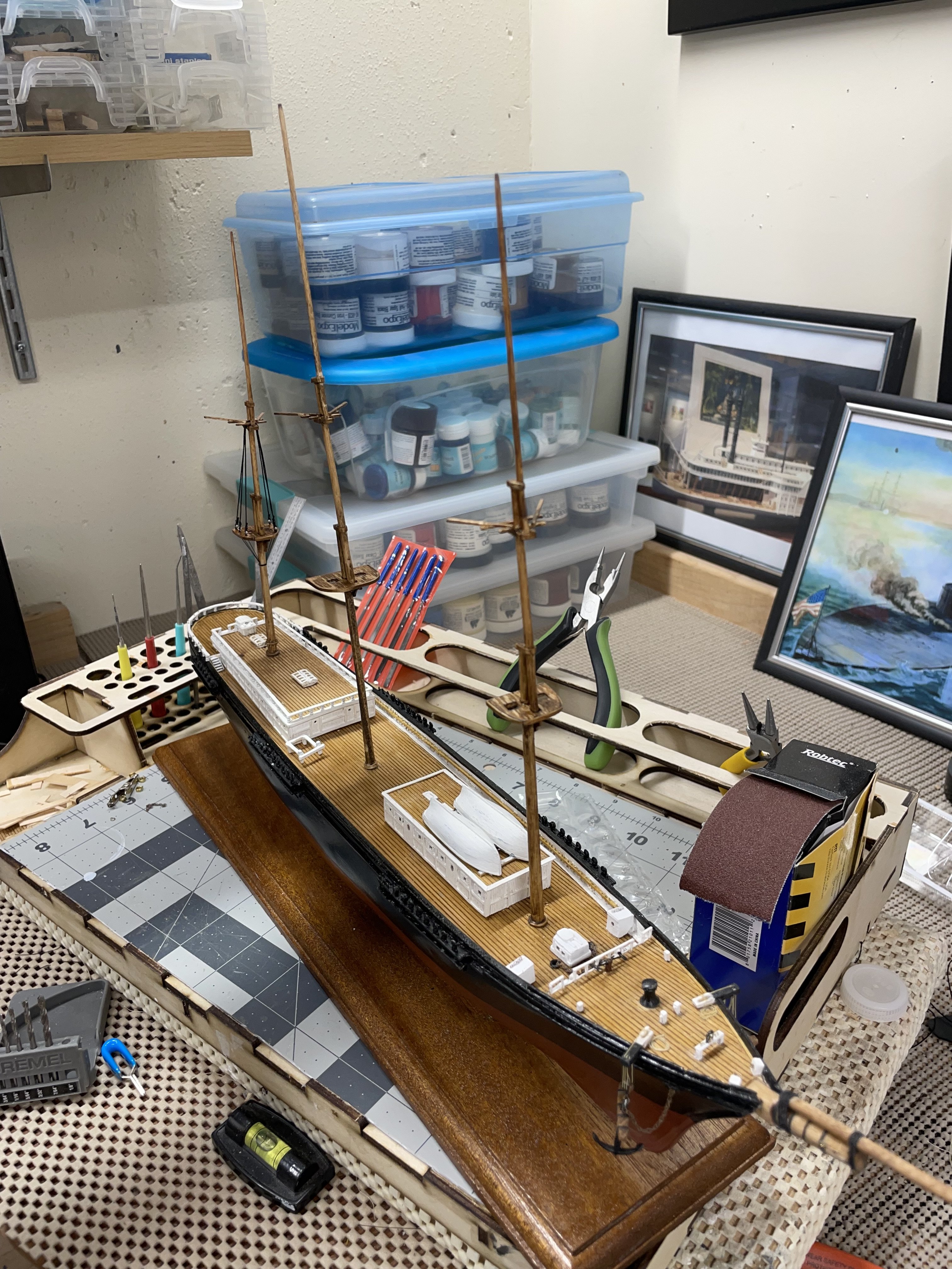

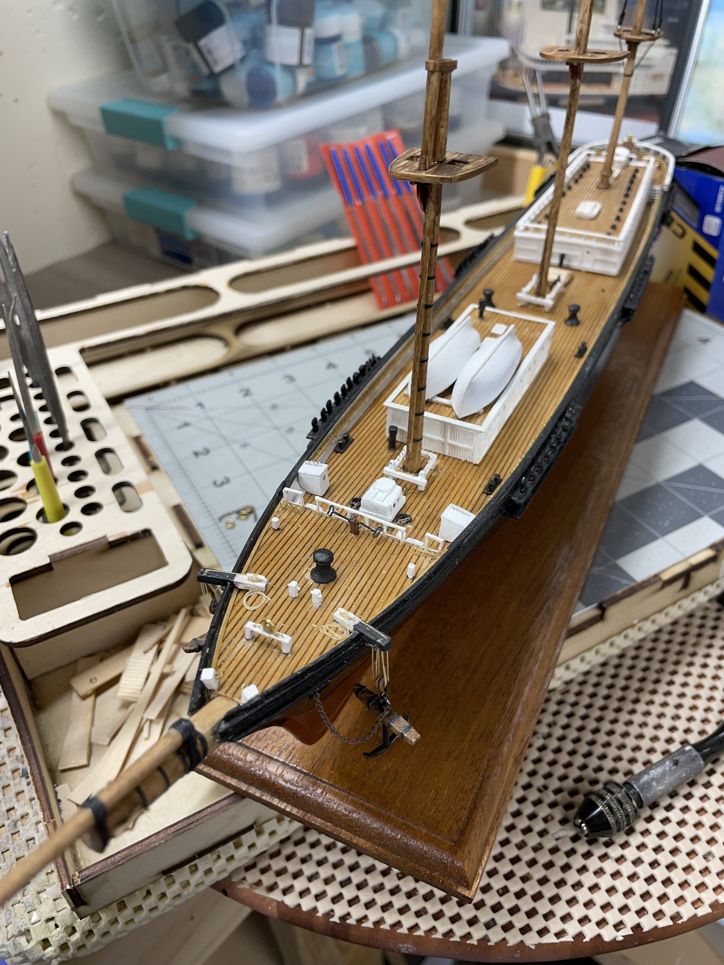

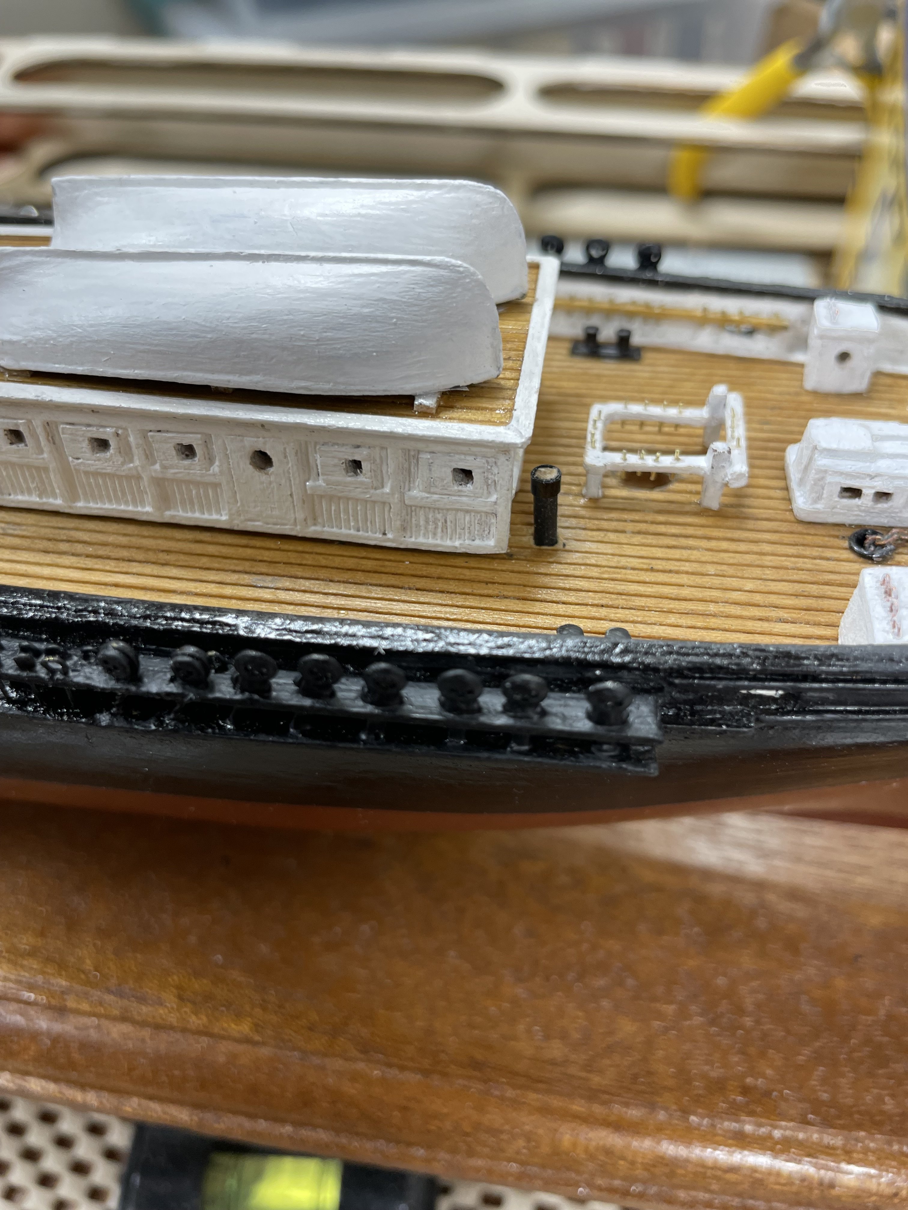

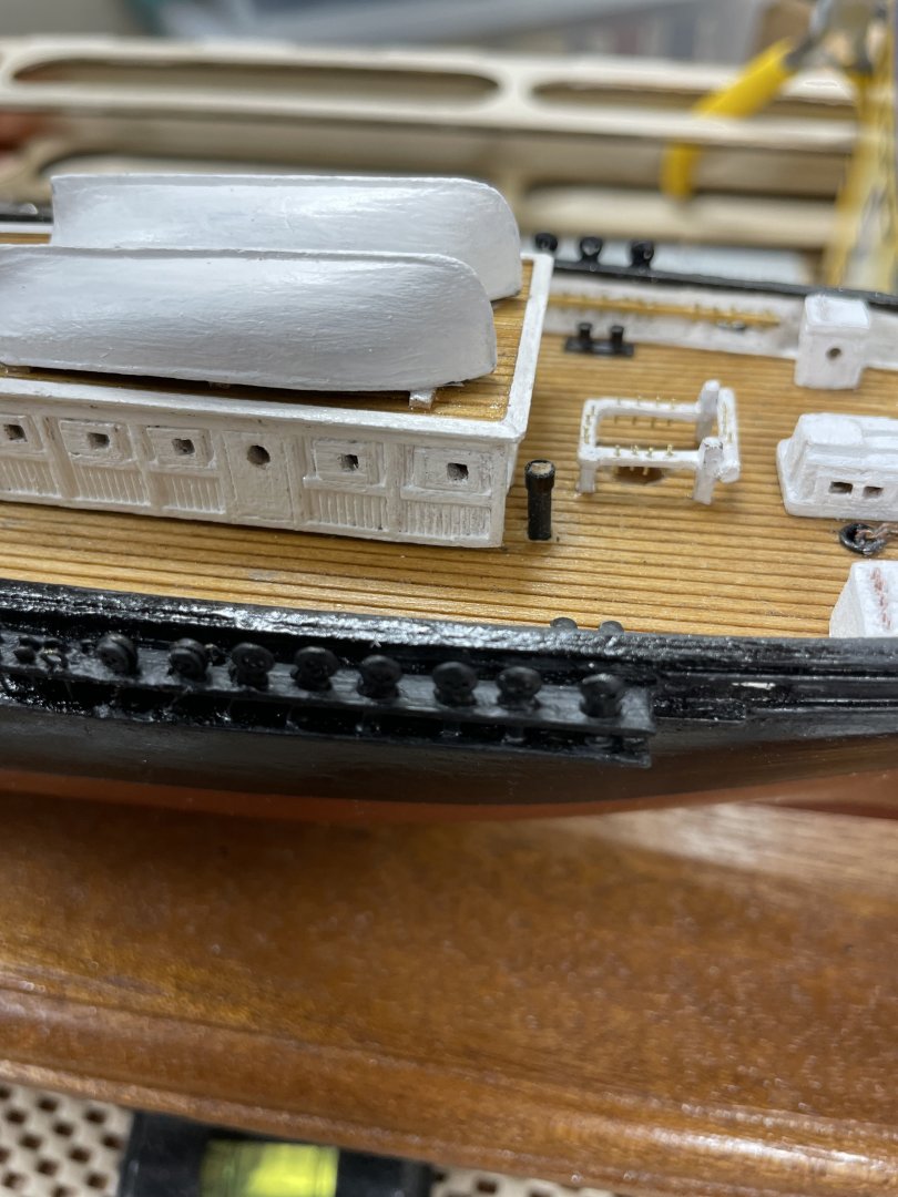

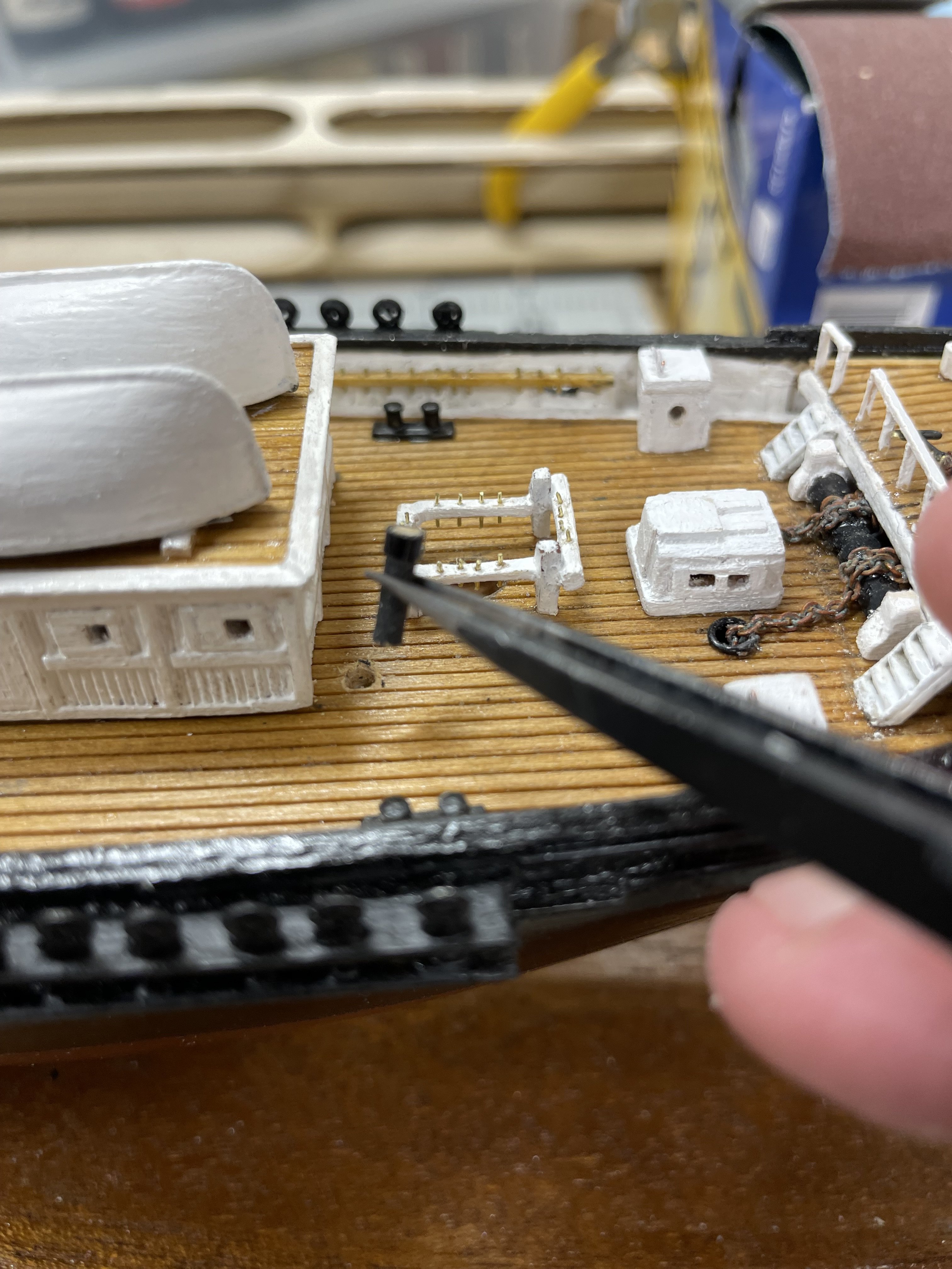

Time for an update… Progress is slow, I just haven’t had the time to work in the shipyard. Sealed the deck stain and white acrylic with Testors Clear Gloss Acrylic.

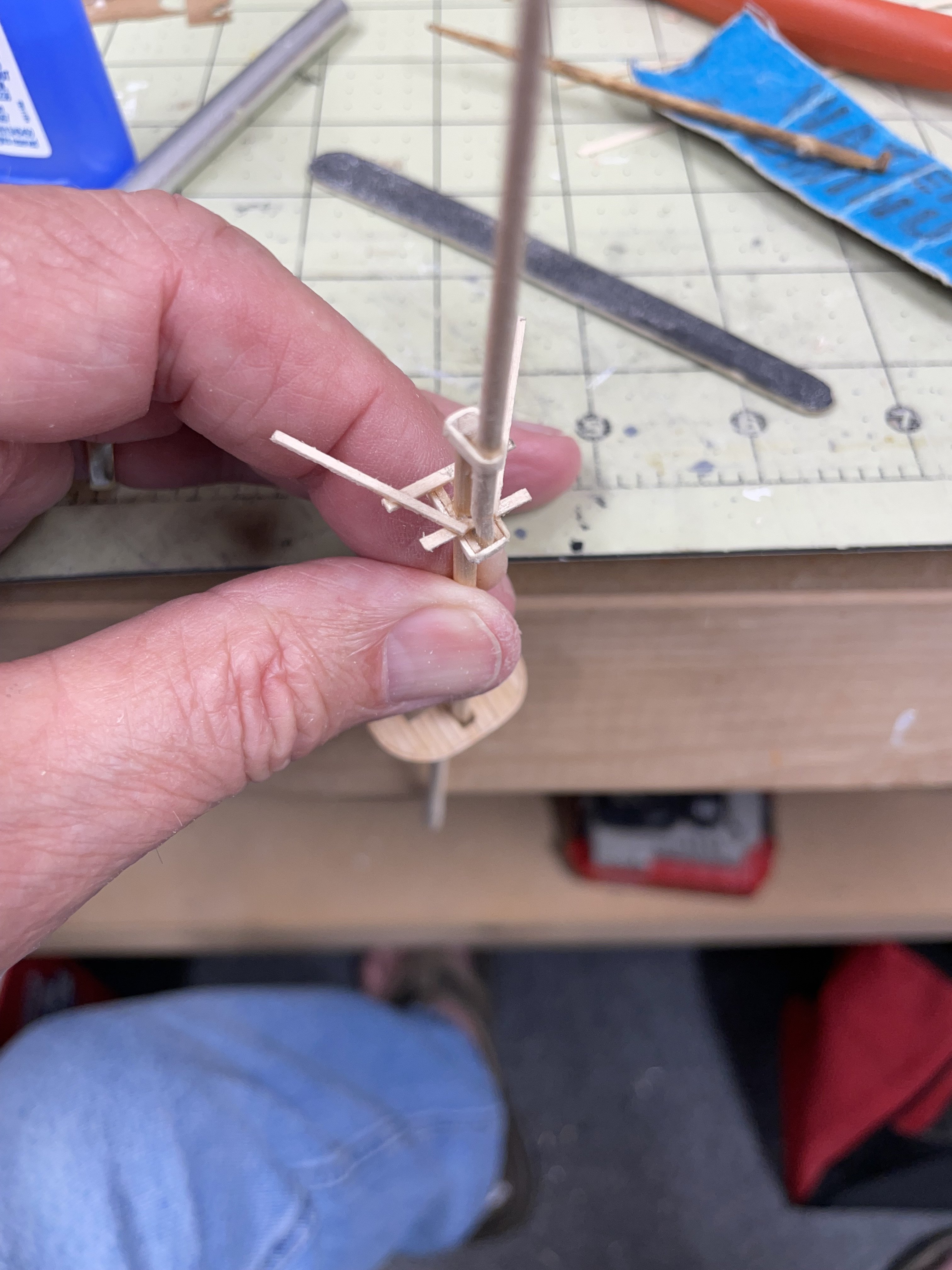

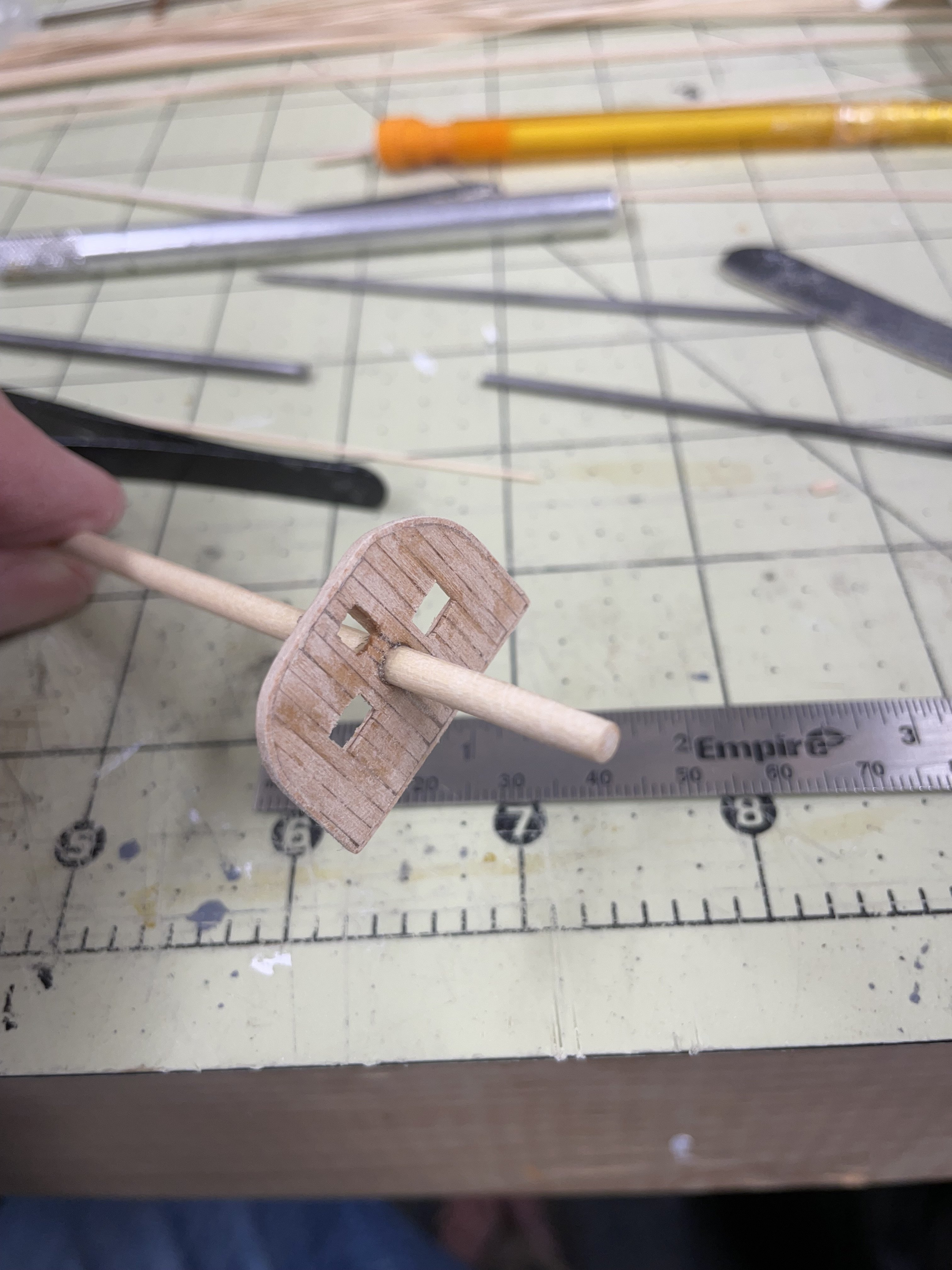

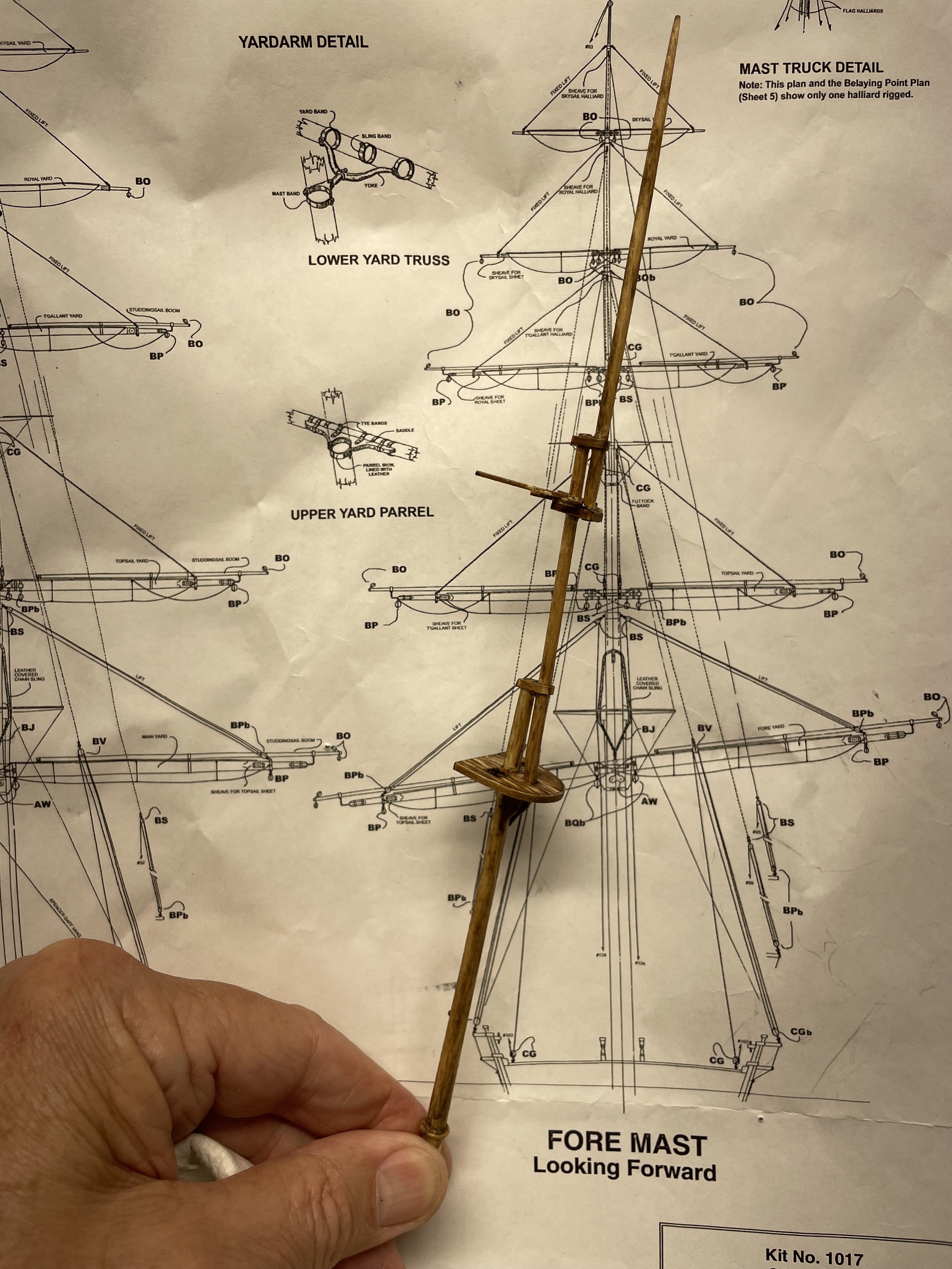

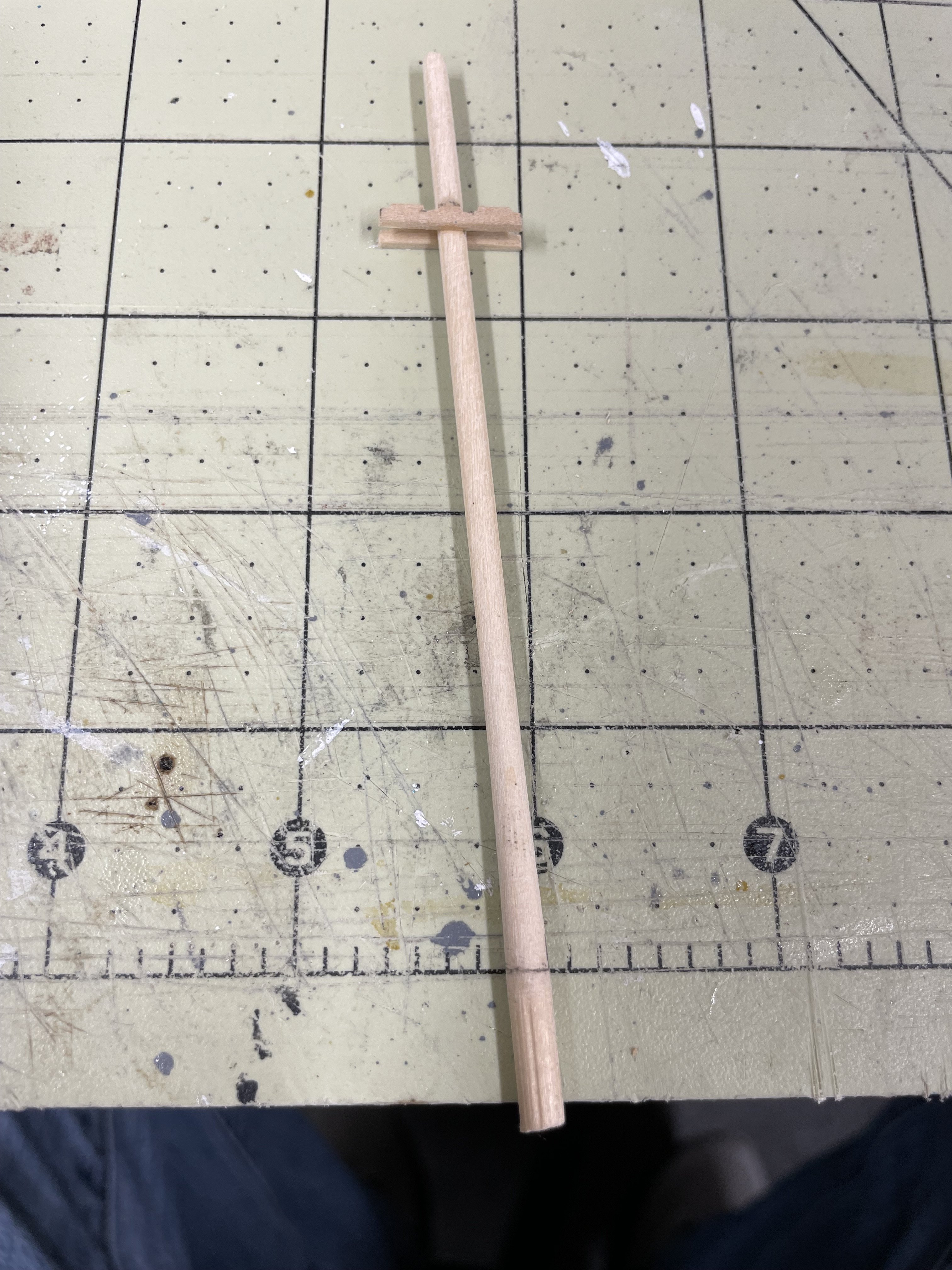

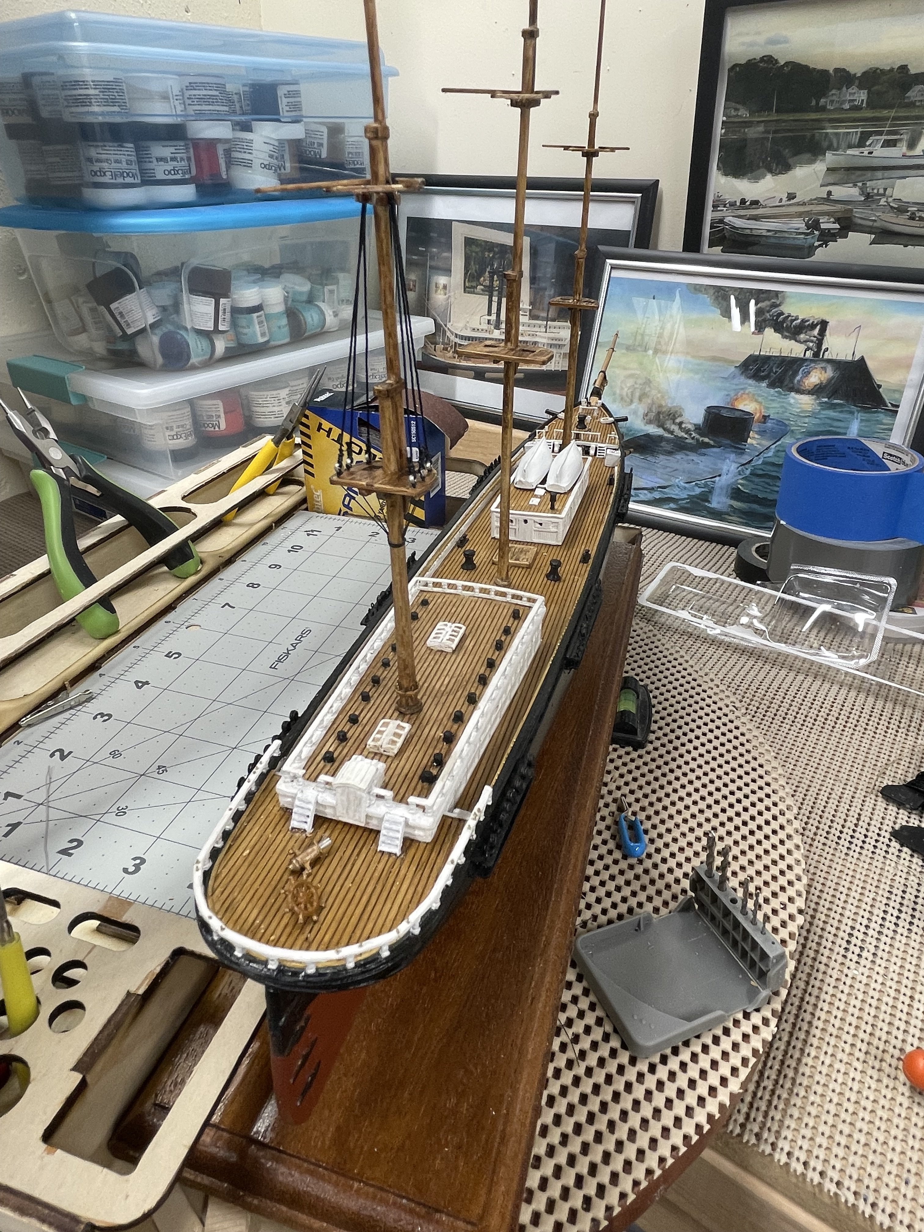

Stepping the Masts

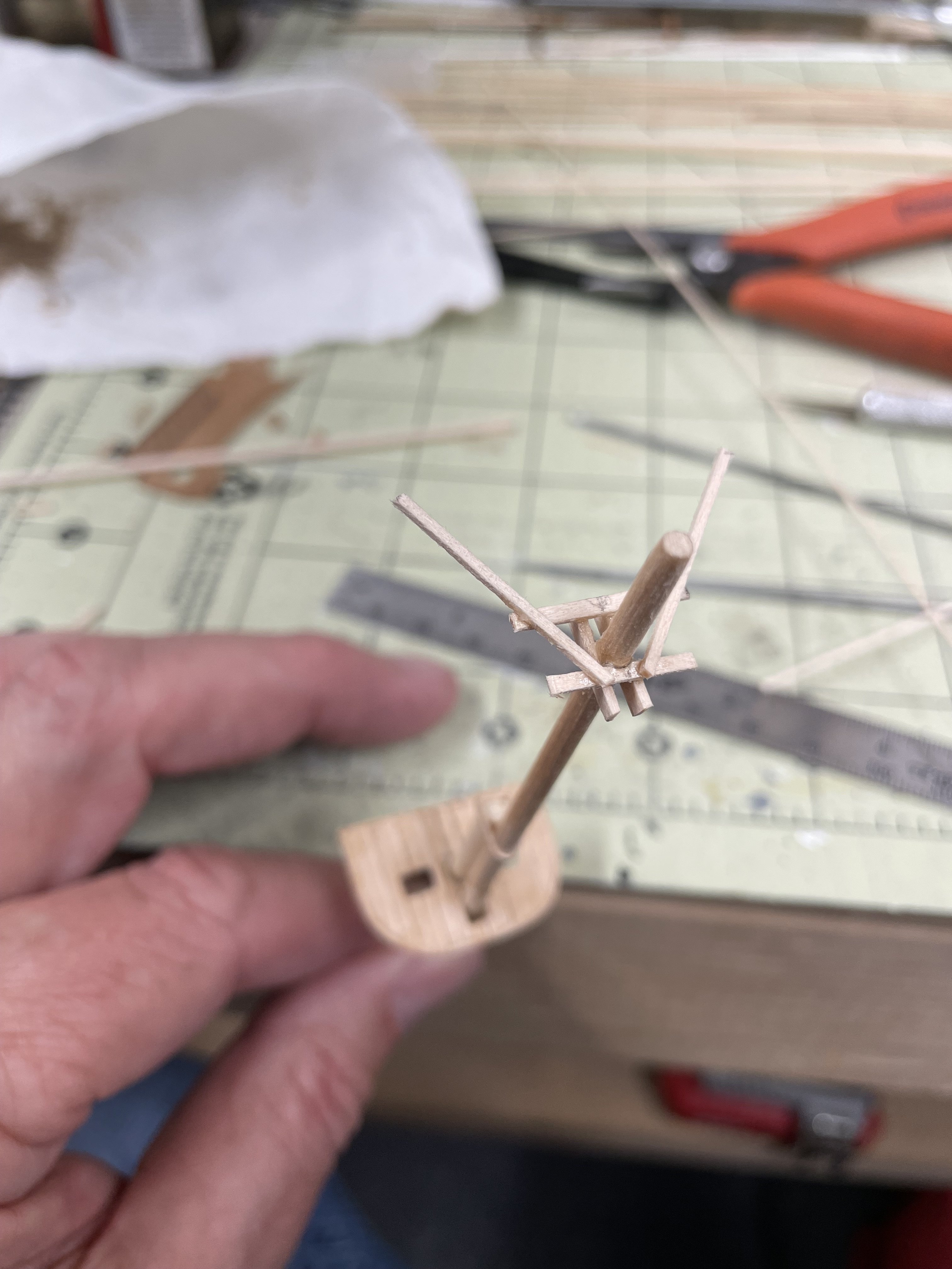

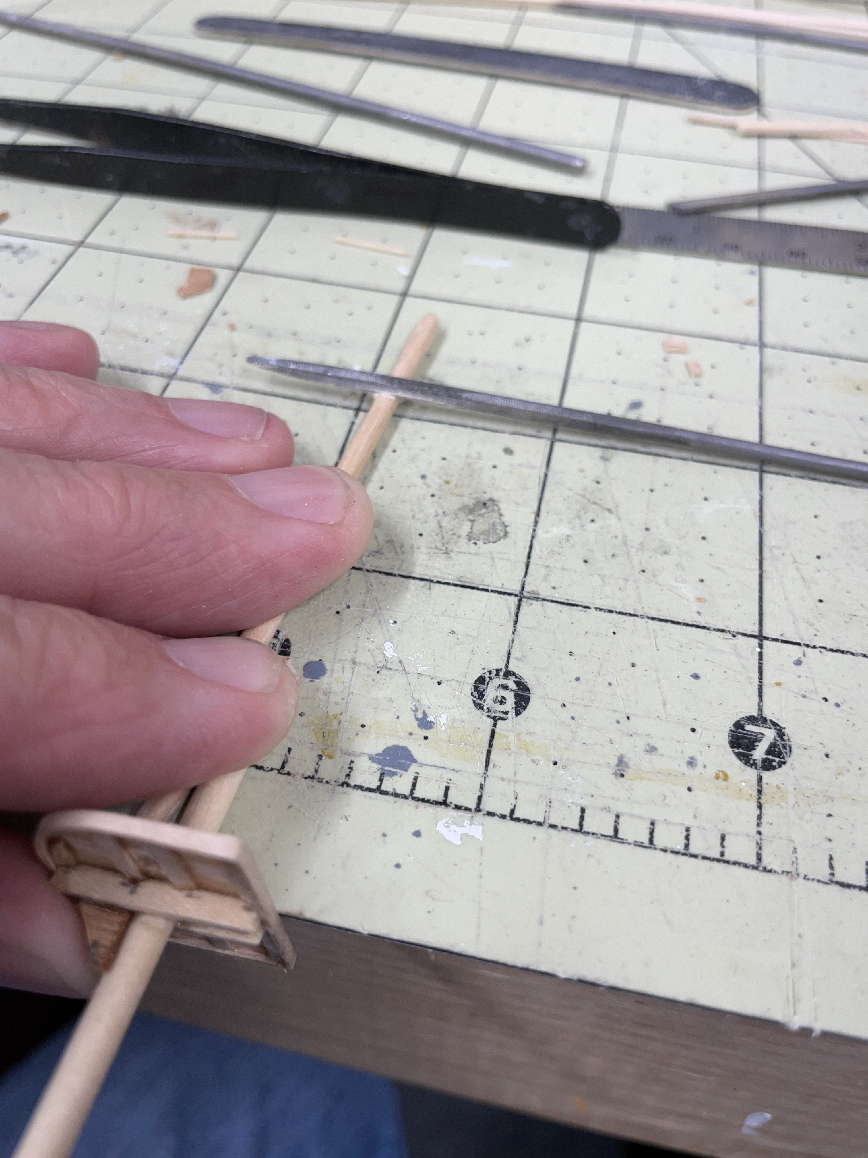

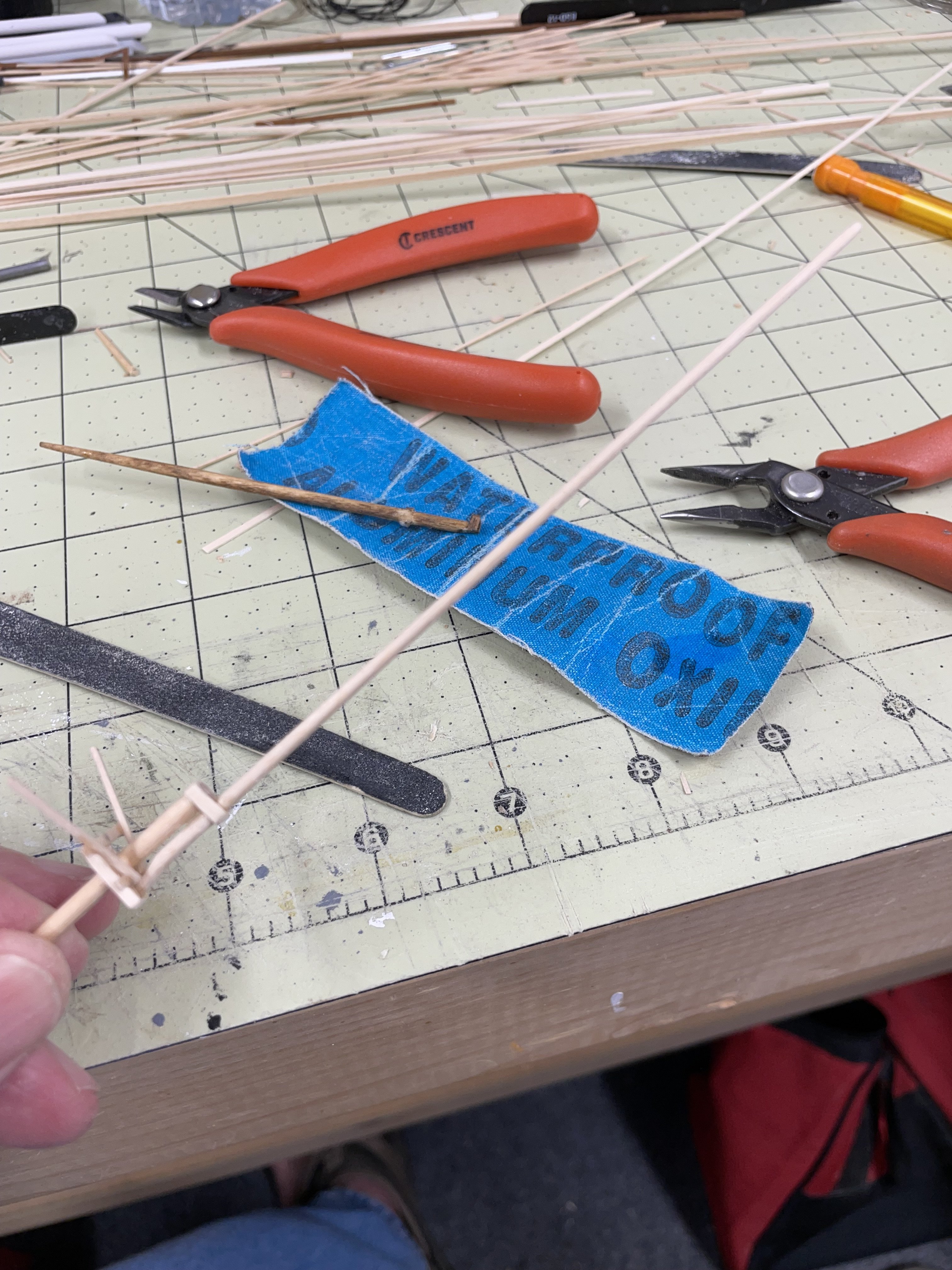

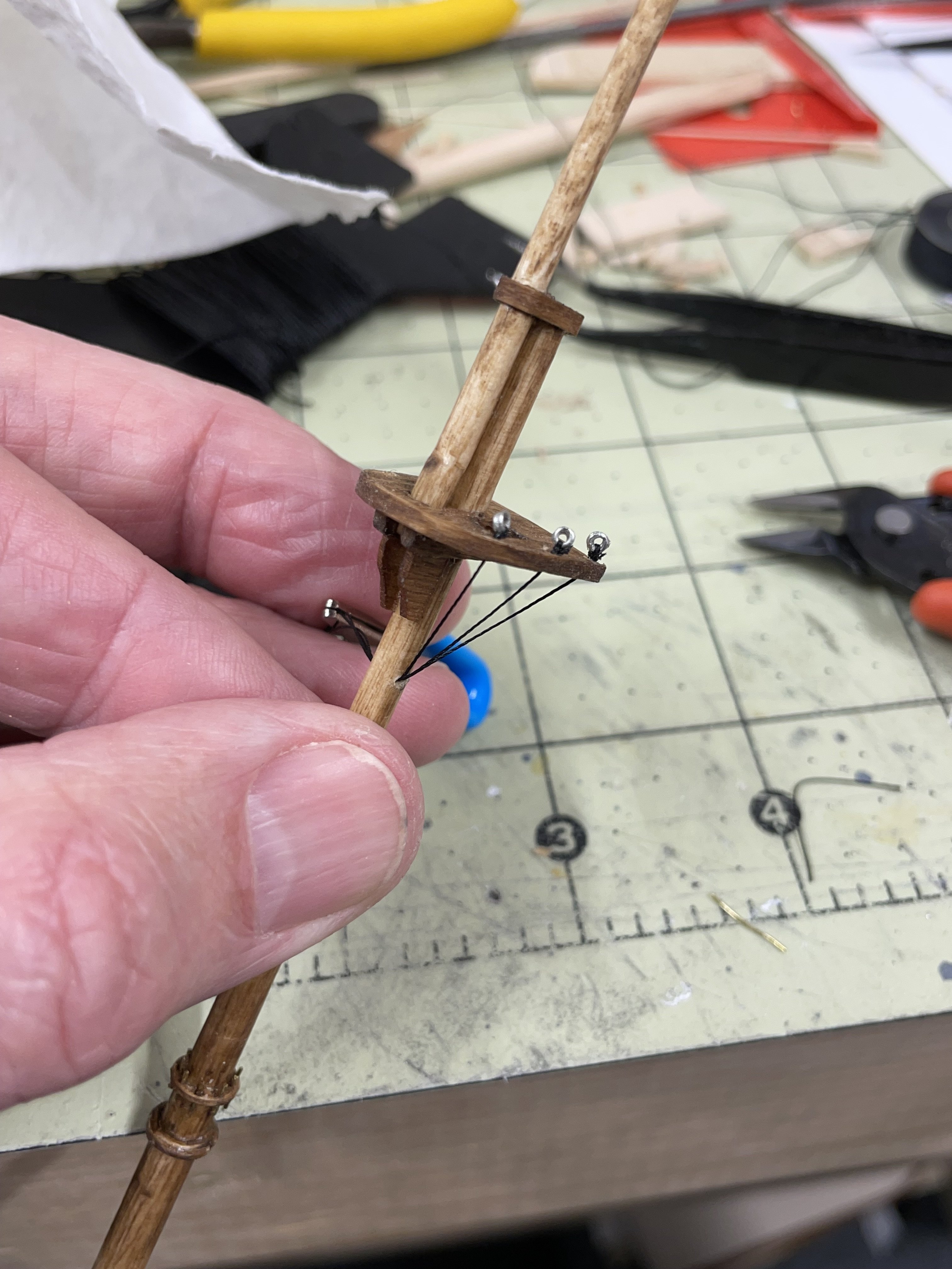

Tapering the Mizzen Lower Mast utilizing my drill chuck lathe. 😎

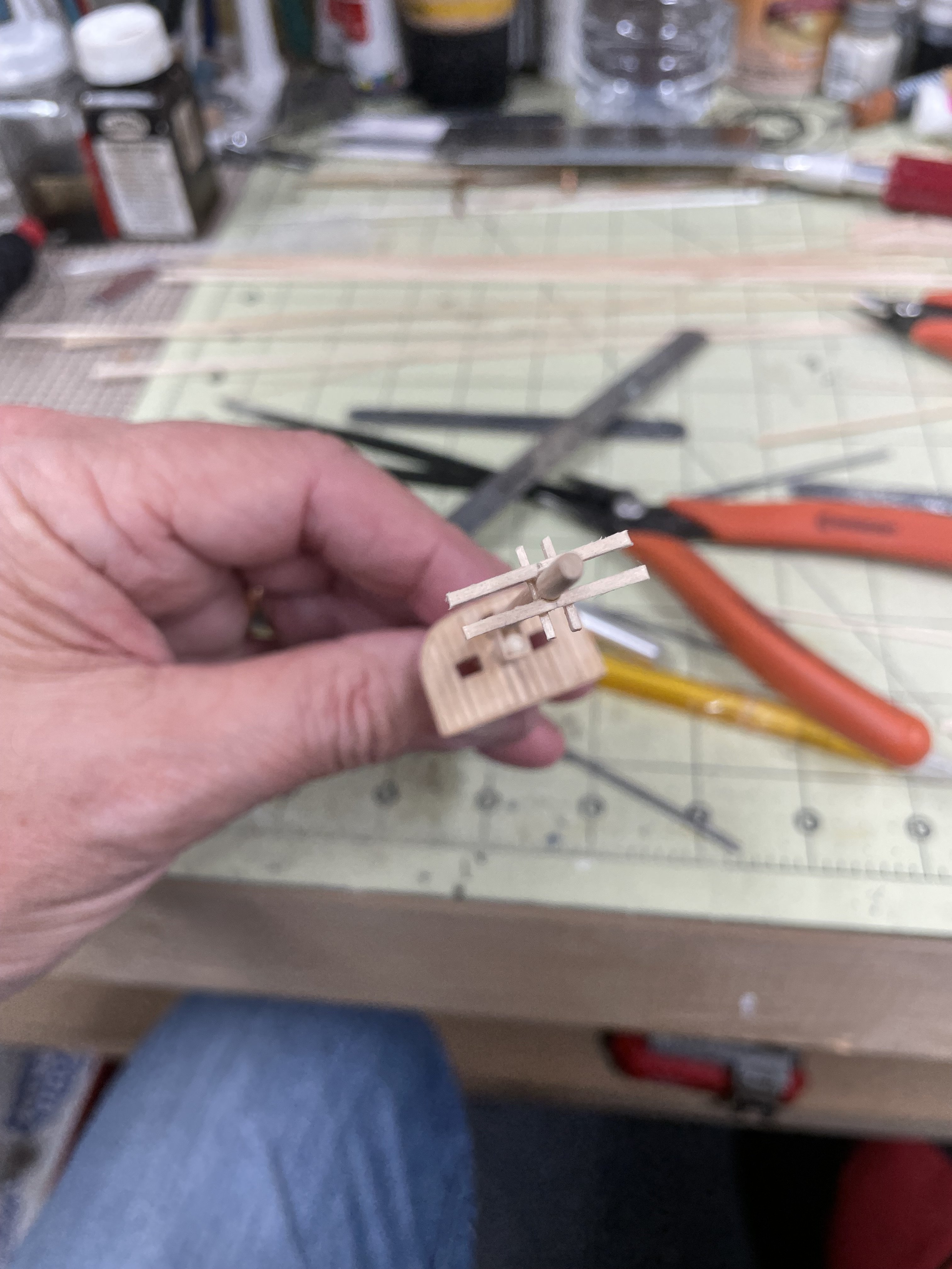

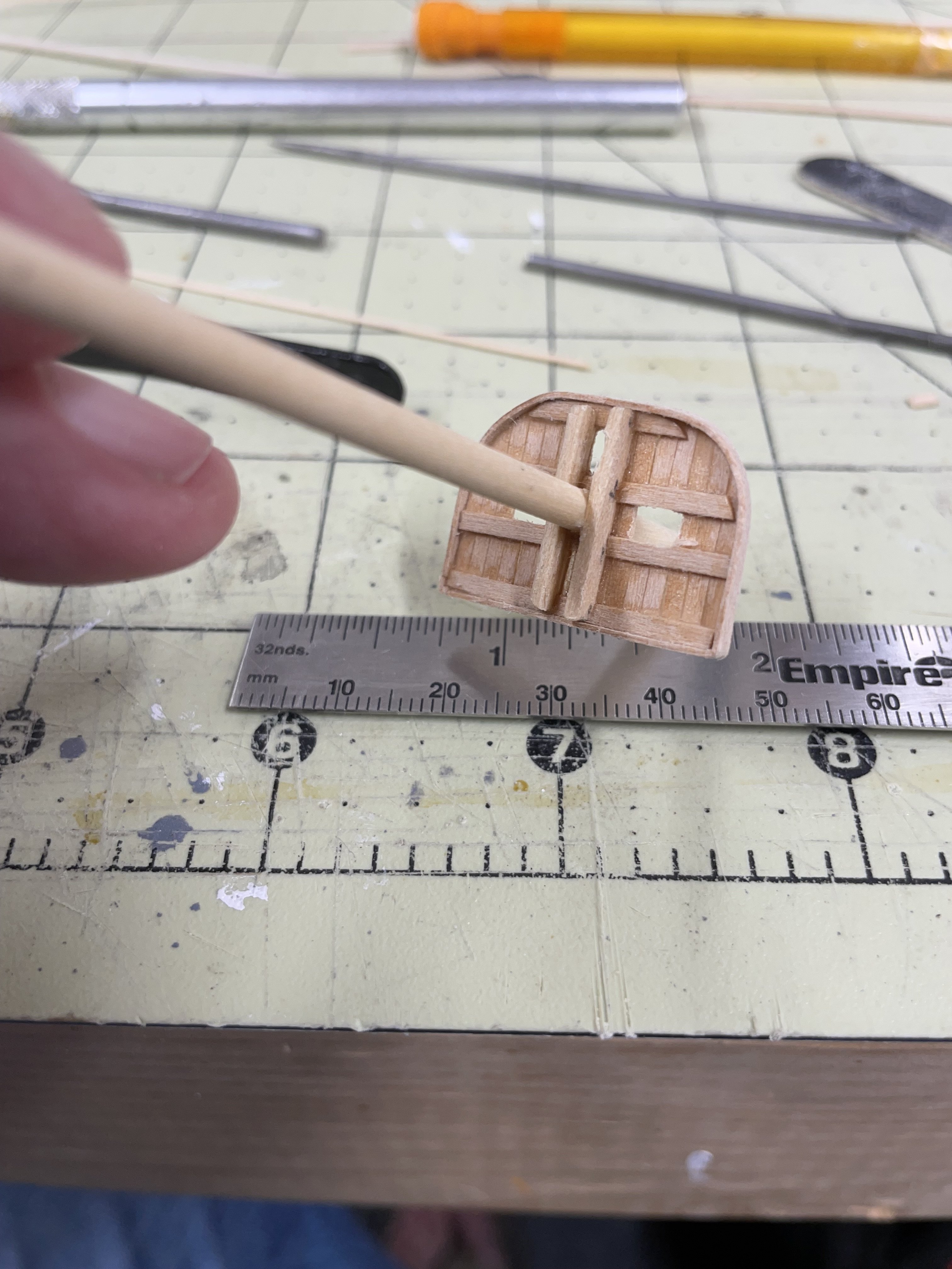

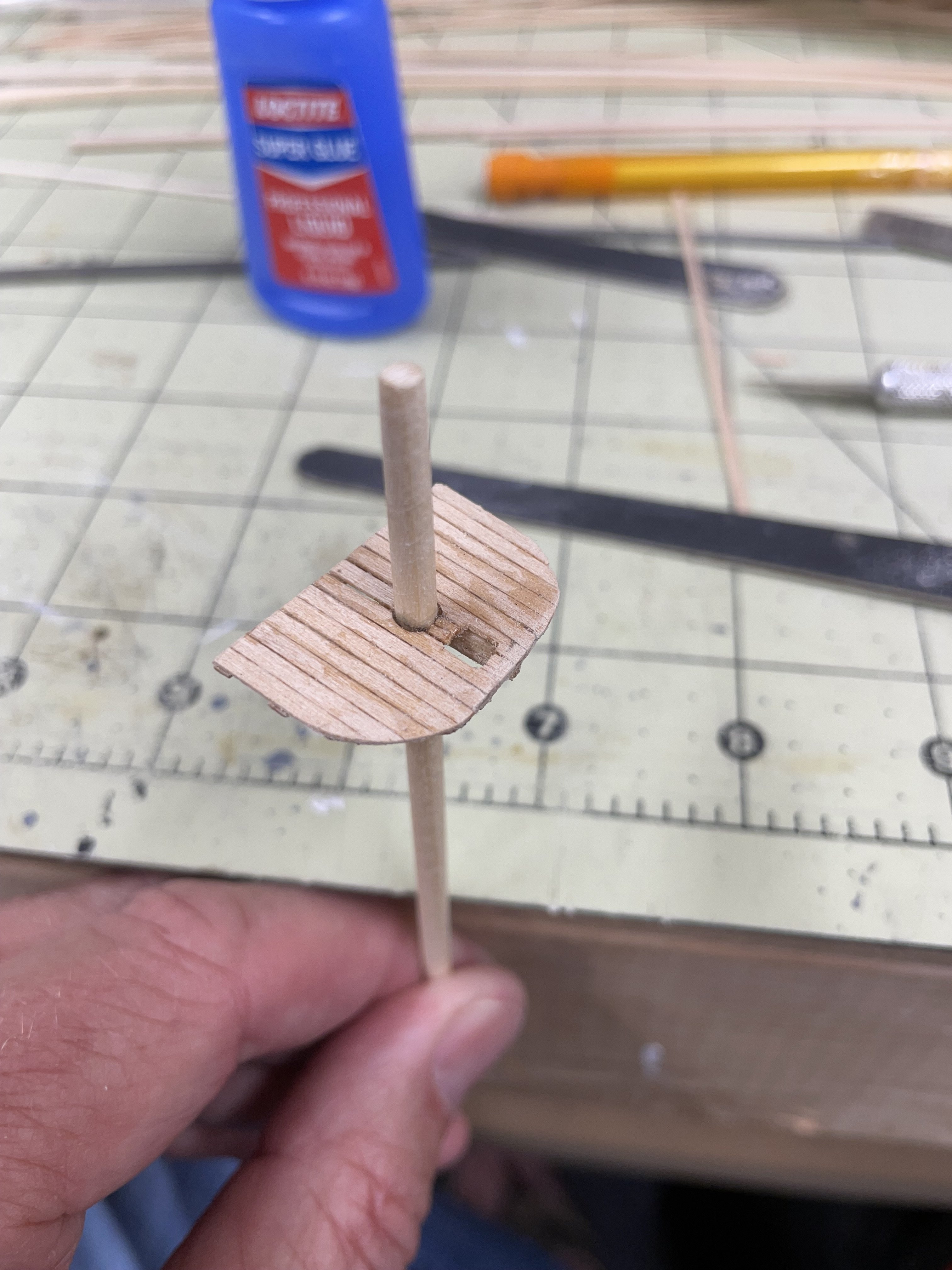

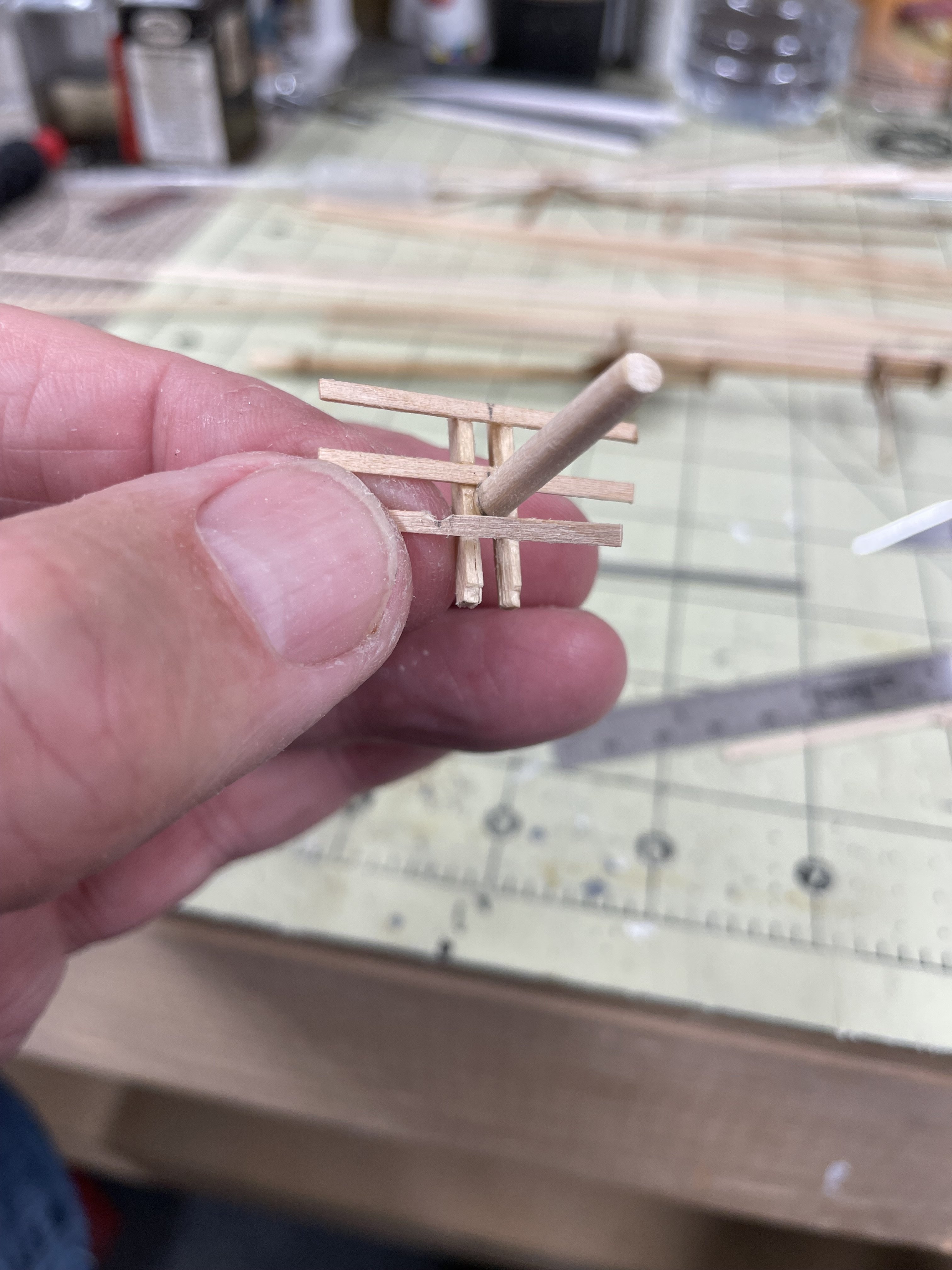

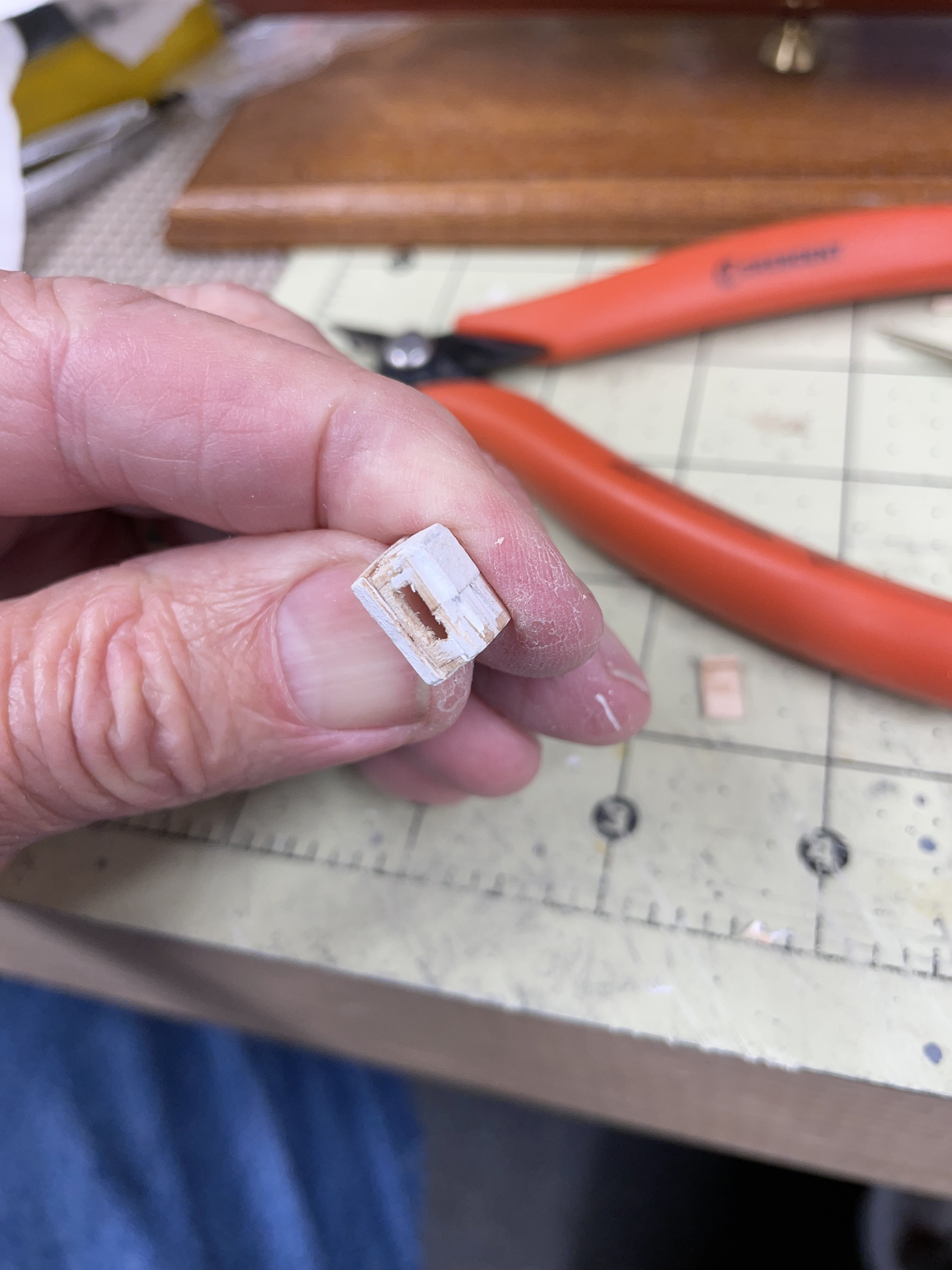

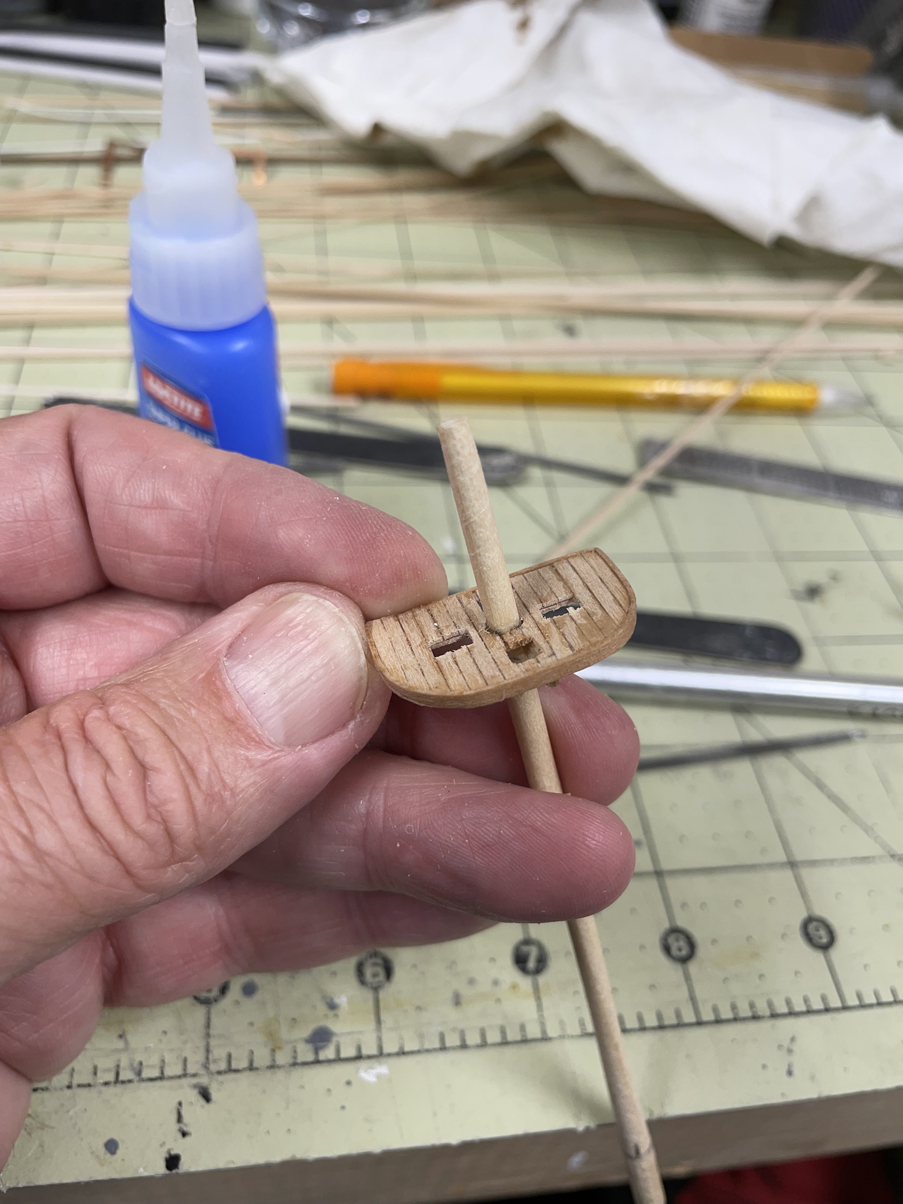

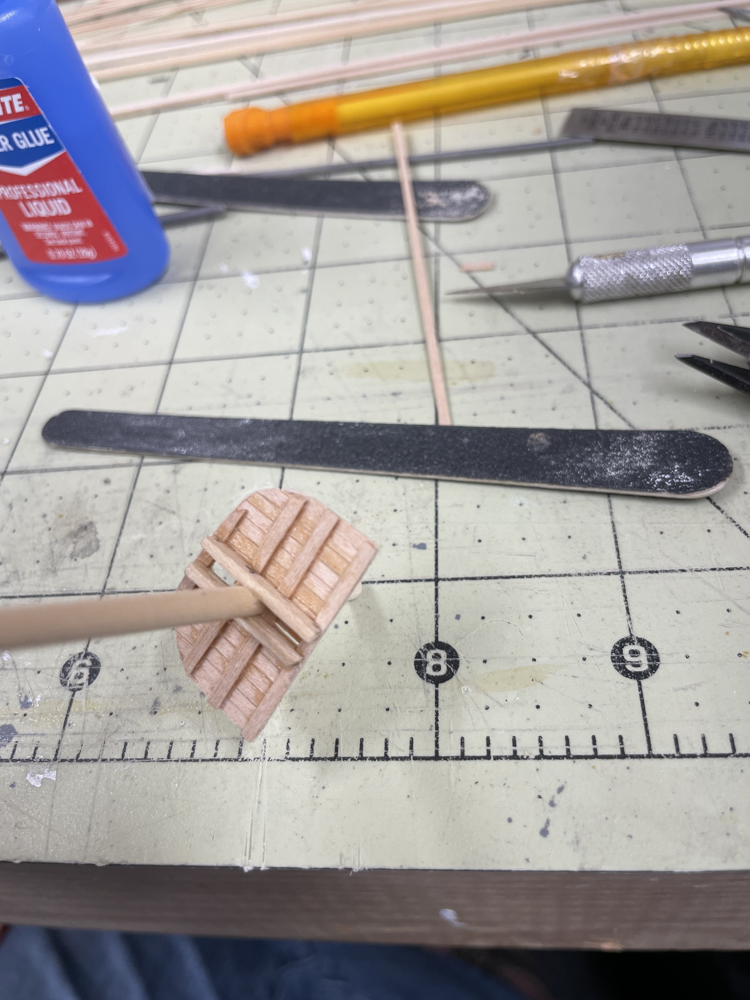

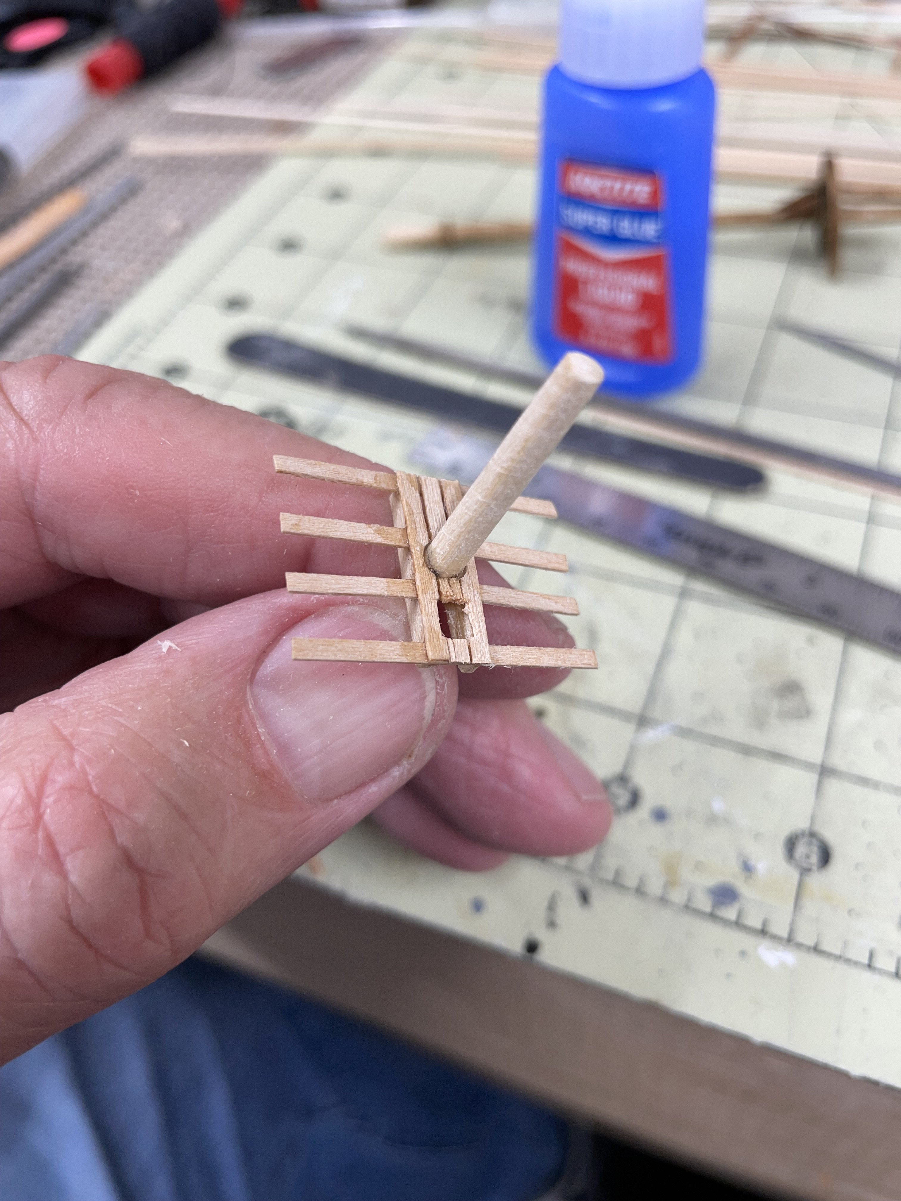

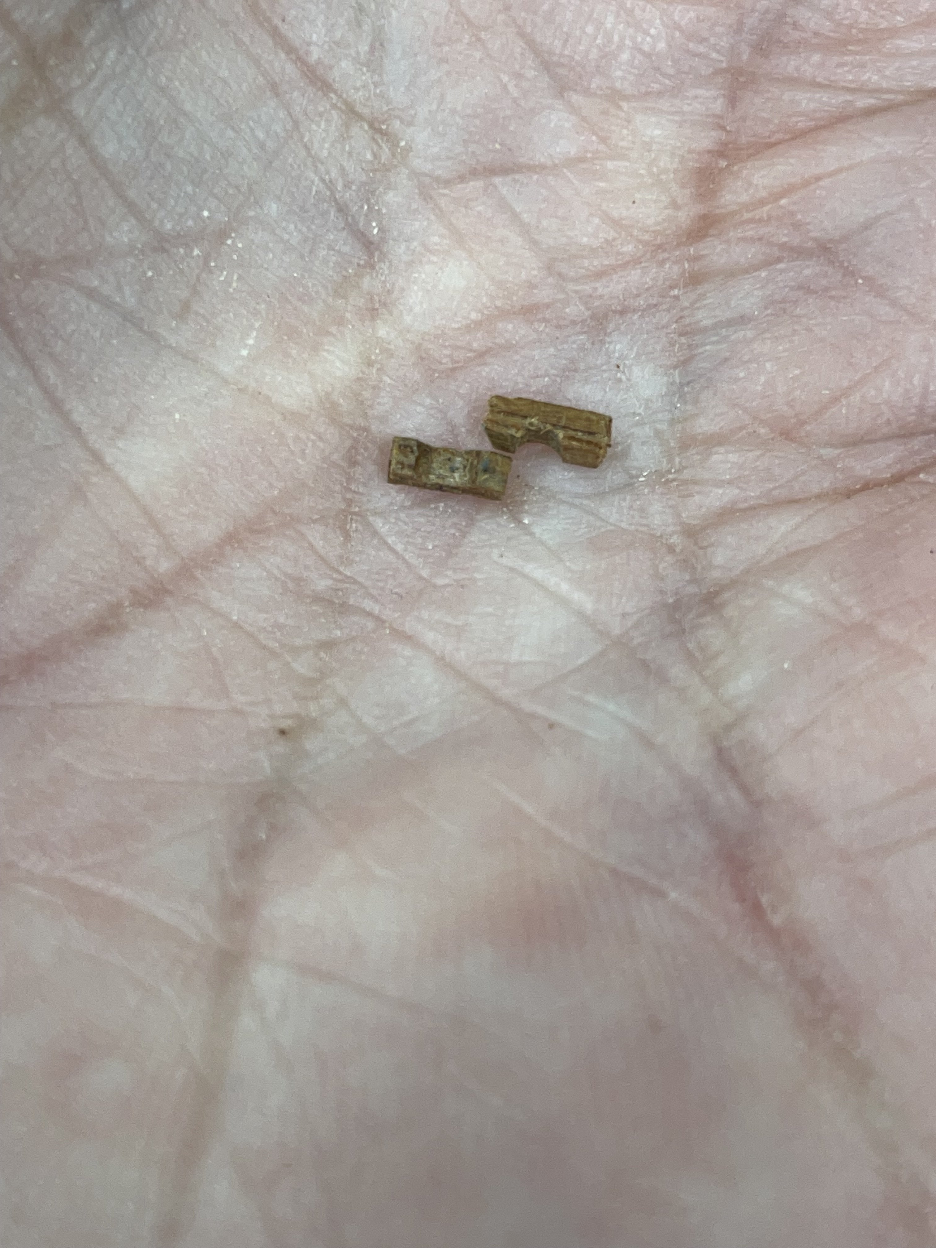

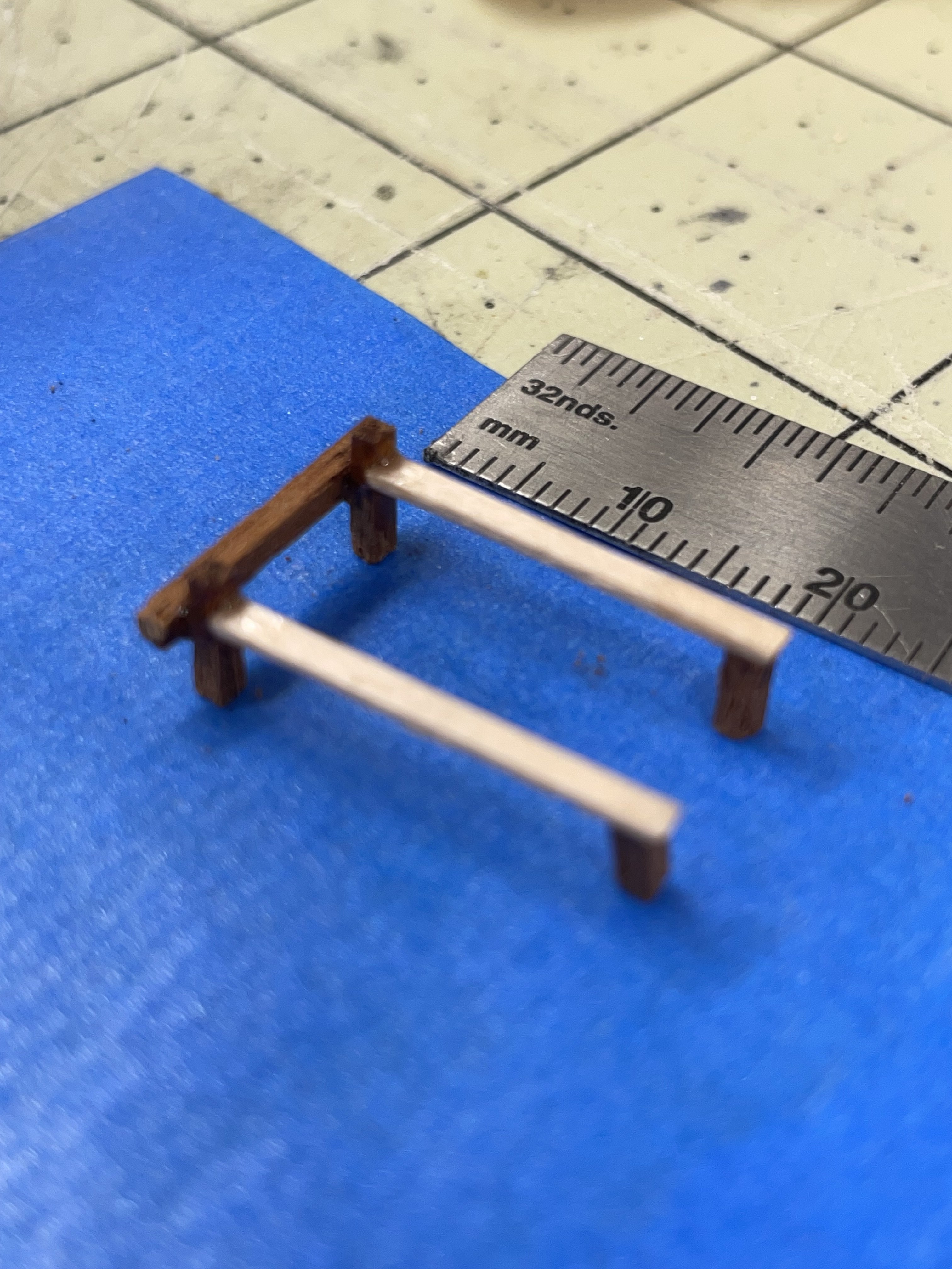

Building the Lower Mast Head.

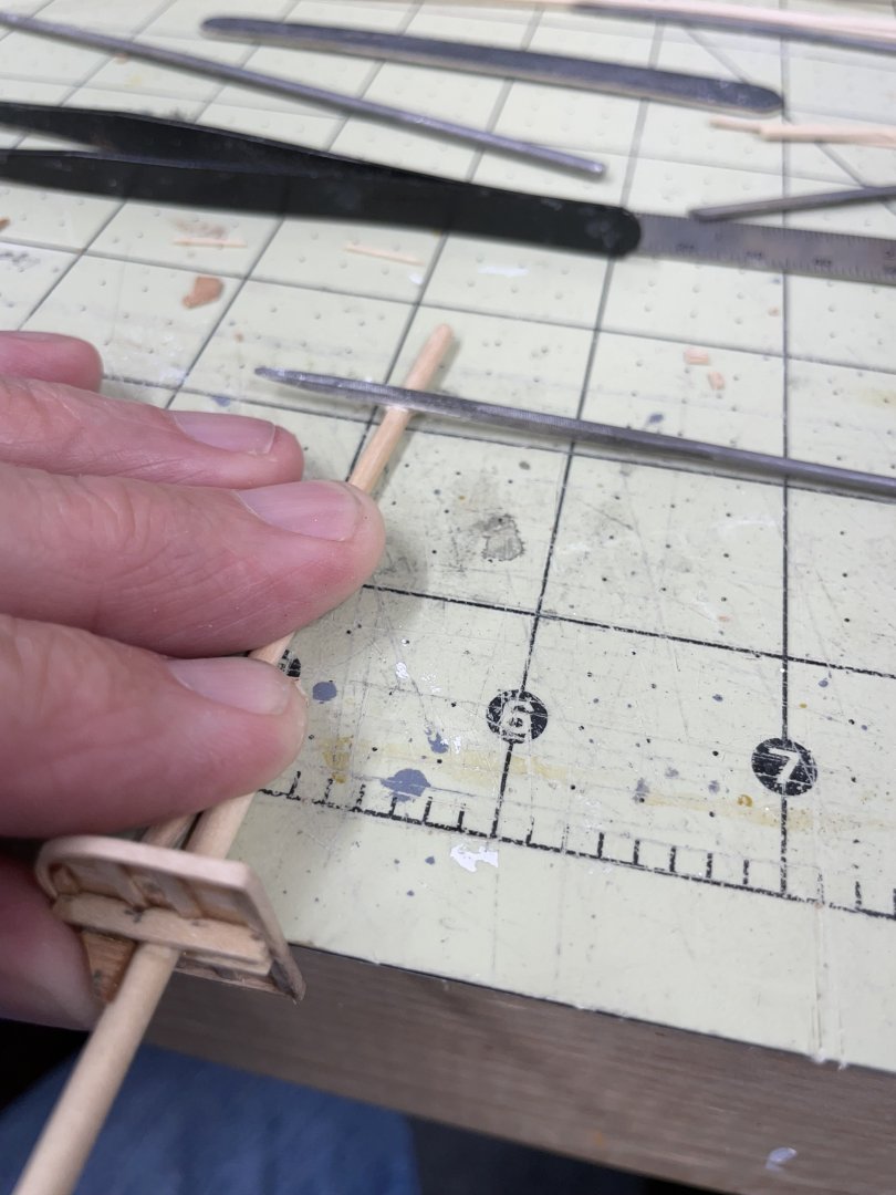

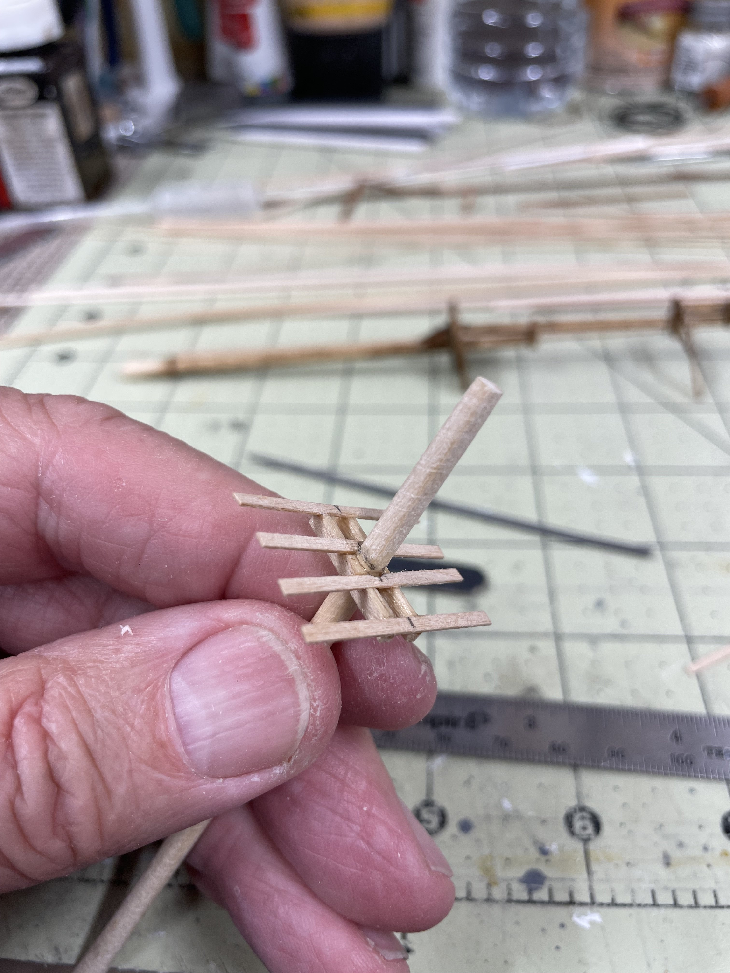

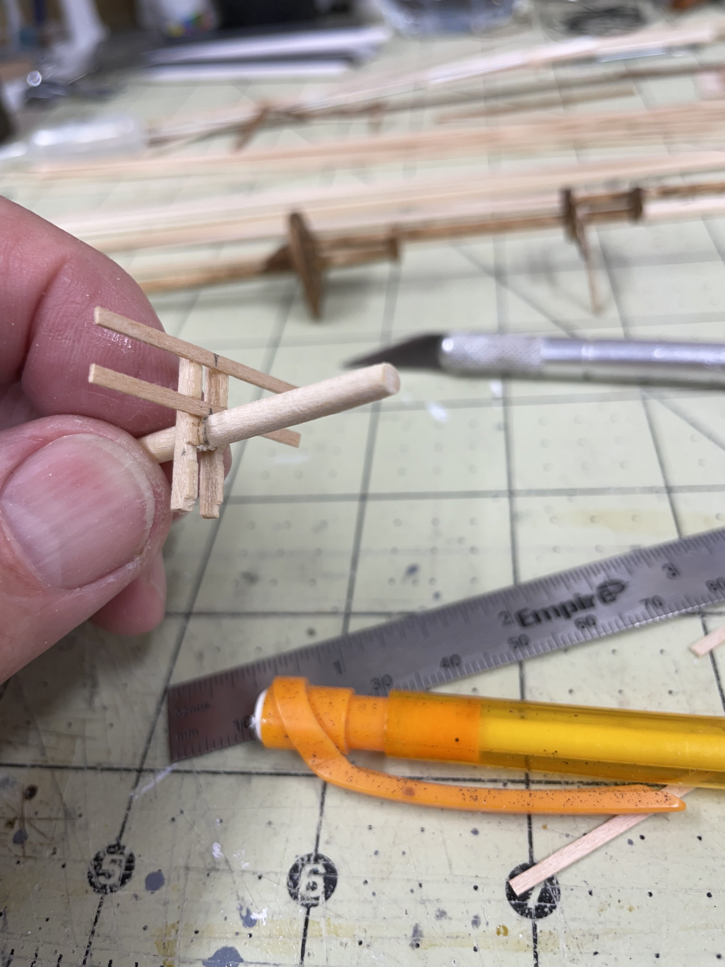

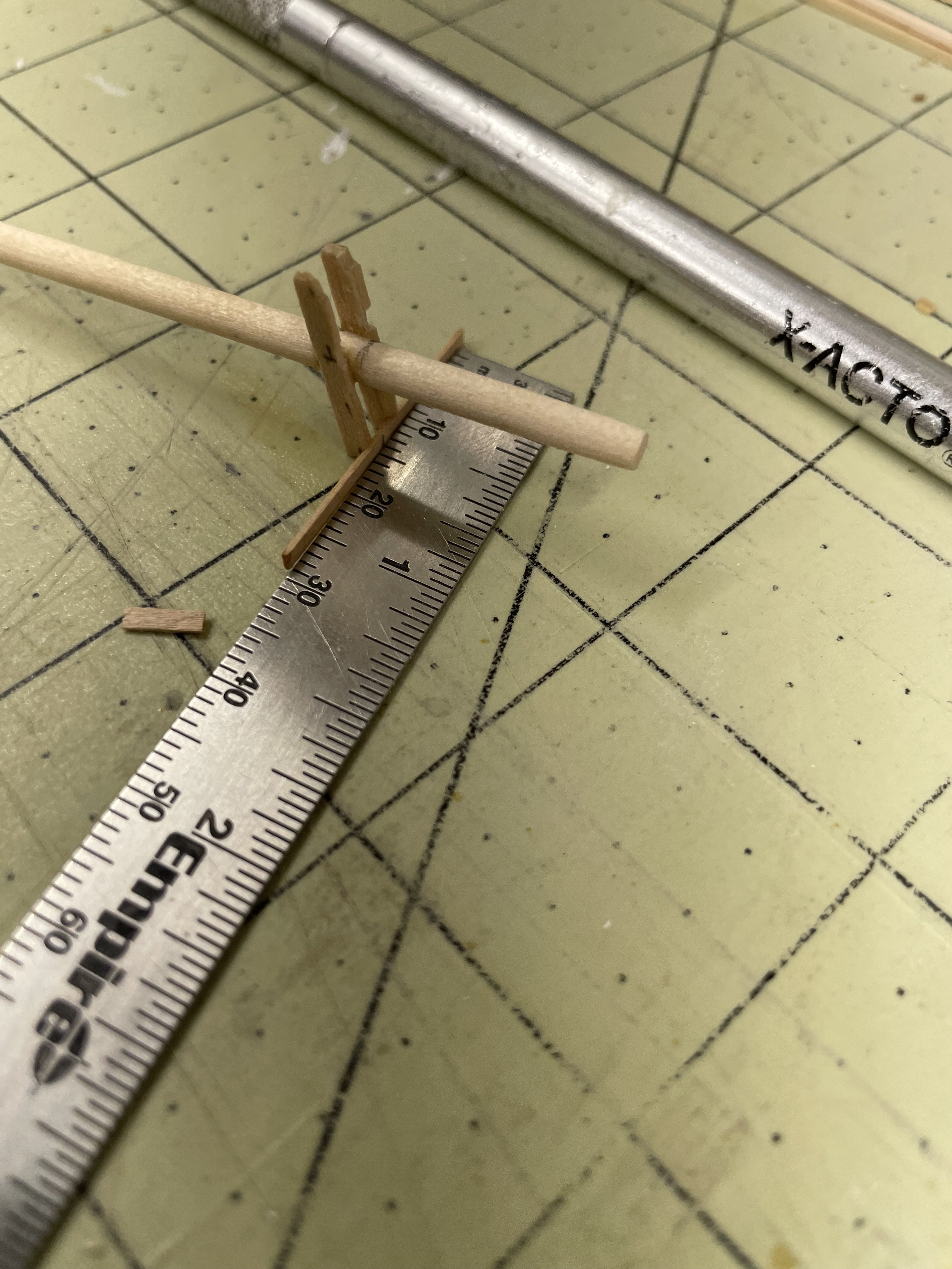

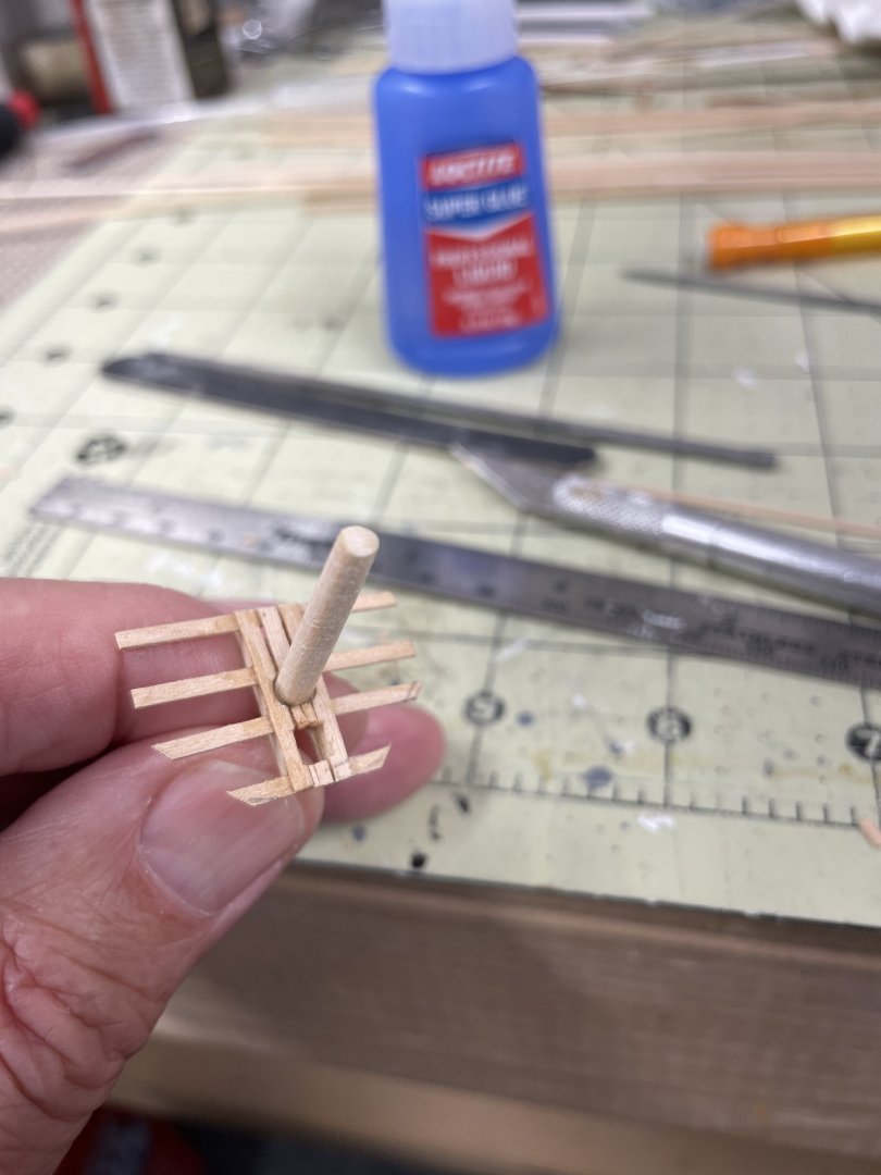

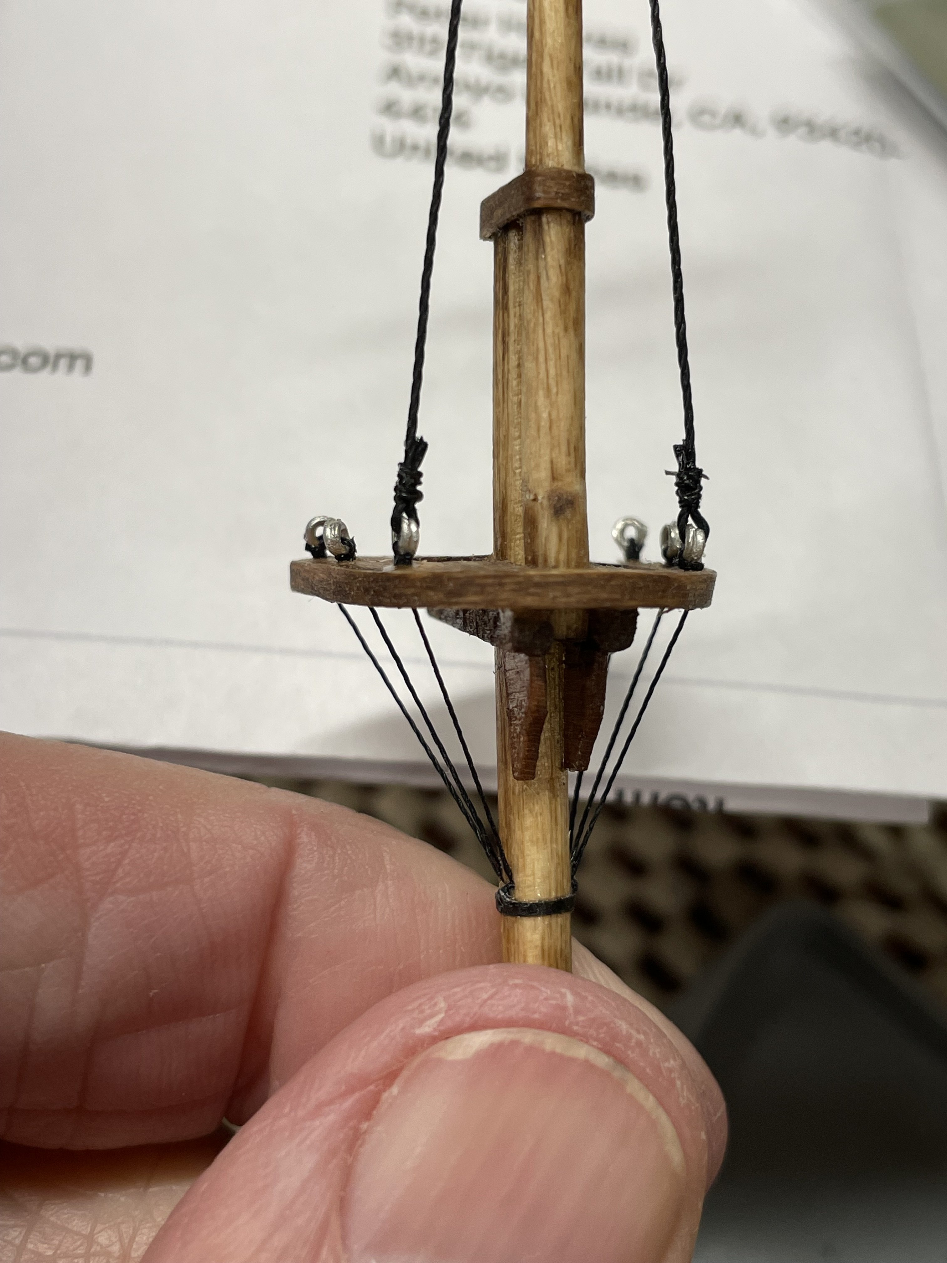

Continuing with the Top Mast Triple Tree.

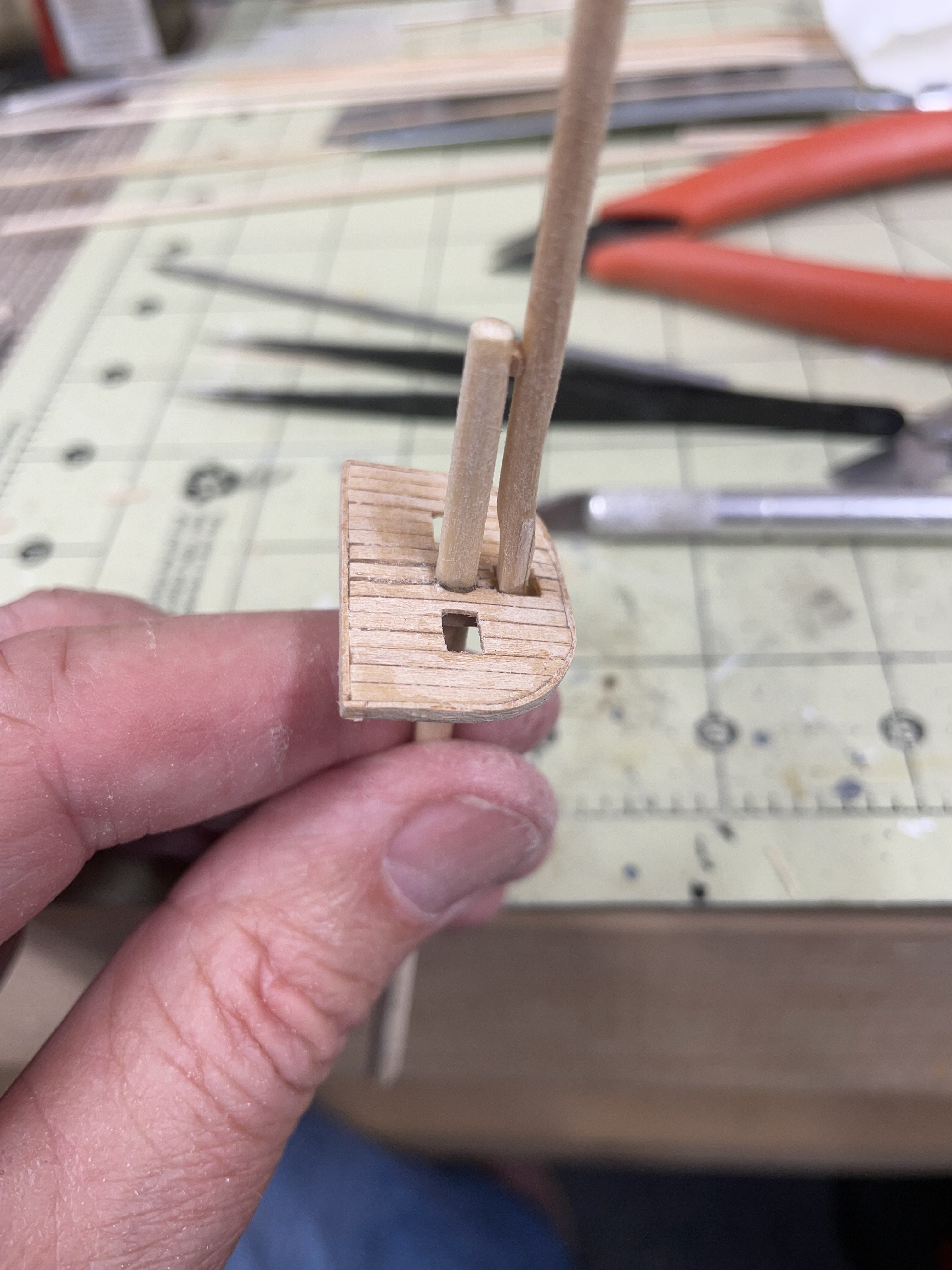

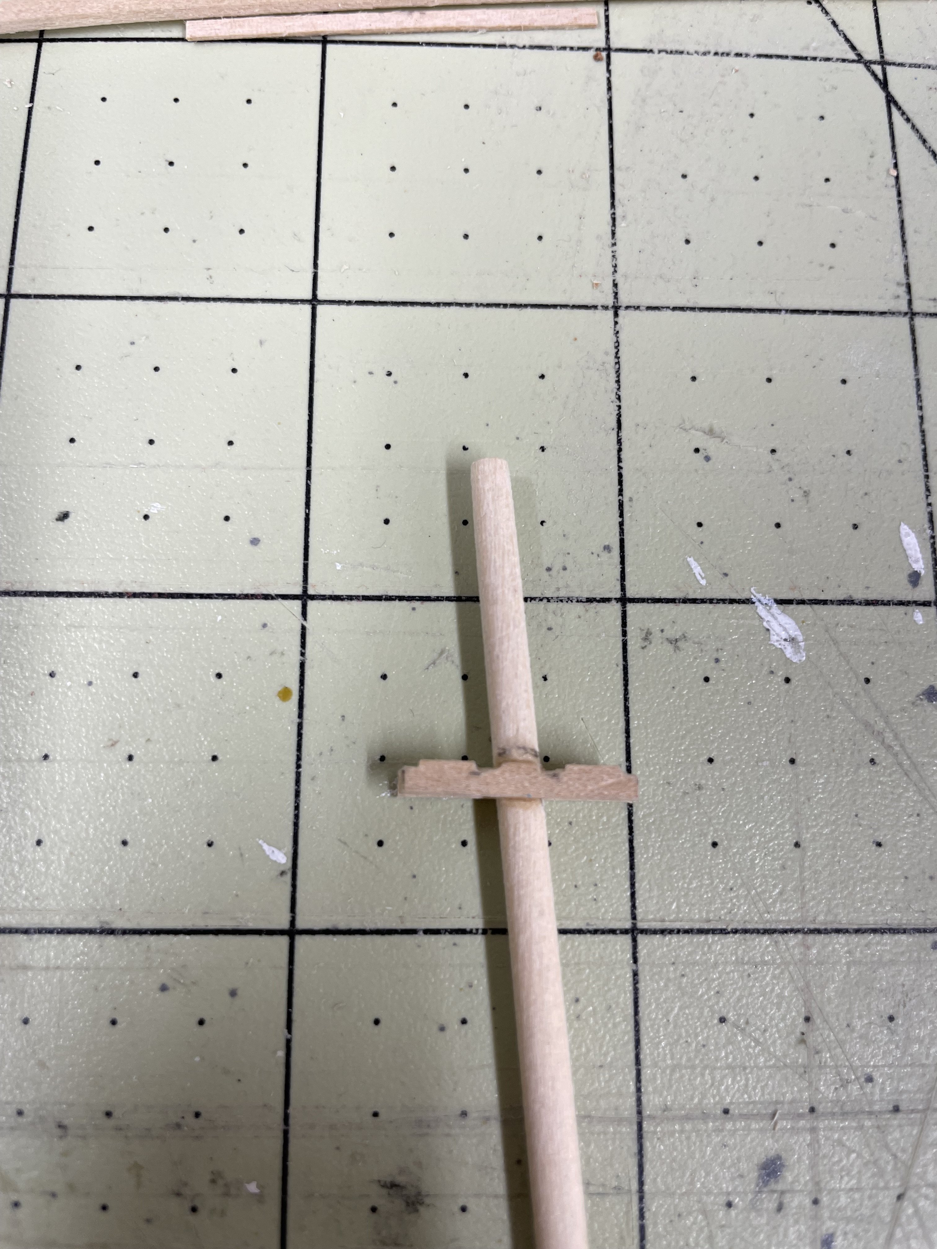

Mizzen Mast completed.
Cheers 🍻

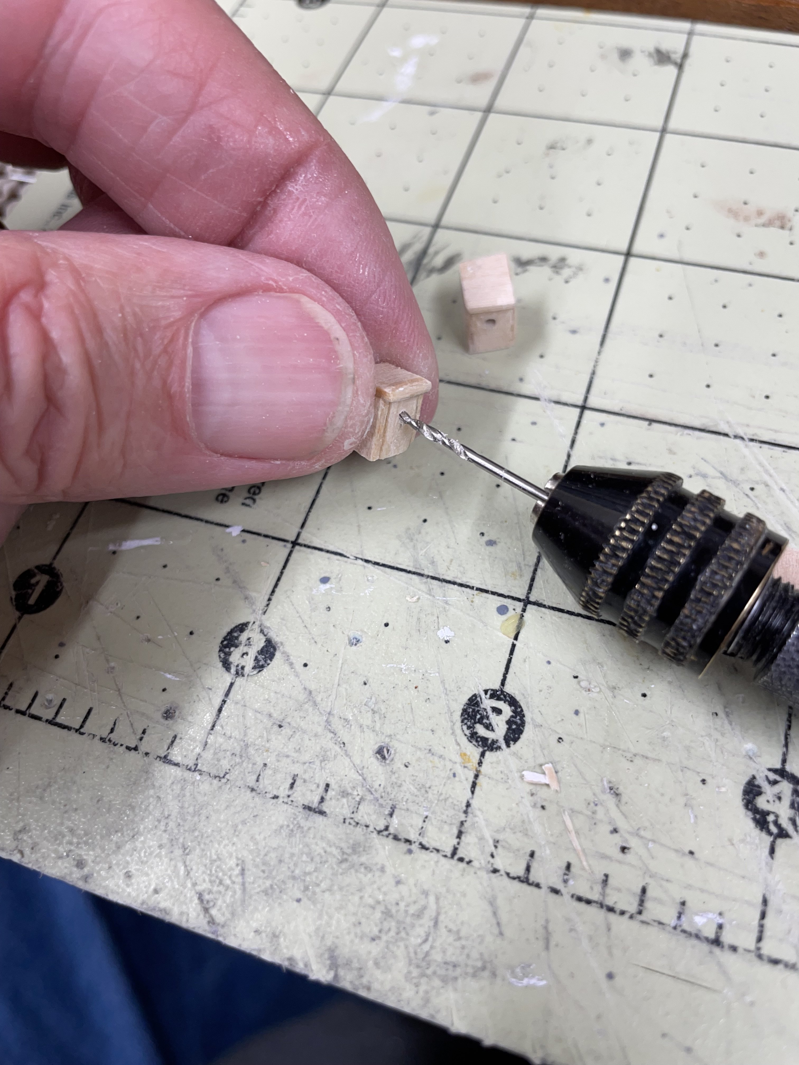

Things are pretty small at 1:192 scale! I have had difficulty with the small pieces at 1:48! You are doing a good job.

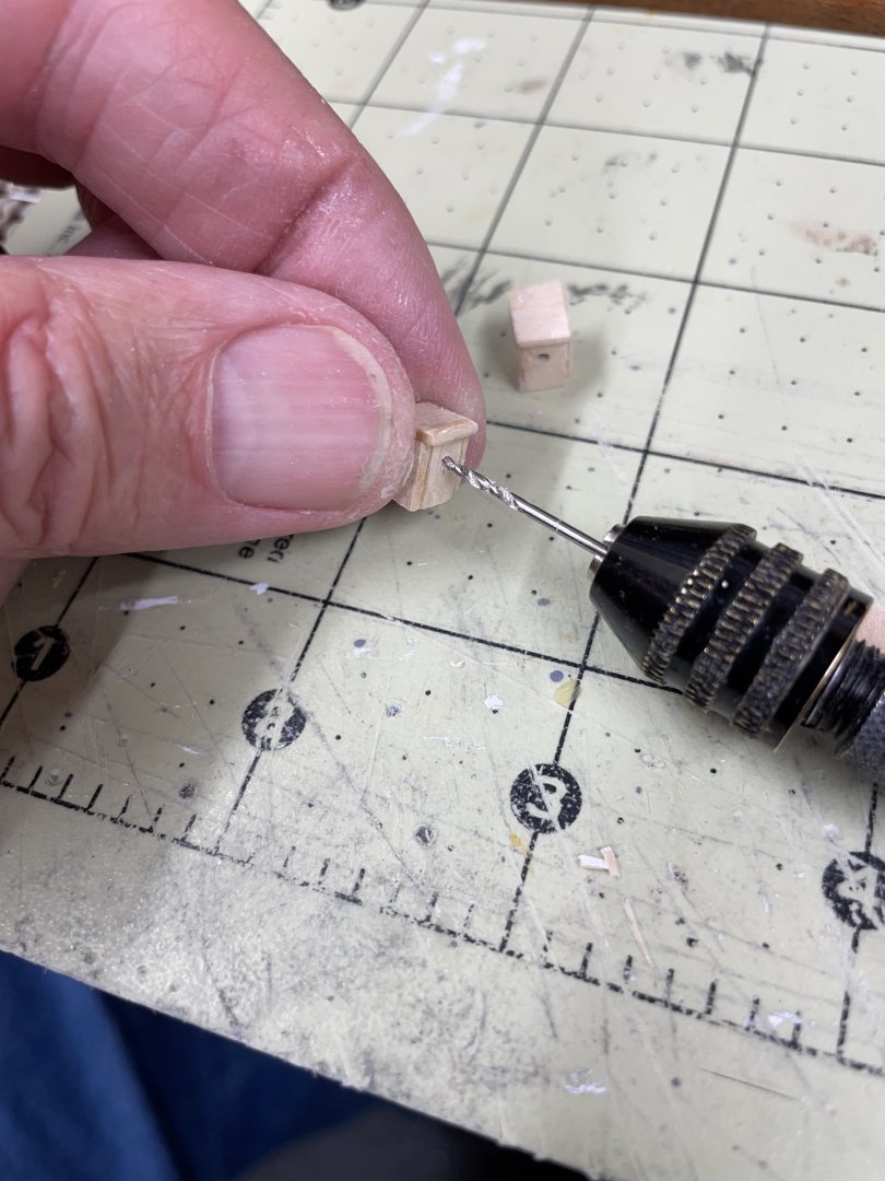

YES! Working on a pair of Catheads now. Drilling out the triple block in the end is challenging. CAN’T WAIT TO START RIGGING. I think some blocks will have to be a painted knot 🪢 LOL 😂

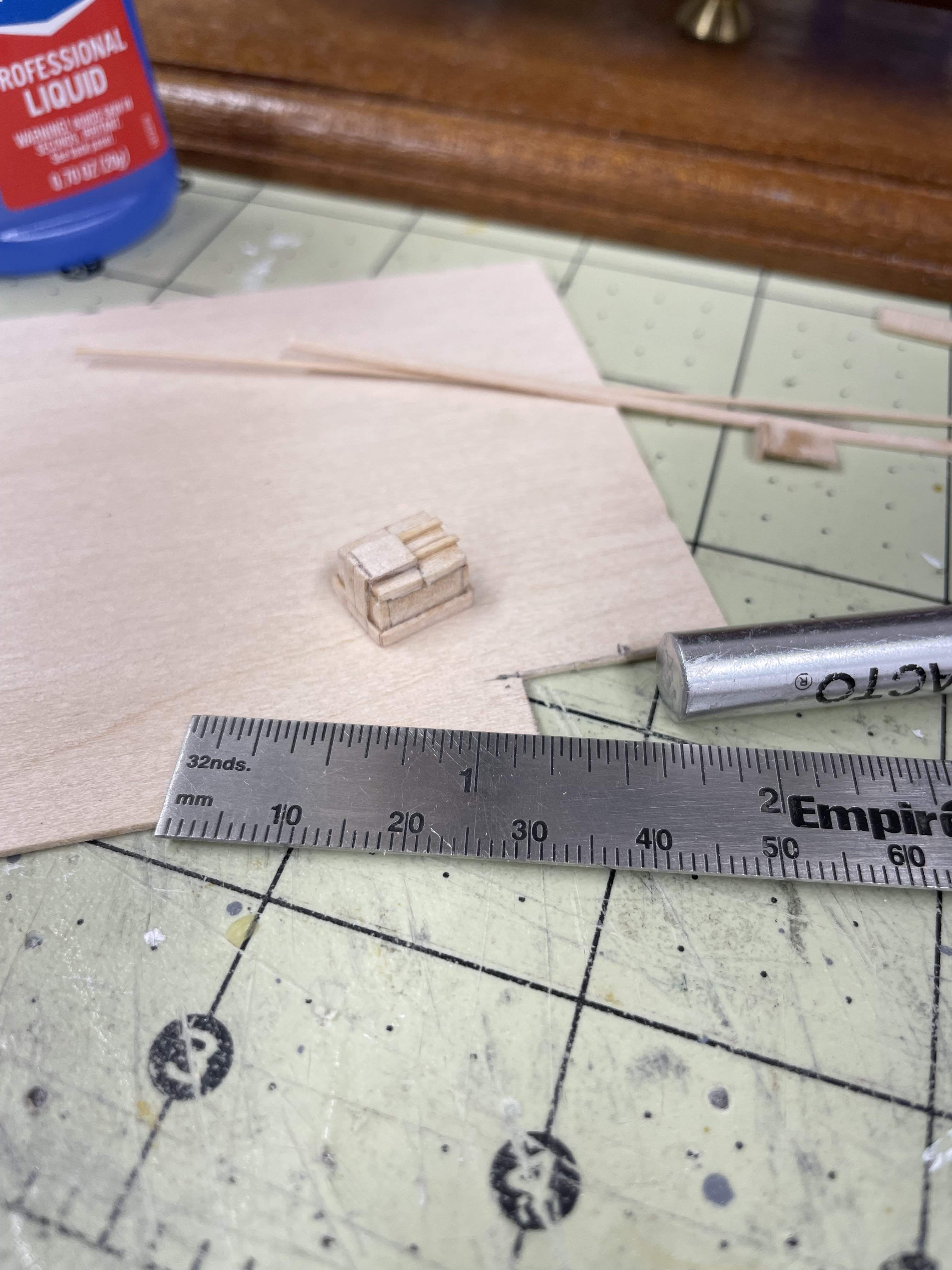

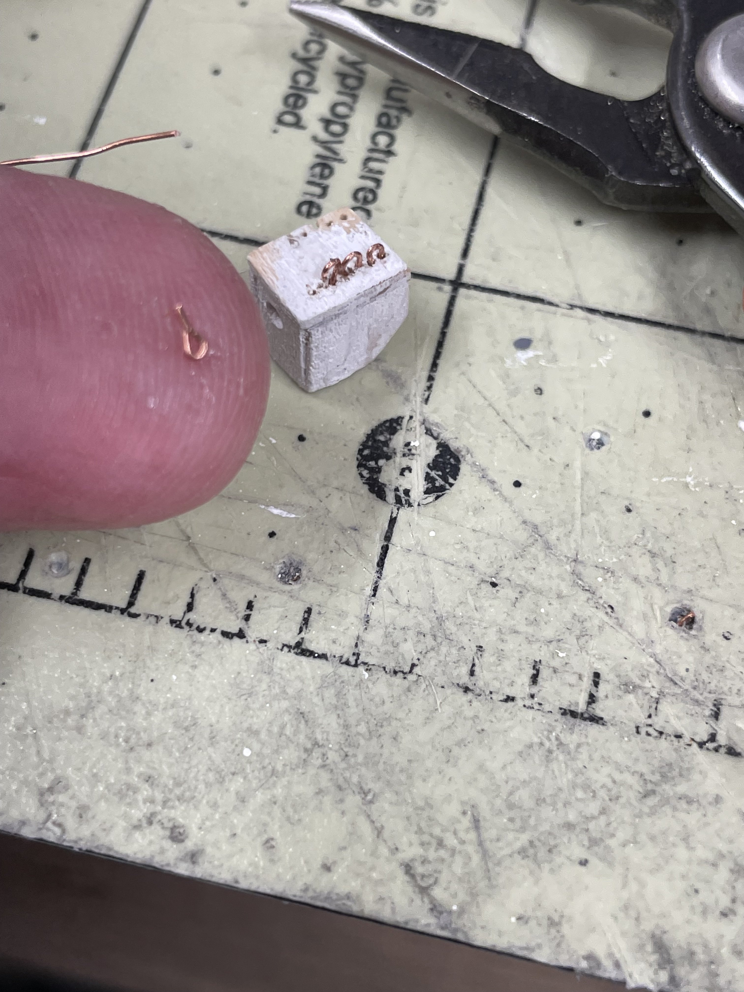

Thanks Bill, You think that’s small, watch this. LOL

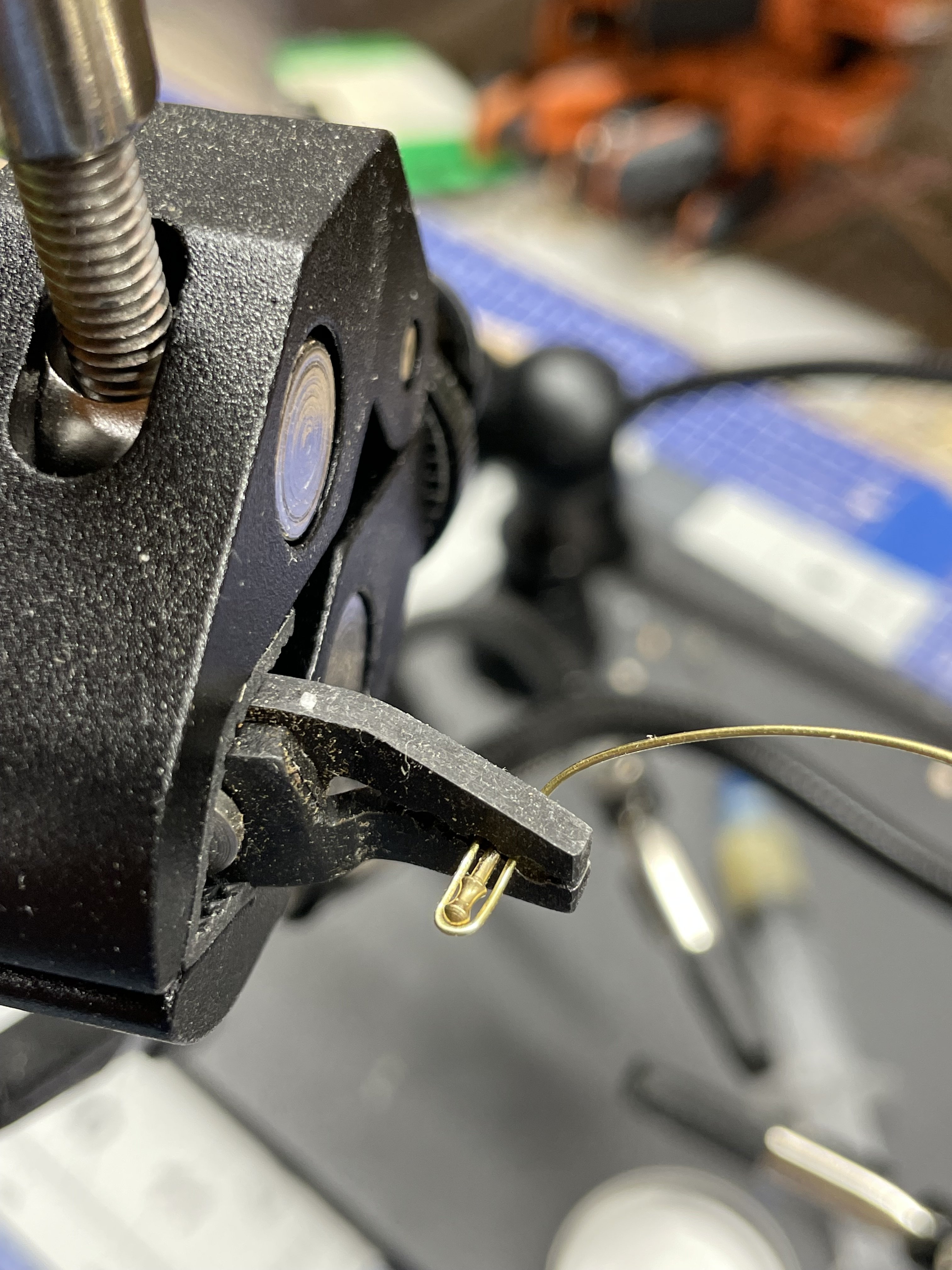

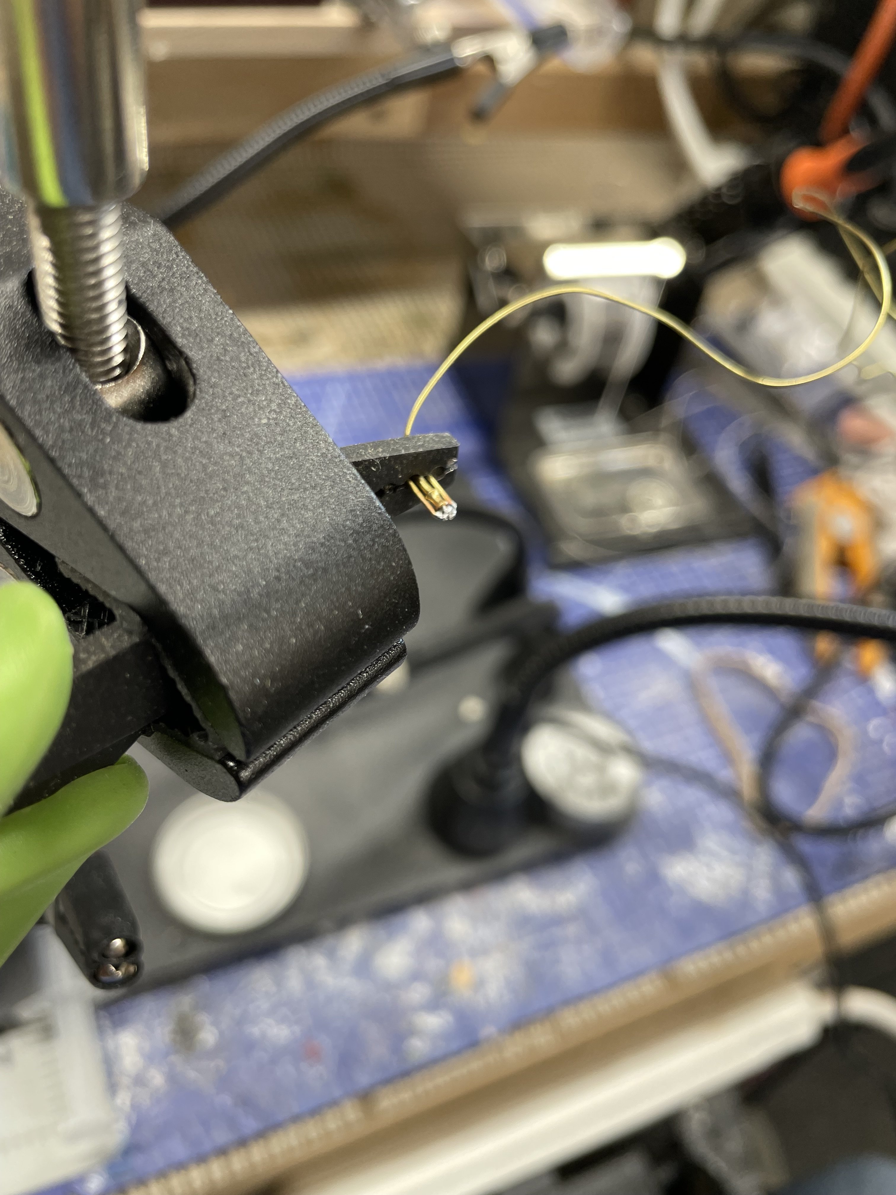

Futtock and upper shrouds on Mizzen Mast…

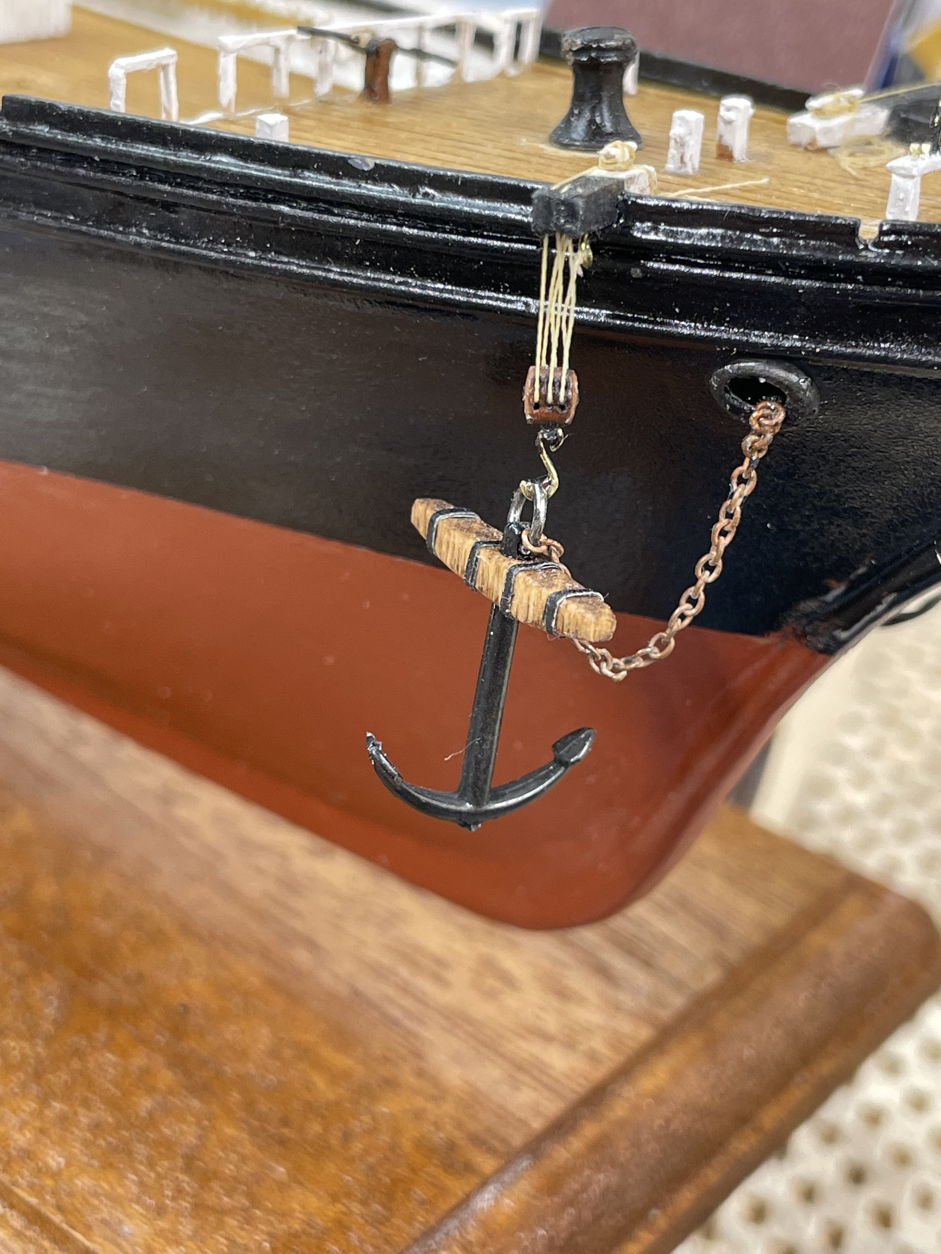

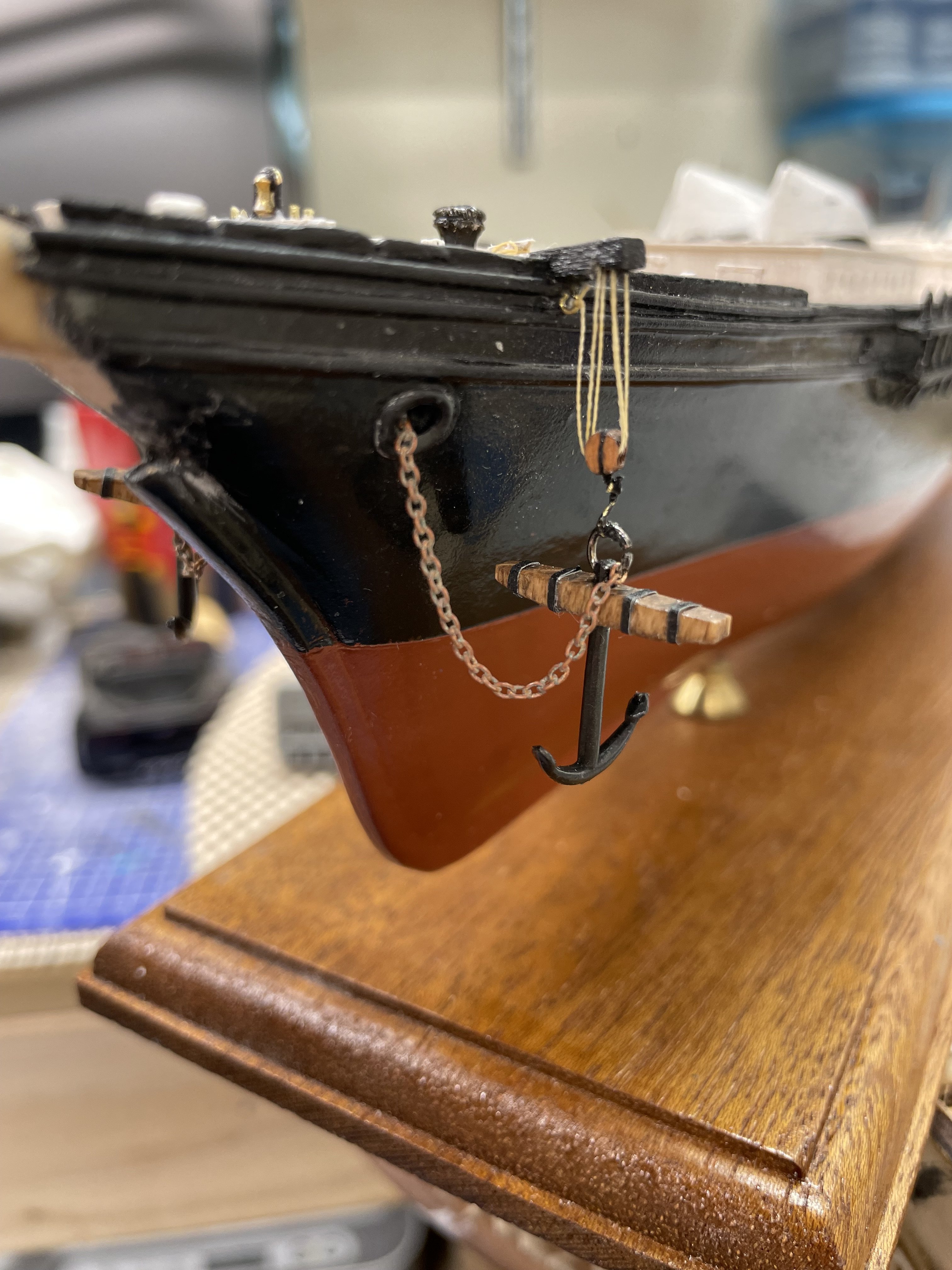

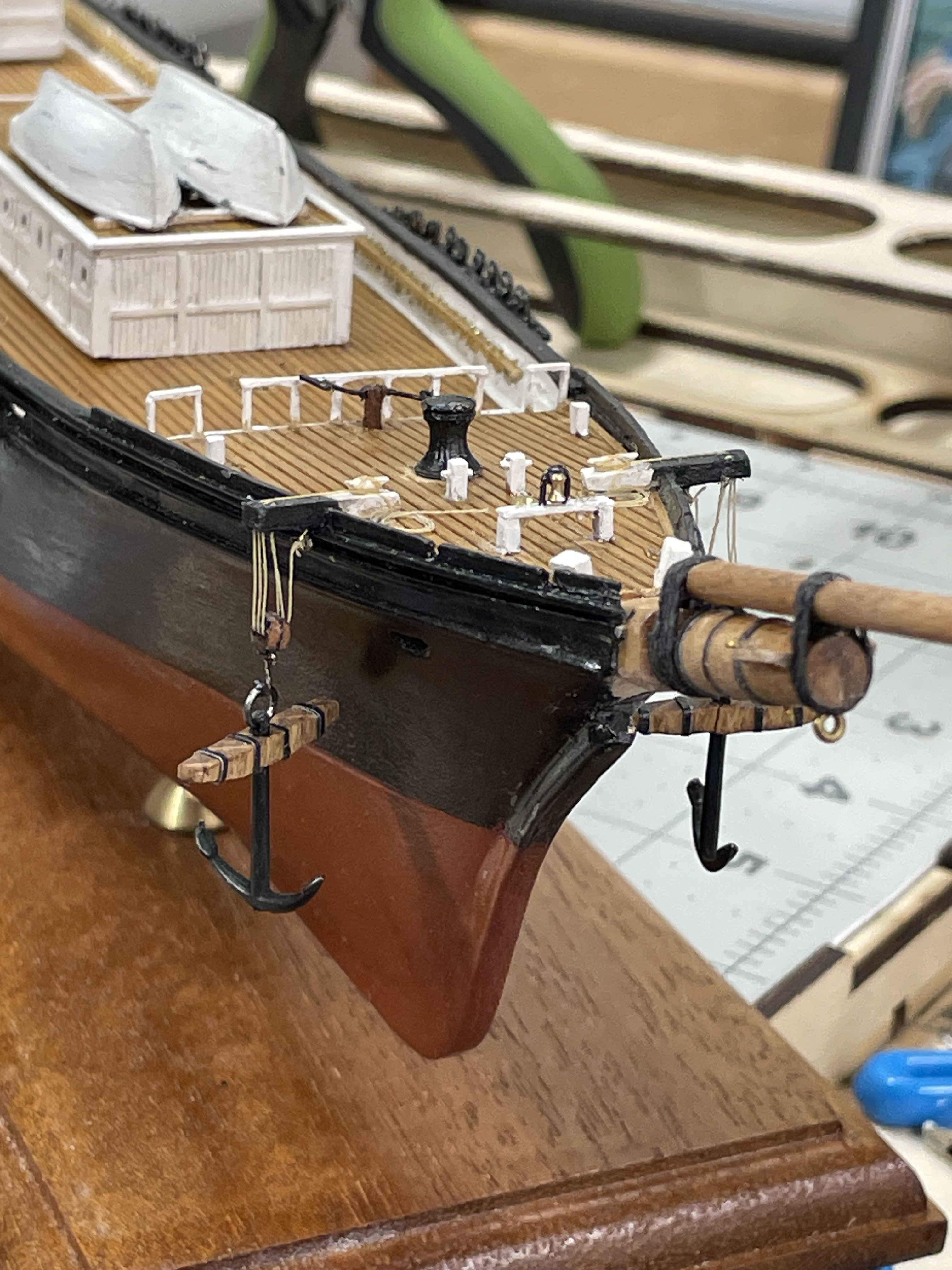

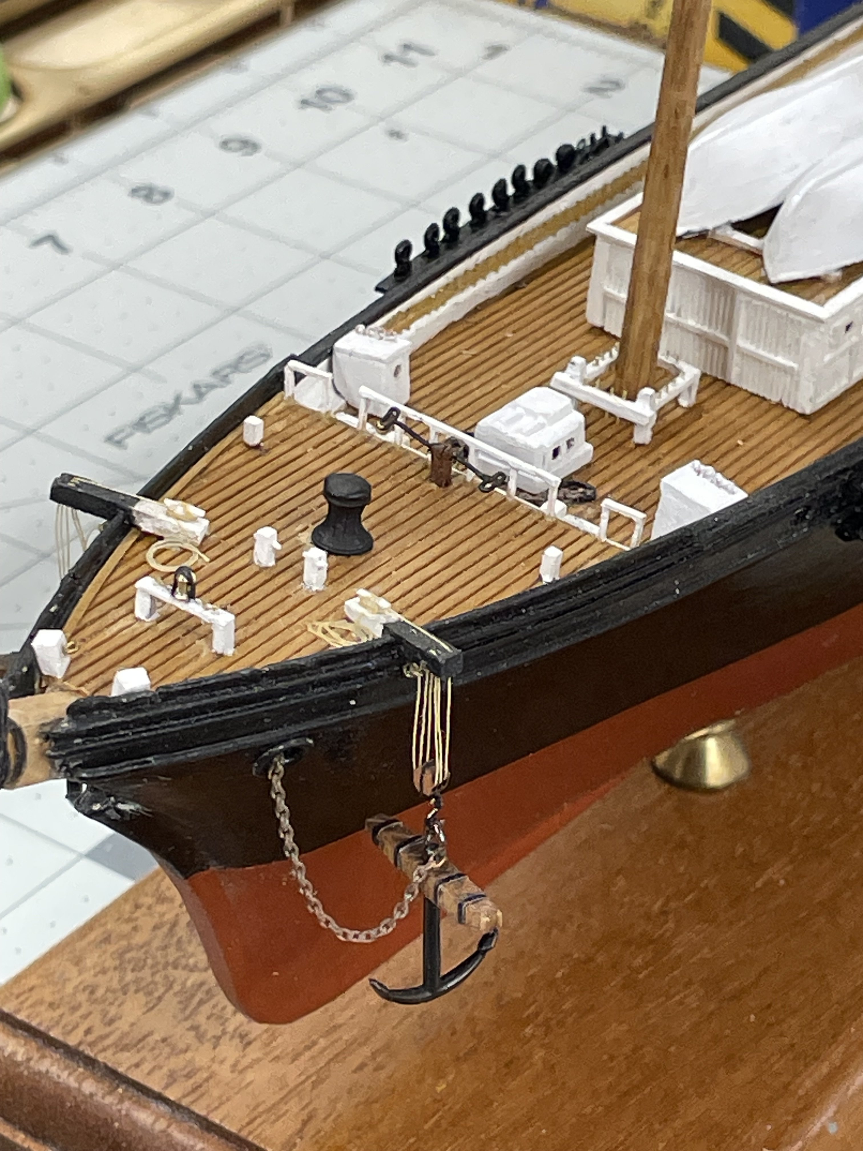

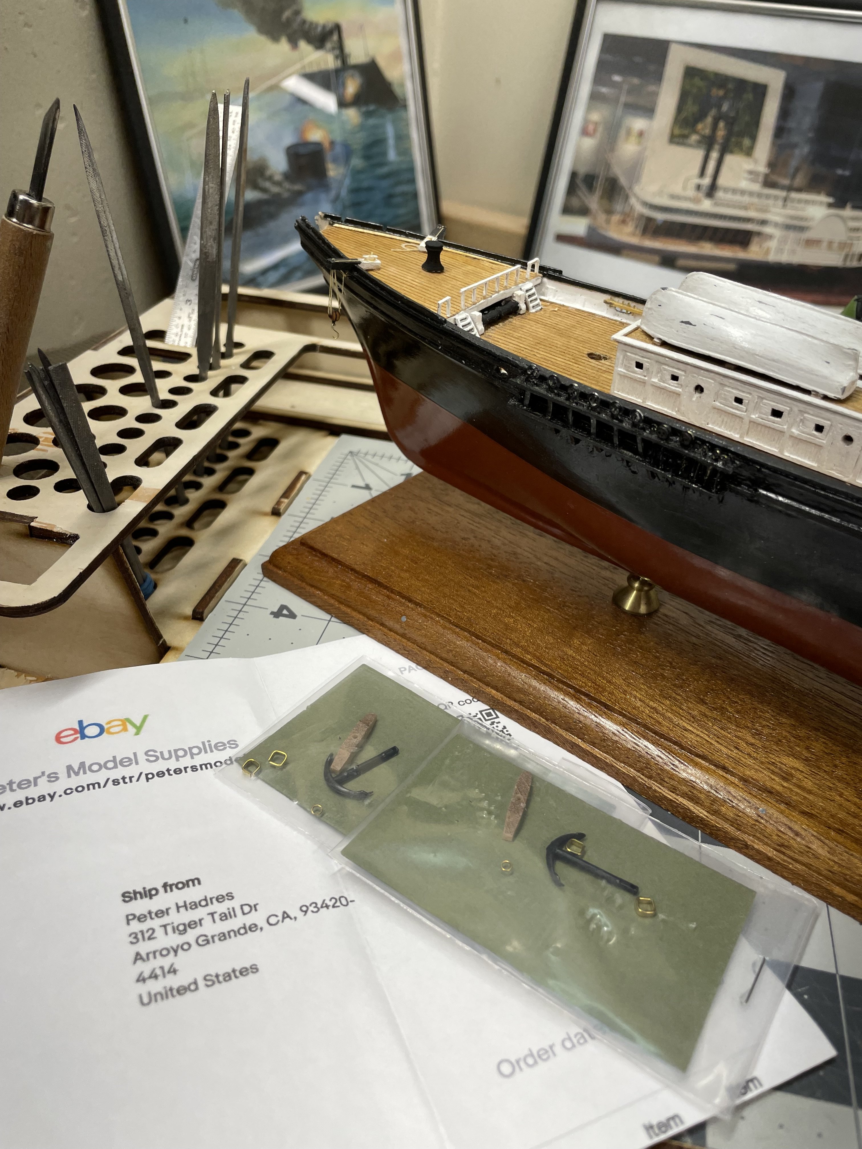

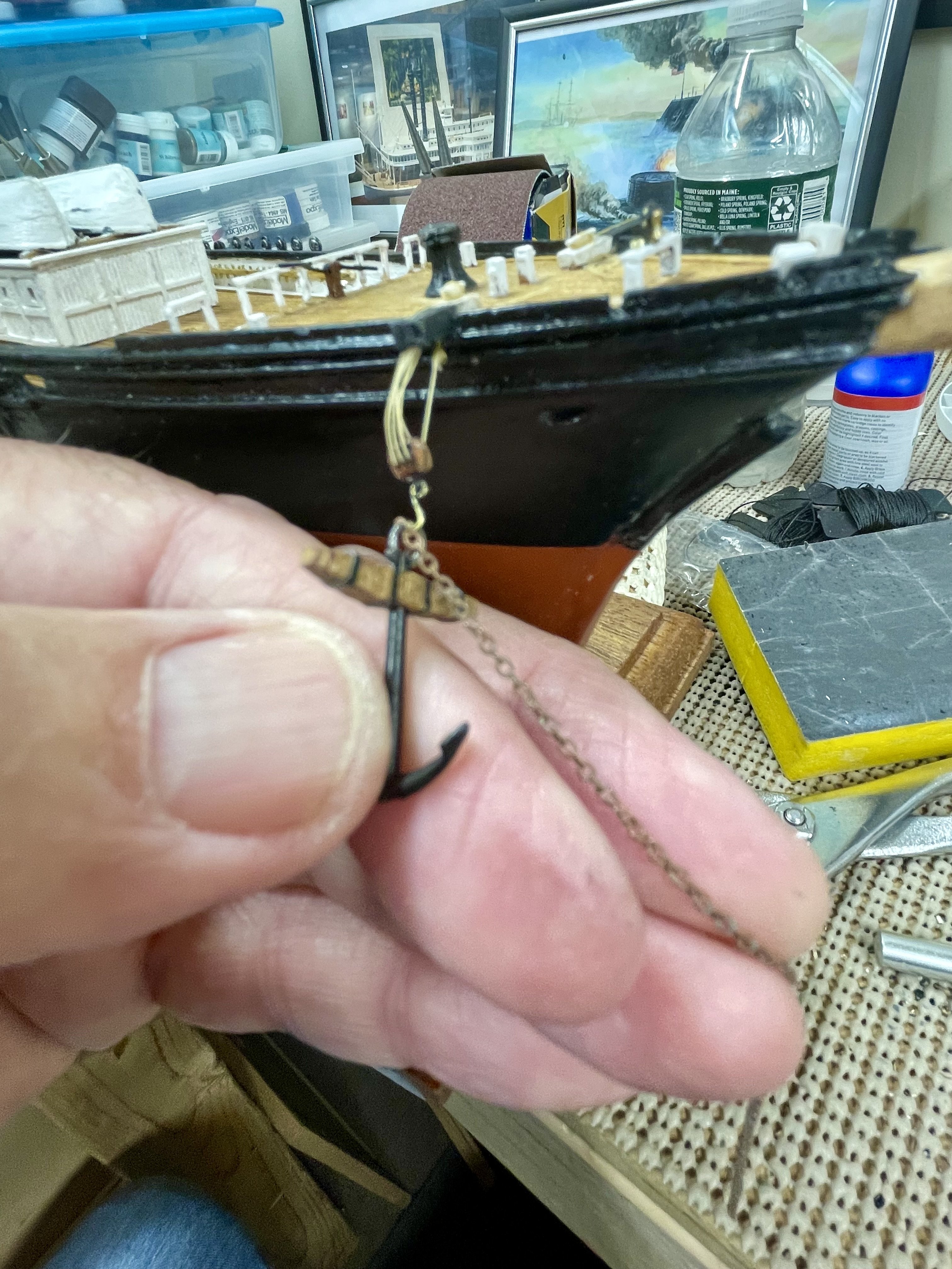

Anchors came in today from Peter’s Model Supplies on eBay. Great sources for parts.
Can’t wait to do Ratlines on this one. Steady as she goes…

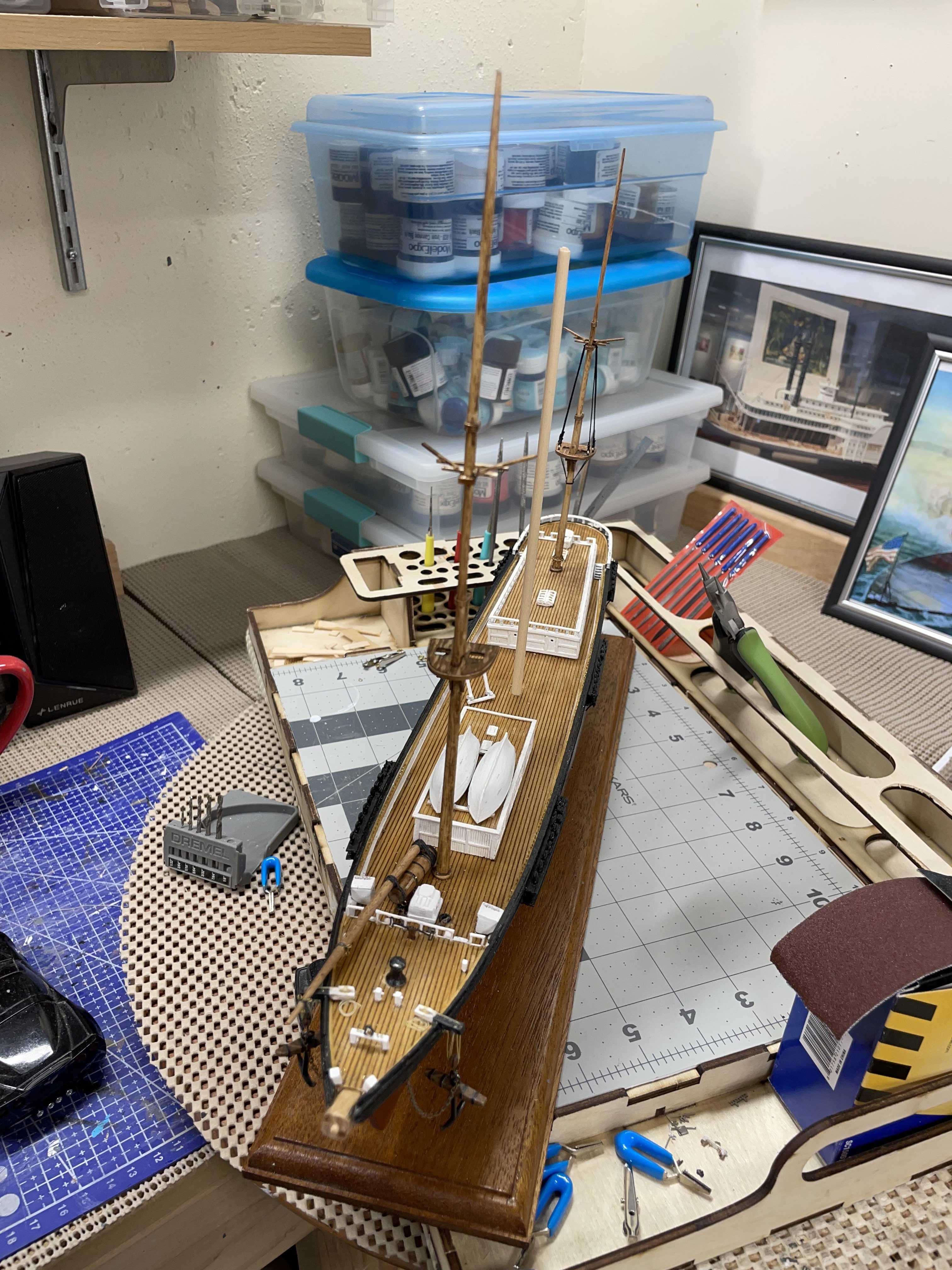

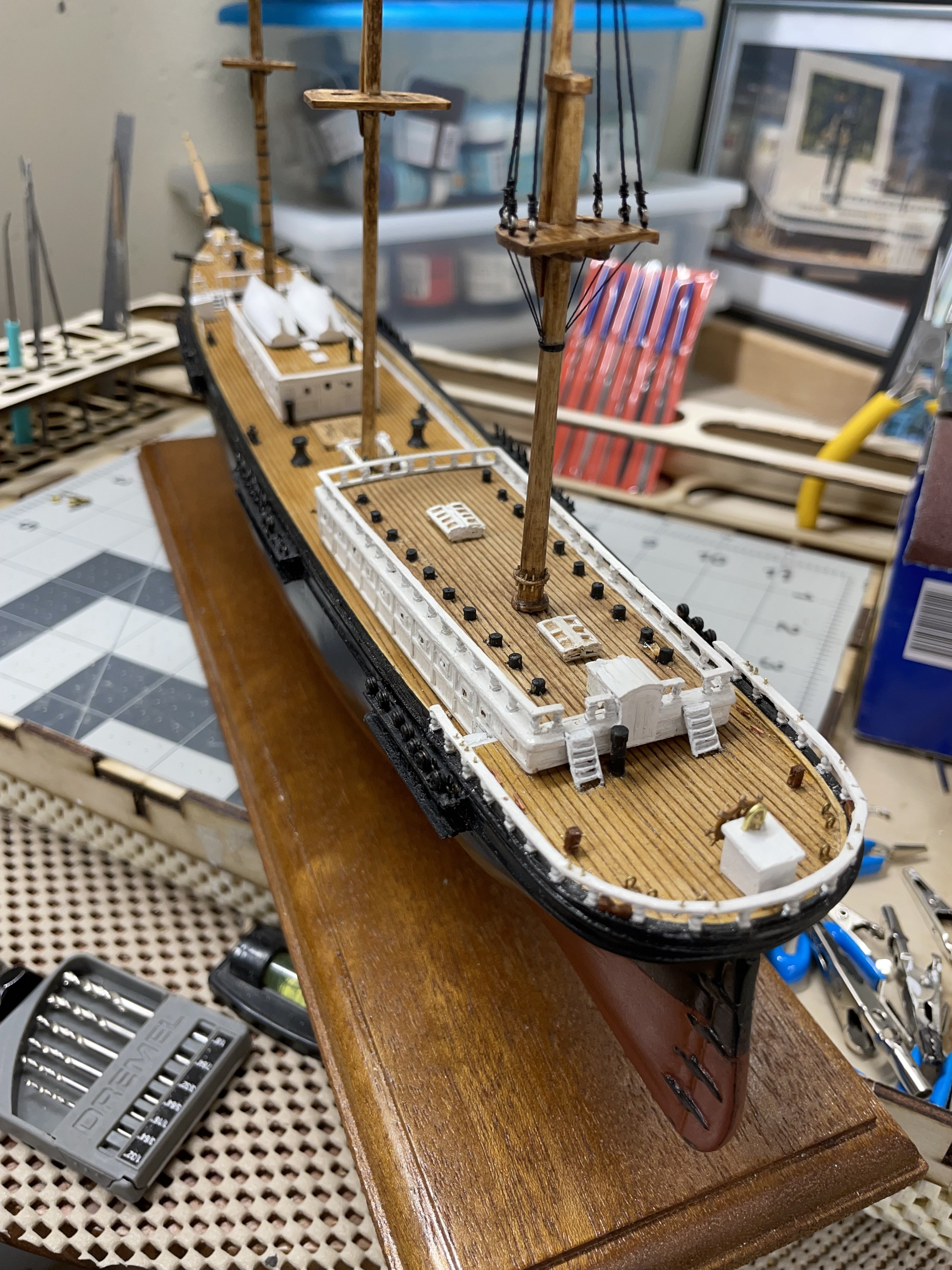

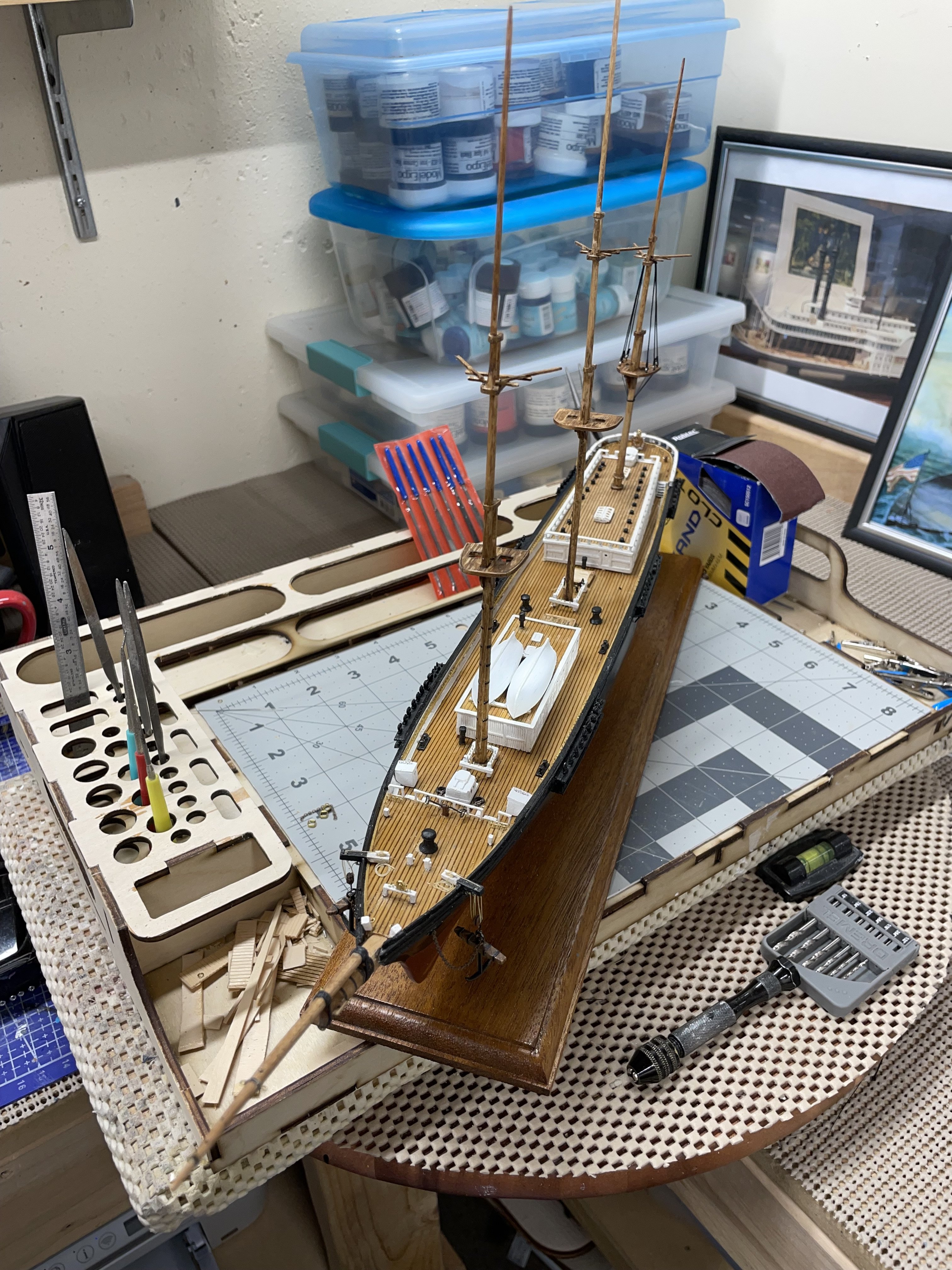

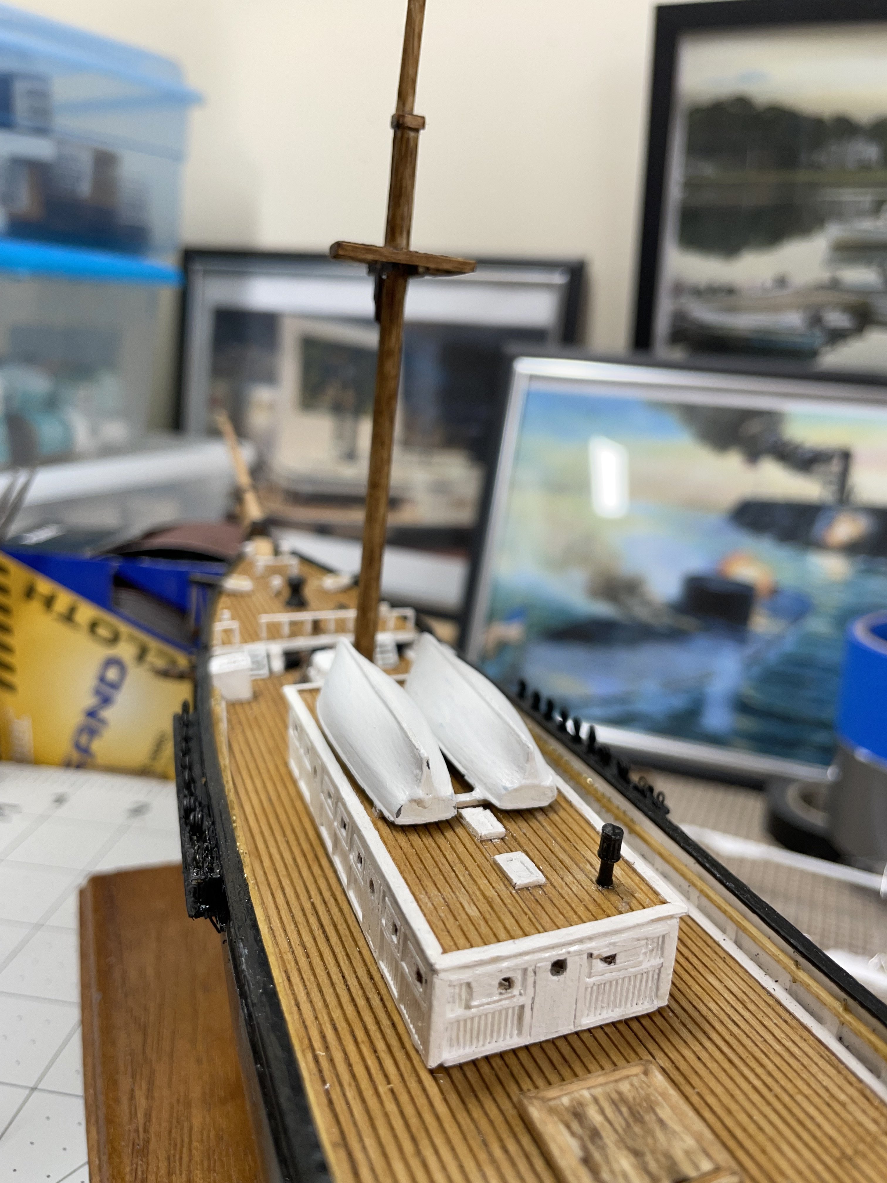

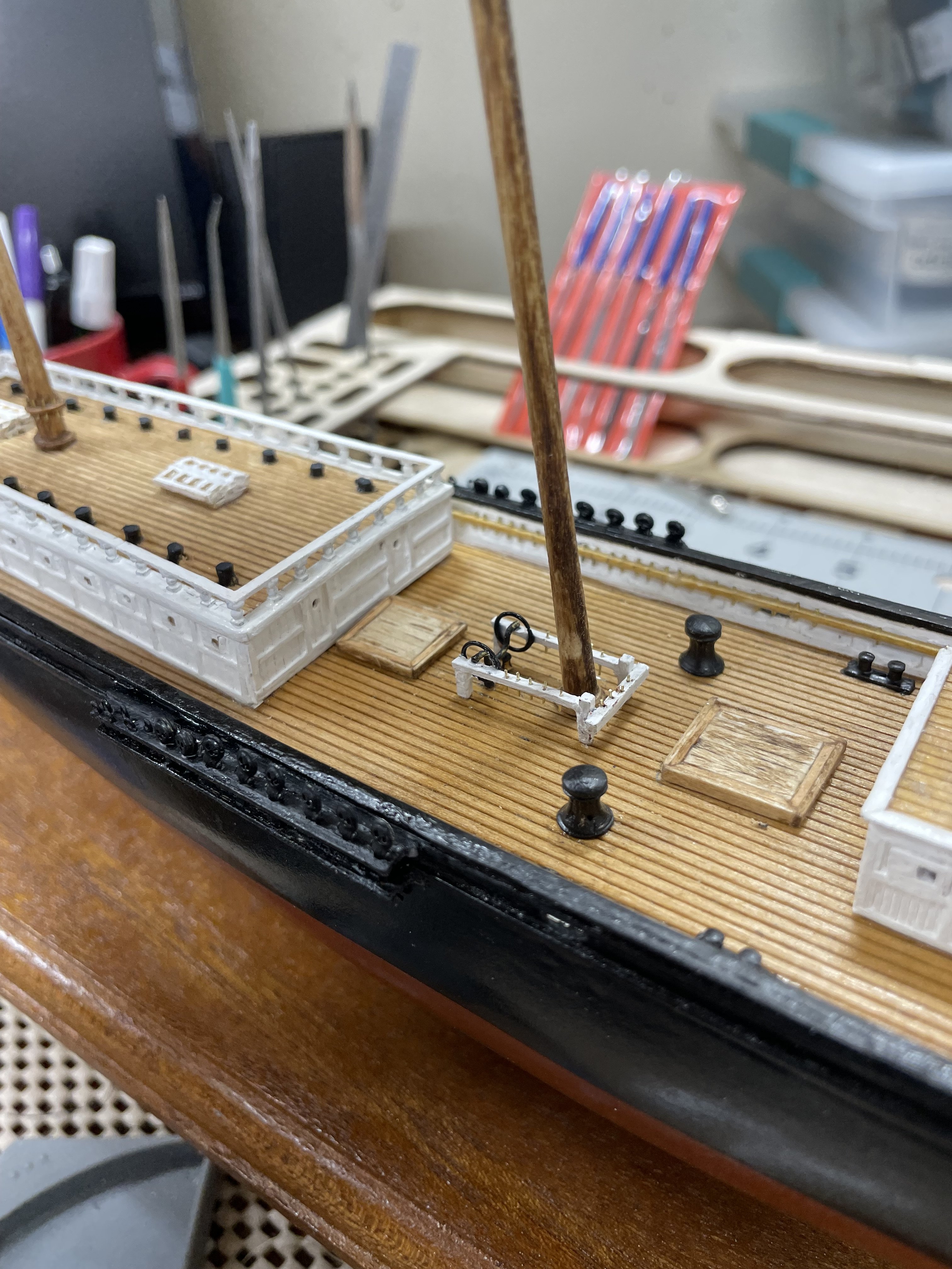

Fore Mast Conpleted…

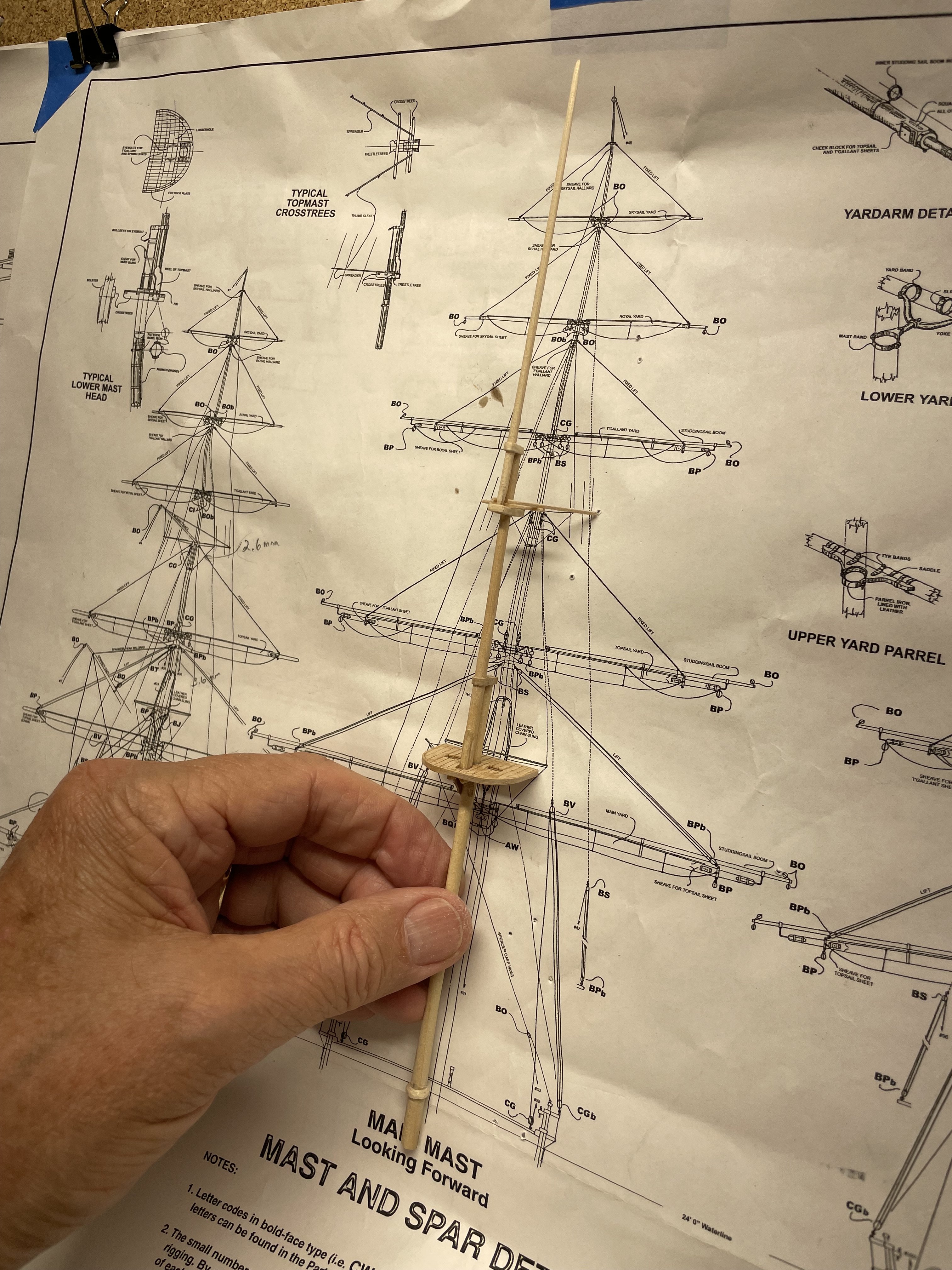

Mizen Mast completed earlier in the build. Here are the steps to building the Main Mast.

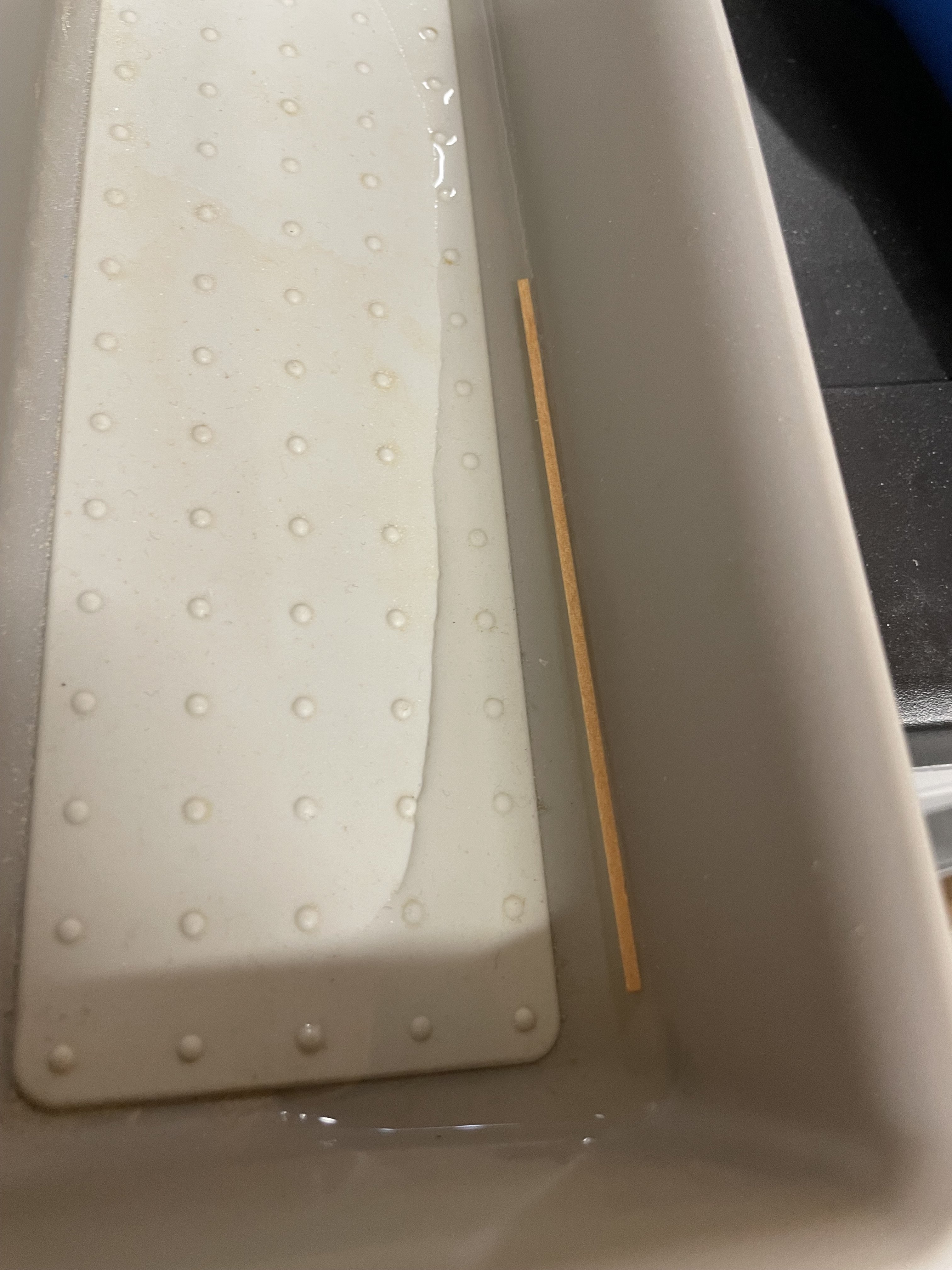

Soaking bass wood in 100% clear ammonia for bending.
Masts now ready for rigging attachments prior to shroud placement. However, I need to go back to finishing the deck furnishings to included the fife railings, before any shroud work can be done.
 Cheers 🍻
Edited by John Ruy
Ammonia! Hope you had good ventilation for that!! I have unpleasant memories of working with reagent grade concentrated ammonia. It stinks a lot worse that cyanoacrylate glue (CA)!
Dows it really work better than warm water?
Phil

I believe it’s a bit quicker than warm water.   I use so little of it at a time fumes don’t seem to be an issue. But then I don’t notice the CA glue either. 😜

Rob, With a little research here on MSW you can find that Ammonia isn’t recommended for plank bending.
However, it does break down the wood fibers quickly allowing for bending quickly, but may damage the wood in the long run. For my purposes (very small pieces) it works well, as I use CA glue to hold these pieces in place. The CA glue adds another controversial component, as well.  🧐

... 100% NH4 ? (Lab grade ammonia)  That would be a powerful base and dangerous.  Perhaps a 'full strength' household ammonia was used (a guess).  In another build a triangular file was used to press  a little into the back side of a plank to be bent to make a series of indents along the backside in the area to bend. (I can't locate the image right now.)  I mean to experiment with this idea - and some water soak may assist.

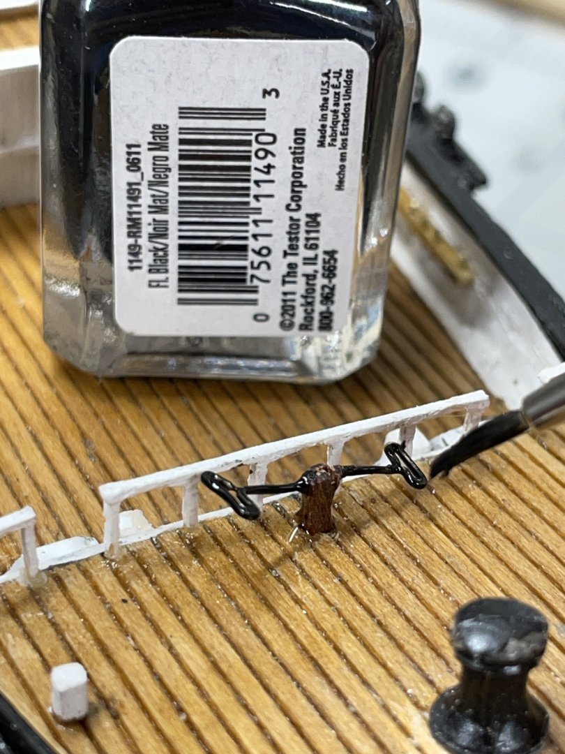

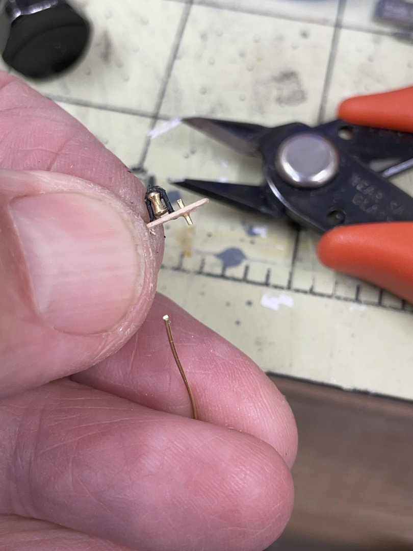

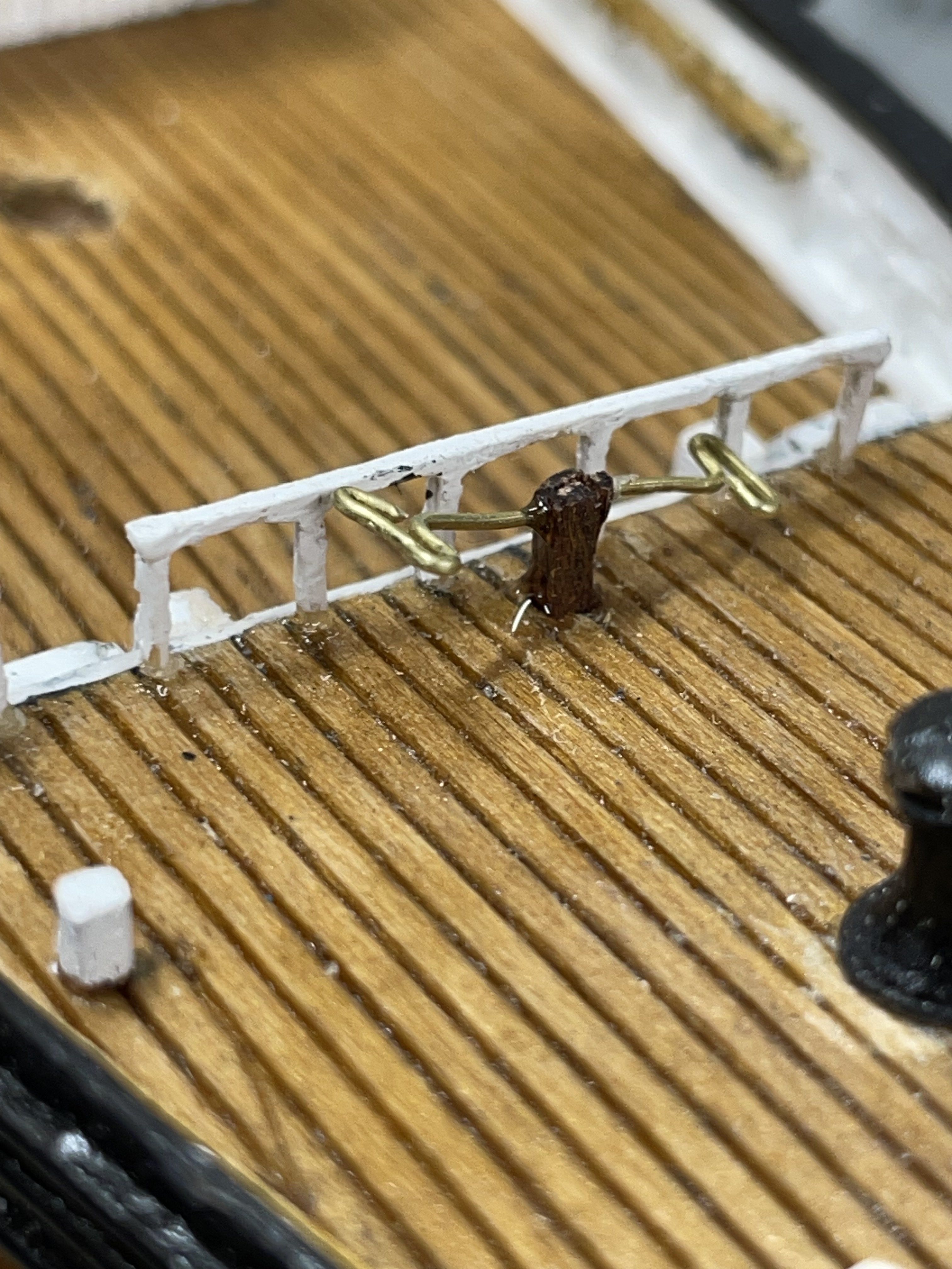

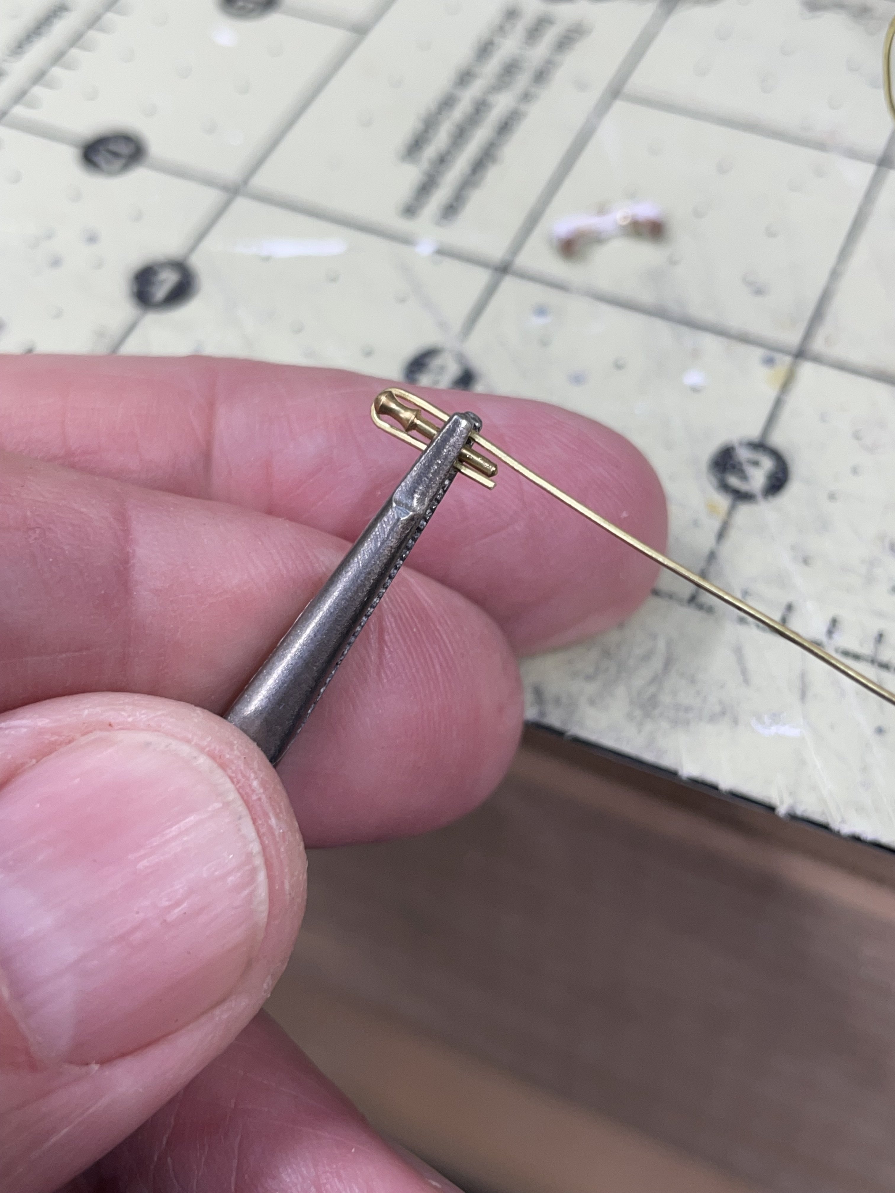

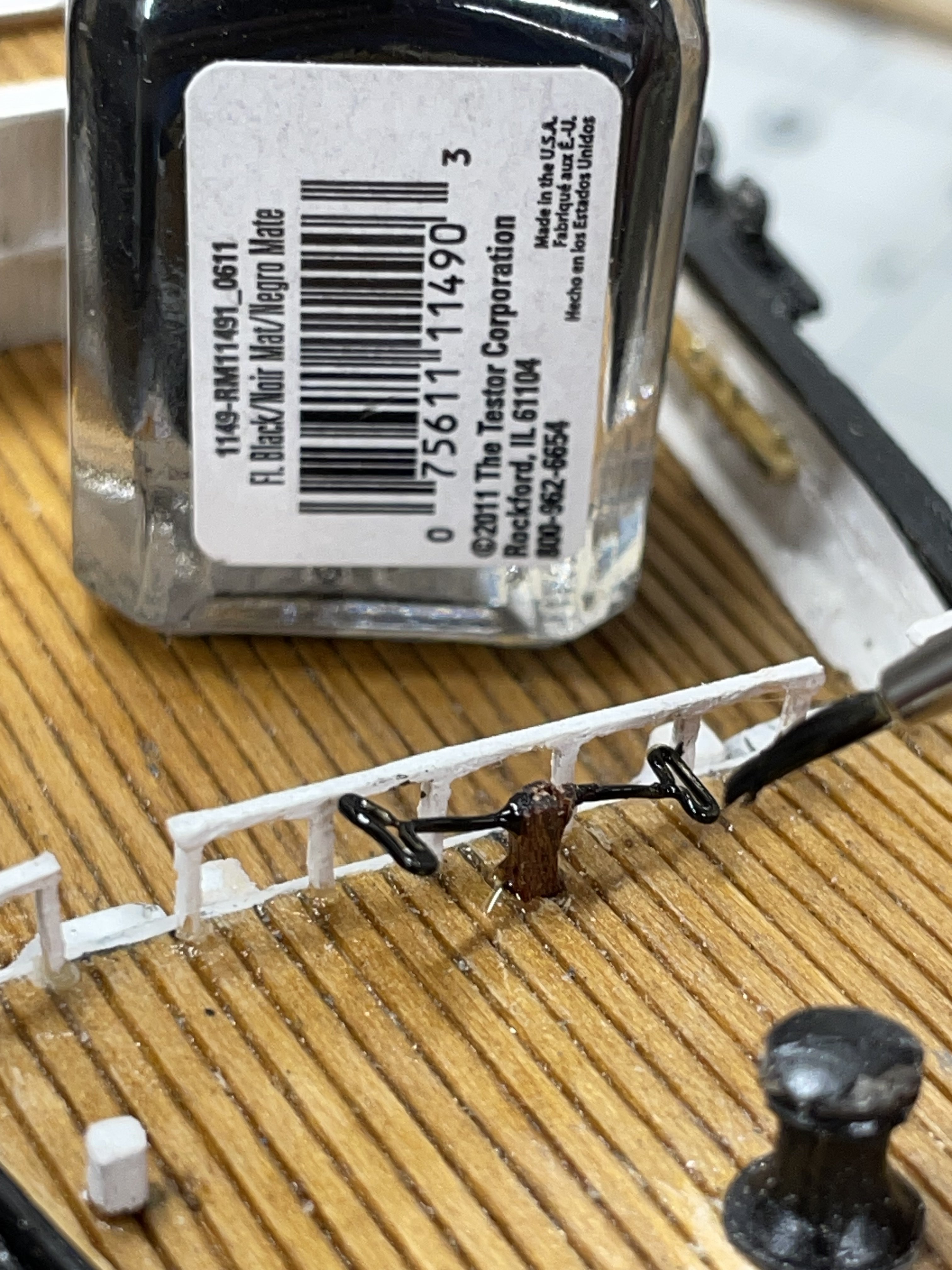

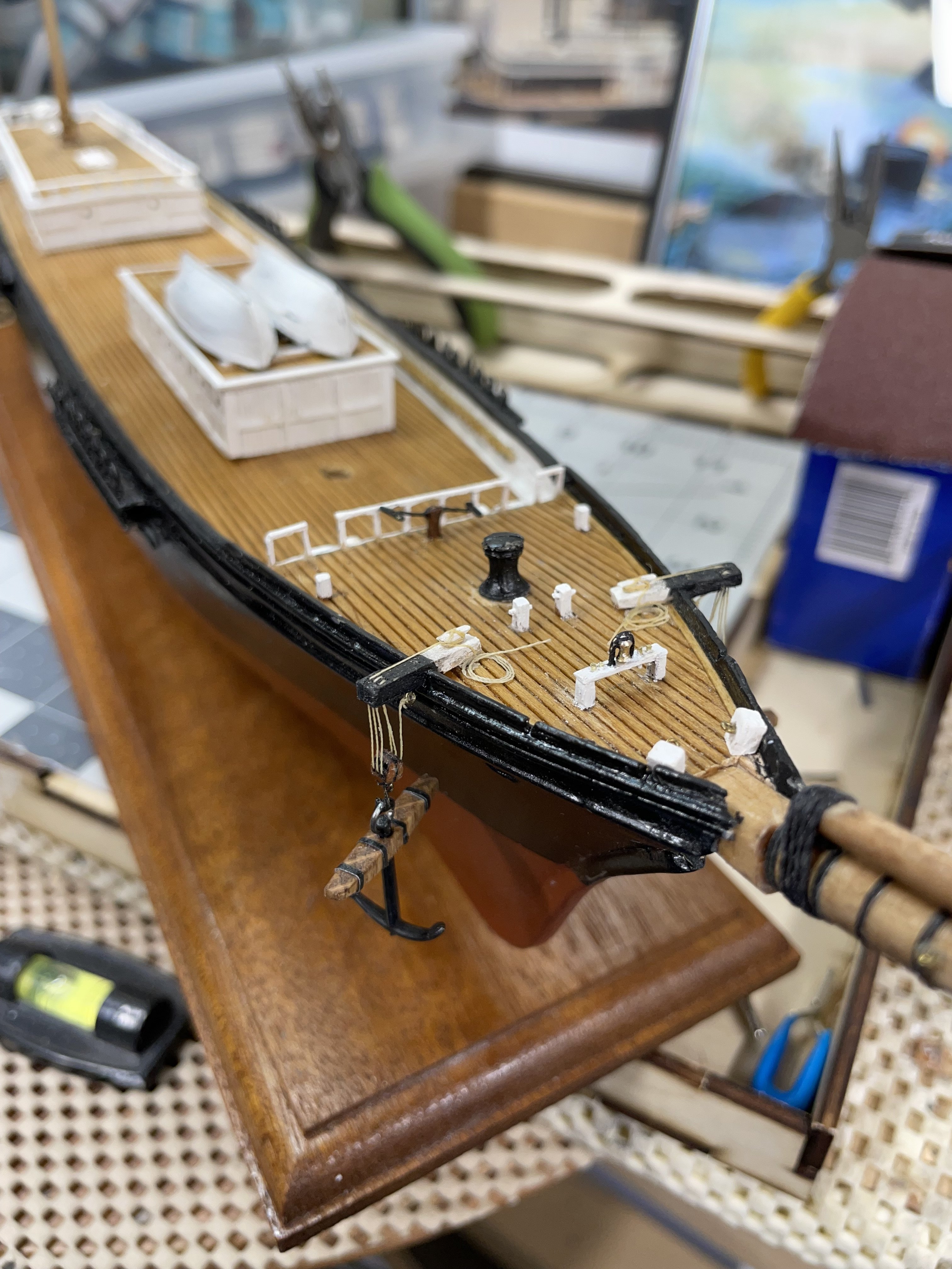

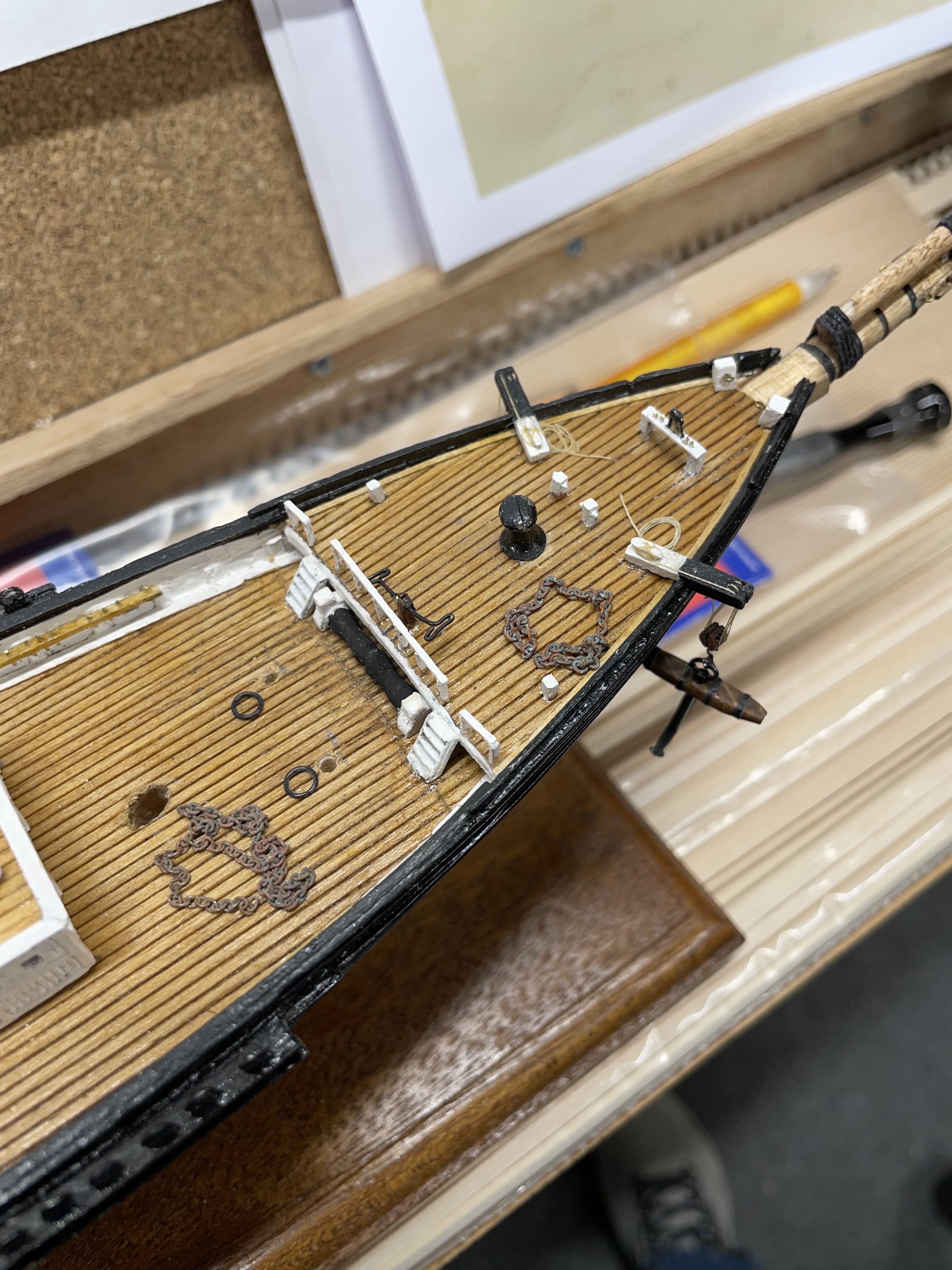

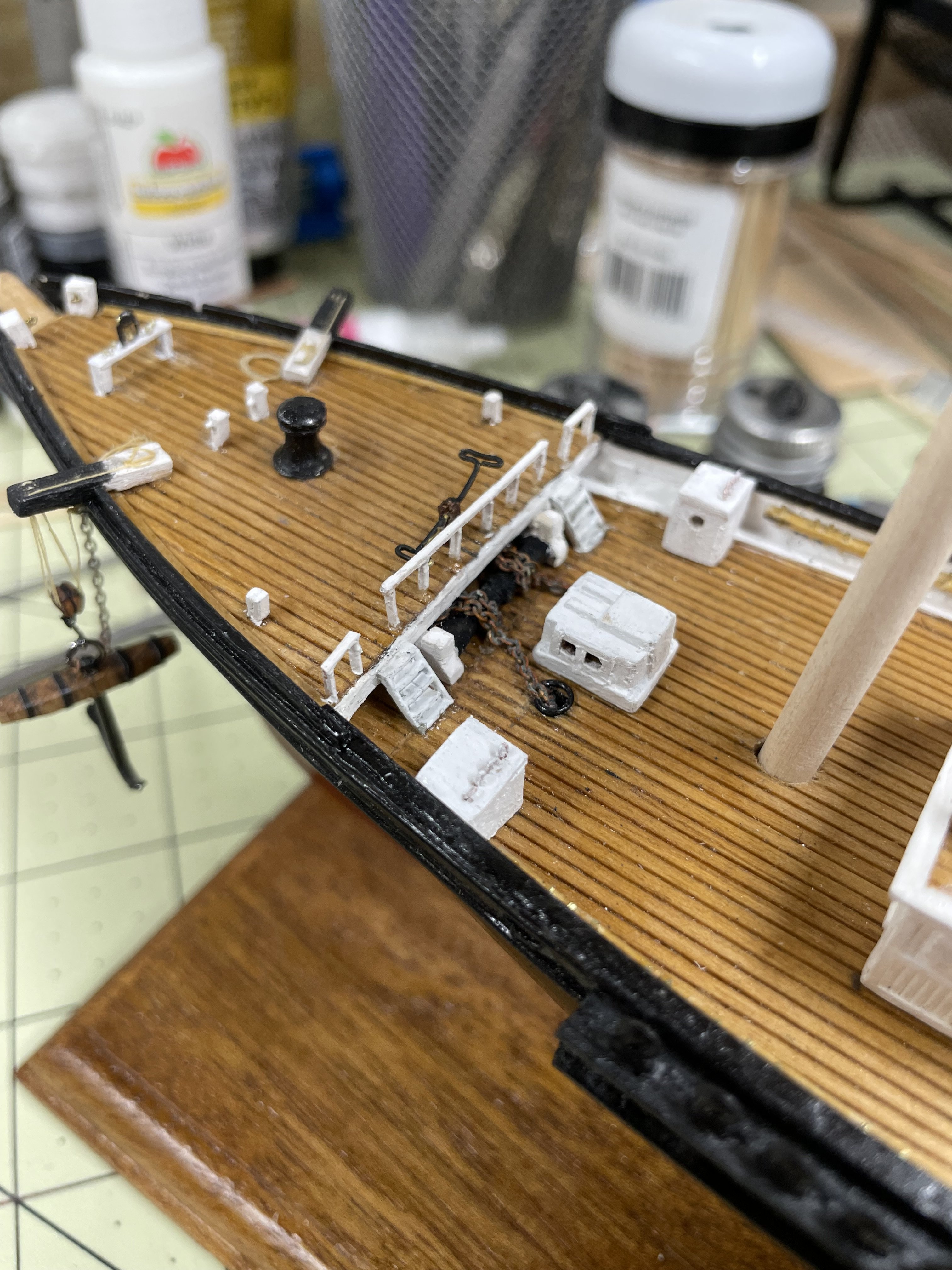

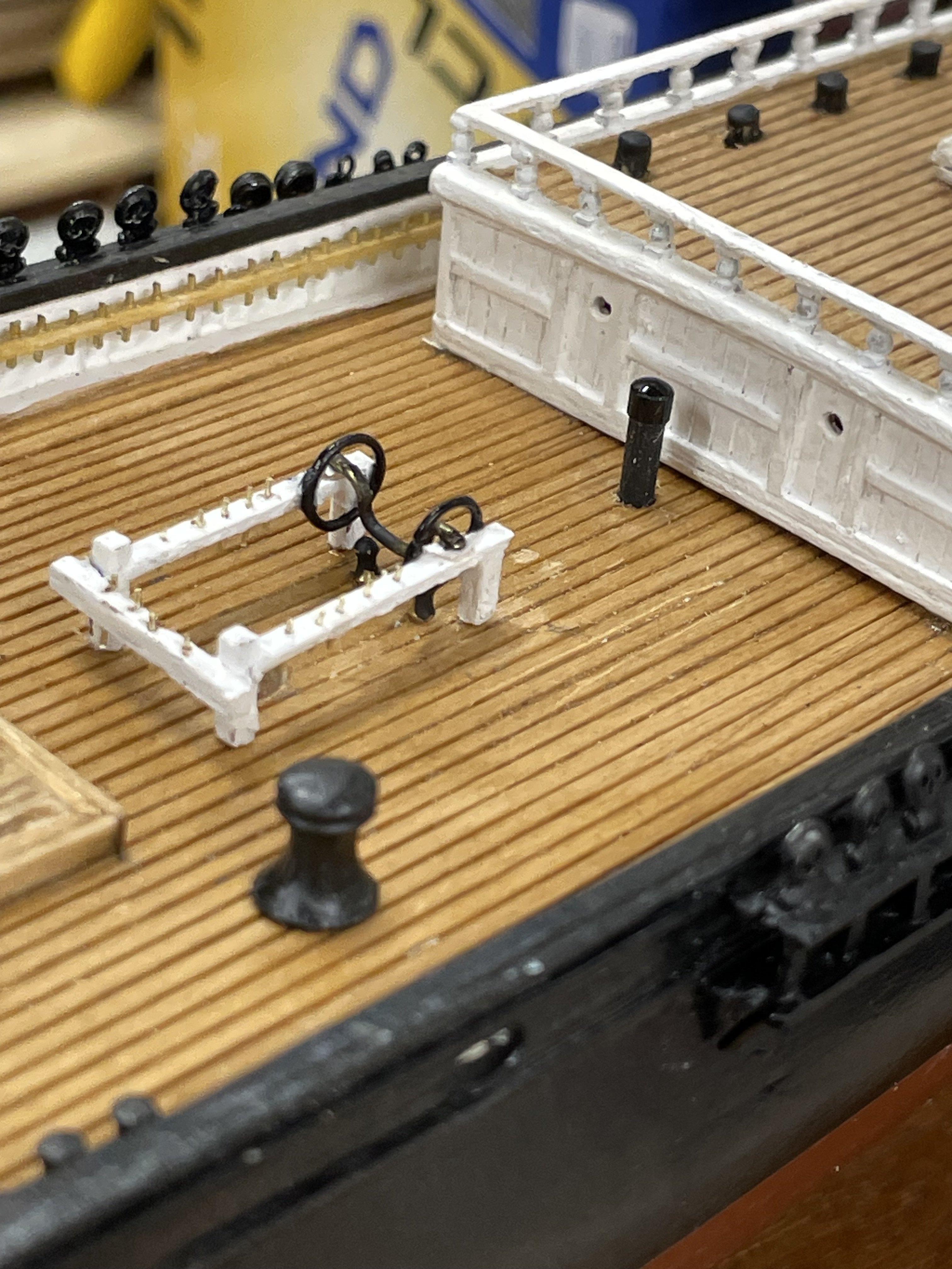

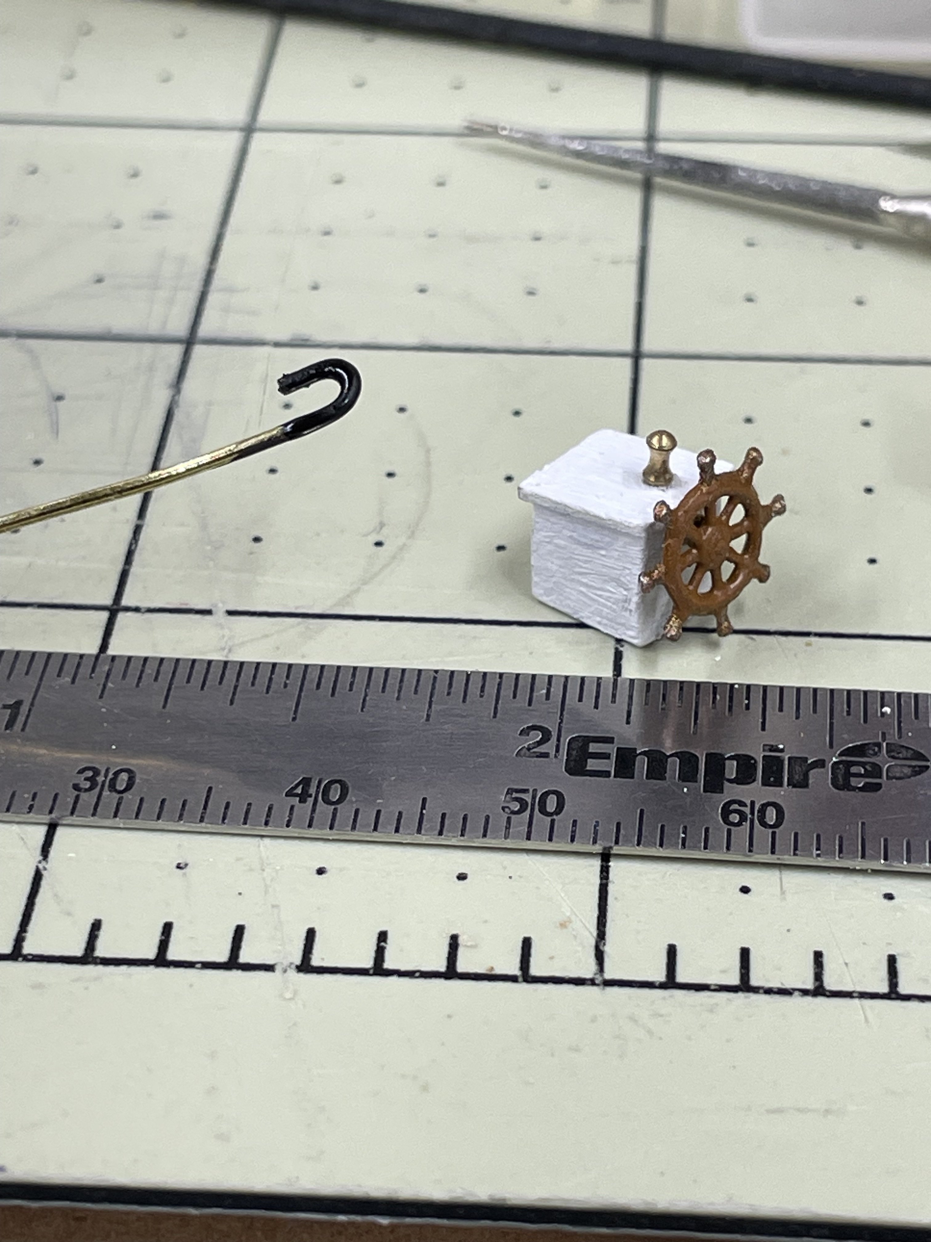

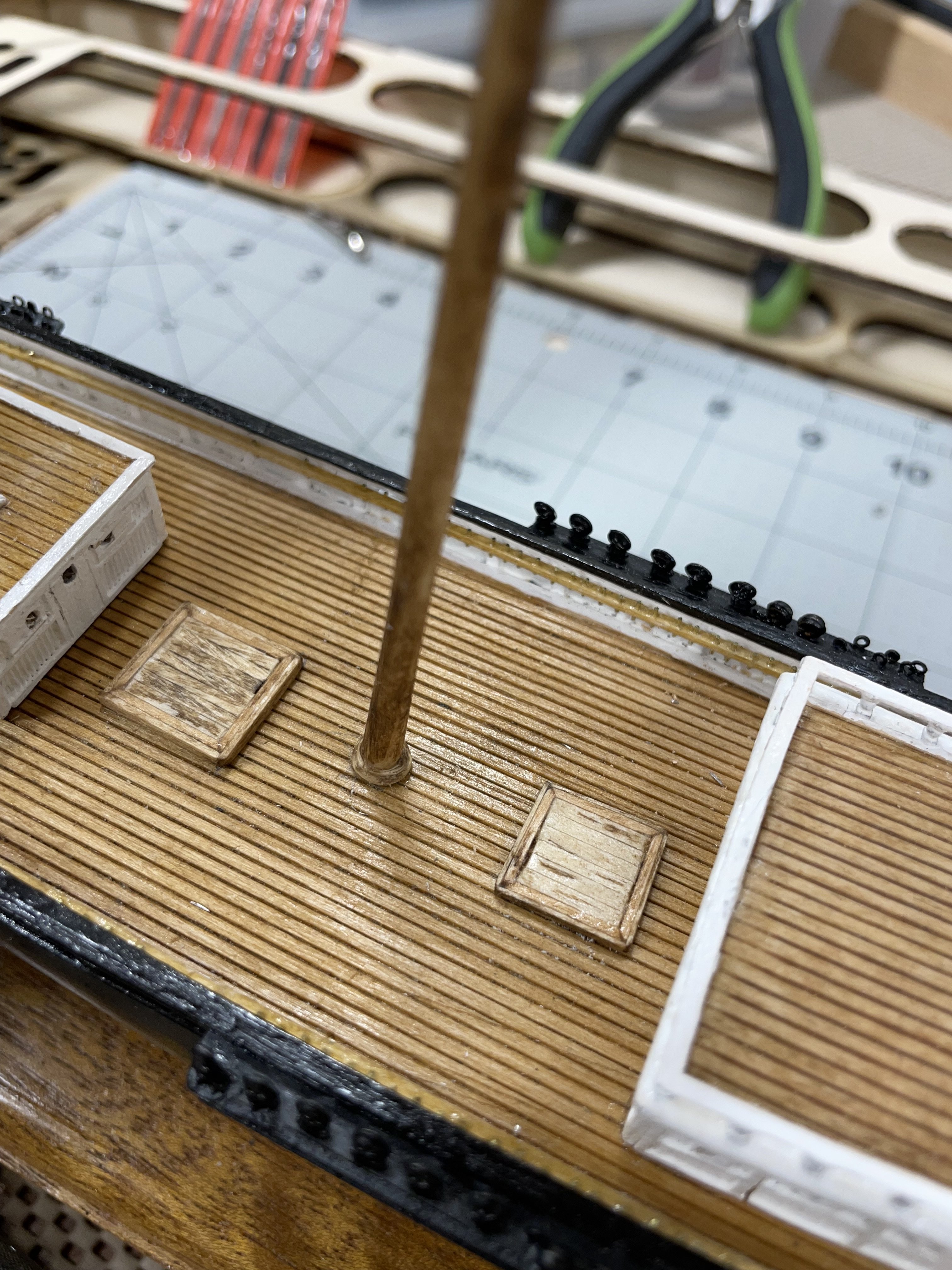

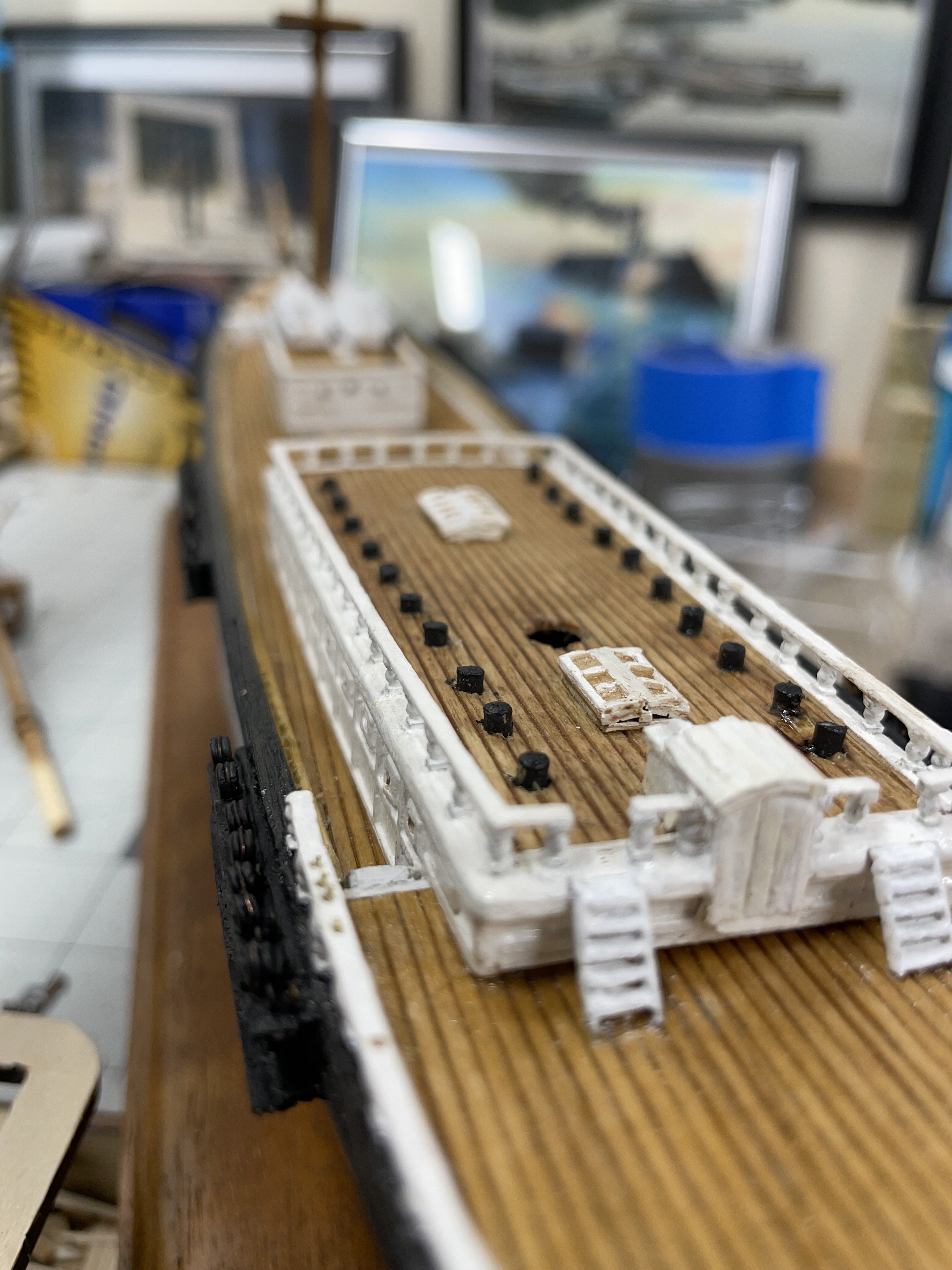

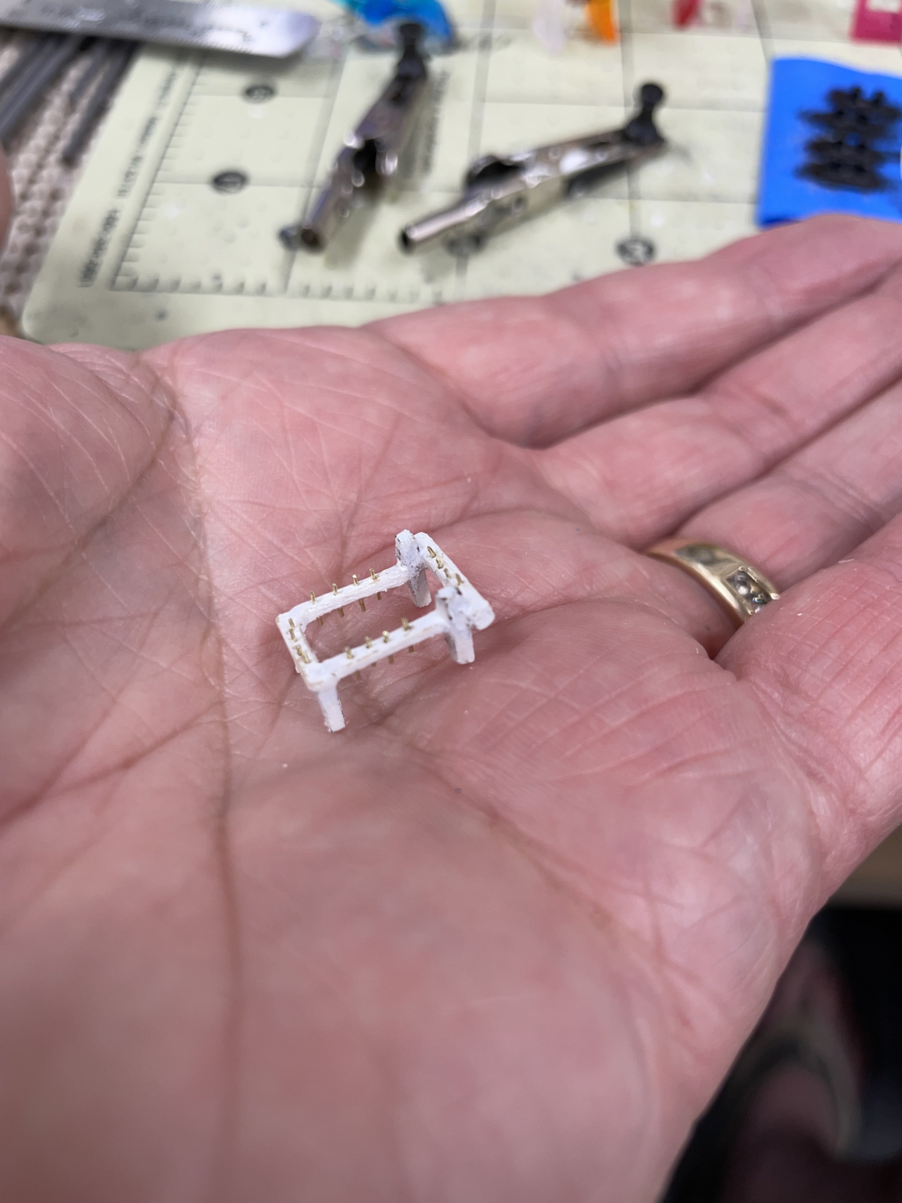

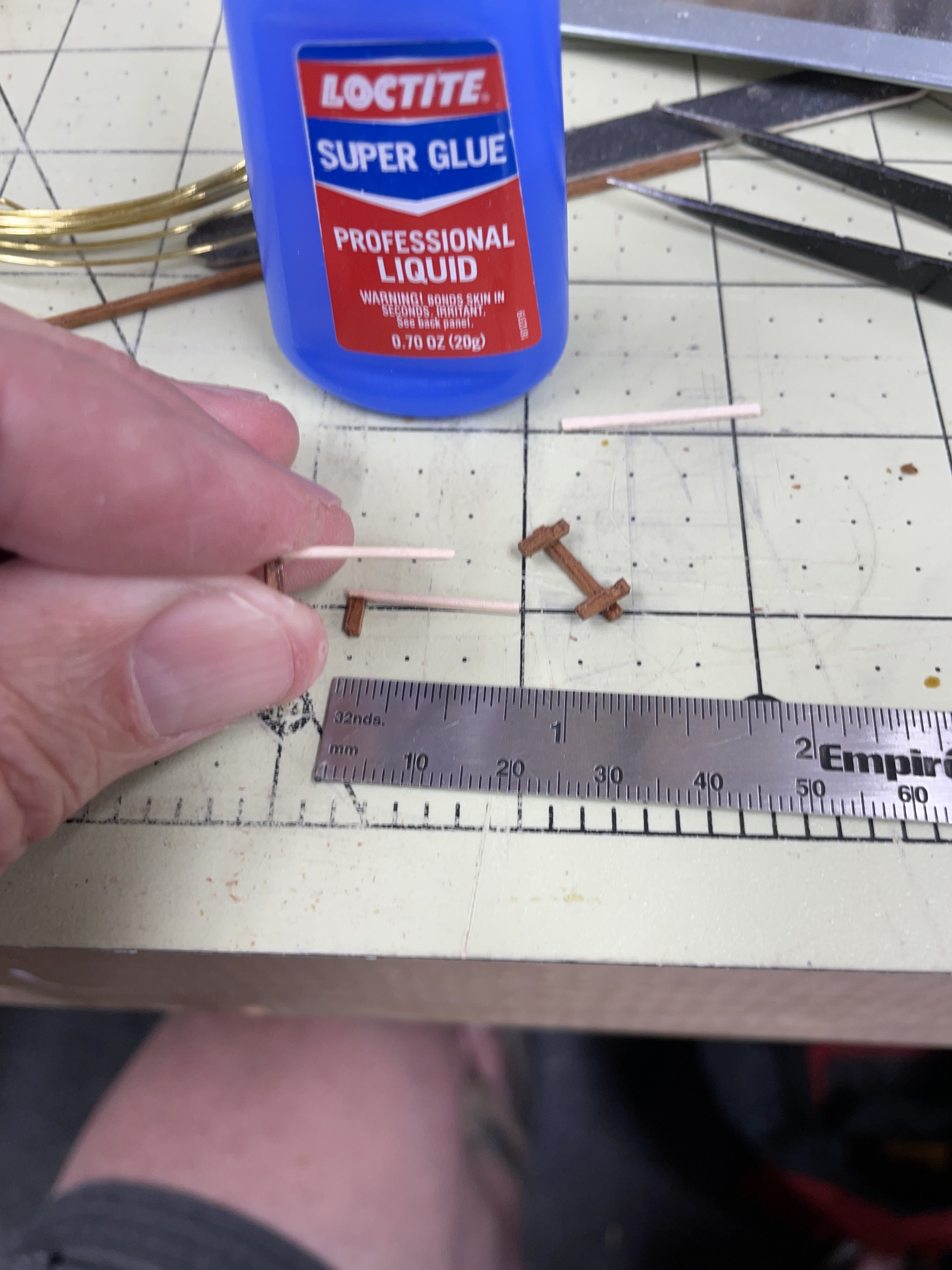

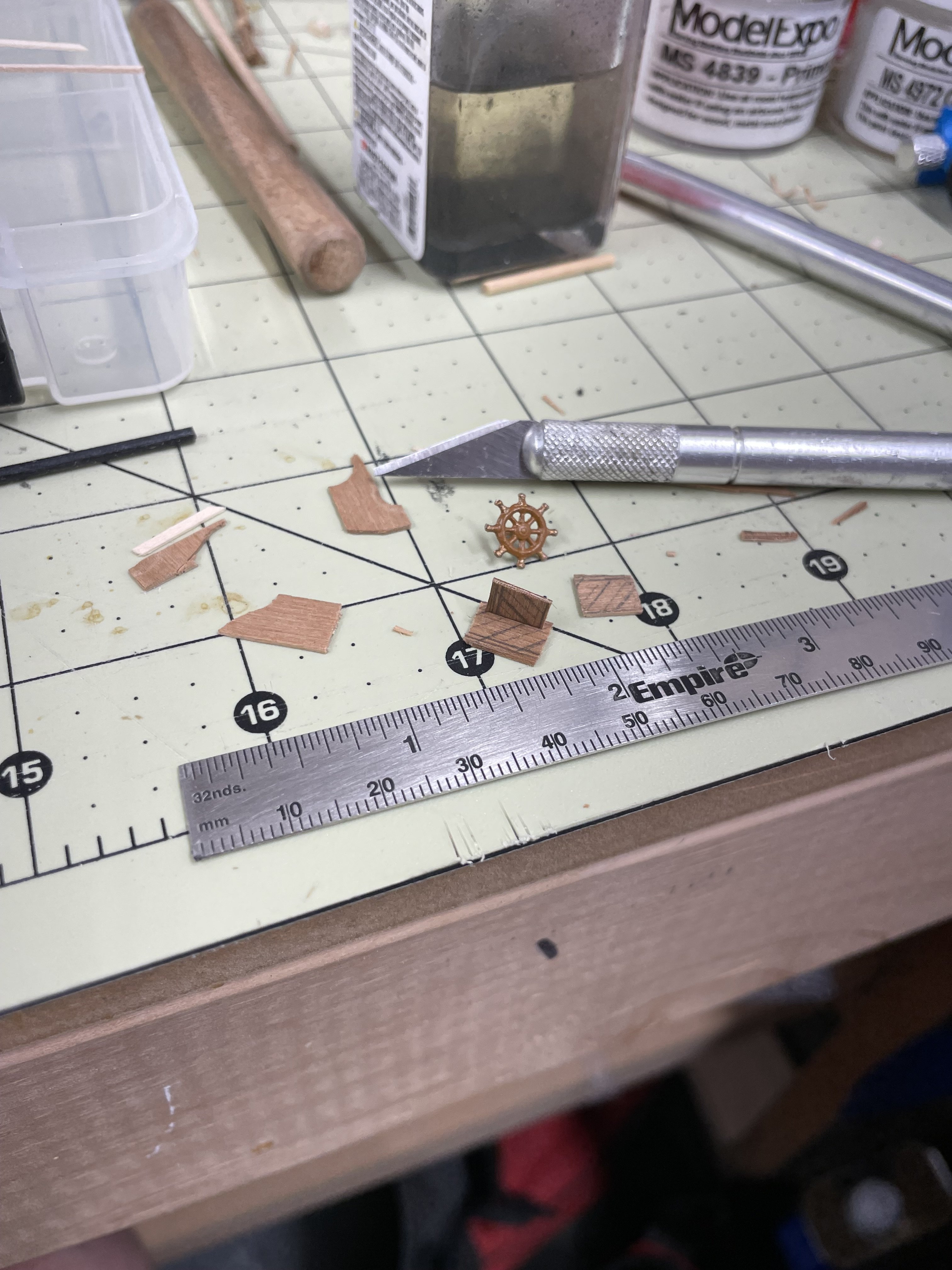

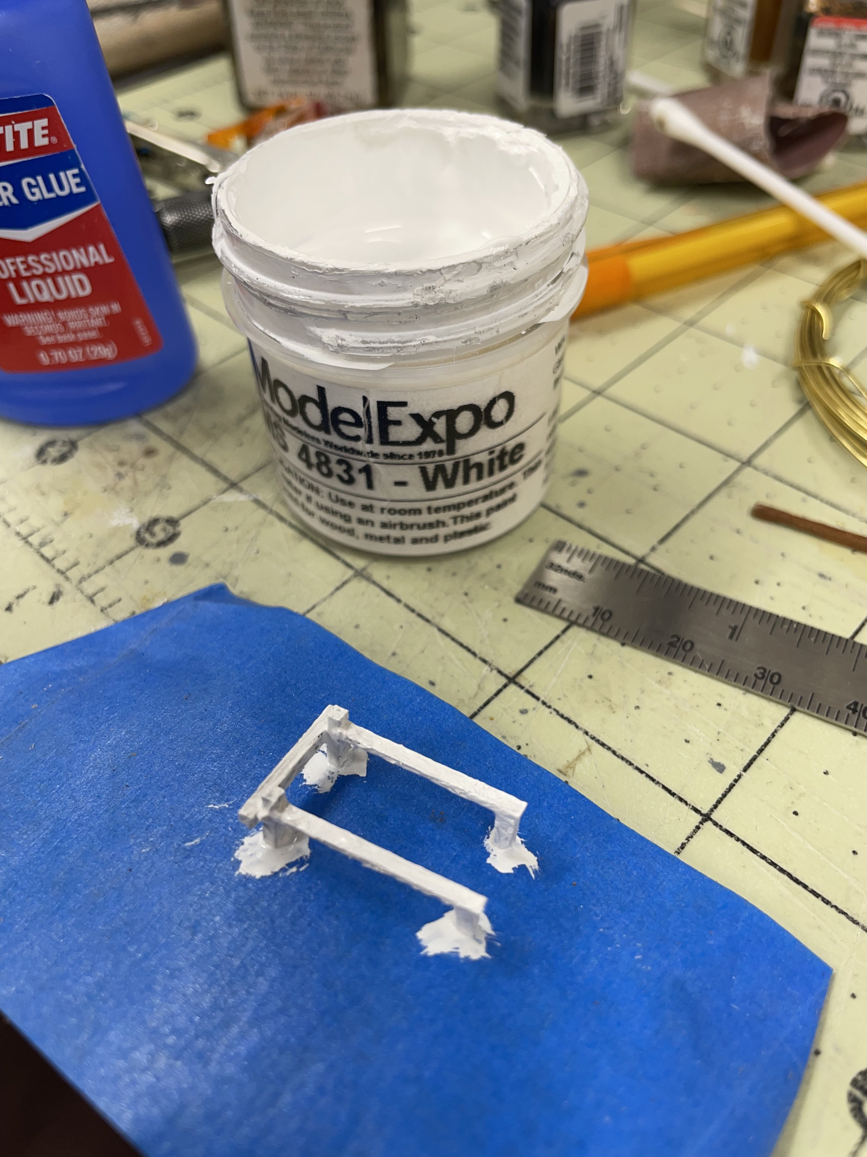

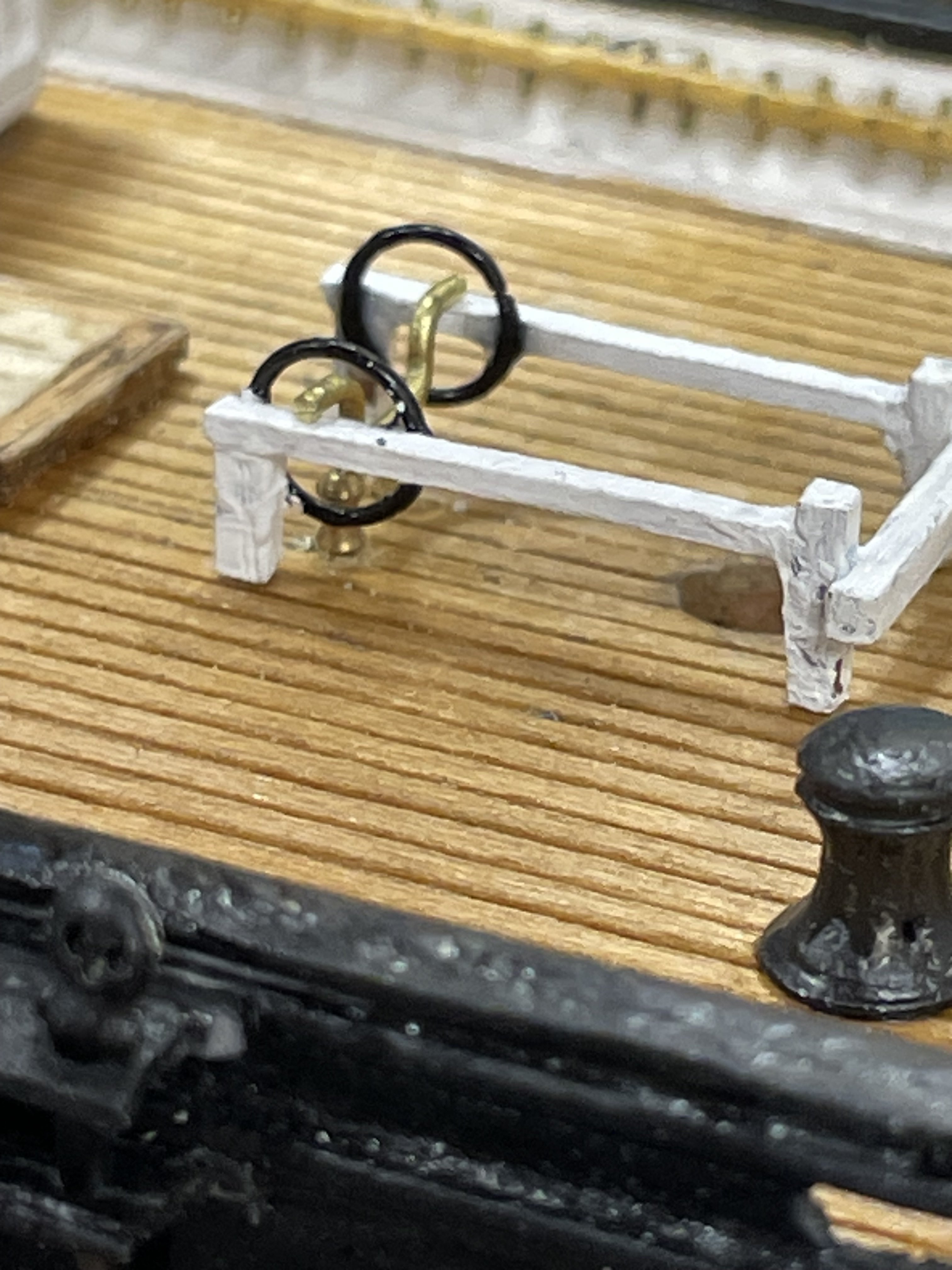

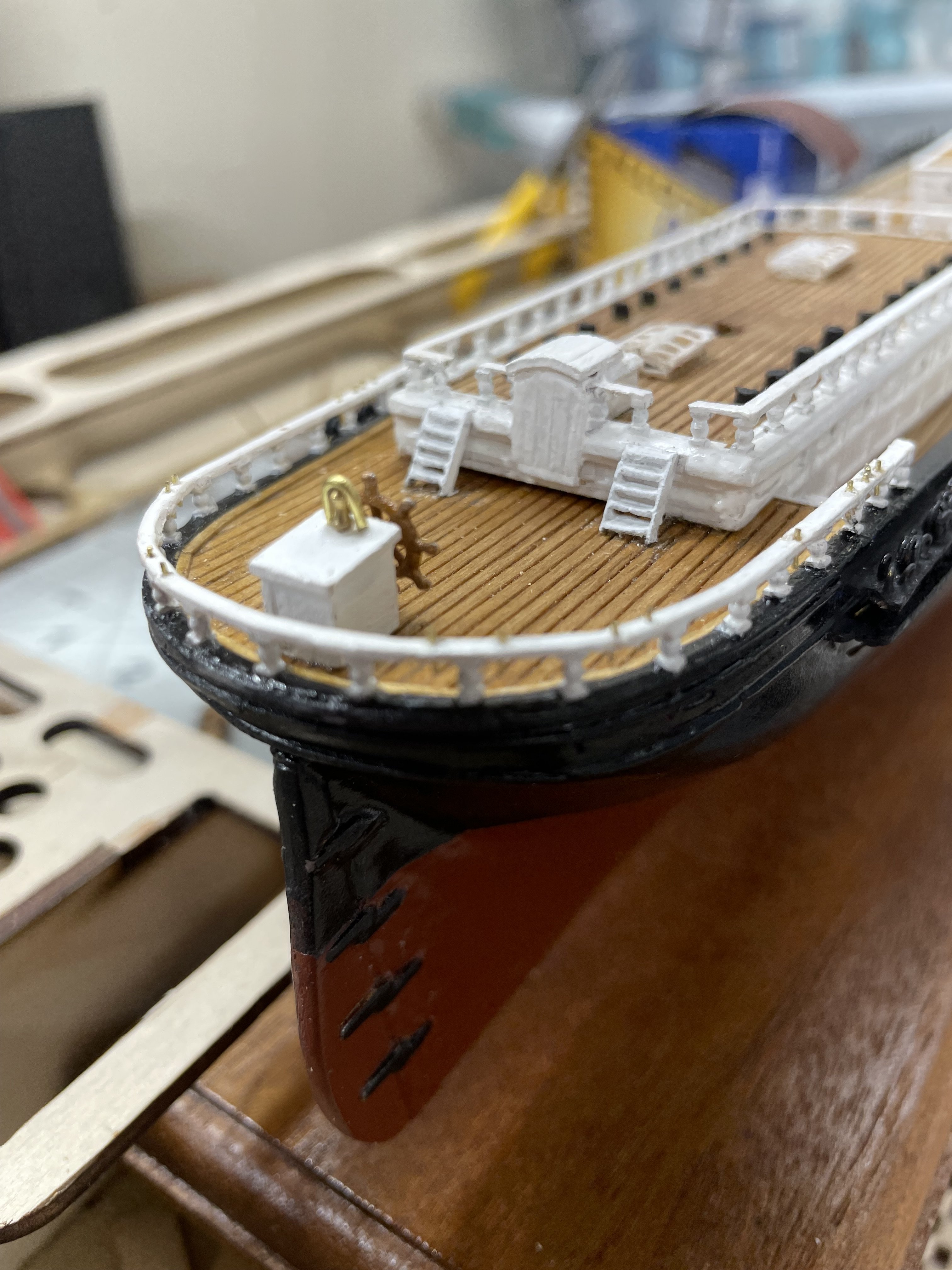

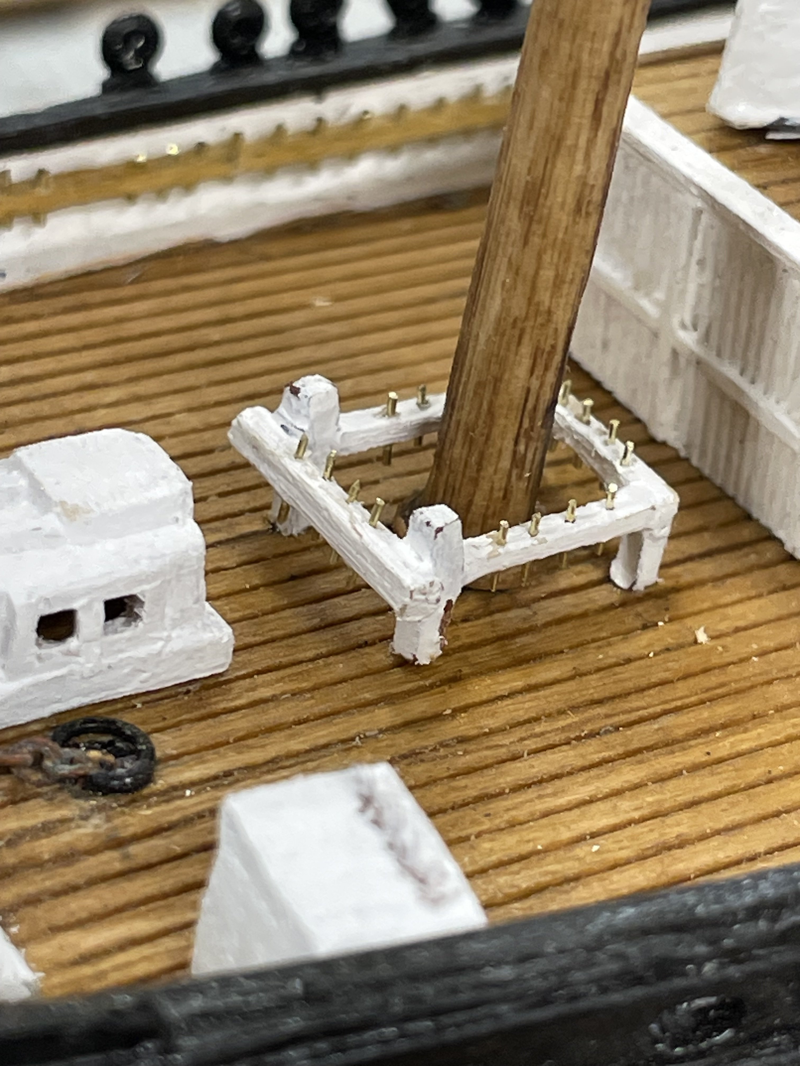

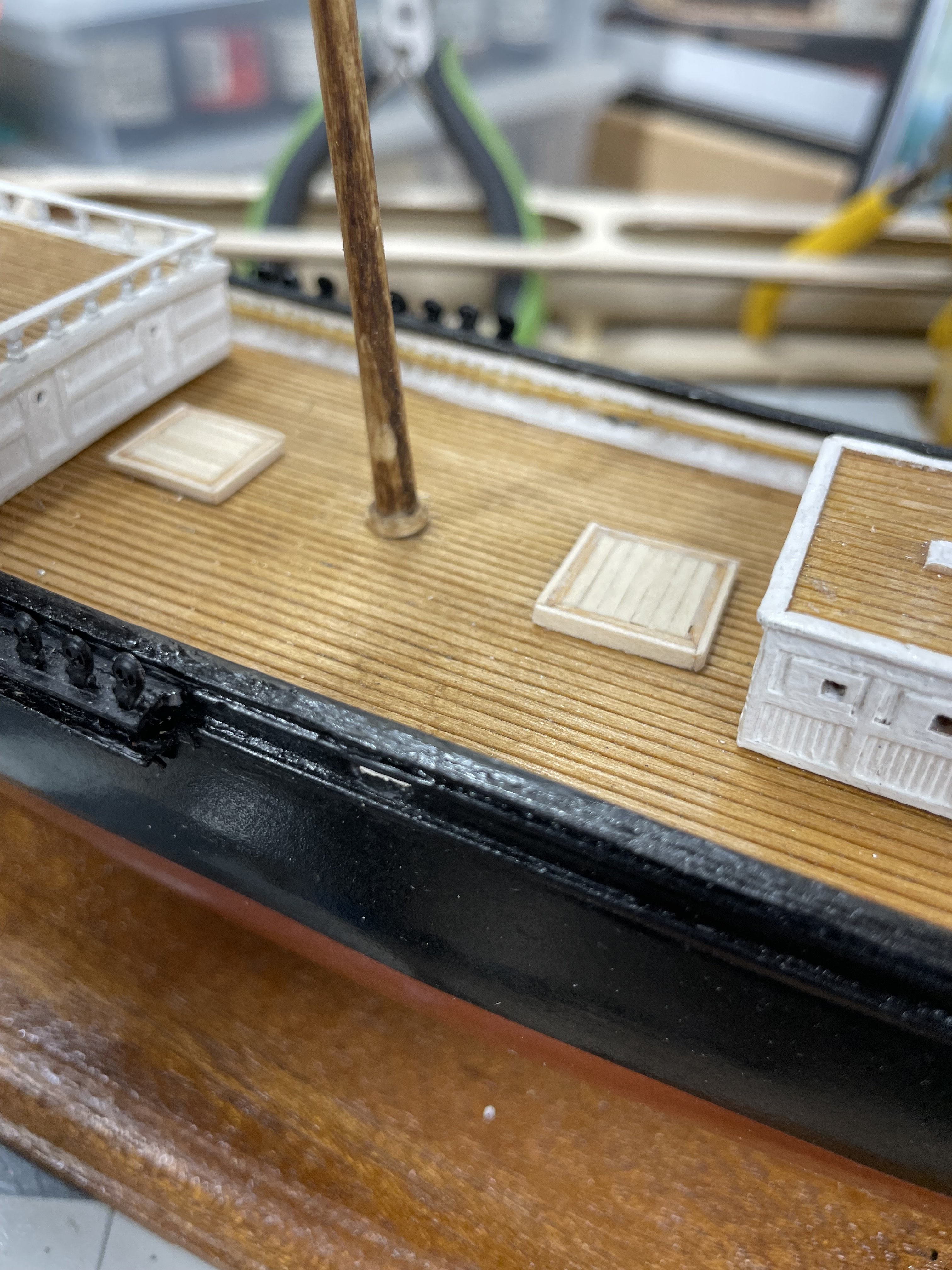

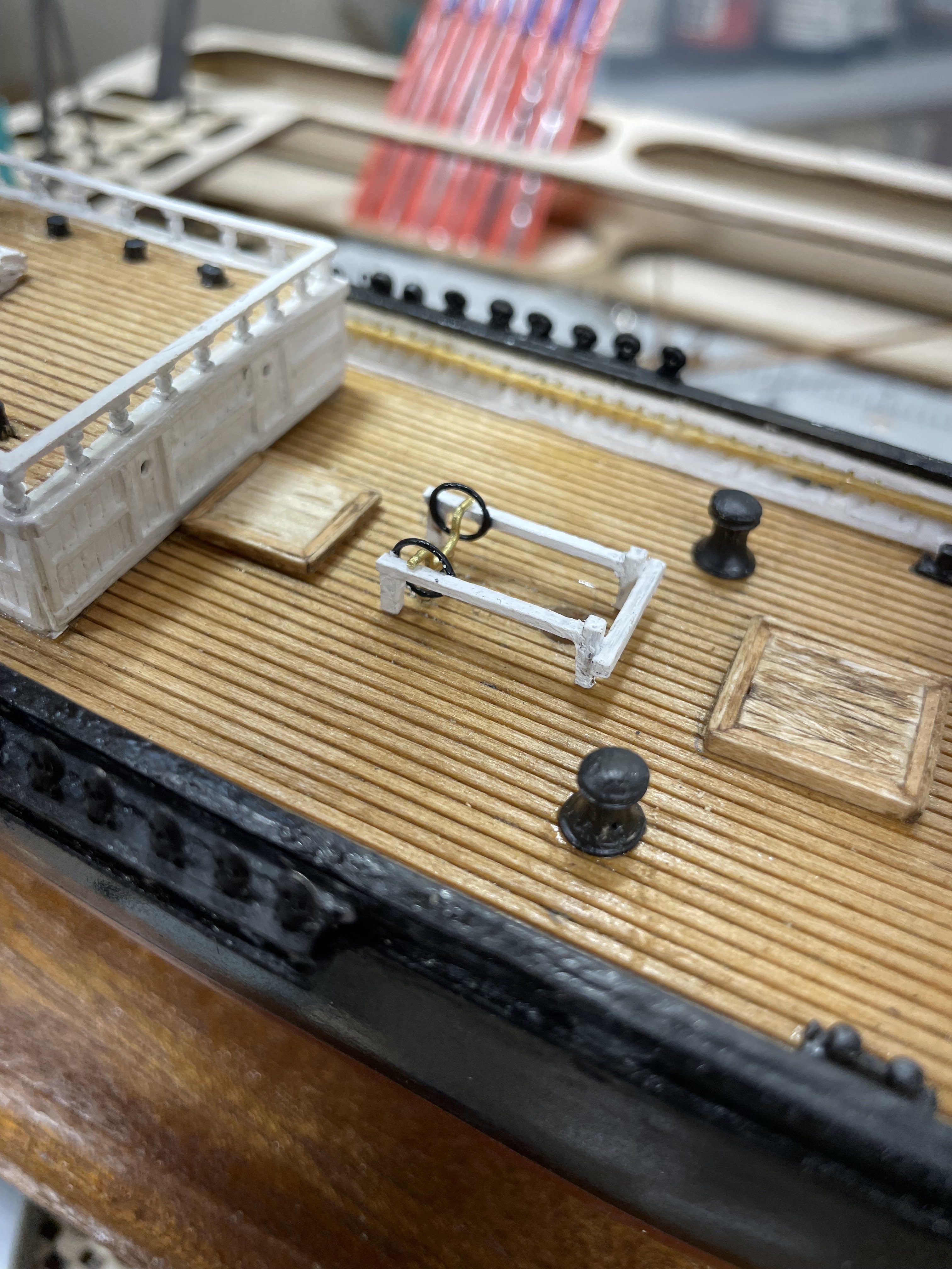

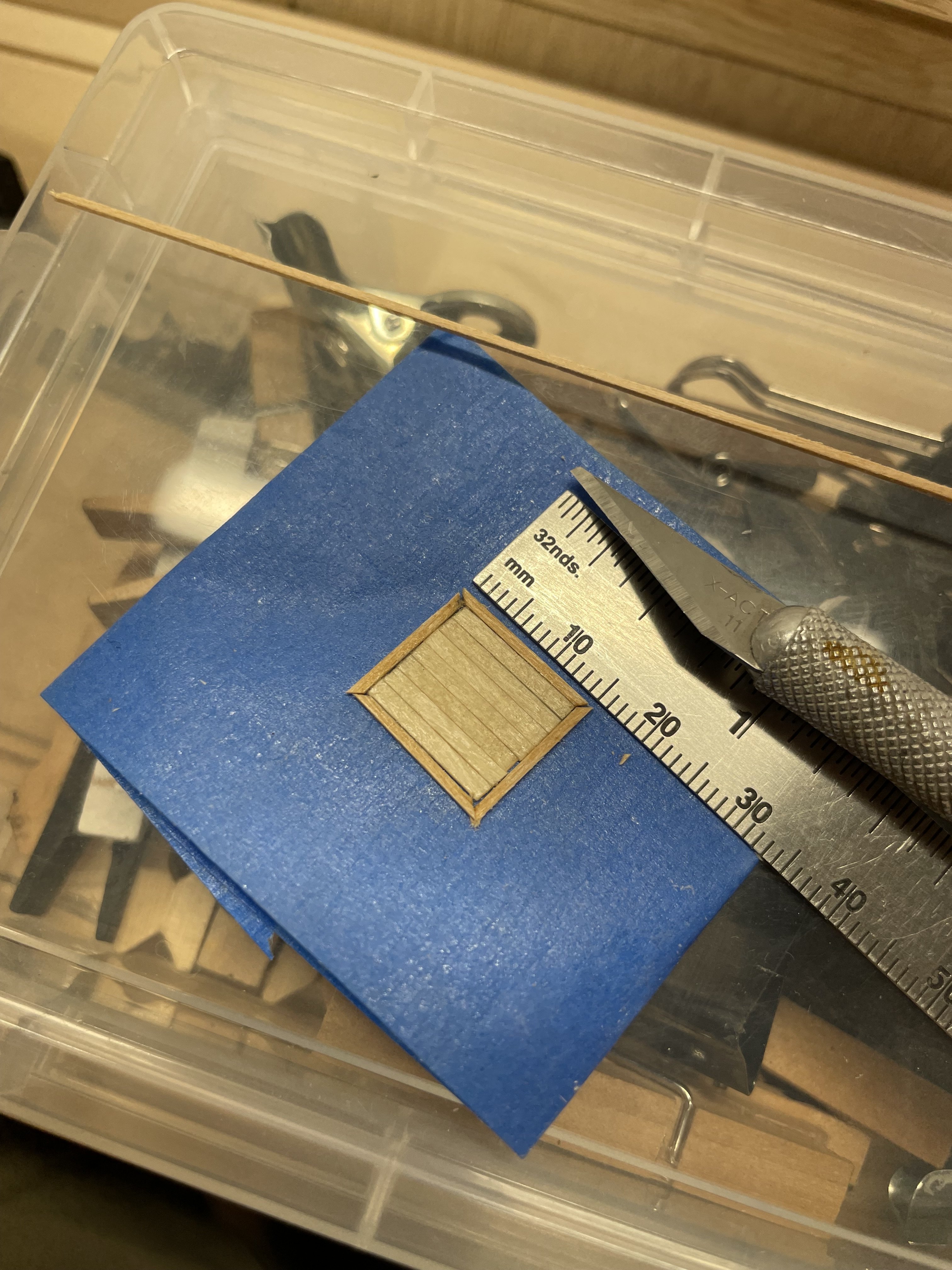

Finishing the Deck Furnishings…
Hatches…

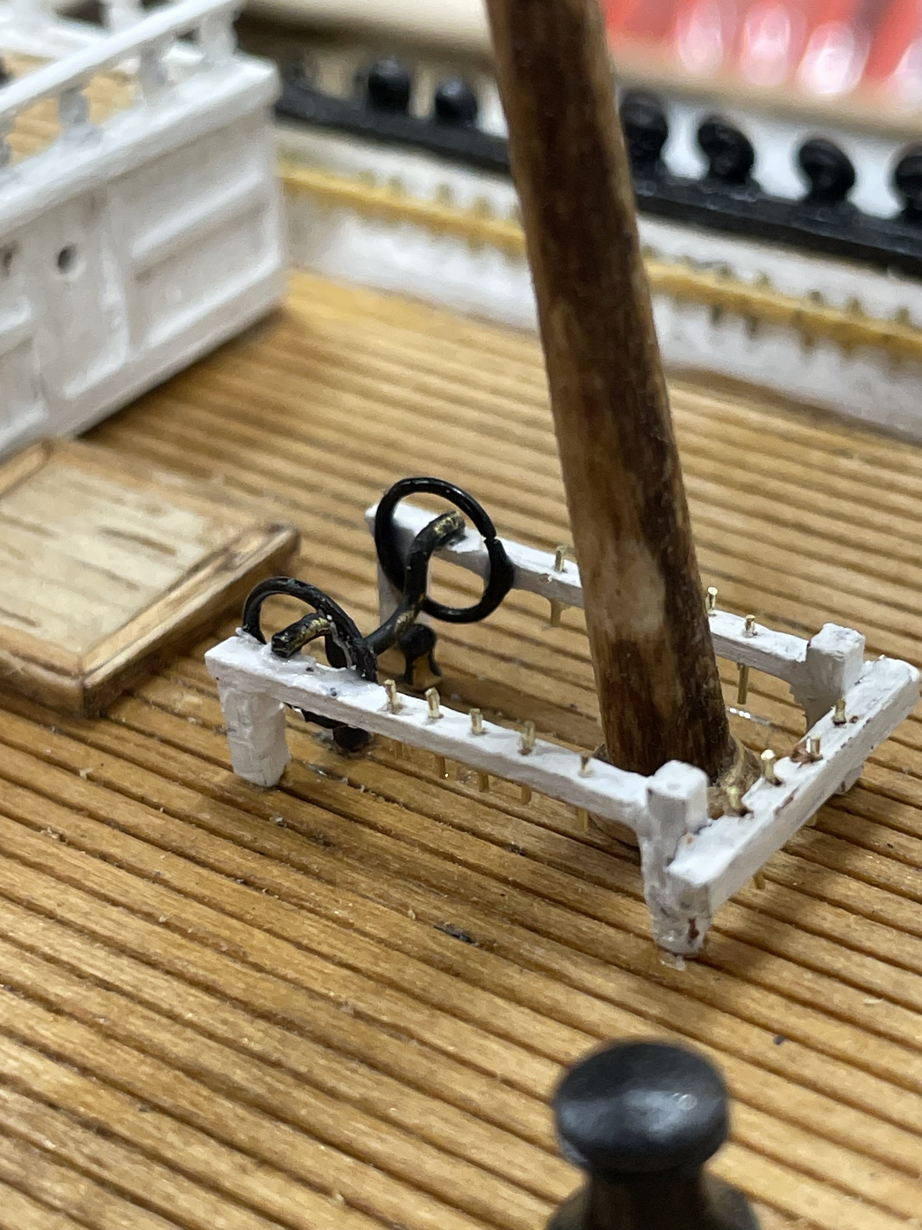

Fore Mast Fife Rail…
Cabin Ventalators…
Galley Stack…

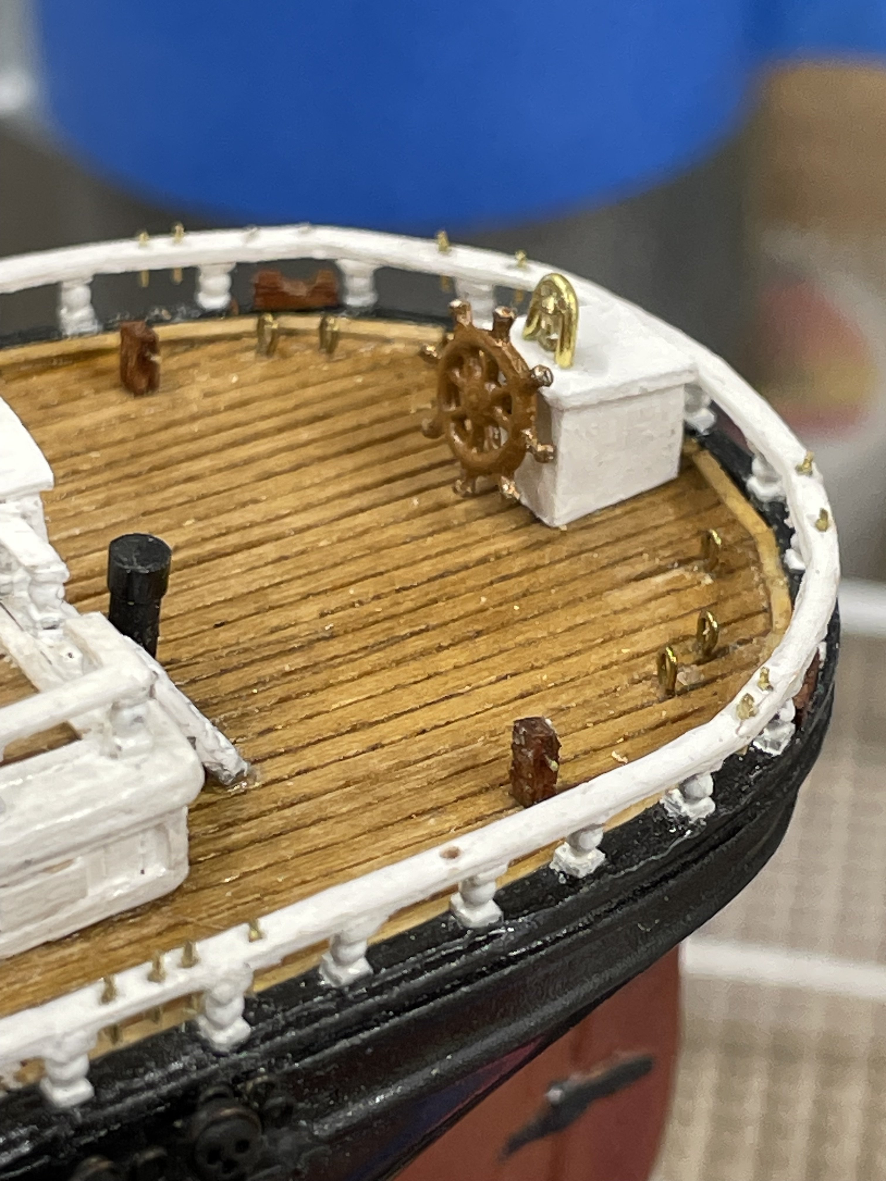

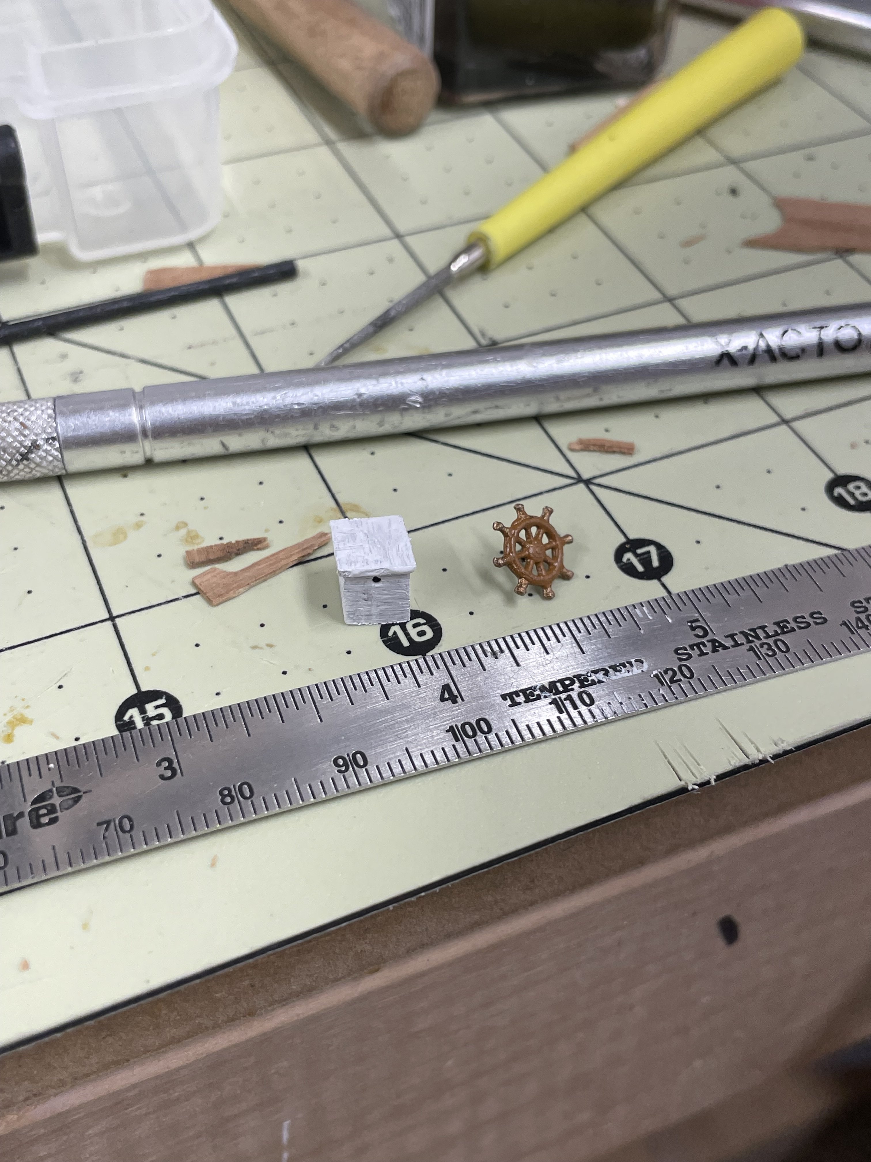

Steering Stand w/Helm Bell…
Main Mast Fife Rail…
Pump…
Ventalators…
Stern Open Chocks…
Now I can start finishing out the fittings on the Masts and then Shrouds. 😜
Cheers🍻
