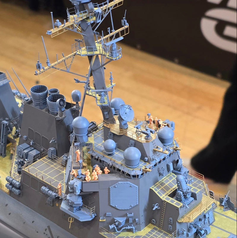

Hi all,
Thanks for the looks and likes. It's been a bit since I've posted on this project. I've been pouring a lot of efforts into the main superstructure on this ship. Something I've learned since last time; this kit is actually geared more for a much more recent time period than I had originally thought. Comparisons between the kit and online pictures make this much more clear to me now. Here are some pictures of my progress. I'm still needing to paint and decal much of this before I permanently stick it down to the deck and hull.
I hope you all enjoy and thanks for following!

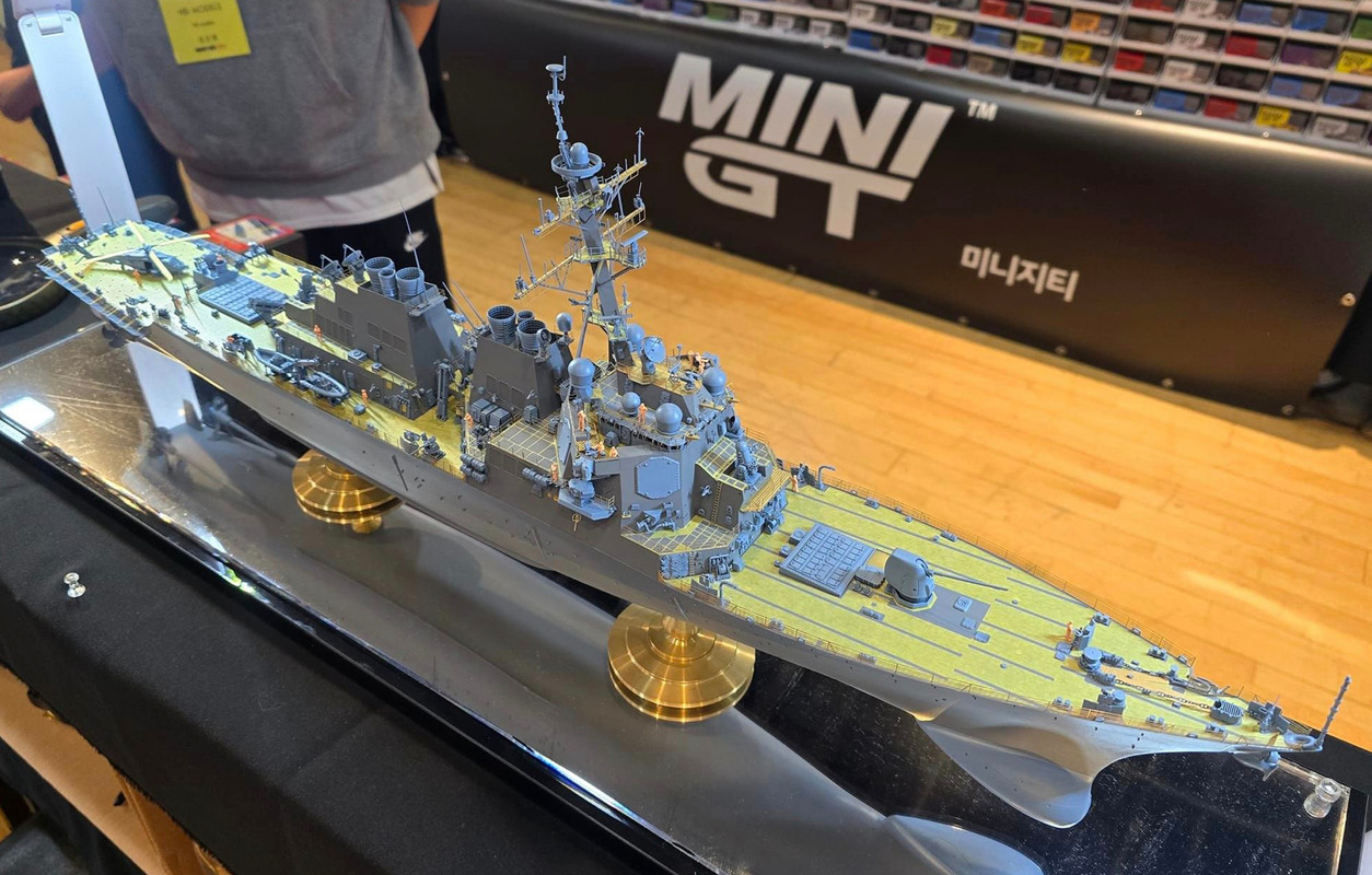

I've been seeing a lot of pictures for this really big set and other smaller sets from HS Models. The detail looks exquisite but some of it also seems a bit egregious. This is only an assumption, but looking at the pictures, the dark blue details would be resin? And if that really is the case, some of the molded on detail on the bulkheads, such as little thin wires and other things, might be a touch too much to sand off and replace in resin. Looks like they would also have you remove the VLS systems fore and aft. At some point, they might just look at issuing an entire kit, LOL. The extra detail will be lovely, but some of this might be a little over the top, IMHO.

Thankfully that hull plating is not present on the plastic kit hull. I wonder if it's just an artifact from their CAD modeling.
