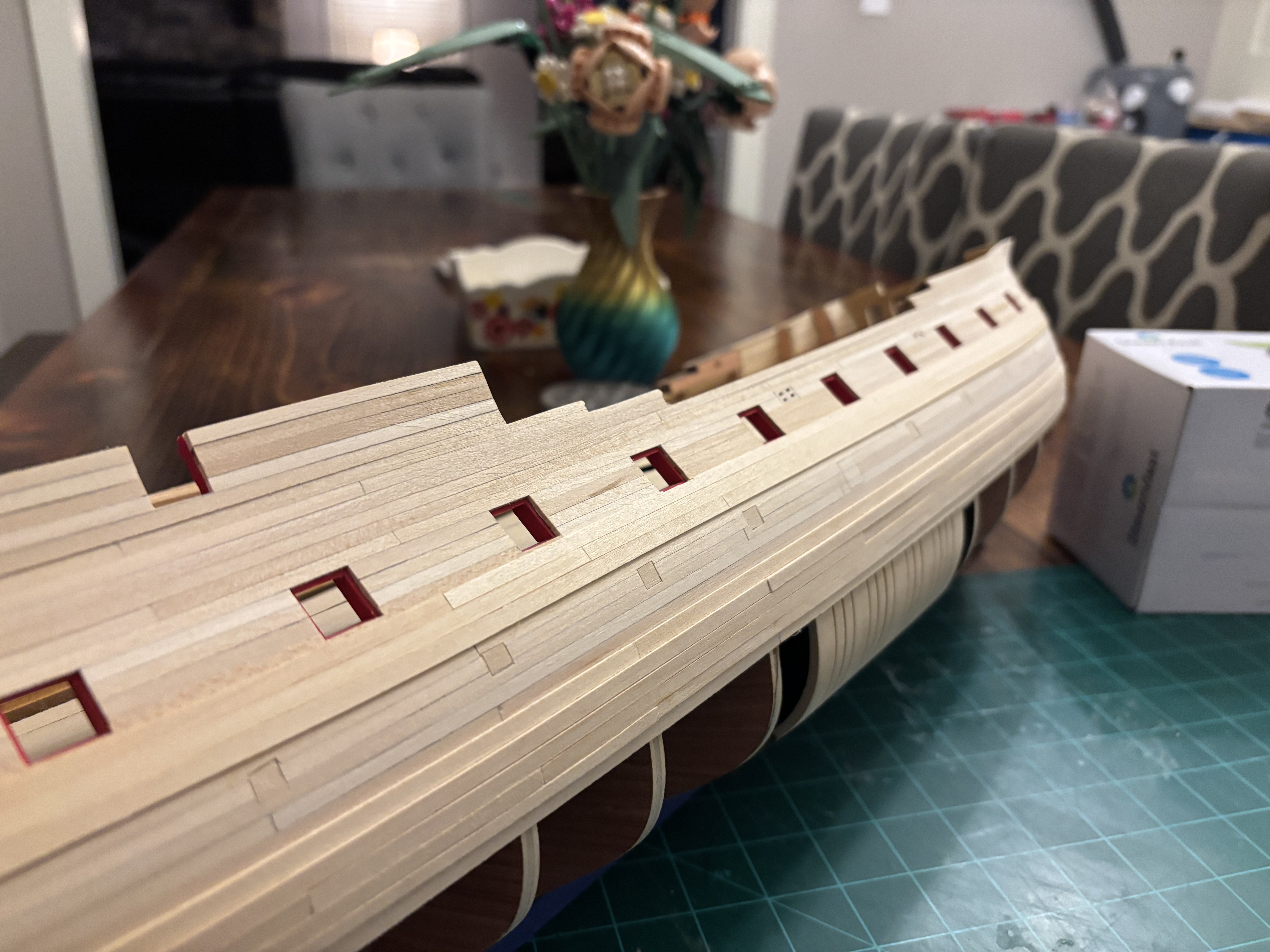

All of the second planking rows for the channel wales, black strake and wales have been installed on the starboard side. Tomorrow I hope to start on the port side. Once the port side done, then I will sand them all smooth before starting work on the molding strips. IMG_9948.thumb.jpeg.fdf0faa2be608d14765153ed59186258.jpegIMG_9946.thumb.jpeg.b31e8c50647a9cfd8b805a0236366dd3.jpegIMG_9947.thumb.jpeg.db246f4c1357c3b552c4865659dfbab9.jpeg

I have finished the second layer of planking on the wales, black strake and channel wales on the port side.  No pictures yet, I will post some after I finish sanding it all smooth.  That brings me to my question.  As I am re-reading Chucks log on his Cheerful prototype build (post 196), I am wondering if I should sand the wales, black strake and channel wales to the same thickness as the surrounding planks at the bow.  Chuck said that this was the true for most ships of that time and I am wondering if Confederacy was the same.  What do you guys think?  I am thinking that I will do the same on Confederacy, but would like some opinions from some of the more experienced members on here.

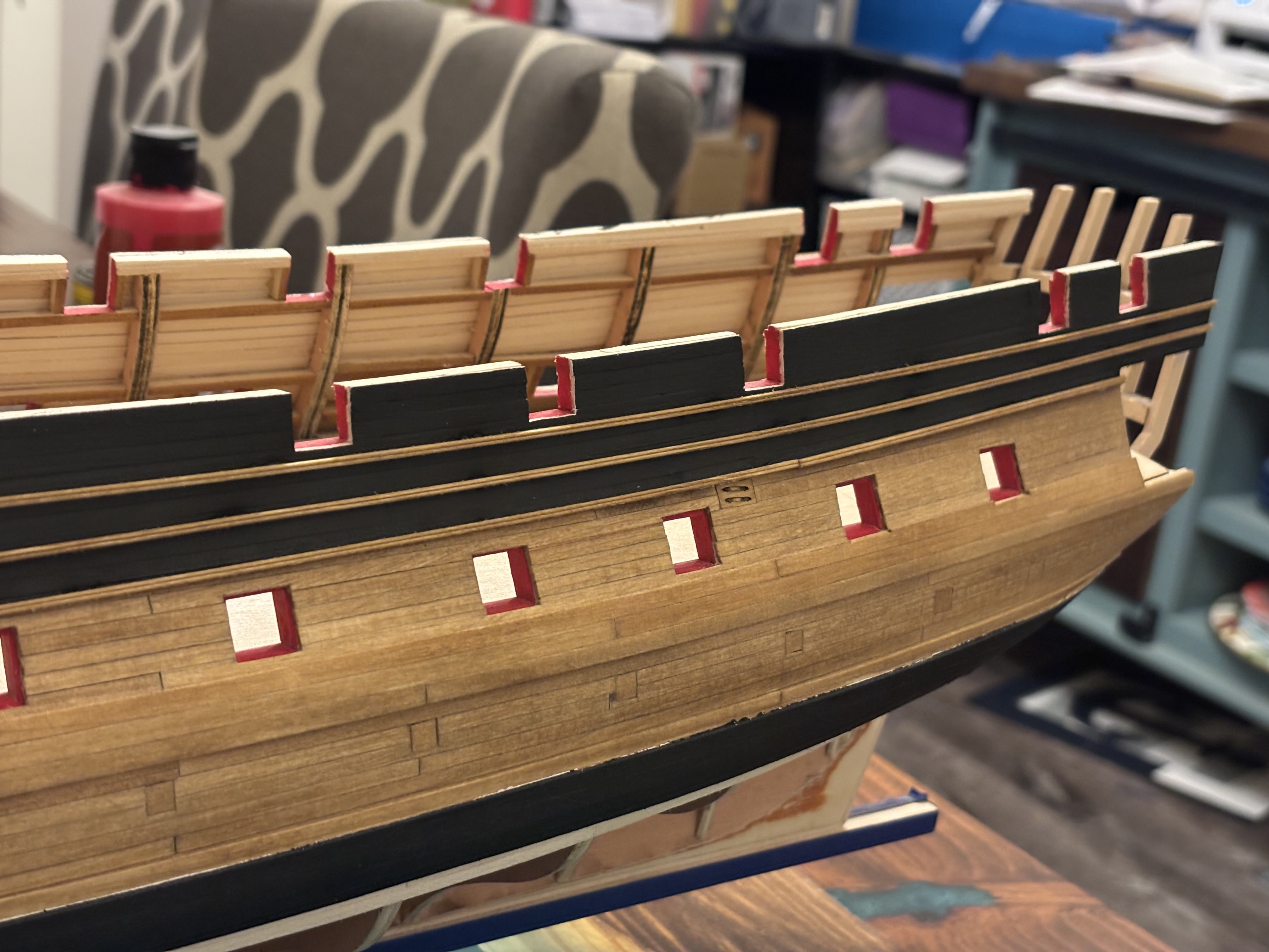

I got the second layer of planking sanded smooth and then I painted the wales black along with planking above the decorative molding.  Then I applied golden oak stain to the rest of the planking above the wales.  While that was drying, I scraped the molding pieces and then I stained them with golden oak.  Once everything was dry, I glued the molding onto the model.  Now I get to start planking the rest of hulls below the wales.  I will not be treenailing the model since I think that it would take me over a year to drill all of the holes due to my carpal tunnel.

Ronald, it is Minwax Golden Oak 2108 that I used.  I love the color and I think it came out great on the model.  I used an old acid brush to apply it.  That gave me more control as to where and how the stain flowed into the wood.

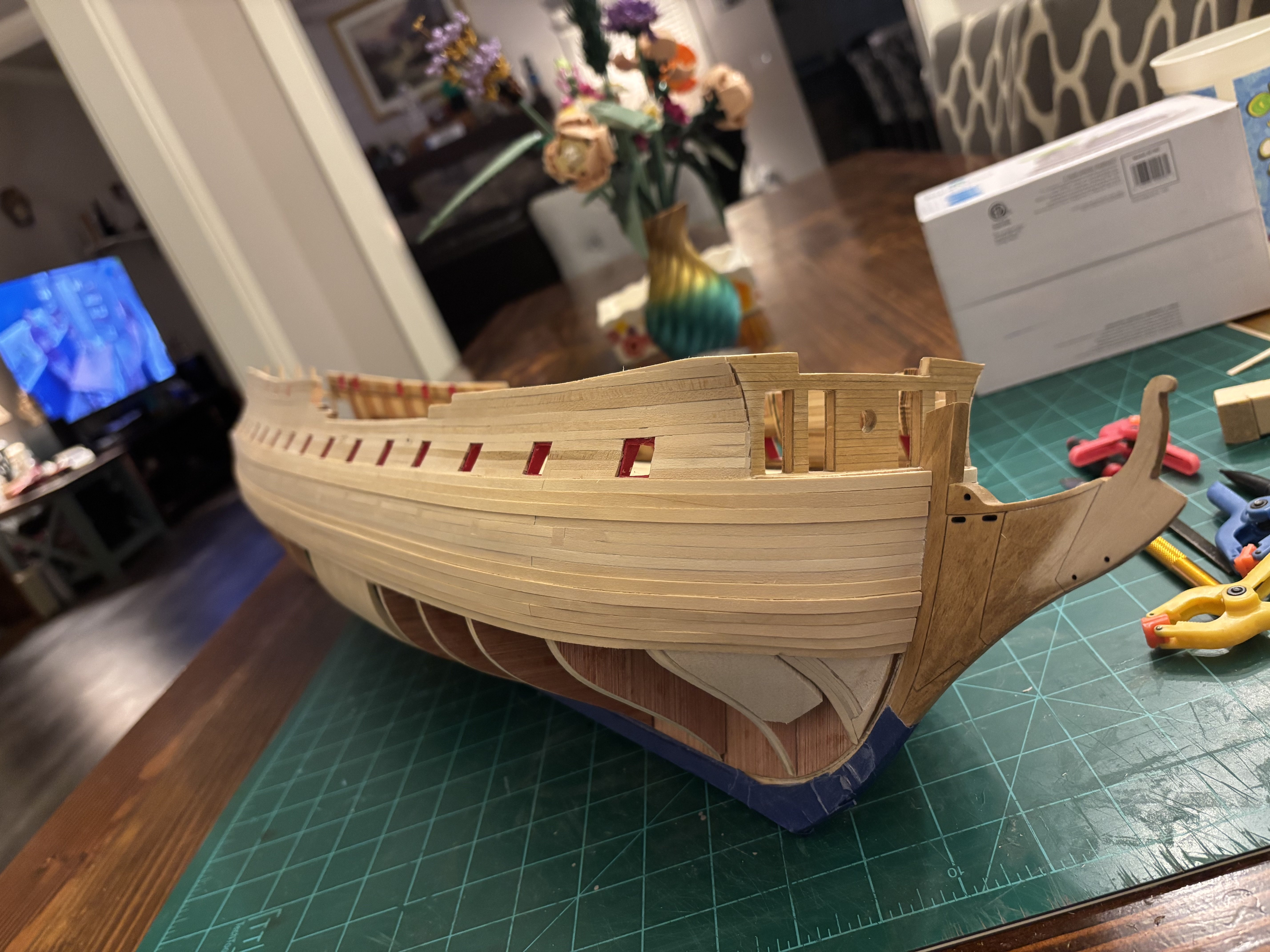

Planking below the wales has begun.  First thing I did was to line off the hull and separate the hull into 3 belts.  Then I started planking the first belt on the port side.  I am about half way through with this belt, it will consist of about 9-10 planks.

So far I am pretty happy with how the planking is progressing.

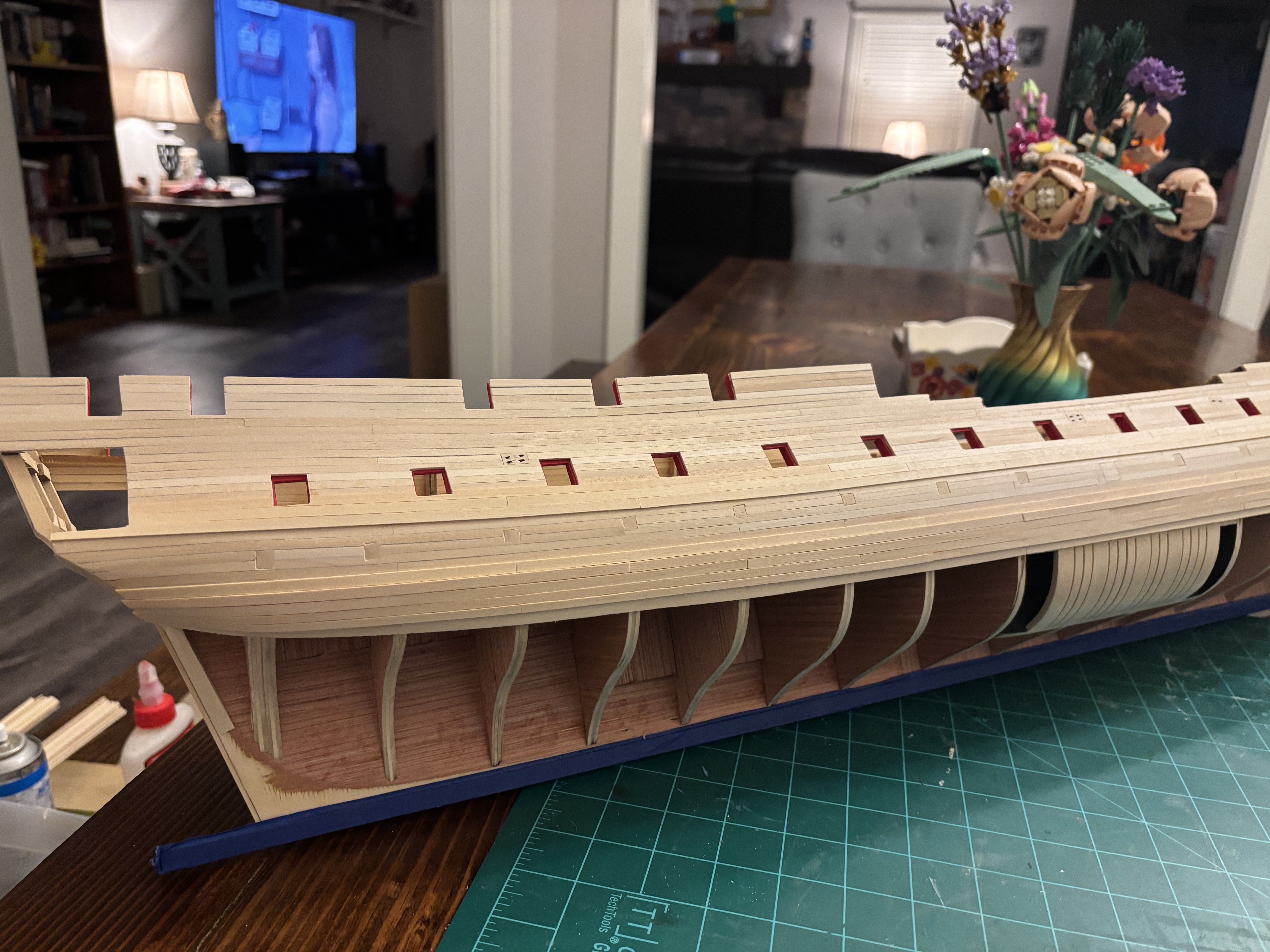

Got the first belt on the port side finished. I think I will continue on the port side before I move onto the starboard side. So far I am happy with how it is progressing.
I did have to redo some of the planks at the stern because it didn’t look right to me. I toyed with the idea of just letting it be, but ultimately decided that I can do better and that I would be happier if I just went ahead and fixed the planks.  I sure am glad that I did.

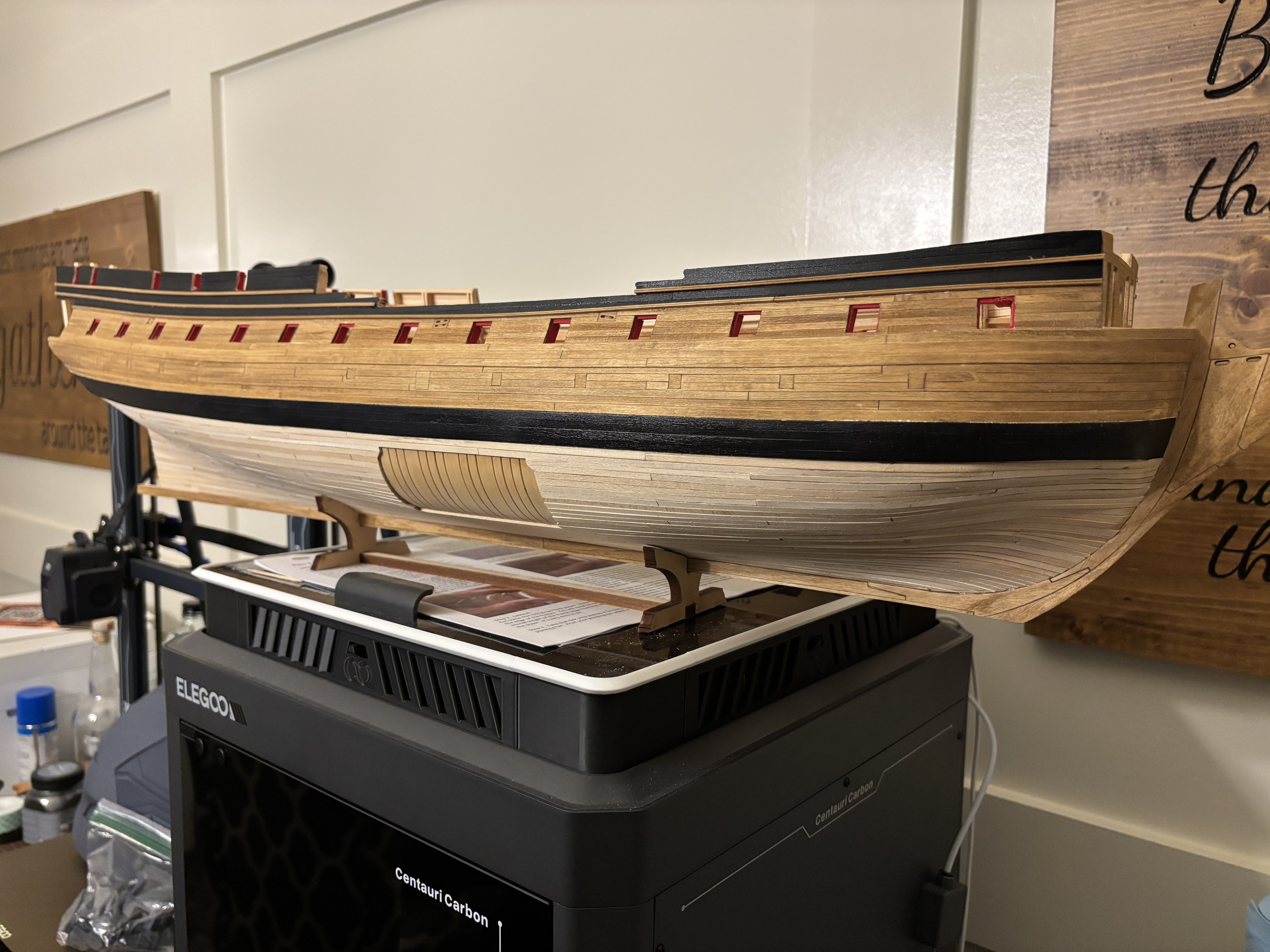

Planking on the starboard side is progressing at a steady pace. I hope to have it finished up by the end of the weekend. So far, the first belt is completed and the second belt is 1-2 strakes away from being halfway done.
IMG_0013.thumb.jpeg.796eb435405d6efff3e28a6e56c55d79.jpegIMG_0012.thumb.jpeg.b727a91fd35bc0a02f9c32bd0a69ca5c.jpeg
Once her hull is fully planked, I will need to switch gears and show Chuck’s Medway longboat some planking love.
Kenny

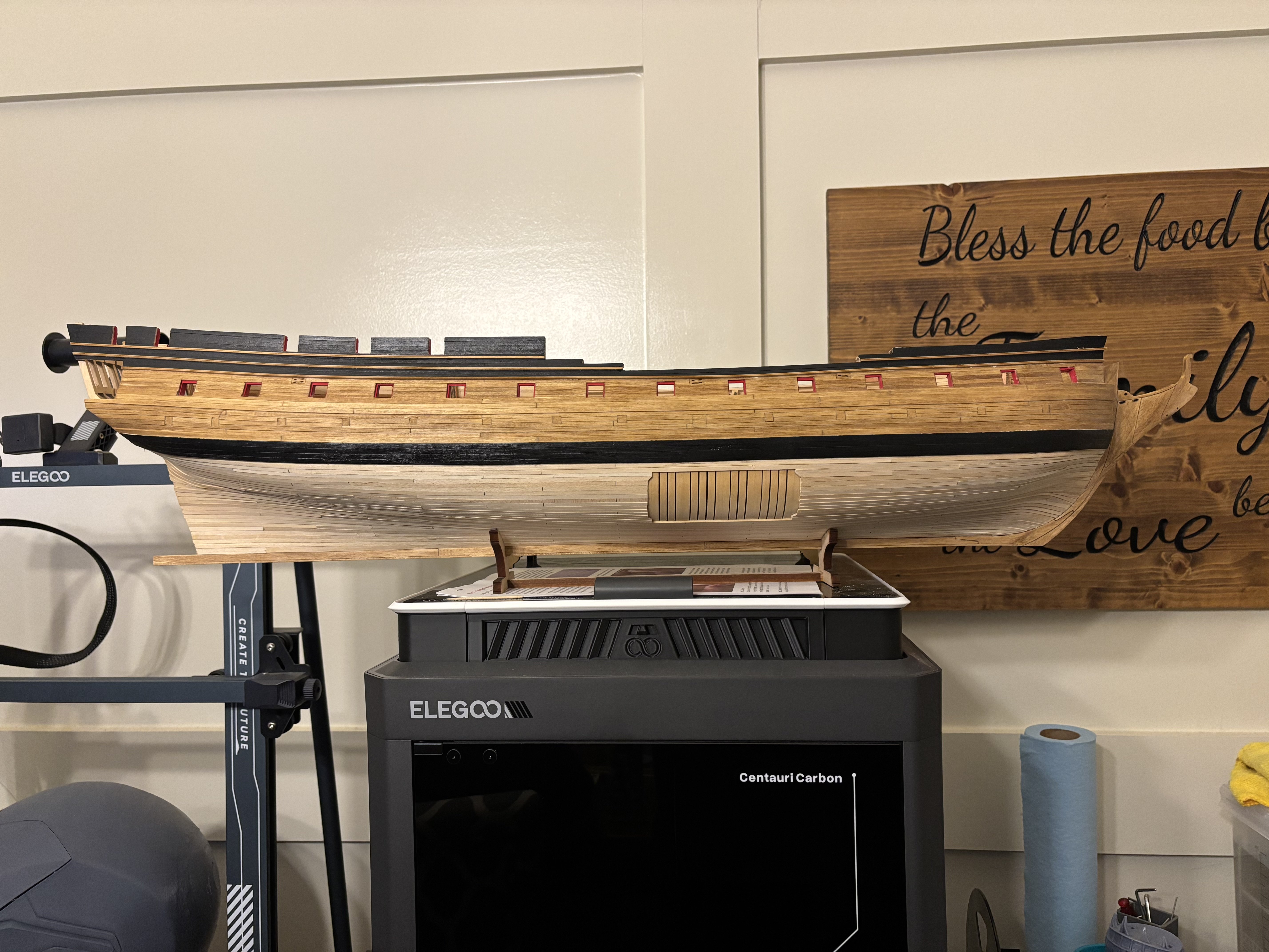

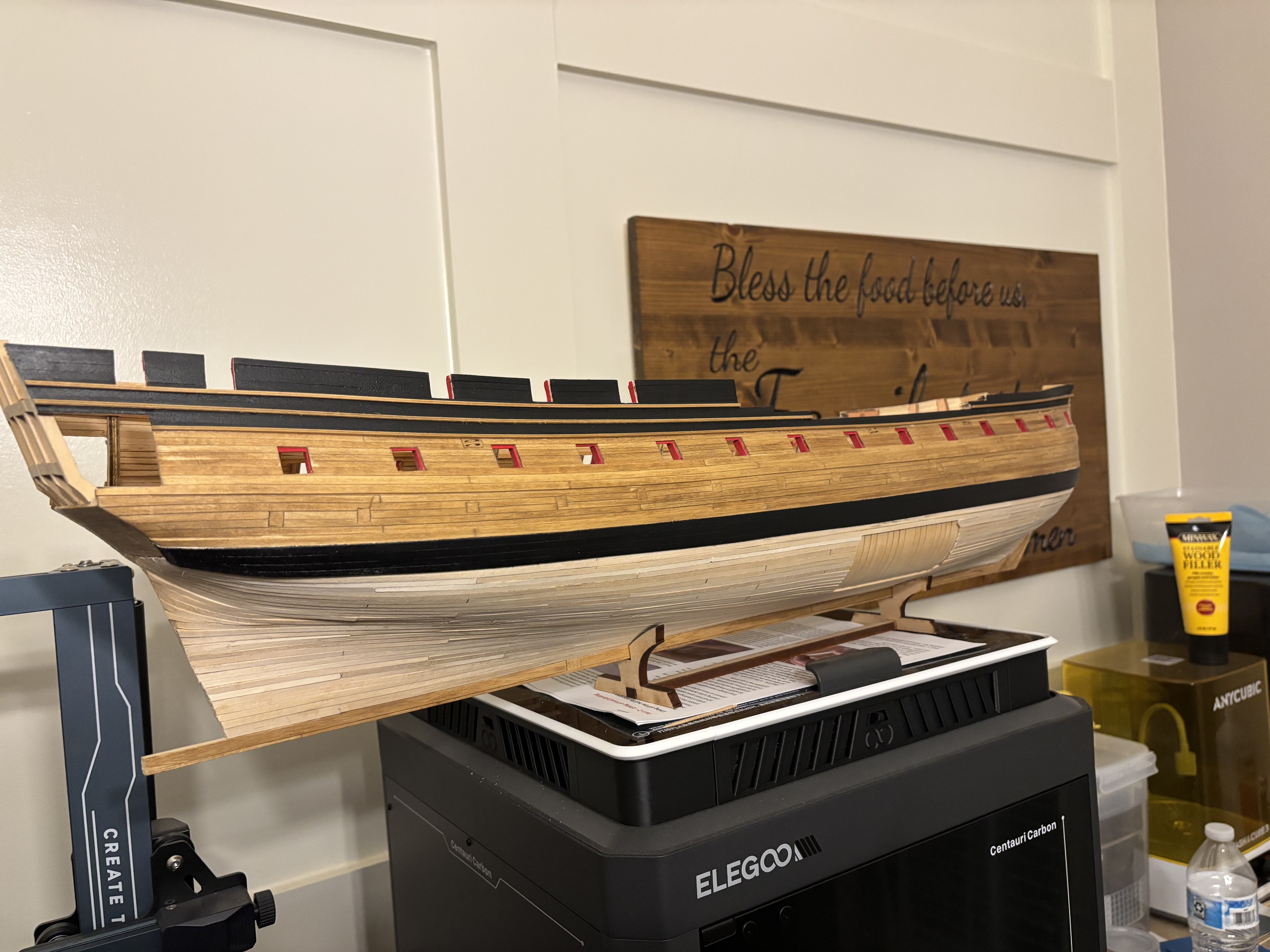

Finished up the starboard side planking tonight. Next up is the tedious task that everyone loves to do; sanding it all smooth. It’s not the best planking job, so no close up pictures; but I am happy with it and learned a lot from the whole experience.
IMG_0043.thumb.jpeg.64937320756dde061aa11ac134bd676b.jpegIMG_0044.thumb.jpeg.98ac136151da930677a9ec45a579e53c.jpegIMG_0045.thumb.jpeg.4ef546c092a1b76e6e2a4f3821562ef3.jpeg
