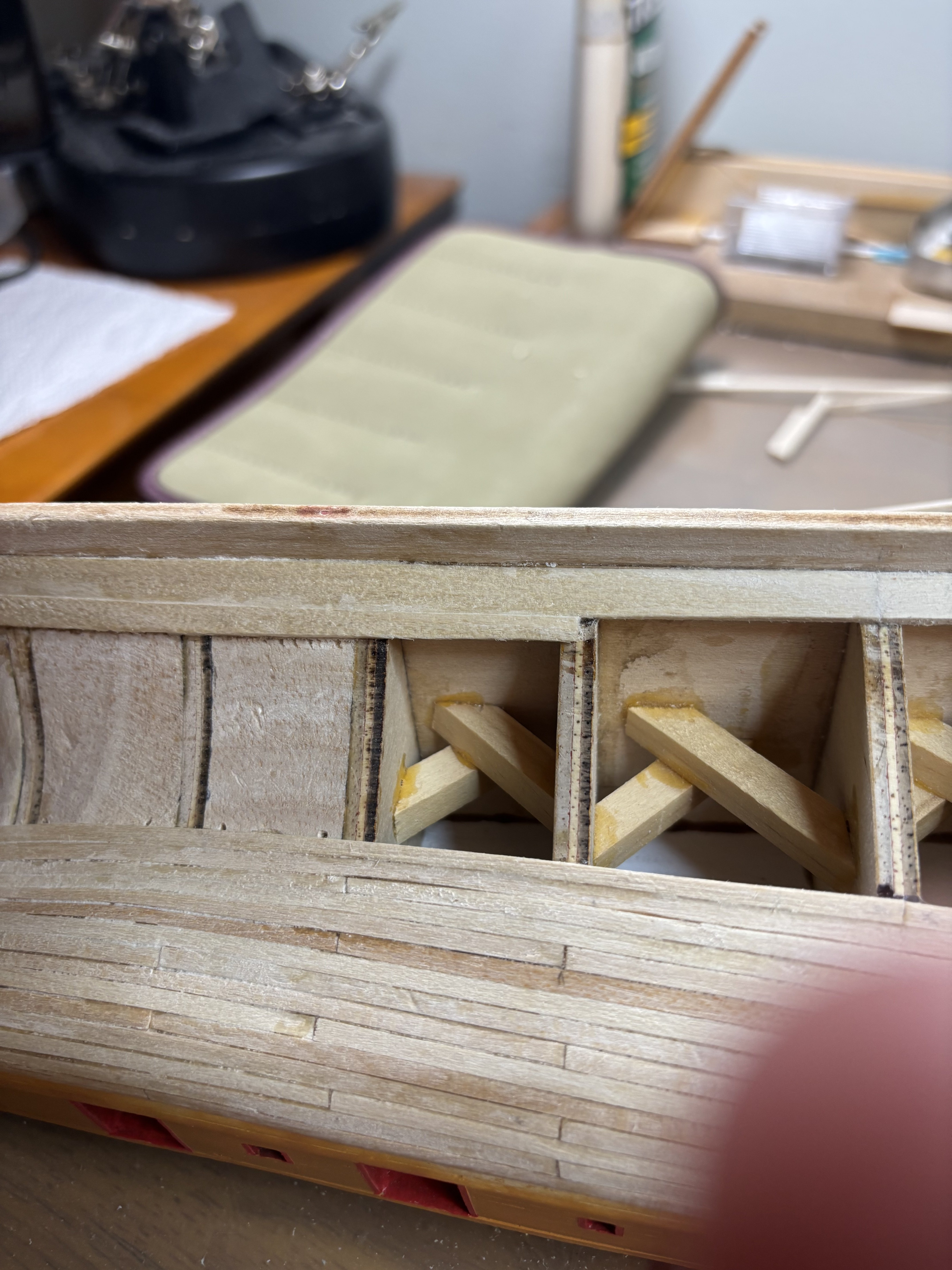

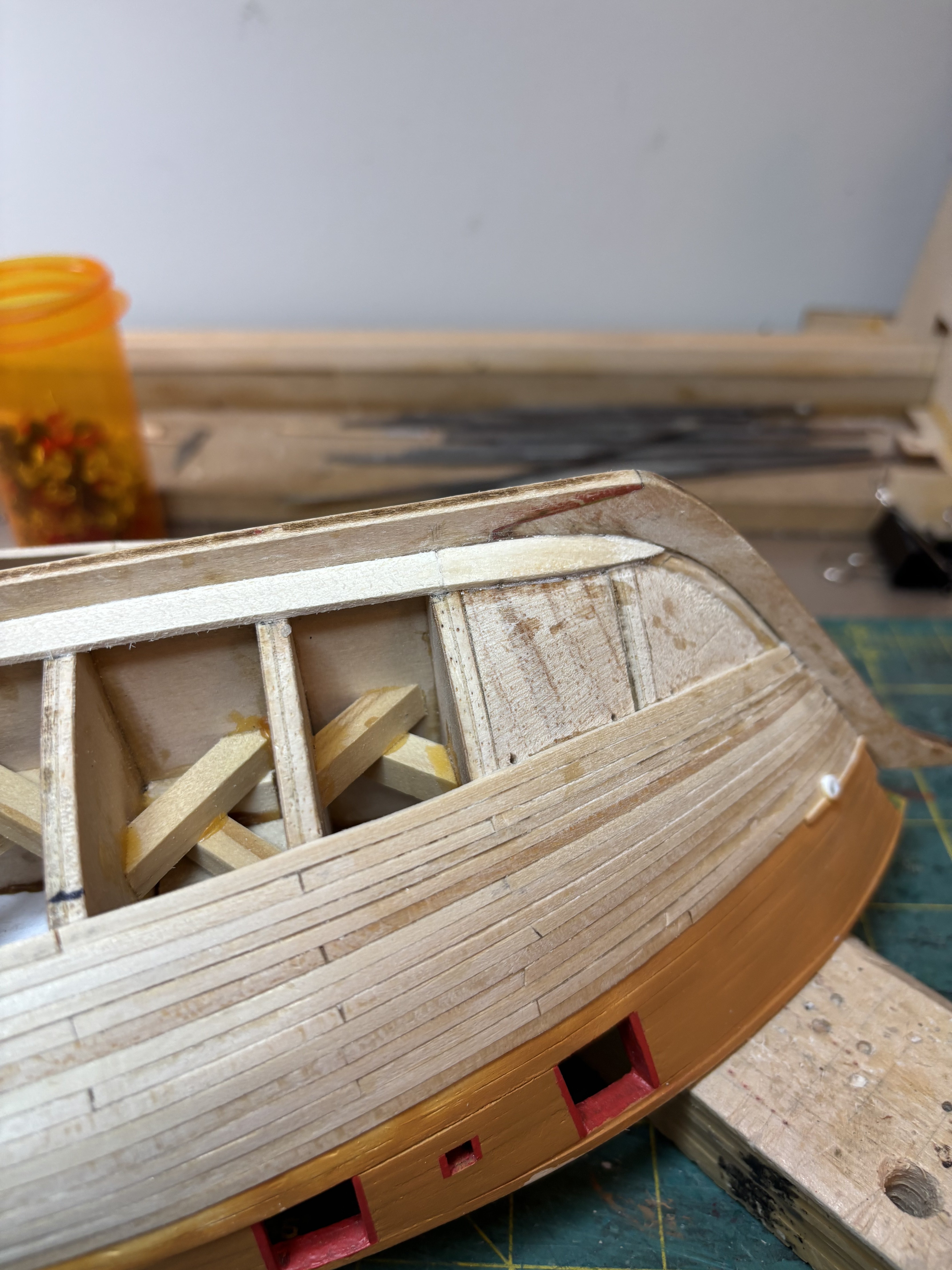

Your Niagara is really coming along nicely.  Your work on the framing is very clean and crisp.  That's something I need to strive for to improve.  Interesting use of cross bracing between the bulkheads. Haven't seen that technique before.  Reminds me of the cross bracing between the floor joists in an old house I used to live in.  You're going to end up with a beautiful model that you can display proudly.  Keep up the good work.

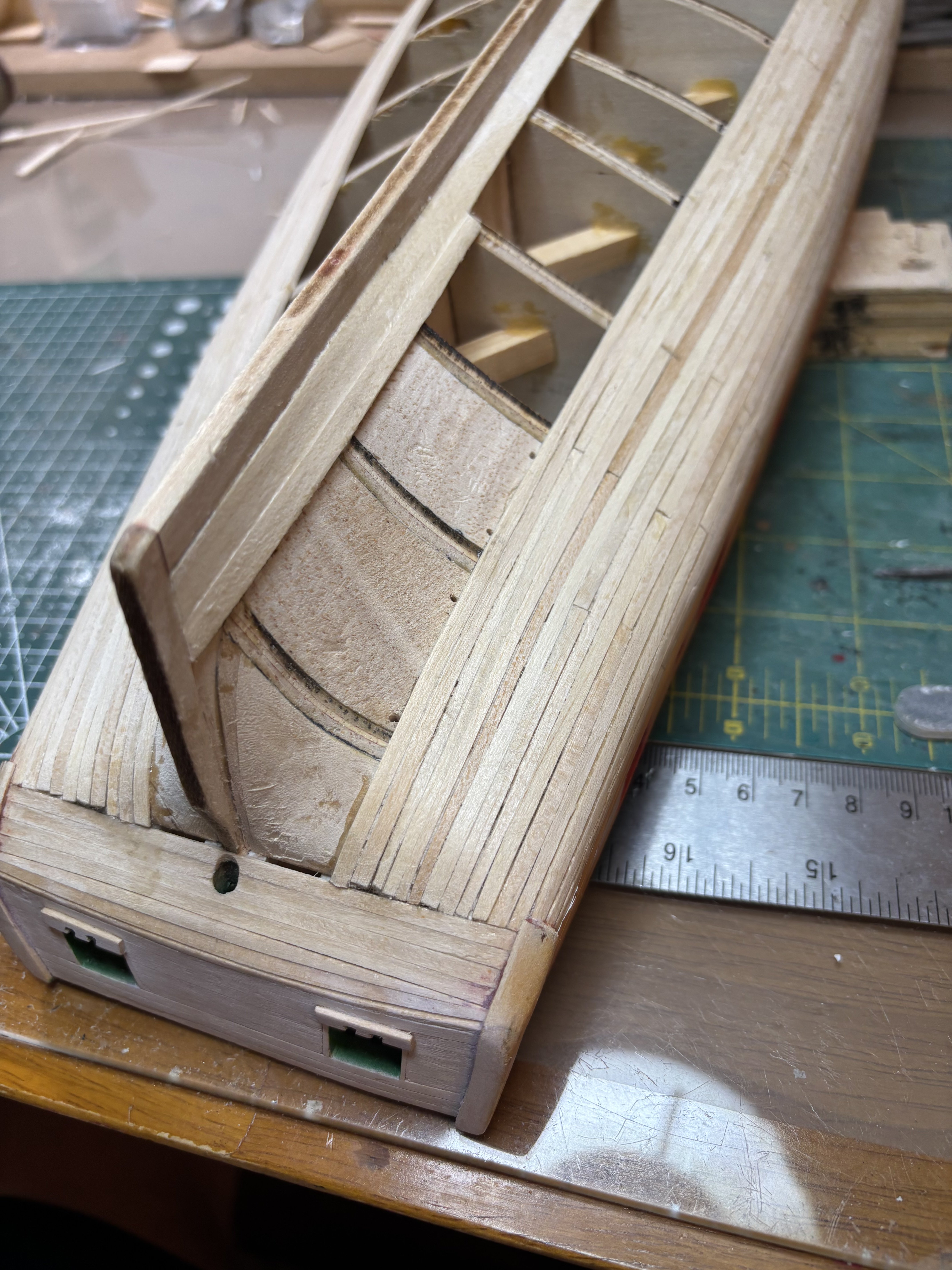

Appreciate the comment. I did the cross bracing like that as it was easier than trying to cut pieces to precisely fit between the bulkheads. Two 45 degree cuts in two pieces of wood allowed me to provide bracing more easily for me
Some more progress on planking the transom - inside the hull and outside
Also attached the rail on top of the ceiling - again both inside and outside the hull
Edited by Usgecko

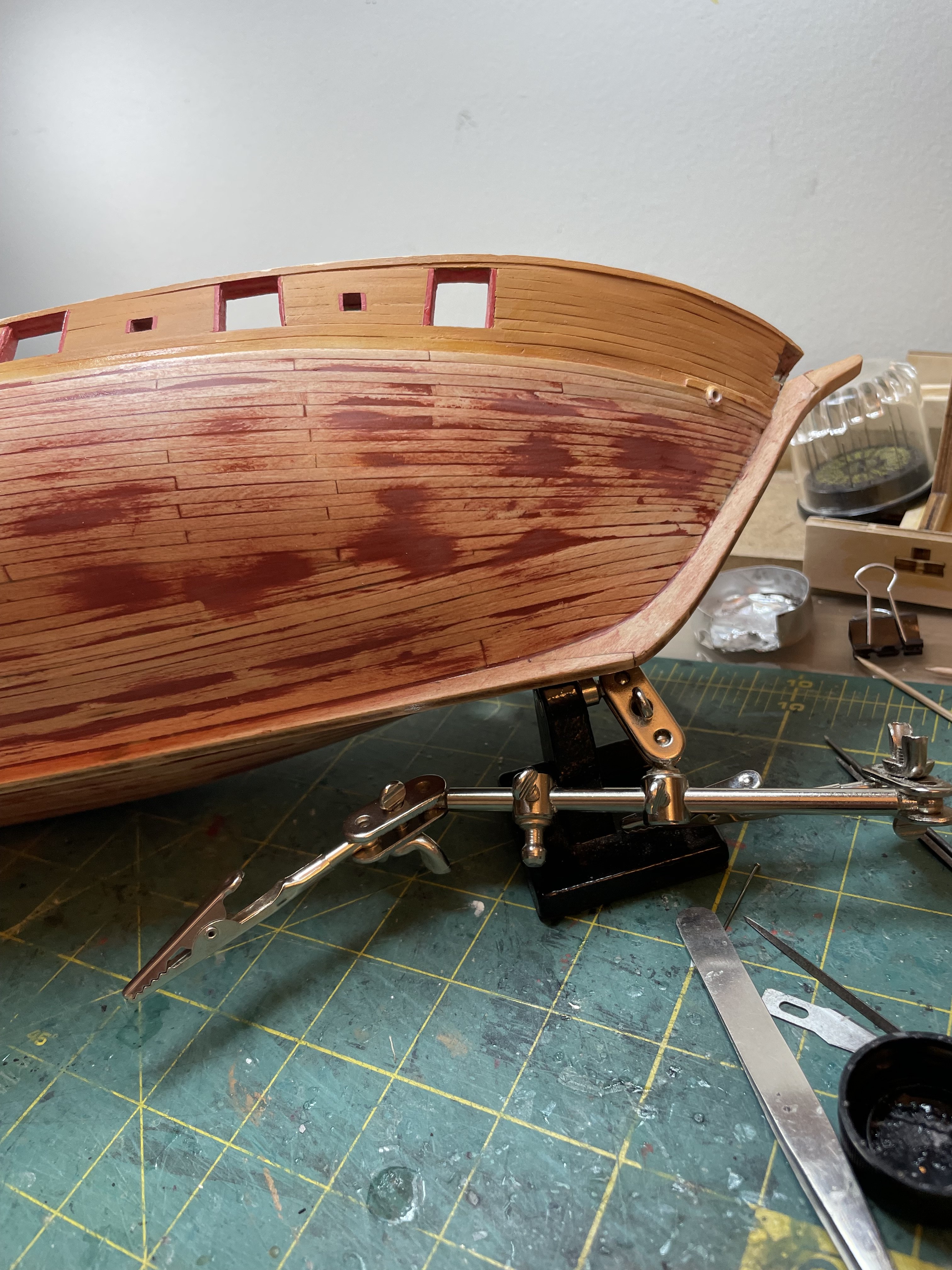

Onto the first batch of hull planking. My first time at doing this so I am not totally unhappy with it and as the hull will be painted I can apply filler when the hull planking is complete to even out my efforts

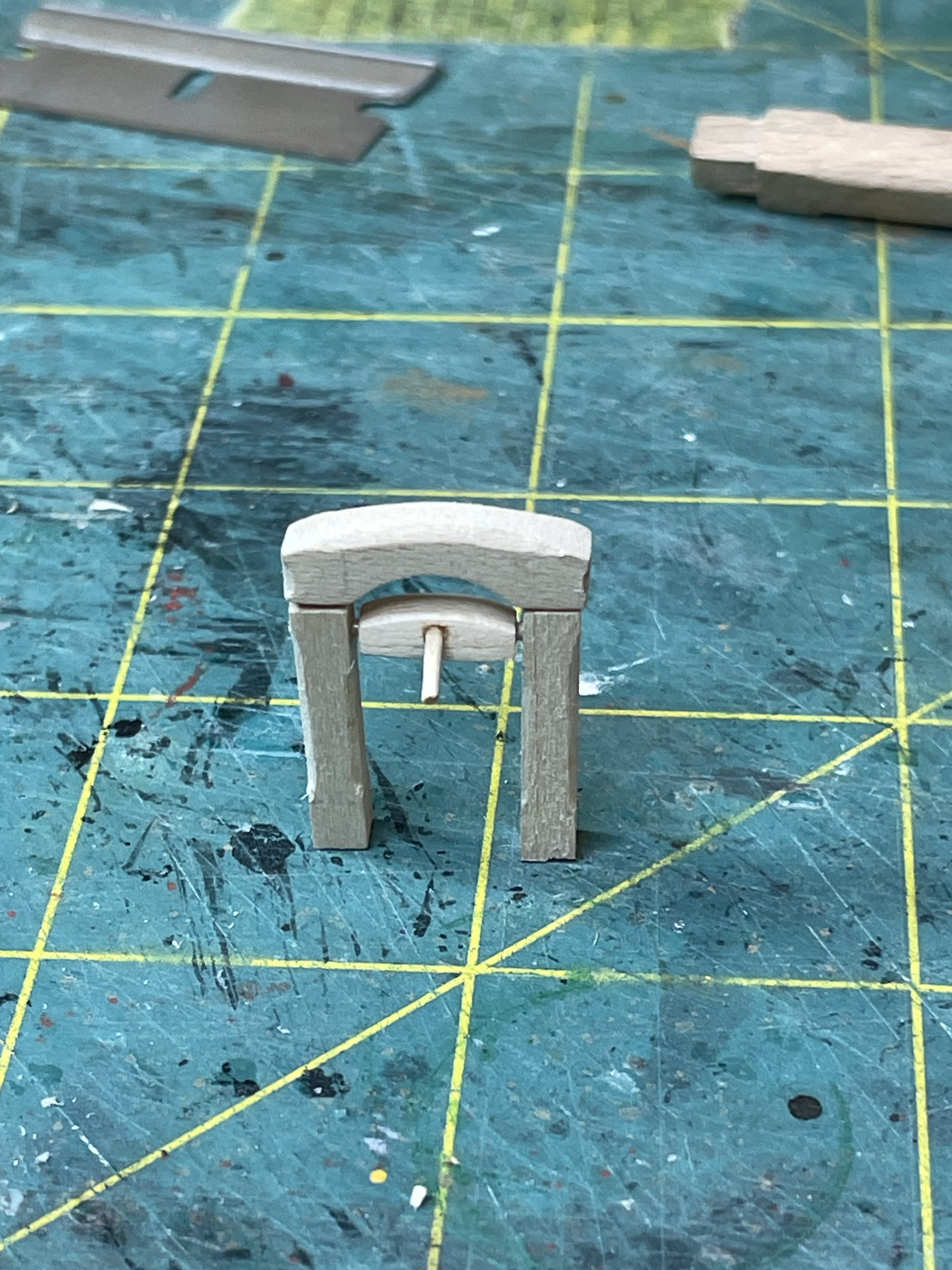

Last work has been to put together the capstan which needs a little tidy up paint wise but otherwise is complete. The disc on top of the capstan is cut out of plastic sheet with very small diameter plastic rod inserted and sanded down to represent the fittings.

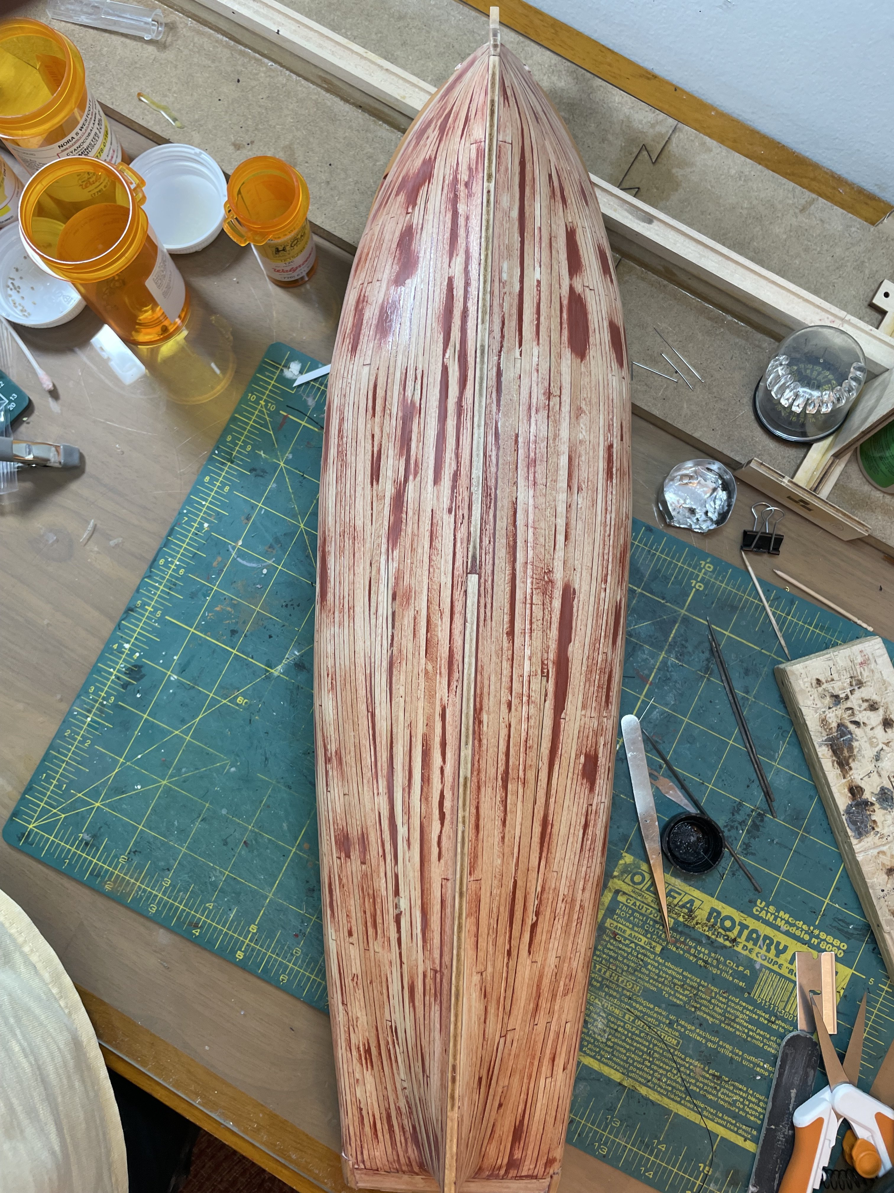

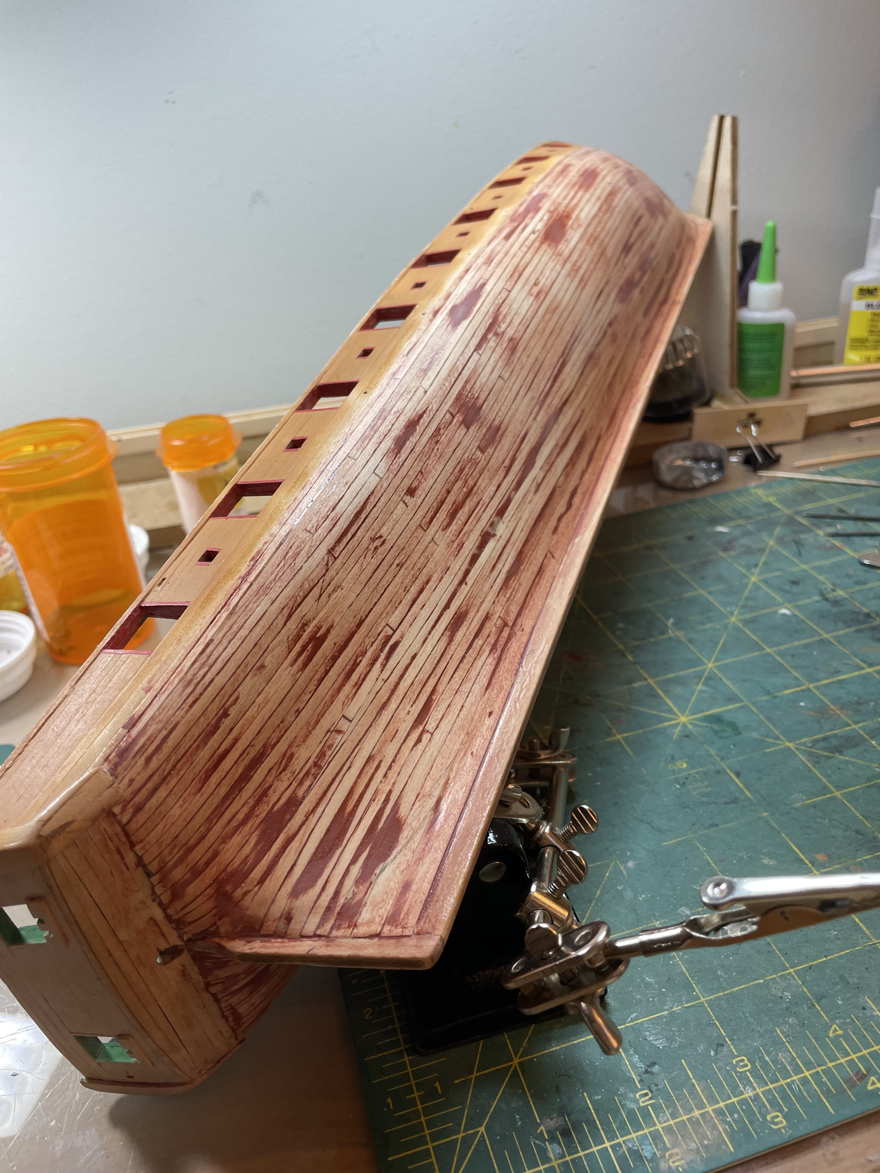

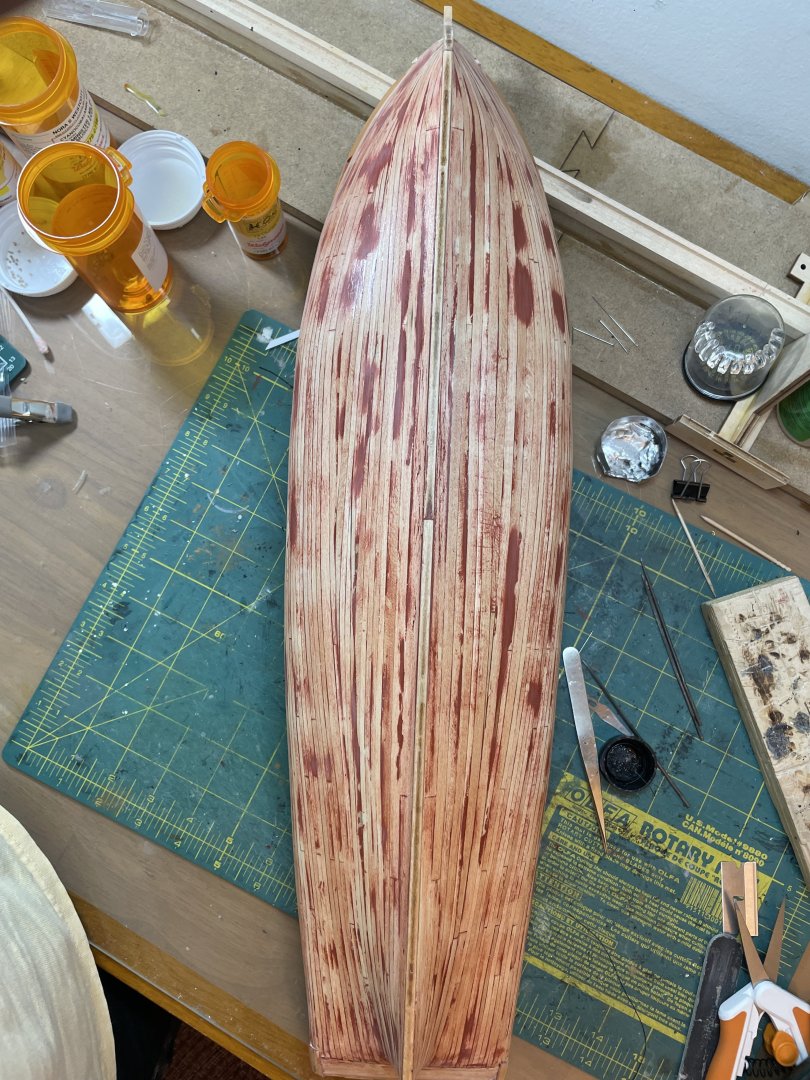

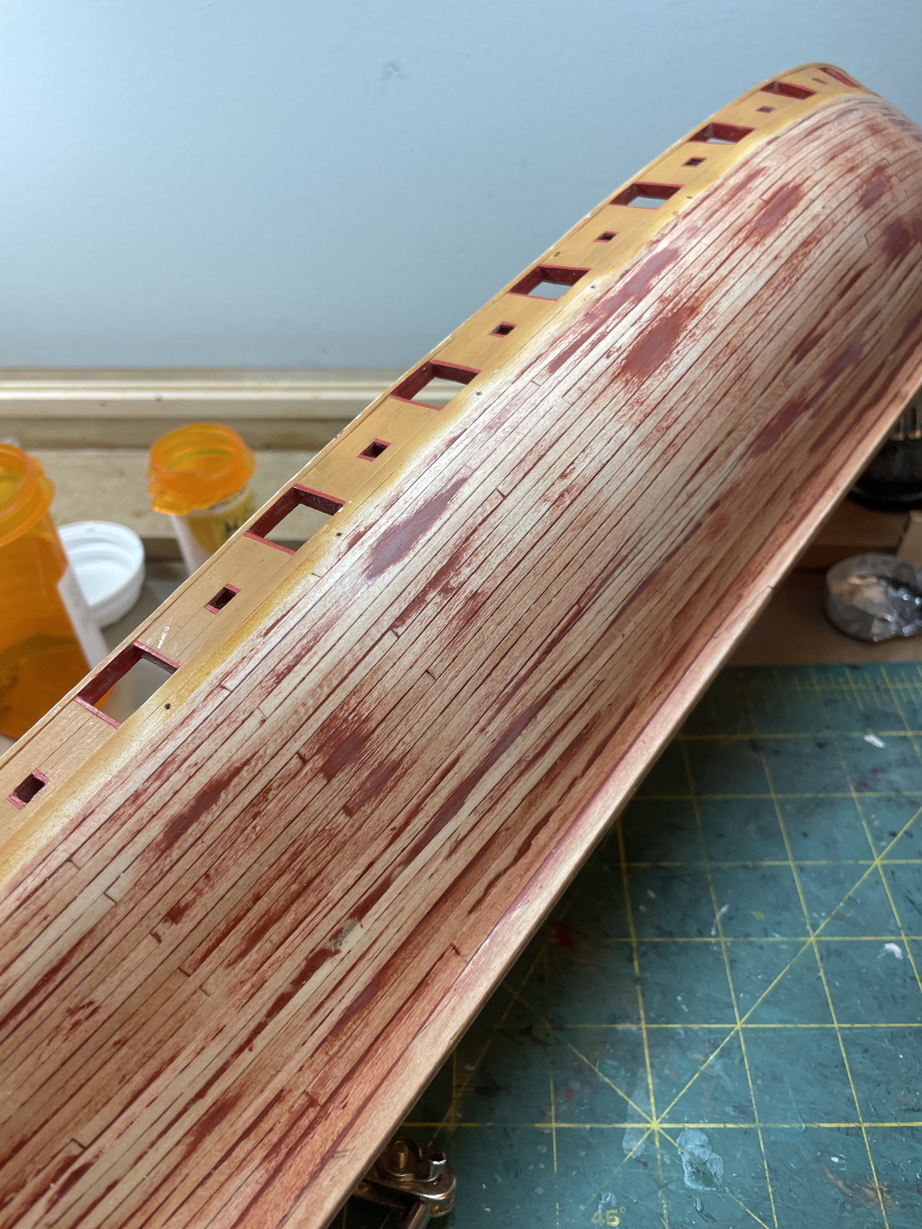

After working on the masts and yards I turned my attention to completing the planking on the hull. Not 100% happy with it but it's the first planking like this I have done and after use of bondo filler and judicious sanding it was completed and ready for a couple of coates of sanding sealer to get rid of "fuzzies" on the wood and next step will be priming.

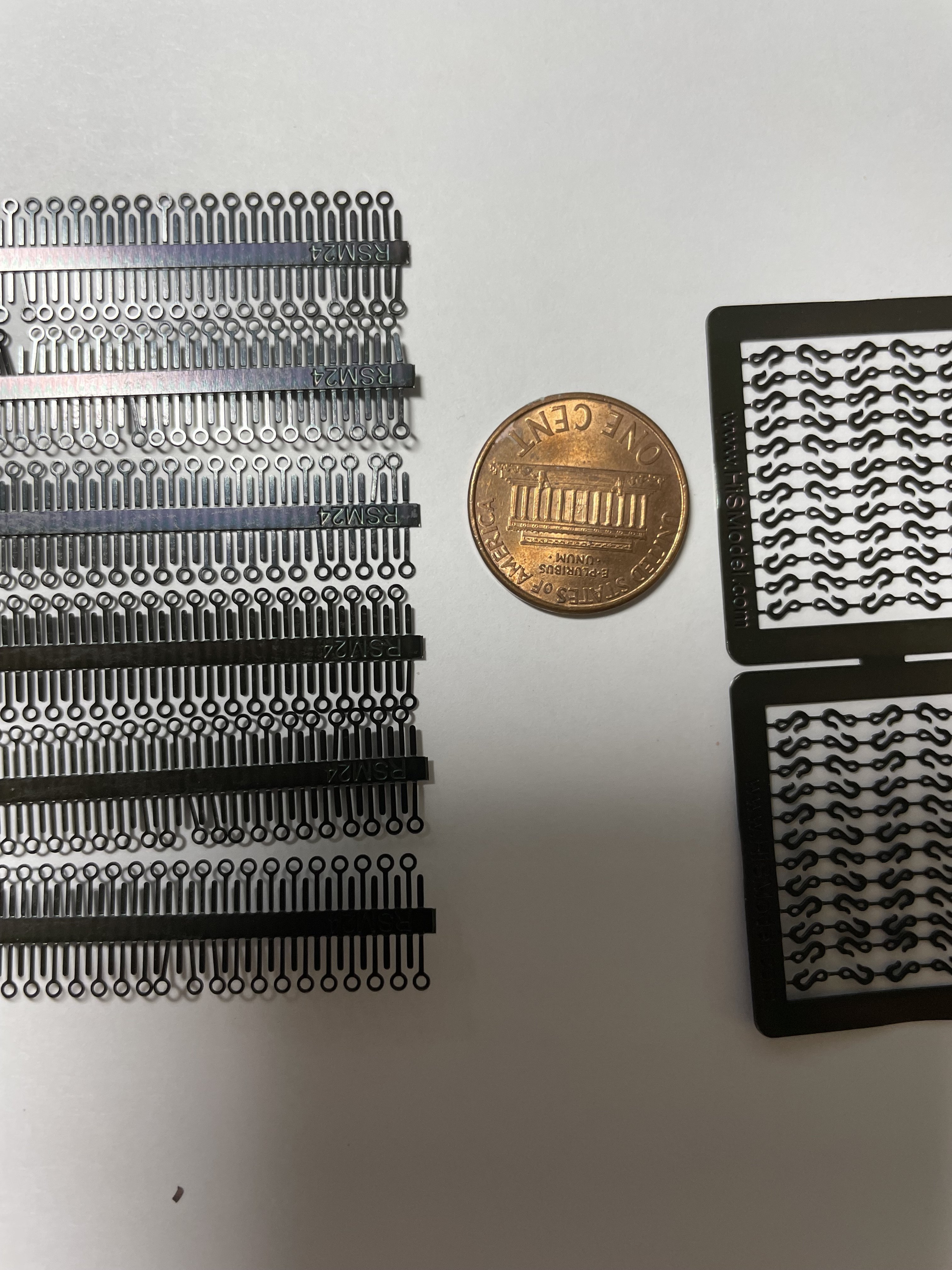

I could not put it off any longer - construction of the cannons and carronades and all the associated rigging. Got small very small hooks and eyebolts online as I just wasn't pleased with the hooks I coul make myself

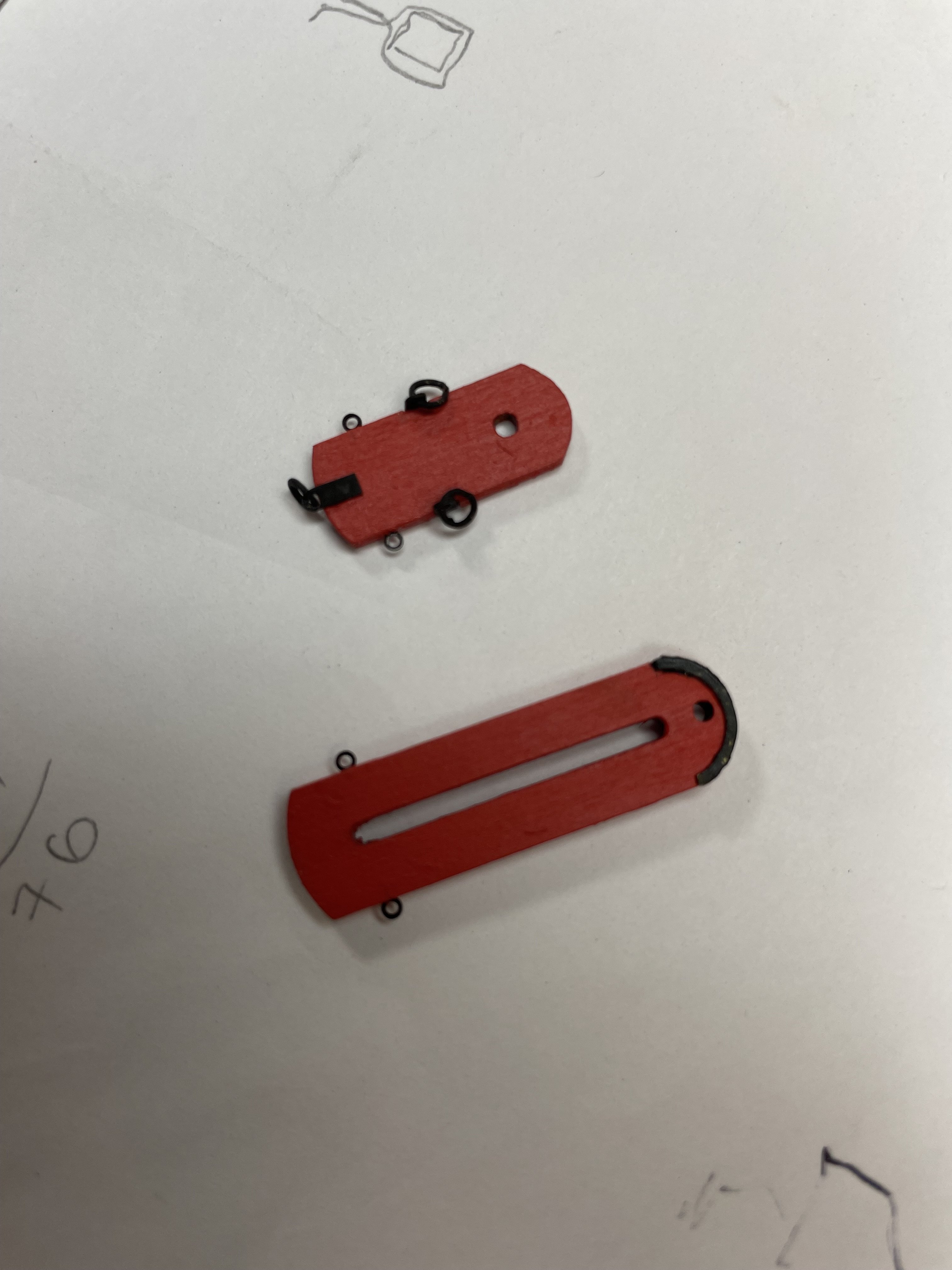

Started putting together, and painting the carronades, adding the required hardware. The hardware was made out of the rings and brass strip provided in the jit, blackened using a commercial blackening solution.

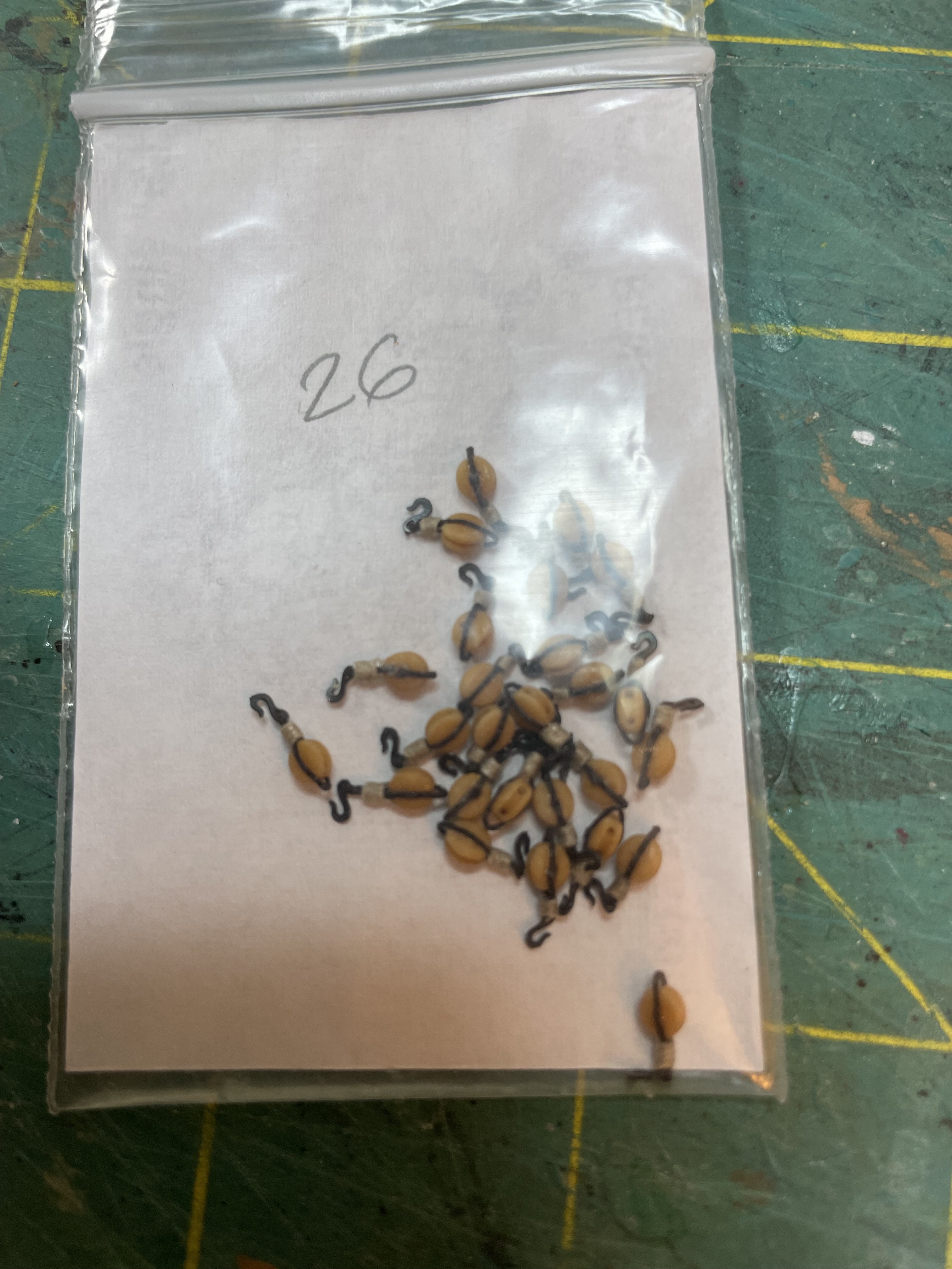

And then on to the (for me) daunting task stropping the blocks for the rigging for the cannons and carronades. I purchased rope and blocks from Syren and as many other people have stated - what lovely stuff! I ended up going down the pre-made seizing route for stropping the blocks after unsuccessfully trying other methods - It's not perfect but I am ok with the results. I'm not 100% pleased with them, but what modeler ever is?  🙂 Working through the single and double blocks in groups of 25 while working on other parts of the construction to try to maintain my sanity!
