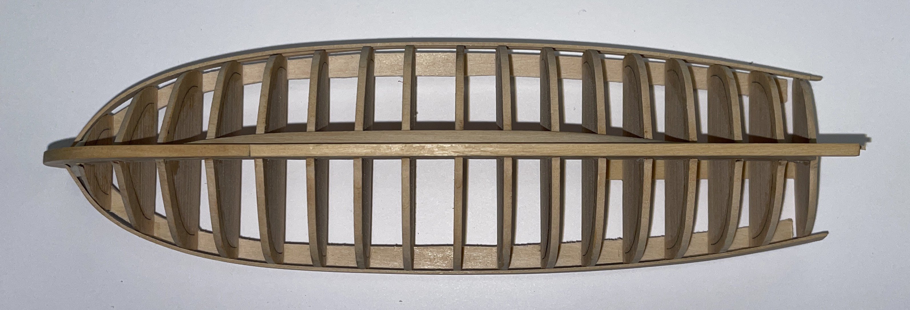

I decided to add some support prior to fairing.  The basswood pieces will get removed after.  It has been a while of gluing, debonding, and regluing, but I think I am in a good place. The frames are symmetric and look in the right place related to the bearding line.  Took longer than planned, but hopefully sets me up for success for the rest of the build.IMG_6372.thumb.JPG.4dc5b58355da7fc3578bae9130fc1f15.JPGIMG_6371.thumb.JPG.167d179e47486a936d5094af8588ab56.JPG

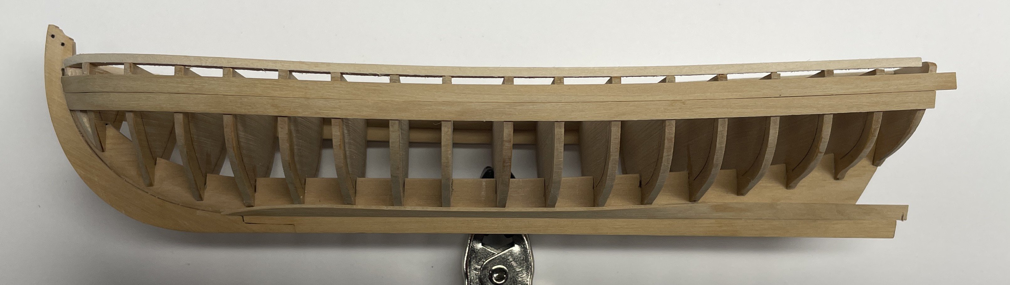

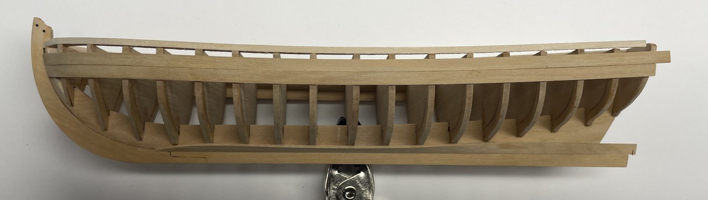

I've restarted work on the long oat.  I'm not sure how it sat for an entire year.  Somehow the rhythms of my work and personal life made it a lot easier to migrate to my plastic models.   I've added the two upper non-tapered planks and the first of the garboard planks.  I'm happy with how the garboard runs looking at it from the top and bow.  This is the first time I've seen it from the side without clamps obscuring most of it.  I'm not sure about how the lower planks will run viewed from the side and will need to see after a couple are in place.IMG_7070cropped.thumb.JPEG.cc9fee4c8a8e30ffed44c6a270b0d4c3.JPEG
