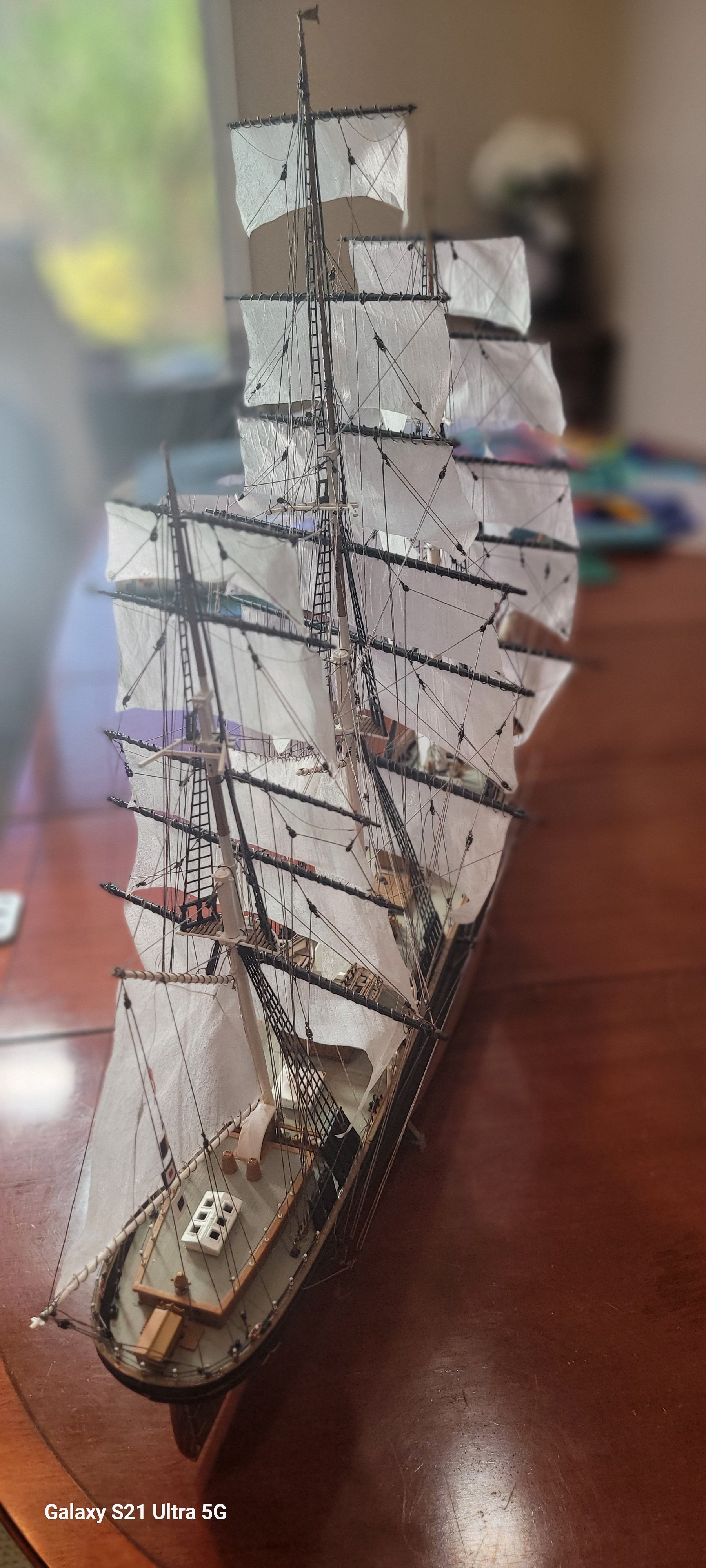

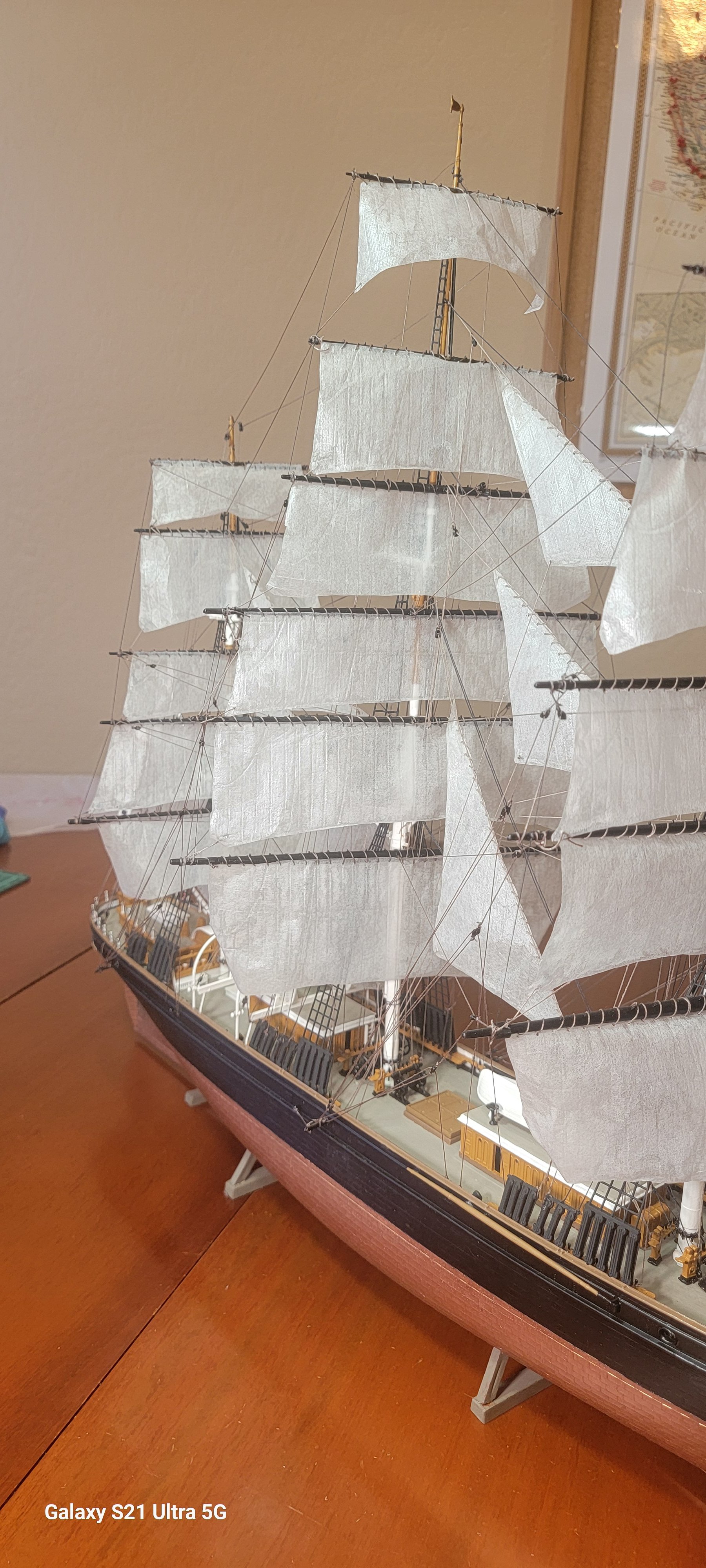

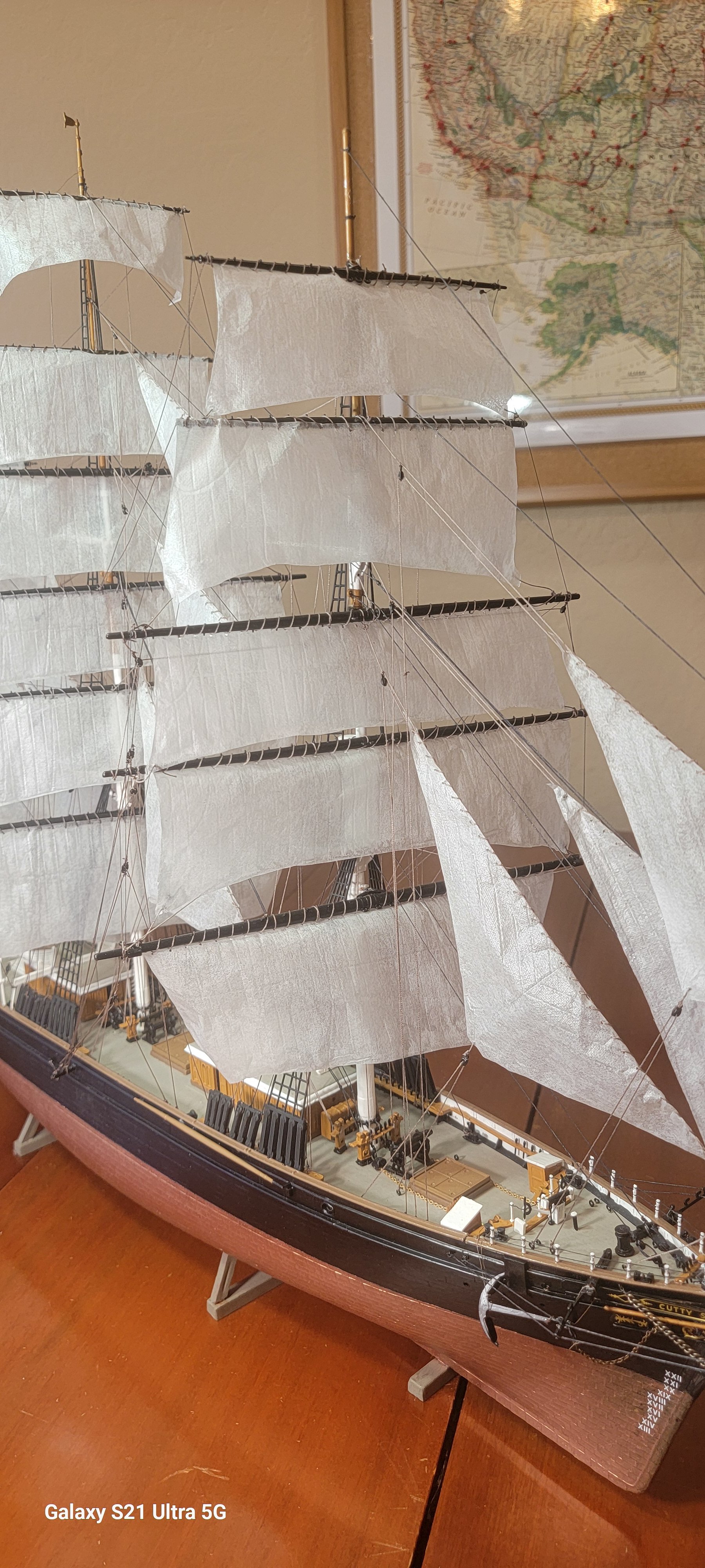

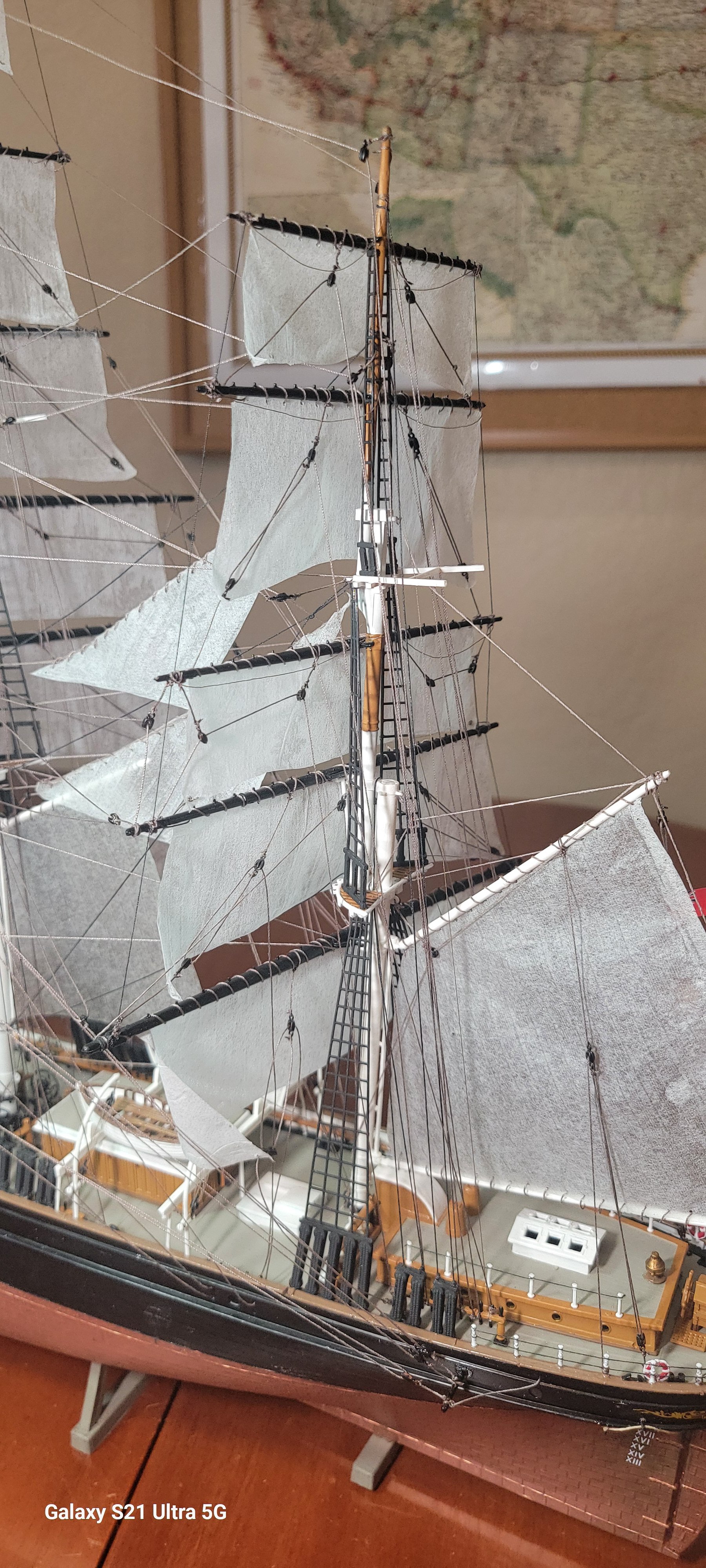

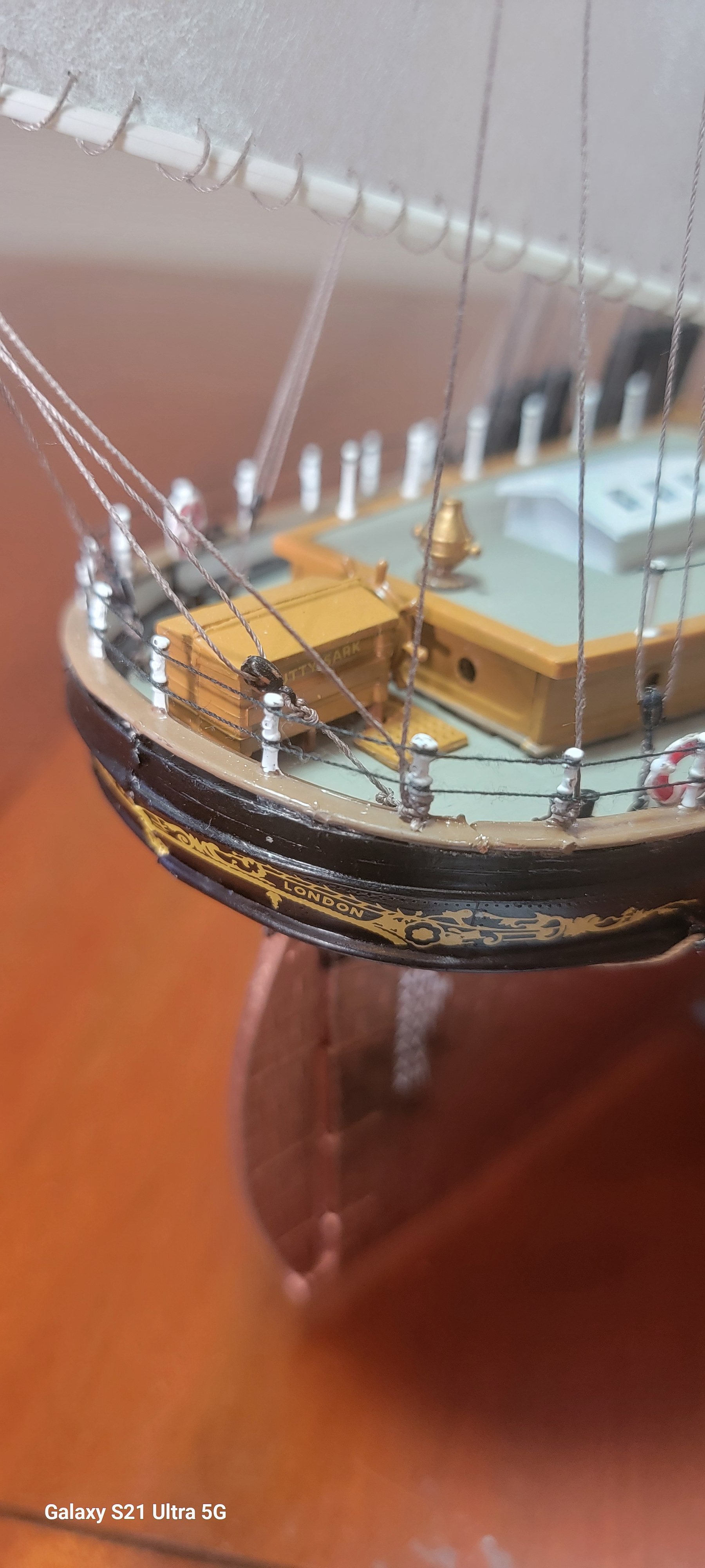

Anyway, never really stopped pecking away at the model. I'm well into the rigging and have just started the sails. Per a suggestion from here, I got some Eze Tissue and a bottle of Eze Dope. This is my first venture beyond "all stock". These products are made to cover the wings of model airplanes.
I started by soaking the Tissue in Dope and then draped and smoothed it over the tacky plastic sails. After a second coat and overnight drying I carefully peeled it off. While the finished product is a bit translucent, I'm quite happy with the result compared to the plastic version. And despite how fragile it appears, it's quite durable. It even transferred the texture of the plastic.
What do you think?

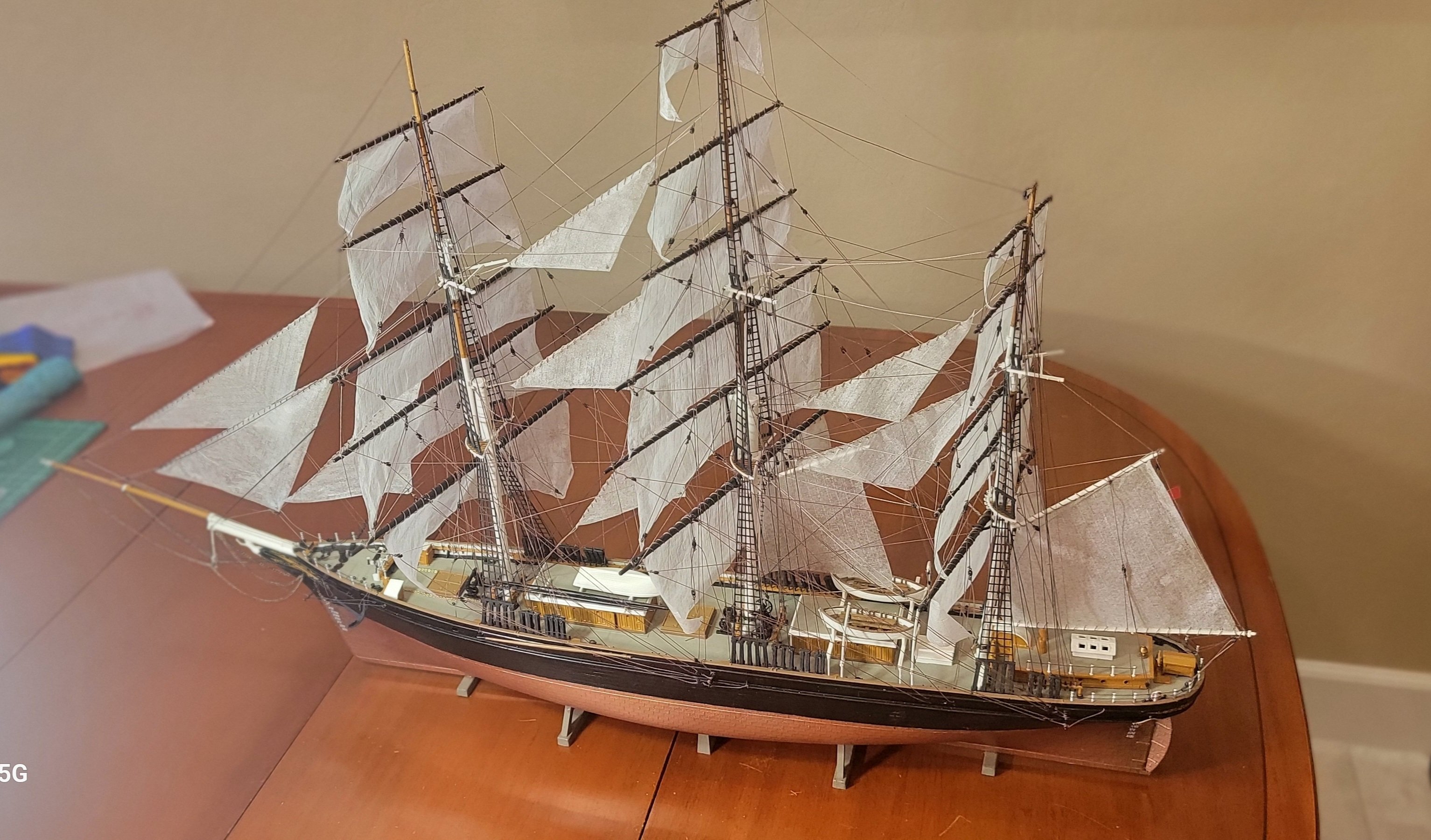

 David, it's good to see you post again, glad you enjoyed the cruise. The sail shapes will look good once trimmed but they're too transparent,IMHO. You need to add color. The link below is to Bruma's Cutty Sark build, his sails are some of the best.
Current Builds:  1870's Sternwheeler, Lula
Completed: 1880s Floating Steam Donkey Pile Driver
David, I think you’re on to something here. I had fleetingly wondered about using the plastic sails as formers but parked my build, largely because I still don’t have a sails solution, before trying it. Anyway, I agree with Keith, they look very promising in the raw but need a bit of paint and weathering.
