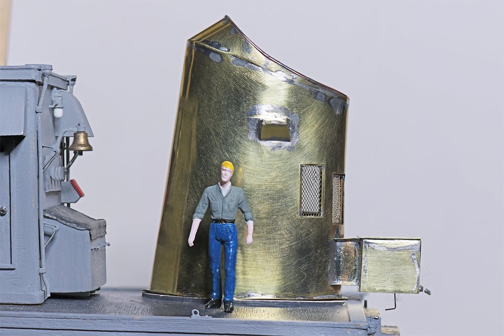

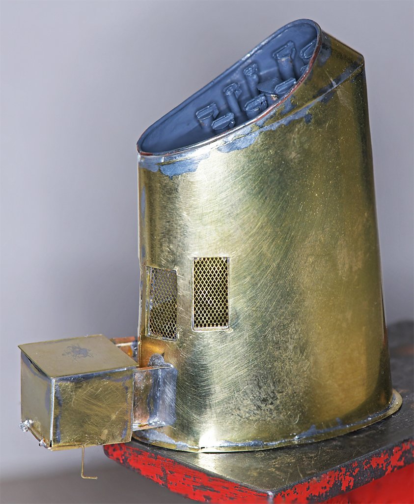

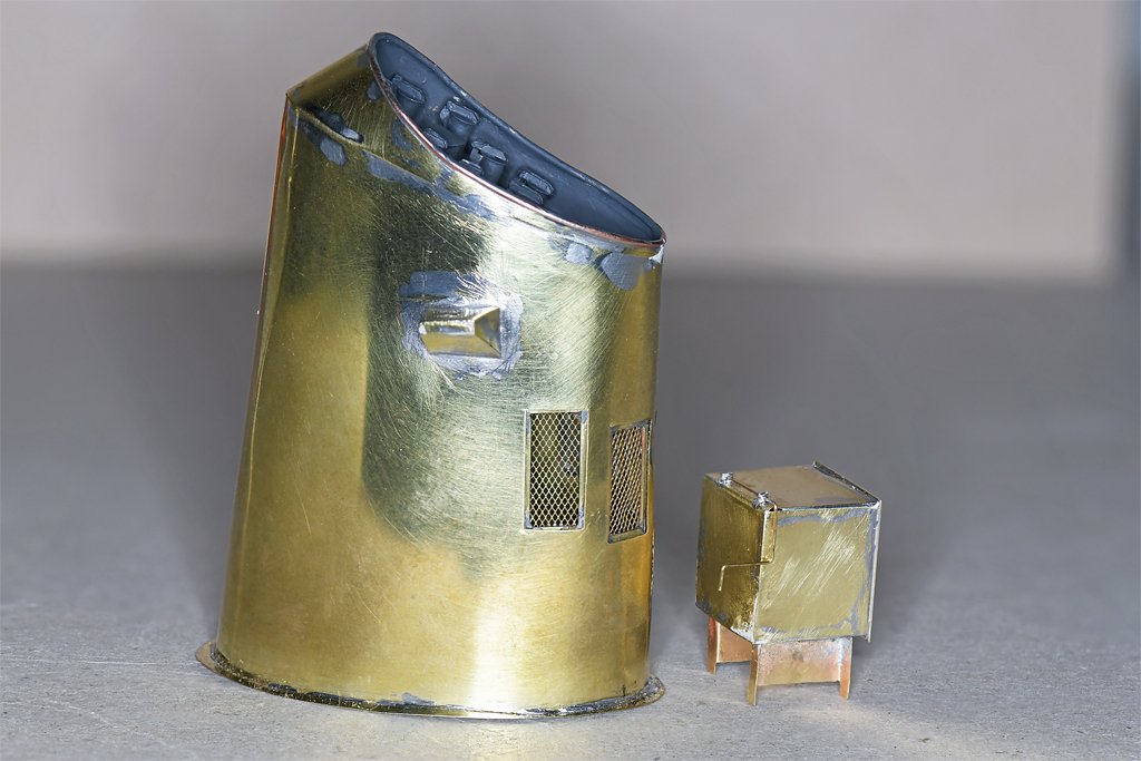

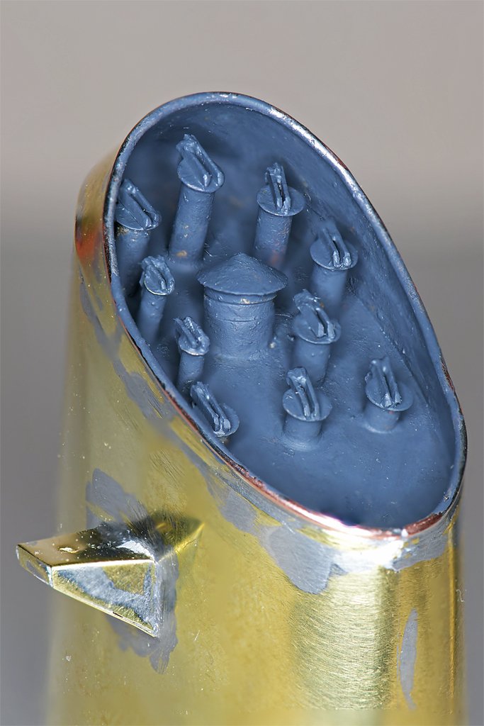

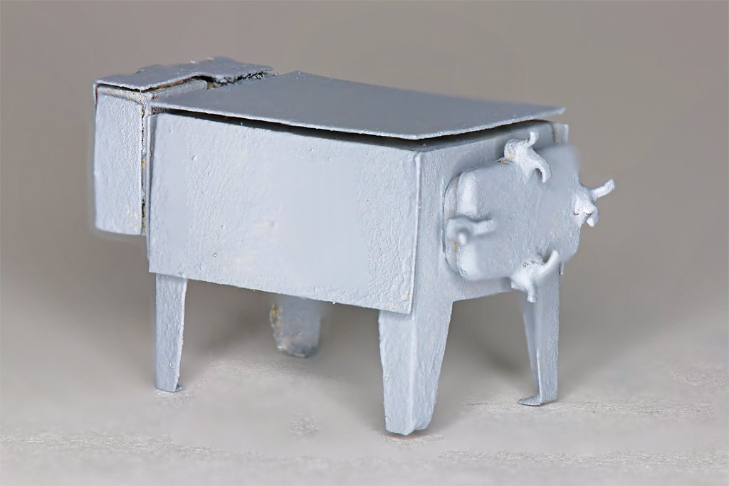

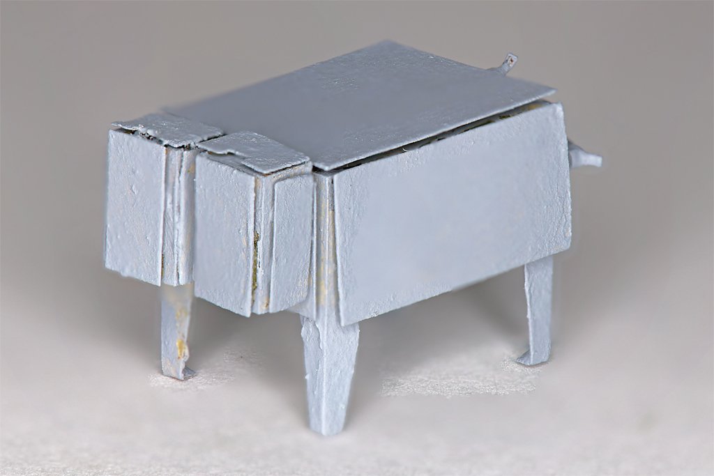

smokepipe11.jpg.74b4caeb5953a3f3e06f5fa7c8f53753.jpgI am finishing up the smoke stack. I made the conical cap for the boiler vent from a brass rod, turning it on my hand drill.
The hinges for the diesel exhaust pipe caps were made from 0.010 inch (0.25 mm) styrene strips. First the lower pieces were glued to the brass pipes with CA gel. After the CA set the two hinge strips were glued to the lower piece with plastic model cement. I used a bit of clear acrylic sealer to "glue" the styrene hinge strips to the top of the cap. It probably isn't the most robust assembly, but they are protected by the stack cap.
I painted it with the grey paint I am using for the decks. It is Tamiya XF-63 German Grey. I have found that the Tamiya paints do not cover well on brass. This was all washed with water to remove the liquid flux, and then acetone to remove any resin flux and oils. There are three coats of paint on this assembly, each allowed to dry over night, and still there are places the paint just "rolls back" leaving exposed brass.

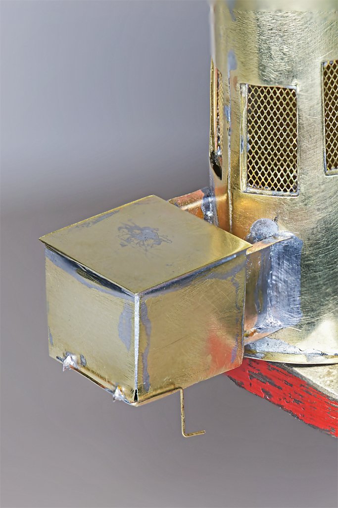

The platform jutting from the side of the stack is a support for a radio antenna. I suppose I could have glued it in place with CA, but the solder will make a stronger attachment. Now I need to make the complex insulators for this antenna and two more. I have the Navy electronics data sheets for the antennas and some photos taken on the ships to show me what they look like and how large they are. It will be an interesting project. But the antennas will be some of the last pieces to go onto the model.

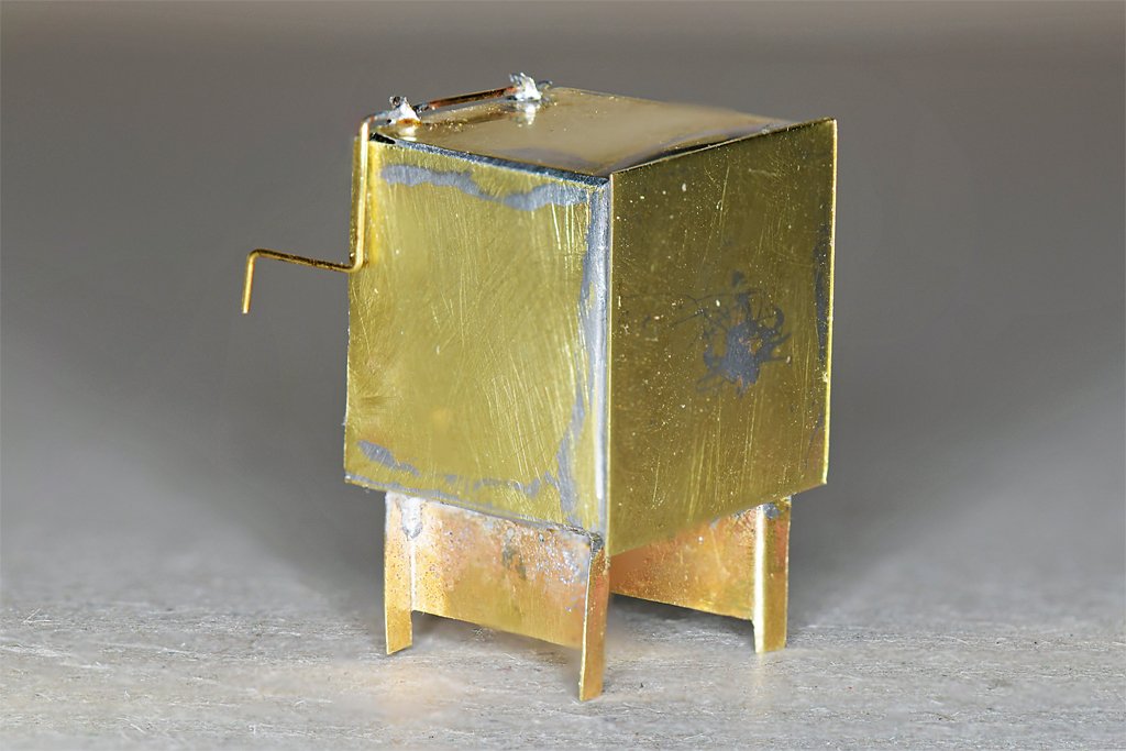

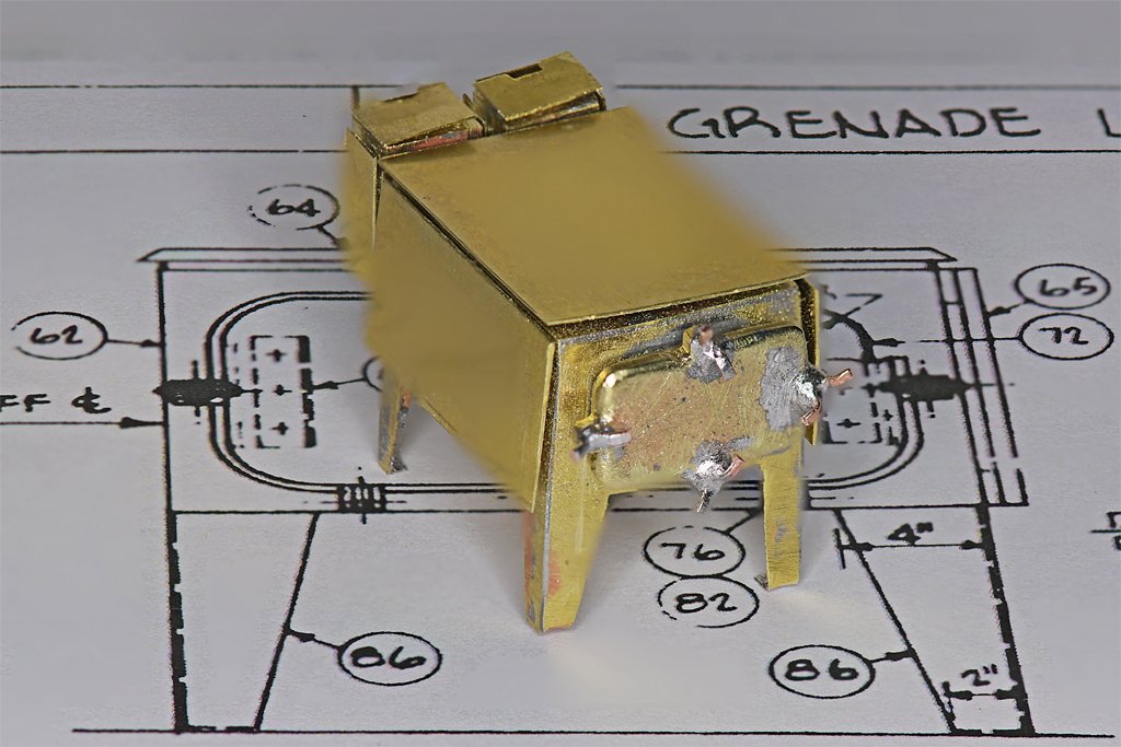

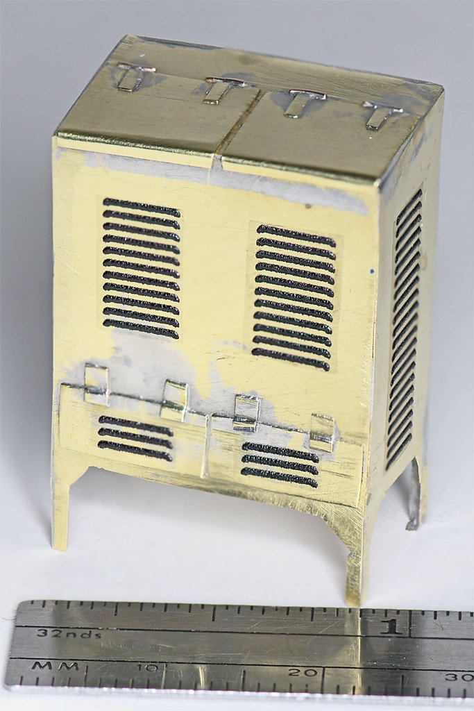

The last part of the stack assembly is the life jacket locker that was attached to the lower rear of the stack below the air intake grills. The box is a bit wider than long (about 32" wide x 31" long x 26" high full scale). I folded the box from a single piece of 0.005 inch (0.13 mm) brass sheet and then soldered the edges. A separate 0.010 inch (0.25 mm) thick top plate was soldered on - this hides the folded edges that were a bit rounded. A 0.010 inch brass wire serves as the handle that released the bottom of the locker to dump the life jackets.
lifejacketlocker.jpg.26a982898c7ee201adaa92085485309c.jpgsmokepipeandlifejacketlocker1.jpg.19ba59128a41e26991eefe7fb4e08a88.jpg
smokepipeandlifejacketlocker2.jpg.195dbf3155321b630c2f3ddeb7399ba7.jpgsmokepipeandlifejacketlocker3.jpg.4390b0da9c03fbee6d806ff21921bad7.jpg

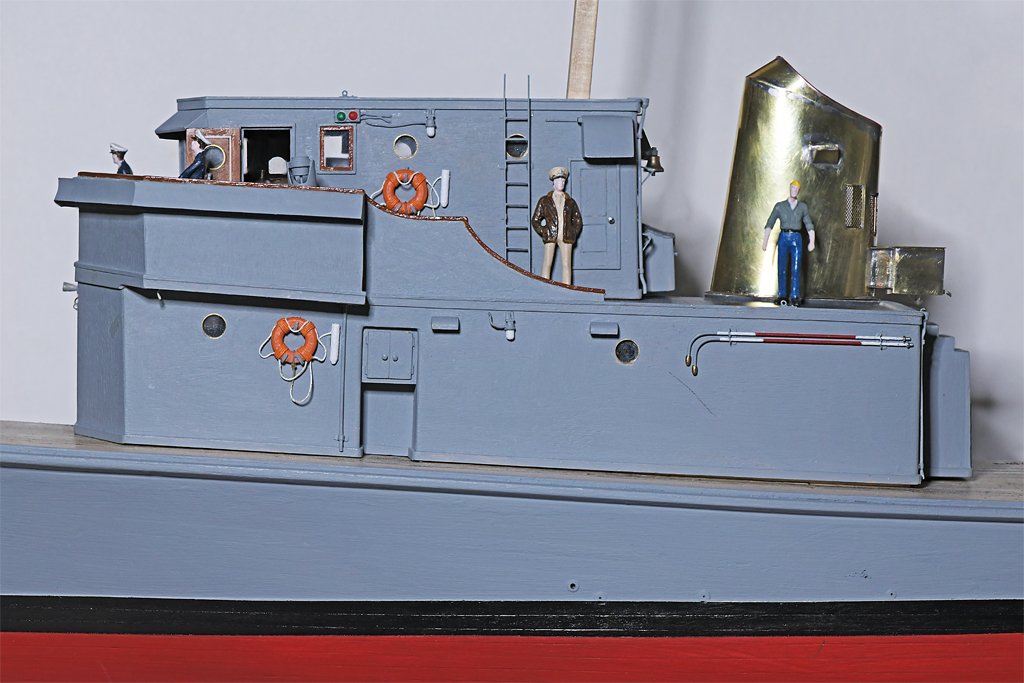

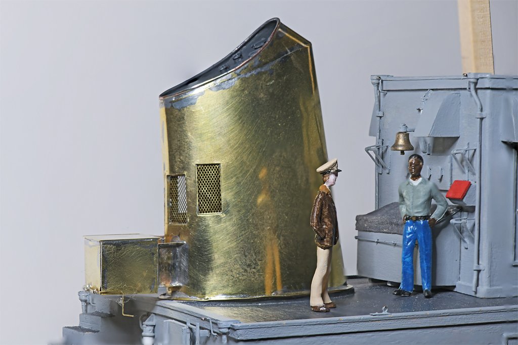

Here are some photos of the stack in place on the aft end of the O1 level.
smokepipeinposition1.jpg.e4e6827d7796d17d7f27753357dc6d9e.jpgsmokepipeinposition2.jpg.e7e7dfc436d43be64a3845c0aca1d258.jpg
Now I need to prime the funnel and paint it to hide all of the solder stains in the brass! I probably won't get around to that until next year.

This type mechanism was common for life jackets on US Navy ships. The top is a lid that hinges up, allowing life jackets to be tossed in after use. The bottom is a door that hinges down, allowing the life jackets to tumble out on deck. I have studied the blueprints on the Cleveland class cruisers of WWII and the MSI blueprints of the 1950-60s. One thing they have in common is that the lever that pulls down to open the bottom door was held in place by an ordinary US Navy issue 1/2 inch (12.5 mm) fuse clip. Two of these were used in electrical circuits to hold a cylindrical fuse. Just one was used to hold the 1/2 inch diameter life jacket release handle.
The MSI lifejacket locker had to be located above a place on the main deck that was open and easy to get to but not in a passageway. As you will see as the build progresses almost the entire main deck was covered with equipment or stowage lockers. About the only place suitable for the life jacket locker was above the fire hose station at the rear of the main deck cabin. And there was nothing else attached to the rear of the stack which was directly above the fire station, so that was a convenient place to mount the locker.
The Cape had a crew of 19 enlisted and 3 officers. The life jacket locker held 25 CO2 life jackets and 3 "fibrous glass" life jackets. I guess the three fibrous glass life jackets were for the officers. They didn't need a charged CO2 cylinder. There were 6 spare CO2 life jackets in case some didn't work.
The ship also carried two 15 man inflatable life boats and a 12 foot (4 meter) "wherry," a small boat with an outboard motor.

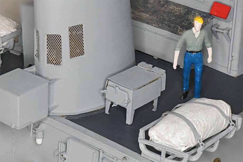

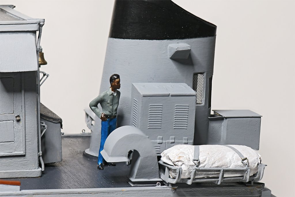

smokestack.jpg.af31ca0edb2b60da27080f5198de06be.jpgThe smoke stack is finished (except for the antenna).
I painted the brass with a thin coat of FolkArt all-purpose satin finish sealer. This is what I have been using to seal the wooden surfaces before painting. The instructions on the bottle say it can be used on a "non-porous surface to add slight texture for increased paint adhesion." It is a water-based clear acrylic paint.
After the sealer had dried about 40 hours (delayed due to Christmas events) I painted the black top. After that dried overnight I applied masking tape over the black and painted the grey. The paint flowed on smoothly and adhered to the sealer nicely. Neither the paint nor sealer lifted off the brass when the masking tape was removed.
Here is a picture of the fire station at the aft end of the main deckhouse. The life jacket locker hangs directly overhead.
It was an open space away from passageways where the life jackets could be dumped. However, it was just relatively open! The two sailors are standing on a "portable" (removable) deck section that is directly over the four GMC 6-71 main propulsion diesels. An inclined ladder will lead down to the main deck behind the sailor on the left.
When I get around to making the minesweeping gear a small winch will be mounted on the portable deck section. The winch is for handling the large float for the acoustic sweep device. Just outboard to starboard of the winch was a davit, and the acoustic sounder mounted outboard of that. The life jackets would dump on top of the winch and the spaces around it.
A hand grenade locker was positioned where the Captain (in dress khakis) is standing. One of the life rafts will be positioned at the aft starboard corner of the deck house. Forward of that was a pyrotechnic locker.
There was a narrow walkway between the lockers and life raft leading to the top of the vertical ladder. There really wasn't a lot of bare deck space anywhere on the ship.

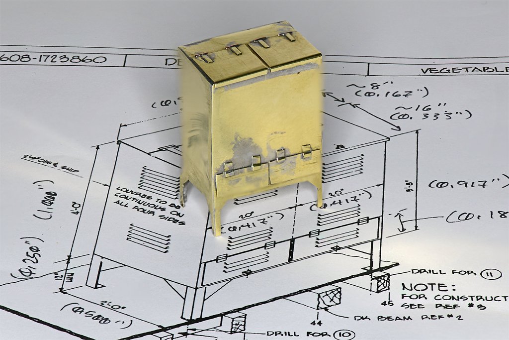

I am working to finish up the "furniture" on the O1 level.
First up was a supply vent that provided fresh air to the engine rooms. I wanted to make it from 0.005 inch (0.13 mm) brass because it looked like it would be fun. I made a 3D CAD model based upon the blueprints, and from that generated the 2D surfaces. These were printed and the parts cut out to serve as templates. They were glued (glue stick) to the brass sheet and then the parts were cut out with scissors - like cutting out paper dolls!
The pieces were soldered together with the same technique used on the smoke stack. It is sitting on a US one cent piece in the right hand photo.
supplyventparts.jpg.d6f69ee66583873700d441bde95e4832.jpgsupplyvent2.jpg.ffc7e908e7541f587ad752da423e2e73.jpg
supplyvent6.jpg.a0da33f768b274badb167468f46ac438.jpgIt went together pretty good. I drilled a hole in the center of the base and soldered in a short 1/16 inch (1.6 mm) brass rod to serve as an alignment pin.
One of the "fun" things about it is that it has a rectangular duct opening, with the long axis running athwartships (port to starboard). But the long axis of the duct penetrating the deck runs fore-and-aft. So I had to make a 90 degree twist without reducing the cross section area of the duct. This is simple -  if you have ever worked with HVAC ducts, and you have an entire workshop full of sheet metal bending tools. But it wasn't too difficult at 1:48 scale, except I had to repeat one solder joint seven times before I got everything lined up perfectly. Murphy was having fun that day!
I placed the mounting hole in the deck where the blueprints showed it. This was a bit critical because a life raft was stowed immediately between the vent and the aft end of the deck house with not a lot of spare room. And I had not yet made the life rafts! That was the next project.
