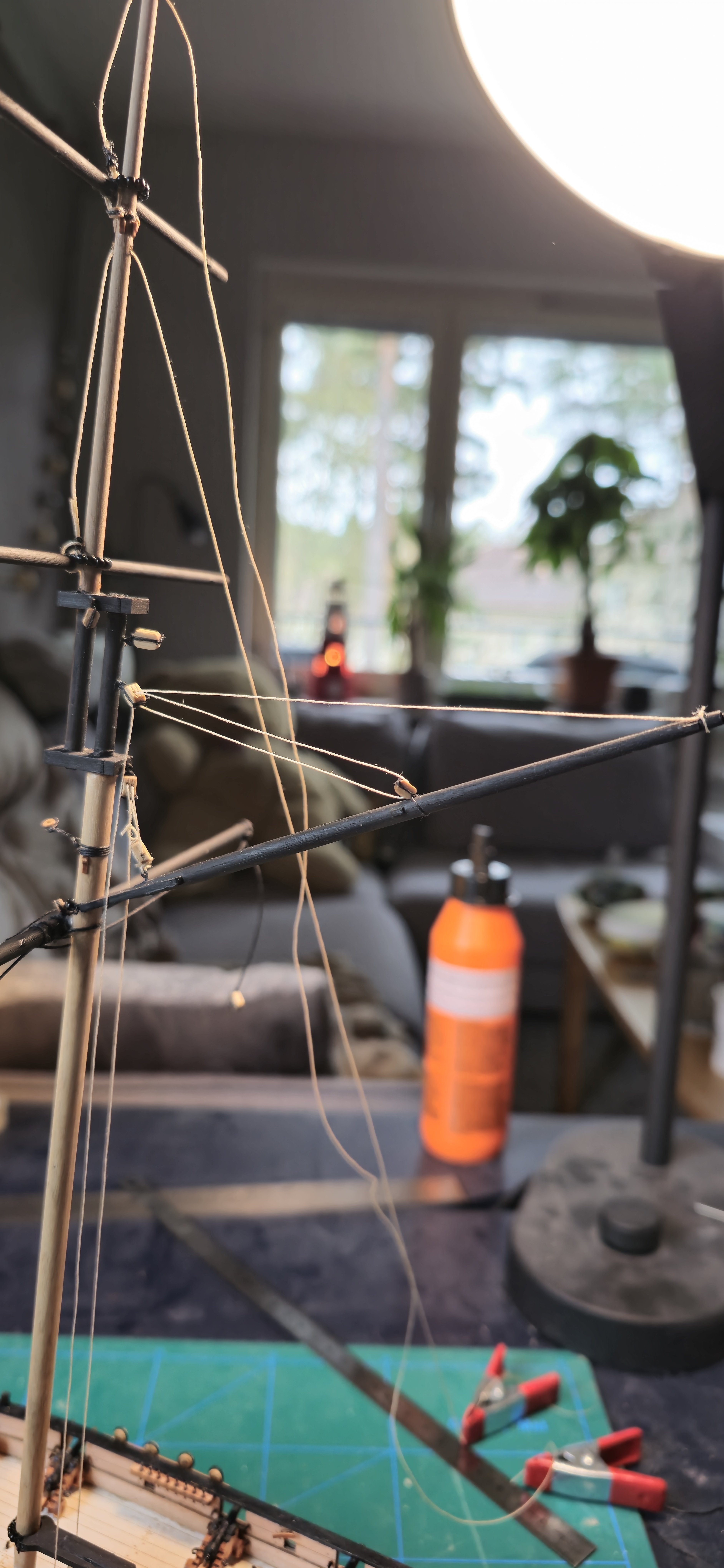

Easter season so I got time off from work.
I assembled most of the mast now and added all the strings pretty much. For the Bowsprit triple 5 mm block I glued together 3 single blocks from another old Constructo Cutty Sark. Then I attached the bowsprit which I hope was not a mistake cause I have the rigging ahead.
The mast assembly had some bumps here and there like getting the mast properly aligned. Mine is slightly off so its not entirely symmetric. Also I had some trouble figuring out a good way to attach the two 600mm strings on the yards. I did a newcomers attempt at my own seizing with some glue then I wrapped some string accepteble for this model but for future models I will try chucks guide on it.
But progress has been nice. Feels good to not be stuck on every step again haha.

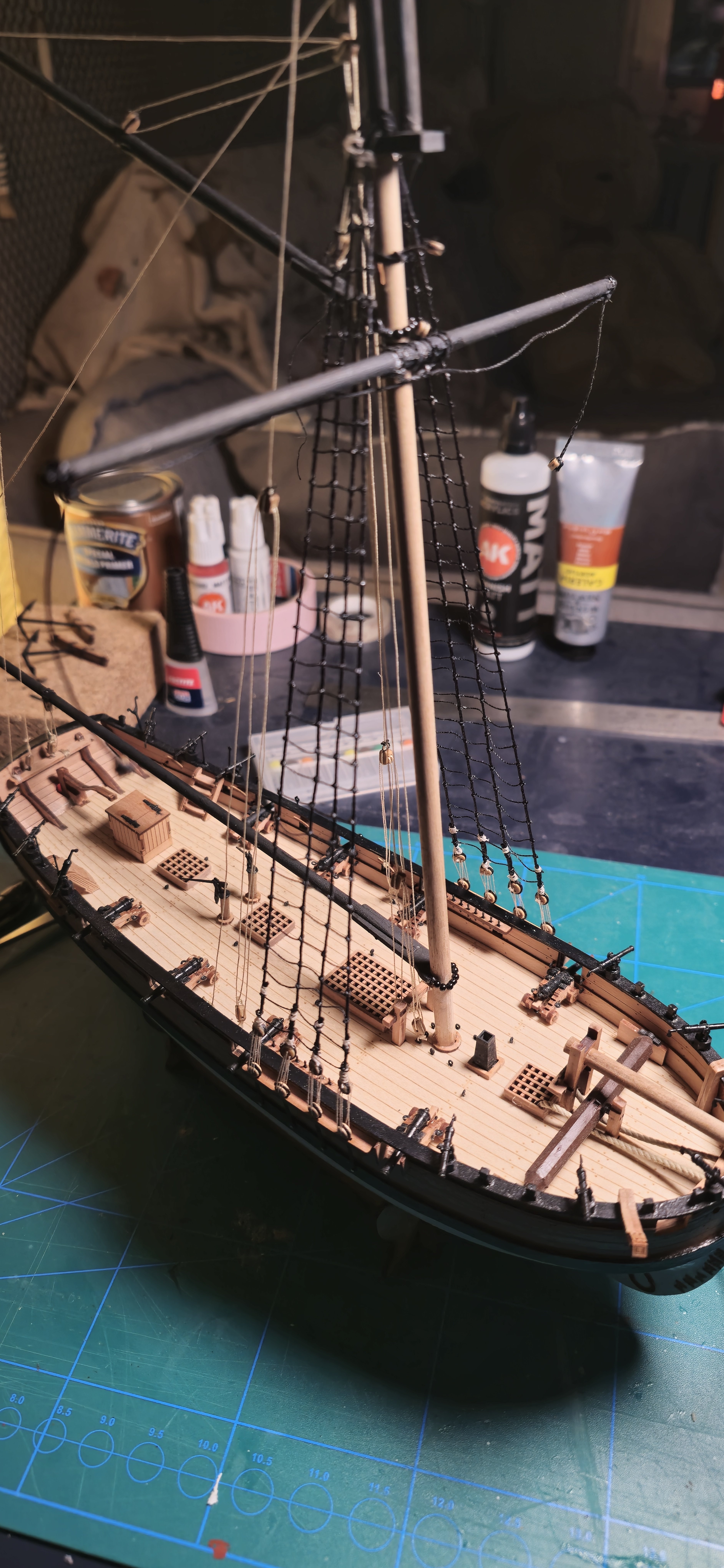

Okay the boom gaff rigging has now started I think it goes smooth.
But some questions for you more experienced people there. Are you supposed to do a clove hitch at the end of these lines into the main bitts or is it just to glue the string and wrap it around?  (Images will be posted for context.)
Also i use tweezers like the following but I feel like I might need longer tweezers so what tools do you guys use?
Other than that I feel like it has been more straightforward but a constant learning process trial and error sort of say.  Example one of my blocks of the gaff boom was tensioned with the line but then lost that tension so now it looks the way it does. Nothing abit of glue wont solve I hope.
