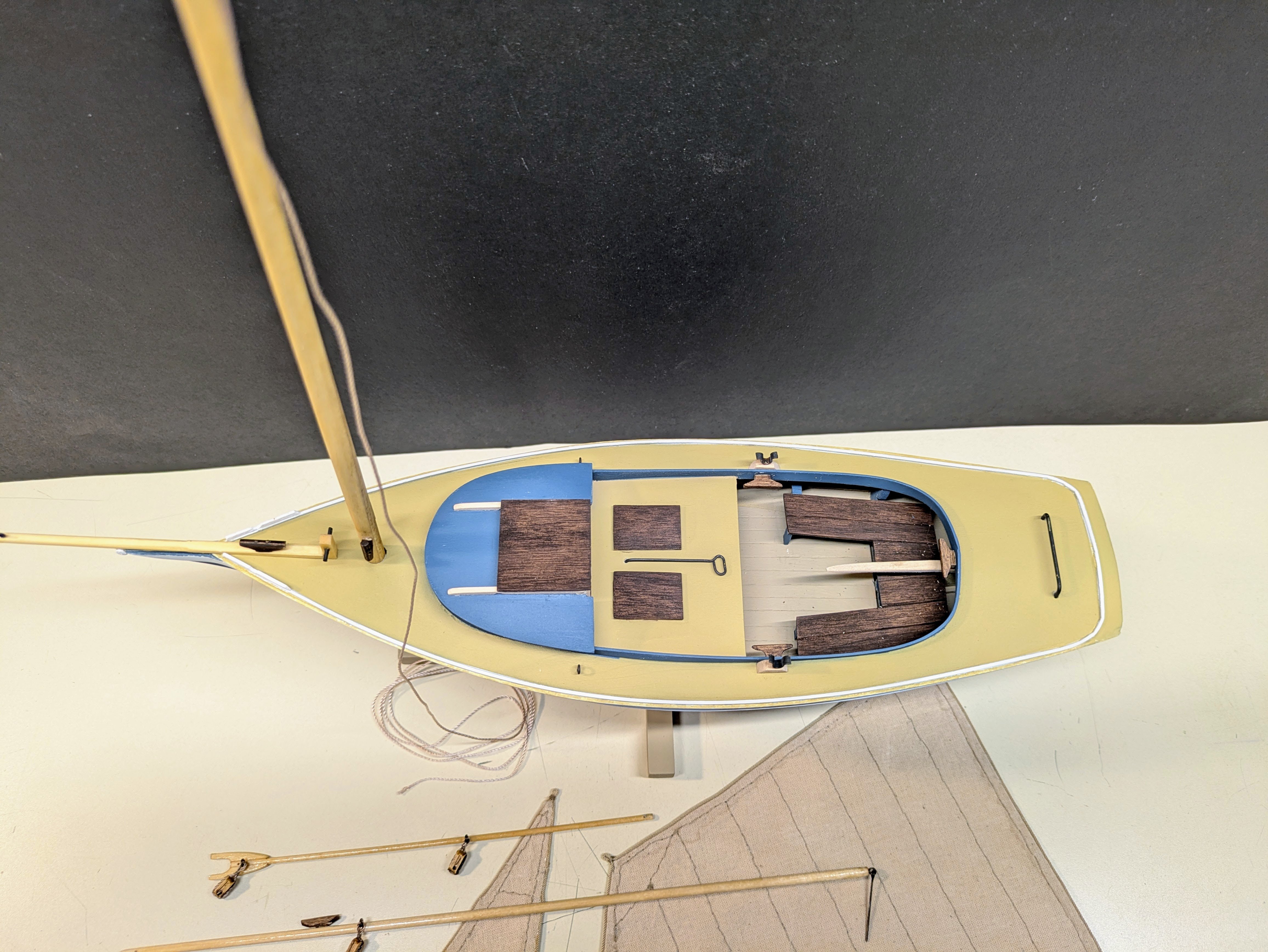

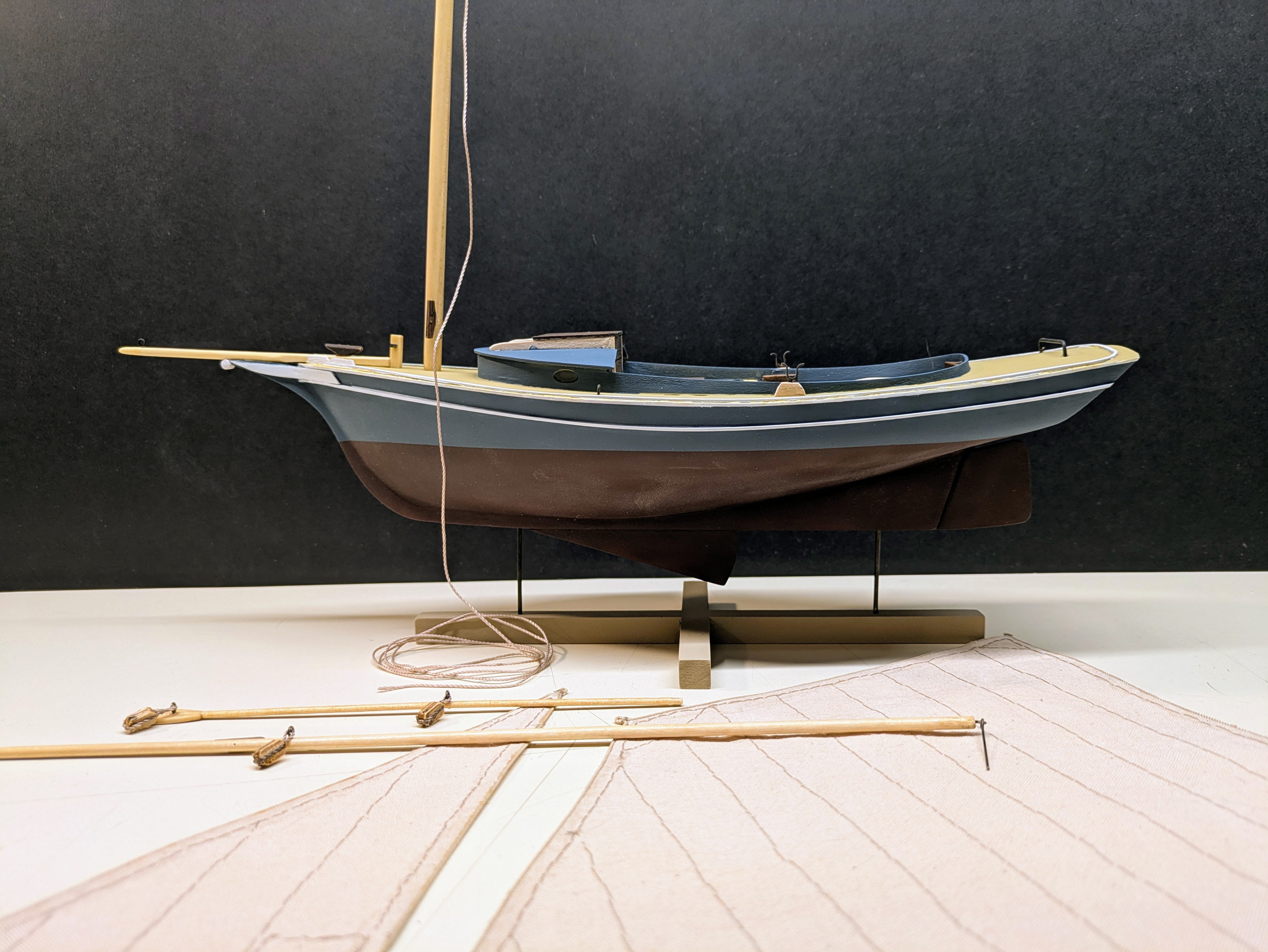

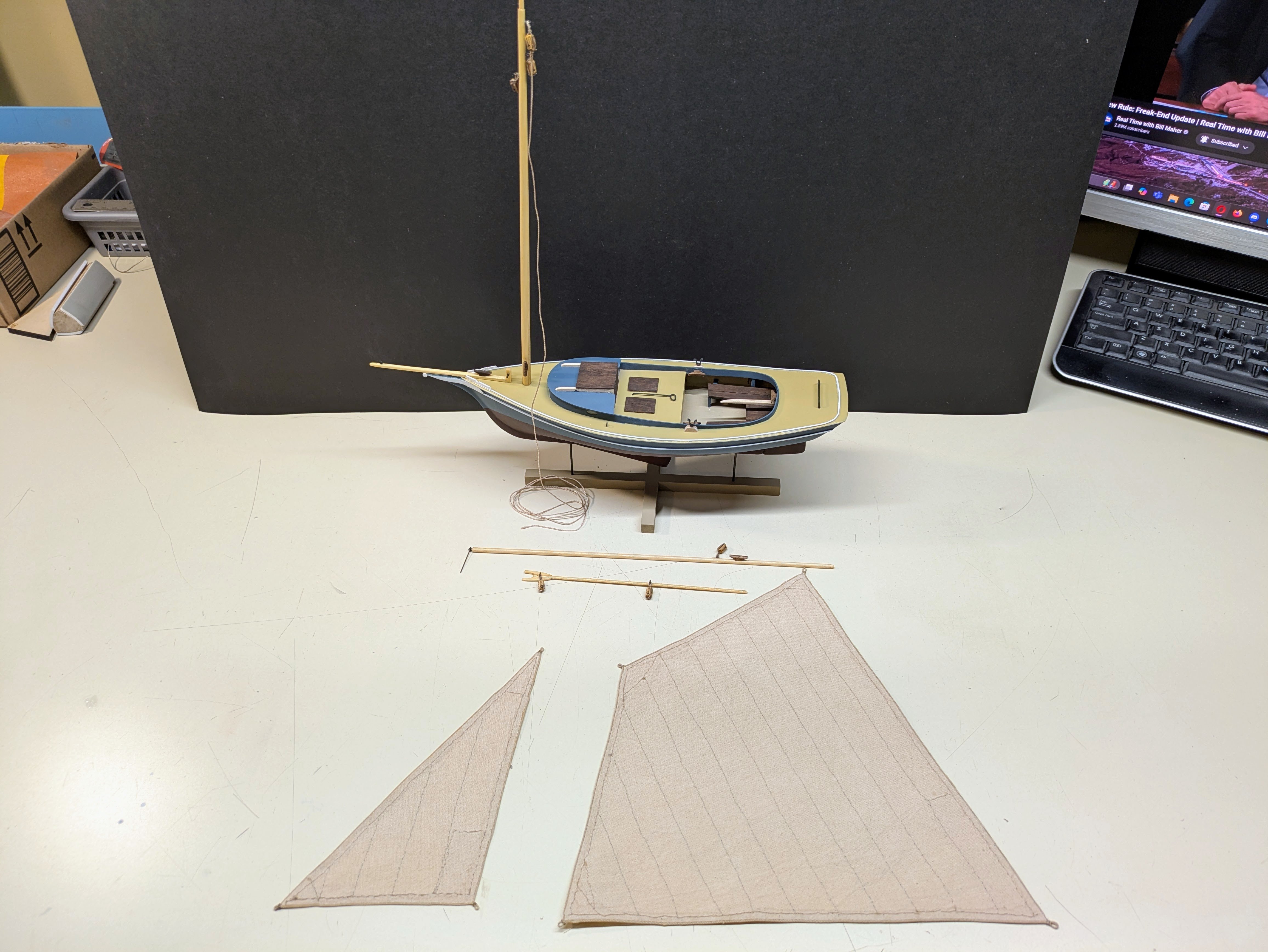

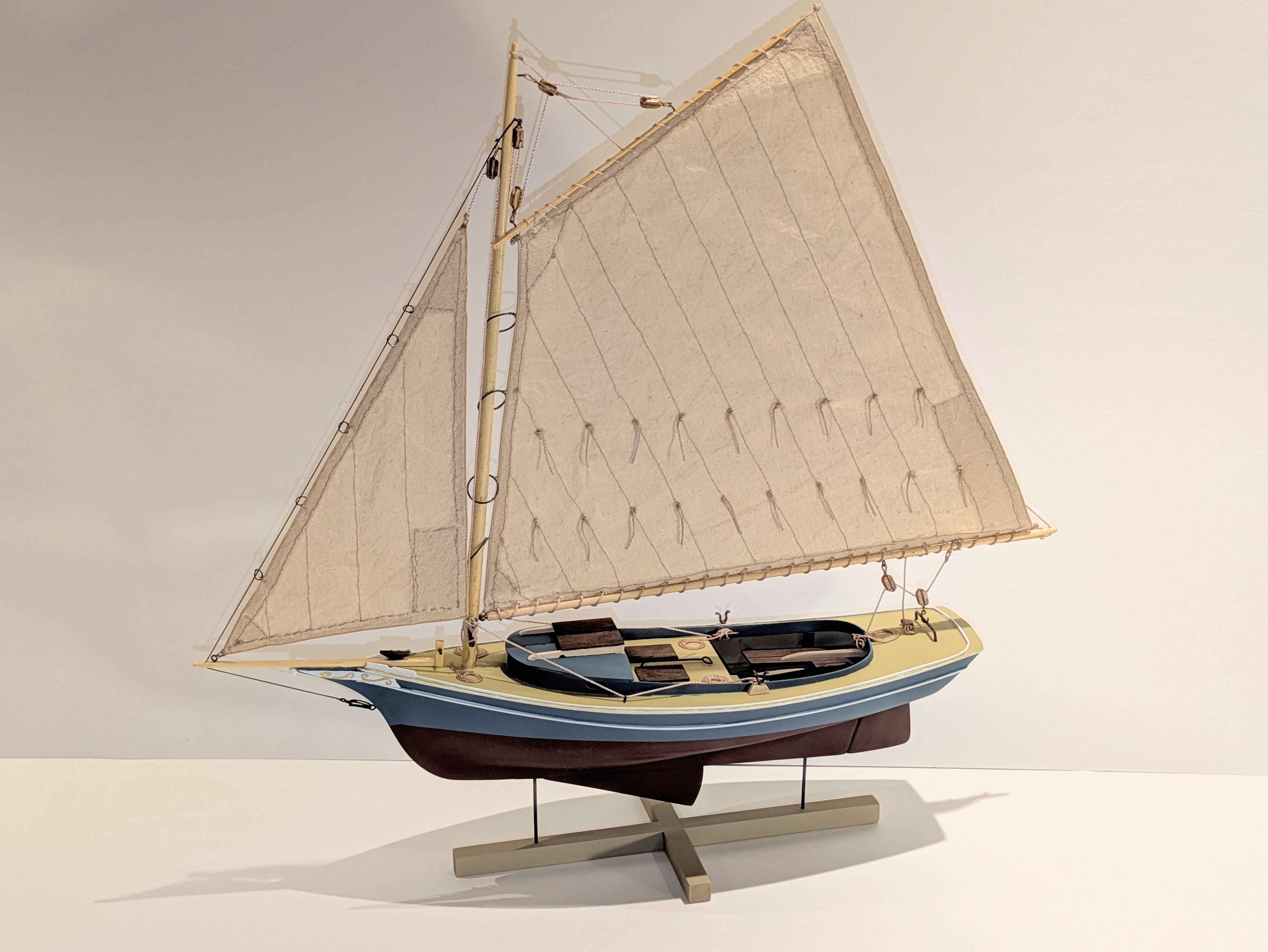

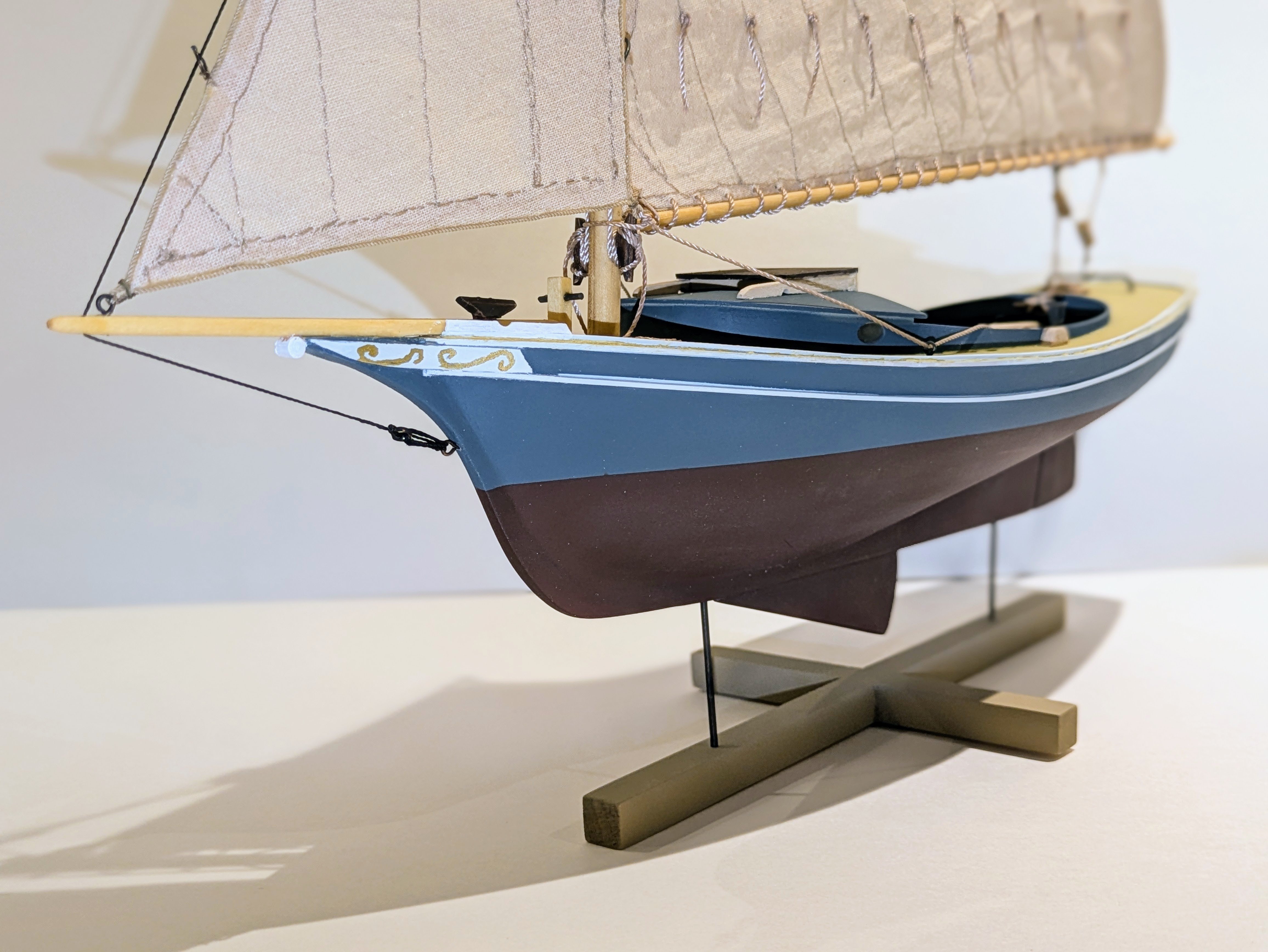

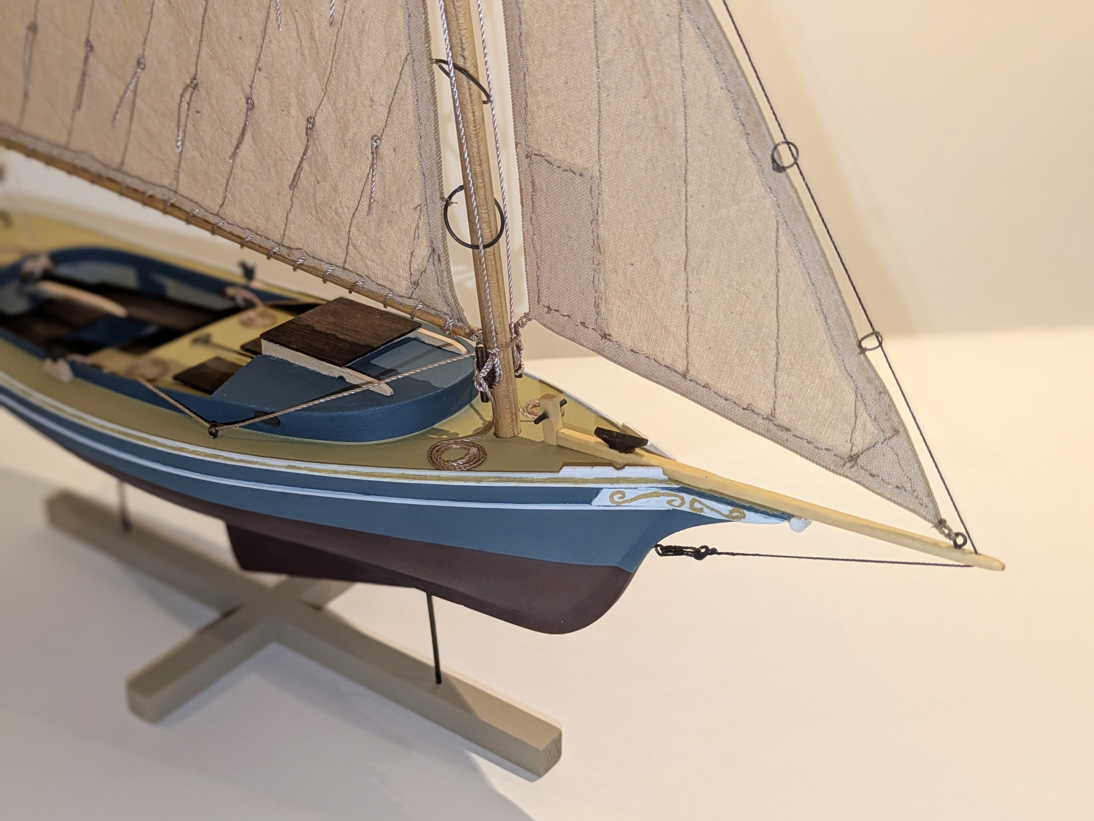

A bit of work done this past weekend.
Managed to get the bottom painted.  Tamiya Hull Red.
Added some porthole windows.   Kristal Klear dabbed into the holes and let to dry.

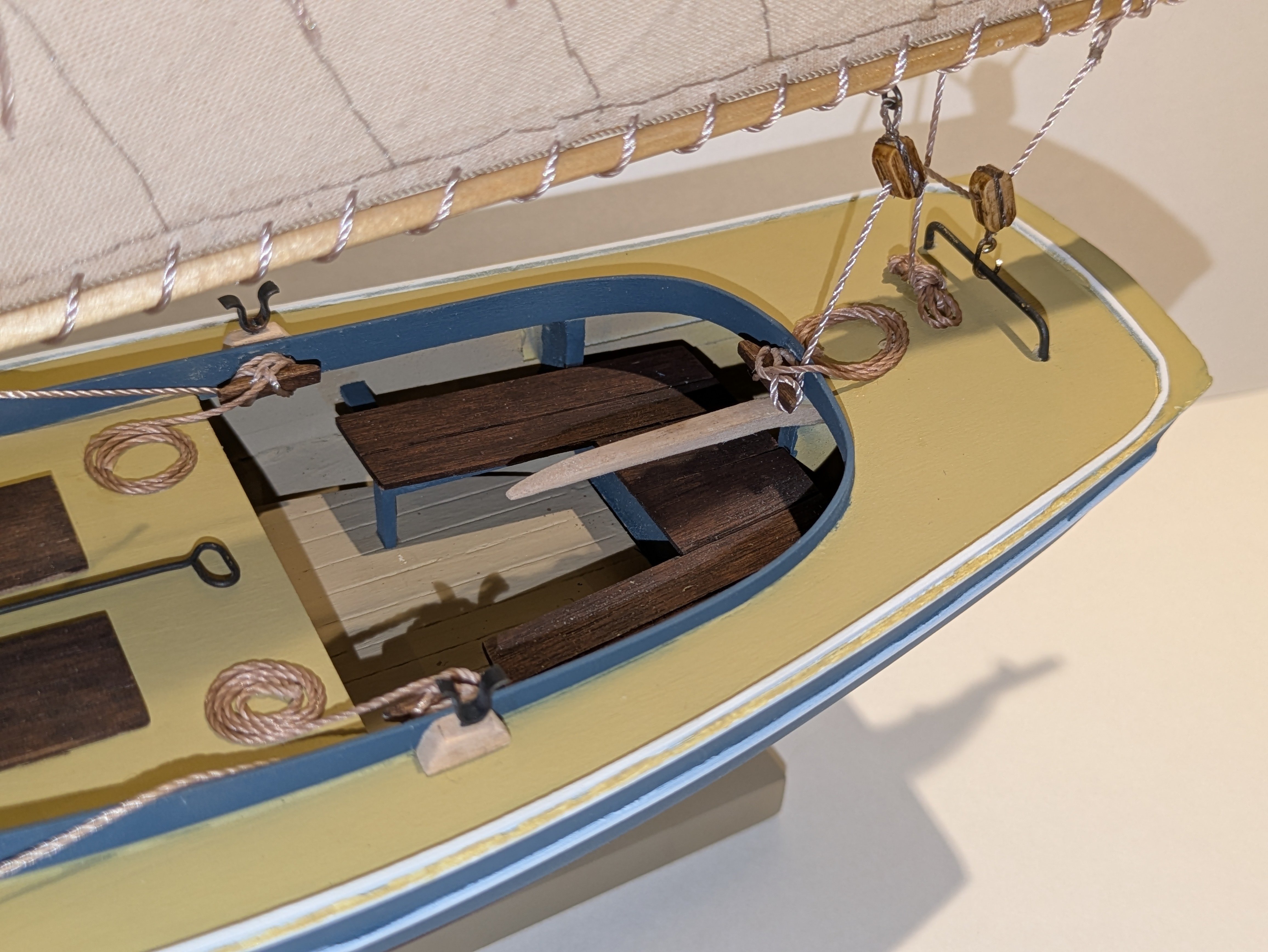

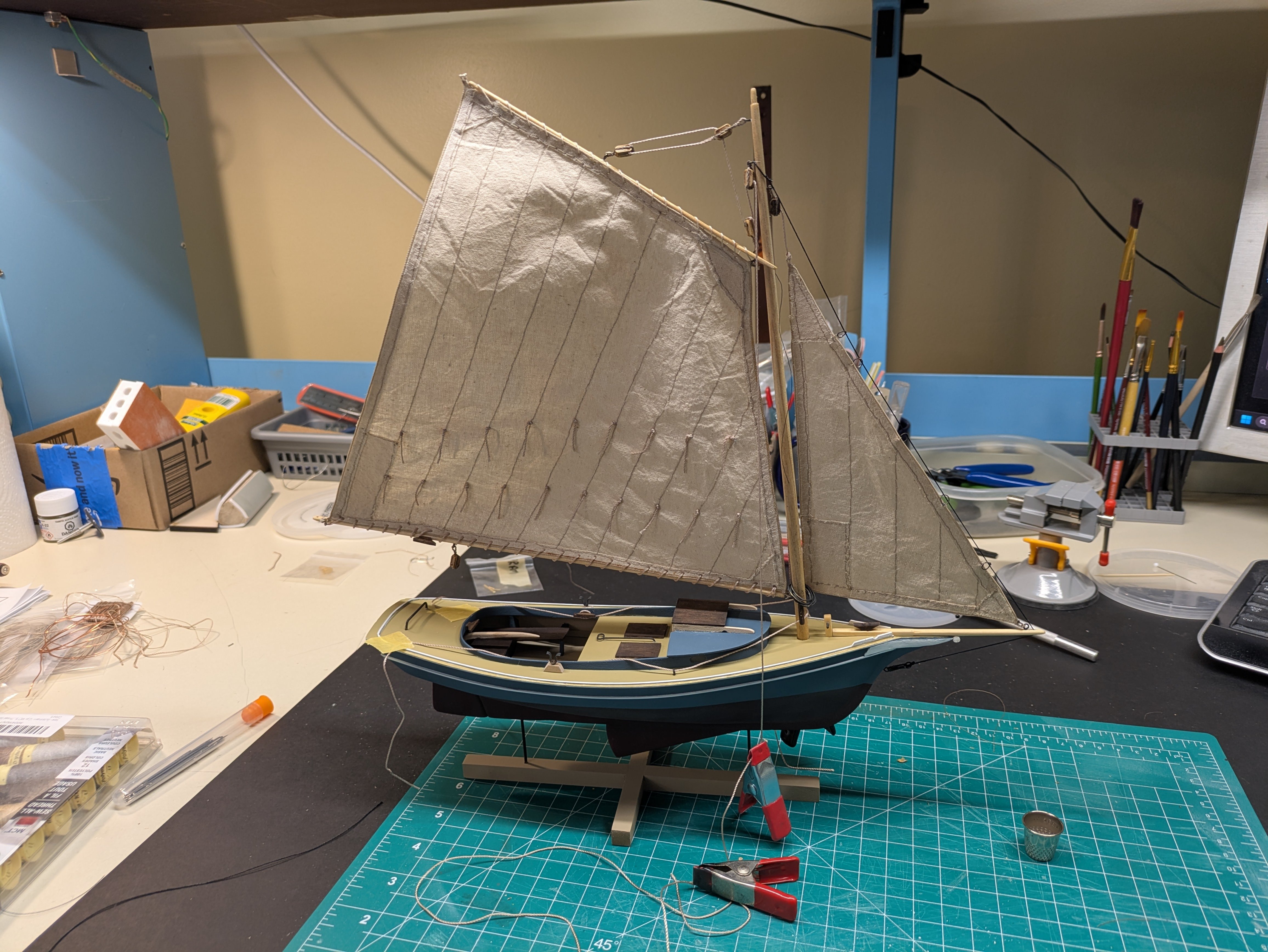

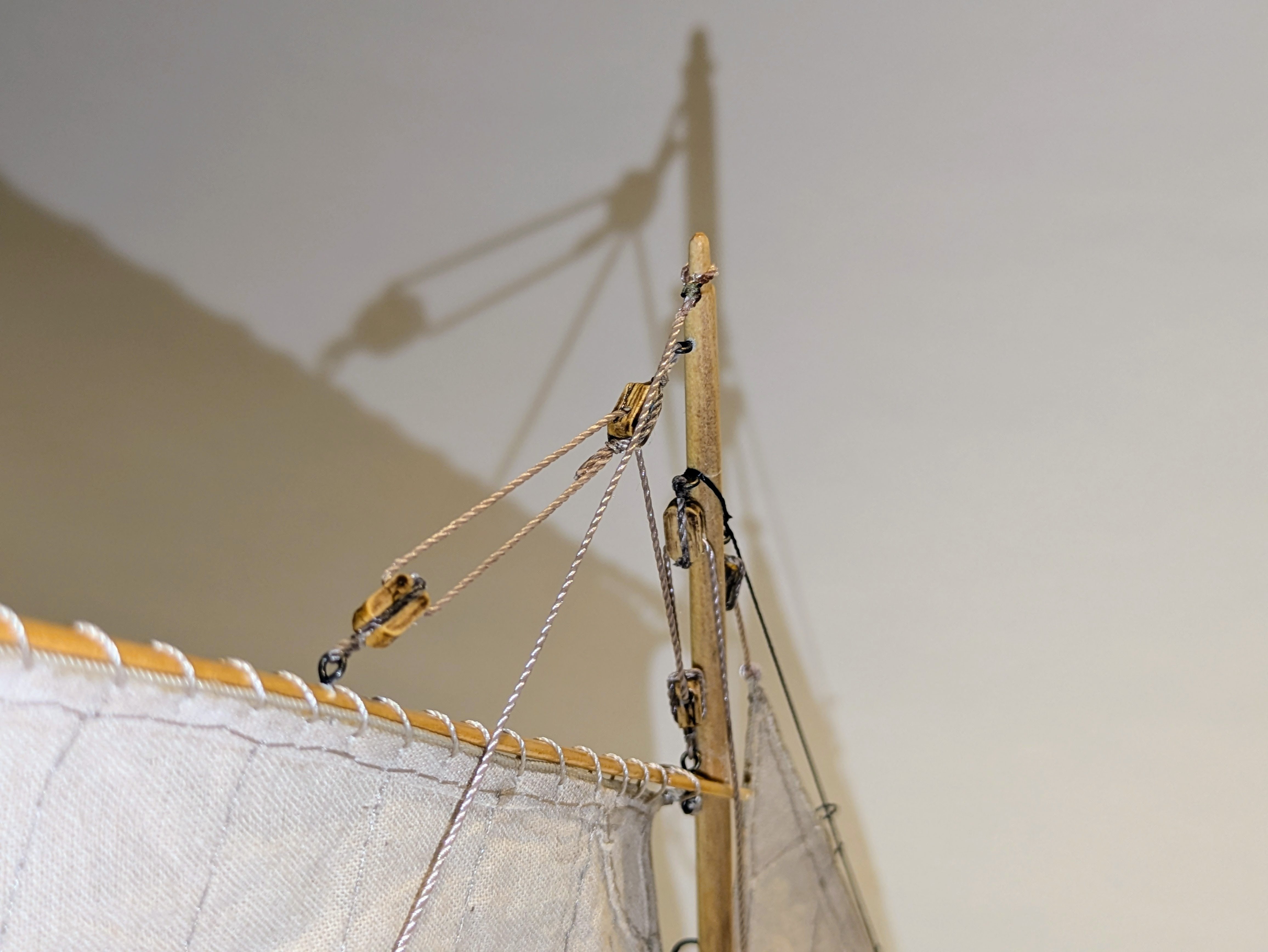

Learning how to tie blocks and realizing after the fact that these blocks are not very nice.   Staining them to at least improve the colour.  Needs another coat yet.

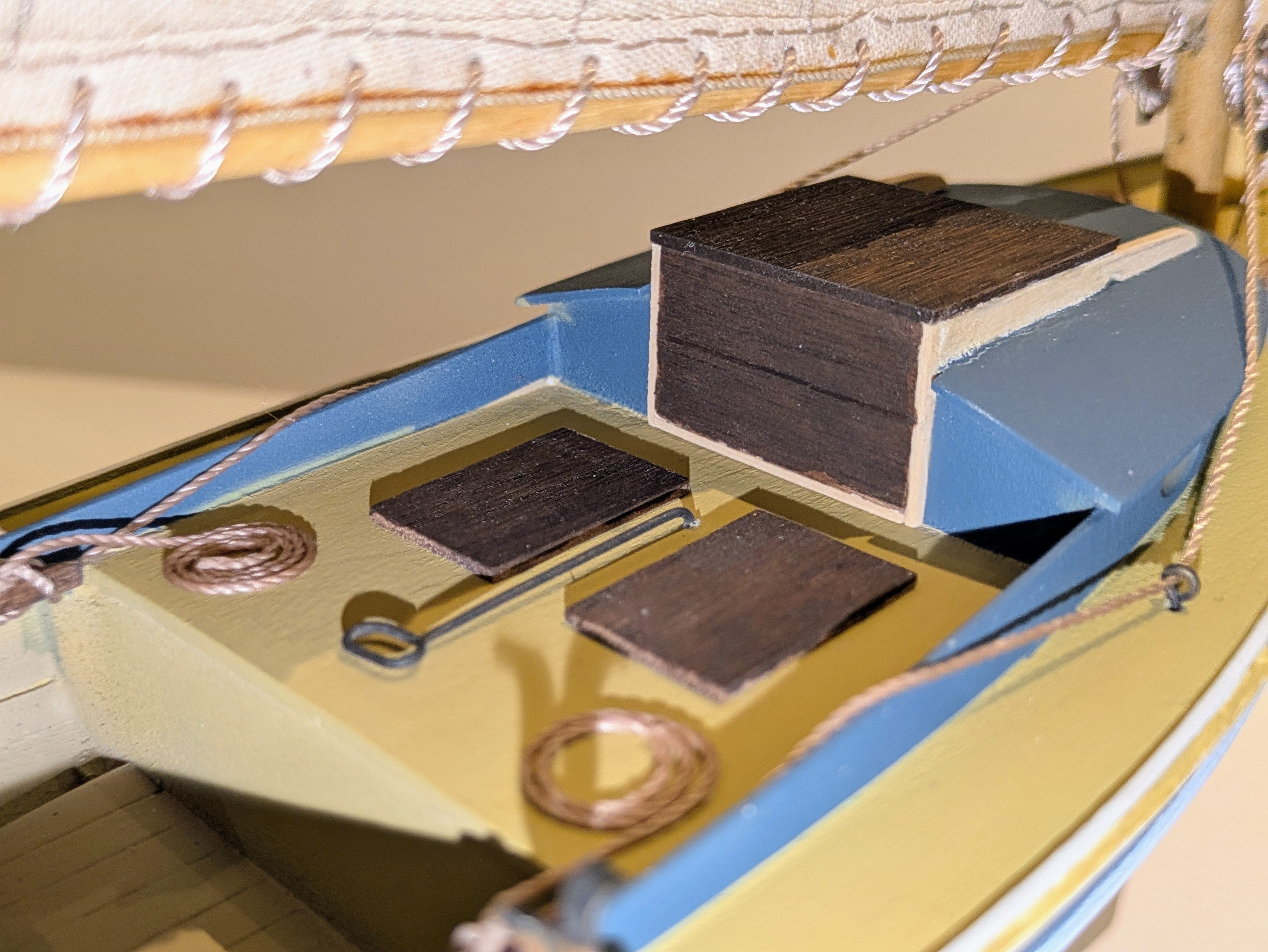

Really Midwest?  These are the cleats you put in the kit?   These are sooooooo bad.  Pewter?  Really?  So have an order in with my hobby supplier for new cleats, blocks for future builds and some other goodies but I am not putting these crap cleats on this model.  I don't even think they are in scale either.   Wish my brain would have clicked in sooner as to how bad these cleats are and poor the blocks are.   Another lesson learned.
This is totally on Model Shipways, not on Midwest, since MS now does the manufacturing. The Midwest-version smack was my first wooden ship model, and I don't recall any metal cleats in the kit. Off-the-shelf fittings are one of the unfortunate cost-cutting compromises found in kits.
Pewter?  Really?
The correct term is Britannia metal (also called white metal), which is a specific type of pewter, but yeah, it is still awful to work with. It came into use as a placement for lead fittings, which would oxidize over time, causing a phenomenon known as "lead disease" (not to be confused with lead poisoning).
Keep up the good work!
Nice job on the hull, the color scheme looks great!
The metal cleats are unfortunate. There are lots of better wooden ones for sale, thankfully, and they aren't hard to make by hand either.
In the Model Shipways version of the Smack, I also had trouble with the Britannia metal garbage fittings they provided. Thankfully, the metal cleats that came with that weren't quite as awful as the ones you showed (I had to do a bunch of filing and reshaping because they all looked like different pieces). But there were some other metal fittings that were used in the rigging (that had a hook on one end that attached to an eyebolt and a hole on the other end that accepted a tied off piece of rigging - don't know what they are called) that had holes way to small to accept any rigging line supplied with the kit and after I tried to bore the hole out a bit to get the line through and added to the rigging the piece came apart in my hands. You'd think they would have discovered 3D printing by now.
Are there third party vendors that sell quality cleats and fittings like that? Who is your "hobby supplier"? I know you can get great rope and blocks from places like Syren. I haven't seen a place where I can replace poor metal fittings for cleats and other parts.
There are indeed some really good ones out there but the problem I have is shipping from out Canada being sooooo expensive.   Still learning best sources for fittings in Canada.  In this case I have some ordered from Great Hobbies (a Canadian franchise) but the new wooden cleats are from Model Shipways, still very blocky looking but I don't mind shaping them and putting holes through them to put make them look more realistic.   Same for some 3mm and 3.5mm blocks, from Model Expo but much nicer than the ones in the kit.   Sometime I am ordering a big model from the states or elsewhere, will get a bunch of packets of ropes, blocks, cleats (all the little stuff) to make the shipping costs worthwhile.   I know they consider these beginner kits but it would be nice to have quality fittings included.
I have kept my rigging holes very small at this point and will only slowly make them bigger if I need to but so far it looks like everything will fit on the expo version of this kit.
PS - I know that Expo and Shipways are the same company now but I guess it is old expo stock, half the stuff in my local store is marked one way or the other.  I do think the newer shipway version of the Lobster Smack looks to be a nicer construction and parts but without having my hands on it, all I can go by is all the build logs.  So similar yet so different.

Wow Scott -I can't imagine trying to bend that sheet around the frames. You did a great job all things considered.

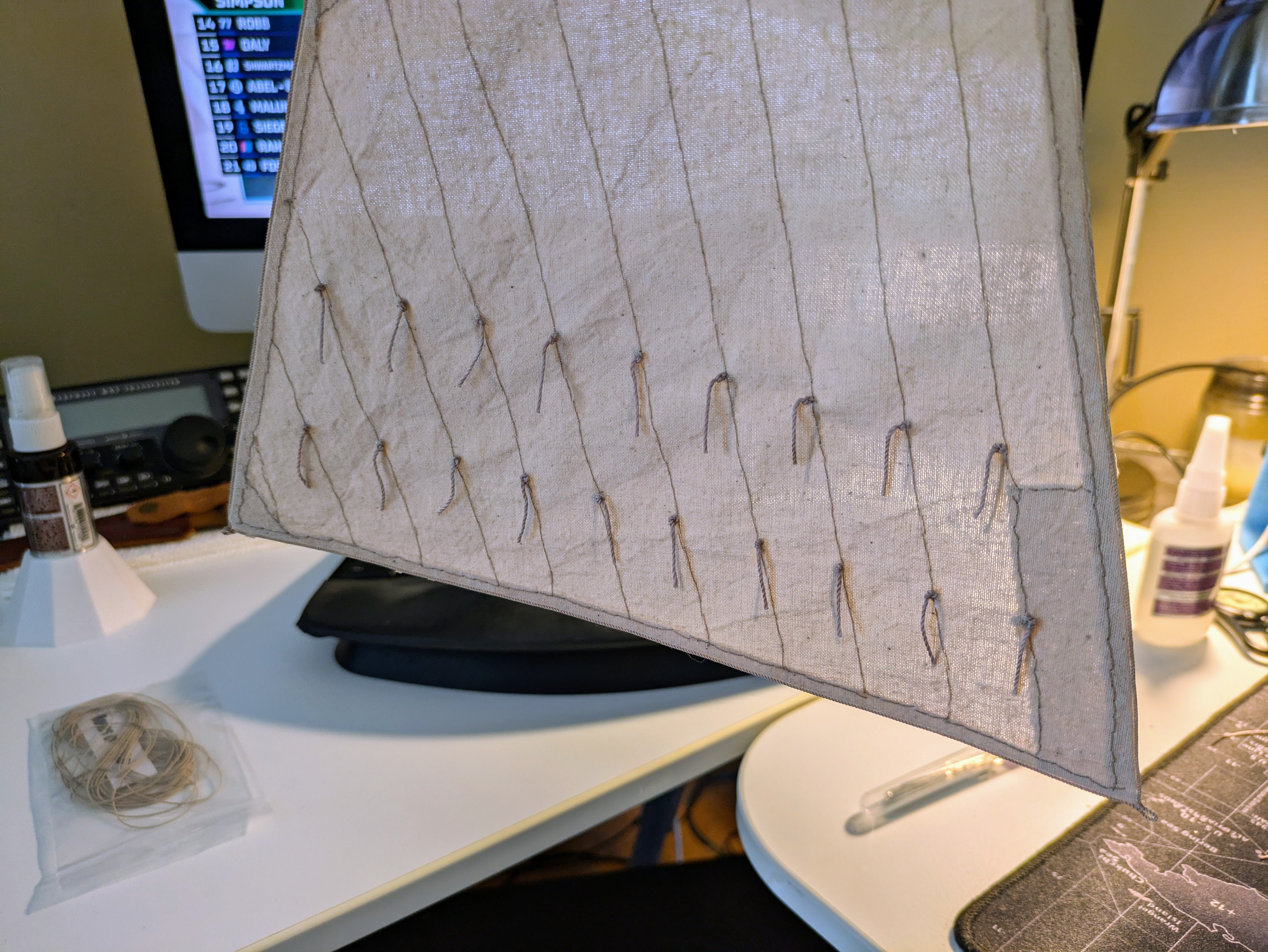

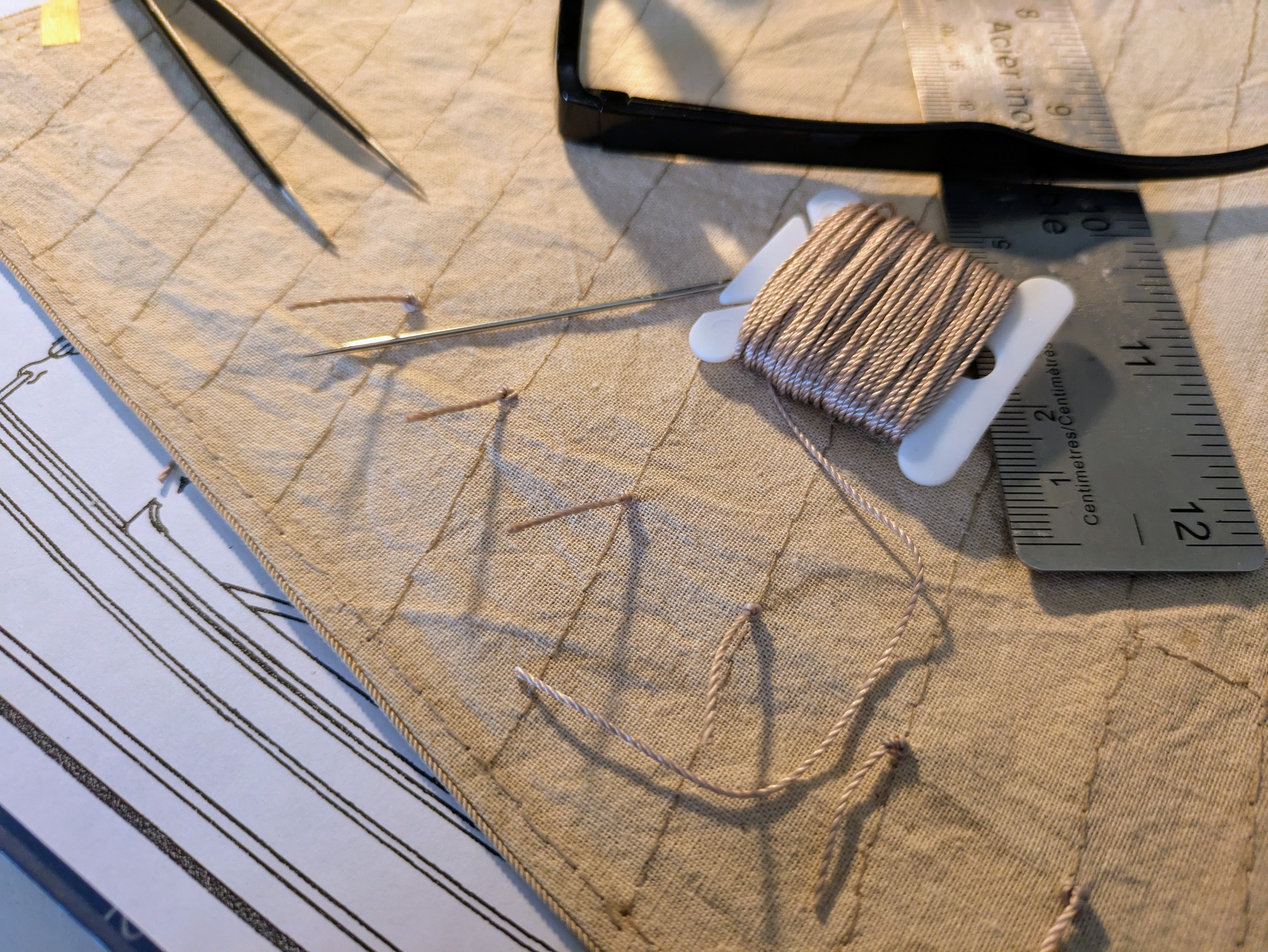

Time for an update.    After messing up the first batch of sails - they shrunk when washed in hot water, I purchases a couple of meters of fabric and started again, this time staining before drawing the lines and cutting.
Although I have access to a sewing machine, I have never used one.  So I figured 3 or 4 hours tops to hand sew.... ya no.   Took 10 hours to hand sew.  In that time I could have taught myself how to use the machine, did 4 practice runs and still make the sails :).   Now I know!

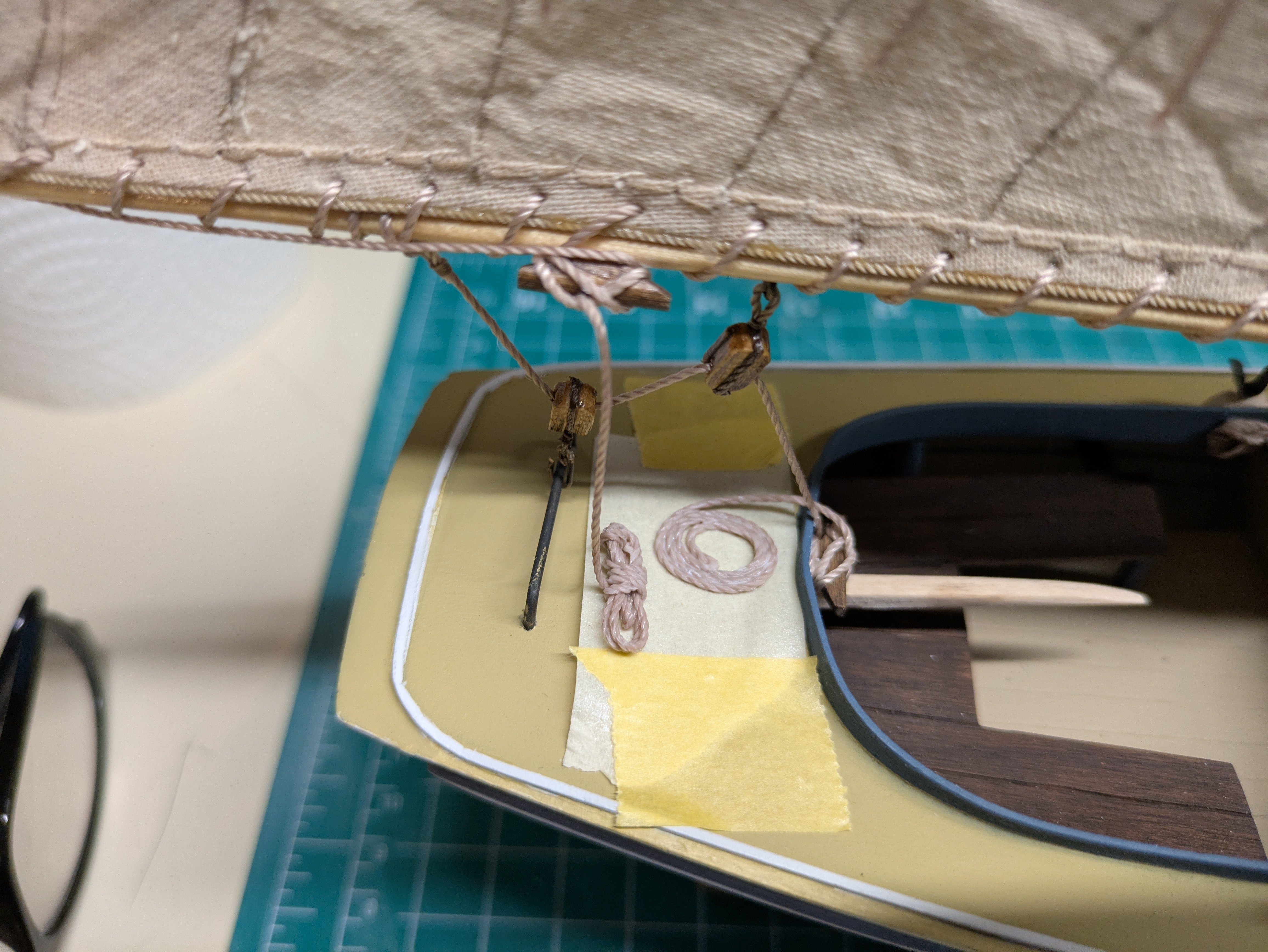

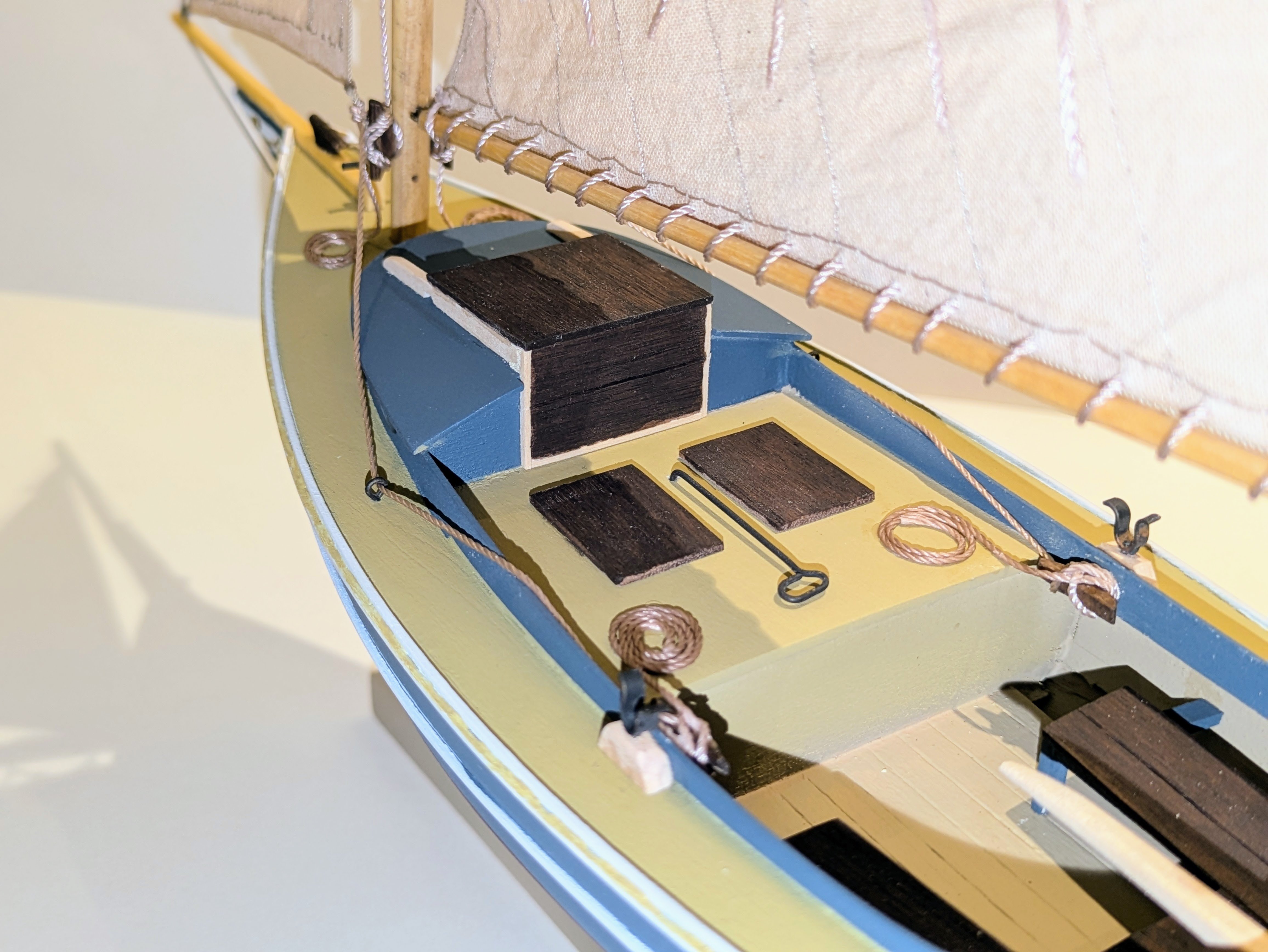

More of the finishing touches in the cockpit and on the hull.  Seats in place and did some metal work and blackened the pieces.    Hatch and bow will be next and should get to stepping the mast and adding sails and rigging shortly.
PXL_20250424_200048171.thumb.jpg.6ba1ad1a123deef0ca3b1e29c9d43fef.jpgPXL_20250424_200059885.thumb.jpg.e6bcca4fdee372423d95314db73cec2a.jpgPXL_20250427_152617334.thumb.jpg.df0633ea03c5a598639af4e041e3b3a1.jpgPXL_20250427_161013182_MP.thumb.jpg.8fd01290ccb91c069a71705c92921c16.jpg

Scott if you have to make another set of sails (or for future reference) you might consider adding a thin piece of wire inside the hems. This can give you an easy way to add shape to your sails.
It's easy when you make your own sails, but I have also done it with kit sails.
Sail on...... Mike         "Dropped a part? Your shoe will always find it before your eyes do"
Current Builds:                                                          Completed Builds:
Jabeque Cazador Occre - 1:60                                  US Brig Niagara - Model ShipwaysSection Deck Between Gun Bays - Panart  ; Arrow American Gunboat - Amati
 Riva Aquarama - Amati                                           T24 RC Tugboat  ;  Hispaniola - Megow - Restoration ; Trajta - by Mikiek - Marisstella ; Enterprise 1799 - Constructo
Good idea, thanks for the tip.    I still need to iron them out and I believe we are putting a bolt rope around it yet as well, which should clean up the bit of wonky in the shape.
Scott - bolt rope is a good idea. It adds a lot of realism, but I'm not sure how much it will help you shape the sail. I did the wire thing in both my Enterprise and Trajta builds. Links are in my signature.
Honestly it just depends on what you want your sails to portray.

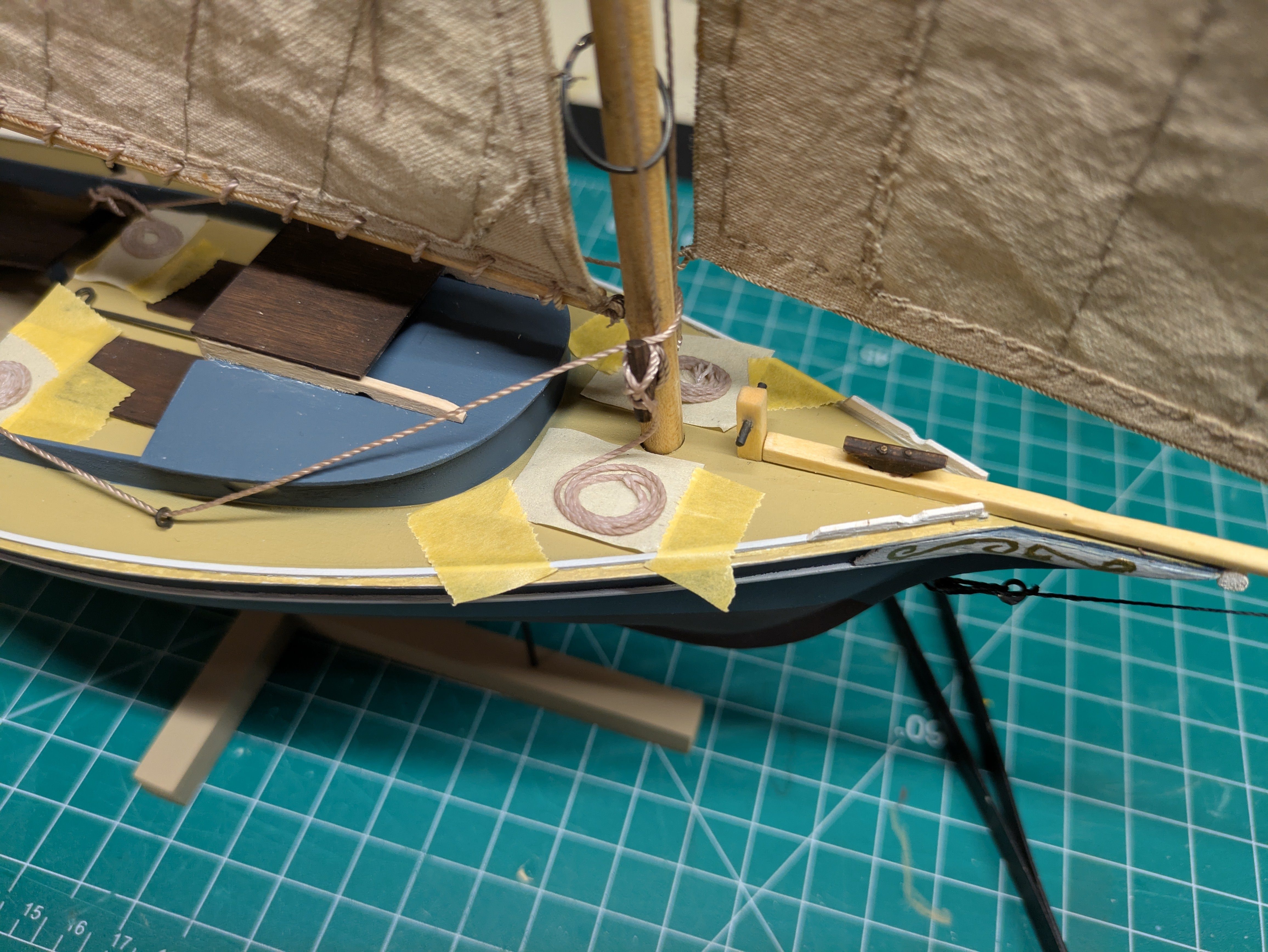

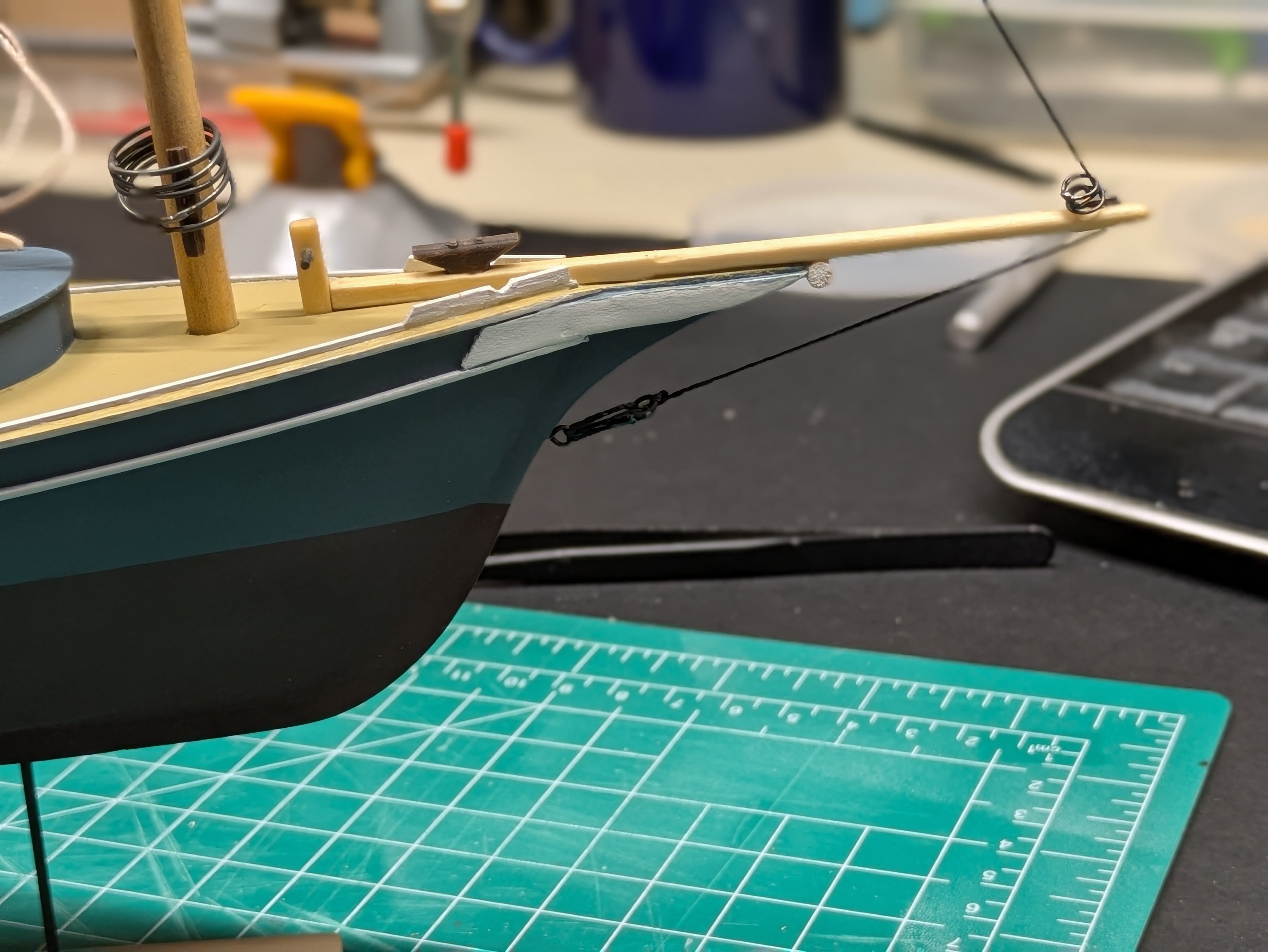

Its been a while since my last update but the class teacher has been spending a lot of time on the sails.   We put a bolt rope around the sails and have added the tails.  Mast is in place, stained some of the wood and stand is in place.   Fingers crossed the rigging goes well this weekend and we can start the finishing touches.

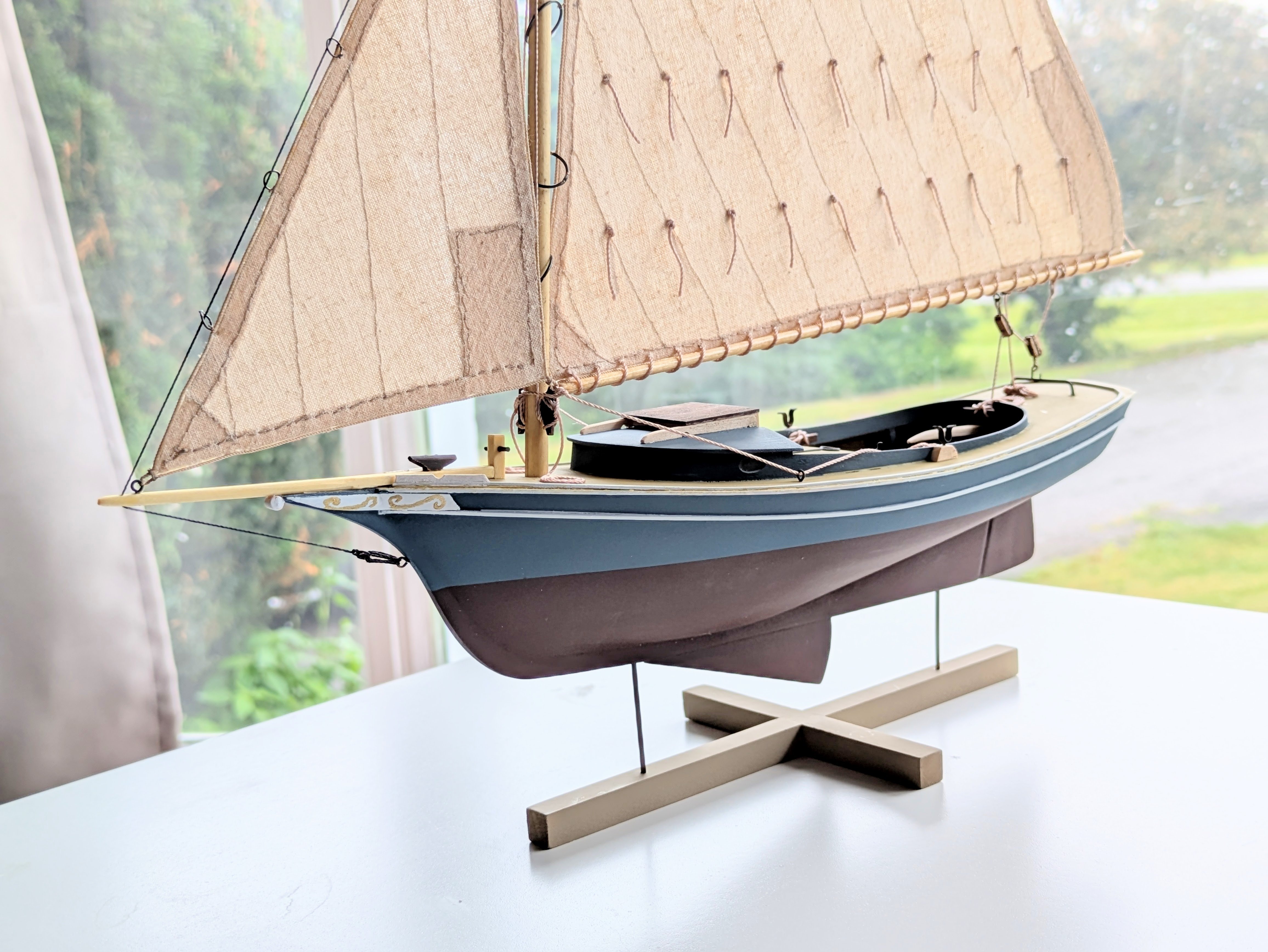

Yikes, just realized how negligent I  have been with my updates.   Before I show the final pictures, a few shots of working on the rigging and ropes.  I did purchase some ropes from "Ropes of Scale" which I used around the sail itself, but I kicked myself, after the fact, for not removing the kit rope that I had already started with and completed the model with.   The Ropes of Scale would have been so much nicer to look at but even easier to work with.   Ah well, I am learning what parts in a kit to use, and which ones to put aside.   All part of the learning process.

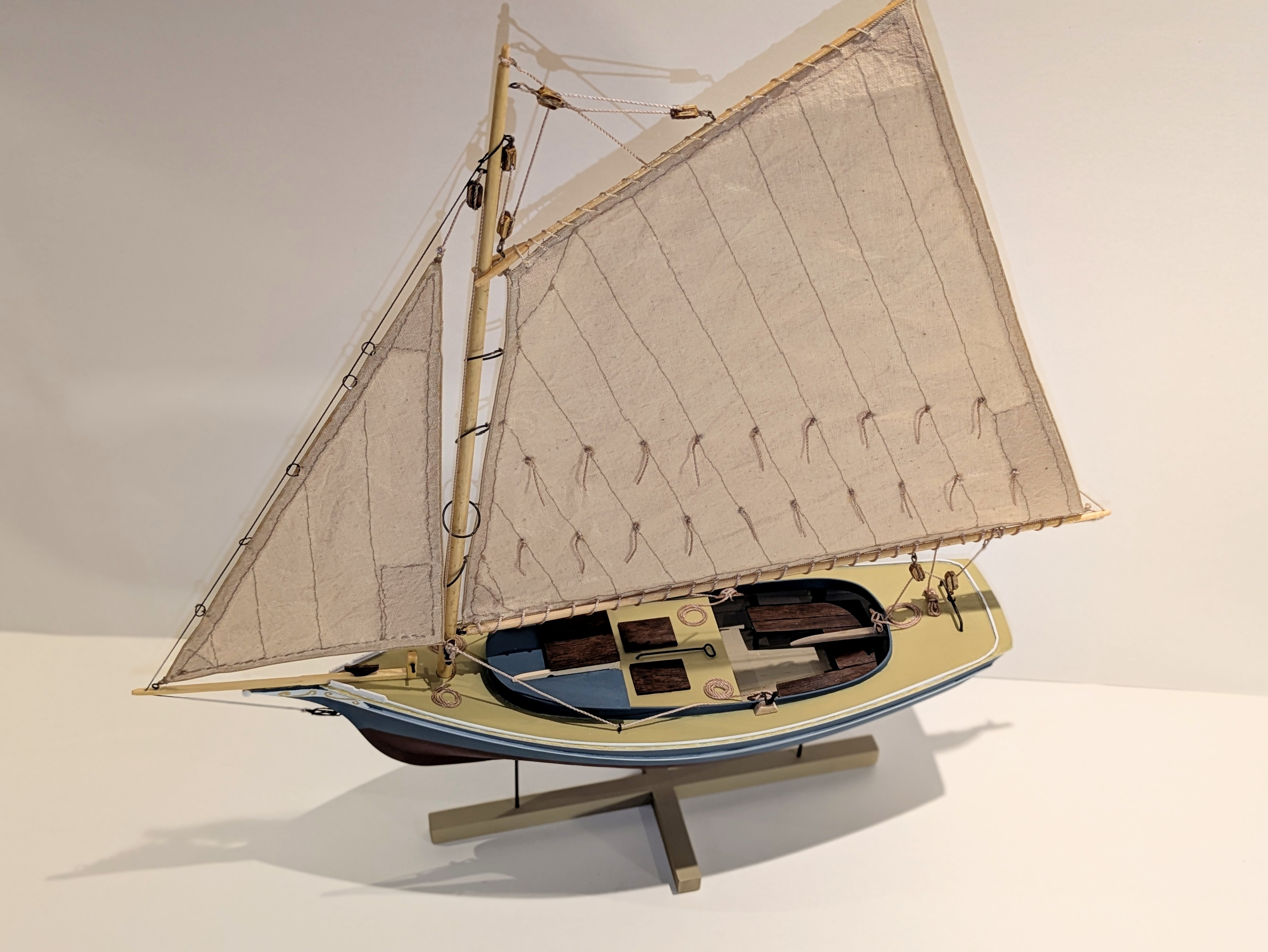

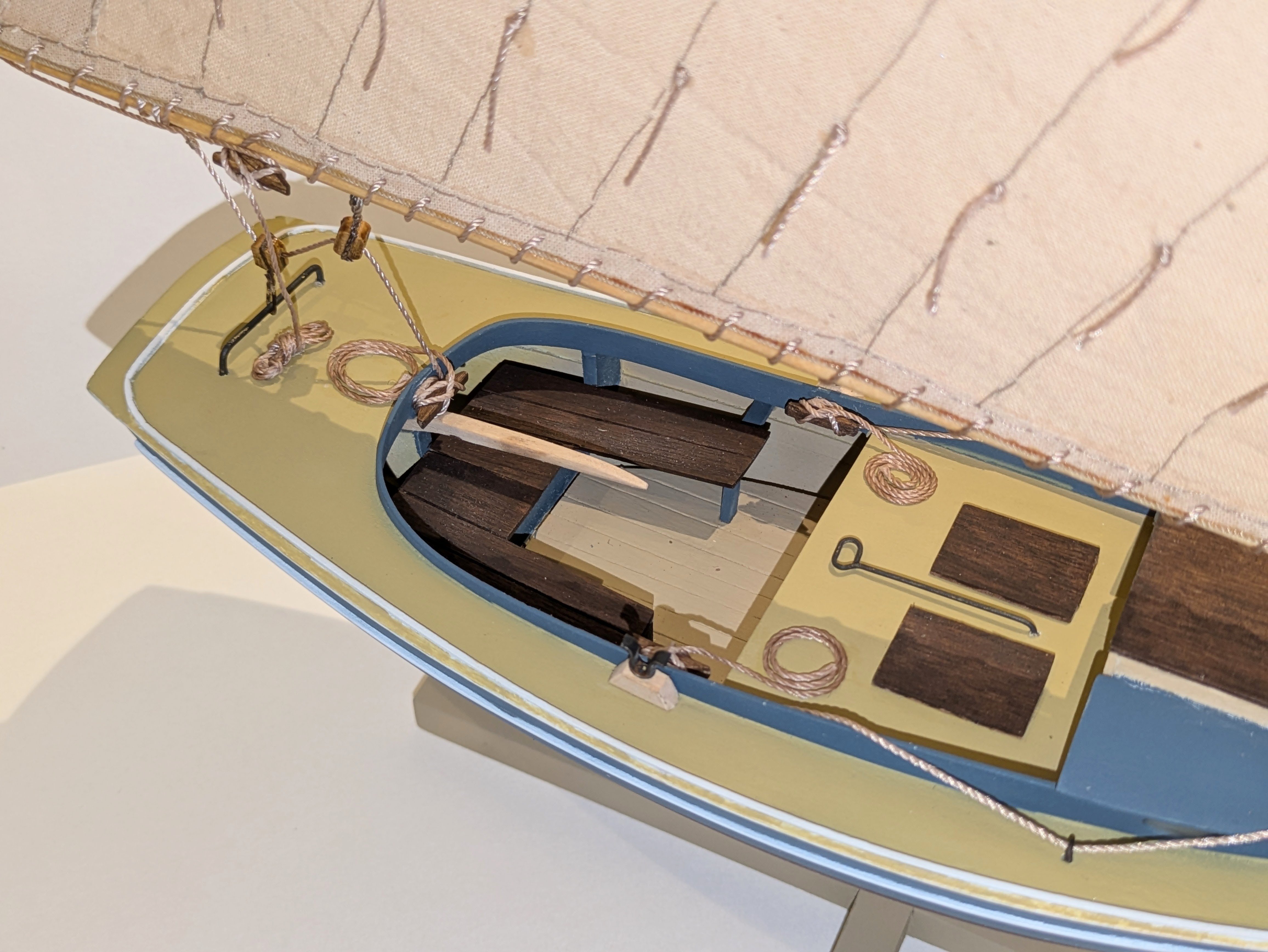

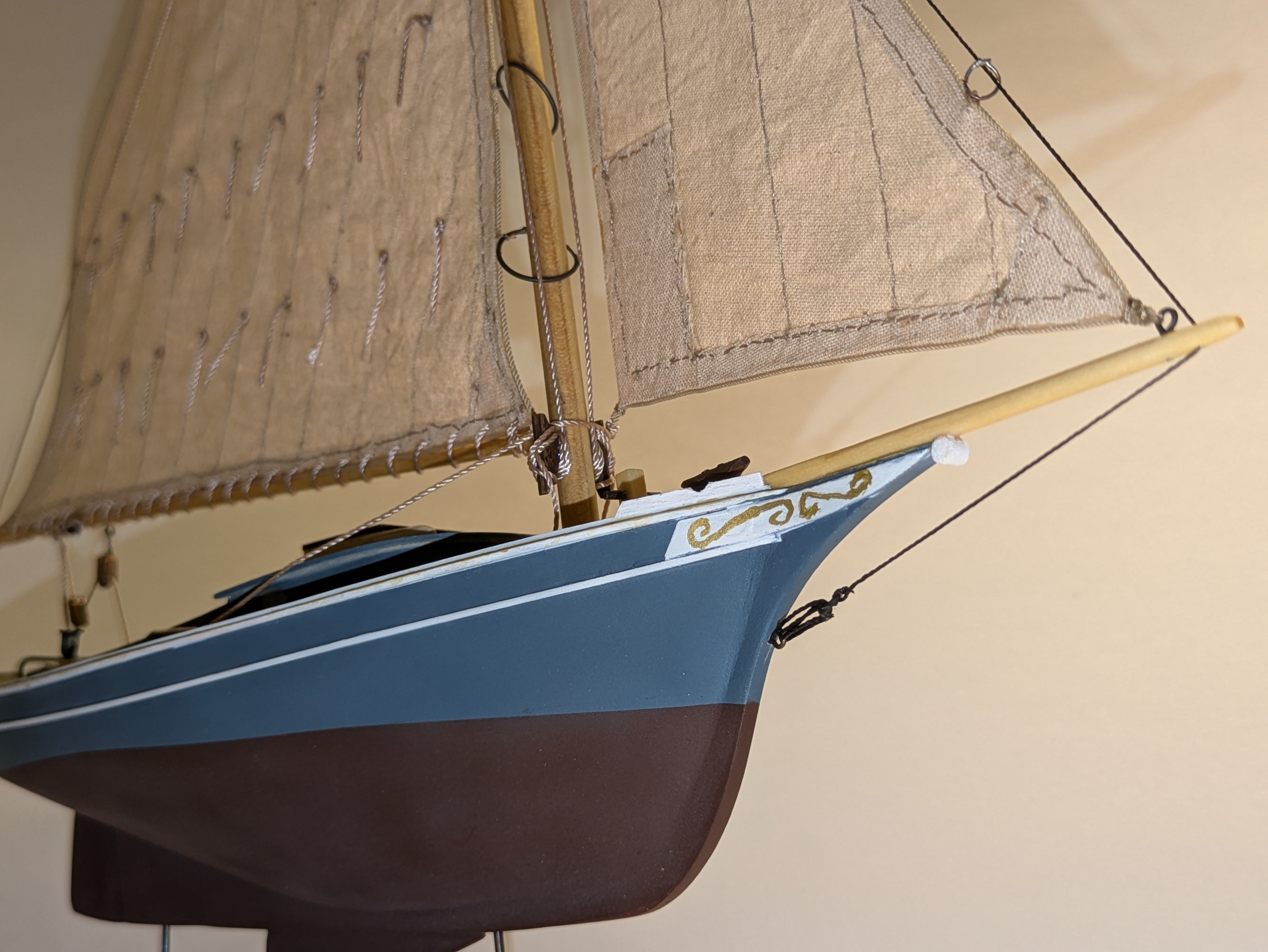

and completed.   Numerous things I am not happy with and will take away as lessons learned.  First I will never hand sew sails again hahahaha, that was extremely time consuming.   Replace ropes, need to find better and more to scale cleats, need to find a solder that brass blackener will work with, would make the sail rings smaller and I need a steadier hand in hand painting the bowsprit.  After some time away from this kit, I might go back and fix the bowsprit and mast rings as they stand out too much to me and can be fixed relatively easily.  But over all, for my 3rd model (this is the last in the midwest series) I am happy.   Can't thank Olha enough for her online classes and tutorial and for the comments here on model ship world.    She is now proudly displayed in my living room.
2.thumb.jpg.0ae9c6814c231b2b42dd8855c159aed4.jpg3.thumb.jpg.2104c6f2d6d8d86d4e2d50830688be8a.jpg4.thumb.jpg.19610a213afc39ee1da402dfb2254069.jpg5.thumb.jpg.212595a0bcca47c70016117bace18701.jpg6.thumb.jpg.1437afa4694cfd7f787d52686388d93a.jpg7.thumb.jpg.6ab8d2a3cd9d7e49234720e8e32889f4.jpg8.thumb.jpg.6af9e59738899db9db3d25972df16188.jpg9.thumb.jpg.80a0b118ac630fa67595266d246ca6df.jpg10.thumb.jpg.706e7e44b7e5f640be2a3f08e2646079.jpg11.thumb.jpg.a8aa2d7608adbc201a97723280b4d8f5.jpg
As always, I created a google album of all the gory pictures if anyone wants to see the build pictures from start to finish - https://photos.app.goo.gl/PEPshL8zixs5suDi7

Congratulations on finishing! Very nice work, it's definitely a model to be proud of. I particularly like the color scheme, and the technique for making rope coils on tape before finally gluing them down is a very good idea that I'll have to borrow for future builds of my own.
Thanks Jacques.   Yes, just put them on the sticky side of the tape, mix of PVA and water, let it dry and carefully remove.   Works well.
