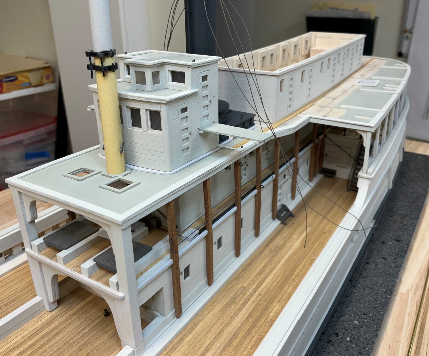

20 hours ago, Paul Le Wol said:
And this is what she looks like today.
Simply splendid Paul.

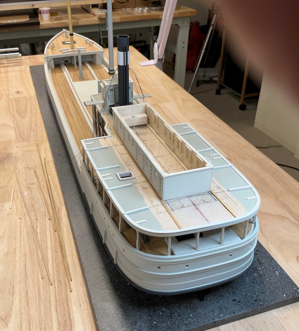

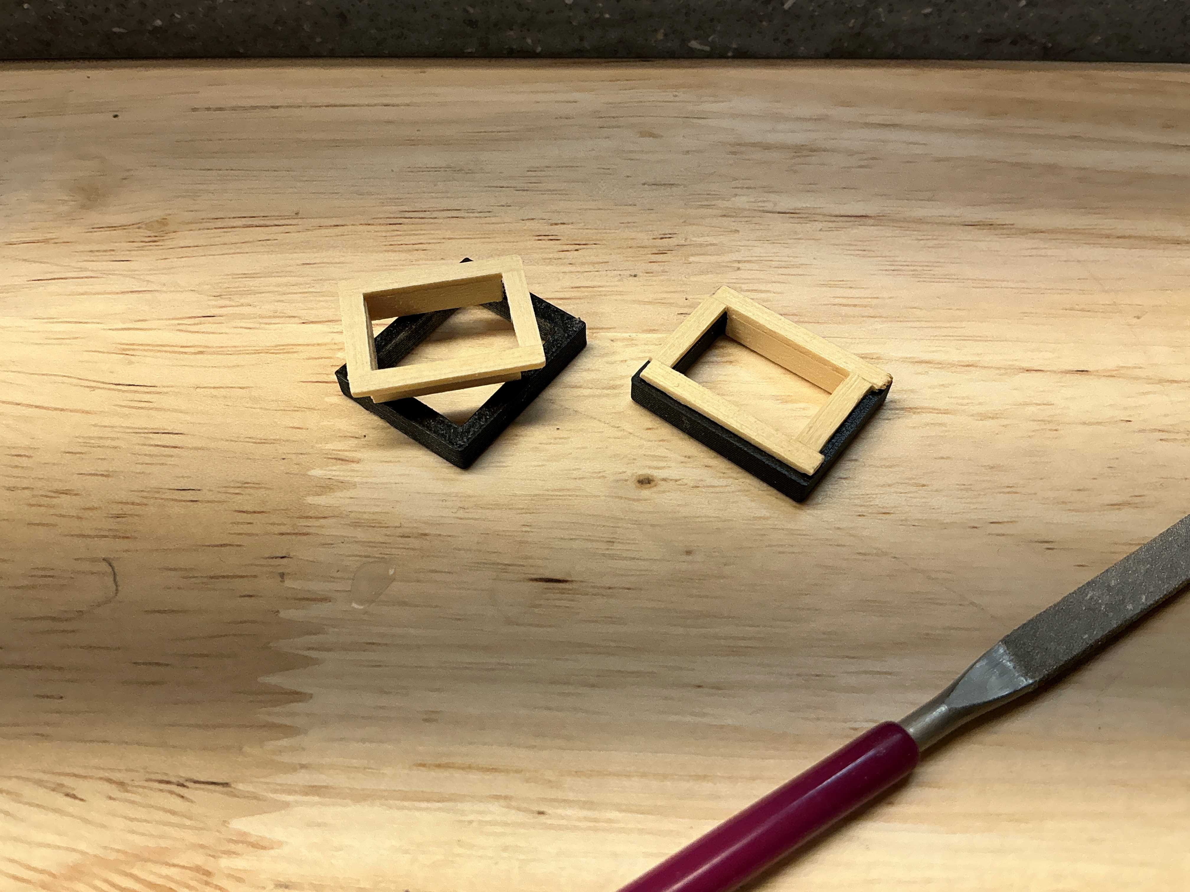

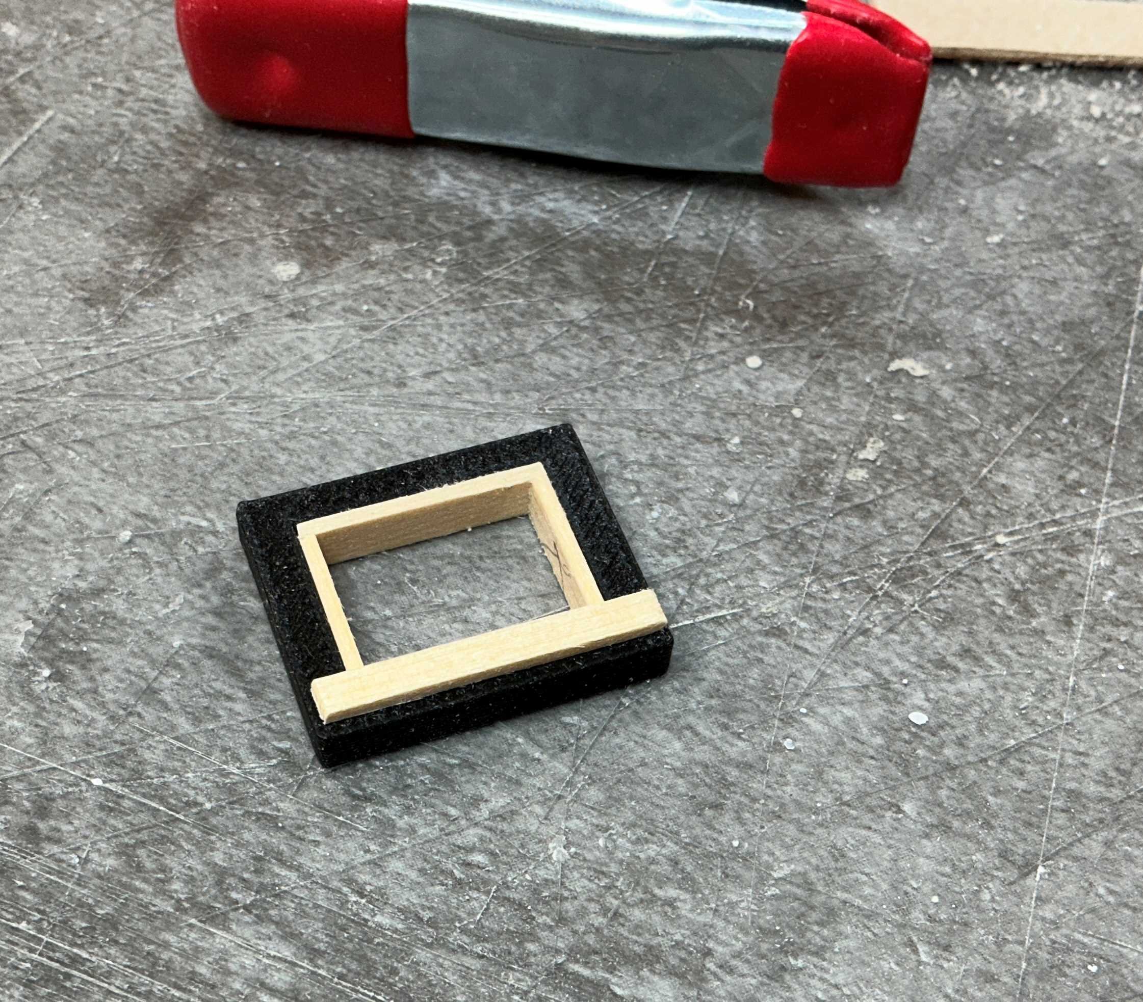

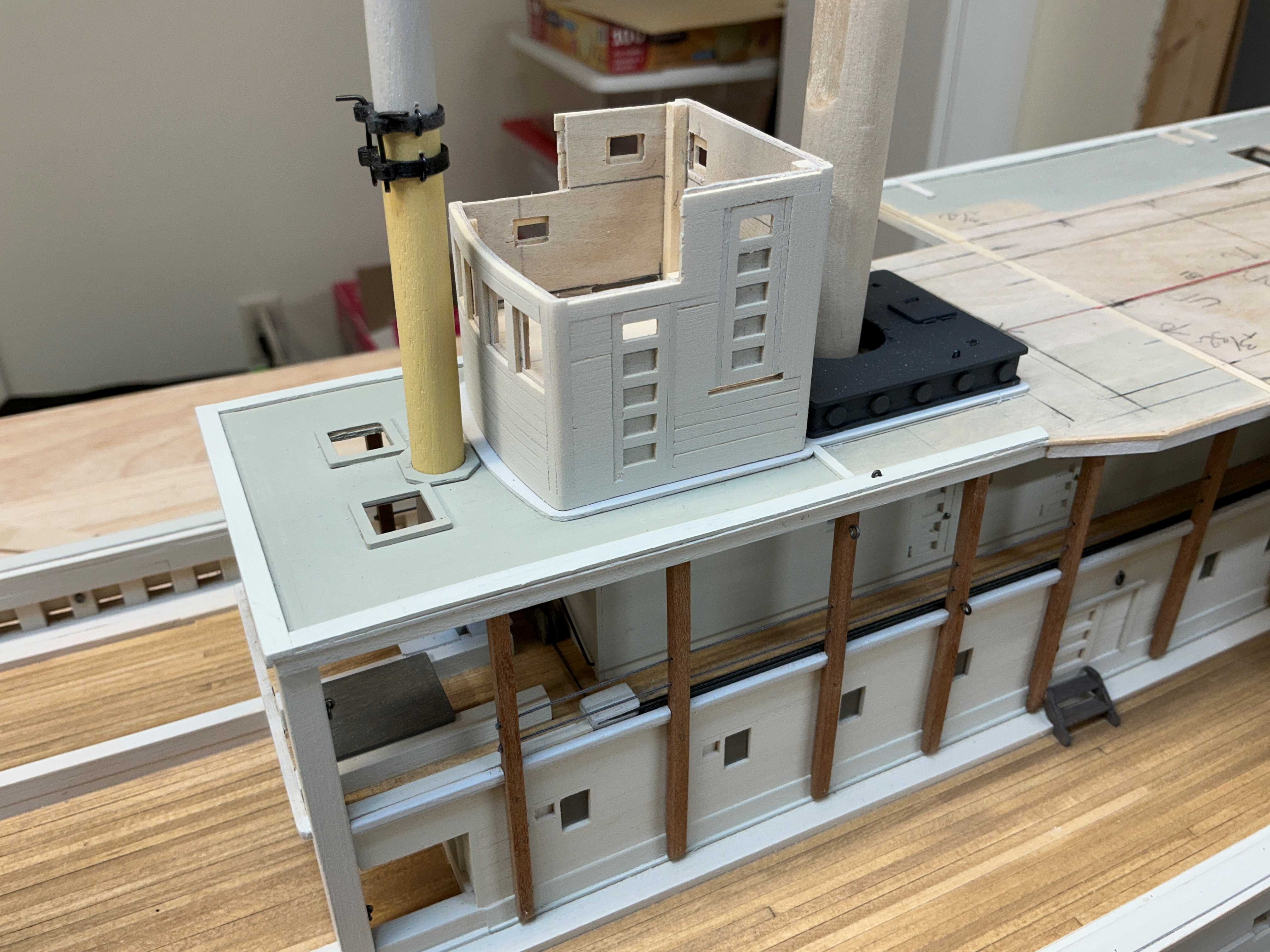

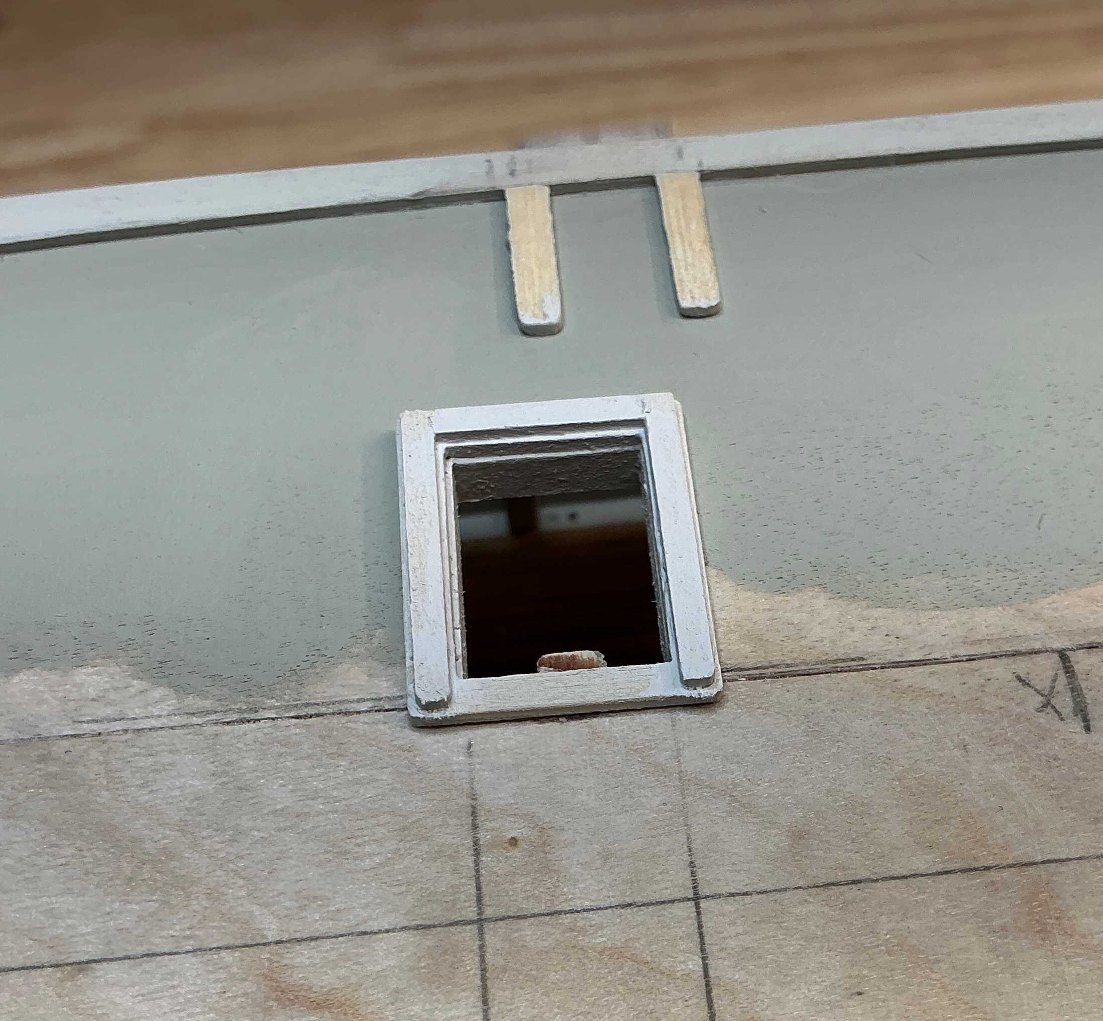

Hey Everyone, I hope you all managed to stay safe in this  weather. Luckily only had a 6 to 8 inch dusting of fluffy snow here. I have a Creality K1C 3d printer all fired up here so I made a couple of jigs to help build the coamings at the top of the ladder way on the boat deck.

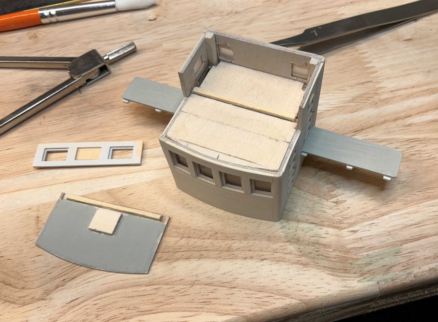

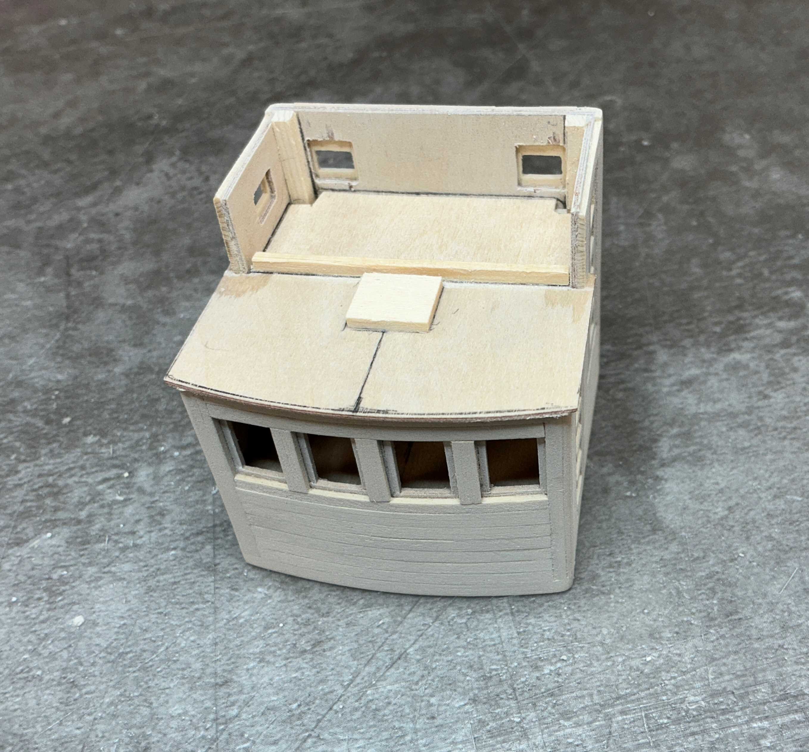

They are dry fitted until the railings can be attached. The Wheelhouse/ Pilot House was given a coat of paint and the windows were glazed.

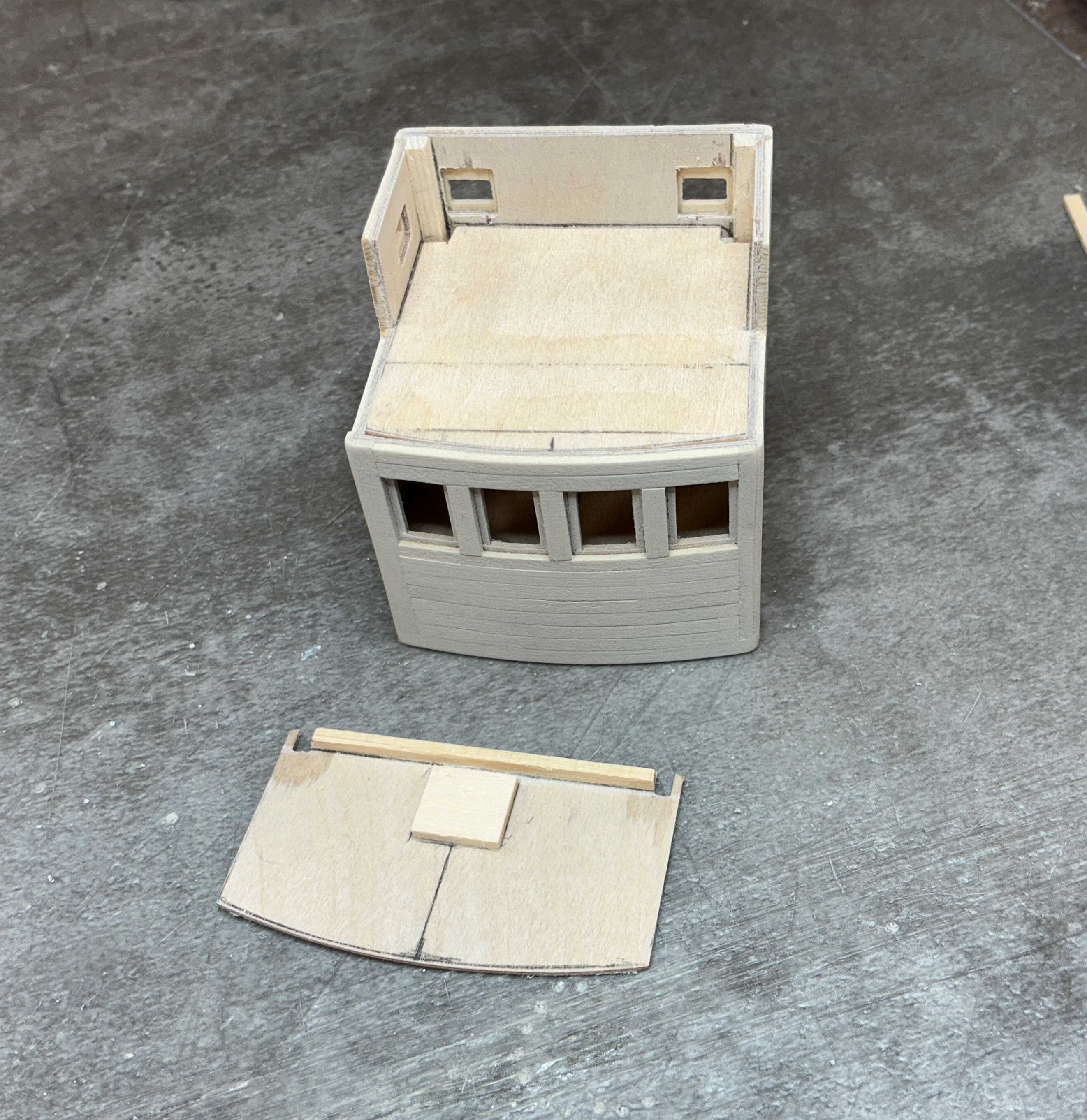

A 1/16" piece of plywood was used to support the roof of the wheelhouse and to keep the structure square.  A 1/32" piece of plywood sits on top of it. Before they can be attached the bridge wing(s) have to be glued into place.
The pilot house windows were framed, painted, and glazed. Then the roof of the pilot house was installed.

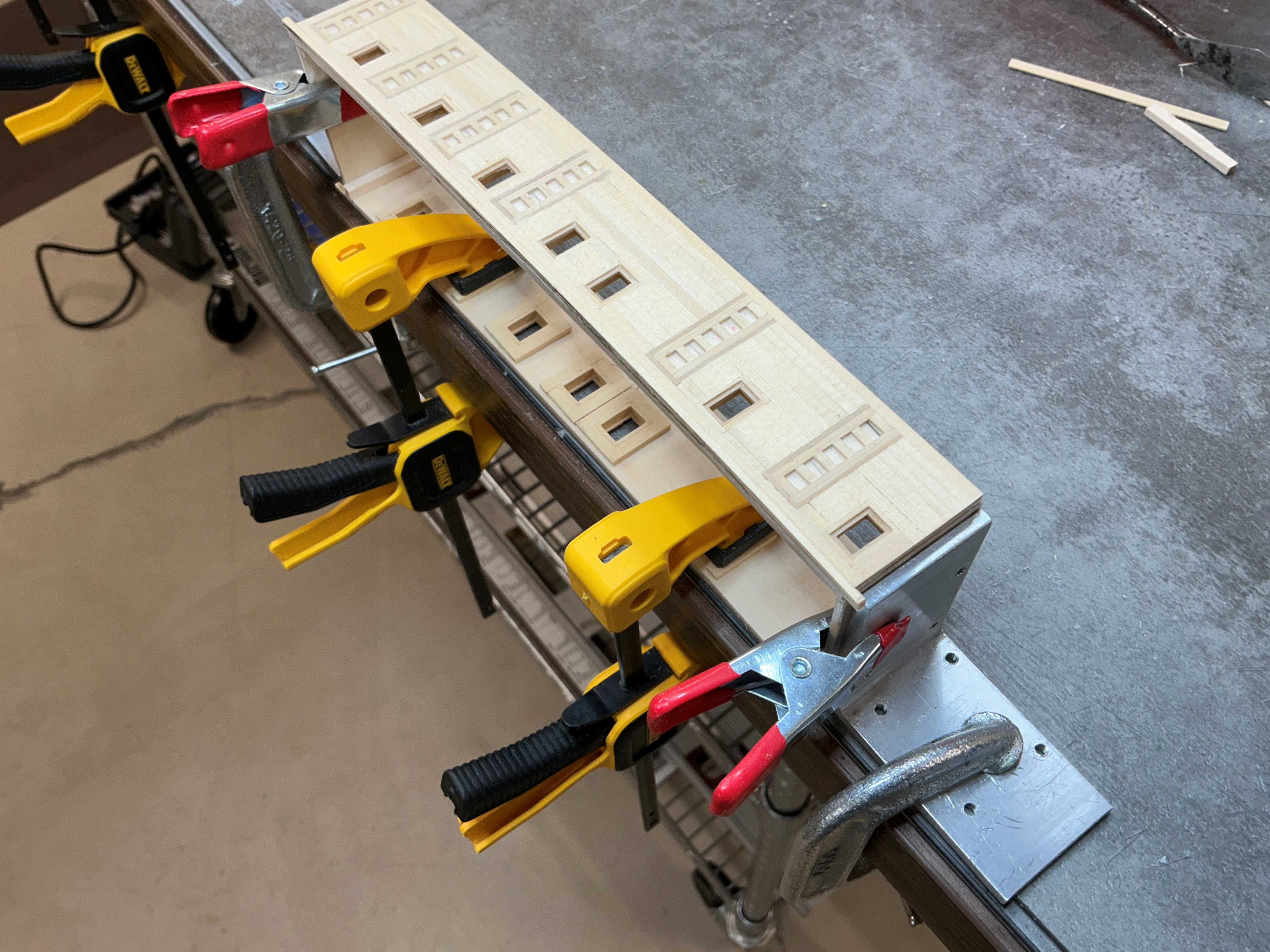

While this was going on I sided the cabins and assembled the parts.

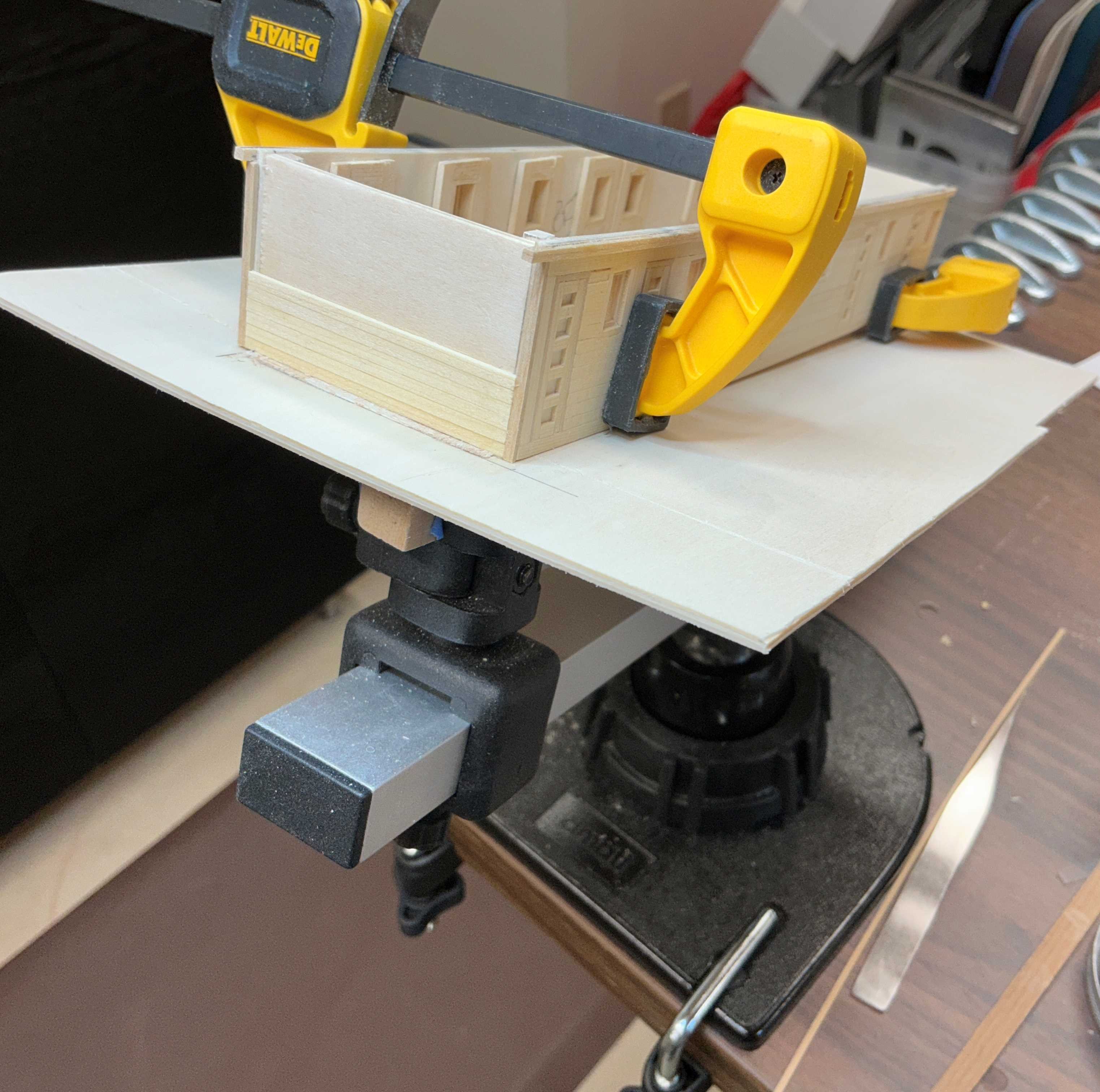

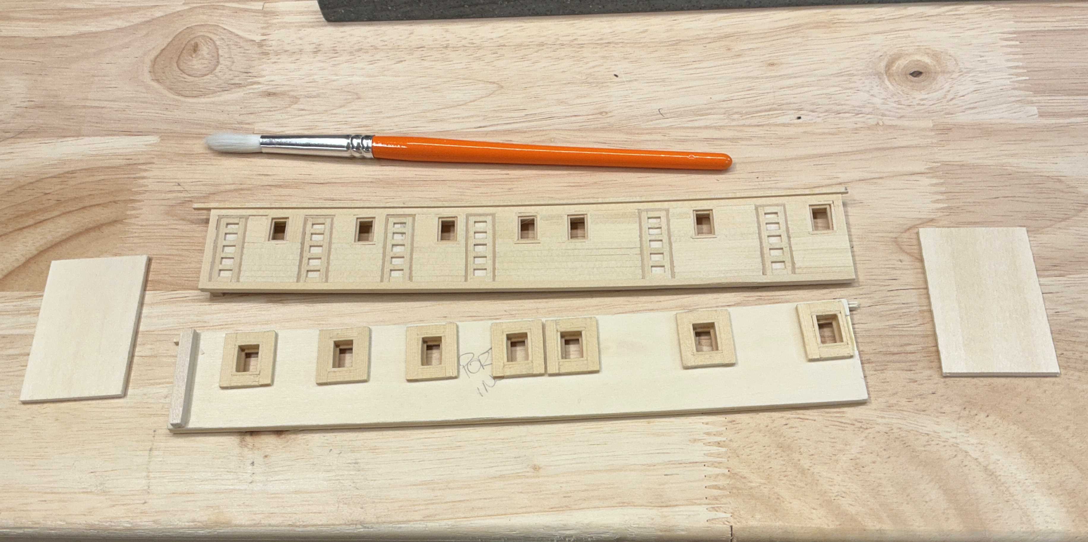

After the fore and aft bulkheads were sided it was painted and the windows were glazed. Strips of 1/8" square basswood were glued to the subdeck to keep the structure in place while gluing.
Pieces of 3/4" square balsa wood were glued to the inside of the end bulkheads with holes drilled in them to accept #4 wood screws. The wood screws were screwed into the subdeck to hold down the cabins while the glue dried.

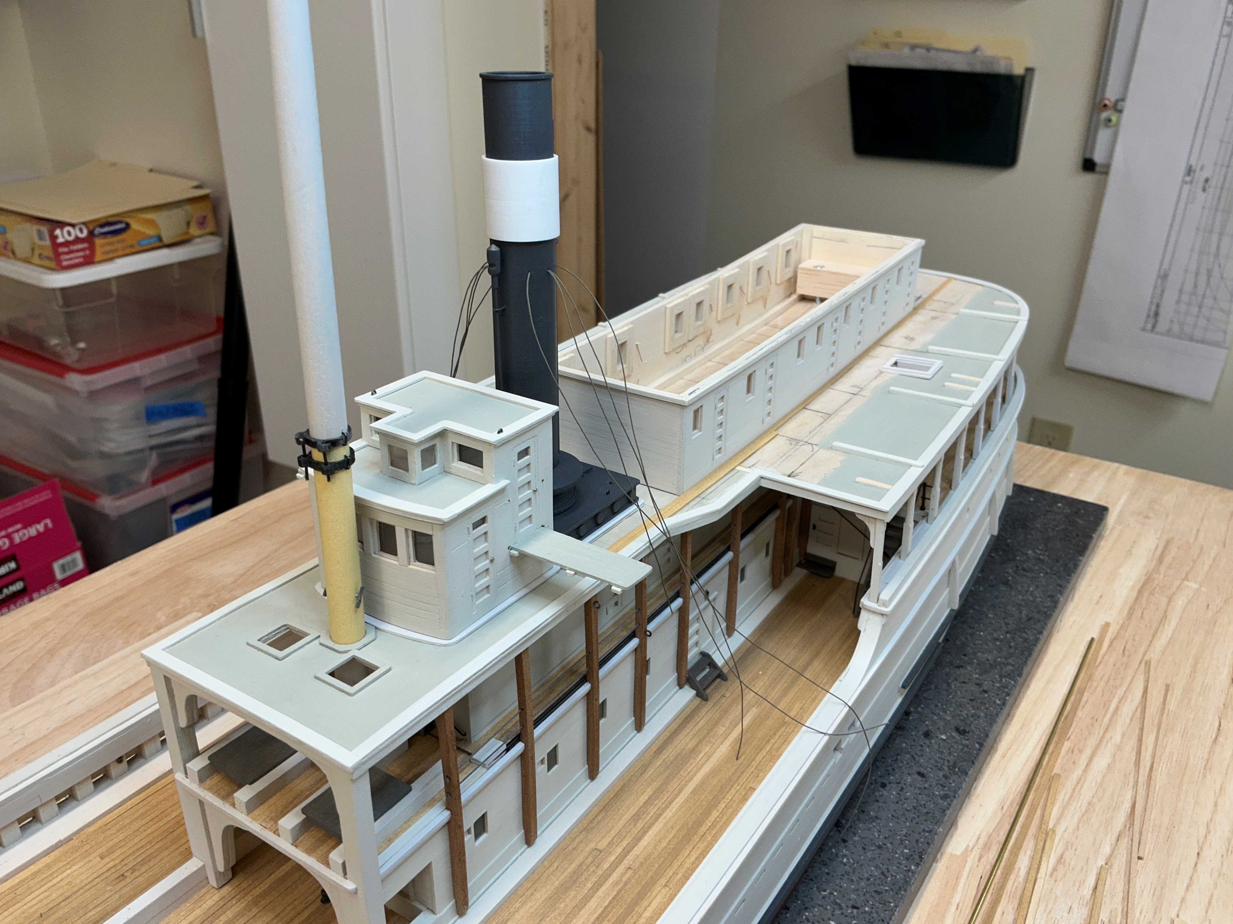

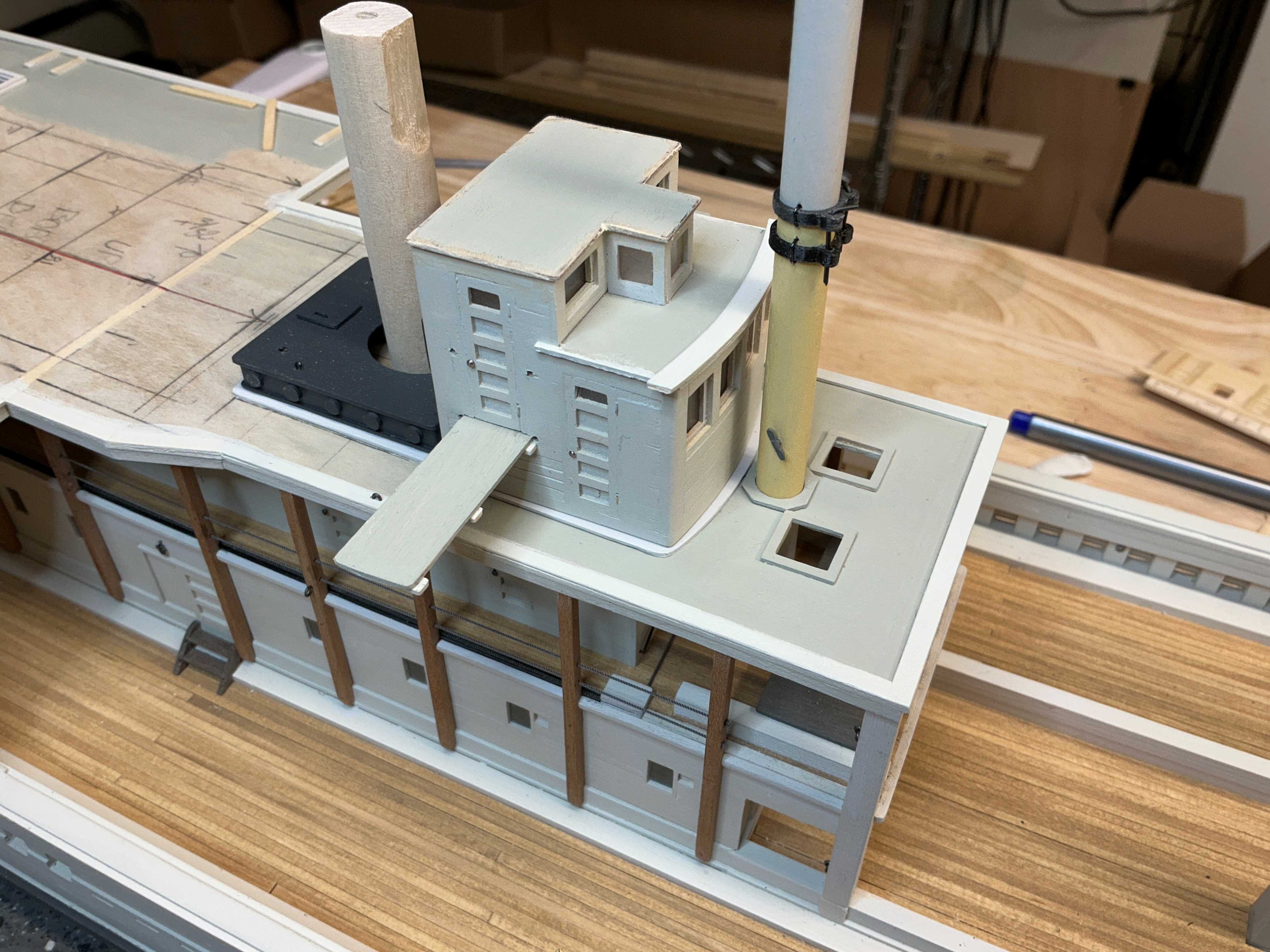

I apologize for the finger in front of the lens
And of course I had to throw on all the parts on it that were laying around to make it feel like there is progress.
Now it is time to finish planking the boat deck. Hope to see you soon!
