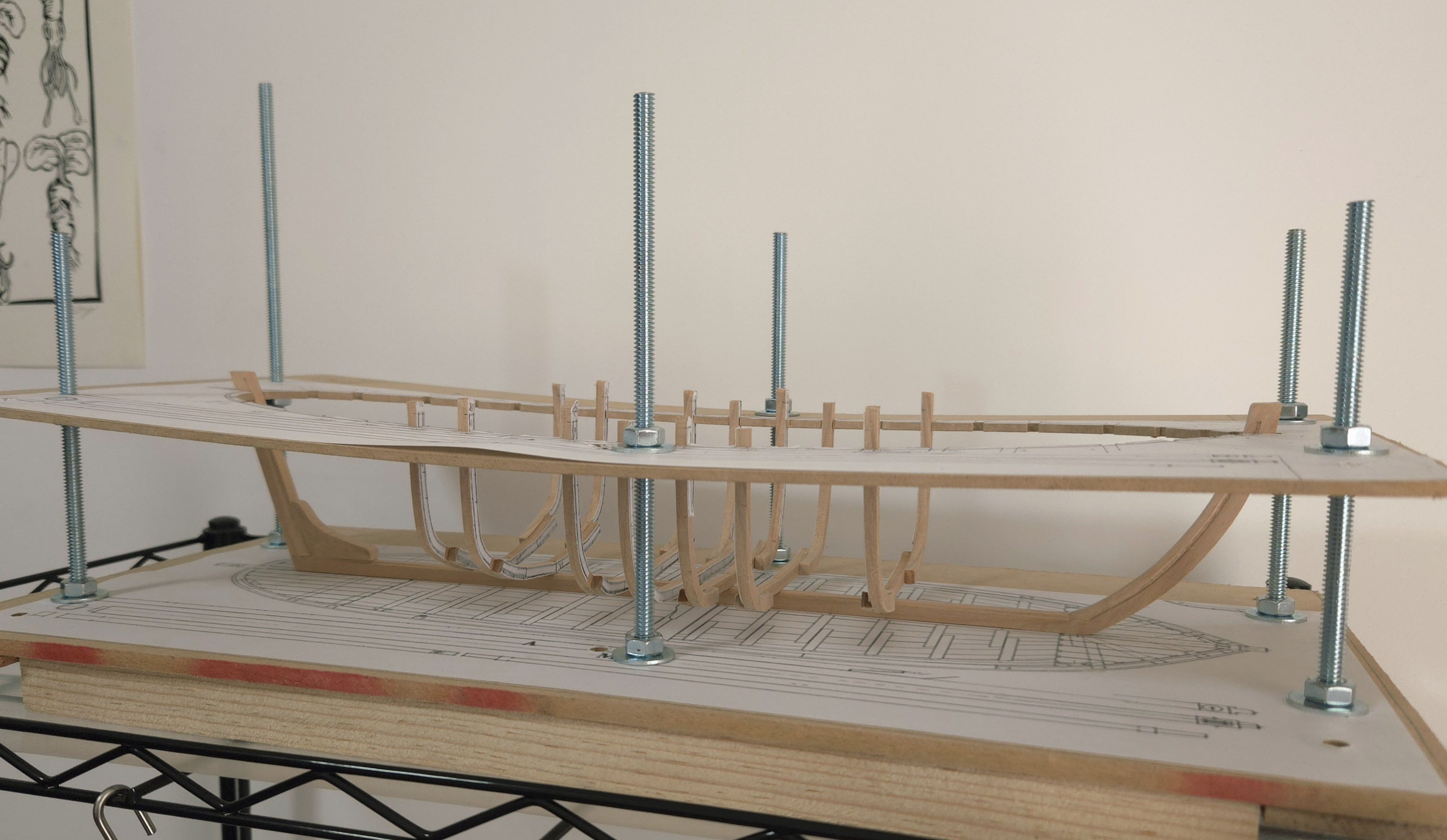

I've had a very long break from this project, when I was focused on work, the Lancha Chilota build, and planning and organization for our long-delayed wedding celebration (which went wonderfully). But I've finally gotten back into this build. I was able to cut a long threaded rod into shorter lengths to use as bolts. With the jig finally able to be positioned (although I need a few more nuts, which seem to have gone missing along the line, to fully lock it in place), I've been able to start placing frames, and I've made progress on cutting and gluing more frames. As can be seen, the paper glued to the top part of the jig is lifting due to the slight curve of the sheer, but the notches have already been cut so it's fine if the paper comes off at this point.
None of the frames have been glued in place yet. I am going to do a further round of sanding to pre-fair them before gluing. The interior, especially, seems like it will be tricky to fair, so I want to at least knock down obvious bumps before attaching things. Once I figure out the bulk of the frames, I'll turn my attention to the cant frames, which need a lot of attention to get right.
Edited by JacquesCousteau

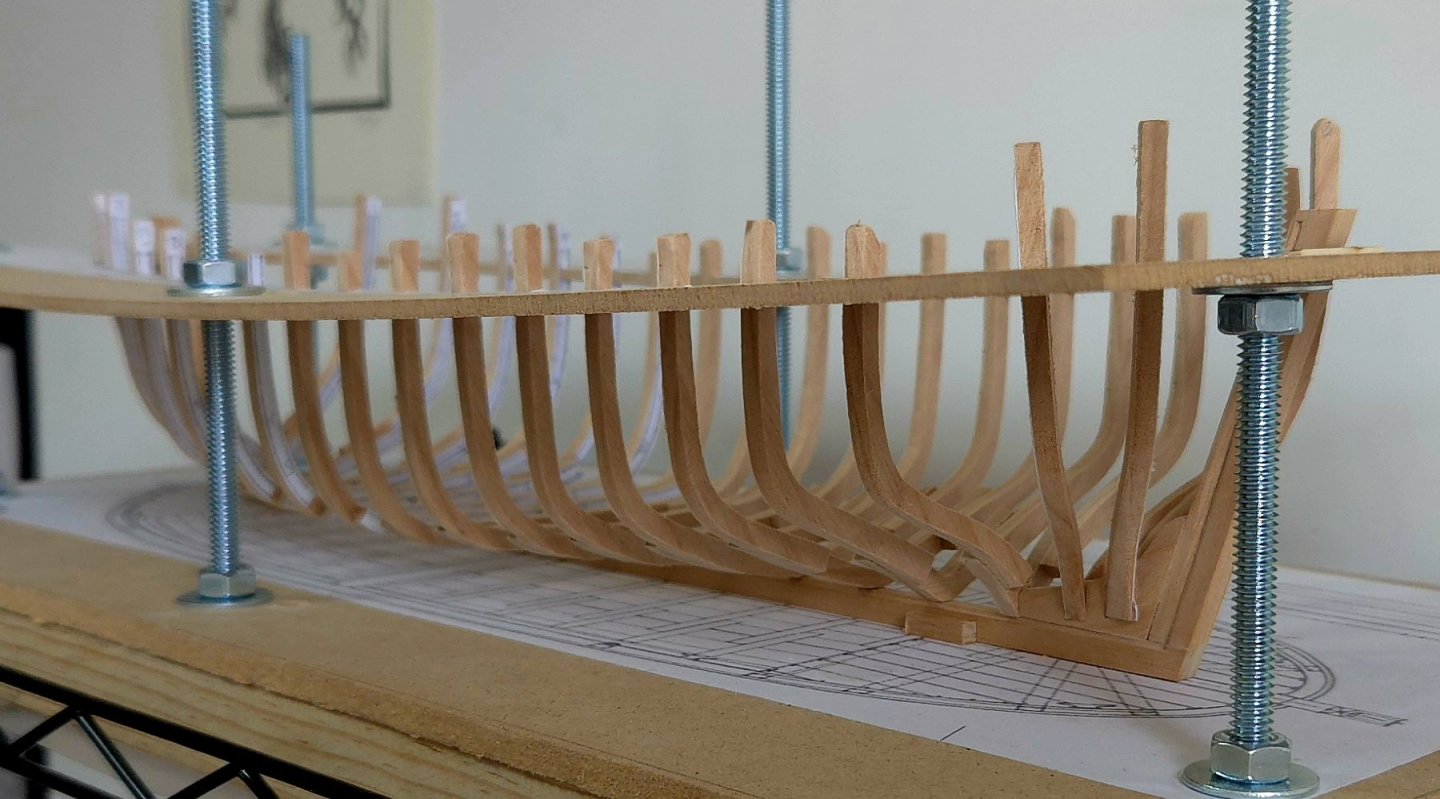

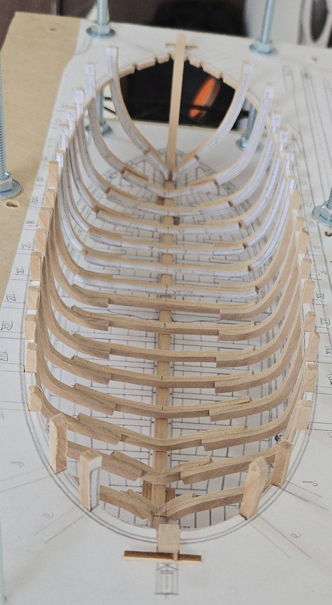

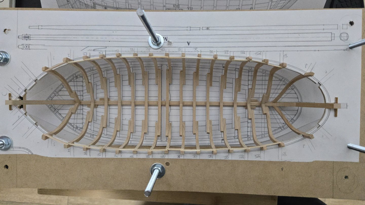

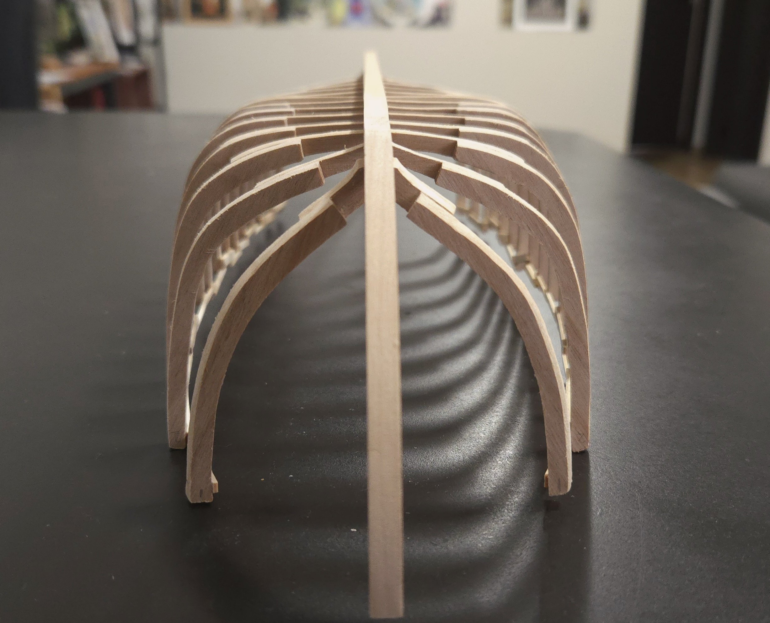

But this build is more of a marathon than a sprint. Two more frames were glued up last night:

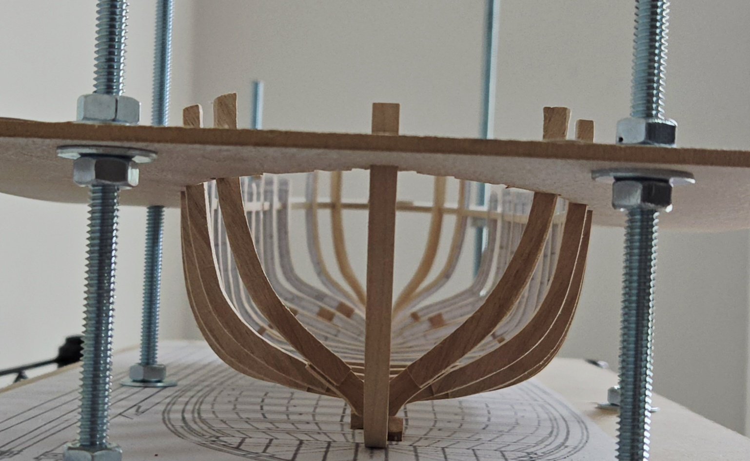

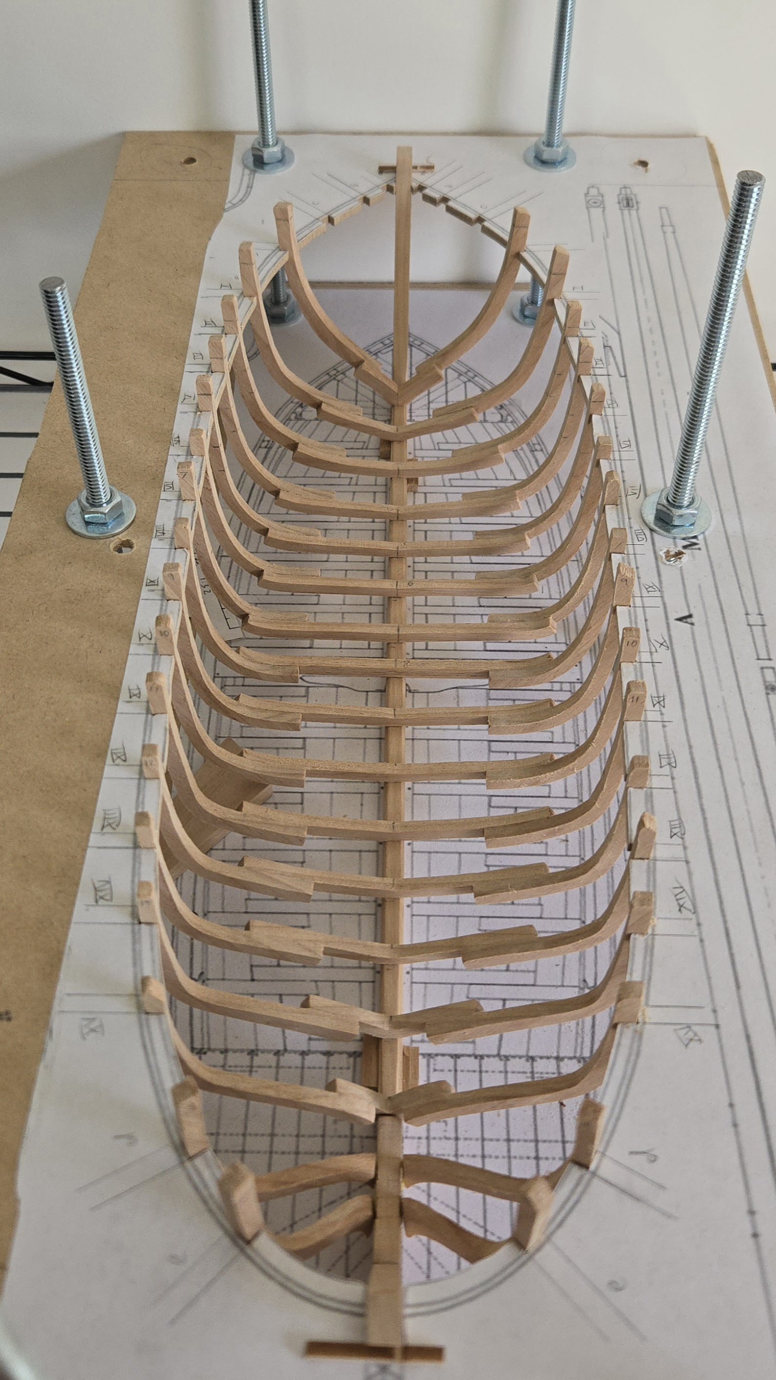

At the moment, I have ten frames glued up and dry-fit, although they'll need a lot more shaping before they can be glued. I'll also need to figure out the cant frames soon.

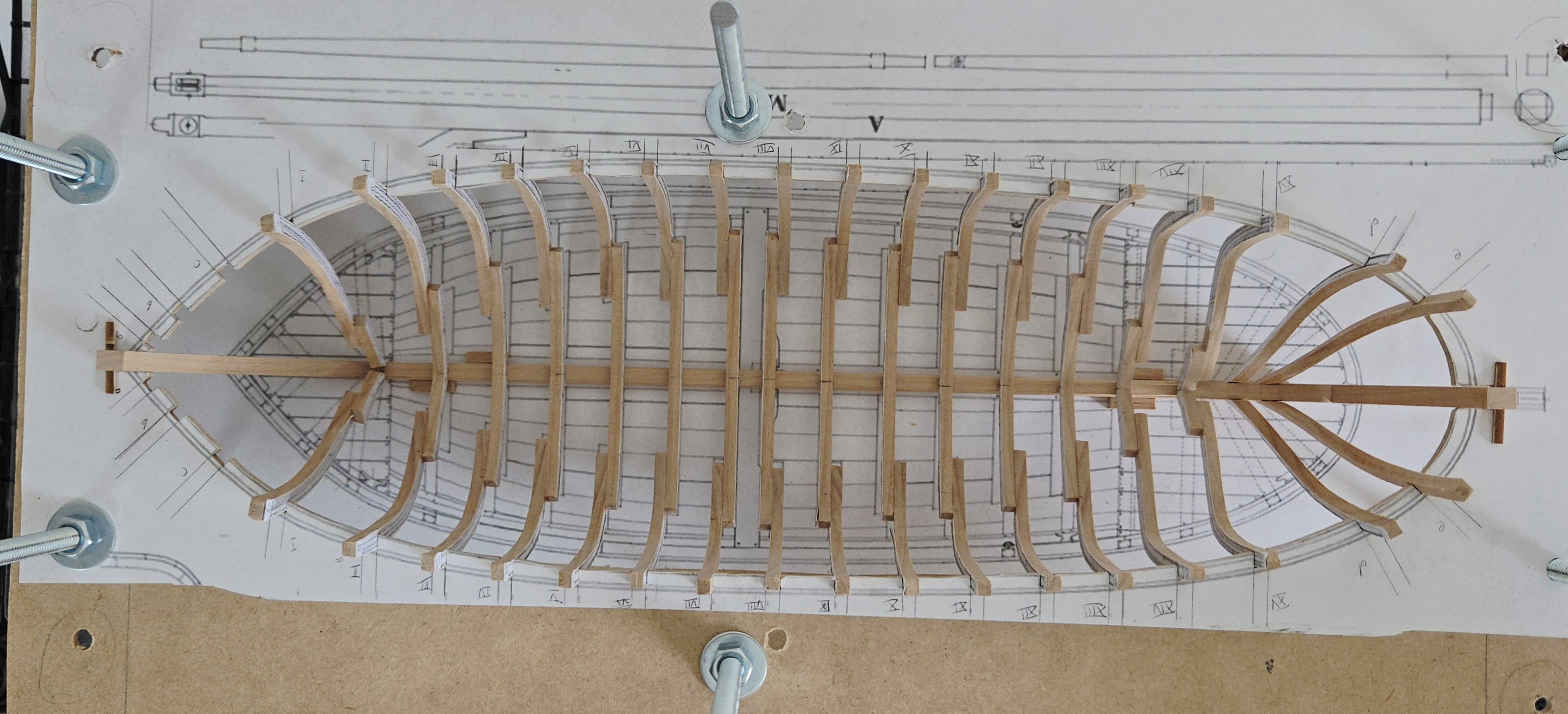

Two more frames glued up and dry-fit in the jig!
Two more frames--II and III--glued up and dry-fit. At this point, only the cant frames are left.

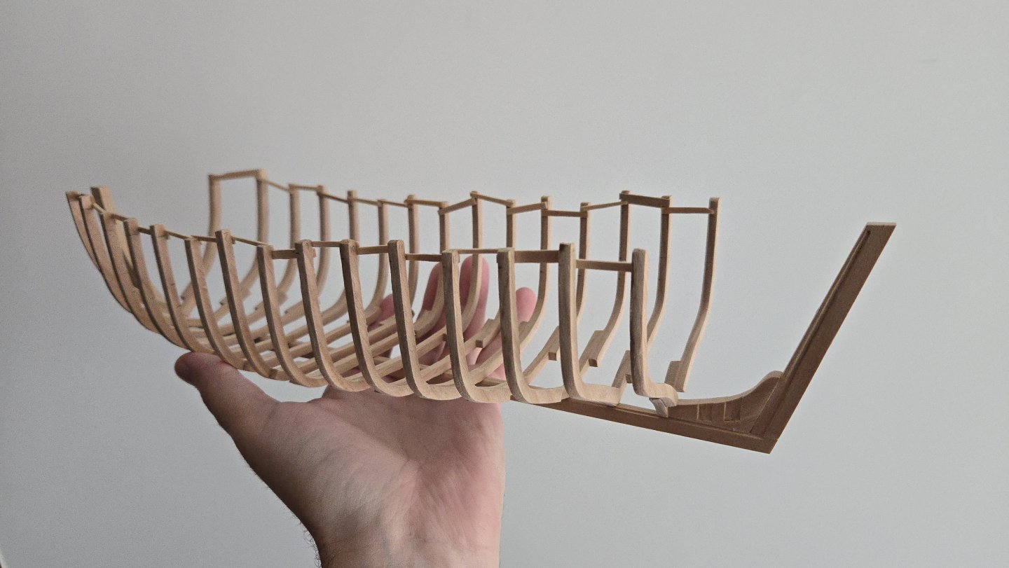

The shape of the hull is really starting to come together by now.

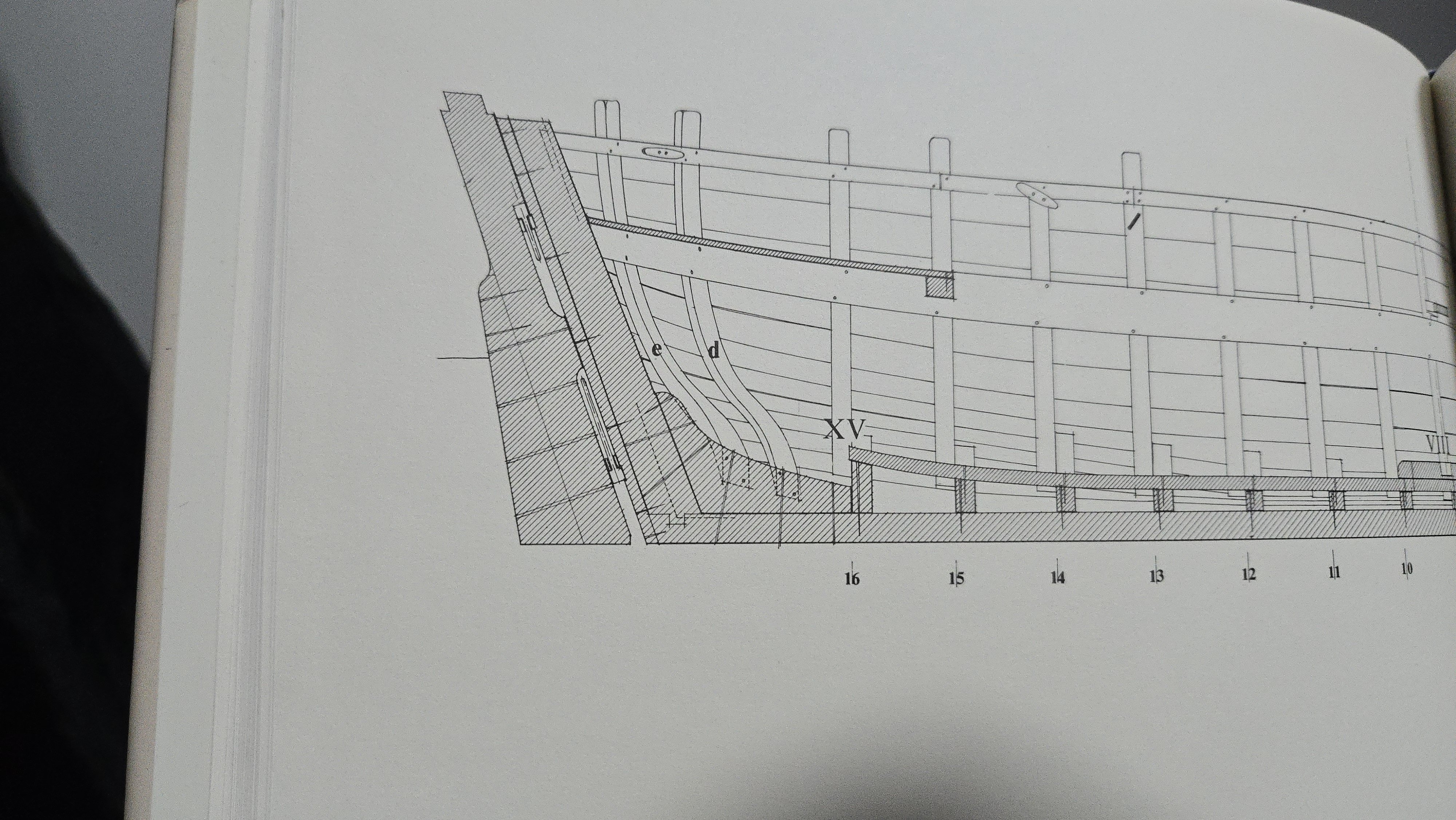

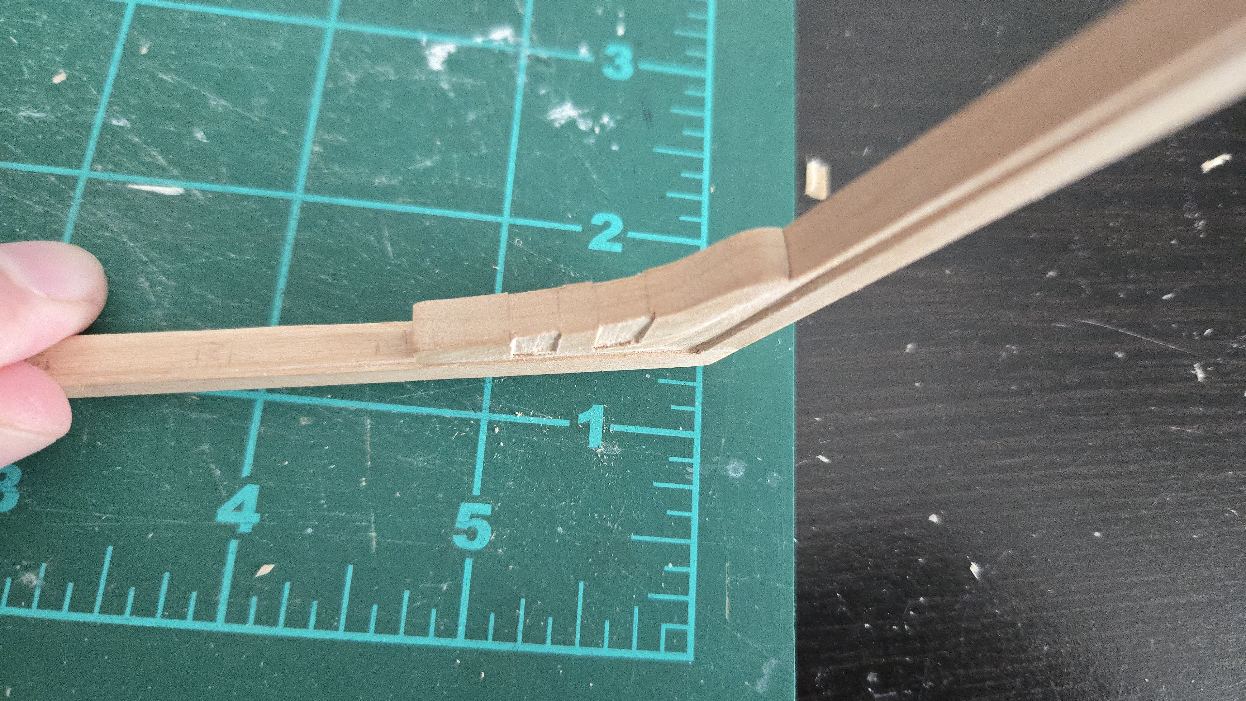

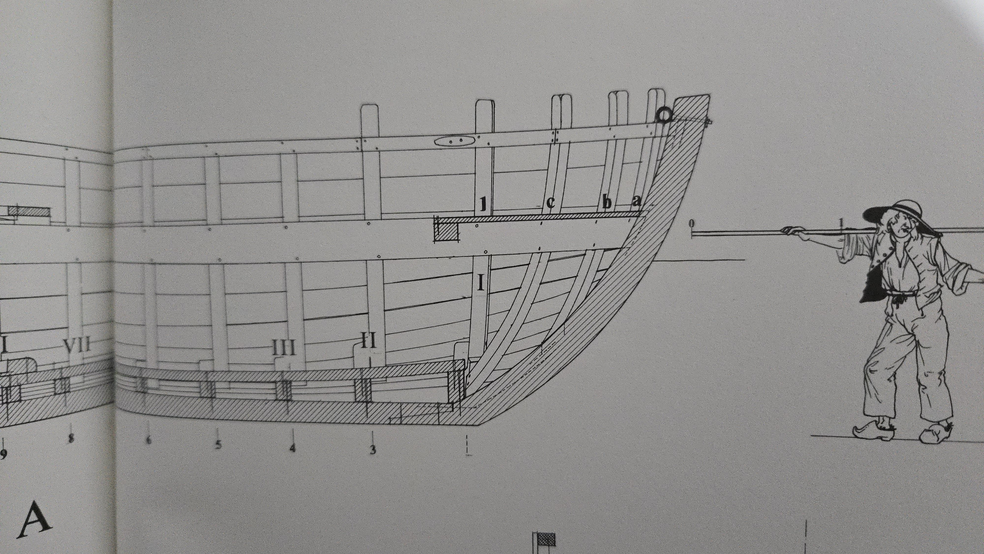

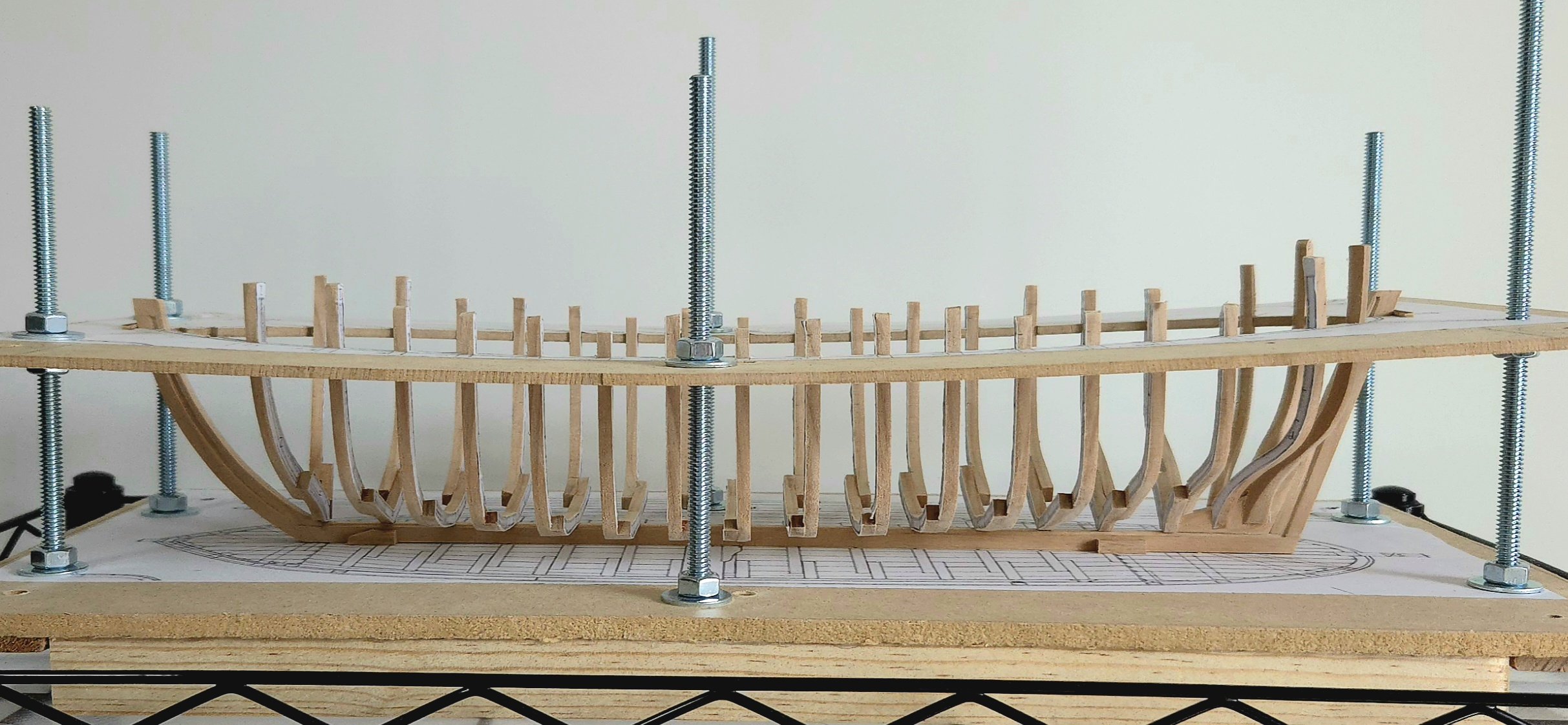

But, an issue. Looking at the side view in the plans, you can see that several frames are supposed to extend beyond the sheer.
But of the frames I've made so far (II-XV), only II extends beyond the sheer. XII, XIV, and XV all end at the sheer, following the frame sheet of the plans, when the side plans show them as extended. It's a little hard to tell because I've left all frames a little long, which I suppose means I can try to extend them a bit, but maybe not quite as much as given in the plans. I have to admit that this is very frustrating--part of the point of buying a plan set like this, instead of developing this all from scratch, is that you assume the plans will be consistent between sheets. Ah well, I guess that the extensions will just be a little stumpy compared with the plan sheet.

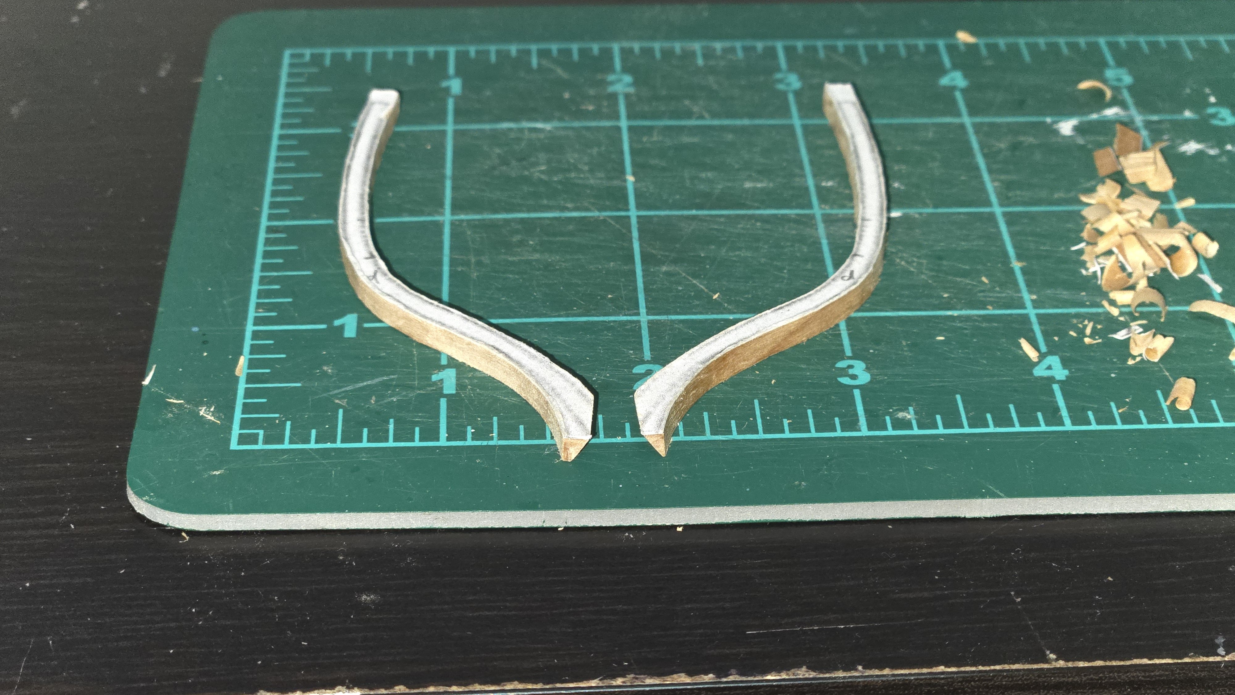

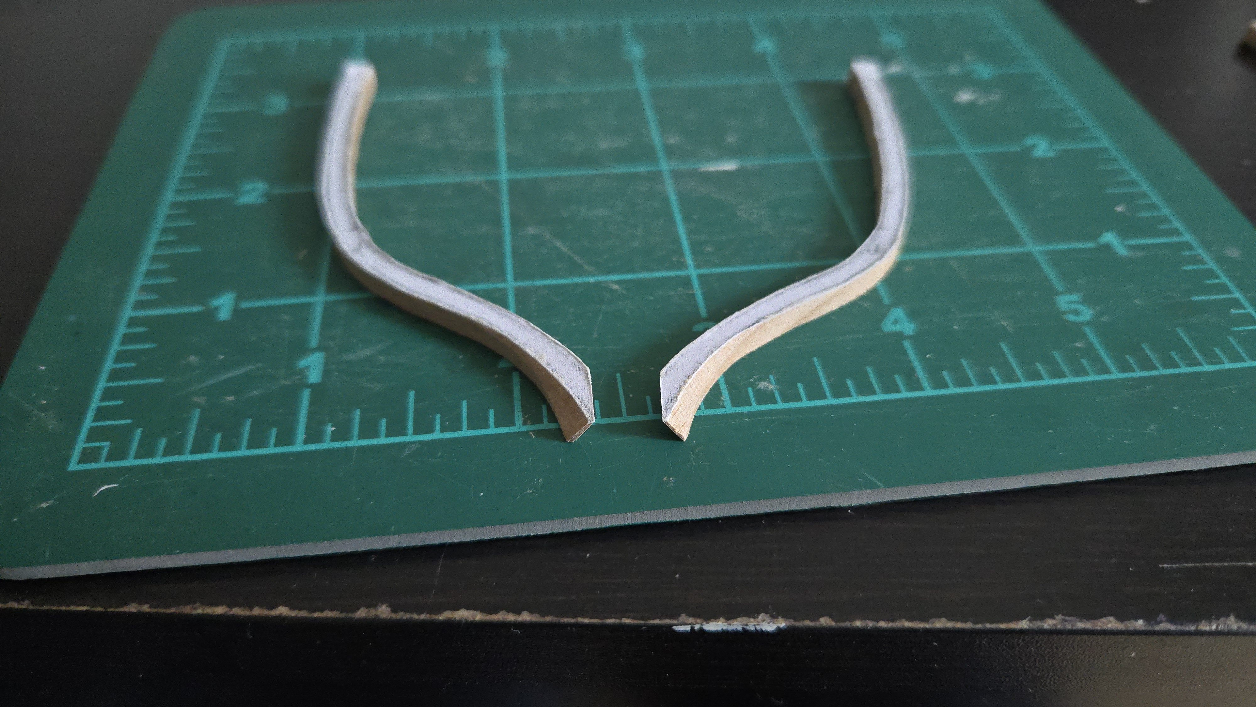

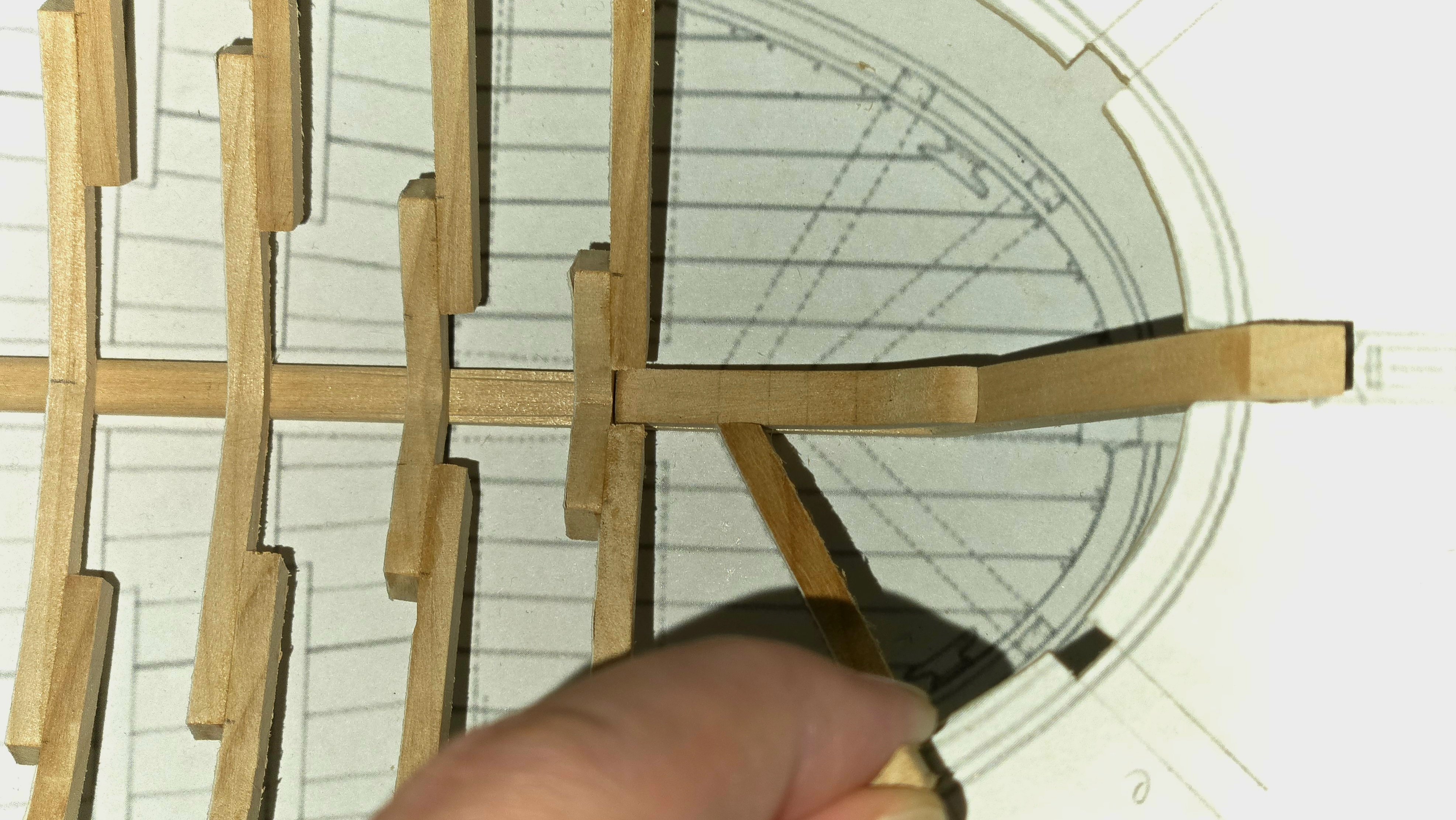

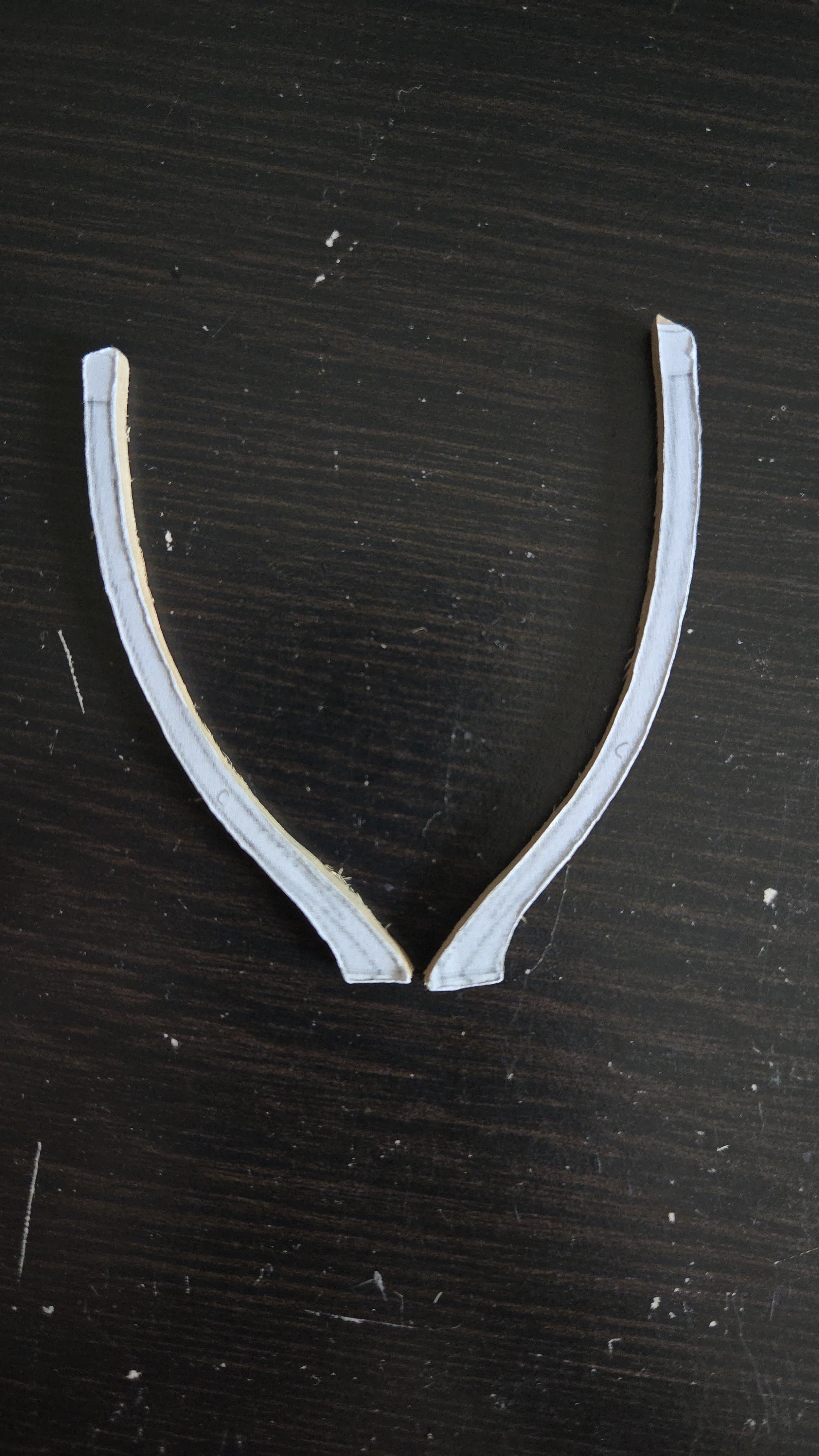

Next up are the cant frames. I've never made these before, so I started with frame pair D near the stern as it seemed the simplest. That said, it was still a bit tricky. As can be seen, the frame drawings show this as reaching all the way to the keel:
While the side view shows it as merging into the deadwood a little higher than that. I should note that other drawings make it clear that the deadwood isn't supposed to be notched or anything.
Rather than try to fit it as on the side view, I think I'm just going to make it full length to the keel and, once it's glued to the deadwood, see how it turns out with fairing.

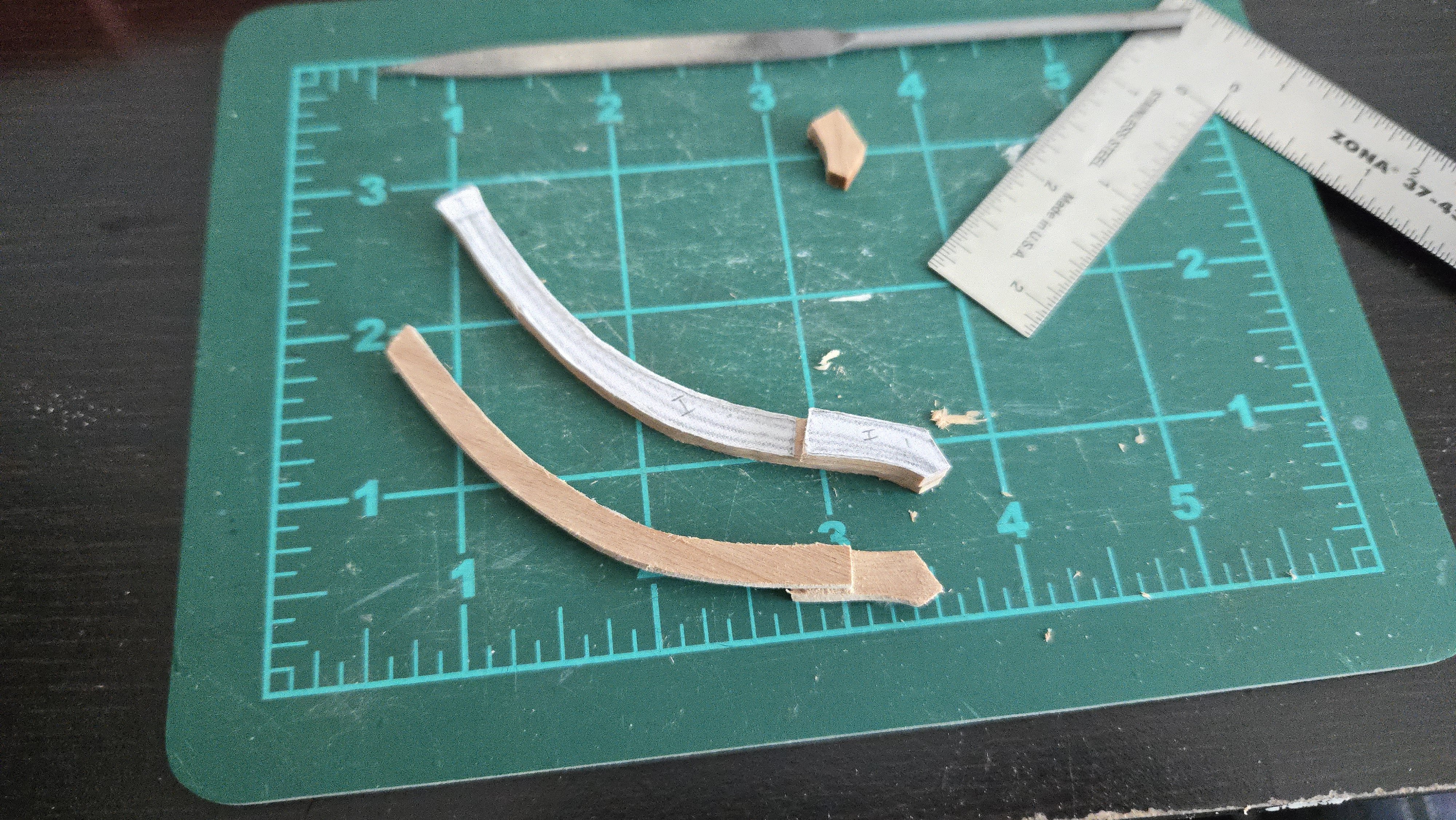

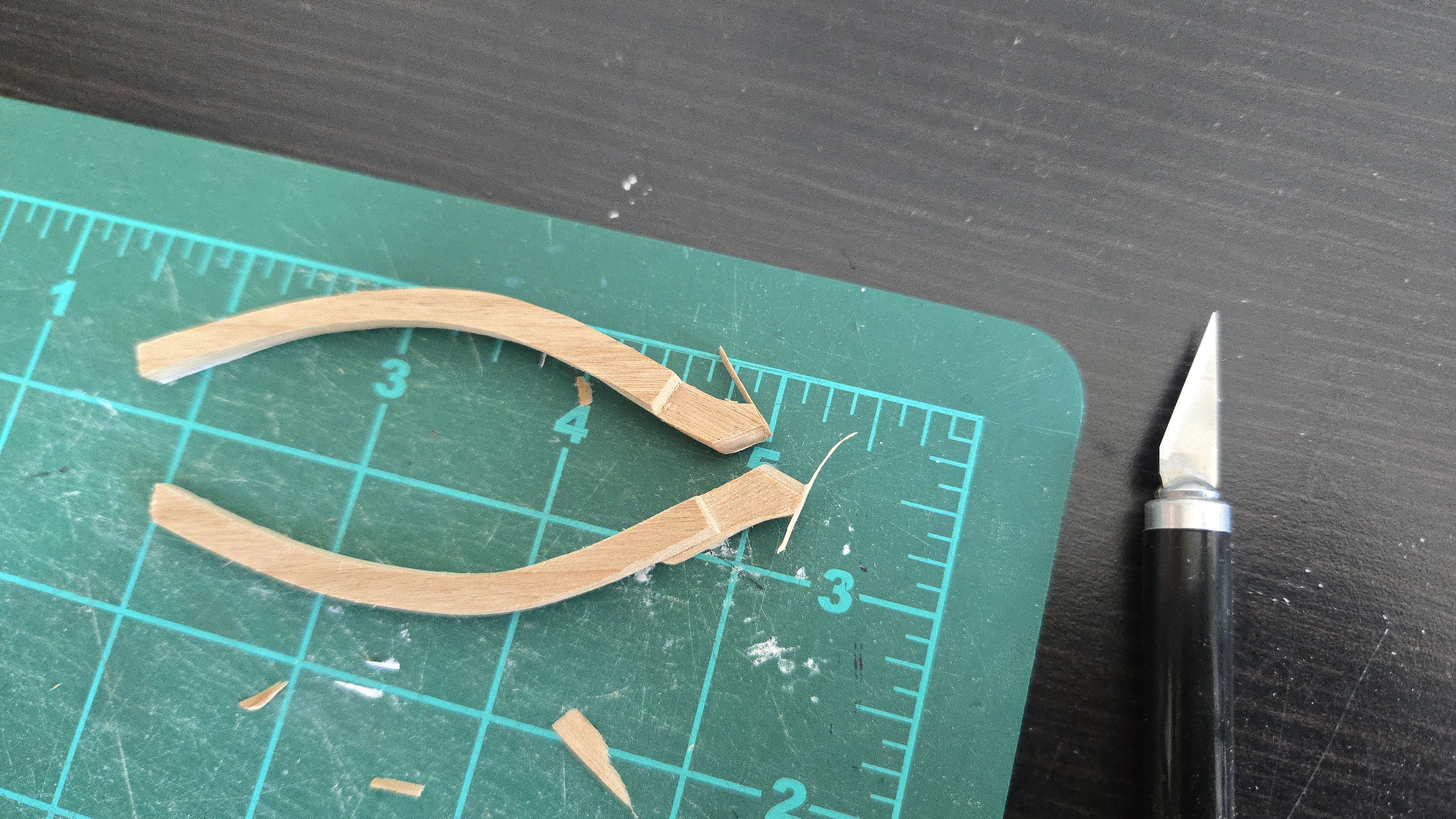

I began by trying to cut the inner angle. This took a lot of patient, minimal trimming and checking fit. Given the angle and all the jig pieces blocking the view, it's a bit tricky to hold the frame in place to check fit. You need to check alignment both in terms of landing on the deadwood correctly, not to high, low, or off fore-and-aft, and make sure the part that's hanging between the jig and the deadwood is properly lined up from the top down, as otherwise it will really throw off the hull shape. Meanwhile, without a notch or anything, the piece wants to slide all over the deadwood. All of which is to say, apologies for the poor photo quality of the test fit below!
Eventually I got the inner angles about right.
In contrast, beveling the bottom of the other side was much easier, I just had to pay attention to the changing grain direction around the curve.

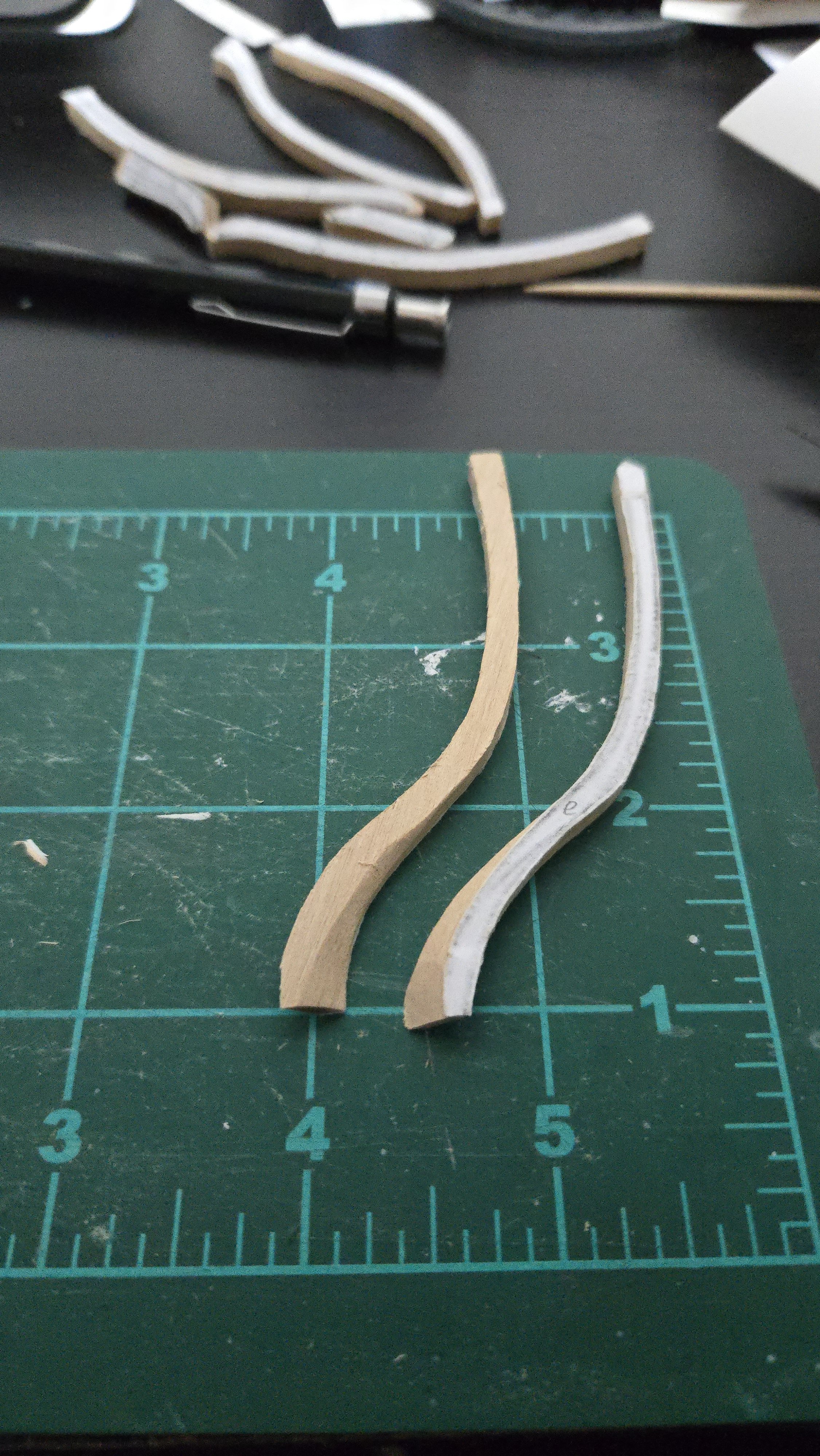

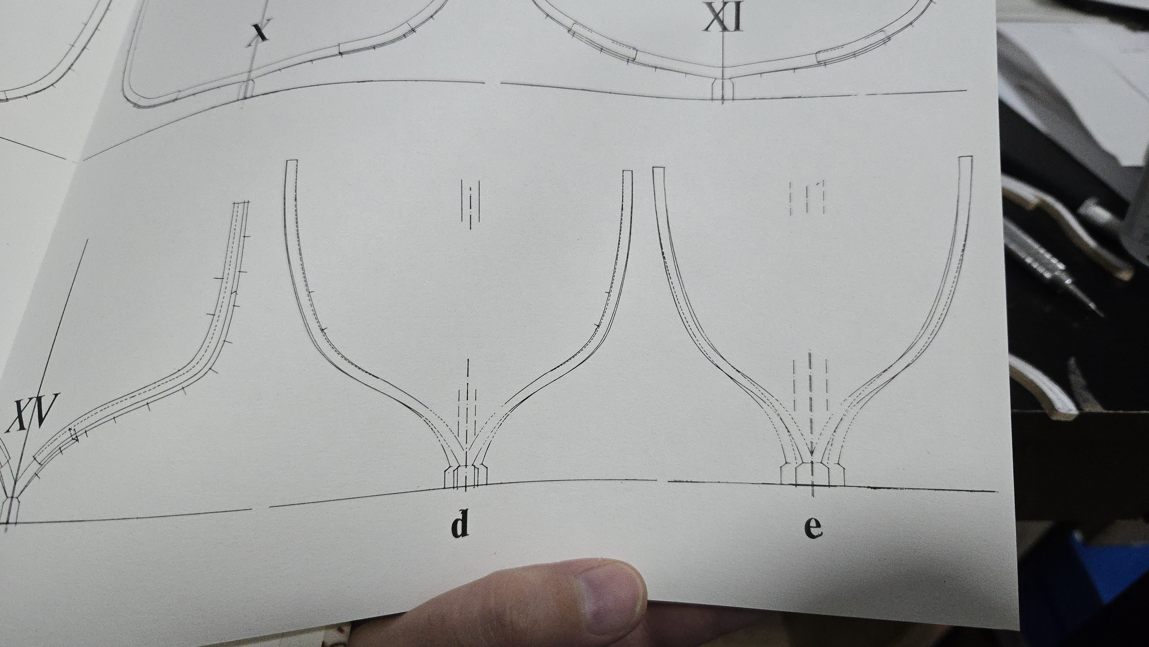

Cant frames E, the aftermost frames, were also fairly straightforward to make.
That said, I've realized that my plan to just extend them to the keel isn't going to work, as they really should end at the bearding line on the deadwood. Working out how to properly fit these is going to be very difficult, and I do wish the planset had drawn how they actually fit instead of showing them going full-length to the keel. Overall I'm finding the plan set to be very useful, but I have found a number of issues, and I'm confused by many of the choices made in drafting the cant frames especially--I haven't even gotten to cant frames A and B yet, where as I've mentioned before, the plans don't show the end of the frame pieces.

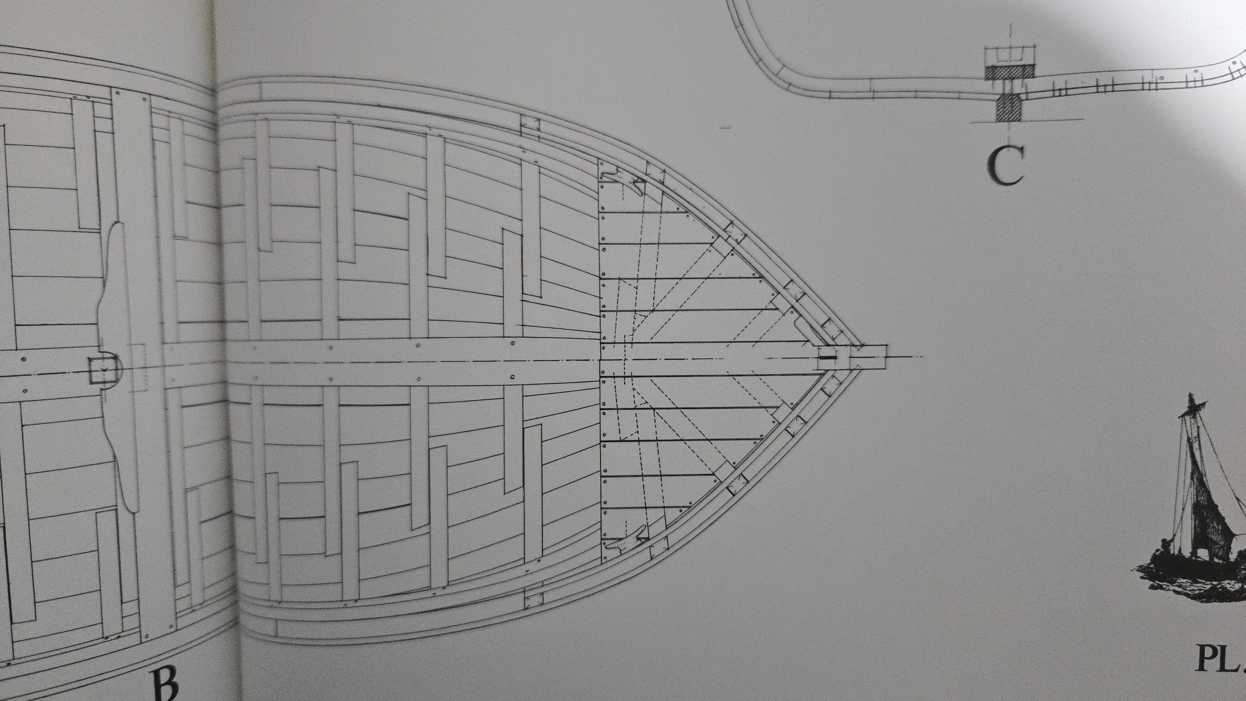

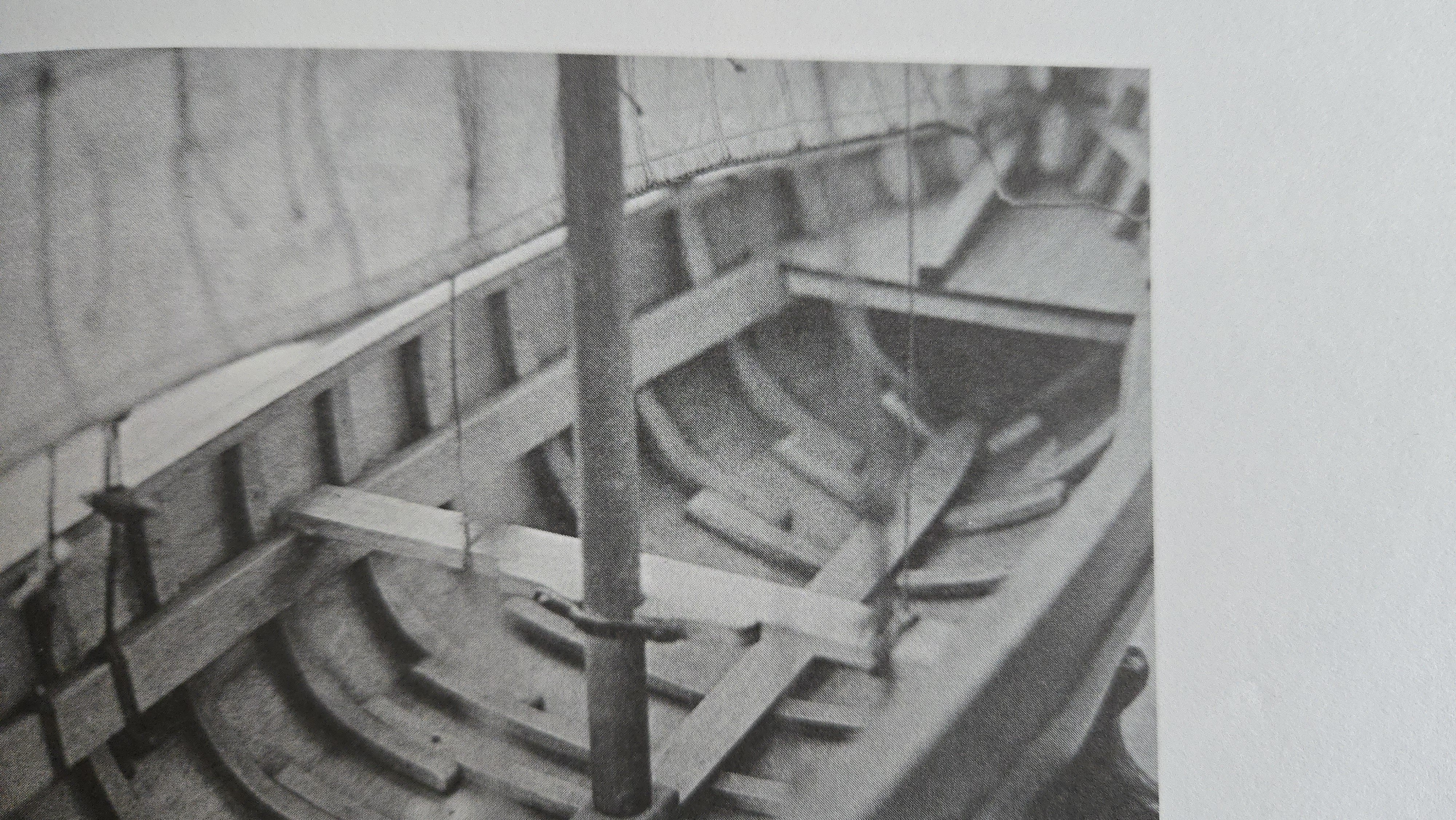

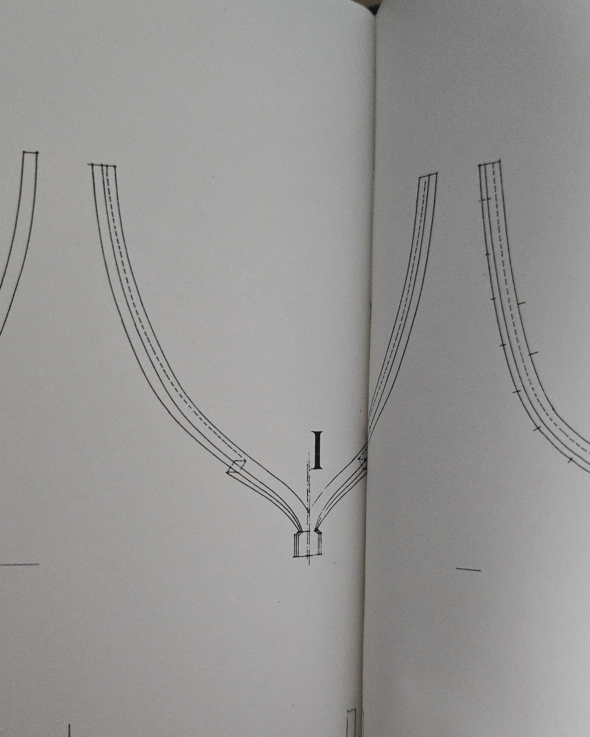

Another issue is frame 1, which is slightly canted forward. Unlike the other cant frames, but like the full frames, it has a floor piece--actually, two of them, which you have to properly angle. As can be seen, the frame plans show the futtocks as nevertheless extending all the way to the keel, doubling the floors:
While the side and top view show the futtocks as ending well before the keel, barely overlapping the floors, and leaving space so that cant frame C can butt up against the floors of frame 1 and the keel:

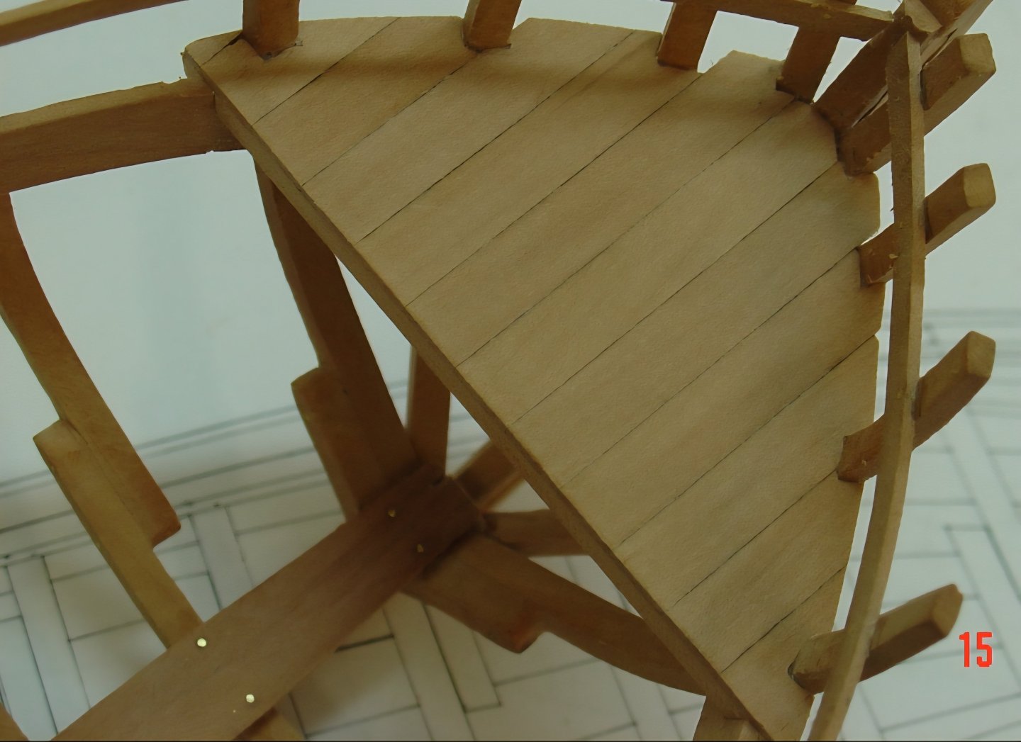

Definitely a bit odd. I was curious how others have handled this. The only actual build logs I've seen are on a french modeling forum where you need an account to view images. Another site, though, shows photos (without commentary) of a build. From what I can tell, they left the frame 1 futtocks full-length and butted frame C up against them. This certainly seems like a simpler solution, requiring just one cut across the bottom of frame C instead of two.
Source: https://www.alexshipmodels.com/2016/12/10/le-bateau-de-lanveoc/
At this point, I'm wondering if I should glue the full frames in place and run some battens to help determine how to place the cant frames, or if I should make another jig plate of a waterline to add below the existing one. Either option seems like it would be extremely helpful to work out the placement issues caused by the oddity of the plan set. In the meantime, while I ponder what to do, I'm pre-fairing the frames, which are currently extremely chunky compared with how they should be.

Hello,
In the hope of making your decision easier and perhaps giving you some confidence in how to proceed with the timbers at the bow, it can be said that these plans are structural reconstructions, so they can certainly be reinterpreted in various ways.
For example, in addition to the solutions you have already mentioned (or shown), others can be added: the first frame (I) can simply be made perpendicular to the keel, rather than canted (as the frame XV at the stern), or if you still prefer this frame to be canted, you can make the construction simpler and do this by slightly tilting the flat first floor piece (instead of making it V-shaped when viewed from above).
It is clear that these boats were individually built in different ways by different builders.

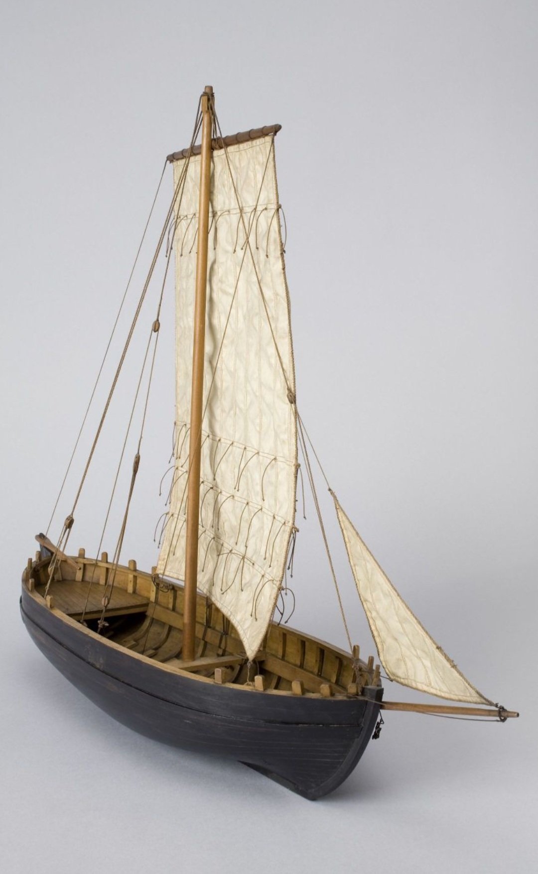

Incidentally, I realized that I was forgetting another source: the model in the Musée National de Marine, photos of which are in the monograph itself! (This is what I get for building so slowly and for doing multiple builds at once). The photos are a bit blurry. In the first, the futtocks look like they cut off just before the keel. In the second, it looks like they go nearly to the keel if not quite to it. Interestingly, cant frame C, which by the plans is supposed to butt up against frame 1, isn't visible at all, and from the angle looks like it would go to the keel further forward. Of course, on this model, the frames aren't really structural: the hull is actually a hollowed shell with planking scribed on the exterior and frames added later.
The Musée National de Marine site has some nice photos of the model, although none of this detail under the foredeck.
Source: https://mnm.webmuseo.com:8443/ws/musee-national-marine/app/collection/record/9718

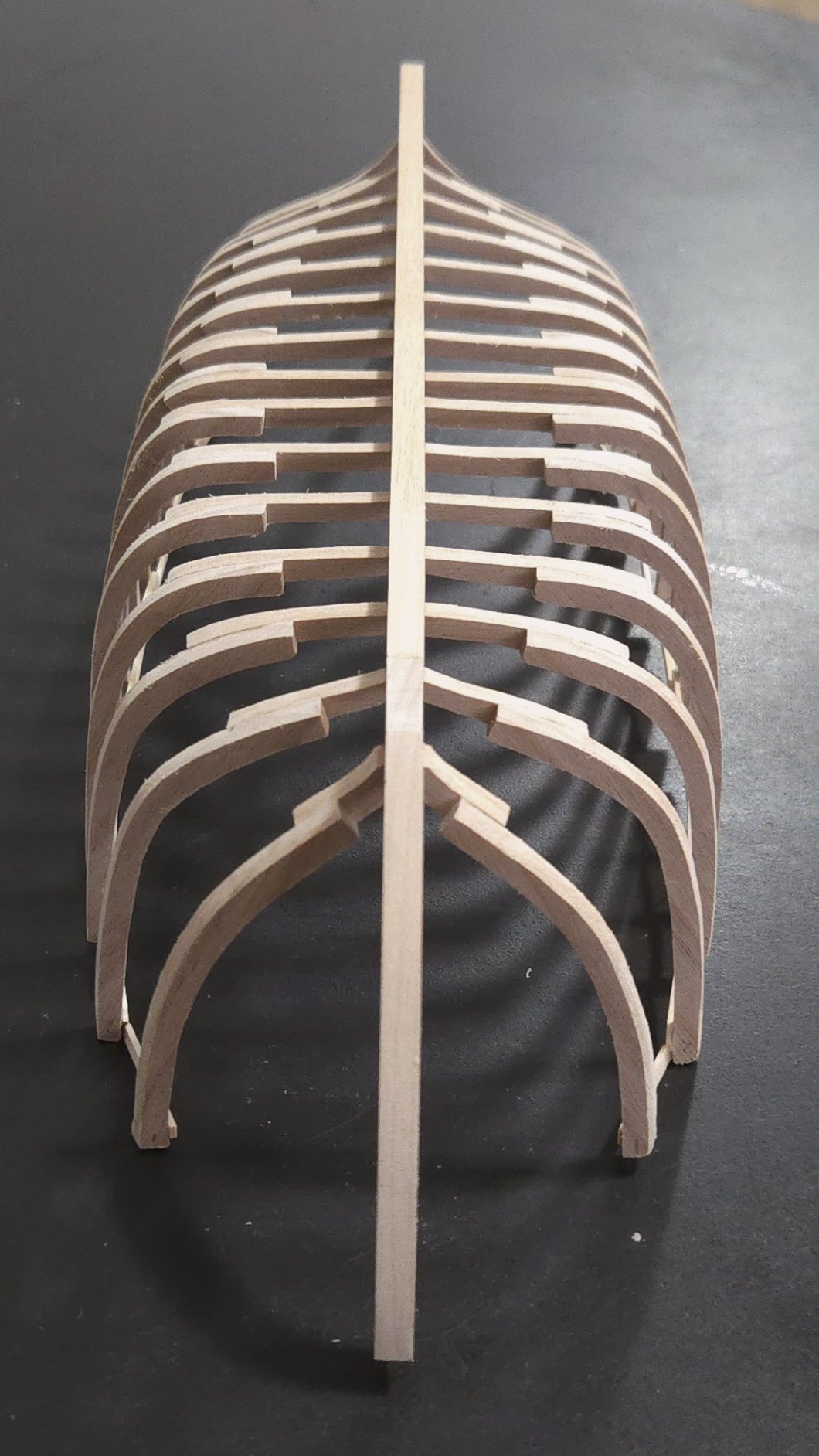

In the meantime, the exterior of the frames have been sanded a bit. Still a long way to go, though!
I had already glued the floors to the full-length futtocks for frame 1, as given in the frame view plans and shown in the other photo-only build log I mentioned above. However, after some thought, I decided to trim back the bottom ends of the futtocks, as shown in the top-down plans. Frame 1 reaches the keel right where the keel joins the stem, meaning that there's a lot of extra shaping to fit the curved stem if you leave the futtocks full-length. This was pretty easy to do, using a razor saw to carefully cut the futtock, then applying alcohol to the part to be removed and using an xcel blade to cut it off before sanding and filing smooth. In the photo below, the bottom frame has been trimmed, while the top is next.
I also decided, in the spirit of the monograph being a reconstruction and not an exact replica that must be absolutely followed, to deviate slightly from the plans regarding the aft cant frames' joints with the deadwood. The plans show this as a simple butt joint. However, as the deadwood is smooth and the cant frames have a complex curve to them, I found it extremely difficult to place them against the deadwood at the correct location. I had marked it in pencil, but it was hard to see with the jig and my fingers in the way, and the cant frames want to slide all over the surface with any pressure, especially as pressure must me exerted on the highly curved and angled exterior side. So, I decided to cut slightly into the deadwood, giving the frames just enough of a slot that they can be held in place much easier. This was done carefully with an xacto knife and a file.
As can be seen, it's a very small amount that was removed, but it makes a world of difference in positioning the cant frames.

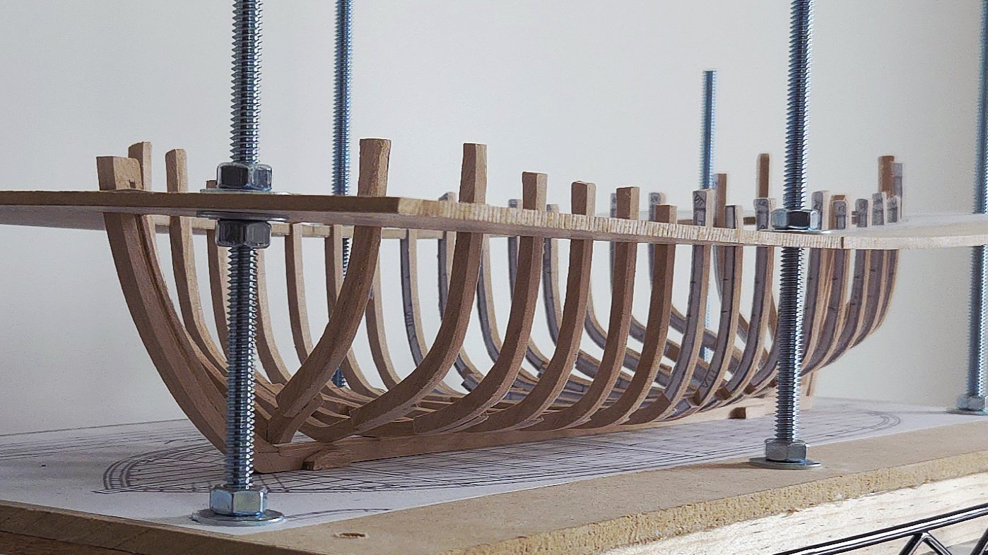

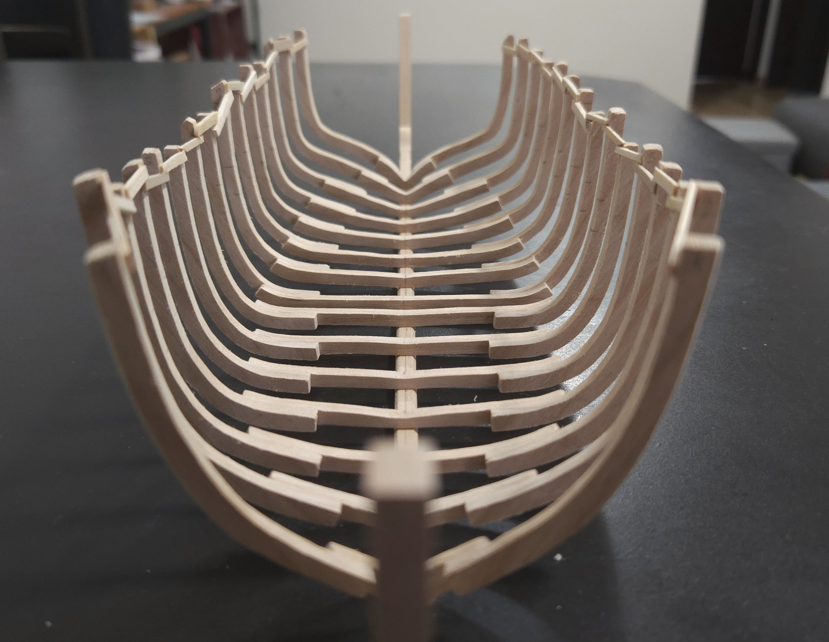

I've also finished pre-fairing the exterior of the frames (except for the cant frames). With everything dry fit, the shape of the hull shines through. After six months of work, admittedly with a lot of interruptions, the model is looking more like a ship than ever.
The interior of the frames still need pre-fairing before I actually glue anything. I have to say, I quite like the skeletal look, and I'm strongly considering leaving the model unplanked between the broad strake and the wales.

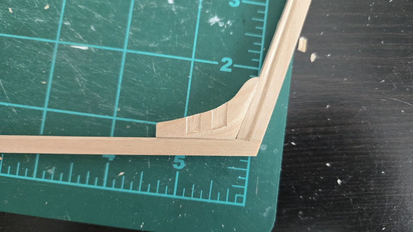

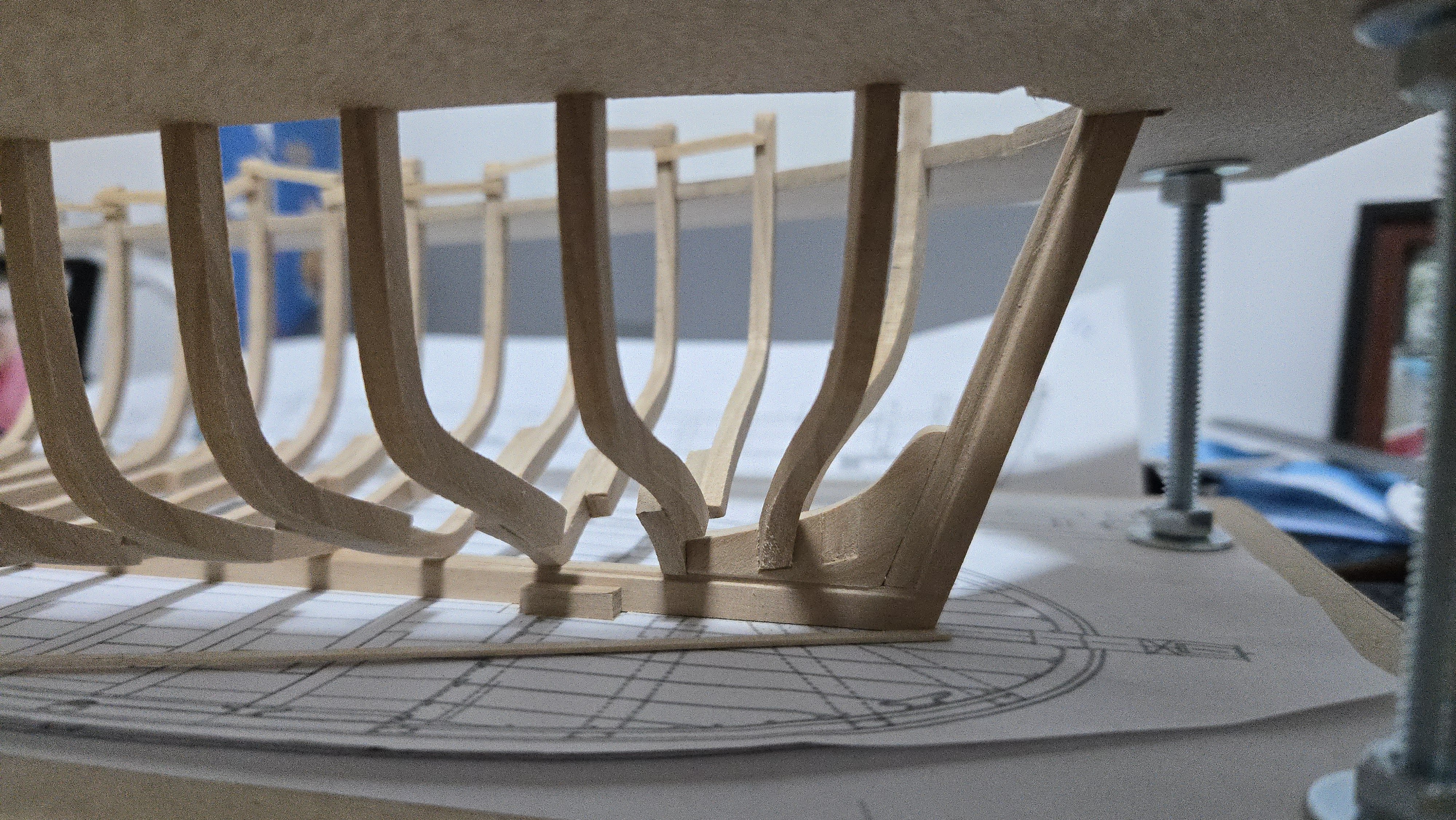

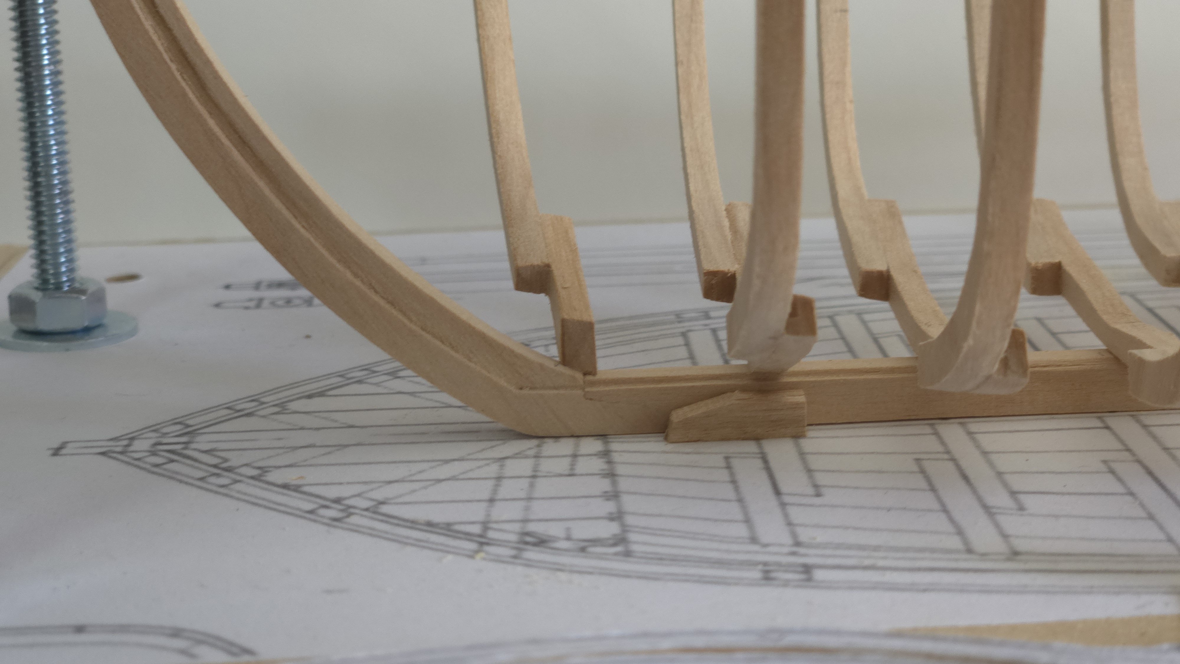

Cant frame 1 needed some shaping at the juncture with the keel, both to get the proper angle between the two half-floors and to set up the proper shape against the keel and running up the curved stem a bit. This was tricky to get right. I didn't quite cut the right angle between the two half-floors, although that side of the joint will ve totally covered by cant frame C, the keelson, and the garboard and broad strake, so I'm ok with leaving it as is and doing better next time. I then beveled the bottom, to match the frame's rise onto the stem, in the wrong direction. Thankfully I was able to glue back on the shavings I had removed, and some extra as necessary, to build it back up to the proper size, then did it right the next time.
As with the other cant frames, I found frame 1 quite challenging to properly fit. As can be seen here, with the port half left off and the starboard half dry-fit, it's an awkward fit over the juncture of the keel and stem.
More challenging will be Cant Frame C, which need to butt up against the fore side of frame 1. Confusingly, while the frame drawings show these as having a flat bottom, while they actually will intersect the curved stem a distance above the line of the keel. Not to be a broken record, but it would be nice if the plan sheets properly depicted the joint between the cant frames and the keel/stem/deadwood, as a difference of a millimeter or two can really throw off the shape of the hull.

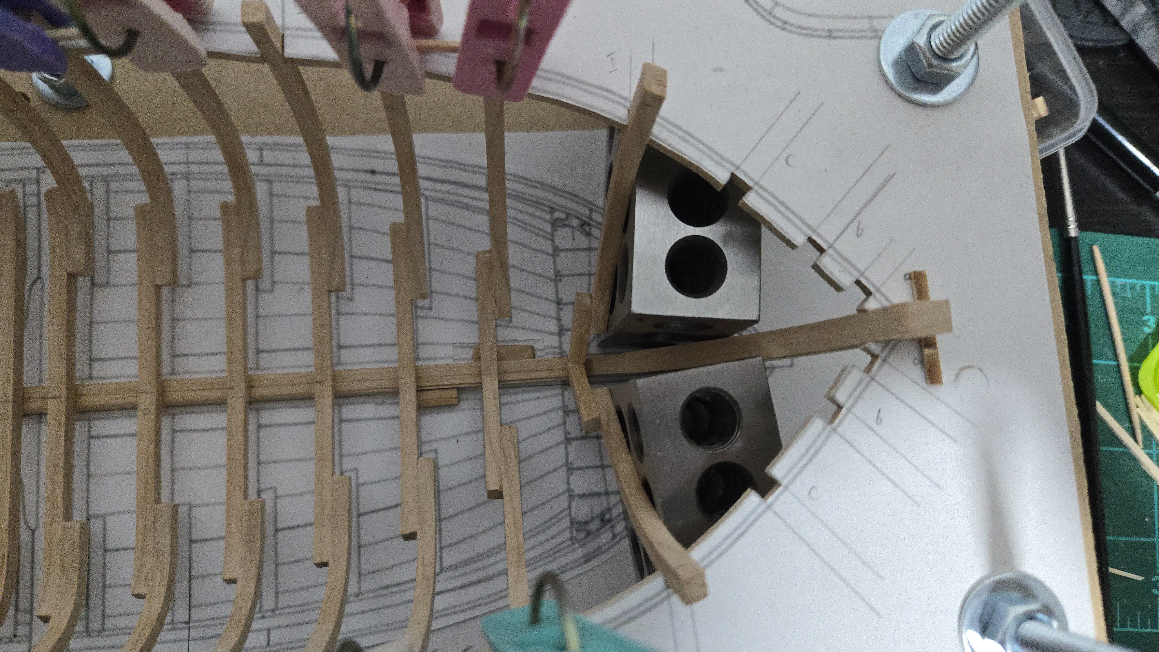

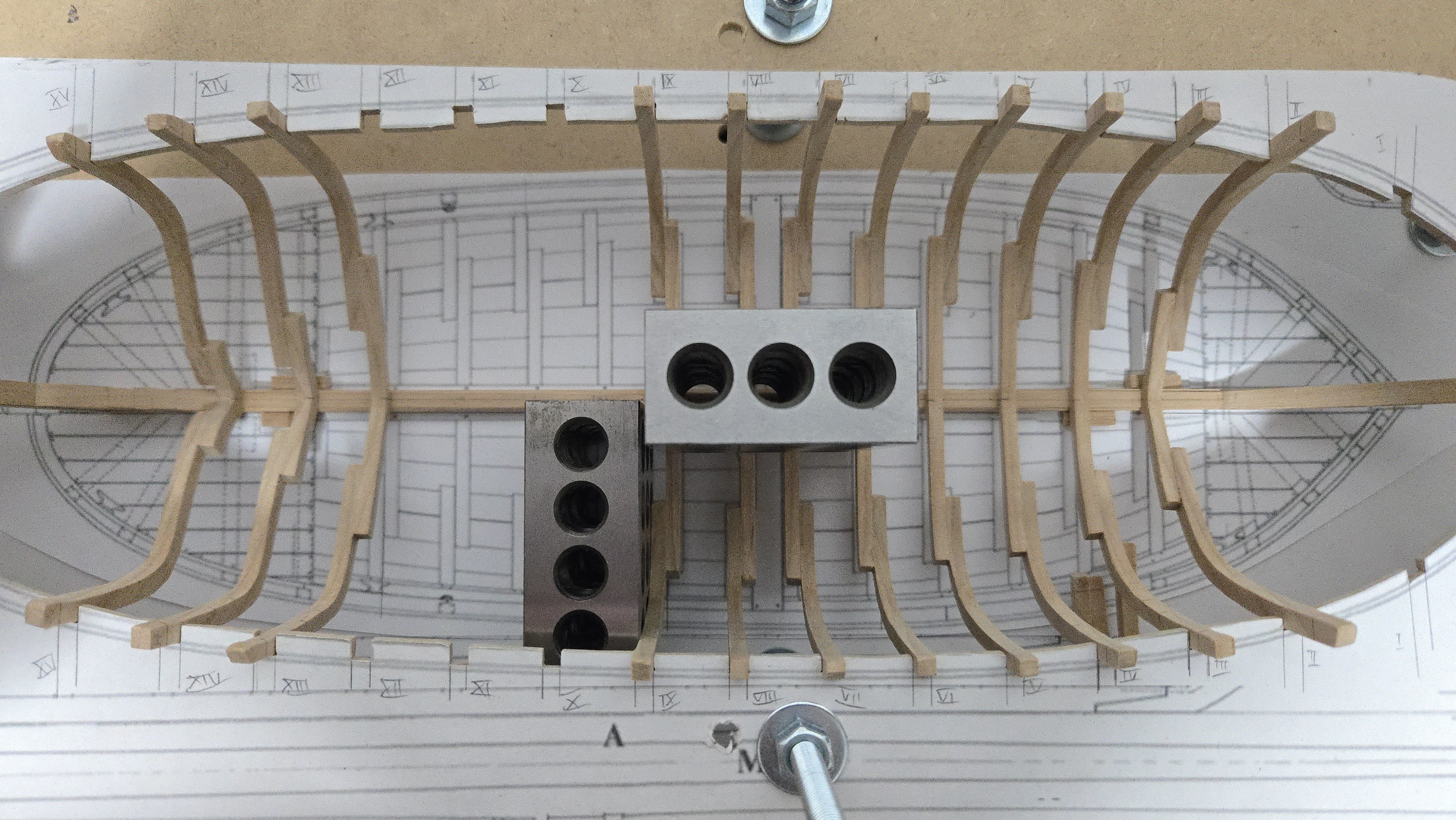

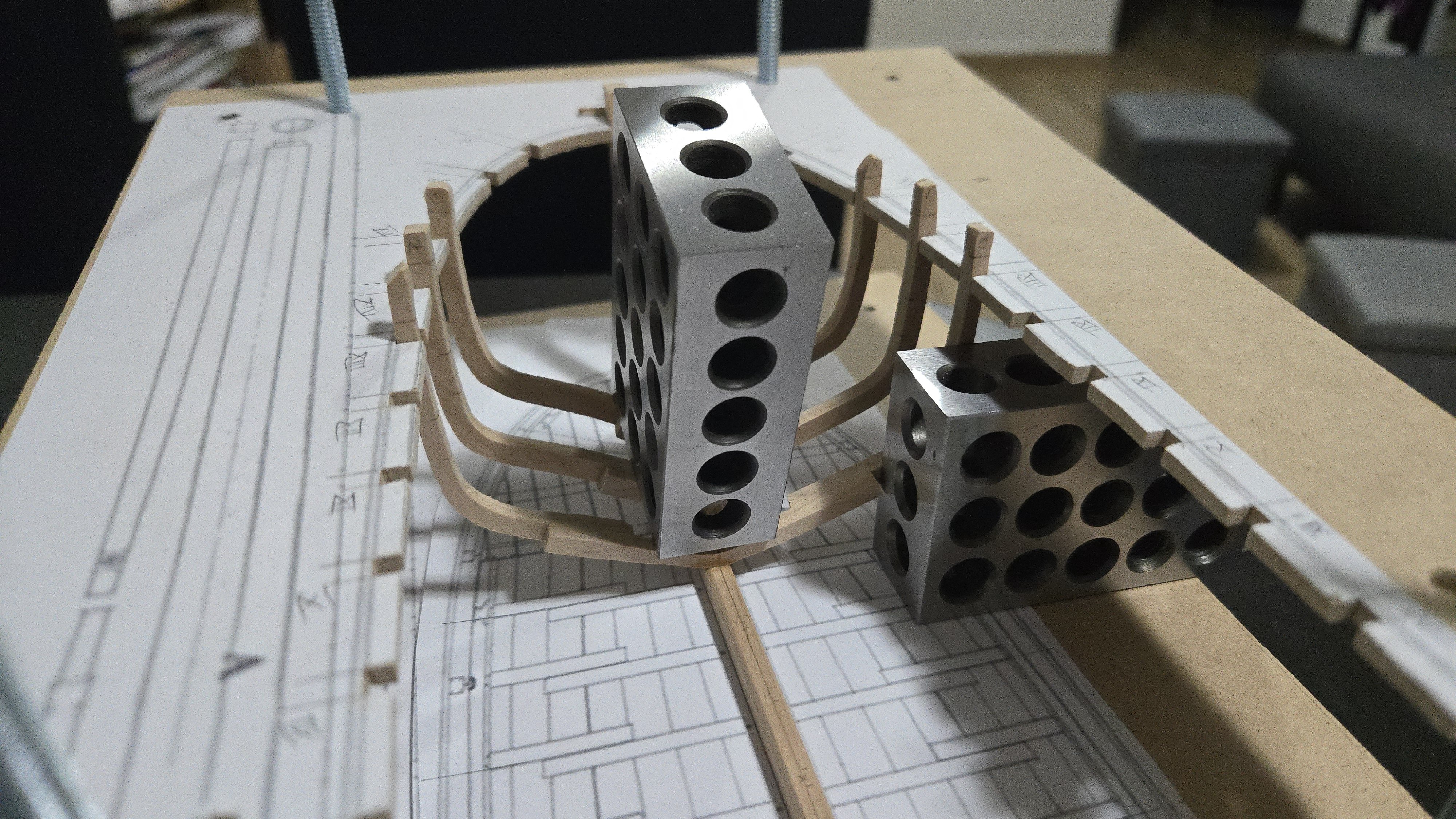

I ultimately decided to add the normal frames now and the cant frames afterward. One challenge I've had with working out how to position the cant frames has been that the frames I was positioning them in relation to weren't fixed in place, so this will allow me to more easily set up ribbands to help position the cant frames.

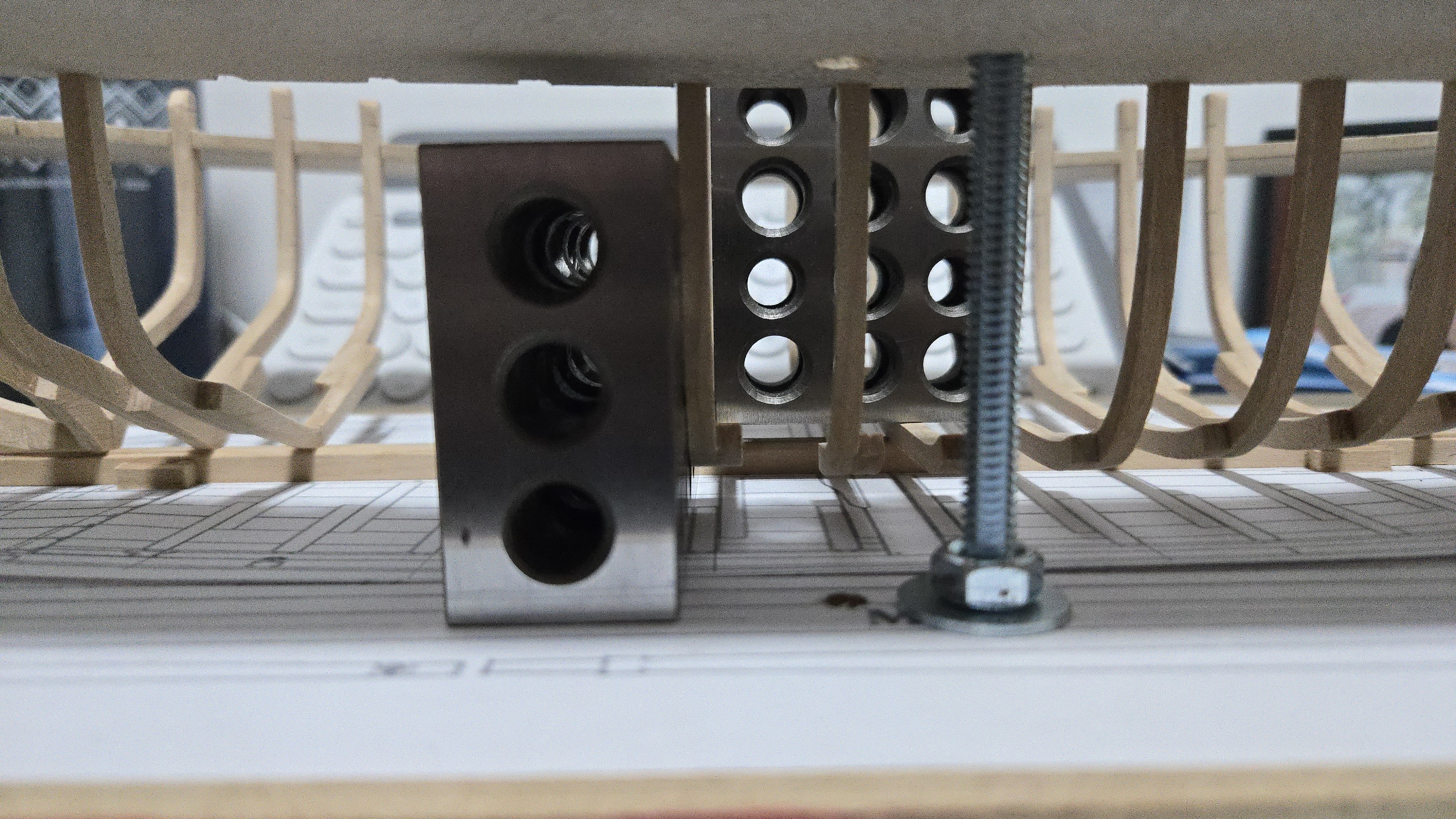

I found the 3-2-1 blocks really useful for this. As seen below, I set up one to mark the edge of the frame, which ensured that the frame would be vertical. The other was used as a weight to clamp the frames while gluing.
I used the blocks to also hold Frame 1 at the proper angle. I couldn't really clamp this one, so I'm a bit concerned that it will be fragile.
In fact, the frame-keel joints are generally rather fragile, as there are no notches, just parts butted up against each other over a small area. I would like to add the two floor planks (or are they considered a keelson?) before I do much fairing, as they would significantly strengthen the structure, but I need to fair the interior, at least at the bottom of the hull, before I can add that. I've therefore added some temporary supports around the top of the frames, leaving the hull open for now (although I may add some temporary crossbeams before fairing the exterior). The frame tops aren't yet trimmed to their proper size, and the supports are made from scrap, so it's pretty ugly so far. Once they were added, my curiosity got the best of me, and I carefully removed the skeleton from the jig. The structure is fragile, but sturdy enough to be handled a bit. This model has been a keel and a pile of disconnected frames for so long, it was exciting to see and hold it as an actual 3-D structure!

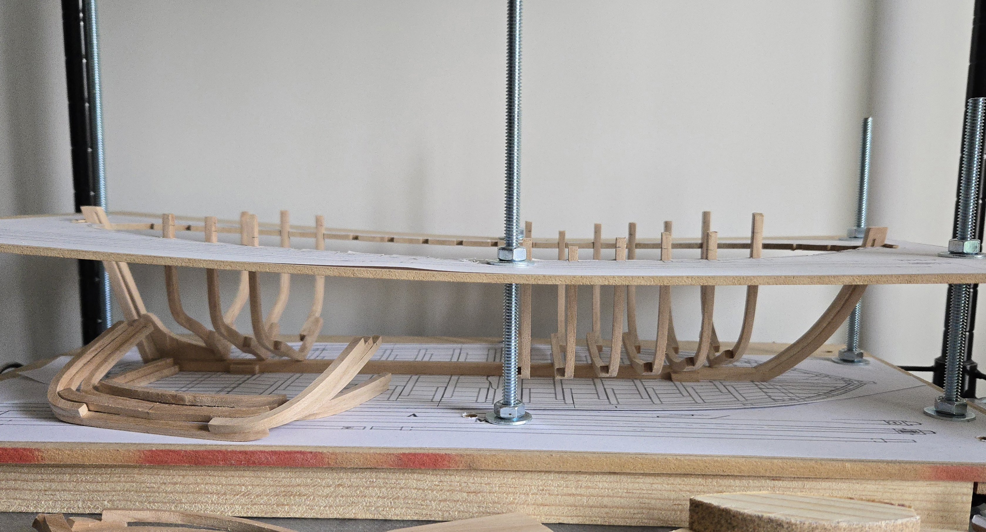

I decided to start with the aft cant frame pair D, as they've already been shaped. Gluing them in place was a bit tricky: I used the 3-2-1 block to again provide a vertical surface, and used a clip at the top to keep the frame from dropping too low.
The result looked nice!

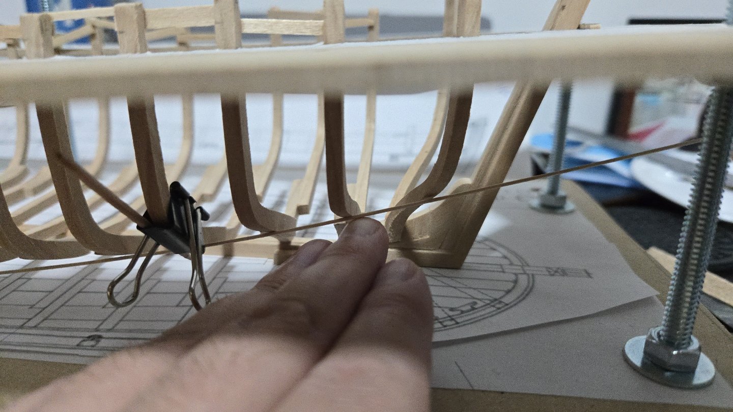

However, I then decided to check the fit with a batten. It's a bit tricky to tell, because the hull hasn't been faired yet and I don't really have a very effective clamp to hold the planks to the frames, but the cant frame seems to be a bit too low, forcing the plank to bend down in a way that goes against the preceding curve (not to mention making it much harder to bend the plank back again to meet the sternpost.
So, I think I need to unglue the D frames and reglue them just a hair higher up.
Also, I clearly need some more effective clamps before I get to the planking. How do people clamp onto POF hulls?
