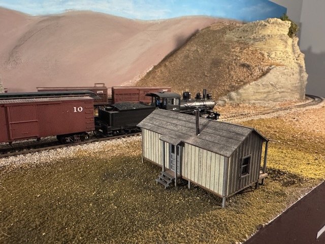

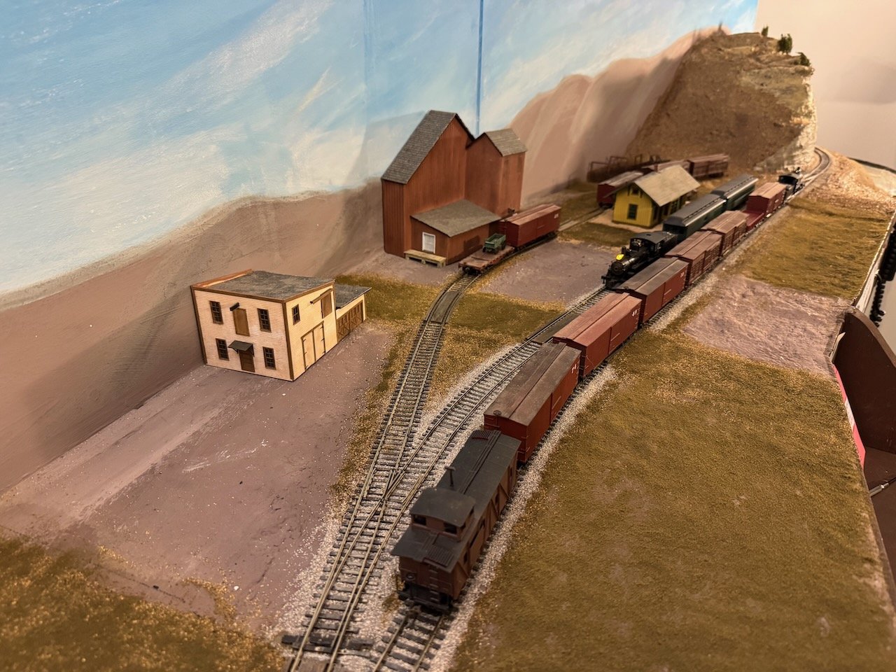

Apologies for ghosting this log. Summer has continued to push us hard, with relatively little persona time. I do have two updates to write up, the shorter of which I'll do here, the longer of which I'll need more time for.

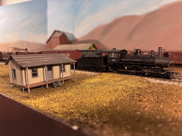

I've moved forward with a bit more scenery work, mostly laying down base layers in the eastern part of town. Here's the current status:
This is trying to replicate the pattern clearly seen in historic photos, of the depot area having a much lighter layer of ground cover (some form of sand/gravel) than the rest of the area. The foreground area will become a rough farm field; much of the area south of the tracks was functionally in the river's floodplain and had small farm plots on it. You can also see that I've filled in the road east of the depot and added a rough version of the stock pens along the spur behind the depot. Here's a photo of this area in the early 1900s.
A couple closeups: here are some of the grade crossings, laser-cut wood castings that I weathered.
And here's the stockyard part of the spur.
Both the road and the spur's ballast are finished with sand from my local stream, sifted to a grain size I want. The stockyard is a cheap plastic modular kit; down the road I'll want to rebuild this from scratch using wood, but I had this sitting around, and adapted it to fill the space for now. At some point I'll use an airbrush to do some weathering on it.
This all continues to look like Montana until I get more vegetation on it, but that's down the road yet. But at least I'm slowly moving forward with filling in the blank surfaces with something at least resembling scenery. Thanks for sticking with me on this! Look for a longer post at some point on my first test runs of an operating scheme for this town.

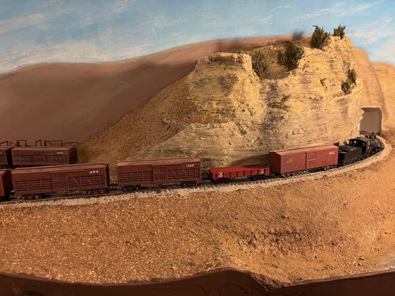

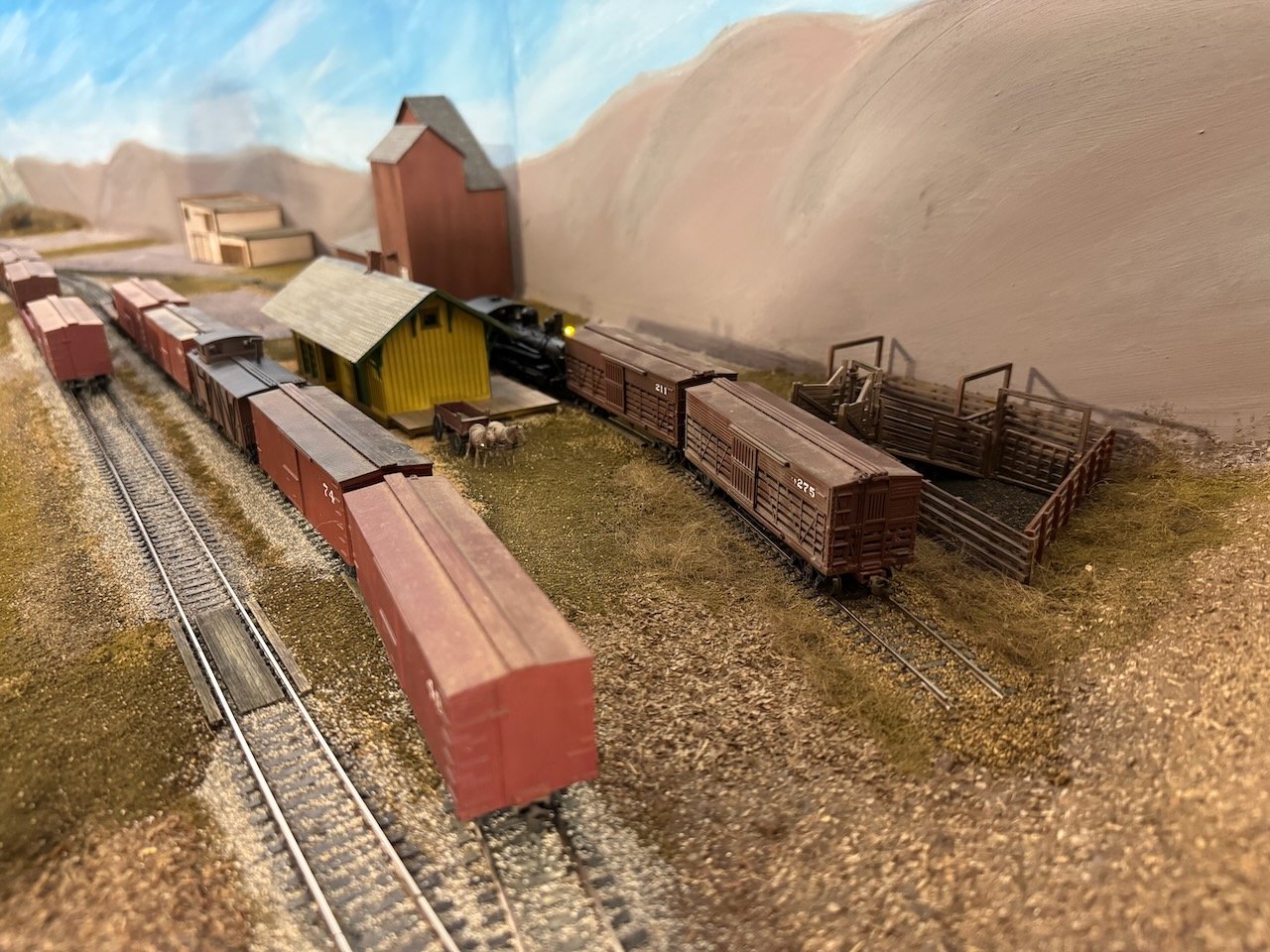

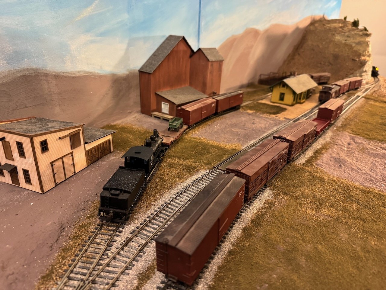

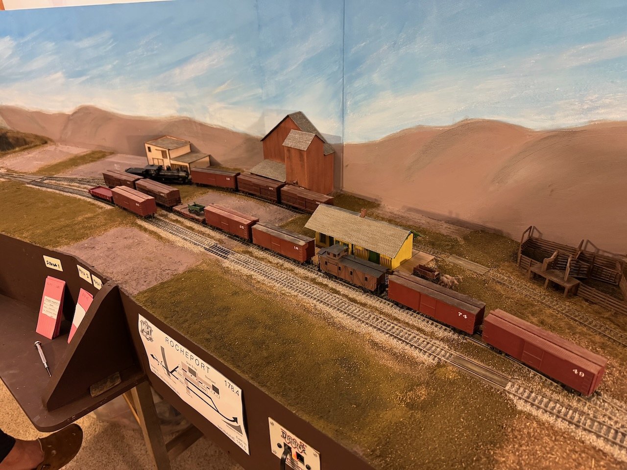

OK, so things have progressed enough that over the last month or so I've run a few test operating sessions in Rocheport. I put a lot of thought into designing the track plan and the operating scheme for this layout, and the early results are that it's paid off as things are really working as I want them to. I could go really deep into the weeds of all sorts of planning details but that's not of primary interest to most of you right now. What I'm going to do here is an illustrated walk-through of a single local freight coming into Rocheport, doing all the switching necessary, and then heading on. This is the basic concept of an operating session, bringing an actual train into town and doing real railroad work in a way that's reasonably similar to how a real railroad would do it. I can't post video so you'll have to make do with the images below, which I took in sequence while Mrs. Cathead and I ran this session together. You'll have to imagine the sound-equipped locomotives as they huff and puff and whistle their way through the work. Also, keep in mind that scenery is nowhere near done and I have a lot of buildings left to complete, so town looks rather emptier than it should.
Leading off, an eastbound seven-car local freight arrives through through the tunnel from the yard at Franklin, where its cars were previously dropped off by through freights that don't bother stopping at dinky little towns like Rocheport:
Already in town are five cars waiting to be picked up: an empty gondola that had delivered coal to a local dealer, a boxcar loaded with grain from the elevator, a boxcar  behind the depot that both dropped off and picked up small shipments (the UPS truck of the 1900s), and two stock cars loaded with livestock from local farms and ready to be sent to processors in St. Louis:
Our locomotive starts to break down its train and sort cars for delivery. It's easy to just pick up all the outbound cars and take them back to the yard, but how do we know where each inbound car goes?

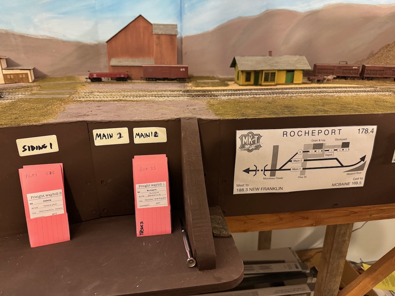

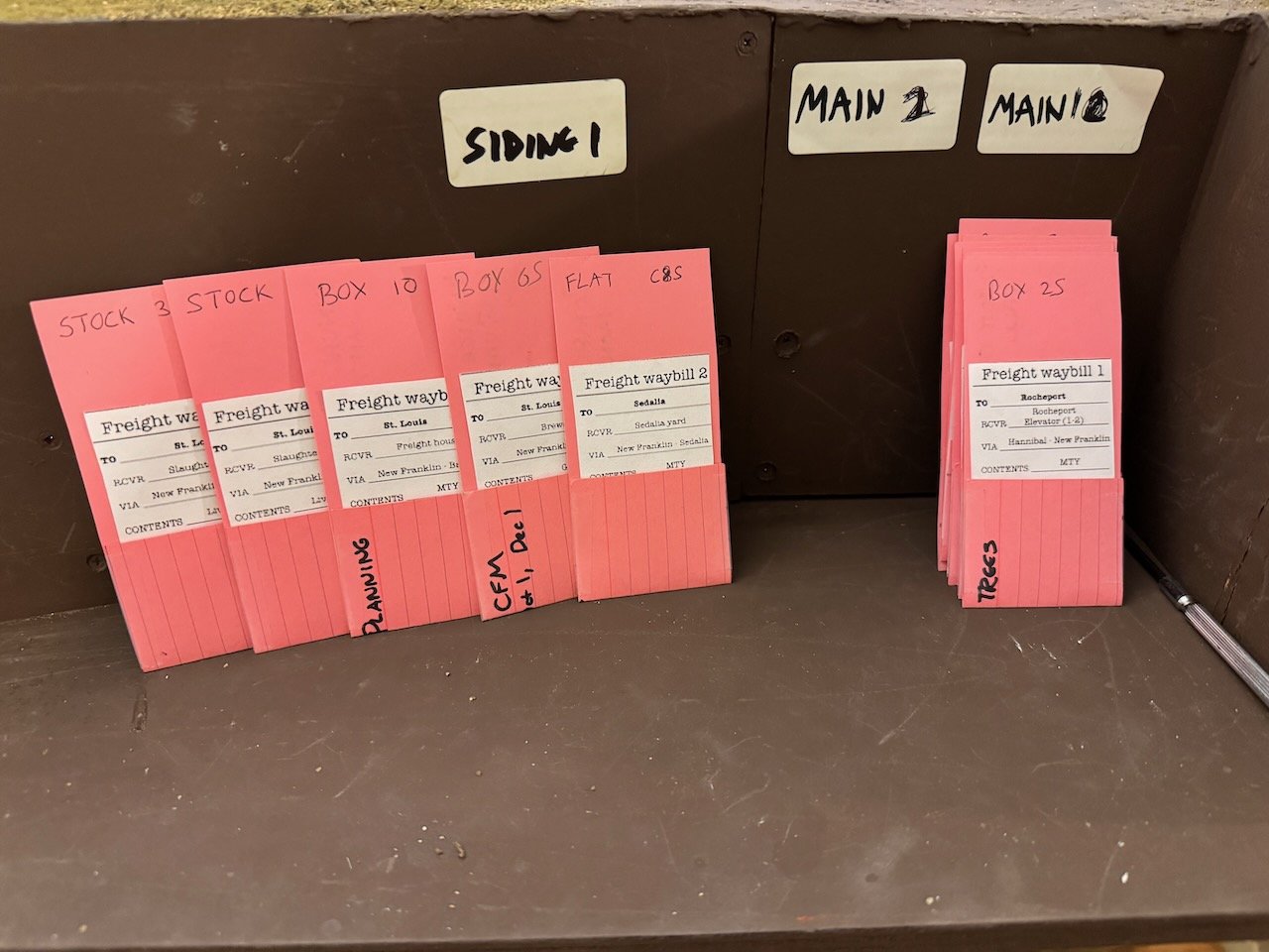

The answer in this scheme is the car card and waybill system, very common in model railroading. What's presented here is a rough version I mocked up for testing purposes; I'll make better ones later when I'm satisfied.
The pink slips are car cards, each of which represents a physical car on the layout. The waybills are little printed slips of paper that slide into a pocket on the car card, with information on where the car originated, what it's carrying, and where it needs to go. Back in Franklin, the yard engine would have switched all these cars onto the same track based on their final destination printed on these cards, and here in Rocheport, other printed lines tell us which cars are destined for Rocheport (vs other towns down the line) and which exact destination they go to.

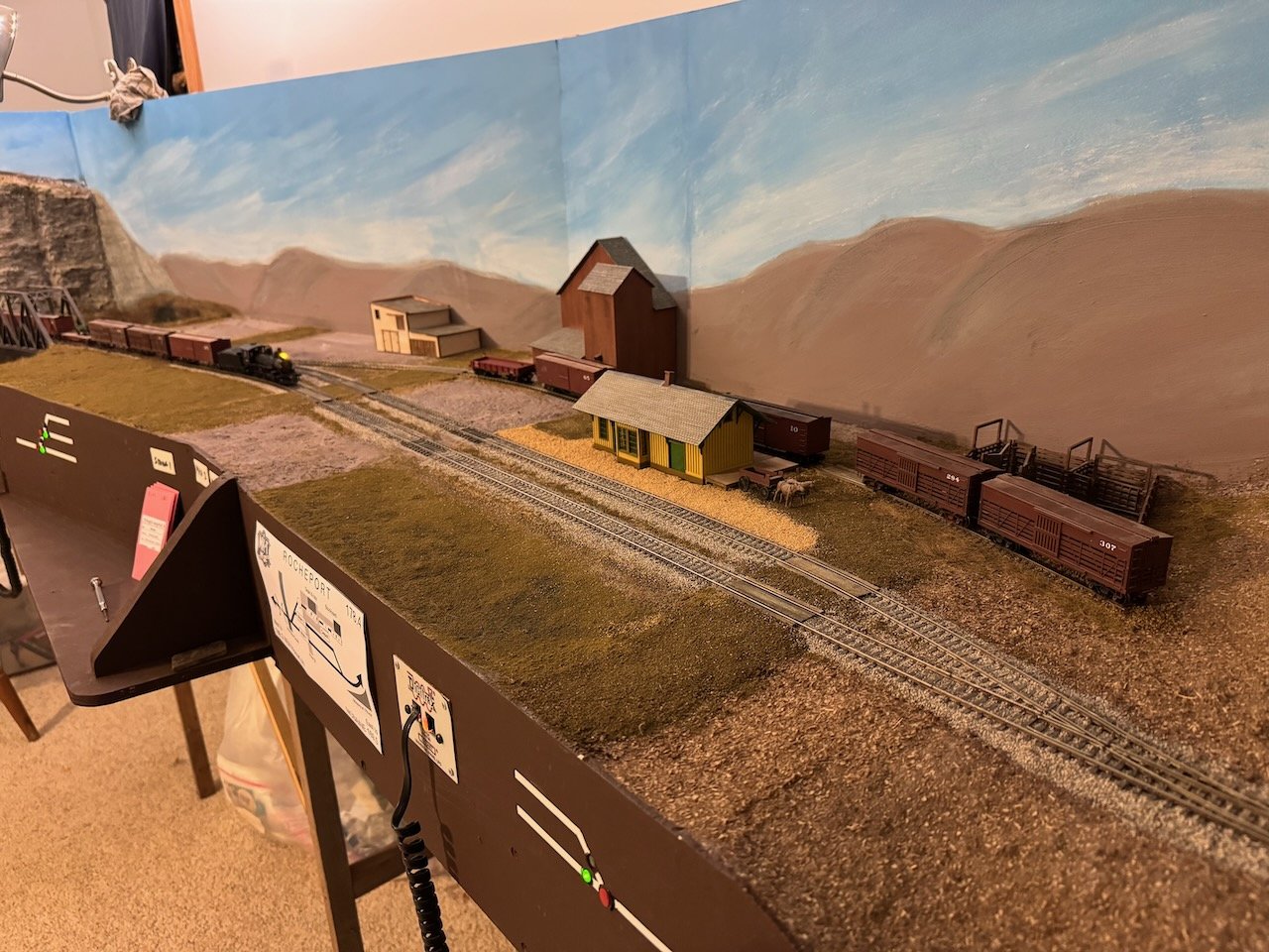

I also drew up a railroad schematic for Rocheport, which shows operators where each track is, what its official name/number is, where different car destinations are, and other relevant geographic features. Using the waybills and this map, you can figure out where any car is or where it needs to go. The numbers in the corners are the actual railroad mileposts. If you go back a few photos, you'll see this hanging on the fascia where it's easy for operators to consult.
There's a little shelf hung from the fascia right in the center of town, where operators can sort and read the car cards and waybills as they do their work. This "desk" is a key featuring in making operations functional. Here you can see how it's laid out. Right now each track just has a cheap label, in front of which the car cards are stacked based on which track the cars are on. Soon those will be converted into little sorting boxes that will better hold the cards separate.
With that explanation out of the way, we'll follow our freight as it switches this surprisingly complex little town. But I'll do that in the next post.

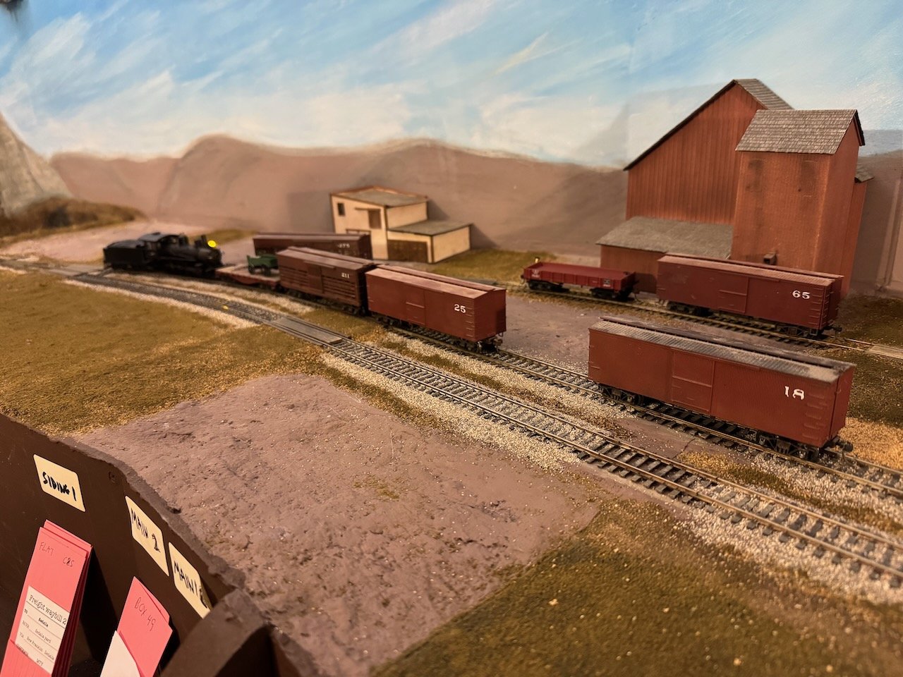

OK, let's get to work. Our locomotive is going to start by sorting all the inbound cars into the right order for shoving into this siding. In some cases this pre-sorting might have been done in the yard to make the road crew's life easier, but that didn't seem to happen today, so they're all jumbled up (more busy work in the real world, more fun work for us). Below, we're using the near end of the siding as an extra place to stash a car while we sort things out.
Keeping an eye on our MK&T timetable, we know we have to clear the main line for an express passenger train soon. So everything gets shoved out of the way while this passes through. One change I made from the real Rocheport is to designate the track nearest the depot as the passing siding, and have the main line be the track away from the depot (on the real thing the main line was in front of the depot). The actual reason for this is complicated and has to do with how best to arrange turnouts in this condensed scene, but there is real-world precedent for having a depot on a passing track. In my case, I can argue it makes sense because only slower locals stop at Rocheport so this lets faster expresses barrel right through on the outside track.

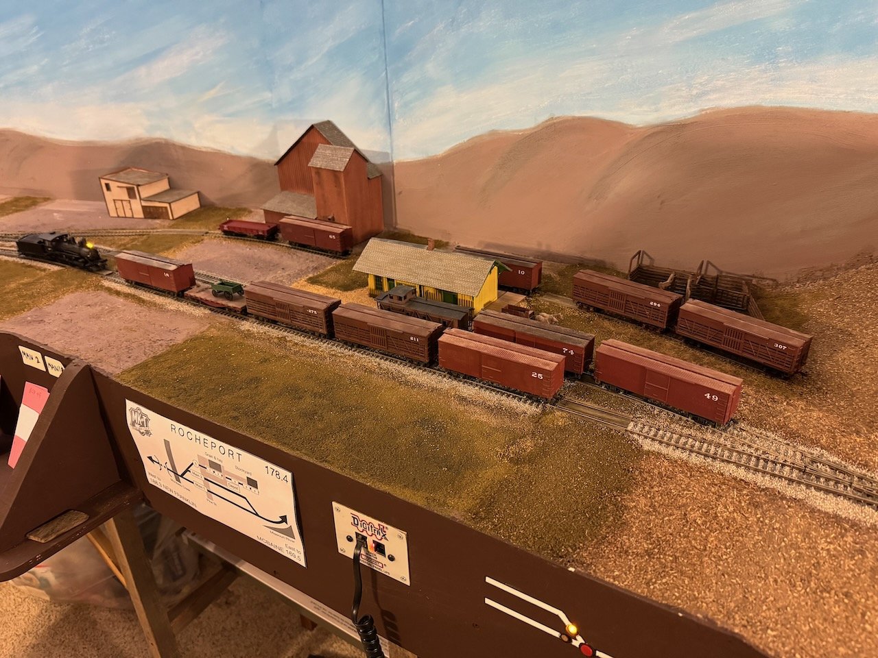

Once all the inbound cars were sorted, we pulled all the outbound cars and started spotting inbound cars. Here the locomotive is shoving two empty stock cars toward the stockyards. Cars 74 and 49 in the foreground are going to a different town than Rocheport, so will just be left out of the way with the caboose until we're done.
And another angle on that move, shoving the stock cars into the siding.
And the final placement.
With those cars shoved into the far end of the siding, we can place the other three cars at the western end. Here the locomotive is shoving in a boxcar of small freight for the depot, an empty boxcar for the grain elevator, and a flatcar with a new wagon for one of the local implement dealers. You may recall from an earlier post that all the businesses listed on my waybills are real ones found in the railroad's business directory, adding to the sense of realism.

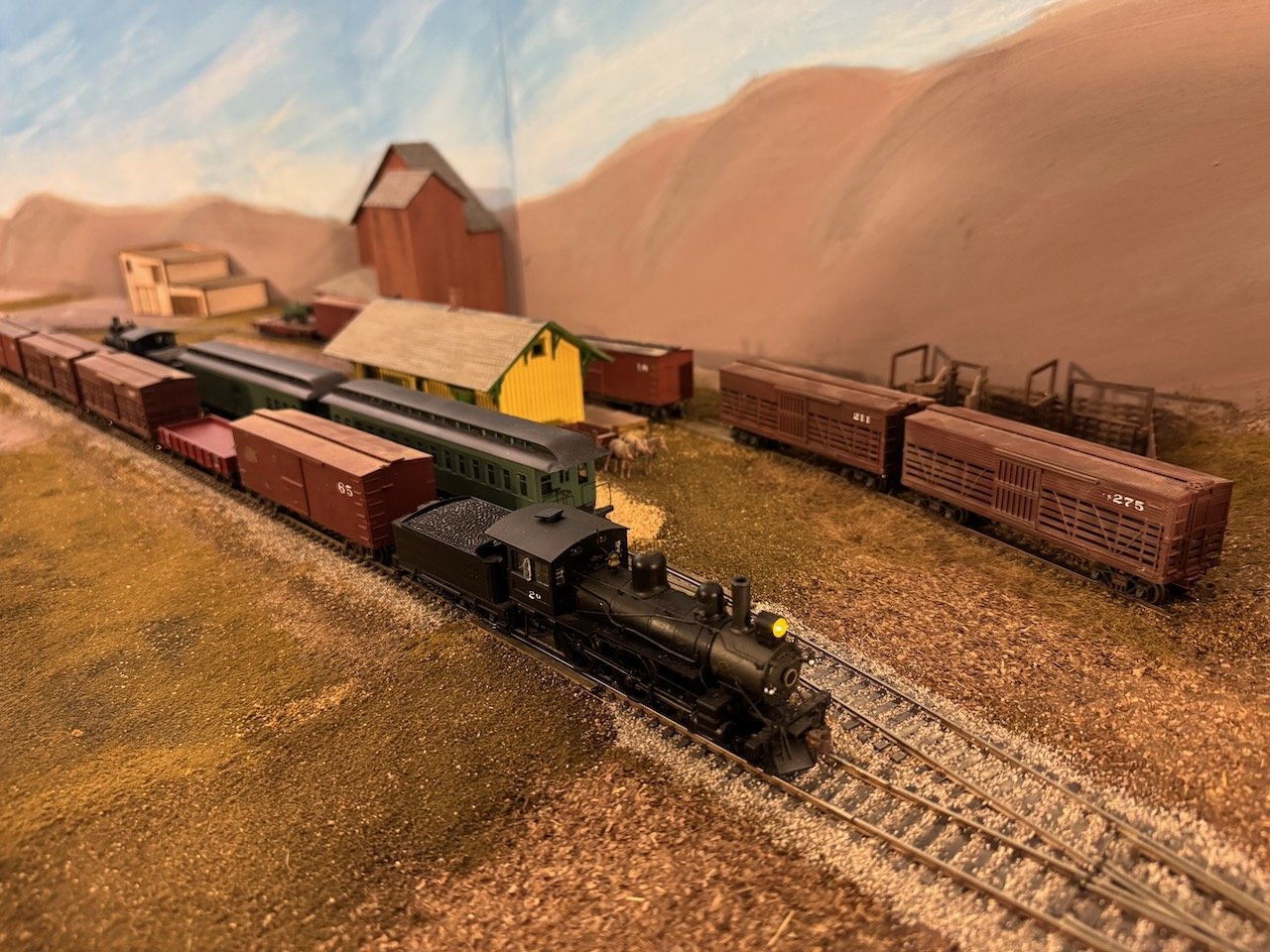

With all the inbound cars spotted, it's time to reassemble our train. Five outbound cars and two more to take to another town before returning west to Franklin. Let's grab that caboose and those two cars and stick them back on the end of our newly pulled five cars.
Tacking the caboose and two final cars onto the rest.

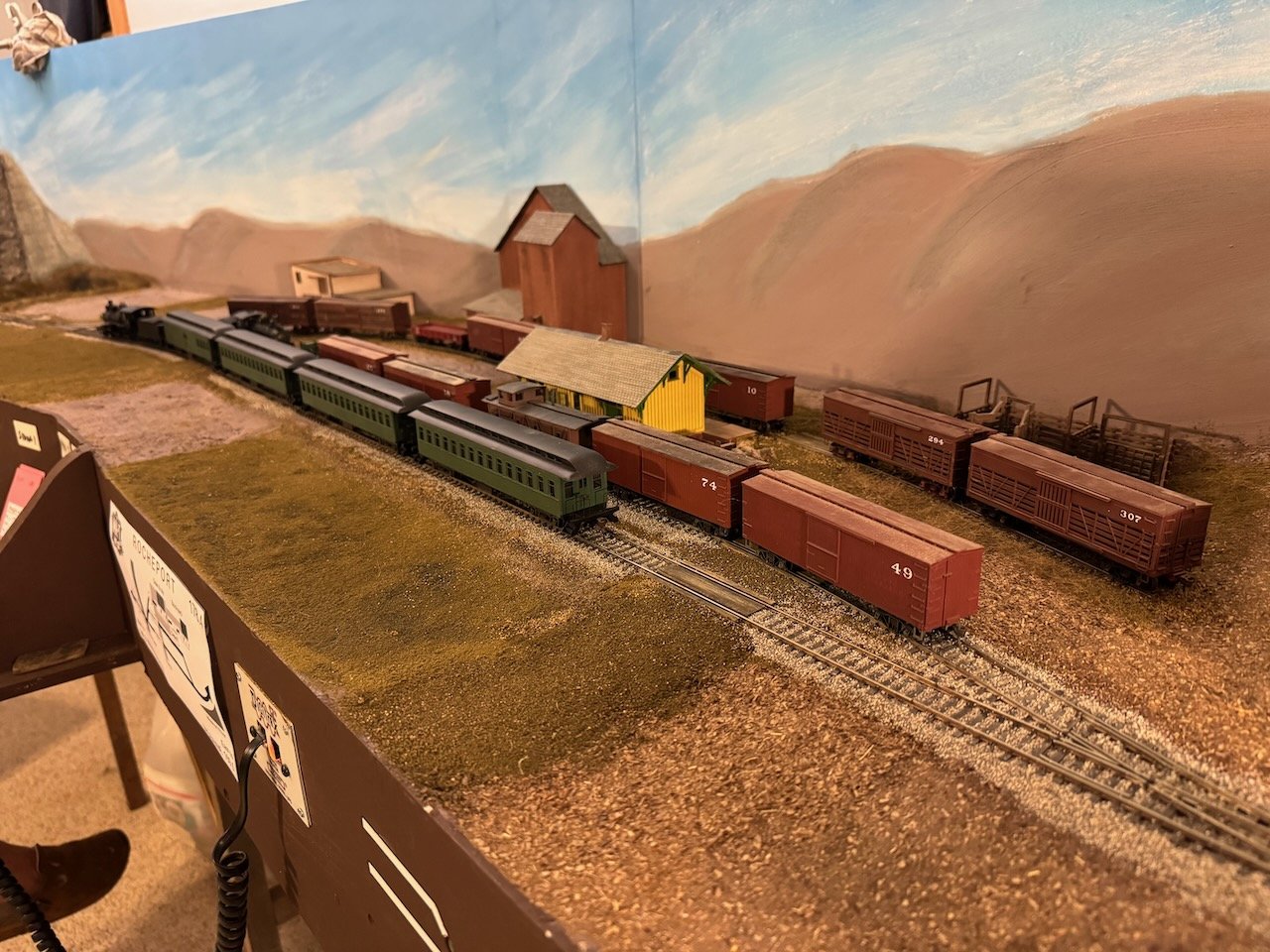

Our train is reassembled, but we can't leave yet, as there's a local passenger train due. We were smart enough to reassemble our train on the main this time, so the local can pull into the passing siding in front of the depot.
Another view of this meet, with the short local at the depot and the longer freight ready to depart eastbound.

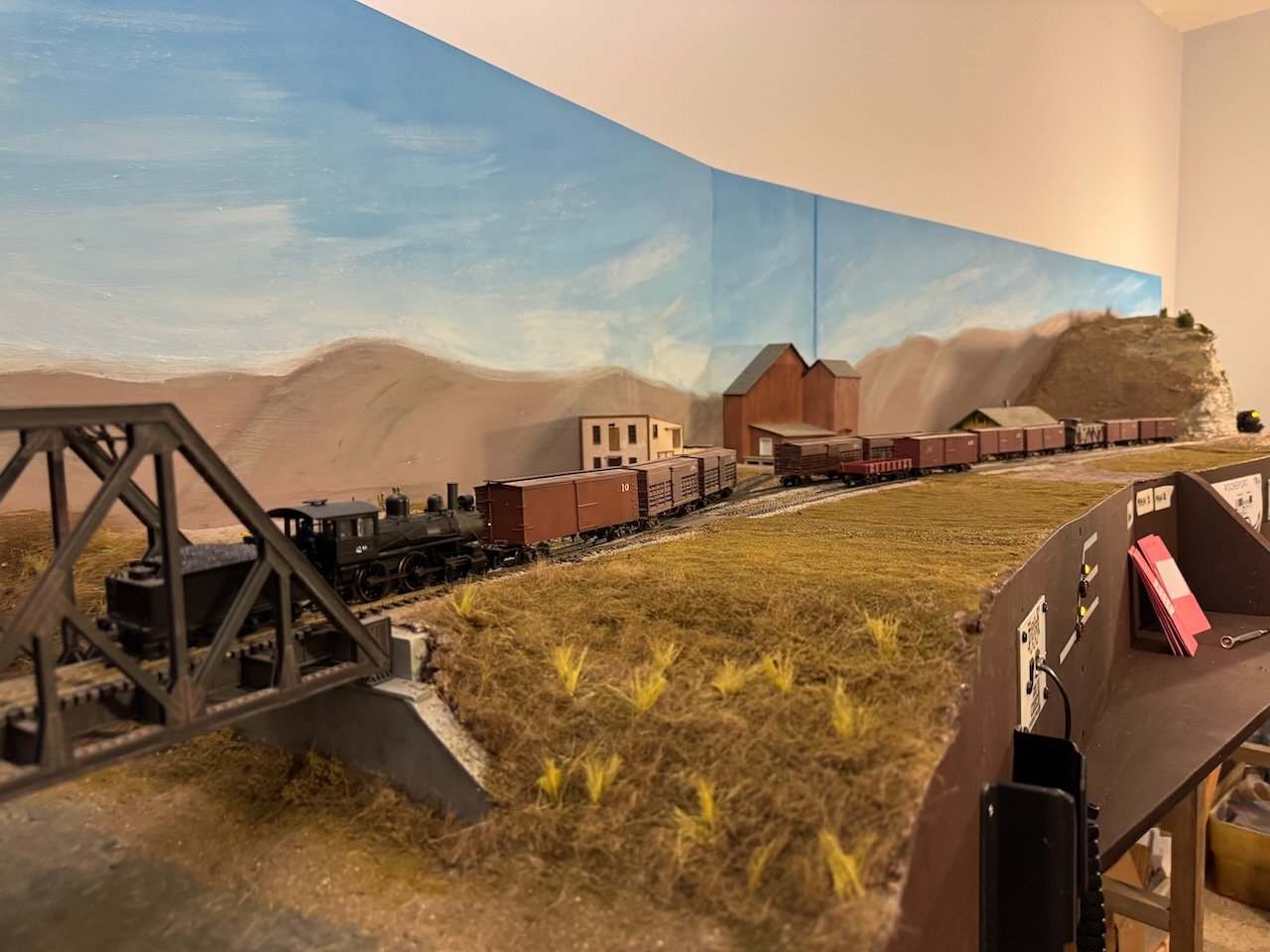

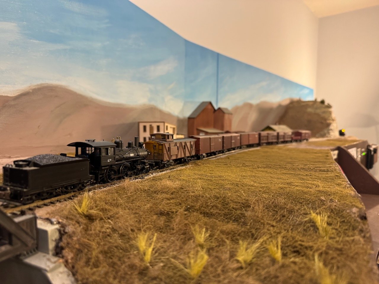

Our freight heads east along the river bluffs...
and our passenger local heads west toward Franklin.

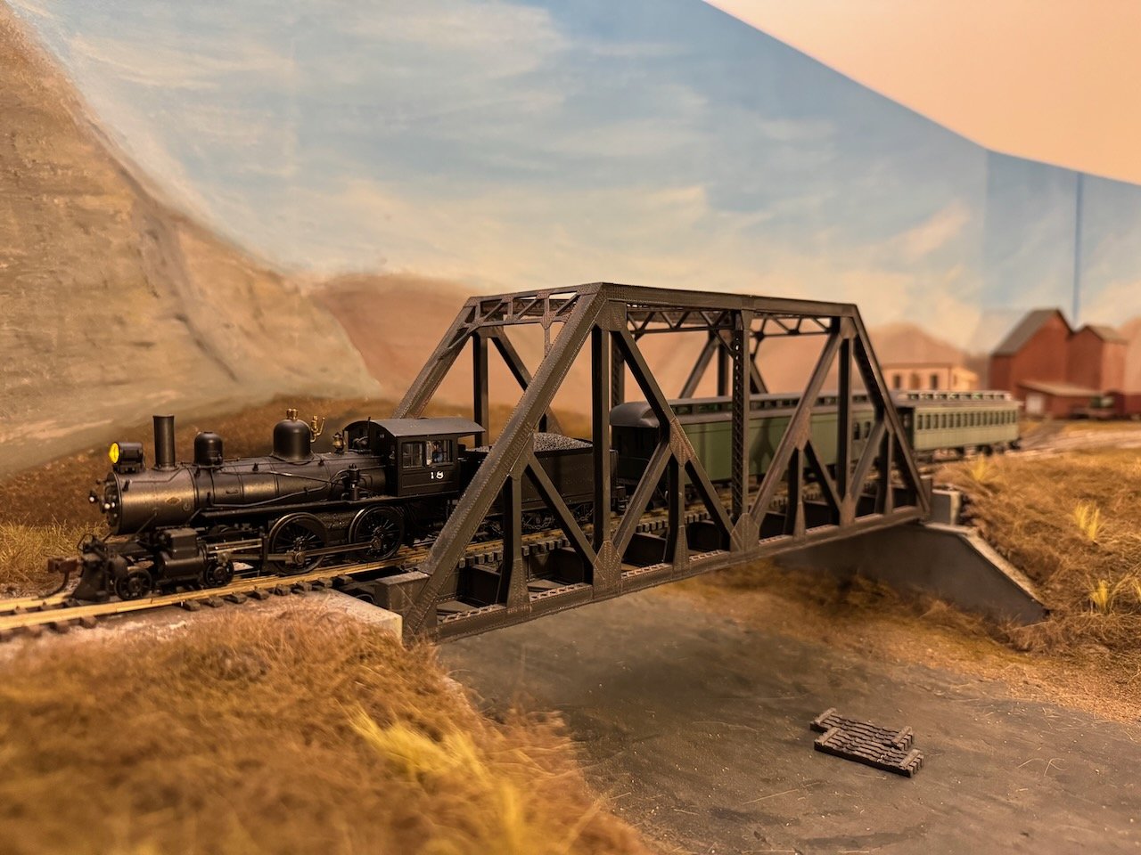

The last pic of the train passing through the bridge is quite picturesque.

How do we know where to set out cars? Here are two examples of waybills. There's one per freight car, and they slide into a pocket on the car card so that you can only see the top half (we'll get to the bottom half later).
The first one tells us we have a car headed to Rocheport, on consignment to a wagon dealer named W.W. Scobbee (a real Rocheport dealer at the time). See that "1-1" after the receiver's name? That tells us the car needs to be delivered to Rocheport's siding (1), spot [1], as shown on the diagram above. That's because this dealer doesn't have his own trackside warehouse, just receives individual shipments now and then. So this needs to go to the team track, where this fellow can pick up his new wagon.
The second one tells us that this car has shipments for two different general merchandise dealers (again, real Rocheport businesses), and this one goes to spot [3] at the depot, which handles crated items like these (hand tools, canned groceries, clothes, whatever).
Both cards also tell us that the cars came from St. Louis' Baden Yard, brought to nearby Franklin yard by a through freight, where they were sorted onto the local freight that brought them to Rocheport for final delivery. So what happens when it's time to pick up these cars? Between operating sessions, we flip the waybills over in their car card pockets.
Notice how the first ones had a big 1 in the upper right corner? That tells us this waybill brings the car onto the layout to its destination. When we flip these over, we get a 2, which tells us that now we're in the second part of this car's movement, sending it back off-layout to some other destination. For example, if we'd loaded an empty boxcar with grain at the elevator, it might be destined for a mill in Chicago or St. Louis. In the cards above, both cars delivered a product on their first run, so they're now empty (MTY) and are being sent back. The merchandise boxcar at the depot goes back to an MK&T freight house in St. Louis, and the empty flatcar goes back to a yard in St. Louis until needed for some other job. In both cases, the local freight takes these back to nearby Franklin yard, where an eastbound through freight will pick them up and take them to St. Louis.
So each waybill creates a realistic set of shipping/movement directions for each car on the layout, lasting for two operating sessions. Now let's summarize how this worked in practice.

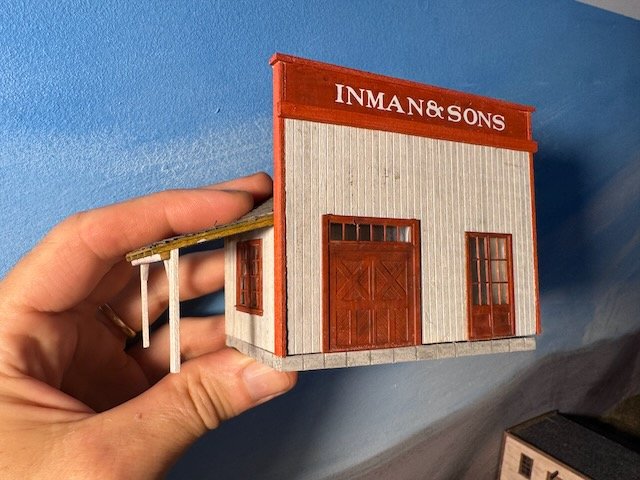

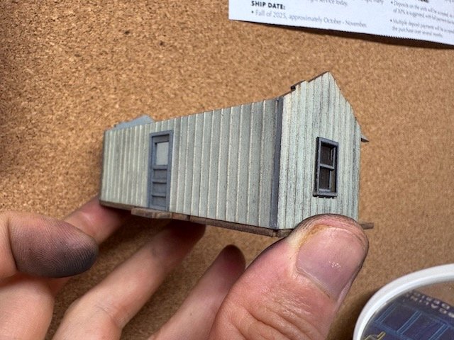

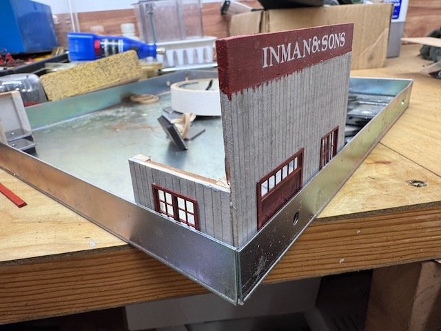

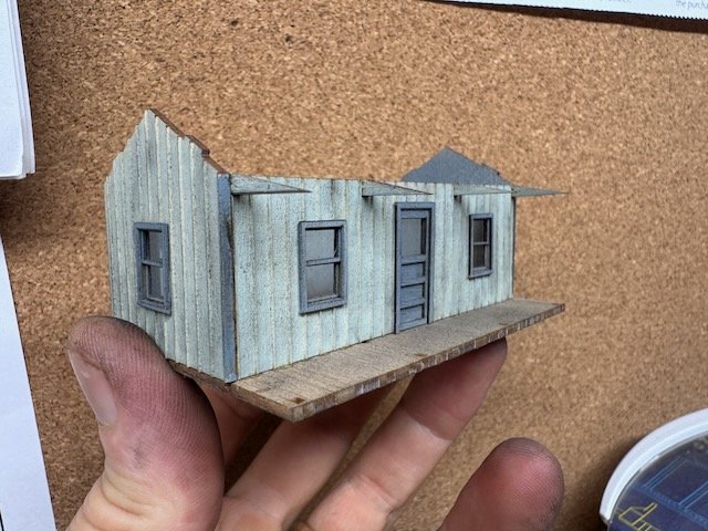

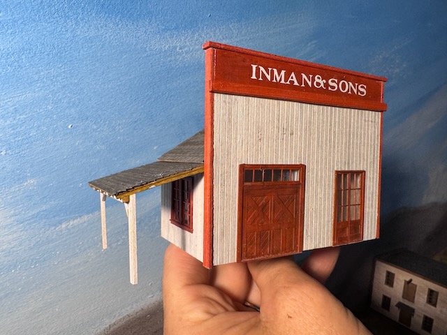

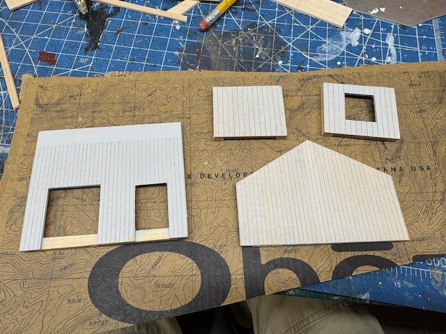

Time to go back to some actual traditional model building! I need lots of buildings to fill out the town, which will be a mix of scratchbuilt and kit-built. First up is a simple scratchbuilt background building. I zoomed into the depot area In the historical photo below (from the State Historical Society of Missouri). See that row of small false-front buildings across the street from the depot? Those fall right on the line of my backdrop, so I need to make a few shallow-depth buildings to fill in that space and convey the feel of that district. I'm not worried about reproducing them exactly, I just want to capture the right feel.
I have a distinct visual theme in mind for Rocheport. This was a prosperous time, overall, with the railroad having recently come through. So I want my buildings looking reasonably well-kept and in some cases fairly new. I'm not going for the decay-gothic look so common in model railroads. I want this to feel like an old but prosperous town. That being said, there are different districts. The core business district off to the west should look especially prosperous, while these smaller buildings near the depot should be a bit rougher, and the riverfront area across the tracks (foreground) should be noticeably poorer if still not run-down. Keep all that in mind as I describe this and future buildings.

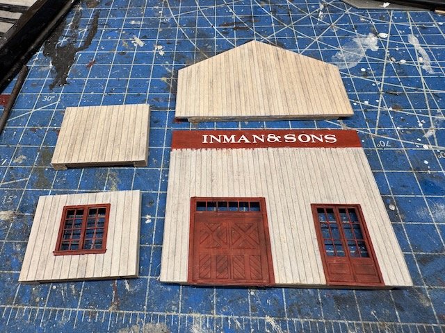

First I drew up a basic design and cut out the constituent walls from the scribed wood sheets I had on hand for just this purpose. These were given several light coats of grey primer, both to seal the wood somewhat and to simulate a coat of paint. Back wall at lower right is after one coat, front wall at lower left is after two coats. The primer color is almost exactly what I wanted (a faded grey-white) so I didn't bother with actual paint. Plus, this maintains a hint of wood grain that I like.
Next I did some gentle weathering of the walls using pastels applied with a thin brush. Working plank by plank, I subtly varied the colors help the planking stand out. In the photo below, the front wall at top hasn't been pasteled yet, while the back wall at bottom has.
I then painted the door and window fittings I dug out of my scrap back, and lettered the top of the false front using dry transfers. It's really hard to line up individual dry transfer letters perfectly, and if I could do it over again I'd use a little more space on either side of the ampersand. But the slight unevenness also brings to mind a small business's hand-painted lettering, which does fit the setting.
You can't easily tell here, but I gently distressed some of the wood to give a hint of peeling paint. Not too much, just enough for subtle visual effect in person.

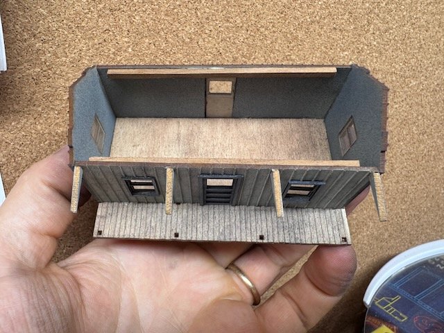

Time to assemble the building. I used my magnetic square jig for this, which both holds walls square and uses strong magnets to lock pieces in place while glue dries.
I haven't mentioned it yet, but all the walls have interior bracing to make sure they don't warp. I did this early on, prior to priming.
Overhead view of the assembled walls and interior framing. I don't intend to show the interior of this so made no effort at detailing. This is a background structure that will be partly hidden behind the depot.
And the assembled walls from the most common viewing angle. Notice the slight bleeding of red paint into the planking, which I don't care about because a piece of trim is about to be installed there.

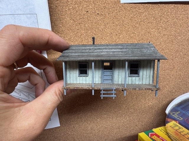

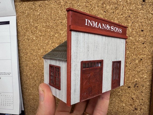

Time for the roof. I braced thin sheets of wood cut to size, then applied pre-made trips of paper shingles. Several manufacturers make versions of these. They're slow and fiddly to apply but I love the results. These also get some light pastel weathering to vary their appearance.
Rear view. This goes up against the backdrop.
Front view.
Not quite done, I wanted to add a lean-to overhang on the left side for added visual interest. This was pretty straightforward and I didn't photograph the process. I forgot to add earlier, the name comes from that railroad business directory I wrote about a while back. Inman was a real merchandise business in Rocheport with ties to the railroad. I made it Inman & Sons so the name would stretch more across the false front, and decided this is probably a small furniture maker or other such manufacturer, who might be getting small loads of hardware and supplies (nails, hinges, paint, glass, that sort of thing), which is why being located right behind the depot makes sense since that's where small loads like that would be delivered. This kind of business isn't big enough to have its own dedicated slot on a freight spur. It just gets crates from the depot.
And here's the final structure loosely in place on the layout. It and its future companions will help line the street behind the depot nicely, obscuring the backdrop transition and bringing a sense of busy-ness to the depot district. Go back and refer to the opening photo to remind yourself what this is representing.
So that was a fun little project. The building going next to it is a laser-cut kit, so that'll provide a fun comparison in methods and results.
Thanks for reading, and hope you enjoyed this return to actual model-building!
 That's one neat little building, Eric. I like it a lot!
Eric,
The Inman & Sons building looks great.
Your comment about the Sign's lettering size got me wondering if American 'shop fronts' also included the products sold (eg furniture) on the front signage, as well as the proprietor's name?
Googling that thought for some imagery ....
https://www.google.co.uk/search?lr=&sca_esv=b4f5d26490e949a3&as_qdr=all&udm=2&fbs=AIIjpHxU7SXXniUZfeShr2fp4giZ1Y6MJ25_tmWITc7uy4KIeioyp3OhN11EY0n5qfq-zENwnGygERInUV_0g0XKeHGJRAdFPaX_SSIJt7xYUfpm-75lA8Uar42yNWdqGuJlUAnl4VoyIc9TvIZo00AnzLuo73CKalUXQ8cWgmottQs4BXh0bU9aRqLPpzWejdabGFvk-MuP83mUuK41Ro6dMLX7Czip9A&q=19th+century+shop+front+american&sa=X&ved=2ahUKEwj99Mupl-qPAxXPQkEAHbyIPHwQtKgLegQIFxAB&biw=1376&bih=731&dpr=1.4
...seems to produce a 50:50 split....some did, some didn't. That might possibly be related to whether or not the business was public facing or 'business to business' ... or both eg public facing needs to suck in passing trade so giving as much useful info as possible in the sign is a big help. Whereas B2B doesn't need that.
Richard
Nicely done scratch-build. 👍
If I might add, since I've been zinged about this myself. :blush:   Most structures should have some kind of foundation, lifting it above the terrain. Could just be planks of wood, running around the base. And some dirt, etc. just above the base. Mud splashes and green algae buildup.
Ken
Started: MS Bounty Longboat,
Great question, I had actually given this some thought; guess I should have discussed that! I decided not to list a specific business for two reasons.
  1. Laziness. I just didn't want to hand-letter "Furniture makers" or some such in an even smaller font unless I really had to! Especially for a background/backdrop building. Leading to the next point.
  2. Flexibility.
    1. Even though in my head it might be a furniture maker, why not leave it a bit more open in practice? Maybe it's a cooper's shop instead? Since, as you say, there's precedent for just the owner's name, I decided that worked fine in this case.
    2. You can argue that in a small town like this, everyone knows everyone and their business. And this isn't so much a walk-up business like a grocer or clothes shop, so they're not as concerned with drawing casual passersby. Essentially versions of your B2B point.
    3. In the railroad's business directory, virtually every business was simply listed by owner's name, not any further clarification other than the general category. For example, under "general merchandise", they just listed J.B. Challis, H.R. Harris, etc. rather than something like "H.R. Harris, dry goods" or "J.B. Challis, grocer".
    4. Finally, defining it too specifically doesn't alter operations; you don't need to know exactly what that business is to accept that crates of goods are arriving at the depot for it. It's the depot operators need to recognize, not this little background structure.
I will likely be putting more details on buildings that are more day-to-day public retail (bank, grocers, etc.). Later, I could also change my mind and make a separate sign saying "Furniture makers" or the like, and hang it over the door.
You two are on top of things! It actually does have a foundation, I just didn't photograph it. My goal is to install the foundation permanently on the layout to allow scenic material to overlap up to it, while the building stays removable. Same plan for most of my other structures. This lets me integrate scenery in without risking staining the building. I was planning on presenting that when I did the scenic install work, which I haven't done yet.
But since you asked, here it is with its foundation loosely held in place. Most of this will be hidden by overlapping scenery and by a partial wooden walkway. The overhang is just a storage area where I'll pile stacks of lumber, barrels of nails, etc., so it'll just have a gravel base.
Thanks for the attention to detail and thoughtful questions!
And one more building done this weekend. This one was a laser-cut kit, so went a lot more quickly.
Basic airbrushed coloration, again just a low-key color scheme.
Assembling walls with windows, doors, and roof braces. Already weathered the walls the same way as the last building, using pastels and small brush. Wood porch, same thing.
The kit's wood is quite thin, so I added some braces to keep it from warping.
Basic tarpaper roofing, colored with pastels.
Finished building, with posts and chimney installed. No need for a foundation on this one!
And here it is in its rough intended location.
As discussed earlier, this part of town is meant to be a somewhat poorer district down along the river, which is a short distance from the fascia here. It's hard to see in the photos, but the scenery slopes down gently from the tracks toward the river. There will be a small general store type building across the road from this, also up on posts due to the location. Using this style building helps differentiate from the higher ground districts across the tracks, and implies the nearby presence of the river.
As much as I like scratchbuilding, I do enjoy a well-designed kit where someone's put careful thought into all the dimensions and fit and so on, so I can focus on the artistic side. If you're wondering, here's the kit: https://www.blairline.com/cohouse/ Blair Line is a small Missouri-based manufacturer and I'm happy to support them.
Thanks for reading!
