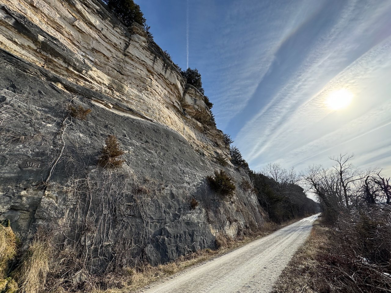

I had collected some chunks of limestone from along the real right of way, intending to crush them for coarse rock debris at the base of the bluffs along the right of way. But as I was hand-crushing these samples, I realized that the limestone was actually powdering quite nicely in addition to forming coarser rubble. So I made a point of finely crushing some of this material, then sieving it out to separate the rubble from the powder. The latter was perfect for spreading as extra-fine road material and also had just about the right color (of course!).
Here's what the new road surfaces look like. The right grey/tan shade, similar to but distinct from the railroad ballast, and finer in texture. Also stands out from the surrounding land without being too bright.

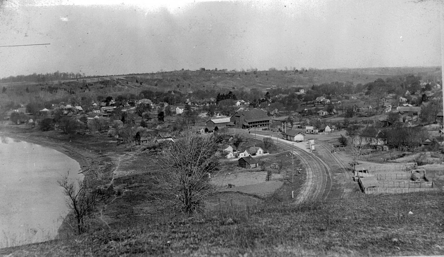

And here's the classic historical photo showing a few sheds east of the depot; I'm just shifting their exact location and purpose to suit my needs, as most model railroaders do:

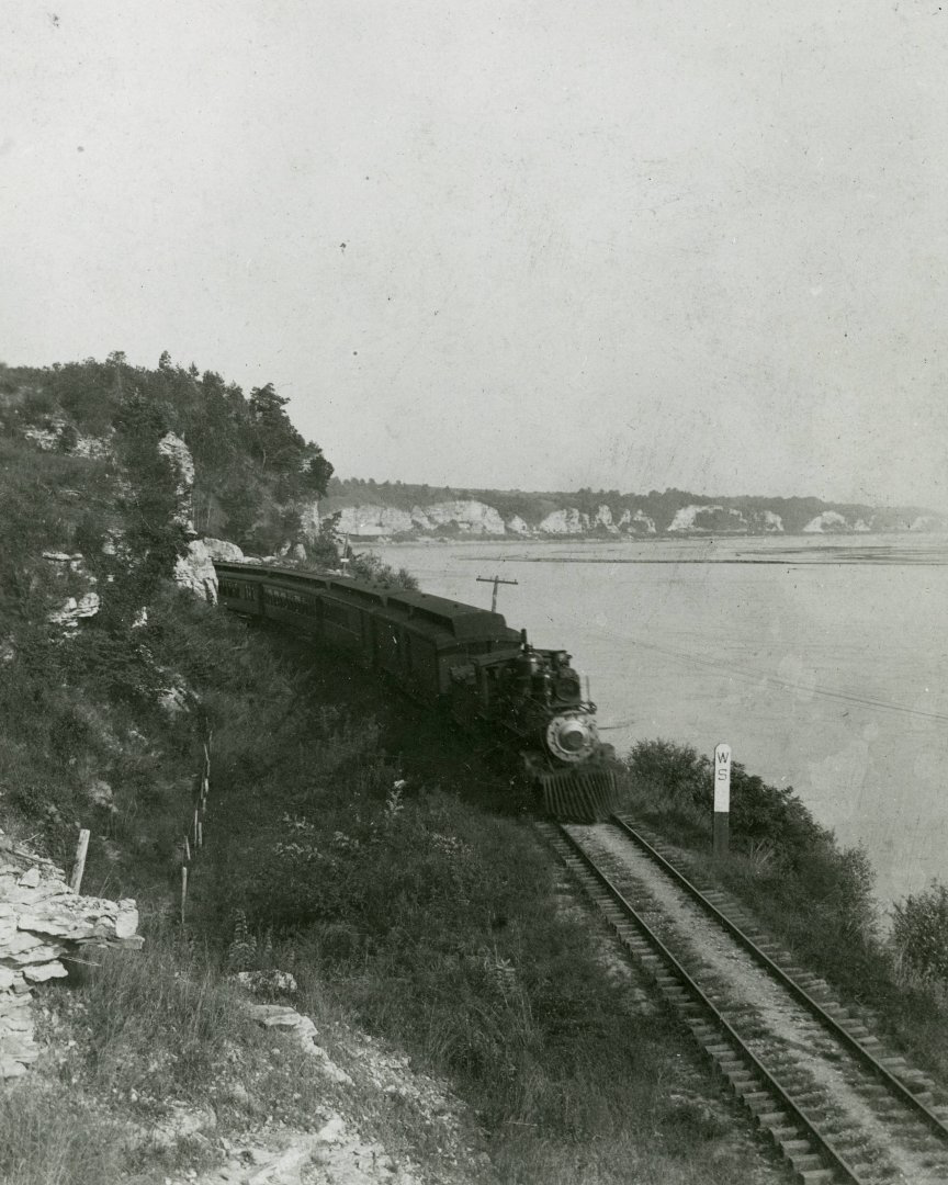

Great question, Keith. There were indeed telegraph lines along the right of way. In the photo from the west (marked up above) you can see them dimly on the north side of the tracks. But most of the time, they were on the south (river) side of the tracks, as you can see in the view from the east posted earlier (the curve near the depot), and this photo from along the river just west of Rocheport. So they must have crossed over once somewhere near the tunnel, then back over again somewhere before the depot.
But having them mostly on the river side, especially along the narrow corridors between river and bluff, is a problem for me. This makes sense for the railroad, as there wasn't really room along the bluff side of the tracks, where the rock faces almost literally overhung the rails. But if I added these accurately, they'd be on the aisle side of the tracks, making access to the right of way rather difficult, because anyone reaching in (to uncouple cars or even clean the rails) will find the telegraph lines in the way, and all but guarantee a damaging interaction sooner or later.
If this were just a diorama, I would definitely add them. But as an operating layout, my instinct is not to, because I think they'd be in the way. Regardless, they'd be just about the last thing I would add, as they'd also get in the way of any other scenery work, so I don't have to worry about it for now. They get filed away in "maybe someday final detailing".
Again, great question, and a good example of how an operating model railroad forces somewhat different thinking and decision making than a static display model.
 The poles I see in the photo run along the track that goes through town. I'm not familiar enough with the layout placement to know if these would fit into you scheme?image.jpeg.8505dadc9e25c58ca0fb1aeb1a5ce597.jpeg
Yes, those are the ones I agreed you could see on the north side of the tracks in town. But the problem is, they cross over to the south (river) side at either end of town and stay there along the river in either direction. So if I ran those north-side lines through town, what do I do with them at either end of town? It'd look ridiculous to just truncate them, but if they cross over they immediately get in the way and beg to be damaged by errant elbows.
See if this map/diagram helps. Remember that the aisle is in the river, so anything on the south (front) side of the tracks is directly in the way.
And I can't just keep them on the north side because there's not enough room between the bluffs and the tracks either to the west and east; the rock faces are right up against the track. Remember, this is what it looks like for long stretches of the mainline along the river:
The telegraph poles/lines (now gone) would have been on the far right of this photo, along the riverbank, where they'd be in the way of a god-like hand reaching in from the river!

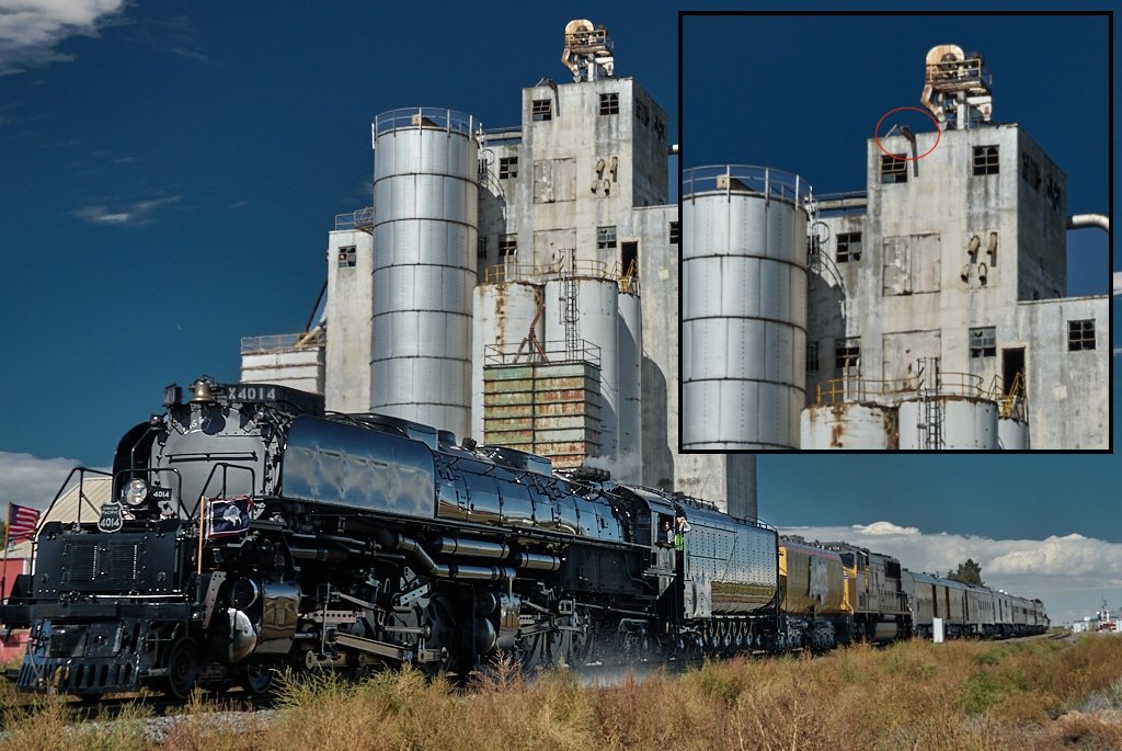

The very early discussion about grain silo doors to nowhere sent me down a rabbit hole for a while. This was especially after I looked at my own photo, taken last month, of Big Boy 4014 steaming past a tall, circa 1915, silo in Ault, Colorado. (A Unique Little Town). Sure enough, probably 40-50 high on the south side, are two doors, one above the other, going nowhere. Closer inspection revealed a steel girder protruding from the roof directly above the doors, clearly a spot where some rigging could be hung to access them.
The online discussion I found turned up several possibilities, as you guys did here, but nothing definite. Still a bit of a mystery to me. I realize this is an old hat discussion, but I found it all quite interesting.

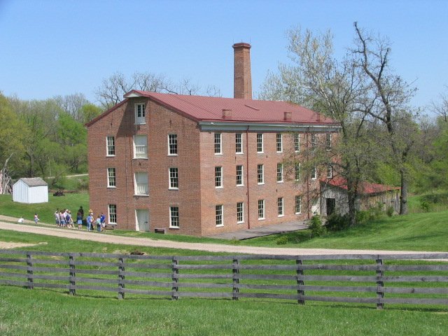

Here's a classic older example from Missouri, at Watkins Woolen Mill State Park (from the park's photo gallery, though I've been there many times). Look at the vertical line of access doors, overhung by a roof extension that housed support beams for whatever pulley system was used to hoist machinery to all the mill's different floors.
As discussed earlier, the commentariat convinced me that my elevator's doors weren't equipment access given the way they're not lined up and don't have any hoist housing above them. But the style of access door shown above is super-common in mills and similar industrial buildings and it's worth recognizing.
