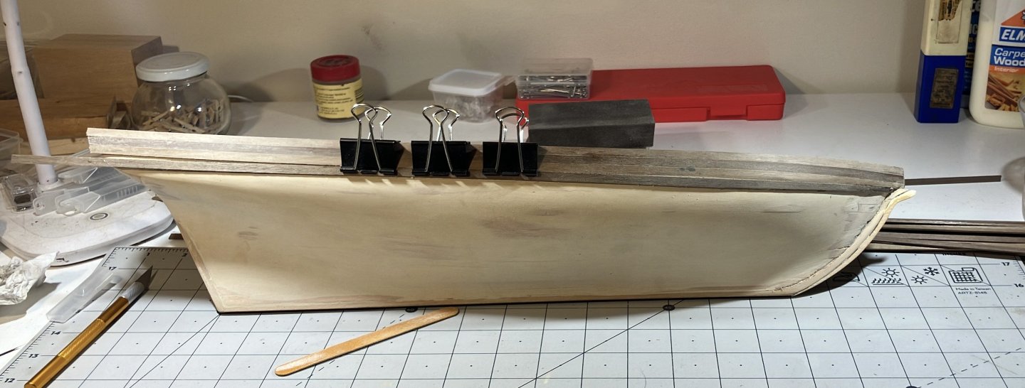

The planking is coming along nicely, I have made good progress on the one side. I was perhaps a little ambitious when I said I would finish this in one afternoon :) , I am taking my time and enjoying every minute of it:
I added a stealer strake to get me back on line while I was working up the hull. I should have done that on the one above it (towards the sheer strakes, the hull is upside down right now), because there is a gap. That strake will be coming off again:

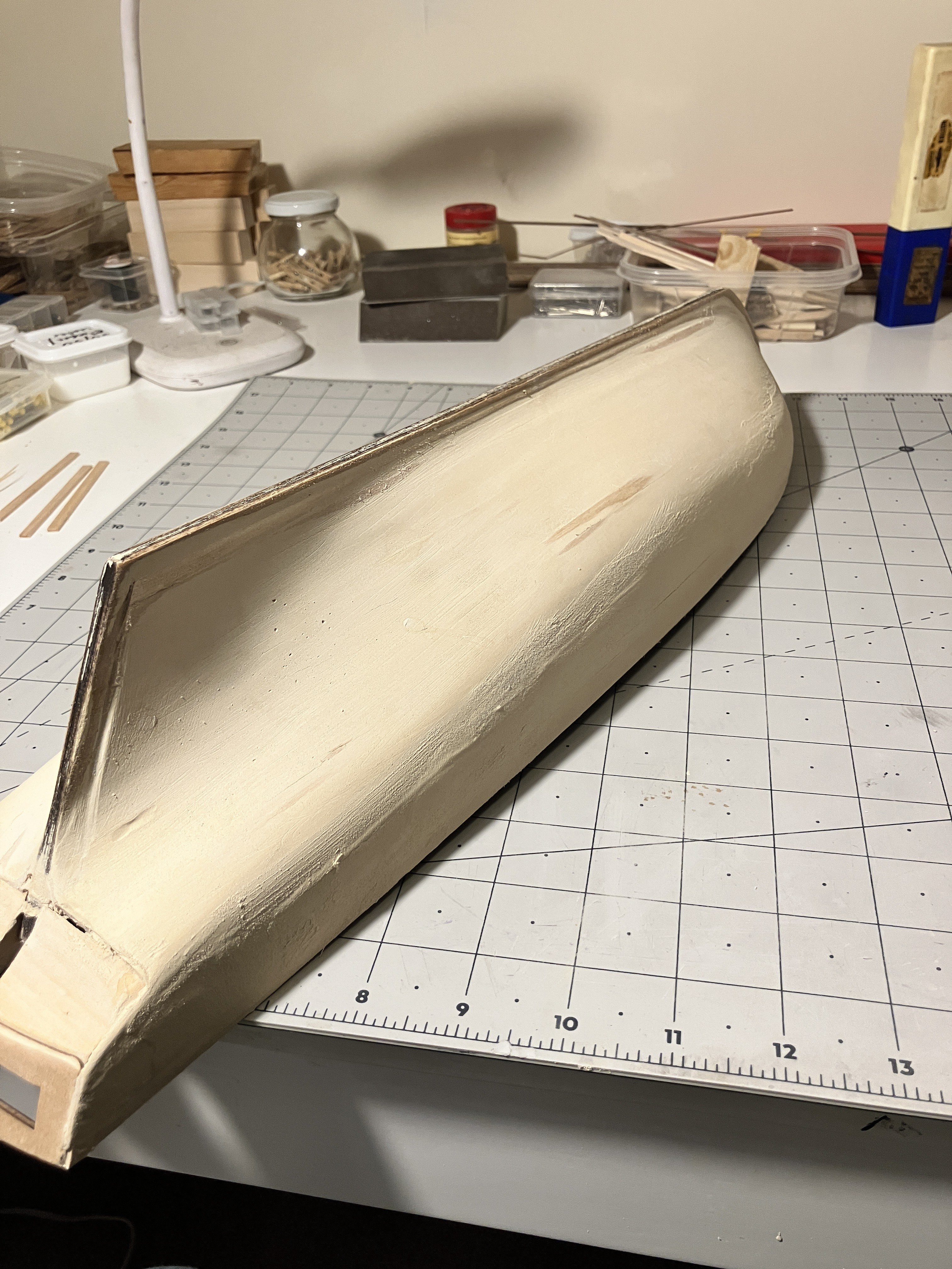

Good morning, folks. I managed to squeeze some time in the shipyard these past couple of days as things are slowing down now that the house is finally sold. The move, at least as far as I am involved, is complete and I no longer need to be running back and forth between here and DC. The other main job we were concerned with that was keeping me from my build was our deck at the back of the house. It was made with composite decking and the water was pooling on it quite badly when it rained. We had to remove all the boards, replace some of the joists and then refit new 5 1/4 decking planks. In effect I guess it was good practice for my deck planking on the build :)
Anyway, on with the build. I finished the first layer of planking and covered the hull with a fine wood filler before sanding the whole thing smooth to accept the second layer of walnut strips. I am not using the material that came with the kit because the quality of the wood in this kit really does leave a lot to be desired.

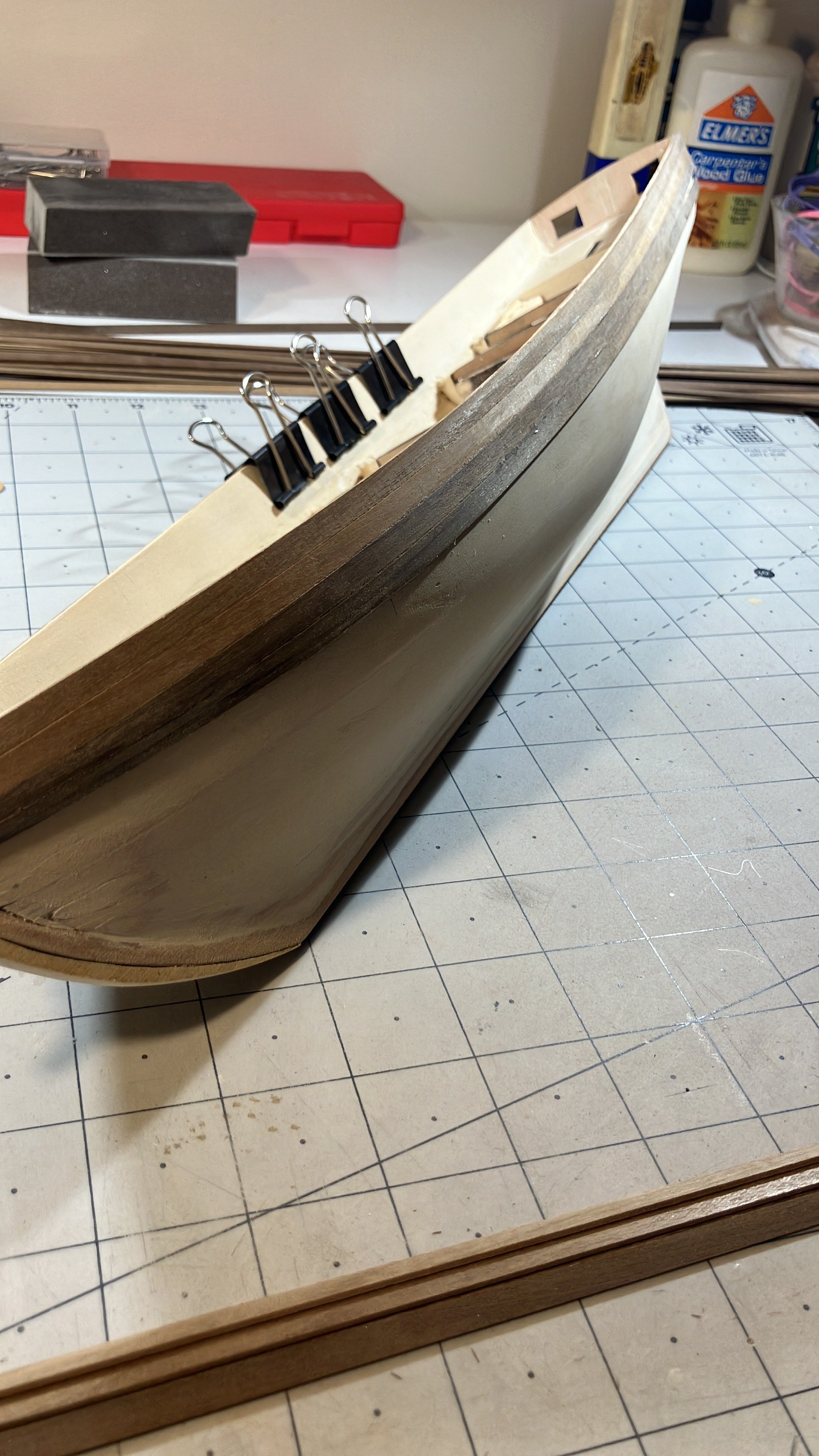

I then started adding the second layer:

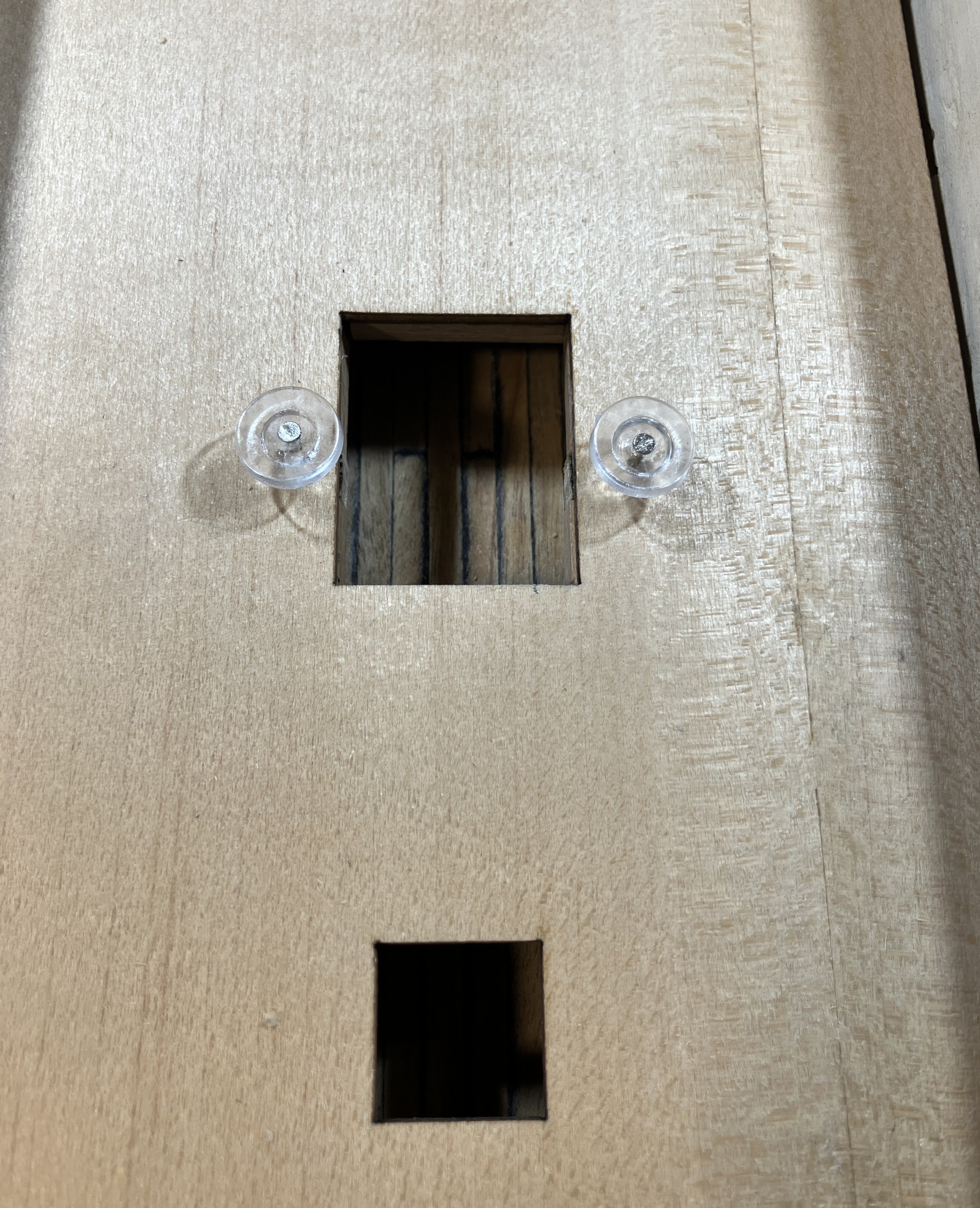

Because of the position of the deck hatches I had to adjust one of the deck beams so that it wasn't going across the middle of the hatch opening, that looked a little weird when I laid the false deck on. It looks better now:
