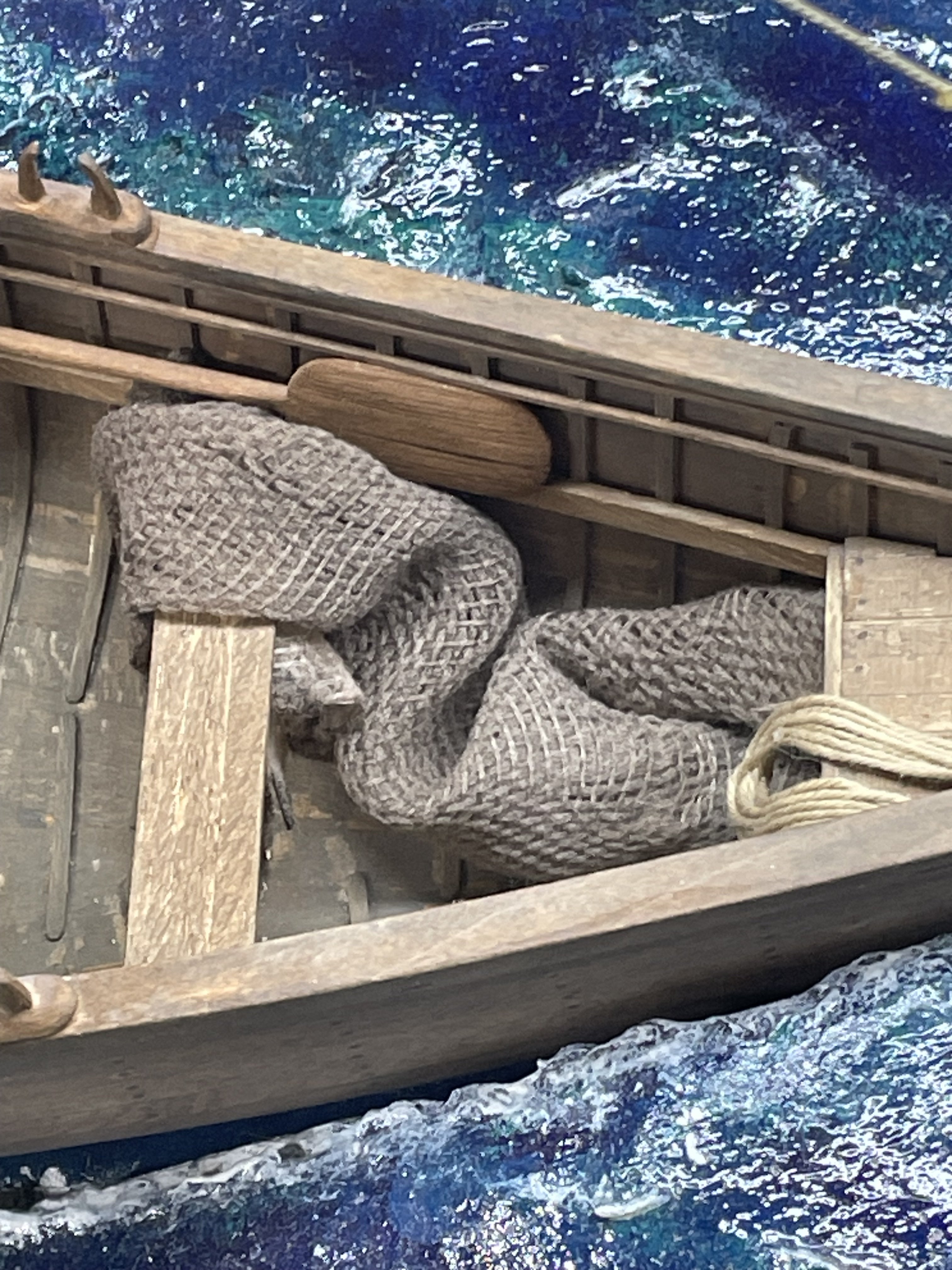

I’ve managed to find time enough to make a couple more extras. A fishing net I made from cotton gauze. Although it did have spongy threads going one way that makes the holes smaller.

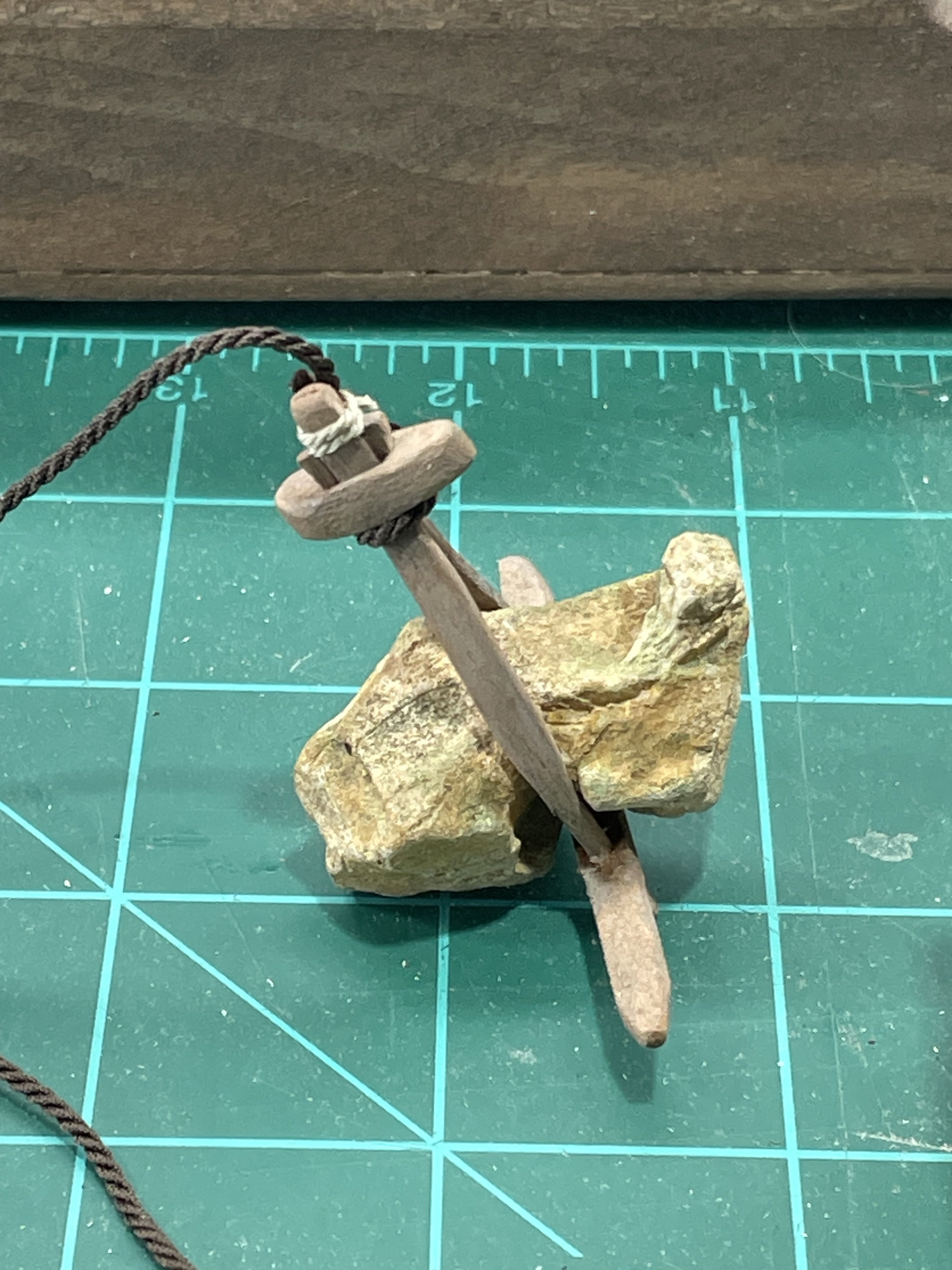

An anchor.
