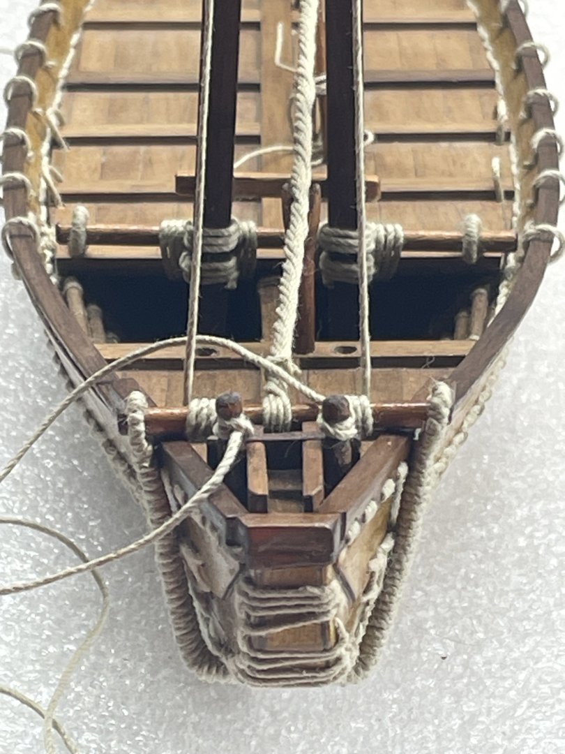

Thanks Bob:-)  the kit came with like 8 spools of thread:-) That one shot of the back of the stern shows more rope than wood:-) Next is about 20 standing rigging lines:-)

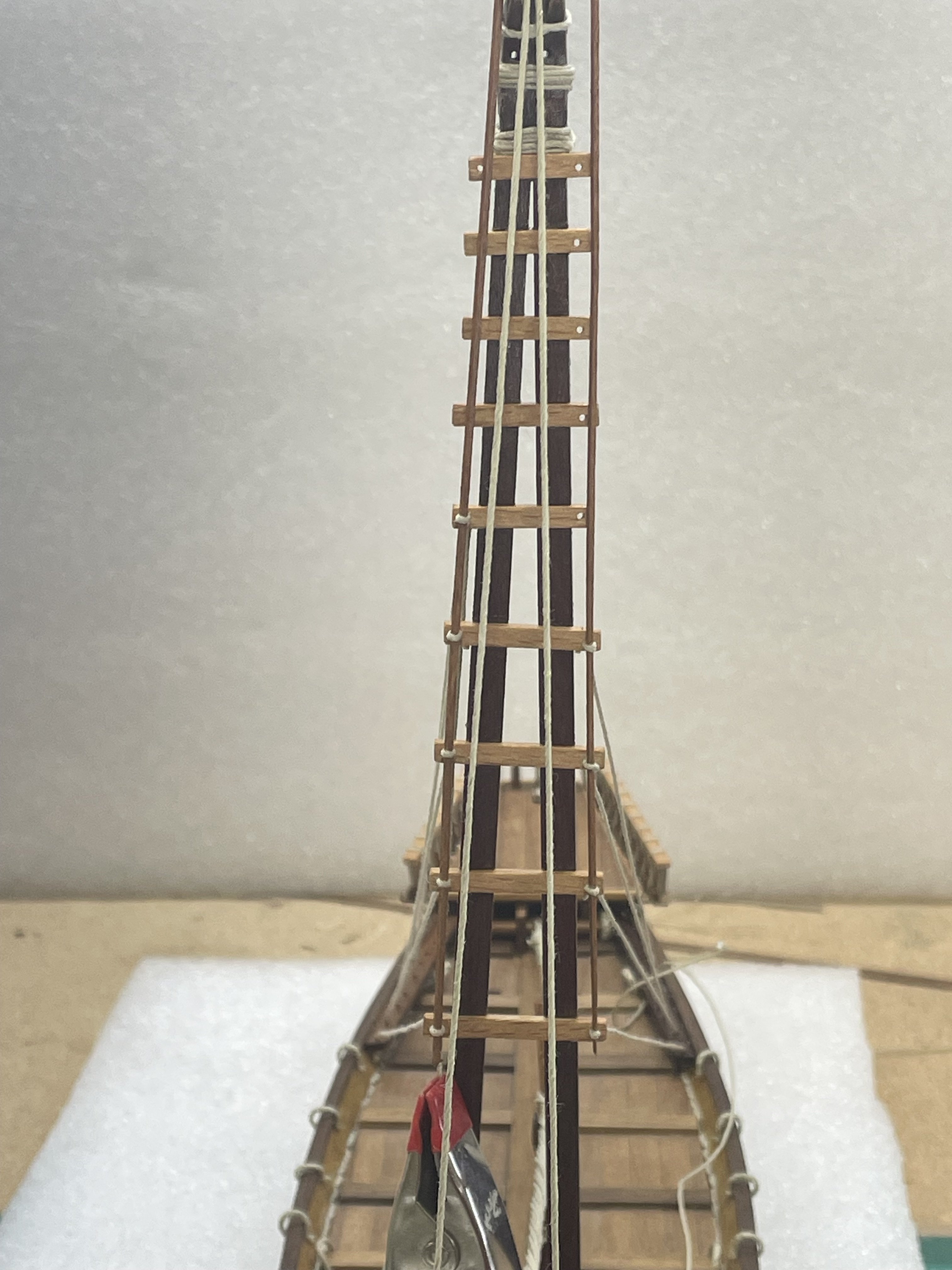

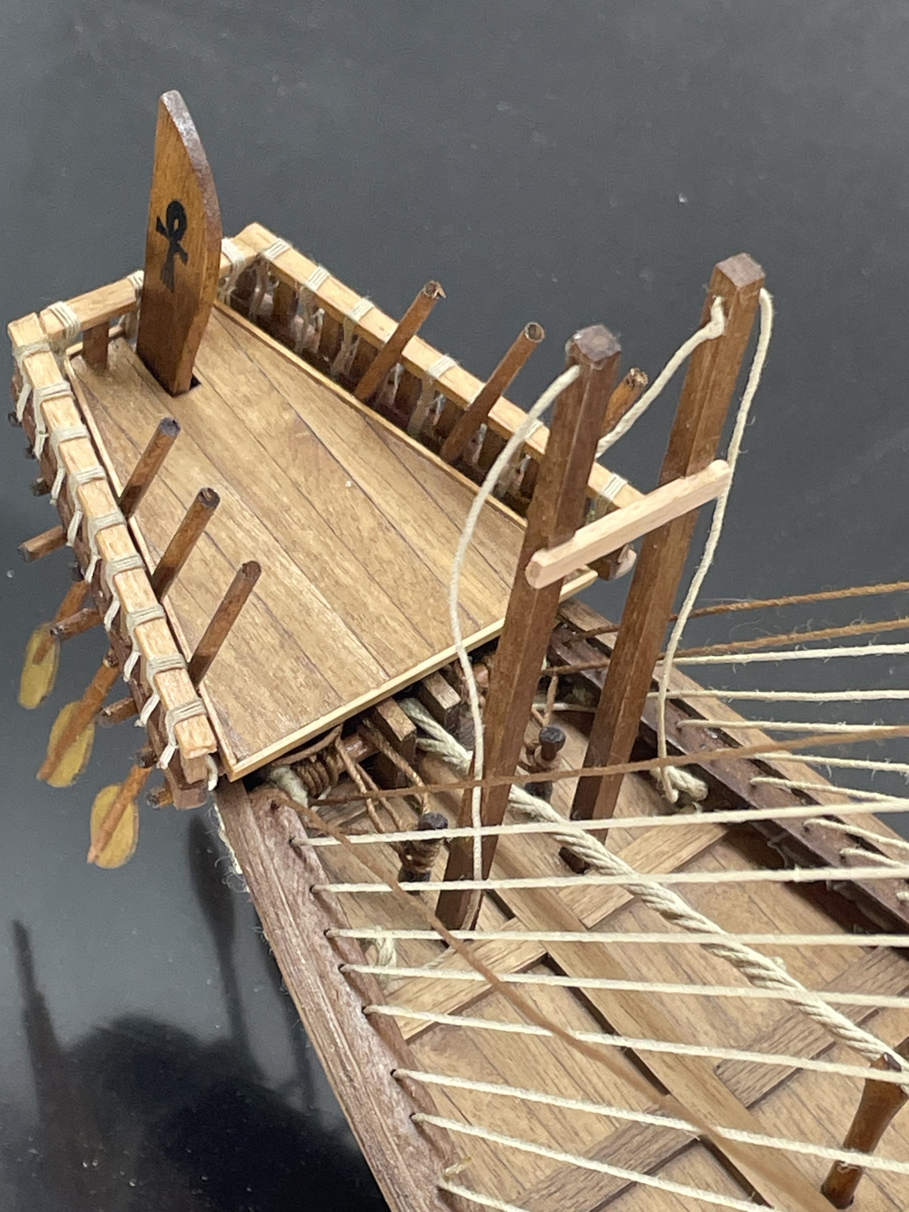

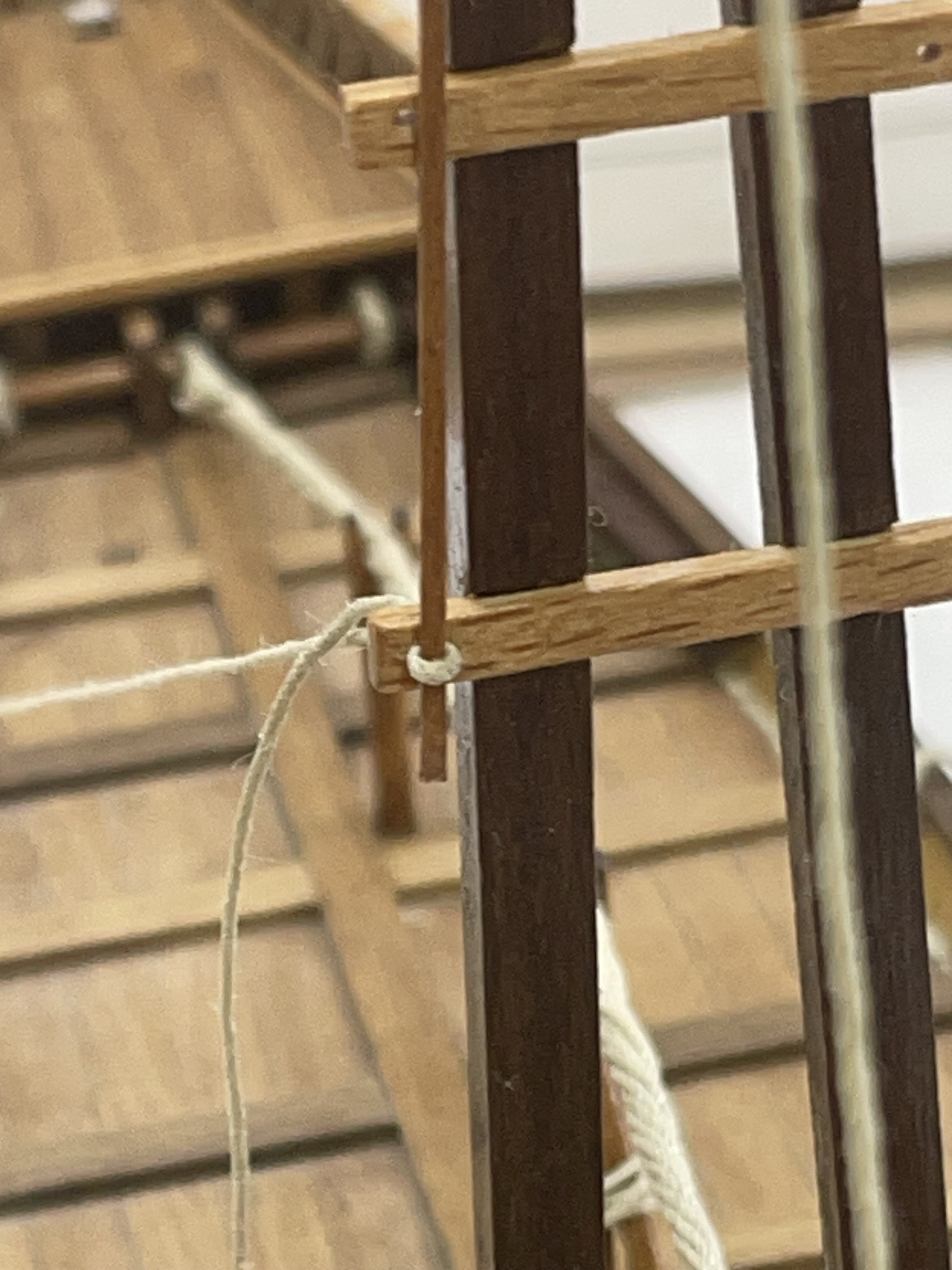

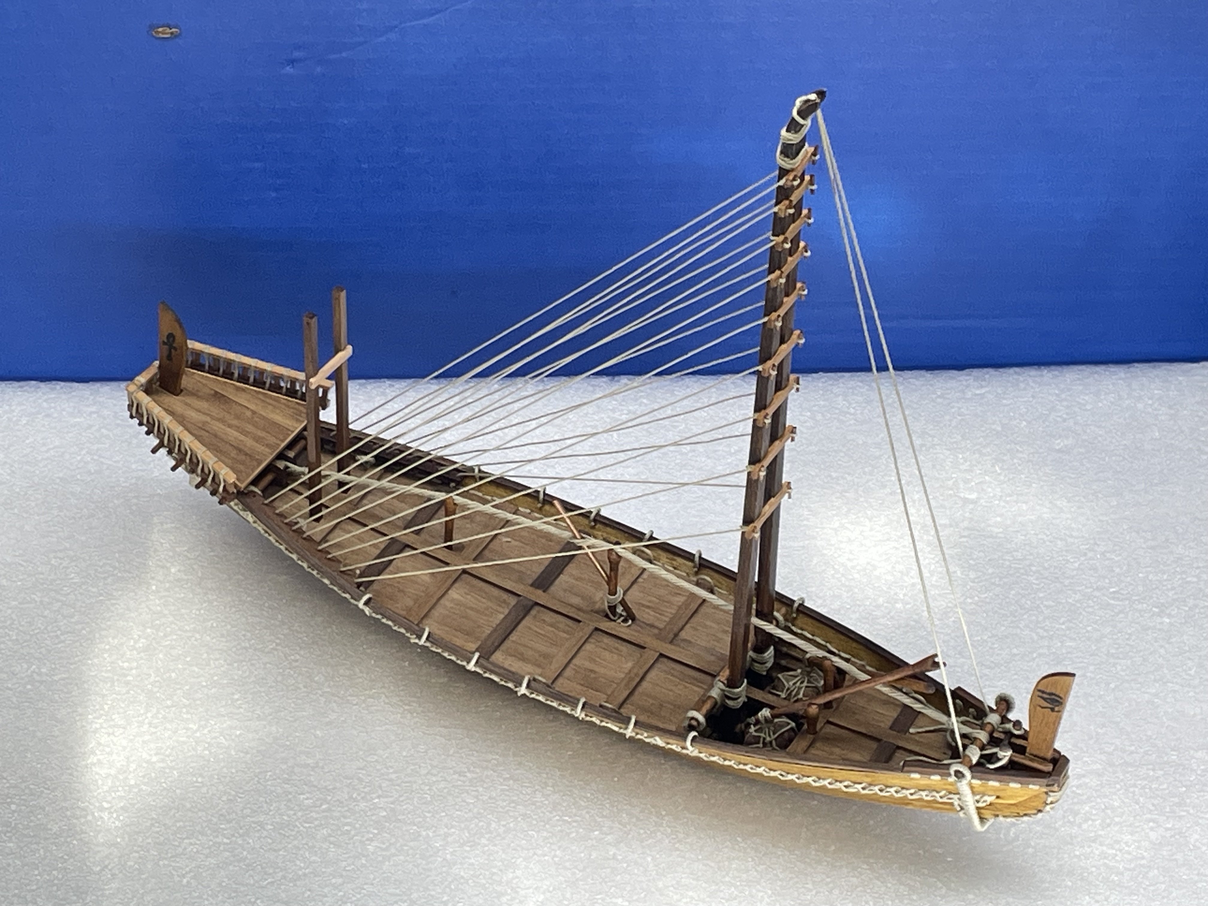

Standing rigging halfway completed. I started with the fore stay. First, the plastic mast head was making it hard to tie the lines on. So I drilled two holes for them. Then I thought it work better to wrap them around the beam holding the truss then tie them to the pins. Plus my pins may not be glued strong enough to hold tension straight up:-)

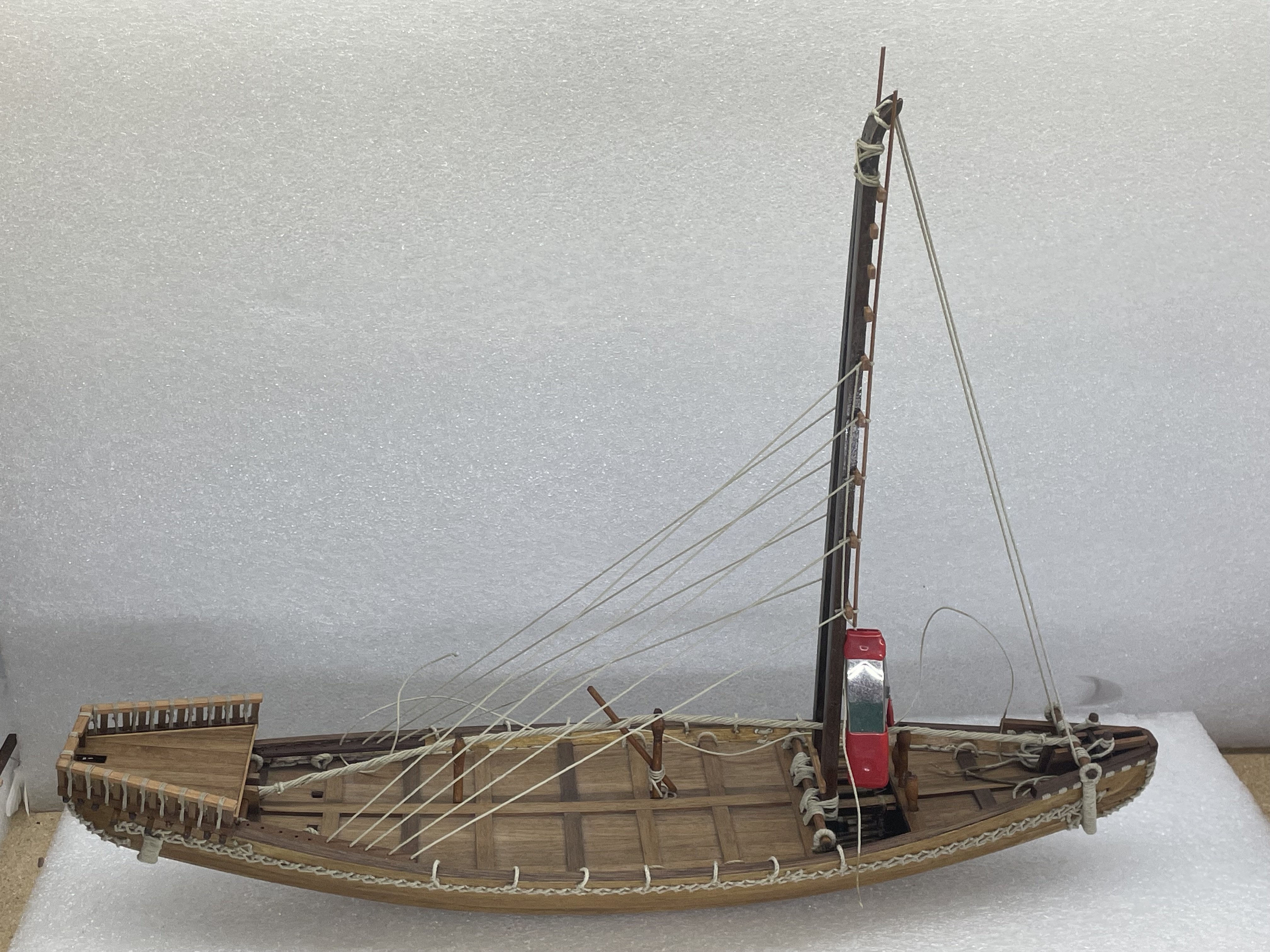

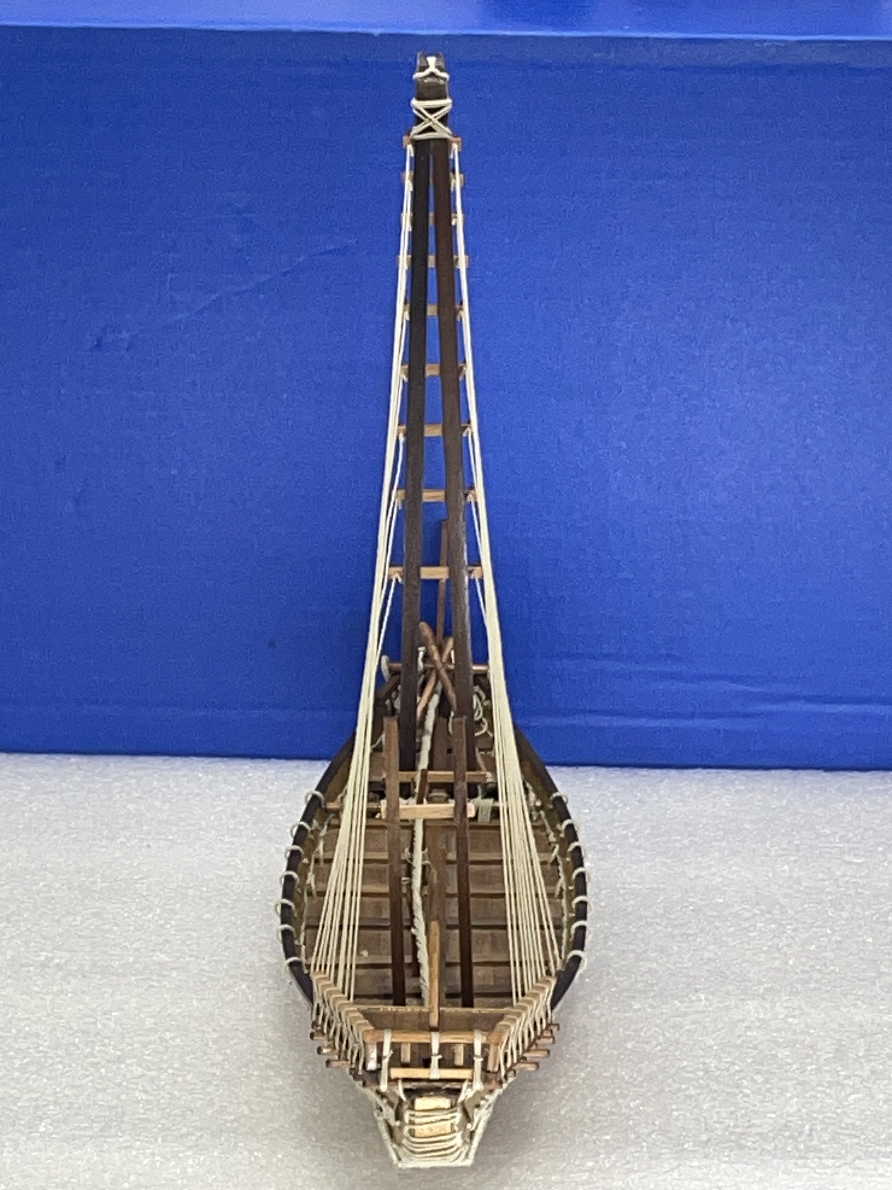

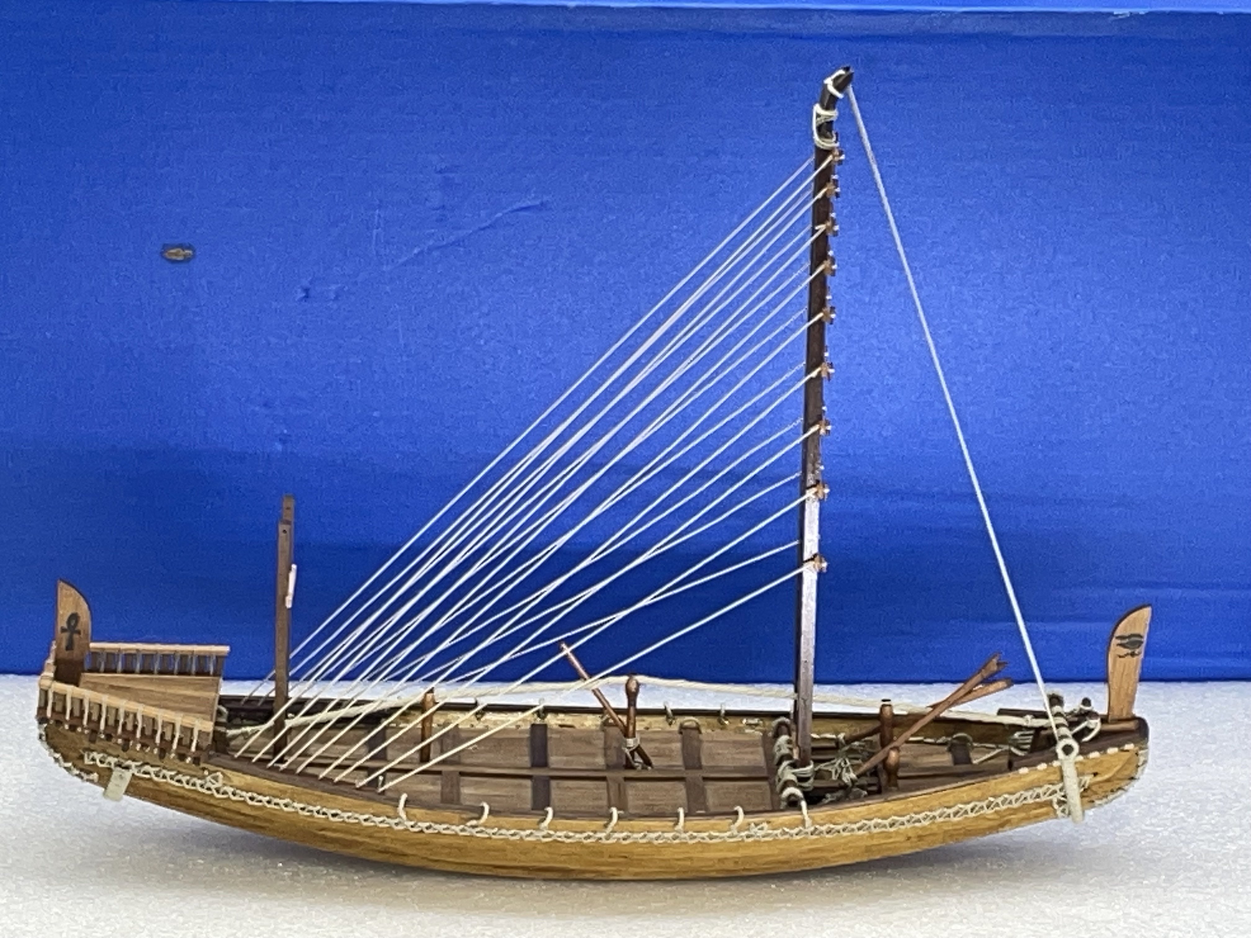

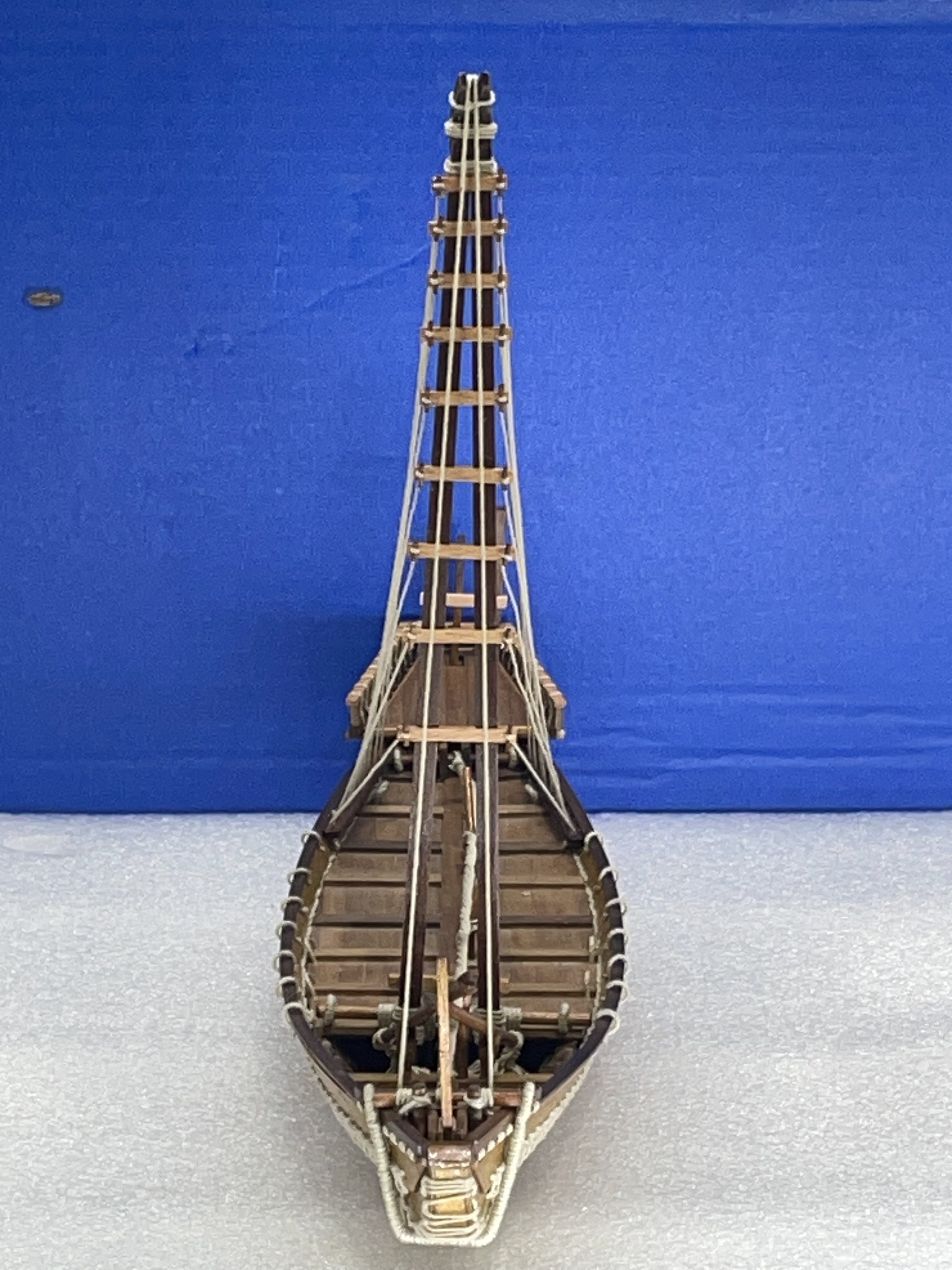

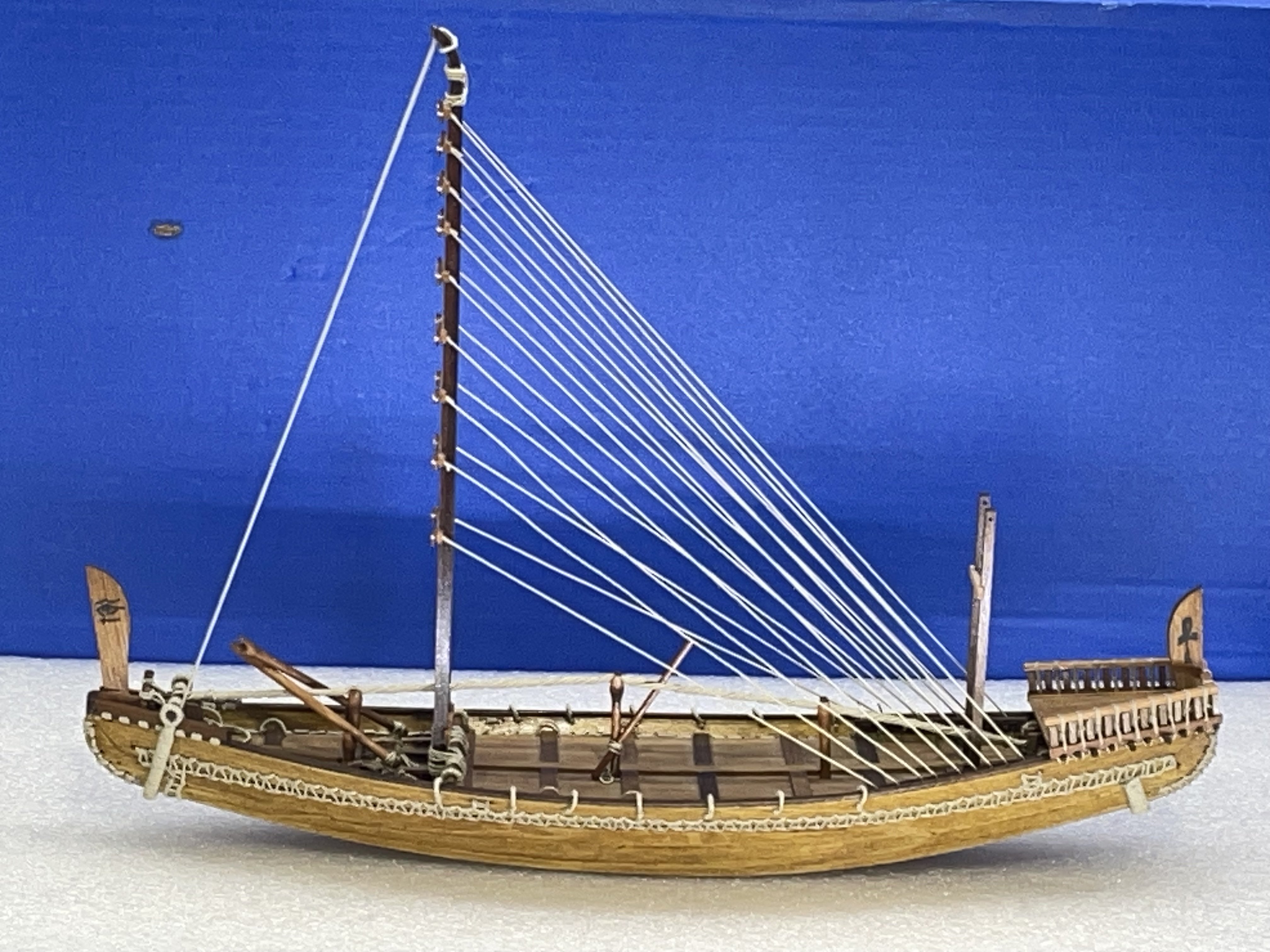

Standing rigging completed. I started on the lowers ones for the ease of installation. It would have been better to start at the top to keep the tension equal.

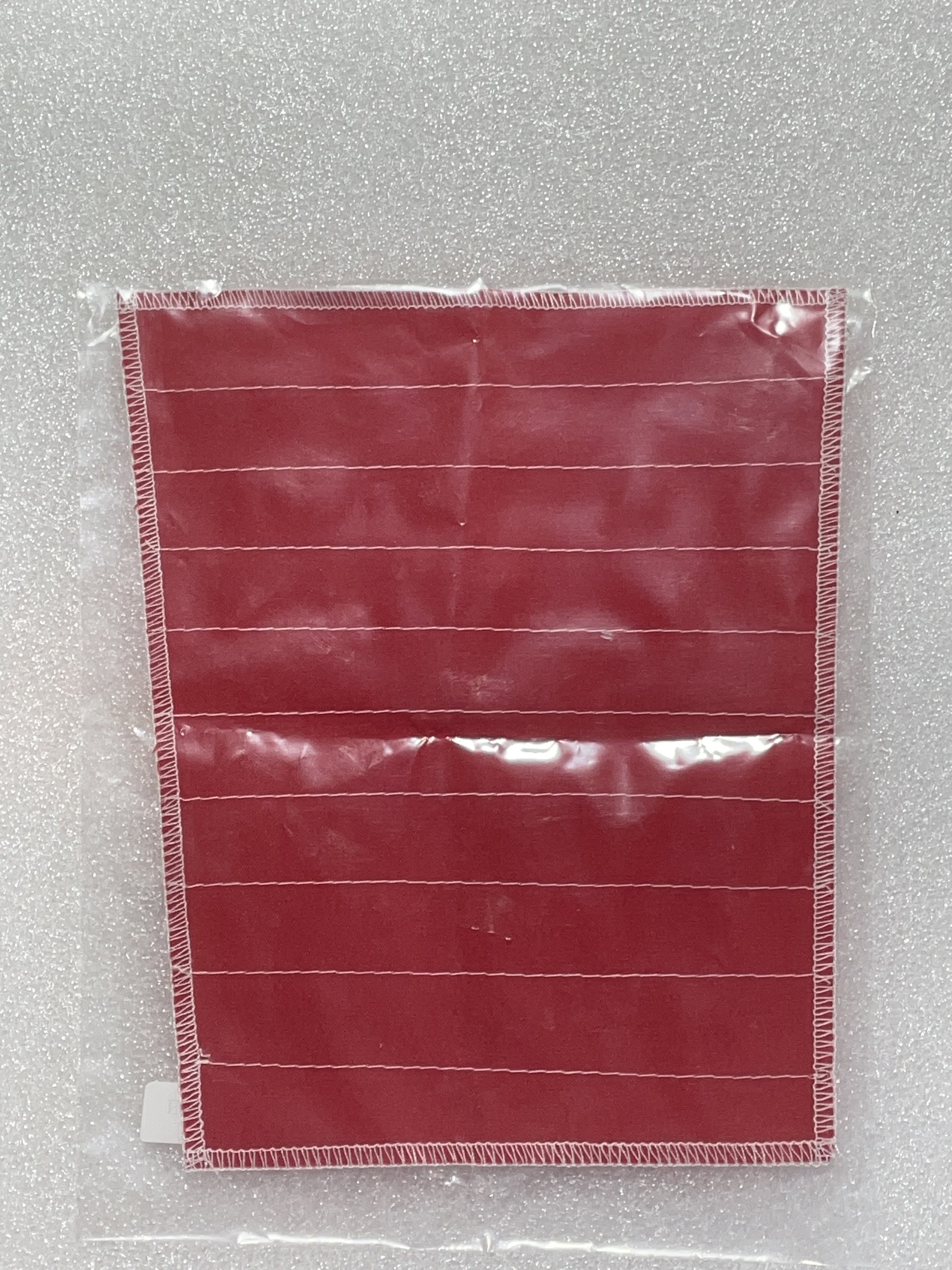

Here is the kit supplied sail.
Not liking the wide hem, probably going to make another.

Yeah, that's your typical machine stitching -- very ill-suited to scale modeling. I agree that making another is the right option.

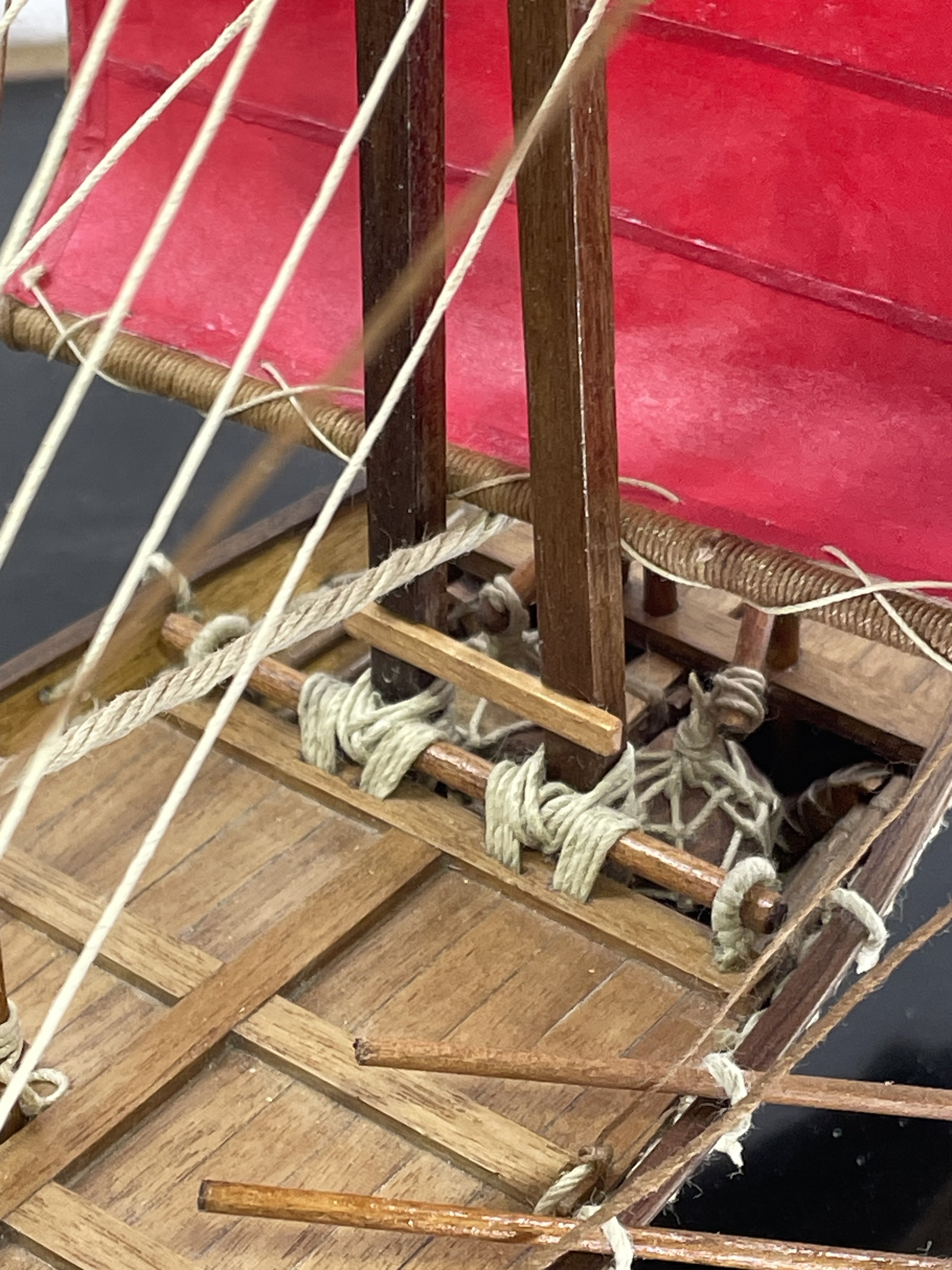

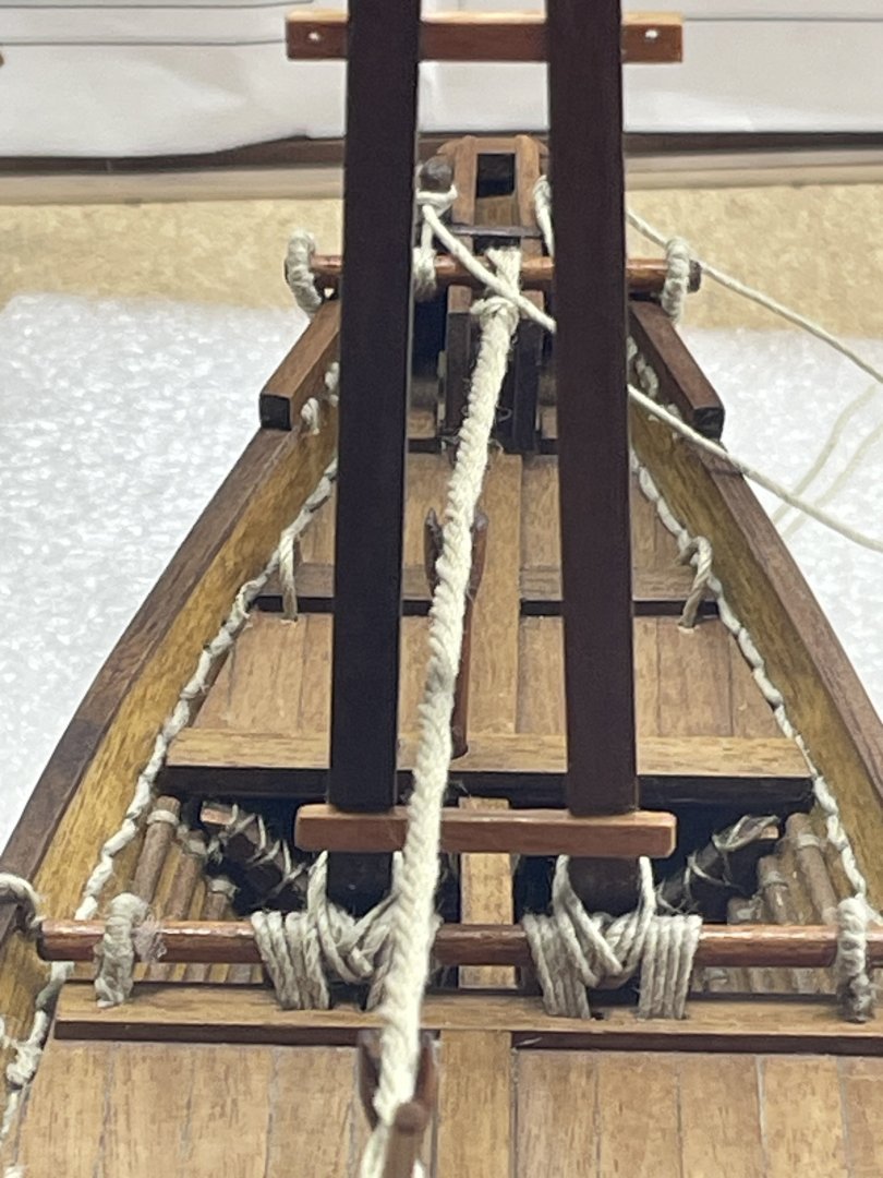

Trying to tie up a few loose ends before the deck gets crowded, I spent time on the boulders holding down the mast. I put a rope from the deck to keep them together. Then there’s part #71 top right on the plan. I don’t know what this is doing, but I cut it down and wedged it as a stop for the other two.

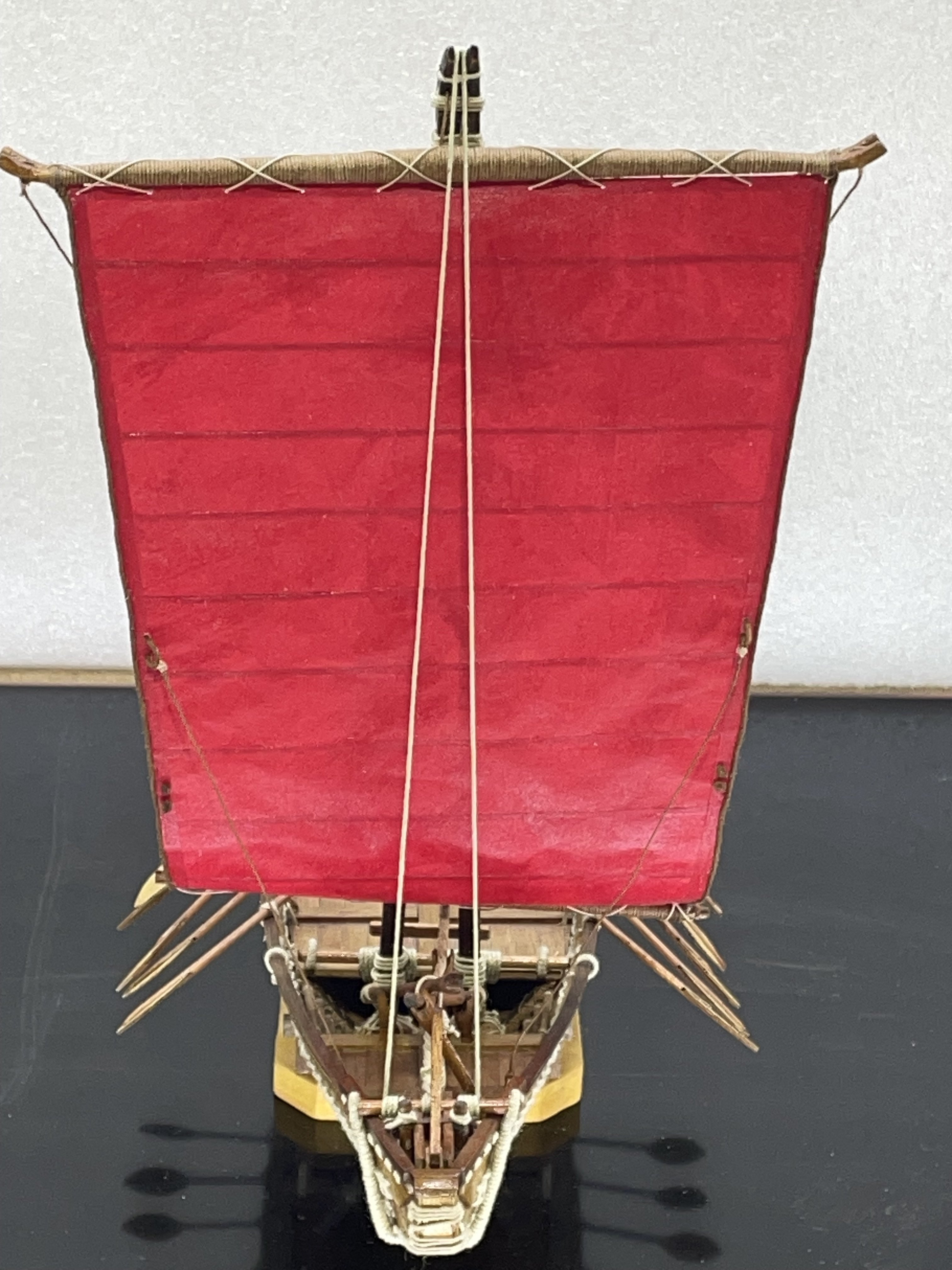

The top yard was different because it was flat on the bottom and tapered on the top. The ends were made from 3 parts glued together then shaped and glued to the yard.
After this it got wrapped with rope that I dyed a darker brown.
For the sail I used artist tea paper I got in a roll. The last I had was on a board and the folds showed.
I traced the sail and the seams on one side and painted the other with acrylic paint. Then cut it out. On the unpainted side I glued 1mm strips on the seams and 3mm on the sides.
After they dried, I glued them on the painted side, using the others as a guide.
On either side I glued a 1 mm bolt rope the same way I did the strips.
After holes were drilled. I lashed the sail on both yards.
Nice work, that sail looks much better than the one that came with the kit!

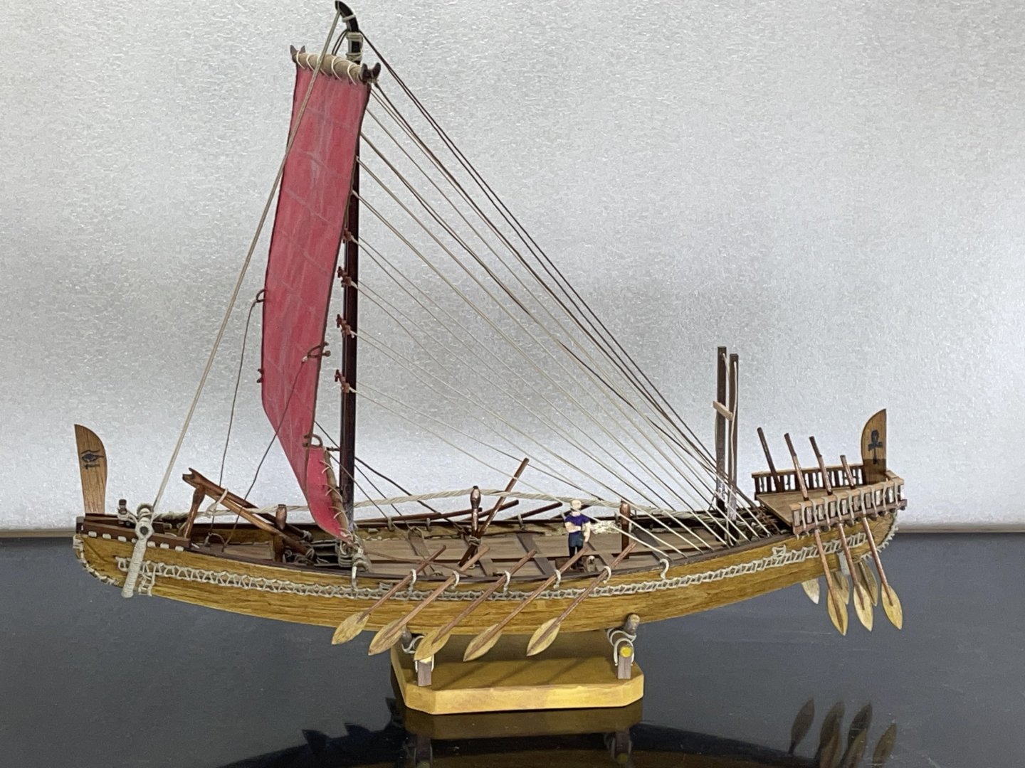

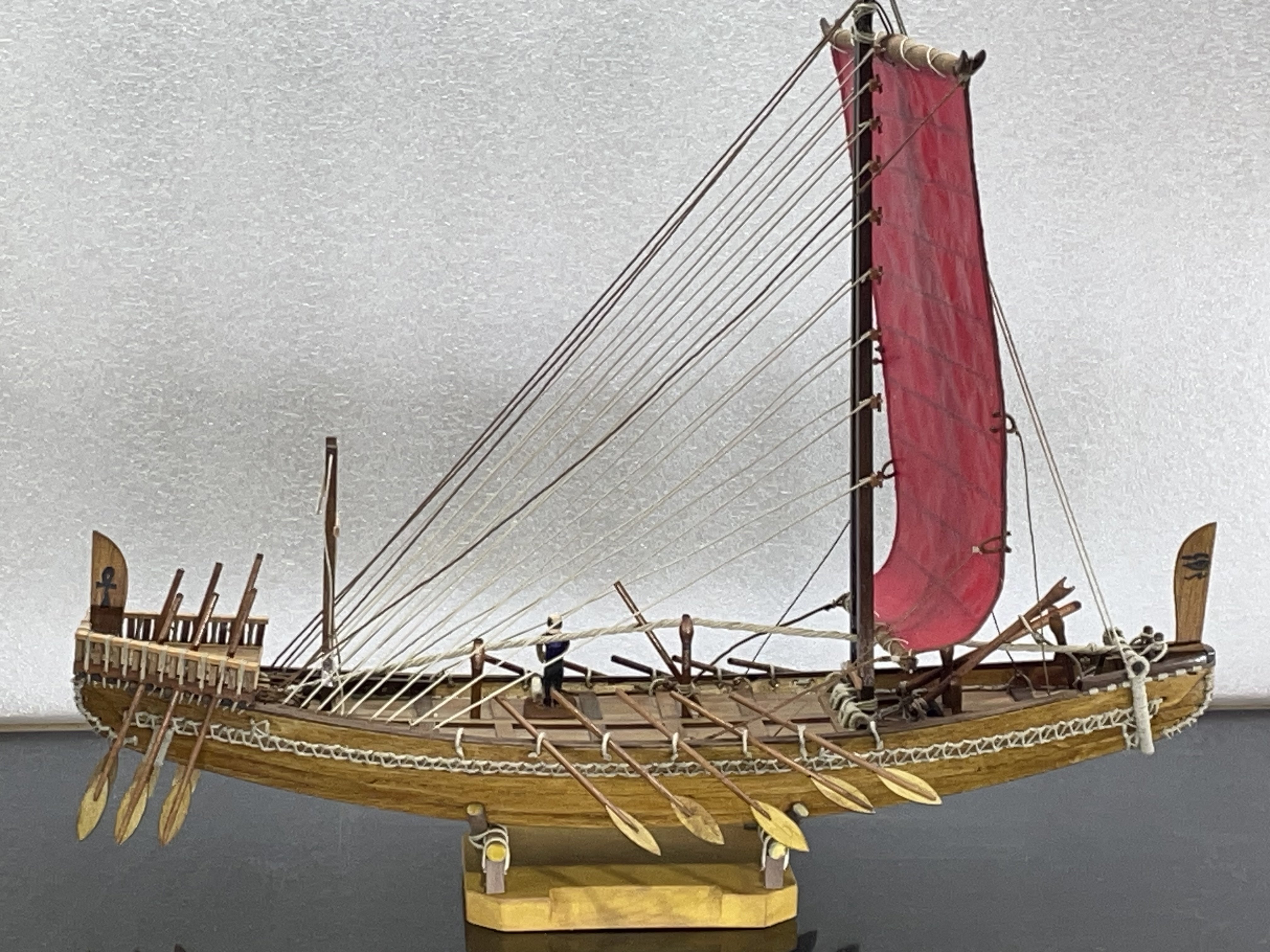

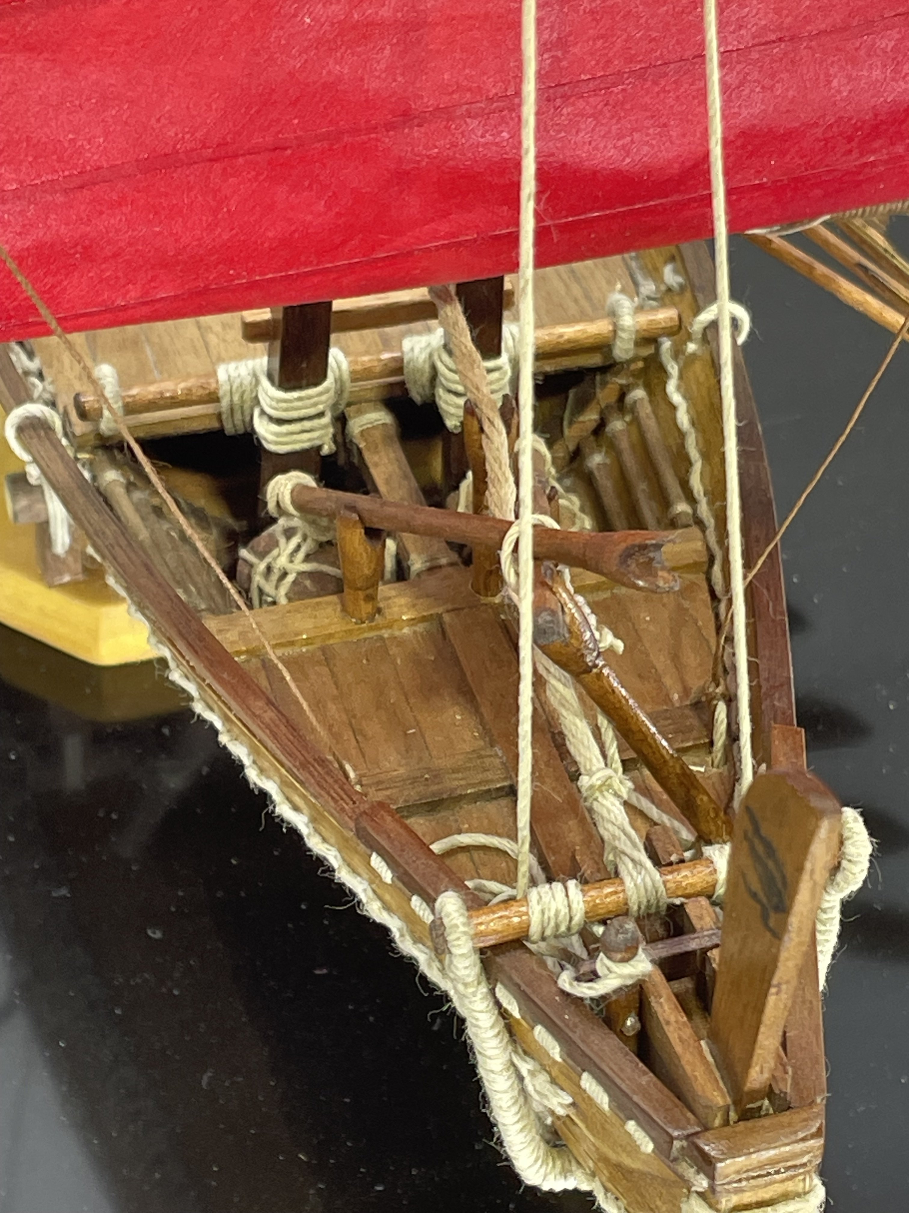

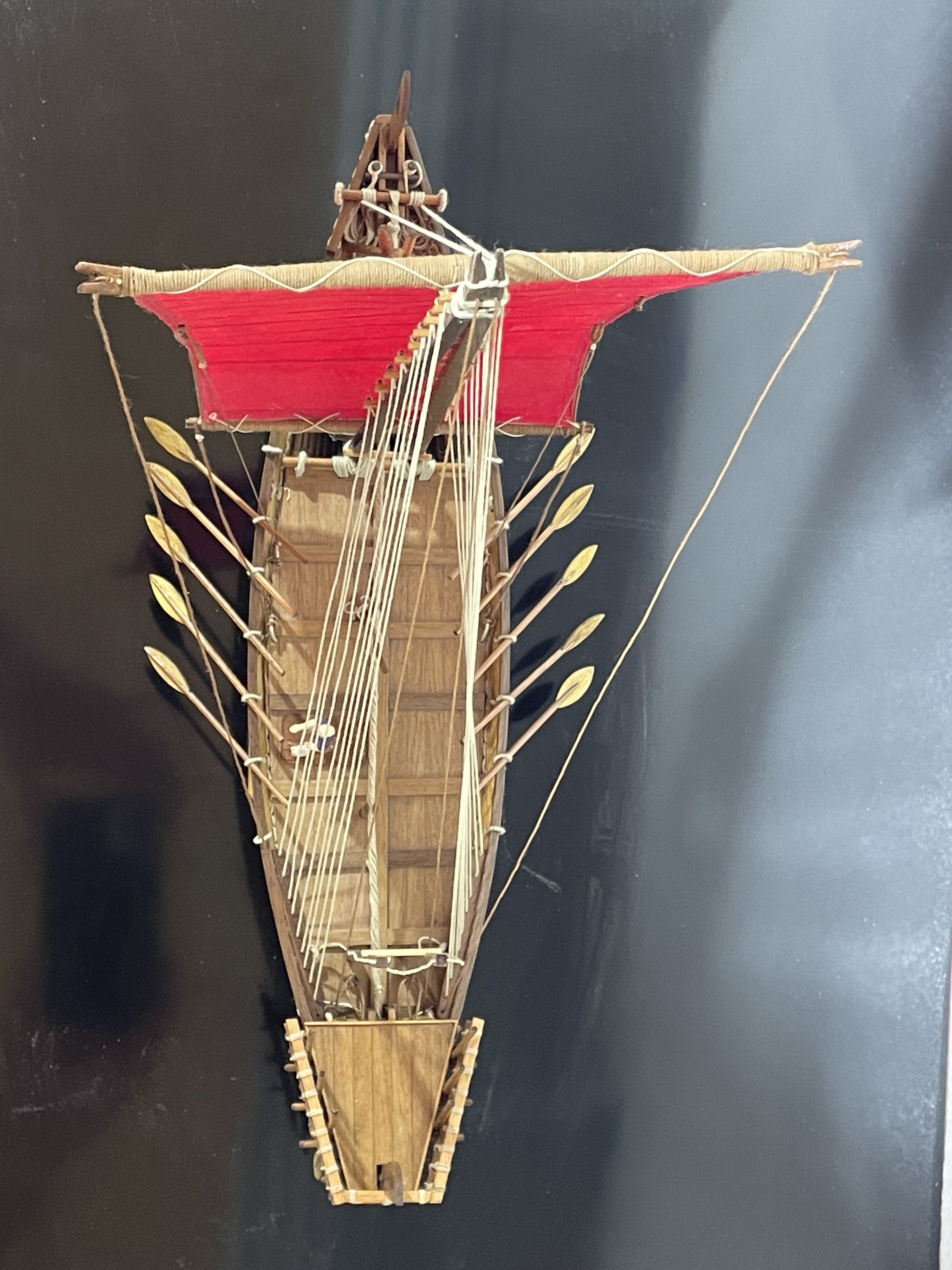

Well, kinda sad to see this one end. But there will always be another. I would rate this kit high for nice materials. There were some challenges, mainly figuring out how some stuff needs to be done. Here’s the finished pics.
Thanks for all the comments, likes and views:-)

Great job my friend  , the joy of  starting another  ship takes the sting out of finishing one lol. Start a big one you have the room now . :cheers:
Congratulations   nicely done.

Excellent job! The rope work is really fascinating and unique, this looks like it was a very fun model to build.
