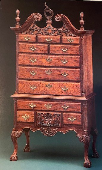

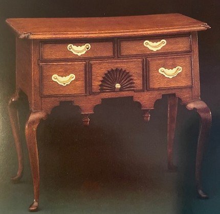

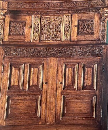

Like to see and hear what you think about owning a laser for building scale miniatures.  Whether it be ships, buildings, RC, etc.

Examples: These are all 1/12 scale

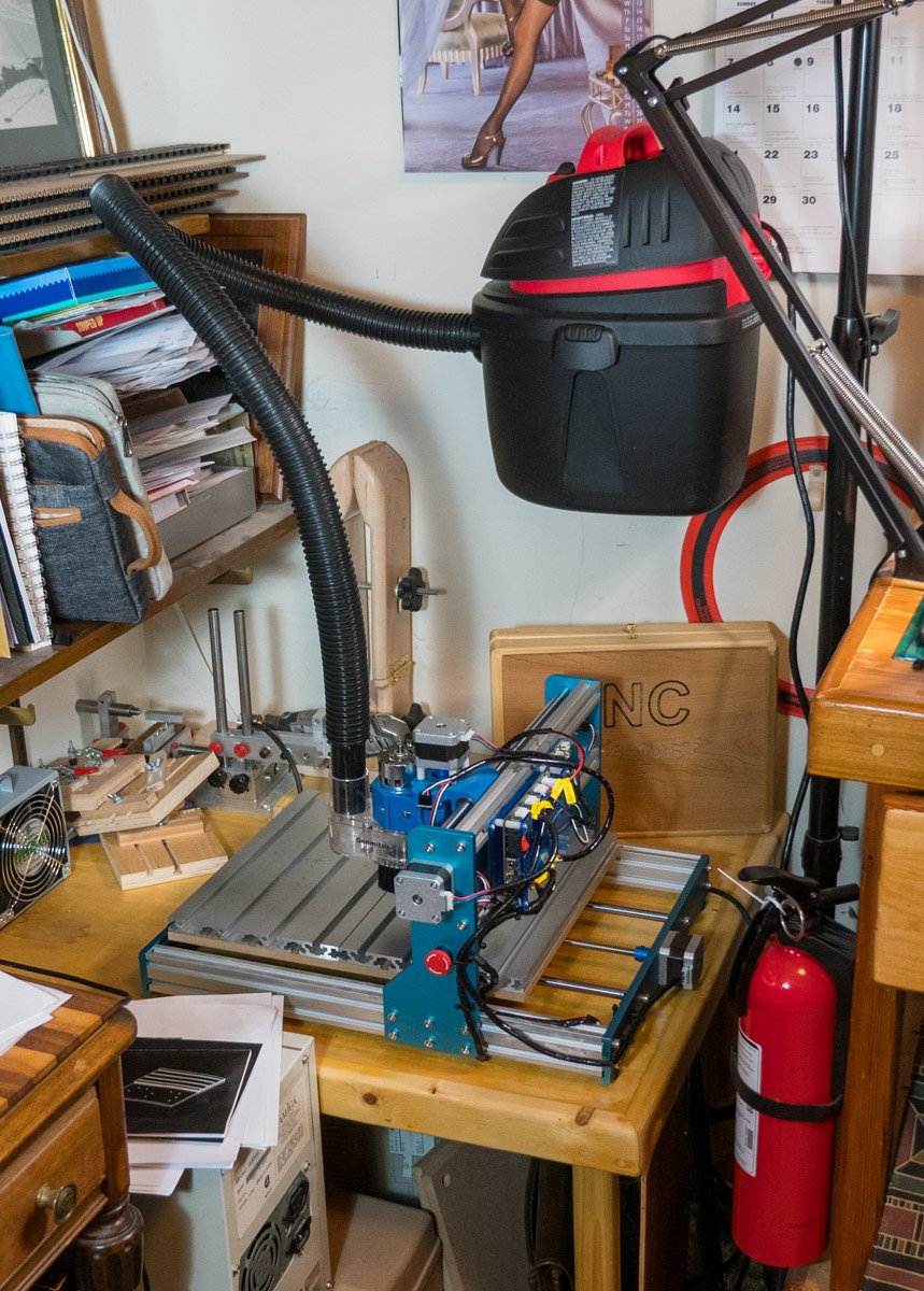

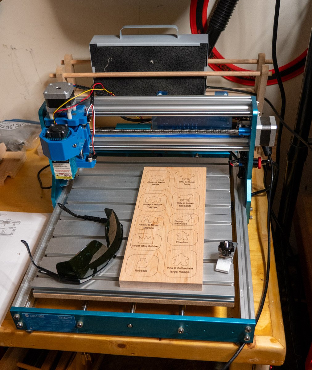

I bought a Genmistu 3018 PROVer several years ago.  It can be configured to use a laser or a spindle motor; I bought a package that included both.   I had a project that could use the laser to burn graphics in wood (a fancy wood burner).  I upgraded my machine with an expansion kit to increase the work envelope of the machine. The Genmistu is a good learning machine and they also have good support.
I discovered the spindle configuration is helpful in model ship building.  The first thing I made was stairway sections to replace broken pieces.  I took measurements, drew it up in CAD software, converted the file using CAM software, and ran the G-code file using controller software to operate the machine; I was able to duplicate the original parts.  I made a jig by routing a shape for railings, I used the jig to bend brass wire and made railings that all turned out the same.  I scanned a plywood piece and created pieces to cover the plywood by cutting walnut veneer with the spindle.
Learning a hobby CNC machine requires that you learn a variety of software.  I found the laser configurations with Lighburn software was easy to learn, Lightburn is probably the preferred laser/machine control software; it can be used to design and control your machine.  For the spindle configuration I used free software but you need to know how to troubleshoot different software working with each other (I experienced frustration until I figured it out).  Based on my experience with the Genmistu I bought a Onefinity CNC router for my garage, a bigger, more powerful machine.  I also got VCarve software to produce G-code files for my Onefinity. it is a complete product like Lightburn except it is for routers (I can use it for both of my machines).  VCarve can also produce carvings using clipart.
I wrote manuals to operate and service industrial CNC machines so I have the basic knowledge of how G-code works and how CNC machines work.  This is useful knowledge but it isn't necessary if you have good software like Lightroom or VCarve.   I bought my first hobby machine to perform a specific project but I knew there is potential for other uses.  I considered the cost to be tuition to learn CNC software and processes.  Manufactures often have forums that I've used to help solve problems.  I use my garage CNC router more often than my bandsaw now.
